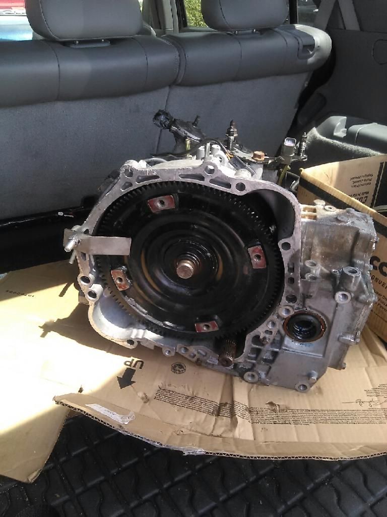

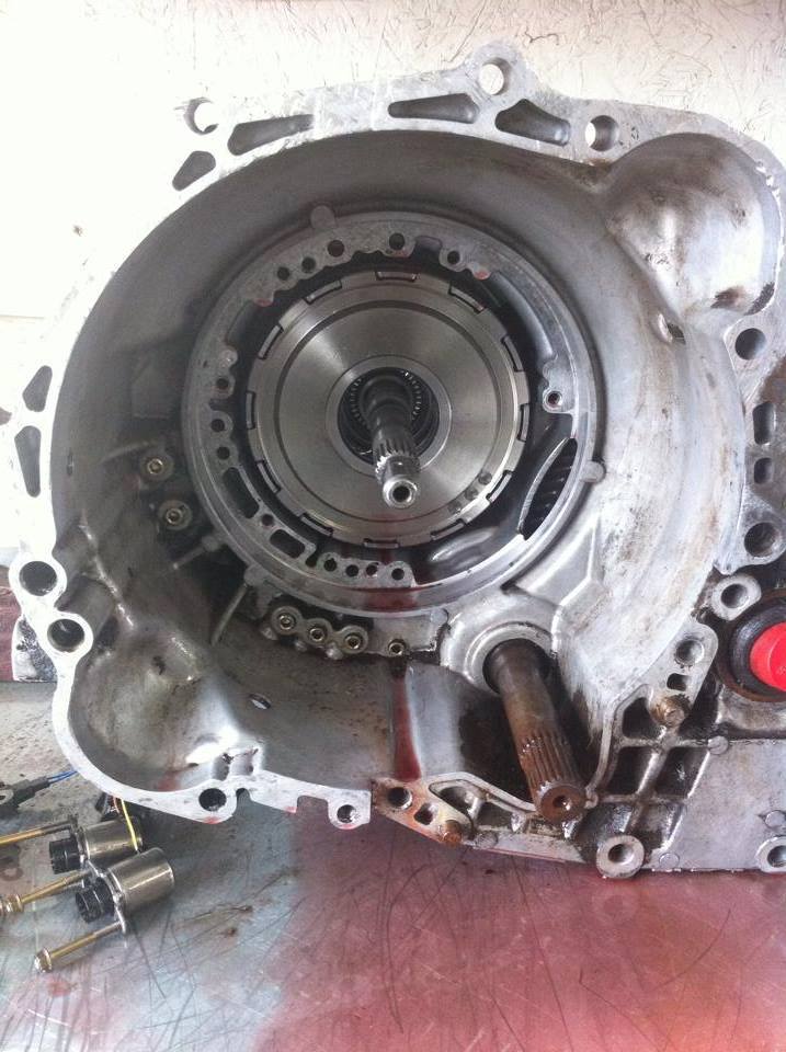

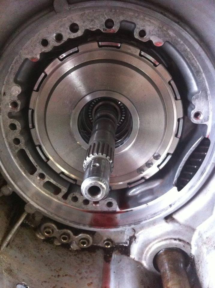

Alright, good stuff so far. :) I finally took a few days to just relax and breathe, and I came back. The wavespring and pressure spring that sits behind the planetary cover, were both in backwards. So I flipped them around, applied pressure with my hand while installing the snap ring, and bam. It went into place perfectly. Brand new forward, direct, low-reverse, and End clutches. :D This was the result.

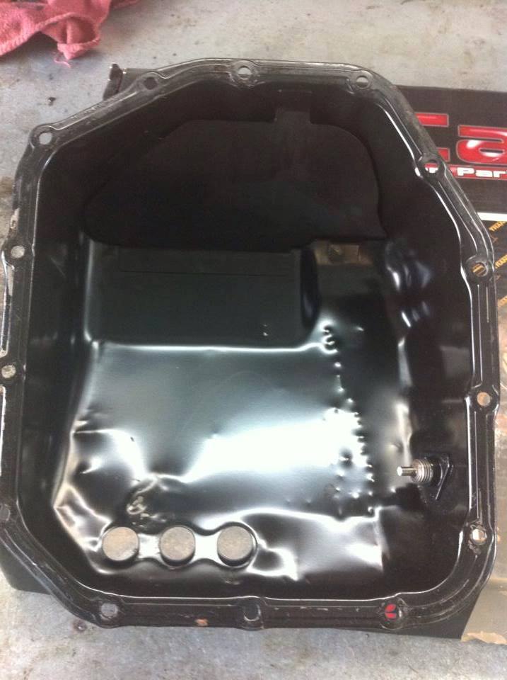

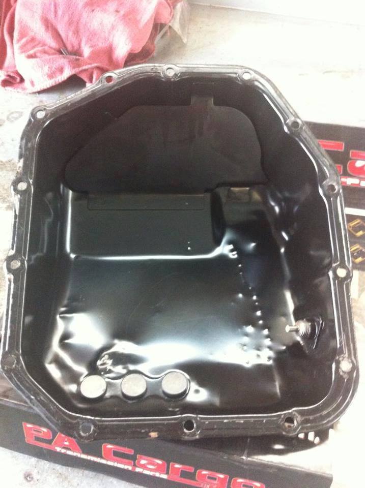

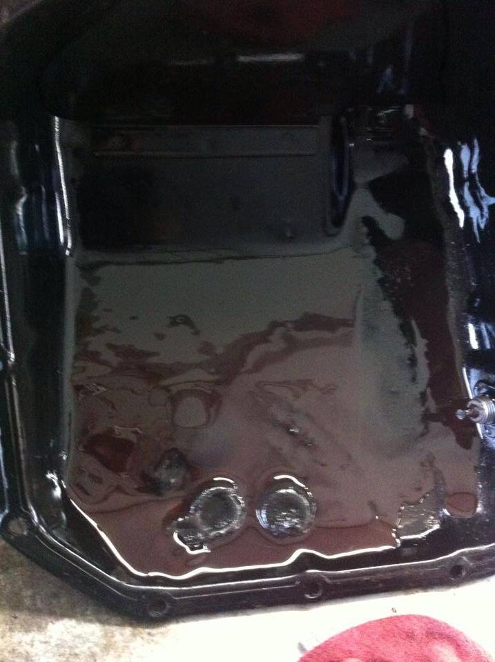

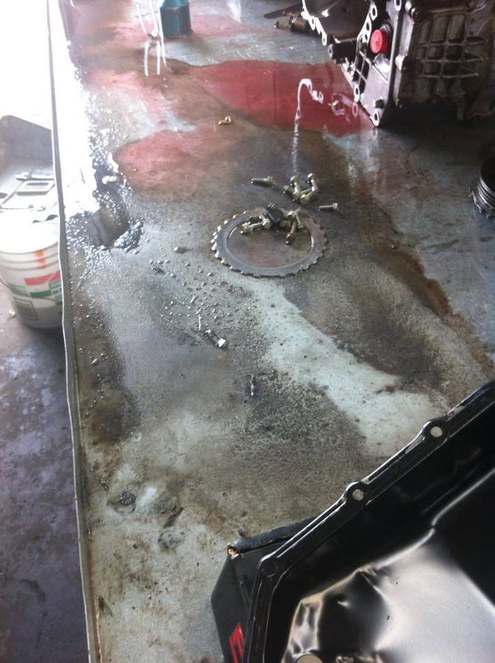

So after that was accomplished, I set about my attention on the transmission pan. Oh my word was this thing...abhorrently filthy. It doesn't look so bad in the "before" shot with fluid in it...but pay attention in the "after" picture of all the bumps and bangs in the pan that you couldn't see before. It's because there was an easy 1/8th" worth of clutch material sticking to the pan everywhere, and the magnets were roughly twice the size of normal, because of clutch material and metal shavings from the previous failed fluid pump. There was so much clutch material it completely got through the cheap POS filter, and clogged the VB. There was so much covering every solenoid screen, it looked like mud. Included is a picture of the screen from Solenoid B. It was so clogged, it tore the screen. Ridiculous.
What a difference, right? That's the same pan. Whoa. :p

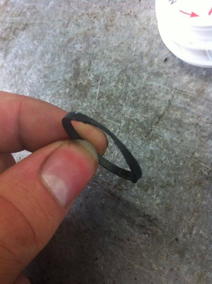

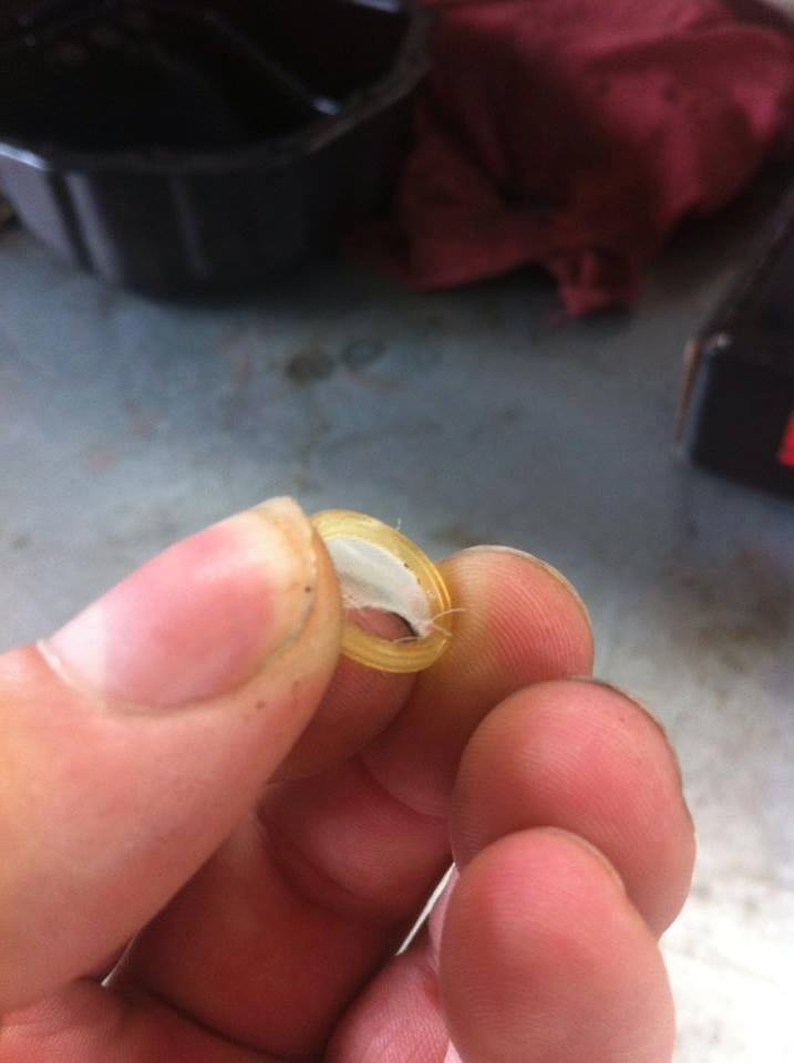

Also, here are the remaining two pictures. One is the screen from Solenoid B with the tear, and the other is the sealing ring[one of three] for the input shaft. It was torn like you see.

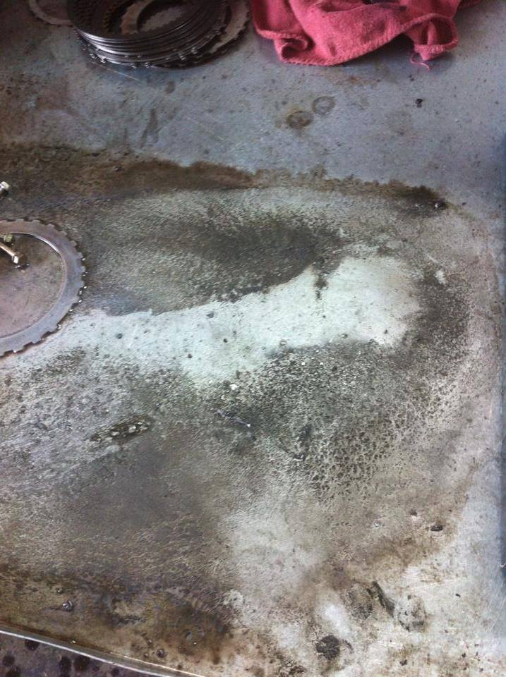

Also, as a bonus for getting this far...this is what came out of the transmission pan while I cleaned it. That's not dirt, the table was 100% clean before this. Every bit came just out of the pan, and there's probably 80% more than I scraped off the table before this picture.

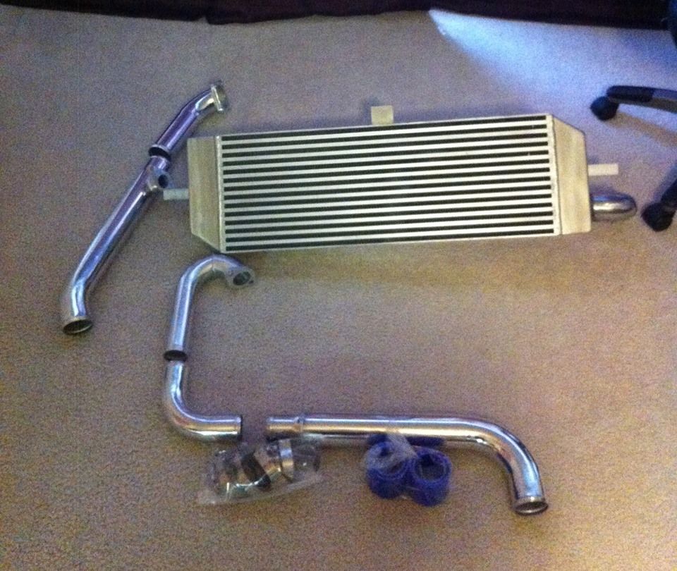

This big boy came today. Man I didn't remember/realize just how big these SSAC FMIC kits are for the 2G. Let's pray I don't have overheating issues. :p

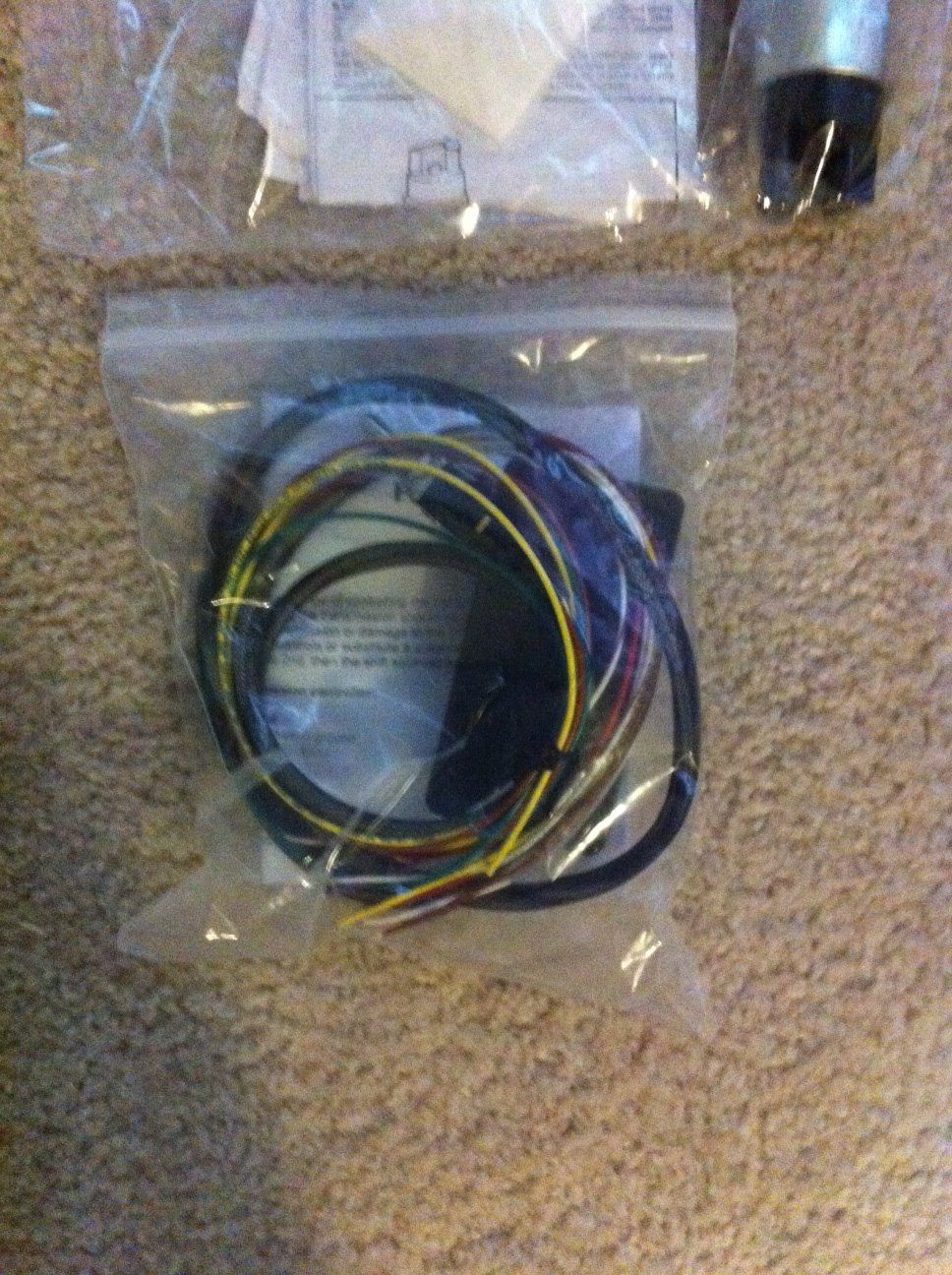

Got some new parts today. One is boring, one is exciting. :D

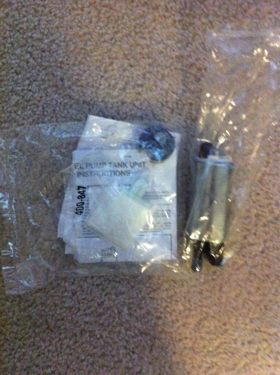

New Walbro 255 High Pressure

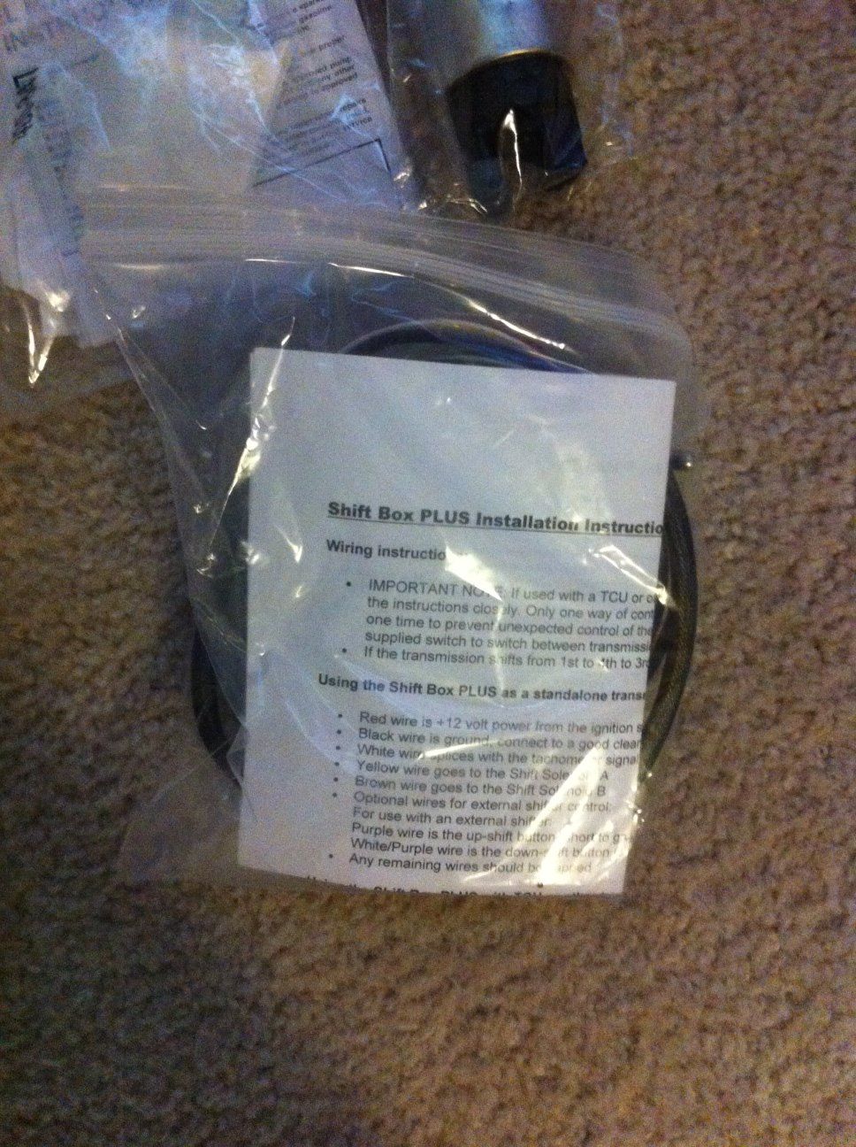

And the fun one...ForcedFour Shift box Plus w/ blue display. :D Got a steal on this.

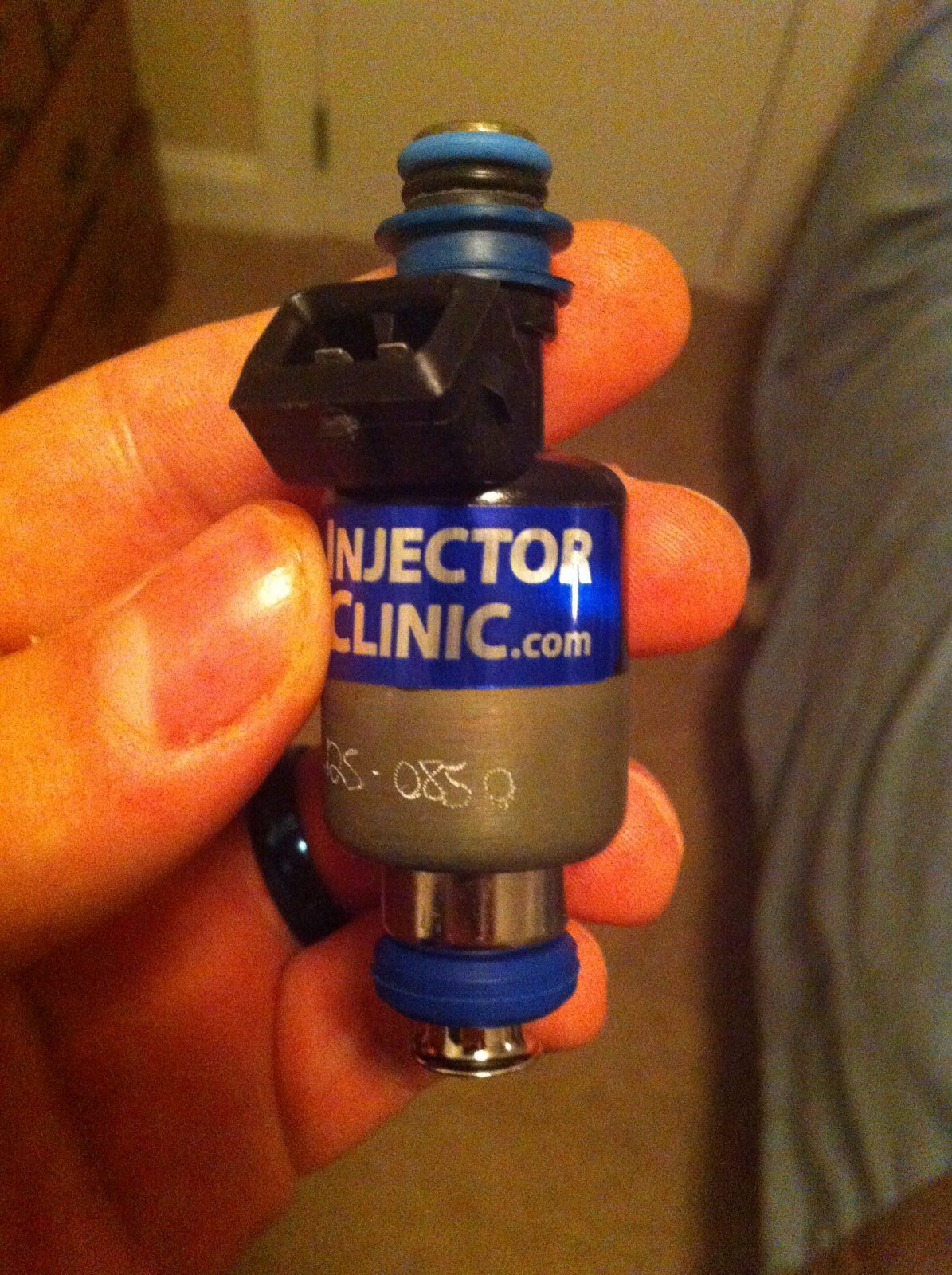

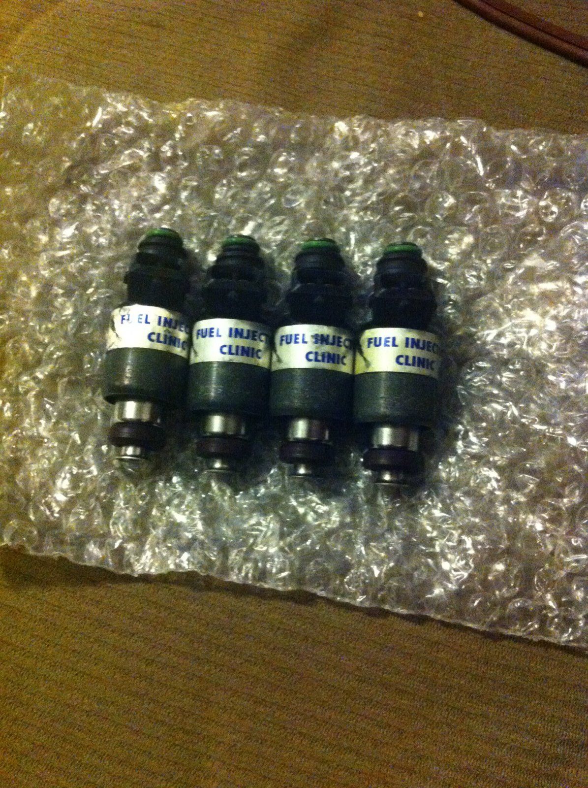

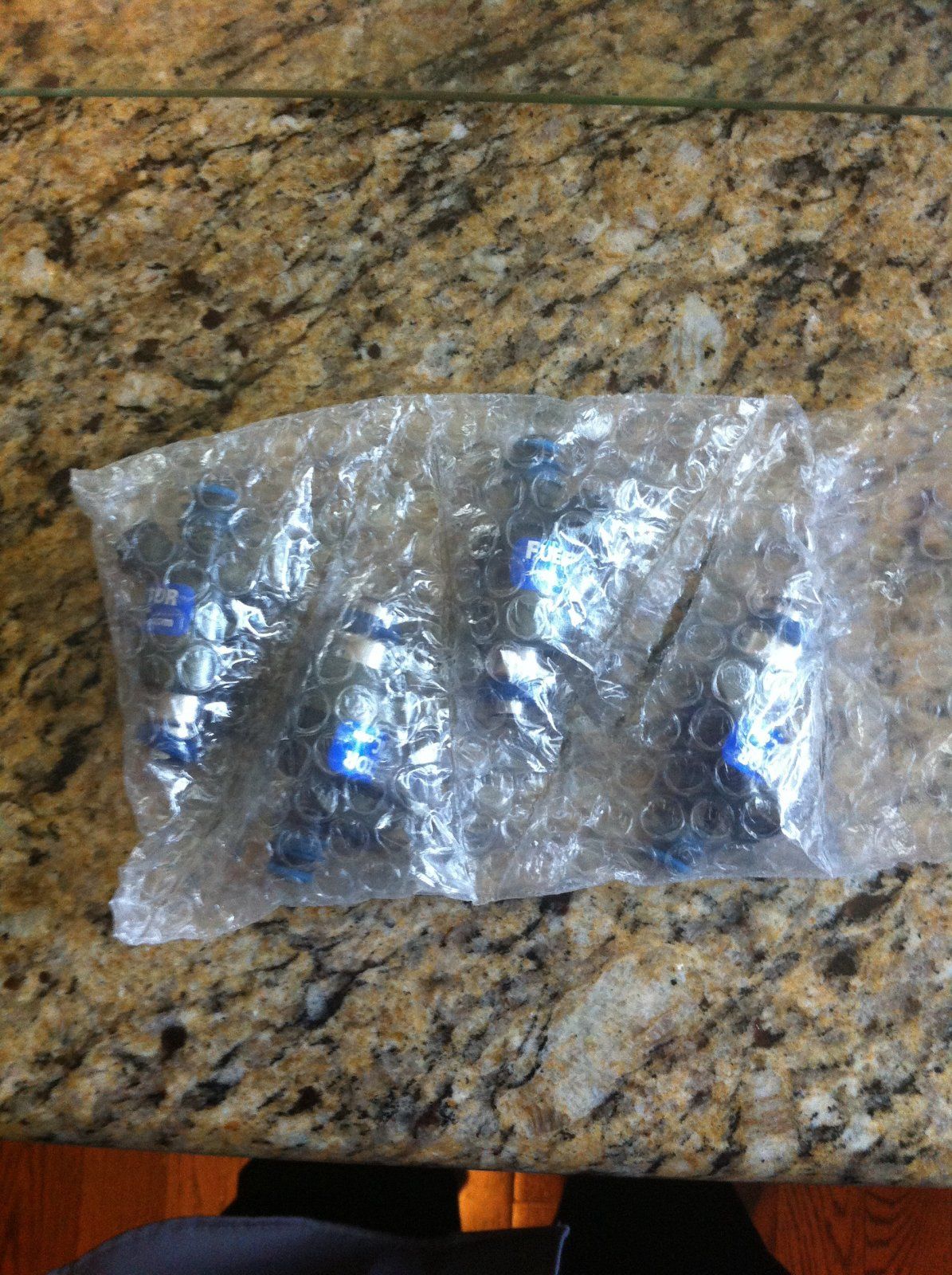

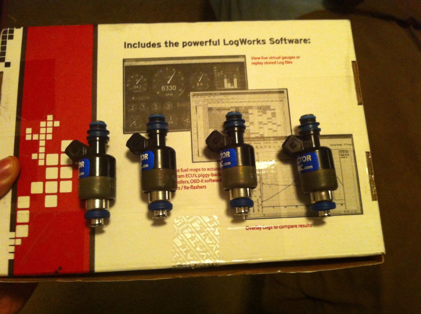

So. Funny story. The package usps lost was actually FIC 850s. However they found it, LOL. But during that time I ordered more. Well the second set came in today and man am I glad they lost the first set. I found a brand new set of the blue max 850s for the same price as the older set. :D so needless to say now I'll have a set of FIC 850's for sale. :p
Older set
New set :D

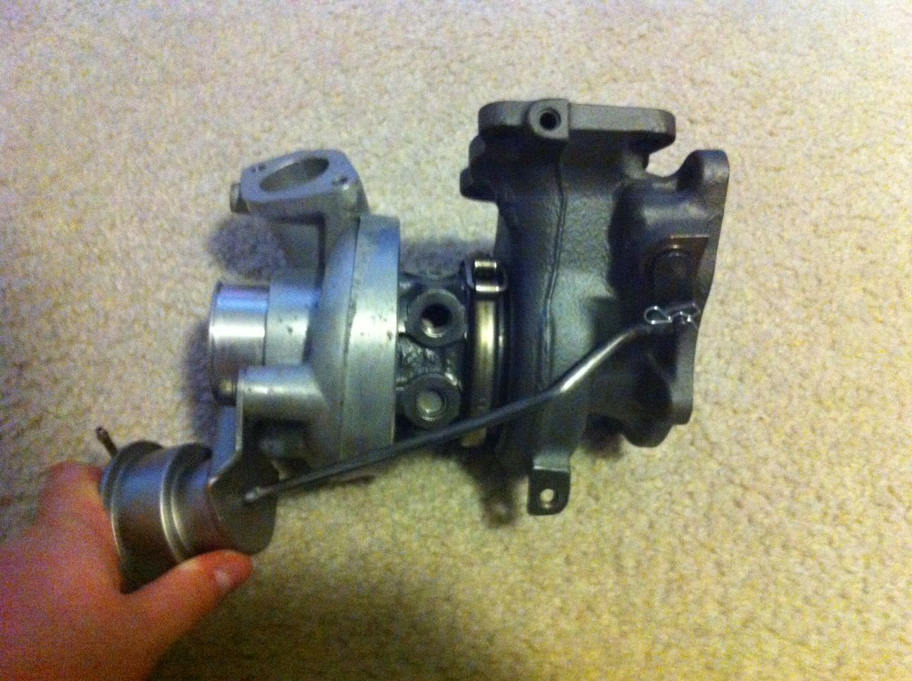

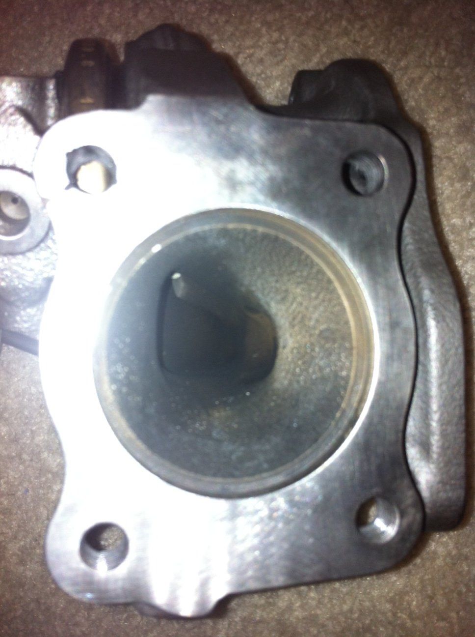

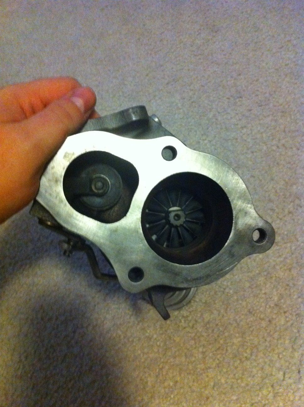

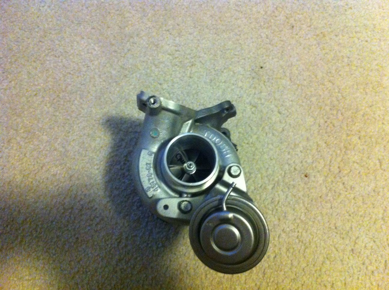

:D It's an Evo 3 16G, freshly rebuilt from the man, the myth, the legend, Justin Whitesell aka Jusmx141.
:D Unfortunately depending on my transmission situation, it may also be for sale here soon depending on how bad I need the cash. But in the meantime it sure is a pretty piece of equipment. Stay tuned, fellas.

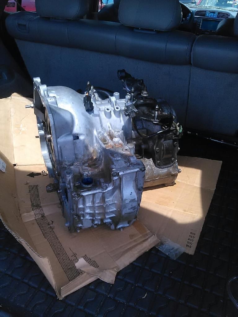

Well, no need to sell any more parts(hopefully!) :D. Transmission finally was paid today, and I feel a lot better about it than before. Apparently the drum was burned up something bad, and there was metal all throughout the transmission. Rebuilder said it was the most he'd ever seen, so thank GOD I didn't try to rebuild this myself and run it. BW clutches and steels, new band, new front pump, new solenoids and VB, translab shift kit, blah blah blah. Finished off with a Buschur/Bushwacker Torque Converter. :D Looking forward to this thing finally. From here things shouldn't be so damn complicated and hopefully I'll be posting lots of videos of the cross-country drive in my 2G hotness from FL to NC.

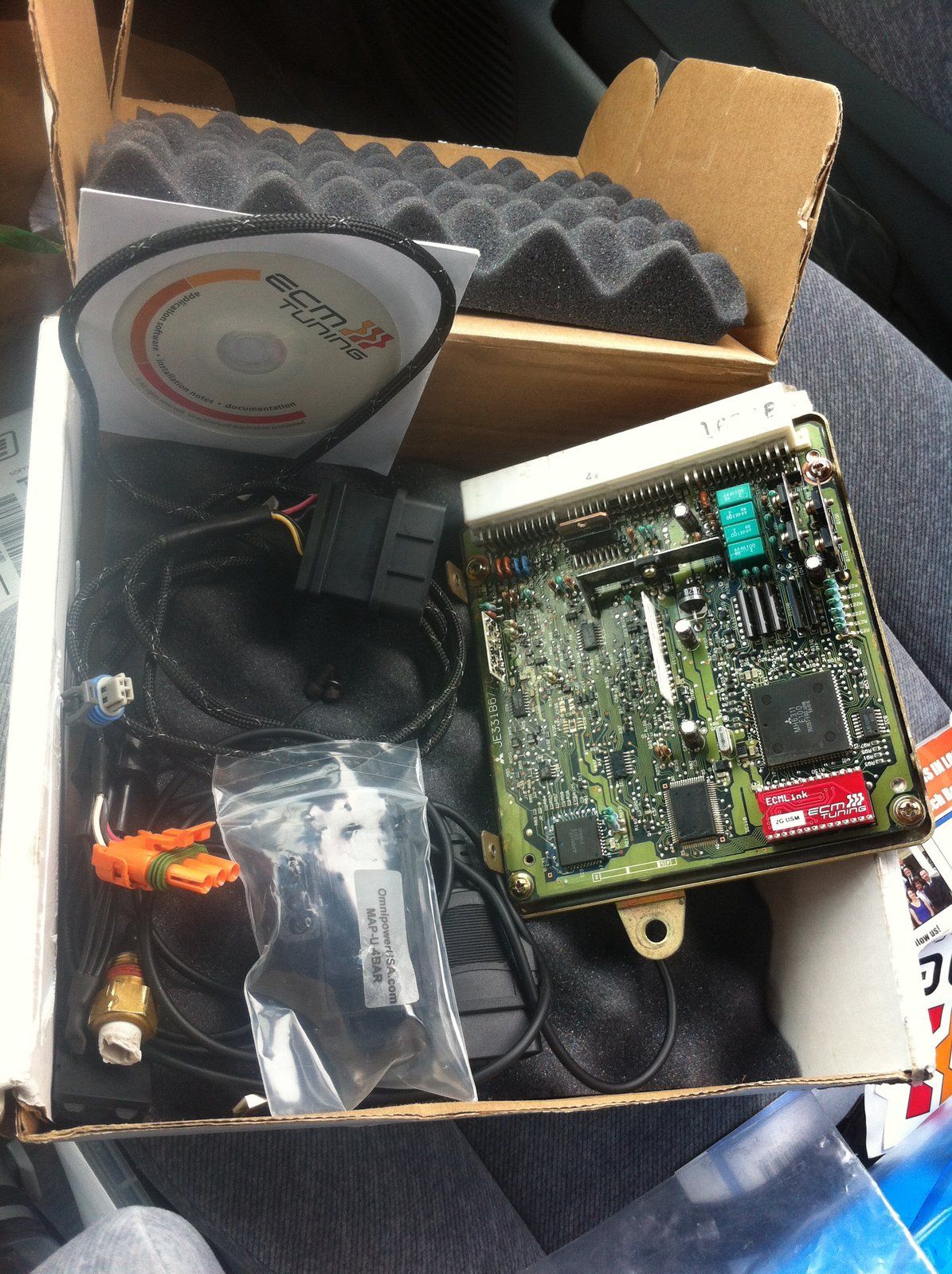

Well, no pictures or anything, but it's finally running again. The transmission was rebuilt but the shop forgot to drill out the separator plate when installing the shift-kit, and they forgot to install a ball bearing/spring, so I made them fix it. The car is still in FL being driven by my father to test it out, and I had to sell the ECMLink and the injectors to help pay for the transmission, still got the 16G and the FMIC, for now and I hopefully plan to use them once I know the car is done with having it's issues and bi*** fits. :p
