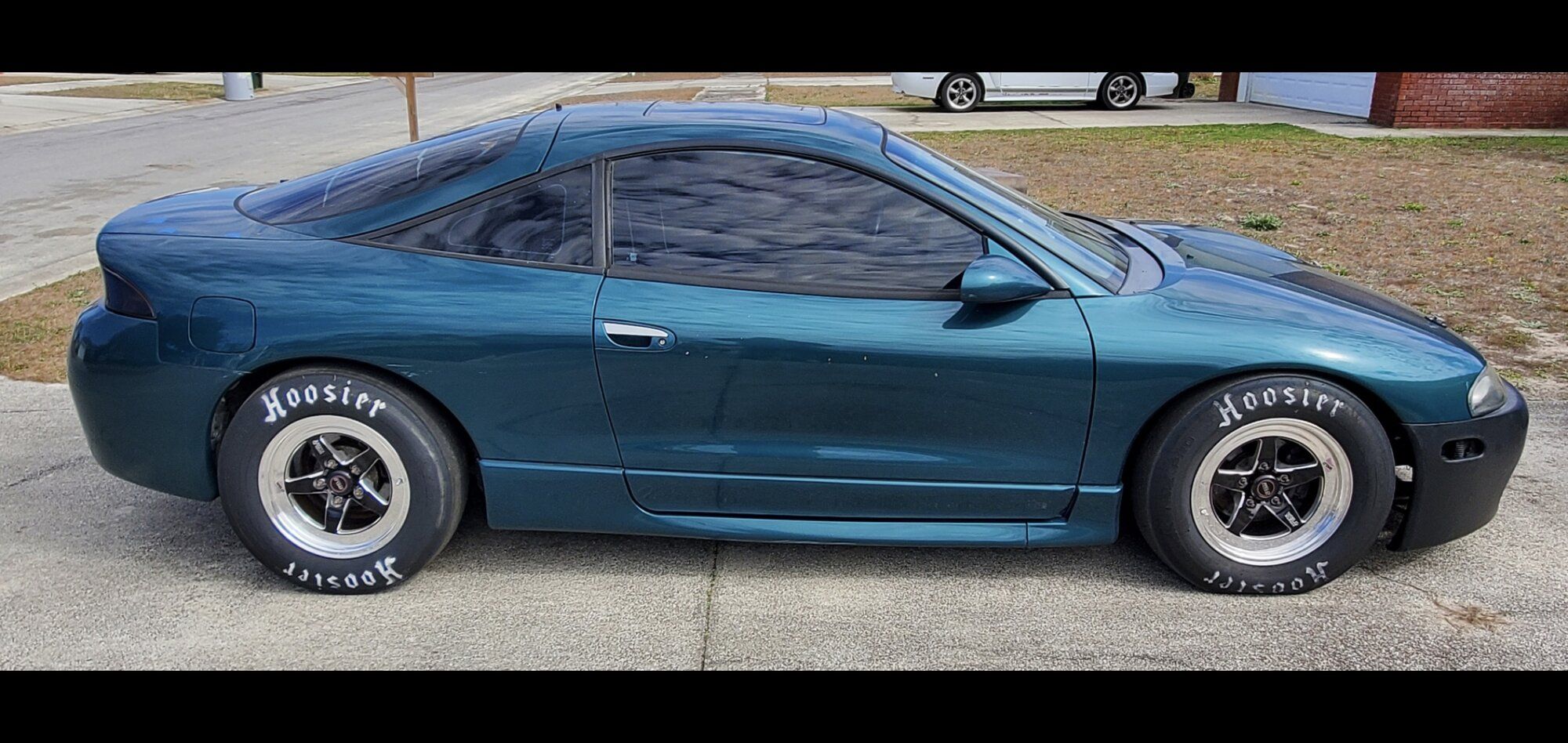

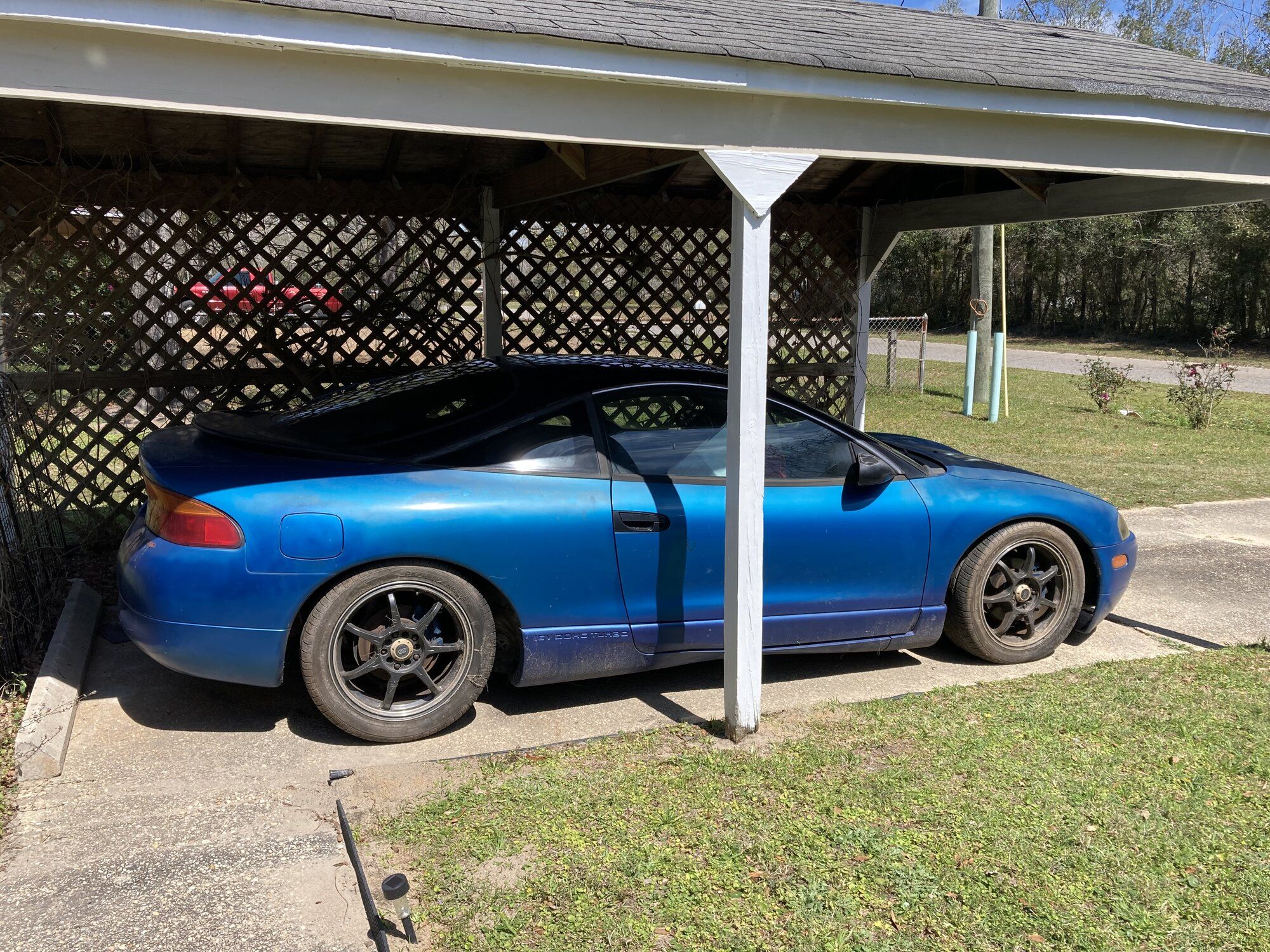

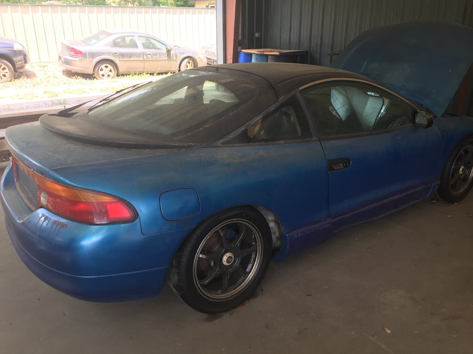

Kona Blue stock Talon that I've dubbed "Little Eagle" that's getting slowly restored to its former glory.

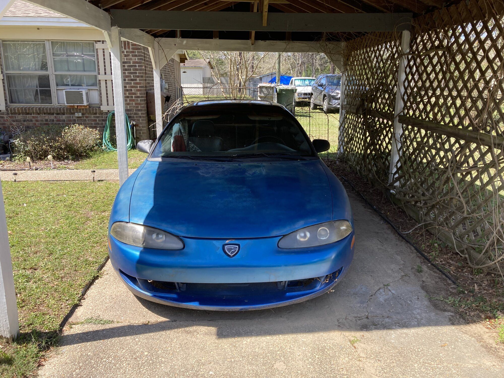

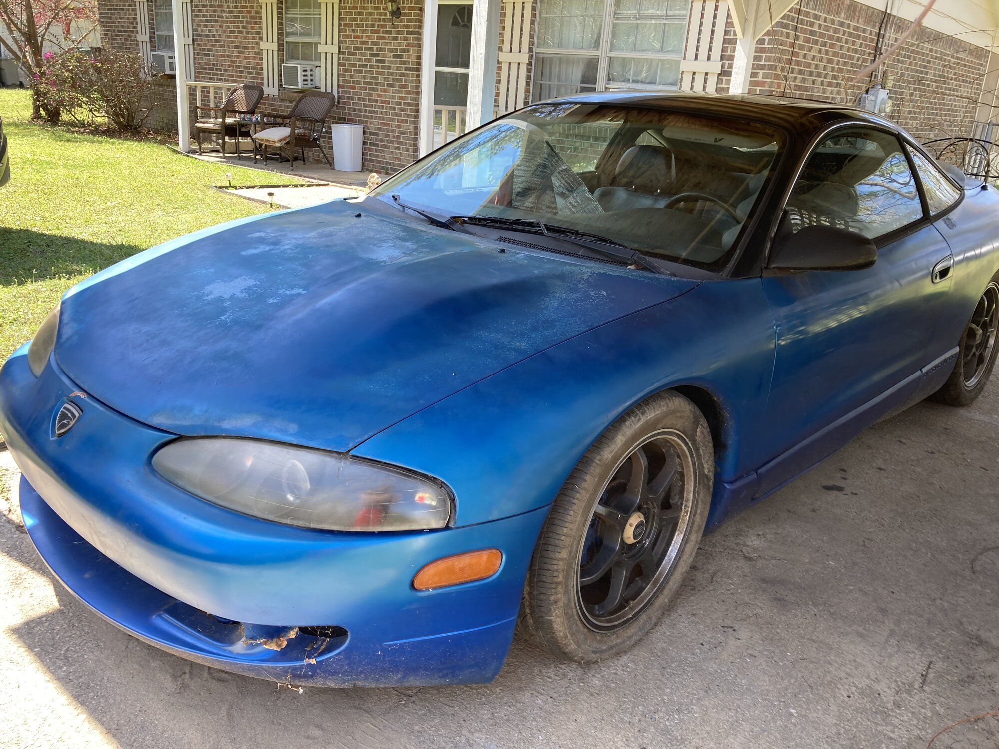

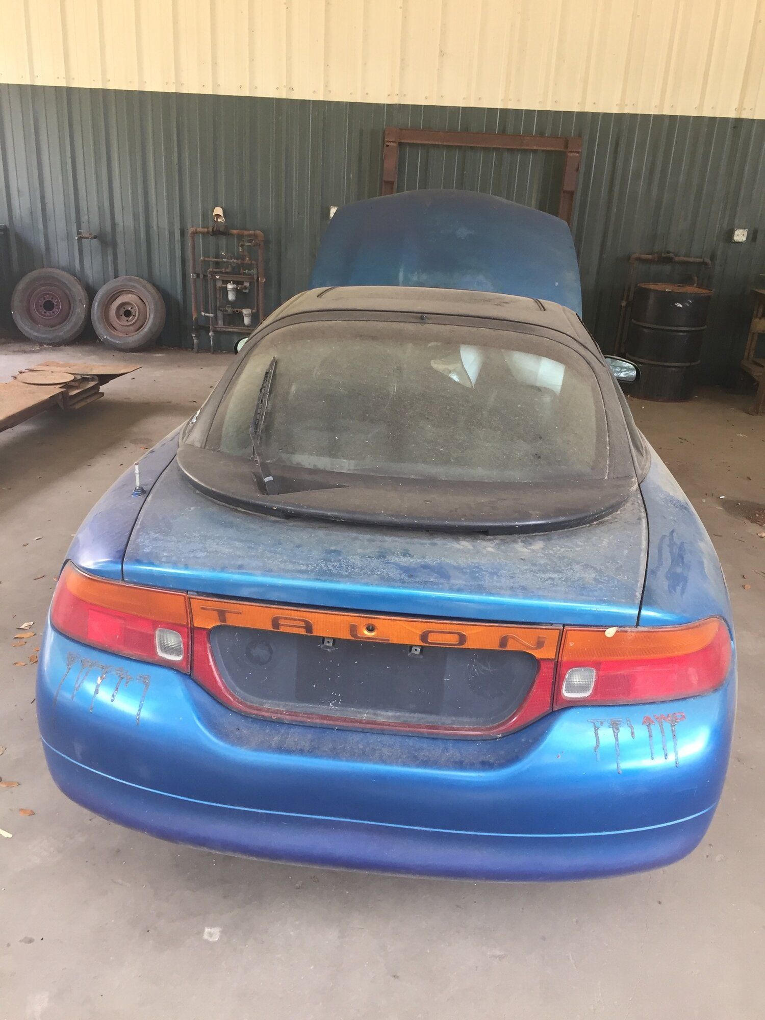

Quick update. I’ve still got the old buzzkill here. It’s been sitting a very long time and the paint is entirely ruined as are the decals…but I’ve still got it. Now that I’m an EMT and out of college, after we move and get settled I can focus on this thing again. Hope there’s still parts made for these things by the time I’m ready.
Pictures of its current state for lulz.
also, shameless plug, here’s the family hauler. 100% stock with only a tune and drop in k&n filter, and runs 13.2’s with massive traction issues. With 265 summer tires it’s got easy 12’s in it especially with e30 fuel. All in a super quiet super loaded unassuming CUV.
Well, I decided to move back home to Pensacola, FL to focus on family and stepping up to paramedic in an area I’m more familiar with. As a slight bonus, I’m right close to this thing again so that’s nice. Here’s pictures as it sits right now. Poor thing has been severely abused by my father. He’s an amazing mechanic, but is extremely rough on cars for some reason. Idk.

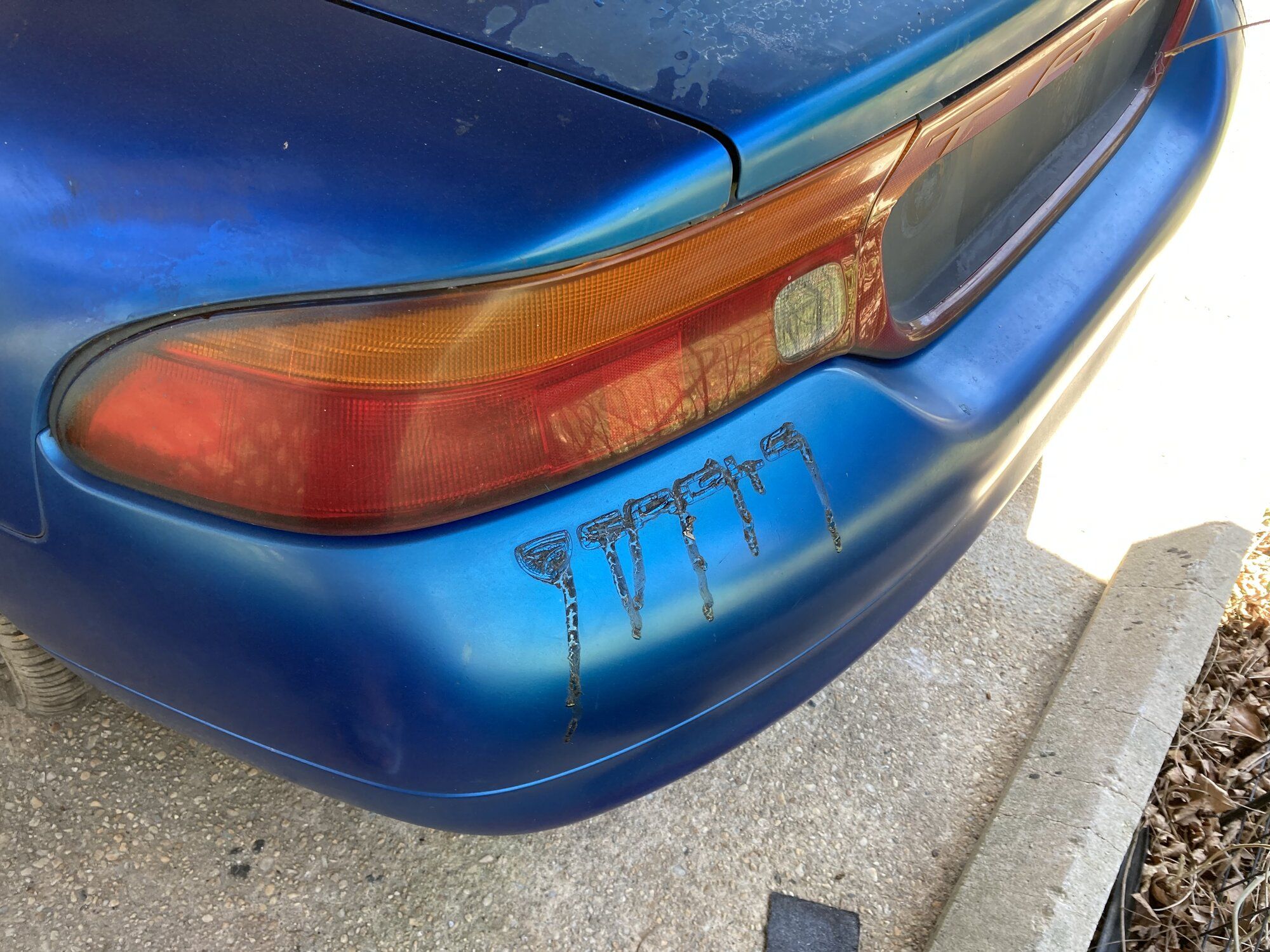

Poor thing. The paint is trashed, the badges on the back cried tears of abuse and have no clue how to start removing the gunk(any tips? Goo gone?) from them. Car runs and drives but the converter is super duper loose. Almost feels like it’s starting in 2nd. But it shifts and does fine. So that’s a plus.
Someone stole the magnaflow 3” muffler off of it though so it’s essentially just straight 3” catless turbo back. Lol. Loud AF. Sound clip later.

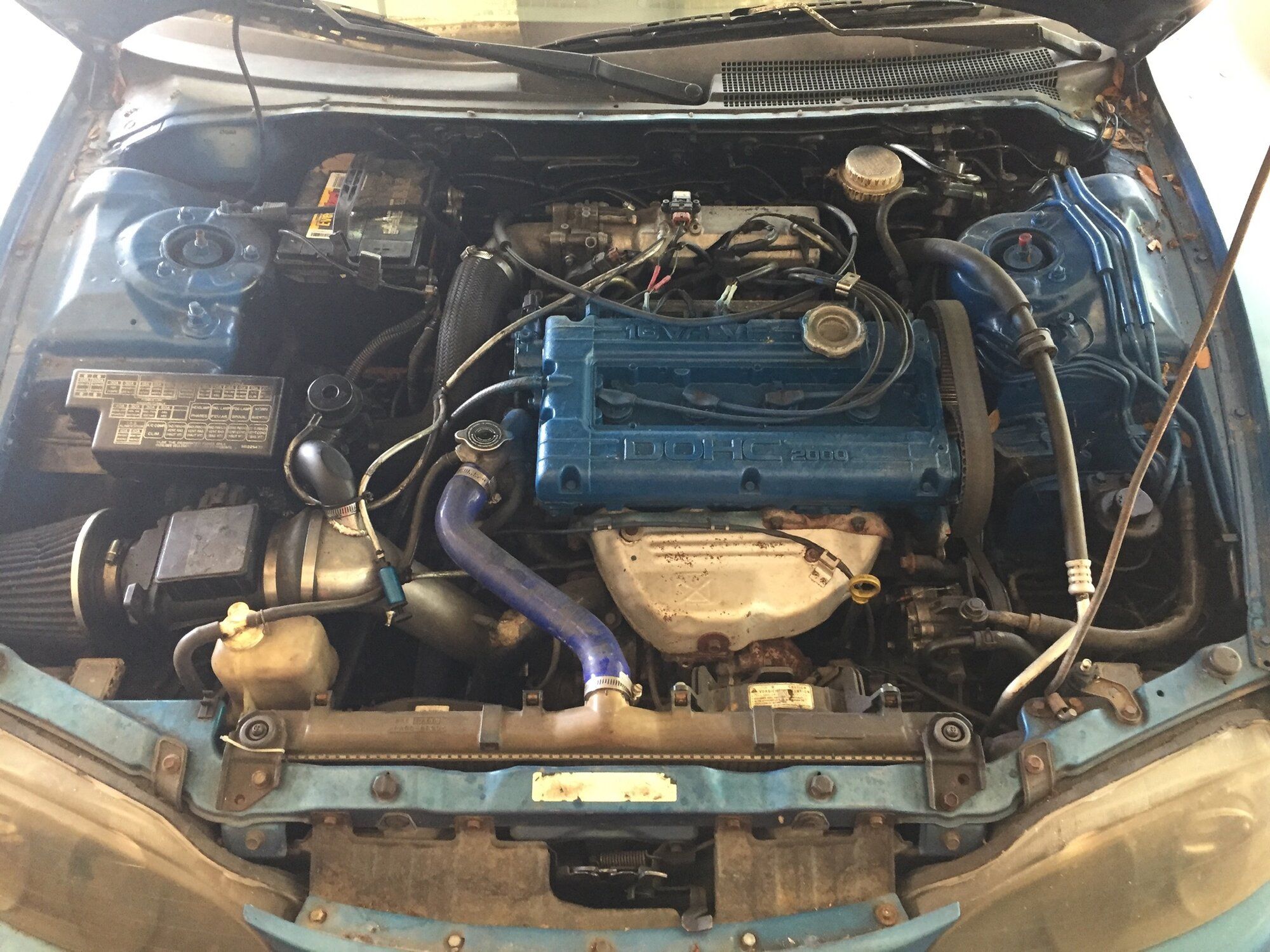

Alright so I’m tackling small stuff(like free or really cheap) while I’m focusing on the home and paramedic stuff, but I couldn’t stand the VC and engine bay situation anymore so I’ve decided to tackle that first. Specifically just the valvecover.
This was how it was left to me. Sad panda. Cheap blue spray paint everywhere, rust all over exposed metal, and black spray paint on the firewall. I just…I don’t know man.
Might not look all that bad. But it is, I promise. There’s aluminum galling everywhere that there IS aluminum, and anything iron or even close to it is rusty. Everything blue you can see has been rattle canned that color. It’s gonna take some work y’all.

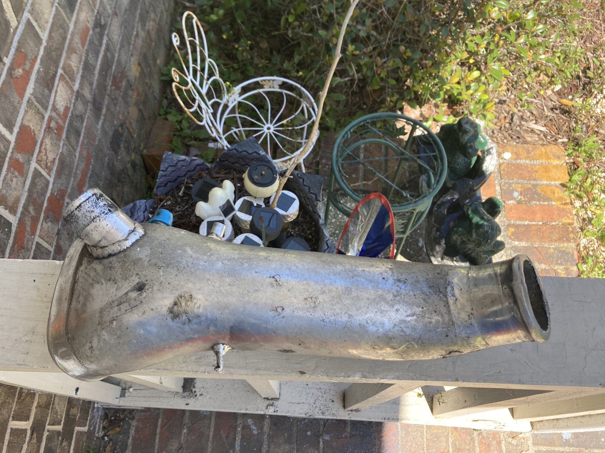

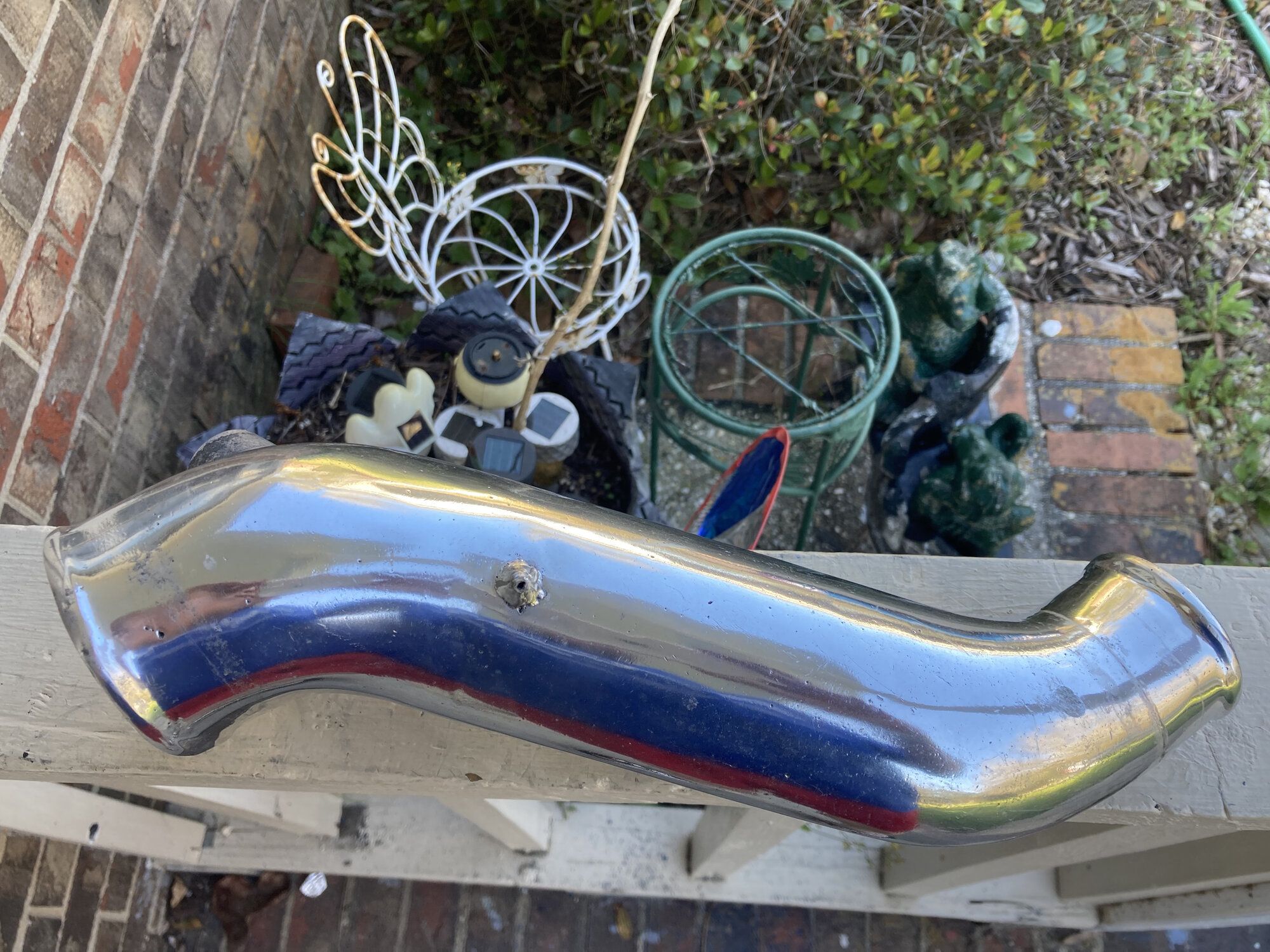

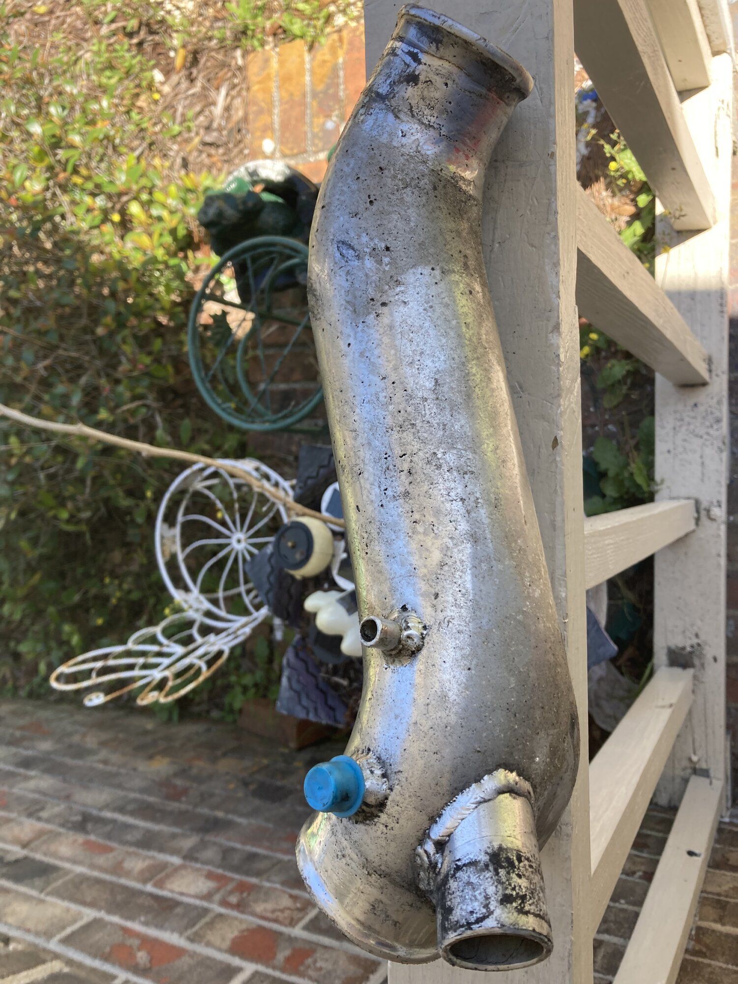

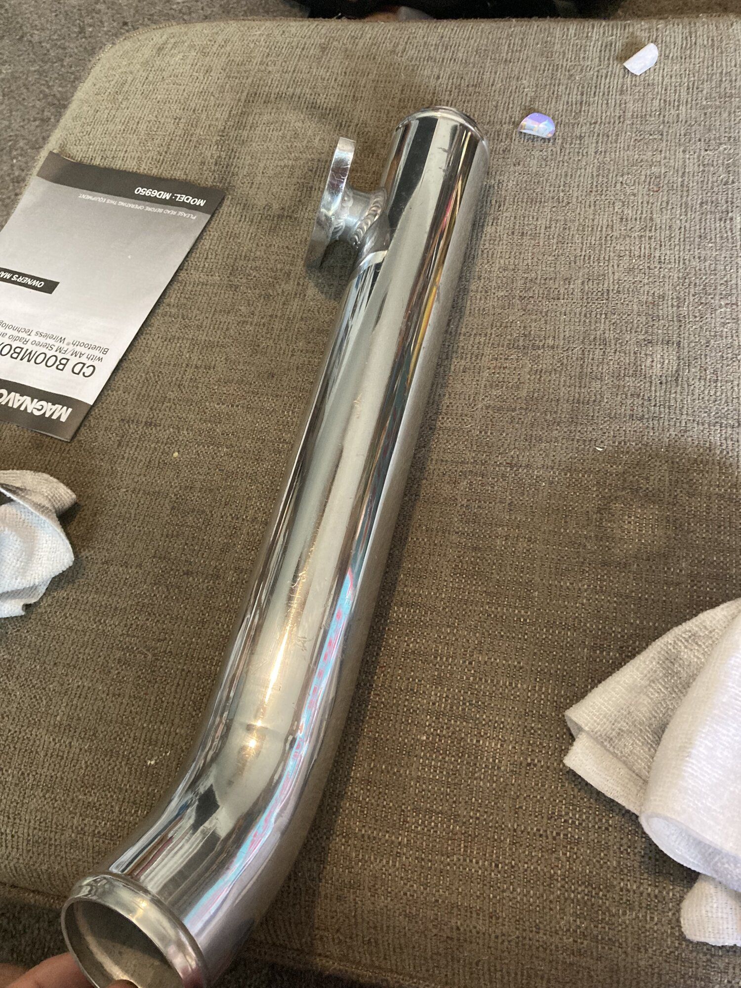

True to my word, I had some extra time today so I decided to do something about this cheap eBay intake pipe. It was absolutely foul, as evidenced by the pictures.
Vomit emoji goes here. Lol. That black stuff is like…non-cured RTV. I have no clue what it is. I got some metal polish and after about 20 minutes of some easy elbow grease this is how it turned out.
It’s not perfect but oh my word it’s so much better! So much more appealing and it only cost $15 for the polish. I could take a drill and machine polish it and make it look brand new but eh. Ain’t nobody got time for that.
It’s small progress but it IS progress! Thanks for the views and all comments welcome.

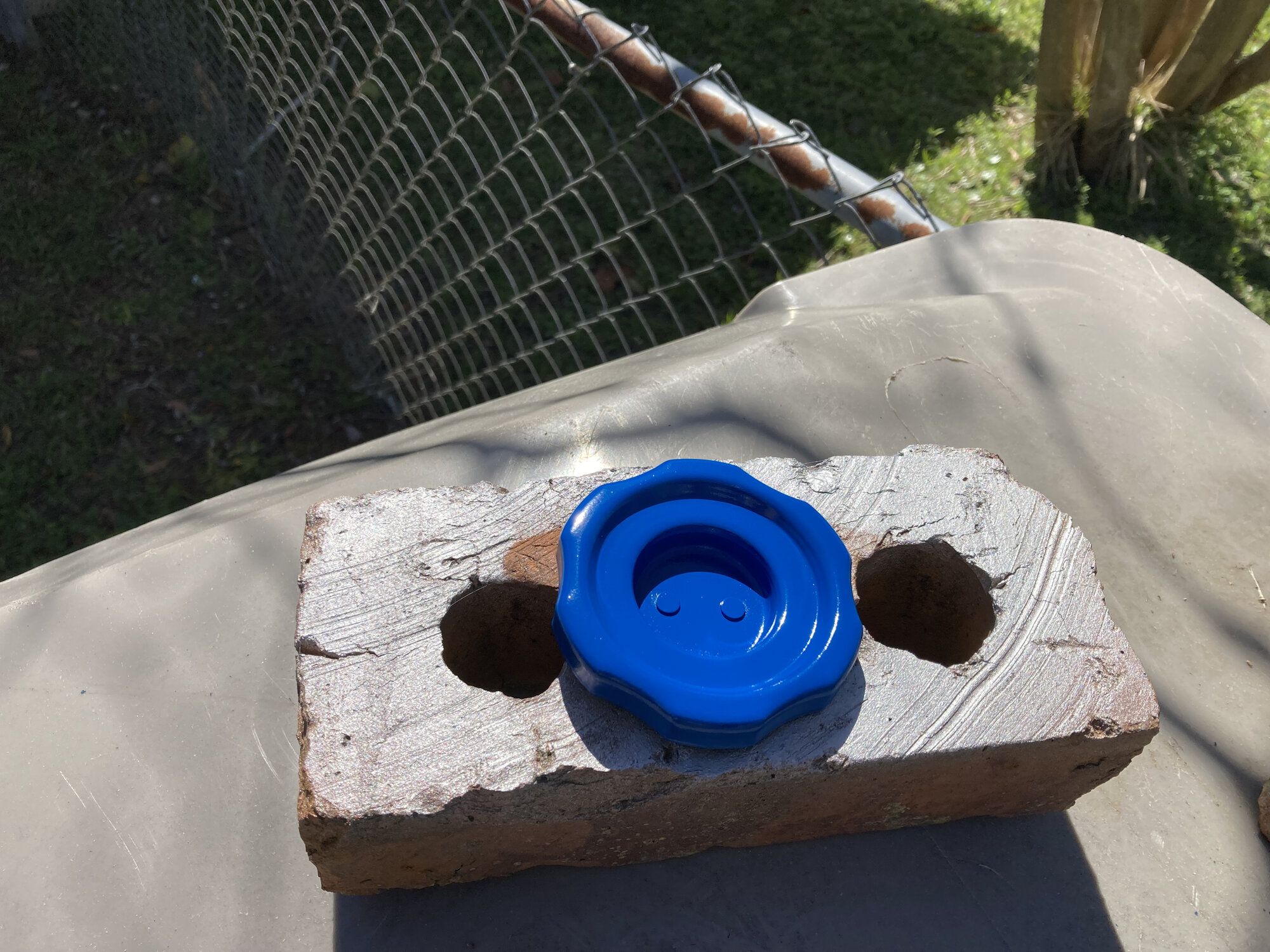

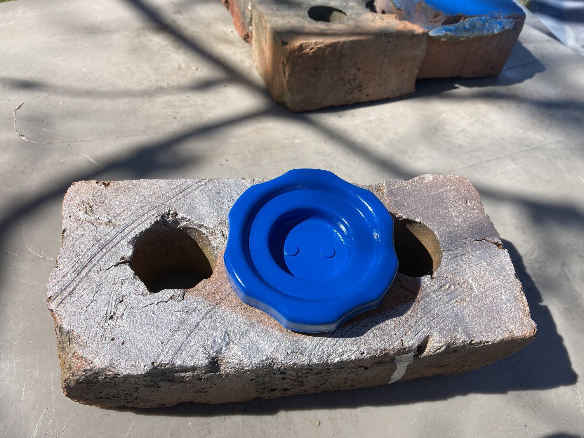

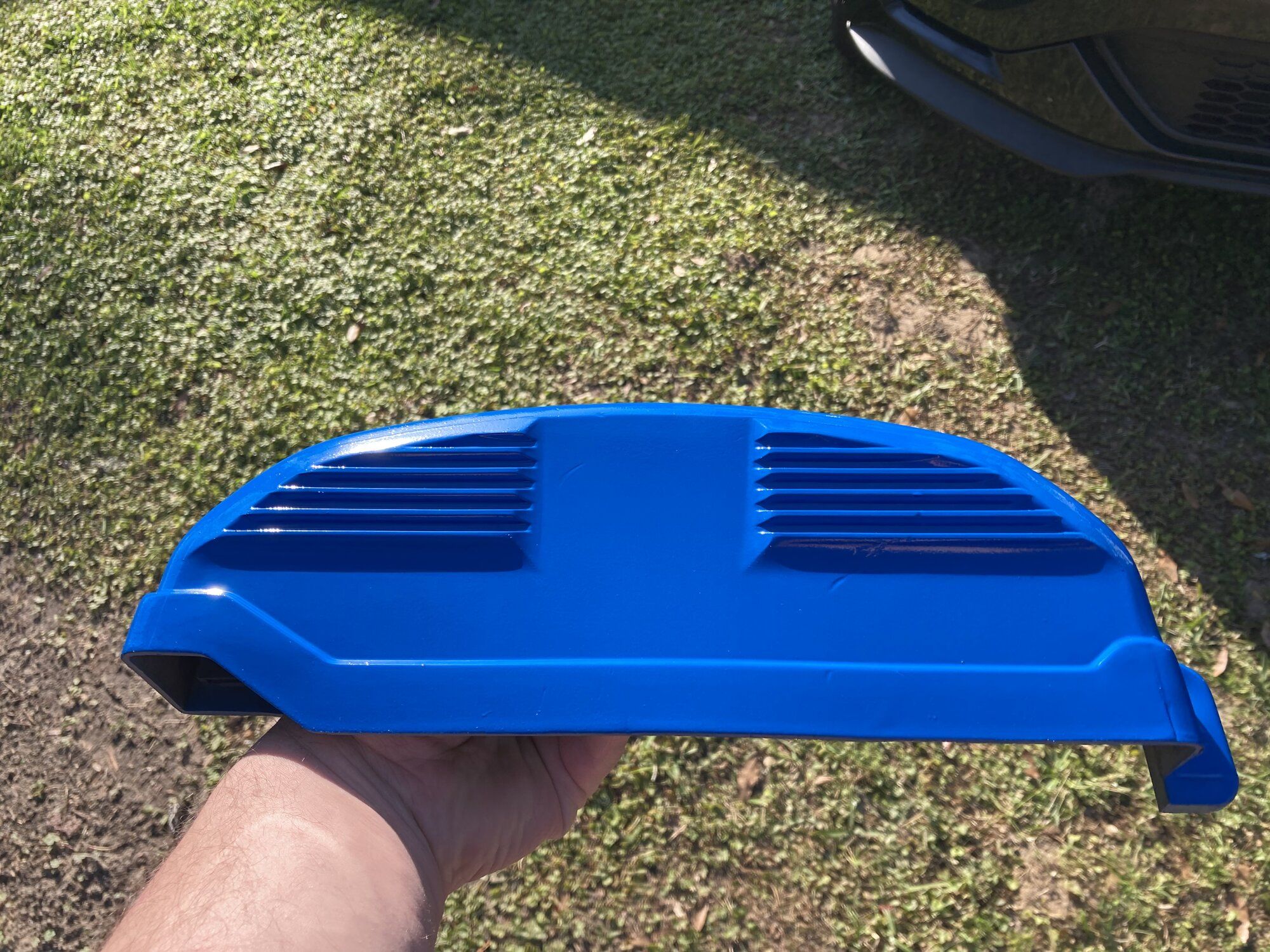

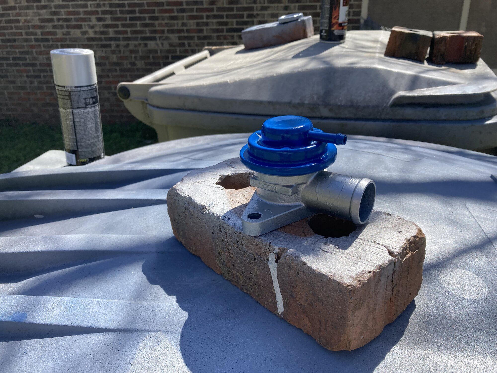

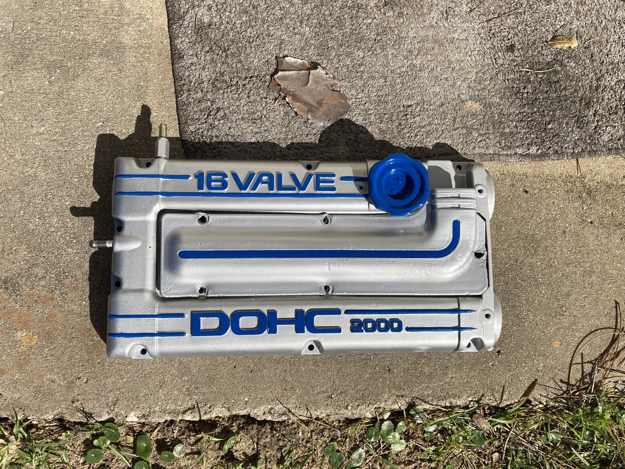

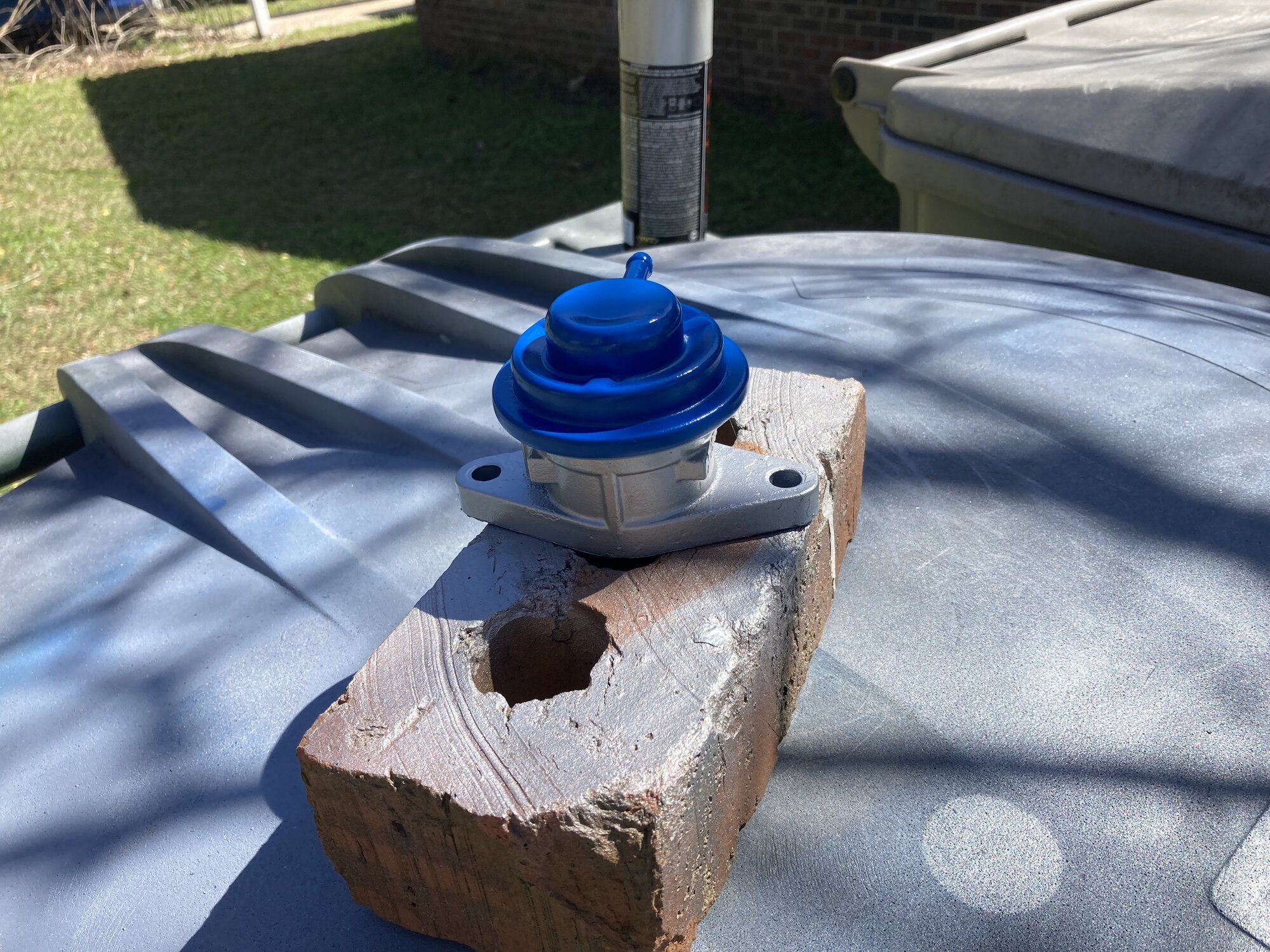

Doing more painting today. Nothing crazy, just the spark plug cover, the BOV, and the oil cap. Oil cap will be pictured later, it’s just a vatozone el cheapo but eh. It seals great. Anyway.

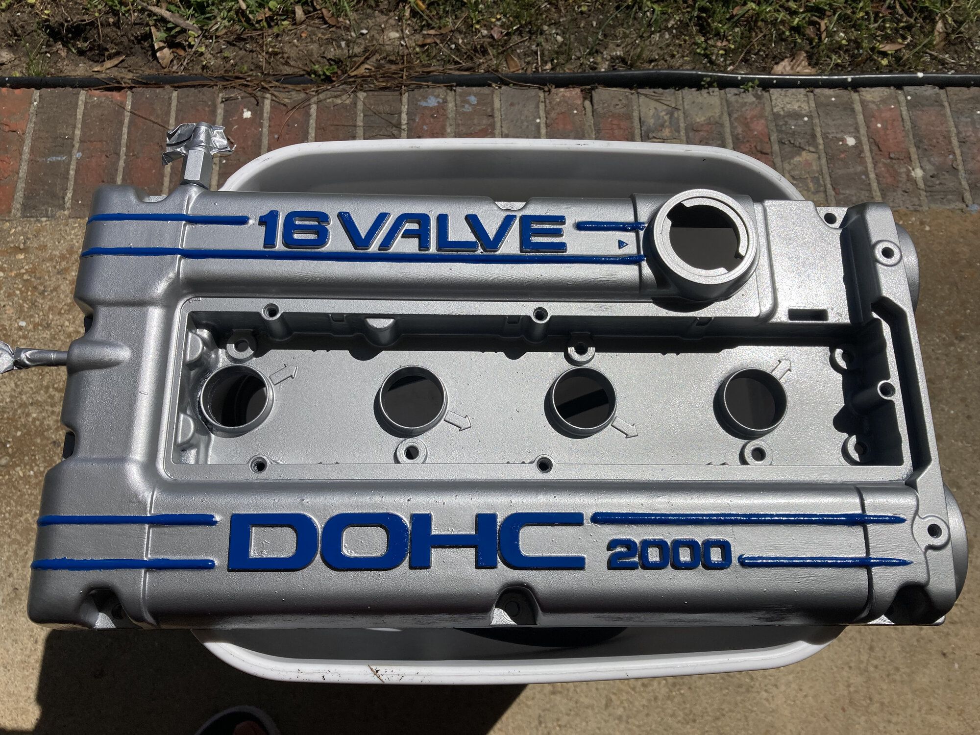

Here’s the spark plug cover on the VC. I actually really like how it turned out. I almost painted the plug cover blue with a silver stripe but I like this better.

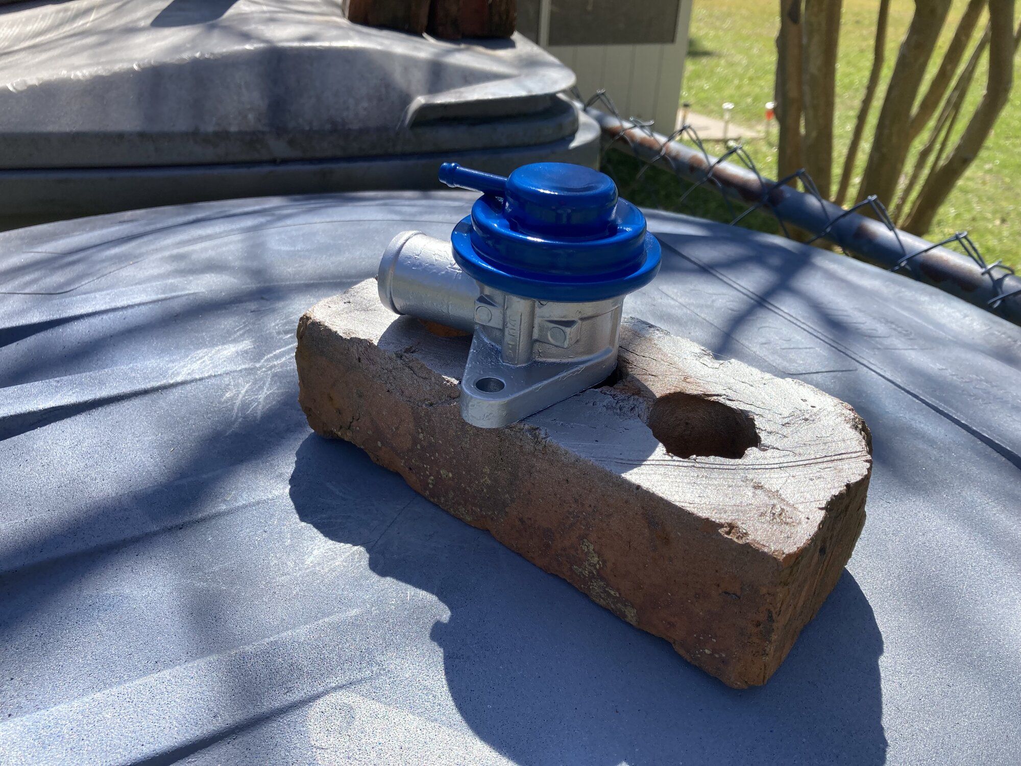

And finally is the BOV. Again I’m not w professional painter but I’m still super pleased how it turned out. This time I prepped it better than before, and I’m gonna make sure it won’t hit the hood. Lol.
Oil cap is just blue. I think it’ll compliment the VC’s silver nicely.

Finished product. I know it’s not like 8 second street car stuff, but I haven’t touched this car in over 5 years, so it’s just good to be around it again.
Love it. It’s high temp cleared too so hopefully it’ll be a little more grease/oil resistant. Lol.

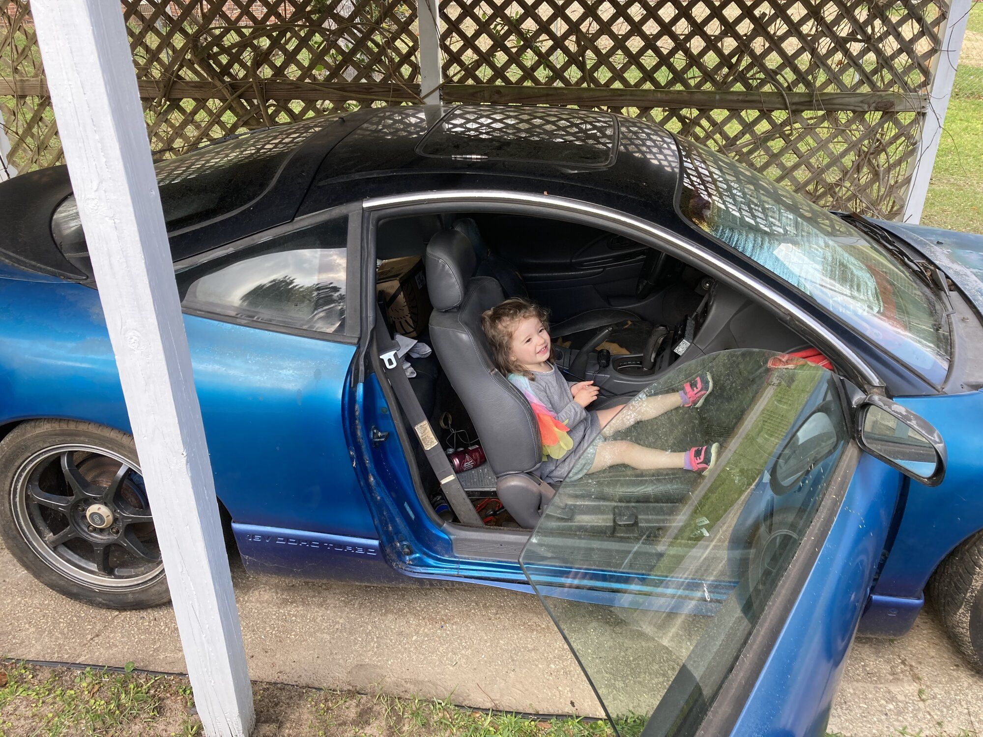

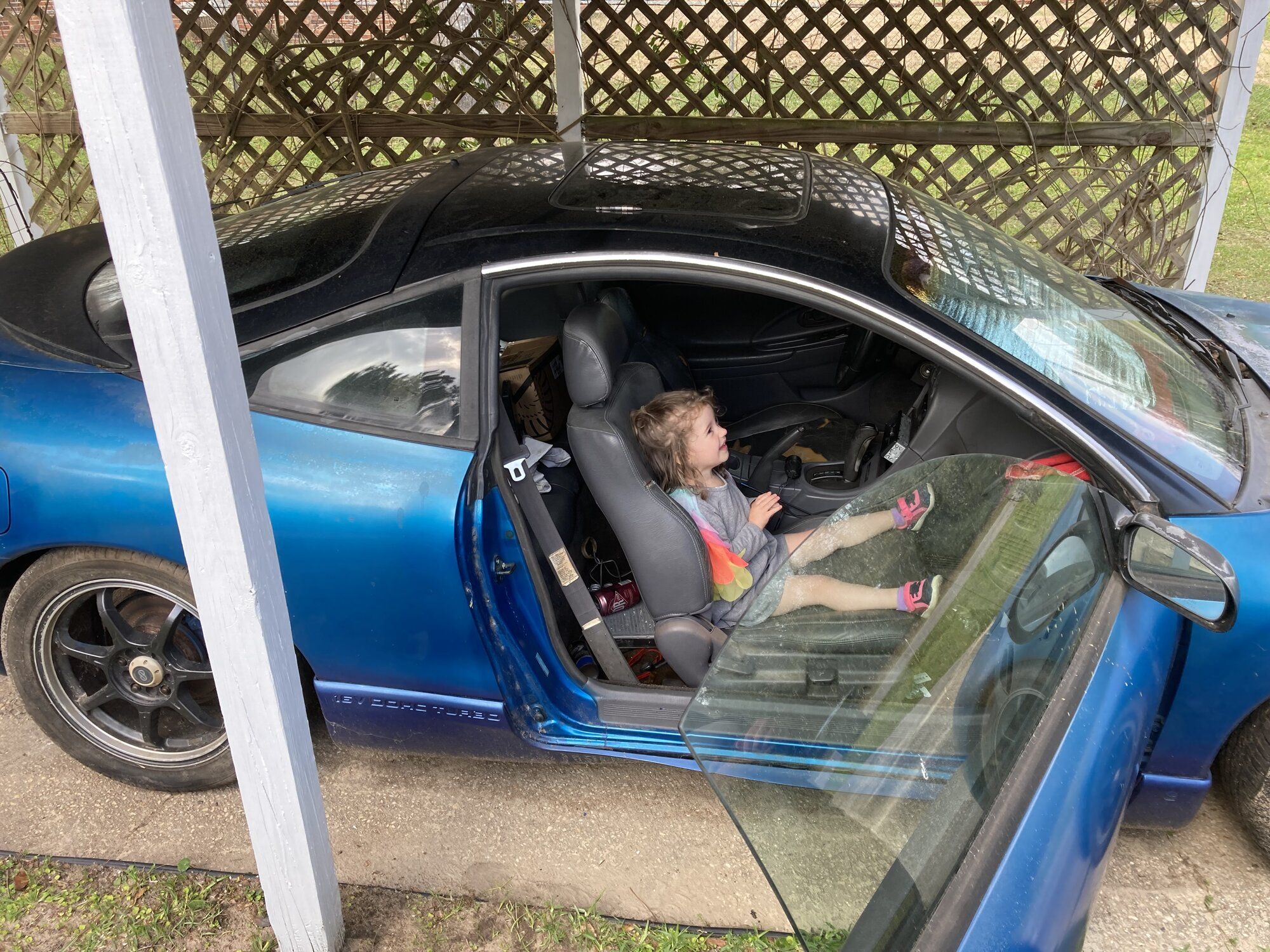

Also, my daughter immediately decided to give her stamp of approval. Future DSMer/car guy!

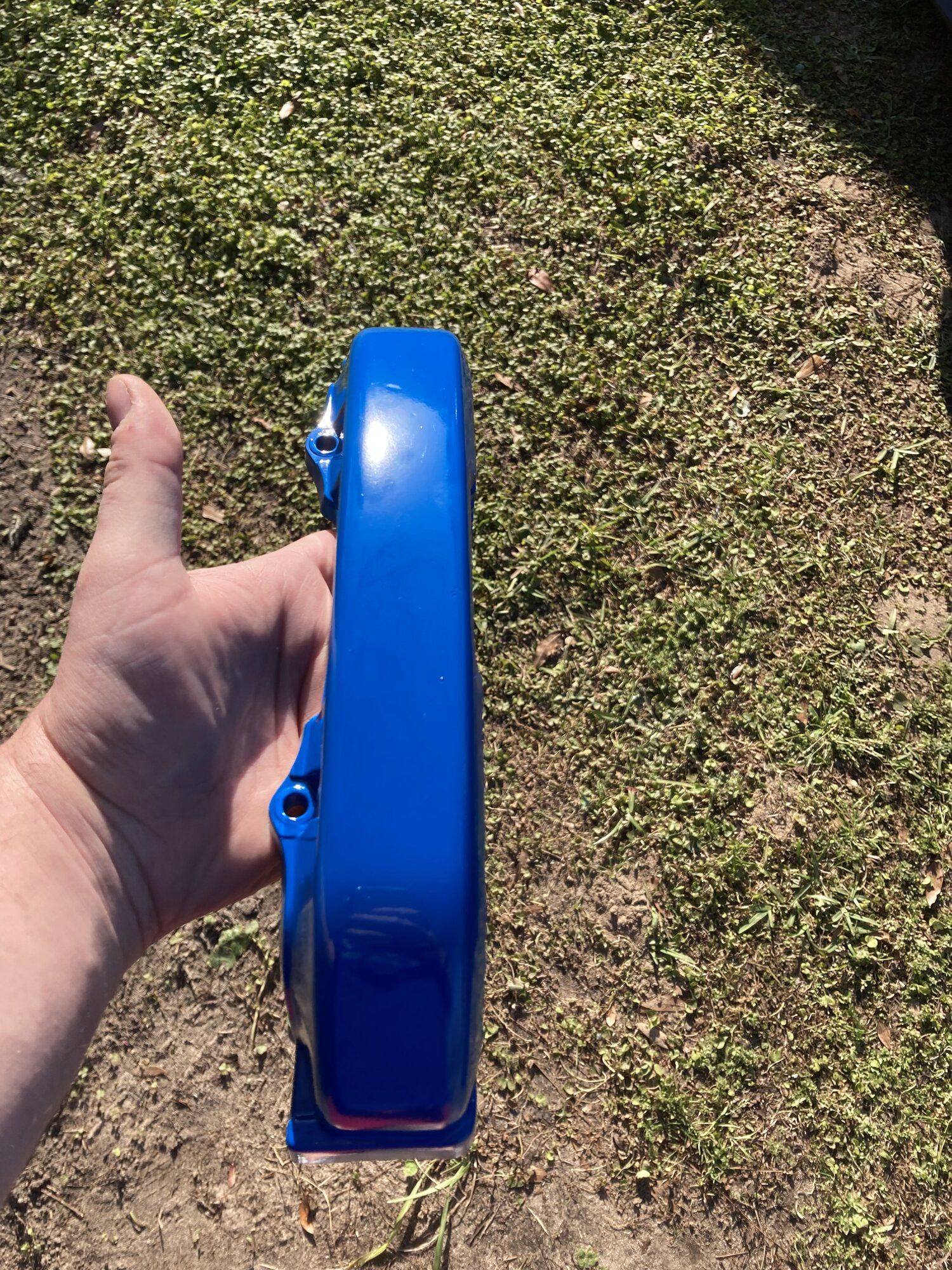

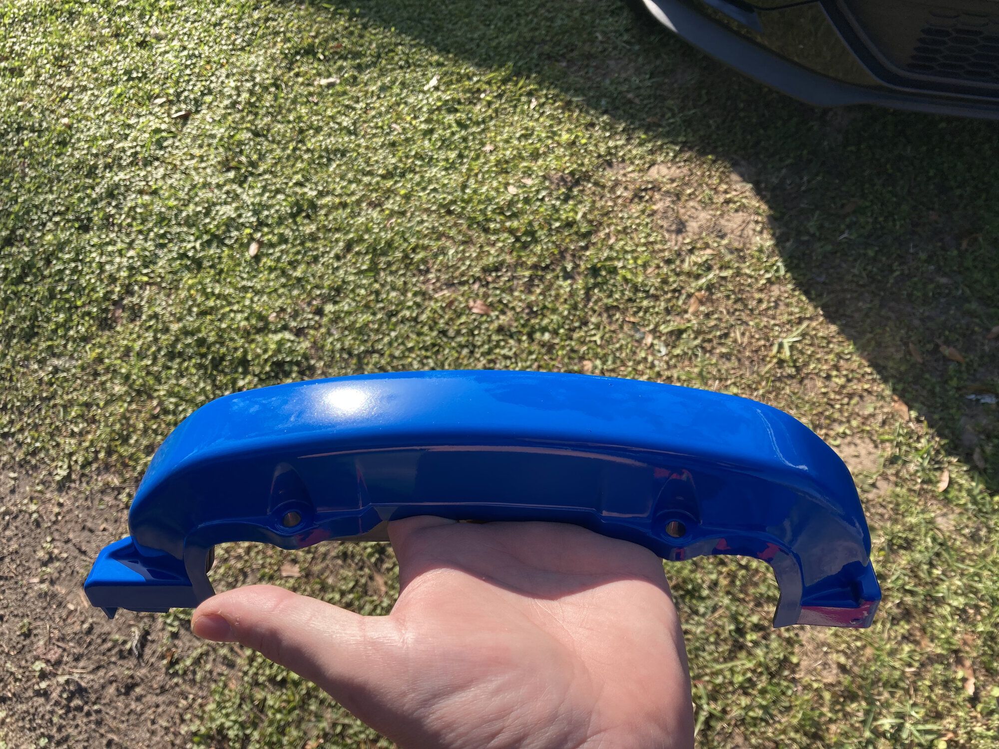

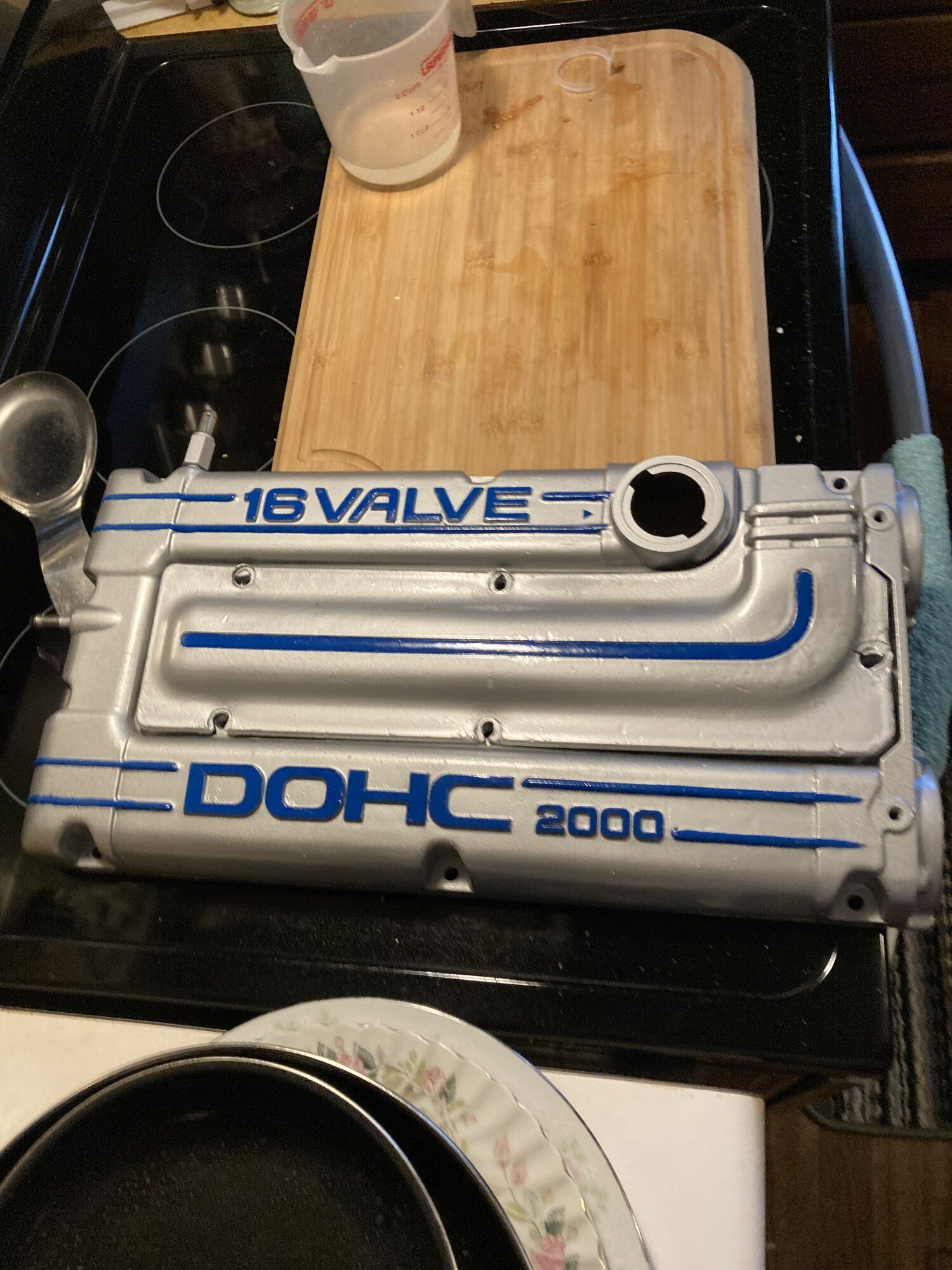

But I bought an upper timing cover/cam gear cover from @1SloEvo and it arrived like the next day. I’ve been sanding it and primed it and finished shooting it in blue today. This is how it turned out. :)
I am proud of how it turned out. There’s a few scratches and imperfections that won’t come out without some hardcore sanding and maybe filler and I’m just too lazy for that. Lol.

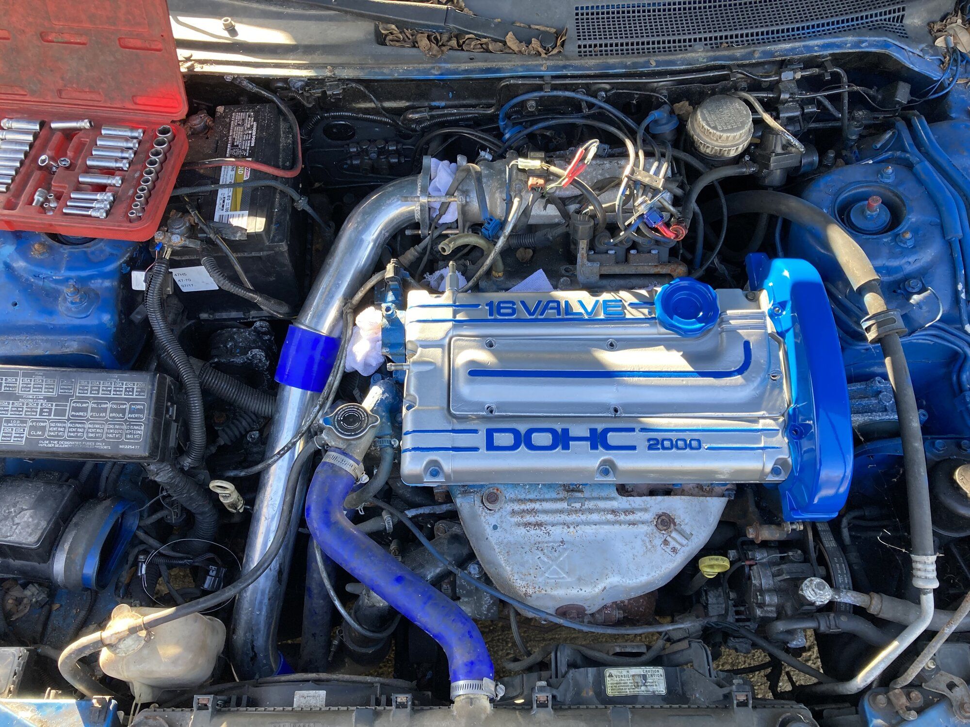

After that I was curious how it would look with everything, so I bolted the VC up, and just set the spark plug cover and cam gear cover on top of it. While I was at it, I mocked up the dirty AF intercooler pipe just to see how everything would look. Keep in mind everything is dirty, so the IC pipes will be polished like the intake a couple posts up, and the IM and Exhaust manifold heat shield will be cleaned up. Engine bay is gonna be pressure washed too. But you can see the potential. I hope at least, because I can.
It’s coming together. Slowly but surely. Stay tuned fellas. :)

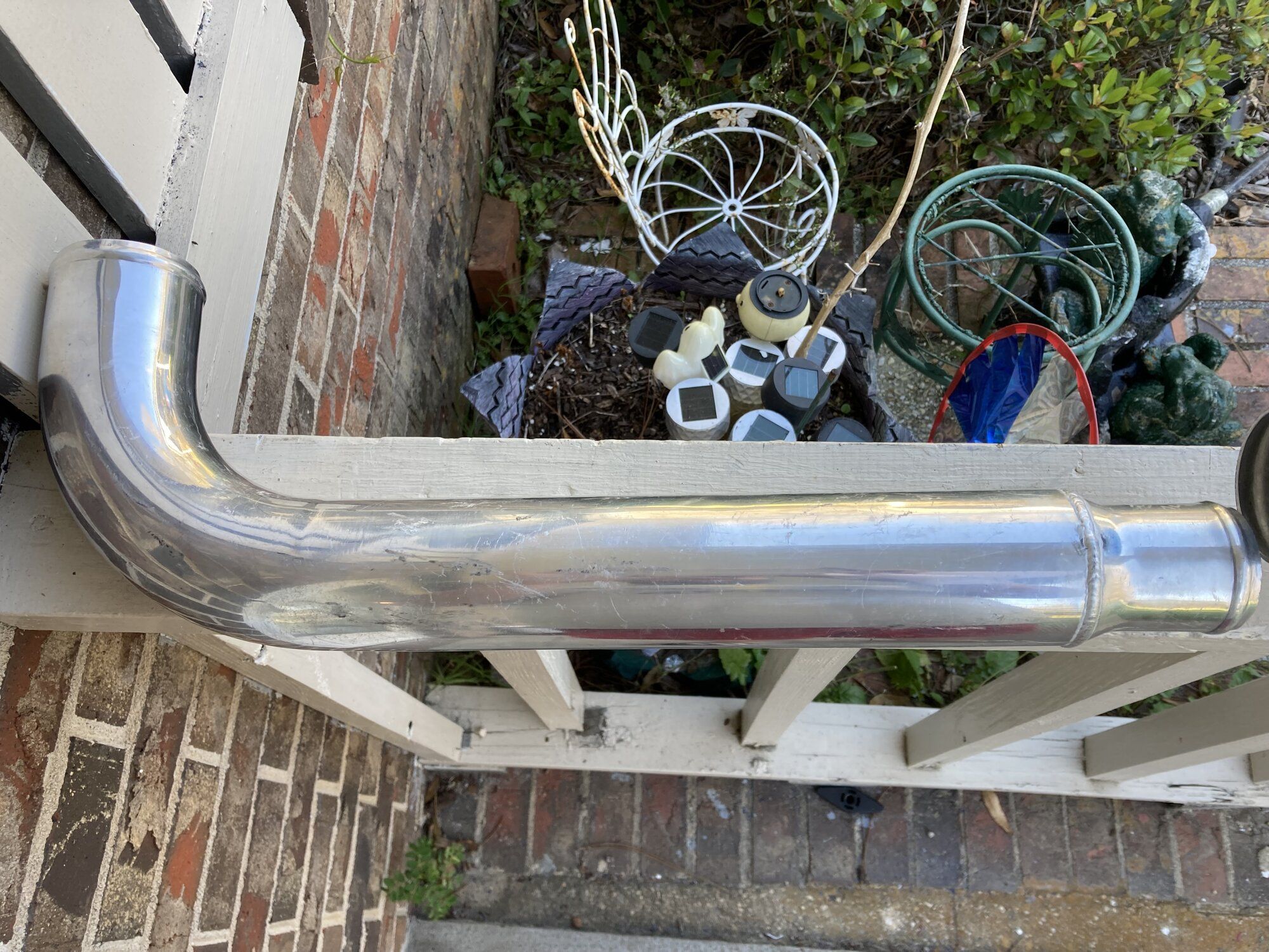

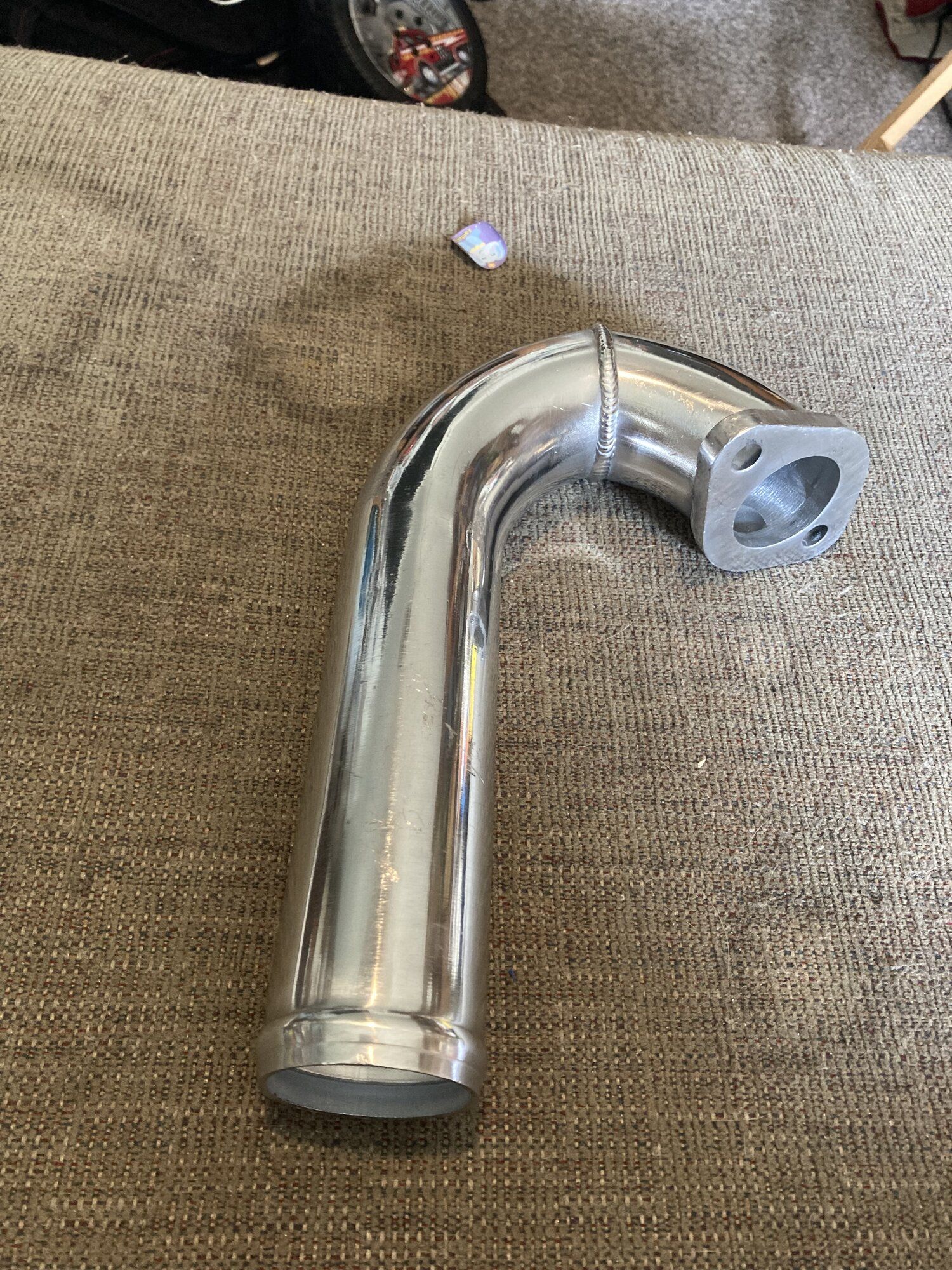

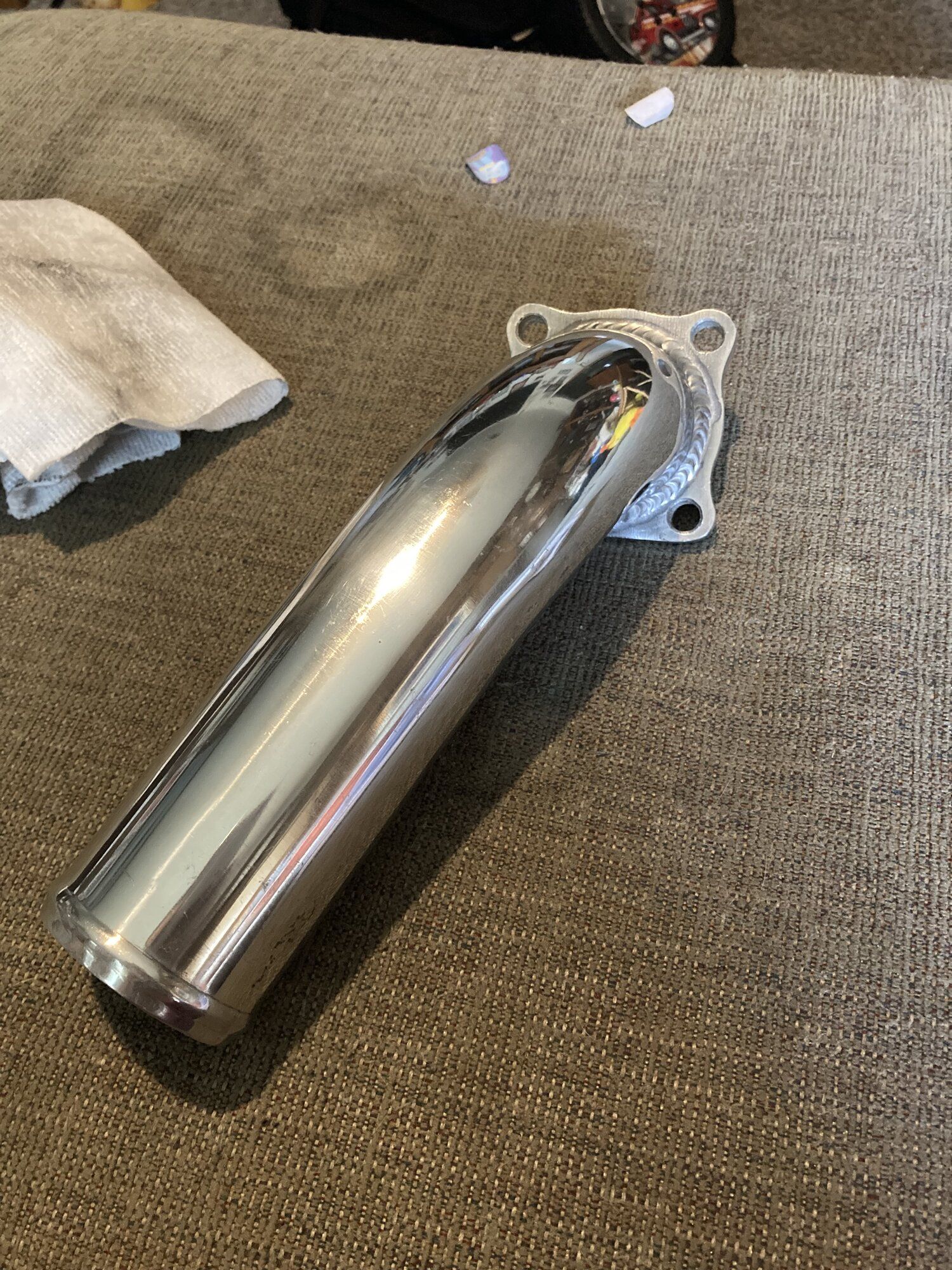

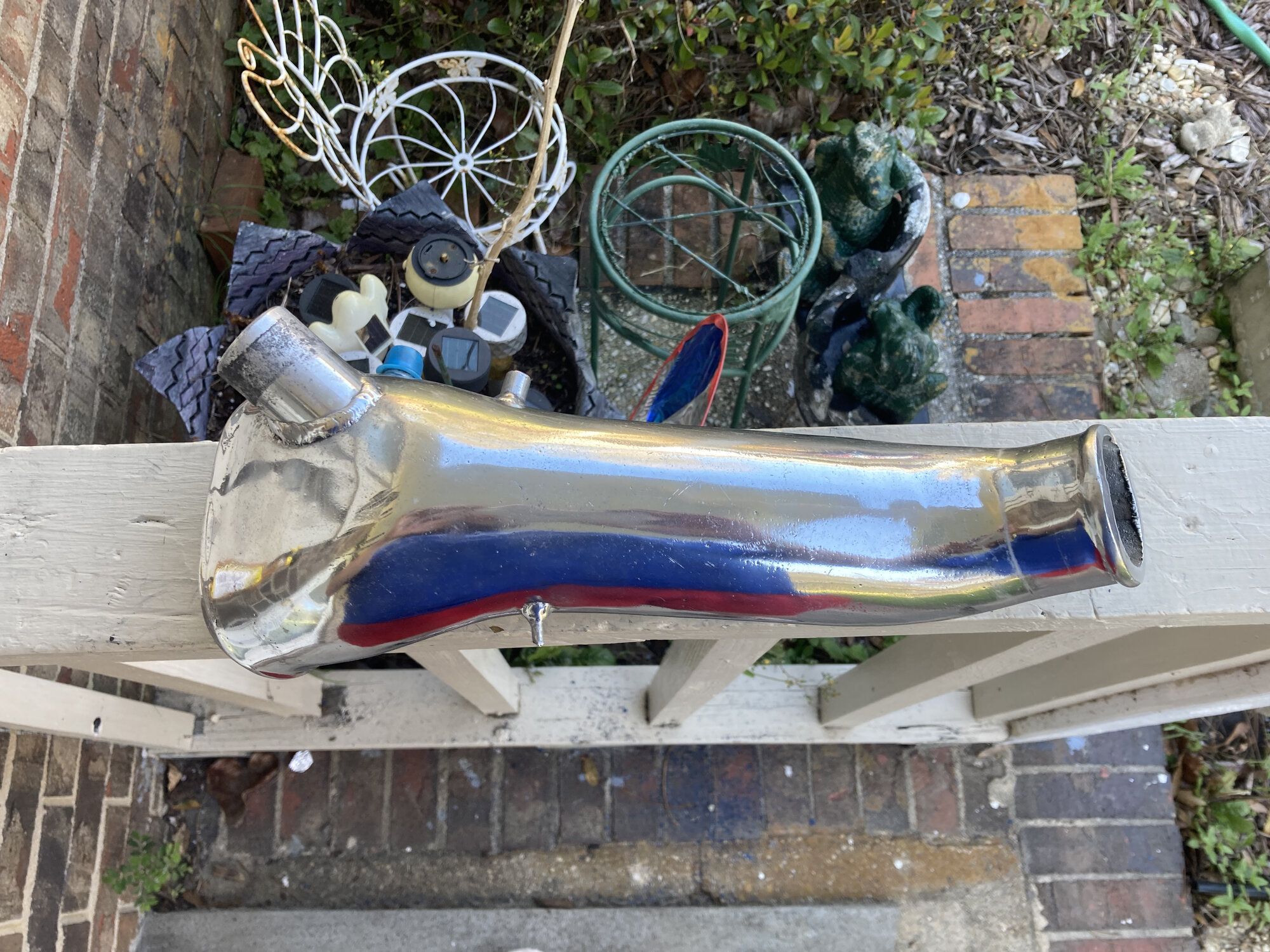

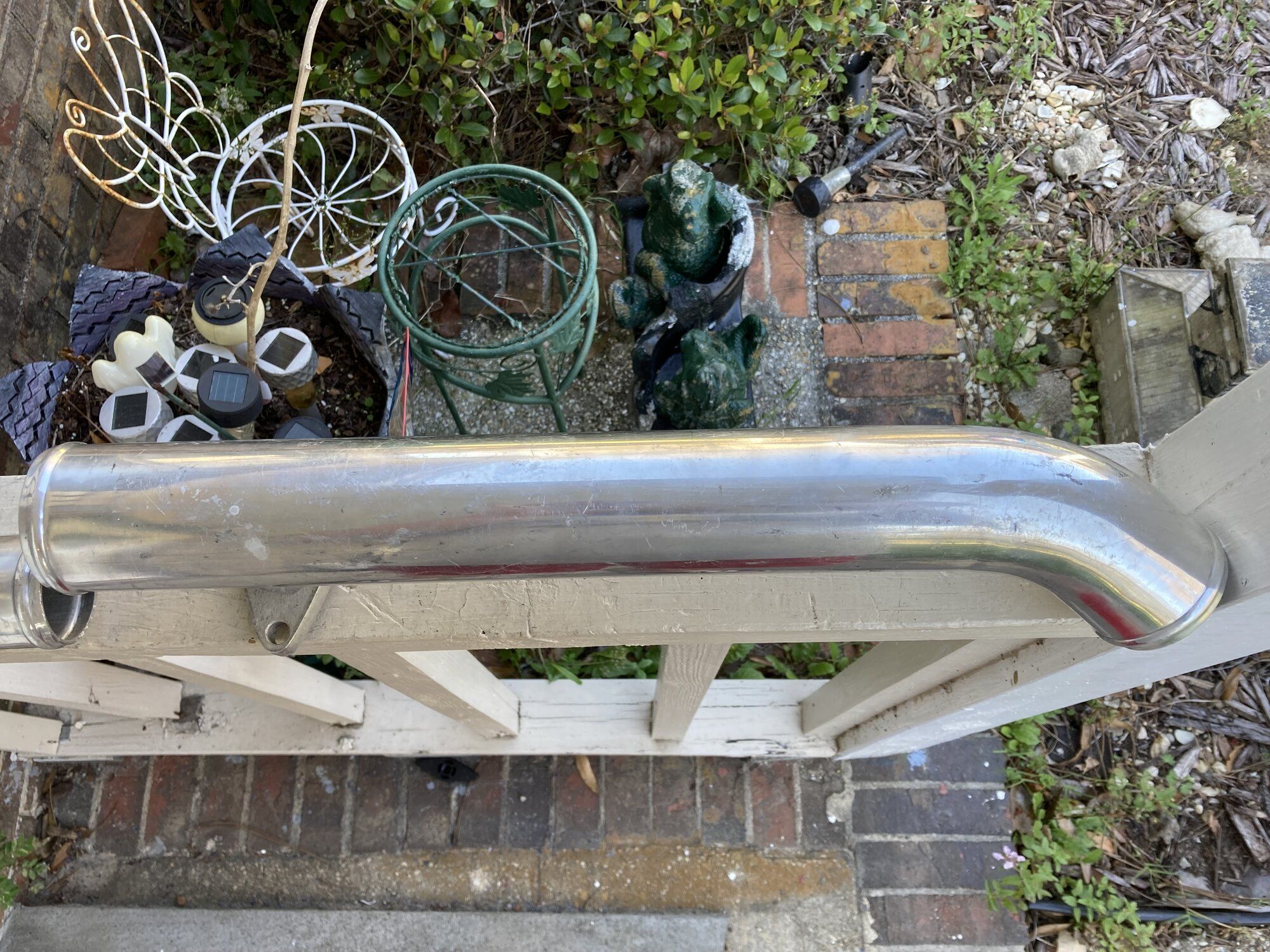

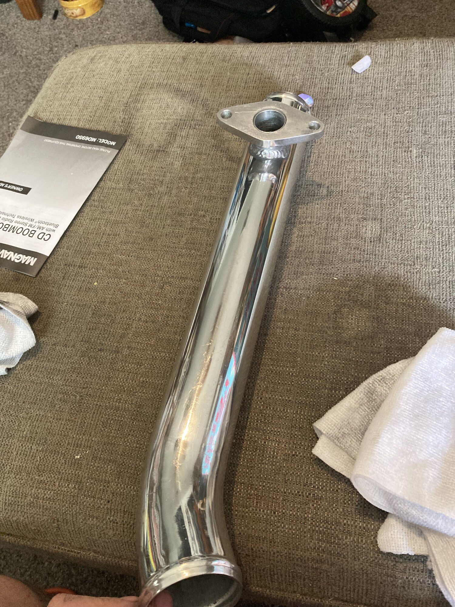

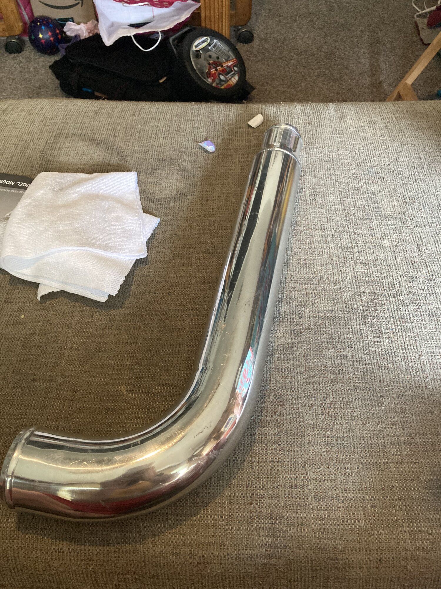

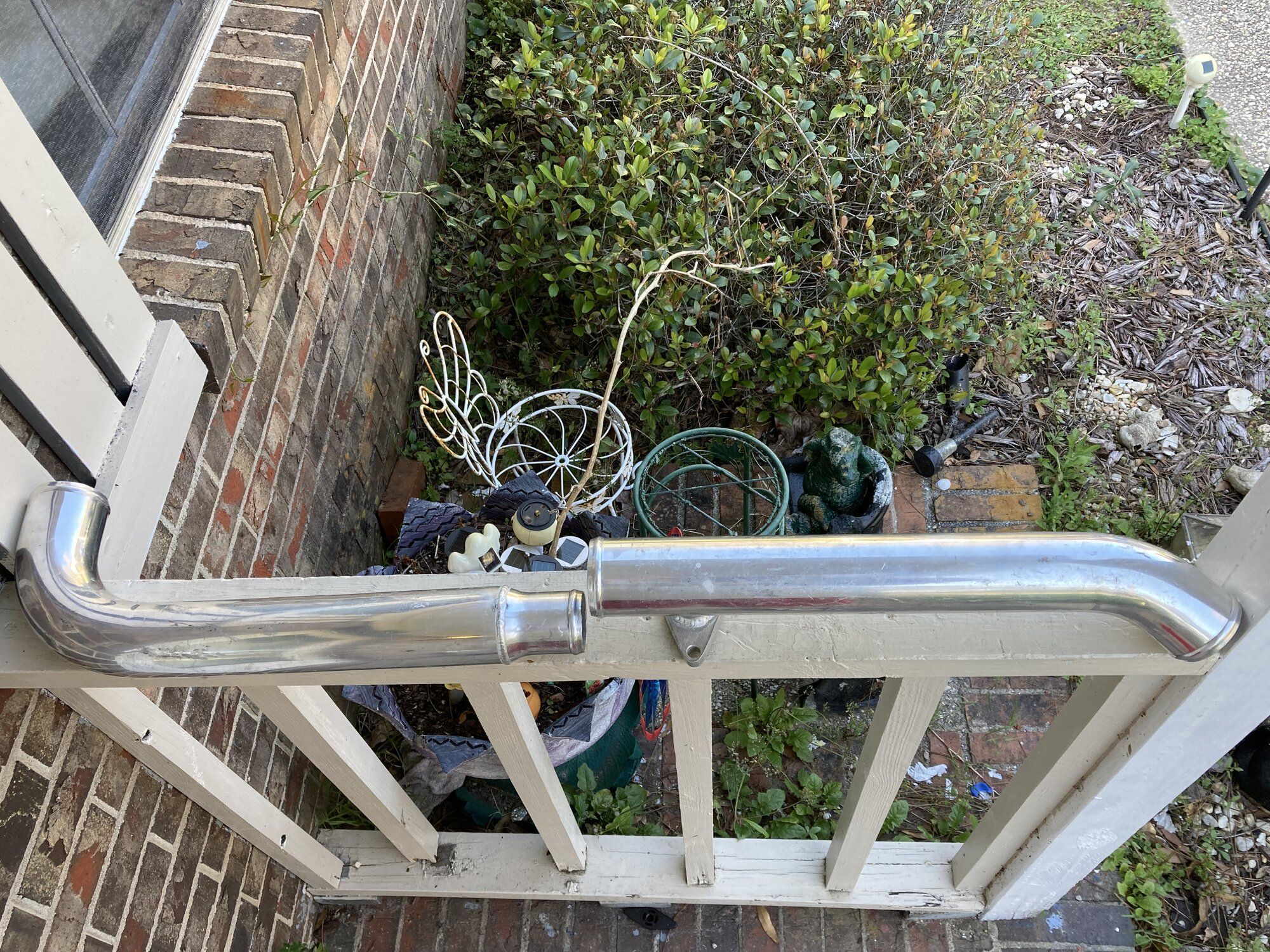

Did some polishin' today on the IC piping kit. I began to sand down/properly polish one pipe but oh my God doing it by hand...that's for the birds. And I don't have a spot to put a polisher/grinder thing that would make it easier, so I just took the easy way out and just skipped sanding and hand-polished the pipes and left the scratches/divots. It honestly looks a MILLION times better than it did before.
Before
They were dirty/had mystery liquid dried on it..scratched, dinged..etc.
Aaaand here's after.
I'm honestly the most proud of this. This is the TB elbow and it turned out like...perfect.
I mean, none of them are truly perfect. They still have some noticable gouges and scratches...but so much better than before. They actually shine now! And honestly they're never gonna stay perfect even if I sanded them, smoothed them, and polished them to a perfect mirror. So, in this instance, good enough is good enough.

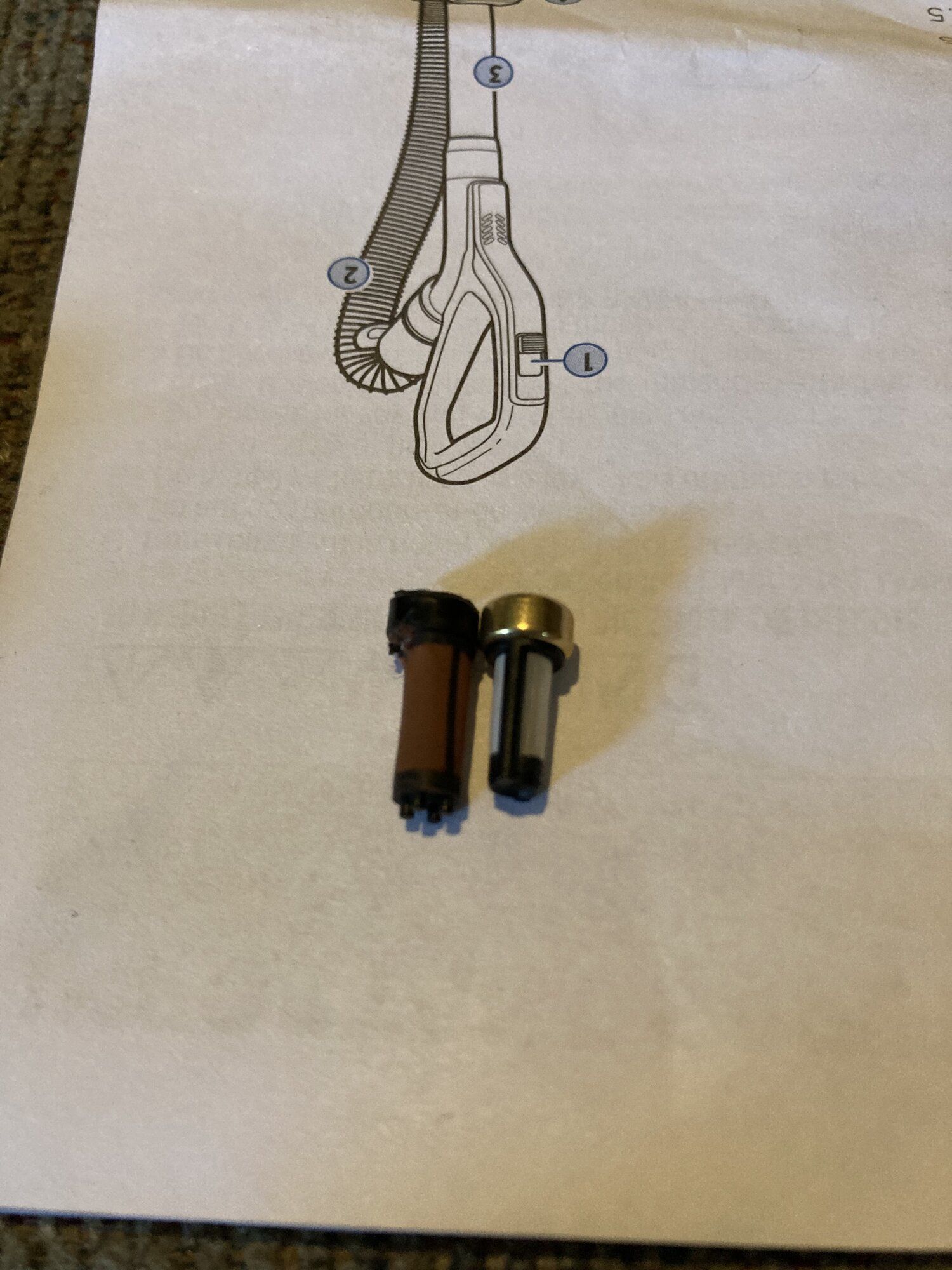

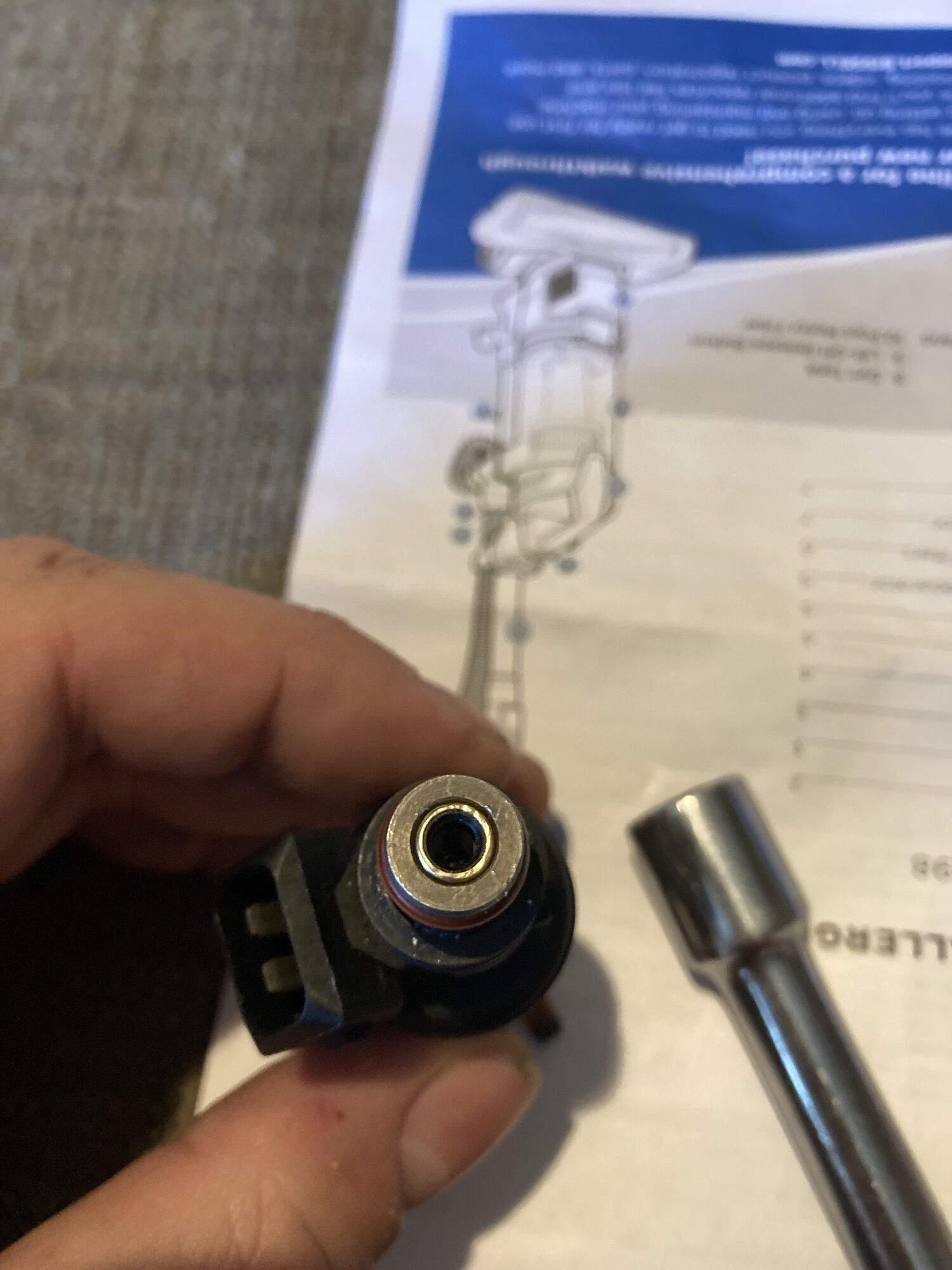

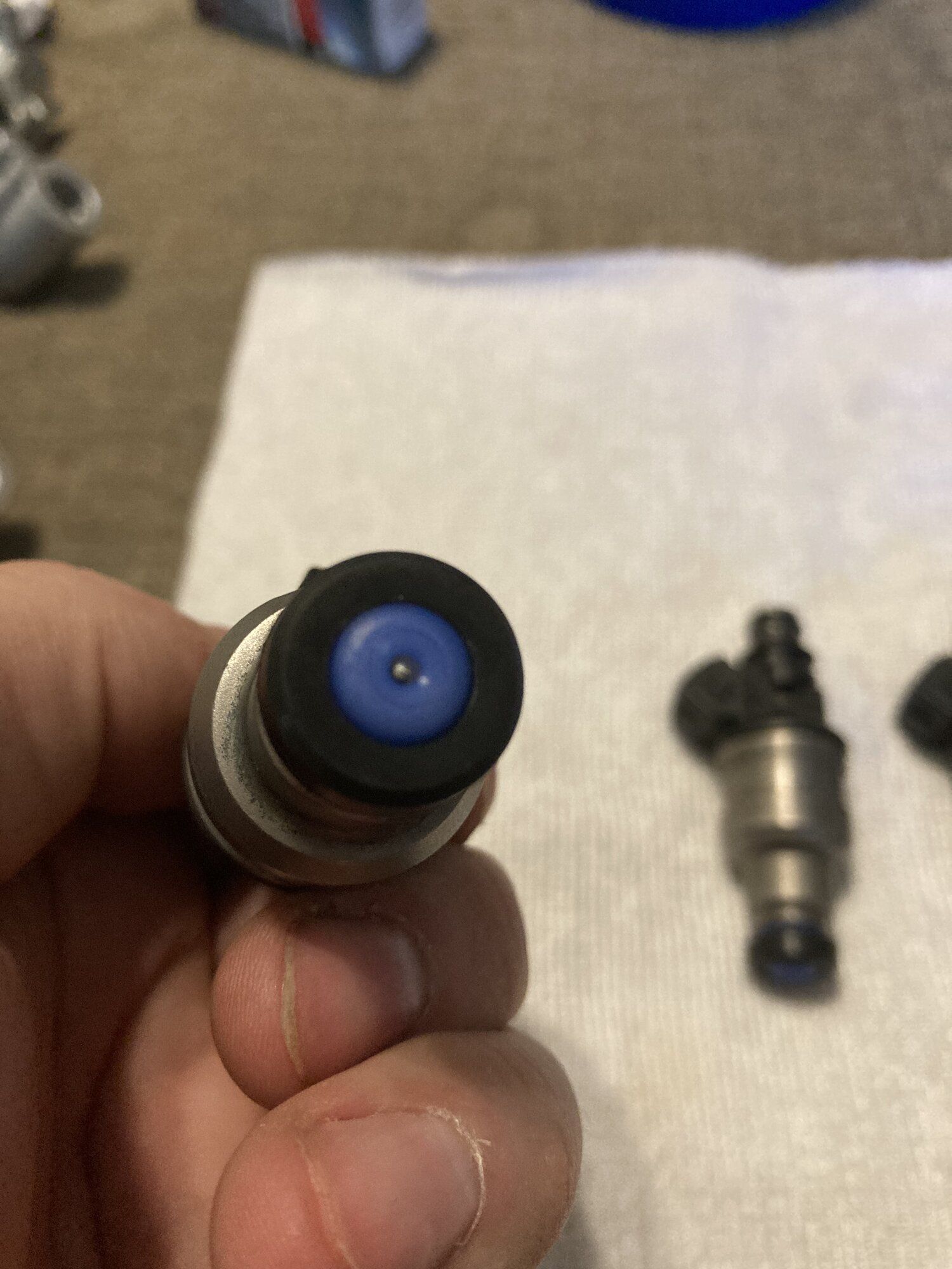

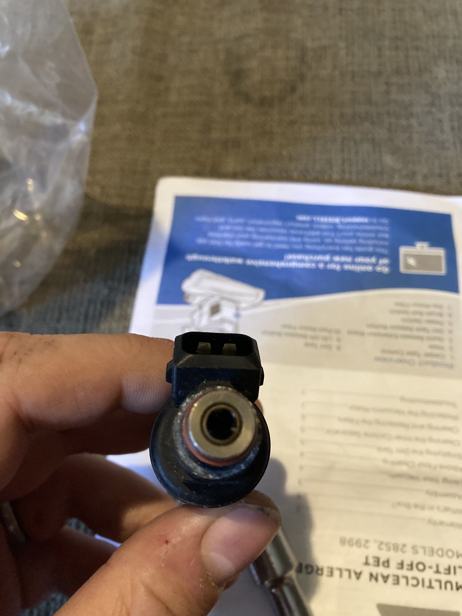

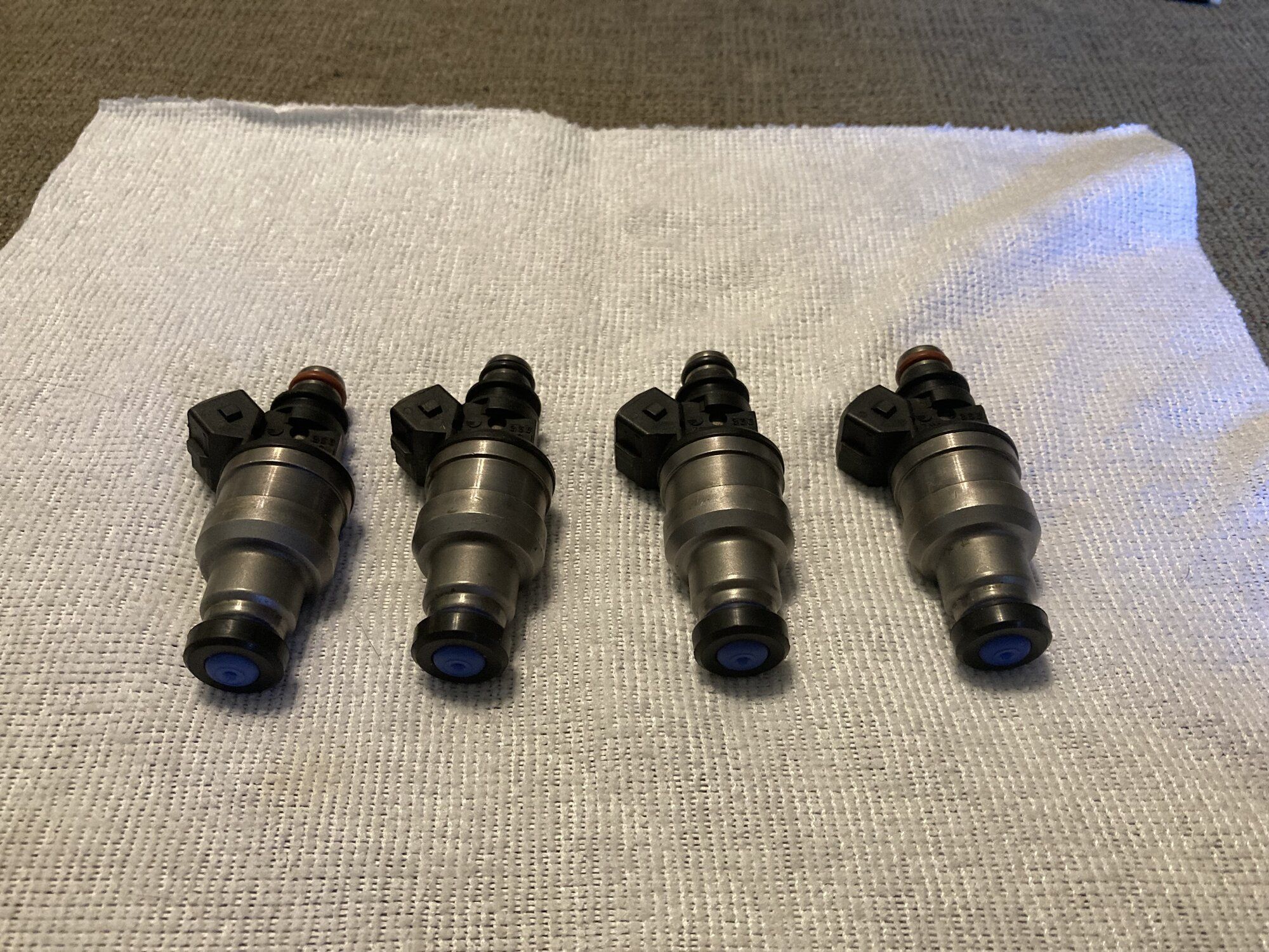

Also: new pintle caps finally came in! It is impossible to find the original dual nozzle 2G style pintle caps so I just ordered the 1G/blue top style. Should be fine honestly. Here they are all shined up and new! They had like blue paint and rust all over them before.
Before/old filters
Phew. Left is old and right is new. Difference in length made no difference in flow testing.
New hotness. Sonic cleaned, new filters, all shined up and ready to go! Wish I could’ve found OEM dual nozzle style pintle caps but alas.
I know I could’ve(and will in the future) just bought new 850’s but it’s still stock ecu and stuff for now and I’m not ready to make it a race car yet. I want to restore it first and that way have a good foundation to build on. Gotta revive this bird whose lost its feathers.

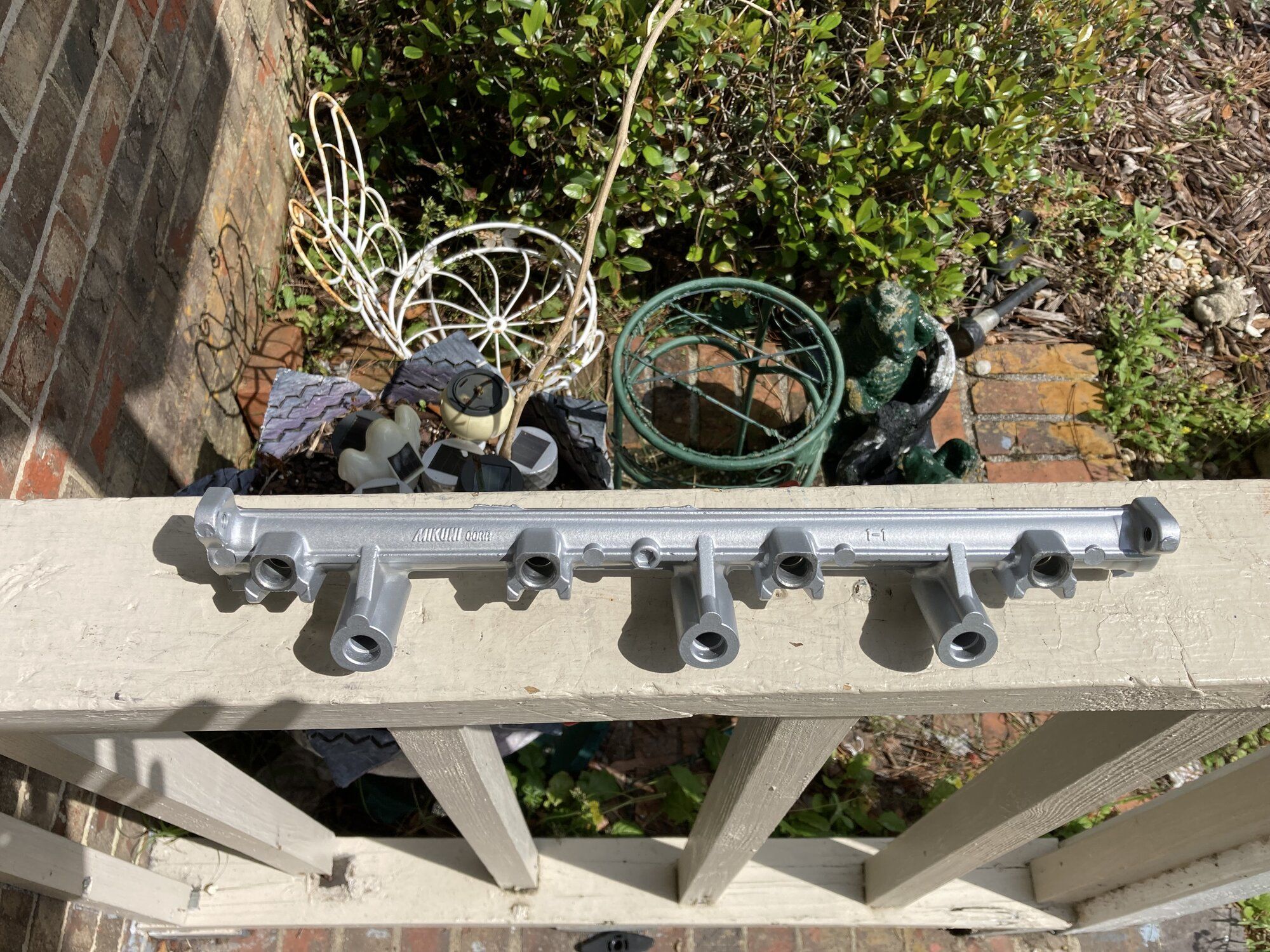

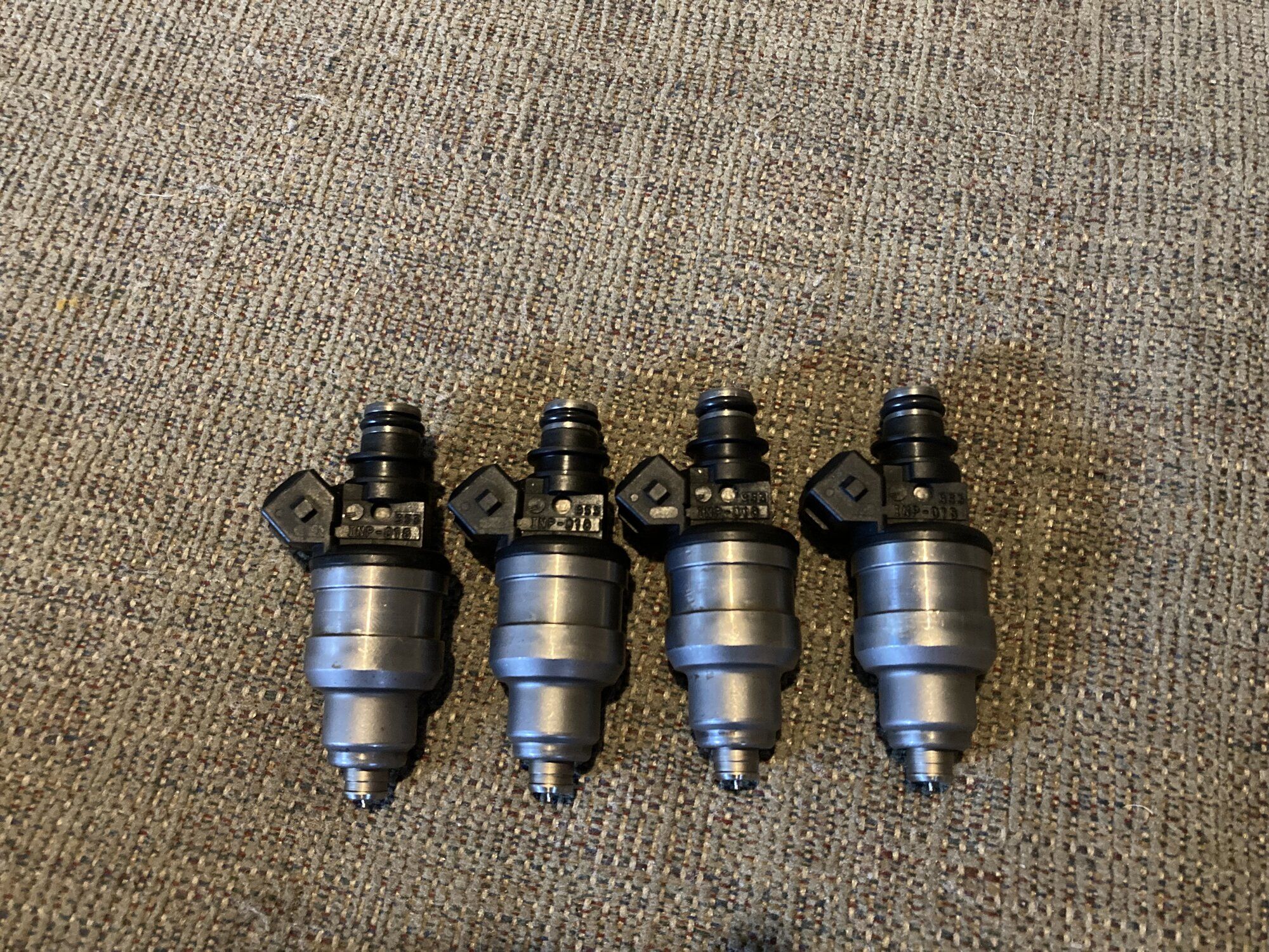

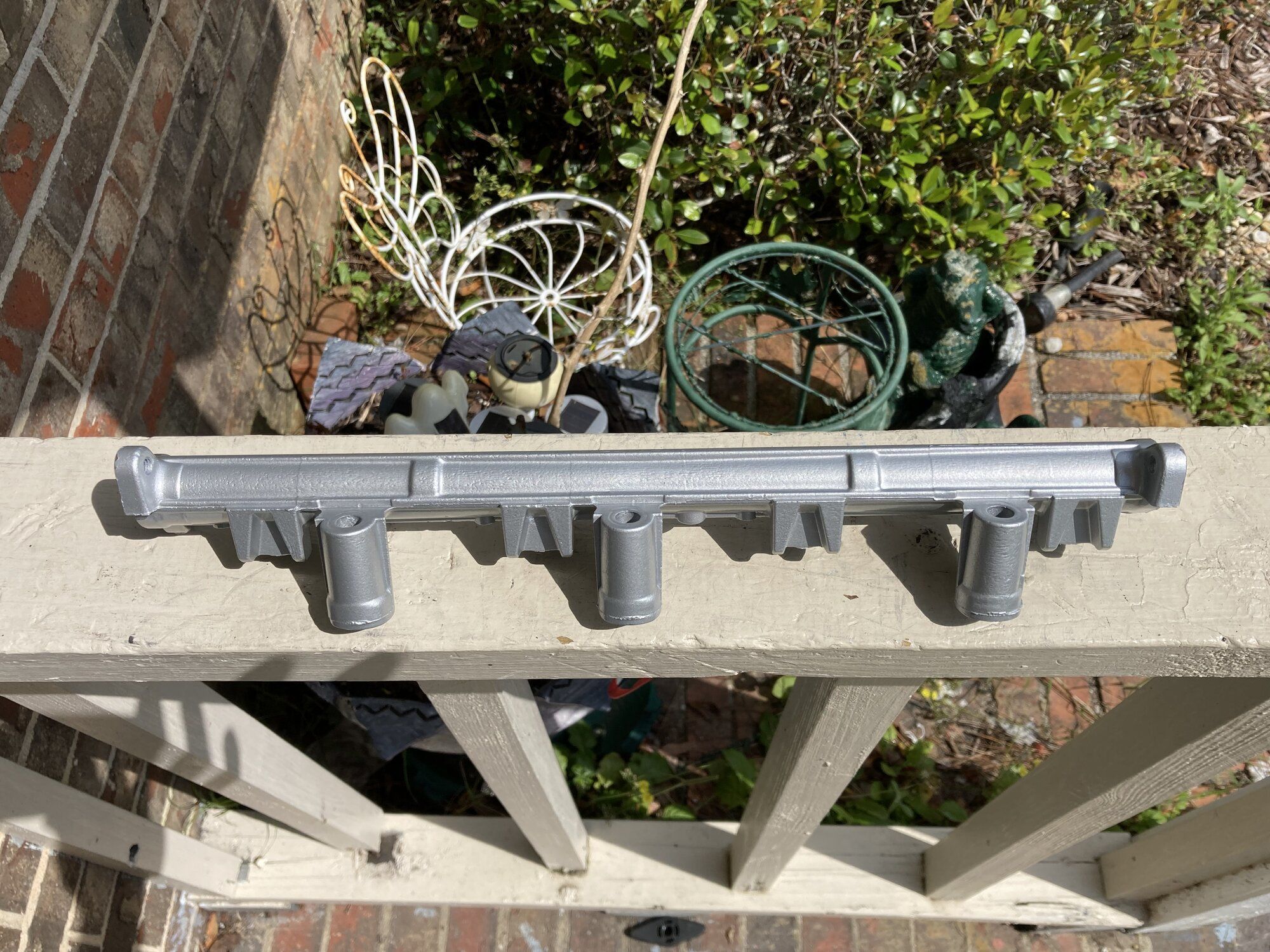

Messing around with some of my boxes and found a couple things from my 1G. Found a fuel rail, exactly 3 blue top 450’s, and a relatively great condition Walbro 190LPH fuel pump w/ sock. Lol. Good to have spare parts I guess?
