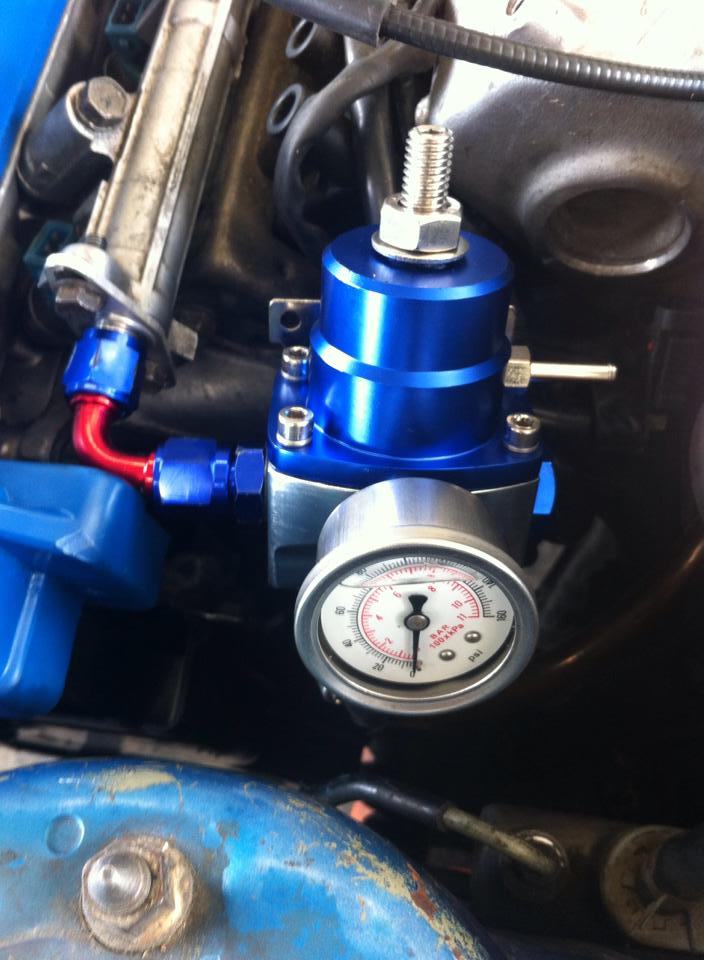

On the adj fpr we got this geneiss (knock off tomei), it actually has really good reviews and seems to be working well. Was $25
I showed my friend your car who actually owns this car and he wants to paint it the same blue, does look so good.
I have our car running and am about to update profile check it out
Interesting. Keep me updated on how it works out. Obviously I love the color on the FPR too. :p Also, he's got great taste! To save you some time, the paint code is B73. Paintscratch.com has really good stuff.

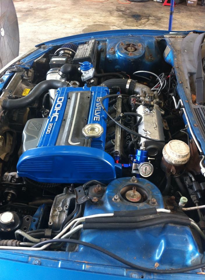

Well, my knee has had fluid on it still, but the swelling is down and I've got good pain meds, so I suffered through it to work on the car a little more today because I'm tired of being stir crazy doing nothing and being a gimp. I didn't get much done though because after a few hours, my knee wouldn't let me put any weight on it anymore. :p Pictures!

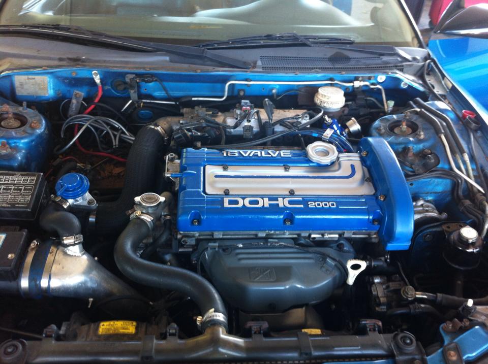

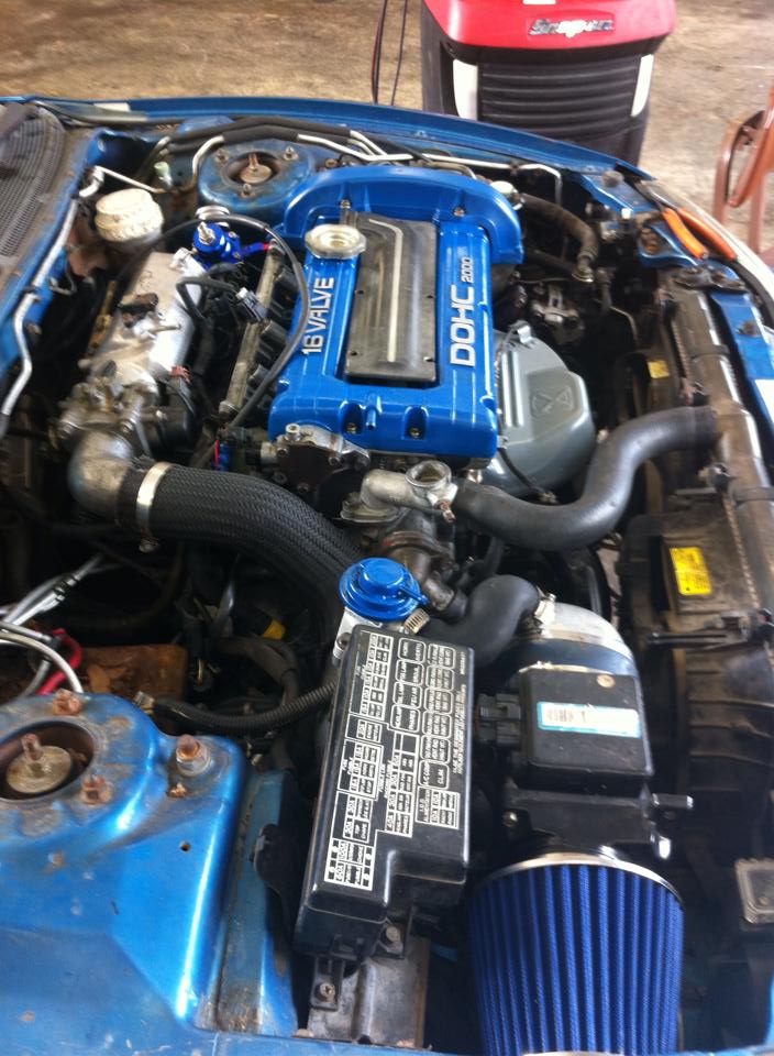

Looks so good. I am in love with how that BOV looks stock like it came that way from the factory.
Pretty cool is I found out the previous owner installed a non-cruise control throttle cable. Hilarious part though was he had it installed wrong. It was pointing out from the firewall towards the driver...for some reason. Lol. So I fixed that little snag and routed it the proper way. :)
I love my regulator. It matches the bay so well and looks good. Probably not going to leave the AFPR mounted directly to the rail though, I was just test fitting/working on the return line/test fitting it.

Very nice, you should post a video up of you starting it. I like to watch those videos. But that BOV does look kinda factory in their. Same with the regulator. Any who nice build man keep it up.
Definitely gonna do a start-up video. :D It's getting close too.

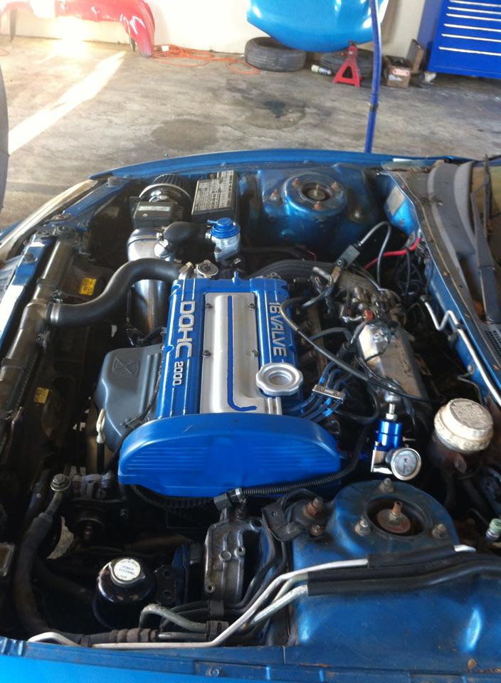

I got a late start to the day, and made up for it with some heavy lifting. It started out slow by replacing various clamps with brand new ones, tightening everything down, and then I got down to business. Got underneath Little Eagle, and tightened the TC bolts(with a metric ton of loctite. Lol), and then after that decided okay, the transfer case needs to go in TODAY. So, I hunted the bolts down only to discover the previous owner decided that he didn't need EVERY x-fer case bolt, and only had five. So I hopped on over to the Tractor Supply Store, and got the missing bolt. Perfect match, and a Grade 8.8 bolt instead of a 7. :D So I lifted the buiky SOB up on there, hooked up the DS to it, put it on the output shaft, torqued it all down, and the underside is mostly complete. Just need to bolt the down-pipe up(two bolts and a slip-fit clamp) and bolt in the A/C compressor(easier underneath it tbh) and the car will be able to sit on the ground!
At this point, the only things left to do are in its entirety 1) Bolt up the downpipe 2) Bolt up the A/C compressor, charge A/C system 3) Install stock crank pully and all belts 4) Fill trans and engine with fluids, check t-case for fluid level and fill as needed 5) connect remaining three connectors unplugged and then...finally...6) start/fix little small issues that'll pop up. :)

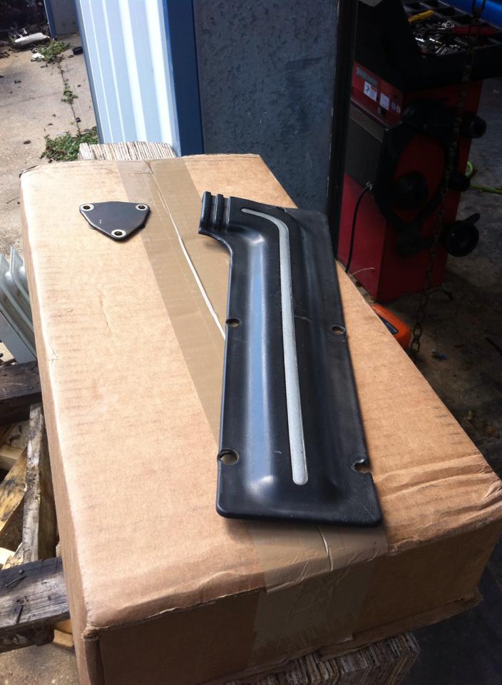

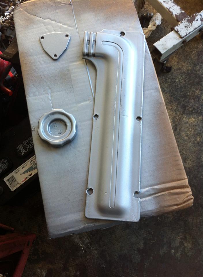

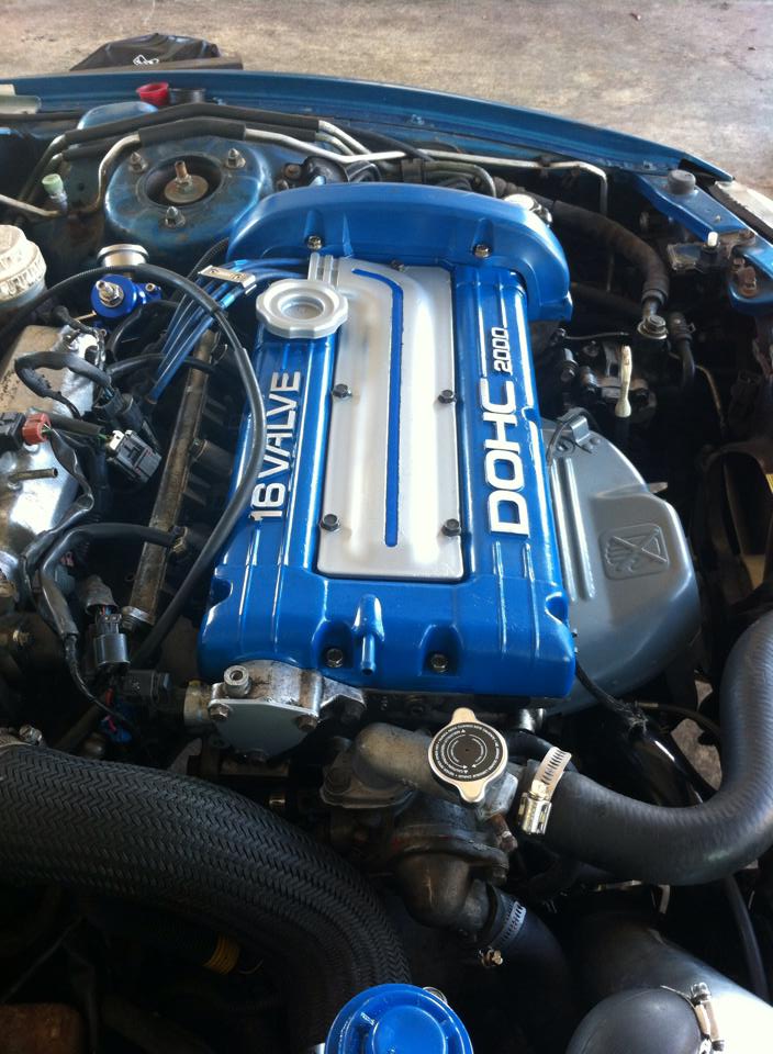

Today was a super productive day though. All the clamps are tightened, everything connected except a couple things, spark plugs and wires are installed in the proper order for a 2GB Cas using a 2GA ECU, and on top of that...I painted a few parts today! The CAS cover was terrible....see picture below.

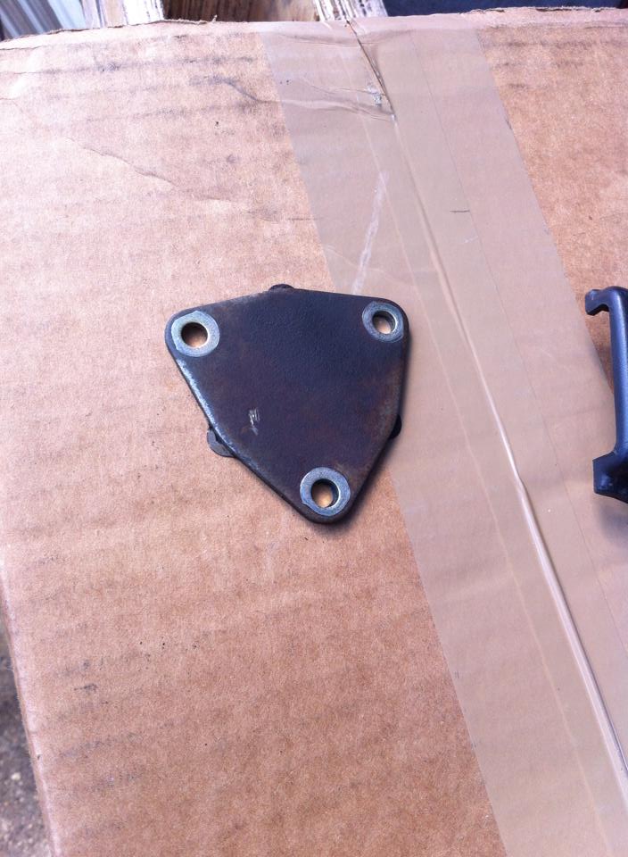

Blech. This was after a wipe-down of wax/grease/oil remover so it's still a little wet, but it's rusty and patchy and ugly. At the same time I decided to paint my oil cap(because it's a cheapo autozone one and it also looks terrible, but no before picture of it) and paint my spark plug cover to match my silver and blue engine bay color them. The VC and timing cover are blue as are a few other things, so I really wanted to cut some of the blue with a mostly silver piece, so I decided on mostly silver with a blue stripe. :) I think it turned out well.

Aaaaand after!

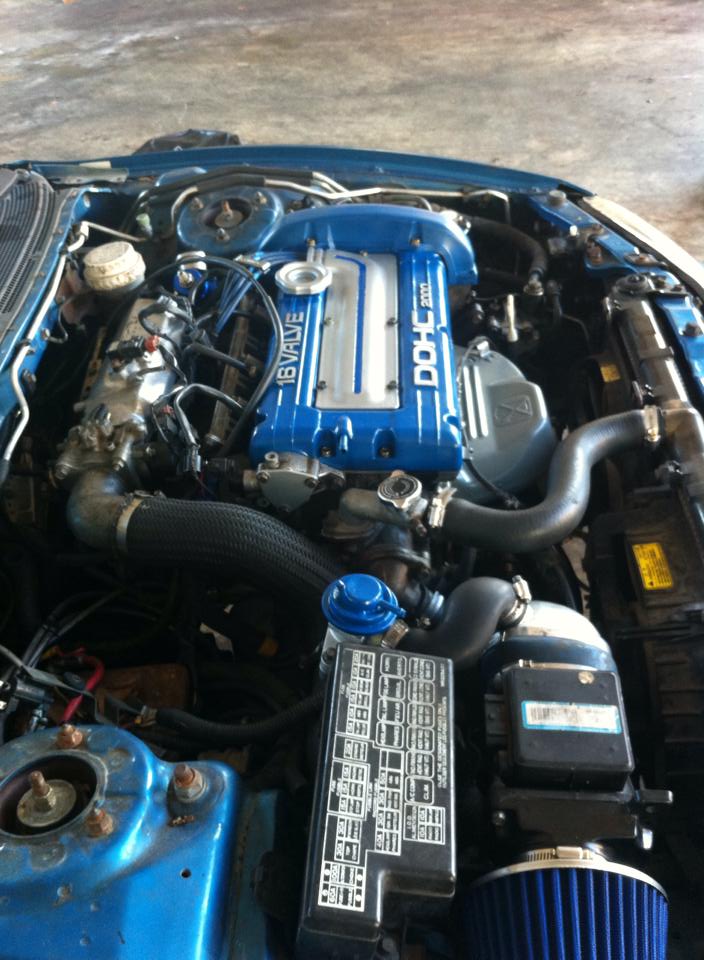

All in all I'm extremely pleased with how it turned out looking. The CAS cover looks a lot better, and I really think the spark plug cover was what it needed to cut some of the over-blue down. The engine bay will look even better once I go with a FMIC because you'll have that solid aluminum shiny pipe and a small hint of blue couplers to offset it. But hopefully in the next day or two, I'll be posting a start up video! And maybe even a first drive! :D Prayers and happy/well thoughts my way definitely appreciated. Thanks for all the kind words and the views/likes!
Definitely like the silver to offset the blue, makes it pop a lot more. Look in to getting some new bolts to rid the bay of rusty parts. A seller on ebay sells a 213 pc bolt kit for like $60, and I was very pleased on how much better it looks. Also pull that brake bracket and paint it!!! Overall great job, look foward to the start up :cool:

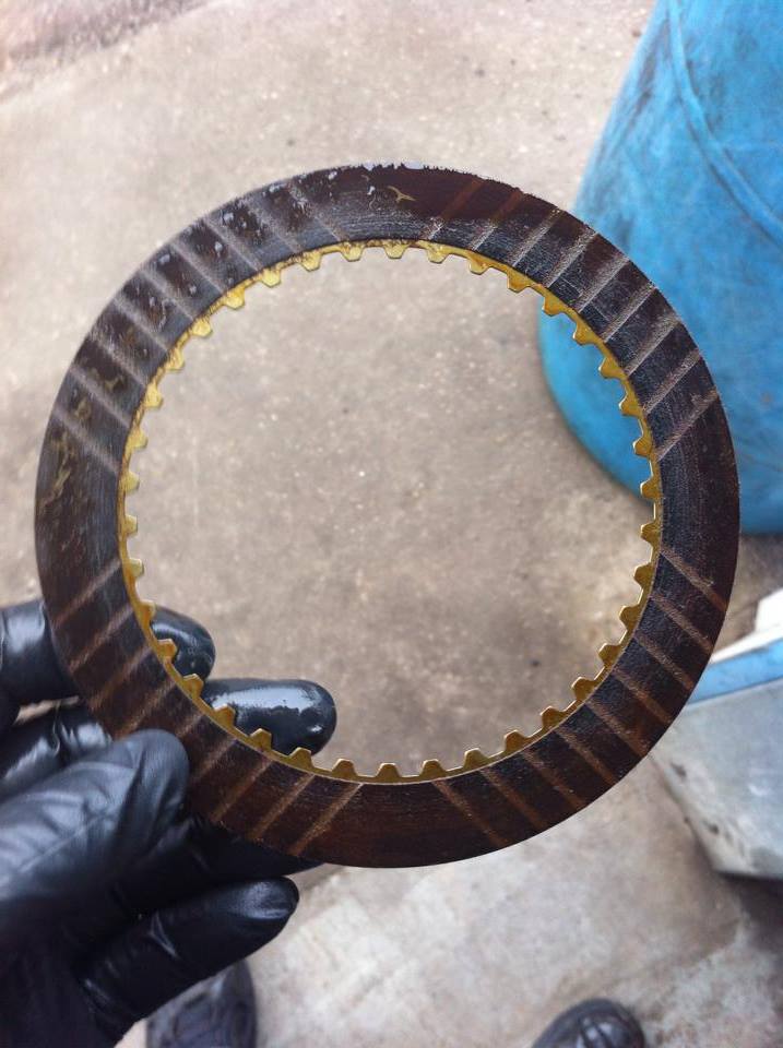

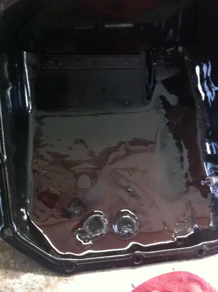

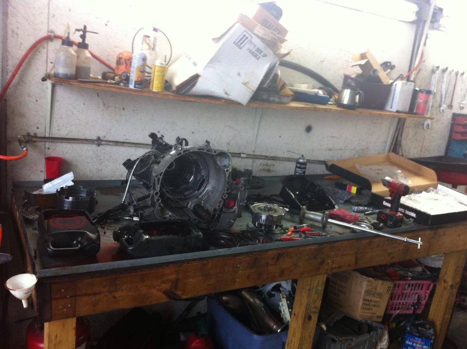

Well, after the transmission recently lost 2nd, I finally had it towed back up to my shop and pulled the transmission today. I am dog tired due to lack of sleep and don't trust myself to be meticulous because of how exhausted I am, but I do have a little bit of news.

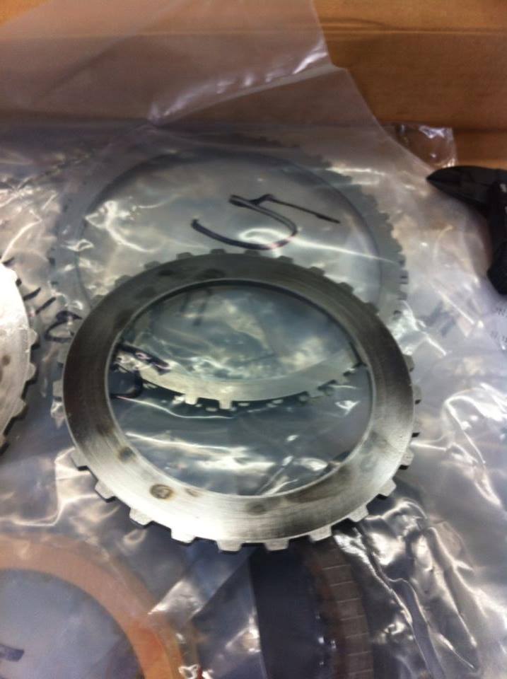

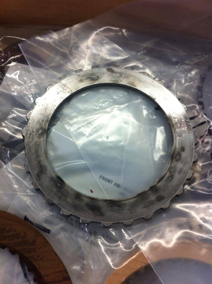

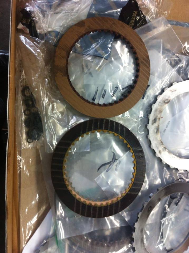

Quite a bit of clutch material on the drain magnet, as well as in the fluid. Fluid itself has less than 200 miles on it, and looks burned. Has silver streak in it as well. No metal chunks or flakes though, just silvery and clutch material on the magnets. A major problem was the torque converter. I had to pry it off with a pry-bar and "walk" it off of the input shaft. They are not supposed to be that hard to come off, so I'm just going to assume the TC is crap and is the cause of the problem. I will still be rebuilding the entire transmission, but definitely gonna replace the TC too. Also, I compared the pilot bushing on the crank, with my brand new 2G OEM pilot bushing I got from ExtremePSI, and the one on the car is entirely too long. I'm thinking it pushed the TC too far onto the input shaft and "rurnt" it.

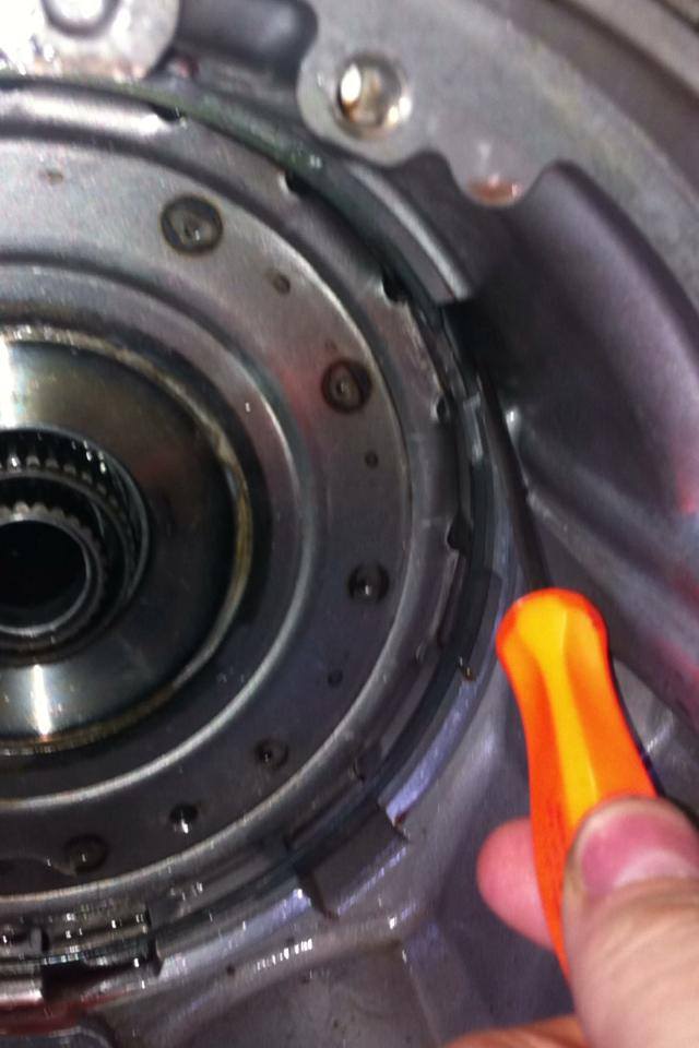

Balls deep in this transmission rebuild and hit a snag. The snap ring that holds the planetary cover isn't going in because the cover refuses to go all the way back for some reason. I gave up and gave myself a couple days to relax. Here's the mayhem. Installed the Translab shift kit completely, found out the solenoids were completely blocked by clutch material/sludge, and one screen was torn as a result. Definitely clutch material all in the VB and the front clutch was toast, as was the reverse clutches. Oodles of pictures to follow.
