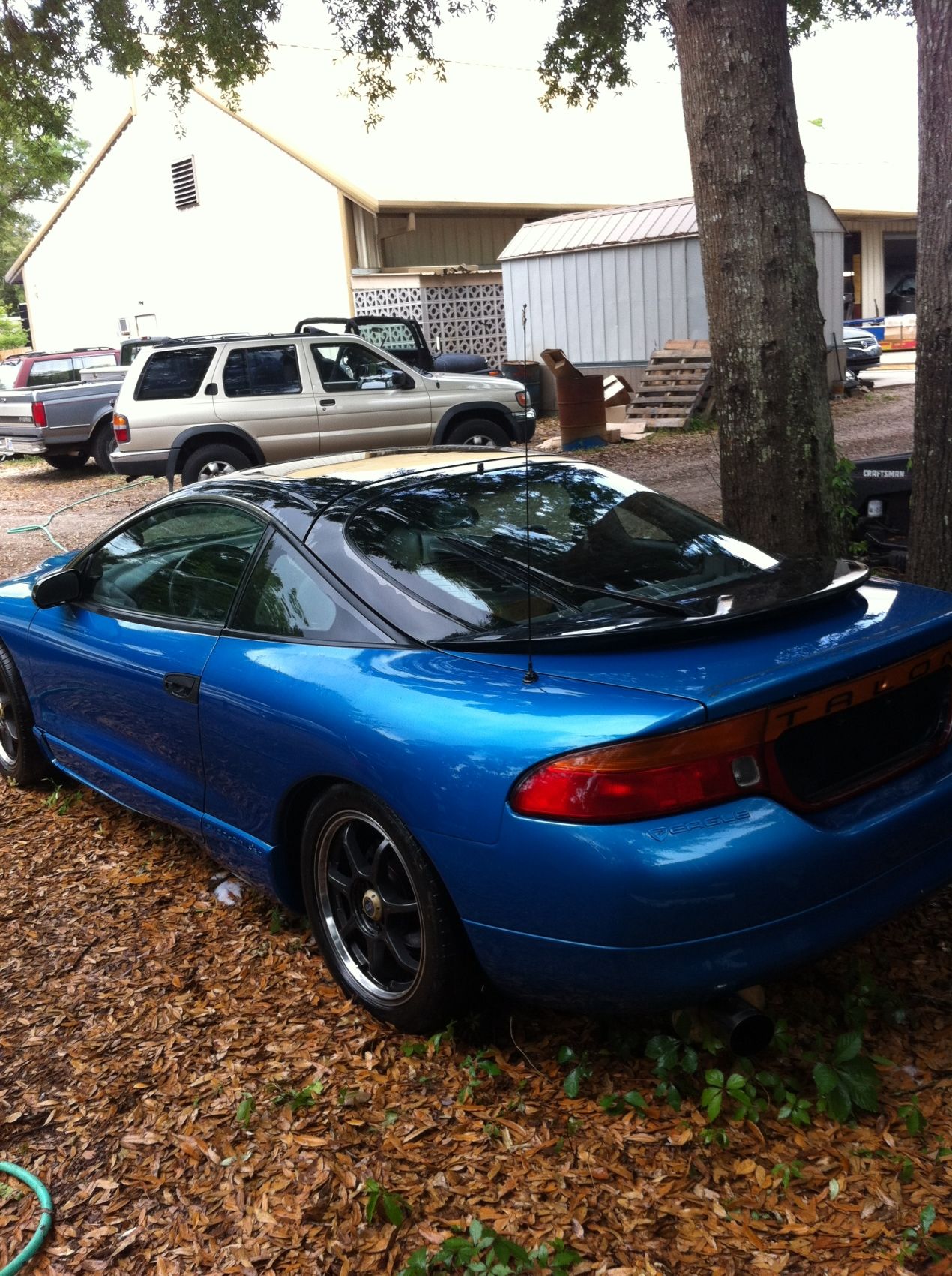

Kona Blue stock Talon that I've dubbed "Little Eagle" that's getting slowly restored to its former glory.

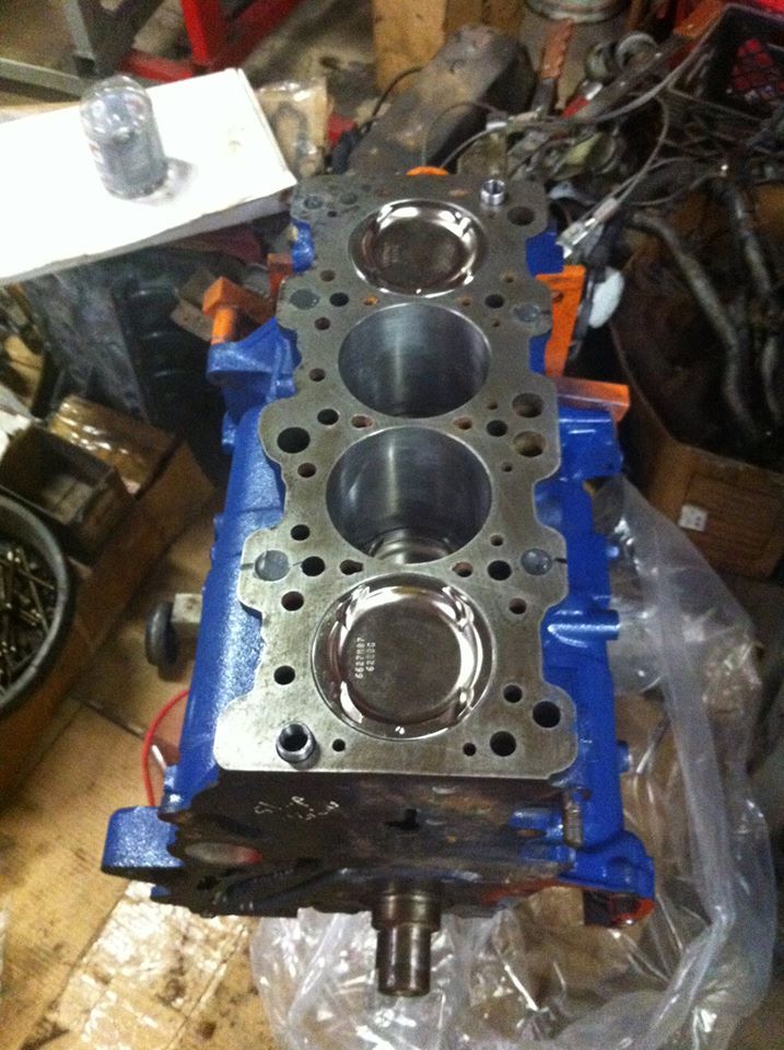

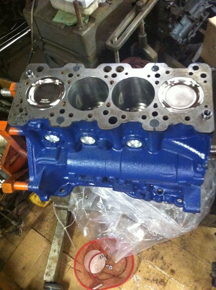

Looky what I've got here.

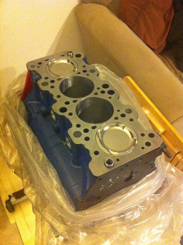

:). 4G64 split thrust block. Bored .020 over. Wiseco 1400HD "stroker" pistons 9:1 compression, BC 156mm "long" rods. Balanced stock 4G64 crank, check balls pulled and galleys cleaned and blocked off. ARP Main studs w/ line hone. King Race Bearings(rod and main), BS bearings spun 180* for BS delete. Deck is a little dirty, but this motor was built by BogusSVO himself. Should push the weight of Buzzkill around pretty nicely. :D

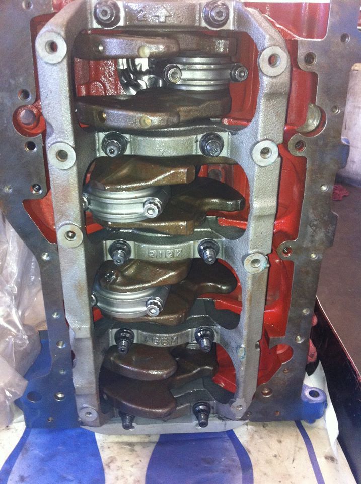

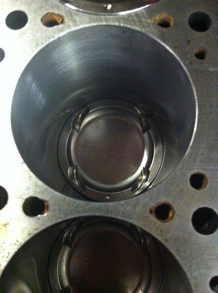

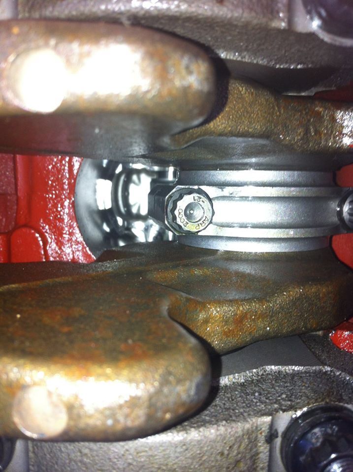

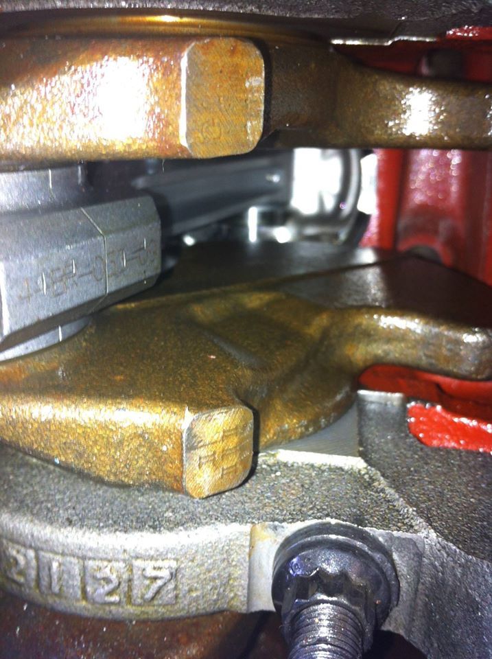

Got the engine back from BogusSVO today, and blew out all the coolant/oil jackets and blew out the cylinders/oiled everything down. Also took the obligatory pictures of the rods/pistons and mains/crank. So purty.

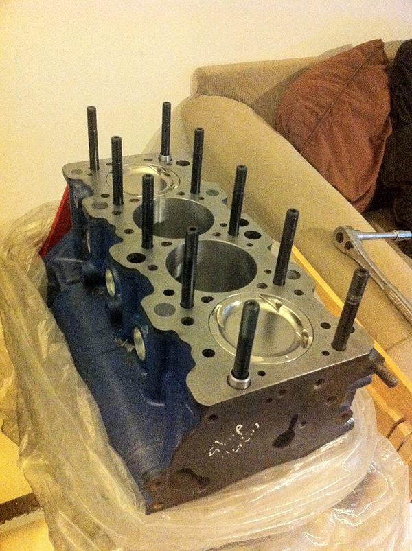

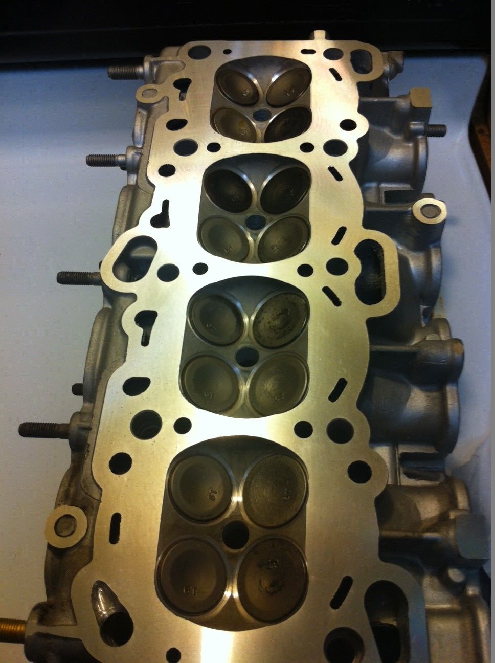

So after some suggestions and research I took a green scotch bright pad and some WD40 to the surface of my deck and went to down. I removed a lot of the surface rust and the surface itself still feels smooth as glass. There is some slight discoloration there still, but I trust the surface. It shines a teeny bit better than before too, so that's a bonus. :)
View updates to this DSM profile...
Before:
4g64-long-jpg.237629
After:

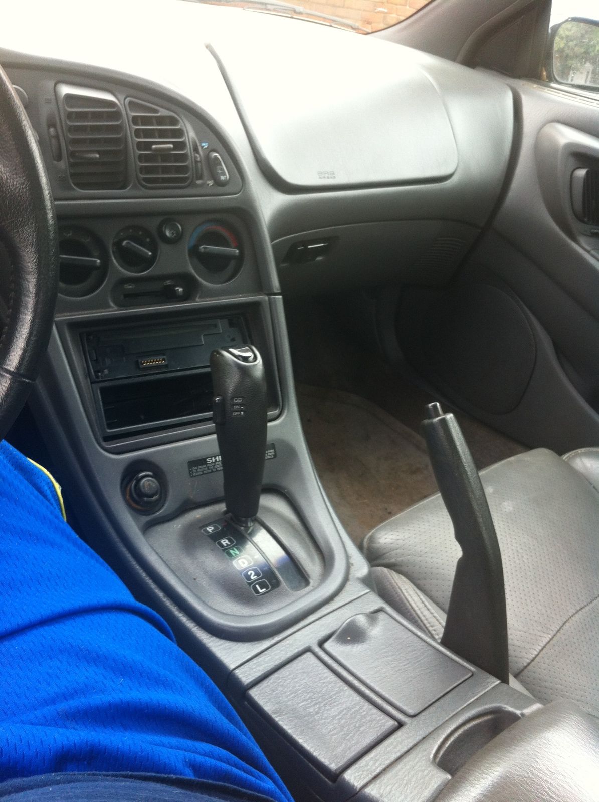

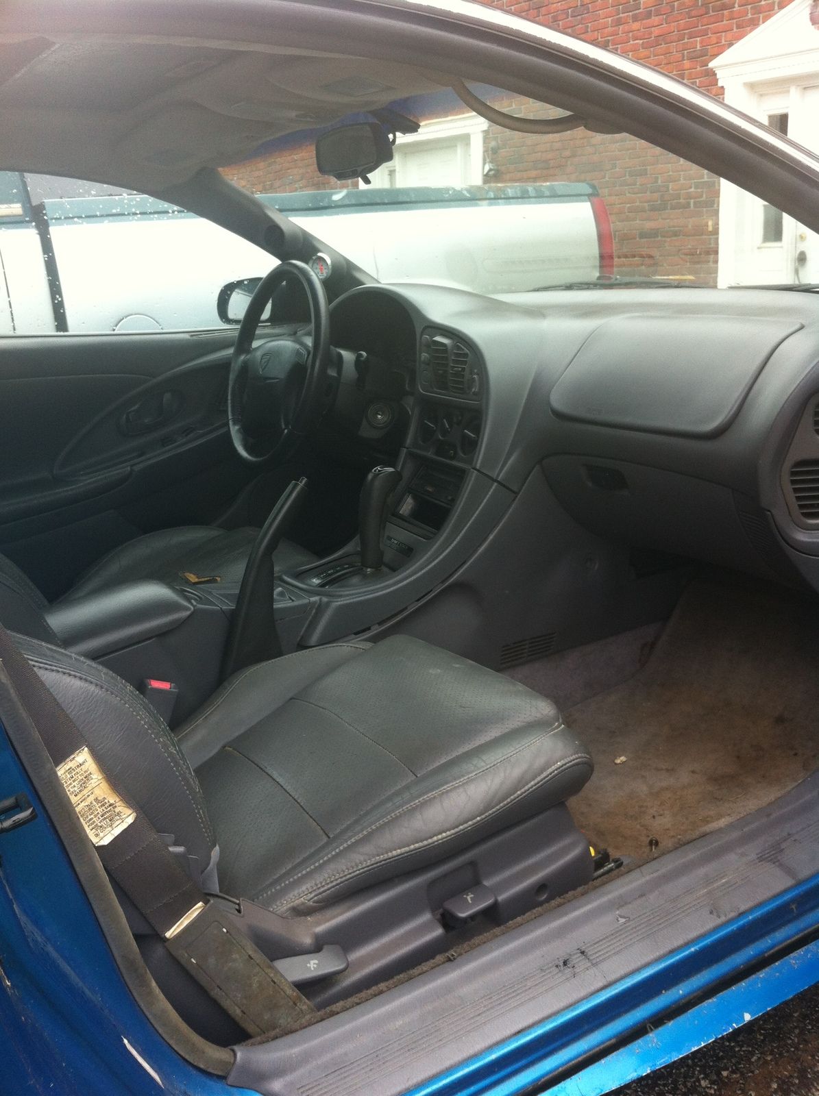

Added a few pics of the interior of ol' buzzkill. Nothing has been washed in like 3.6 million years, but man this interior is comfy. I love my 1Gs, but I can see why people like 2Gs. It's very cushy and comfortable compared to my 1G.
The pictures:

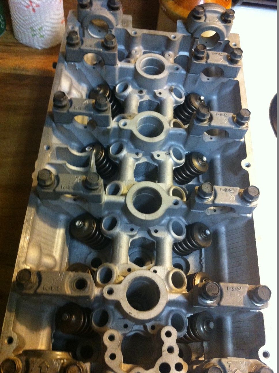

Picked up some BogusSVO goodness yesterday on my lunch break at work. Stock valves that have been unshrouded, oil port mod #1, BC1100 springs and retainers, EGNBLDR 3mm 'big bore' lifters, all that good stuff. Locals get the best deals. ;)
Good stuff. More to come as I get it.

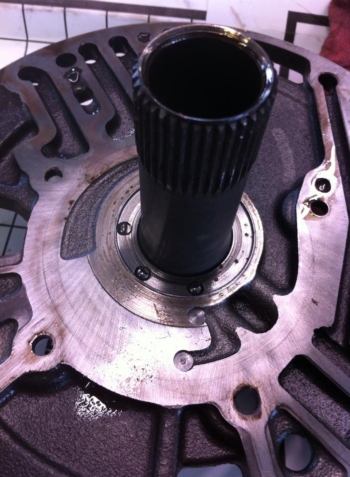

Fun times ahead. Transmission rebuild parts are all finally assembled. Overhaul kit, IPT restalled TC, fresh transmission pump(plus I picked up a spare just in case! Lol). So finally the transmission will be all nice and purty and working again. This was the old pump.
Yeah. Groovy. Literally. Lol.

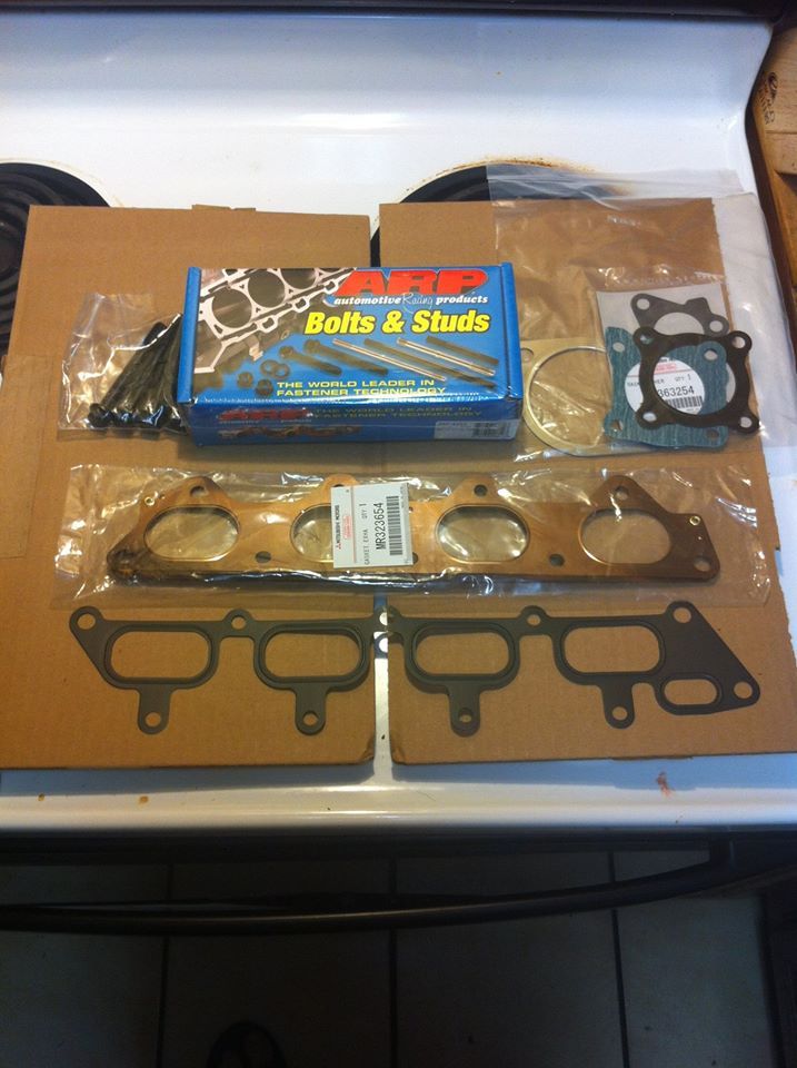

From here though I've got the ARP headstuds, gaskets, and random stuff I need to get the motor all assembled as well. Soon she'll run and drive, God willing!! Also went ahead and ordered an LC2 wideband w/ blue DB gauge, and a blue digital boost gauge from Glowshift(worth a shot and it matches). I'm really the most excited about the IPT torque converter and stuff though. Stay tuned for more updates and assembly pictures.

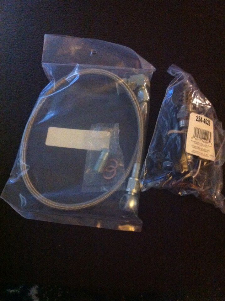

But this came in today. Slightly less boring because it's new in bag!
Stainless oil feed line from OFH to turbo, and new O2 sensor. Can't wait for the fun parts to start coming in!

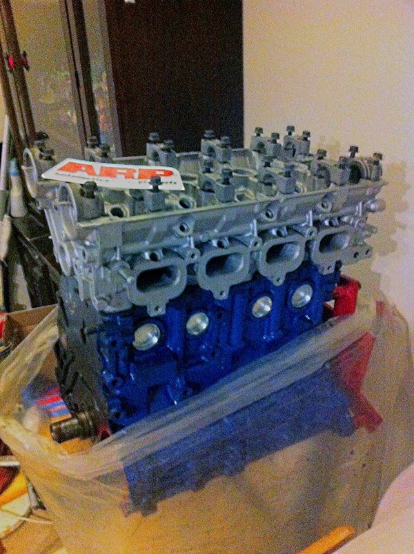

Today was hot as hell, so there was limited progress...HOWEVER...there was some progress made today!!

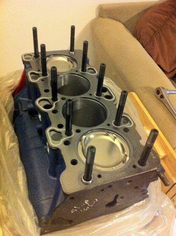

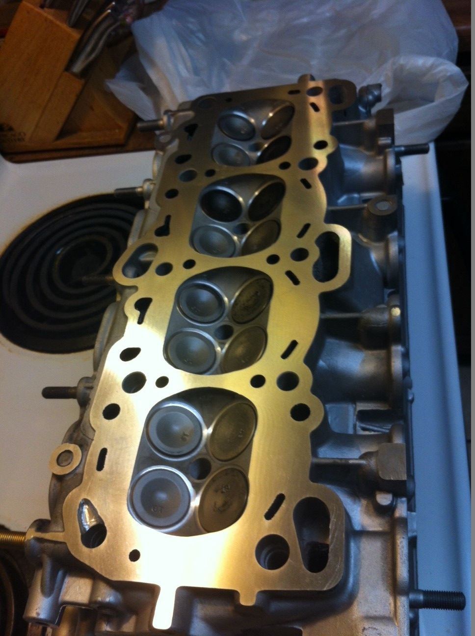

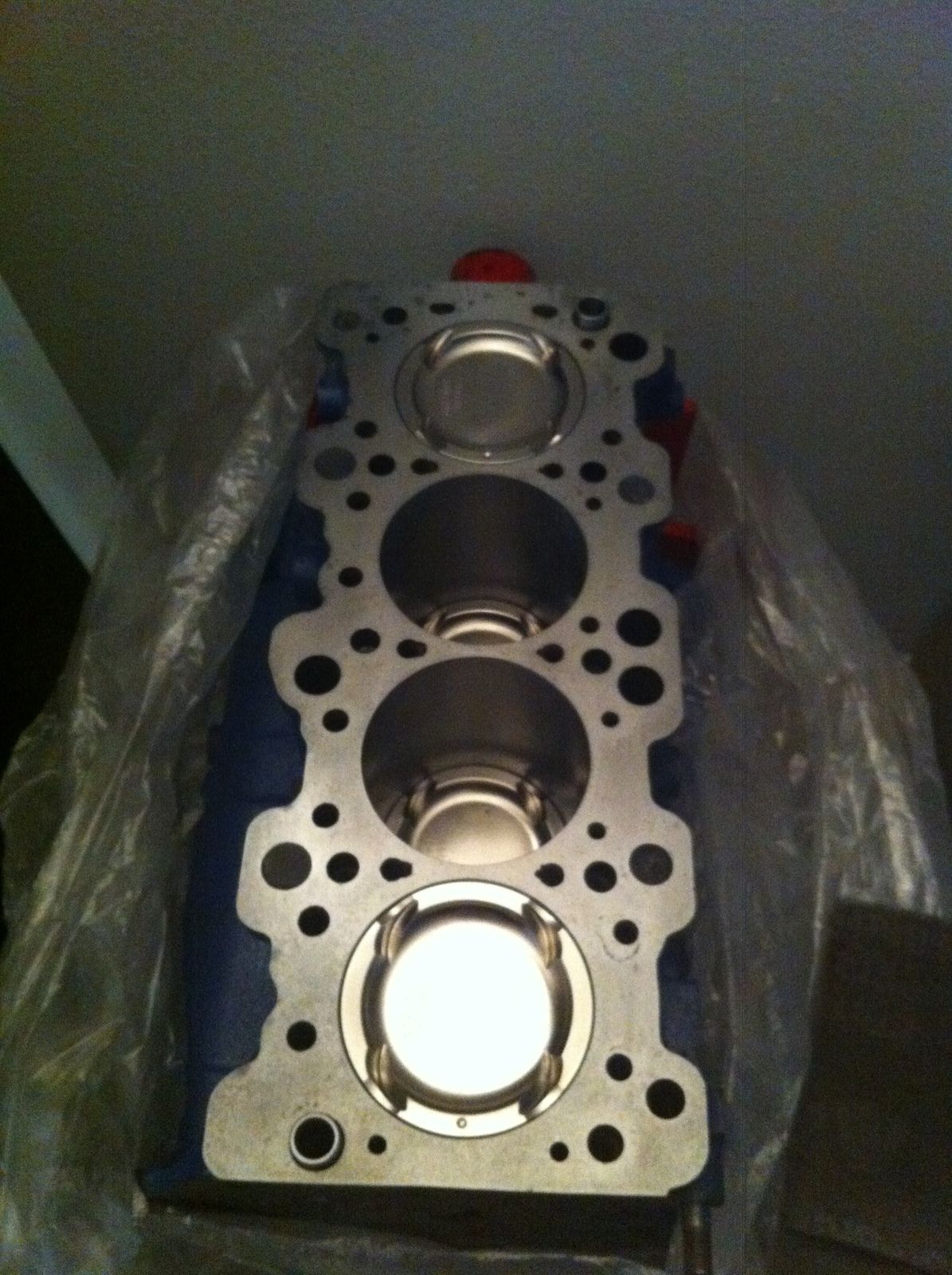

Head is on the block, ladies and gentlemen, it's finally coming together! I just need to run on over to BogusSVO's shop to grab a set of stock cams, and this bad boy will be timed, and all accessories will be installed and ready to go. Build long-rod 2.4L goodness!!
Looking good.
What are the details on the head gasket?
Looking good.
It's just your regular 4G64 head gasket. My bore is 87mm so a regular '63 gasket would hang in the cylinder a bit. The '64 gasket is 88mm so it doesn't hang in the cylinders. There's a member here running mid 30 psi on an FP black using this hg is what made me go with it.
