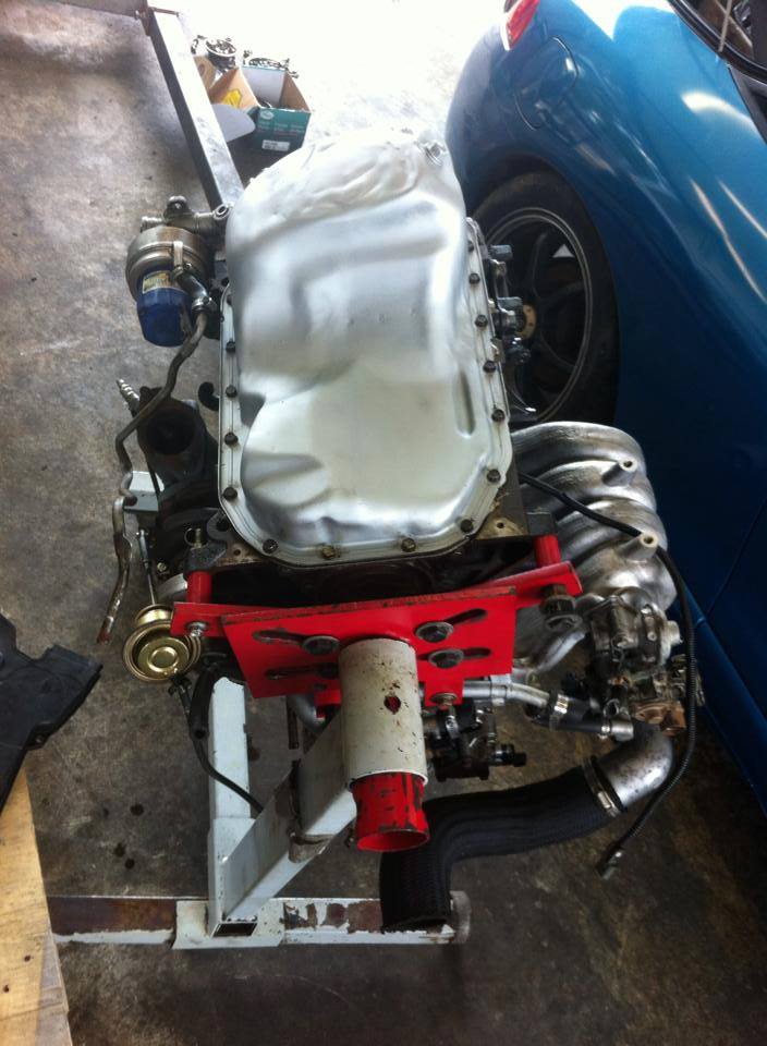

Please tell me you put the windage tray on that girdle...
Yep, I did. However soon after I discovered something that halted the progress.
Are you going to bang out the bid dents in the bottom of oil pan? Those look deep enough that they could interfere with the oil pick up.
FYI: My 7 bolt 4g63t pan fits my 7bolt 4g64 perfectly, including the ARP mains.
I'm going to get an entirely new oil pan because this one is full of dents, and it's full of caked on sludge that is mixed with metal flakes from the bent rods/spun bearings/terrible motor damage from before. Not even a hot tank cleaned the underside of the baffle in the oil pan.
Also, all of my issues are because it's a 3G 4G64/Evo 2.4. I had no idea how different the two motors are, and they look identical at first glance. Totally do not blame my machinist either because not even I could tell. This thoroughly puts to bed the "you can totally fit a 3G 4G64 in a DSM" though because all of the bolt holes except for two on the bellhousing do not line up. Not even close. So right now progress is halted.

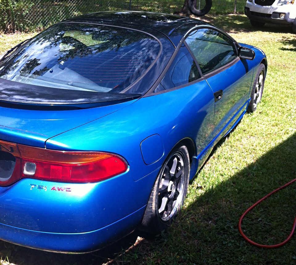

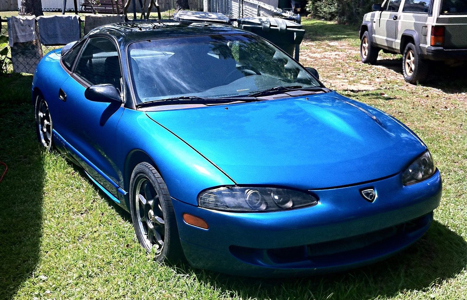

This is how it looks right now. I washed her yesterday, but today the sun hit it juuuust right. ;D
Soooooon. Stay tuned. :)

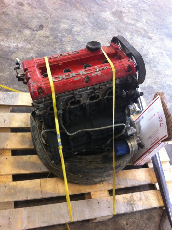

So...Miller made me an offer I couldn't refuse, and so along with my freshly rebuilt 0 mile revised 7 bolt w/ brand new OEM rotating assembly I'm getting from miller...I purchased a complete 2GB Talon swap kit minus front bumper from him for a steal. :D So this baby will be a fully 2GB Talon swapped that's Kona Blue. There's only been two others that I know of that has done this, and one of them wasn't fully swapped because it lacked the side slashes/garnishes/strakes. :D Can't wait til the motor gets here and I can get this baby running.
Progress!! The motor came in from Miller Import Parts and was better than I was originally expecting in a lot of ways. There was a couple hiccups, but Stevie Miller was helpful and if I have issues he'll help make it right. (Edit: I take everything back, Stevie scammed me with this engine, and was absolutely unhelpful. Refused to make anything right and has ignored me ever since after telling me the exhaust ports “look normal” to him. Avoid miller import parts at all costs)
Before

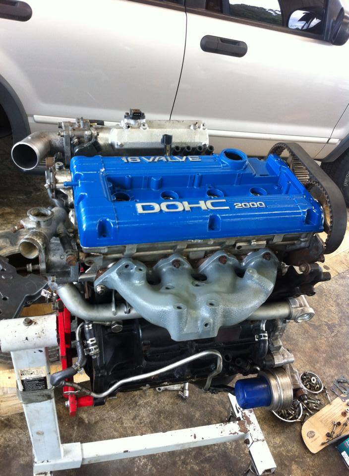

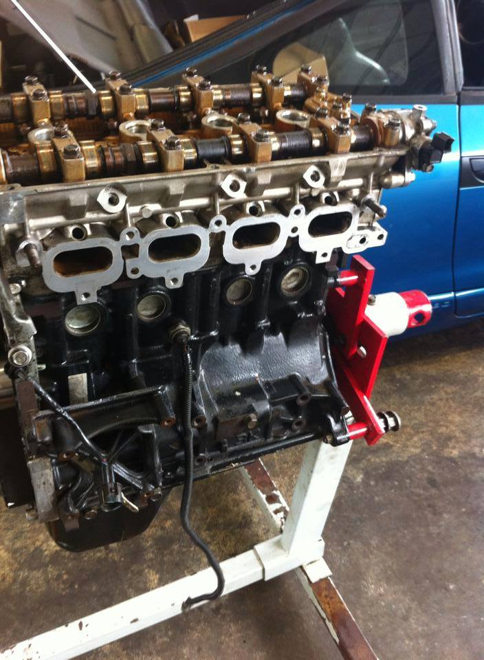

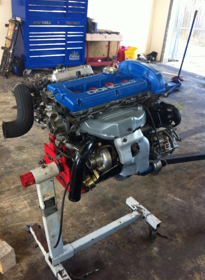

During(I decided to fully degrease the engine and clean the ports up as well. Gotta have it clean! Look how good it looks. (There's Buzzkill himself in the background too)
Mmmh.
After! Self explanatory. All new OEM gaskets everywhere, new OEM timing belt and timing assembly. ARP head studs...and the red is gone! ;)
:D I spent most of the day cleaning everything, getting the timing set dead on, and putting my ducks in a row. Hopefully big progress tomorrow! :D
That dirty motor was the 0 mile rebuild from miller?
Should it not have been hot tanked? Or maybe I missed something.

Yeah he purchased it from some dude who had it sitting for awhile. Either he willingly knew it was bad, or is the most ignorant person I’ve ever met. I think personally he scammed me on purpose because it’s obvious this engine is a hack job.

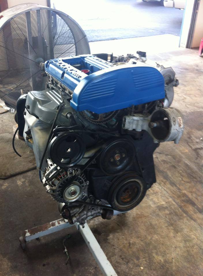

More progress! Didn't get the motor bolted in like I want because my parents had their truck broken into and had to deal with that...but I got a fair bit done. I degreased, cleaned, and painted even MORE stuff(the previous owner let this thing get ridiculous, man).
Exhibit A of the cleaning/painting
:D I like it better flat Aluminum colored than black because it's more aesthetically pleasing, AND it helps you see oil pan leaks better..
Exhibit B. Everything is bolted on and ready to drop in! Also, holy crap did mitsubishi go full retard on these OFH and Turbo coolant feed/drain lines...flexplate, pilot bushing for the TC, and starter plate are bolted up too but the camera died. I am excited!
Hopefully tomorrow will be a super productive day and I'll get it bolted in, filled up with fluids, and started! But even just bolted in and mostly hooked up will do fine. Stay tuned. :) Thanks for all the likes and kind words you guys have given me, even though it's just a boring stock rebuild instead of a built 2.4/medium turbo goodness. I've also decided to rename this build from Buzzkill, to Little Eagle due to my Cherokee heritage, and it just seems to fit better. :)

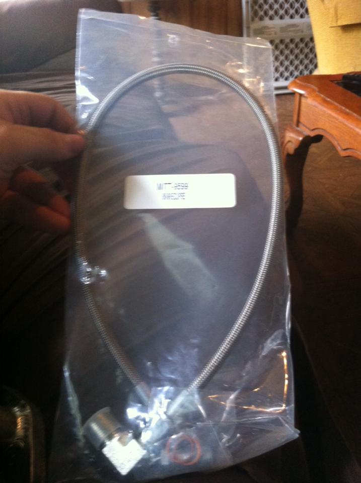

Well, progress is at a halt. Discovered today that I misplaced my oil feed line and no one locally has anything to make one from scratch, SO, I kind of stopped working on it because it's pointless to get it all together but not be able to run it due to no oil to the turbo. Plus I'm lacking coolant/heater hoses and a mess of other things. All of them are ordered and on their way. :) I leave you tonight with the picture of this. Looks so good sitting there all pretty.

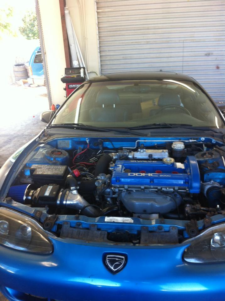

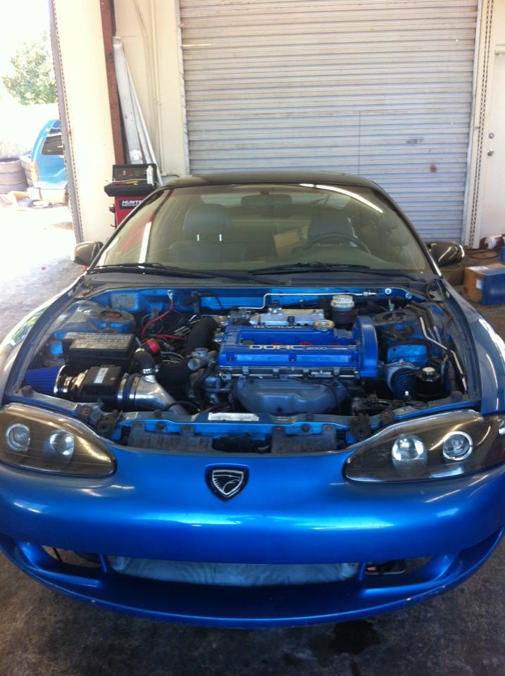

Today I couldn't resist slapping the motor in the car even though I'm waiting on a few parts before it actually gets running. This thing looks so good...

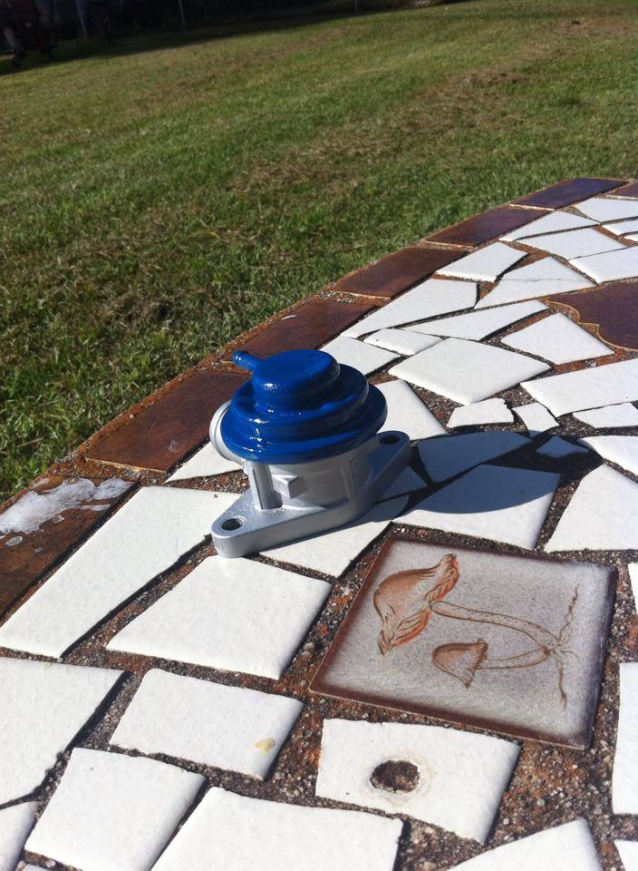

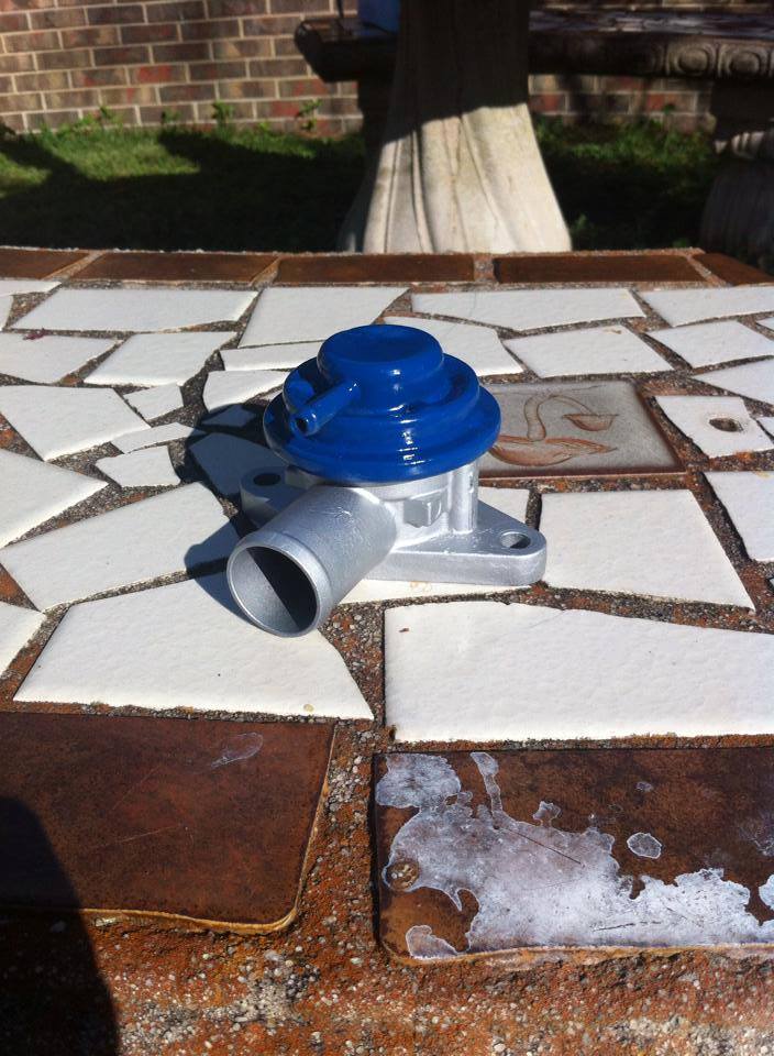

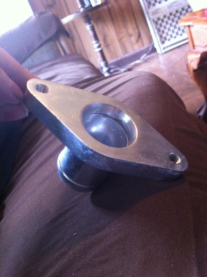

And to replace the stock leaky 2G BOV, I'm going with a 1G BOV w/ adapter. The BOV I got was half-heartedly painted wrinkle black and it was faded, dusty, and terrible shape. Covered from cap to mount in black. Ugly as sin. So I had leftover paint(VHT flame proof and 500* engine enamel...good to know this BOV can handle engine temps. :p) and I think it looks AMAZING. Definitely gonna offset the engine bay nicely. So far the theme is silver and blue. :)

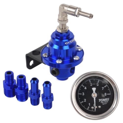

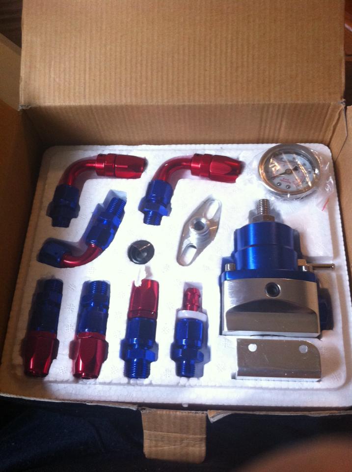

Well, this little guy came in today. Hard to believe this is what held me back from starting it. Lol. But, it's all good, I've got a LOT more coming to me that I'm happy about too. :D Unfortunately I've injured my knee quite severely, and knees take for-freakin'-ever to heal...but soon as I can stand up for a couple hours without agony, I'm gonna be installing these parts soon as they get here and hearing Little Eagle come to life. I'm so damn excited. Here are the other two parts I got today too. :D
:) 1G BOV adapter since I'm still on stock piping. This will match the silver and blue theme nicely!
Yes it's an eBay AFPR kit, however the diaphragm has been replaced with an authentic Aeromotive diaphragm/internals so it'll hold fuel like a champ. I got it from a trusted friend. Plus the blue/silver will match the engine bay nicely. :D

On the adj fpr we got this geneiss (knock off tomei), it actually has really good reviews and seems to be working well. Was $25
