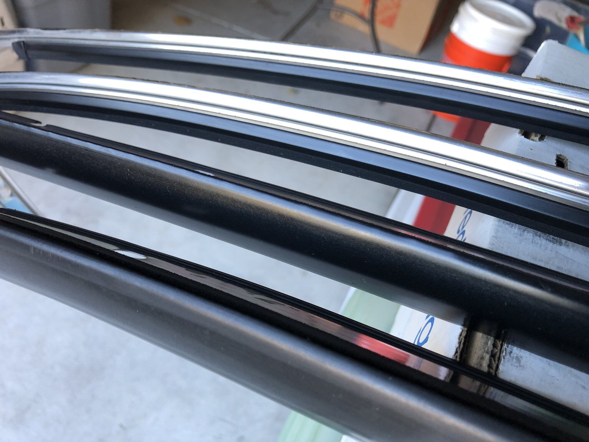

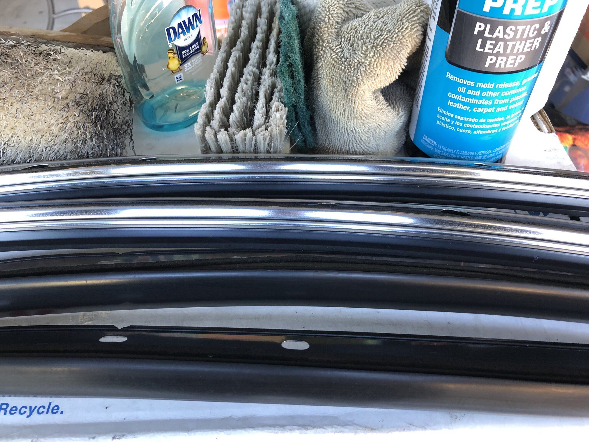

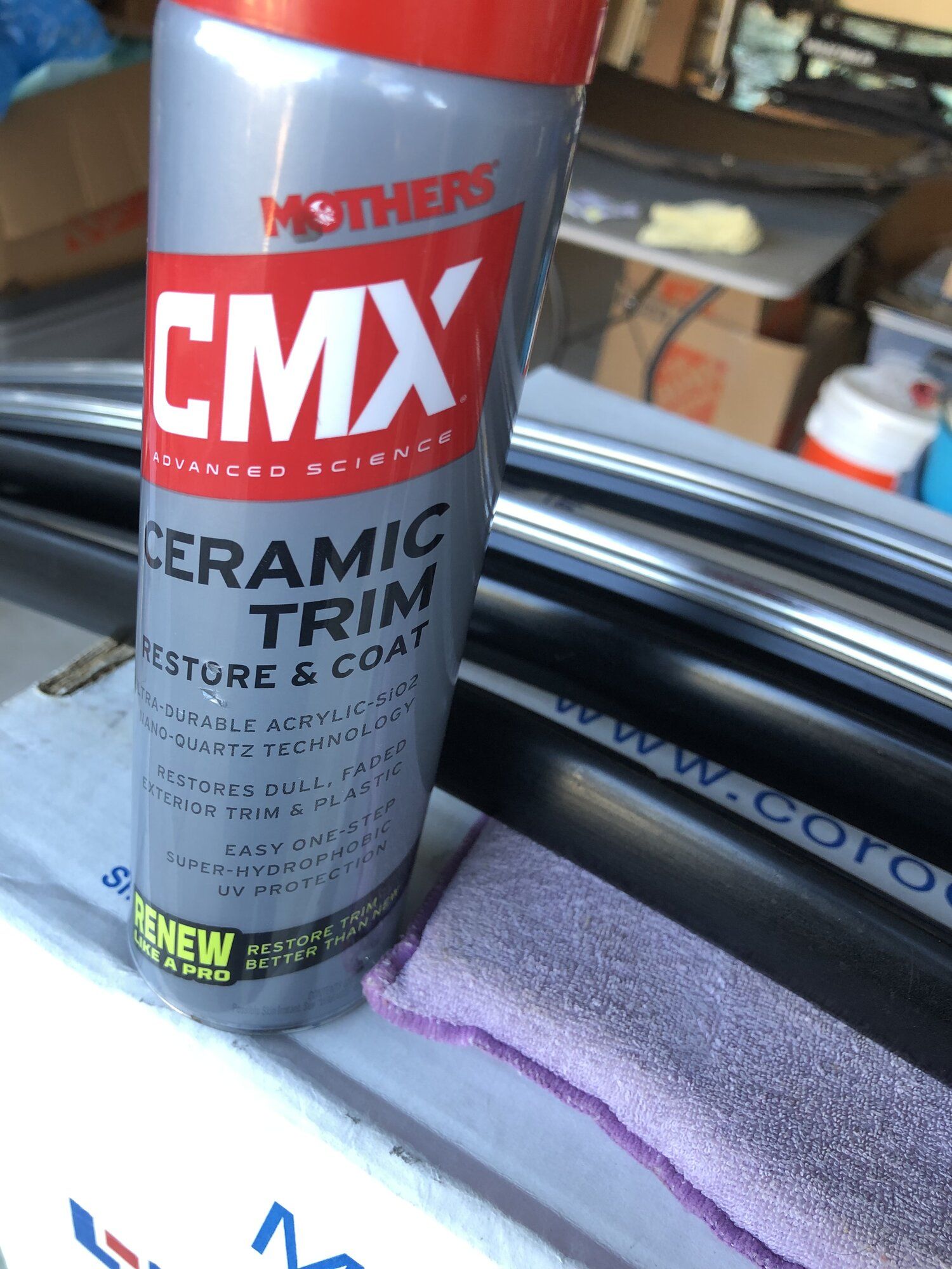

These were the best drip and glass moldings in hand, rubber is intact, scuffed a bit. I wasn’t able to locate a 1/4” open cell foam tape in time for a proper restore, so I cleaned and prepared leaving the old foam. I did scotch bright out any rust spots, and treated the rubber with a wash, scrub, prep, and the best product I could locate in stores for now - meguiers ceramic trim gel-

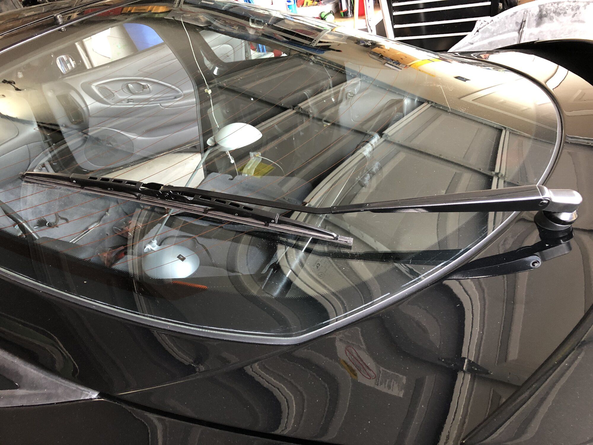

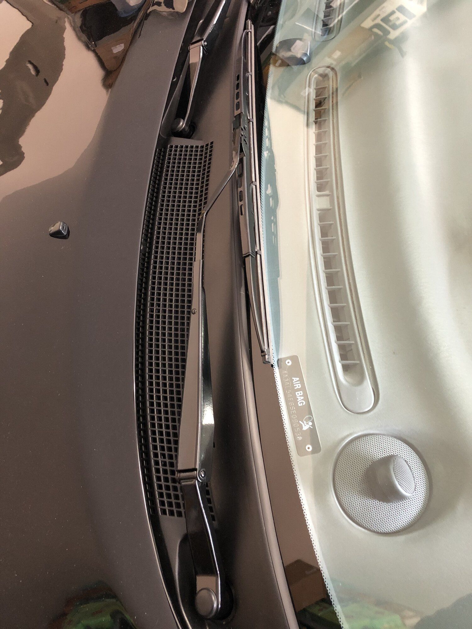

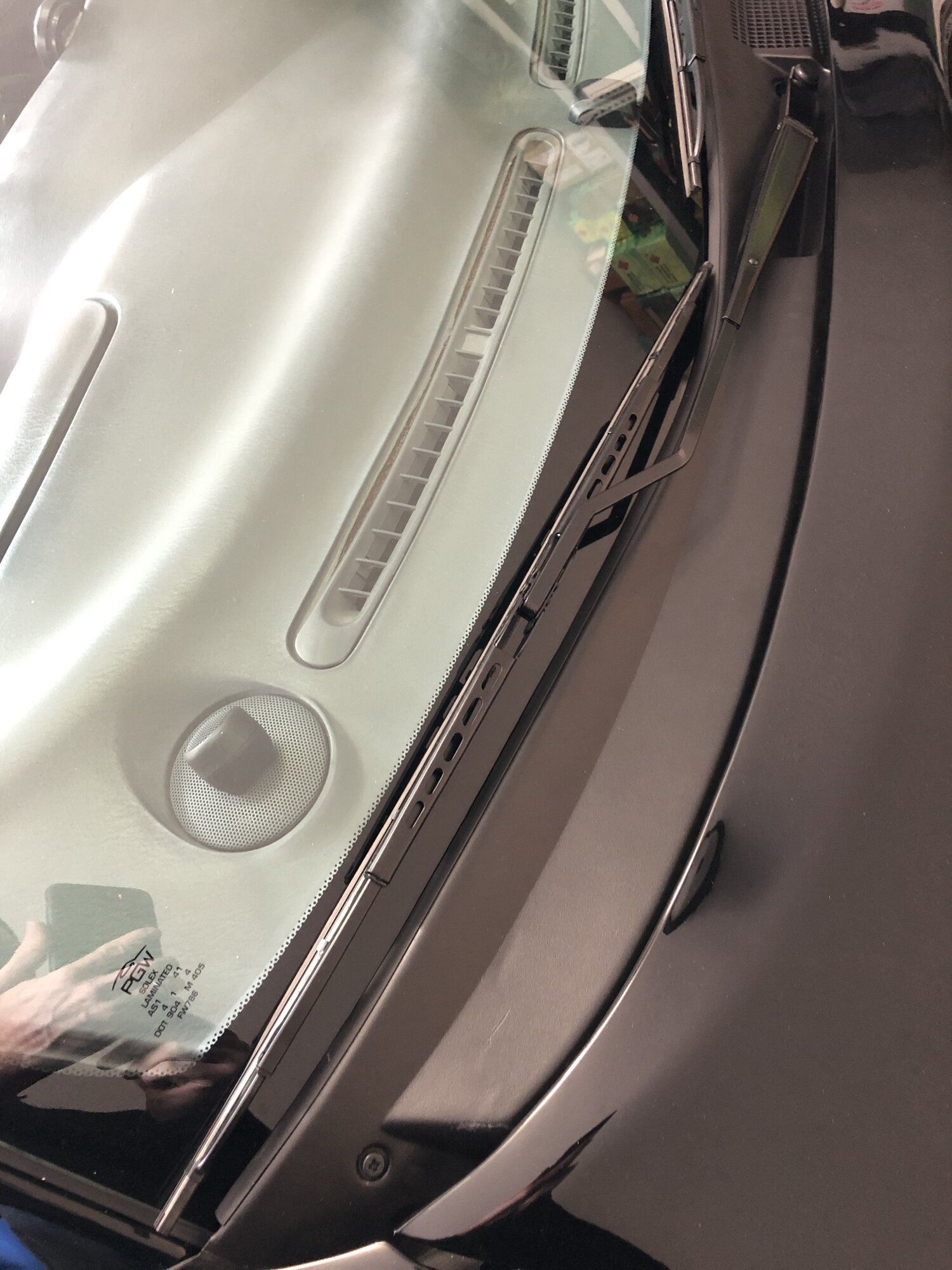

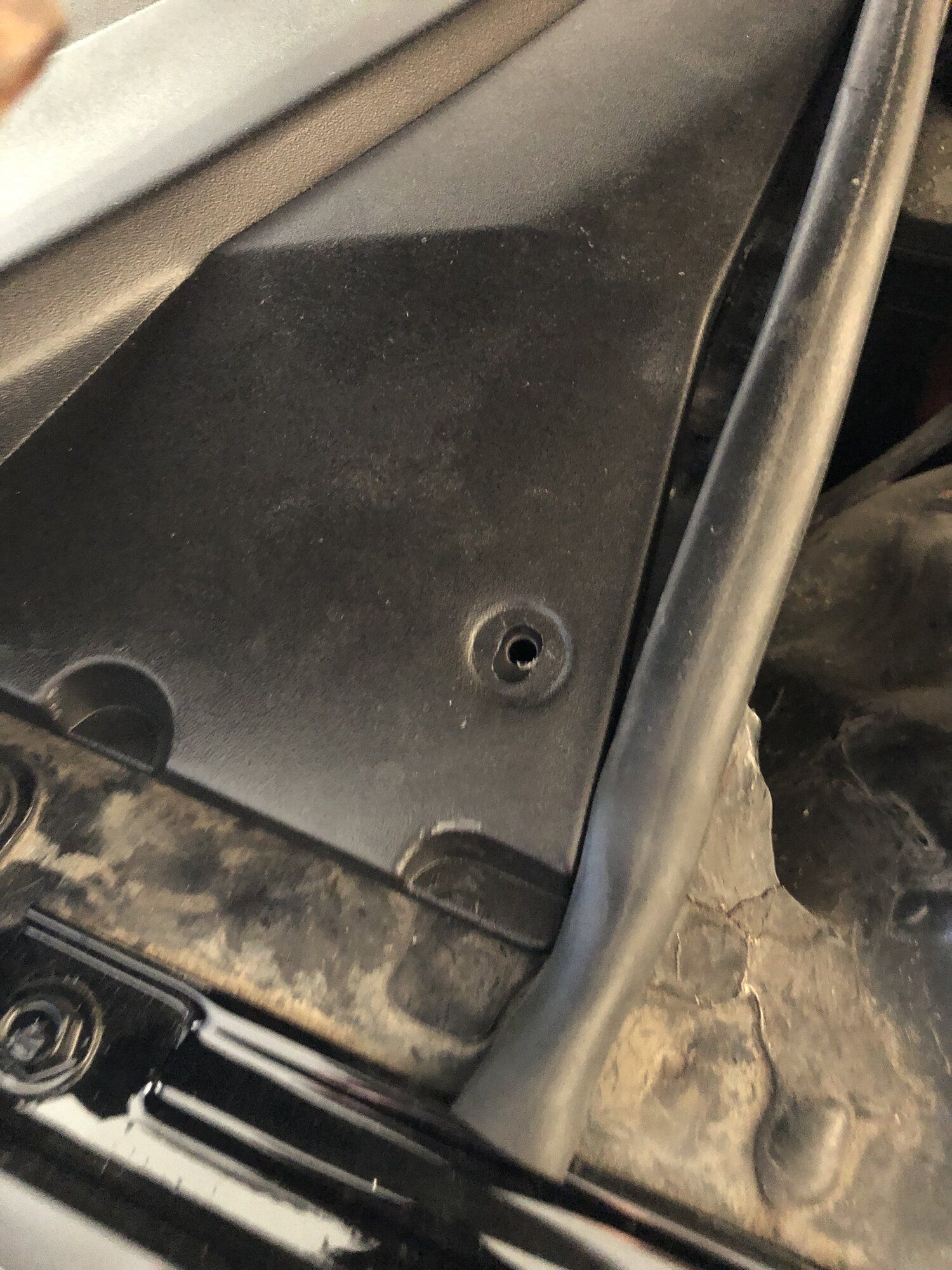

First, getting the wipers installed. I had to re-align the wiper motor mounts and find cowl cover snaps. I have 3, need 2more. Snaps needed paint too:

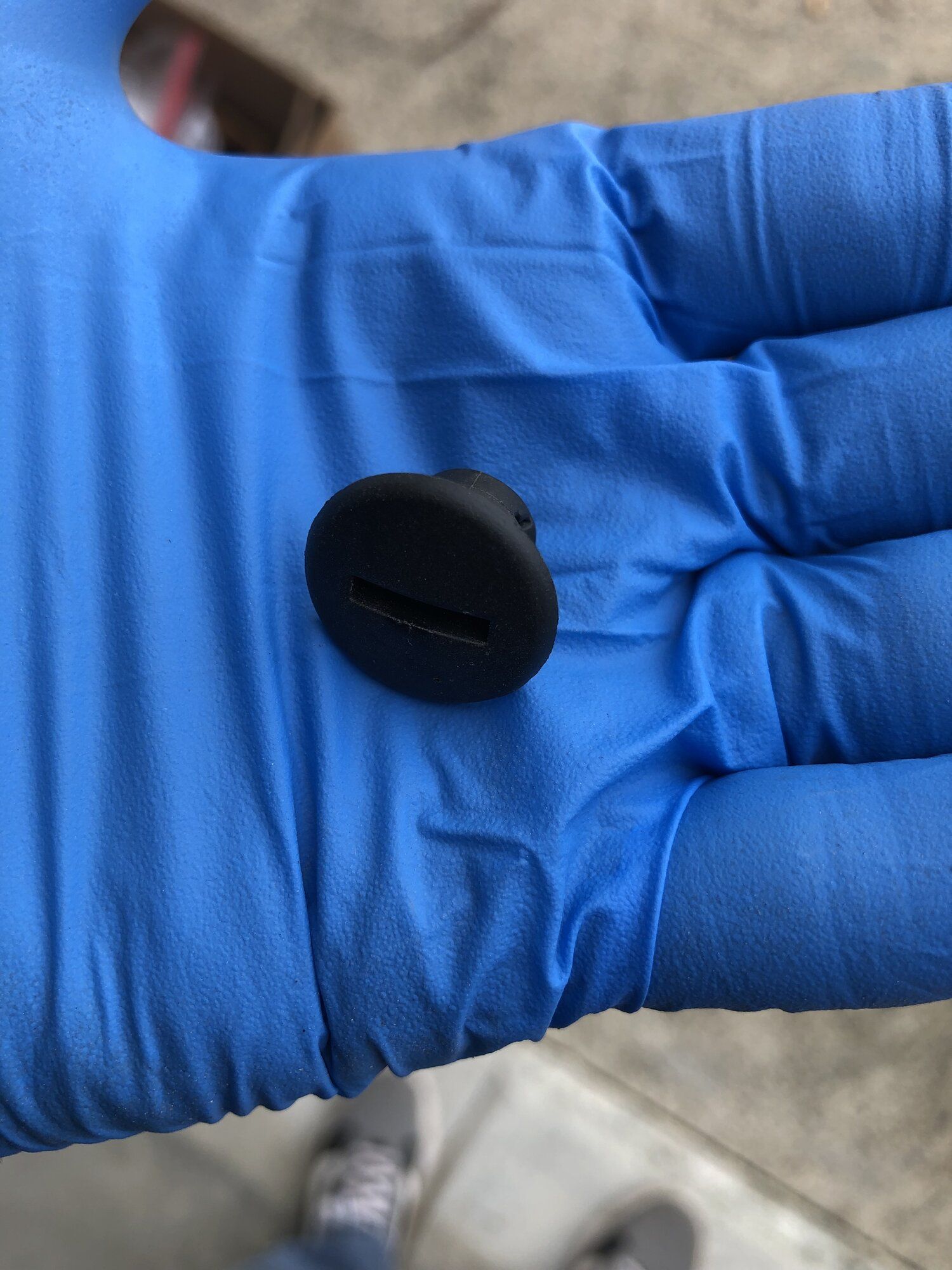

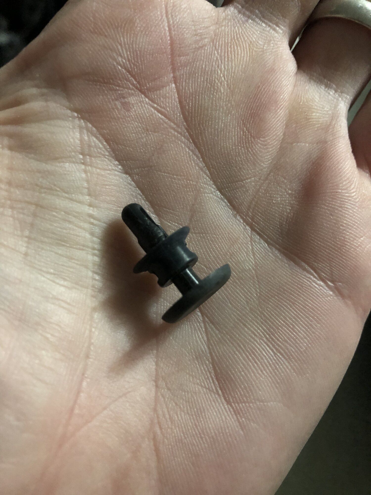

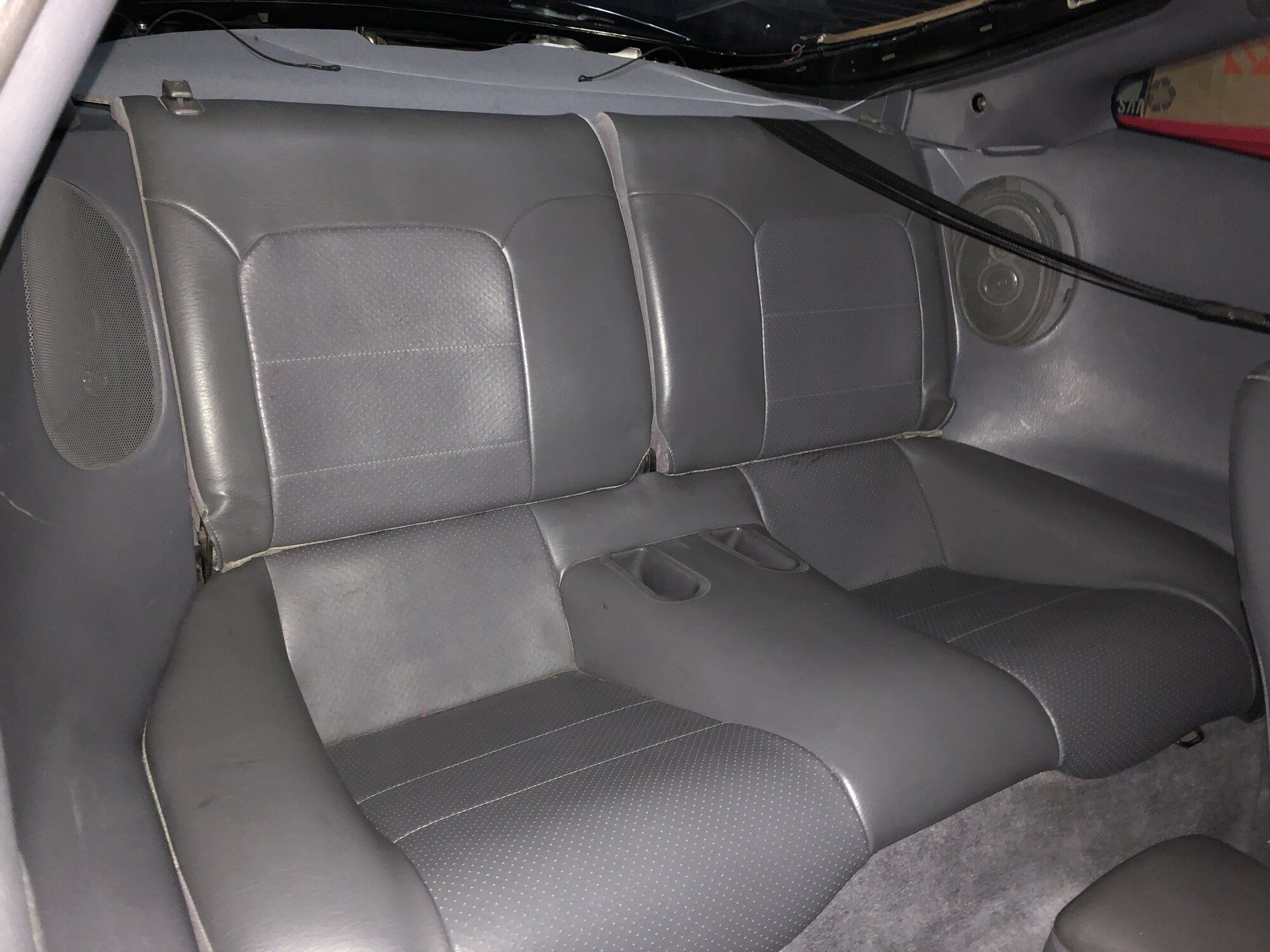

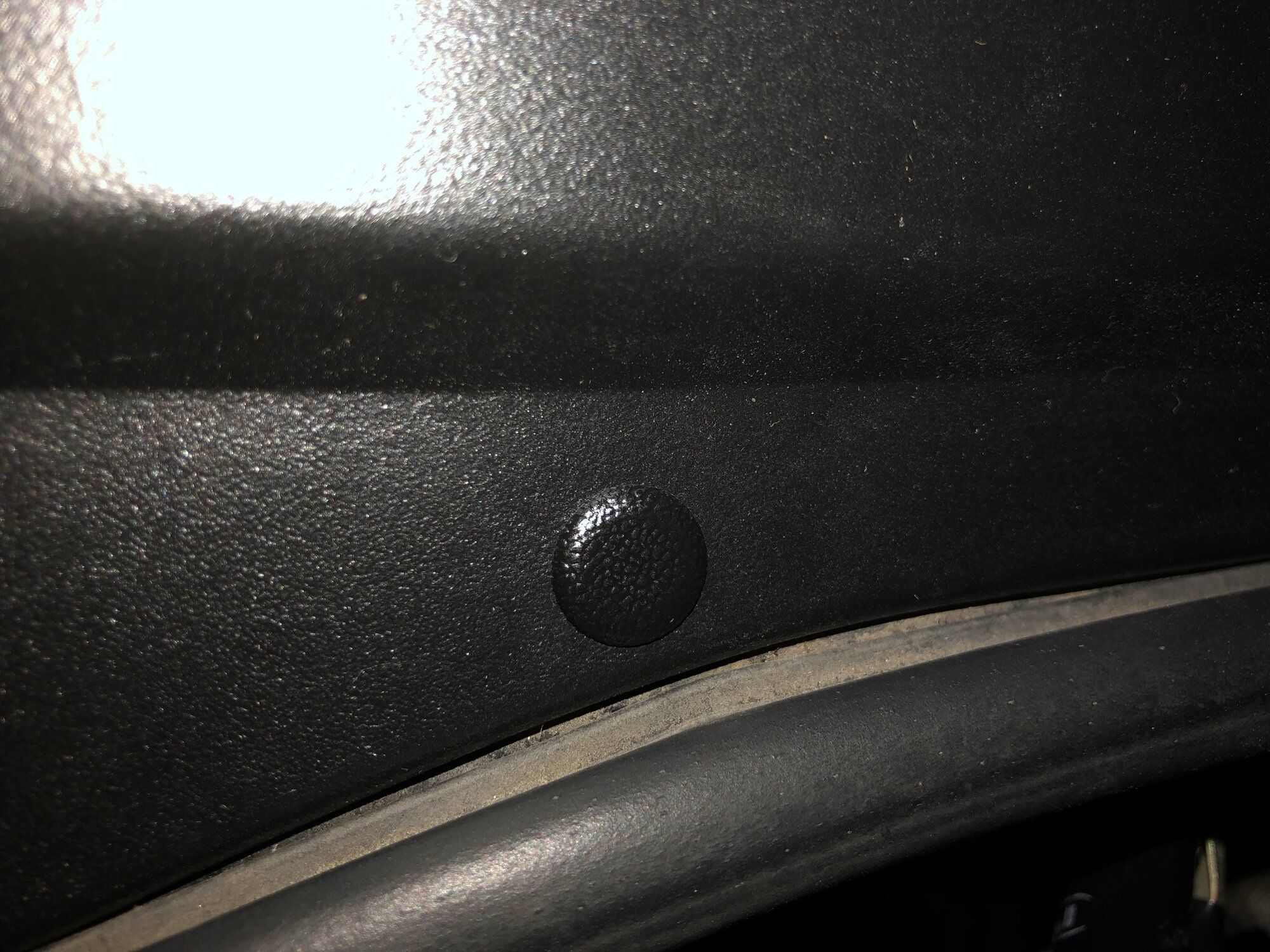

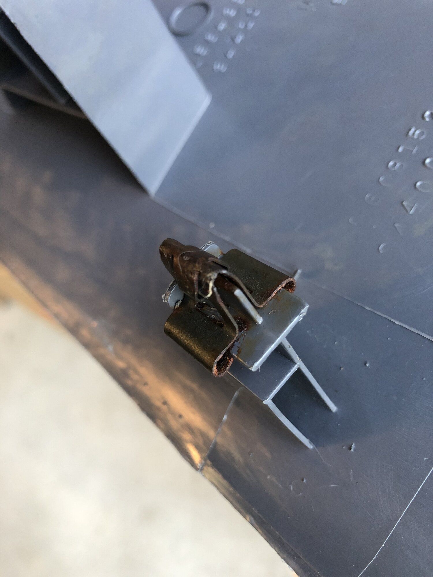

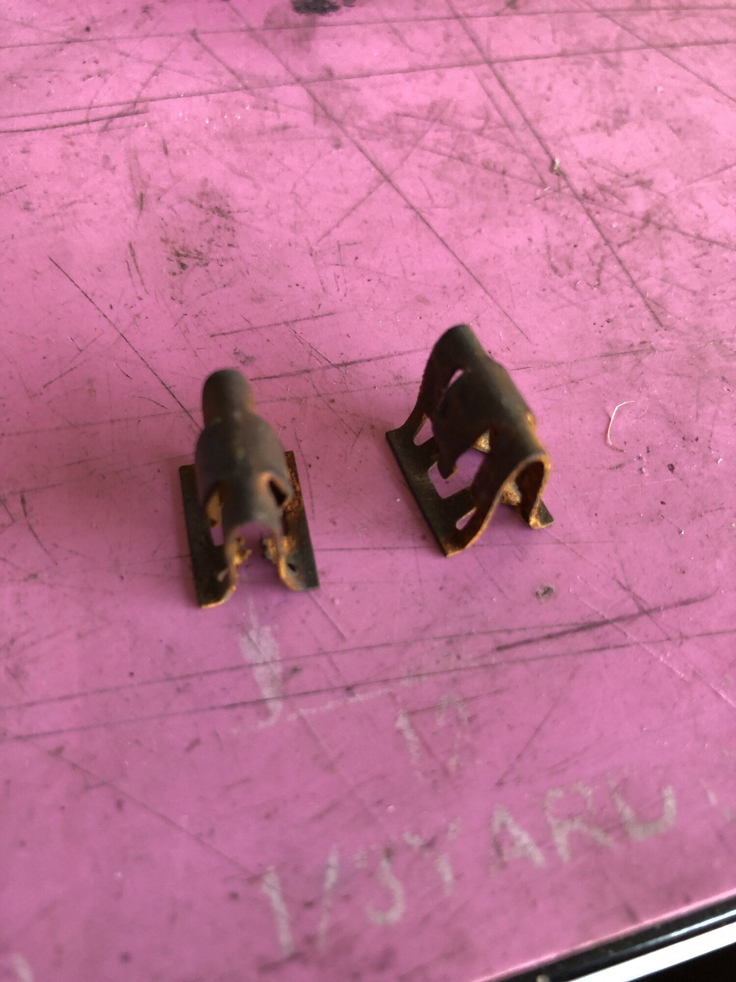

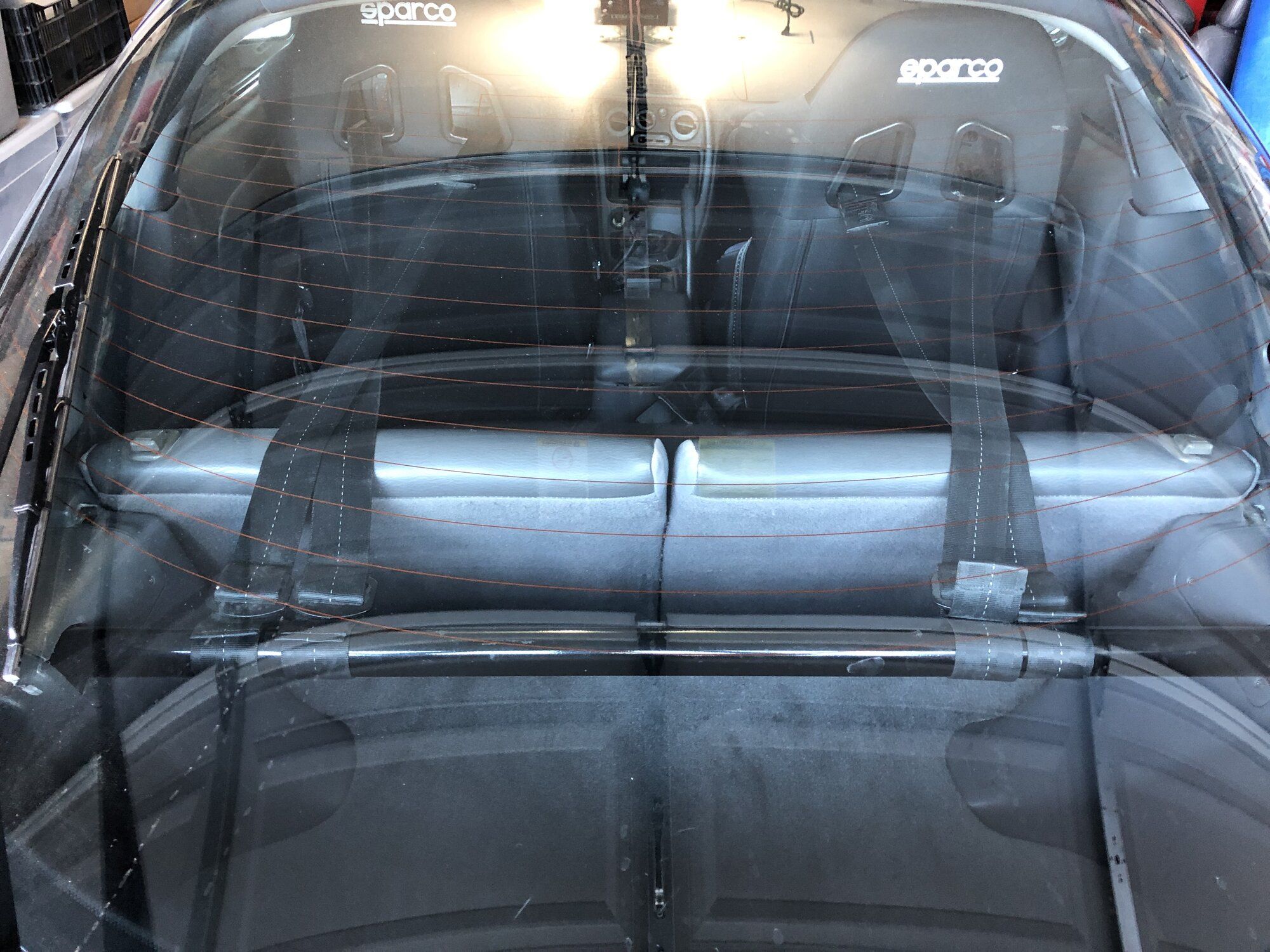

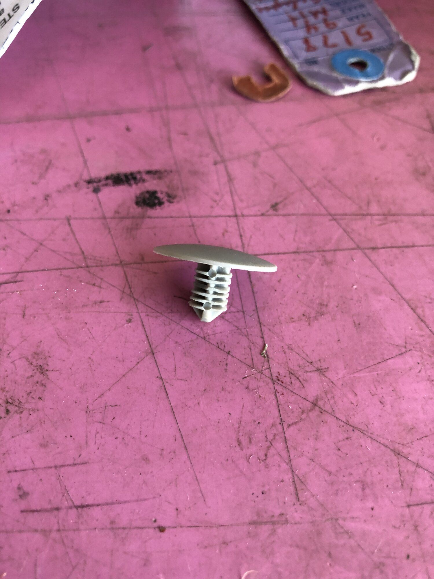

For the rear interior, I need one of these clips:
and one of these plastic nuts:
I hope I just dropped this in the car somewhere, but I looked a lot.
I was lucky to find both the plastic nut, and the metal clip MB608152 in my parts bins.

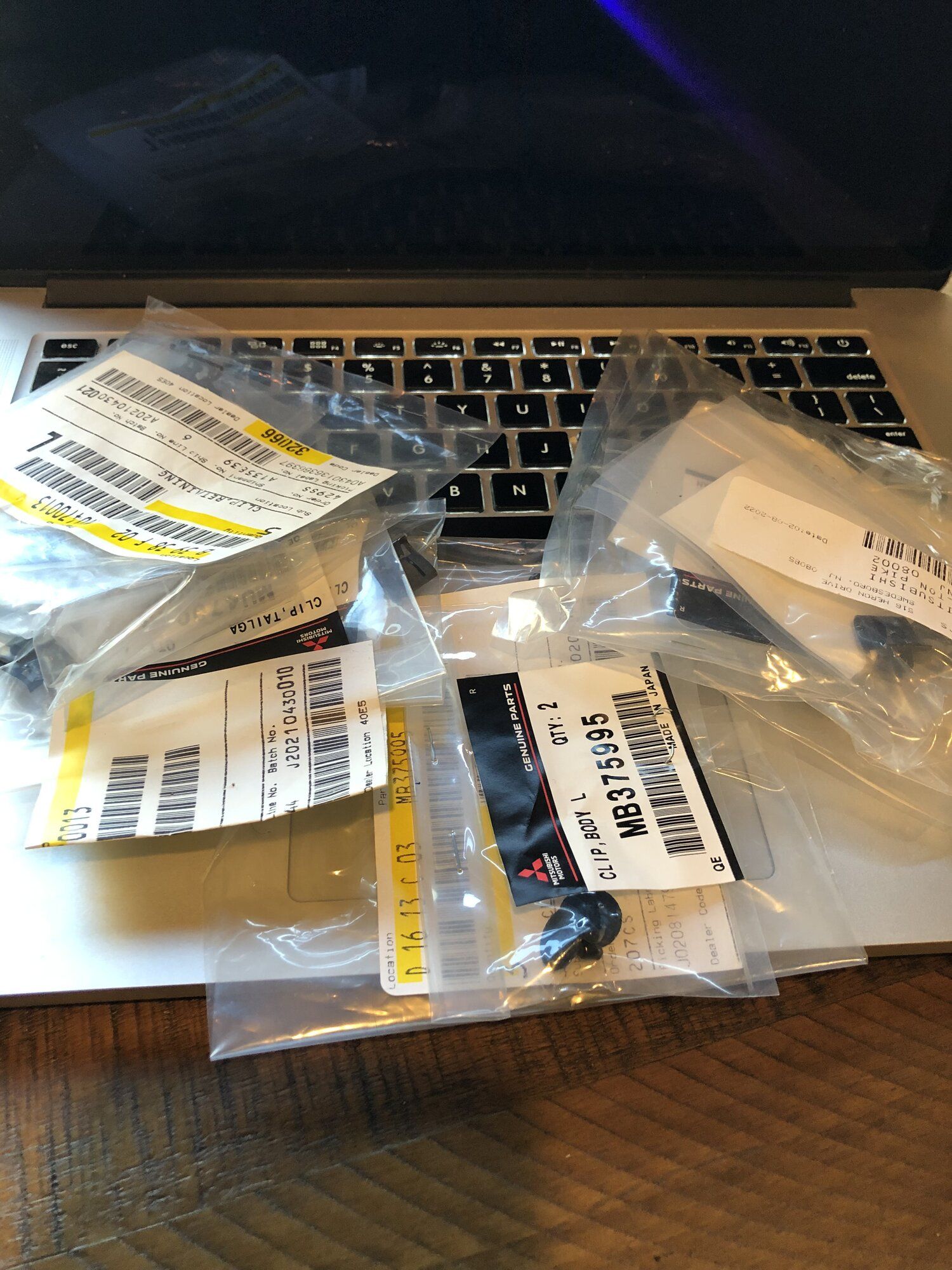

I finished painting three snaps MB375995, and ordered 2 more, along with the other metal clips MU470013 online from Mitsubishi.

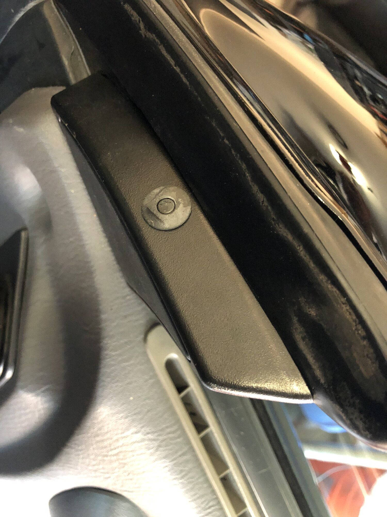

A list of stupid little things, all of which can be addressed:

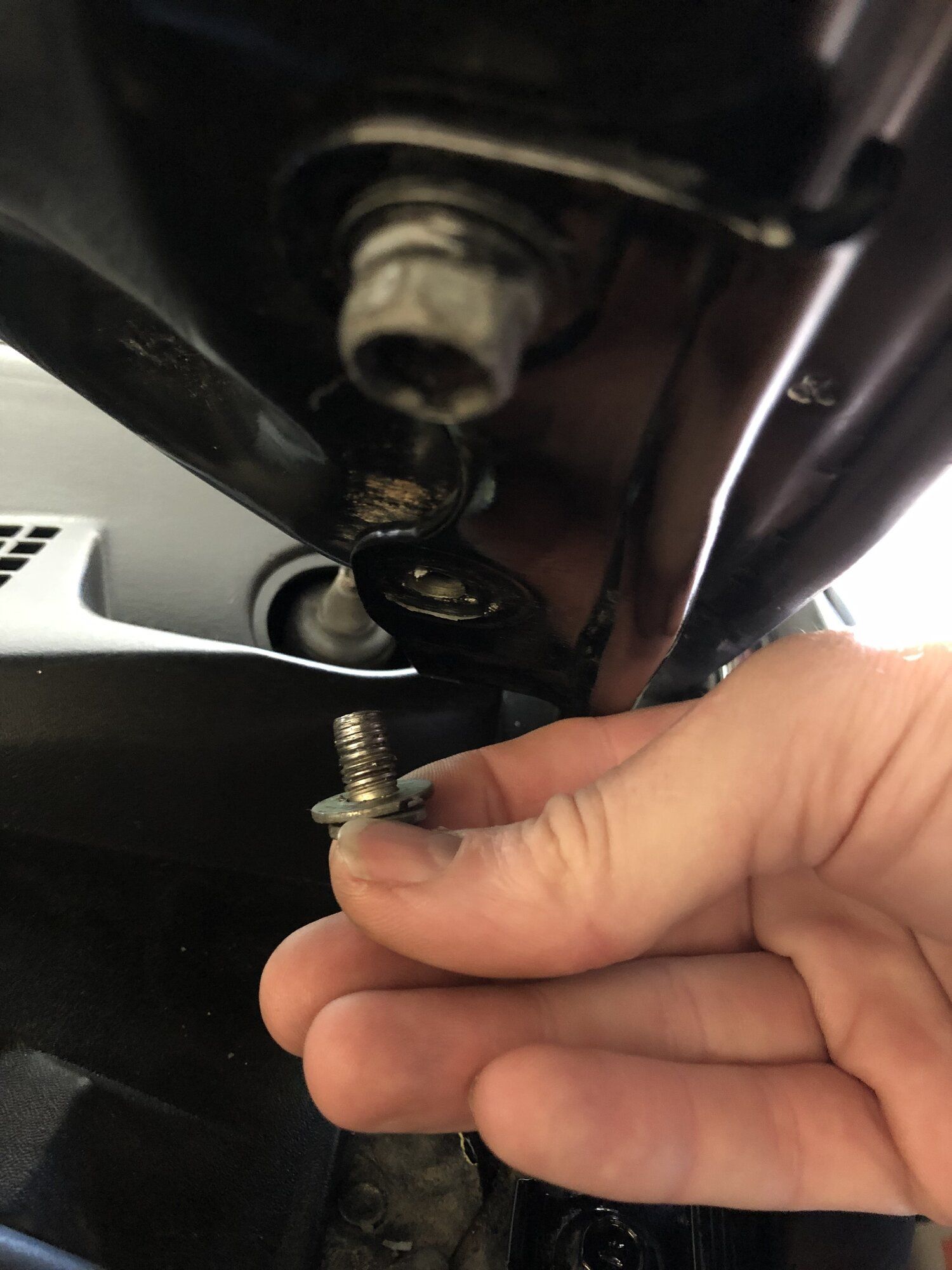

Stripped? hood bolt - must address before installing hood struts.
Cowl cover button fasteners -2 ordered MB375995
Grey Door panels - ordered for delivery from miller
MR707955 - Left
MR707958 - Right

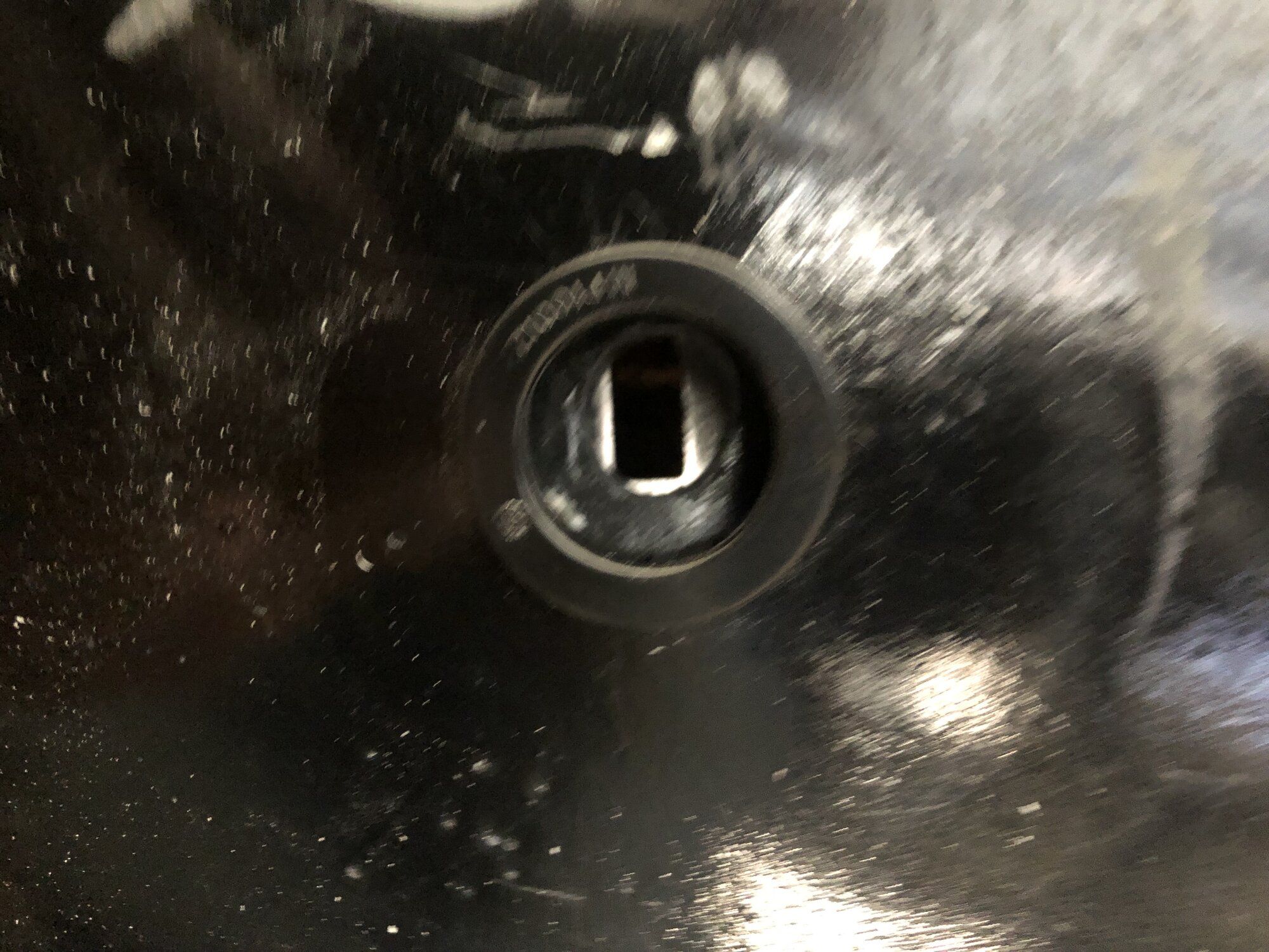

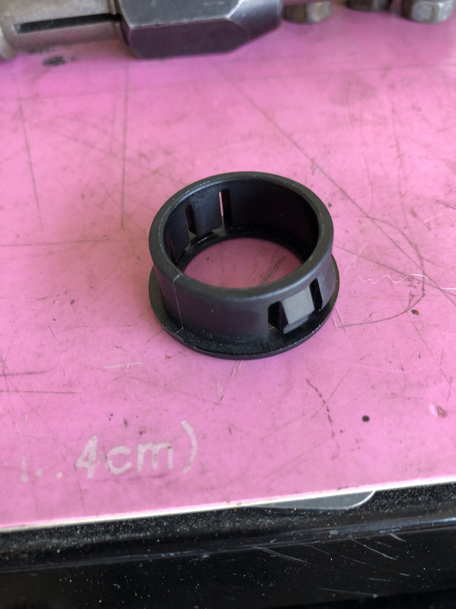

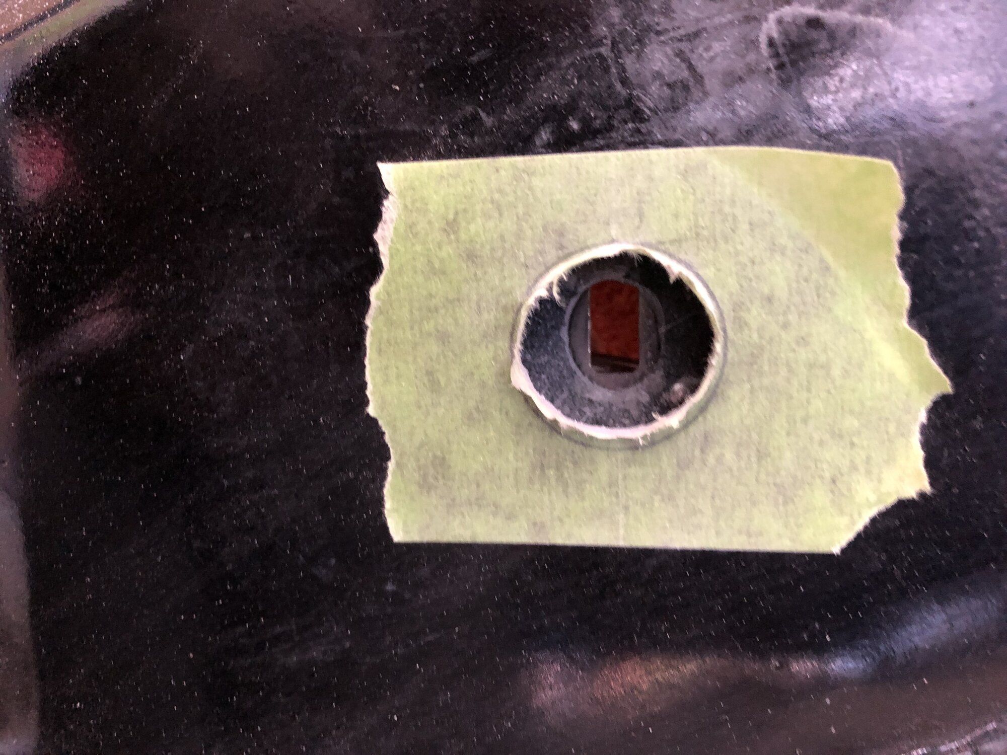

Increase tolerance for the hood pin, and add a thru hull grommet for clean durable finish. looking local hardware for this.
Need a pair, have one. - Inbound - MR189485

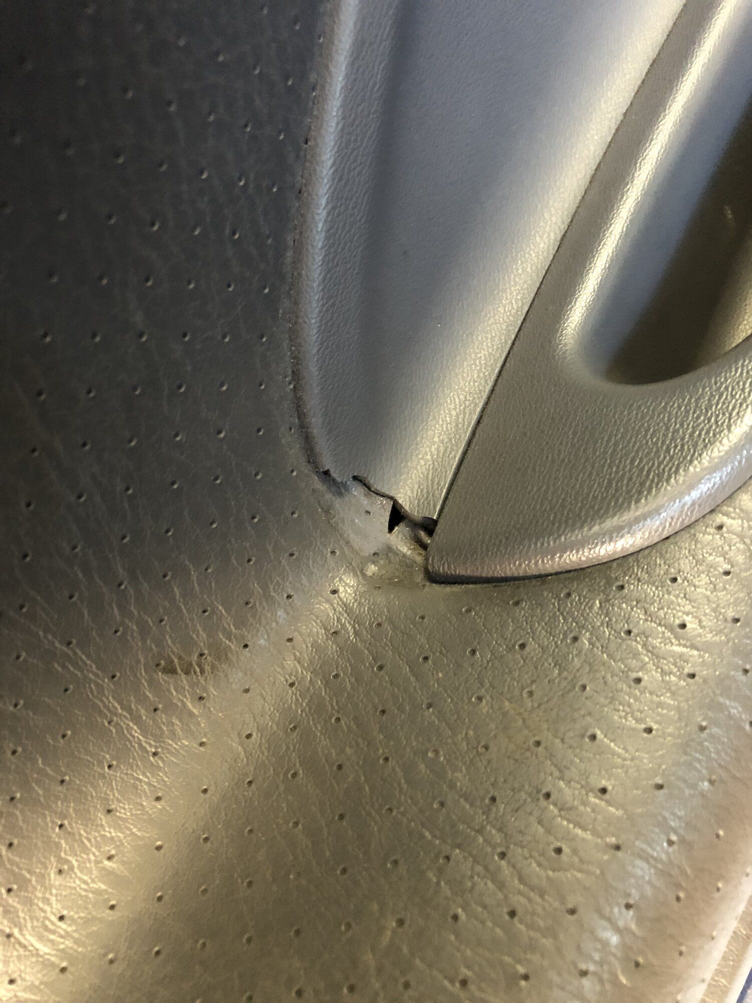

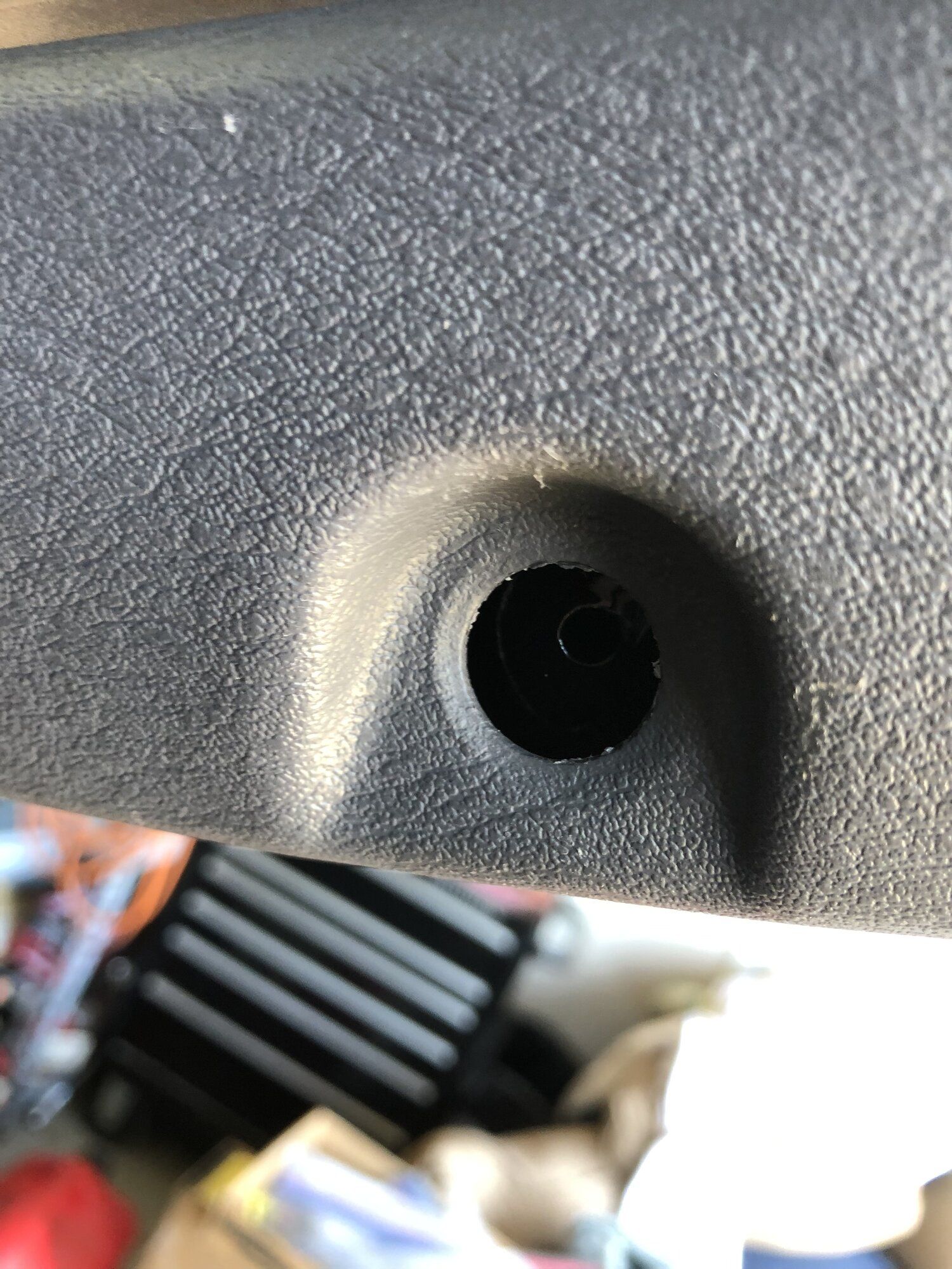

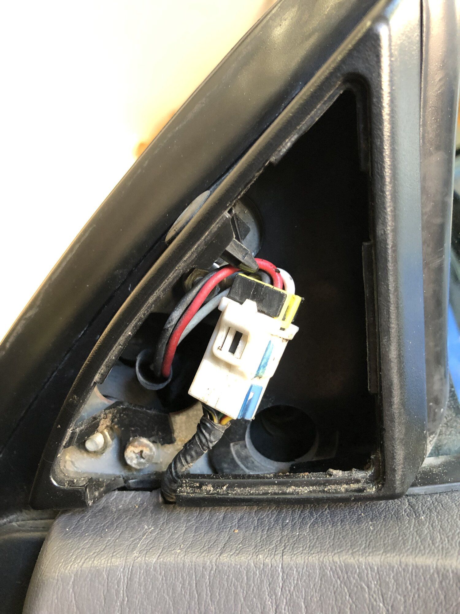

Both left and right side view mirror interior trim covers are cracked, and the pin in pop fasteners are dust. Just started looking…
MB881985 - left
MB881986 - right

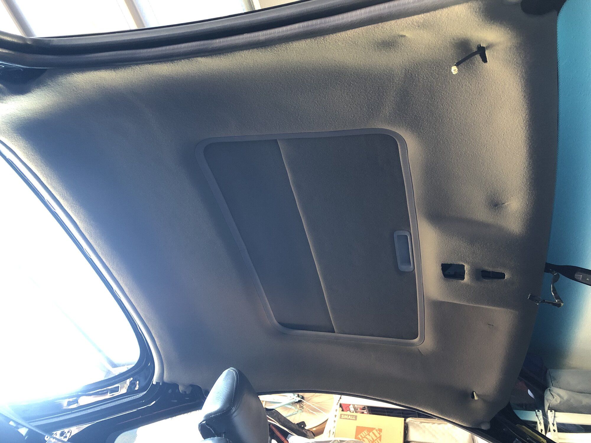

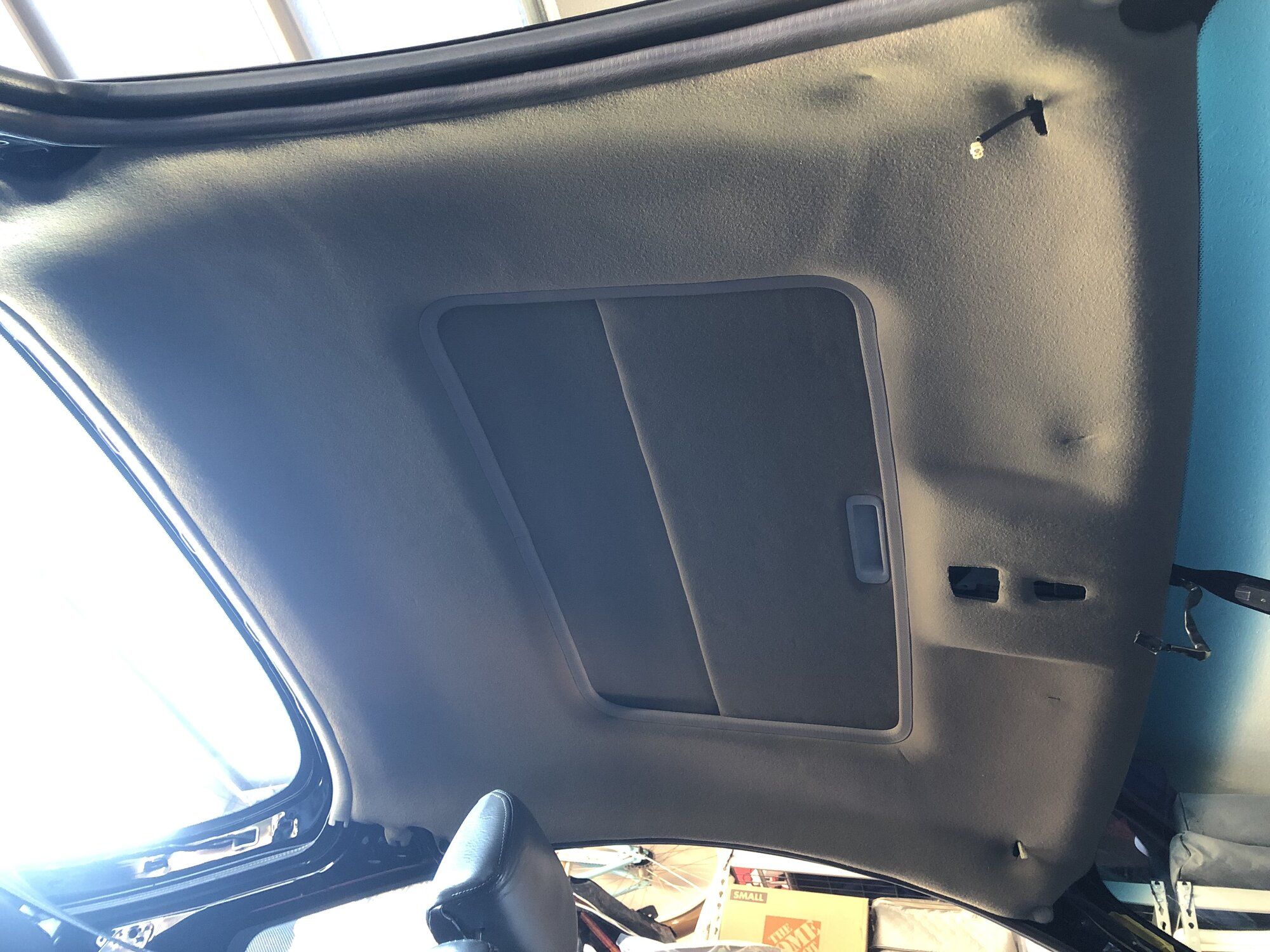

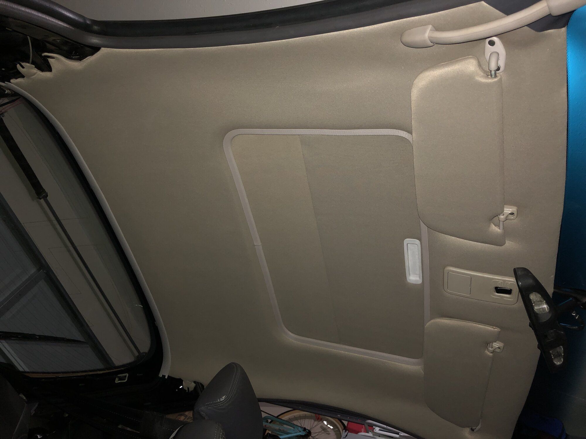

Wish to find one more of these headliner fasteners - MB417490

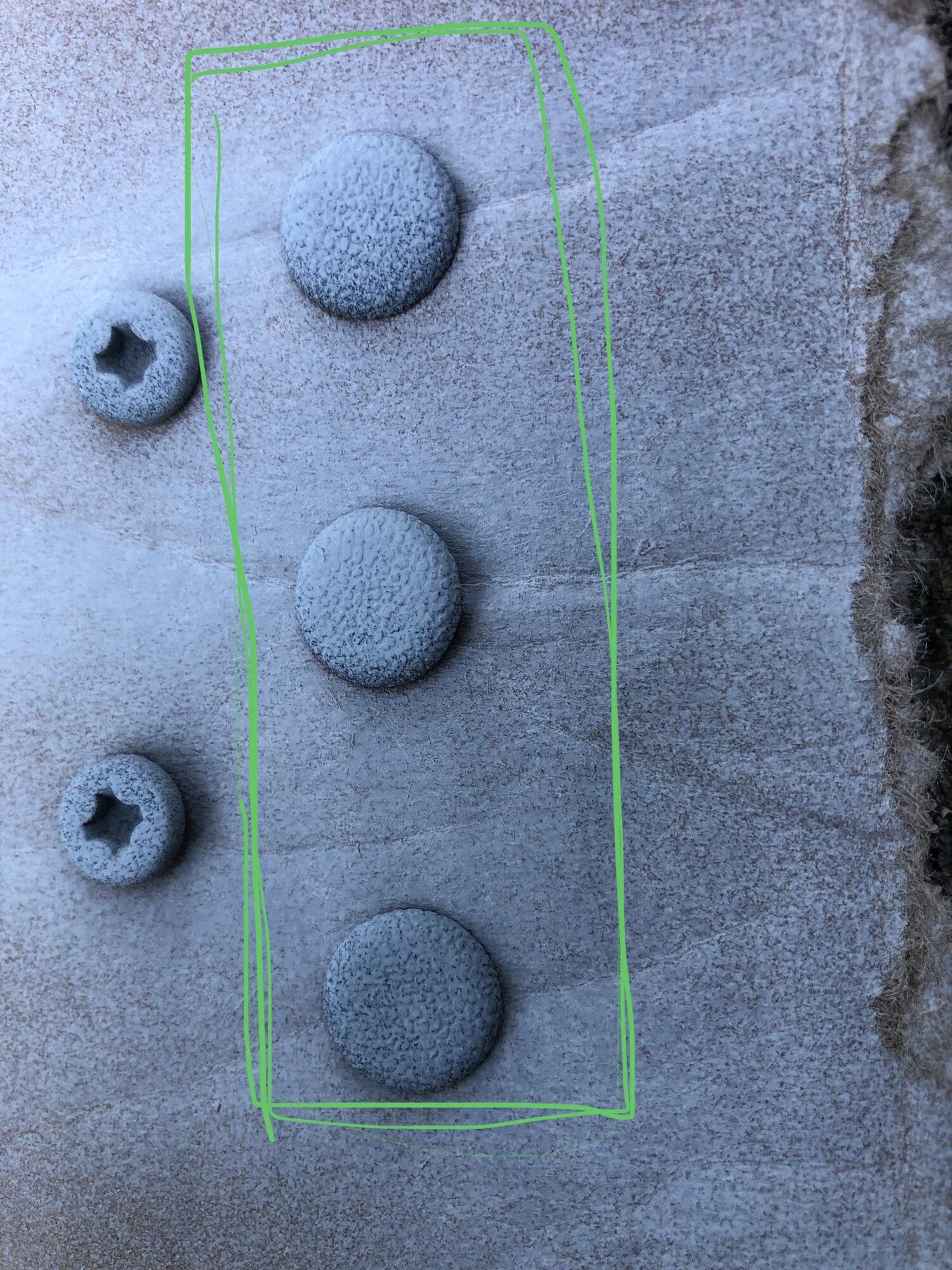

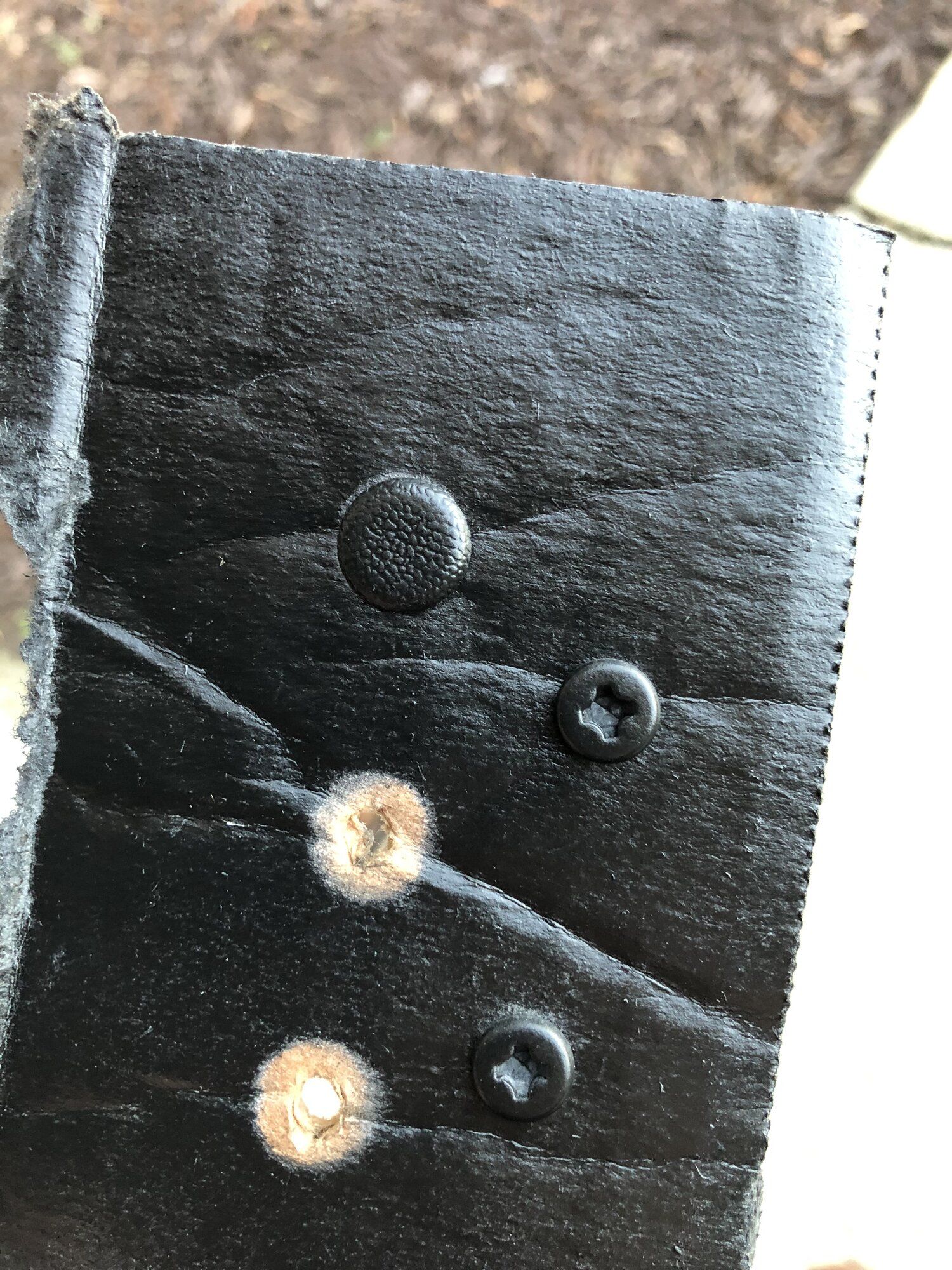

Add three of these to the rear interior cargo area trim panel. -ordered MU470013

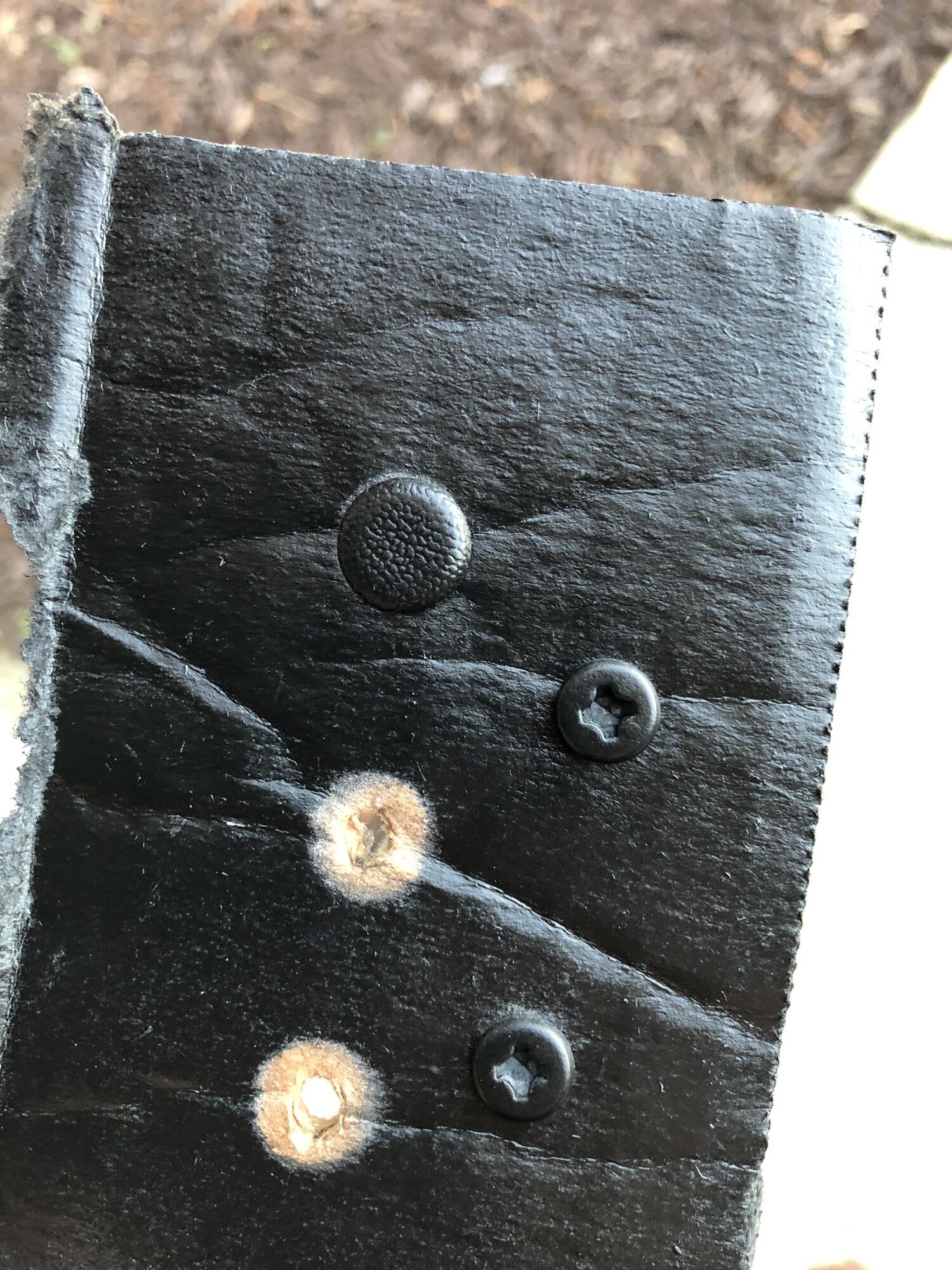

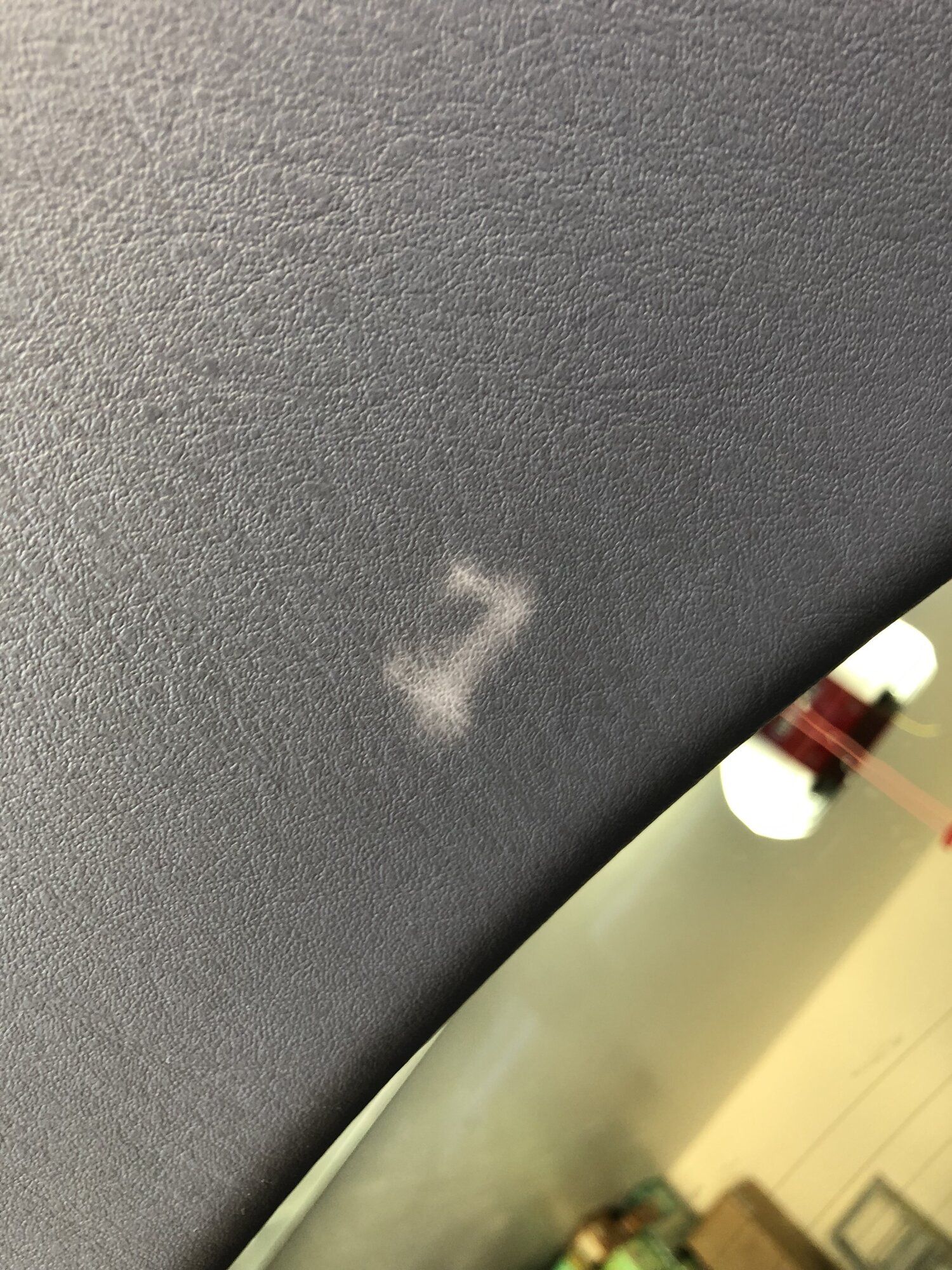

Color match paint over these stress discolored plastic attachments showing through on the under side hatch trim.

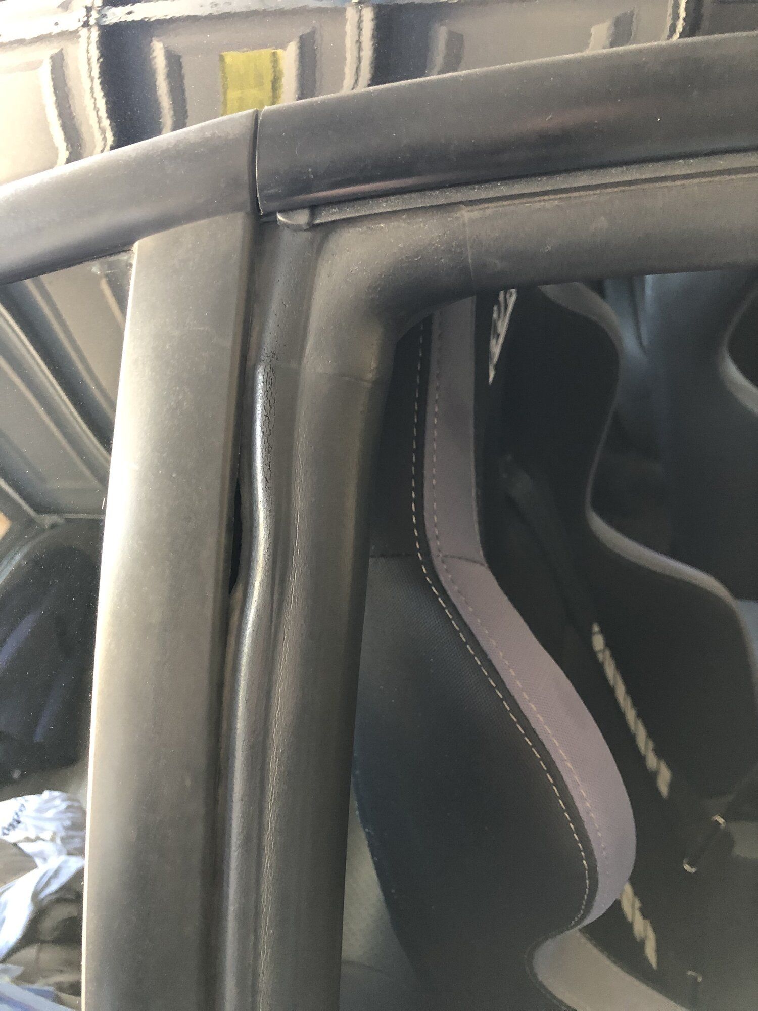

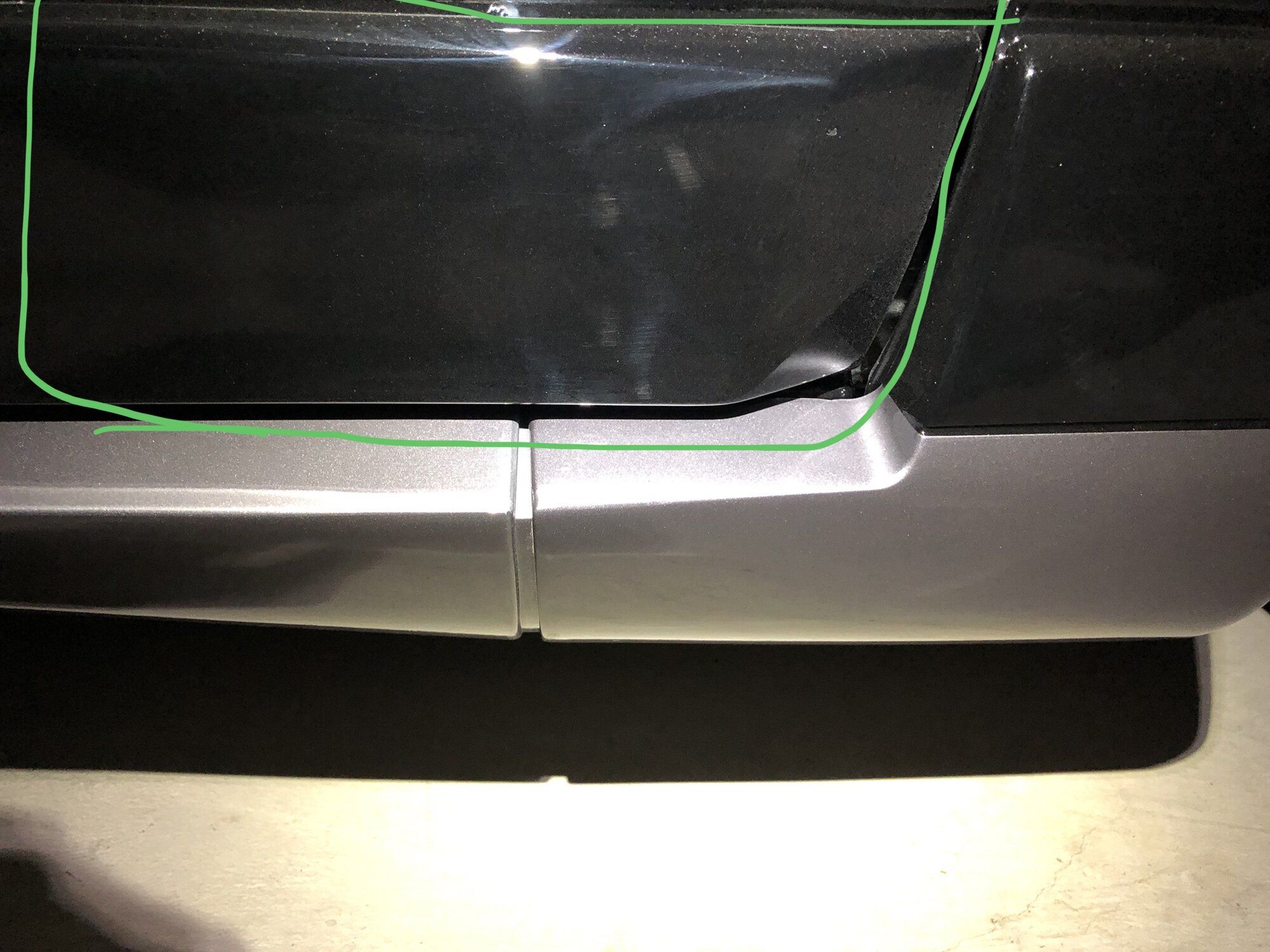

Figure out why this isn’t holding its shape, backup seals ordered from miller

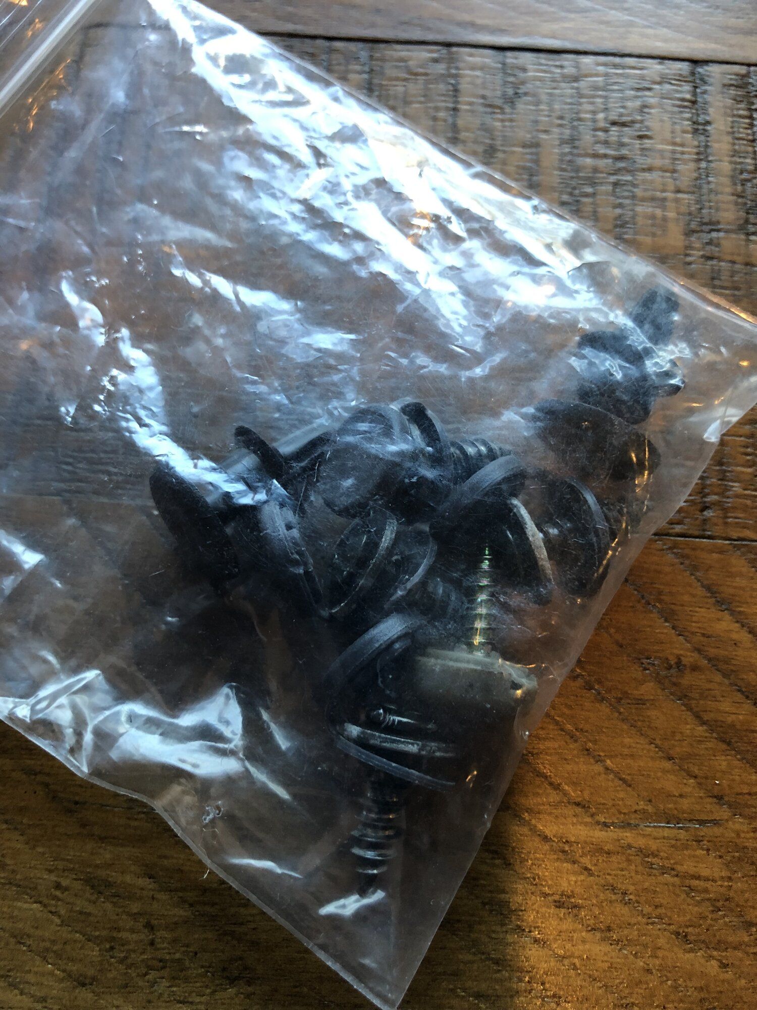

Rear trim panel screws with plastic head covers - inbound! (you know who you are 🙏🏻)

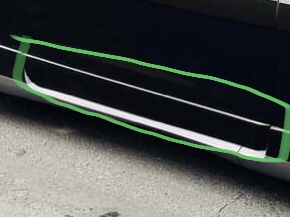

Fender liners (for turbo cars with ground effects)
MR162457 is LH
MR162458 is RH

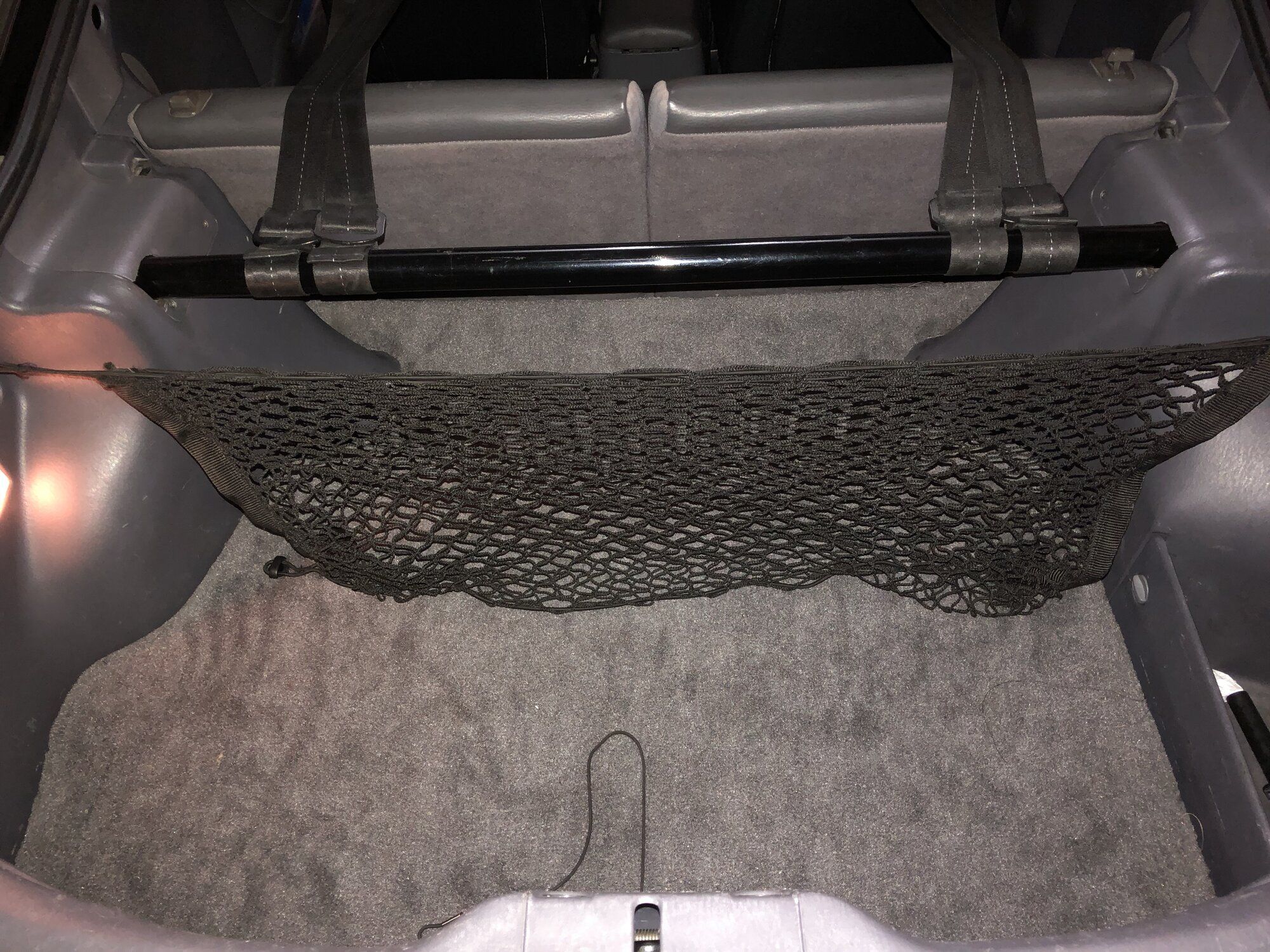

Locate cargo net in storage

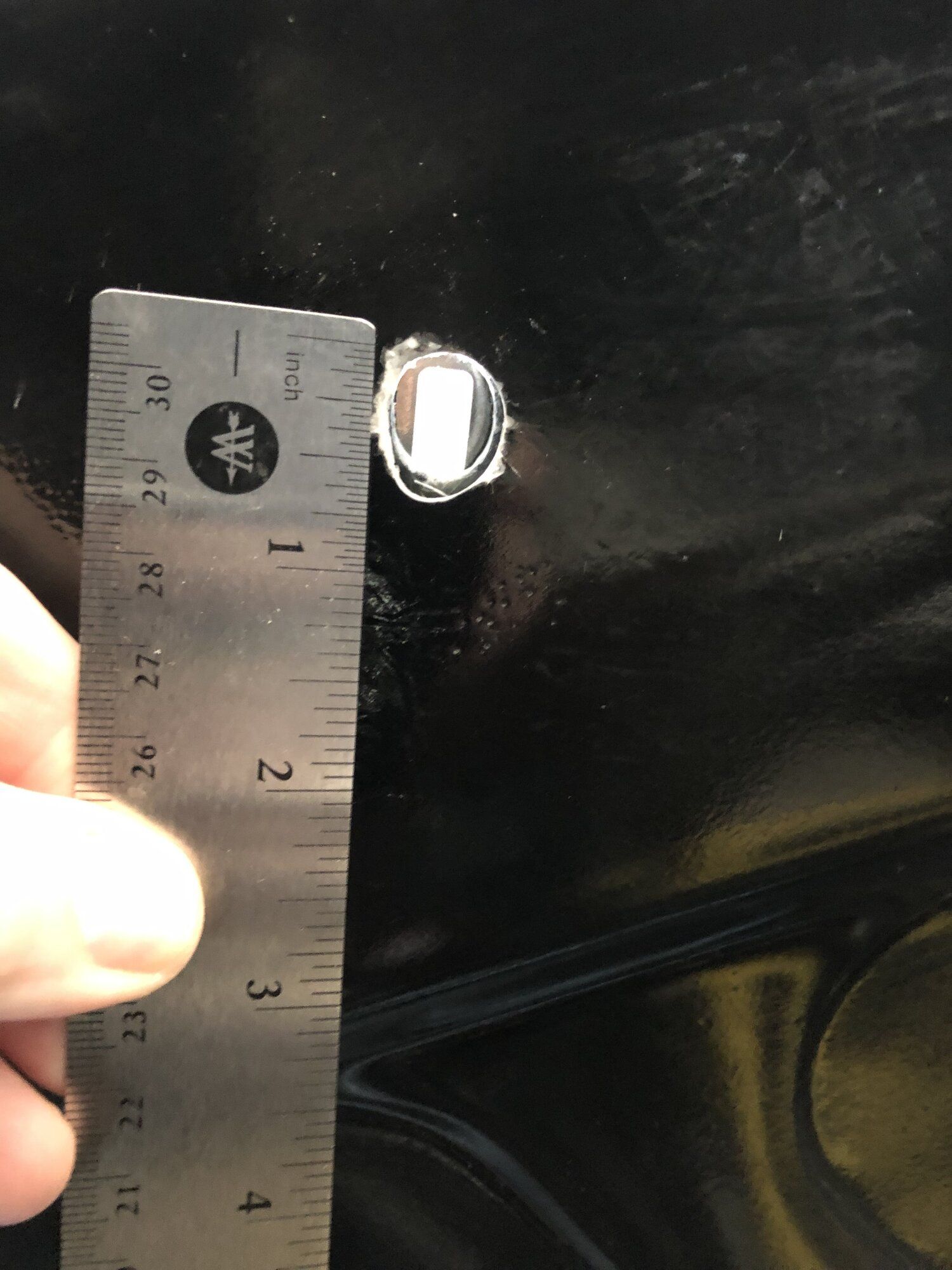

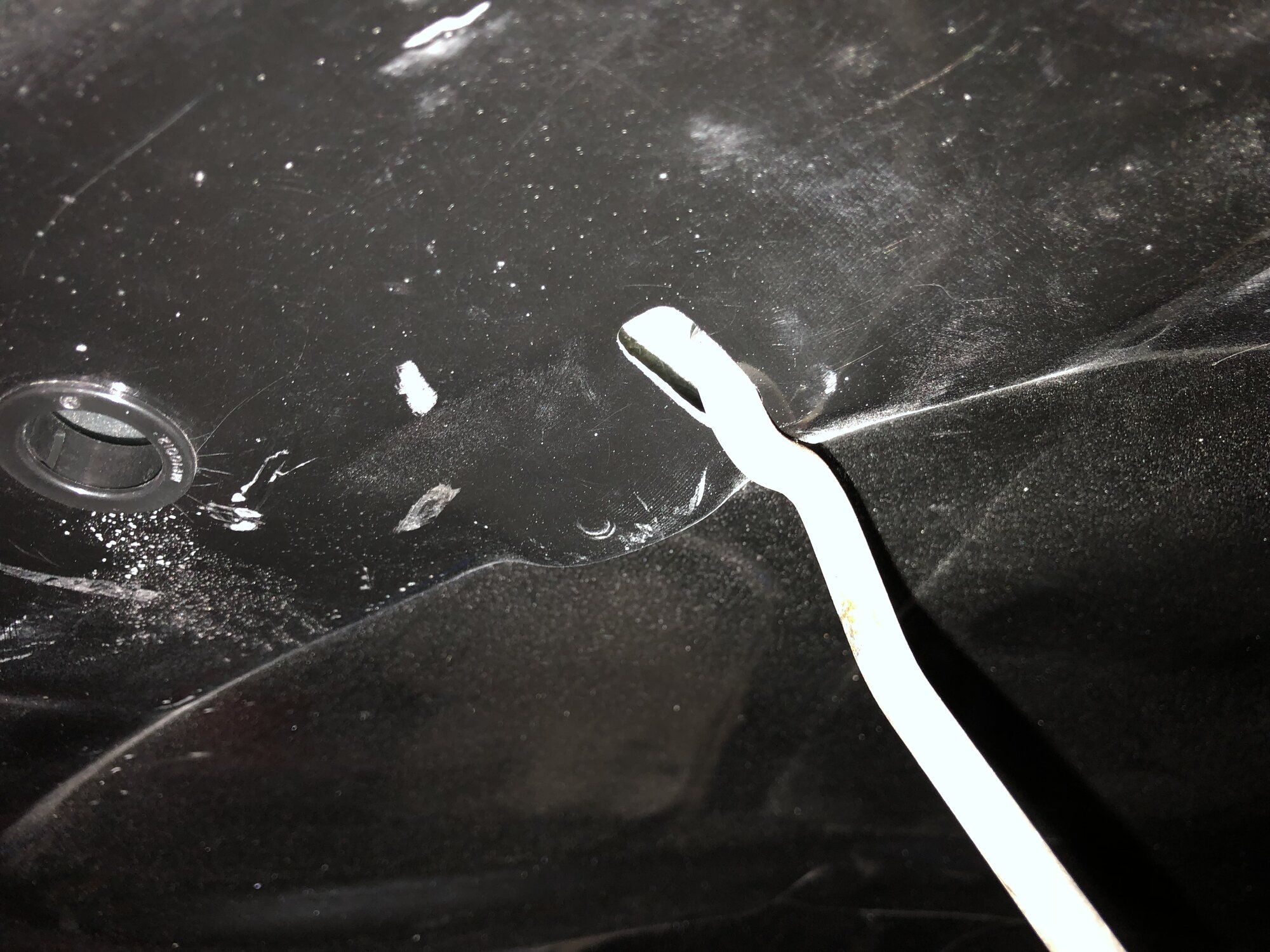

Couple items to scratch off the list:
New bolts and washers for the hood bolts (check)

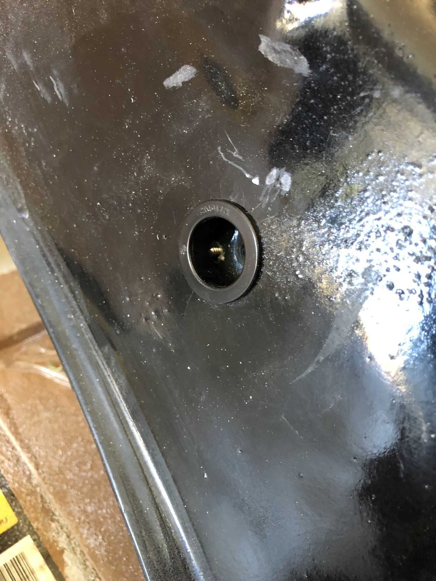

Run a tap to clean out the threads in the hood
(check)

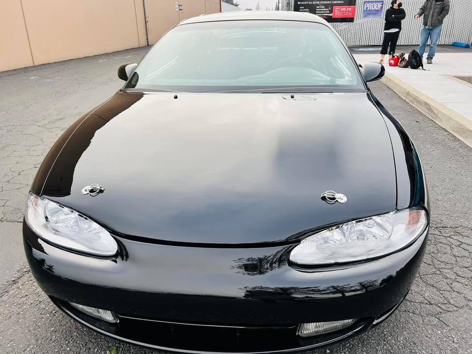

Clearance and center a nice clean cut hole for the hood pins on the under side of the hood
(check)

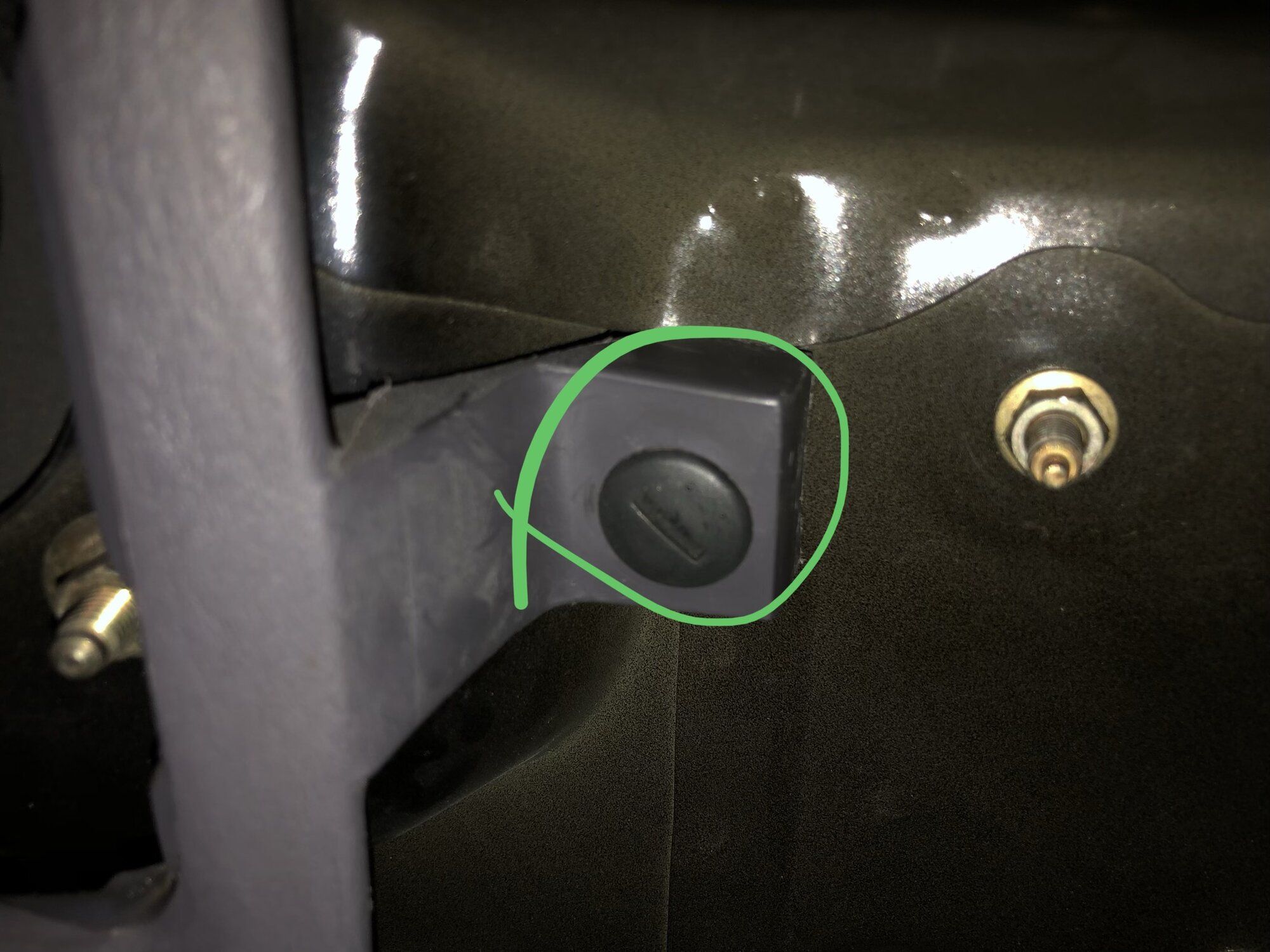

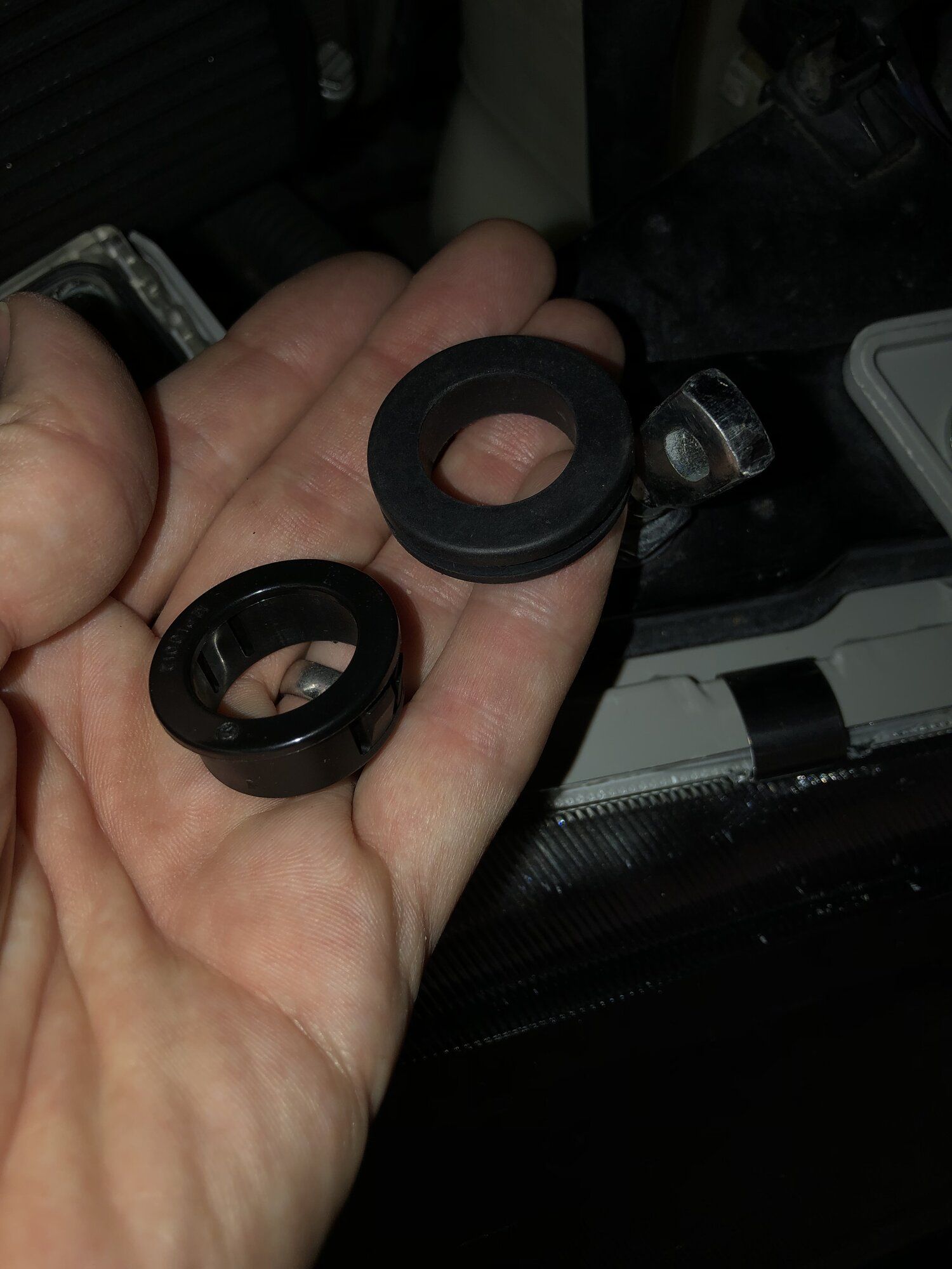

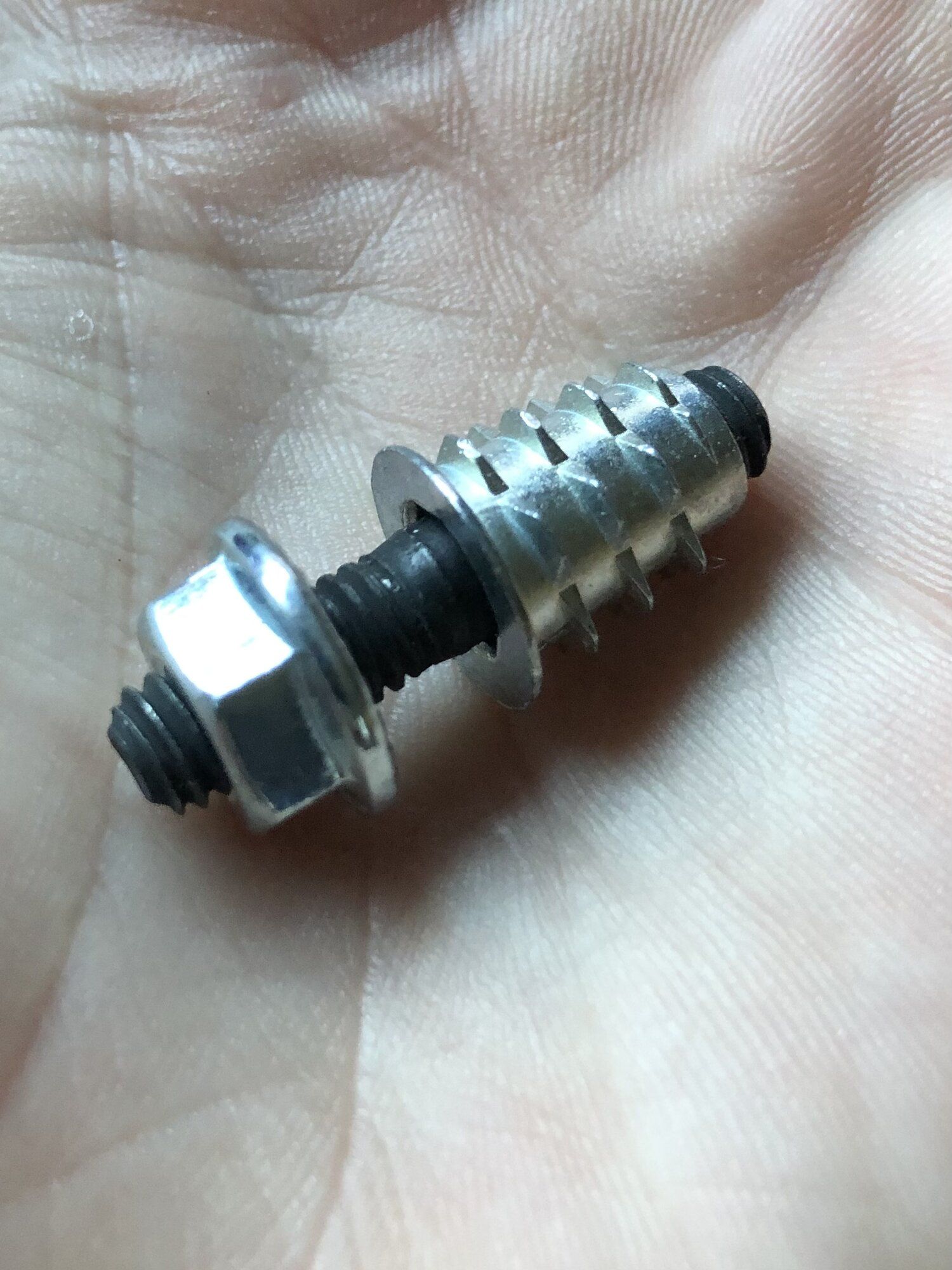

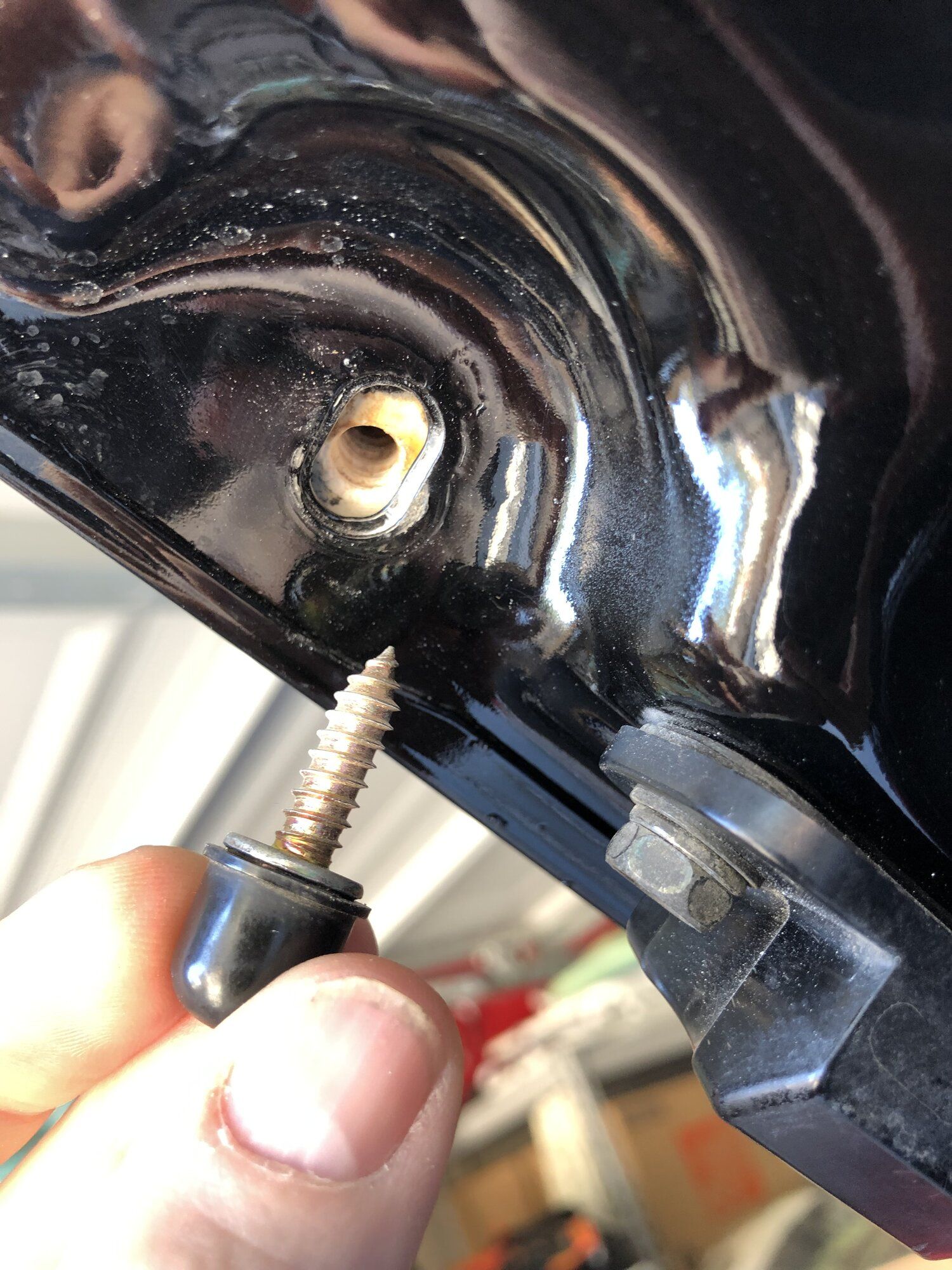

Insert one of these:
and you get this nice result
(check)(check)
Cut a clean hole clearance for the prop open rod
(Ccccccccccheck!)
