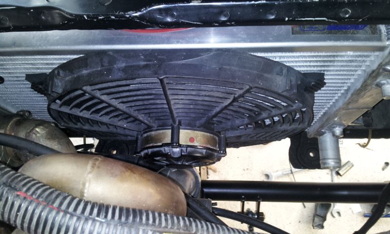

Got some more progress done, got the new fan wired up and mounted.

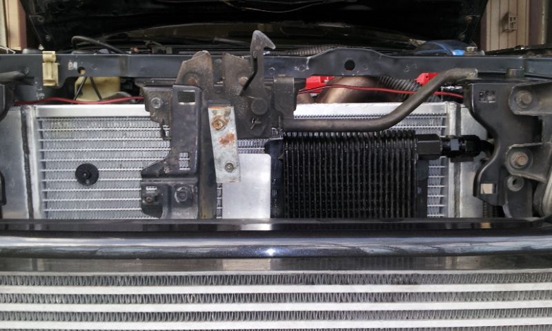

Also got the External Oil cooler mounted as well.

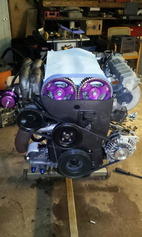

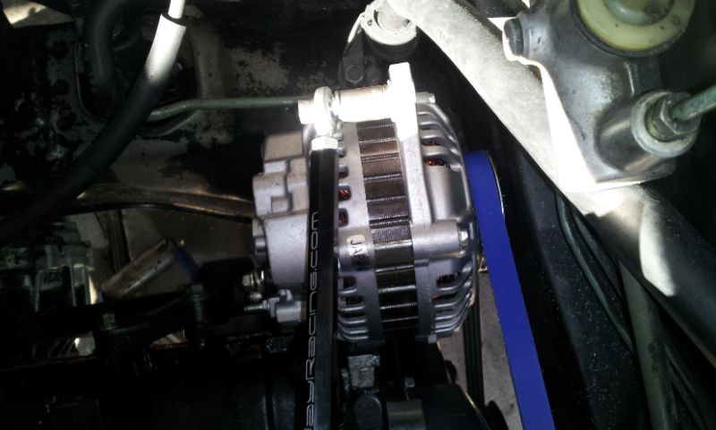

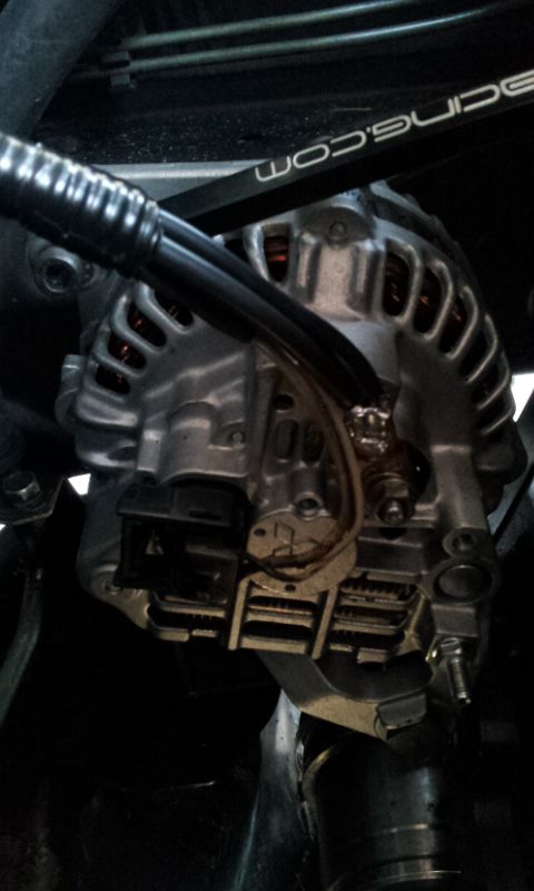

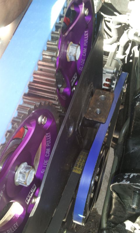

few pics of the Jay Racing ALT relocation Kit, and the belts are on now.

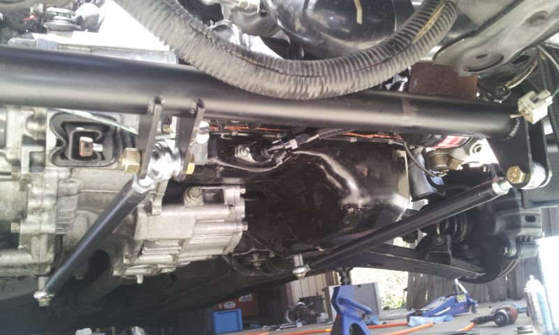

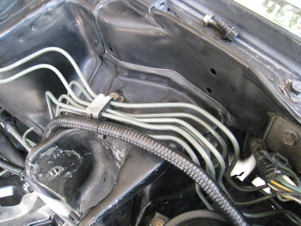

and underview shot of the completed Bulfab crossmember installed.

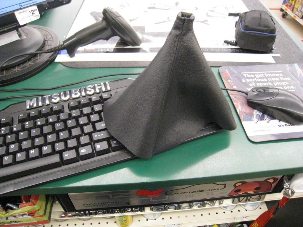

aslo got this new leather shift boot to replace the accordian one thats on there now.
Thanks Guys
Well the Alternator is all wired up now too =D BIG thanks for Mike @ FIST for doing the welding and Rob Patterson for putting it all together and wiring it up.

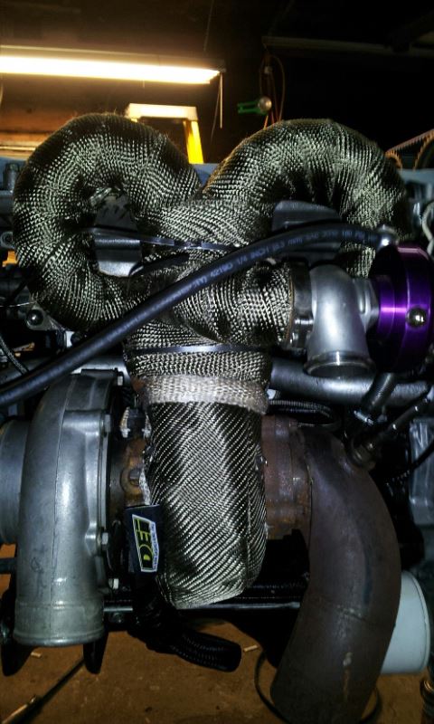

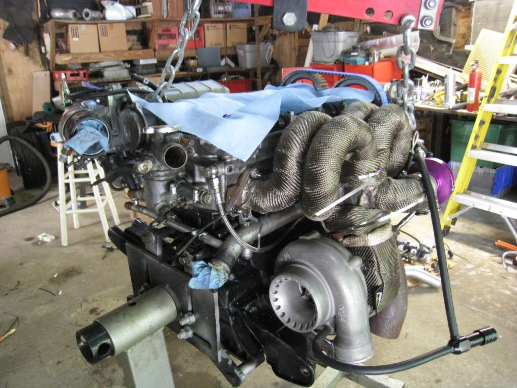

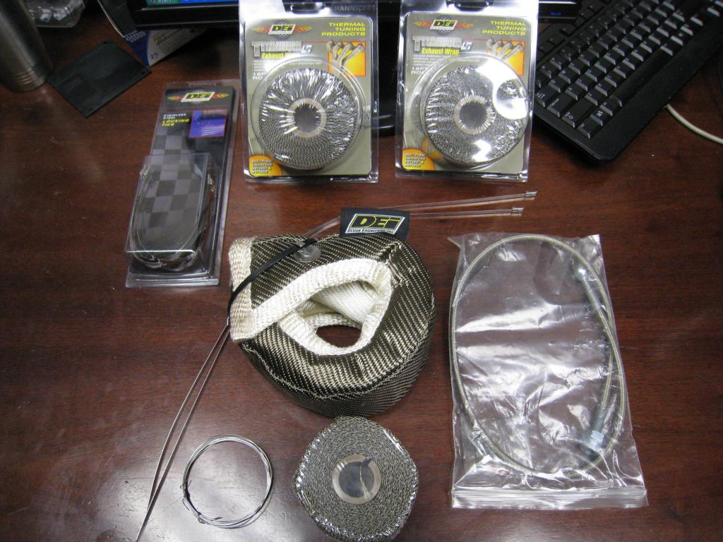

some more progress, getting closer to getting Samara back on the road again finally, bought a bunch of heat wrap for all the hot parts including a T3 DEI turbo blanket

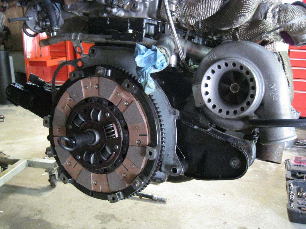

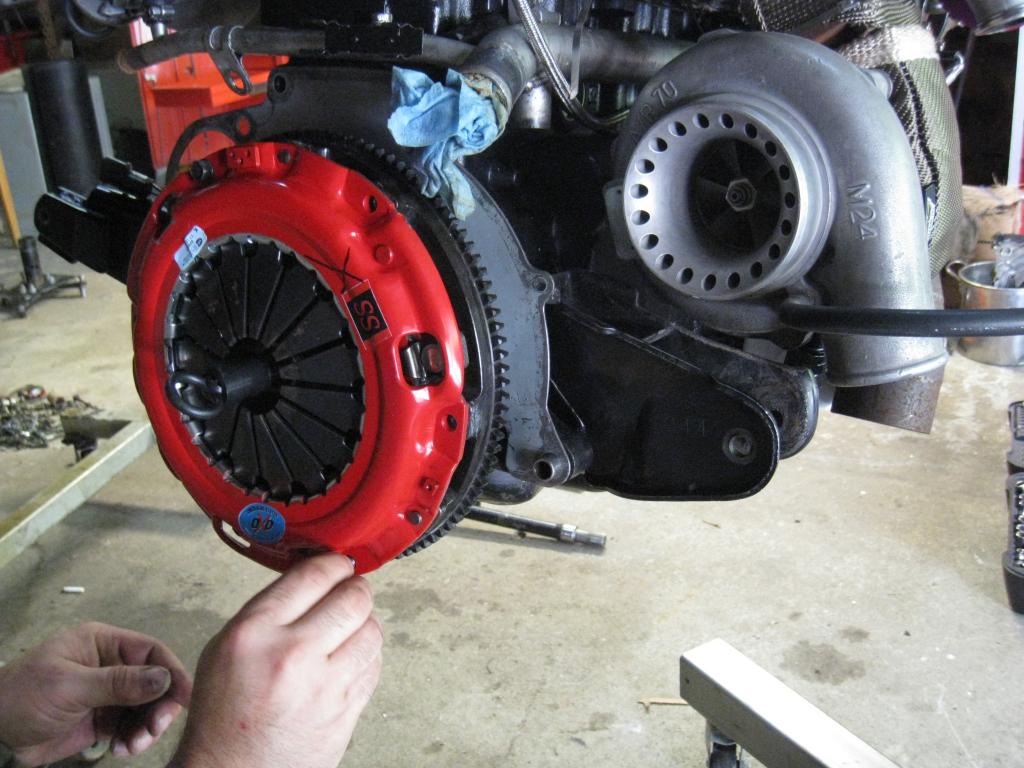

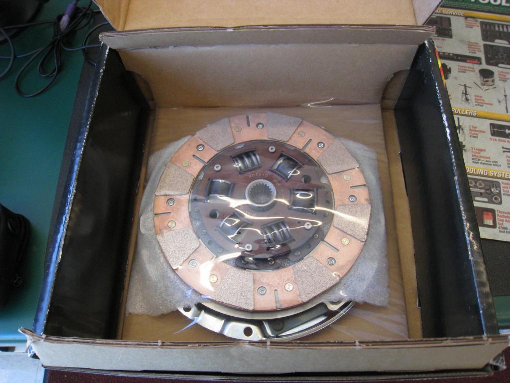

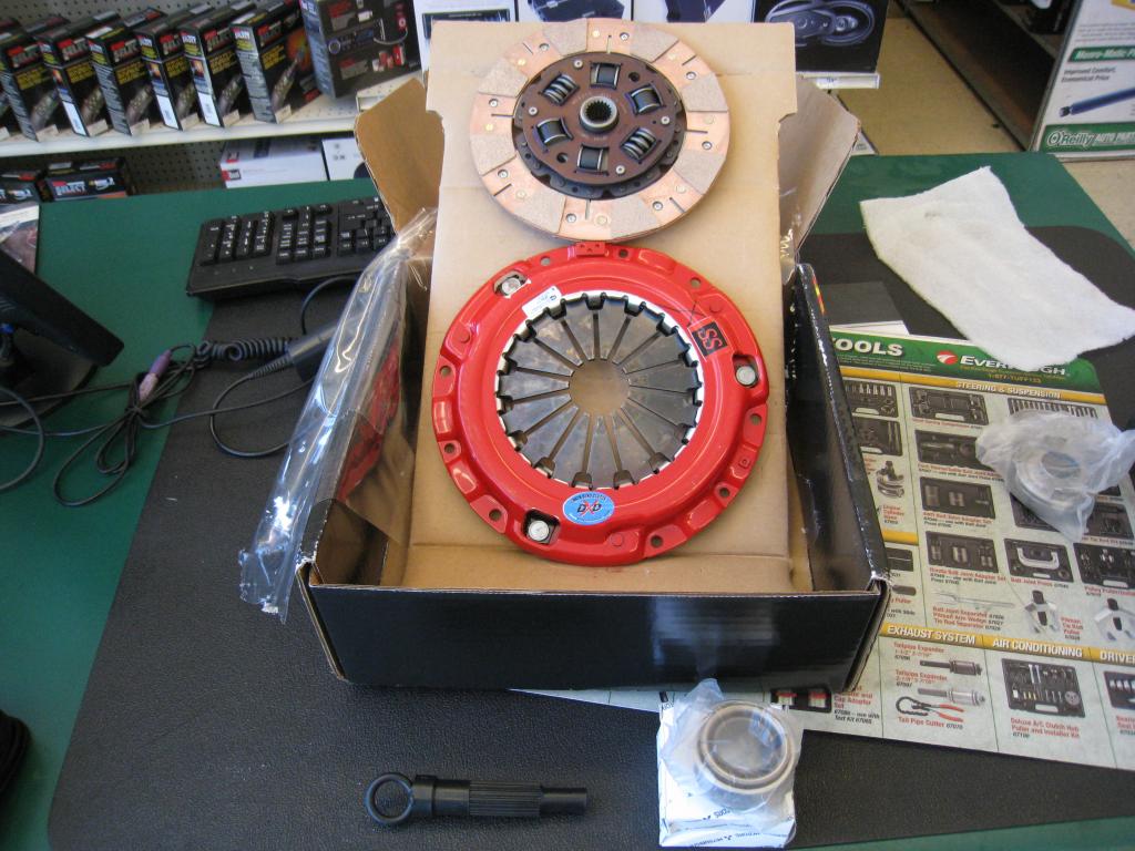

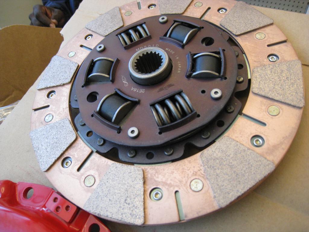

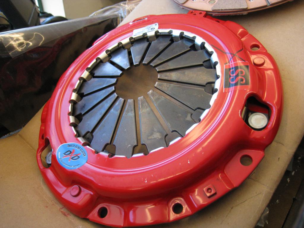

then went ahead and upgraded the clutch while im in there, because i know the old one wont hack it, spoke to Tim Zimmer and he told me this was the best of the best single disk clutch there is, is doesnt get any better then this for single disk's. supposed to handle upwards of the 700 mark. this is the Southbend SS-X pressure plate with full Ceramic disk (b series). part number K536SSXB

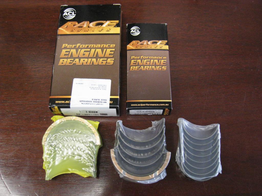

then ordered me new ACL main and Rod bearings.

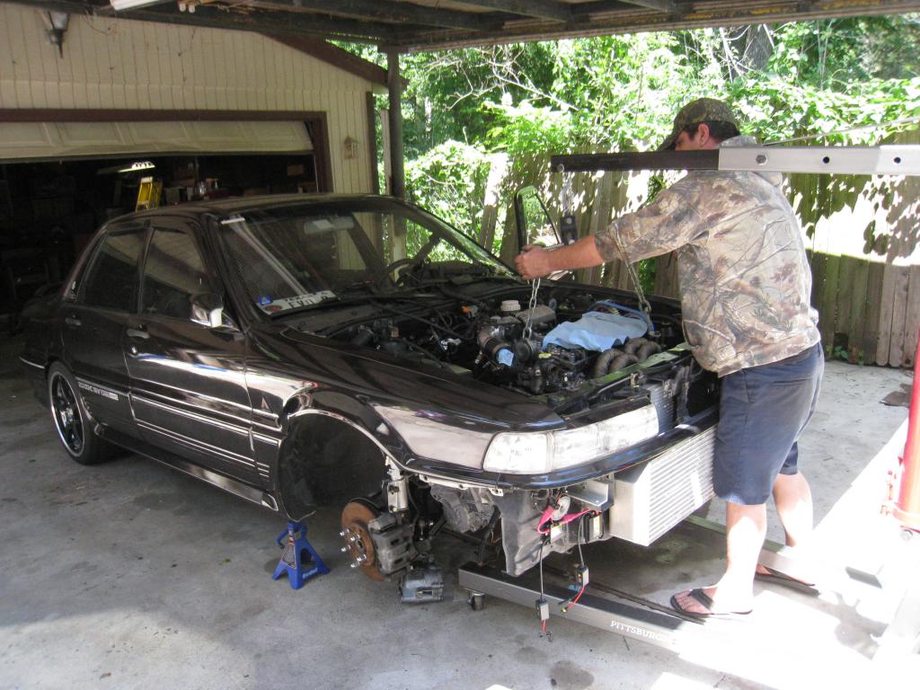

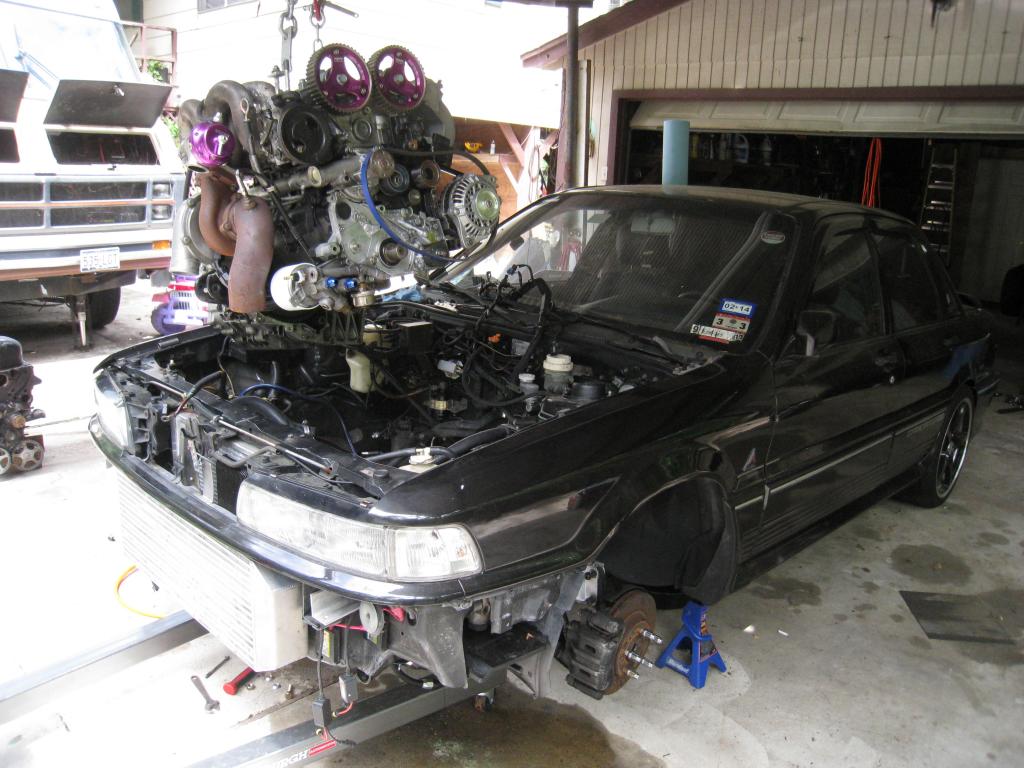

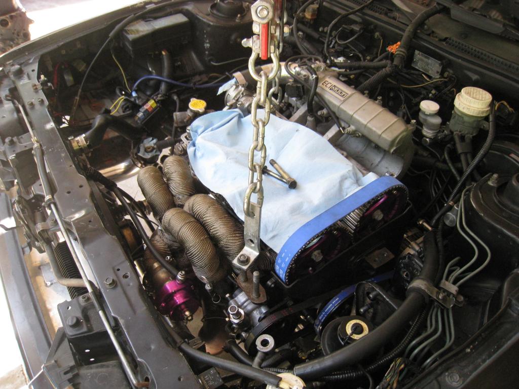

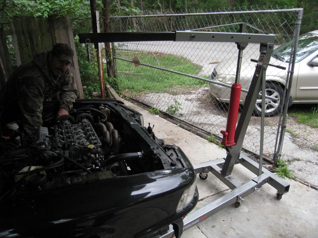

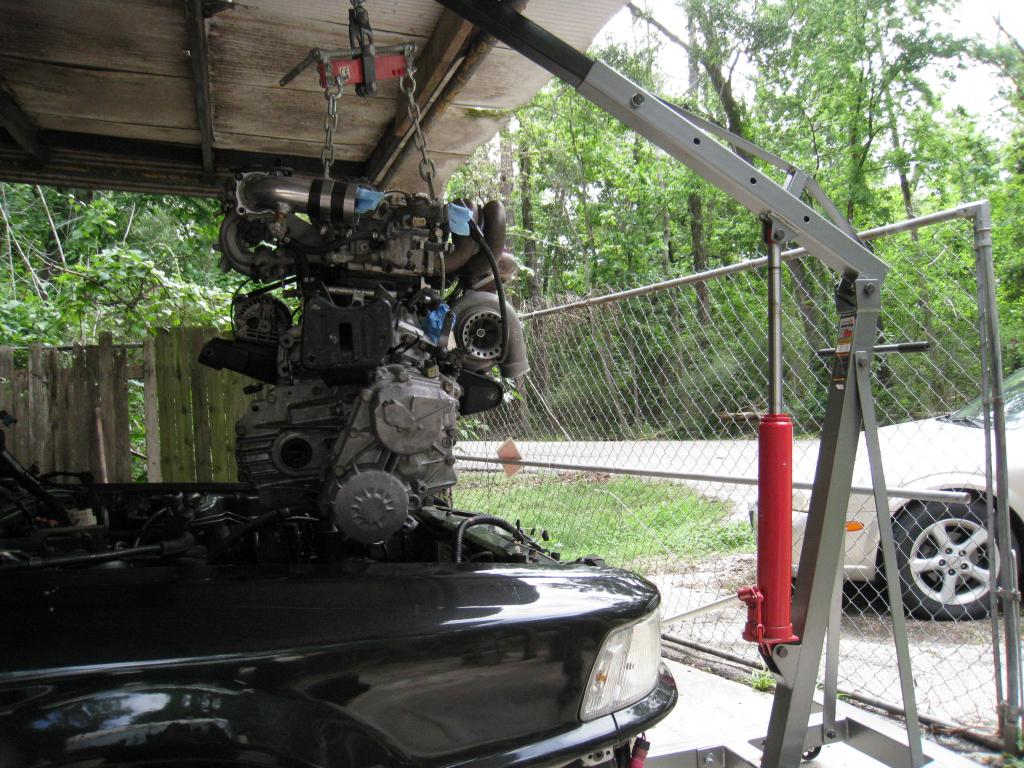

and here we are about to pull the motor.
and out it comes :grin:
and here she is with no motor :(

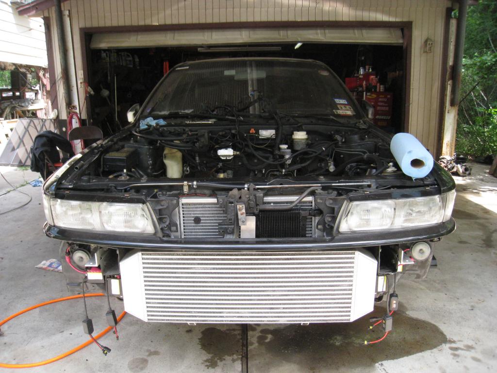

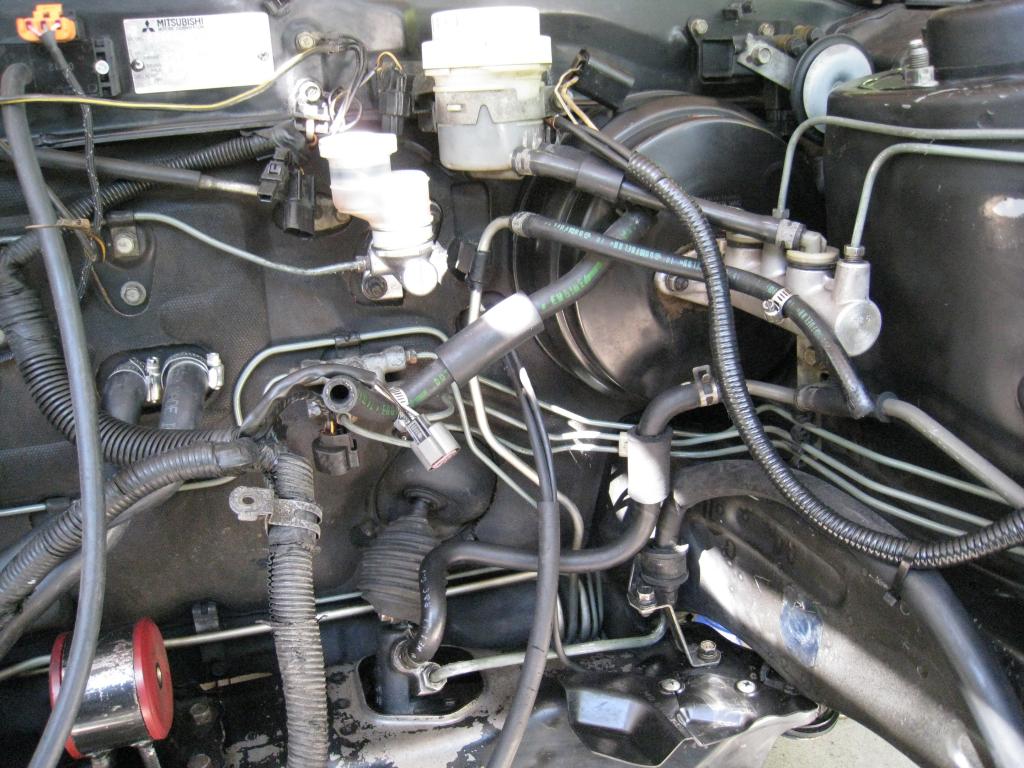

before shot of the engine bay before i went to town on it with degreaser and shop towels.
cleaned every single little line and surface. :grin:

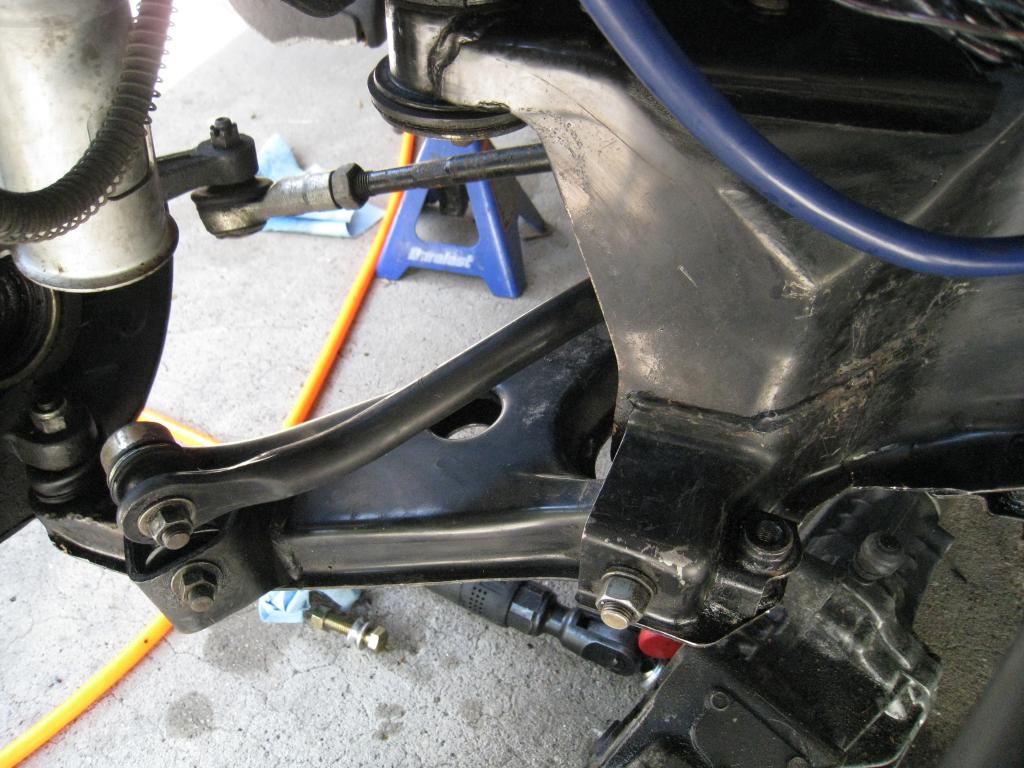

even got the lower subframe.

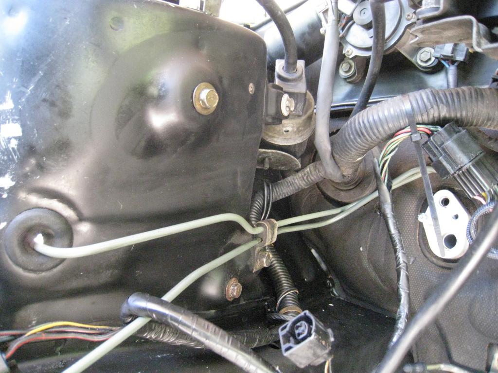

removed my washer fluid res, because thats where the future one off catch can tank will live.

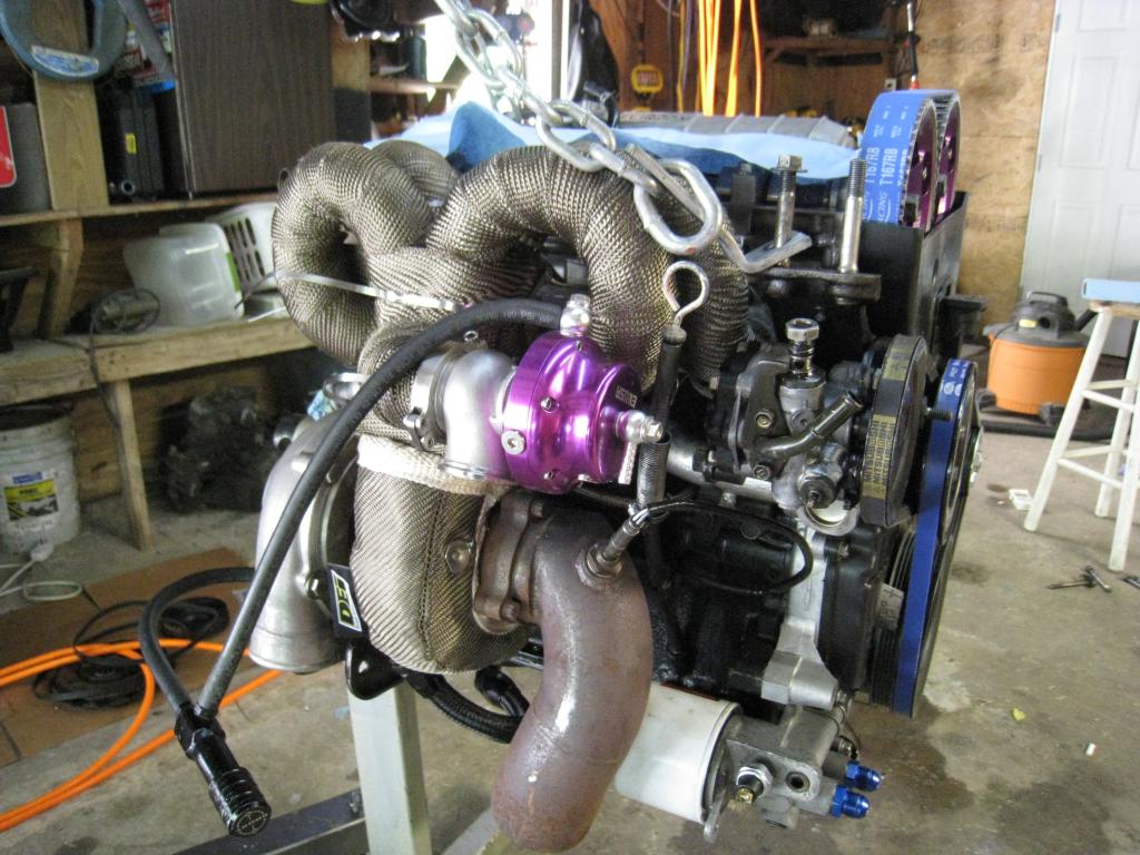

and here's the motor awaiting new parts.

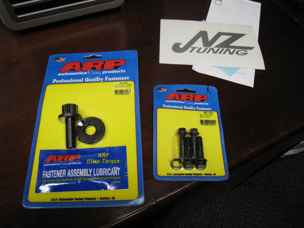

last but not least, i ordered some new ARP bolts for the Fluidampr crank pulley.

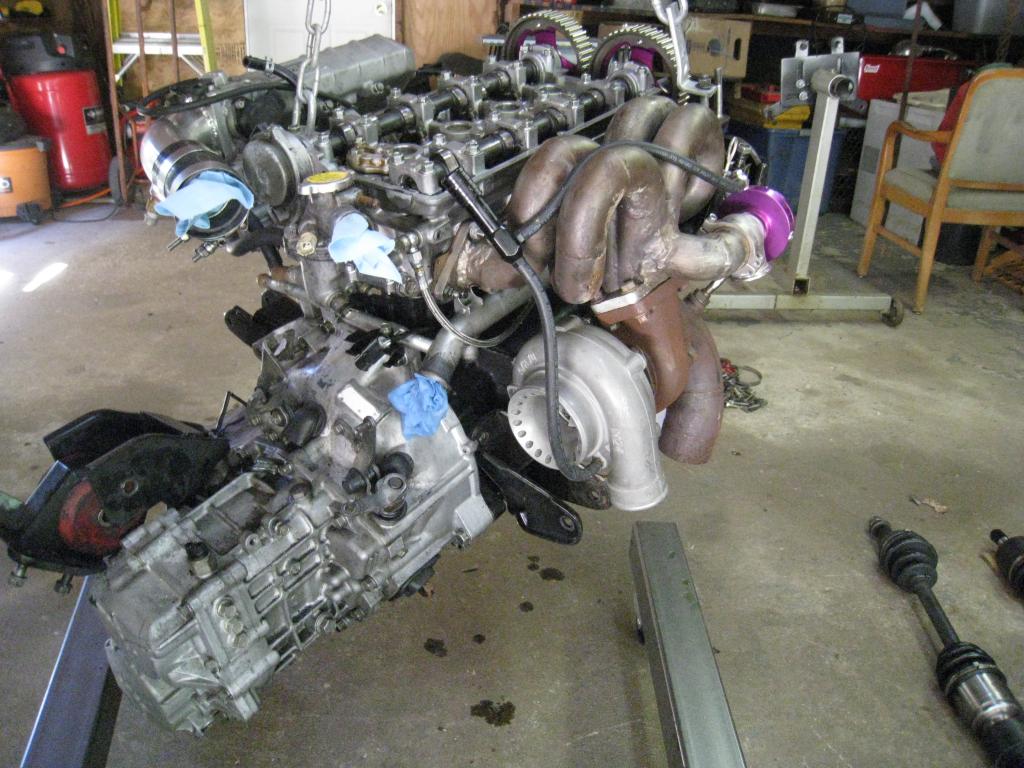

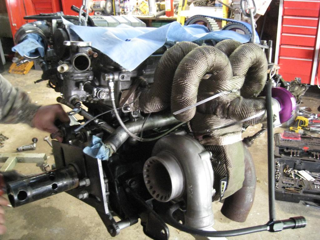

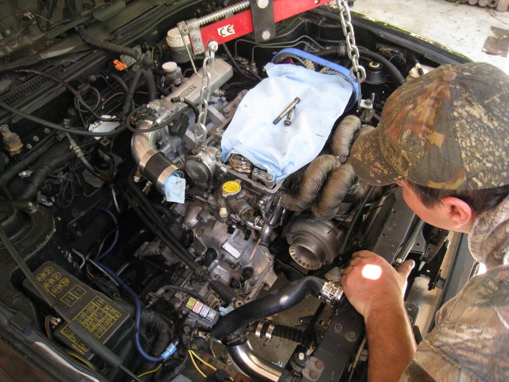

Got the motor all buttoned up and ready to slap on the new clutch and tranny then drop it back in the car. =)

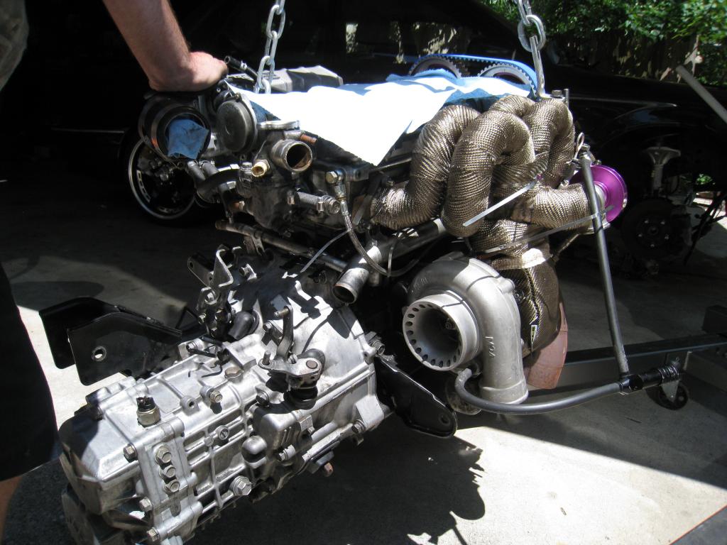

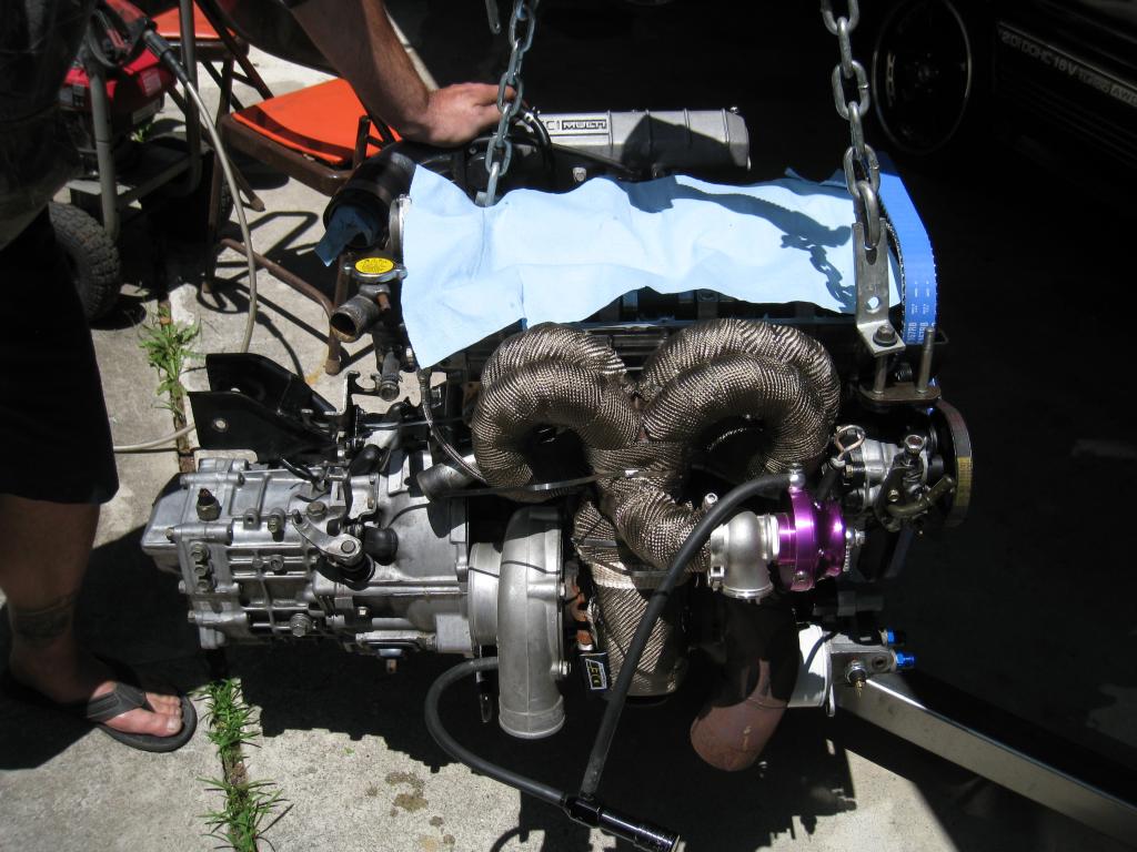

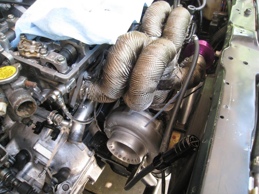

also got all my hot parts wrapped up in fancy DEI Titanium heat wrap and Turbo blanket. still need to change the position of the downpipe so thats why it isnt wrapped yet.
thanks man :thumb:
Got more stuff done this weekend,
engine all buttoned up and ready for the transmission

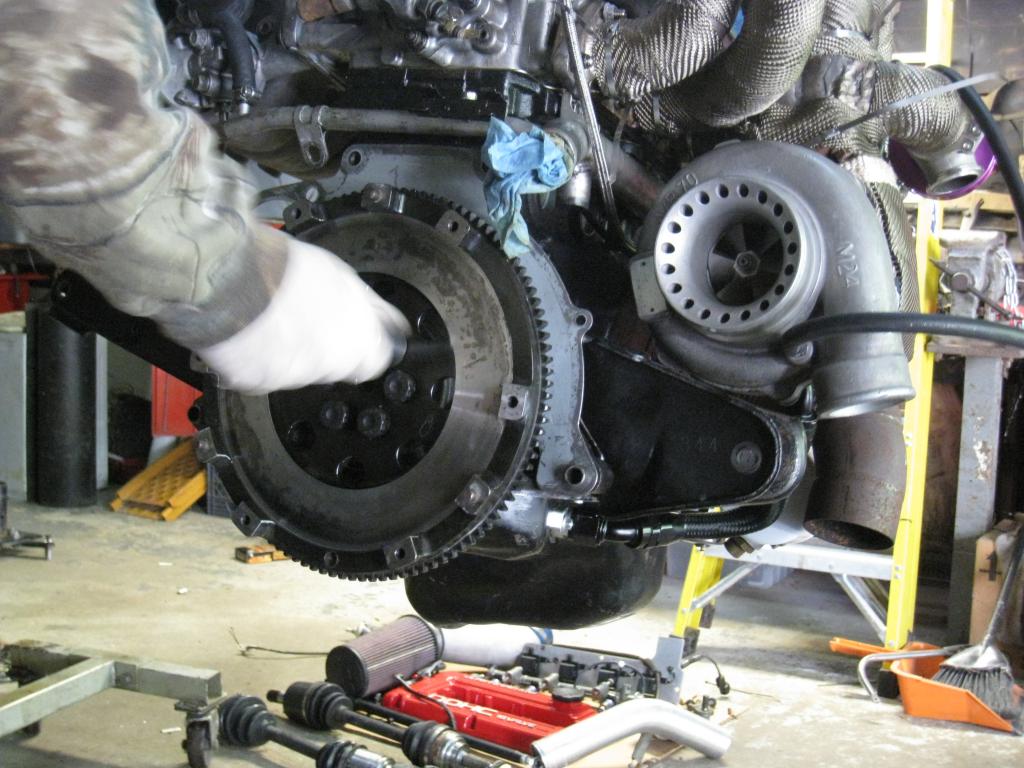

Putting on the ACT Streetlite Flywheel

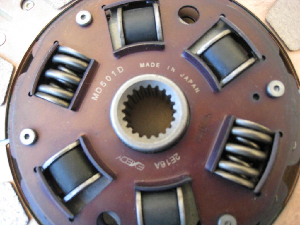

and the South Bend Clutch Disk

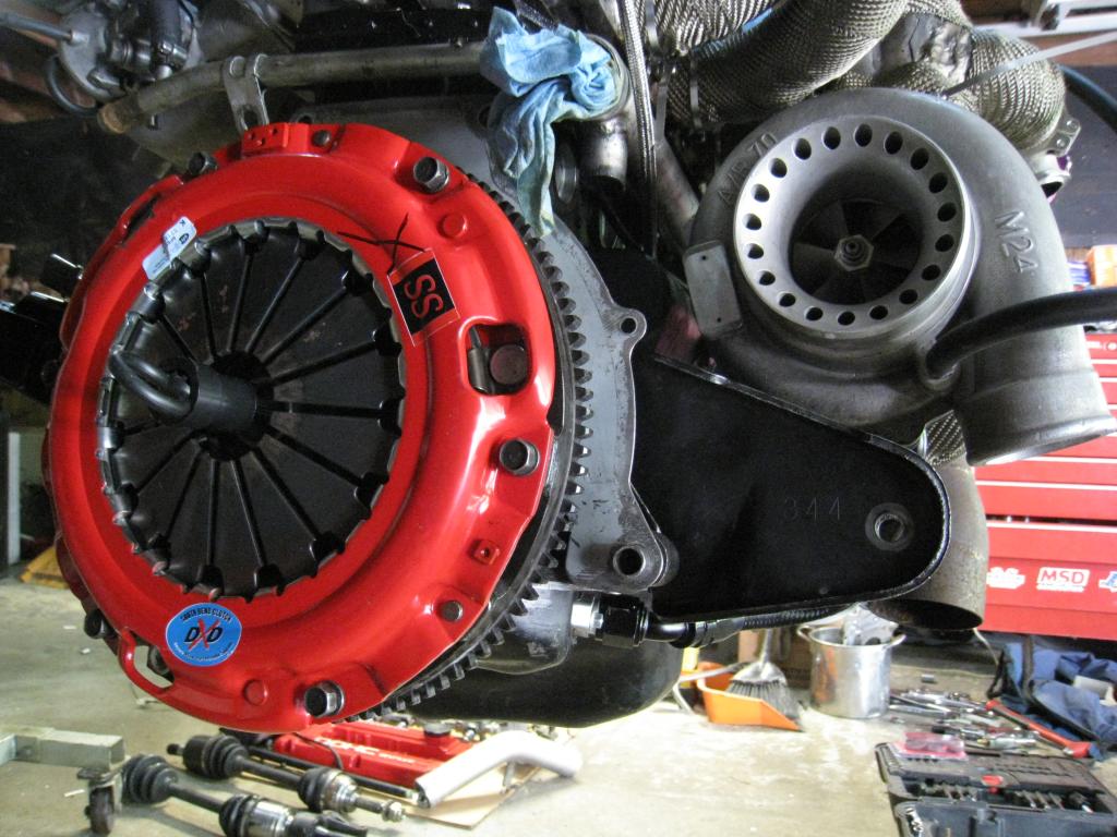

then the Pressure Plate
Fully Assembled =)

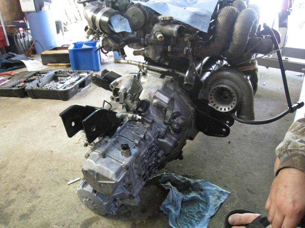

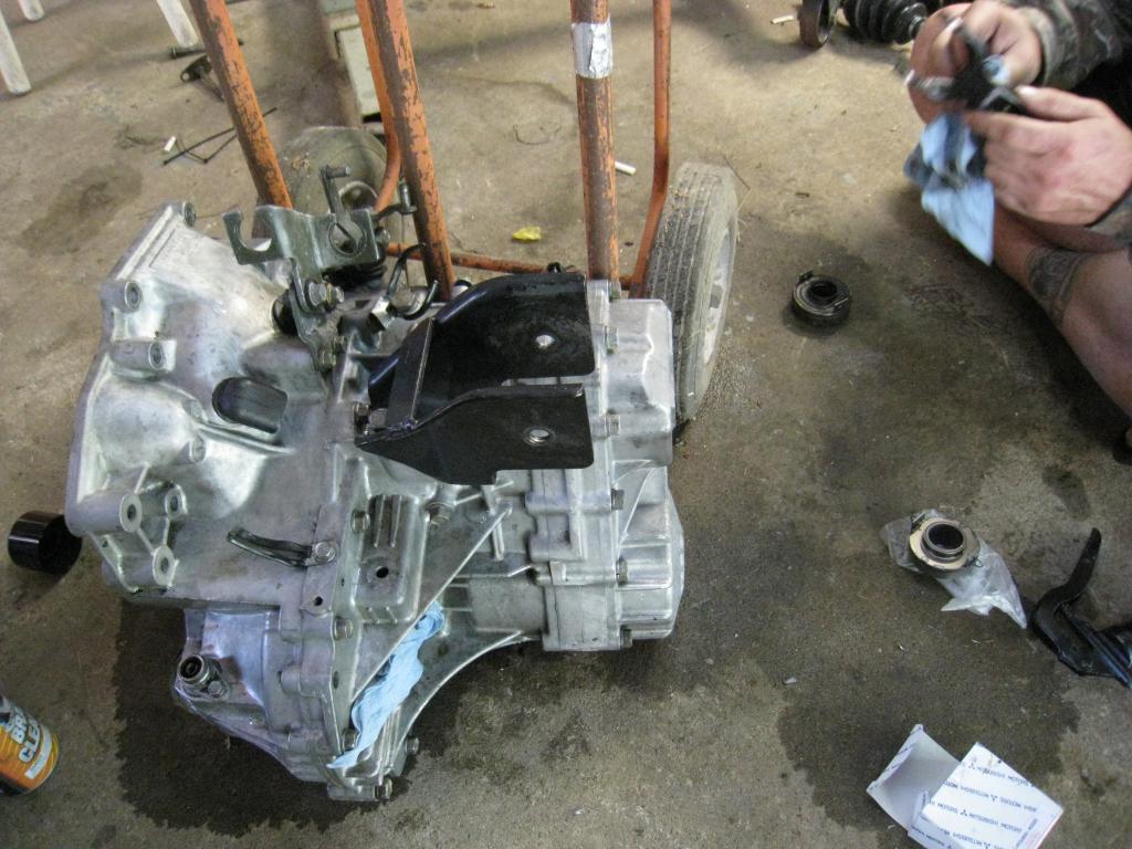

Cleaning up the Transmission a bit getting ready to slap it on the motor.
Installed =)

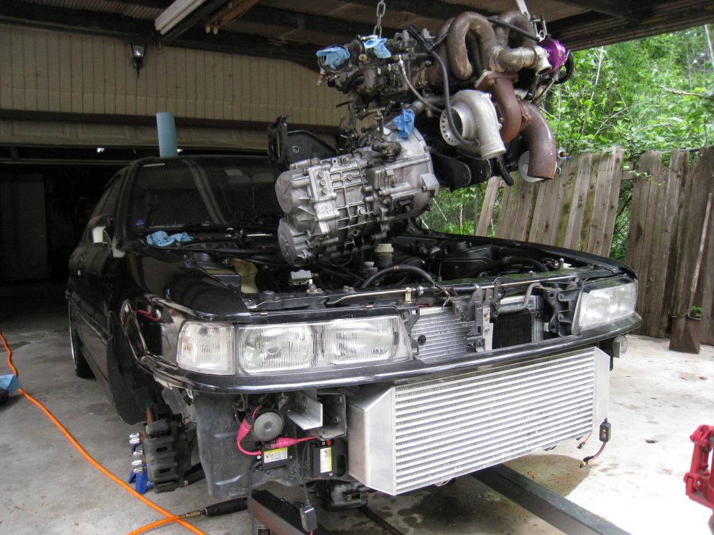

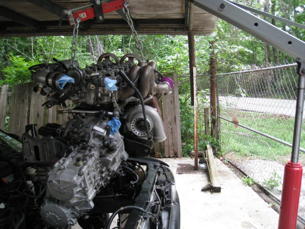

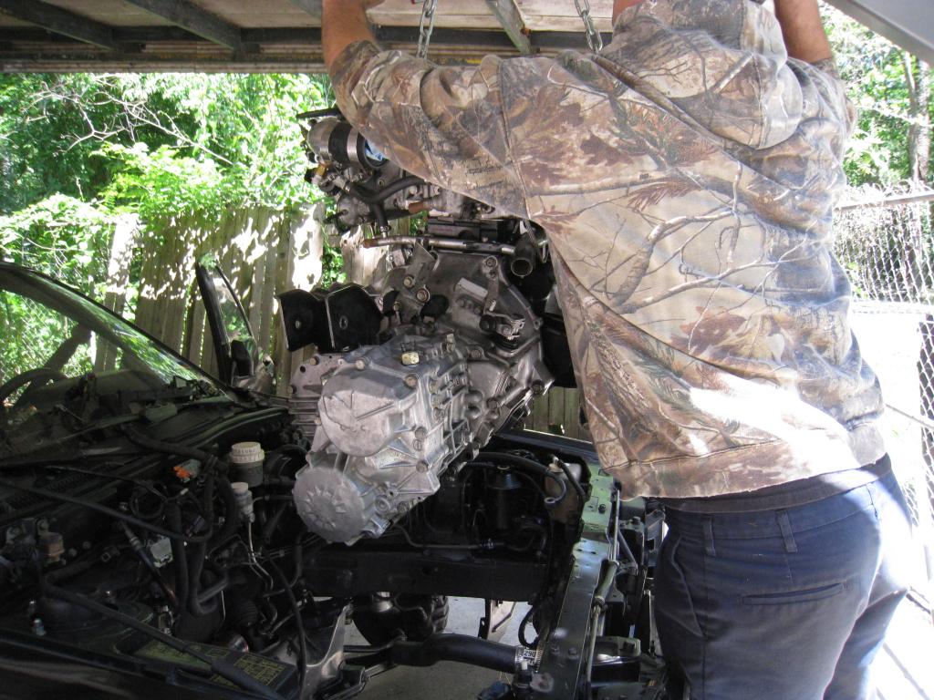

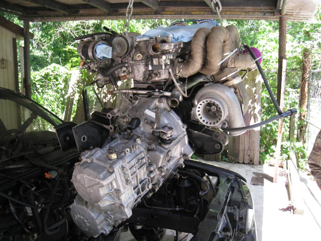

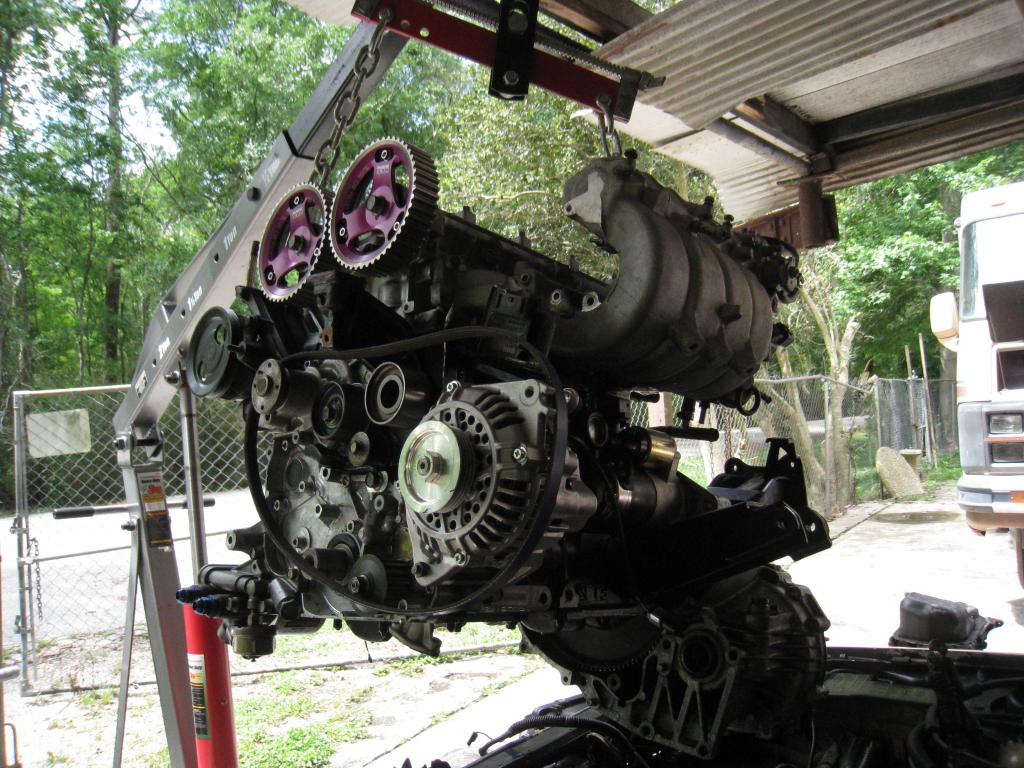

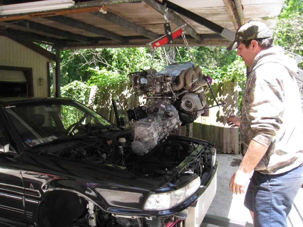

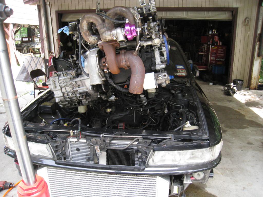

Moving it over on over to the car on the engine hoist.
about to drop it back in.
and back in =D

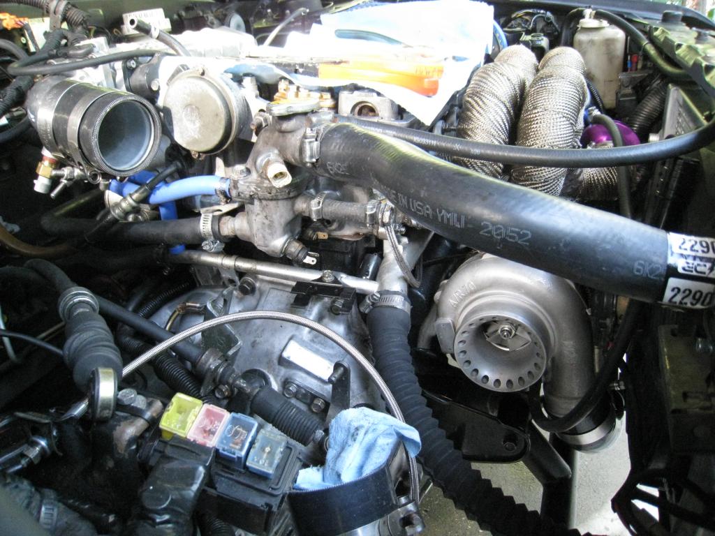

starting to get things connected.
aligning the mounts up.

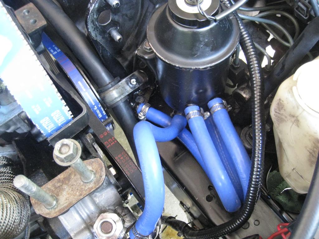

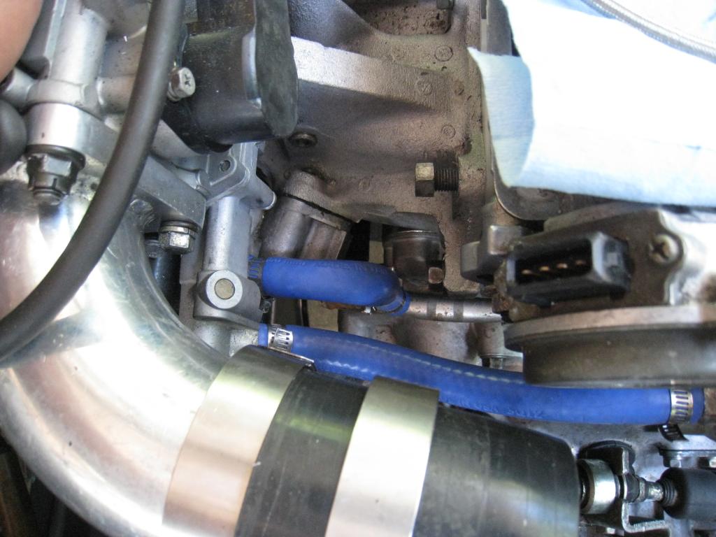

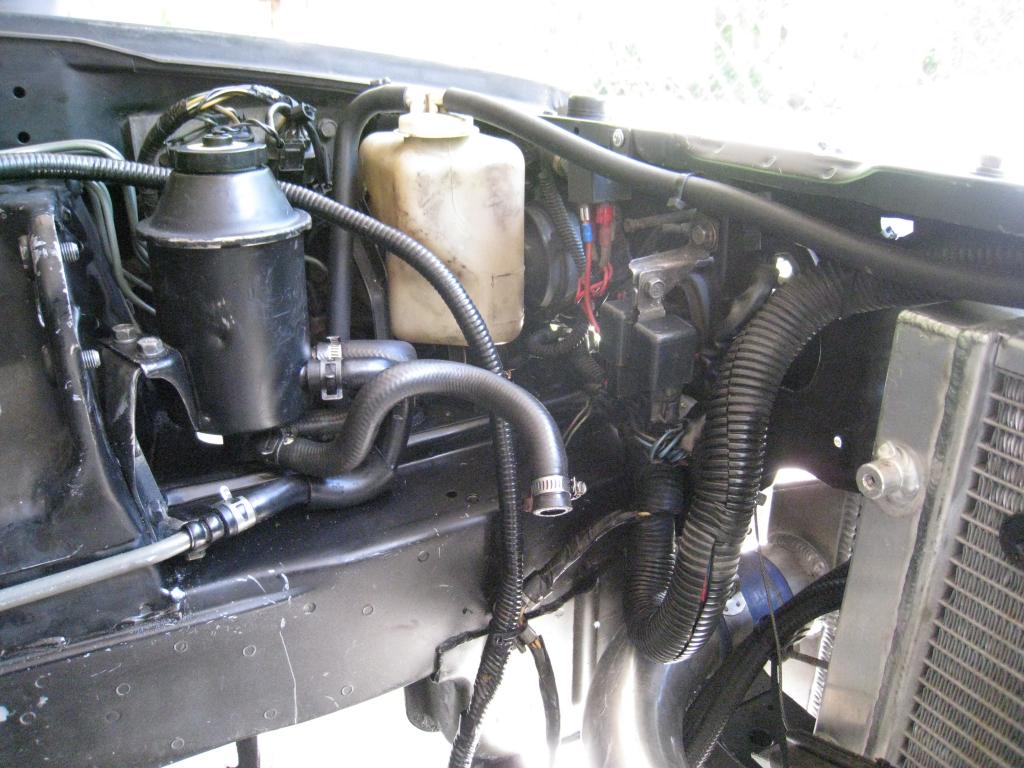

Re-did my old power steering lines with these nice Silicone ones.
also did my small heater hose's in the same stuff.

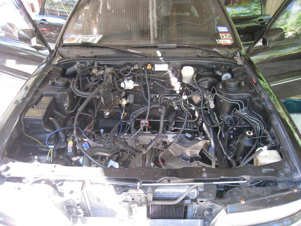

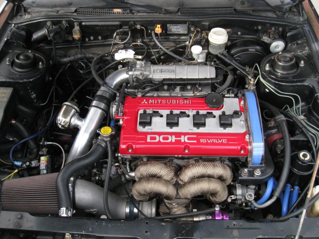

current engine bay pic
