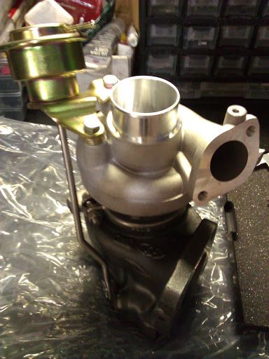

After much time, money and effort, I finally got the car to the point where I felt like I could really push the 68HTA V2. My intention all along was to see what this turbo was really capable of, and I think I'm satisfied with the answer I got. I'll say a few things up front about this turbo:

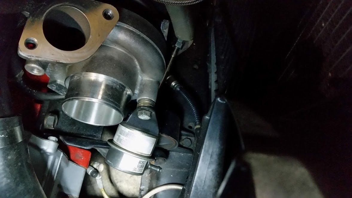

First, I'll concede this turbo is on the laggy side. In spite of my best efforts, I was unable to get this to spool like it's TD05H predecessors. Now, that's not to say there's not room for improvement, because there certainly is. If spool was your overall goal, you could probably tailor your build to suit this turbo's characteristics a bit more than I have, and get better low end response. However, I've said it before and I'll say it again: This is not a 16G, so don't expect it to perform like one. Also, if you wanted to do the work and machine a 7cm turbine housing for this, I'd bet you'd see a decent improvement on the low end, but you'll certainly pay for that in peak flow (@94awdcoupe). That all being said, the spool isn't horrible considering the amount of air it moves up top.

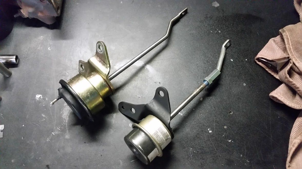

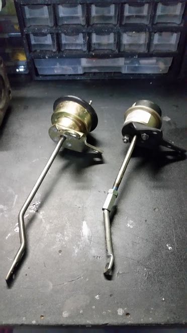

Second, if you want to get real performance out of this turbo, you need to ditch the internal gate. I started with the stock type actuator that comes with the turbo from FP. It's shimmed to death right out of the box:
With the WGA setup above, I was only able to get about 30 PSI peak boost, which would fall off at redline (8k) to around ~25ish PSI. This is obviously bad for power up top, which is where you want gains out of this turbo over the TD05H units. I'm running ECMlink boost control, and maxed my duty cycle out across the board to get the boost numbers mentioned above.
So, I swapped to a modified Holset WG actuator in hopes that it would allow me to hold more boost up top (thanx @19gsx91). I even shimmed the shit out of it in hopes it would hold better. Although it did help a little, it only increased my ability to hold boost by a few pounds. I saw around 32 PSI peak, and could hold just over 26 PSI to redline after installing the Holset WGA. I'm running a good sized stainless tubular O2 housing, and have 3" cat back exhaust. Again also, my EBC was maxed out at 100% DC.
Bottom line, the internally gated turbine housing just creates too much back pressure to hold boost to redline. At least, that's my experience. If you are going for records on this turbo, it certainly won't be on the internally gated turbine housing...I'm certain of that.

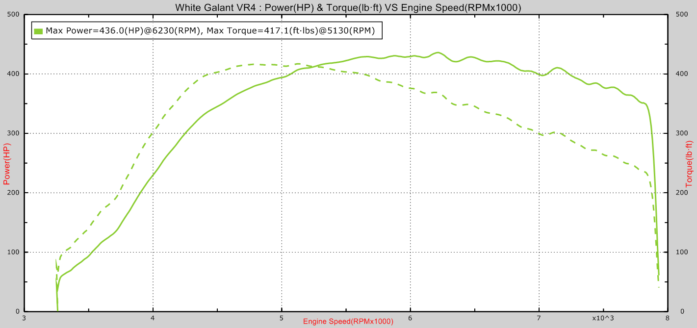

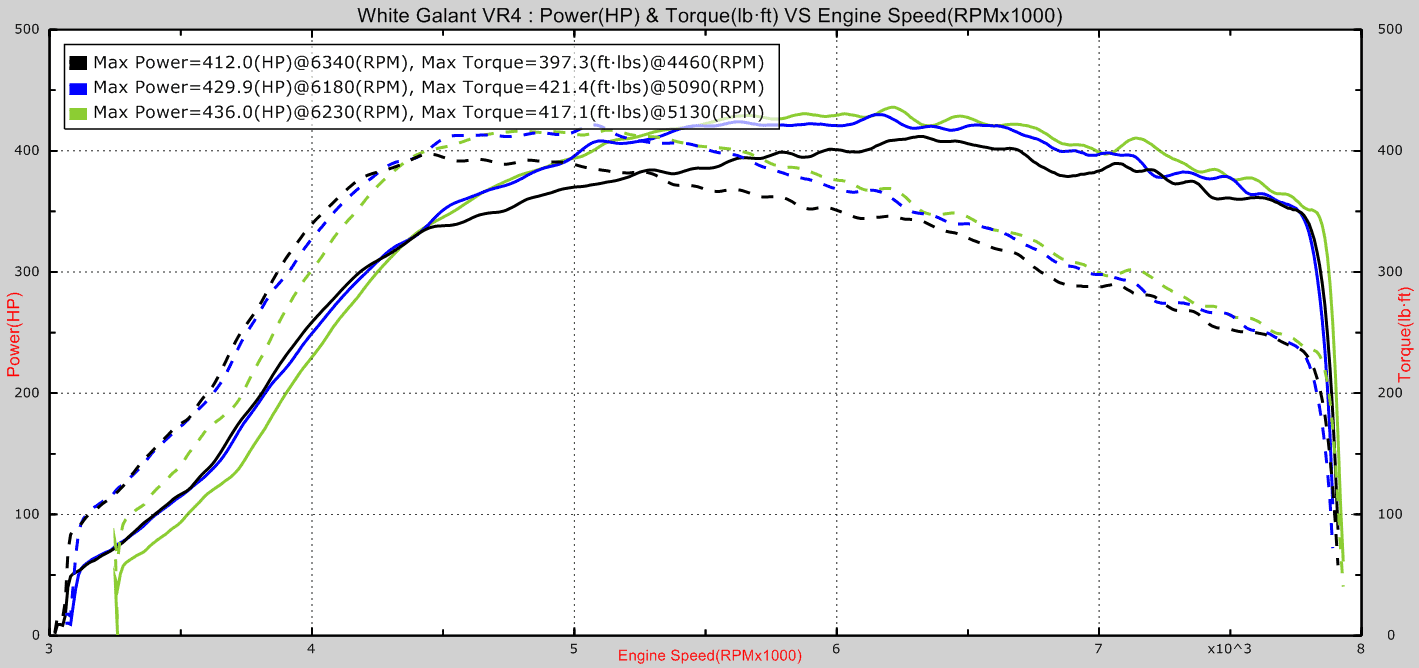

After doing everything in my power to maximize boost, I figured it was time to hit the dyno and see what this 68HTA was capable of.
So, I hit up Dave at EFI Specialties & Performance to schedule some dyno time. All the tuning was done by me, but Dave was kind enough to lend me his dyno and Friday evening so I could put my shitbox on his rollers and play with the tune. It was awesome meeting Dave. He did an outstanding and professional job with the car on the dyno.
On the dyno, I only tweaked the SD table between pulls; boost and timing remained the same for all 3 runs. With each pull I saw a small power increase after tweaking the tune. With more pulls, I probably could have squeezed out a bit more power, but it really wasn't worth the time or effort at that point. Dave and I came to the general consensus that my turbo is damn near tapped out anyways, so there was no use in going for records. Logs seemed to agree, as they showed slightly over 51lbs/min, which would have been higher if the car would hold 30 PSI to redline. A log of the best run is attached below.
Laggy or not, bang for buck it's hard to beat the 68HTA V2, IMO. I picked this turbo up brand new for around $600 bucks shipped to my door, and it's a good performer for a stock appearing bolt-on unit. Sure, there are better turbos out there, but when you weigh them pound for pound against the 68HTA, I think the pros and cons can balance out depending on the application.
At the end of the day, I just wanted to see where the car was at on the 68HTA (V2) before I swapped to a new turbo setup next spring. I'm happy with the result, and the car runs awesome both on and off the dyno.
That being said, the biggest accomplishment isn't the power it made. I drove it 2 hours to EFI in Virginia, beat the shit out of it on the dyno all afternoon making decent power, and then drove back another 2 hours in stop-and-go shitty Virginia traffic. No squeaks, no leaks, no blow-ups, no bullshit. Find me 10 other Galant VR-4s that can make that claim, and I'll start sucking dicks...

That looks really good - your dyno results.
I agree with your conclusions about the turbo, the 8cm vs 7cm housings, the wastegate haha!

Honestly, the car did better than I anticipated. I figured the car would make right at 400whp, so the extra 30ish hp was nice to see. The torque is what I was really surprised and happy with, though! The car made 417ft/lbs, which is MUCH better than I expected out of my 2.0L on a stock frame turbo.
I had high hopes for the Holset actuator, but now I suspect the actuator itself may not actually be the issue. I'm wondering at this point if the stock BCS has something to do with my inability to hold boost at higher pressures. I'm considering picking up a a IR BCS to see if that helps at all (@gofer).
Yeah I was very impressed with the torque figures you put out, I'm very curious to see where it would of ended up had you been able to hold boost to redline, I'm itching to get the GSX back up and running but life keeps getting in the way, I have all the parts, just no time.

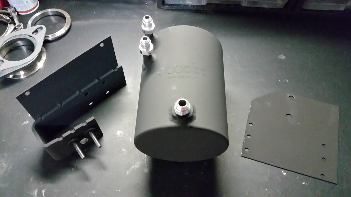

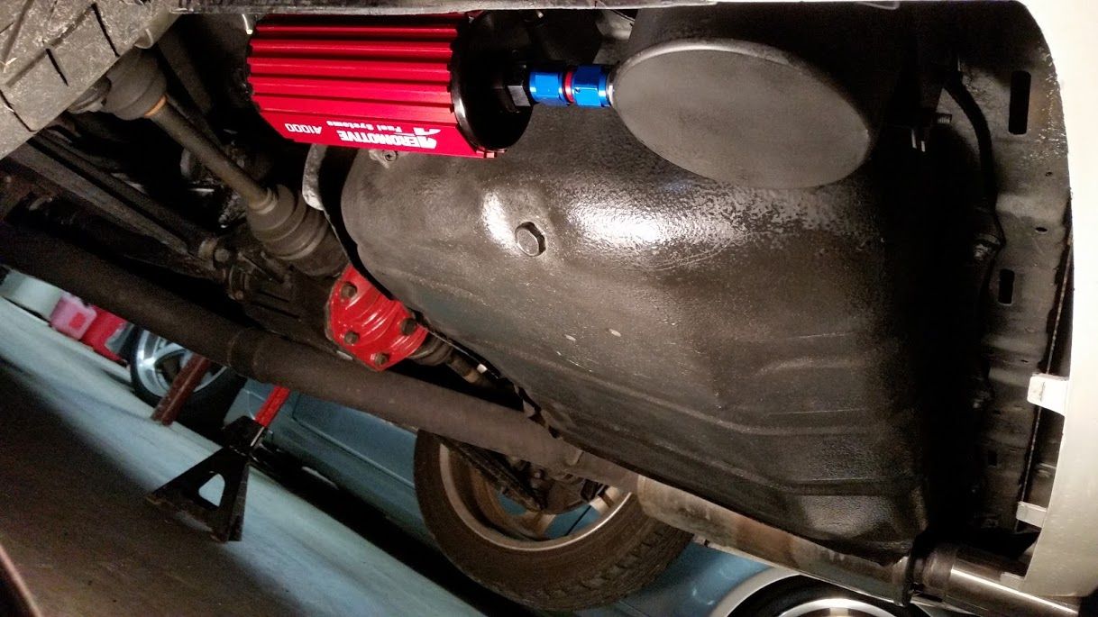

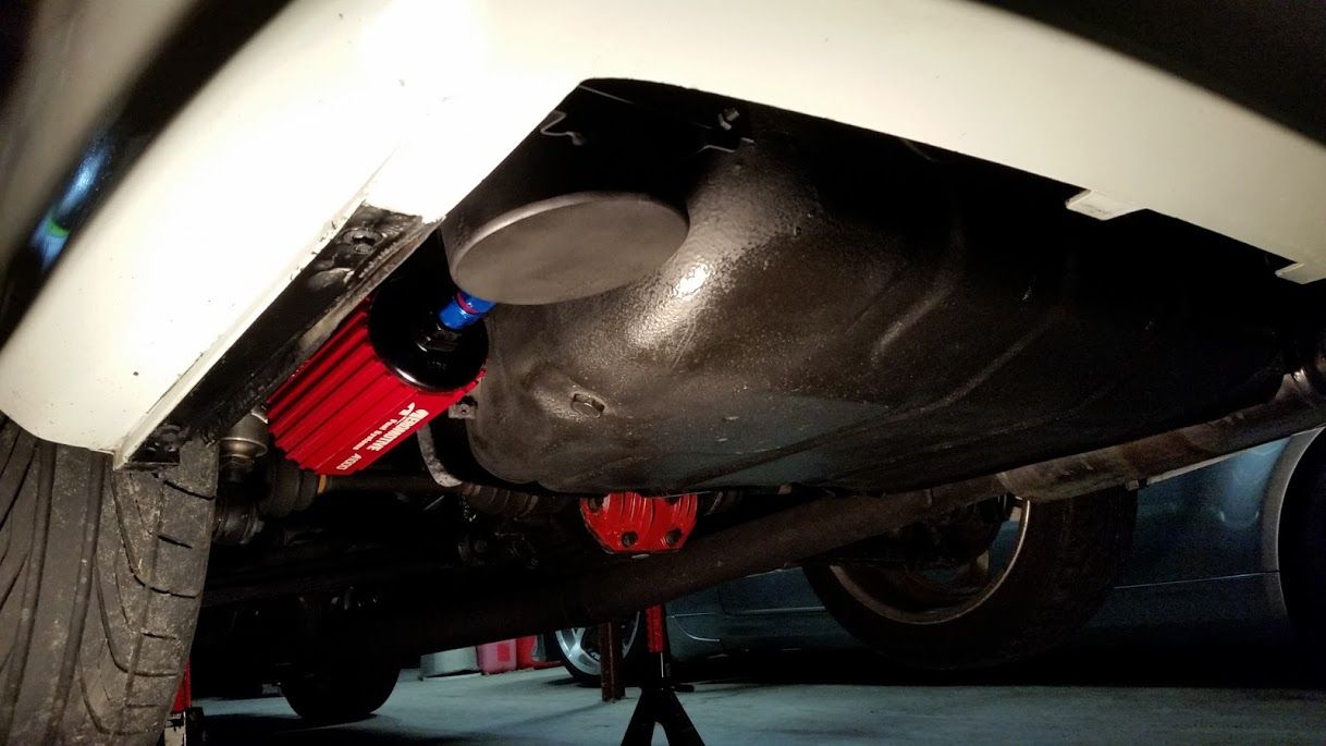

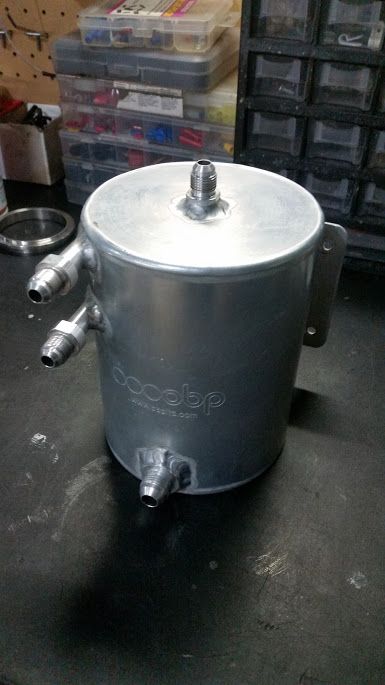

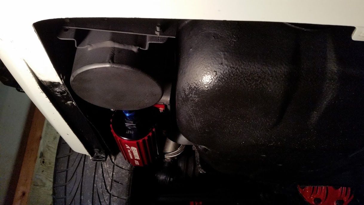

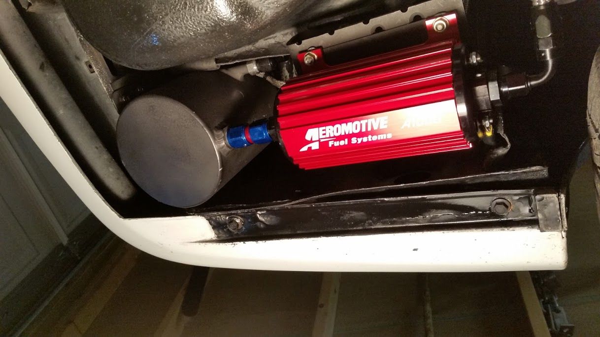

I'm doing some more experimenting with the fuel system. I added an OBP 2 liter surge tank between the lift pumps and the A1000. It's a tight squeeze, but with some custom brackets I got it to fit under the rear quarter panel. I finished up the install at 11pm and didn't want to piss my neighbors off...So test drive tomorrow.

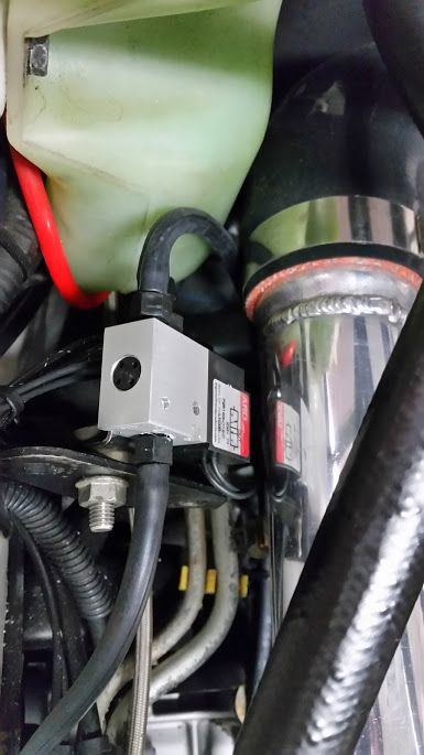

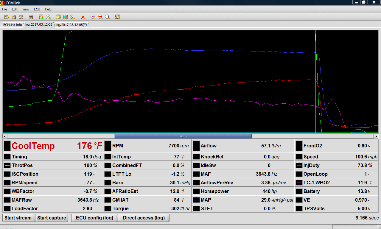

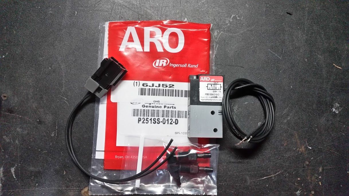

I finished up the additions to the fuel system last night, but didn't get around to installing the IR BCS I picked up. I'm currently running ECMlink boost control on the stock 2 port solenoid, which works great. However, I'm having some issues with boost dropping off near redline. I've upgraded to a modified Holset WGA, but the internal gate is still blowing open up top.
In a last ditch effort, I wanted to try upgrading the BCS to see if that would help any.

After installing the IR BCS, I went for a test drive to try see how the fuel system and IR BCS performed. Everything worked awesome.
After a few pulls, I had the boost holding steady at 29 PSI at redline. So, it seems the stock BCS is definitely a limiting factor at some point. IR BCS FTW.
The new surge tank seems to be functioning as it should. I wanted to lower the working pressure between the 2 in-tank Aeromotive 340 lift pumps and the A1000, so the lift pumps could move more fuel. I was also having some issues with the lift pumps sucking the sump in the stock tank dry when the car would get under half a tank, so I needed to figure out a solution for that. The surge tank seems to have corrected that issue. Performance wise, IDCs still look awesome, and the car runs great. I will say, you can definitely tell the A1000 is there. The car sounds like a rocket ship on startup. If you're one of the guys who hate the whiny Walbro, this thing would make you cry.

29 psi now, that's up more than 3psi from the log you showed in December, so I guess the solenoid really is an improvement.
The surge tank is cool, didn't know you could fit all that stuff back there.
One of the upper fittings is for a return line that goes right back to the gas tank, I think?
The very top port is the return line on the surge tank.
The two ports next to one another are the feed to the surge tank from the lift pumps. I'm currently only using one, but I think I may run a separate line for each lift pump in the future.
