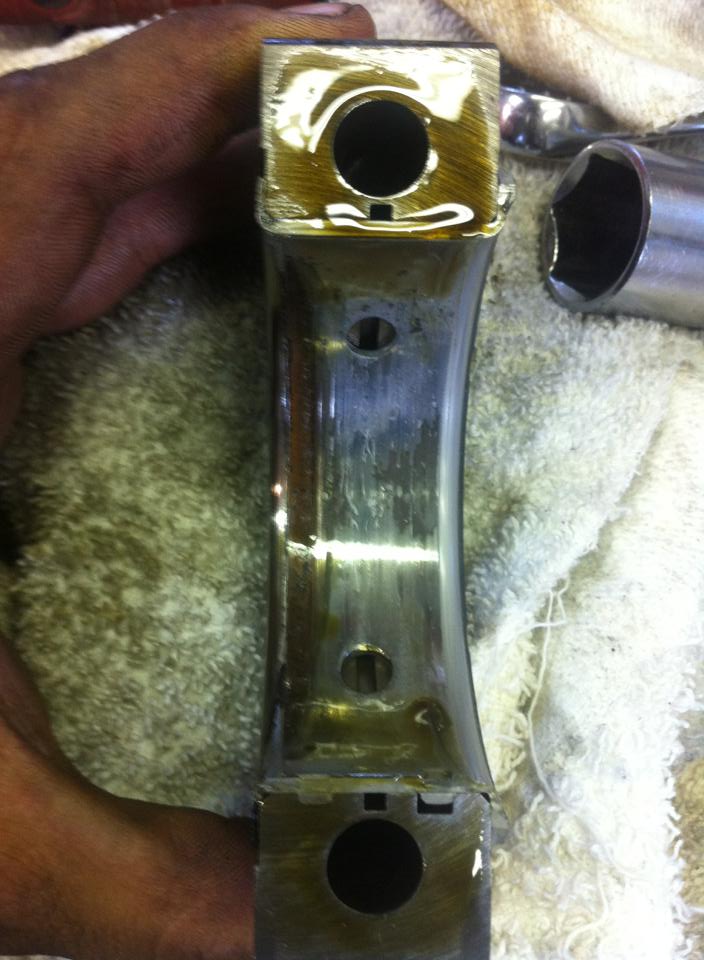

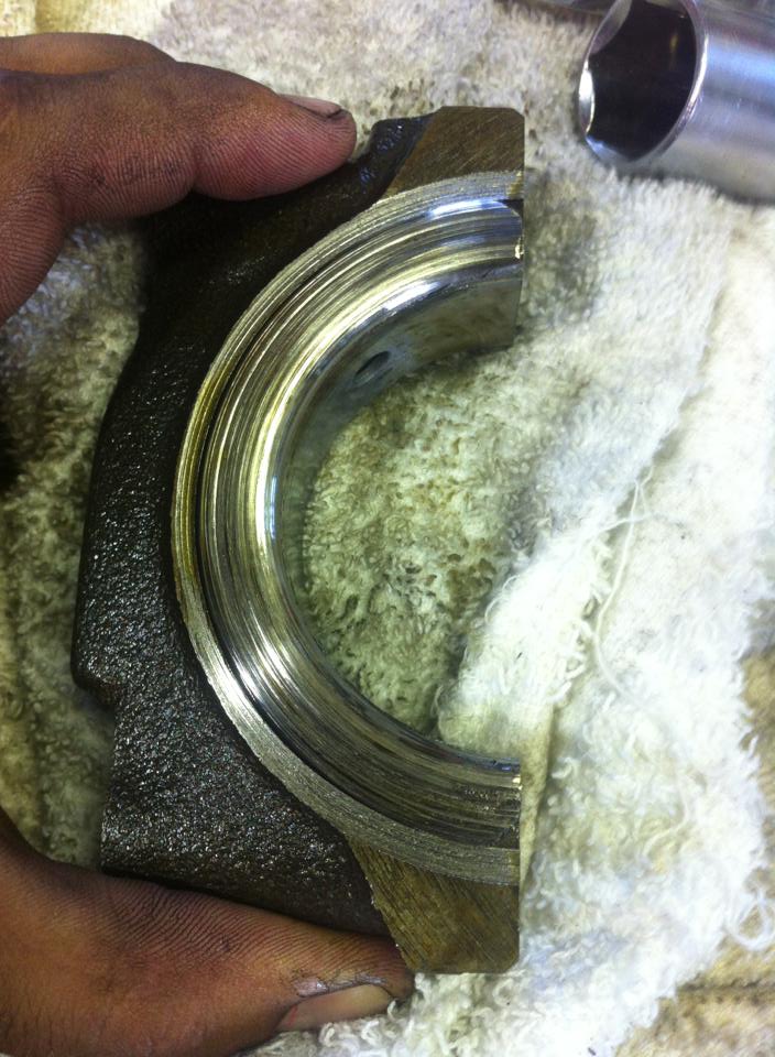

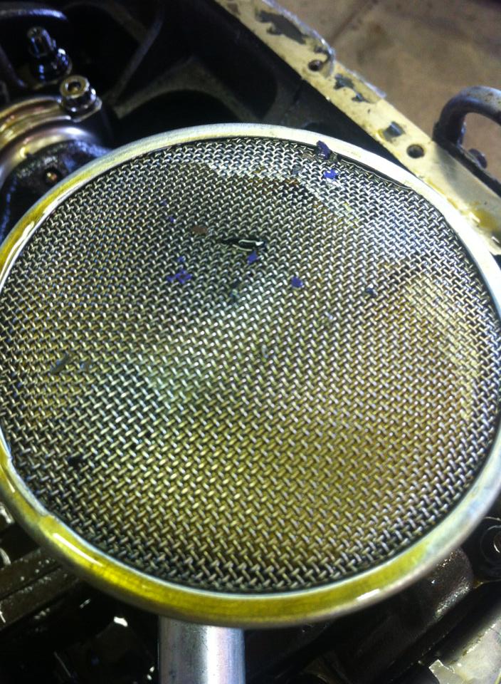

Now, everything was going as planned until it was time to time this thing.. Found some stocker cams to put in the car for the time being. Upon wrapping the belt around the crank sprocket I noticed some movement.. I thought "no this cant be"
Sure enough.. over 1/16" of crankshaft end play. Took the pan off and found this..

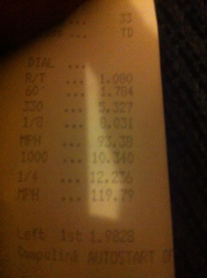

took the car to the track last weekend for test n tune. Had 4 runs. Two of which I was locked out of second .. After I got that all sorted out, first pass was a 12.4x @ 116 with a 1.8 60'.. Did a couple small changes and next pass was better! Almost hit my goal for the weekend which was 11s or 120 traps.
This is on my everyday street tires and FD wheels. 26 psi on the 7 blade hx35. 3400lb race weight.
