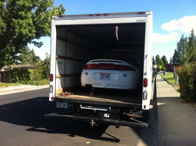

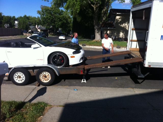

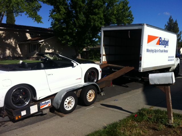

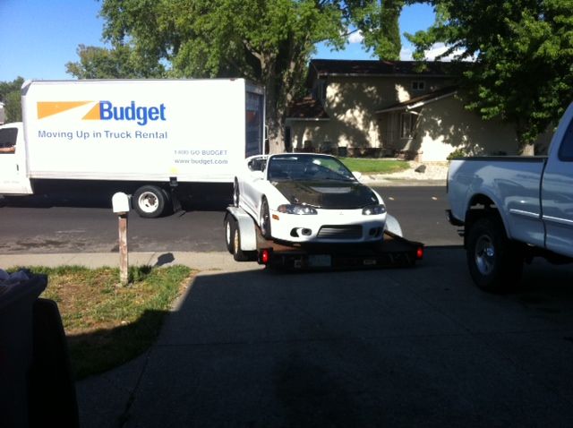

Haha! I cant believe nobody has ever asked that before on here!! No, not custom ramps. When I rented the truck, I also rented a trailer from the same place. And if anyones ever rented a uhaul trailer you know that the ramps extend from the trailer. Well, we loaded the car onto the trailer backwards, unhooked the trailer and lowered the tongue to the ground and chalked the wheels. Then Backed the truck up to about 5 or 6' to the end of the trailer and extended the ramps into the back. Then I drove the car into the trailer, very slowly. I took pictures of the entire thing, Ill try and get them up.
Edit, found some..
[URL=http://s805.photobucket.com/user/oscarson66/media/intotruck_zps5976784a.jpg.html]intotruck_zps5976784a.jpg[/URL]
[URL=http://s805.photobucket.com/user/oscarson66/media/intotruck2_zps2c0f9b4b.jpg.html]intotruck2_zps2c0f9b4b.jpg[/URL]
[URL=http://s805.photobucket.com/user/oscarson66/media/intotruck3_zps0e6c2486.jpg.html]intotruck3_zps0e6c2486.jpg[/URL]
[URL=http://s805.photobucket.com/user/oscarson66/media/intruck.jpg.html]intruck.jpg[/URL]
