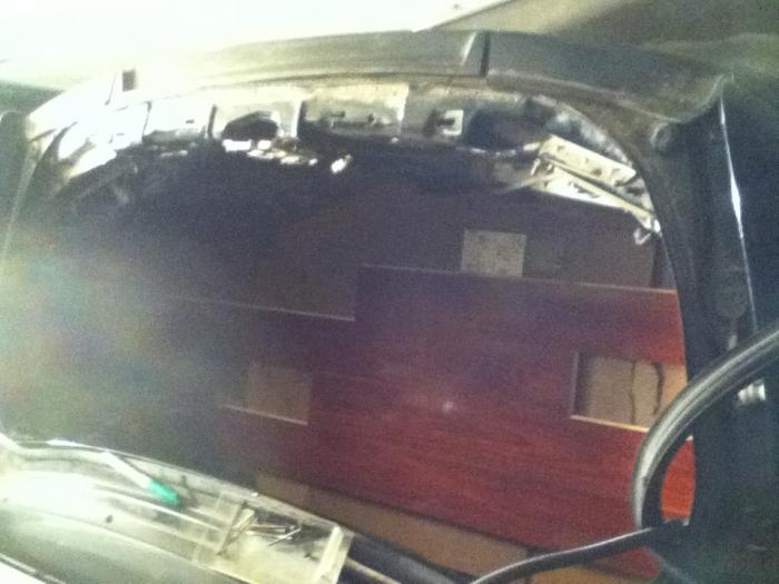

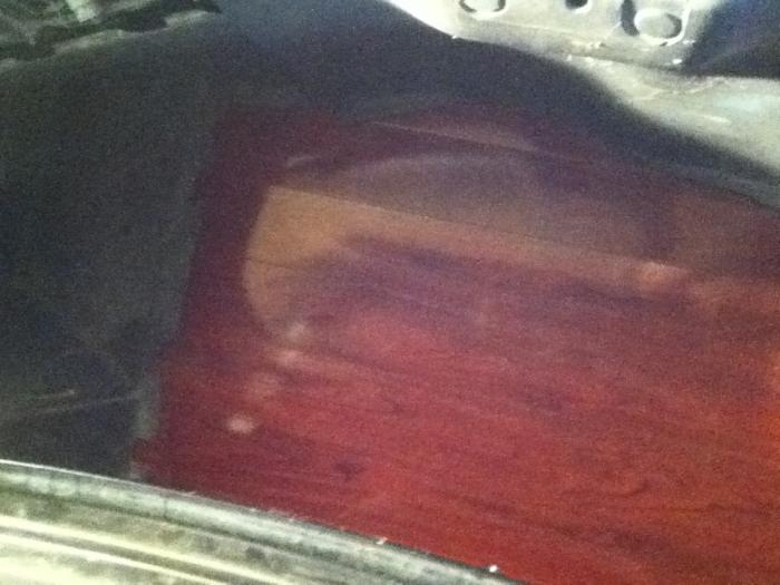

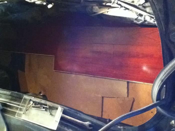

After the crazy wire tuck I decited to take on some thing a little less challenging. So I put this hard wood floor in my trunk let me know what you think I still have to paint the plastics black to match the rest.

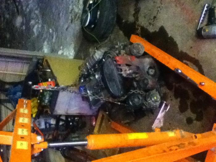

As you all know I'm 6 Bolt swapping g and was going to build my block from scratch but an opportunity came upon me that I couldent pass up. My buddy has a stupid 2g talon that is 6 bolt swapped awd and I pulls wicked hard he bought the car for 400 bucks it had something really dumb wrong with it. Any way it had some wiring issues and he decided to part it out I yanked the motor and still it for 500 bucks no one knows what this motors got in it it's a mystery motor.:pray: so it could be all stock or full of wicked cool parts. We will have to wait and find out

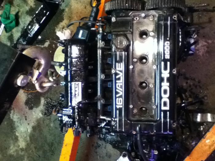

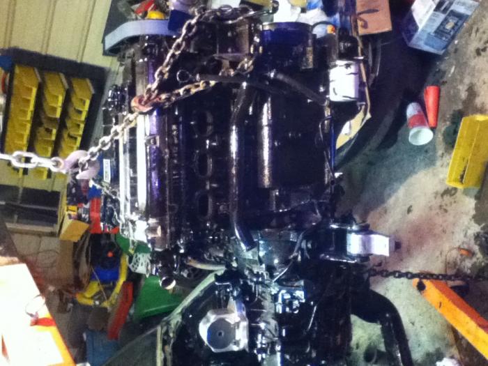

Well the bottom end of my 6 bolt is stock :cry: but it possibly might be caned I haven't looked that far yet. We got the engine and alog of other stuff cleaned and painted with por15 black paint it's all glossy now and I hate it bug the paint has no uv protectant so it will turn flat in the sun.:D

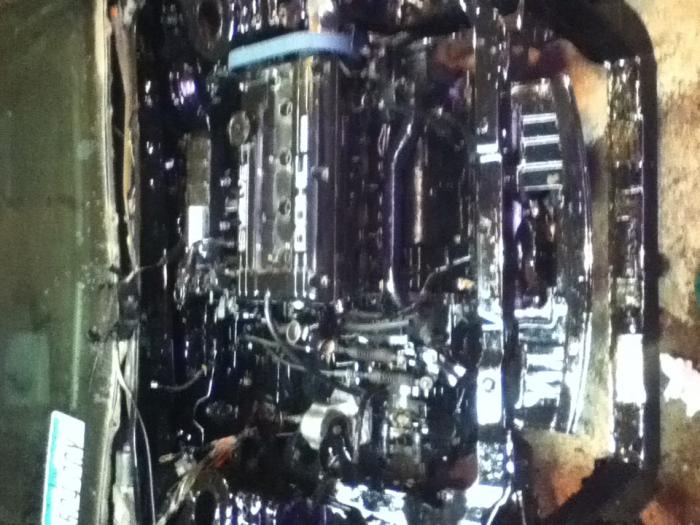

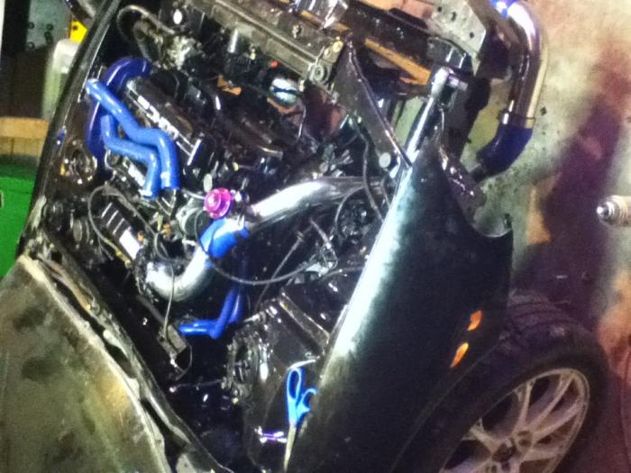

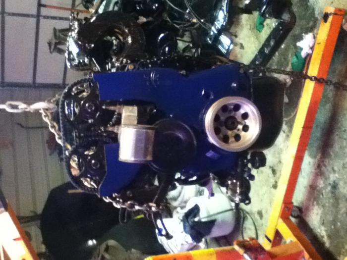

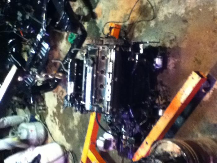

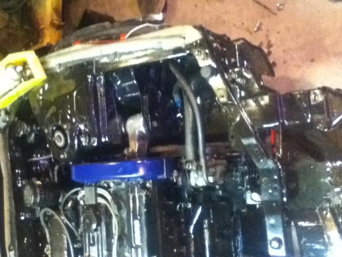

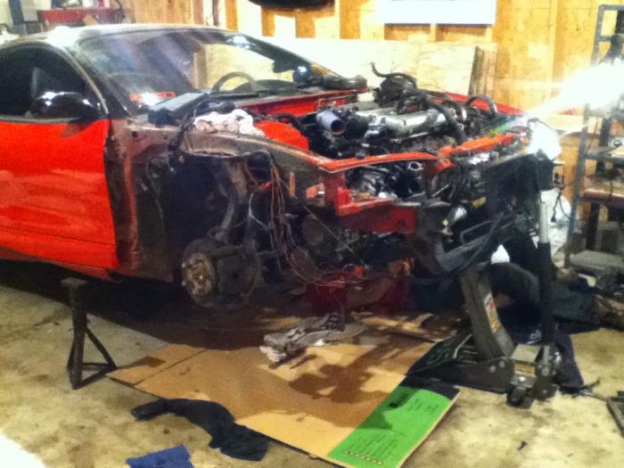

I worked out in the gerage today just kinda dinken around with the spyder and got the engine all put together and in the car the only thing I need are hoses for my power steering tuck and to pick up my turbine housing.
Looking great so far, hopefully that motor holds up for you. Can you do us all a favor and turn the pics right one click before you upload them. My neck hurts LOL.

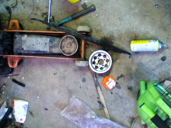

You should rethink that crank pulley.
This is exactly what I was thinking as soon as I saw that. I'd definitely recommend going with an OEM. That OBX may make a nice frisbee though.
X3 on the crank pulley, it's almost an amazing thing to see them still produced with the track record of the aluminum and other "lightweight" non-harmonic dampening front pulley setups for the 4g63
And +1 on the pics, thankfully i can rotate my desktop, but in the normal view they get hard to look at. You can open them in windows basic picture viewer (or whatever it's called) and use it to rotate ad resave them
Hmm you don't think that pully will hold up? It was on the motor when I bought it. And sorry about the pics I upload all my pics to tuners with my iPod and I'm not able to controll the pic rotation :/ it never used to do that to me.:aha:
Only stock or that fluidampr(sp?) crank pulley is the only ones i would trust. You DO NOT want a pulley that has no damping ability. It defeats the point and believe me, harmonics can trash a crank very quickly. Just grab an oem with good rubber and i think youll be ok.

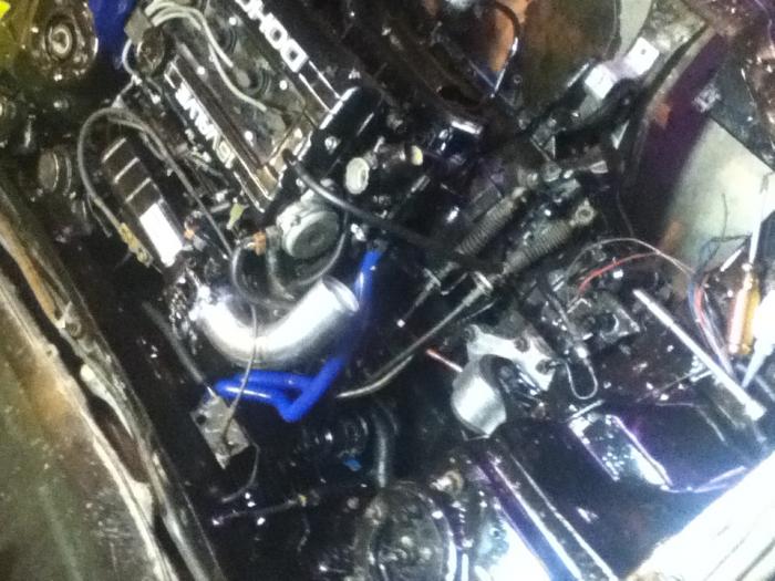

Well thanks guyes for the replies. Iv got some thing new for you. Last night we did a rower stealing tuck. We're not totally sure if ow will work but I don't see why not check it out let me know what you think.

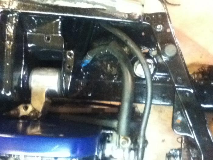

We ran all the soft lines in the wheel well and gig rid of that dumb power steering cooler.

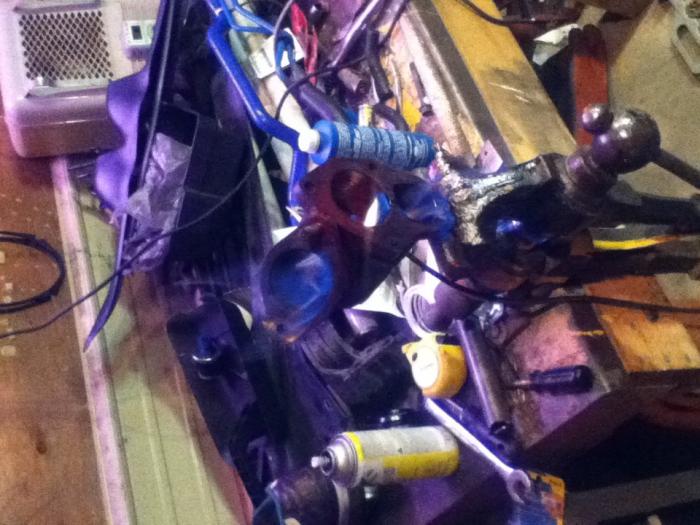

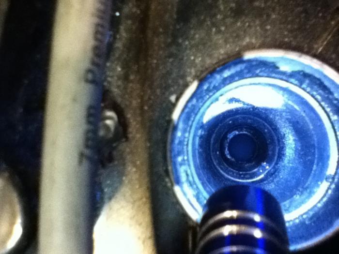

Just as things are starting to smoothly we run into a supper stubborn bolt in the o2 housing so we had to burn it out but we had no torch or any thing so we used a little gas to get it heated up enough to tap some new threads into the stud.

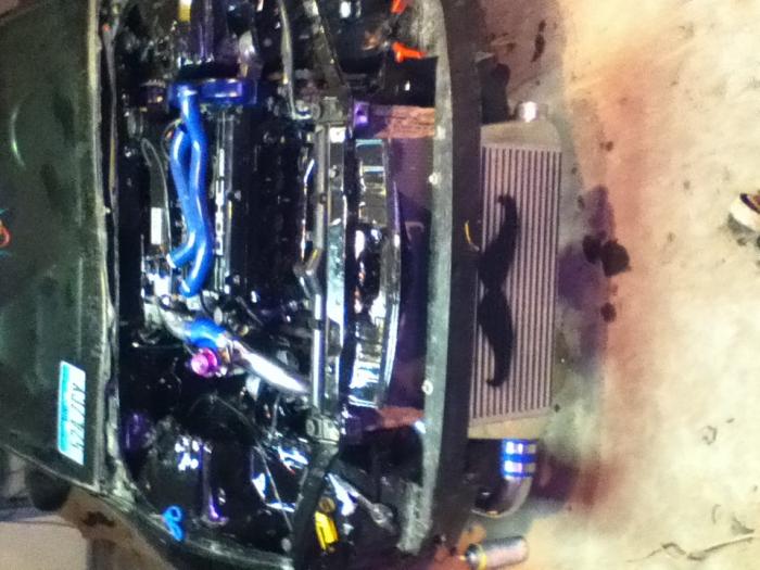

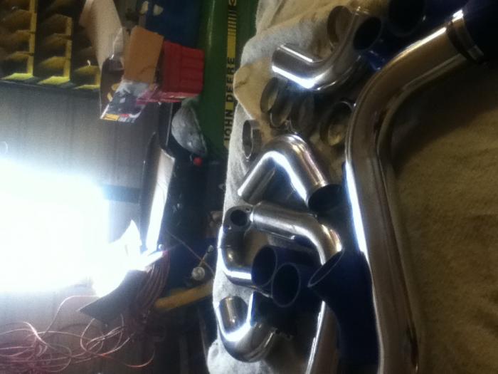

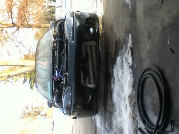

Got the turbo and the fnders put on. I also did a little modification o my inter cooler. :D introducing Sir. Luke Crankwalker

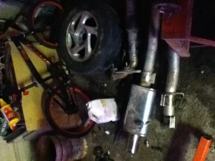

That's the old hacked up one coming off Adams a little stumped he's got one end stuck on the drill press and the other under the car.

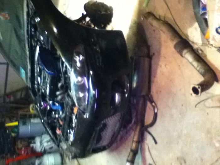

We worked on getting that pesky exhaust out in turns out we were missing the cat and luckily the auto parts store stocked a piece of pipe that was the right diameter and length :thumb:

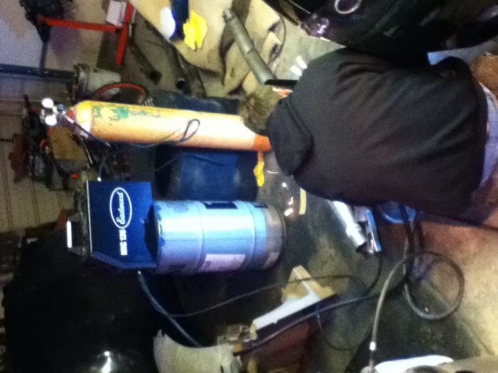

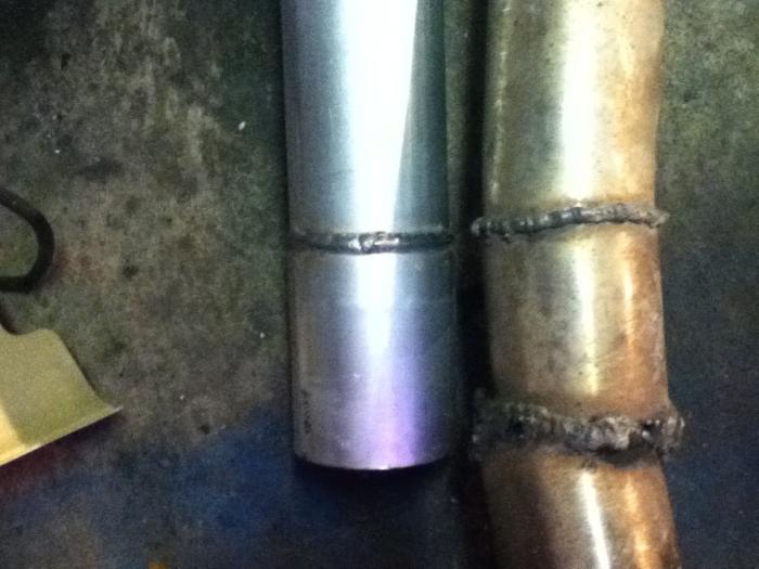

My buddy Adam did all the welding the pipe on the right came off my car gas was not used on those welds. The left is what went on we used gas this time.

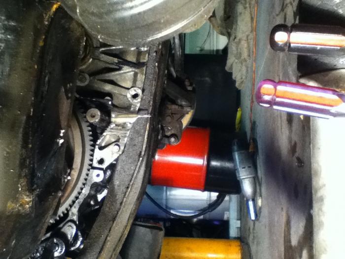

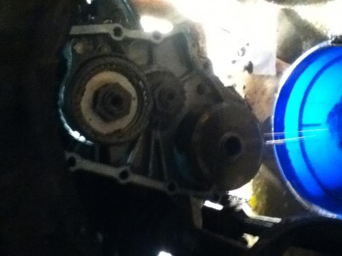

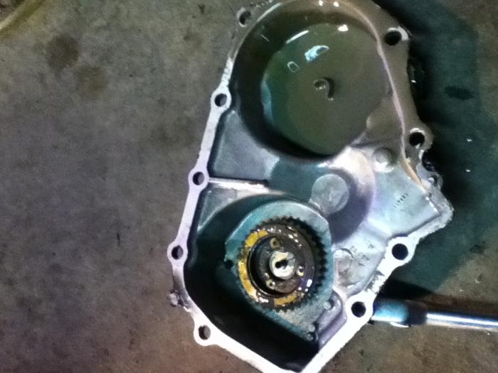

Found out I had tranny fluid pouring out if my axle seal:notgood: so after having the auto parts store order the wrong part twice I got it replaced only to find out it was my output shaft seal leaking so I took out the transfer case took out the input shaft and got the seal in I just need to put it back together.
