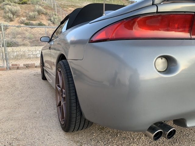

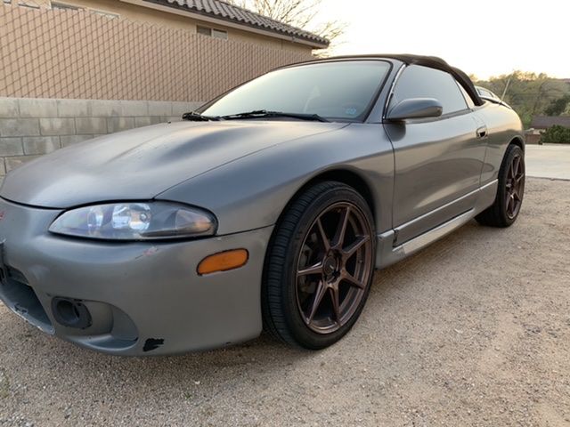

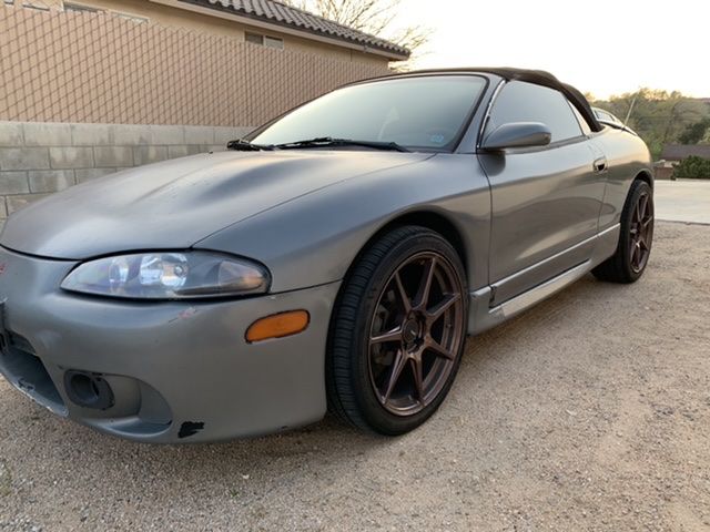

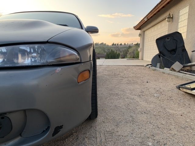

New 2G AWD Spyder build
soon to be AWD turbo
