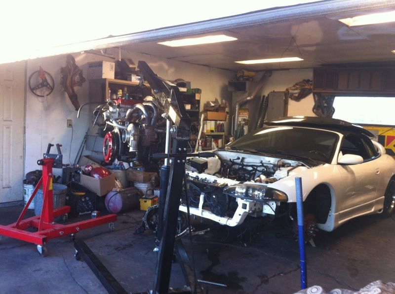

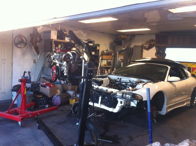

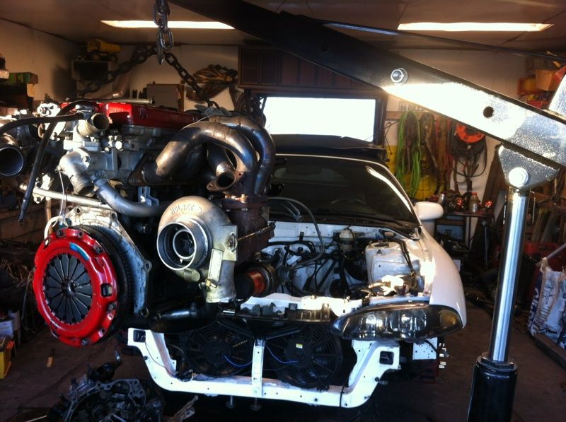

UPDATE: Got the motor out of the car.. Again... haha!! Took me two damn days. Just couldnt really find the motivation to really get going on it! Its hard to take a car apart that still runs and drives great!! Plus I hate working on a car that has a torn CV boot.. gahh that pissed me off!! Whelp heres some pics.

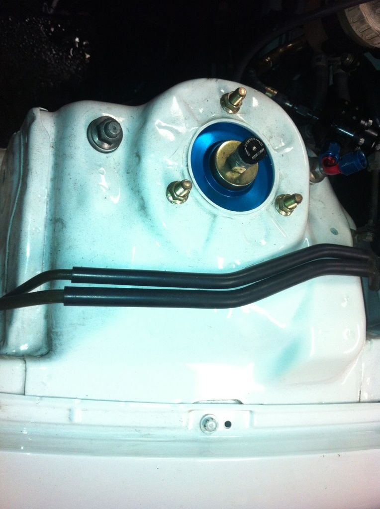

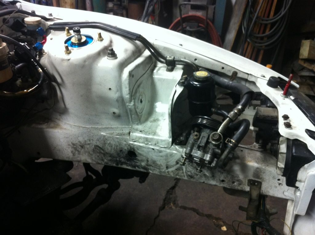

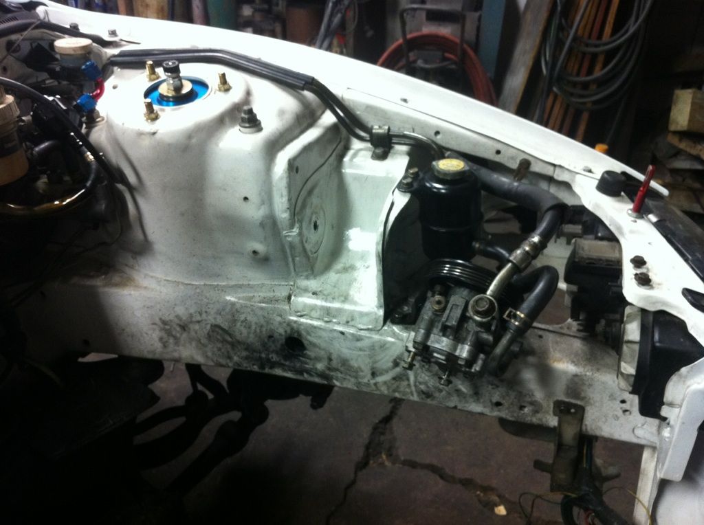

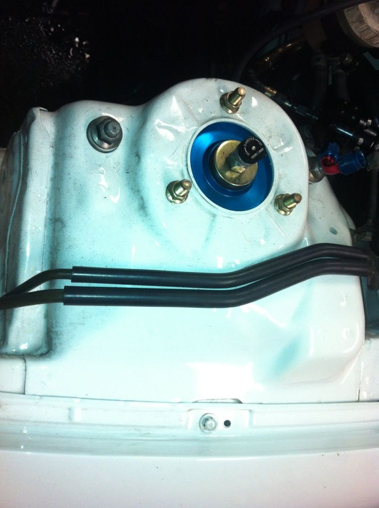

Whipped off one side of the strut tower.. Look how dirty this thing got.. grr!!

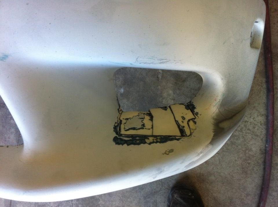

So heres whats been going on in Crash's garage the past couple days.

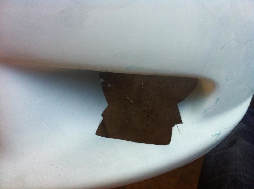

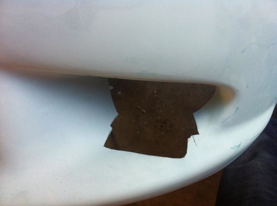

The previous owner must have cut the bumper for some dumb ass reason. It was on a N/t car so maybe a huge filter??
[URL=http://s805.photobucket.com/user/oscarson66/media/bumperfix_zps5cc6a186.jpg.html]bumperfix_zps5cc6a186.jpg[/URL]

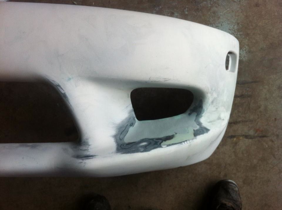

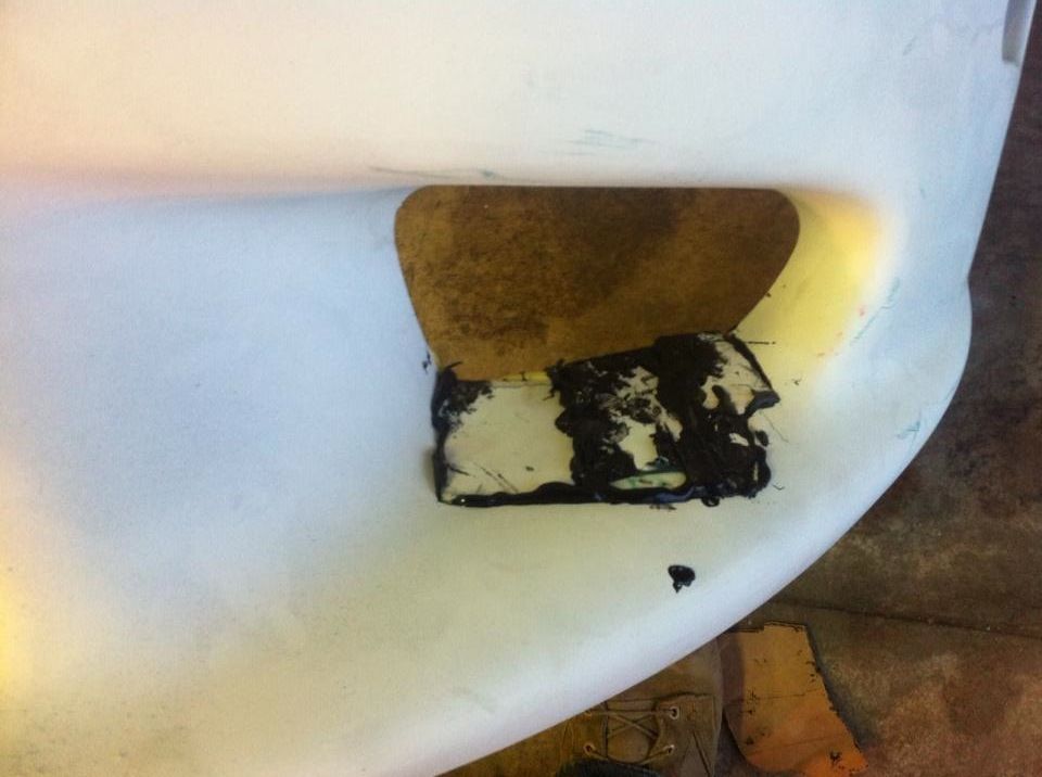

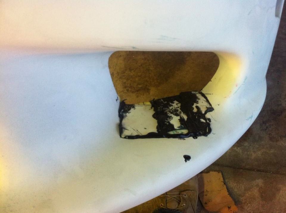

So, with the trimmings from the bumper to clear the FMIC I made three separate pieces to fill the gap. Heated and formed a little to look more OE. Use a 3m bumper repair adhesive.
[URL=http://s805.photobucket.com/user/oscarson66/media/bumperfix2_zps0e23a0af.jpg.html]bumperfix2_zps0e23a0af.jpg[/URL]
Ground down
[URL=http://s805.photobucket.com/user/oscarson66/media/bumperfix3_zps289c5925.jpg.html]bumperfix3_zps289c5925.jpg[/URL]
After another layer of the black adhesive and a few layers of some bumper repair finish mud and a bunch of sanding. Were almost ready for primer.
