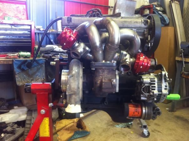

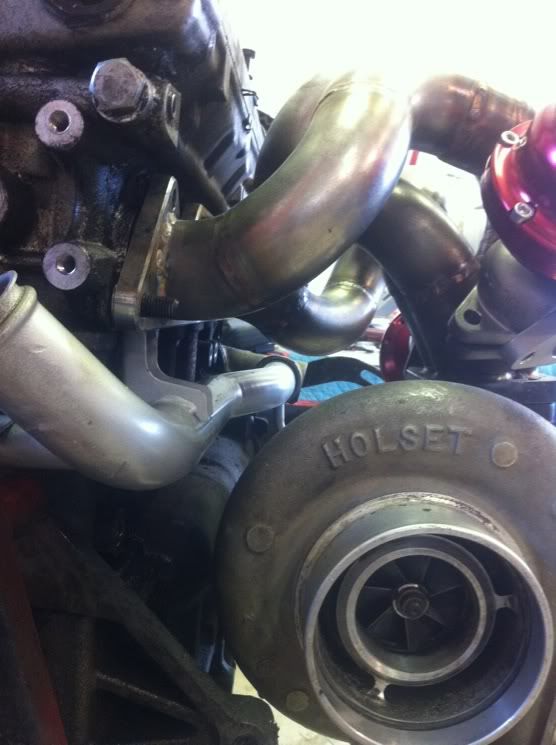

Whats going on fellas.. Started shooting some wires to figure out this damn charging issue.. Found out that one of the wires in the alt plug that is supposed to be hot with the key on isnt.. So, now its time to dig back into the harness and find out why.. In the mean time I mocked up the holset on my other motor to start making my dumps and exhaust..

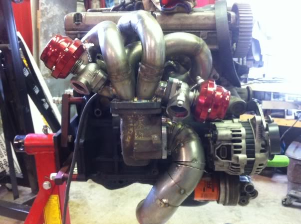

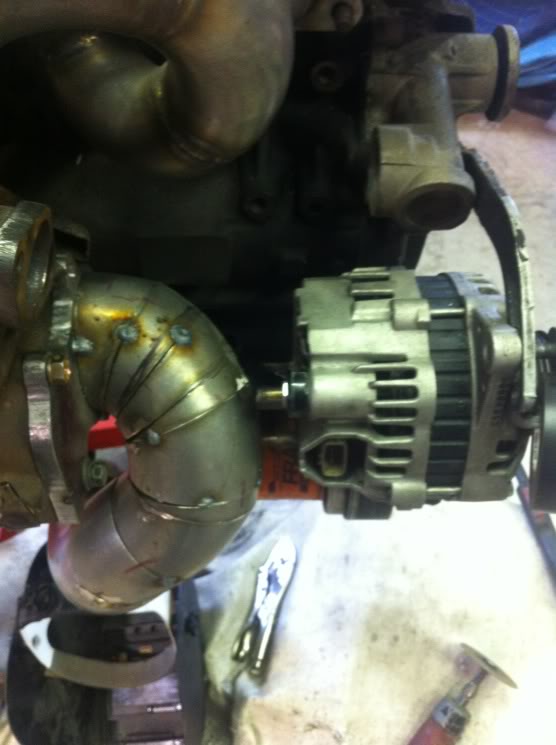

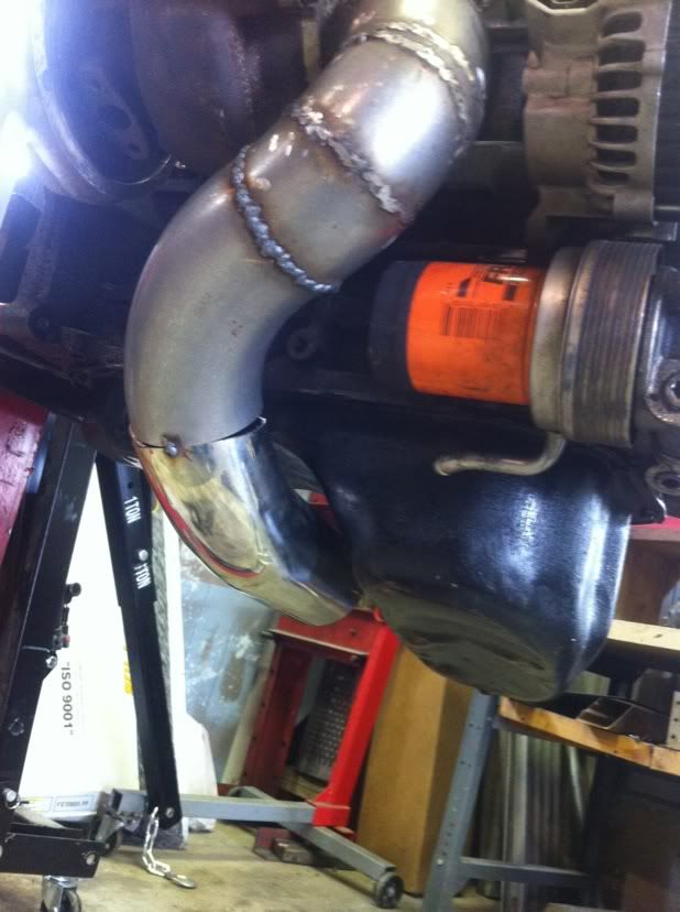

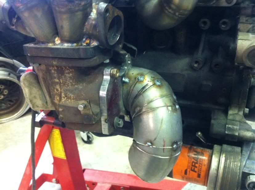

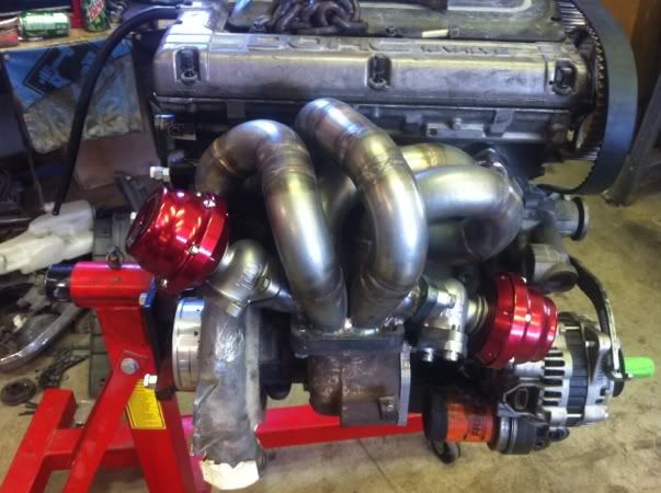

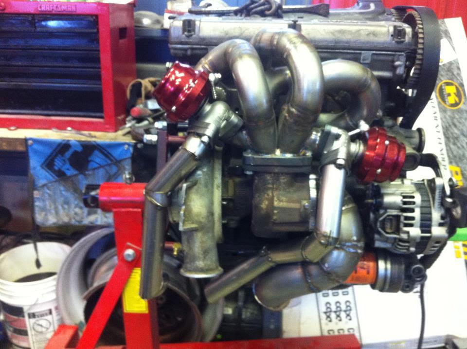

Hey fellas, havent had a lot to update since the car has been running!!! A few little bugs that need to be worked out, but they'll get there eventually.. I finally got my 3" mandrel 90* bends on friday so I started tackin up my downpipe today.. Got my waste gate flanges and pipes for the dump tubes ordered today too.. So, as soon as my downpipe is finished I can start on those then slap this beast on!!

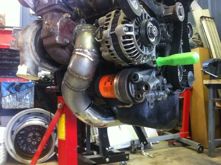

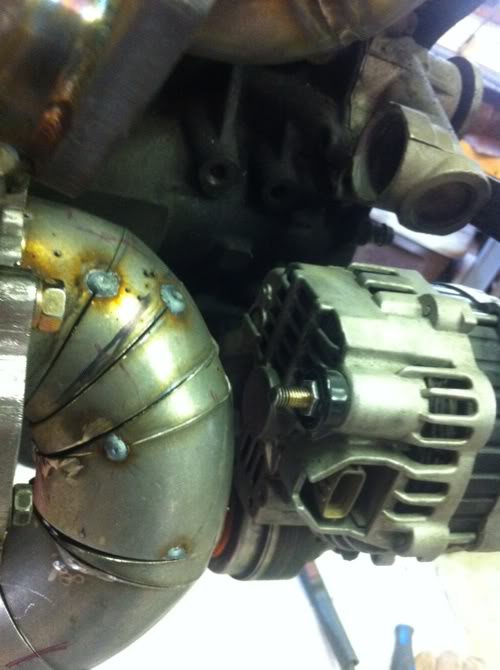

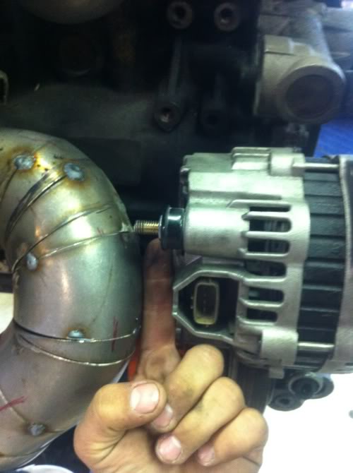

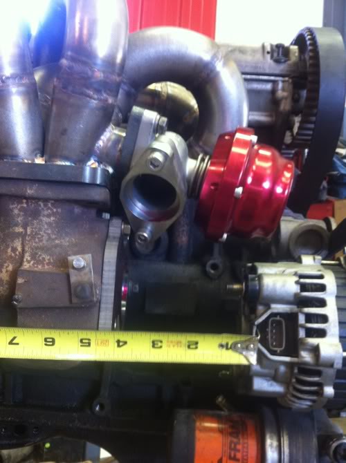

Thats what I forgot to take a picture of, damnit!! Id say an inch or more. I never got to really measure it, thats just an eyeball guesstimate. definitely more room than there is between my wastegate now on the 20g set up! I can actually move the alternator through the whole adjustment range and not even come close to touching anything.. Ill take some more pictures tomorrow!

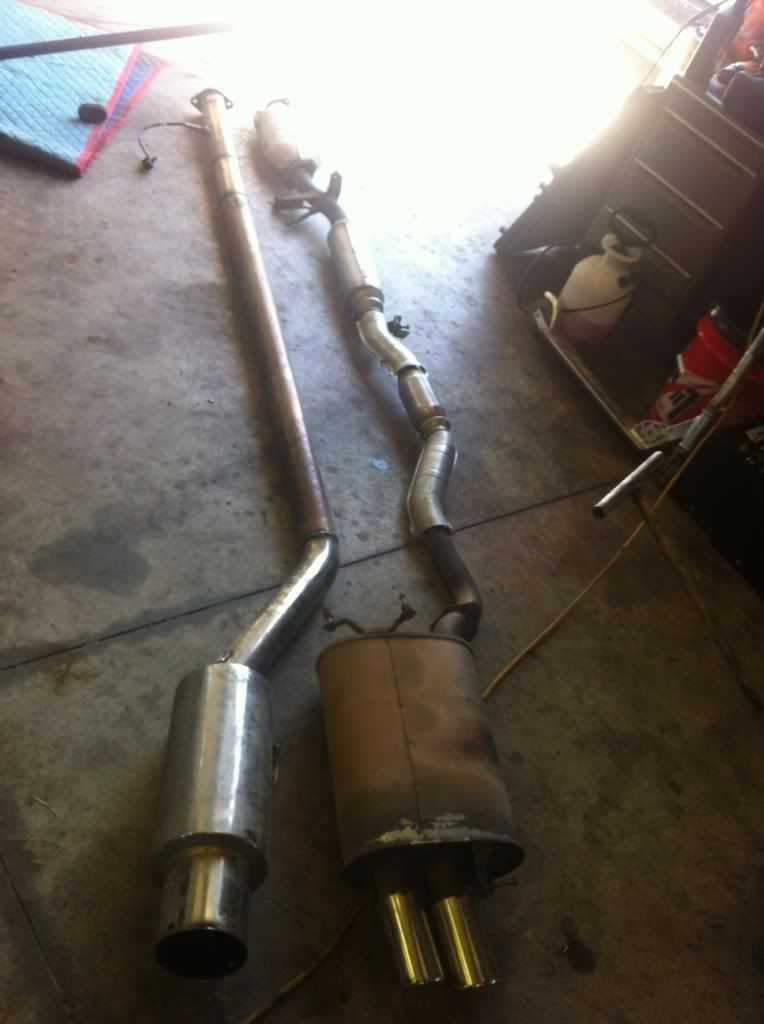

Hey did you guys weld your own Vband things on your guys' exhaust?? Im thinking of it.. Or just going until my first set of hangars and putting a turndown and saying ef a full exhaust! haha
Go ahead call it a racecar!! haha Kenny is the only one who argues cause his IS the racecar! :p
Hey where did you get your vbands from?

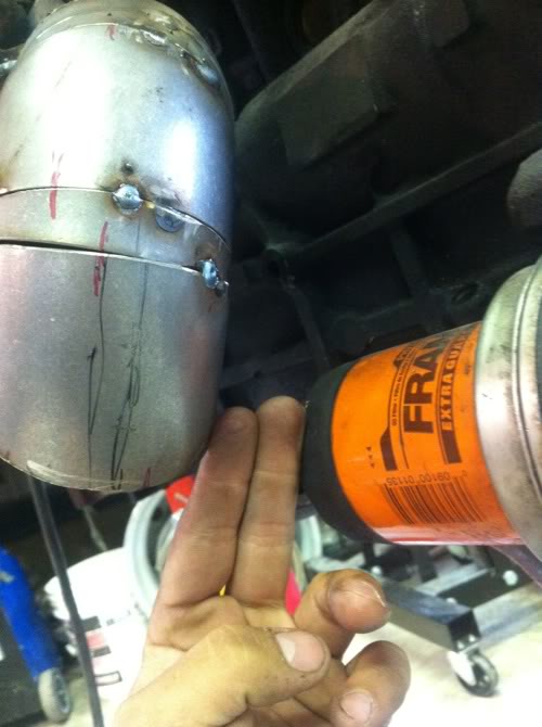

I rotated one of the pieces slightly and made a little more room for the filter!

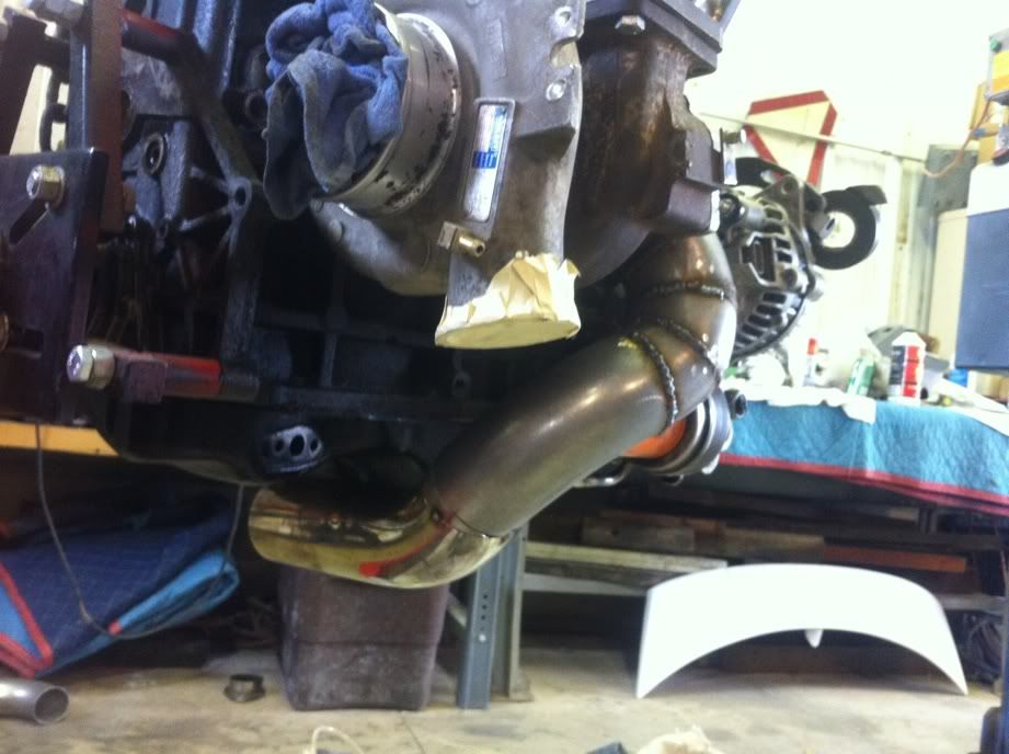

A couple new pieces

From the back

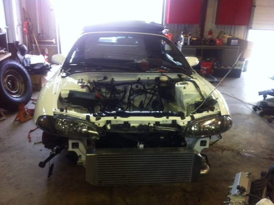

Im sure I will have to do some more cutting and adjusting to make it right, but at least I have an idea where I have it going now. As of right now Im pretty sure the LICP will not fit, that the dp is coming forward too much. Ill have to adjust it over and in some more. We'll see.
My car is a streetcar!! Don't forget to weld in a bung for your wideband. Also wrap your downpipe or your alternator is going to hate you.

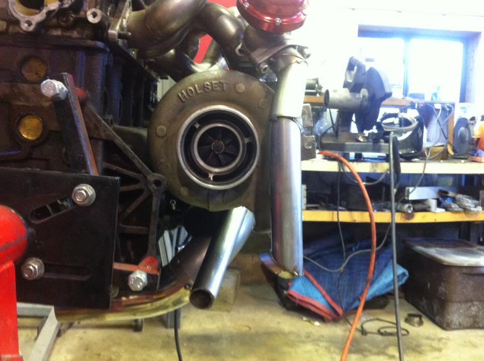

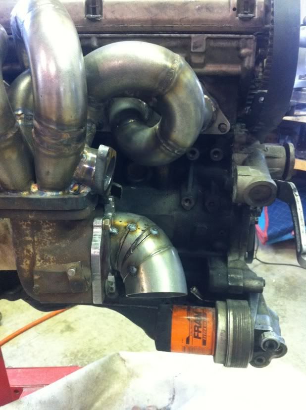

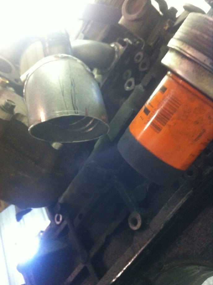

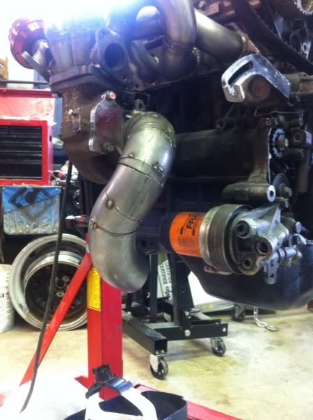

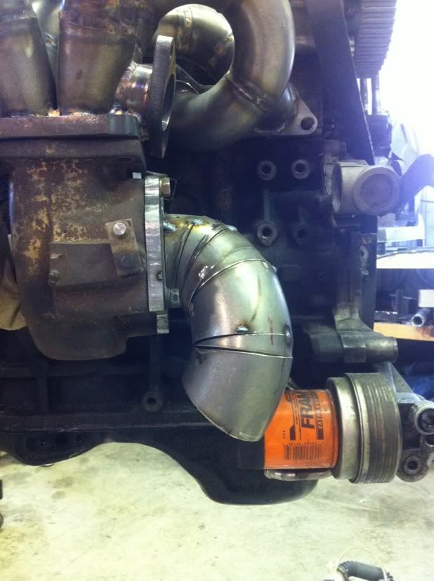

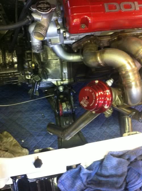

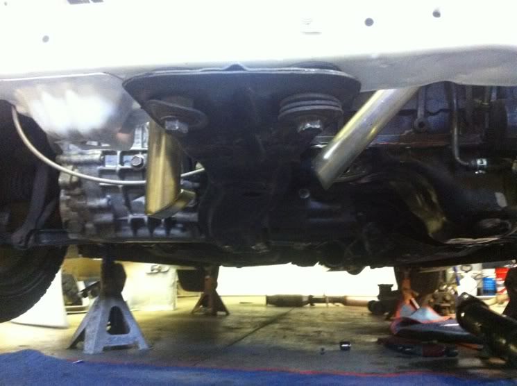

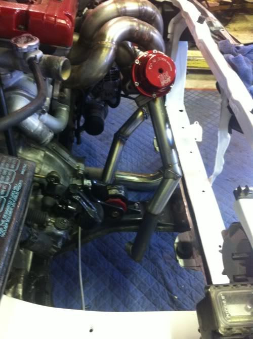

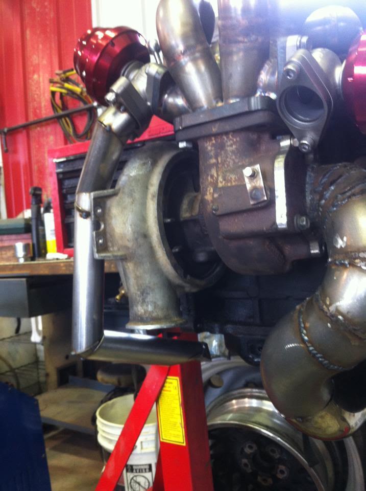

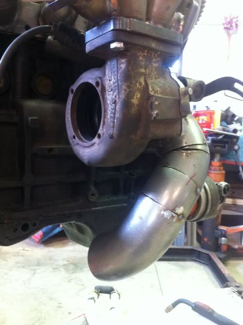

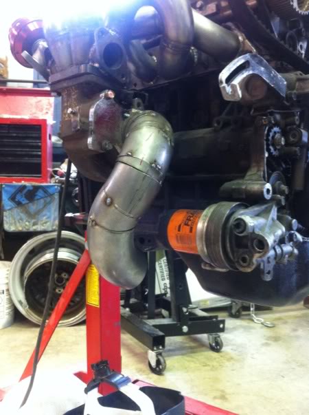

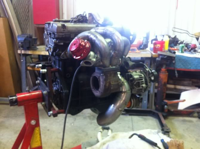

Hey guys, started fabbin up my waste gate dumps the other day.. Everything looked all gravy until I realize that the front roll mount is where it is.. You'll see.. I have to make a couple changes.. PICS!!
Dont knock it, Im still learning! :p Im a dumbass and didnt order any 90* bends of this same diameter.. :ohdamn:
I couldnt run the passenger side dump under the turbo like I wanted due to the IC pipe and oil drain..

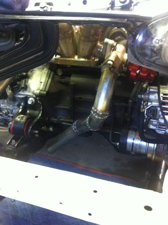

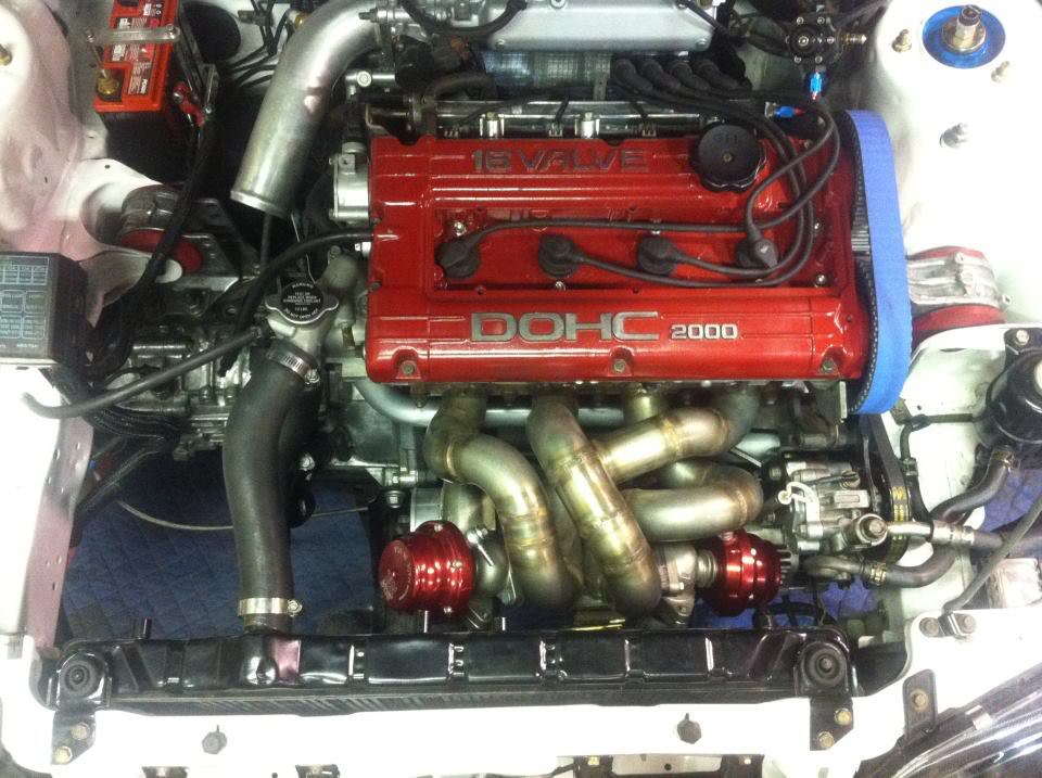

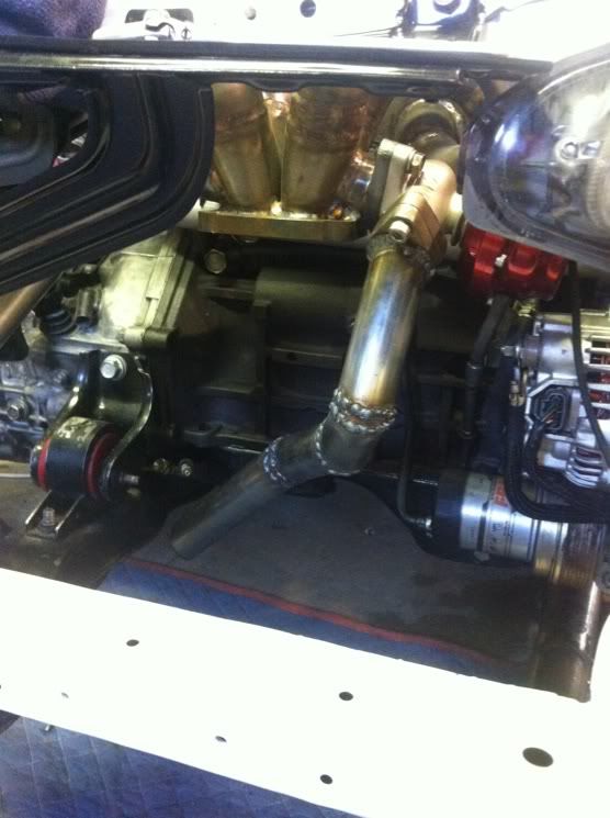

Bolted it up in the car today! I left everything all tacked together just incase I had to change some things.. And Im glad I did because the passenger side one was dumping right on the mount.. I didnt get a pic of it though

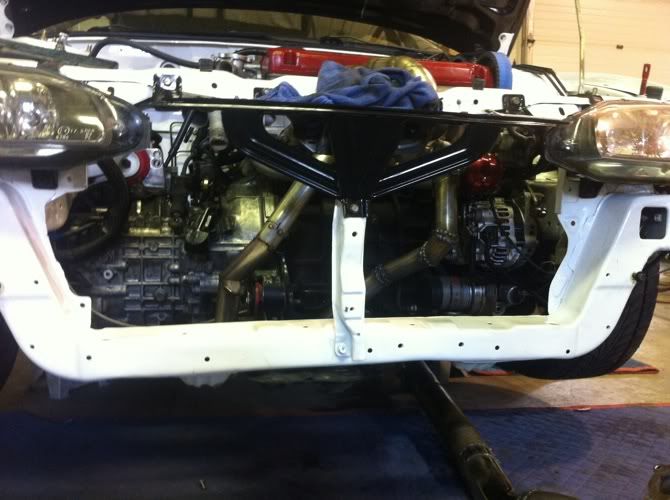

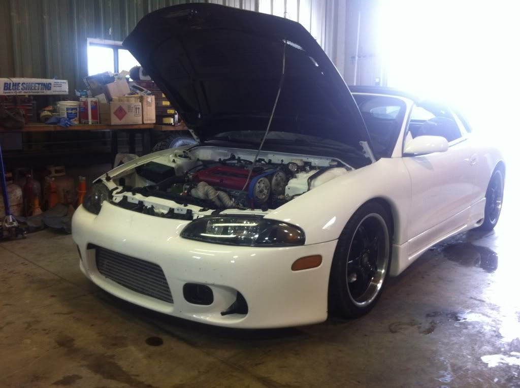

Been a while since I updated this so heres some pics!!

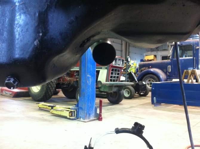

Fixed my exhaust burning my bumper things.. Stock vs Mine!

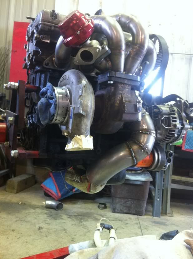

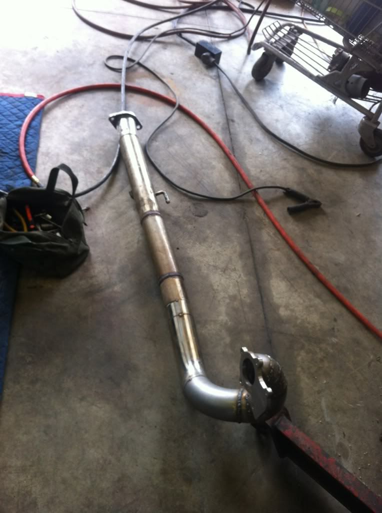

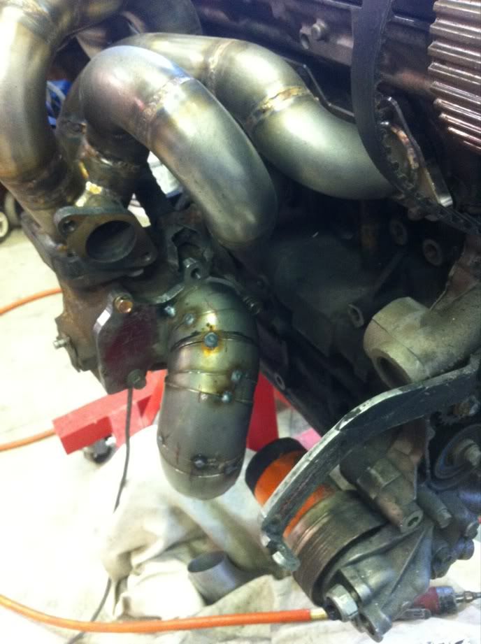

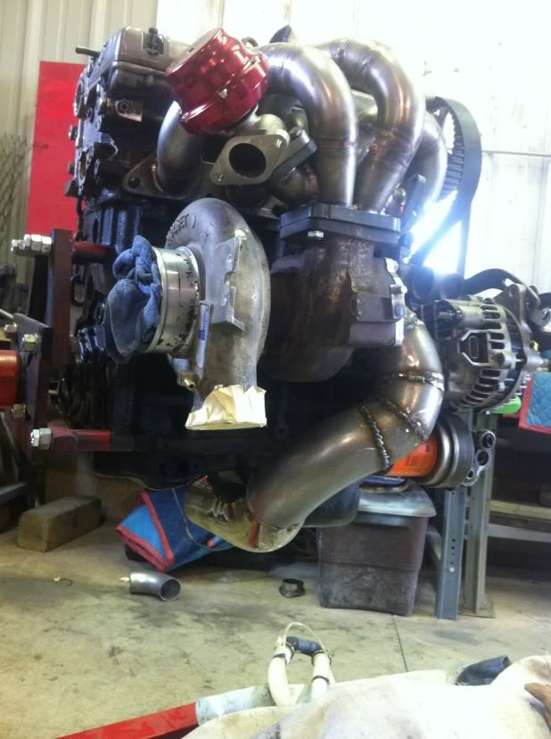

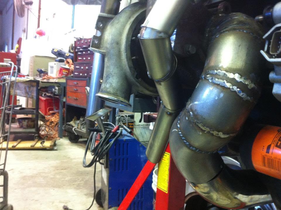

Got the DP finished.
Got everything final welded and heat wrapped and installed last night.. Then with only the oil drain line to bolt up I realized that I didnt weld in a bung for the o2 sensor.. soooo everythings got to come back out today!!! YAY!

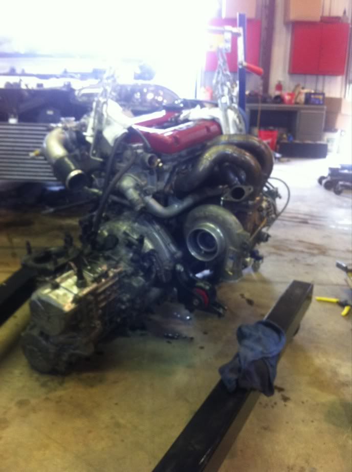

Hey fellas, thought I should update this. As of tuesday night the motor had 800 miles and spun a rod bearing while dialing in the Hx35. I guess 23 psi was too much for my forged bottom end and ACL bearings.. FML!! Anyways this is how it sits as of yesterday..

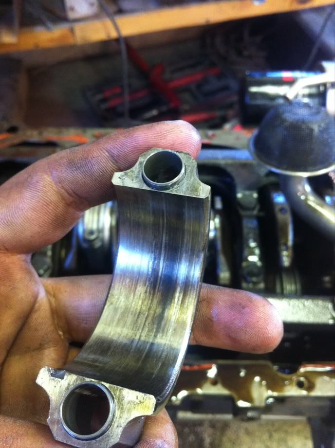

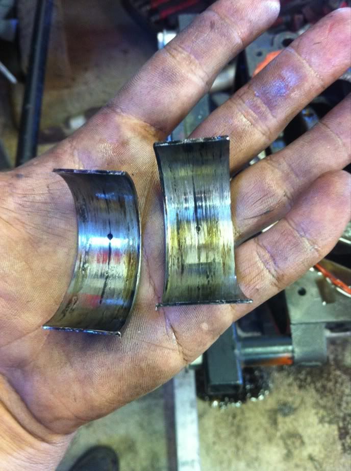

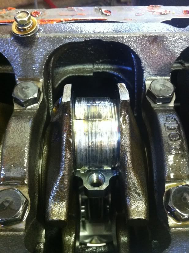

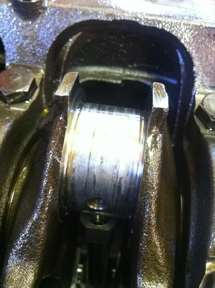

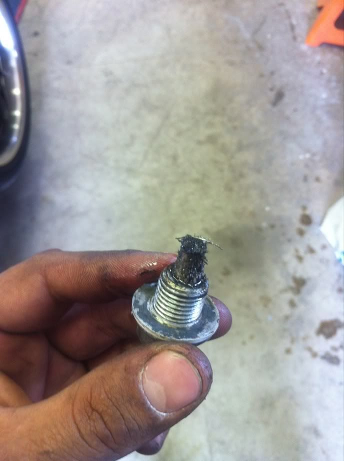

Hey guys, last week I was positive I spun a bearing in the car. Well yesterday I was able to actually inspect the bearing. Yup sure did. Pretty damn bad too. The video was right before I started tearing the motor out.. Pics are just from yesterday..
Car is back up and running on the stock short block with all other mods.
[/URL]
As I took the rod cap off
480255[/ATTACH]"]
Rod cap
[ATTACH=full]480257[/ATTACH]
bearings
480258[/ATTACH]"]
Crank journal
480260[/ATTACH]"]
Ok, not trying to be a douche here.. This is a real honest question, why do so many of these engines get rebuilt only to spin bearings within 1k of driving? Did you do something wrong?
NO! :cry::cry::cry::cry::cry::cry::cry:, and some more, :cry::cry::cry::cry::cry:
O.k., got that out of my way and yelled outside, I haven't checked up on this and you in awhile, so I feel super bad that this happened! Anyway, Good luck on the rebuild once again & have a quick & easy recovery. :pray::pray::pray:
To the post above, many rebuilds fail on the first 5k or less for only very few reasons, "Clearance", "Specs", and obvious little things. If you do not check, double check, and check some more, than it will happen to you period.
I really dont have a direct answer to that pertaining to my situation. It could have been a number of thing. Although I did take as many precautions to keep everything clean as hell (best I could, I mean Im not working in a damn bubble) clearances were spot on as per the maintenance manuals along with the 4g63 specific book I bought.
Now, the only thing I can think of would be that I did use a used crank. Perhaps that journal was worn or not round. Hell it could have been perfect and I somehow got some contamination in it during the build.. IDK..
Im one to learn from my mistakes. This is a lesson learned.. I wanted to build the motor myself. If it worked awesome, if not, well then I needed something to improve on. Now I have to get a new crank, bearings and another Eagle rod.. Oh well shit happens.. This is why I kept my spare motor intact.
