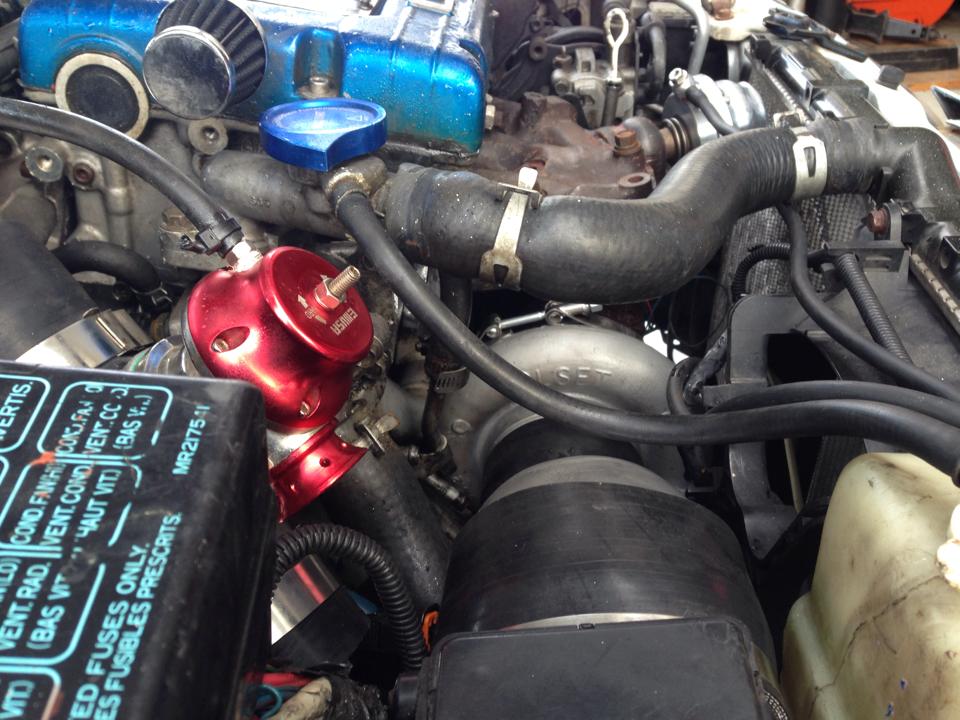

I traded a Browning 22 Lever Action for this car, it had a shredded timing belt (looked to be a cheap one). Also didn't have a turbo, manifold, intercooler, or intake pipe; but it had no rust, which was key.
The Freak Of Nature died recently, so I had a lot of parts laying around, pretty much everything i needed to finish the car. My buddy Joe donated a Gates Racing TBelt, Aeromotive AFPR, Fuel Lab Filter and lines, a stock manifold, and a Tial Wastegate (all used) from his pile of extra parts.
Parts used so far for the build:
Stock manifold

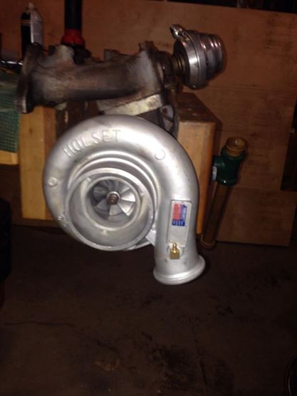

Holset Big HC1
BEP .55 AR Housing
Stainless O2 Housing
Stainless Oil Feed from OFH
-10AN Stainless Oil Return
FP 4" Intake
Big ol 4" Filter
FIC 775cc (temporary)
Aeromotive AFPR
Tial 38mm EWG or Turbosmart Ultra Gate 38mm EWG
3" Megan DP
3" Godsnow Catback
Punishment FMIC
EMUSA BOV
ARP Headstuds
Koni Yellow struts and Tein S Tech Springs
Exedy Stage 2 Clutch
Innovate LC2 WBO2
Wally 190 (Temporary)
9mm Plug wires

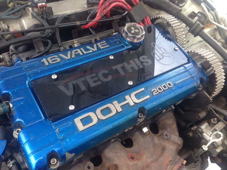

"VTEC THIS" Plug Cover (Thanks Jason Drew LOL)
Blackbox ECU
