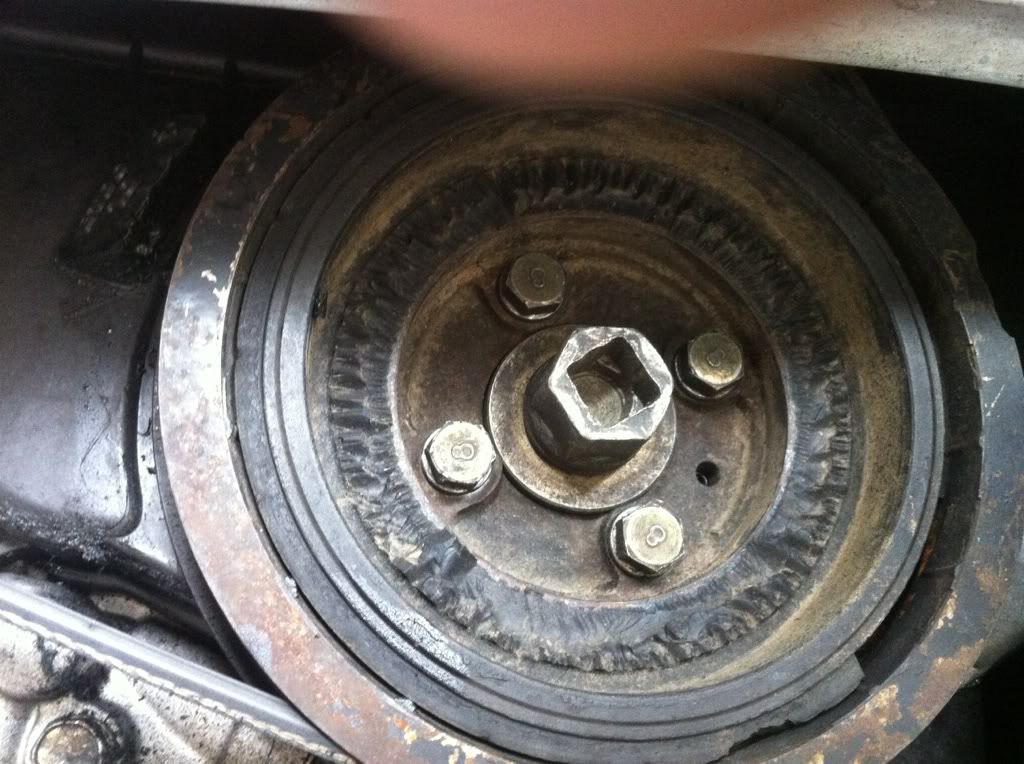

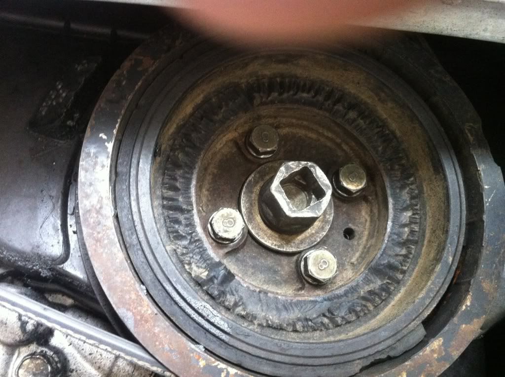

Hey fellas, I suppose I could give a little update of whats been going on.. For the last couple three weeks or so Ive been hearing a strange tapping/squeak Ive never heard before.. Coming from the timing side of the motor so I looked around a bit. Seemed to sound like it was coming from perhaps the idler pulley for the timing belt..
It started off sounding like a piece of plastic was tapping against a body panel or something similar.. Then progressively got louder and more consistant.. One day it was just too loud, I had to figure out what the problem was, only "big" problem was I was about 25 miles from home.. Heres a vid of that day.
Dsm noise from timing side - YouTube
Started to sound like a belt squeaking but not quite.. Looked down at the harmonic balancer from the top and noticed it was wobbling a bit.. Ok its just loose, nope sure was tight.. THen saw this!!
485289[/ATTACH]"]

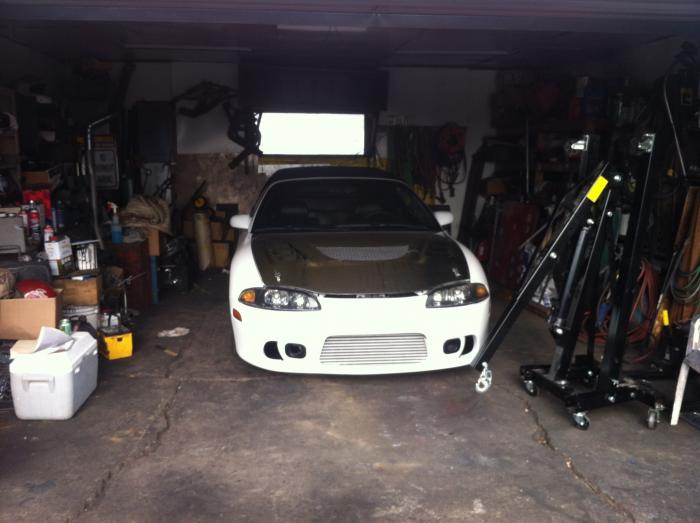

Well hey there again guys! It about time I get the Spyder back into the garage and tear into her again.. This year wont be near as intense as last years was but still should keep me pretty busy for a few weeks!! The engine is coming back out so I can clean the bay back up since I had a few oil leaks with this old block and my alternator belt was rubbing on the timing cover so theres a bunch of black junk all over the timing side of the bay. I also have a CV boot that keeps ripping :banghead:
Plans:
* Track down power drain that kills my battery in around 5 hours
* Pull motor and clean bay
* New clutch, going with an ACT2600. Buddy of mine has one that Im picking up. My 2200 equivalent South Bend apparently doesnt like 26 psi on the holset.
* Fix oil leaks and redo turbo oil drain
* Put a Vband clamp off the turbine side to my exhaust (I fight and fight to get my flange to line up with the hotside)
* Fix cv boot and make a guard to keep future breaks from splattering grease all over
* If I feel up to it I might find another engine wire harness and redo my wire tuck
* Rewire my 255 pump and drill out the return relief hole; E85 next se
* Run lines and set up my new boost controller
* Full 2gb Talon conversion!
Im sure there will be more I do and think of while I have the car apart, this is just what I can think of that I really need to get done this year.
