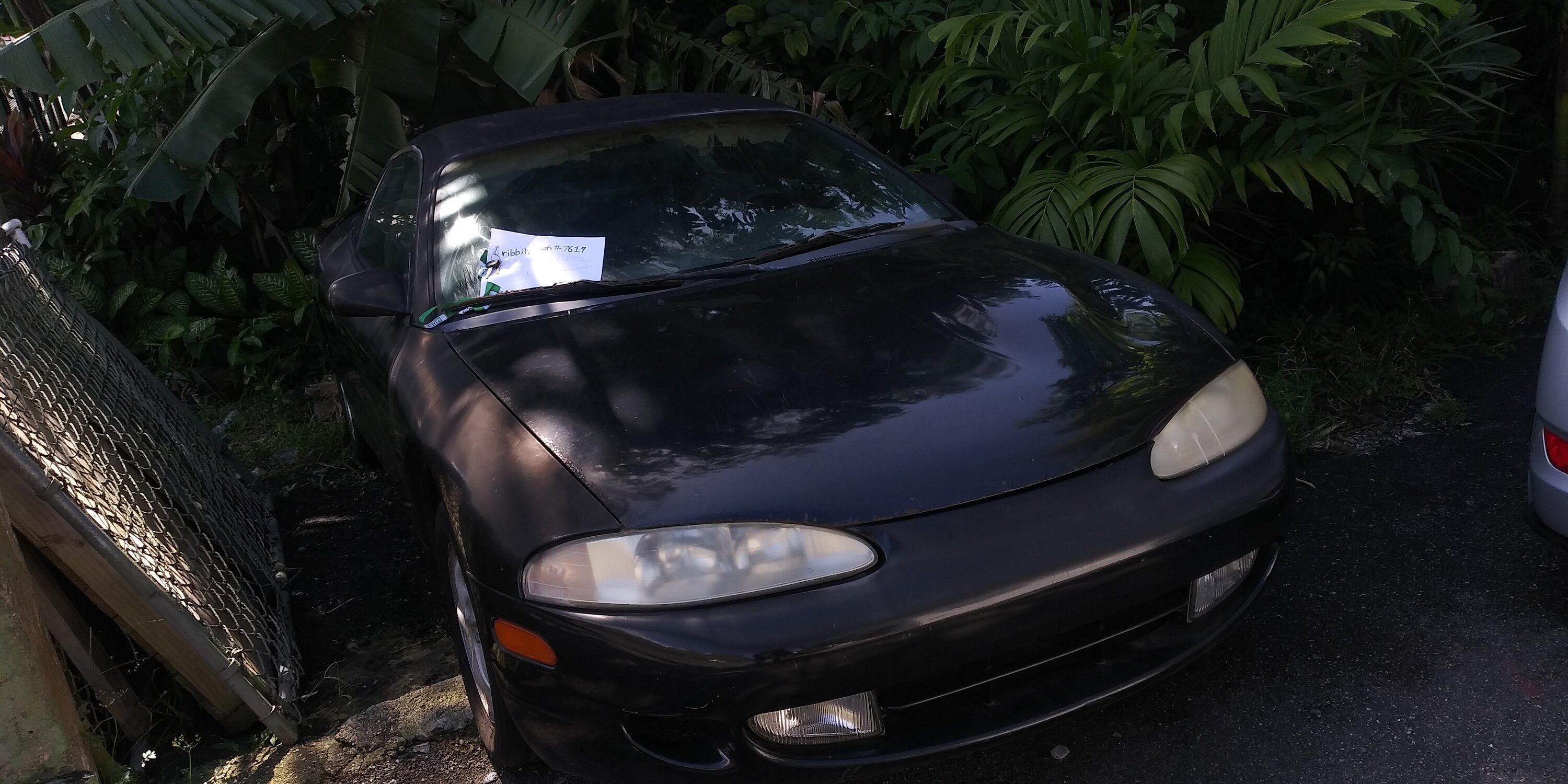

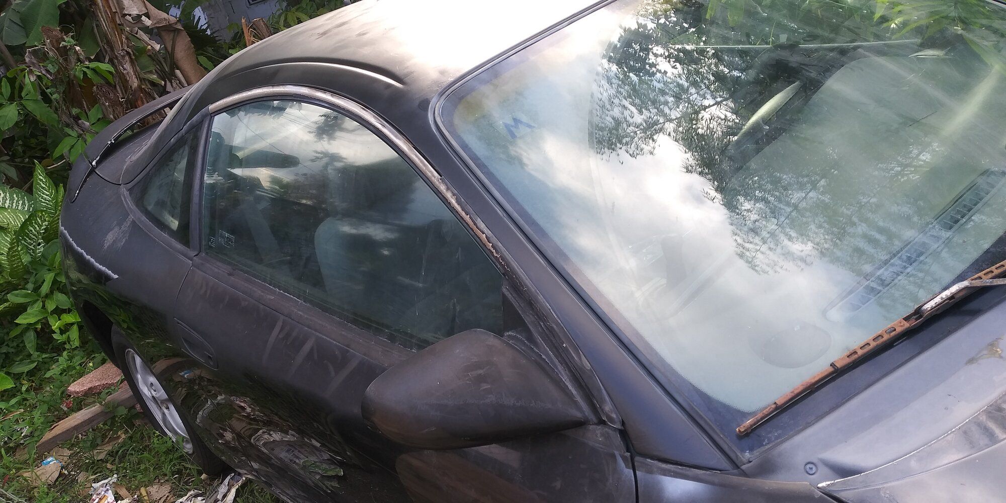

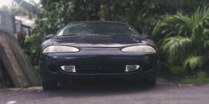

A couple of months ago, I picked up my very first car (and my first DSM you see with me) for $500. Paint was messed up, the shifting was bad, the brakes were also kinda bad as they were locked (I would say they were OP). You know, the usual. In New Year's Eve, we decided to give it a spin and my uncle broke the transmission (which was due to break anyway). So now, I'm doing a full-on restoration, and a major upgrade when I get to the States.

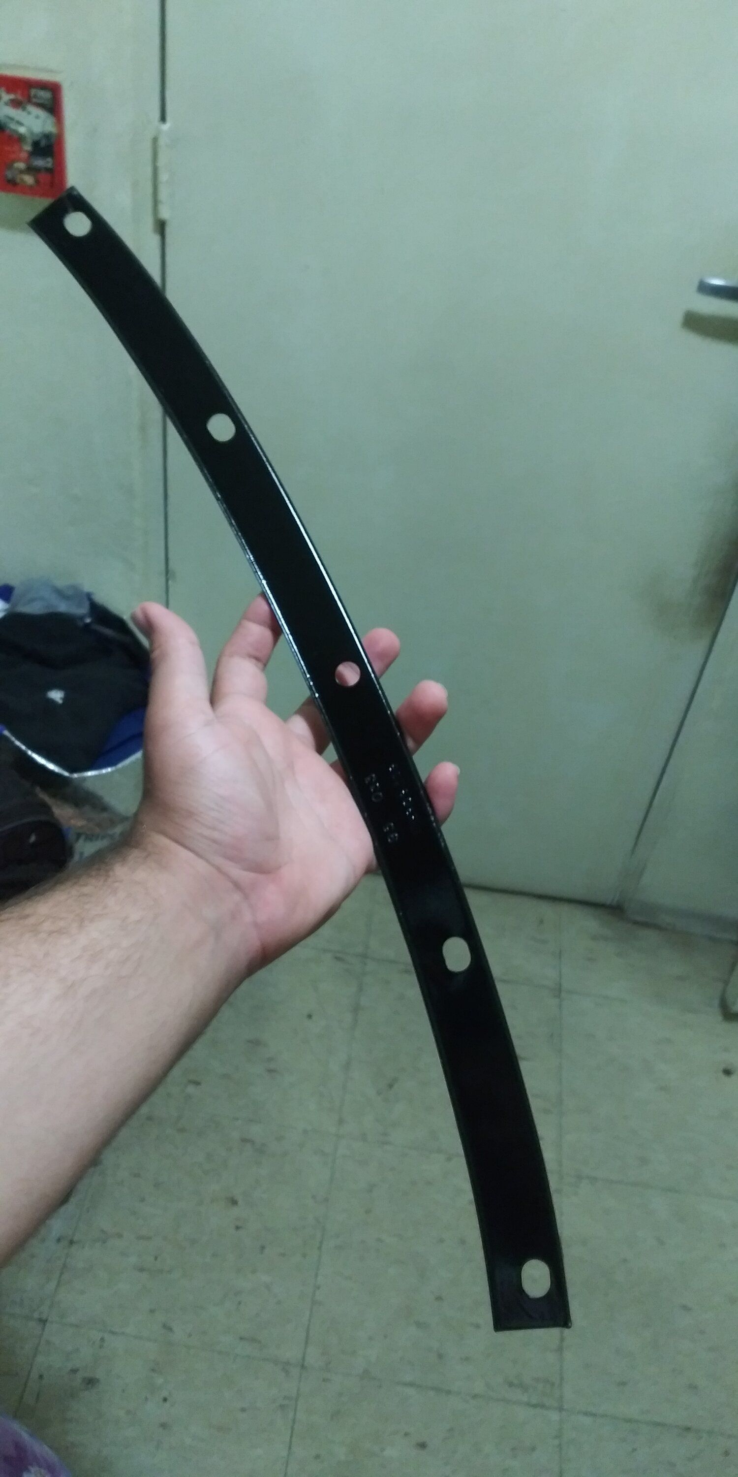

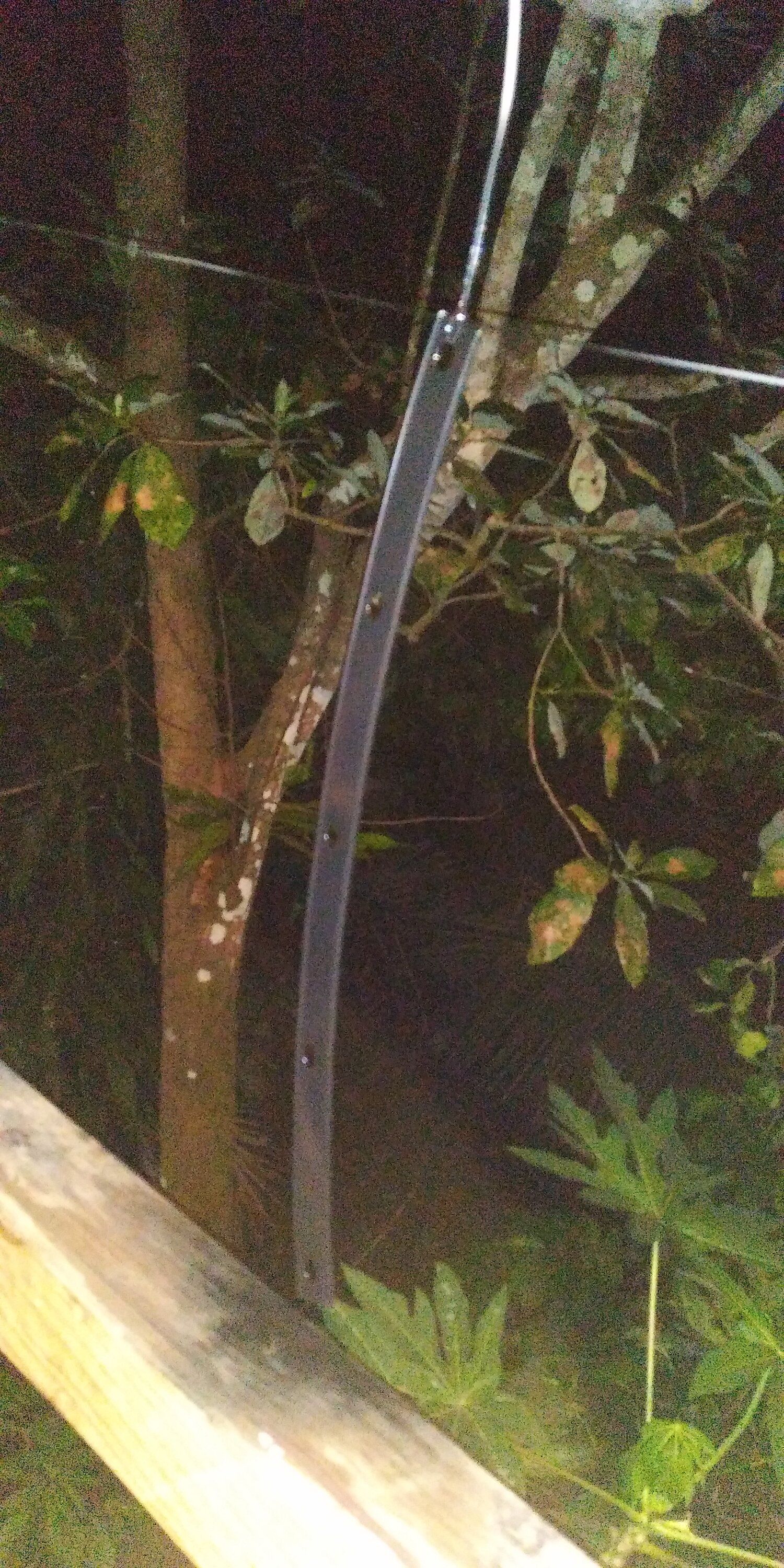

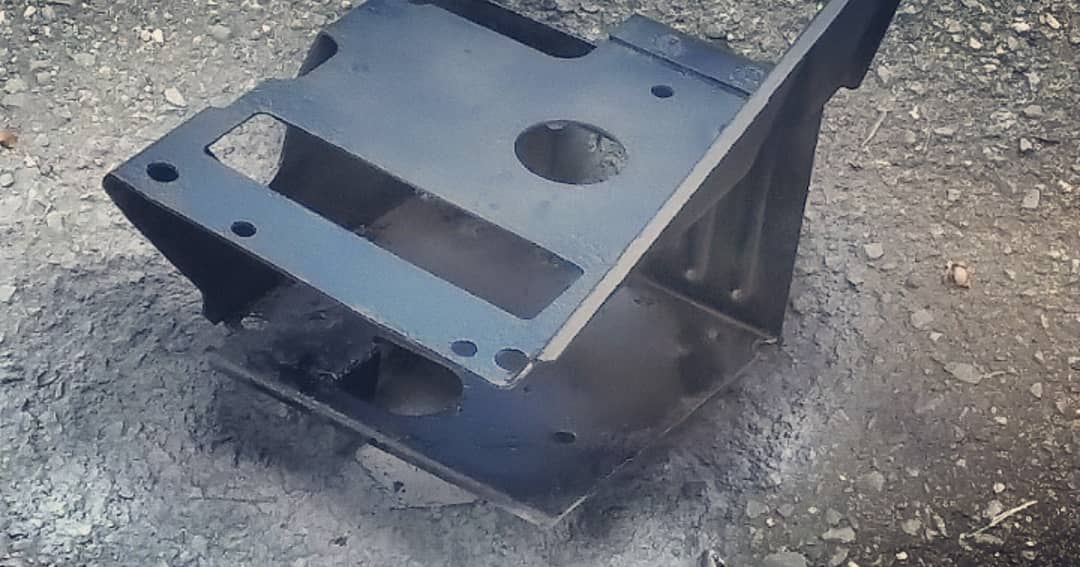

I recently got myself an idea to paint the bumper brackets last night, in which I did.
I sanded out the front bumper bracket once I removed it. It would be my first time trying to remove the pre-facelift kit from my car in favor for a more modern and stylish post-facelift kit (which looks more aggressive).
Here's how it came afterwards:
Before the clear coat (last night)
After the clear coat (just today)
It's safe to say that I managed to get this thing done. While the paint job isn't perfect (there's a side with some paint off because of the zip ties LOLLOL), it sure does look a whole lot better than when I took it off, which was looking like it has surface rust/corrosion.

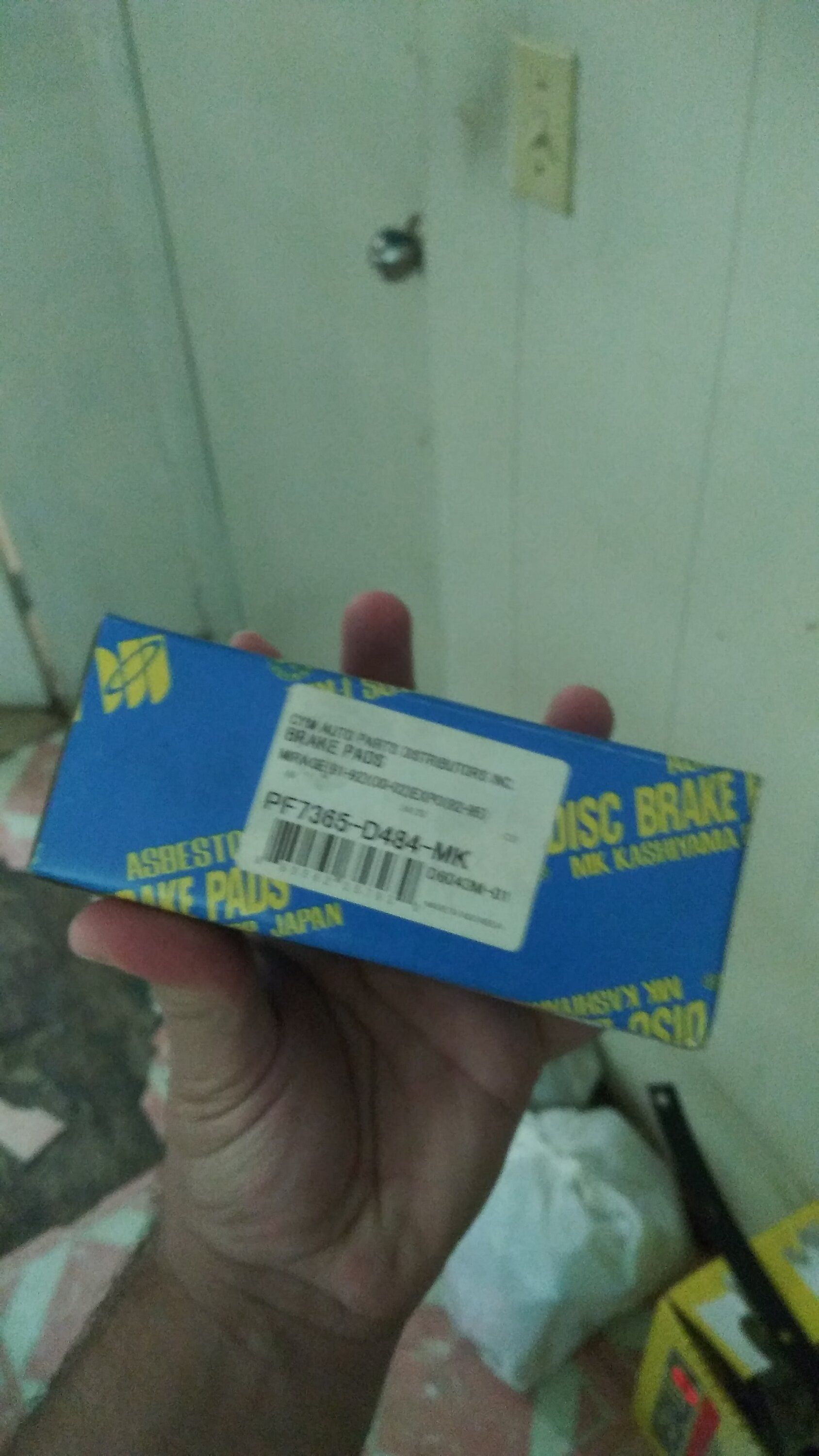

Today, I also bought some new brake pads as I have new discs, one of them fell off a ledge so I have to use the grinder (LOL), but here is the box of fresh new brake pads!

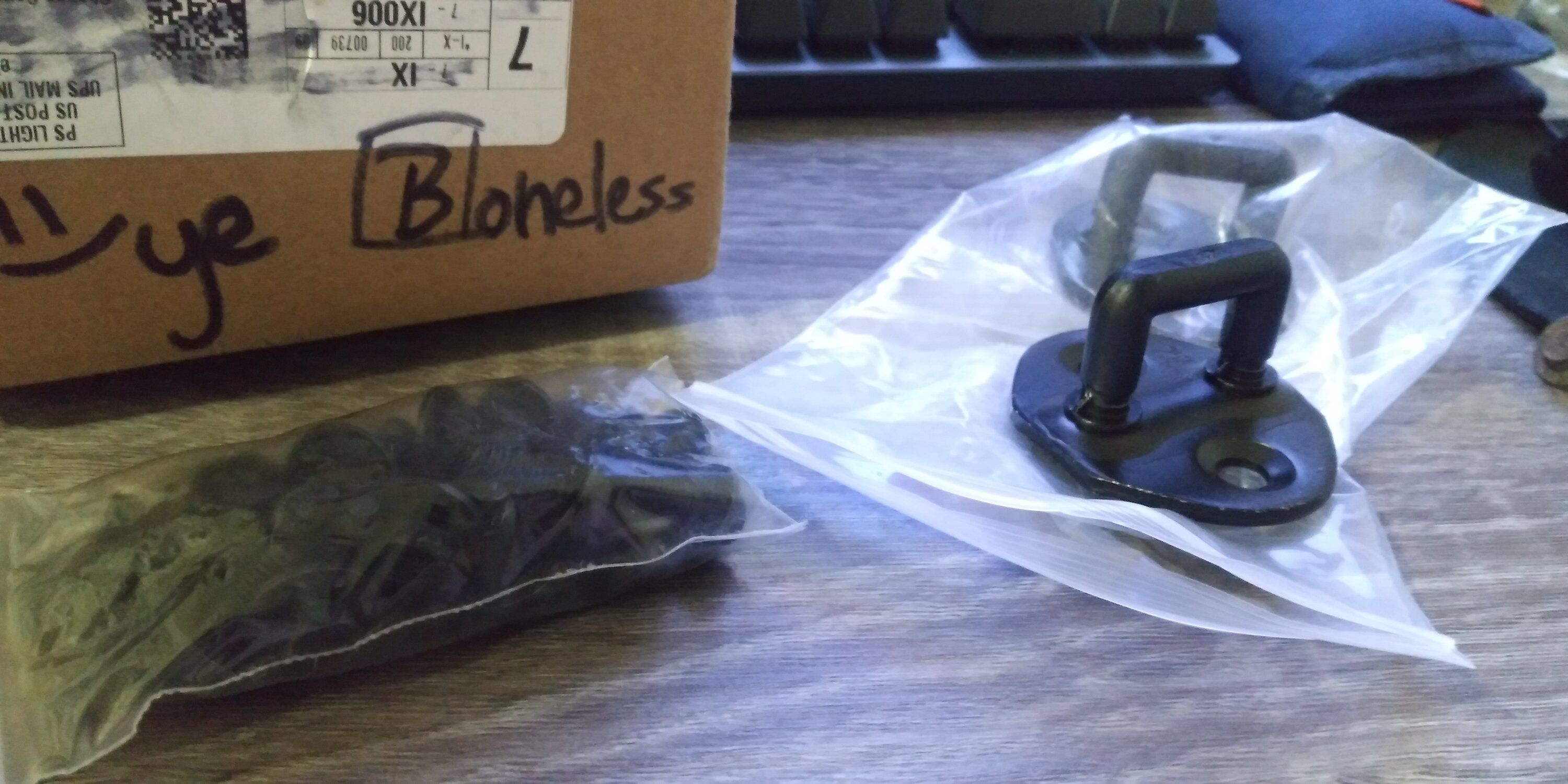

Little update for this: Just got brand new washers for the engine bay, and new door strikers! Straight from China, but it matches the same exact part number that I currently have!
The striker came in so late, I was HEAVY desperate for this to arrive.

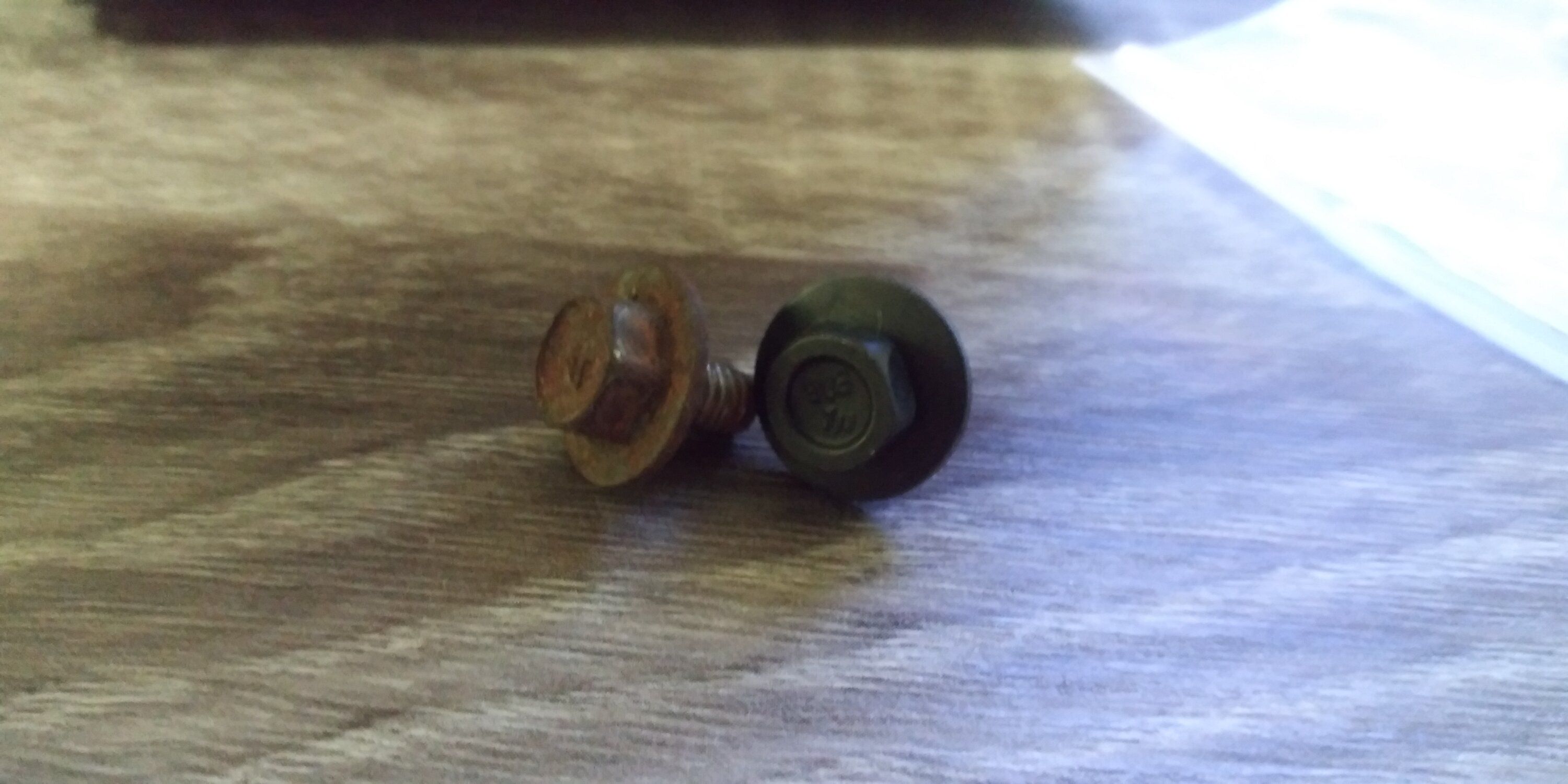

Also, I'm laughing at this. My current washers are rusted out, here's an image of the brand new ones.
(Left = Current washer) (Right = New Washer)

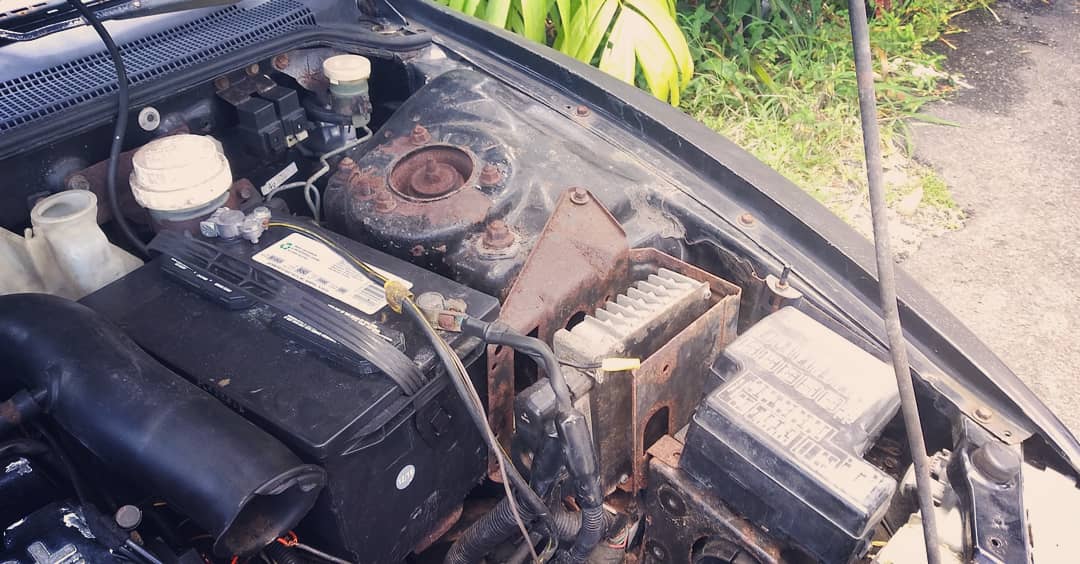

So I'm back! DSMTuners was down for the time being so I couldn't update (follow me on Instagram if you want to see more updates). Anyway, here are some updates.
On my birthday, I decided to buy some materials. Sweet. I bought liquid rust remover, and universal primer + paint spray cans. With this, I should be able to stop the rust from spreading to the car.
Here are some pictures of the primer since I used the grinder + wire brush attachment but didn't get any pictures.
The computer slot has disappeared however I was trying to fix it. Excuse the fact that my old mats were there, I didn't have newspaper LOL.

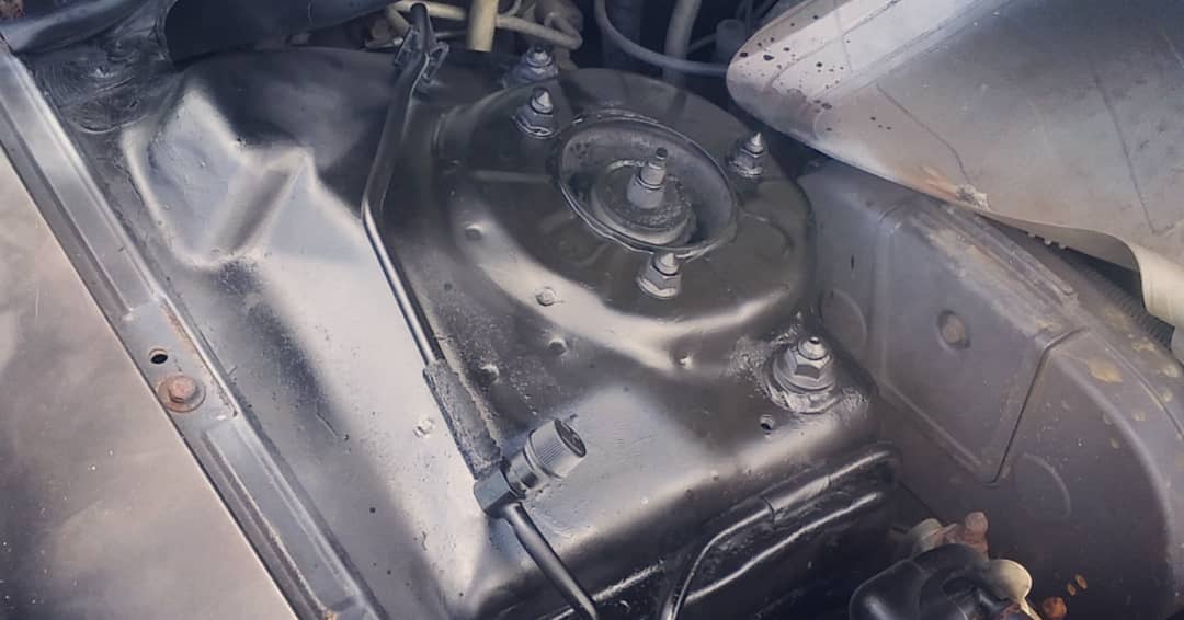

Work has been done and complete on the left strut tower!!
And so far I repaired this. I will get to improving the rust removal on this later on. For now, it looks good to me.

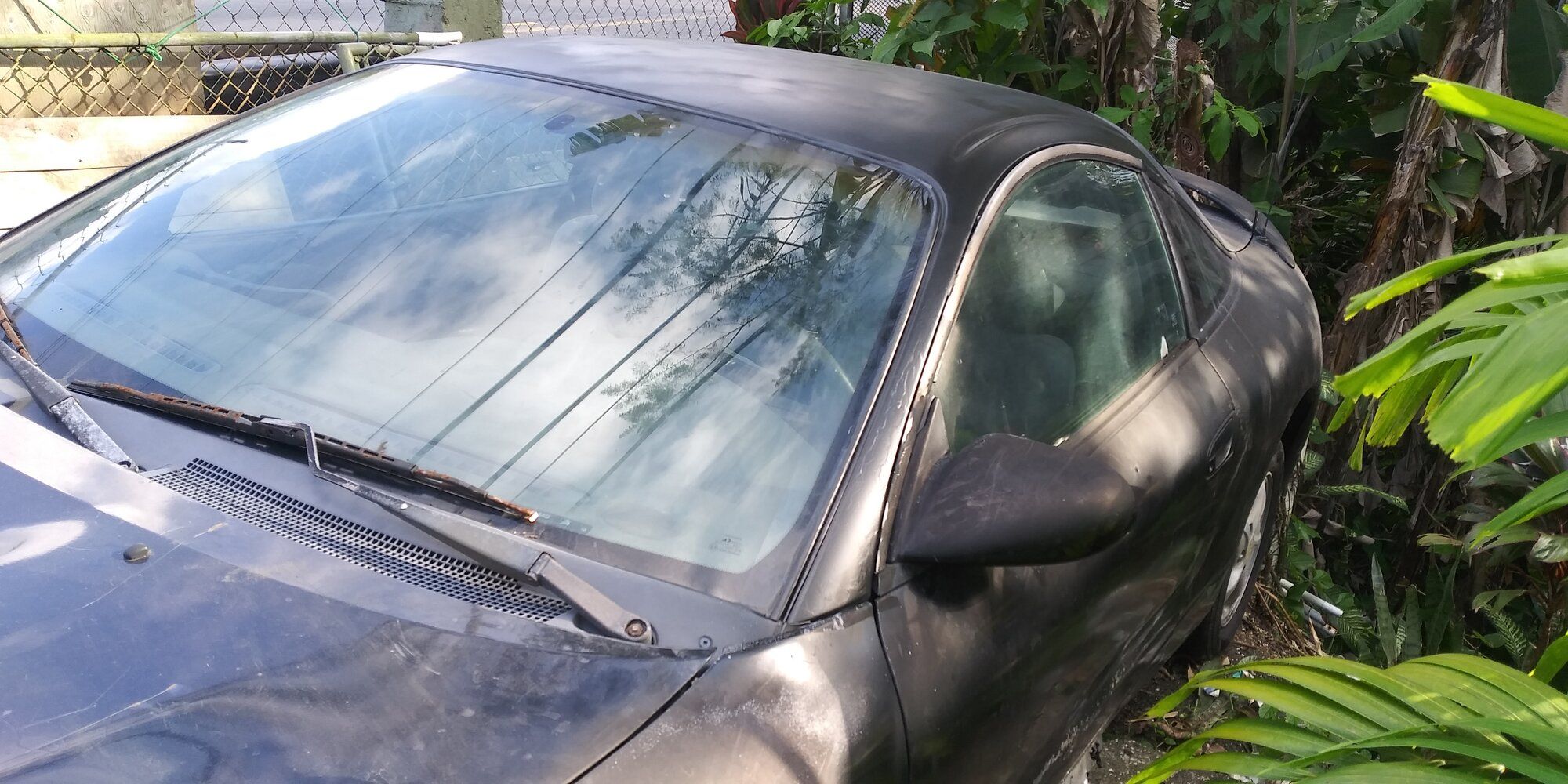

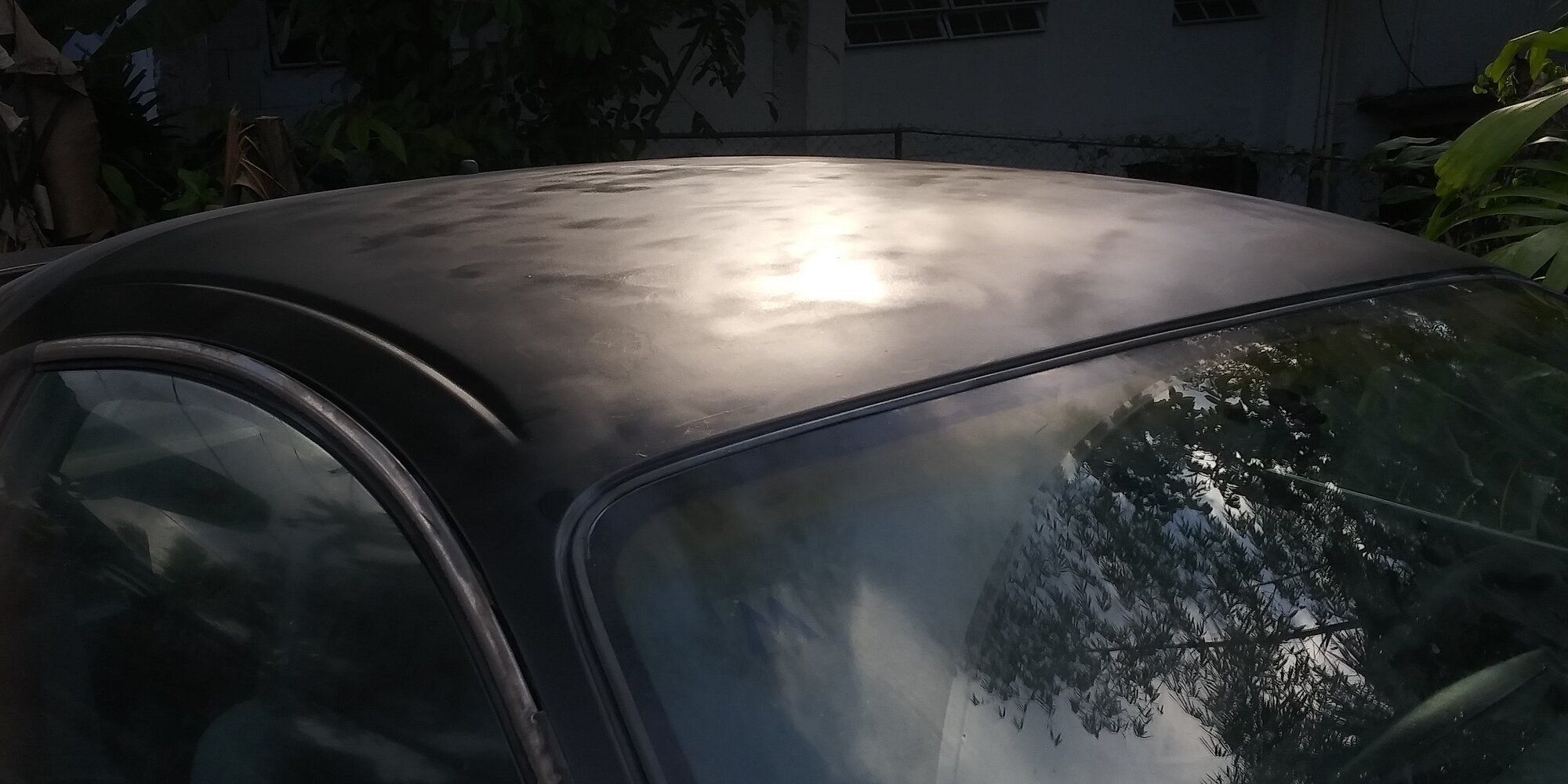

It's been a few hours. I stripped the roof to bare metal , and I began to prime it. I ran out of primer from the engine bay job, so I might have to re-do the whole paint setup once I go to the paint shop and buy more primer and paint, once I get the call to pick up the new water pump.
No clear coat for now, as I forgot to buy some (whoops, LOL, technically I have some, but it's the Harris brand that I've been wanting to use on my PC but was too lazy), but this paint ain't looking half-bad. This is the first time I paint a car in my entire life, and the first time I used a rattle can to paint the car. The paint I used was Kalapana Black, while it may not be exact as my car, it does look a whole lot better. I may need to re-do the roof as I see some marks. I would fill this up with Bondo, correct? There are no rust spots on the roof, by the way.

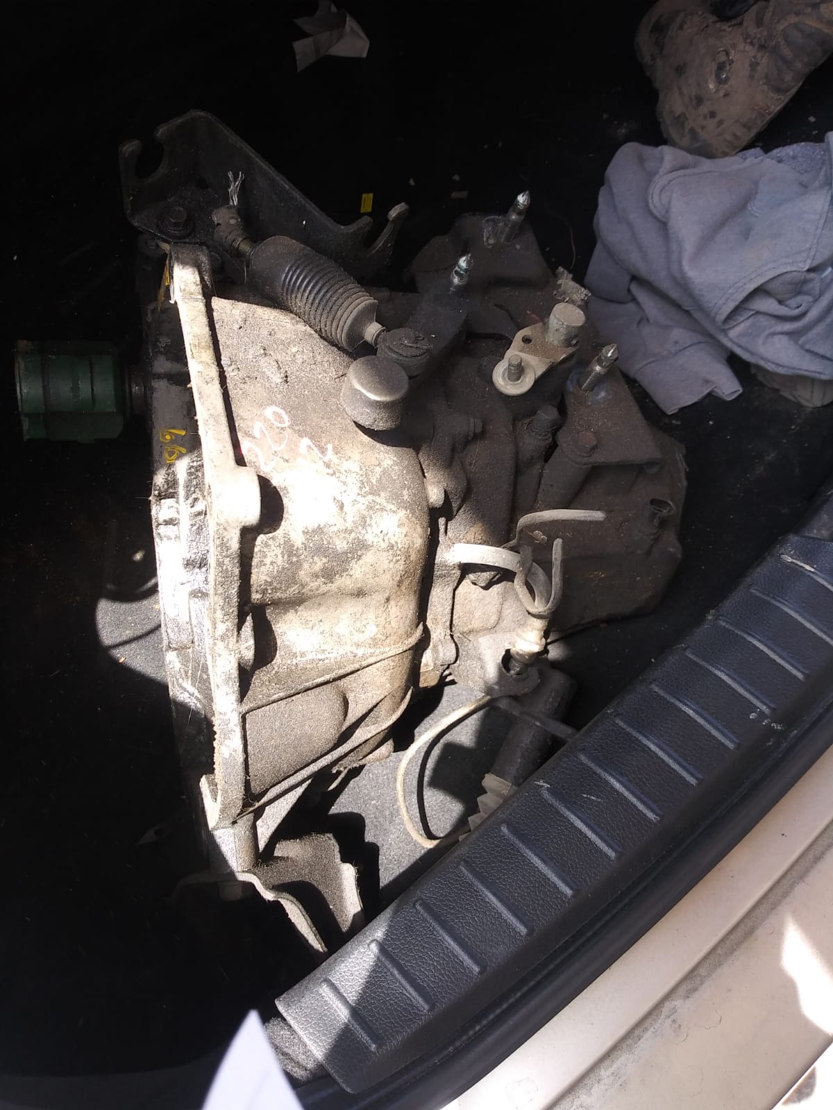

Bought the transmission a week ago from Sanford Auto Salvage in Florida (that was the secret location. Sorry, but my transmission was the last one in stock and was reserved for me! I apologize for stealing your chance hahaha ;) ), and I paid one of my uncles to pick it up for me on Saturday after he got the COVID-19 vaccine. Now I've got to wait to see if I can ship it down to PR. Here's how it looks like.
I was so happy when they got it. Thank goodness I bought ATF+4 so this car will be up and running in no time. :)

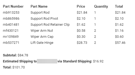

So far, I ordered a few new goodies: I ordered a new support rod, a pivot for the rod, the retainer clip, two wiper arm nuts and two wiper caps (the ones I have are rusted out, same with the wiper mechanism), and two lift gate hinges because mine are possibly rusting out, from MitsubishiParts.com. I also ordered two new door hinges so I can replace my current nasty ones, which are possibly contributing to more loud noise. I also ordered new two new liftgate supports as my shock absorbers are wasted, so it makes sense for me to replace mine.

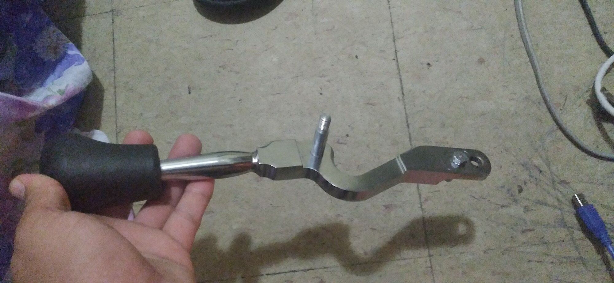

I know people are going to be mad at me, but I also ordered a short throw shifter from eBay (finally, the first aftermarket part I'm gonna put in this car), but to also get the feel of a proper shifting experience, I also ordered the shifter stabilizer bushings from suspension.com. I'm also still waiting for the new water pump from my other local auto parts store, so I can come to the store and pick it up.
Also peeps, I'm also looking for the original high rise spoiler from the GSX/GST. If anyone reading from Puerto Rico, has one for me, let me know if you have one for sale on a budget scale! I don't care if it's cracked, I can fix that myself with some Z-Glue.
Edit: Some of the parts on strikethrough are no longer available on the website. If anyone has a support rod, a support rod pivot, two wiper arm caps and two lift gate hinges, please DM me. I'll even pay for she shipping price.

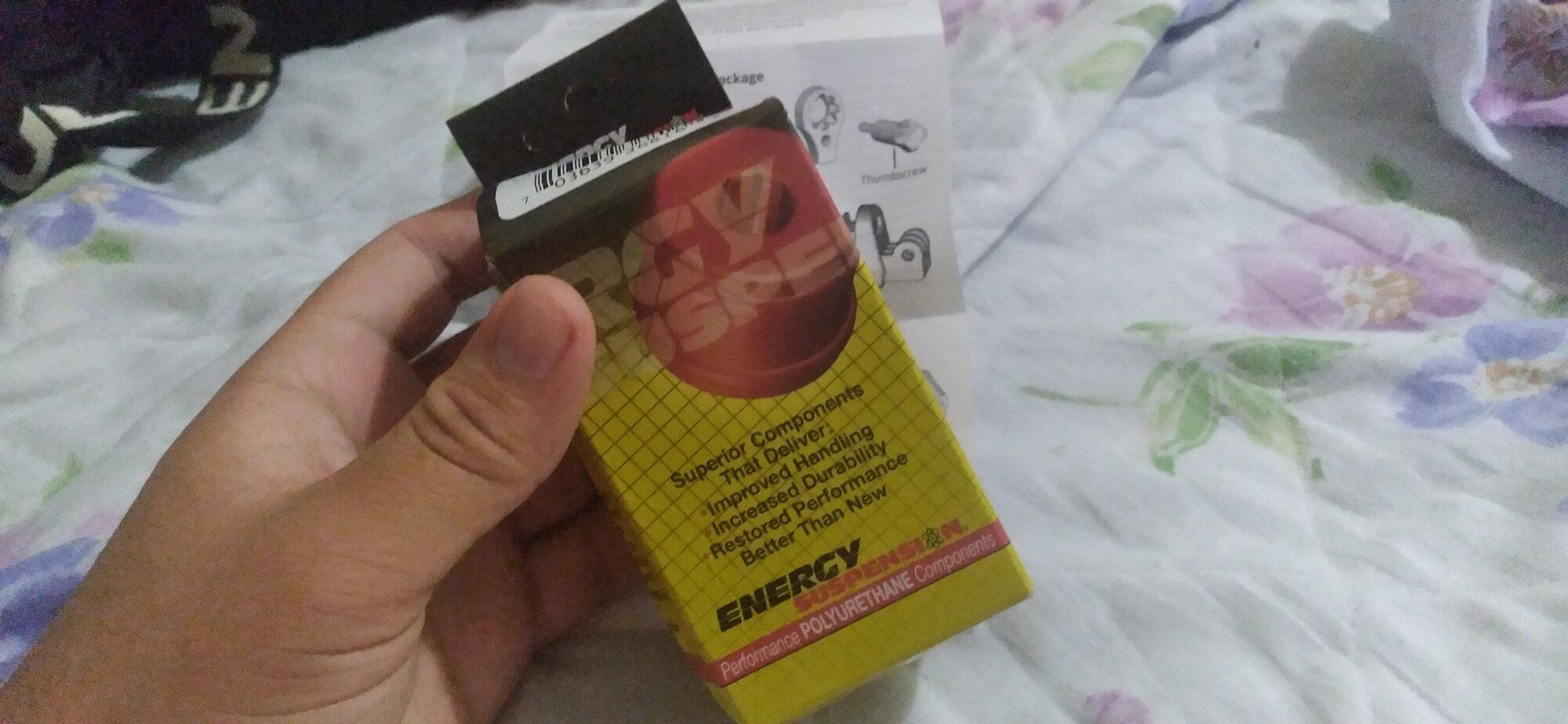

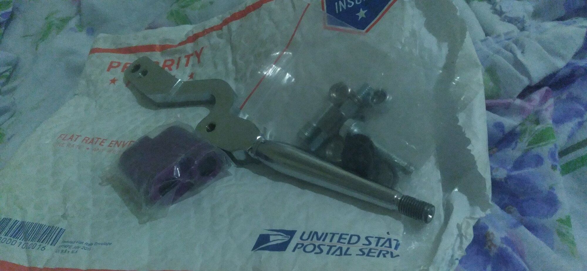

Got the new polyutherane shifter stabilizer bushings for my new and first aftermarket upgrade (the short throw shifter) for the car!
I could also install this right now, but I have no place on working with the car's interior for now until the previous owner has a spot I can use to install the new part.

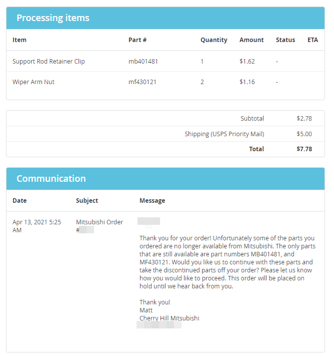

I'll take a look for this. The stock rod is not available. Someone called Matt from there told me, and it wasn't available. :/
When I found the stock prop rod it did not say discontinued on their site ..? but if Matt works there he would know better than I...
That's because most of their systems are actually outdated.

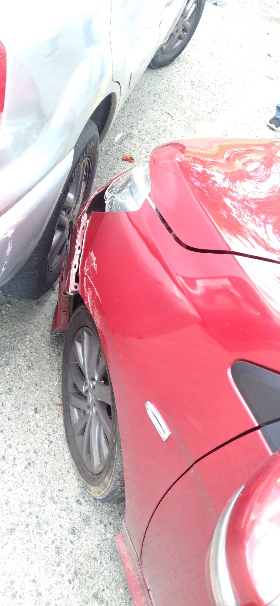

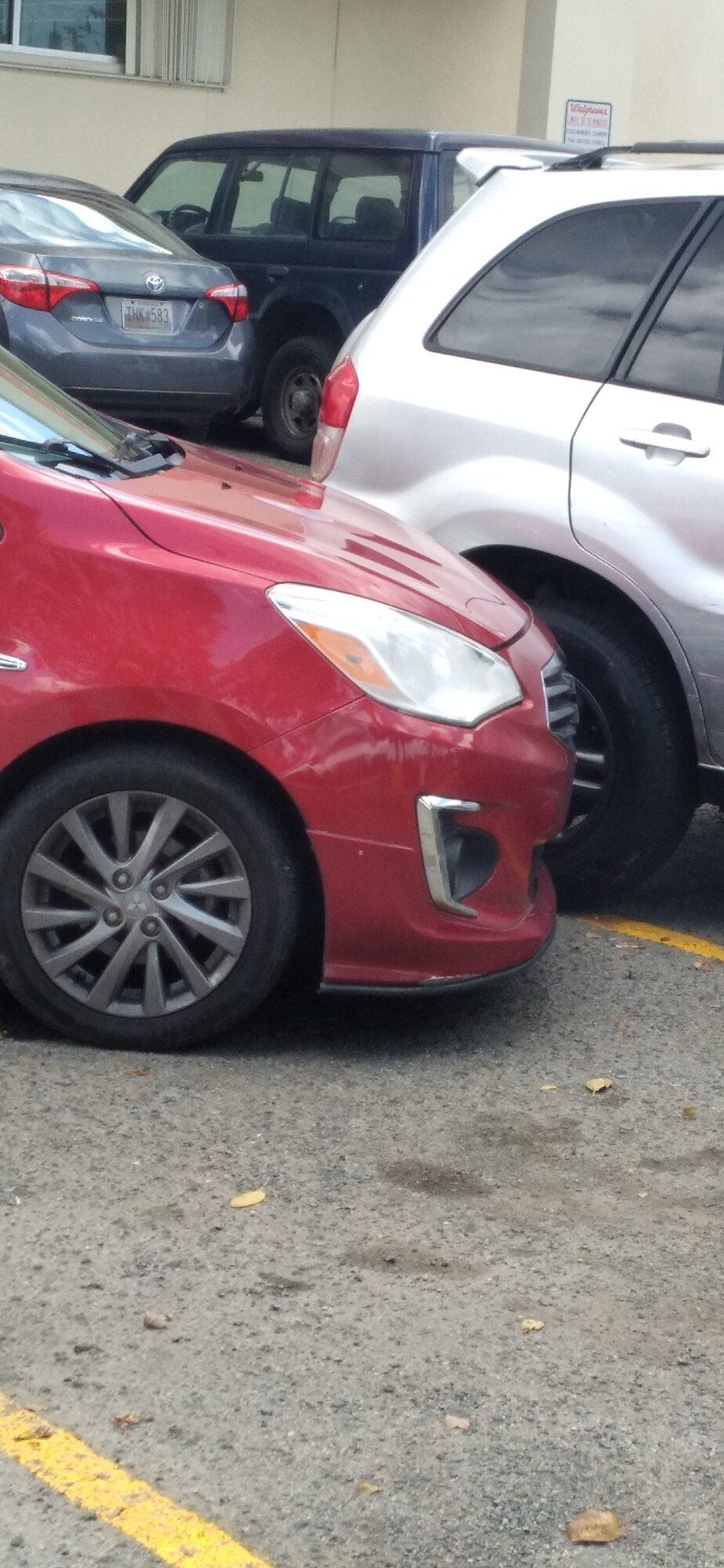

Yesterday, was both devastating and a miracle. What I mean is that I got myself into a little "accident" of a bad driver versus me trying to get out of the parking, I was on an errand to go pick up some stuff for my parents and meet up with the previous owner (as we're both friends haha) to find a place for the car so I can still work on it. This further delayed a lot of the time of the build, considering this car isn't even mine. It's my parent's car. Let's hope insurance covers the damage, otherwise it would delay my build even further if I have to pay for the damages on my parent's car (which is bs, considering they robbed me, so they owe me $900).
So far, the bumper and fender are alright. Same with the hood. I can't say the same about the front headlight. Then again, I found out that if I was in a head on collision, I would die as this car barely has any crash support. That's right. The Mitsubishi Mirage, the newer models, there is barely any crash support, which is why I was able to bend the front fender back into place.

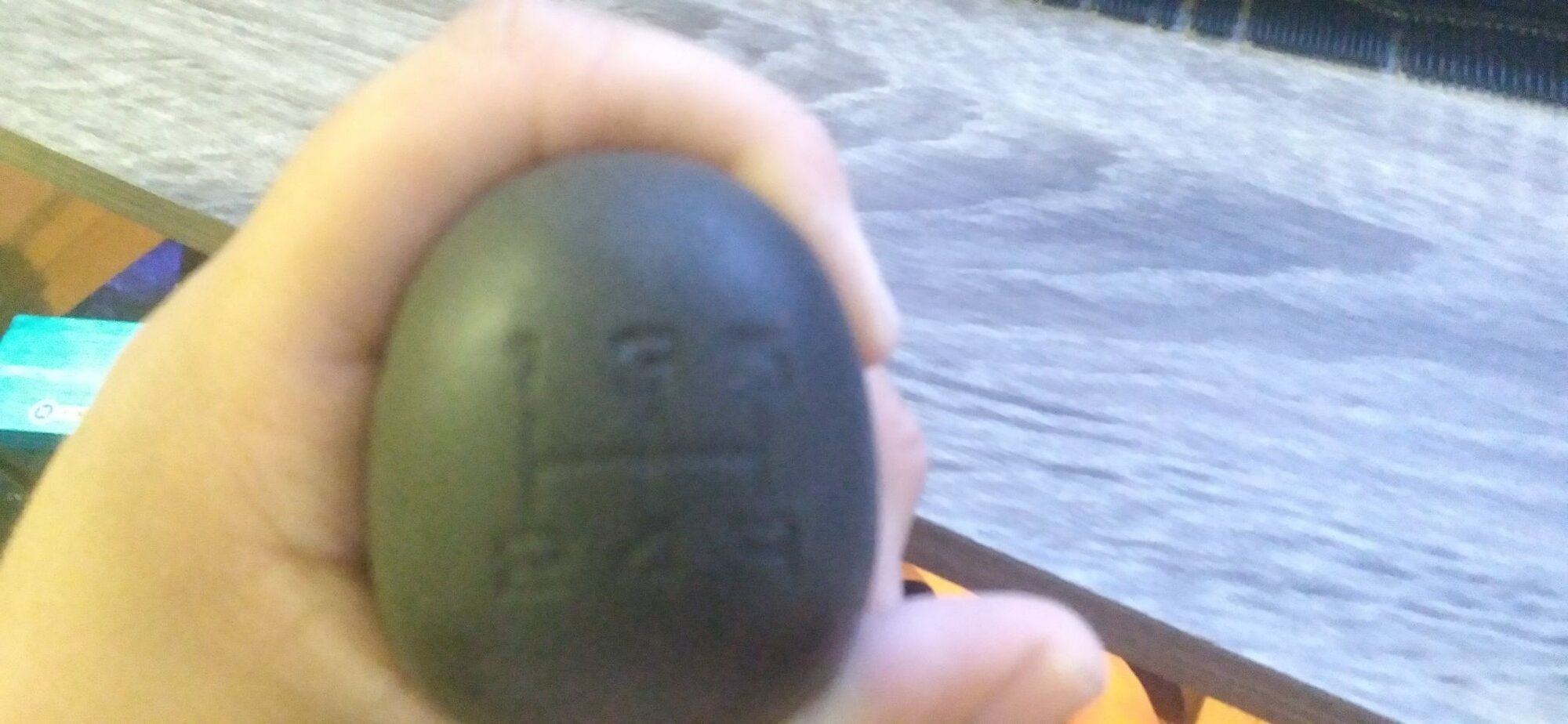

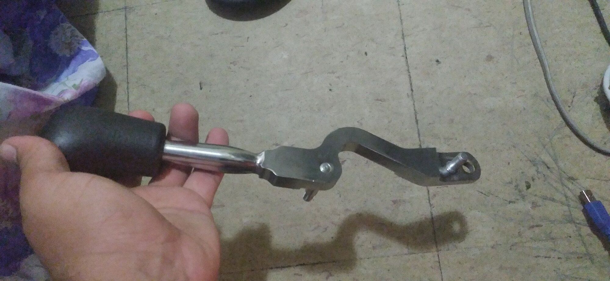

Anyways... New short throw shifter arrived. This is going to be exciting. No shift knob, however. But that's okay. I can use the one from the Eclipse, which still fits perfectly fine.
I made work on it to be done for my current shift knob (which by the way, with these shifters, you can use your OEM shift knob... however I'm replacing mine with something from AMS or somewhere else), I put the bolts in first so I don't have to manually do it when I'm IN the car, which means I'd have to waste more time under the sun.
So far, this feels extremely heavy and that's a good sign of good quality. I'm hoping this will work perfectly with my new polyutherane shifter stabilizer bushings I bought as well.

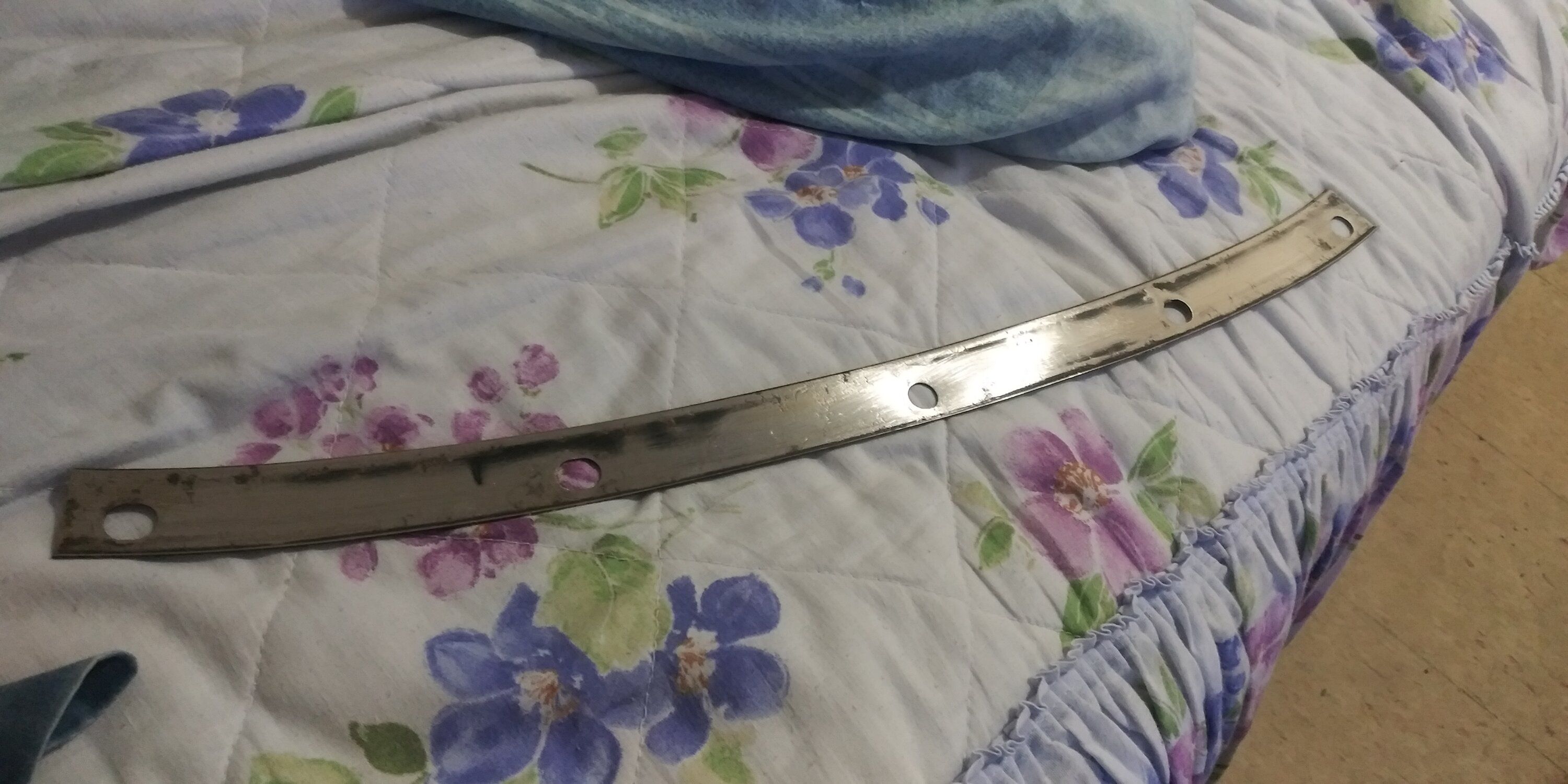

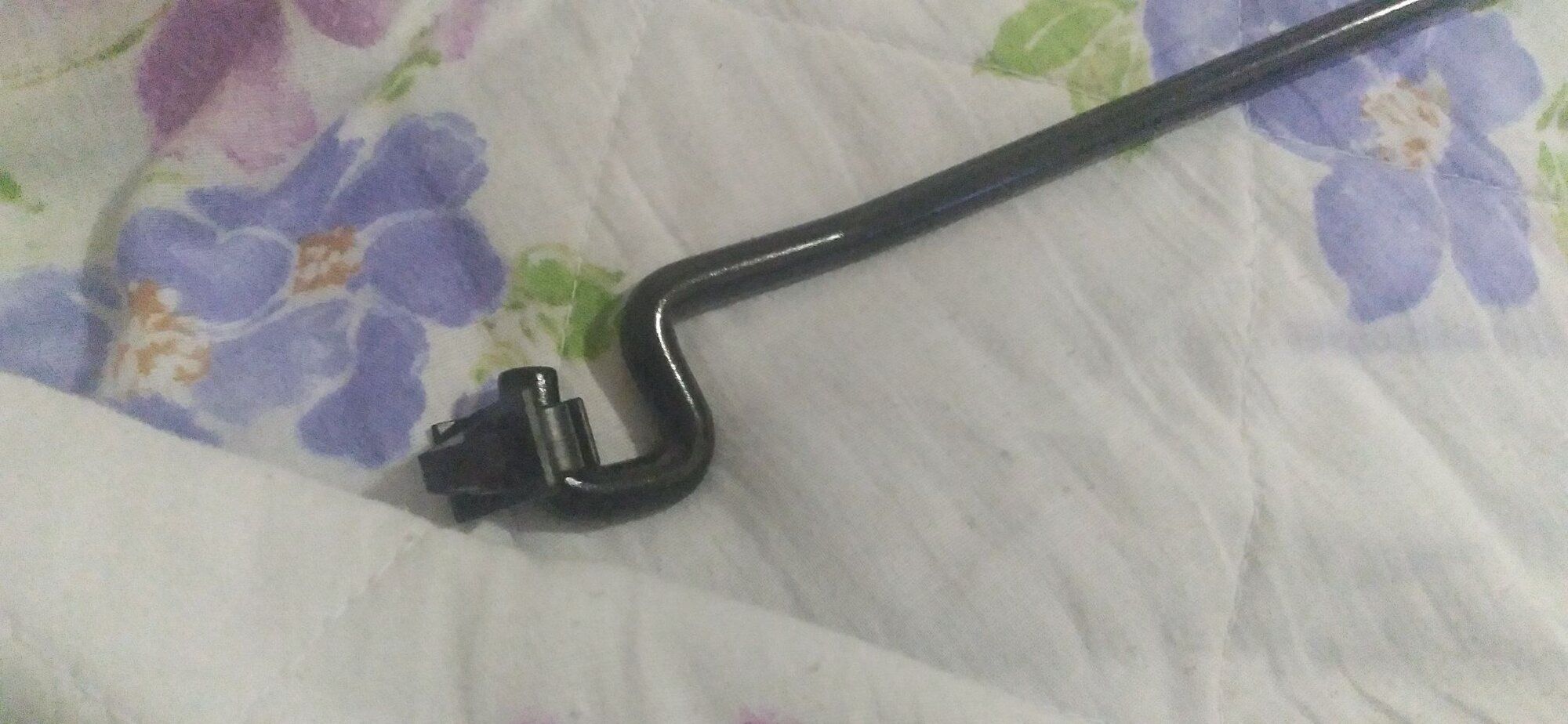

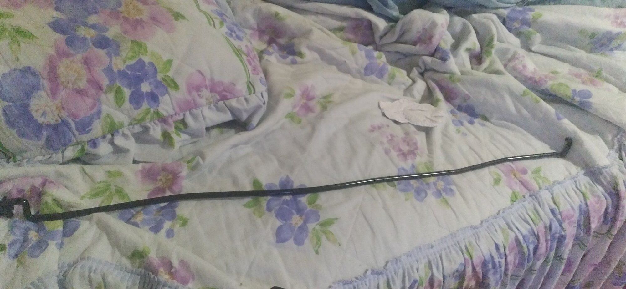

I took the current support rod and surprisingly, it wasn't too rough. So I took the time to properly restore it. The end result was this.
Also new support rod retainer clip!

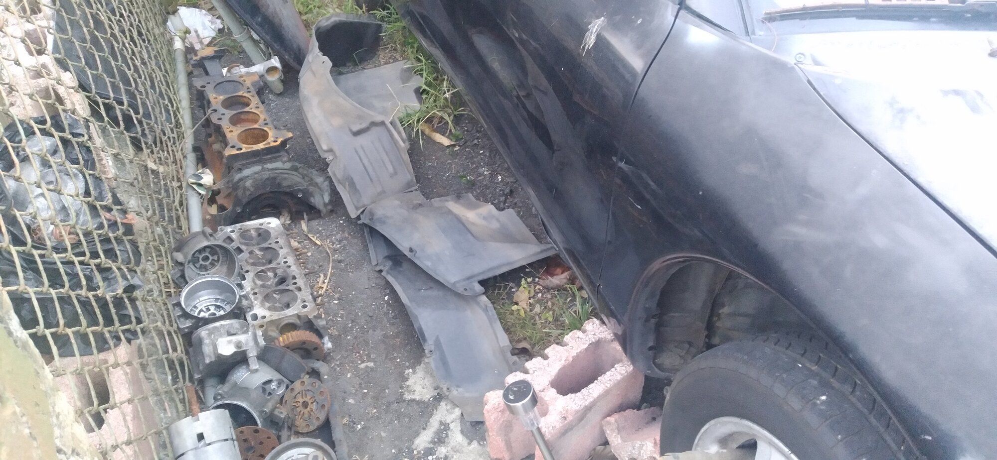

So, I went to work with the Eclipse yesterday, I managed to remove the plastic pieces from the car. I'm surprised my bolts are rusted out. If anyone got bolts for this, let me know. I'm willing to buy brand new ones.
Excuse the fact I have block parts around me + an Integra DC2 hatch door, I am selling some of these (engine parts from a Mirage, bahaha)

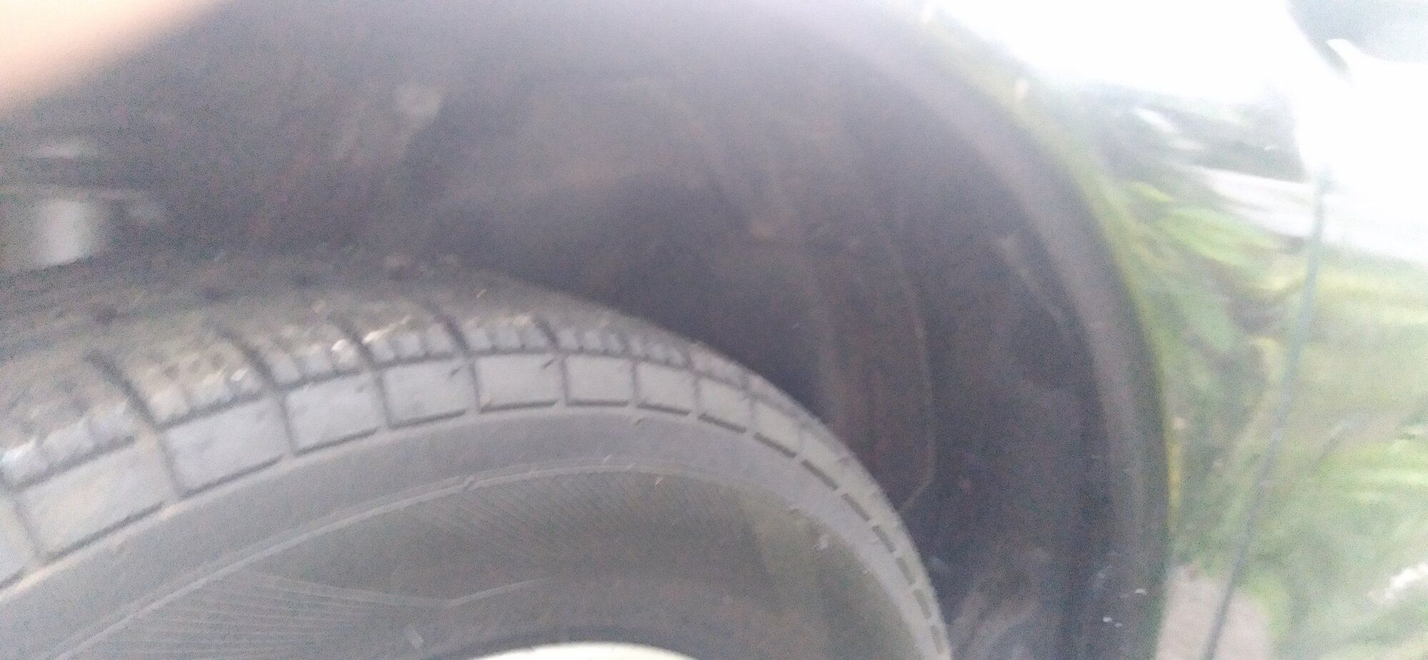

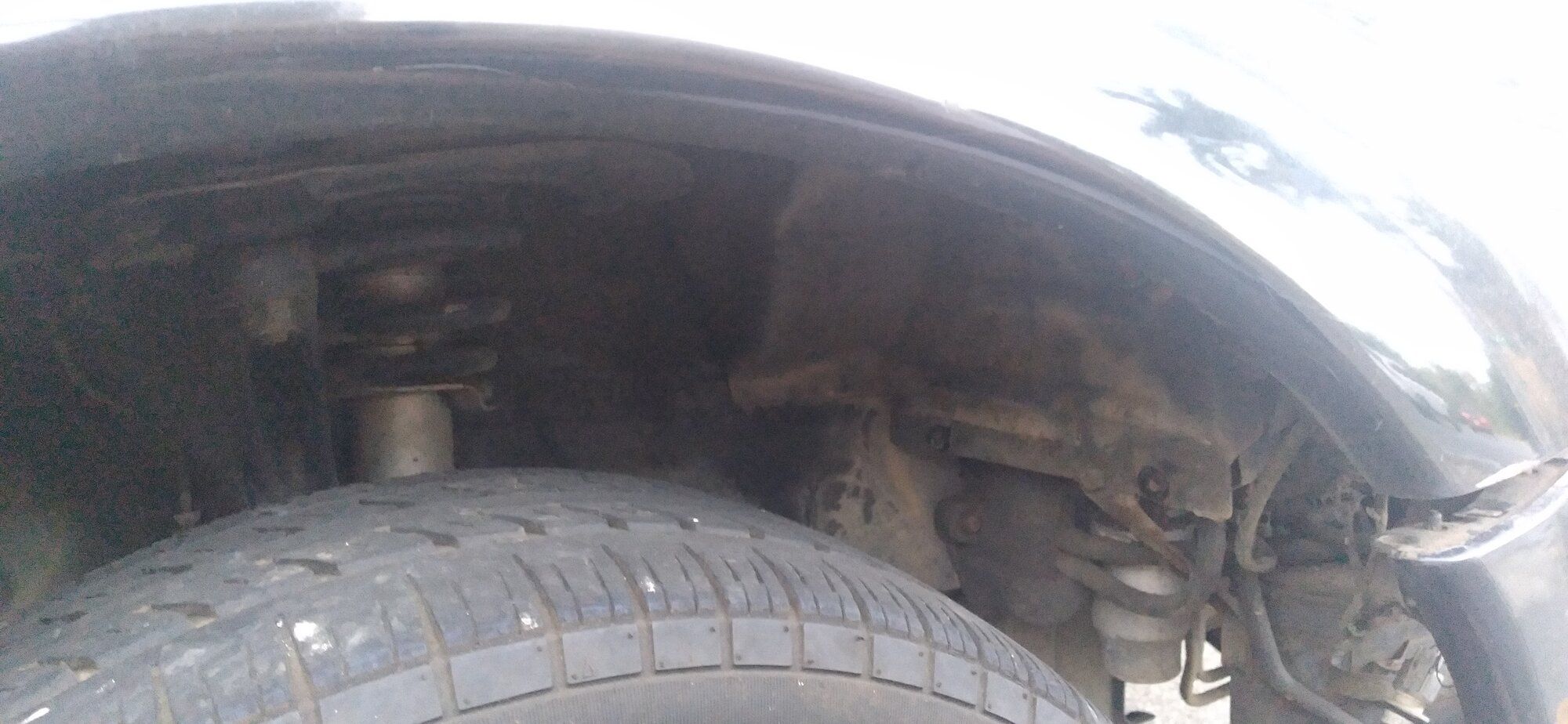

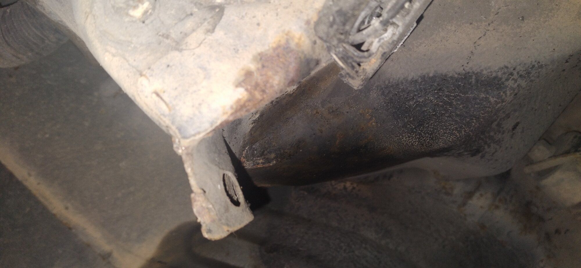

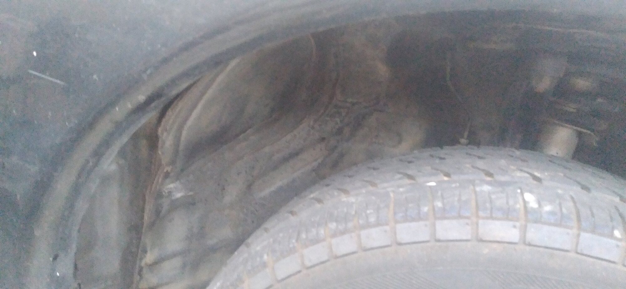

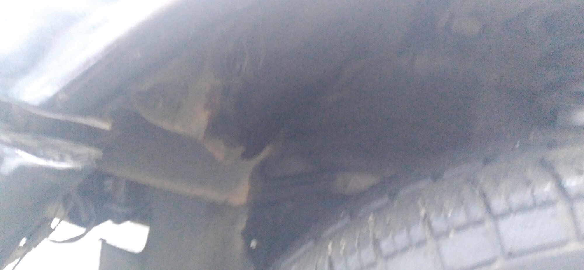

Interestingly, when I checked the left side, yup, there was something weird.
Can you see this, right?
This is a mild case of surface rust. I'd have to sandblast the whole under-chassis. Not sure how I would do this, but it would be fun.
