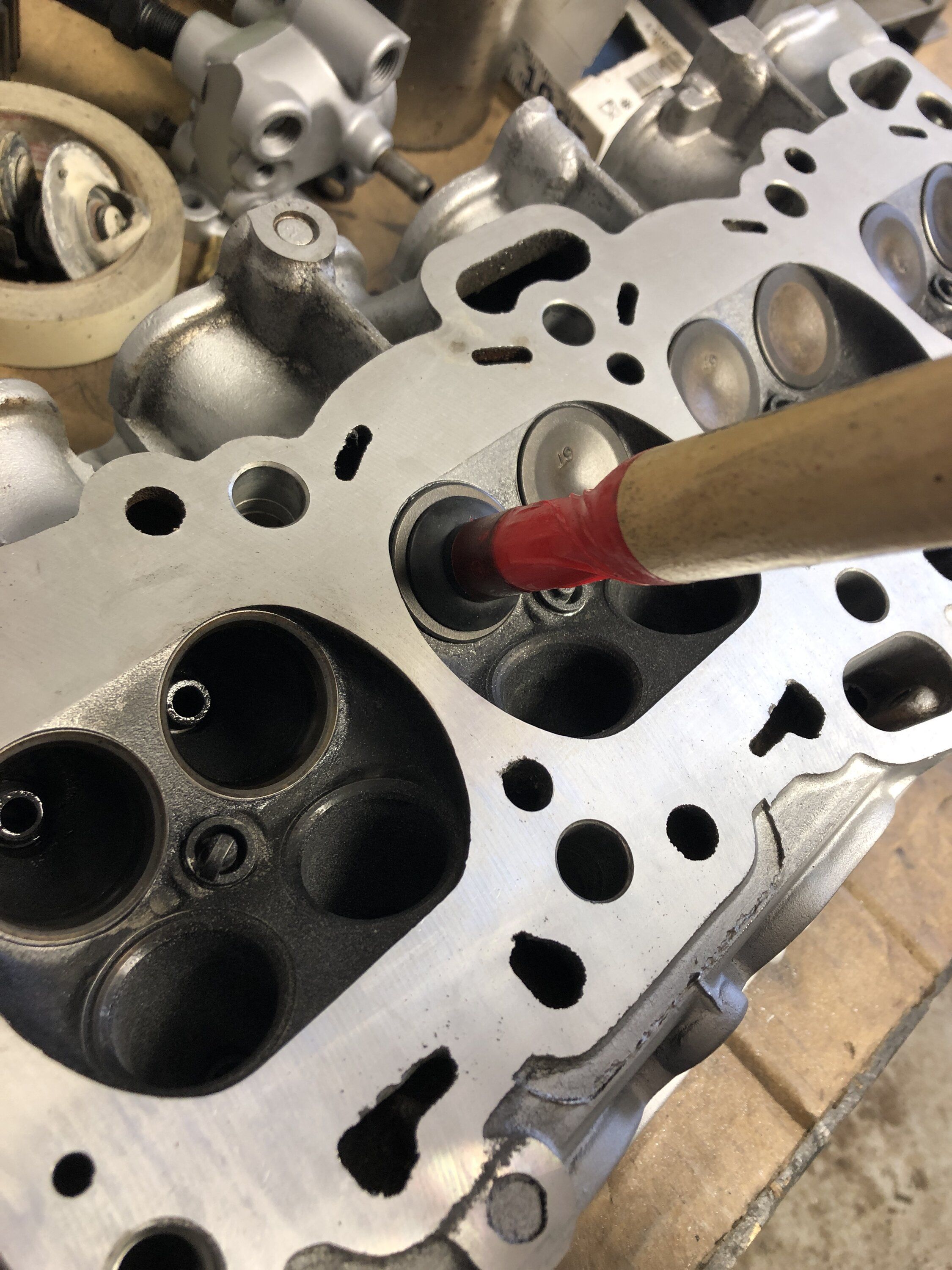

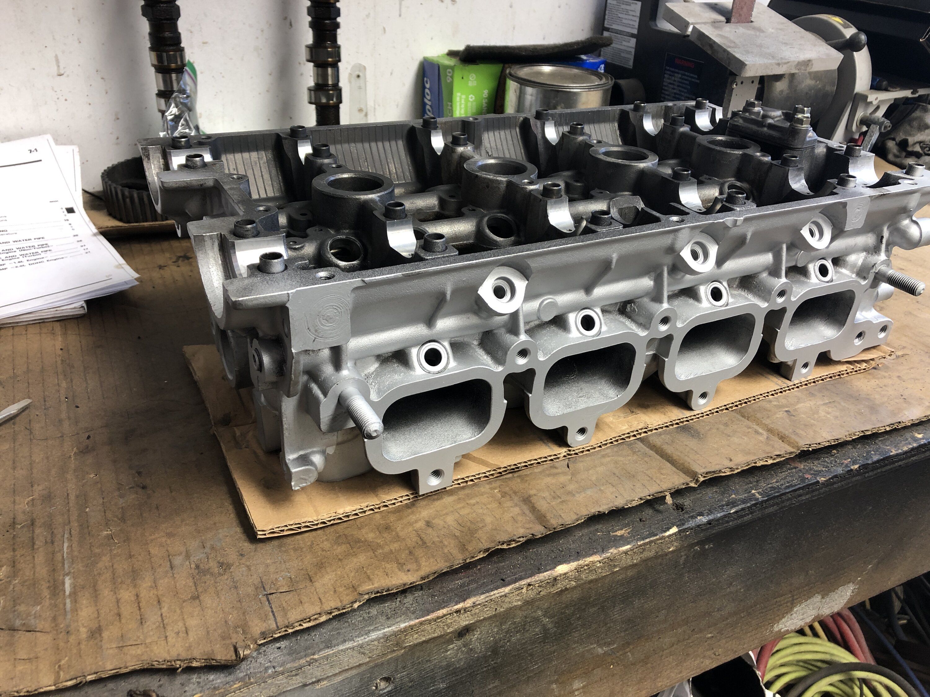

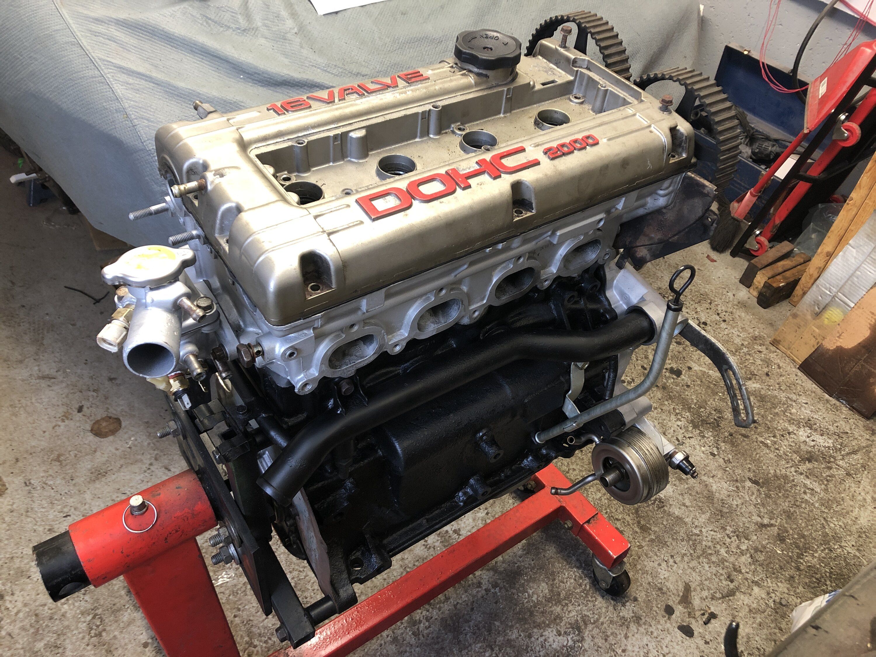

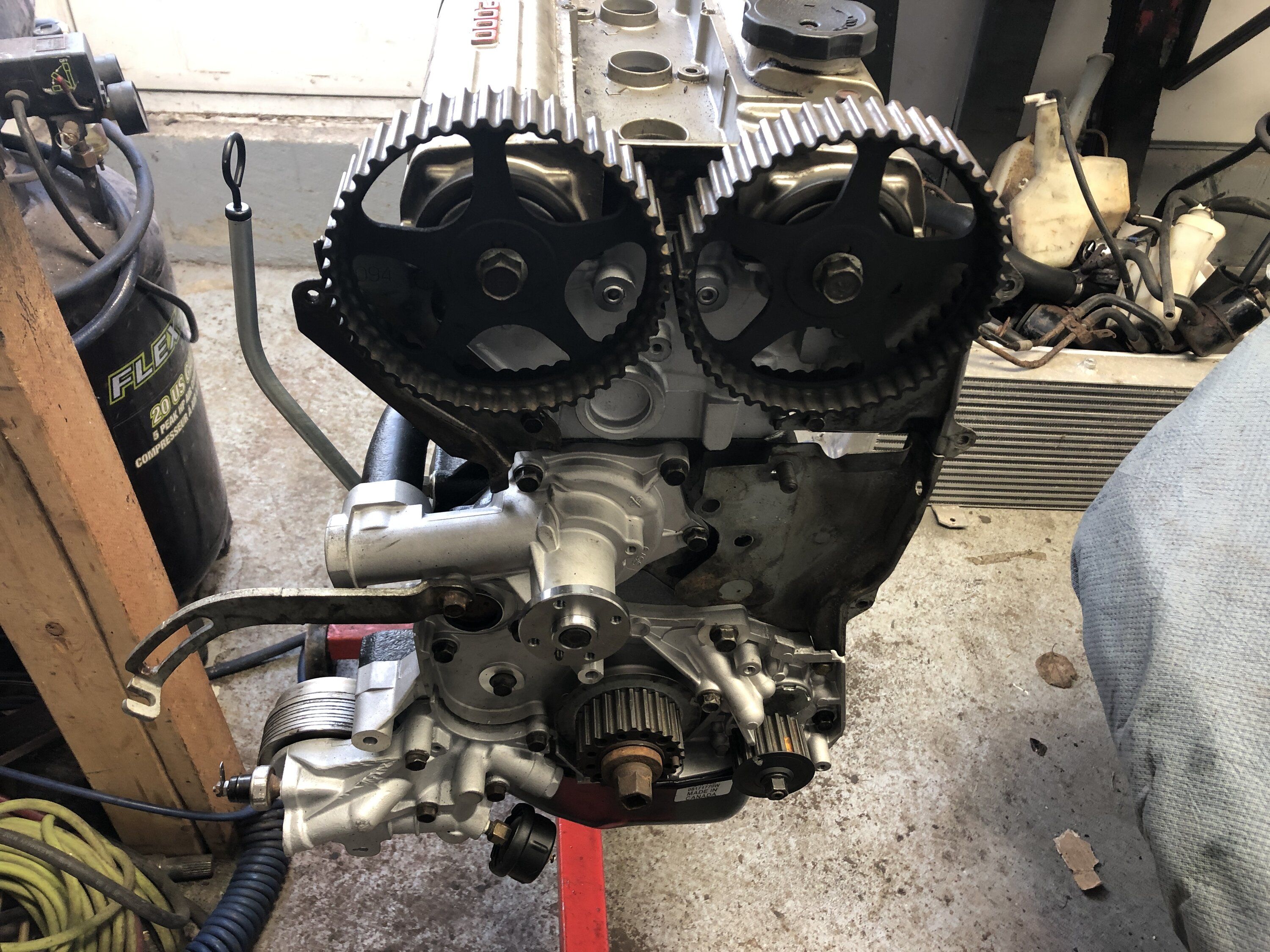

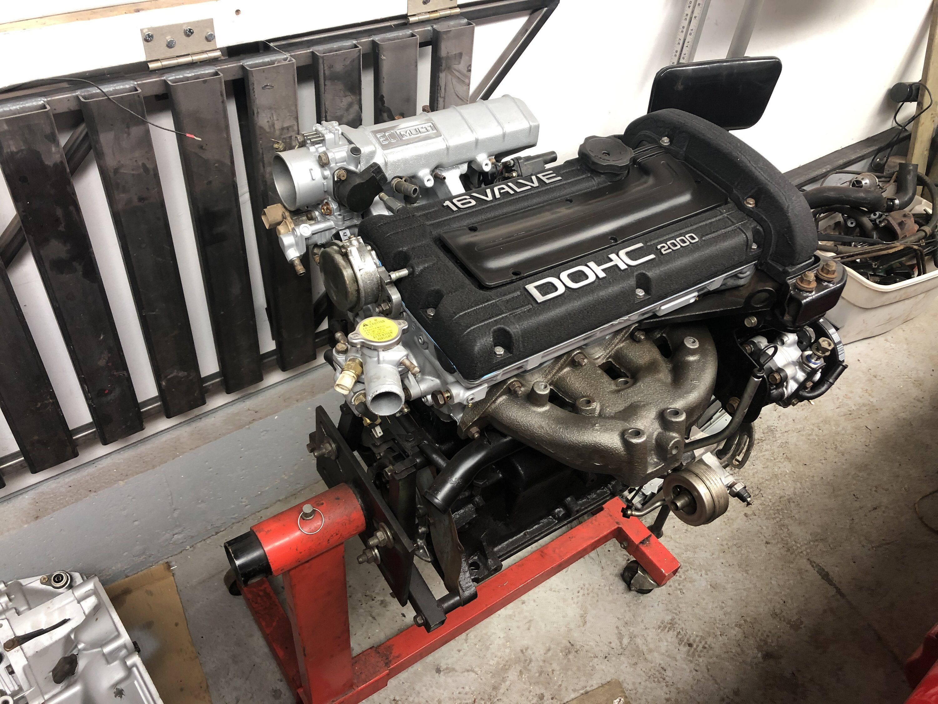

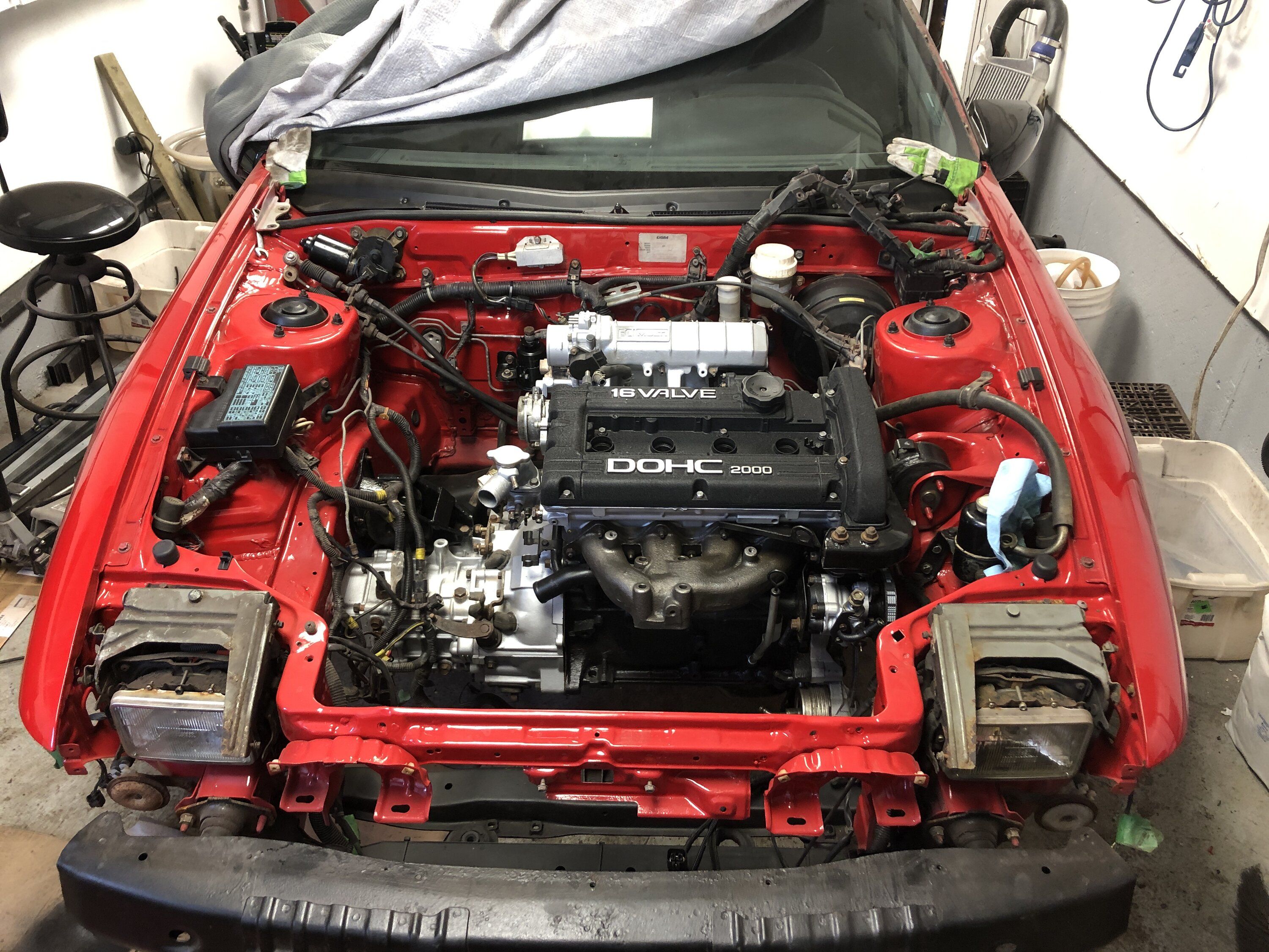

Engine is done!

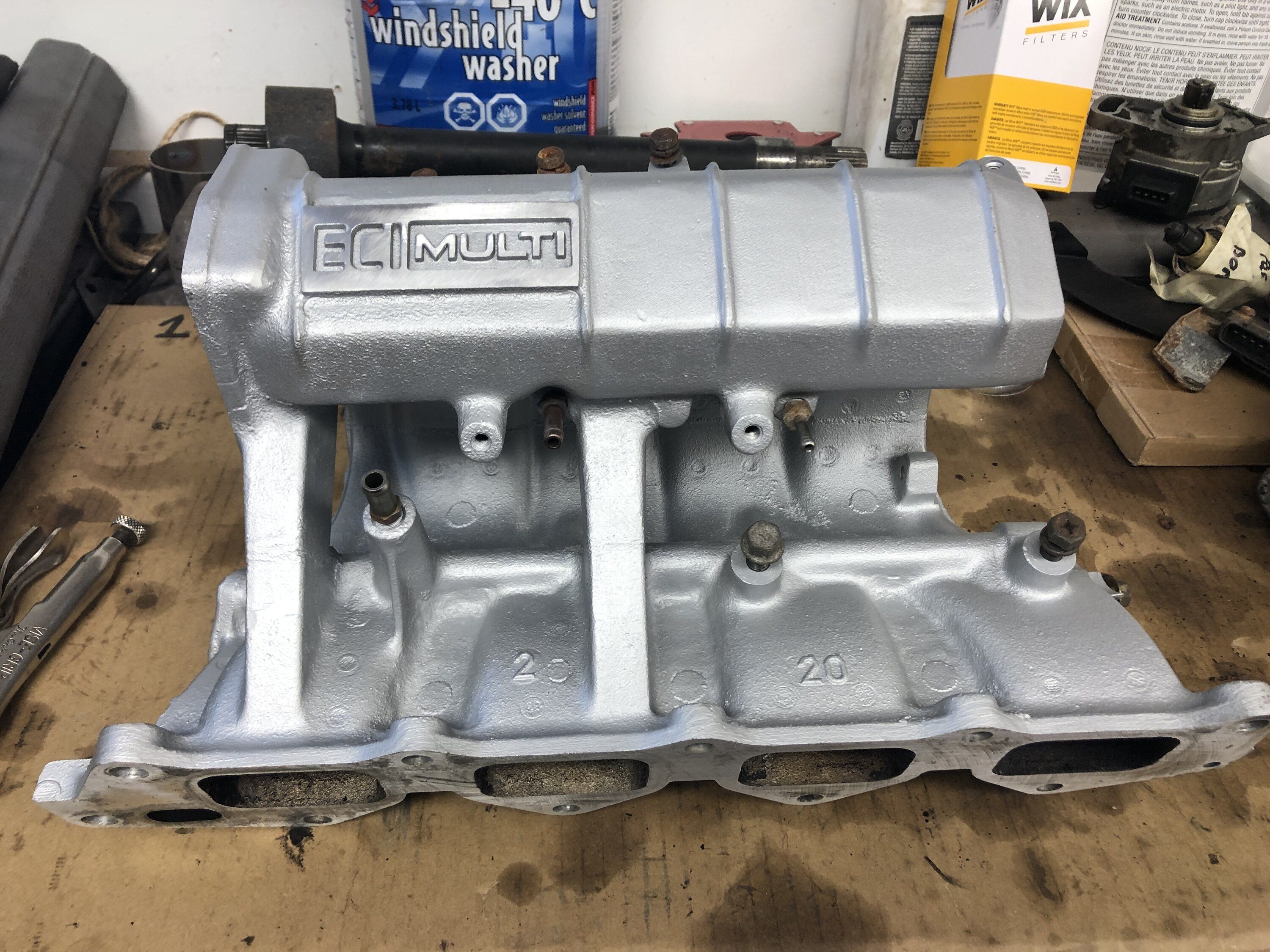

Final picture will be in the next post but as now, intake and exhaust mani are on.
Paint is drying on the valve cover + im waiting next weekend to pick up a cam cover and spark plug cover.

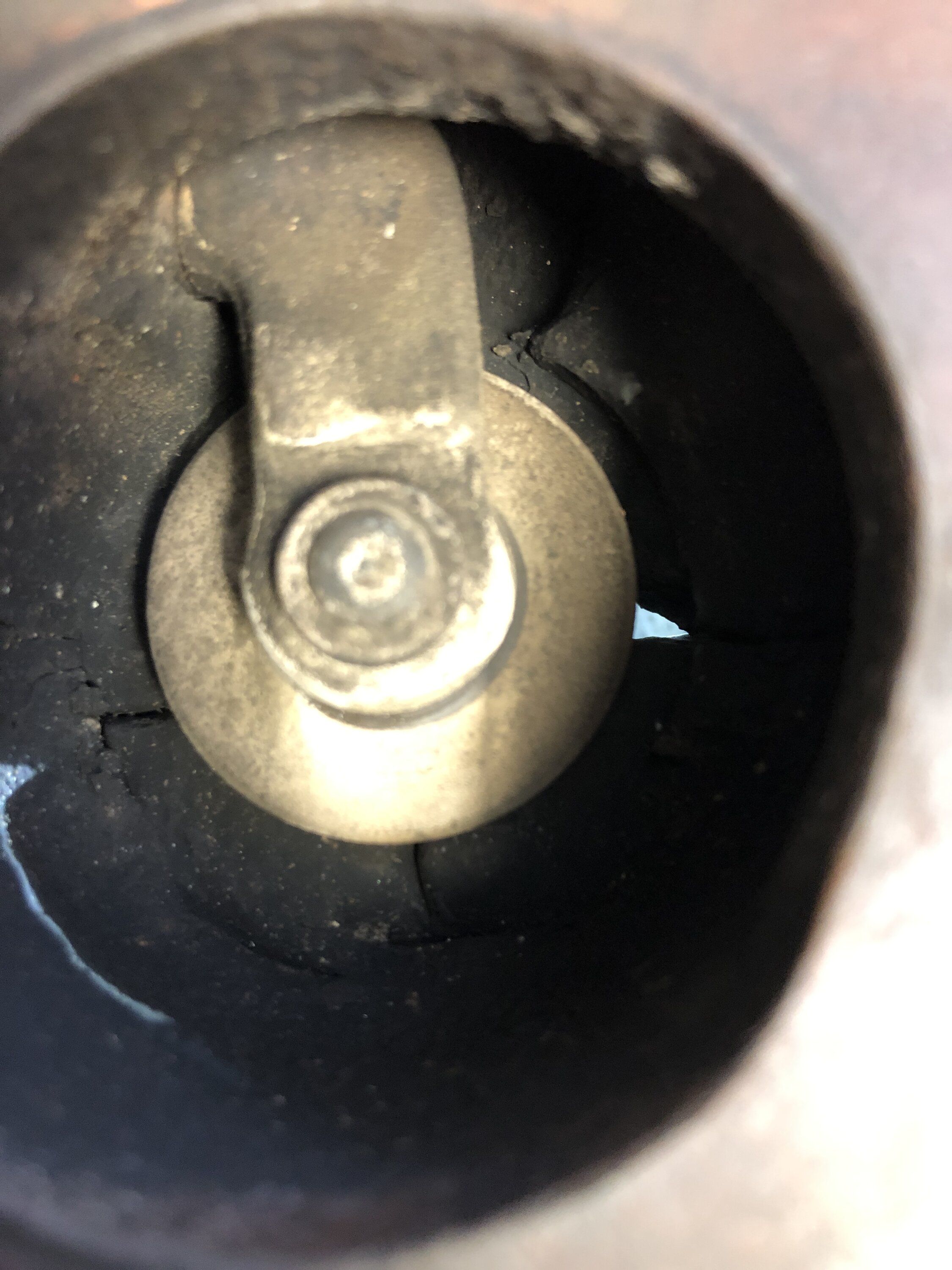

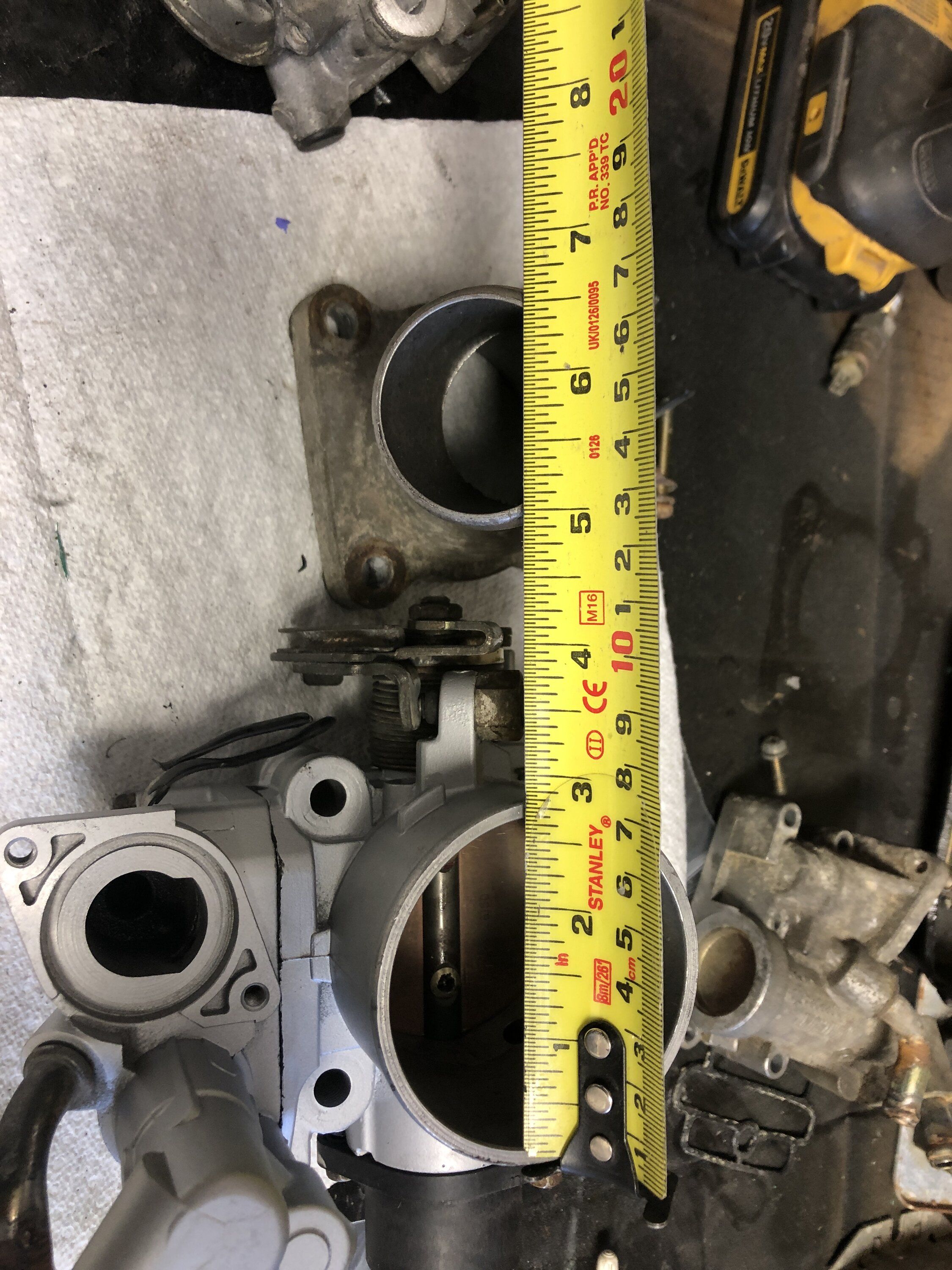

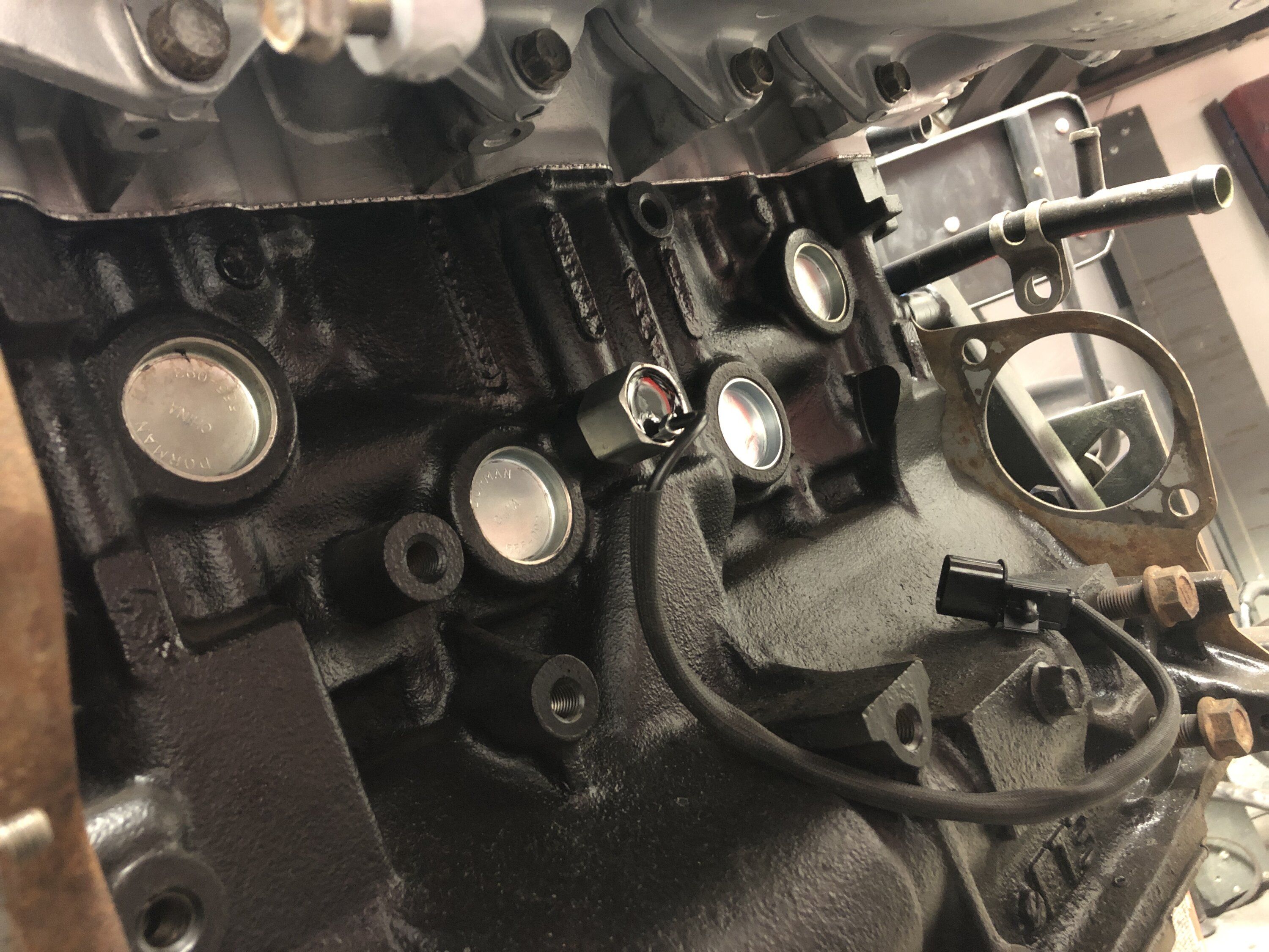

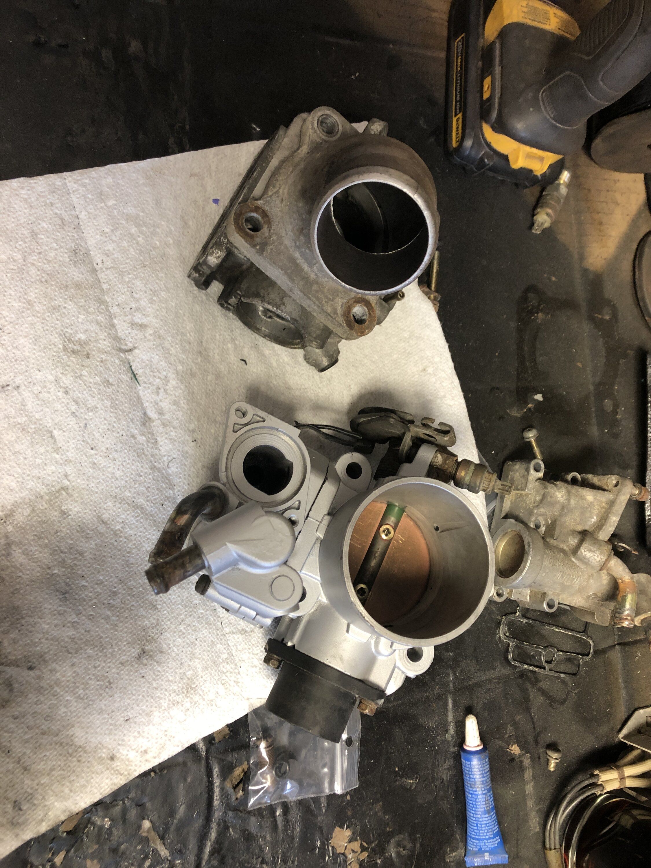

By the time i clean/paint/rebuild the TB, i was looking to keep most oem stuff buf these 1g tb are so small. I had a N/A TB laying around so i took this one.

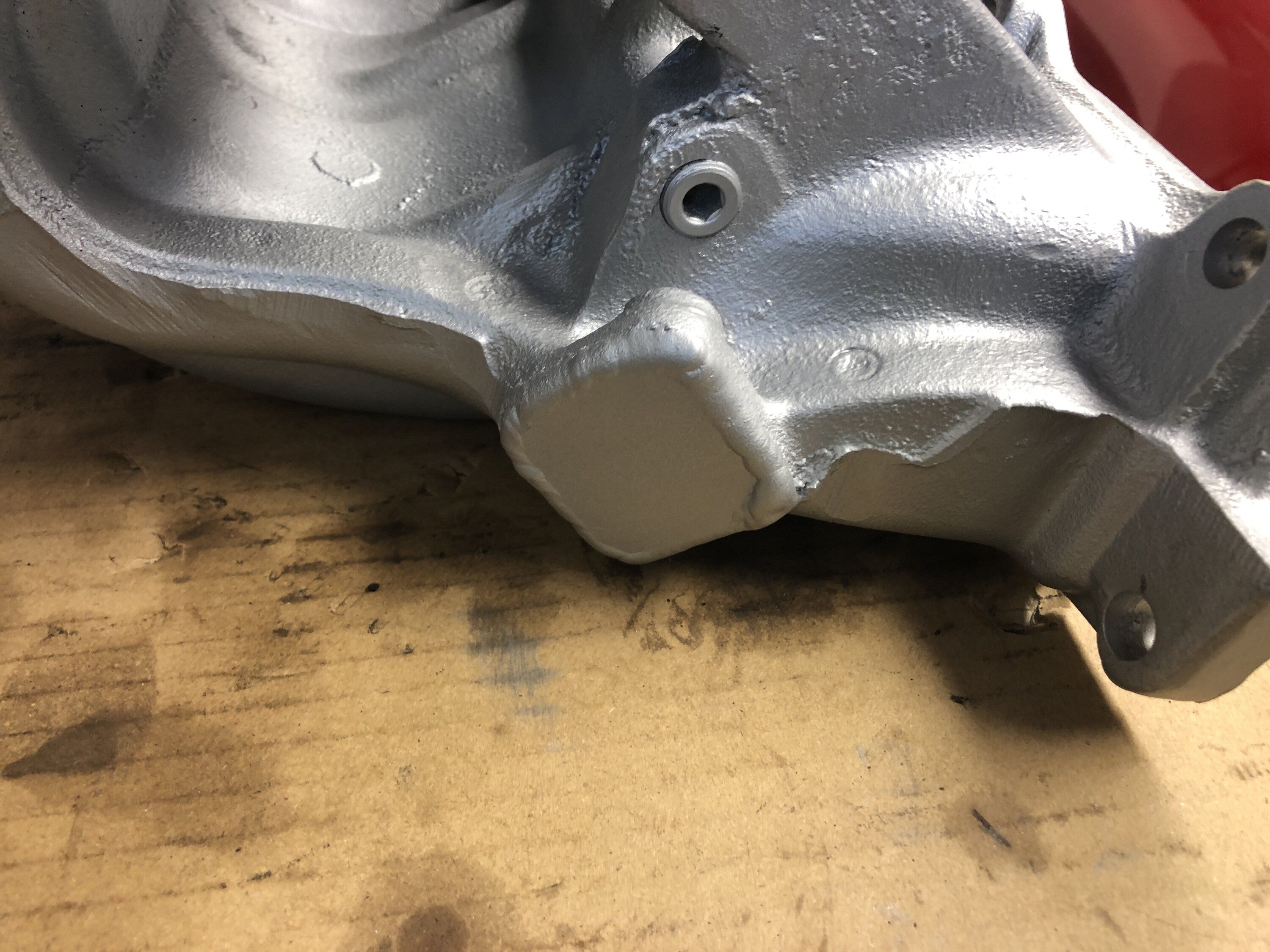

I welded the EGR opening and i installed my new knock sensor ! thx @1990TSIAWDTALON

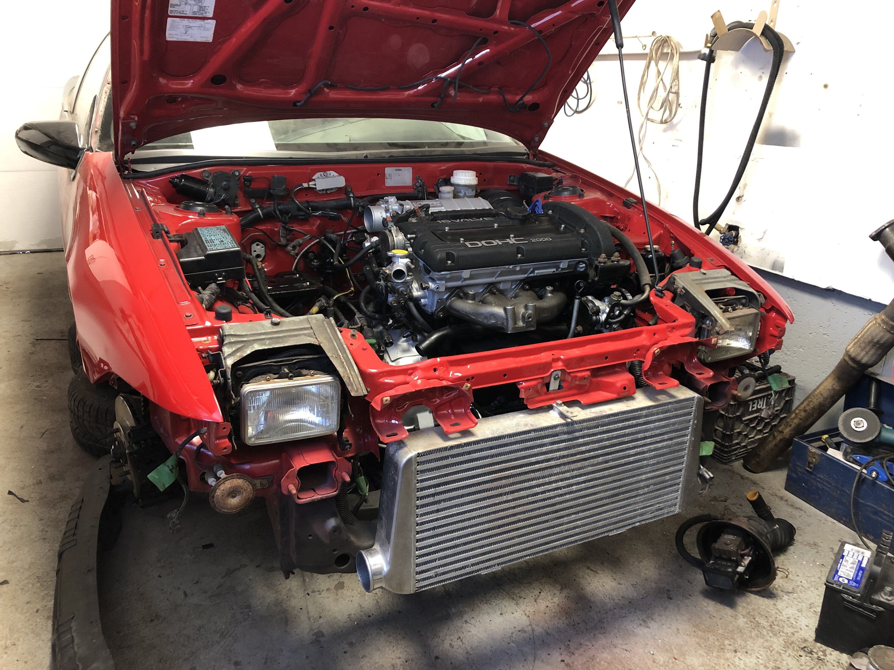

And my choise is made, of course i'll go with a FMIC.

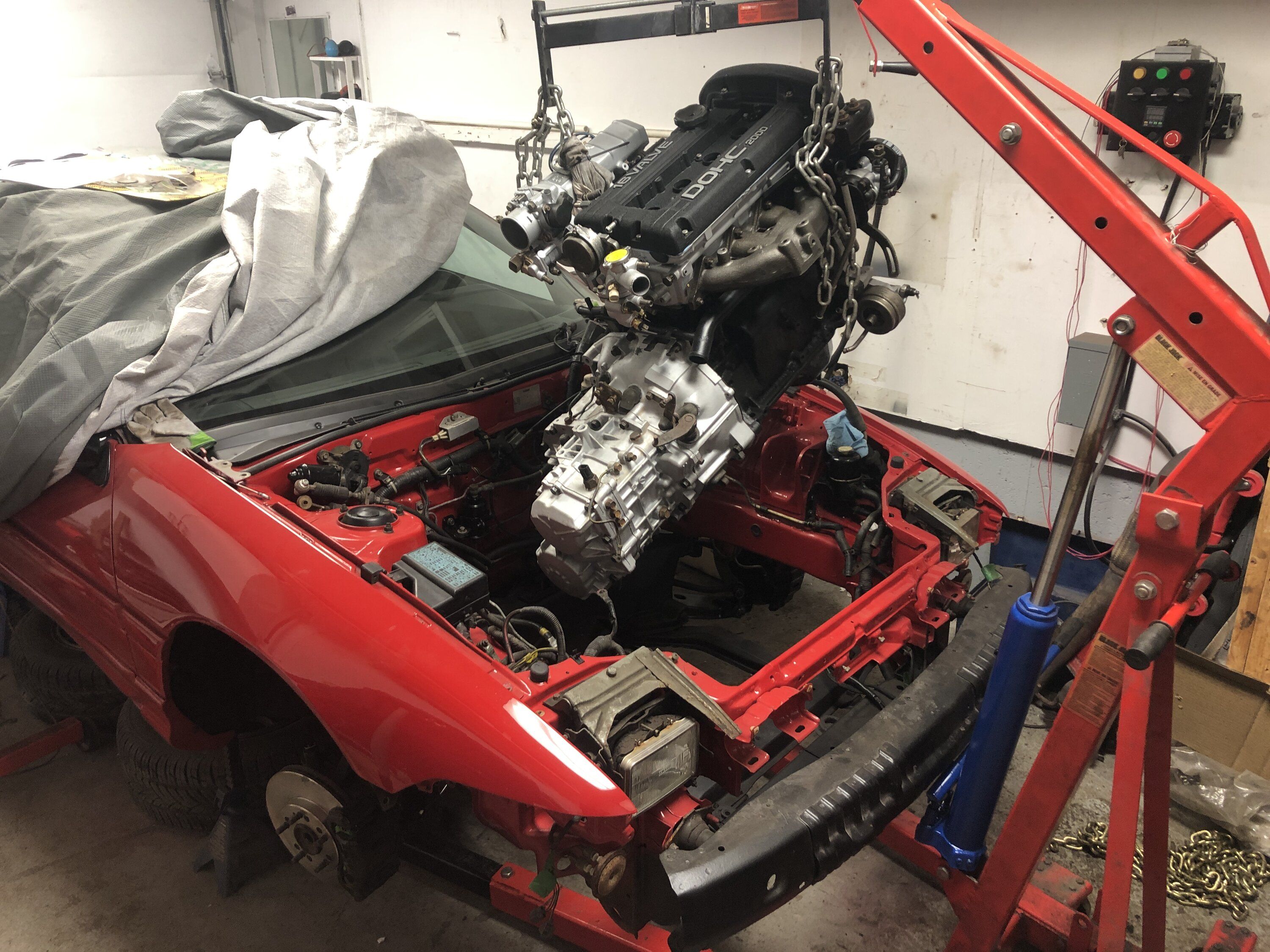

Im now waiting for my new clutch, as soon as i get it, this car is gonna have an engine in! yeah!

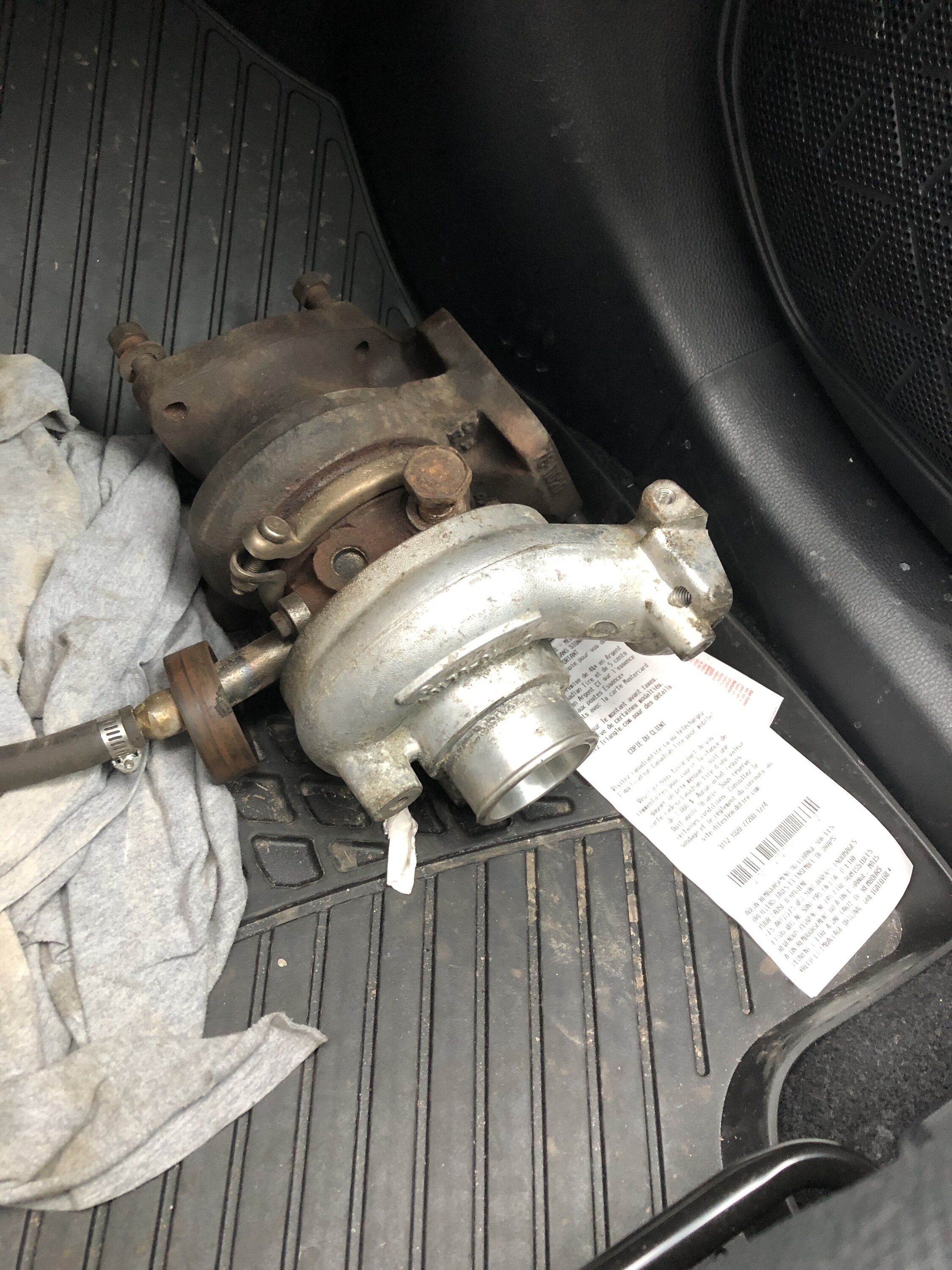

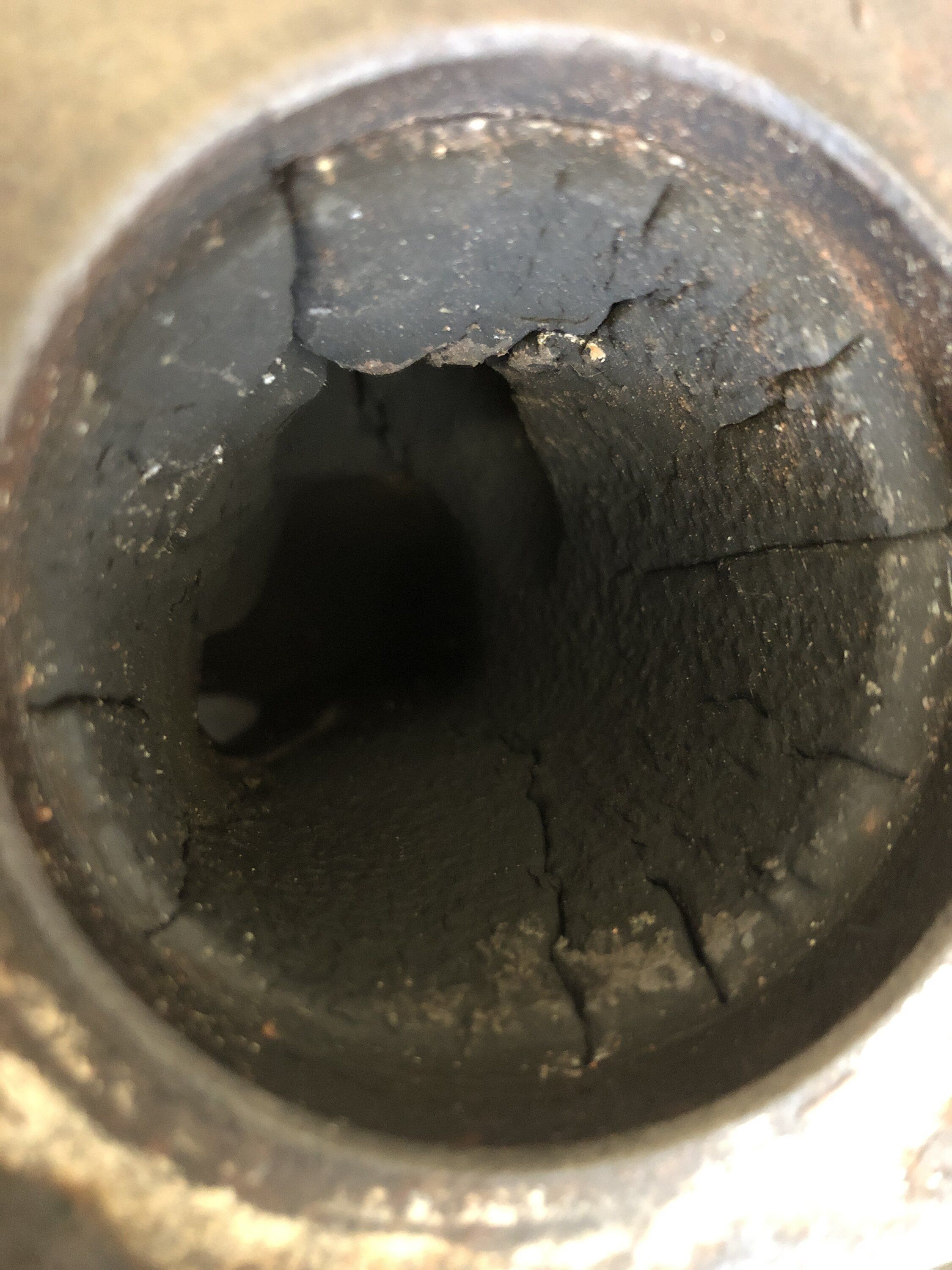

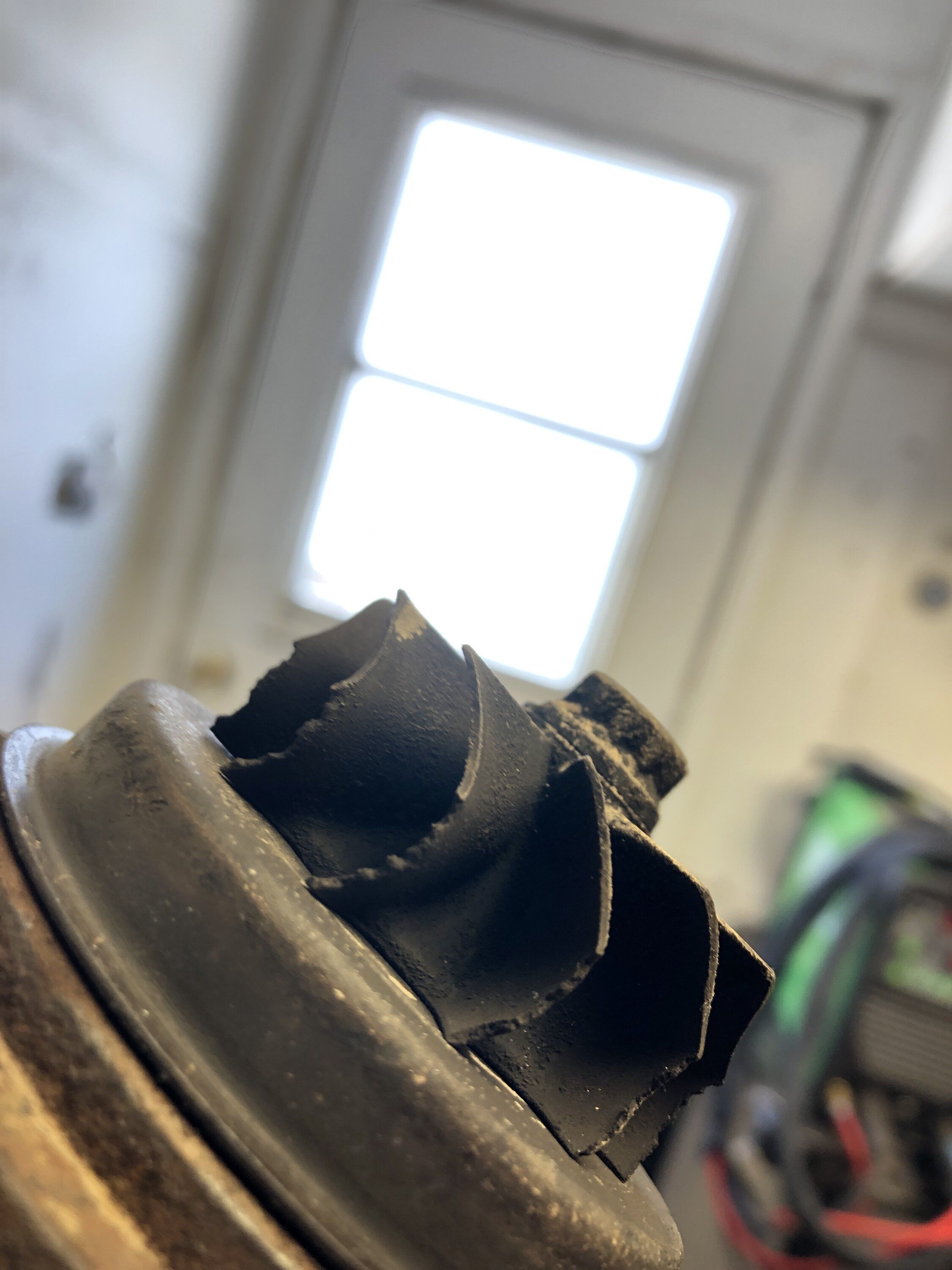

Found out that my 14B was dead.. like really dead! By chance i found an other one. I do not plan to use my 20g for now, i'll stick to the OEM 14b.

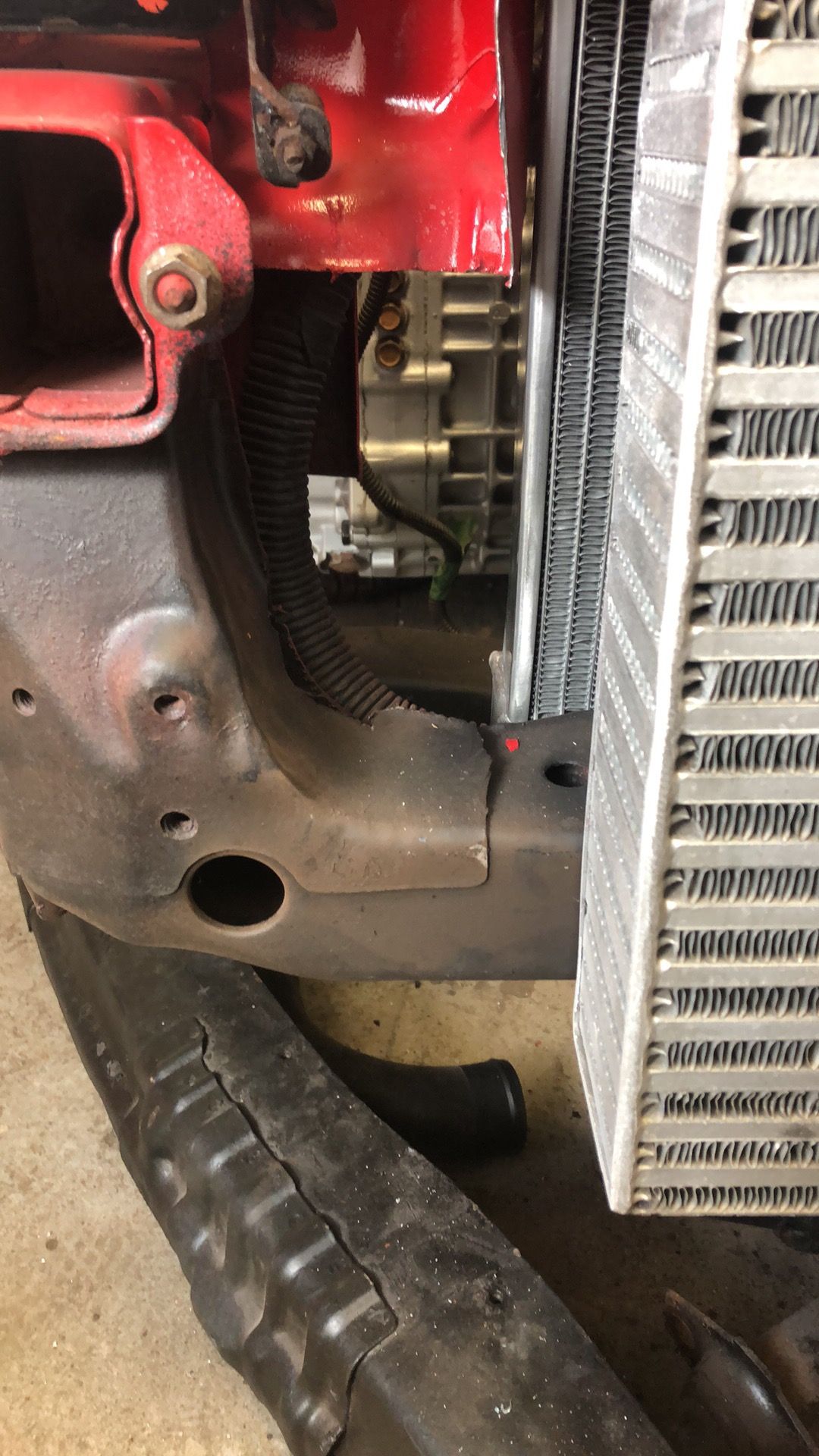

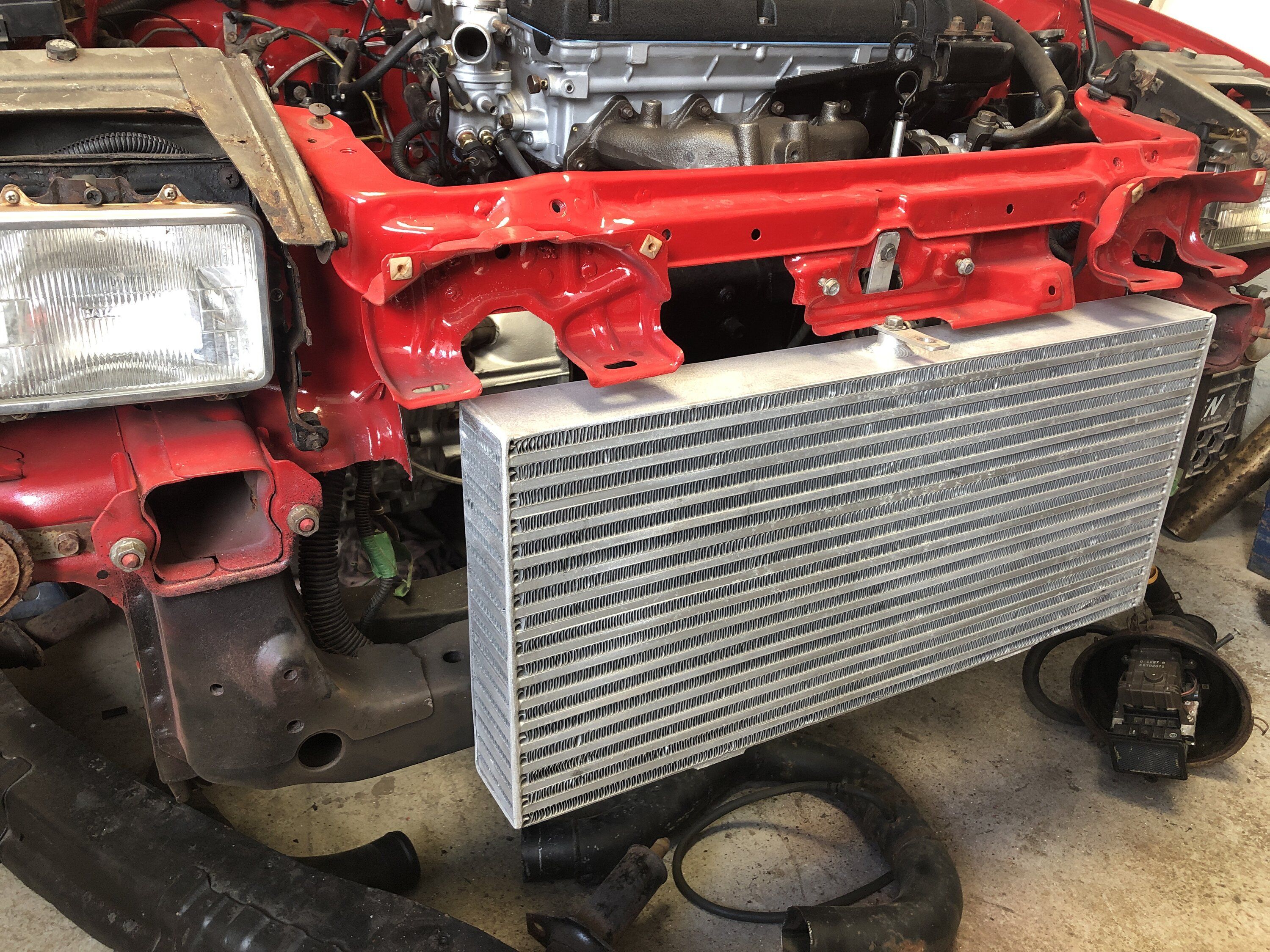

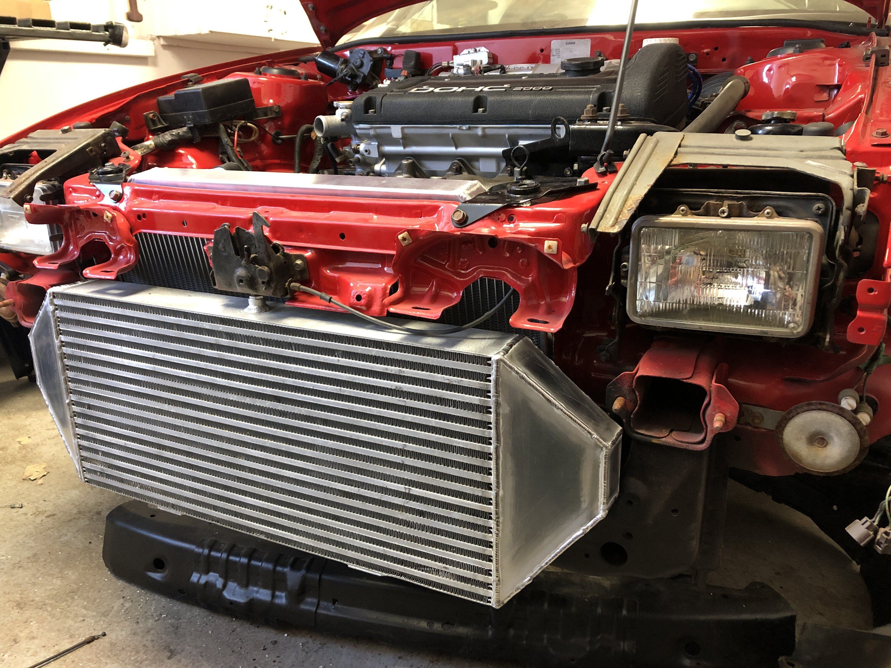

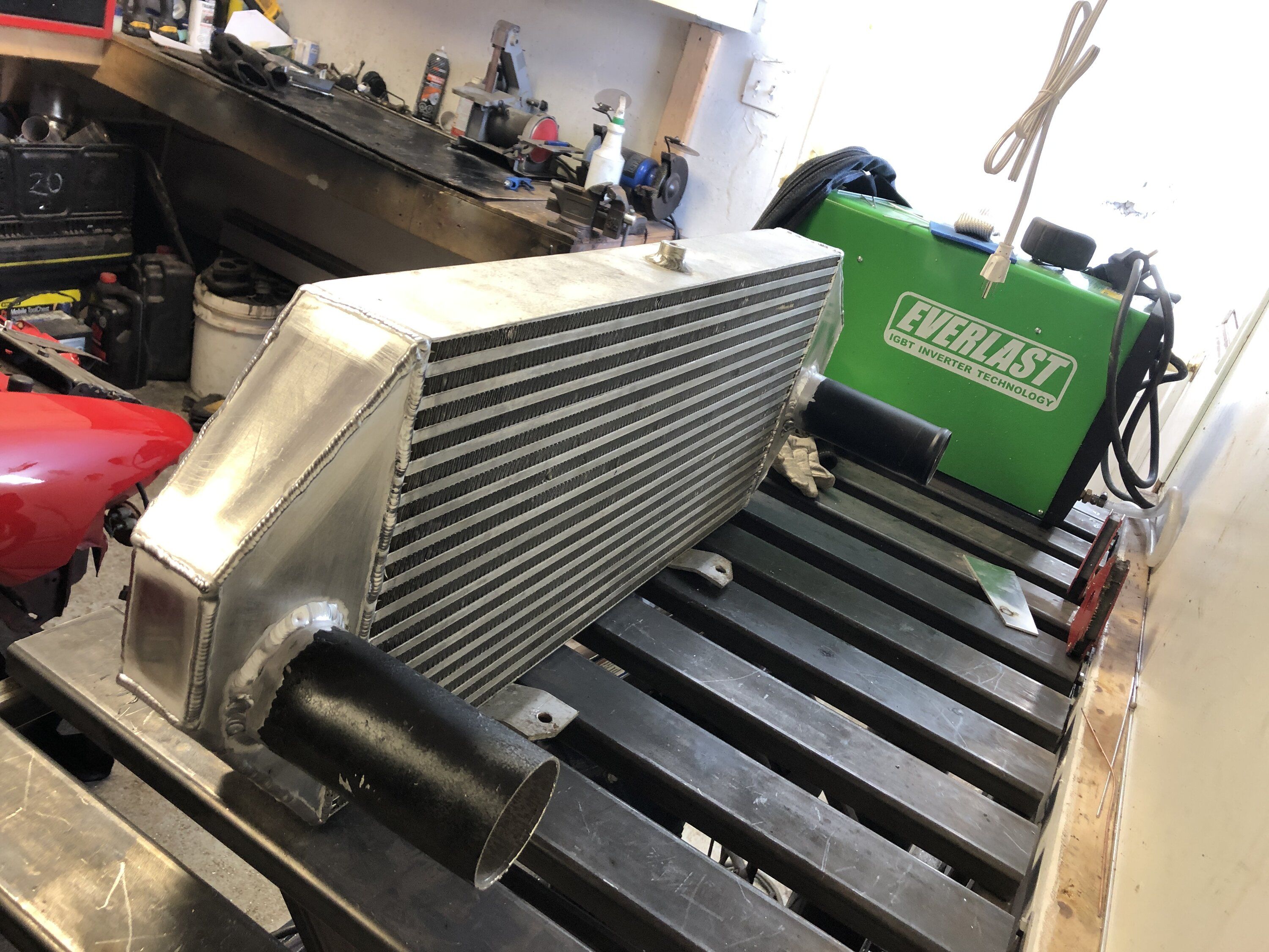

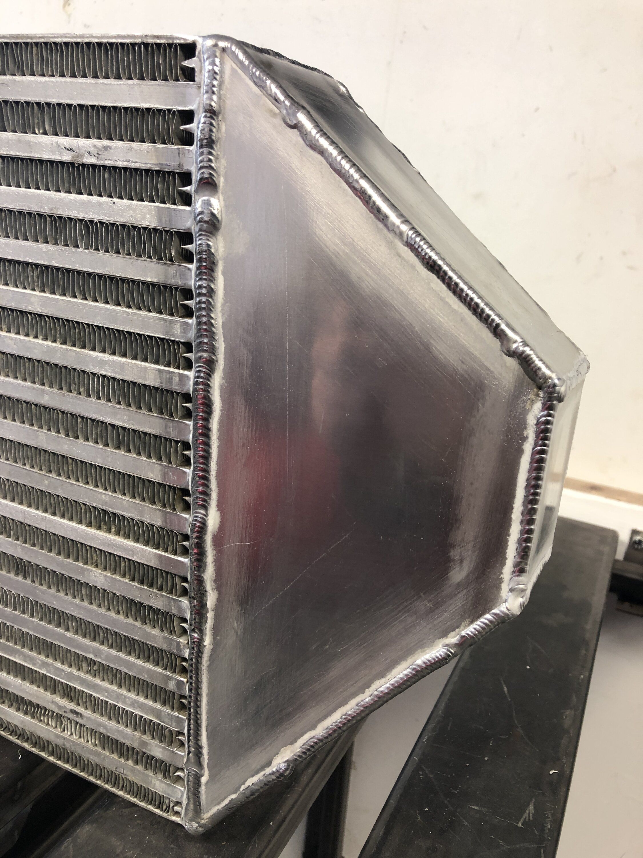

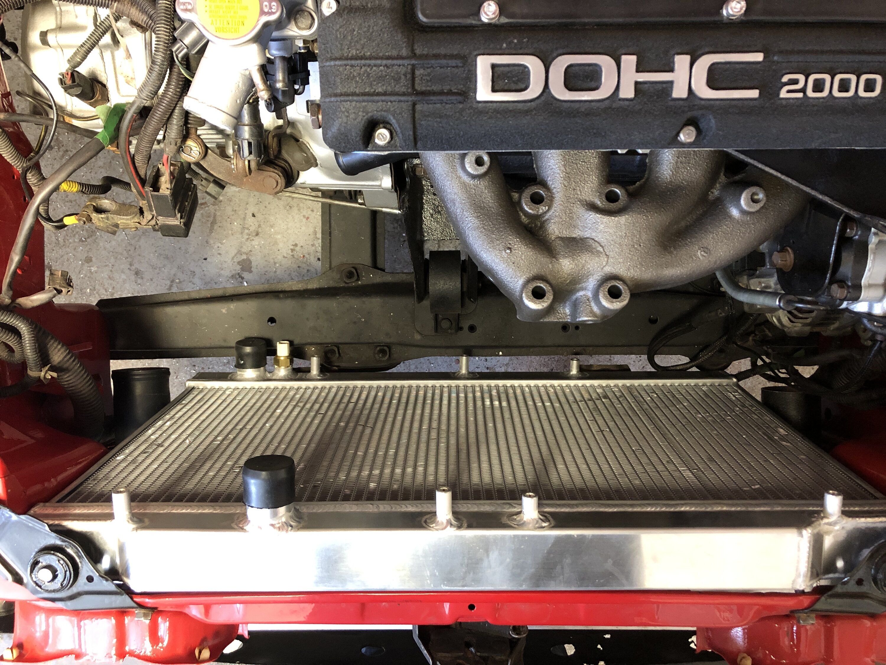

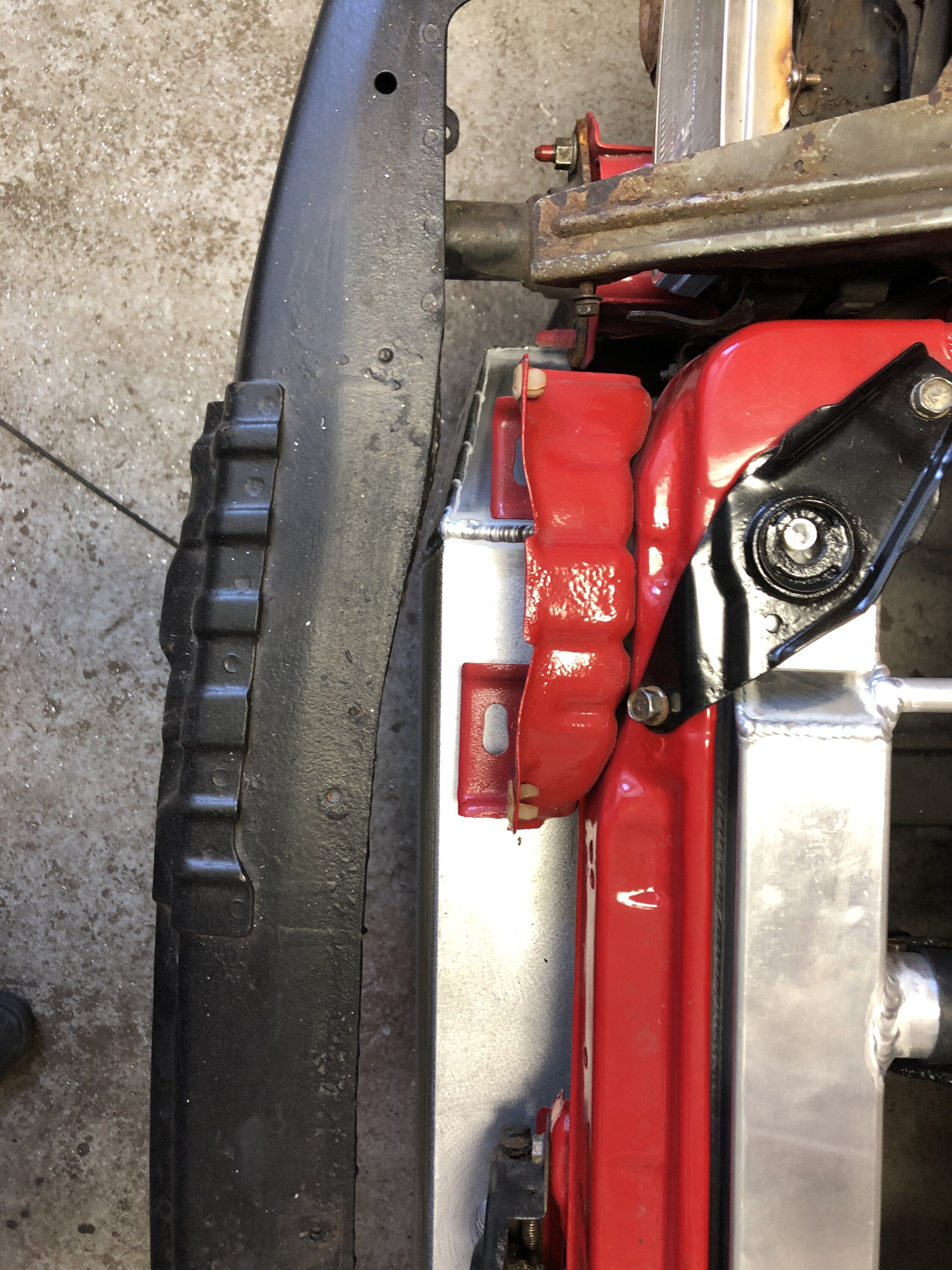

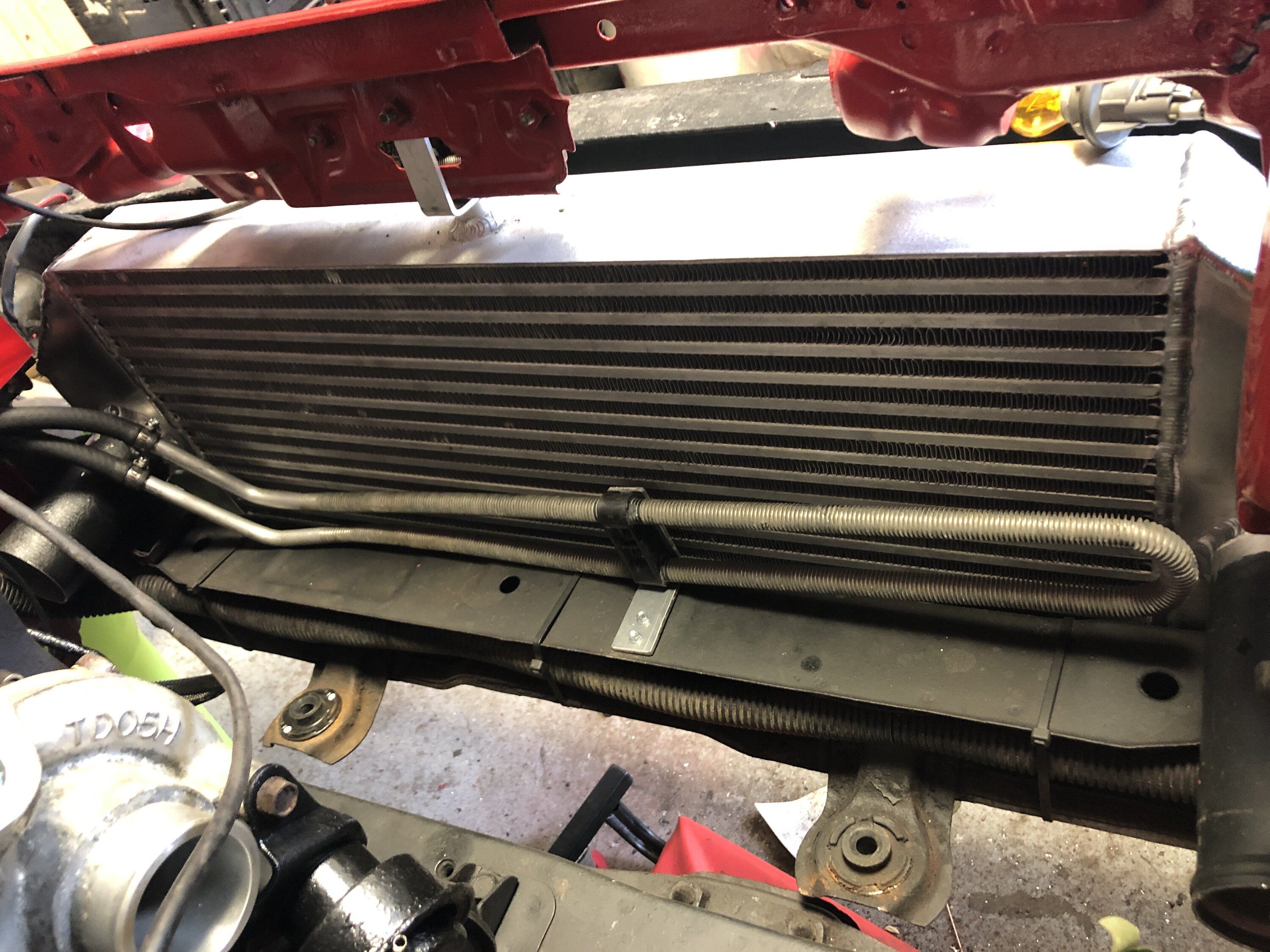

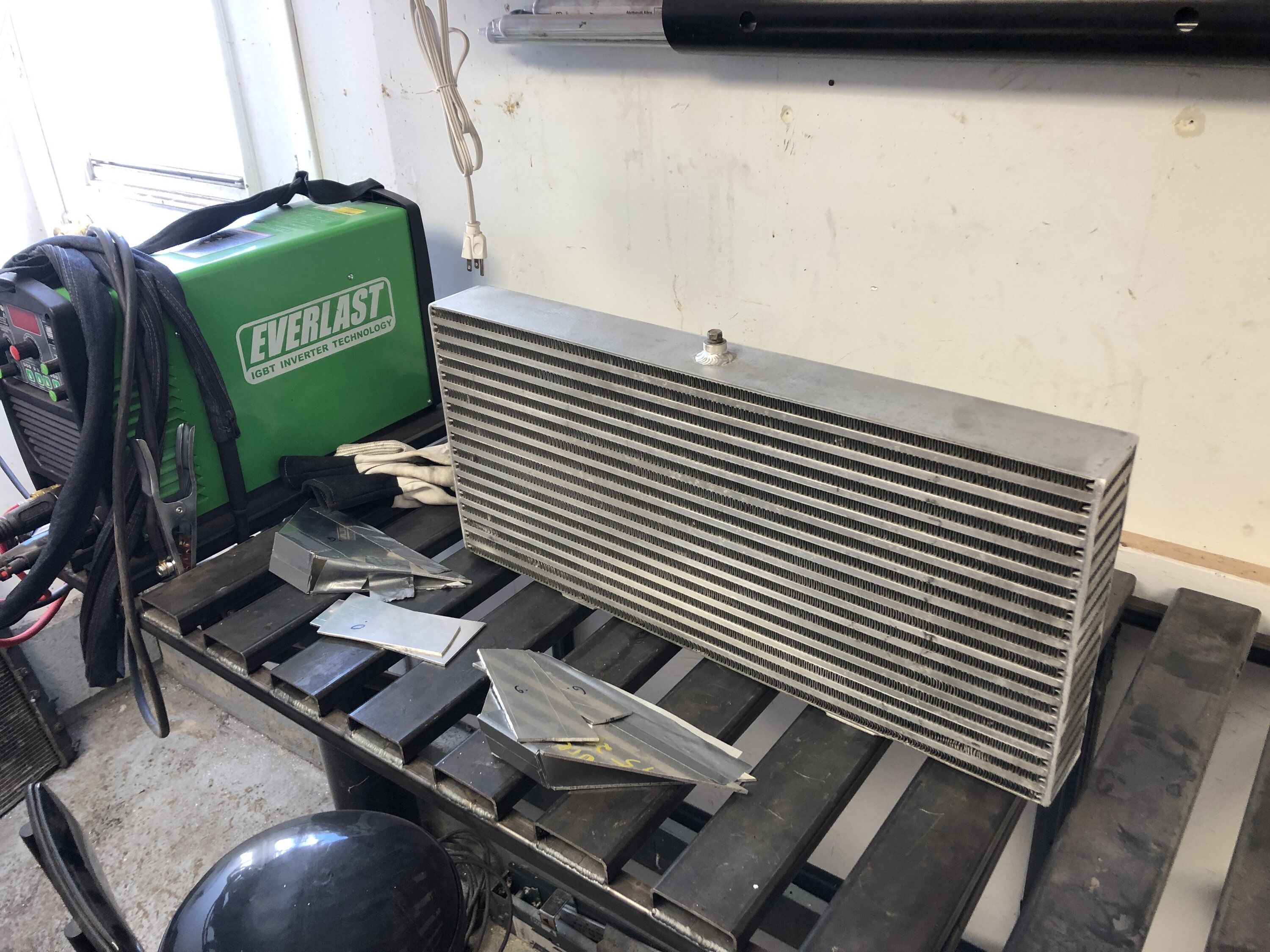

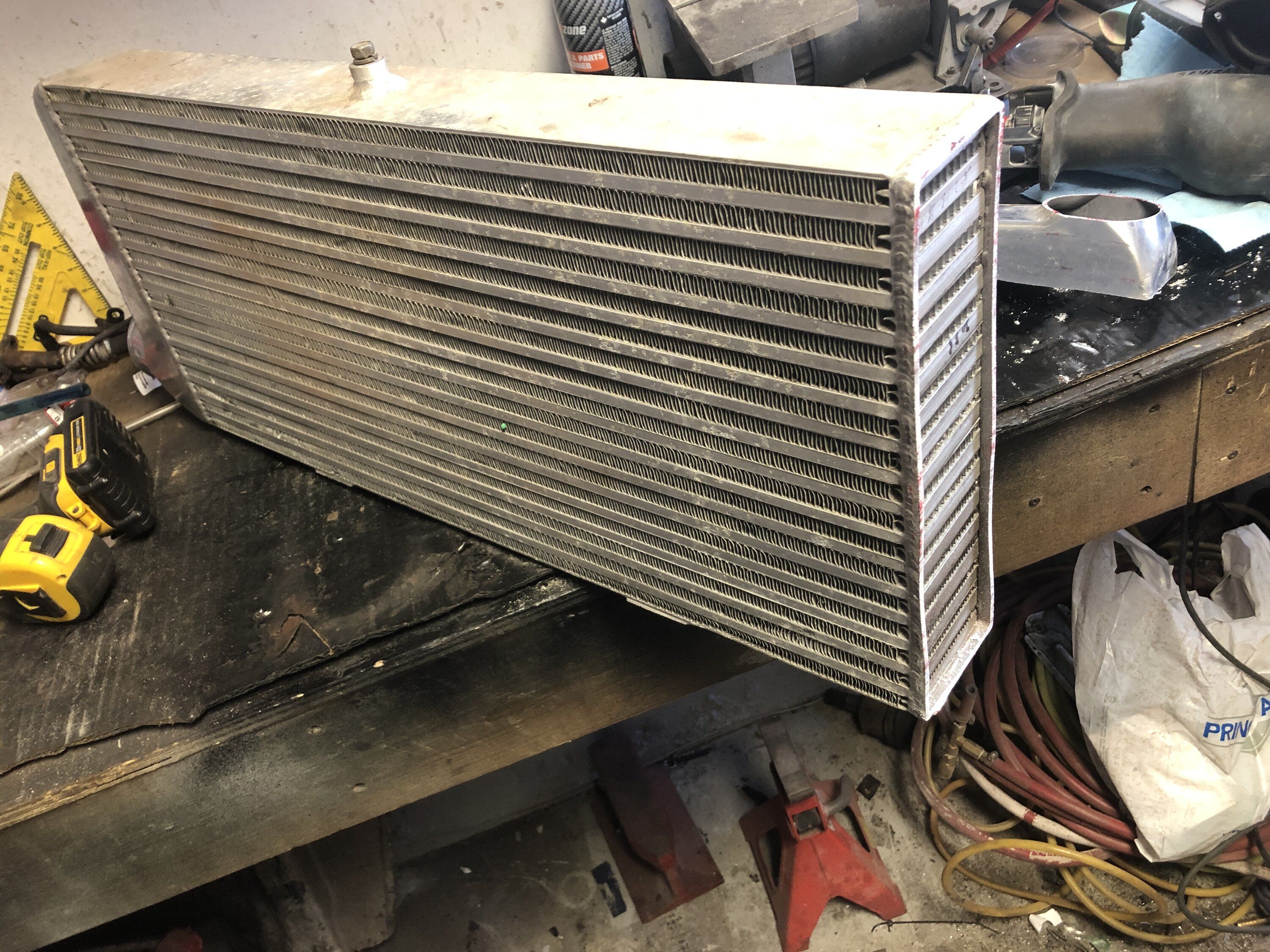

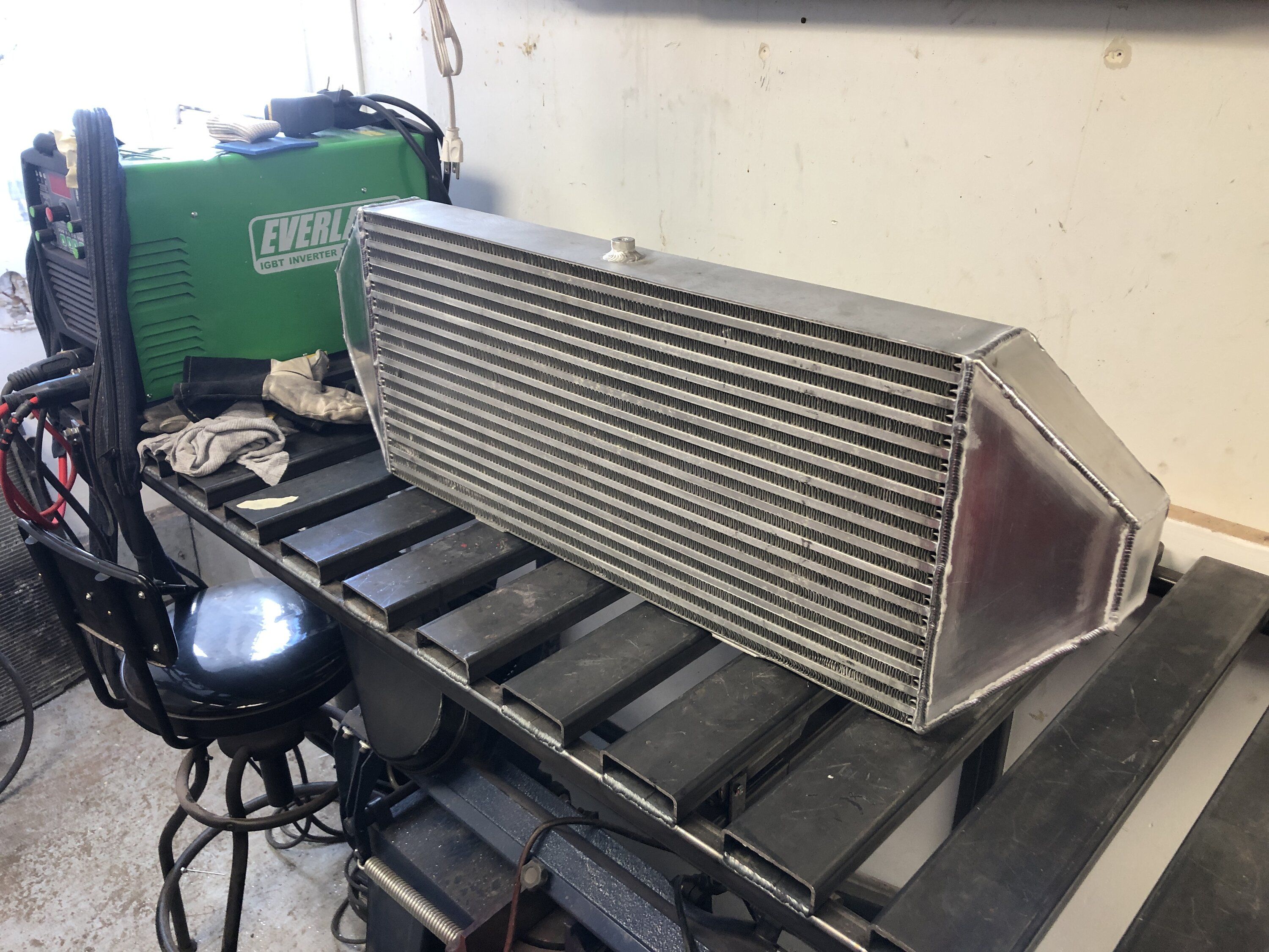

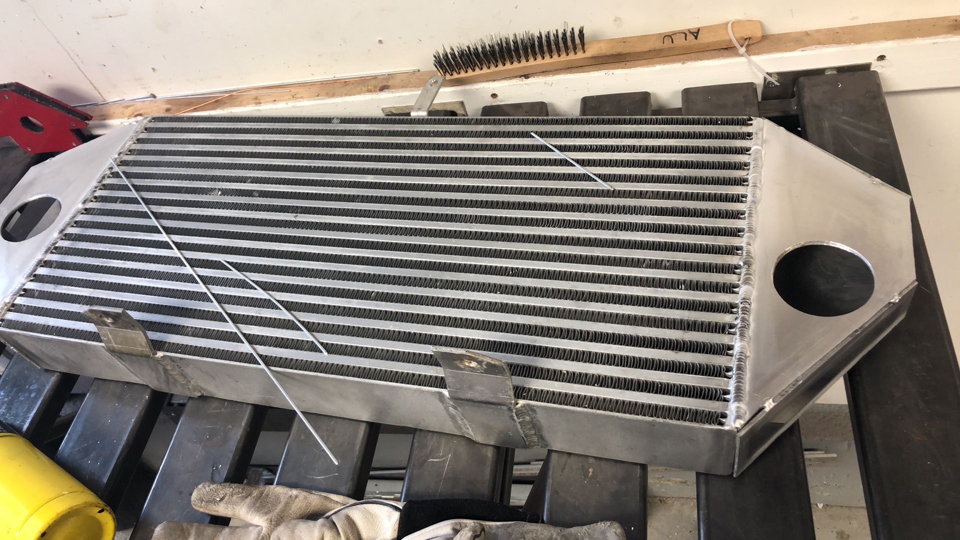

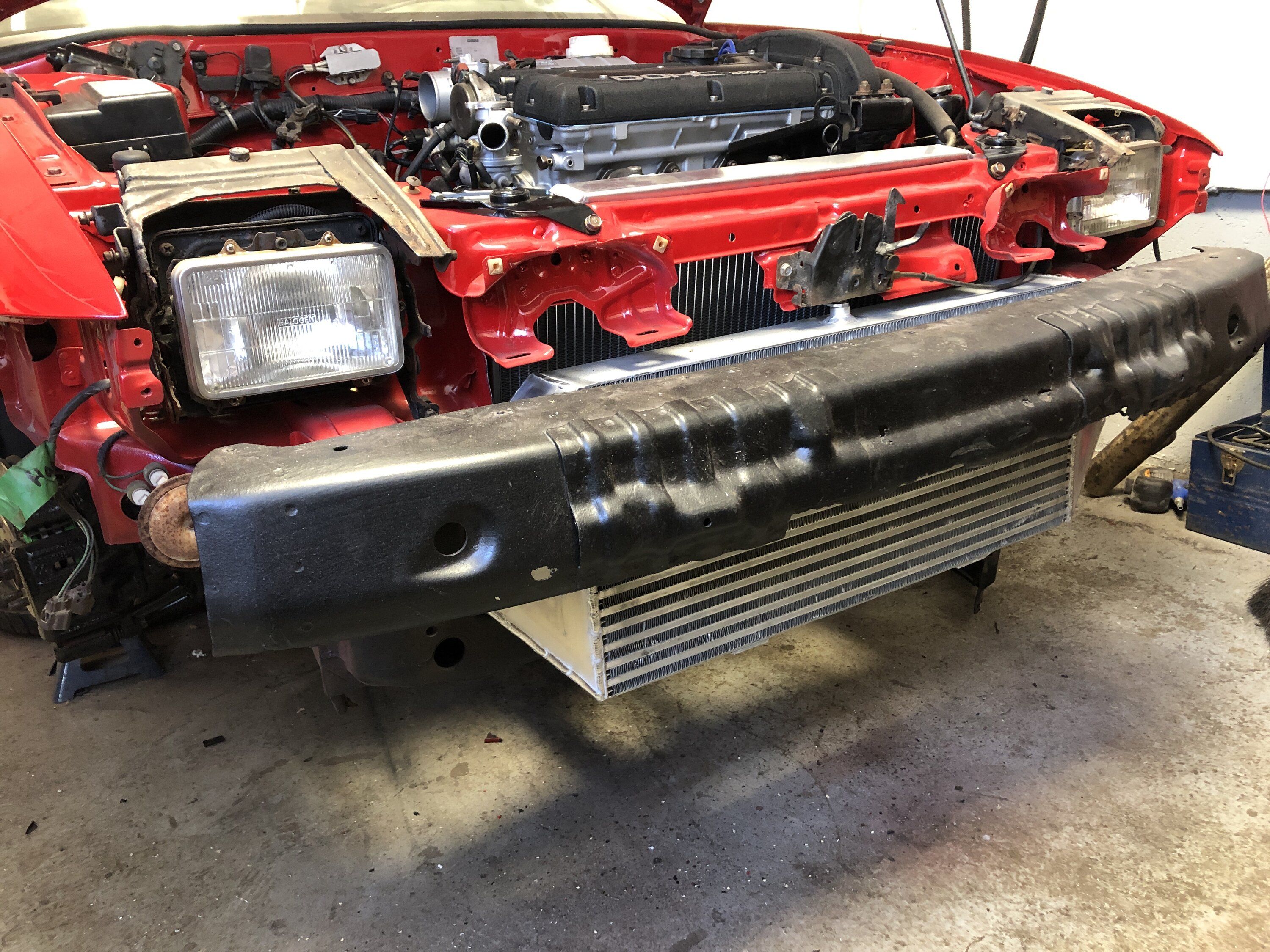

Before putting back the turbo, i found that my FMIC was not working with the stock location alternator and i do not want to move it behind the block.
Sooooo.. why not to hack it up and build a custom FMIC with this core! I'm always looking to weld something. I still need a lot of practice (self taught from youtube) but i've seen worst weld than mine.
And i wanted something to retain the factory crash bar.
IMG_7414.JPG IMG_7416.JPG IMG_7417.JPG IMG_7553.JPG IMG_7587.JPG IMG_7631.JPG IMG_7632.JPG IMG_7633.JPG IMG_7634.JPG IMG_7635.JPG IMG_7636.JPG IMG_7637.JPG IMG_7638.JPG
Next thing will be the intercooler piping (still dont know if i'll go aluminum or stainless), than the turbo back build.

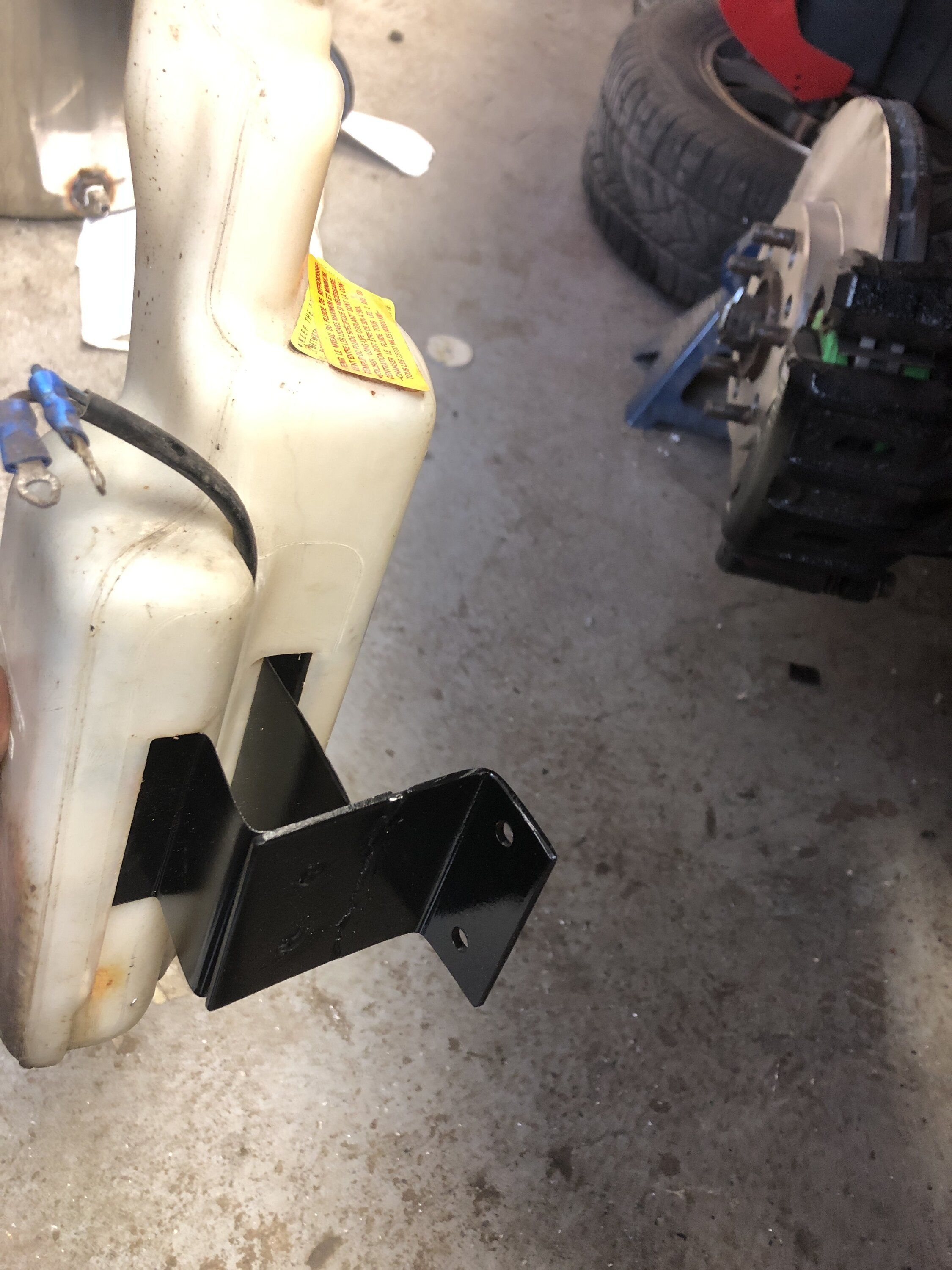

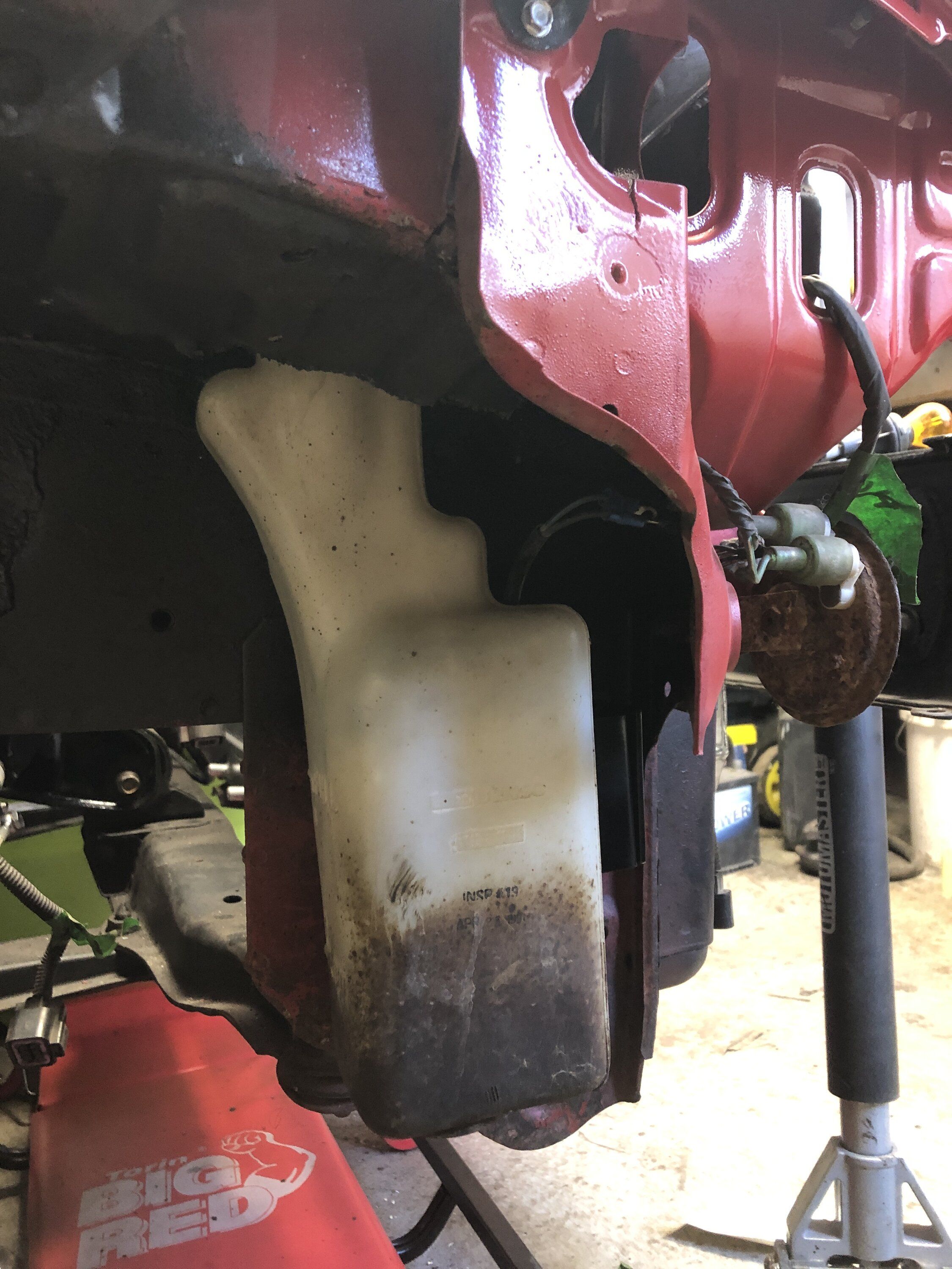

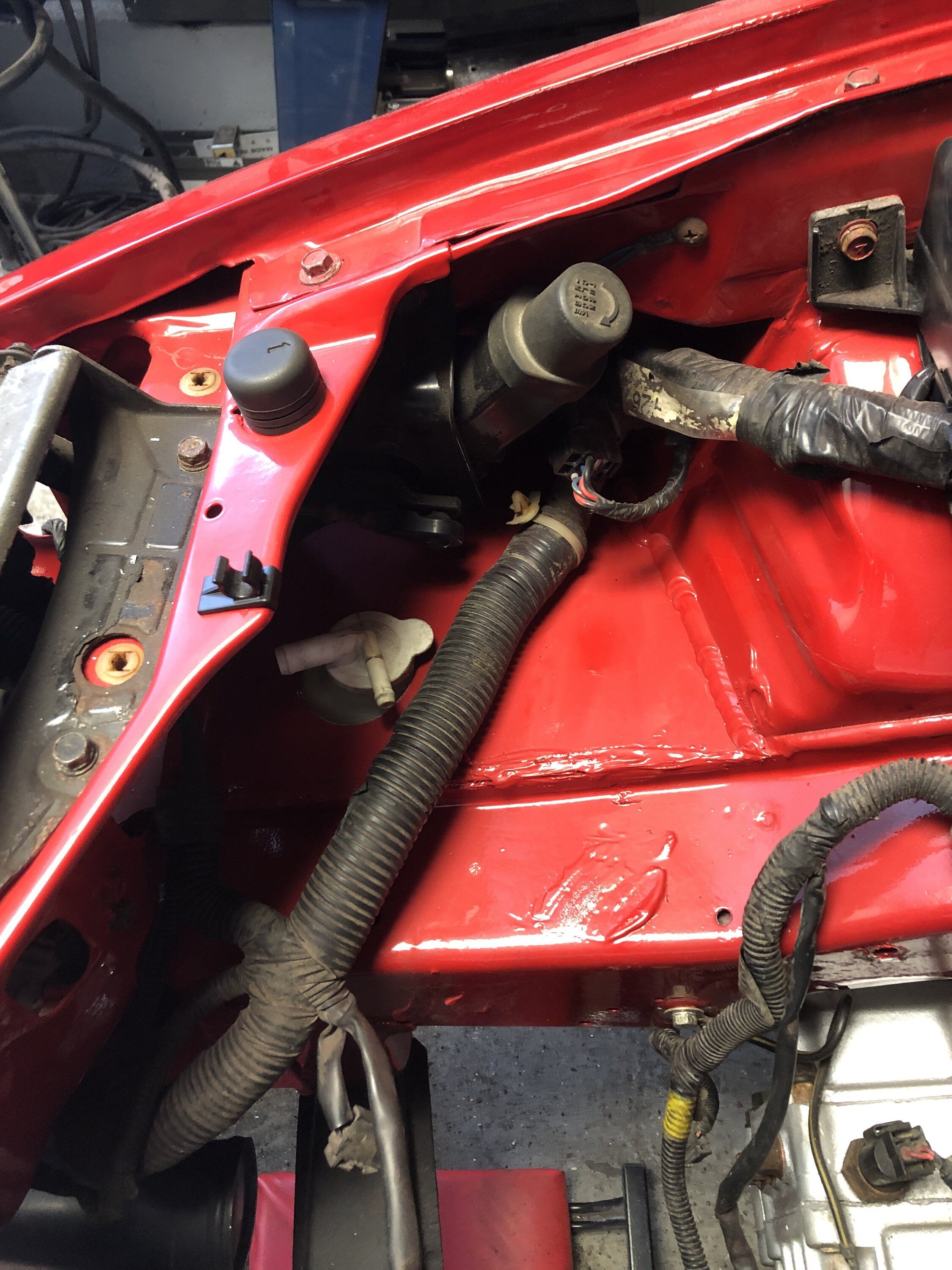

-relocated the overflow tank under the fender (need space for fmic piping)

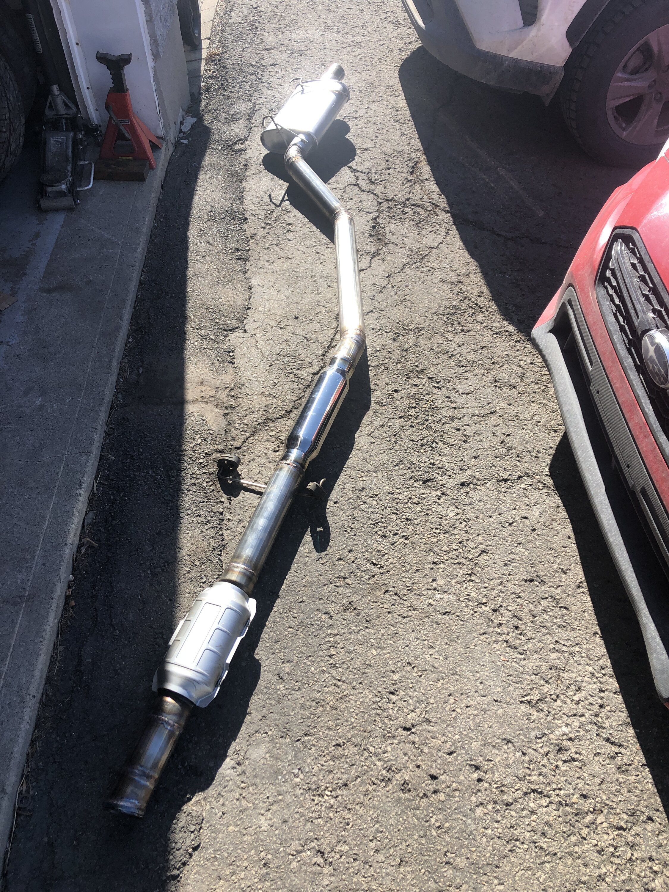

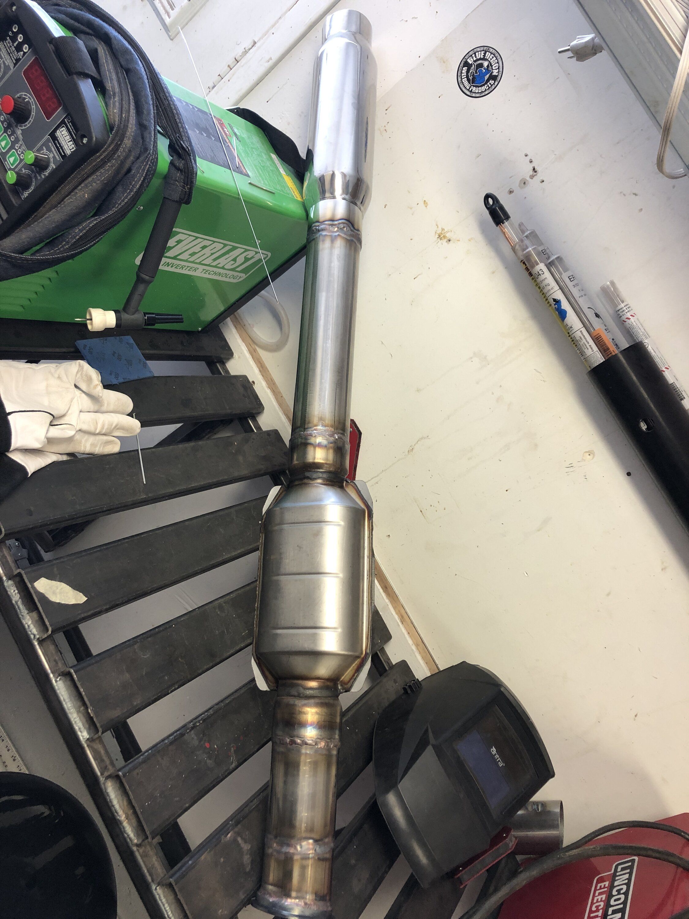

-Finally had time to build the exhaust

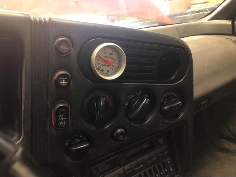

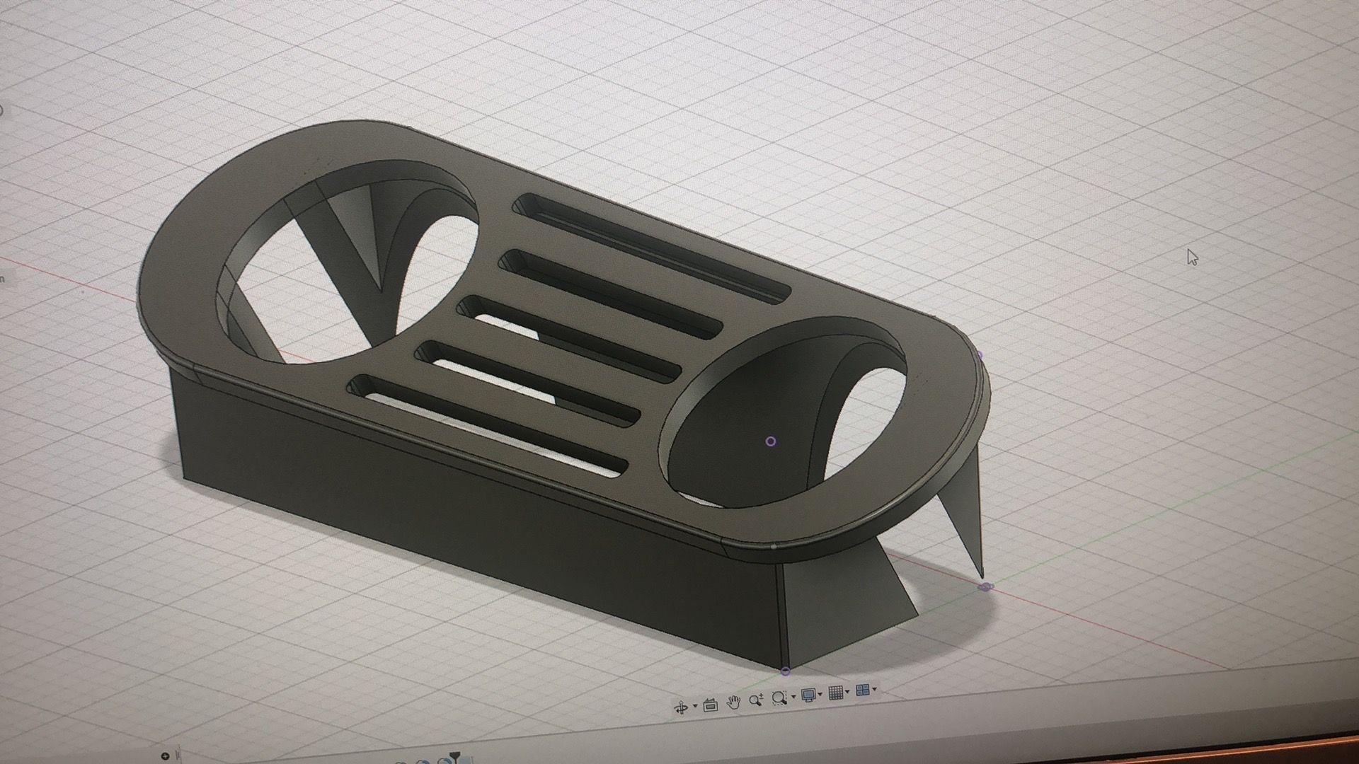

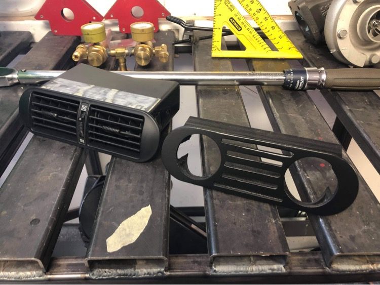

-First time sketching something in 3D, i draw a gauge holder for the center vent. Had a friend with a 3d printer to print it for me. Came out really nice

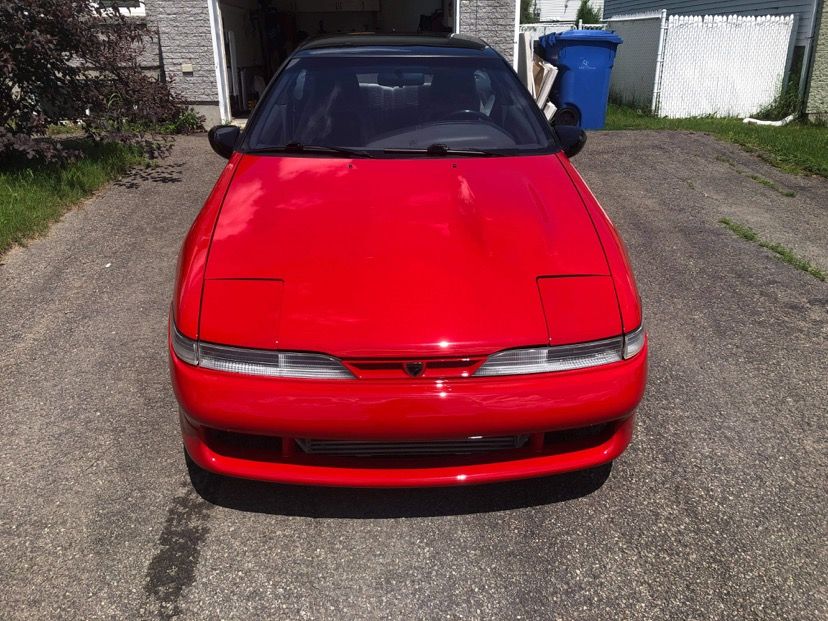

Hey..! i do not know where to start... Been a long time from my last visit on DSMTuners..!
Crazy year.. new project.. lot of stuff happen.

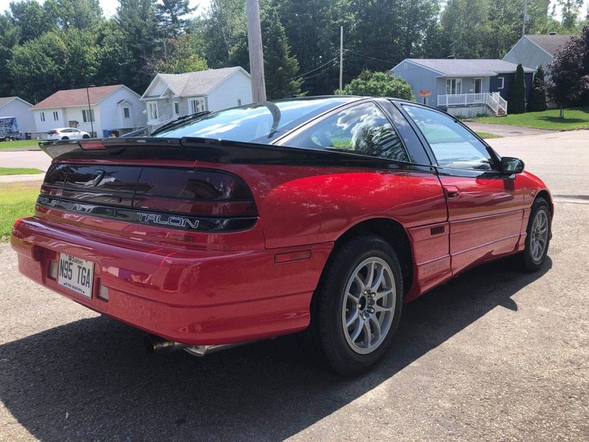

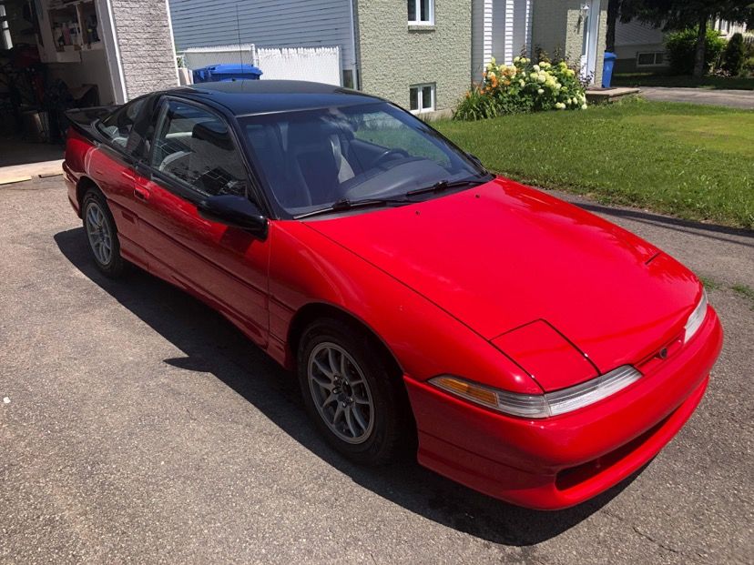

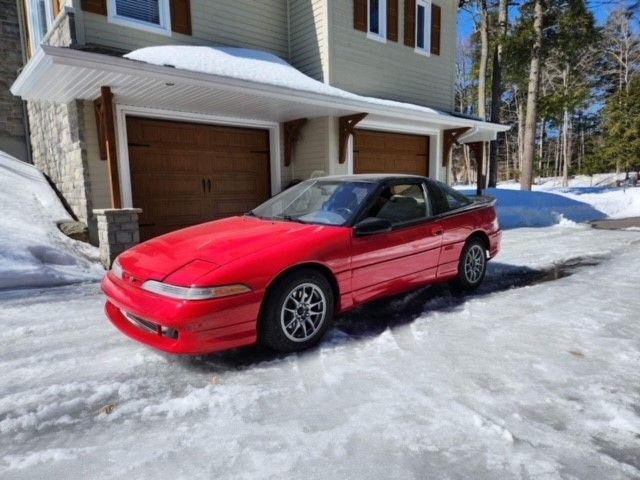

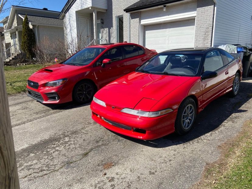

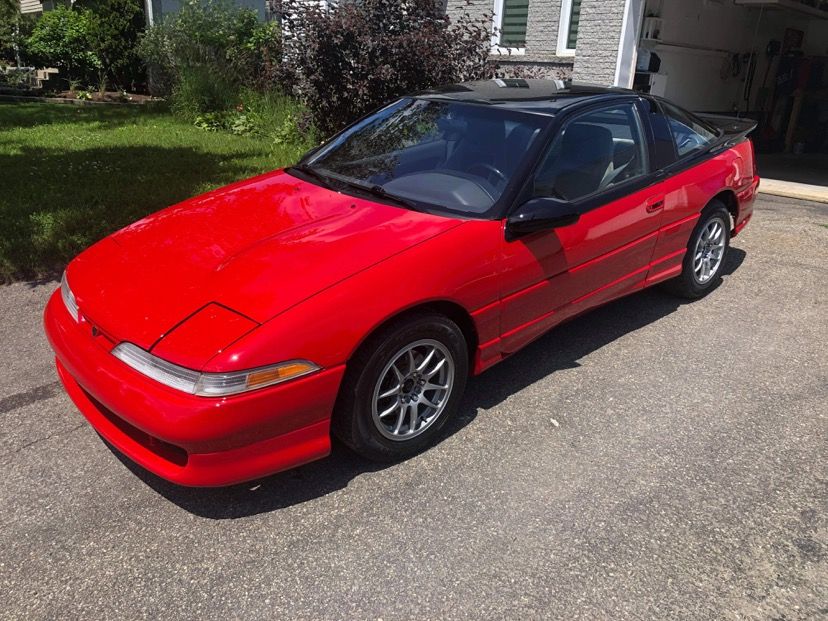

So the 1G was done late last summer, and i forgot to upload at least the last photos. It is running like a charm, no issue at all.
I'm really proud of that project, it was the most challenging one. Had a few build under the belt but never took an entire cars appart like this one.

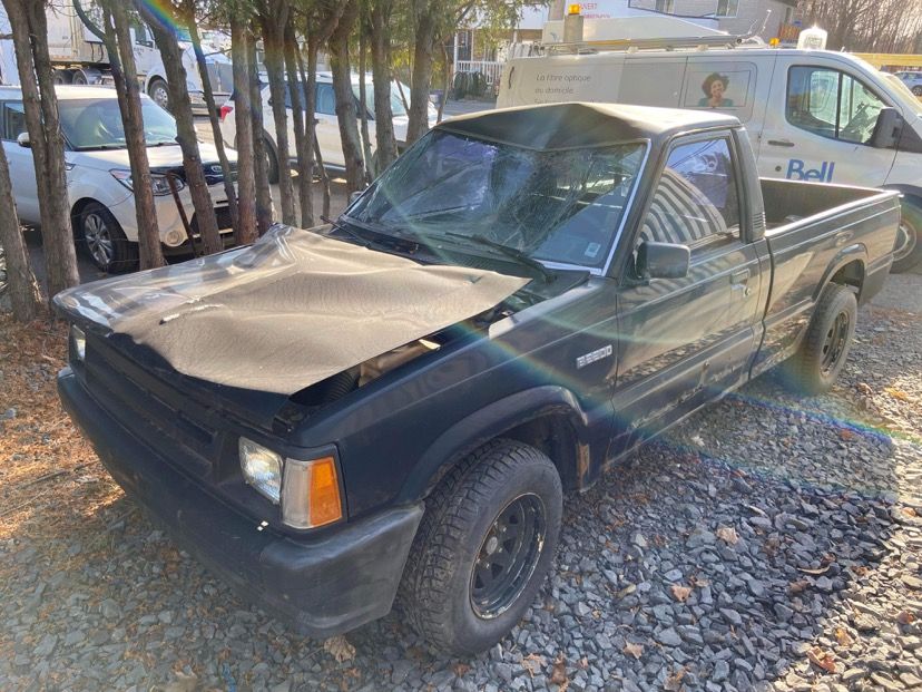

As i was working late autumn (insurance field adjuster) i often visit tow yard for the job.. thats when i step accros a lonely beauty..

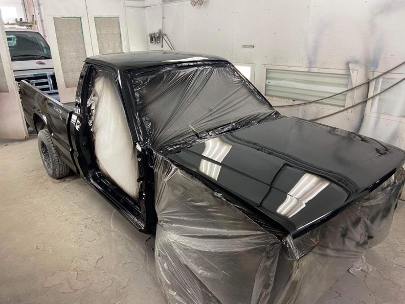

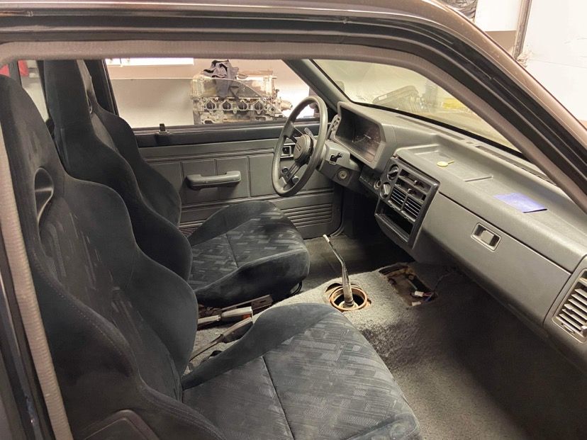

It was sitting here for some years.. Sadly a tree fell on it but it was in a super good condition. Took it home, did all the body work and im now working on the mechanic.

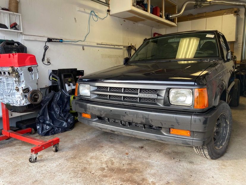

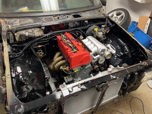

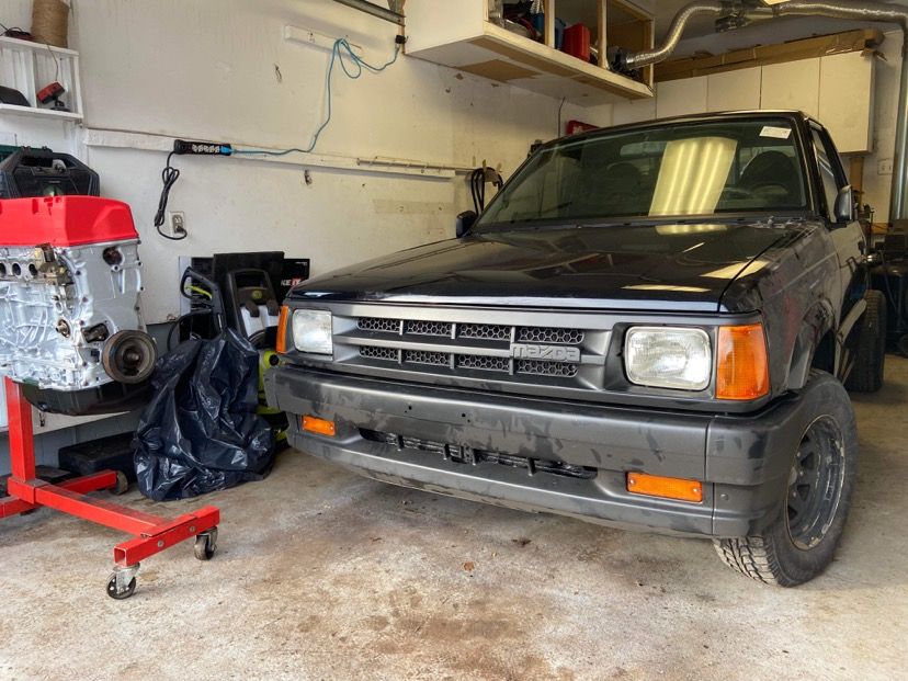

I assure you that i was planning to 4G63 swap it but DSM parts starting to get rare here. So i'm back to my old love... Honda engine..
1991 Mazda B2200 short cab/short bed
Honda K24 engine
Ford 8.8 LSD rear diff
Still looking for tranny choice, should be BMW ZF/Getrag or Nissan CD009
Enjoy..! As i am :D

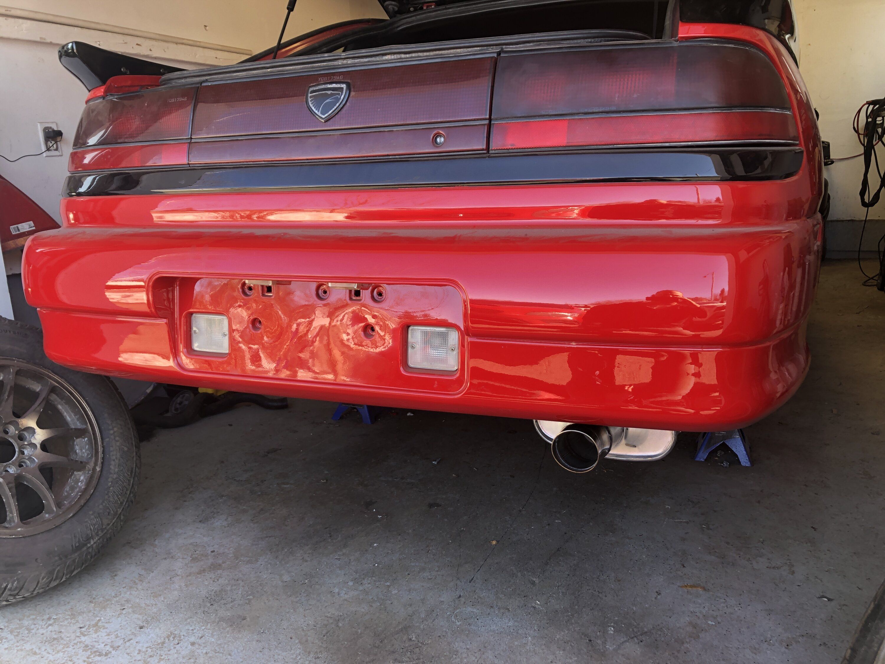

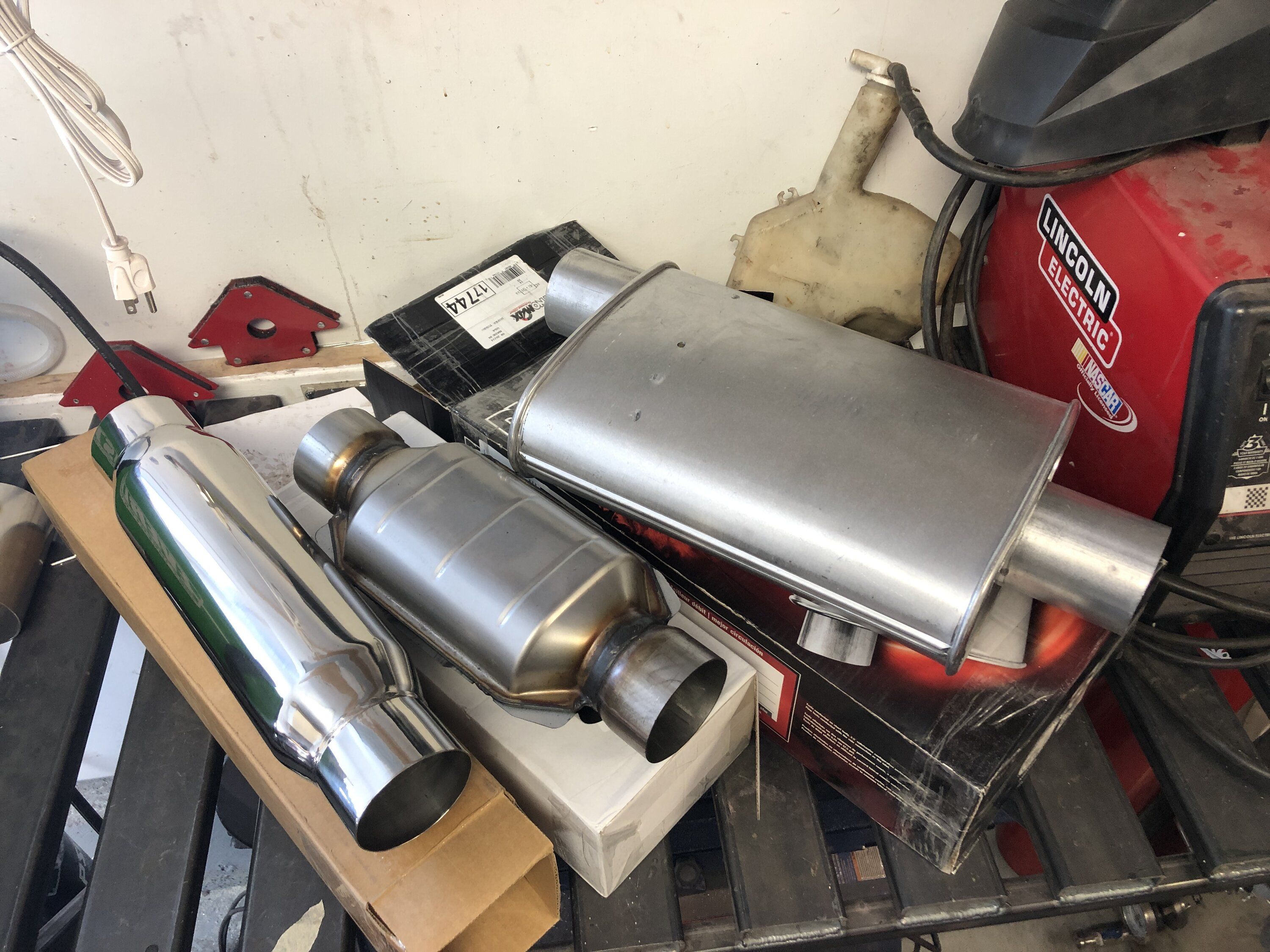

would you mind giving more info on your exhaust/muffler system you built? How is it as far as sound/droning?
I build it with leftover 3" pipe from my last 2G exhaust build.
It had a cheap universal yokana 12" resonator paired with a Dynomax super turbo #17744.
And i used a high flow 3" yonaka catalytic converter.
It made a cheap and good sounding exhaust. Quiet without any drone.
