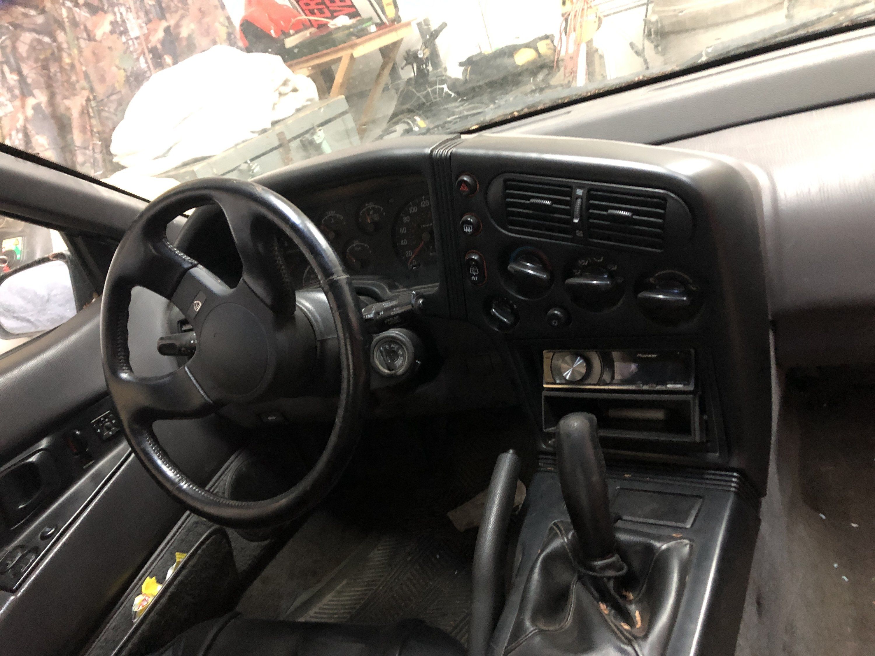

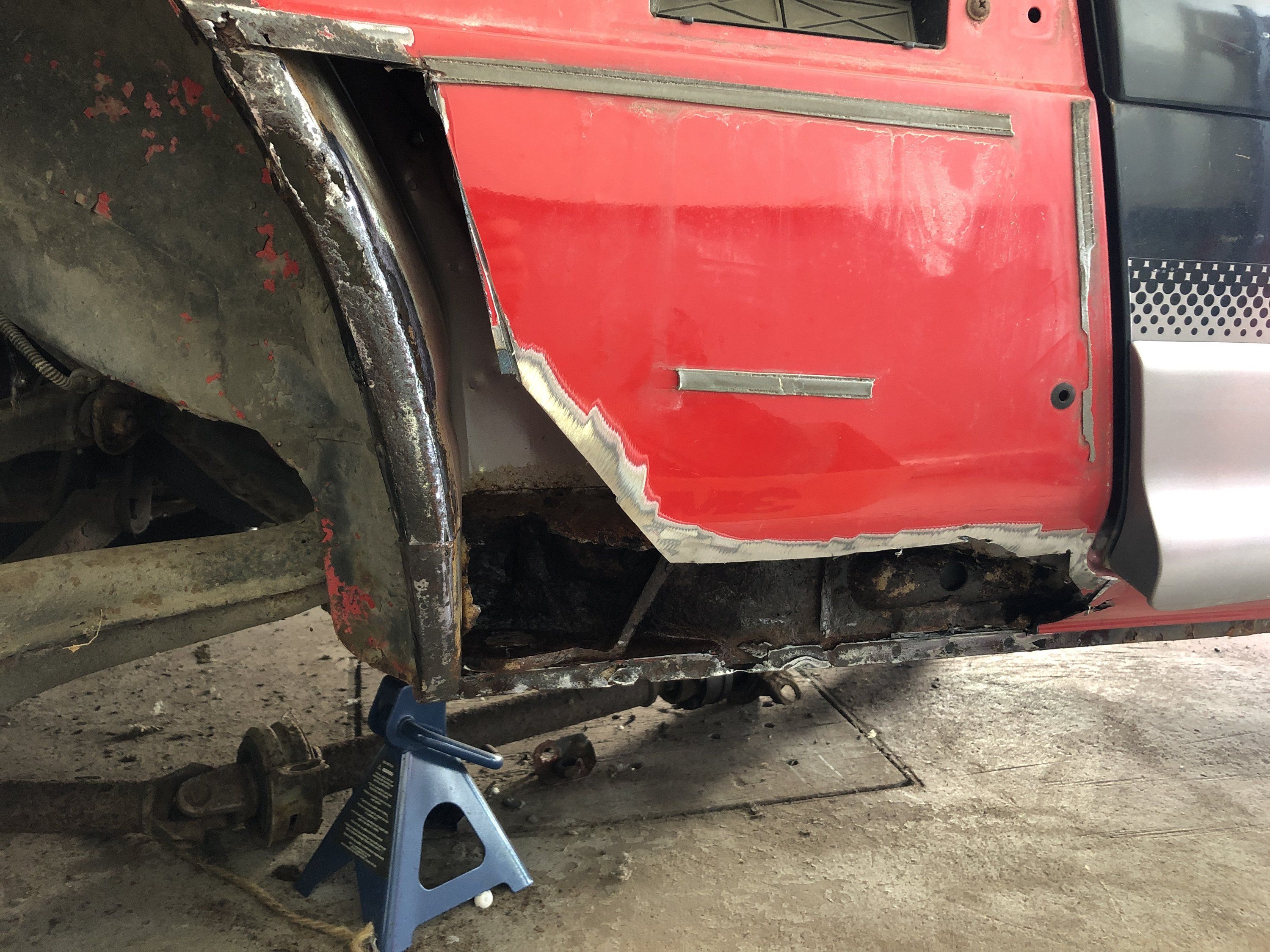

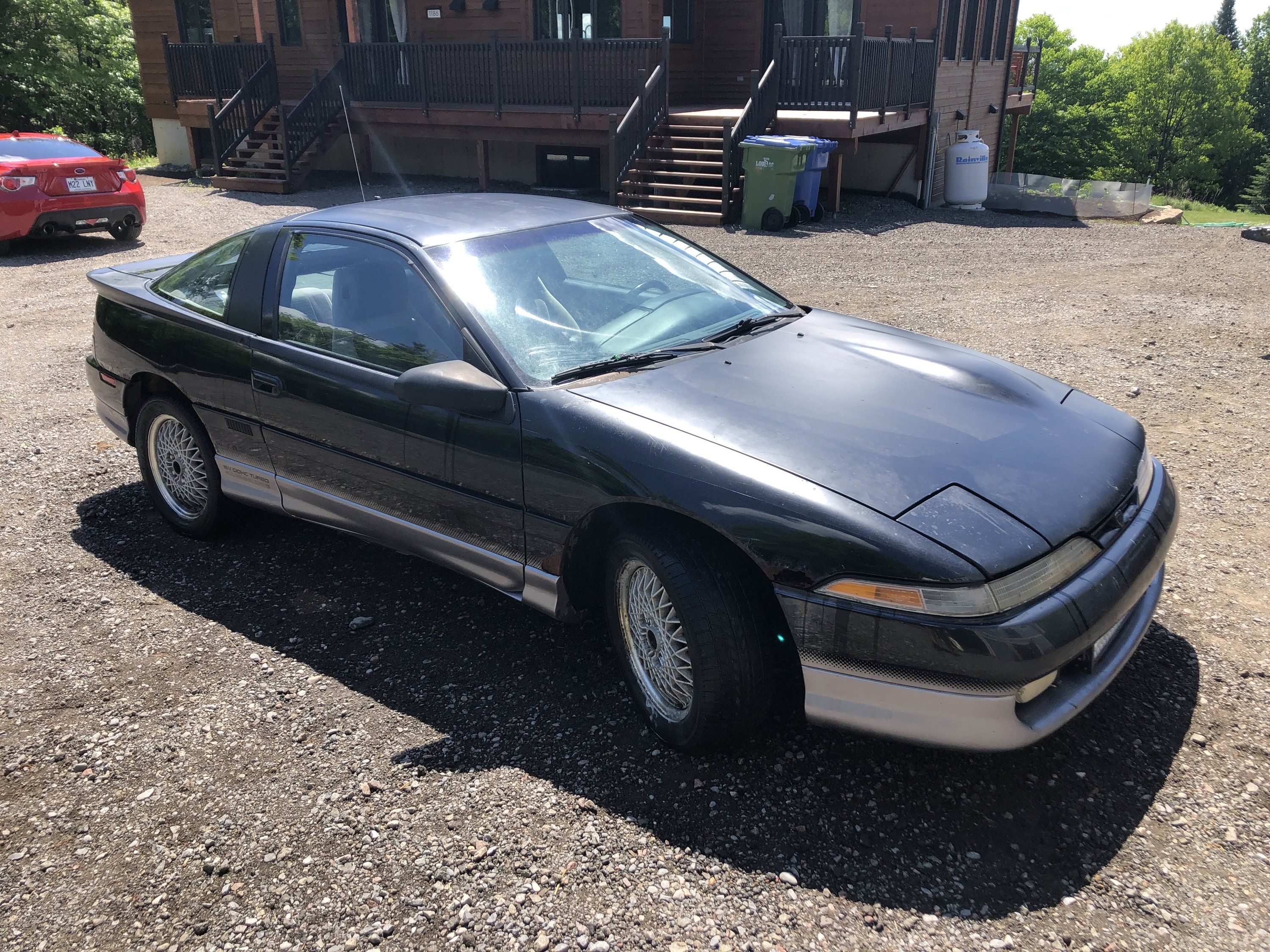

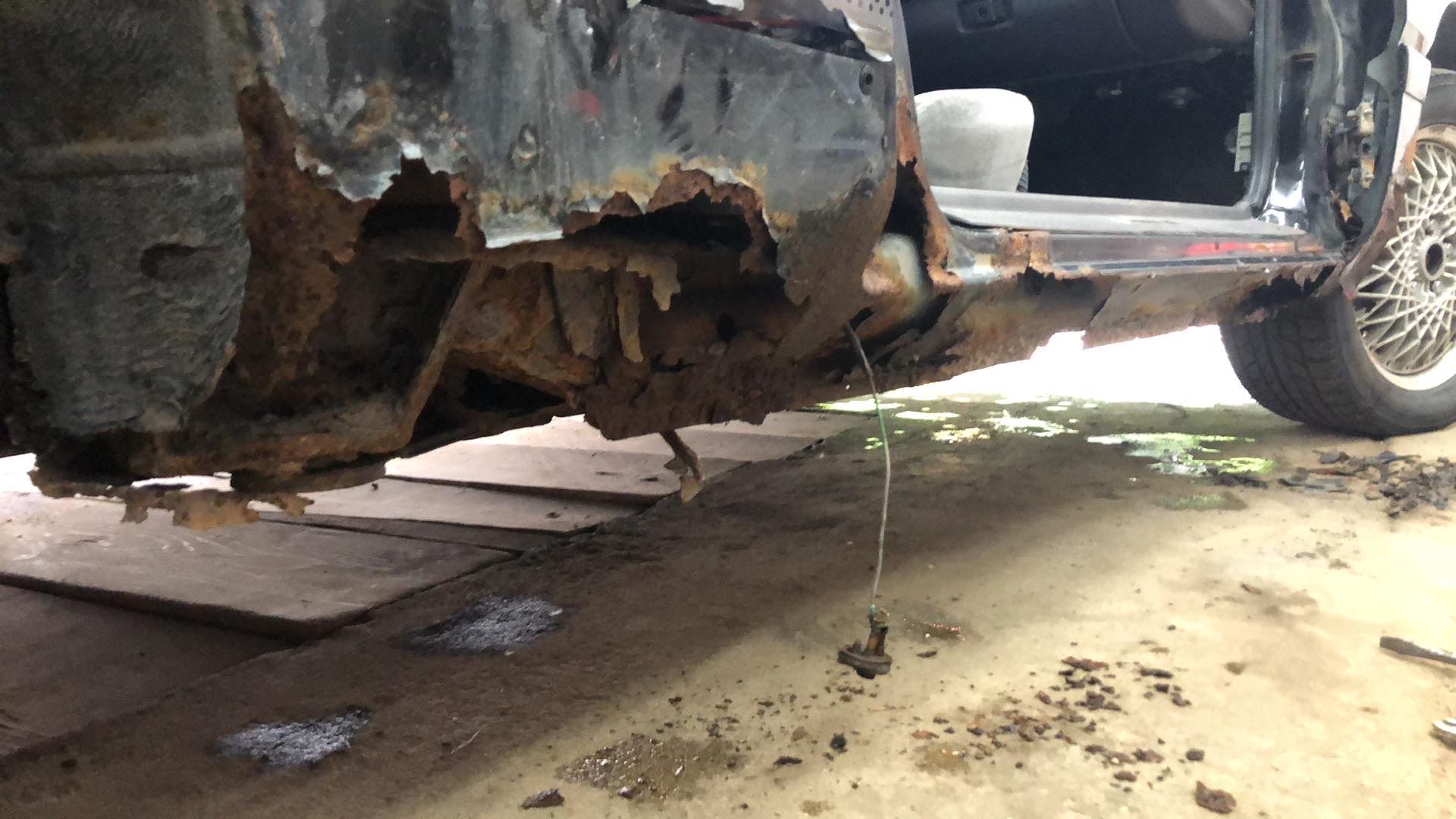

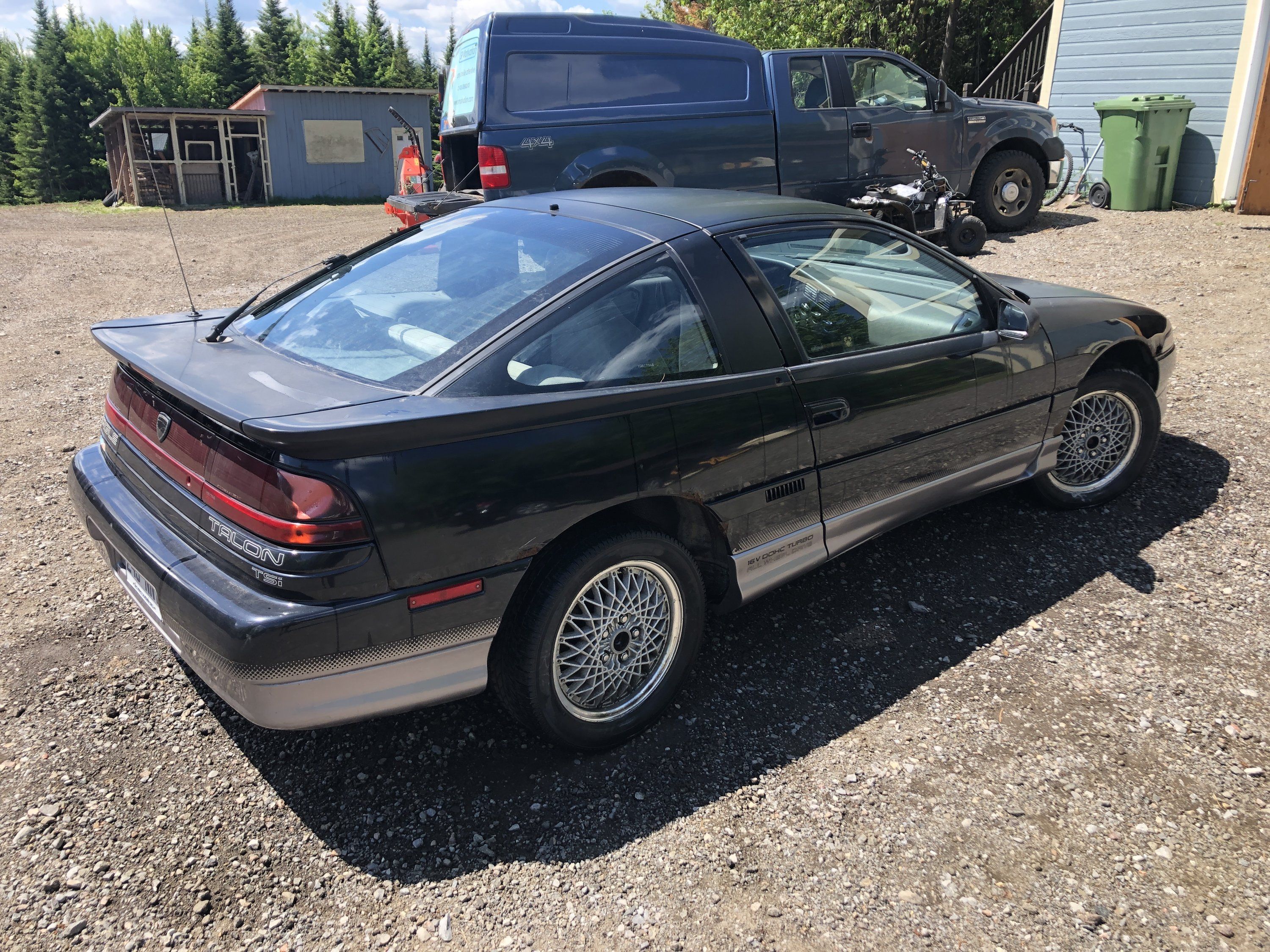

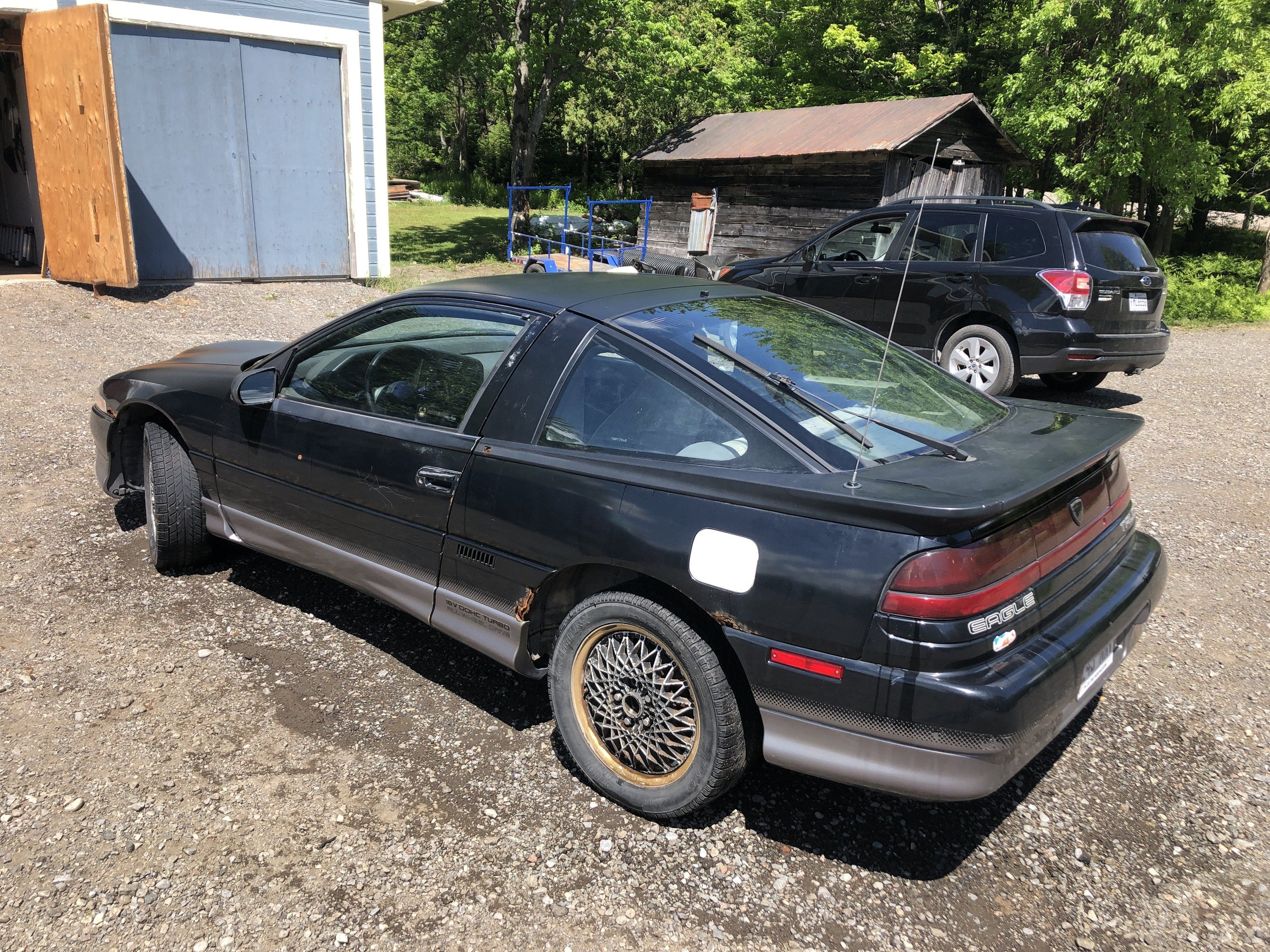

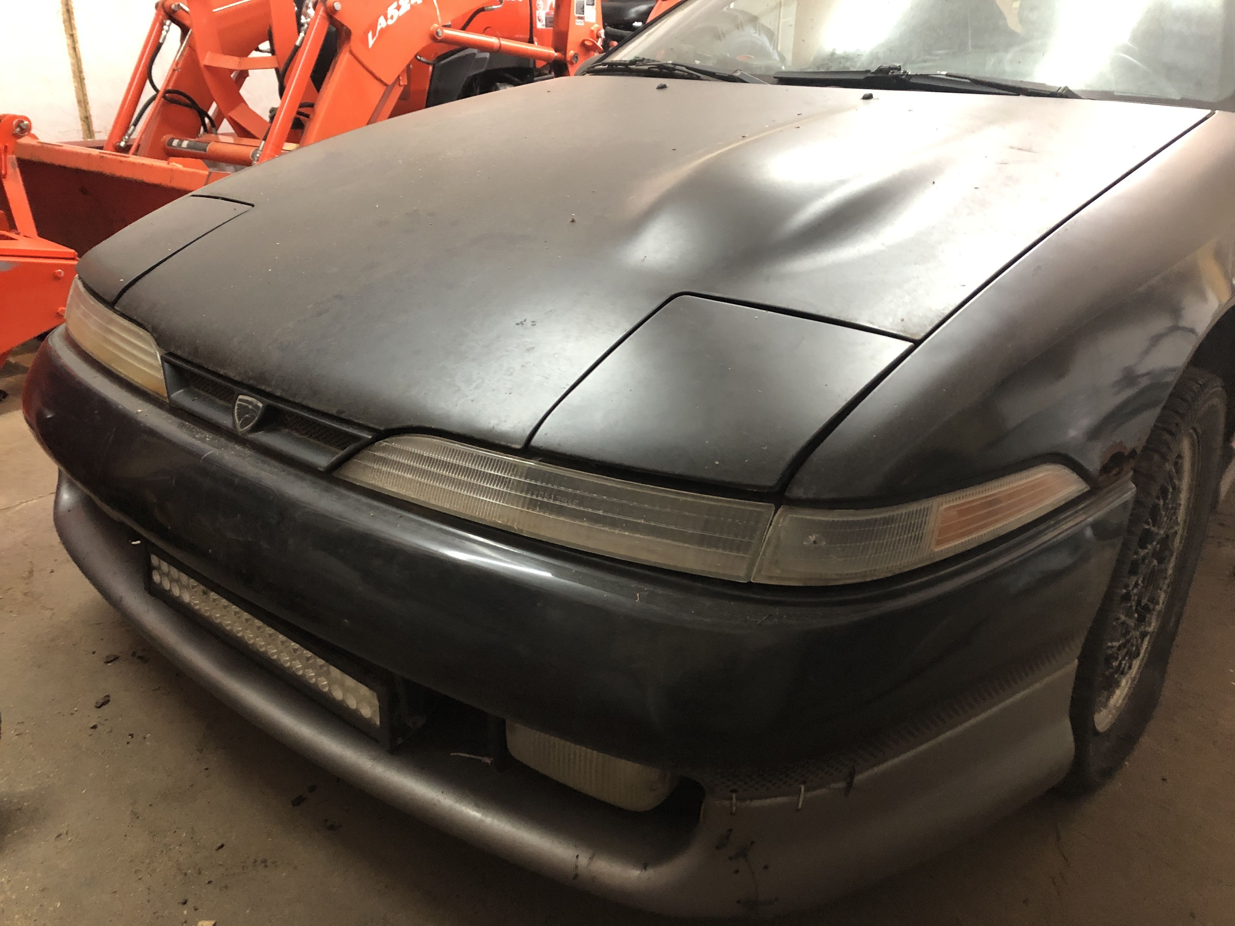

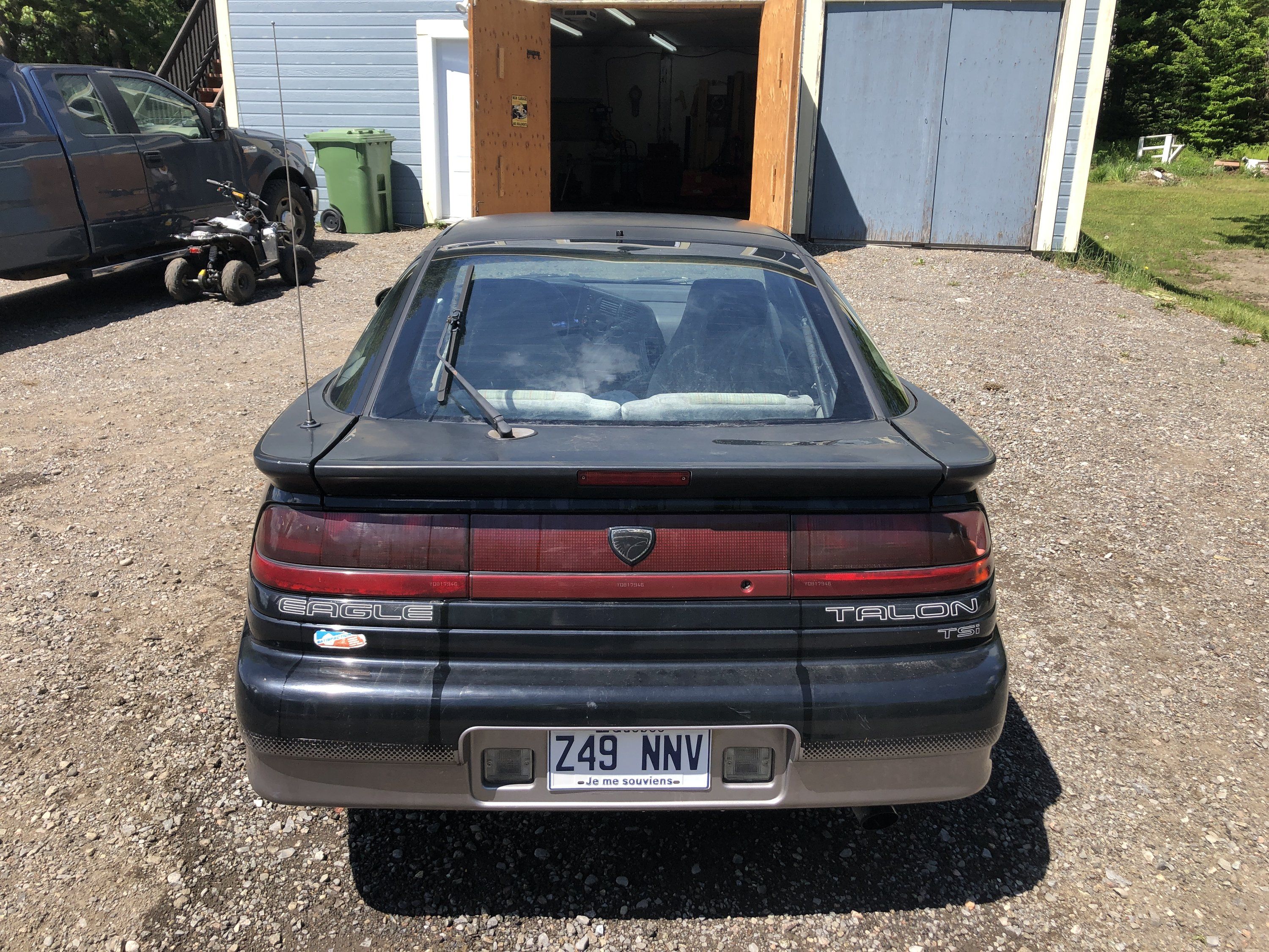

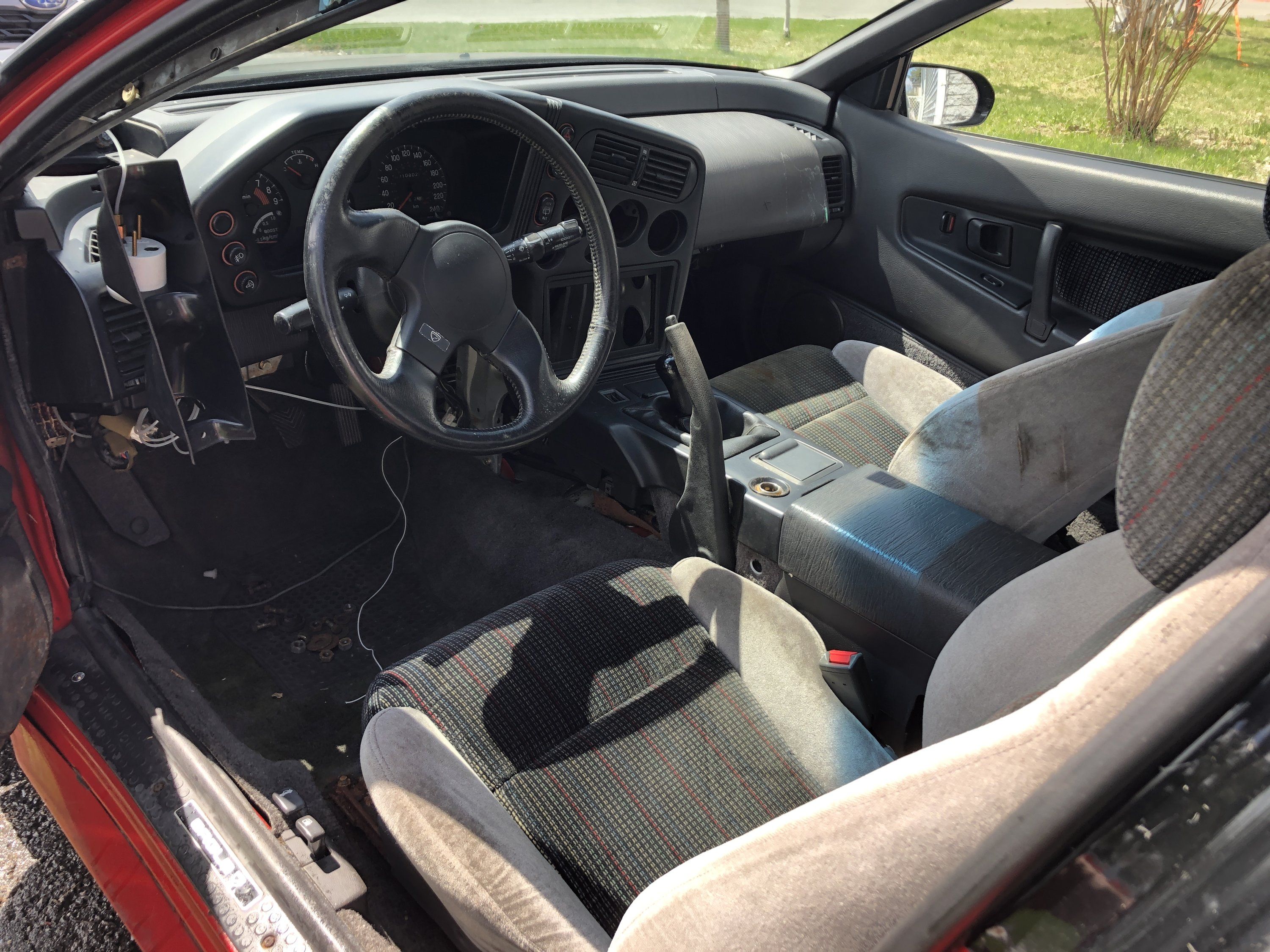

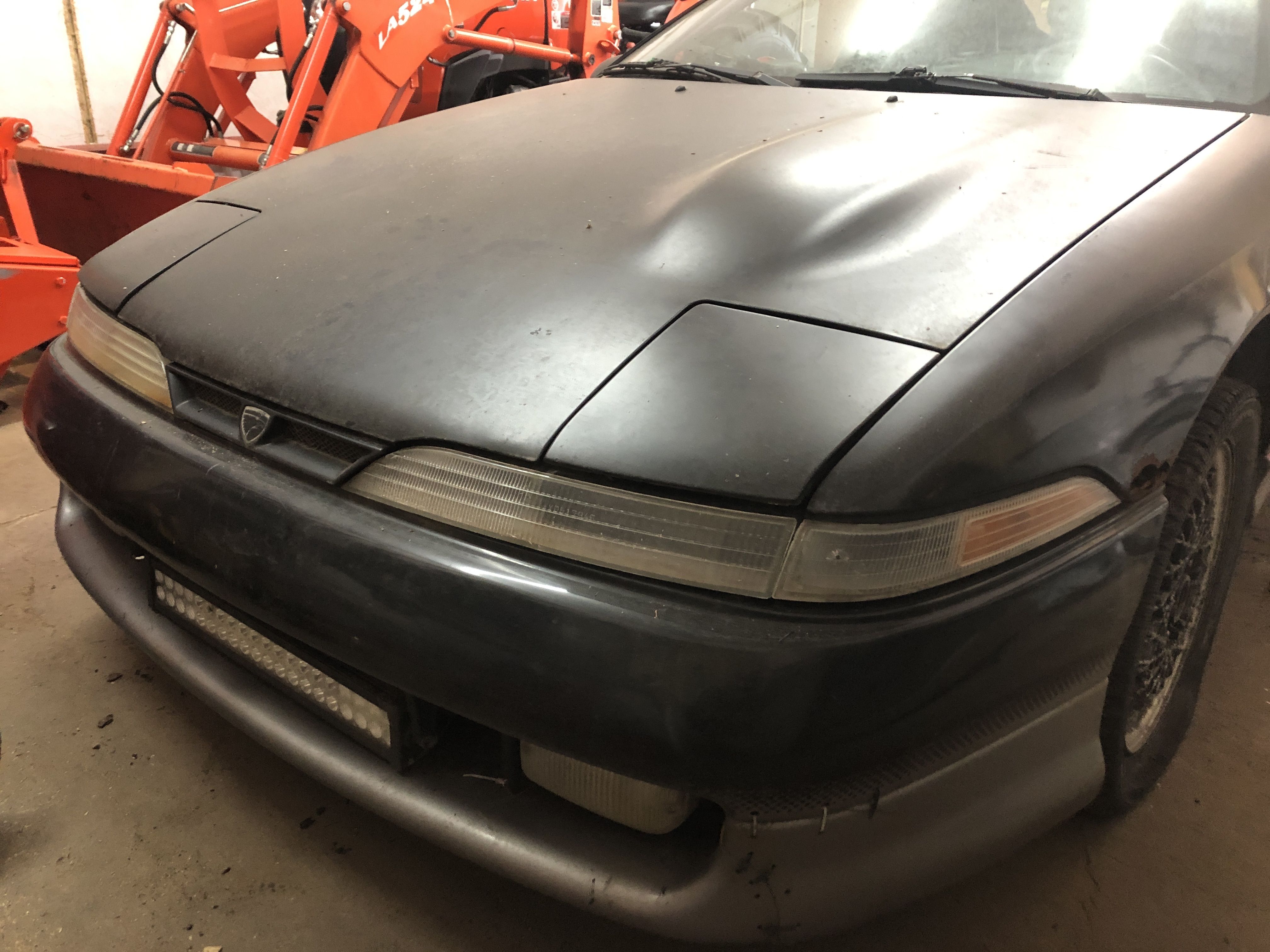

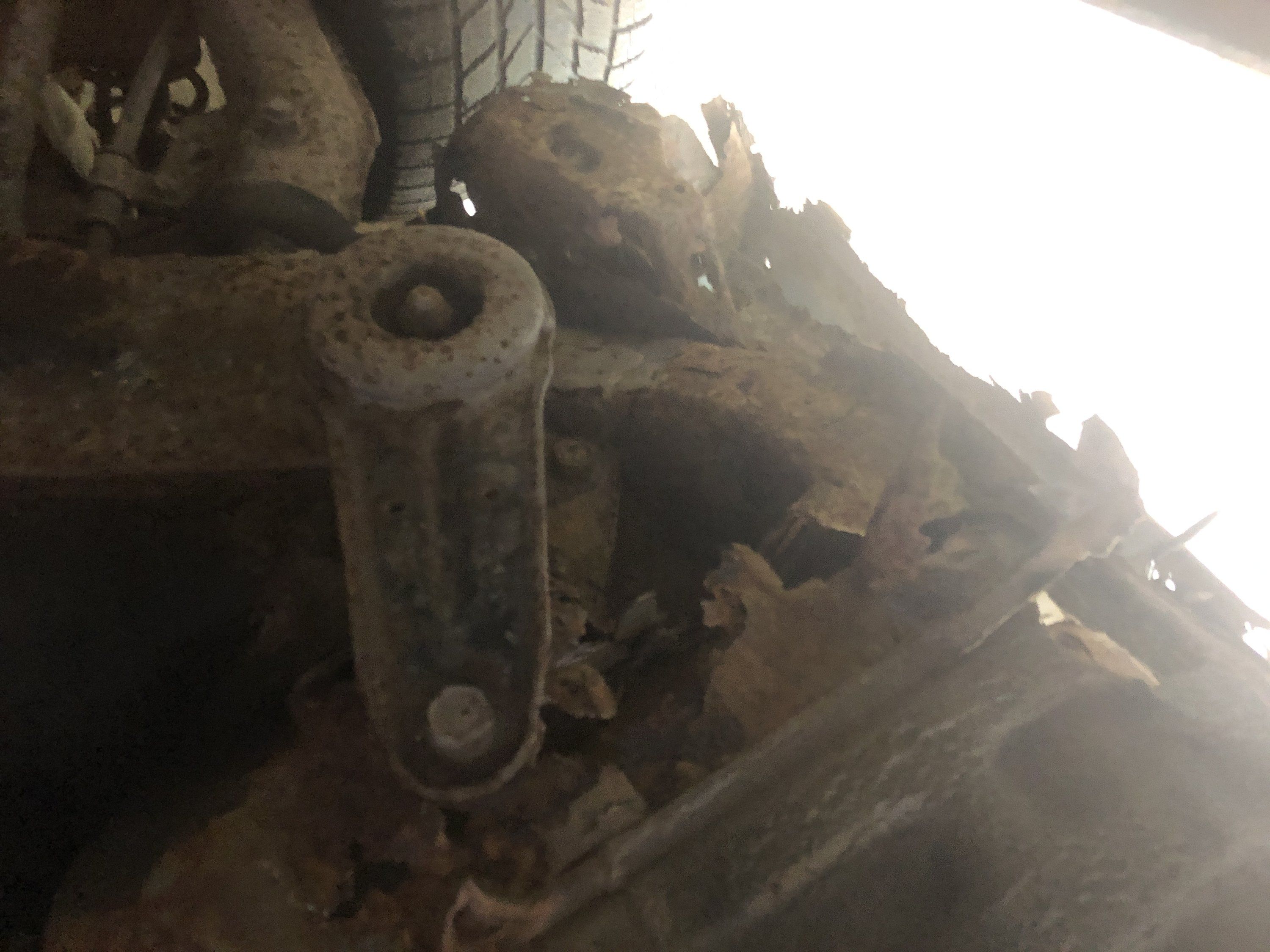

So i bought last december an all stock 1GA TSi AWD with a nice and clean interior and a good running engine.
With, A LOT , of canadian weight reduction. (AKA a damn rusty-rotten shell).
IMG_1690.JPG IMG_1691.JPG IMG_1692.JPG IMG_1693.JPG IMG_1694.JPG IMG_1696.JPG IMG_7666 - Copie.JPG IMG_7667 - Copie.JPG

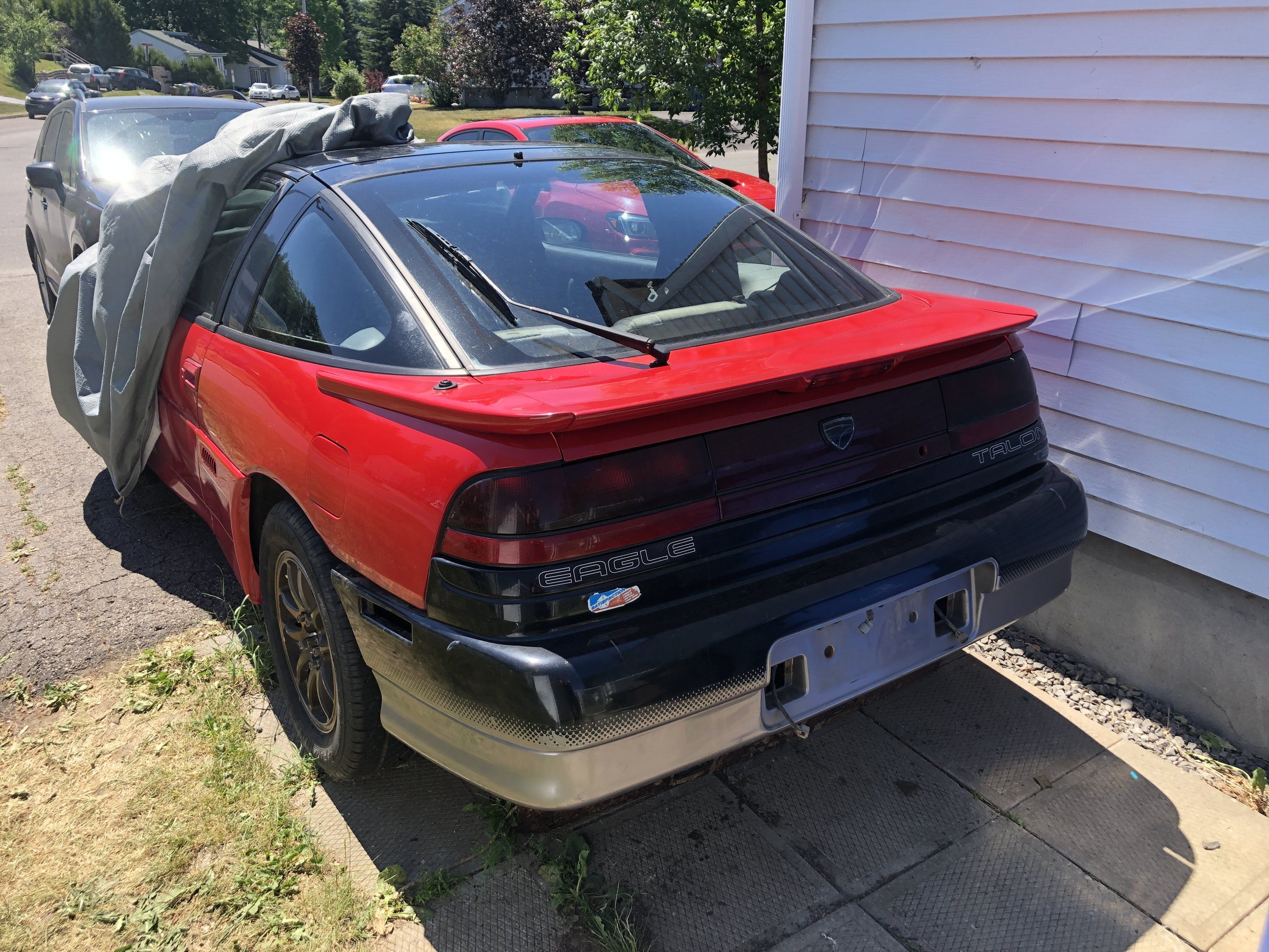

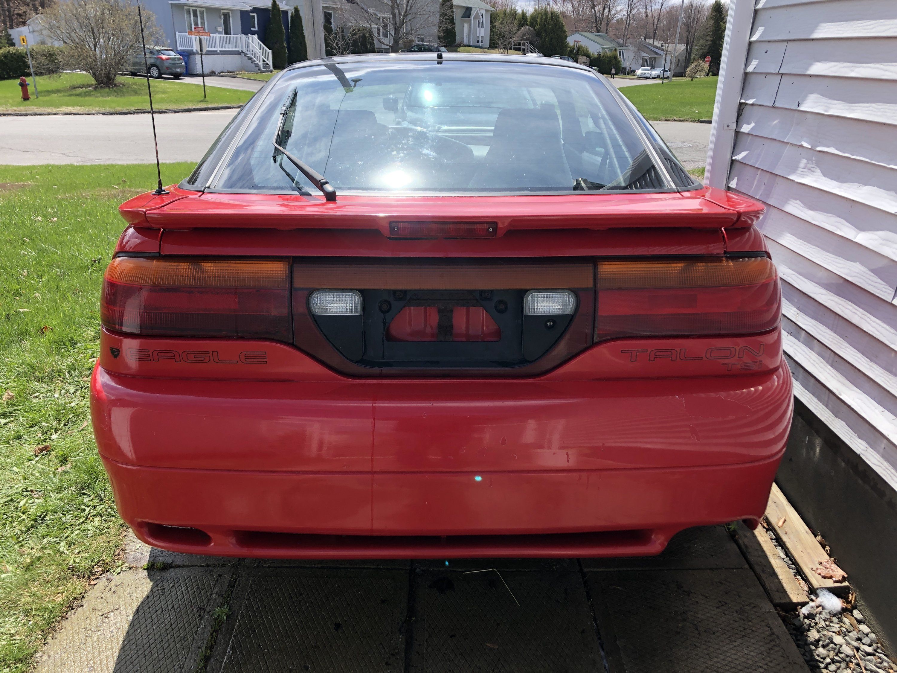

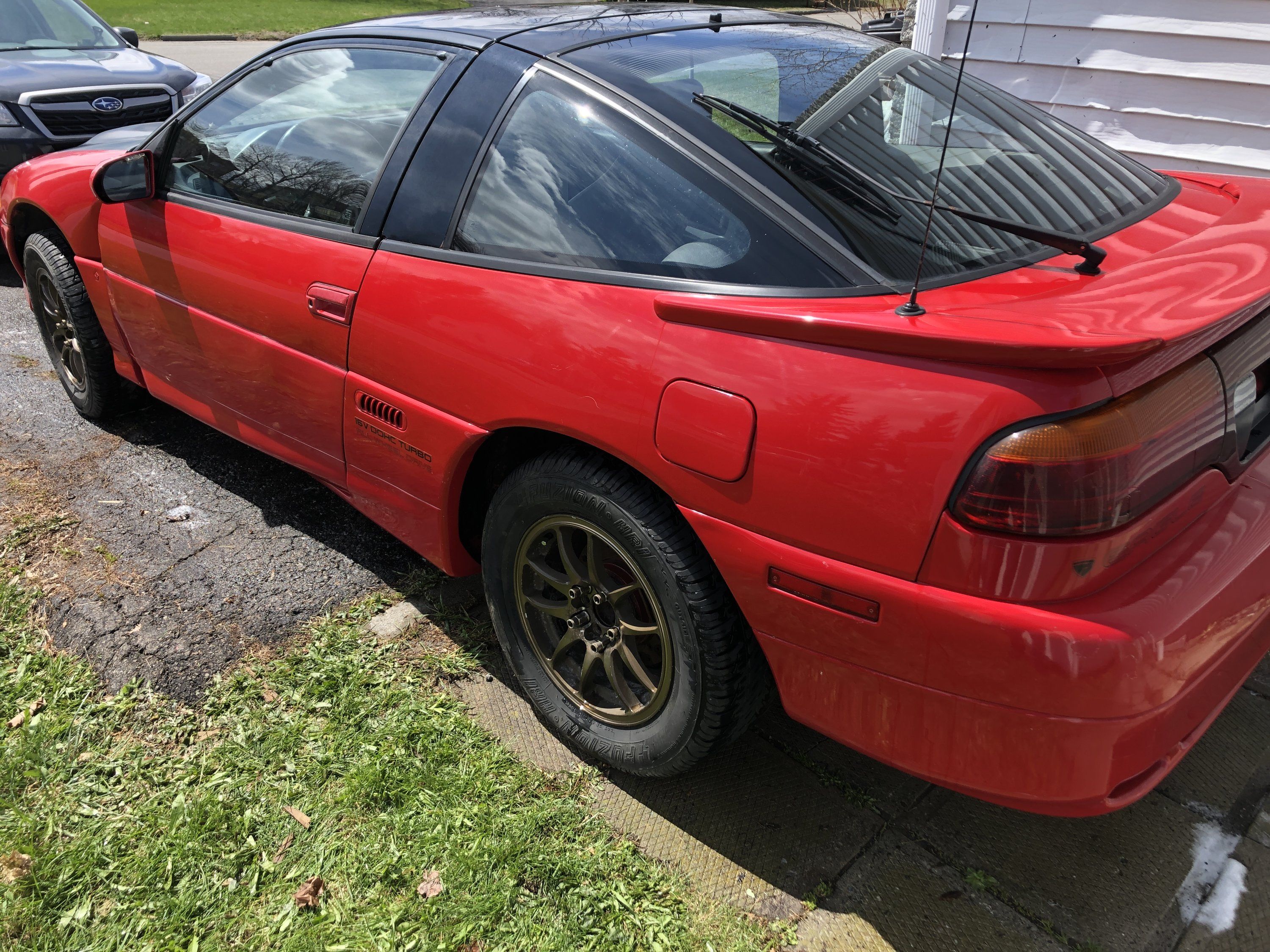

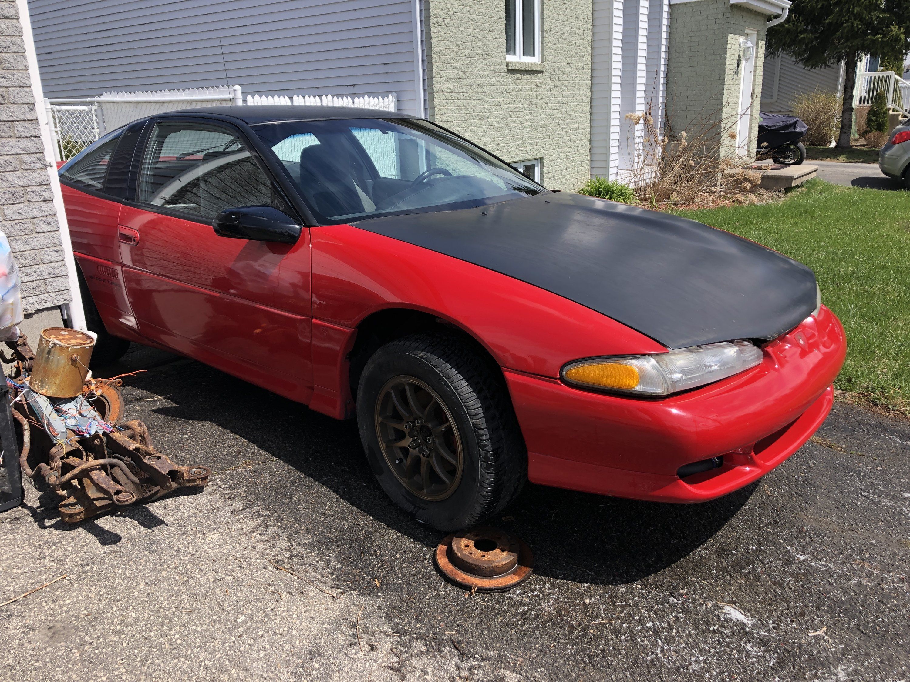

Then, a month ago, a found a really clean rolling shell, 1GB TSI AWD, without engine/trans and the missing interior. No rust! With only a few dent here and there.
IMG_1179 - Copie.JPG IMG_1180 - Copie.JPG IMG_1181 - Copie.JPG IMG_1182 - Copie.JPG IMG_1183 - Copie.JPG IMG_1184 - Copie.JPG IMG_1185 - Copie.JPG IMG_1226 - Copie.JPG

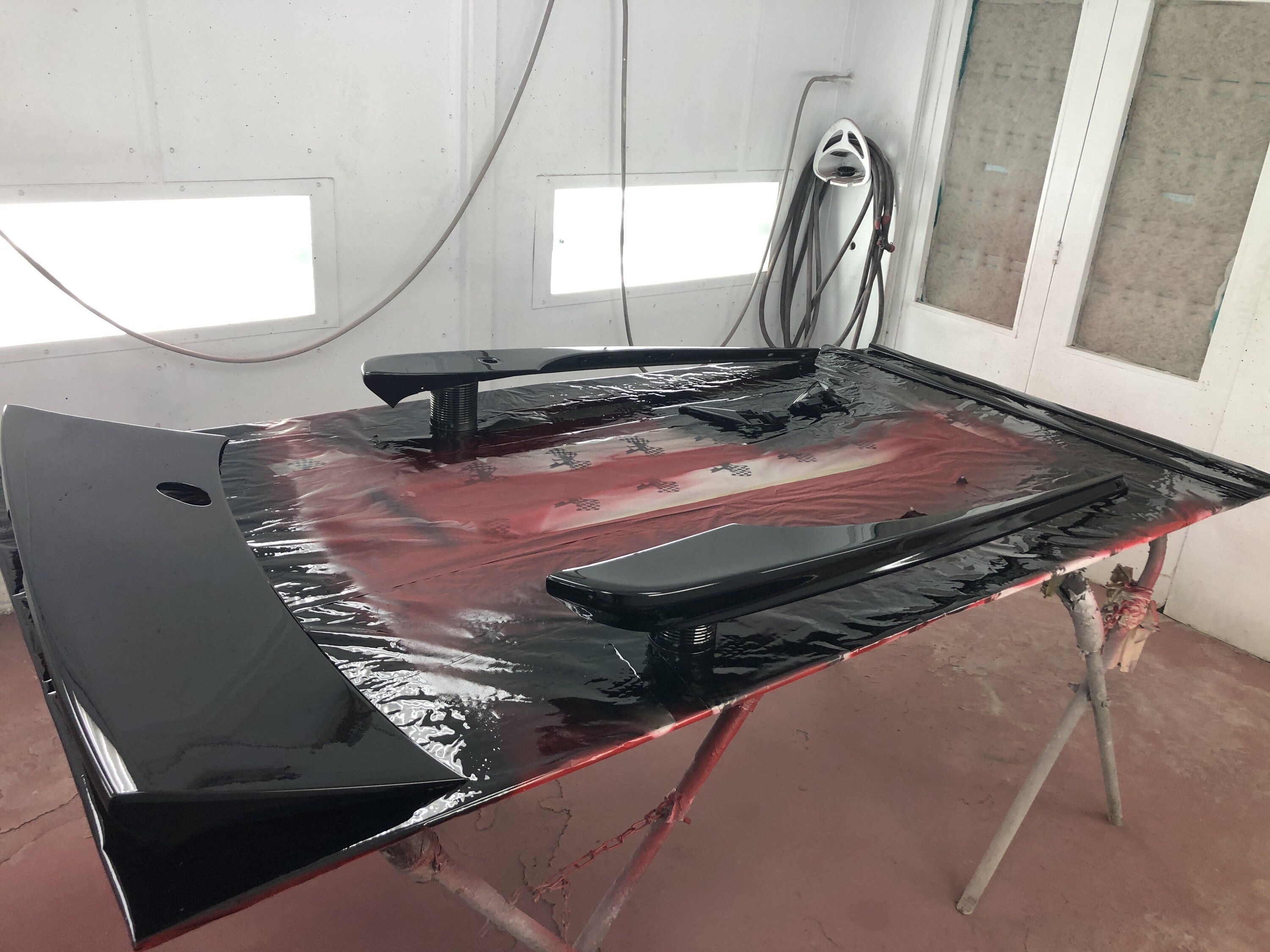

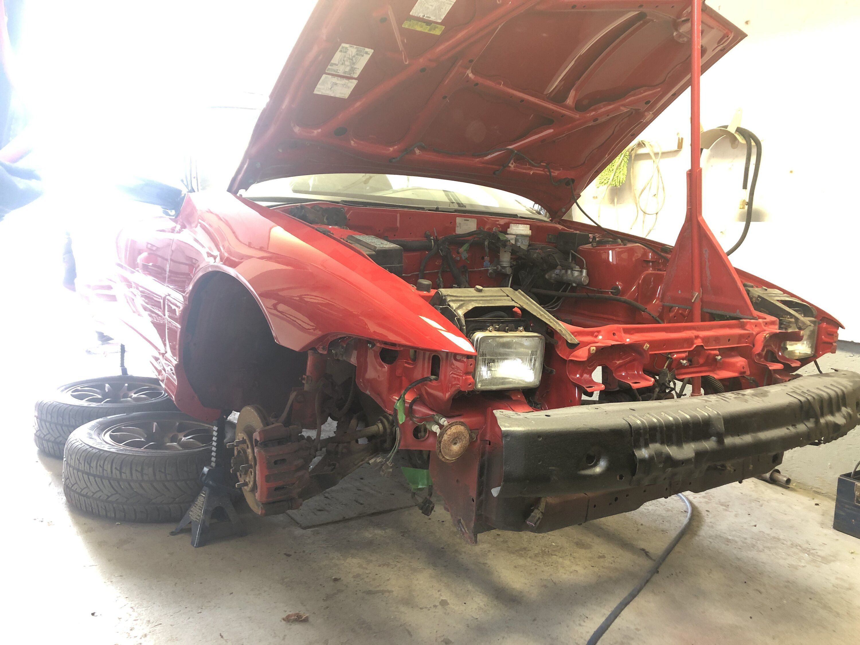

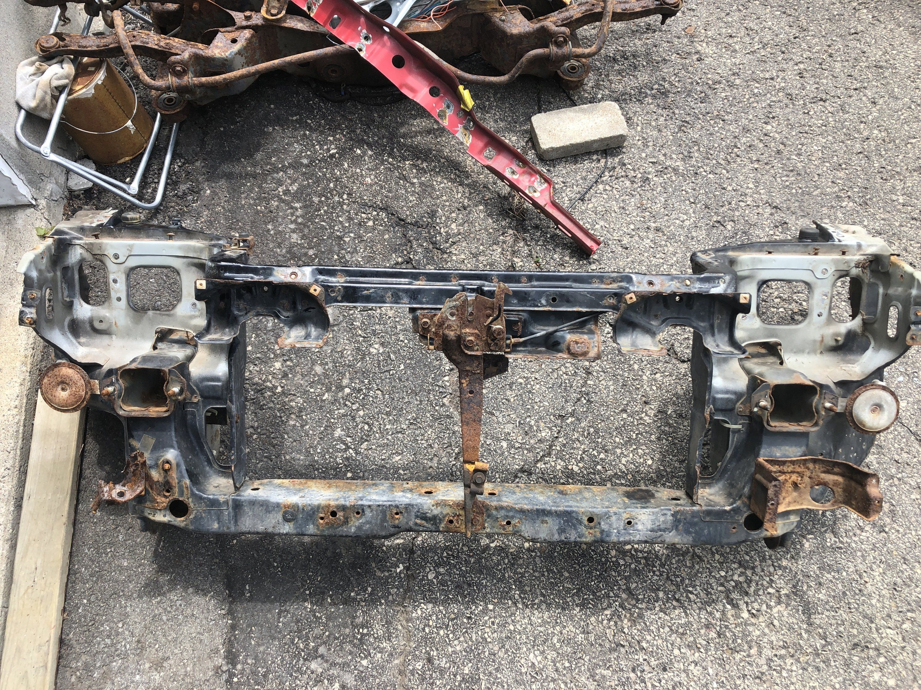

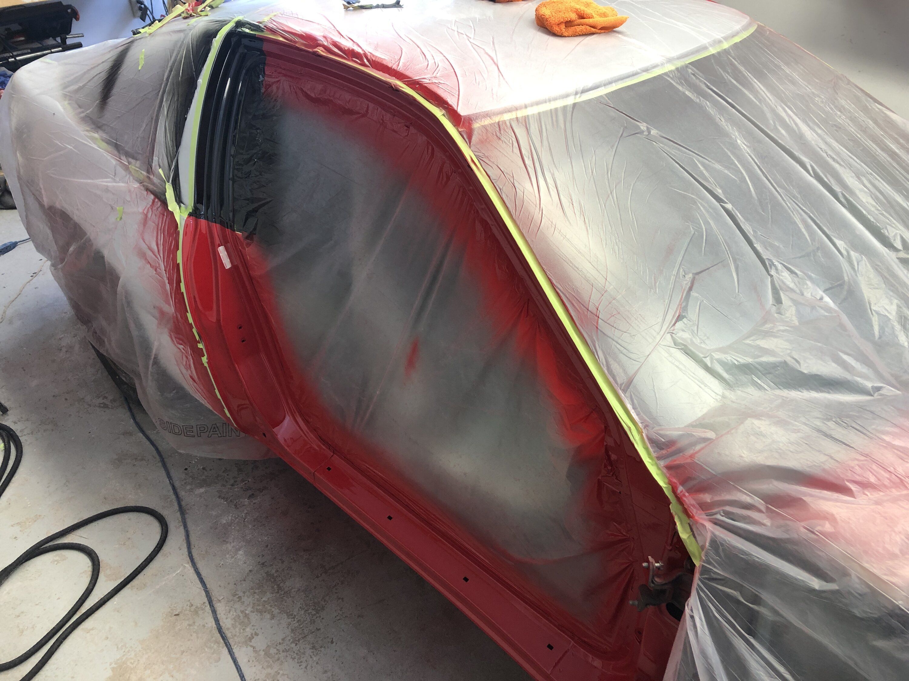

Plan is to swap everything from the 1GA to the 1GB (front+rear end, door, tailgate, wing..) . I really love the pop headling and black tail light. Sorry for the 1GB lover :p

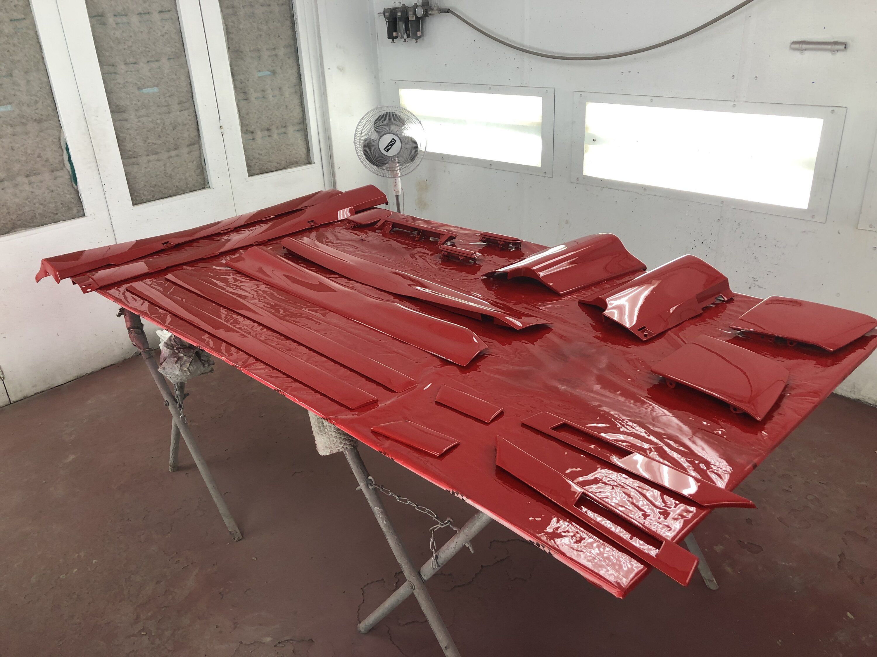

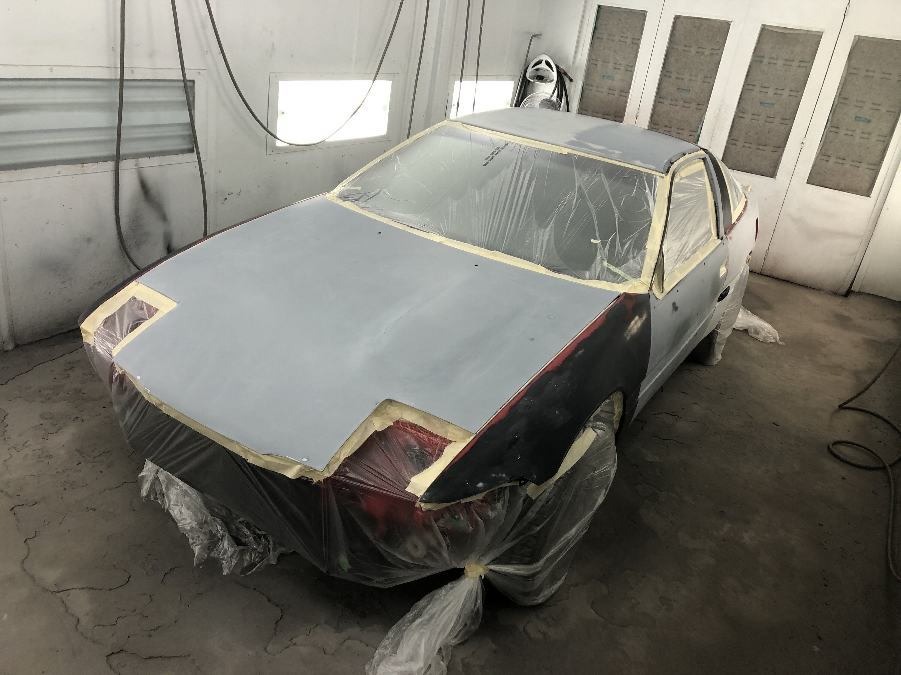

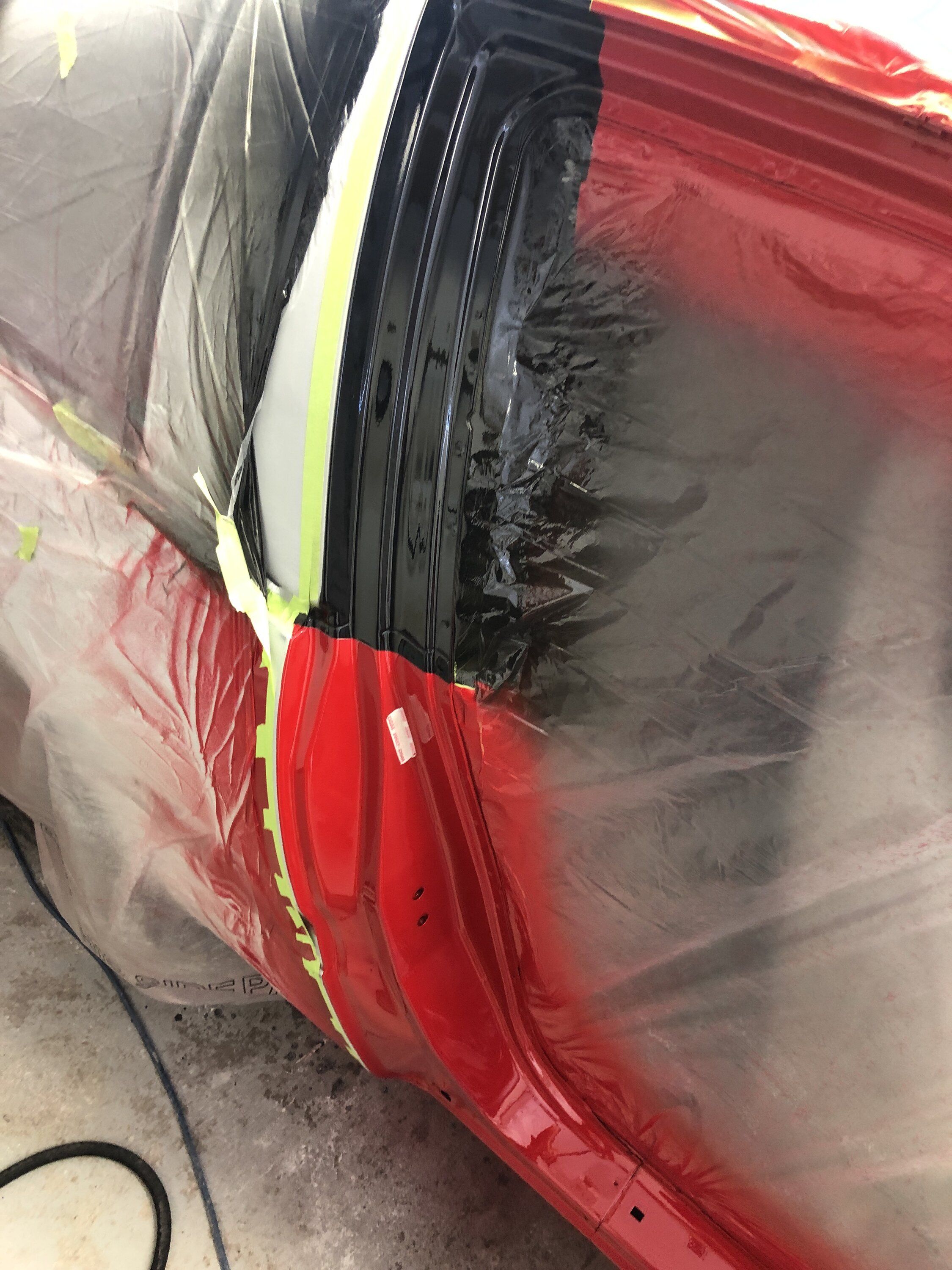

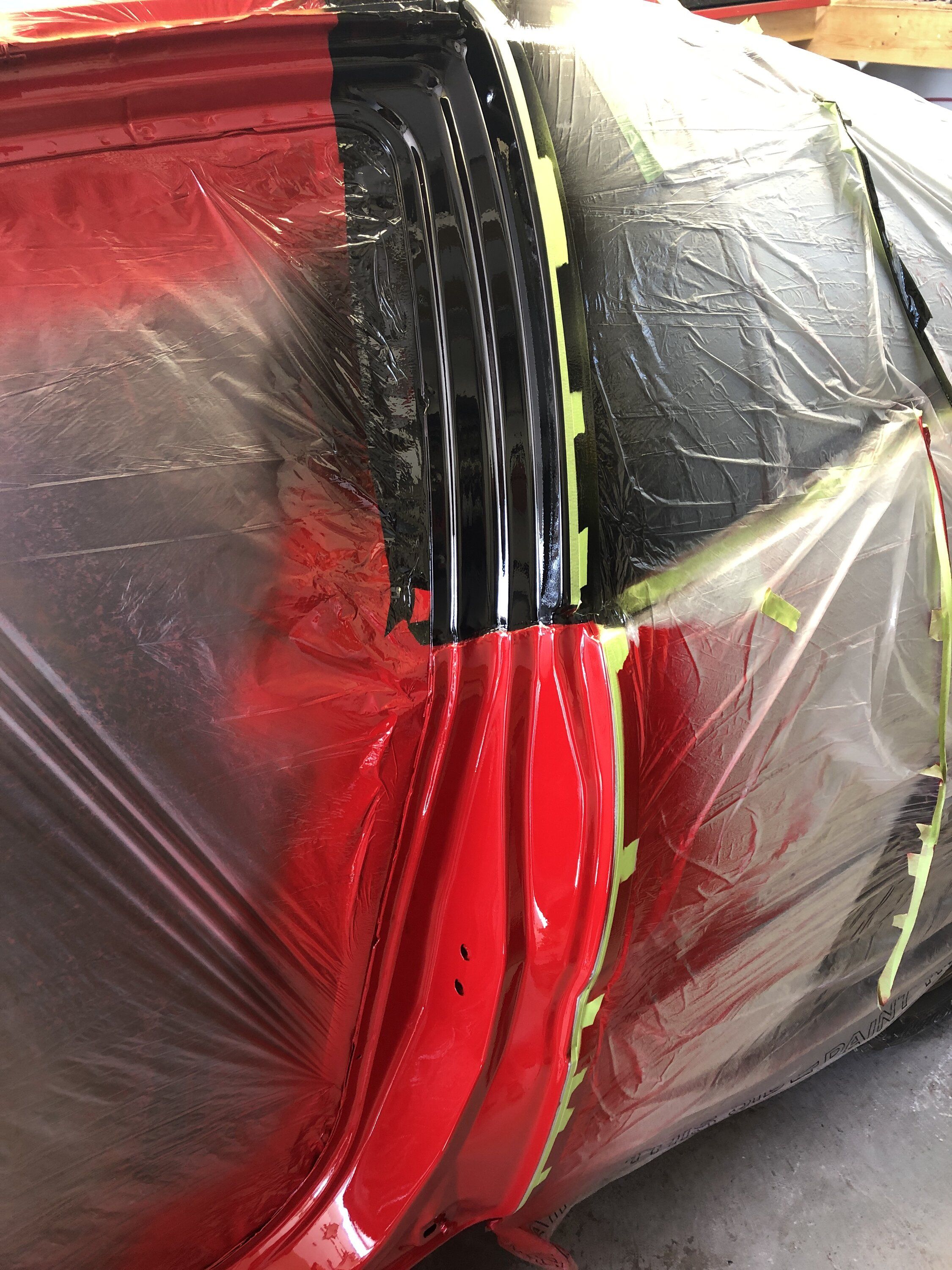

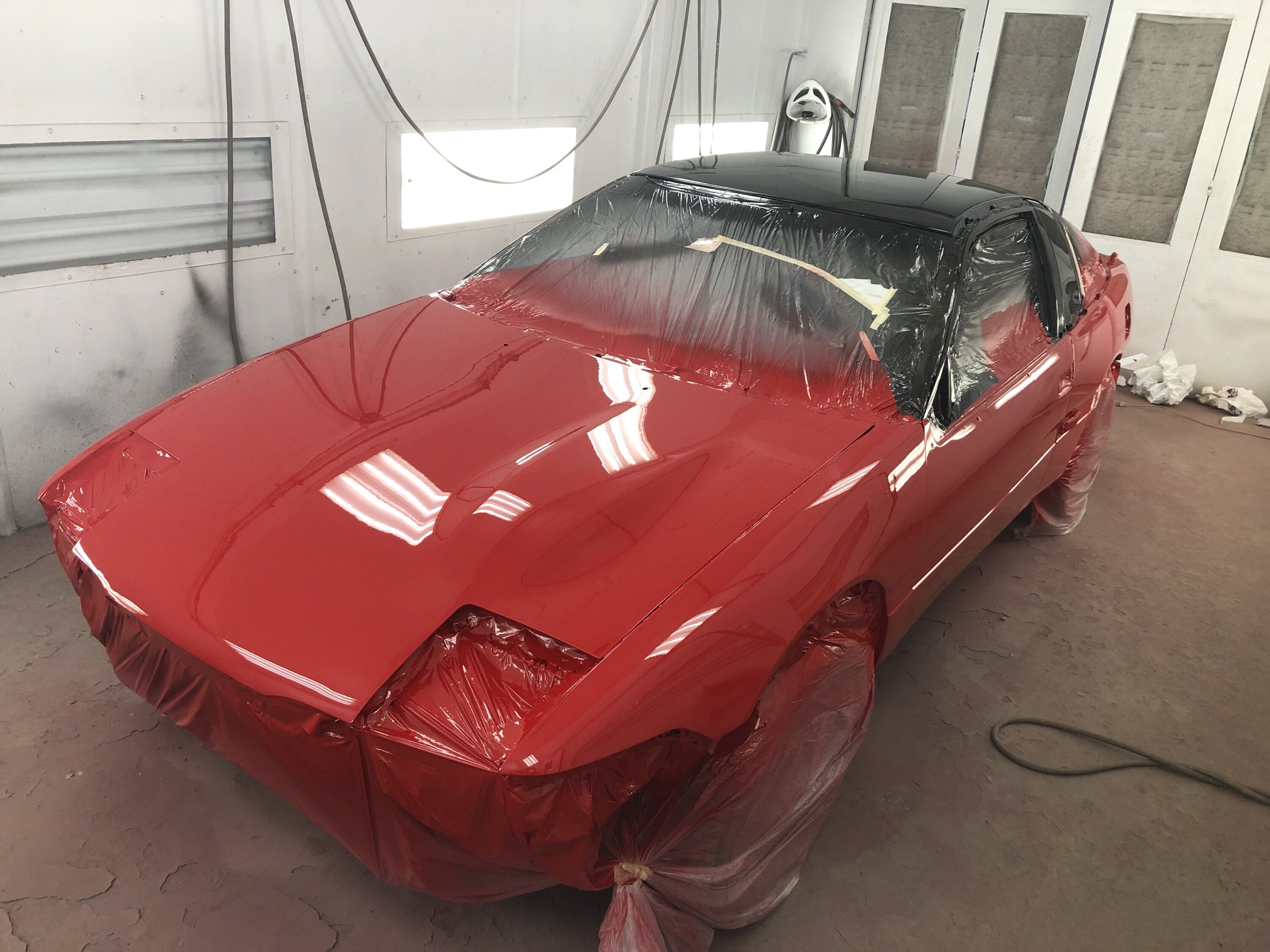

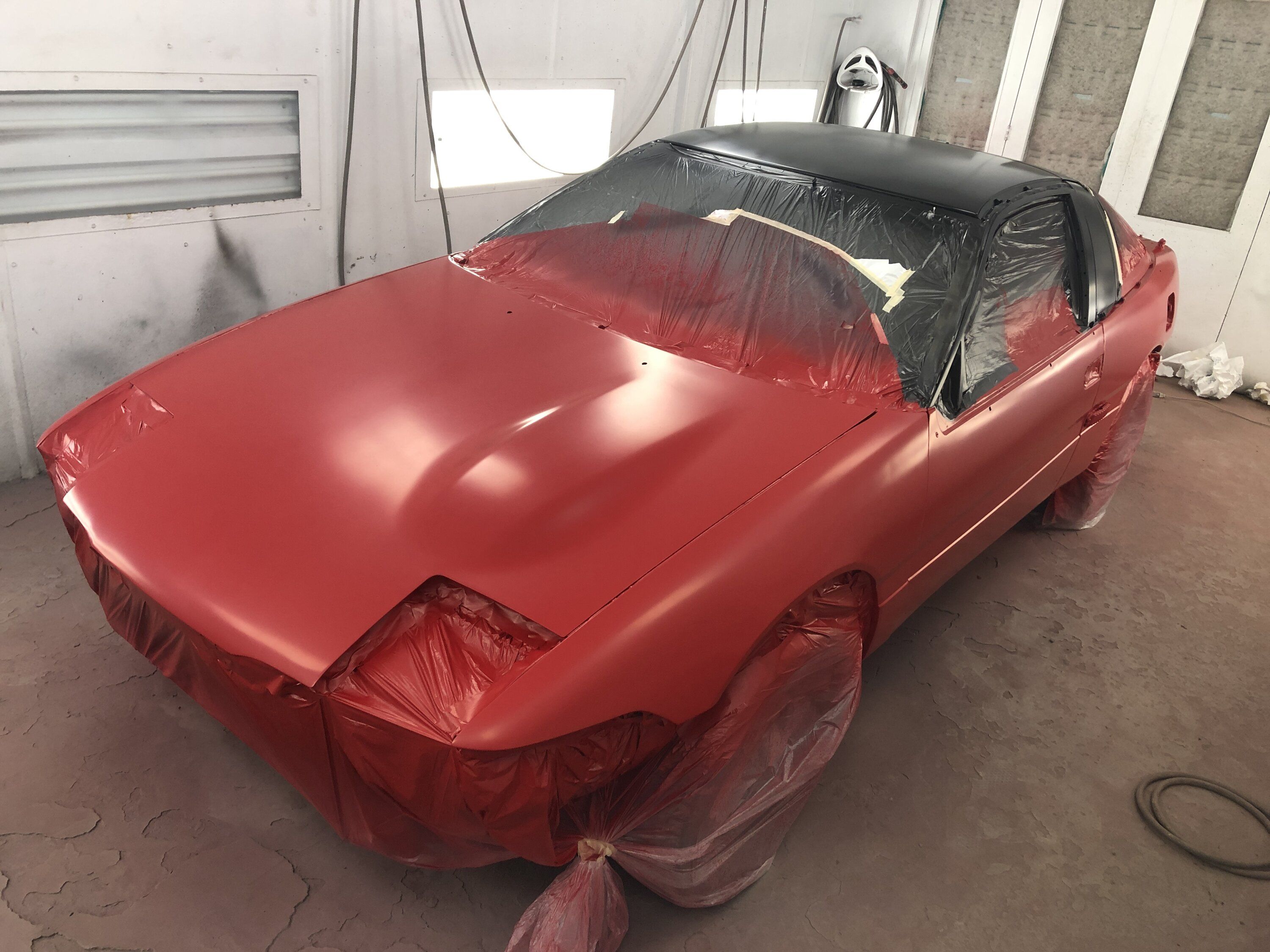

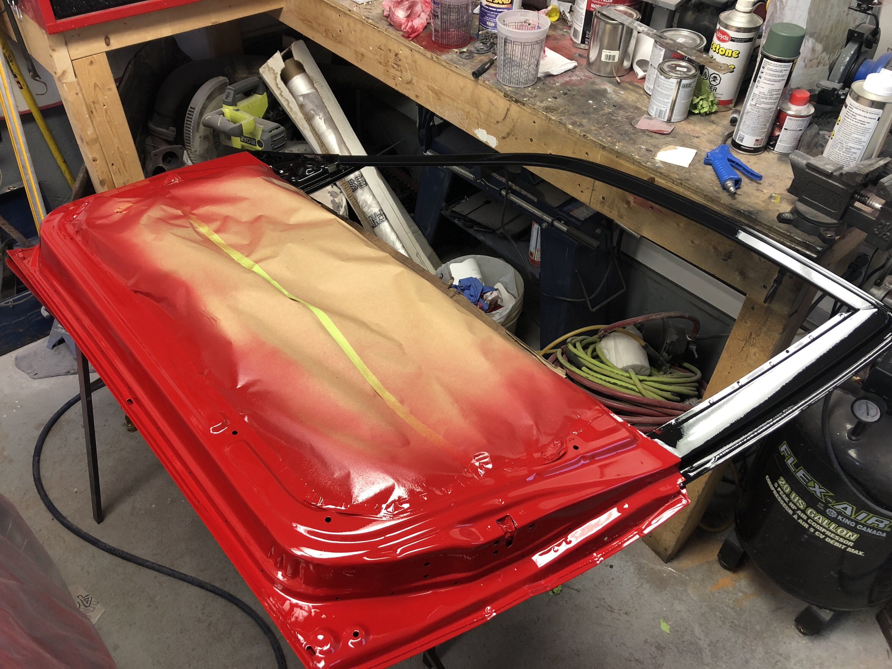

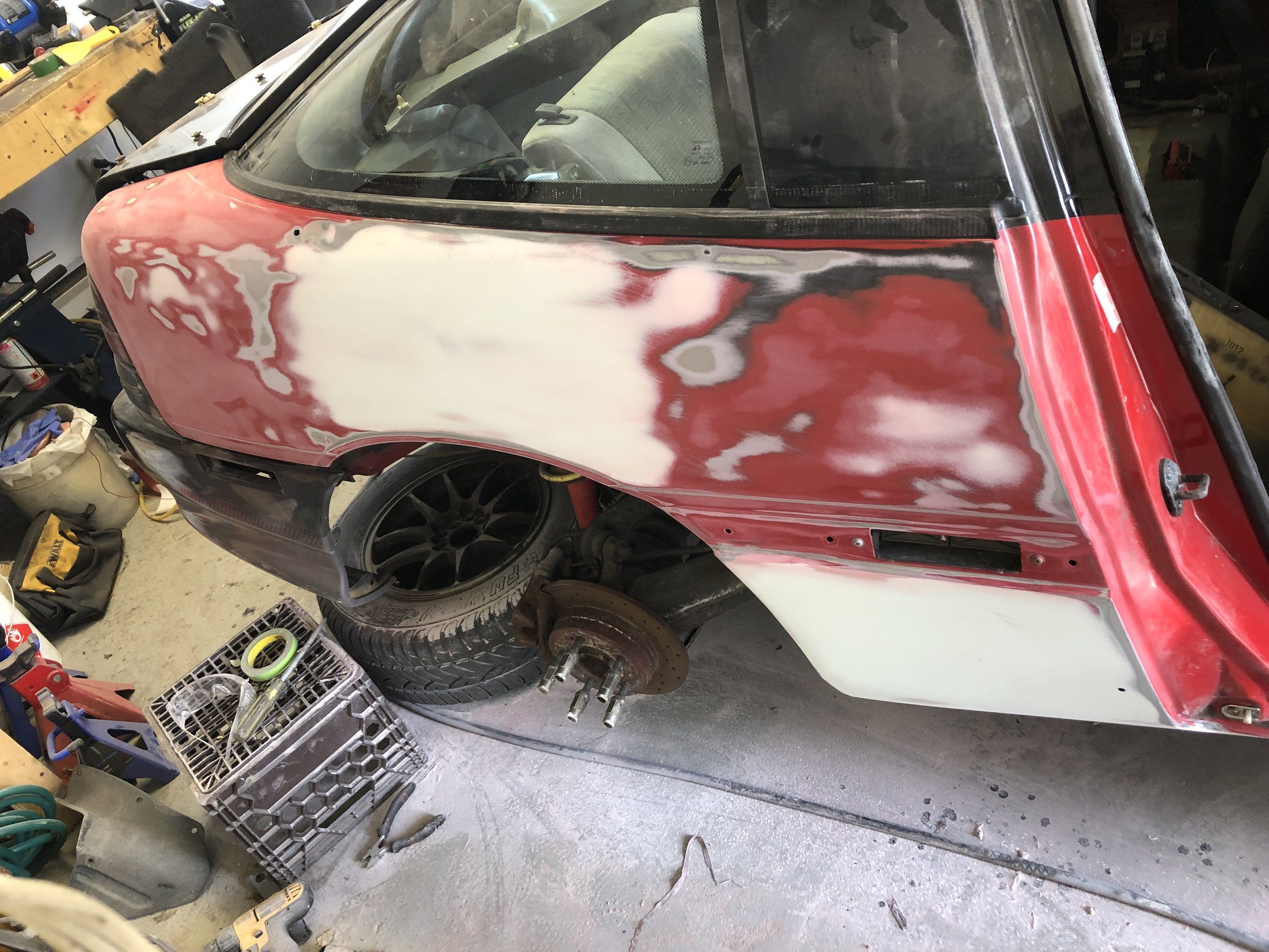

This will come with a full repair/repaint of the car + all of the mecanic maintenance. Maybe a rebuilt on the engine. Will see later.

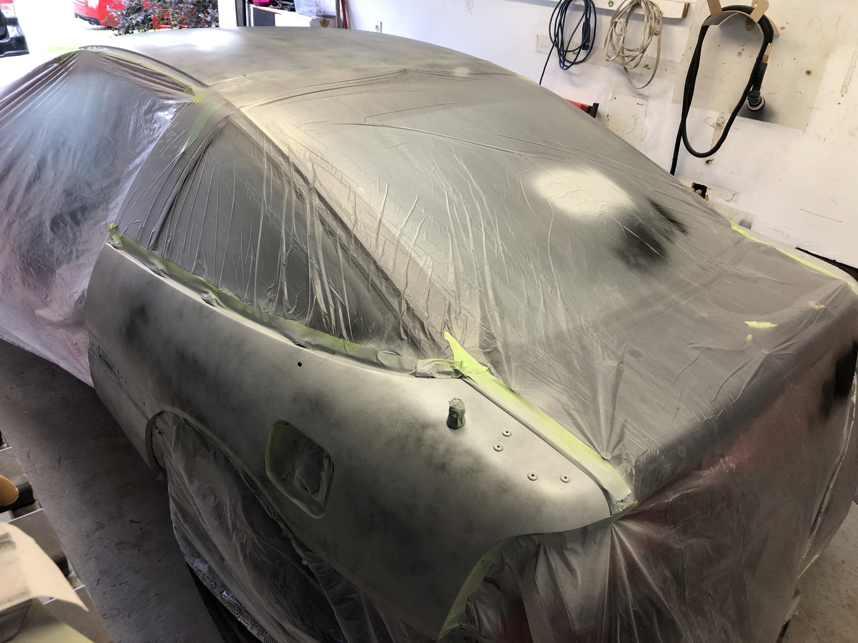

It should go like this:
1-Parting our the 1GA
2-Cleaning and reassembling interior/exterior parts on the 1GB (to make sure i do not forgot any parts before sending the 1GA to the scrap yard)

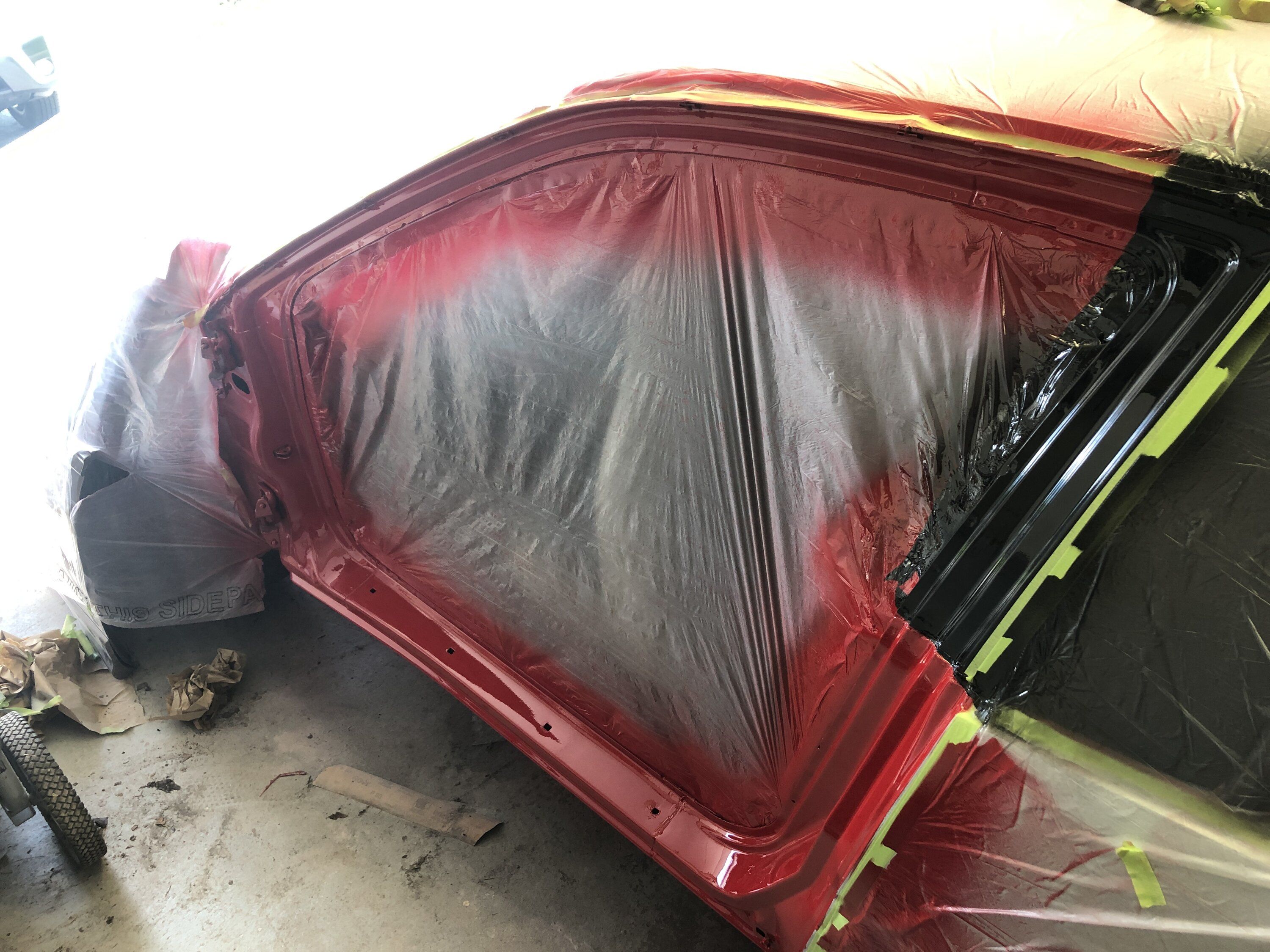

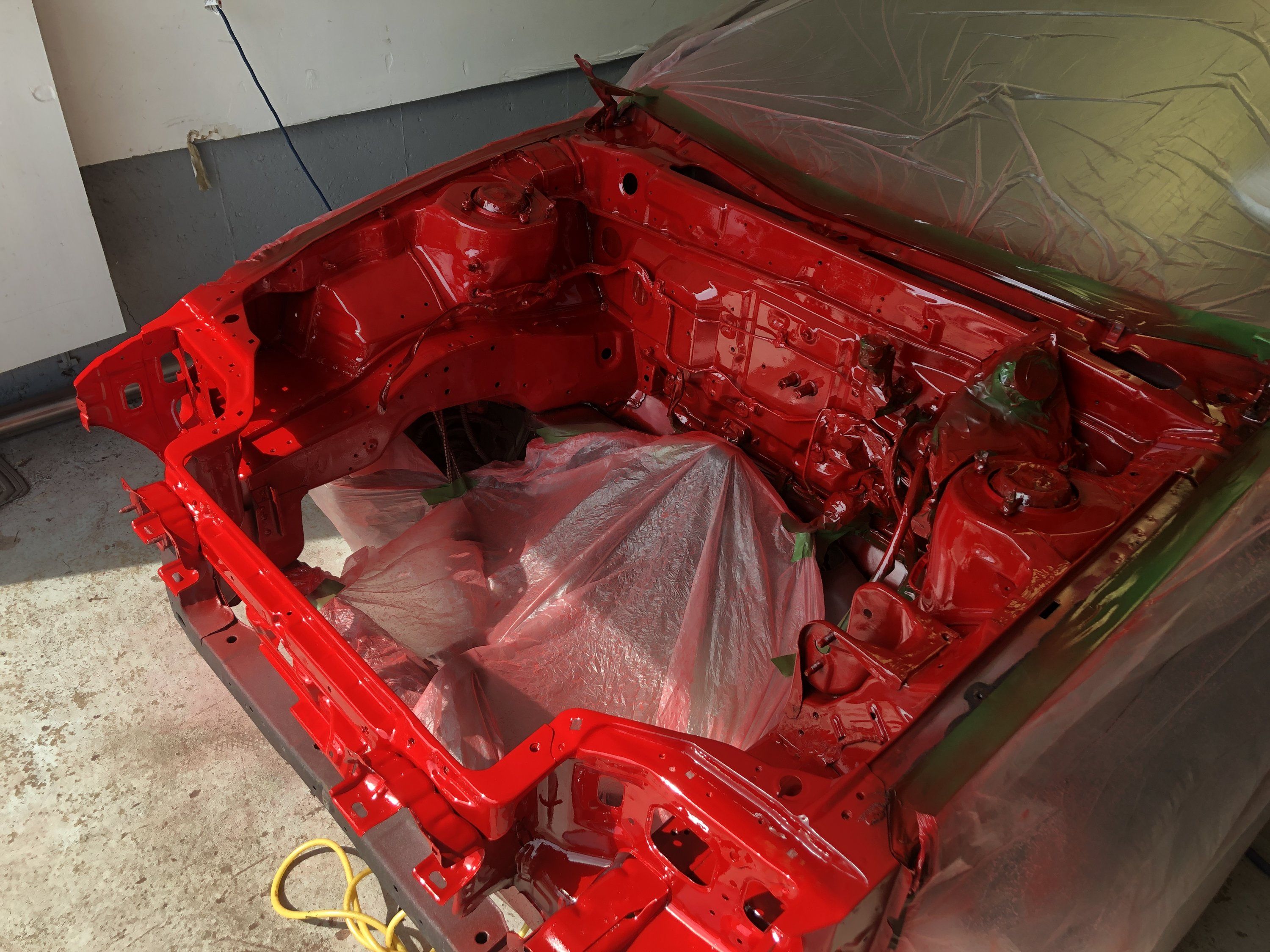

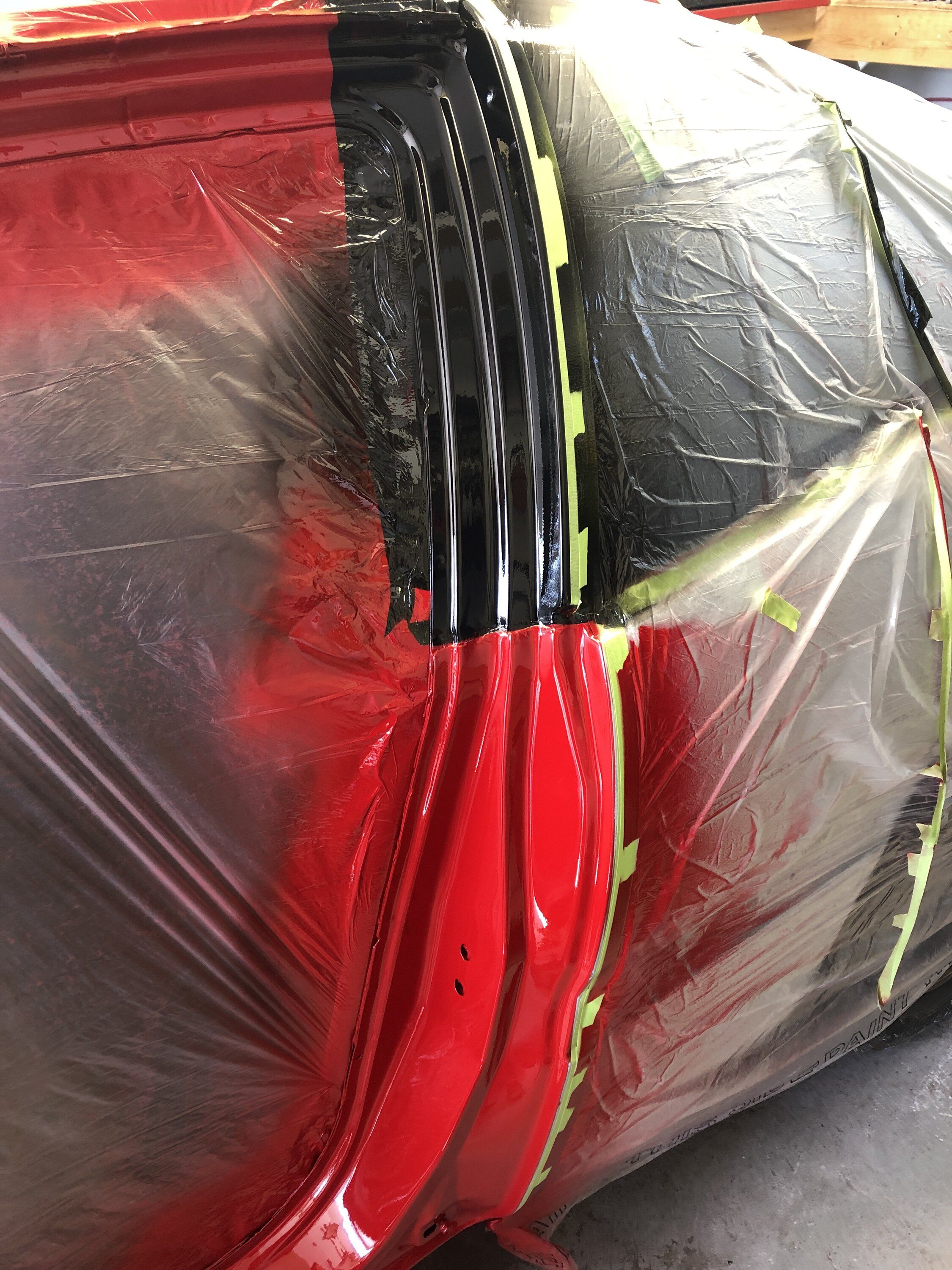

3-Body job IN/OUT/UNDER/ENGINE BAY
4-Mecanic rebuild/maintenance and final install
5-Driving the car !
I began 2 week ago in the parking, but now that i've freed the garage it should go quicker.

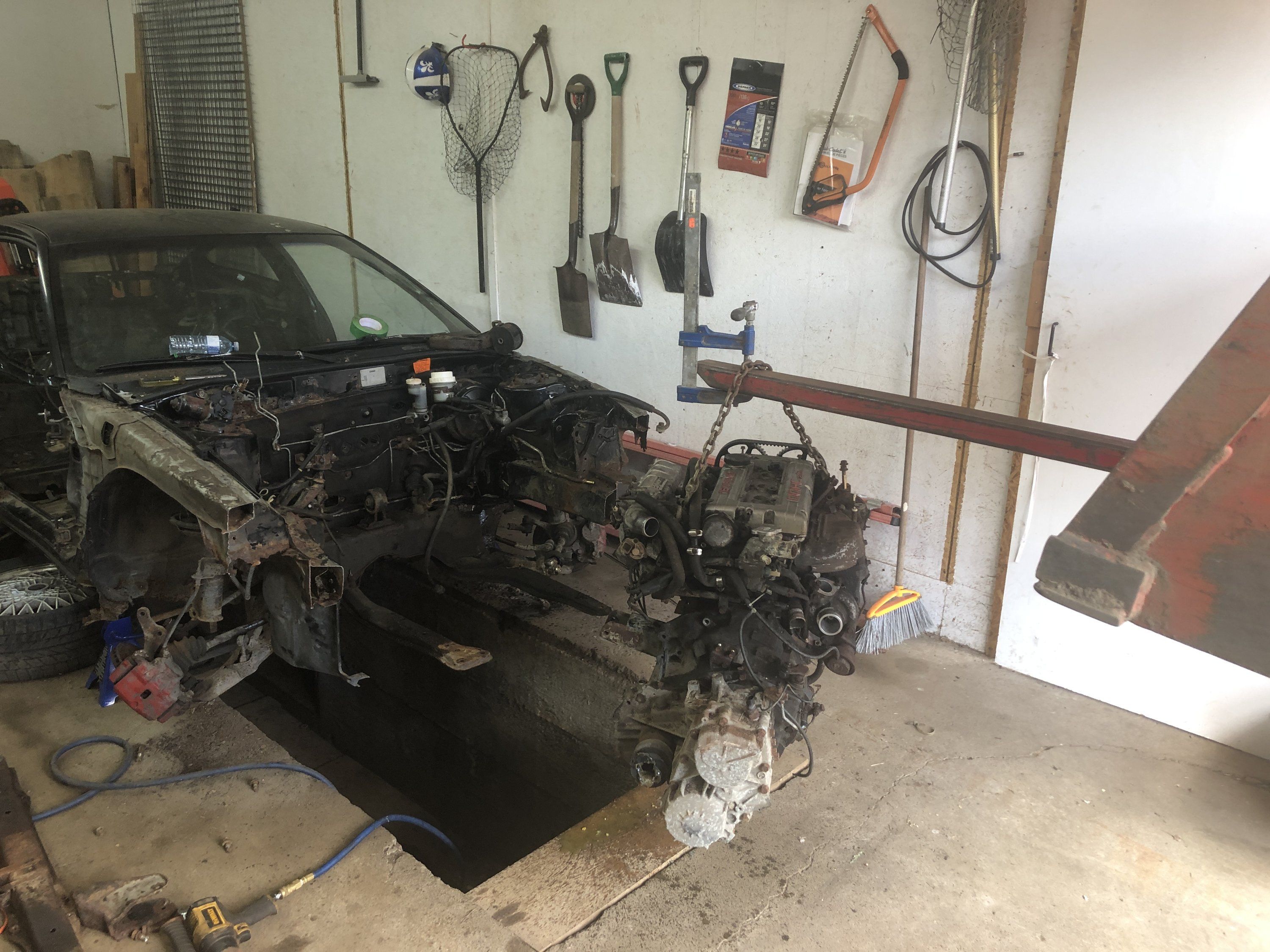

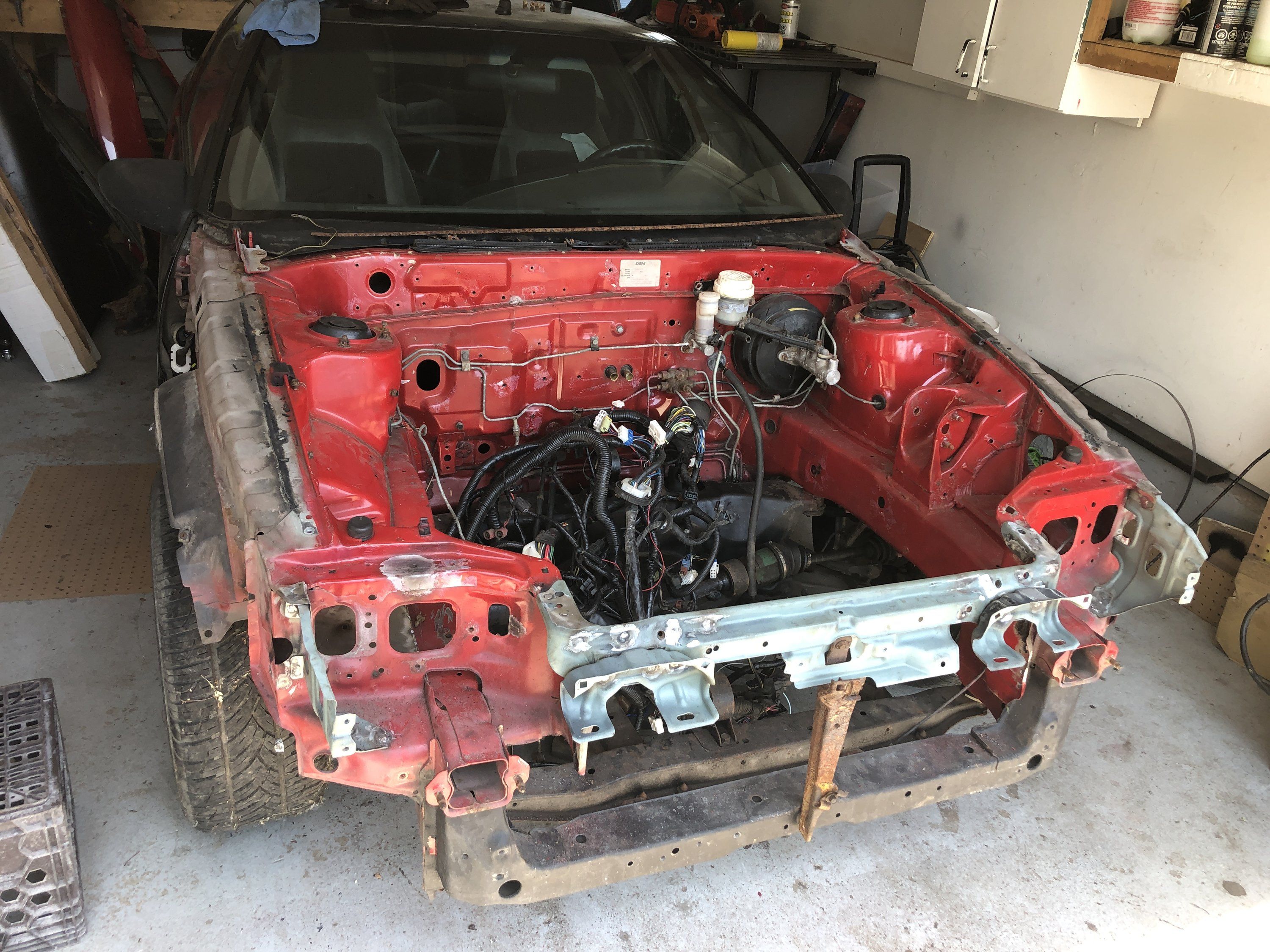

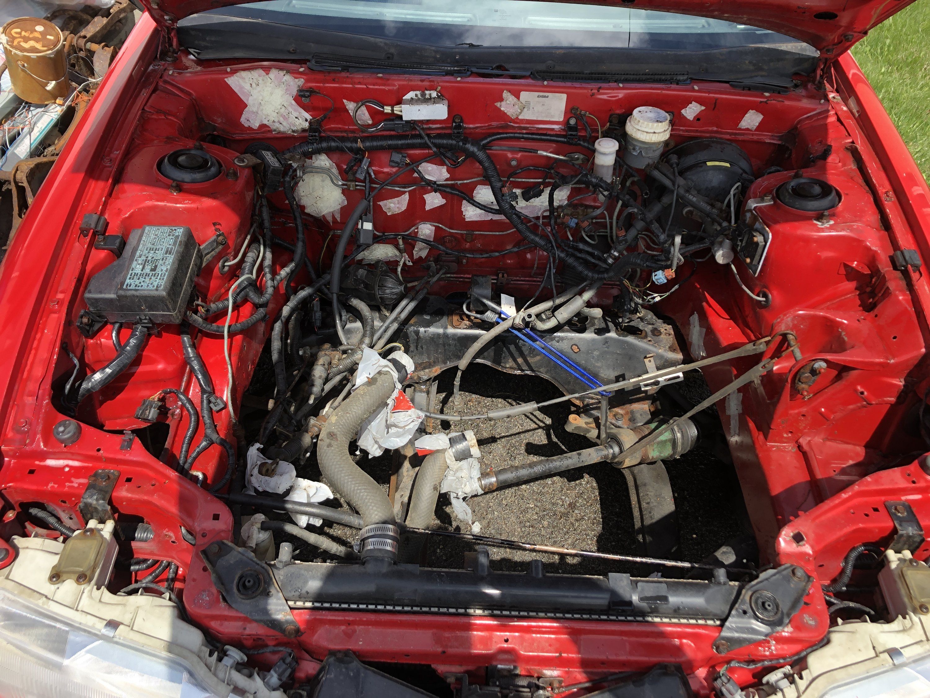

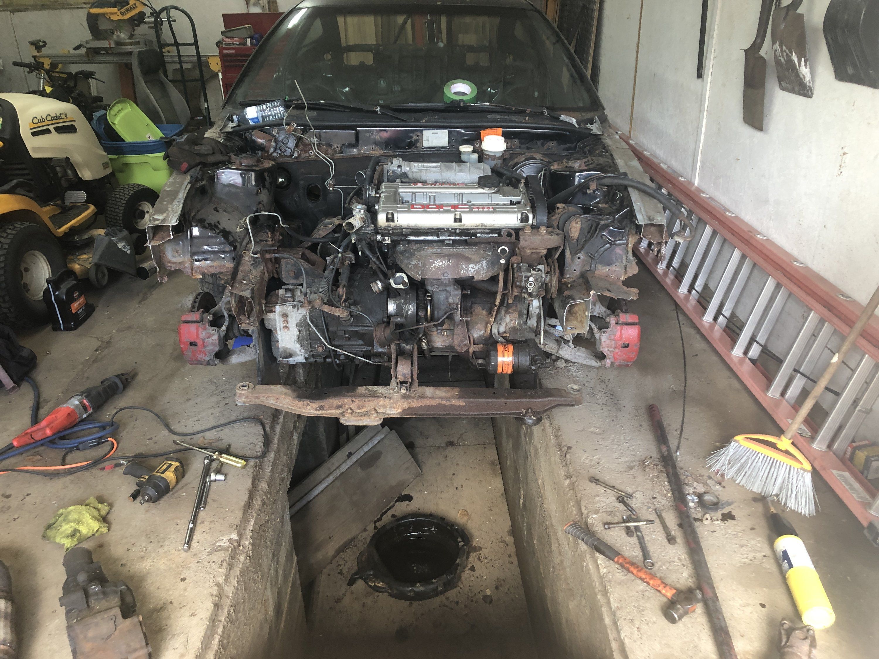

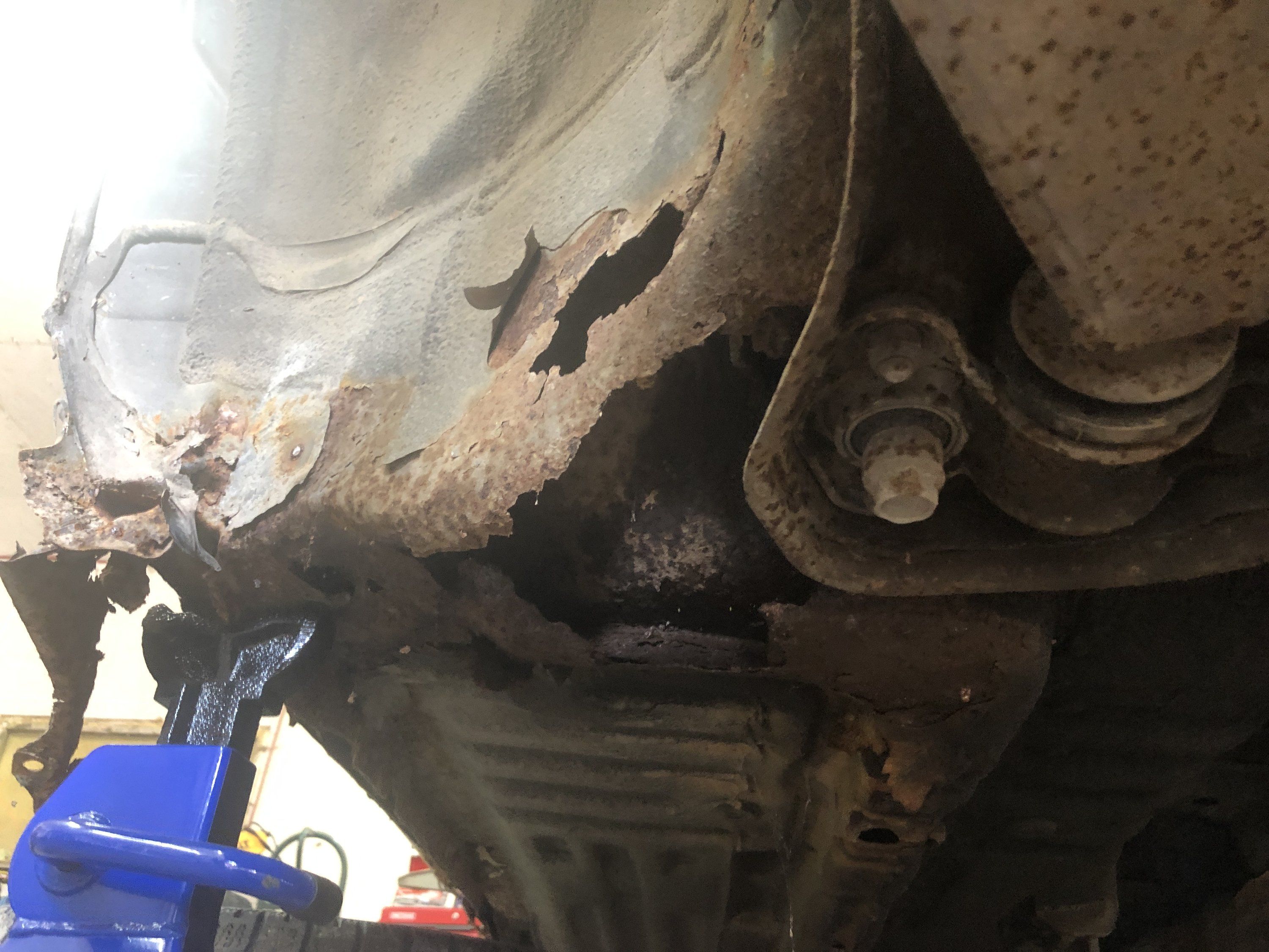

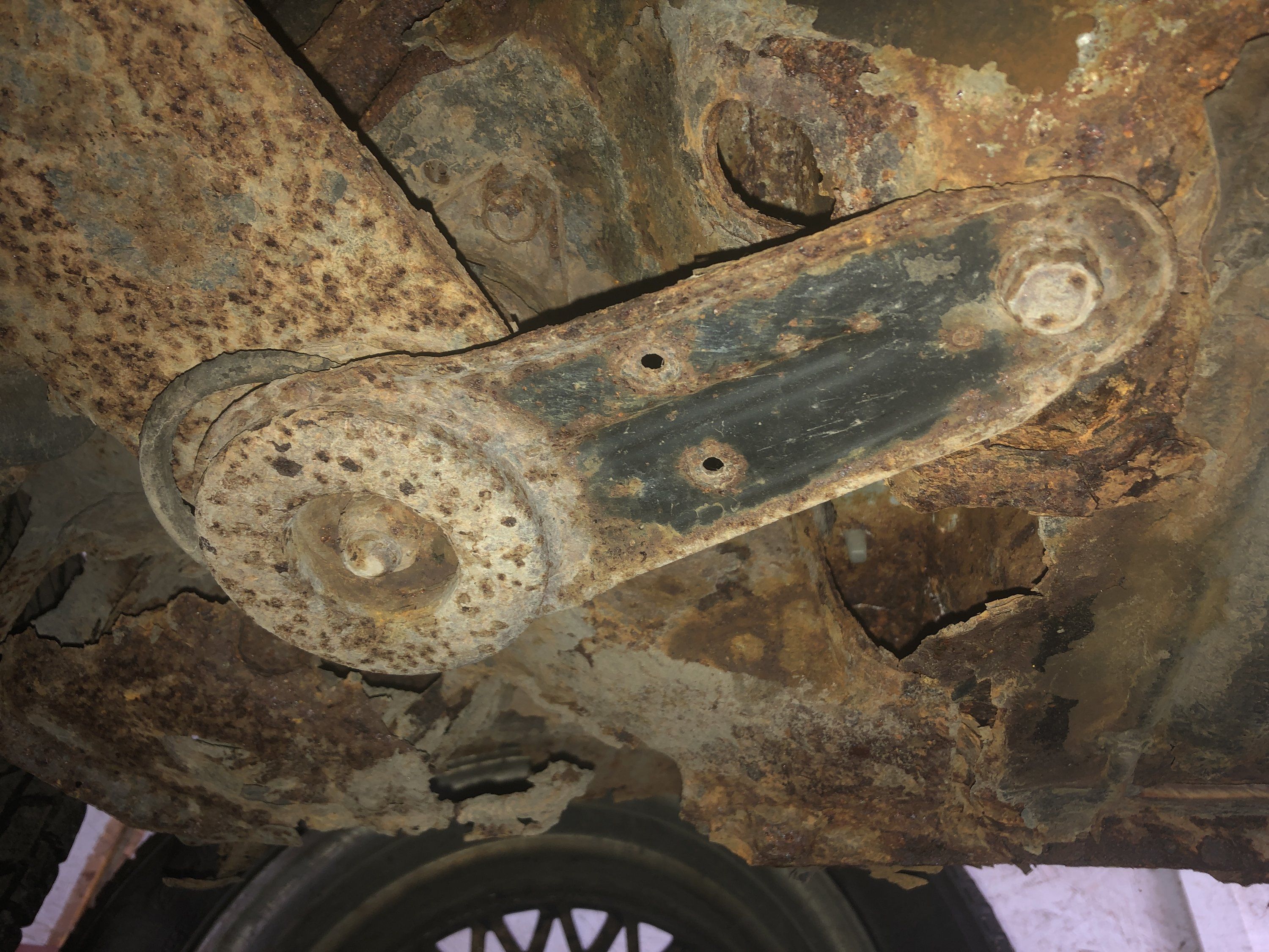

Some update, i'm in a rush to remove everything good on the black 1GA. The car is at my father's home and he is moving in 2 week.

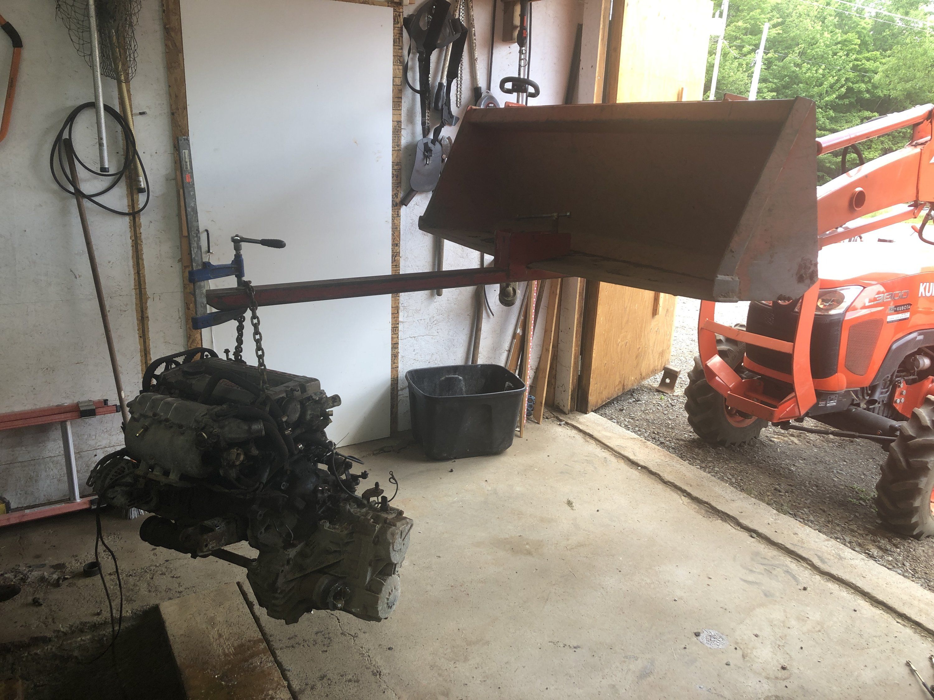

Today i took off the drivetrain.

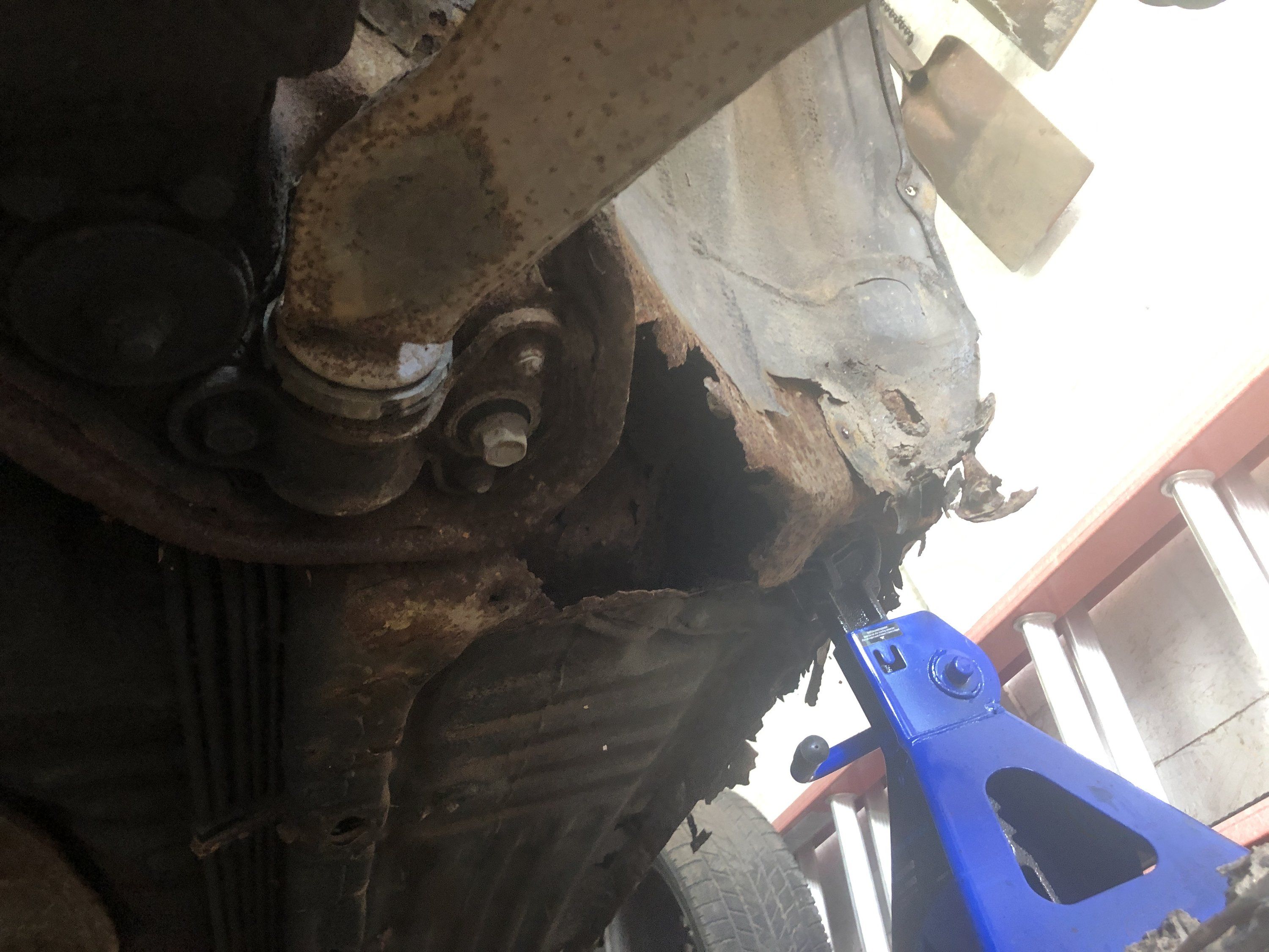

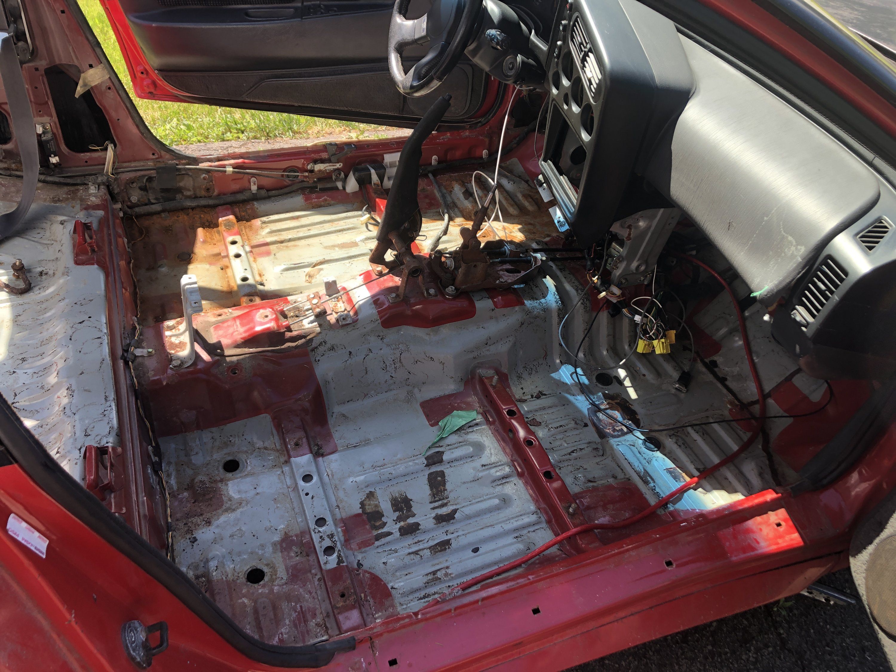

Here is a few photos, look at this gorgeous rust/weight reduction.
IMG_2095.JPG IMG_2096.JPG IMG_2097.JPG IMG_2098.JPG IMG_2099.JPG IMG_2100.JPG IMG_2101.JPG

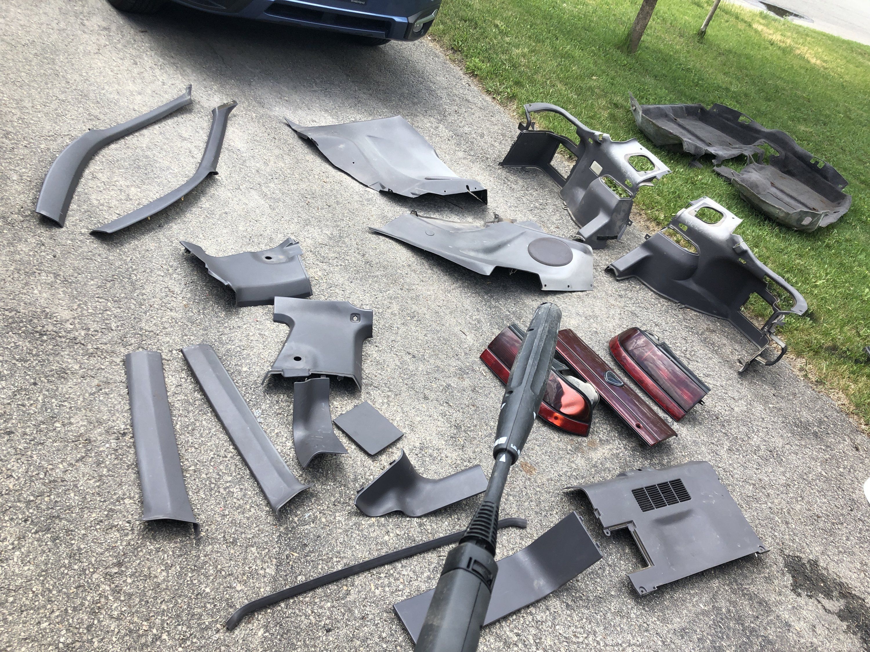

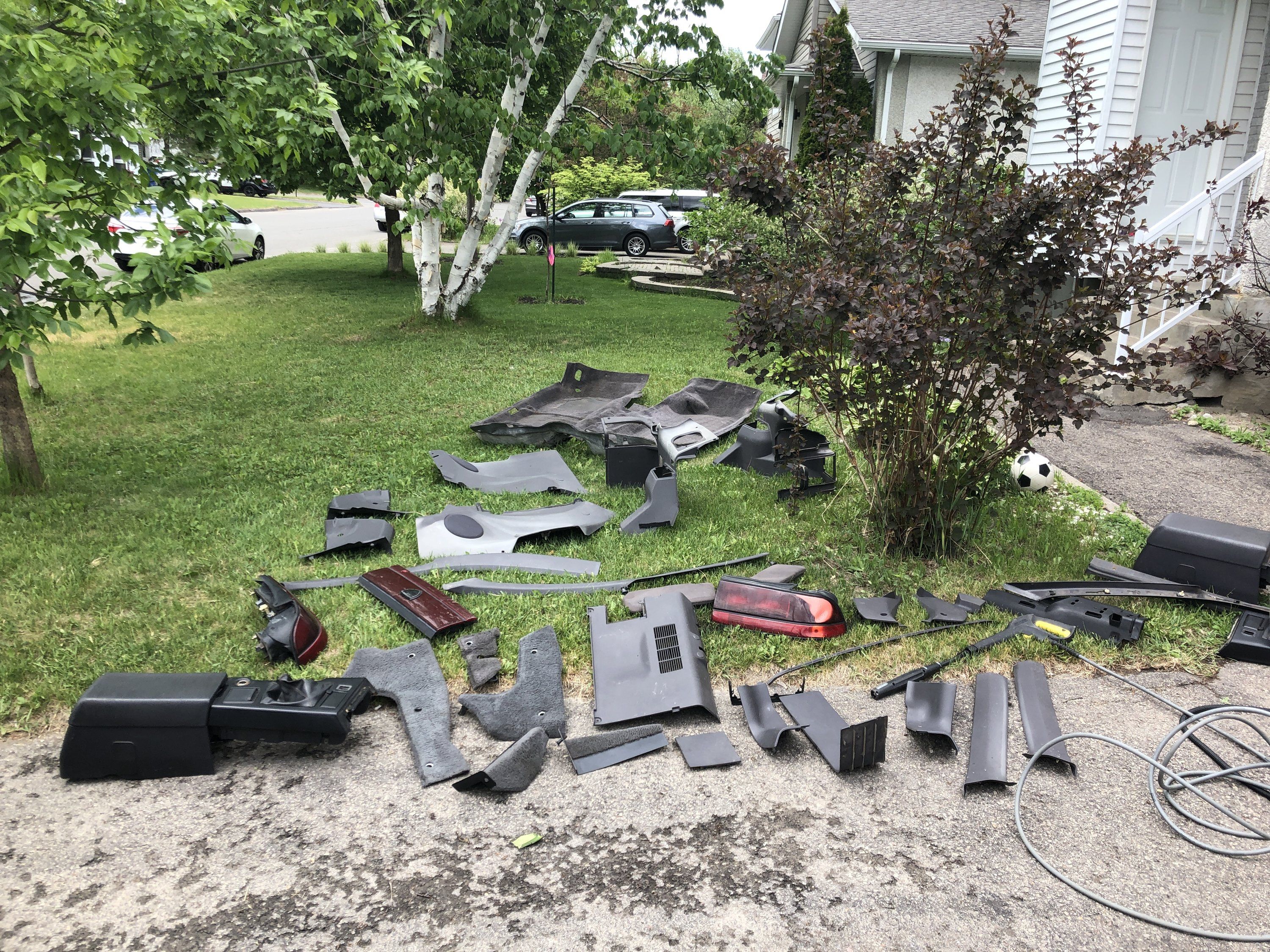

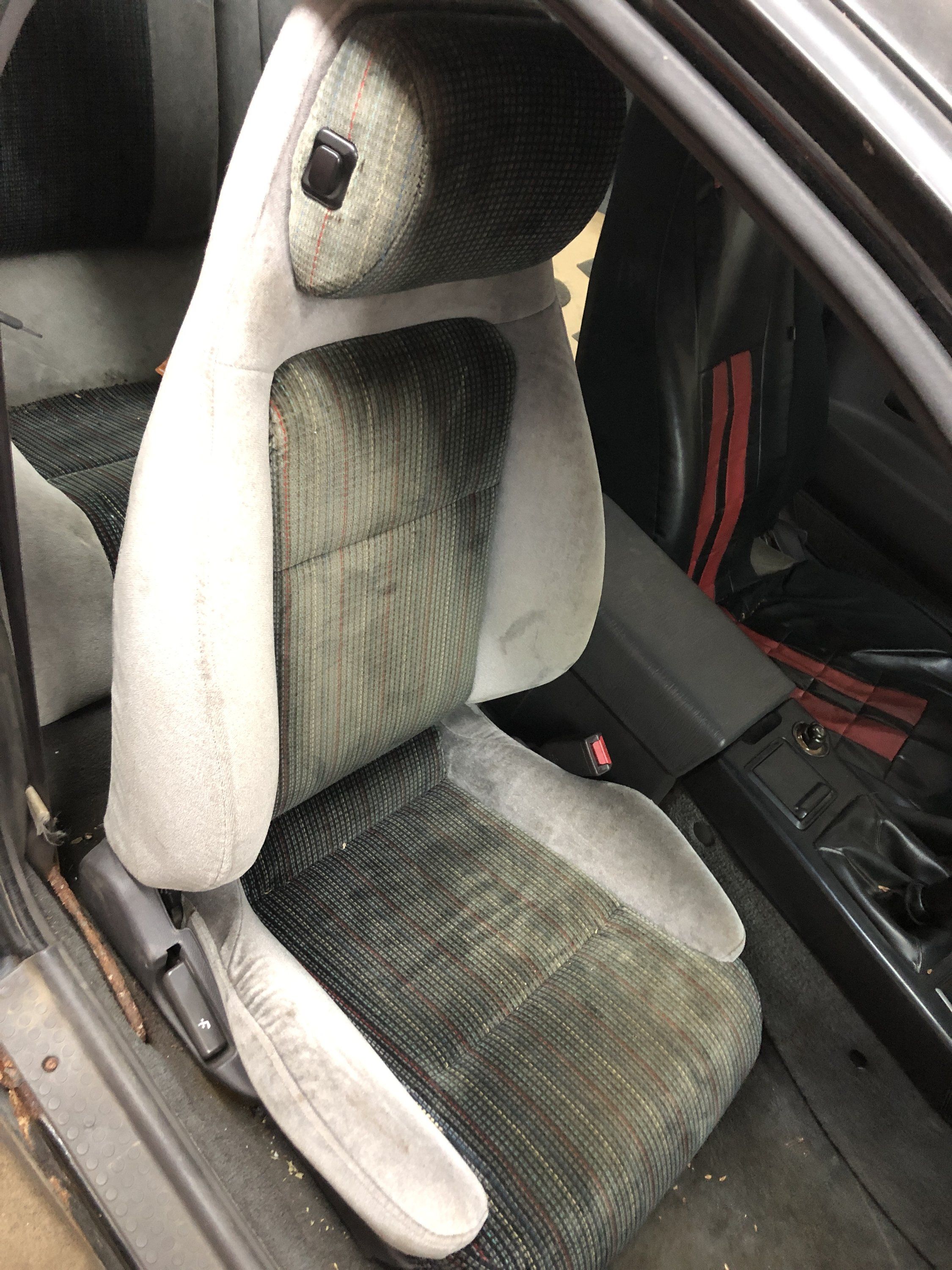

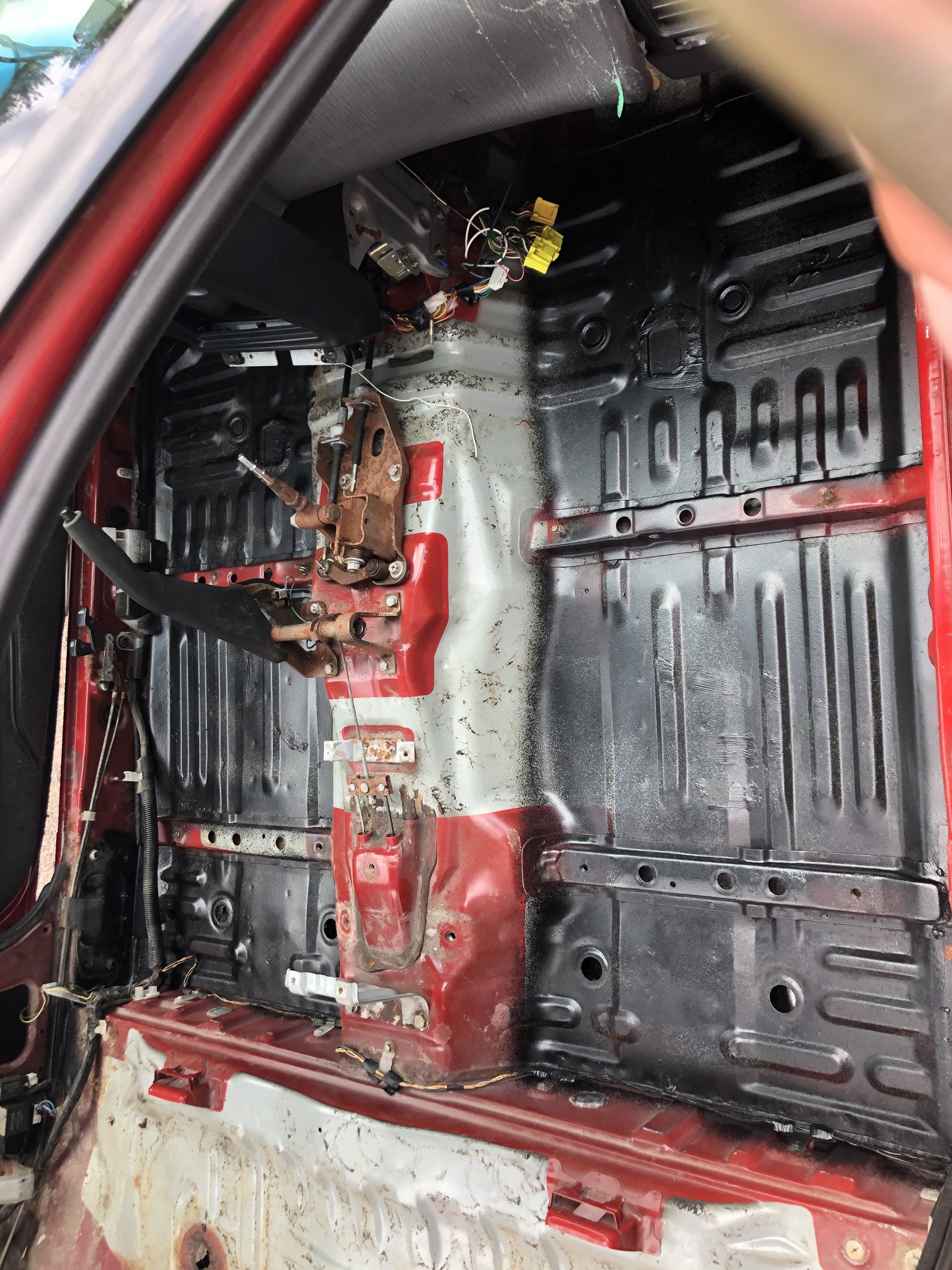

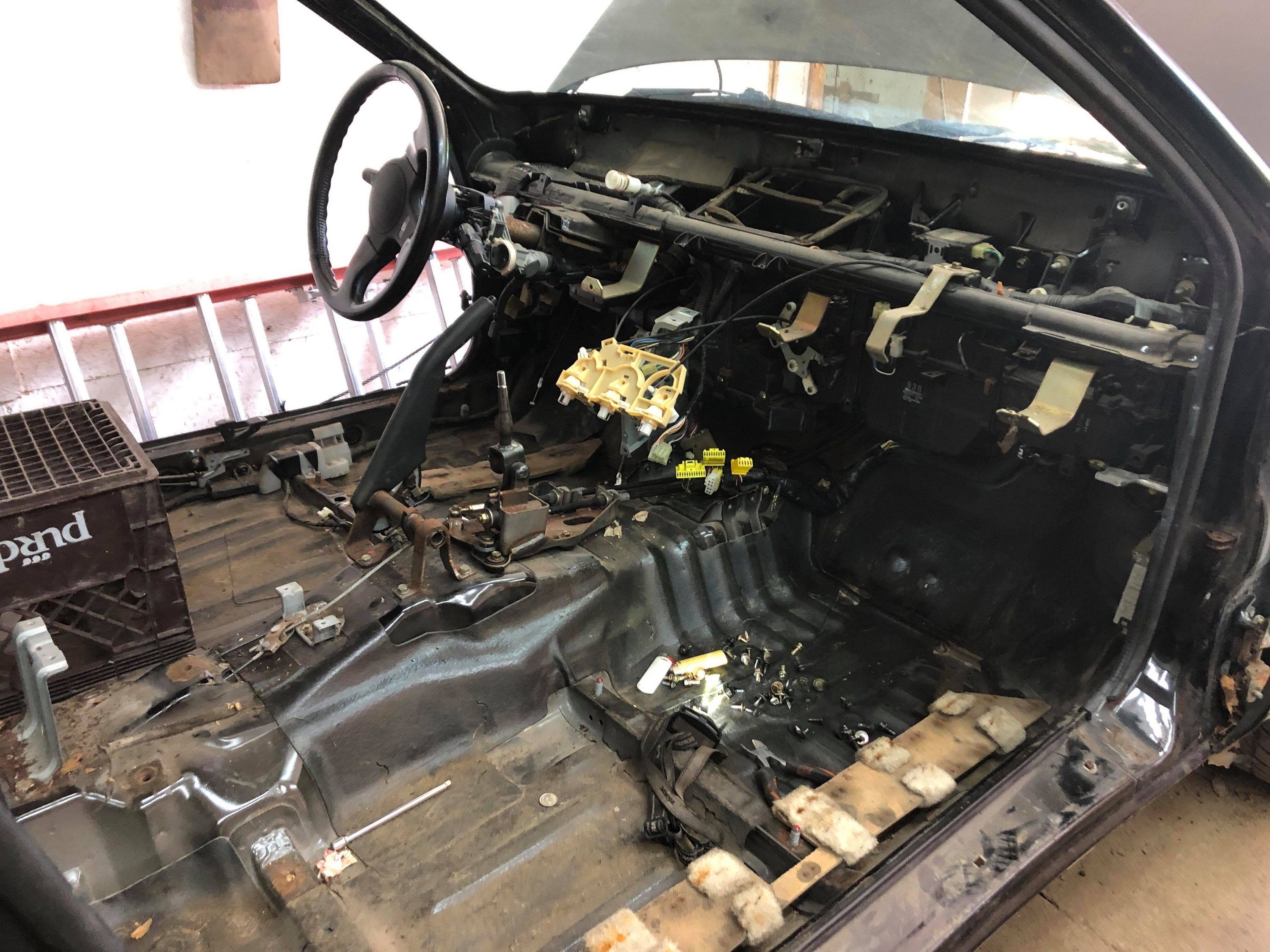

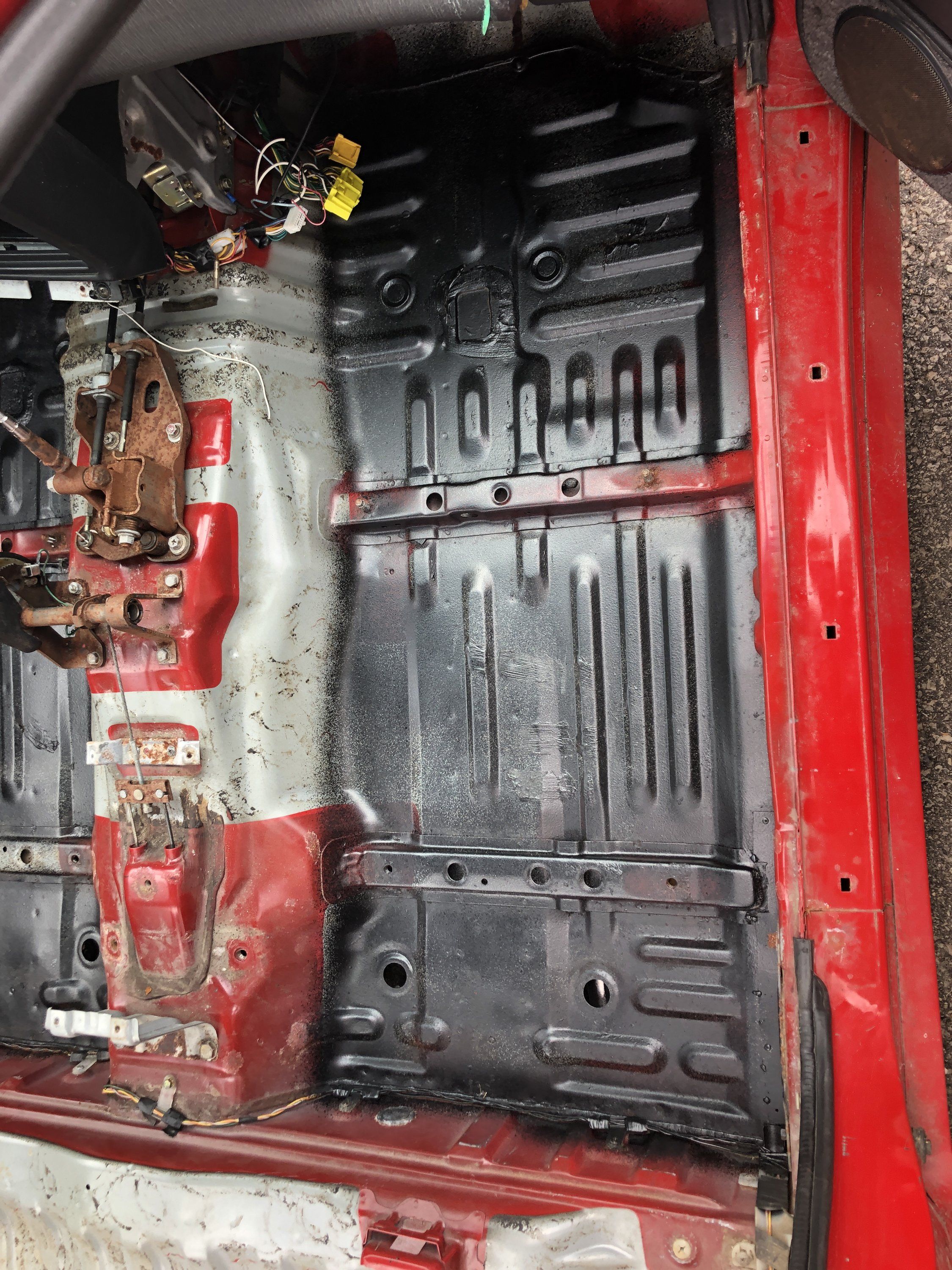

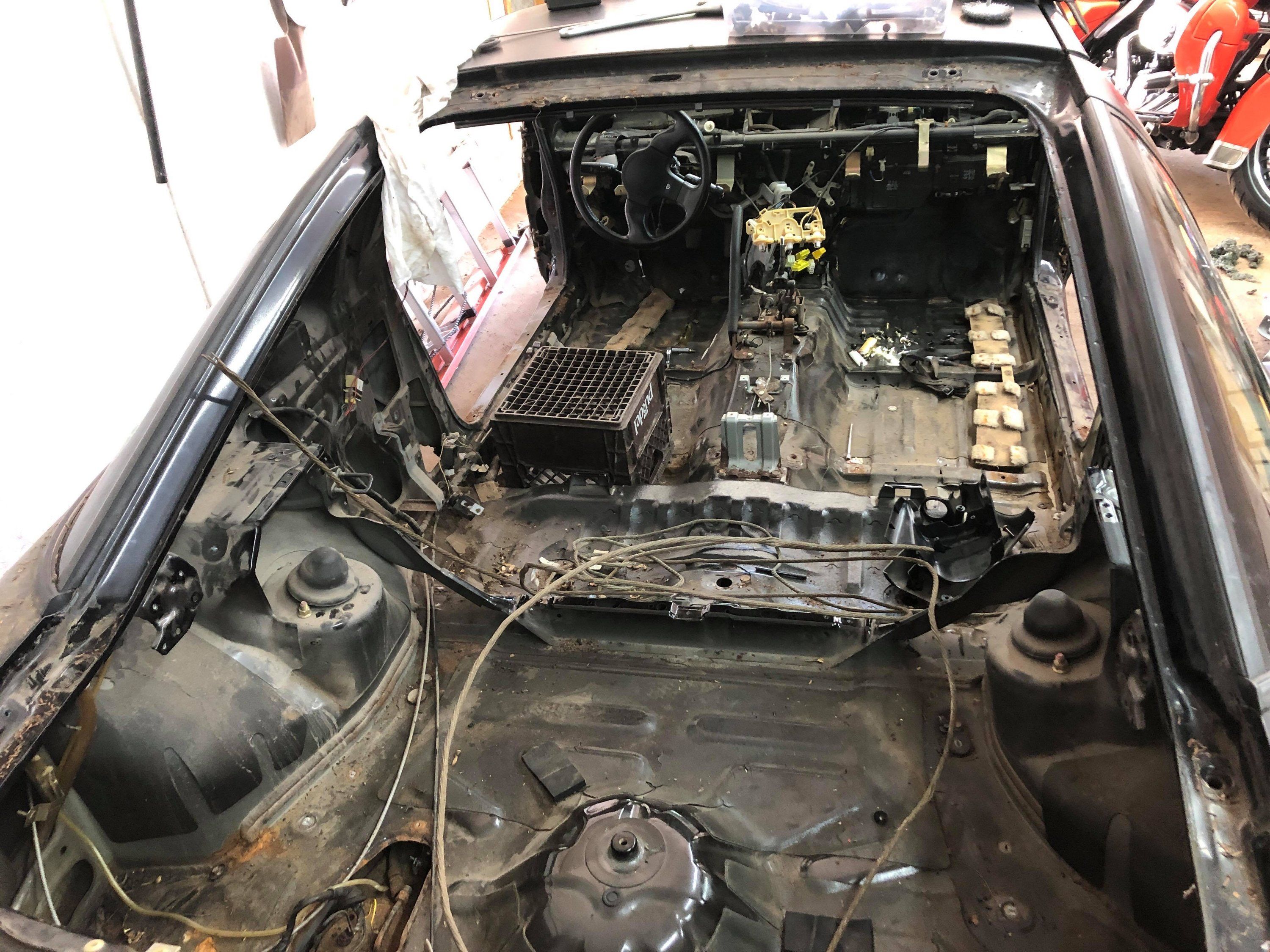

All the interior is done + rear body part too. Front bumper/lamps/accessory will wait at the end (after the engine).

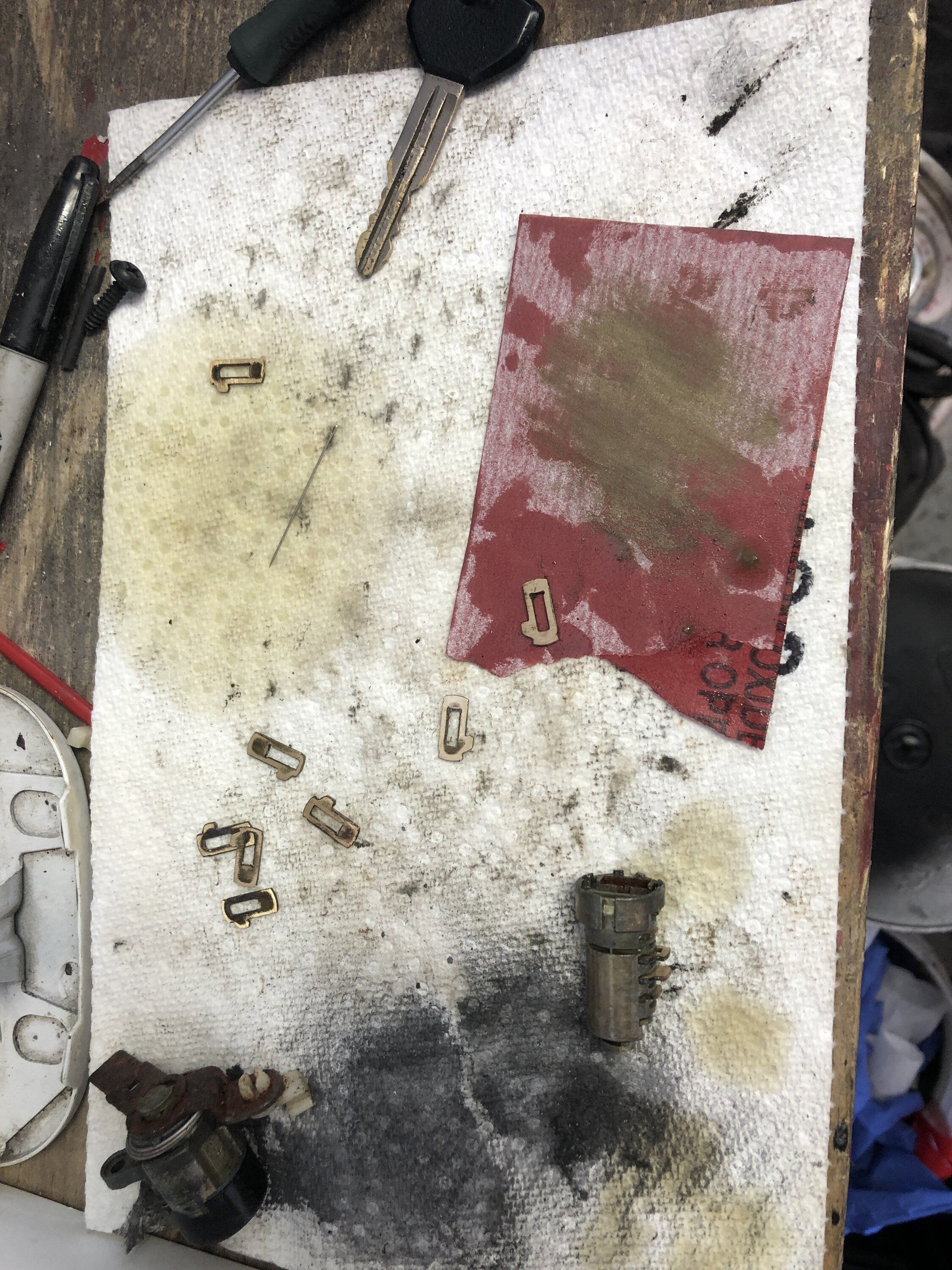

All of the damn key cylinder was seized up. had to play to the locksmith. First try at this and everything thing went perfect. thx to a write-up on the forum.

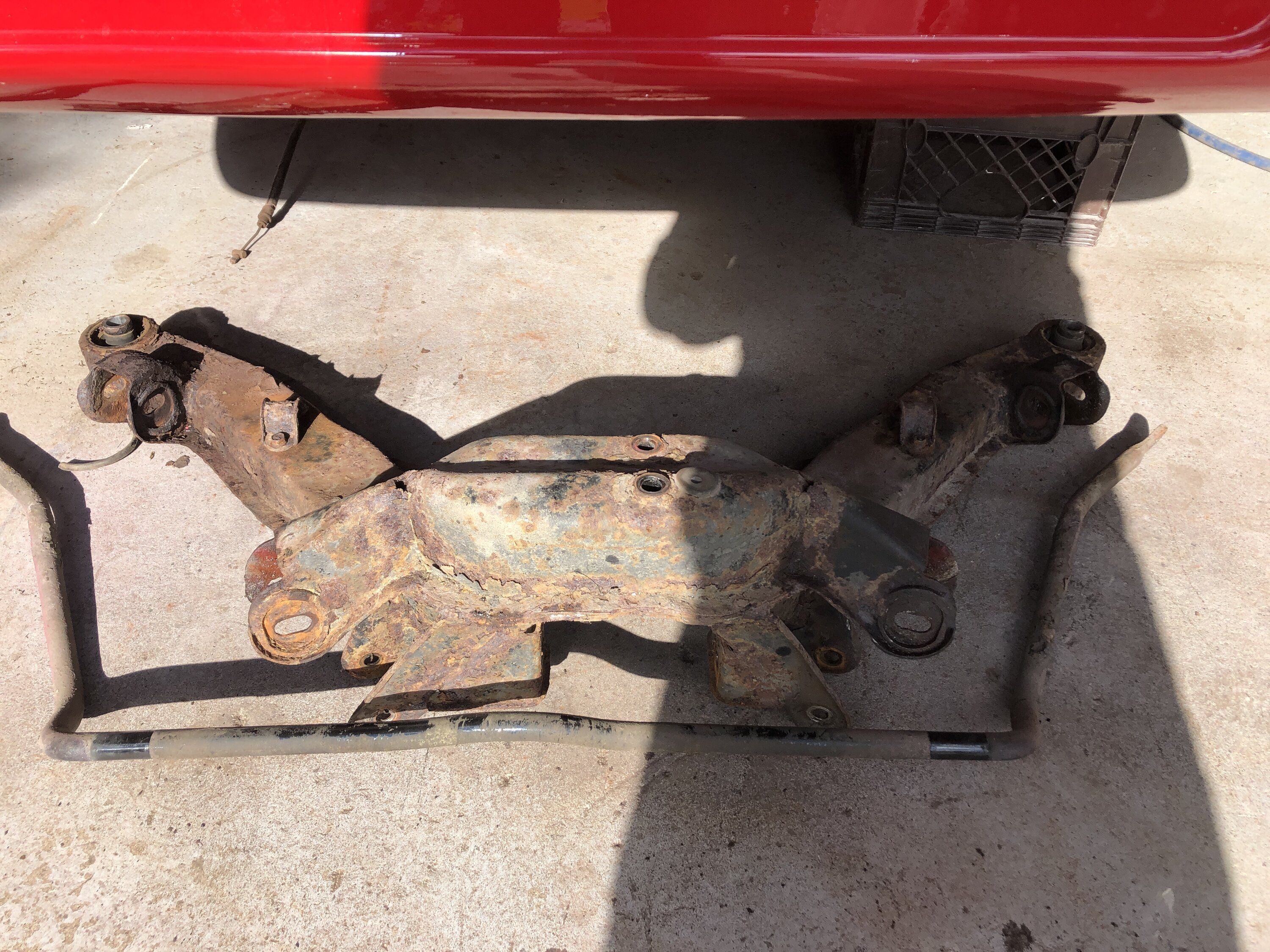

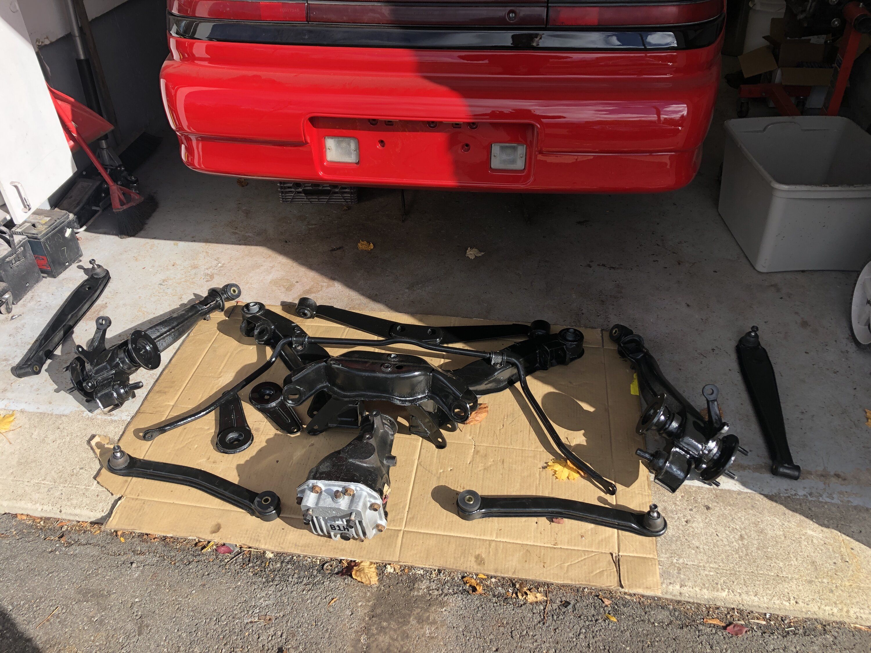

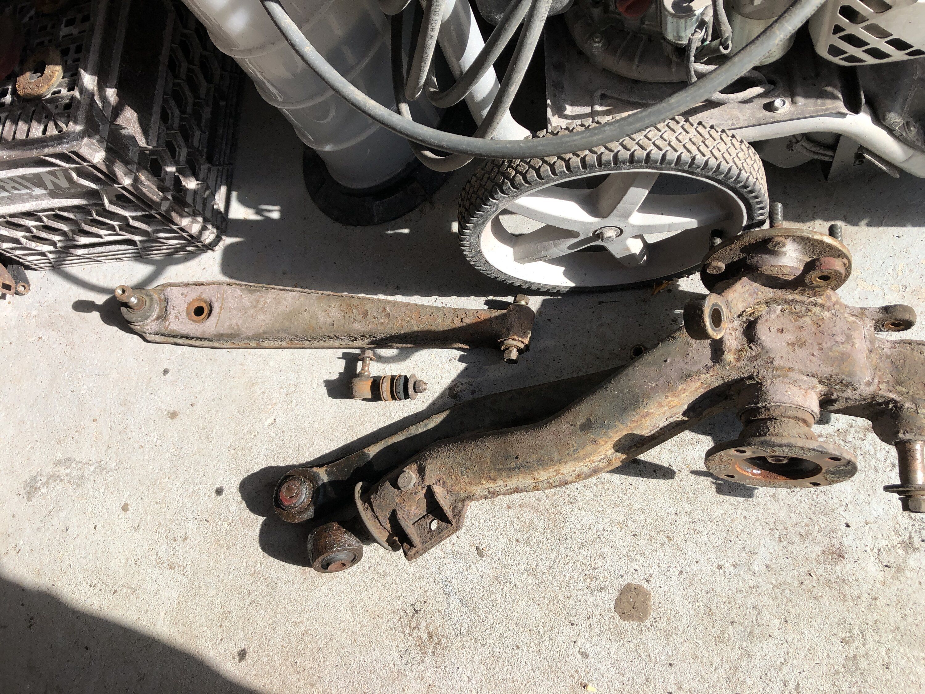

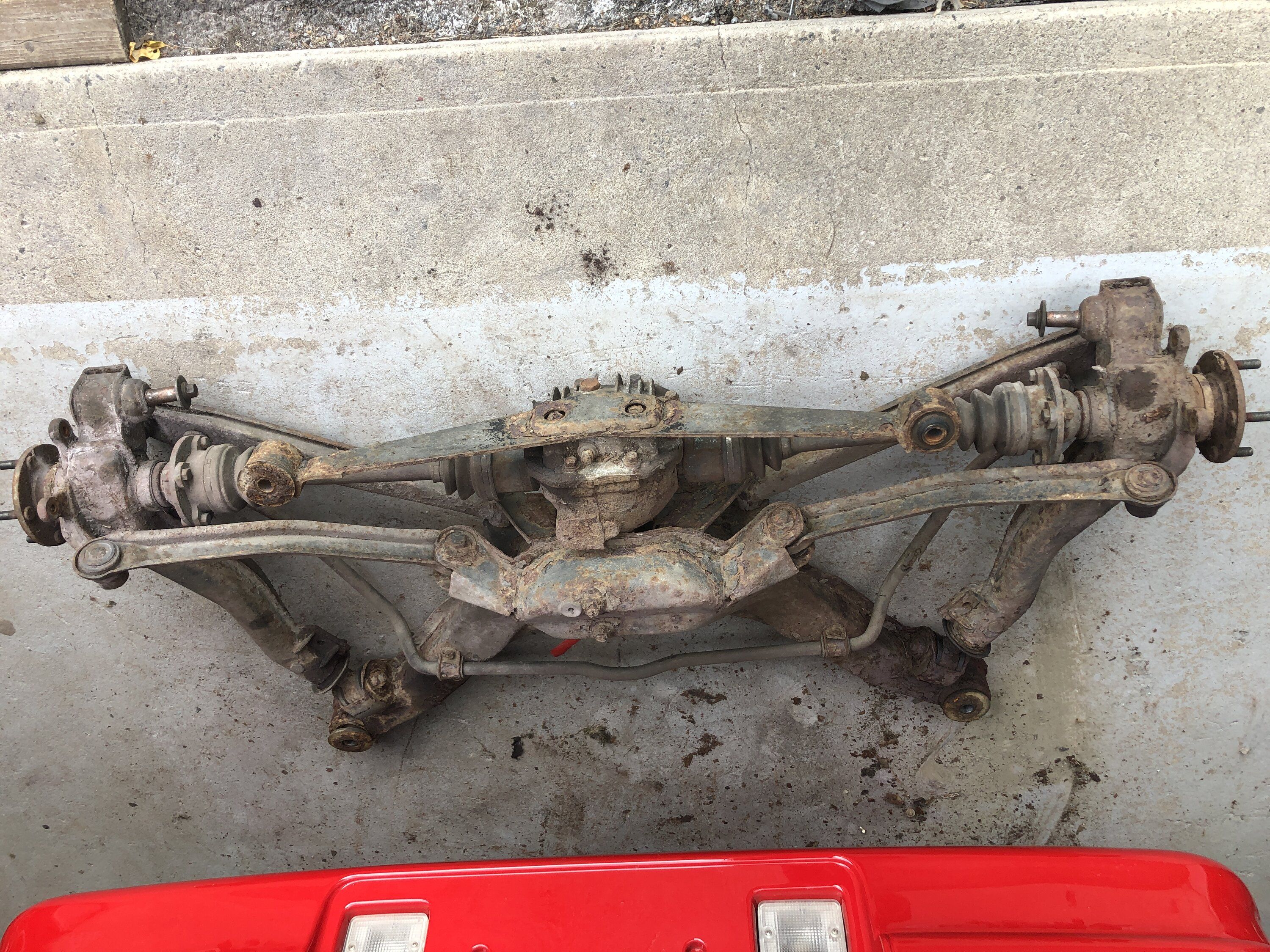

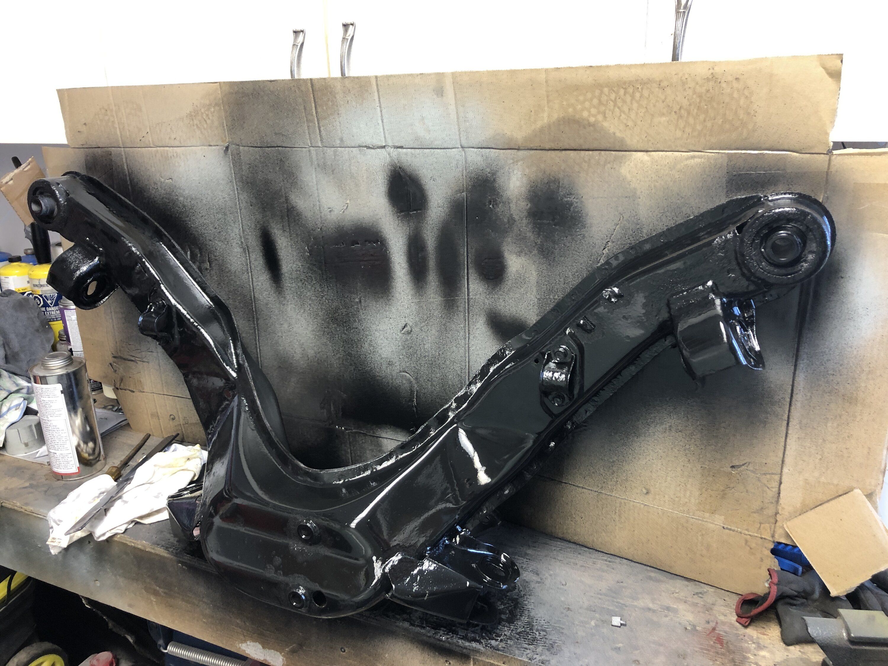

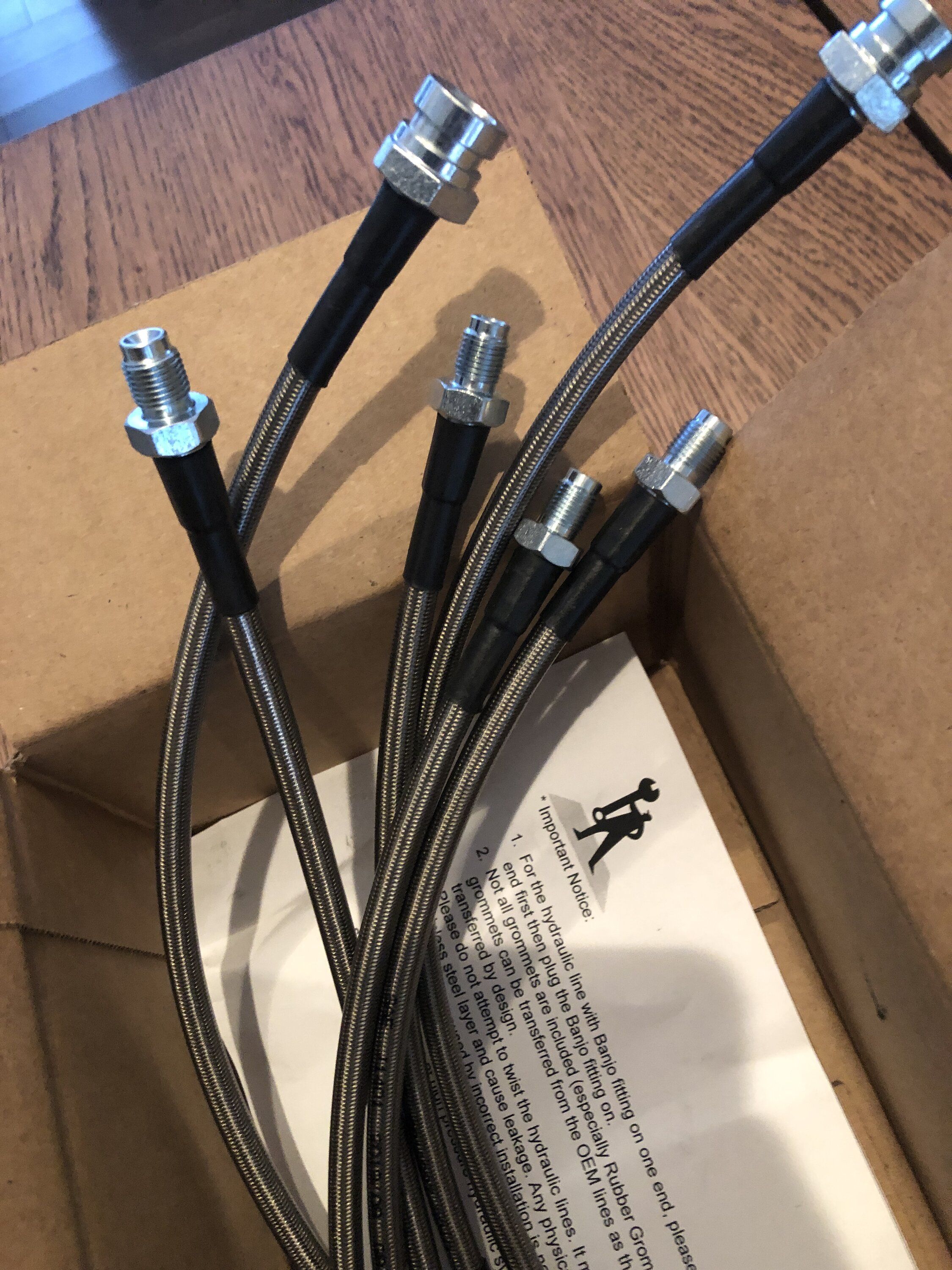

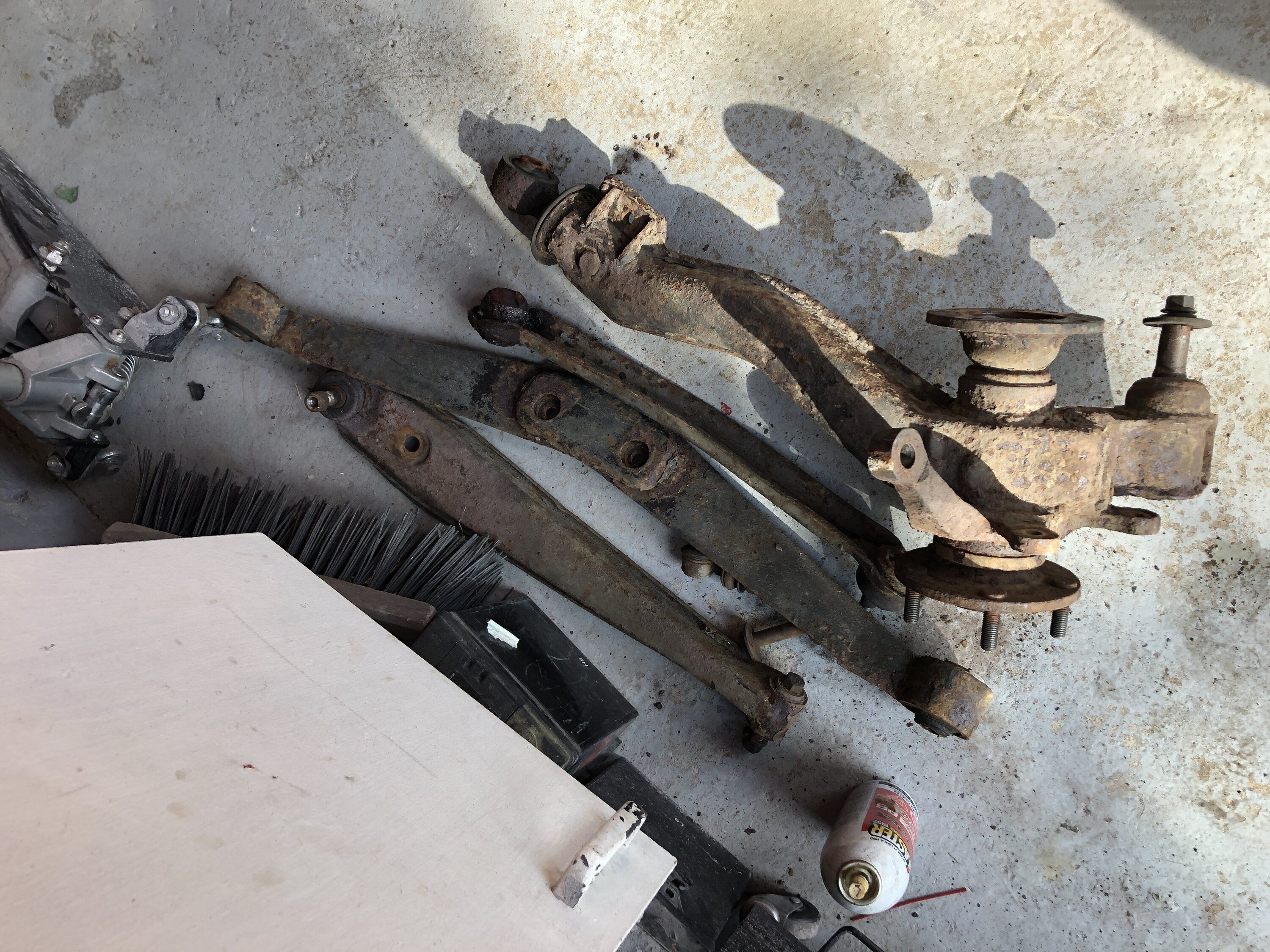

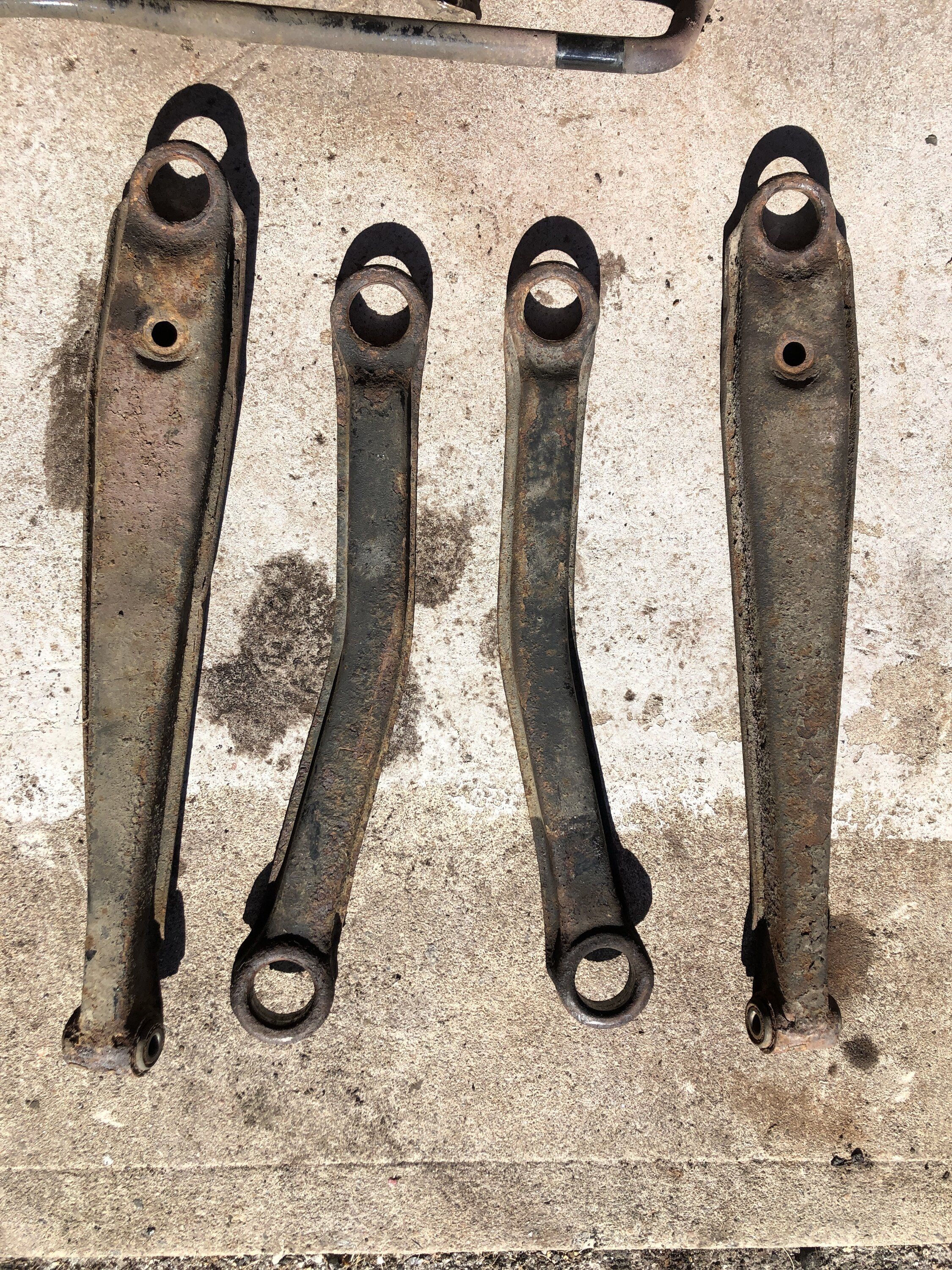

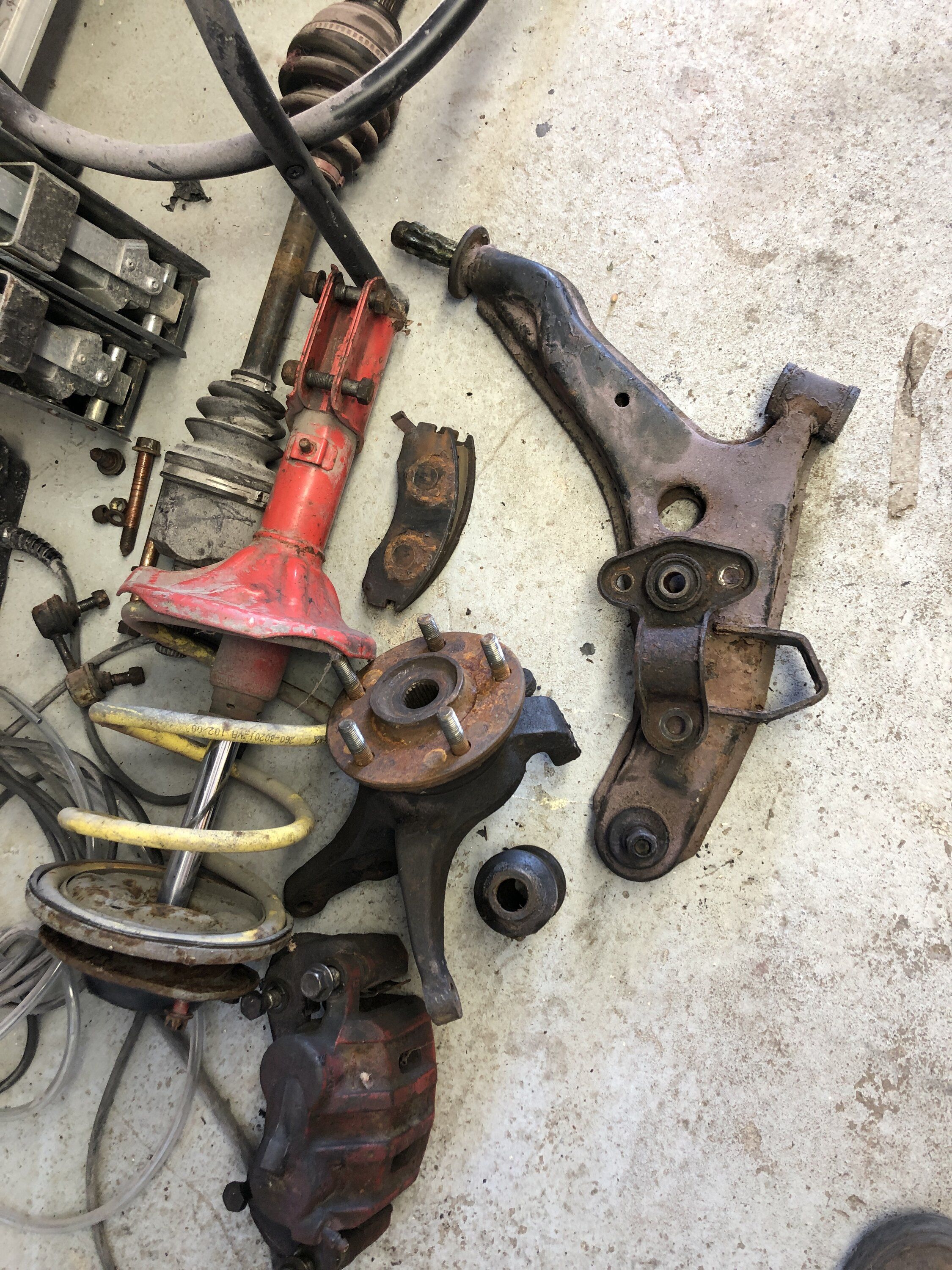

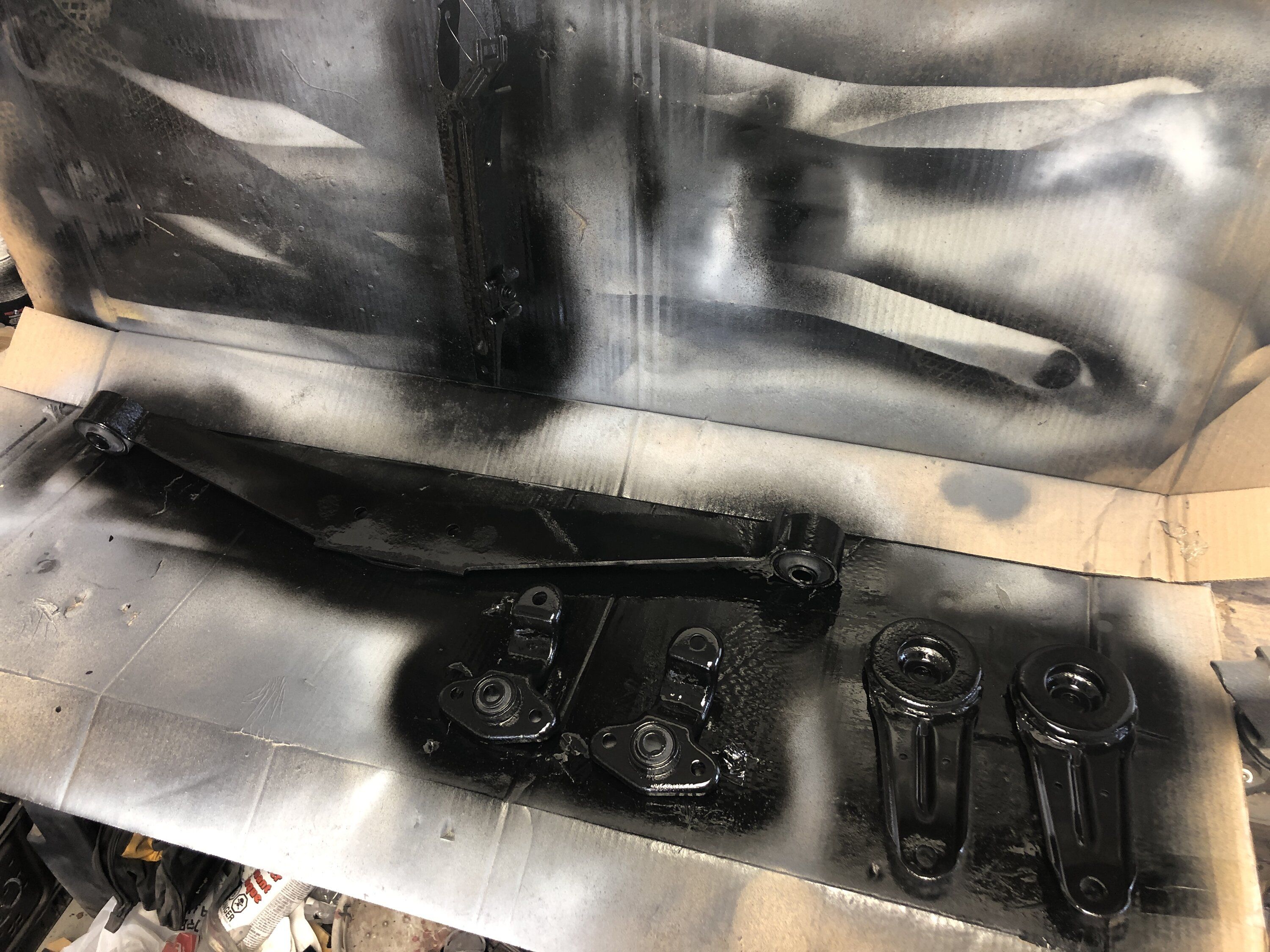

Now im rebuilding the suspension/direction/brake/fuel&brake lines.
Everything will be sandblast like my previous build.

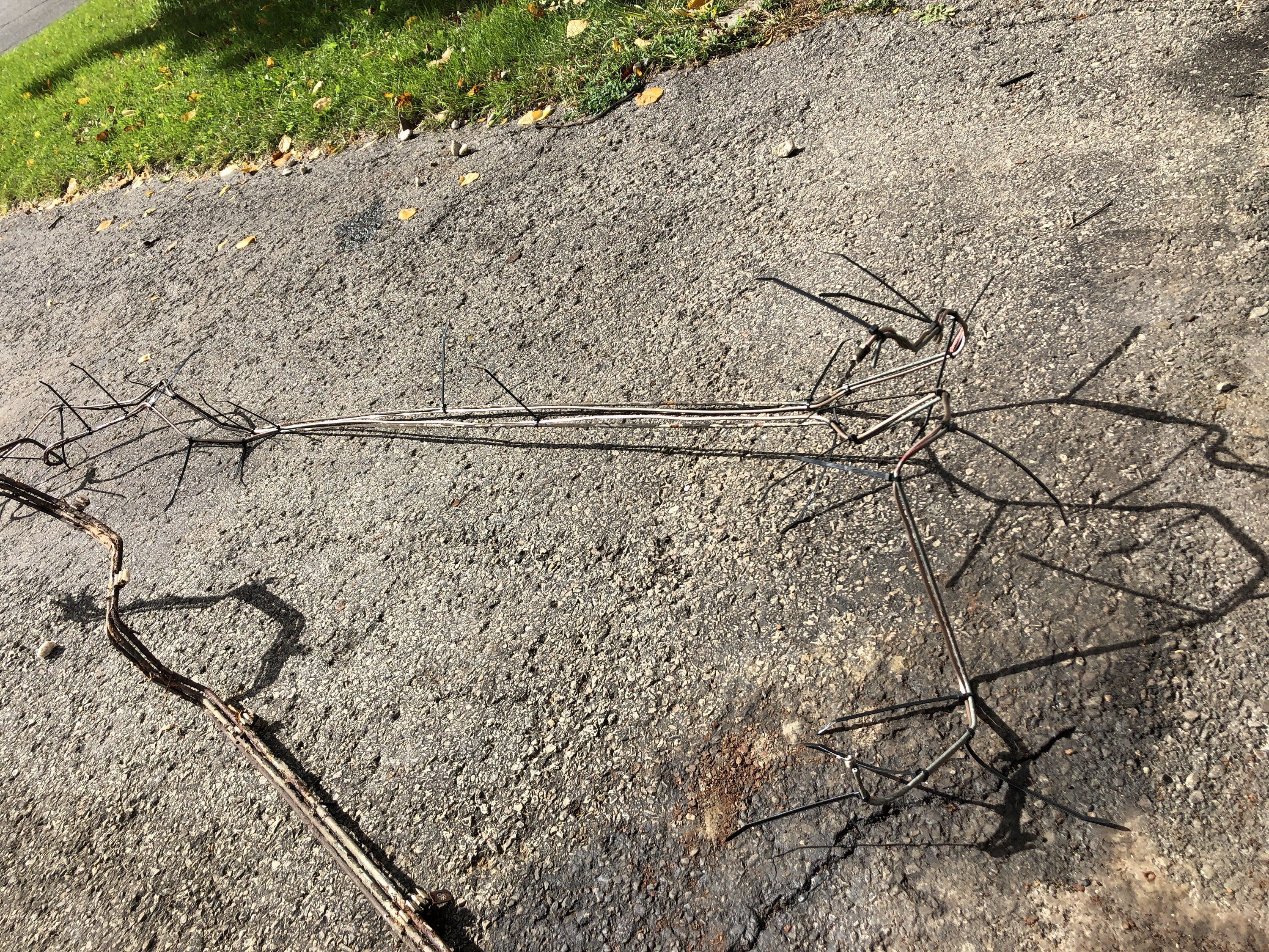

Between the wait time for the blasting, i'll do the new brake/fuel lines.
Already clean and repaint the underside of the car while everything is off the car.
All new balljoint/bushing kit/tie rods are in the mail, should have this soon.
Cant wait to put everything together !

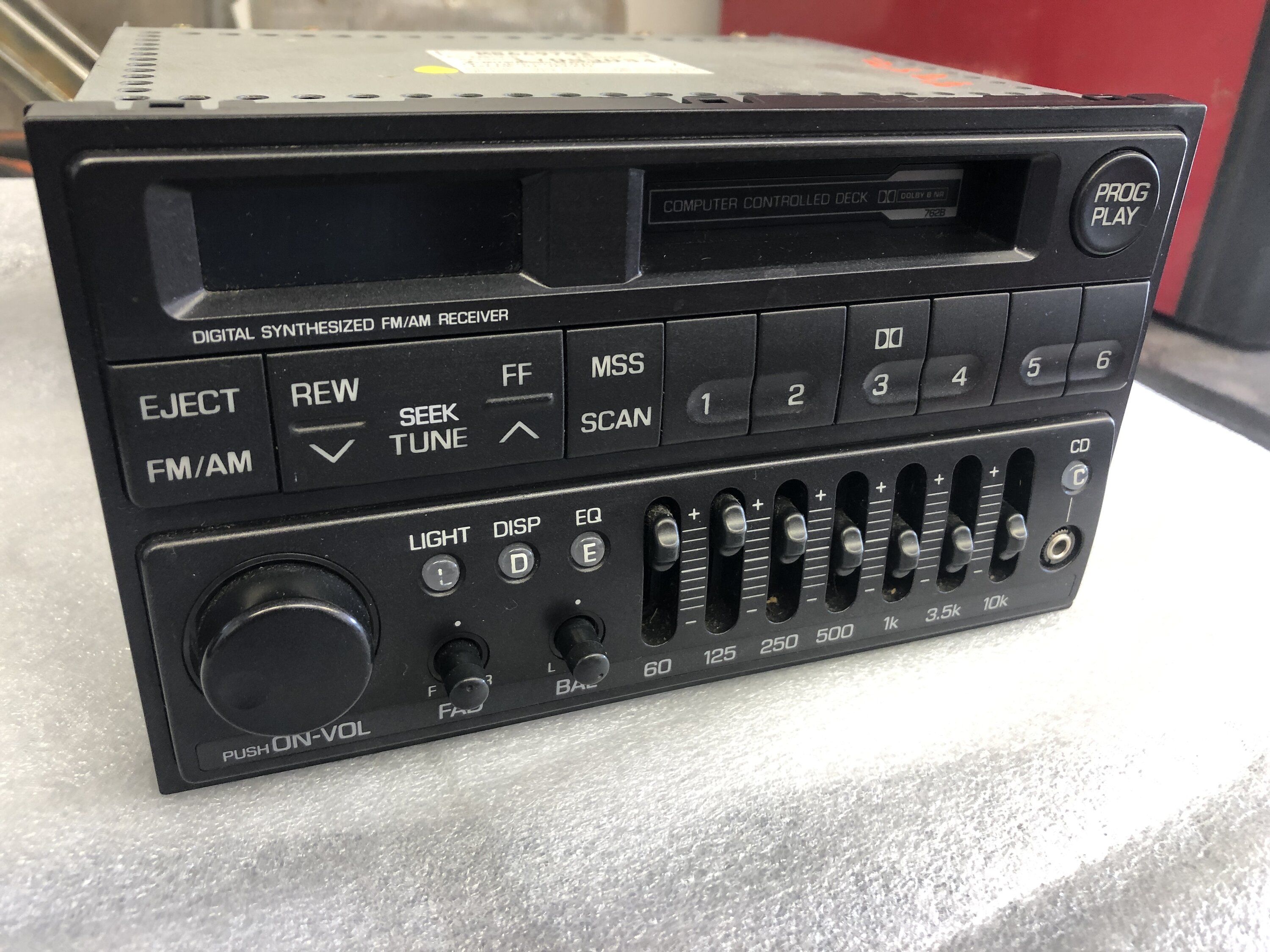

**Im so happy been able to find that OEM 1g radio cassette player!! :)

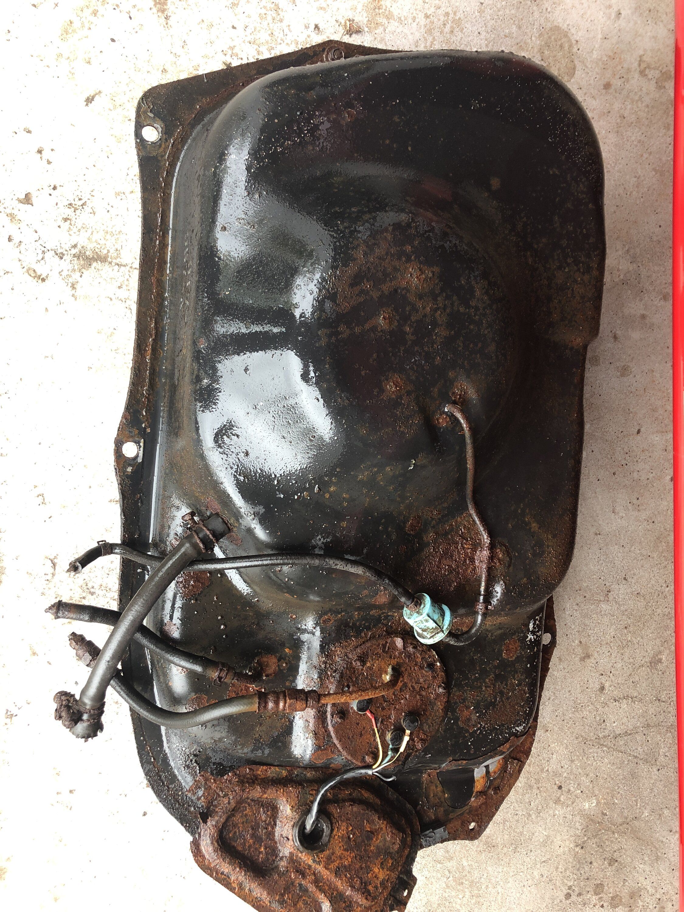

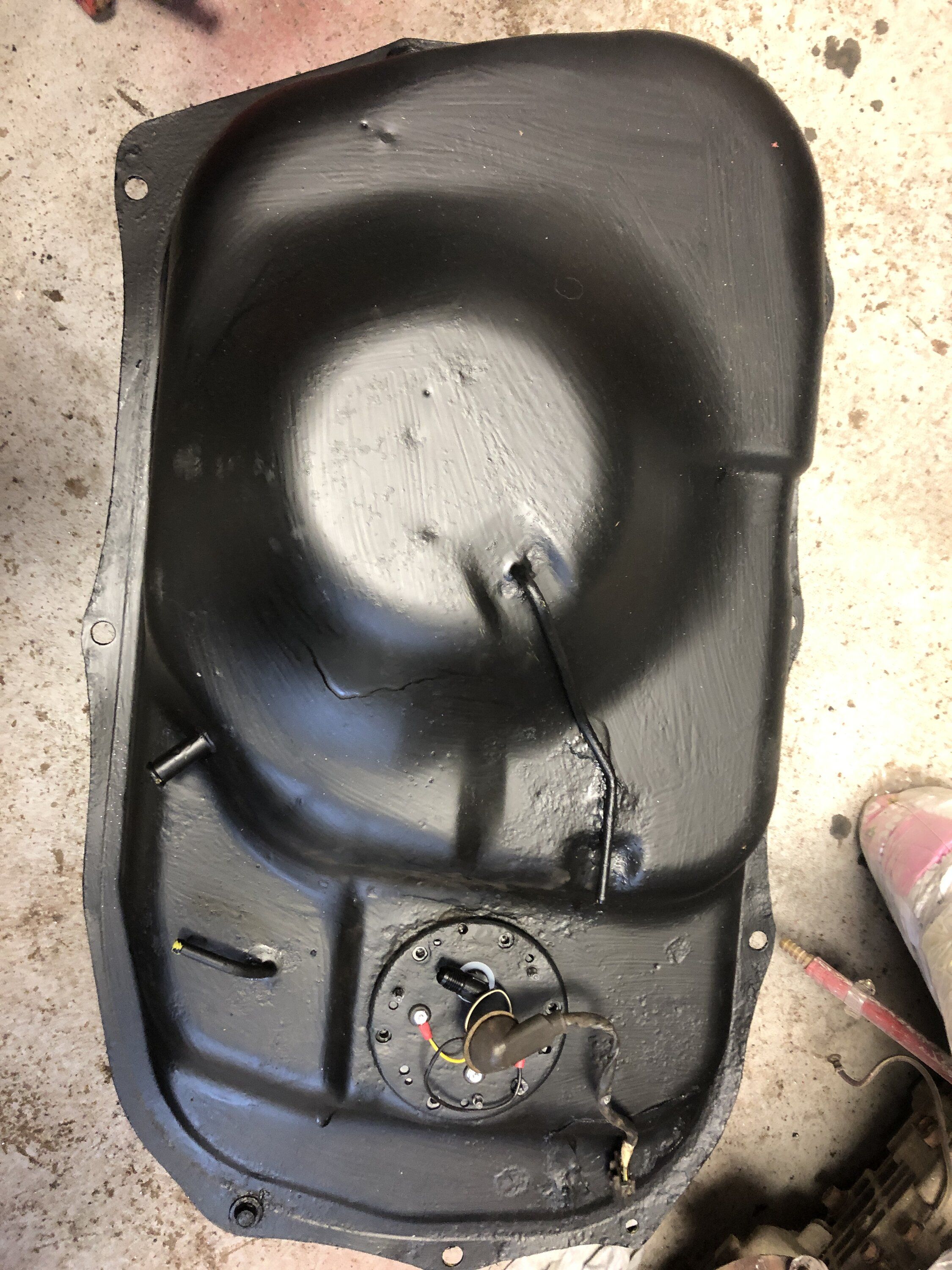

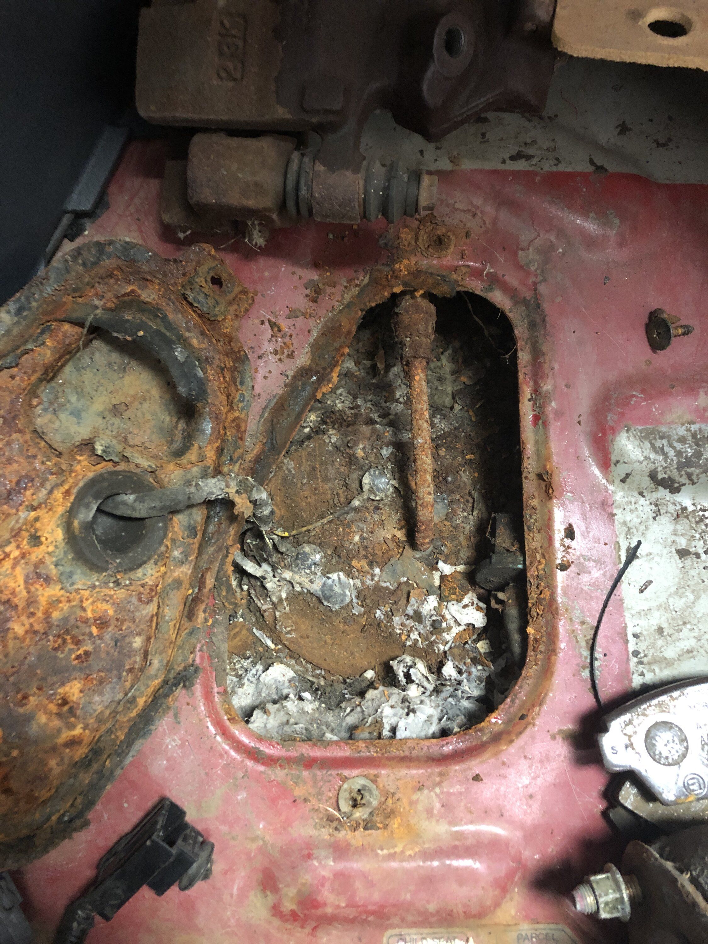

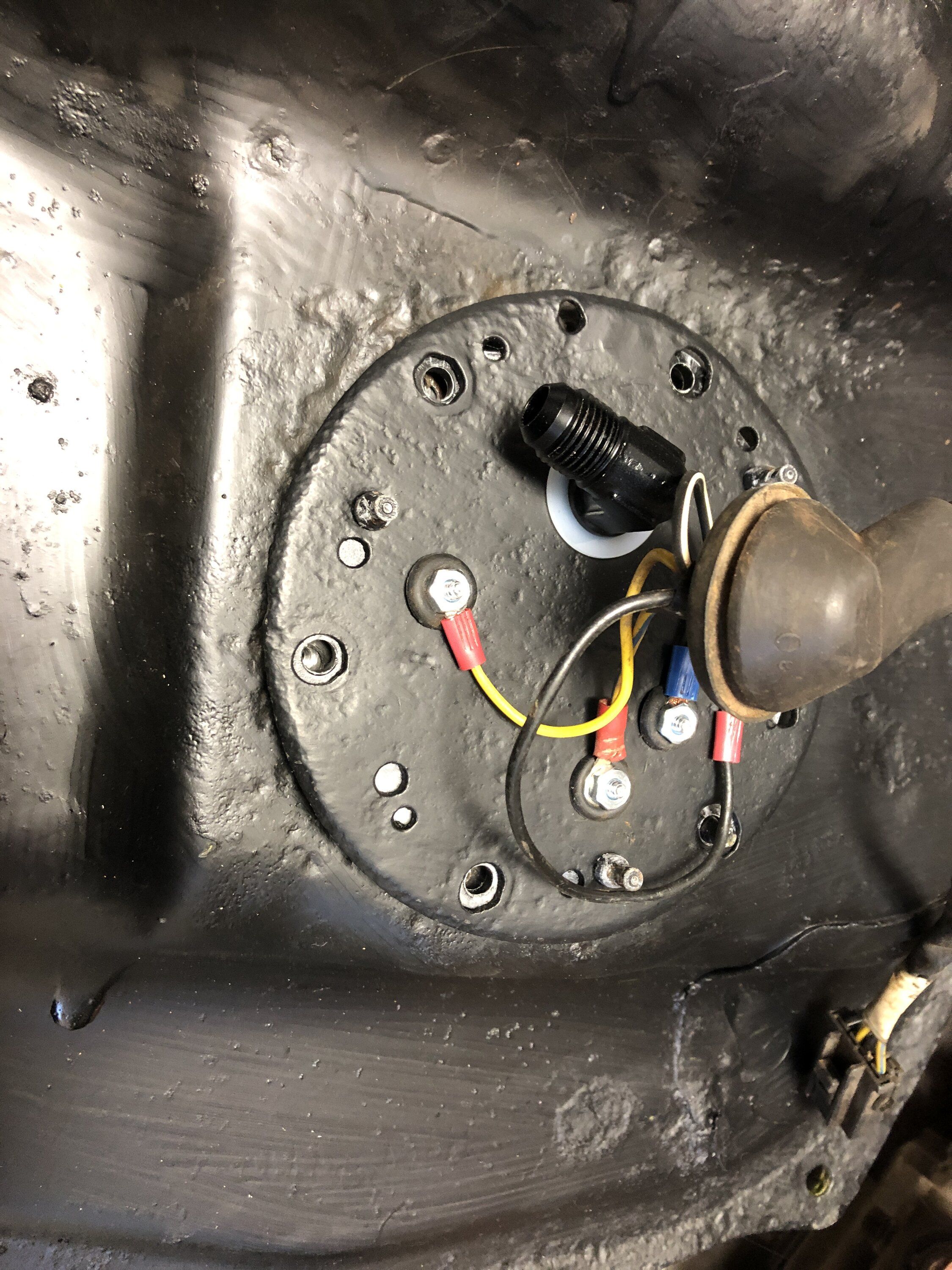

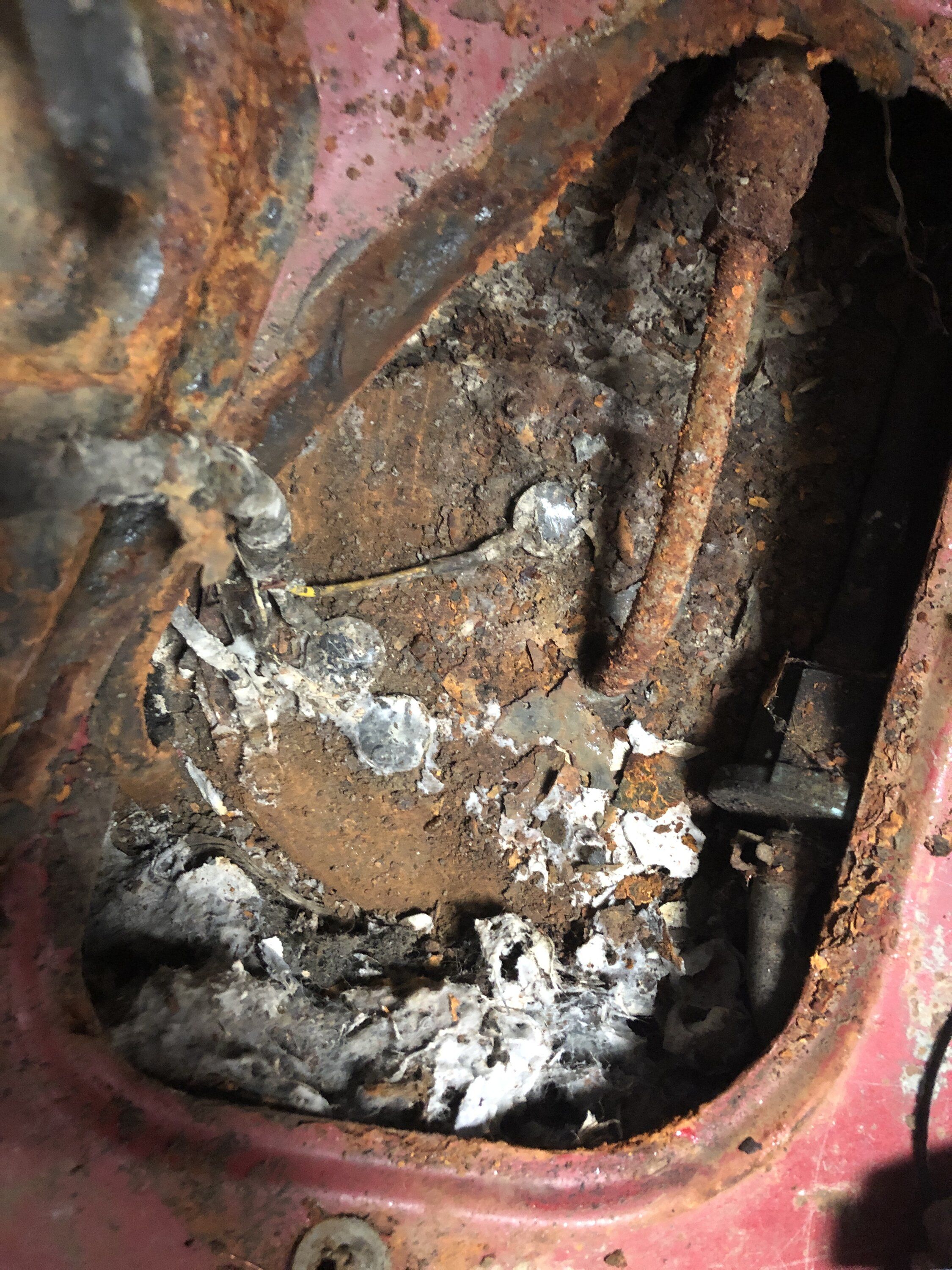

Didnt plan to drop the fuel tank but thank god i did it LOL.
Wtf is that rotting mouse nest.

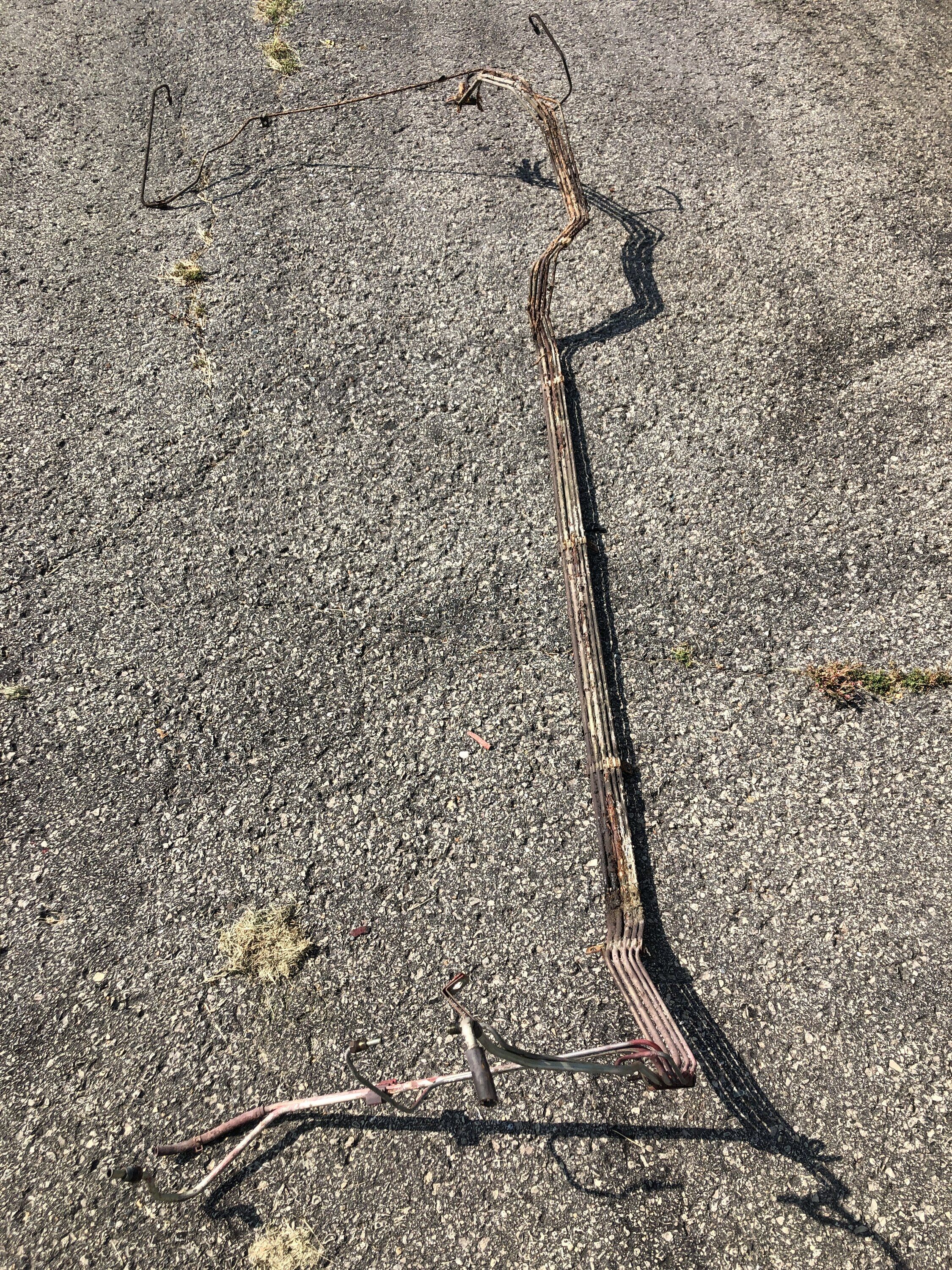

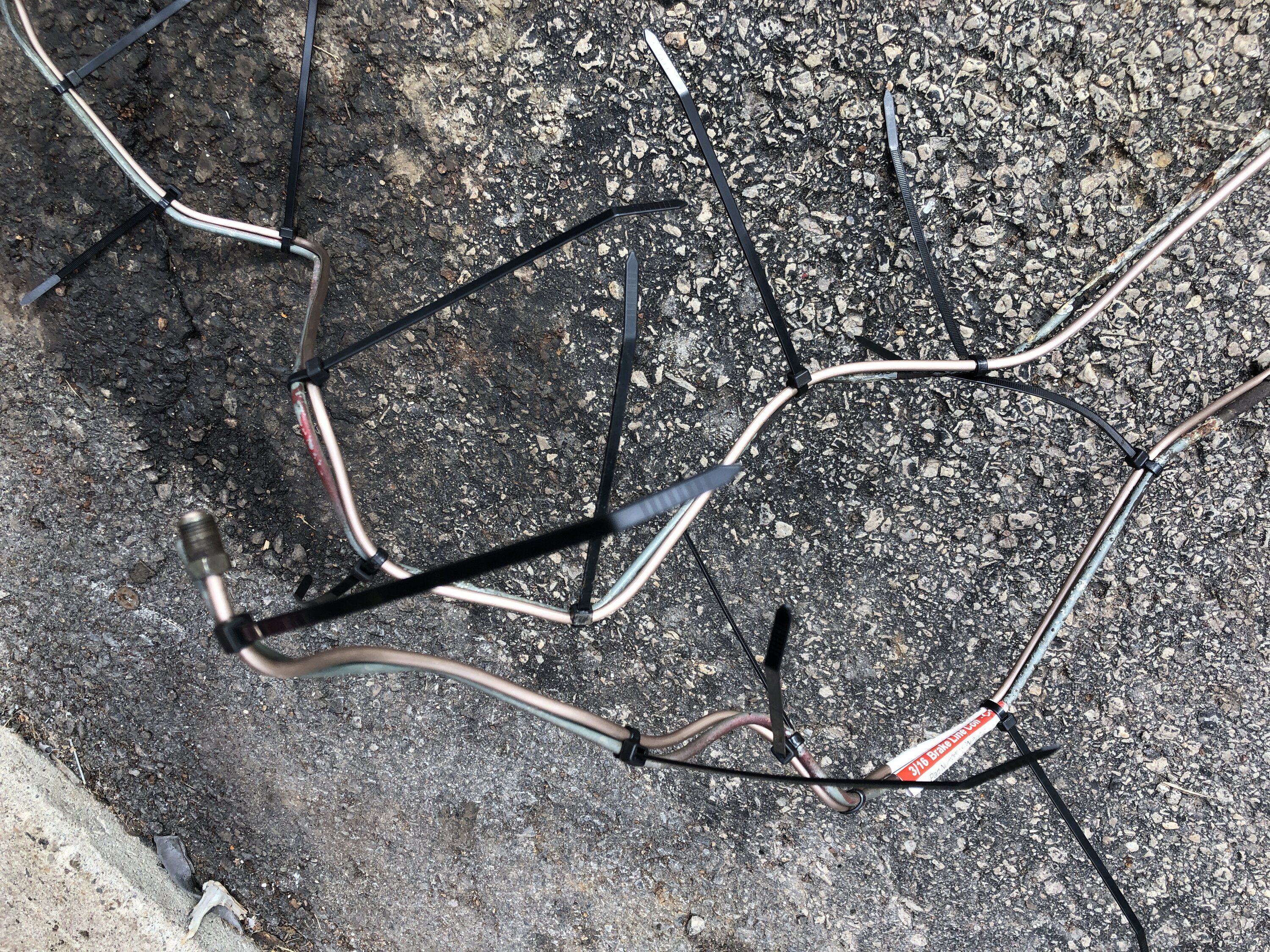

+ i did my brake/fuel line, first try with nickel copper lines and this was so easy to bend. I'll never go back to steel.
While having the fuel tank out, i did clean and paint the tank and the fuel pump hanger with new AN fitting and wiring.

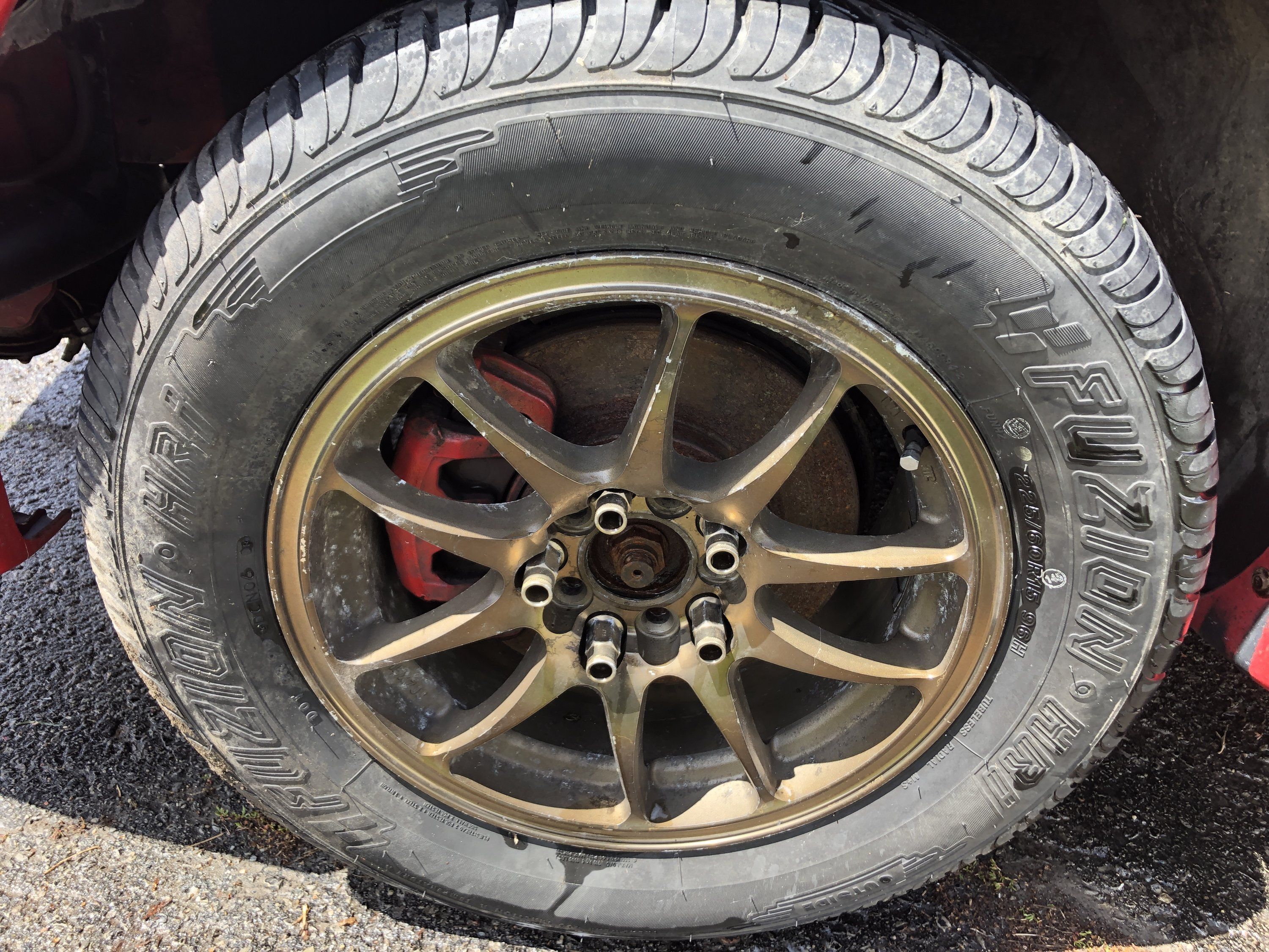

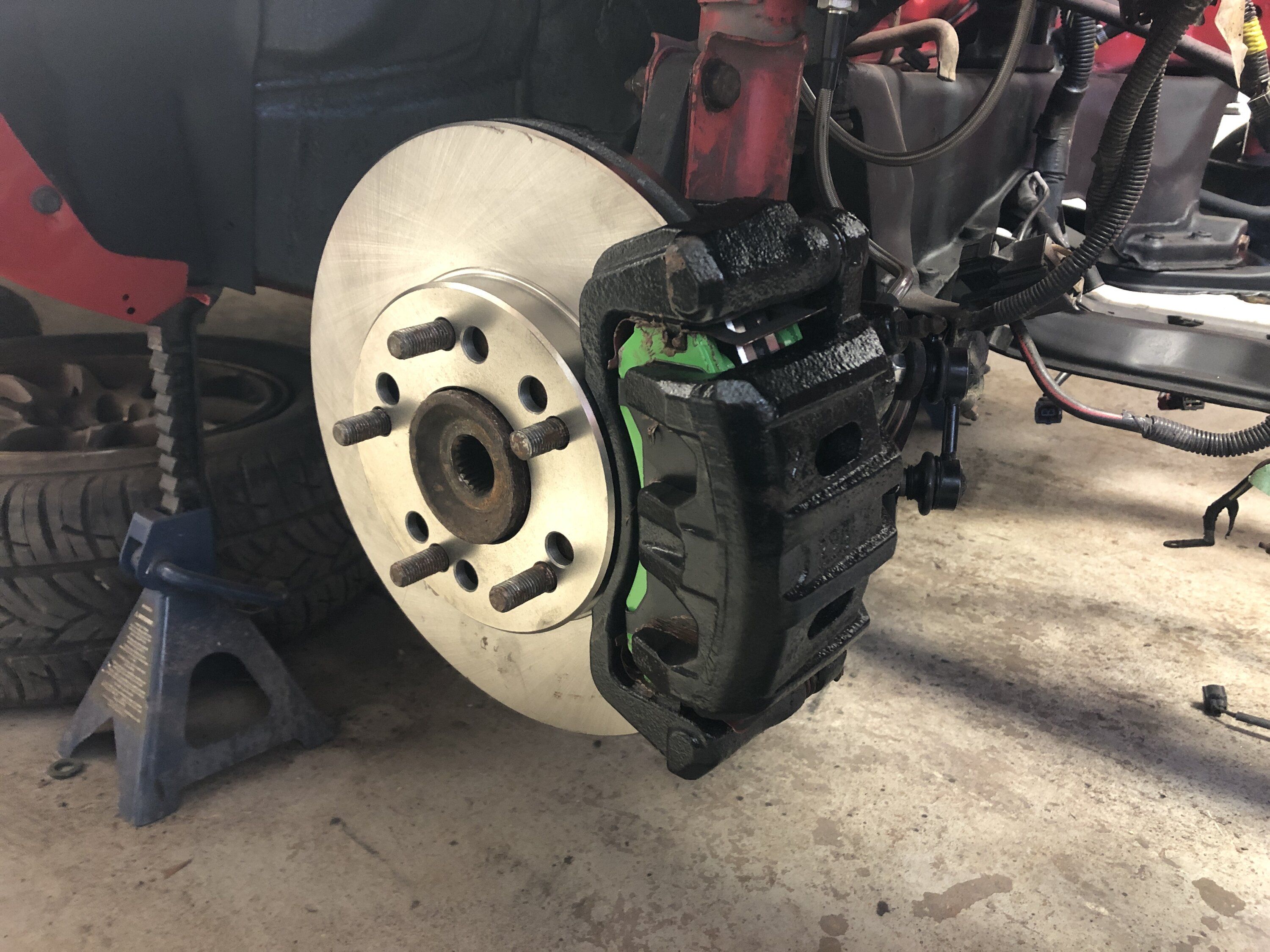

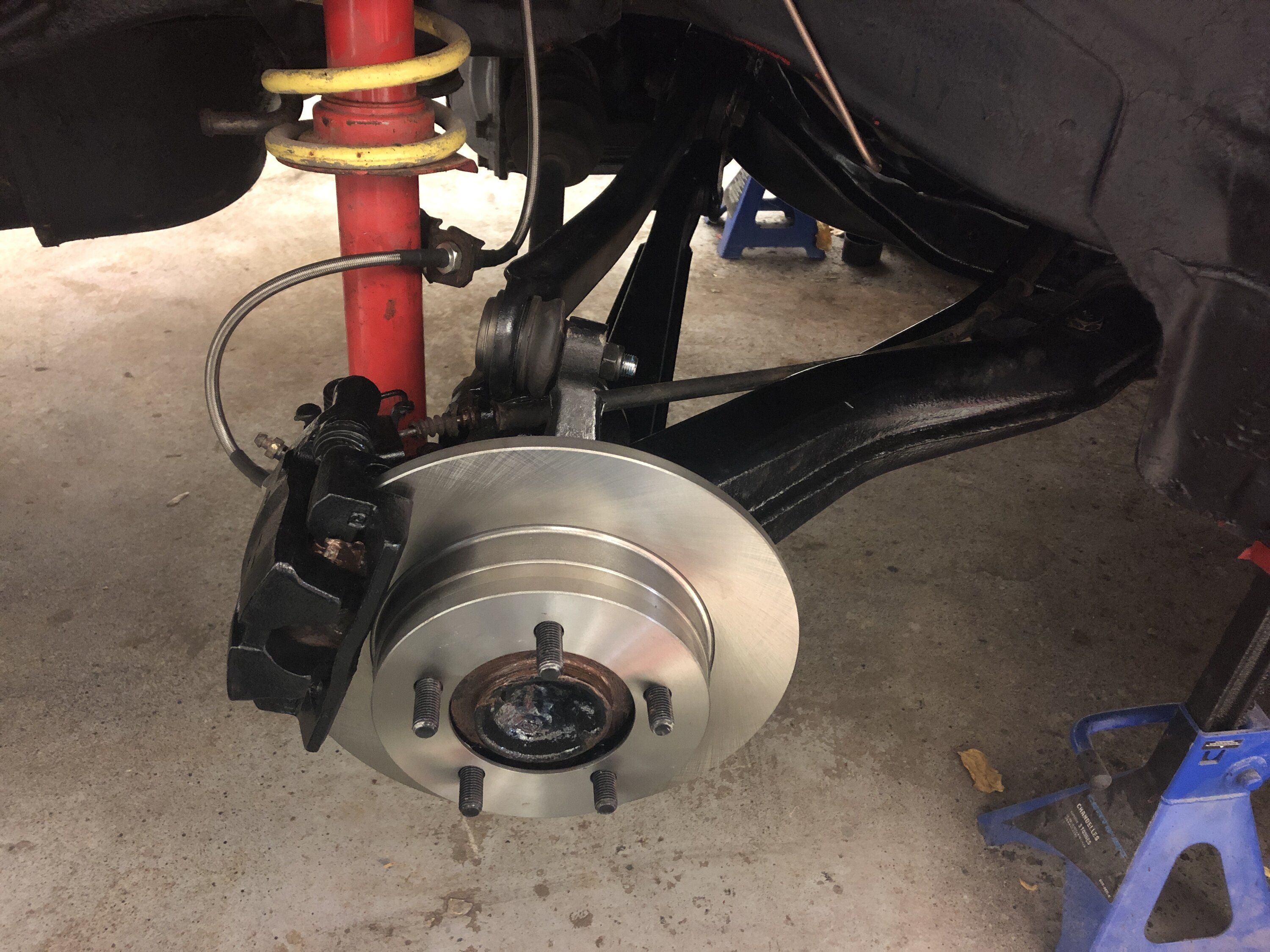

Update!
The car is back as a rolling shell! yeah!
Everything is on with new bushing/balljoint/tie rid/link kit/brake/lines/etc.

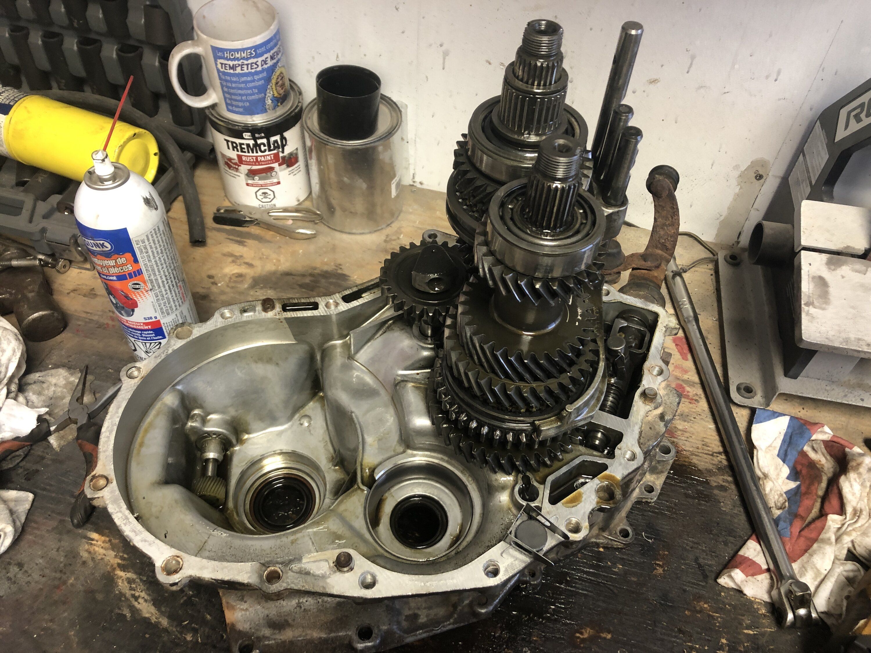

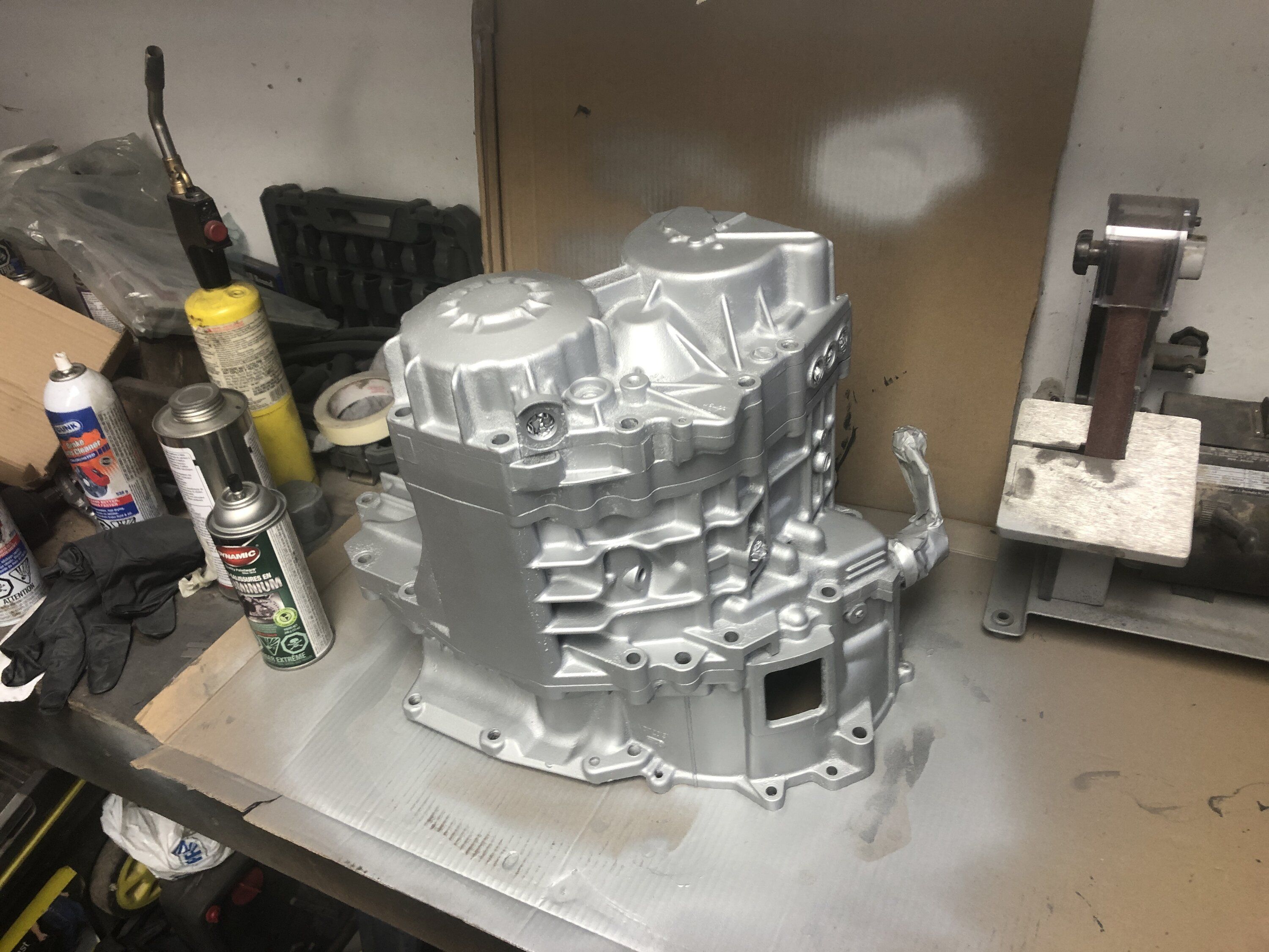

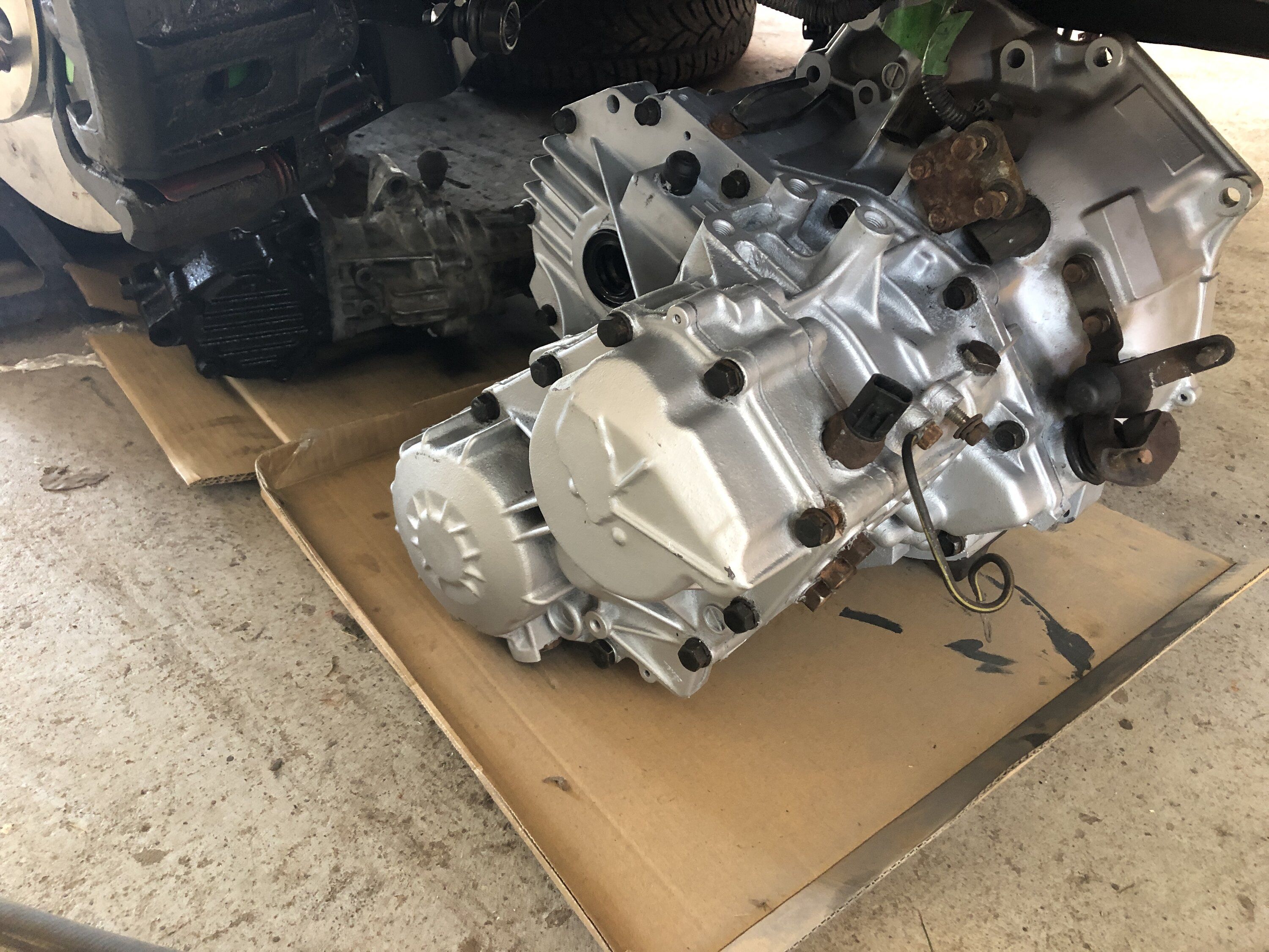

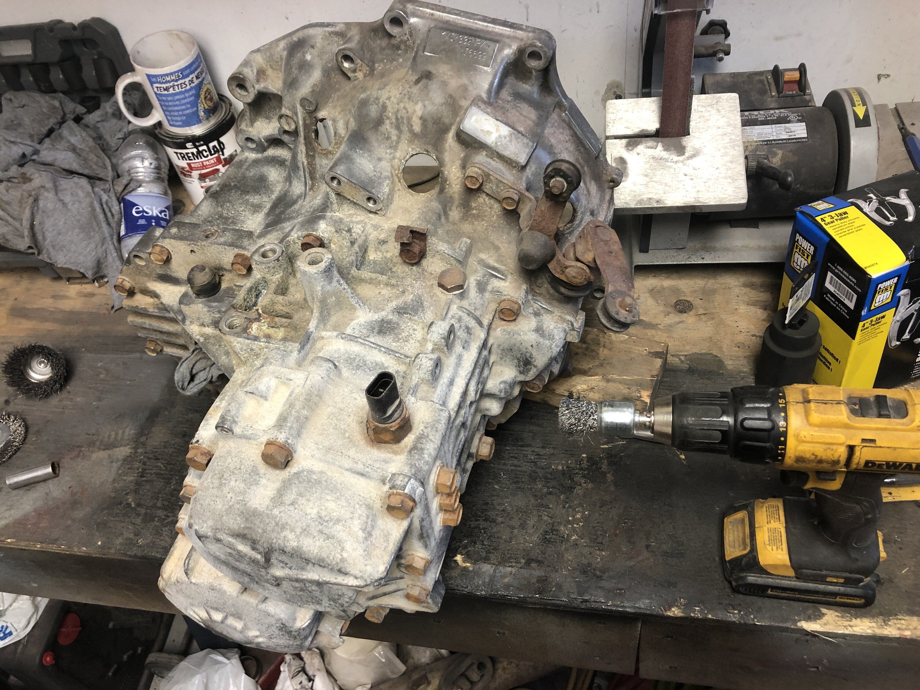

Im now cleaning & inspecting the tranny.
Rear diff is already done, i'll do the transfer case after.
And then... Engine time! i cant wait to clean the garage (now that she's a roller) than start building the engine.

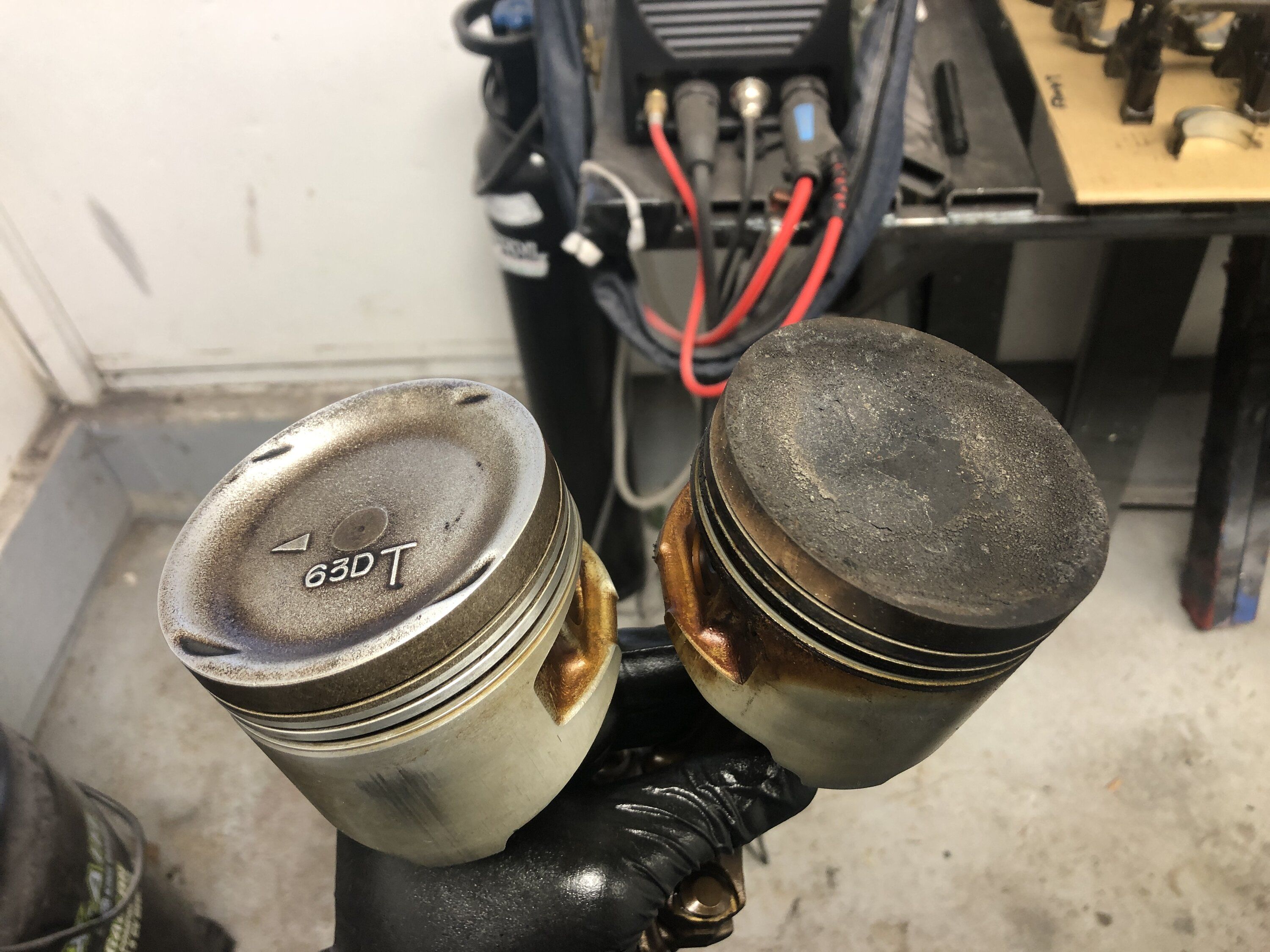

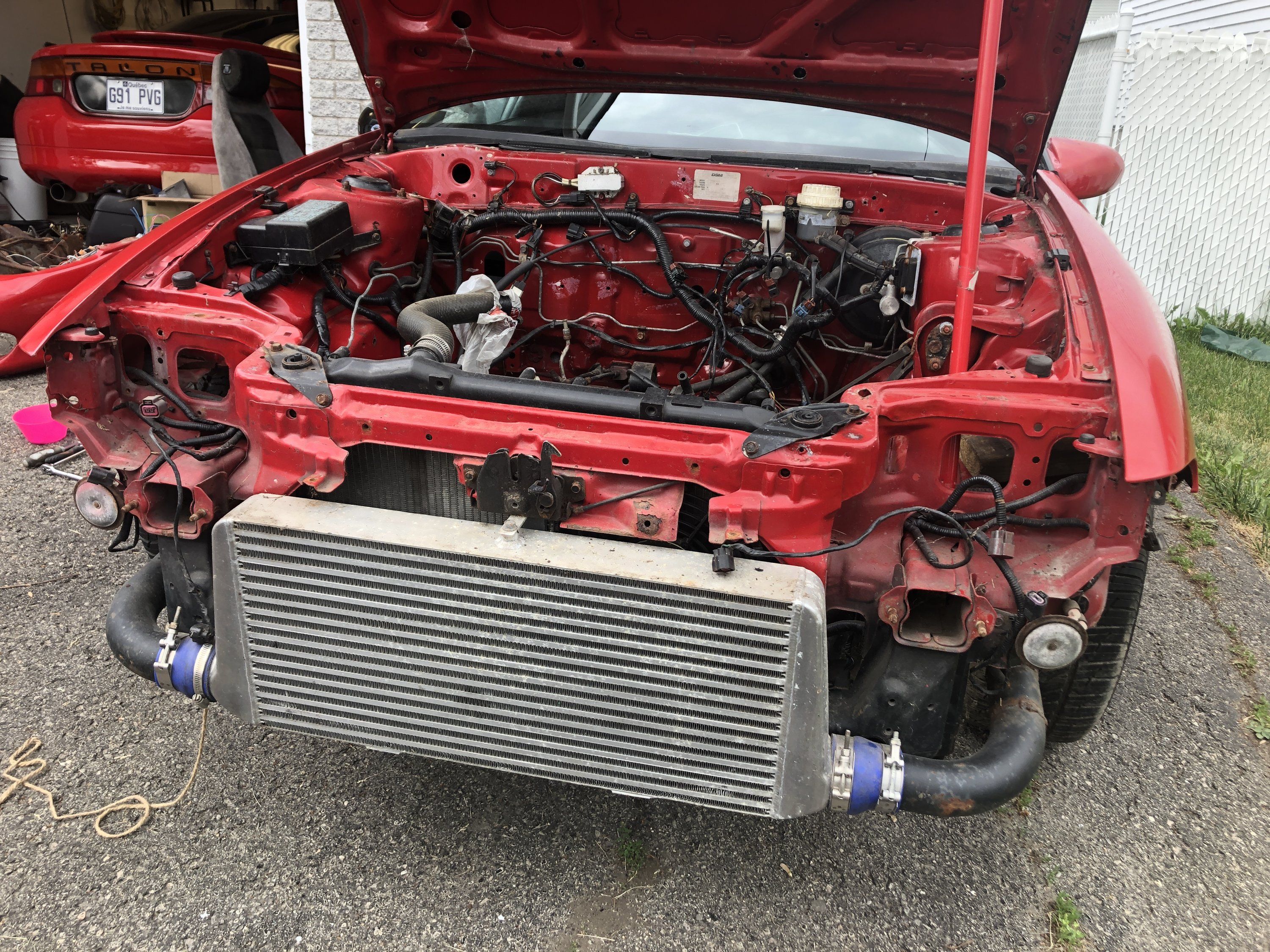

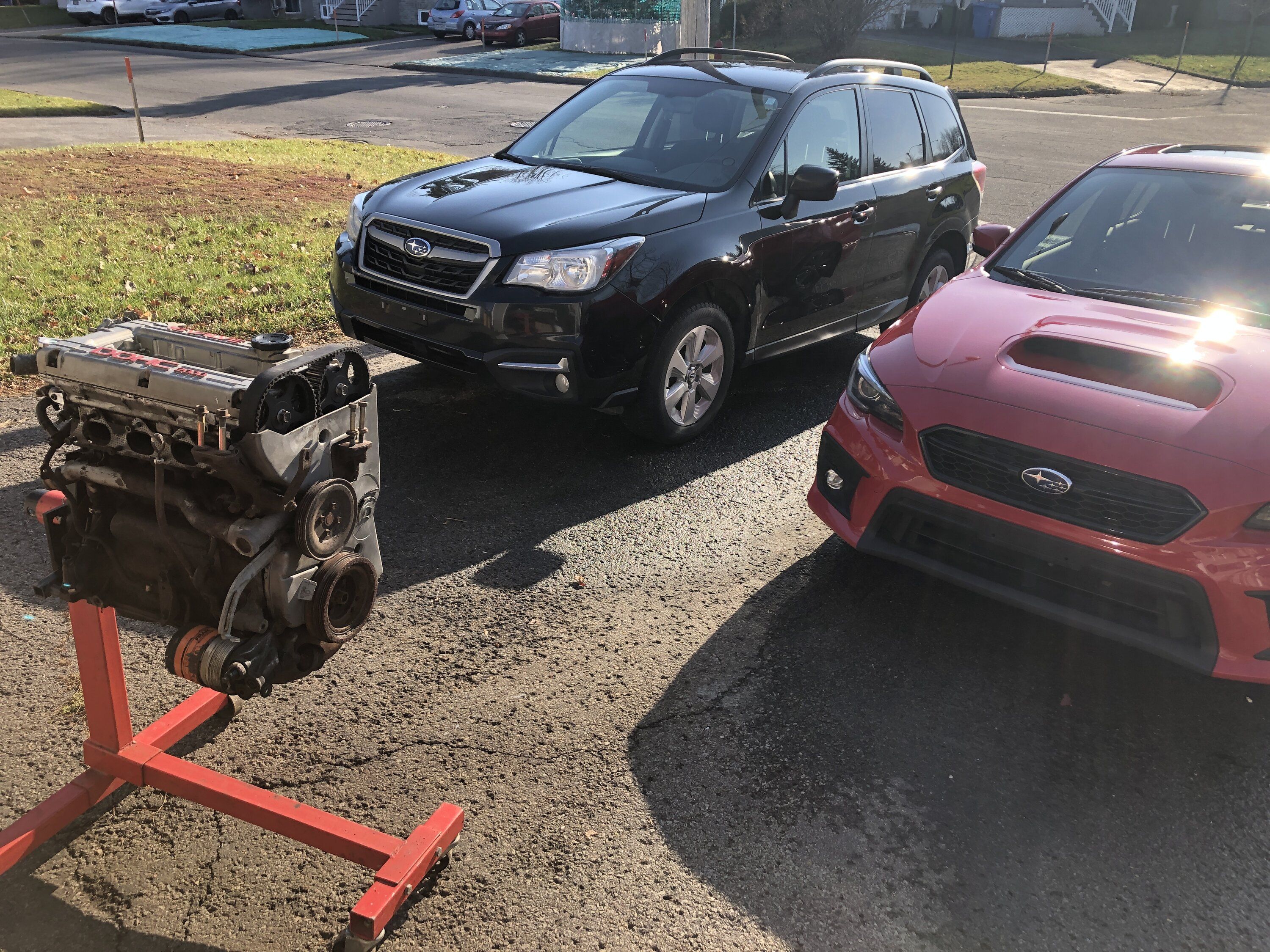

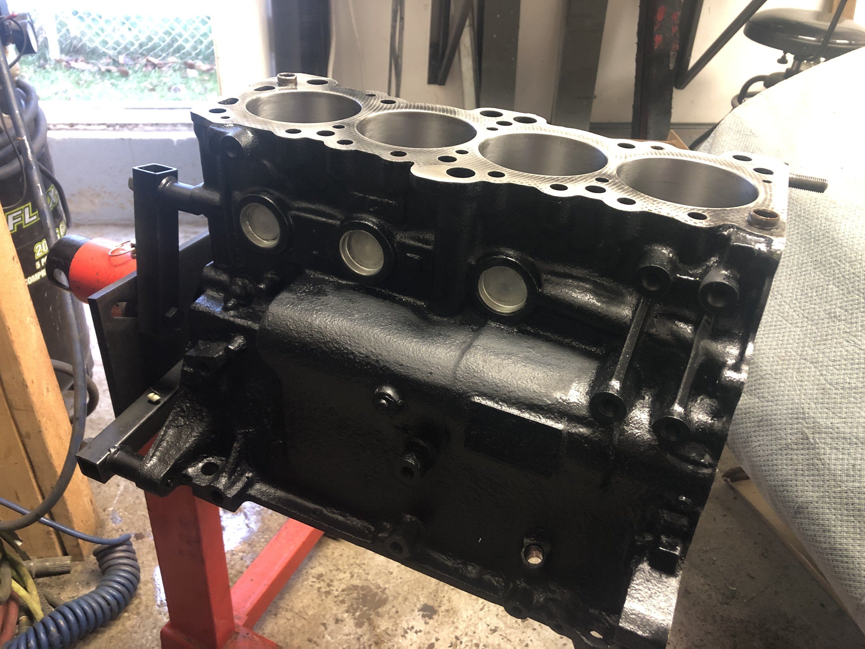

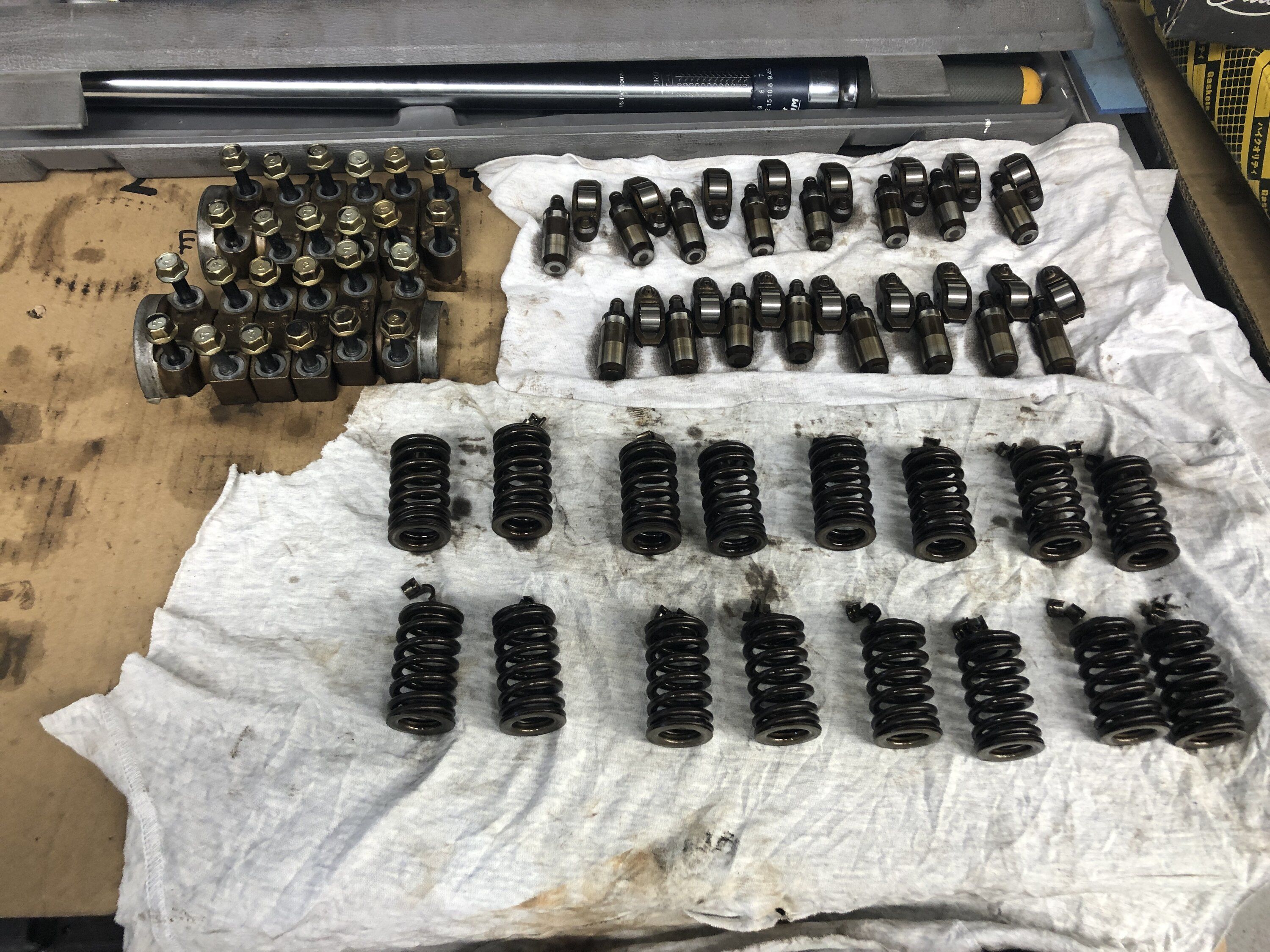

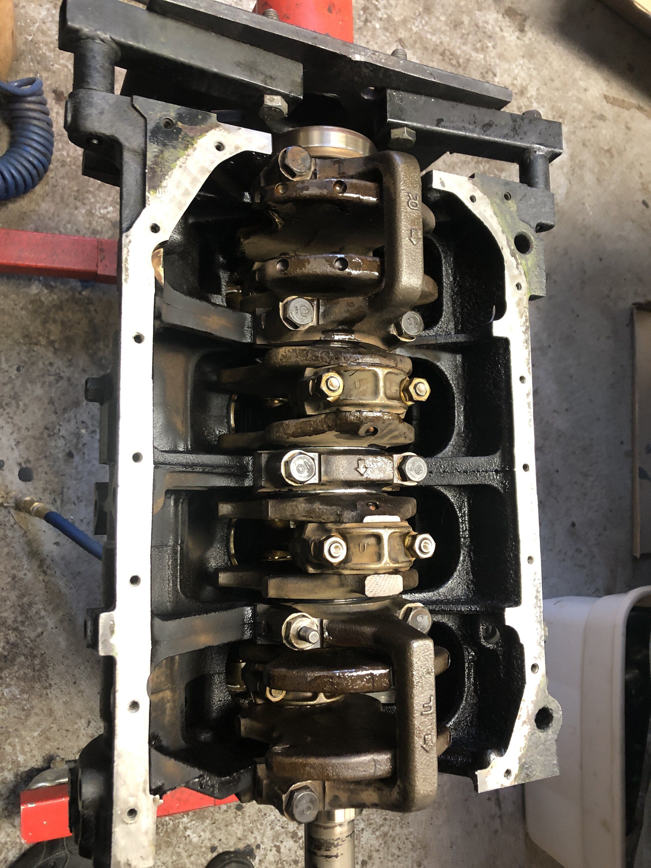

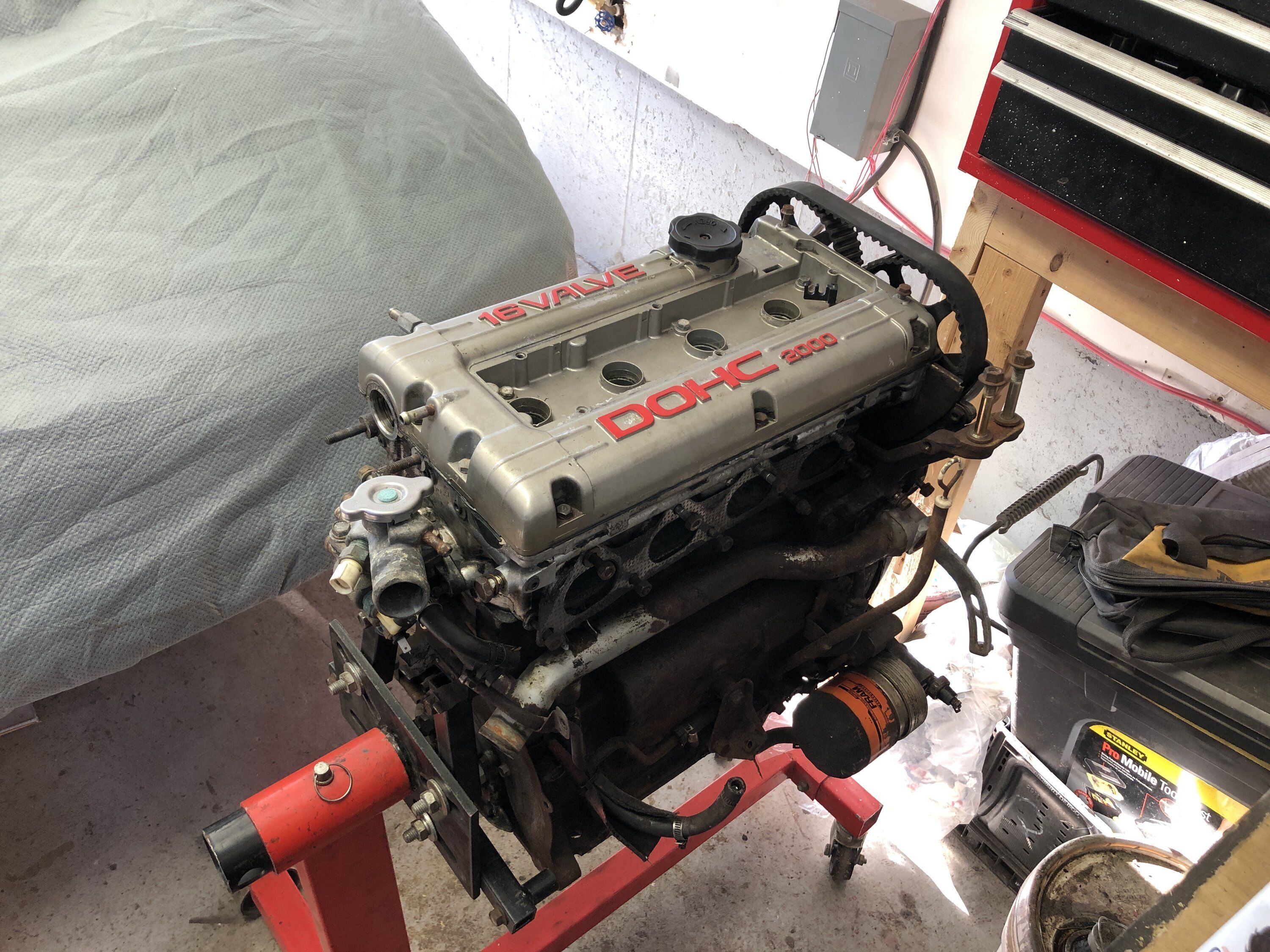

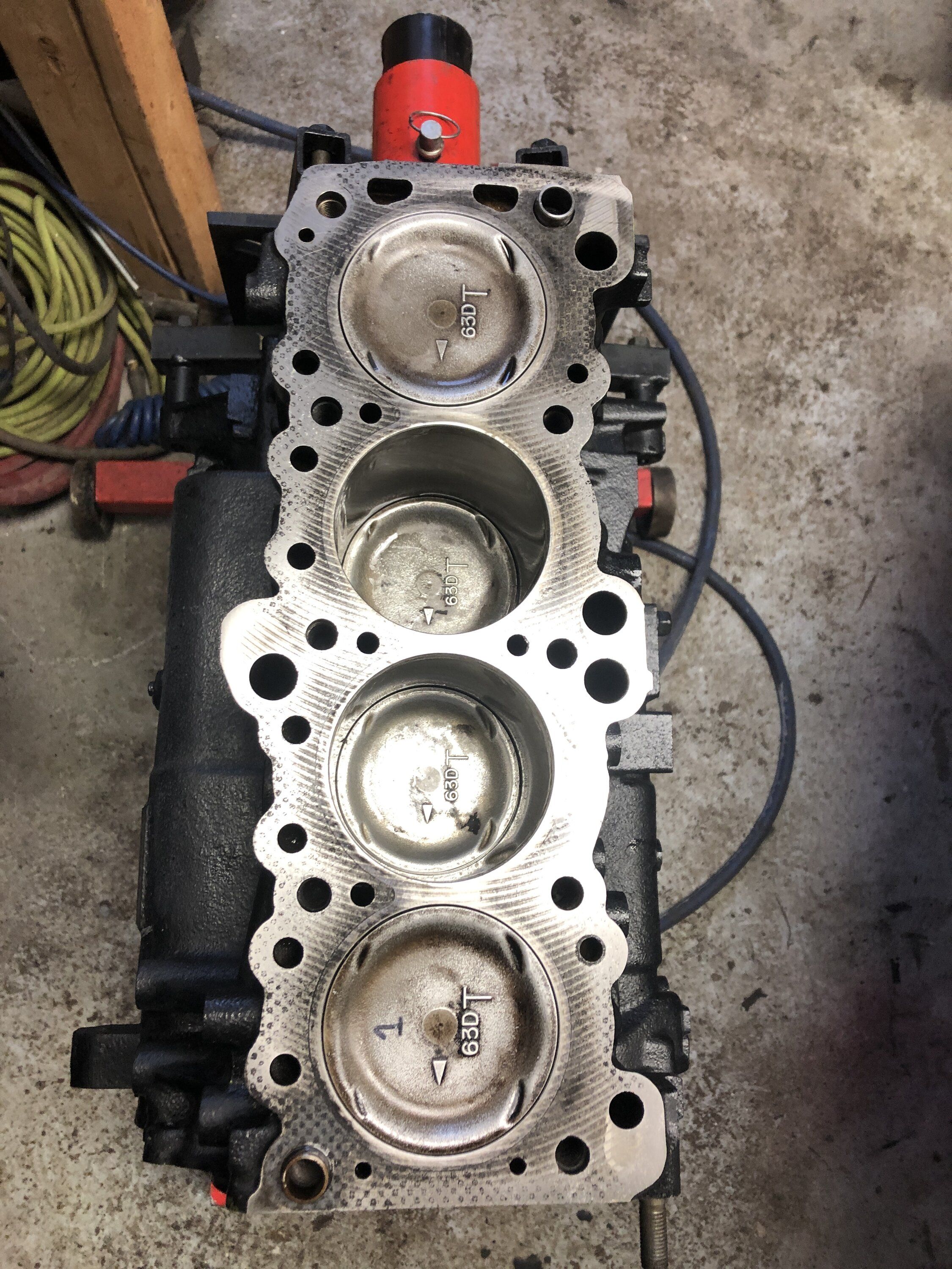

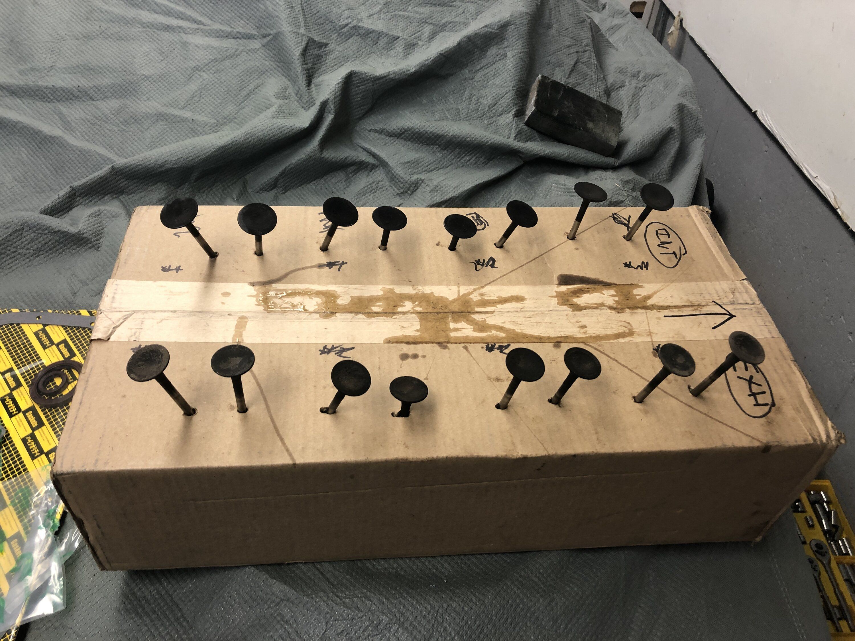

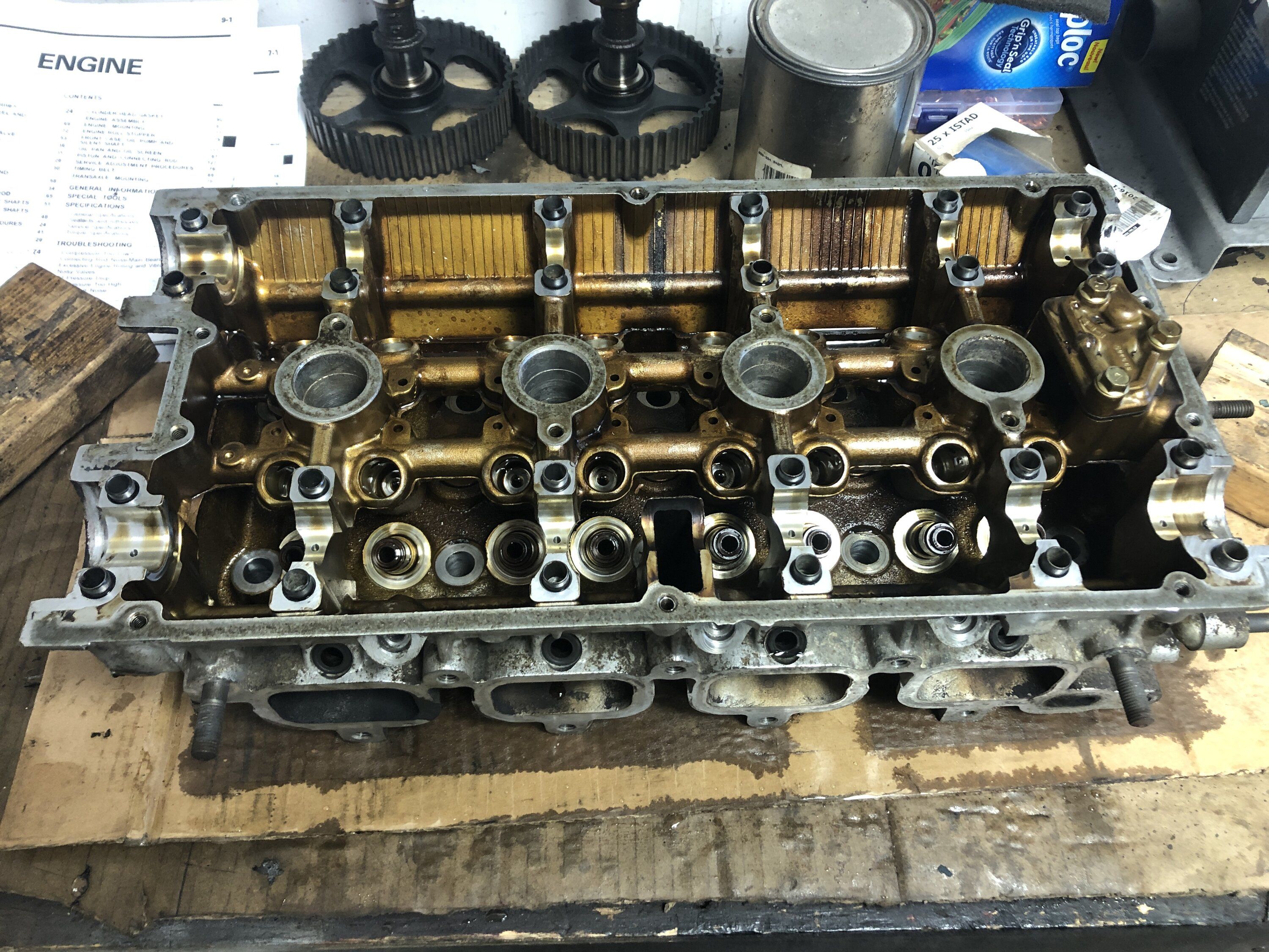

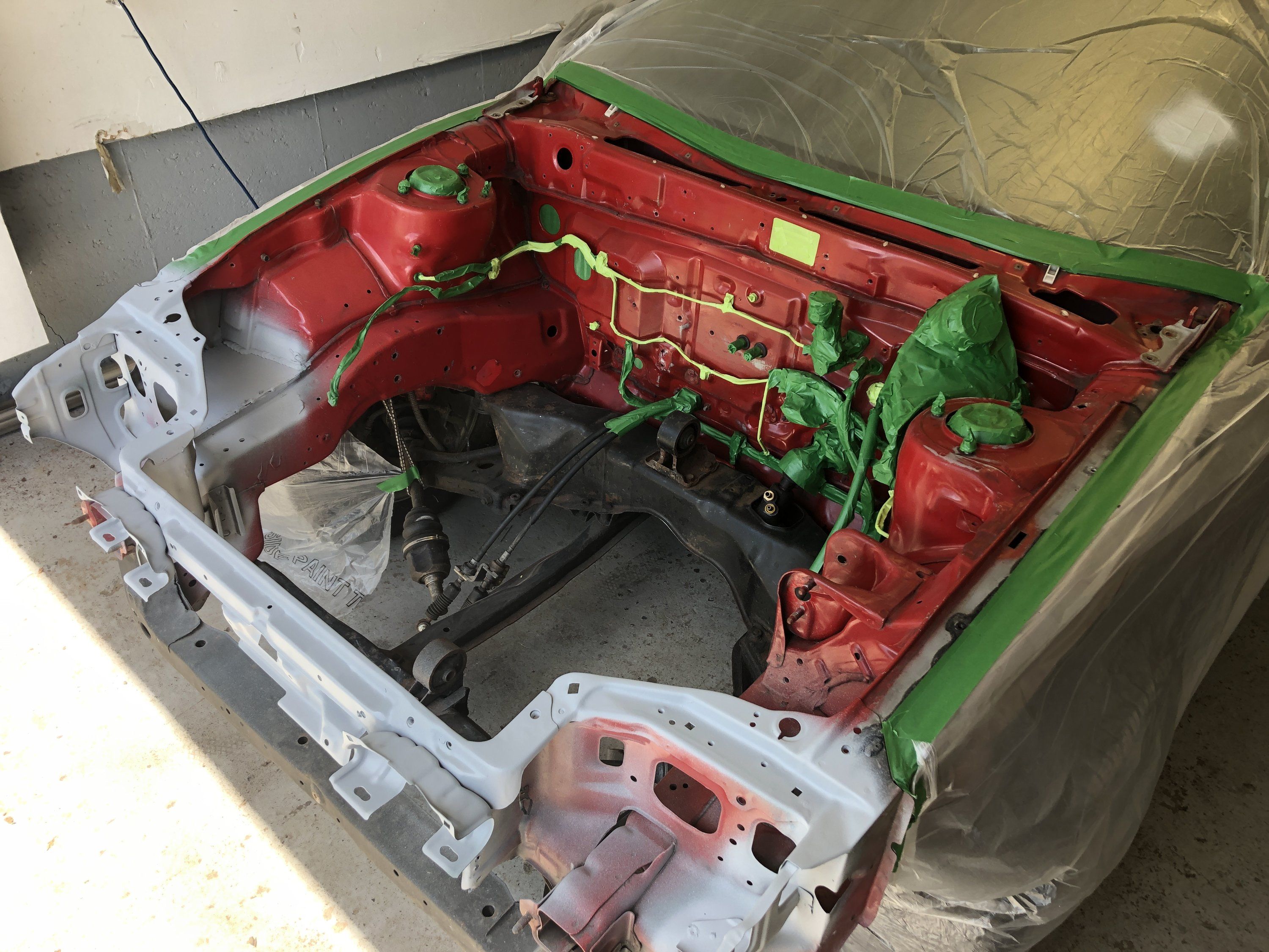

Im finally in the engine rebuild.
Block is done, head is out to the machine shop.
By the time head come back, i'll clean the valve.

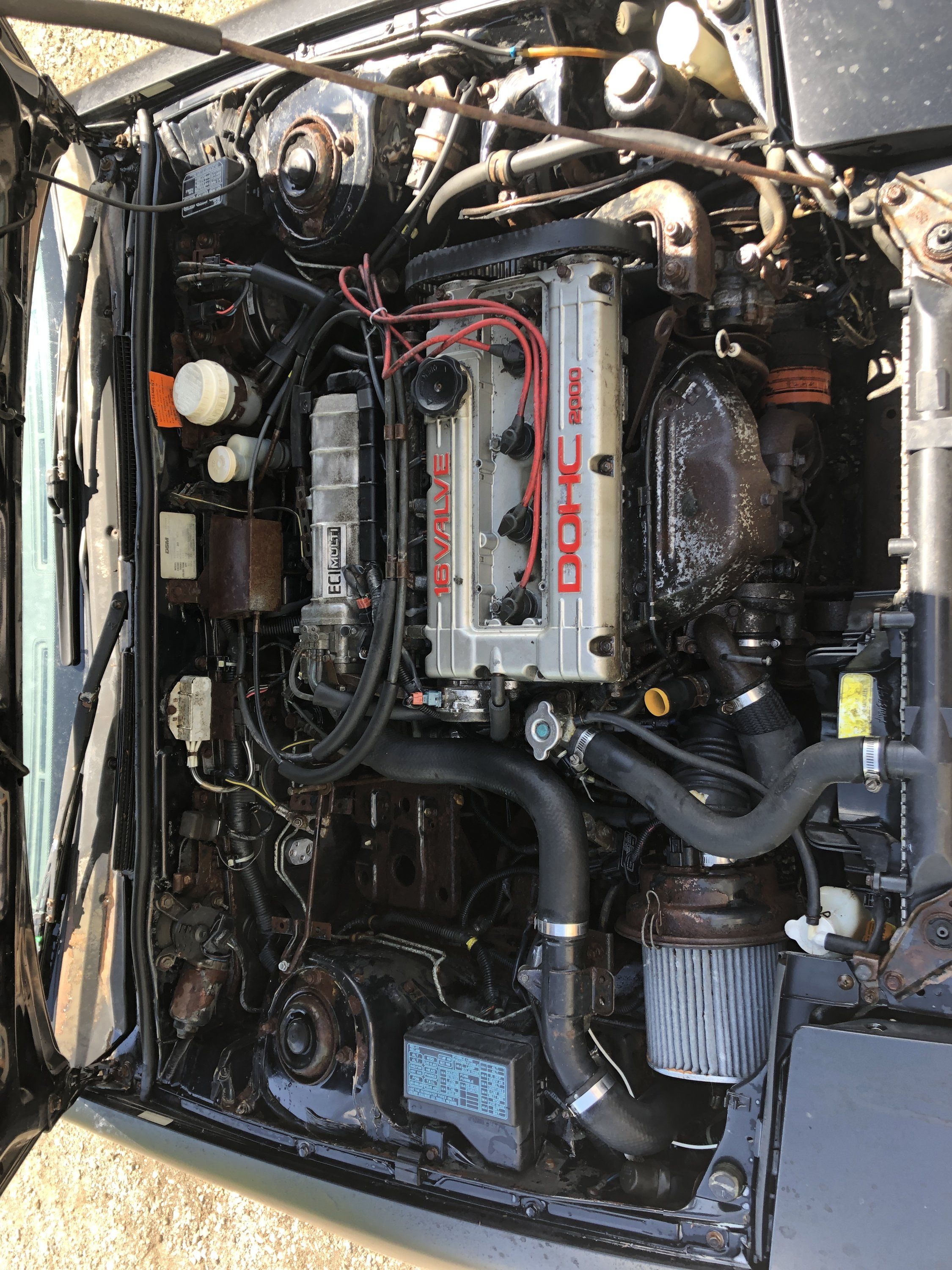

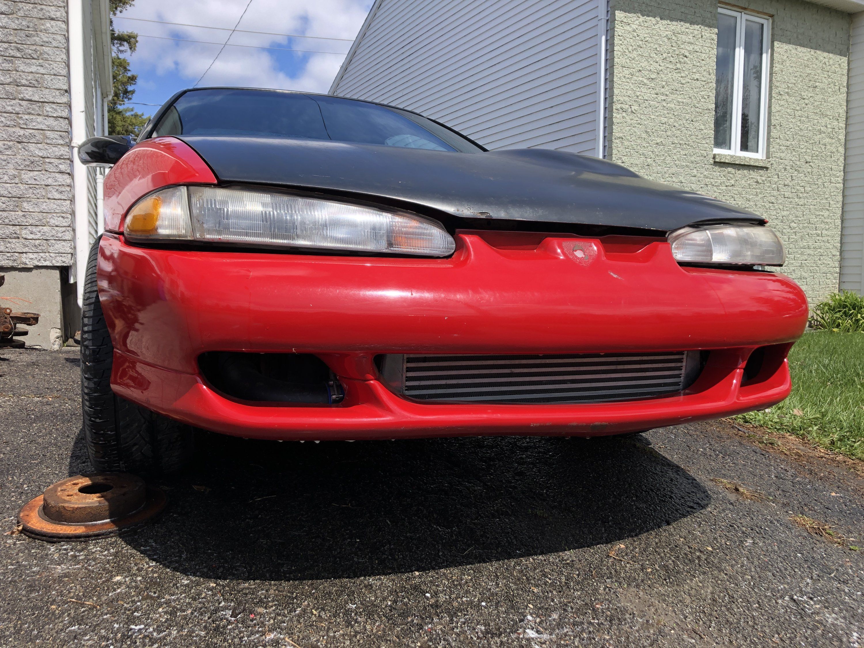

I still dont know what to do next.... with all the piping and intercooler.
Should i keep everything original ? or FMIC/Hard pipe + SD?
Part of me would like the OEM setup but the stock piping is sooooo small. And i'm not a big fan of MAF setup :/
IMG_5550.JPG IMG_6035.JPG IMG_6221.JPG IMG_6222.JPG IMG_6389.JPG IMG_6390.JPG IMG_6391.JPG
