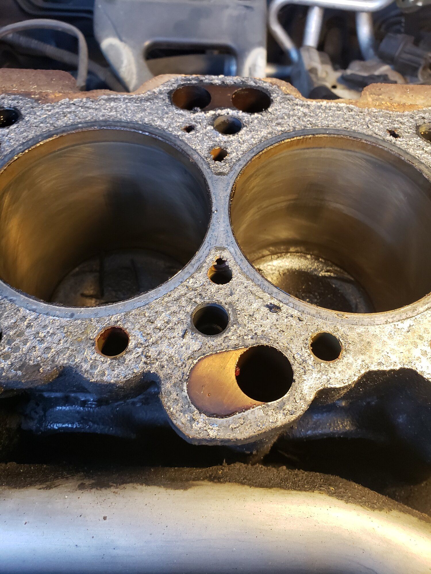

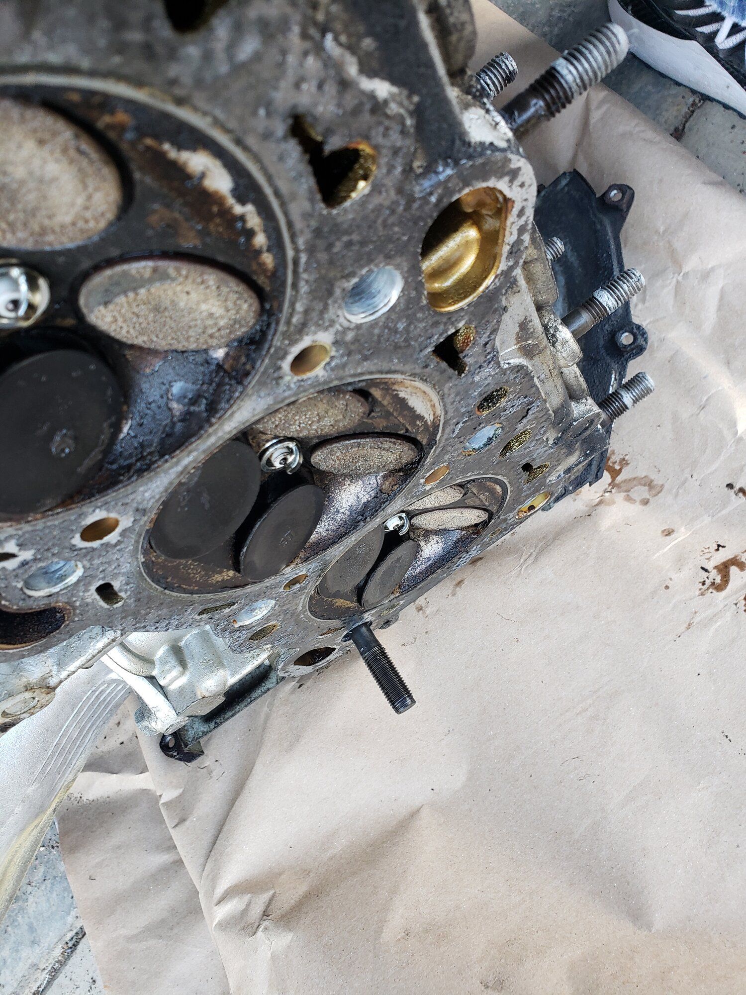

Got the head off today. All the intake valves are bent to hell. That would explain zero compression. I had every intention of putting the rebuilt head on this weekend as well, but found some cylinder wall scoring that I don't like. Pics are attached. Can't feel anything with a fingernail but the shiny areas have lost the cross hatching in some areas. All cylinders have similar markings at the very back and front of each one. Hopefully it won't take much to clean up, but I may as well toss in some forged pistons and rods at this point with ARP hardware. What's a good combo for 500hp goal? I don't want aluminum rods.

After some research and talking to a couple people I trust very well, it seems those cylinder marks are normal signs with high mileage. I am moving in a couple months across the country to Orlando and need to get my Talon on a trailer at that point, which isn't easy not under it's own power considering my driveway and street make it really hard to back a trailer in front of the garage. So I will cross my fingers and toss the rebuilt head back on tomorrow. As long as she runs good enough to drive onto a trailer I'll be happy, then plan on a built shortblock after I'm in FL.

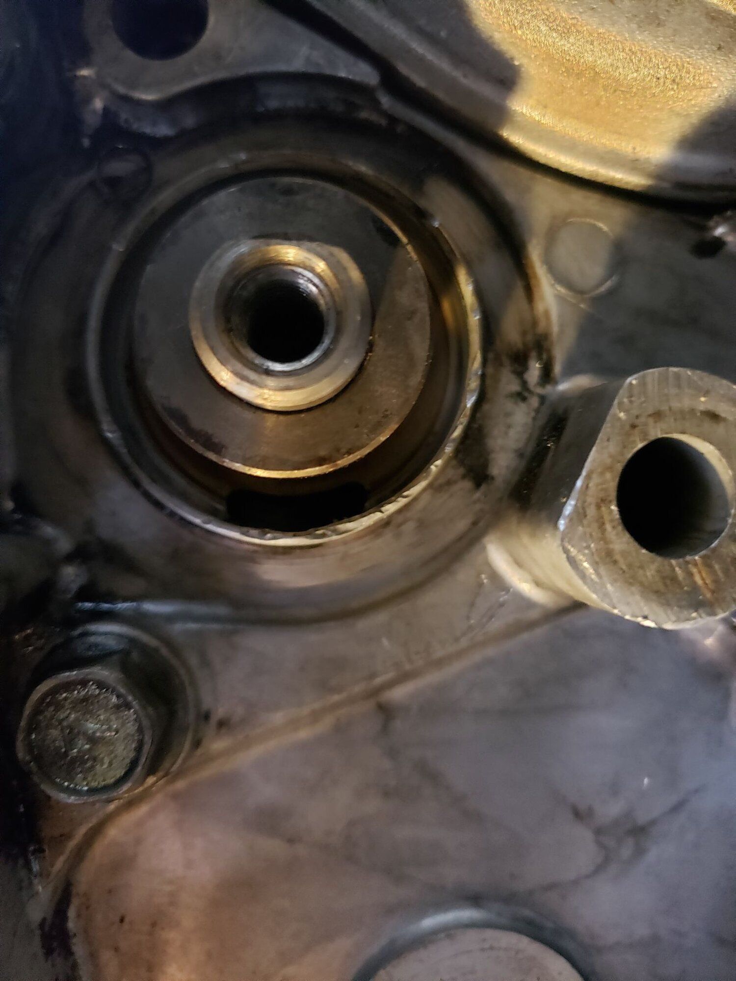

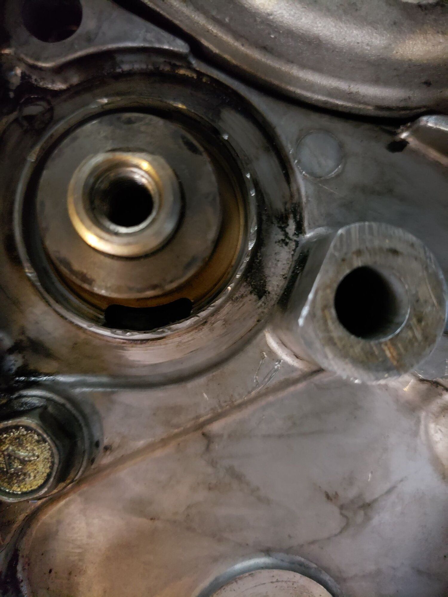

New head is on and got it started a week ago. Unfortunately it still has an oil leak that I tracked to the front balance shaft oil seal. Got that sprocket off today and found the seal was pushed out and barely hanging in there, damn near fell out as soon as I touched it.. Then found these marks on the case around the seal, in attached pics. Prior owner must've changed that seal at some point and marred it trying to pry out the seal. Fortunately it feels smooth inside where the seal fits. New seal is ordered and hopefully have it back together next weekend.

I got the new balance shaft seal in and timing all back together yesterday. Let some fresh rtv set up for a day and she fired right up today! Idles good, no surge, but a tad high at 1,100 rpm. The BISS o-ring is new so I'm sure I just need to set the idle, but she warmed up and not seeing any leaks so far.
