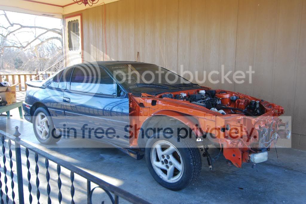

Here is the rust bucket from Canada. It is a gorgeous car, just its rusted to death.
This is what the eclipse looked like at first.

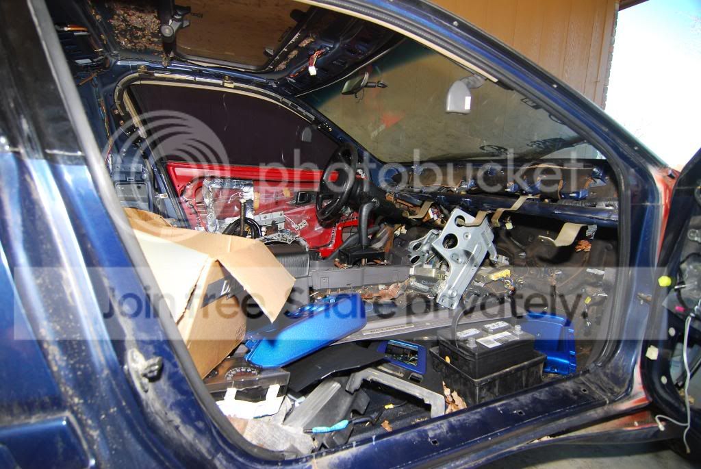

The car was full of parts, I guess the previous owner had big dreams.

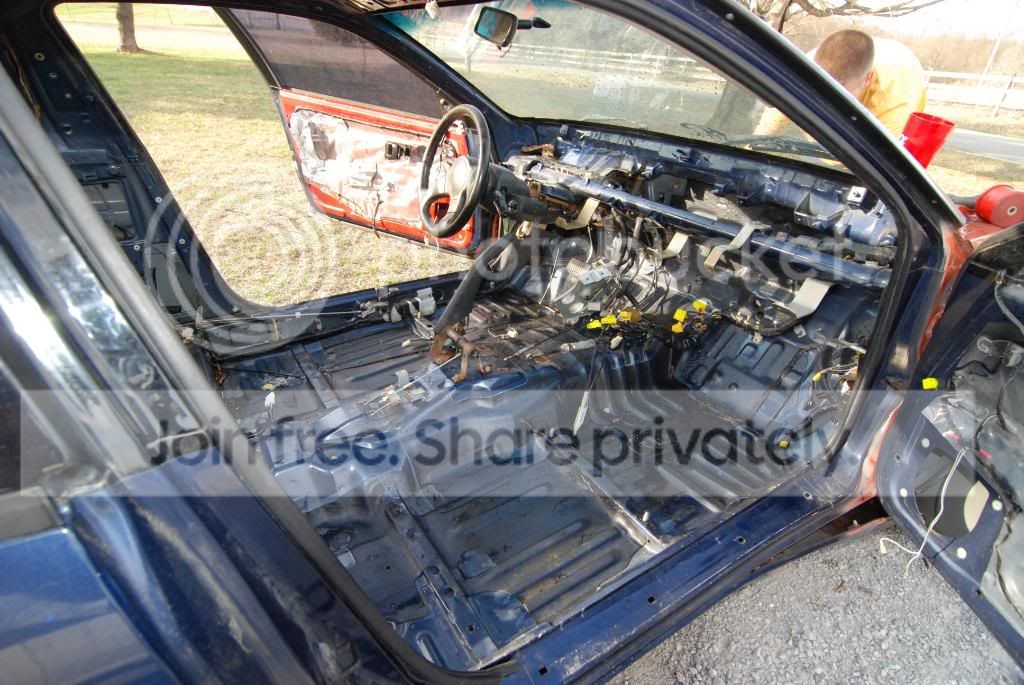

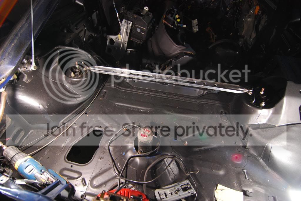

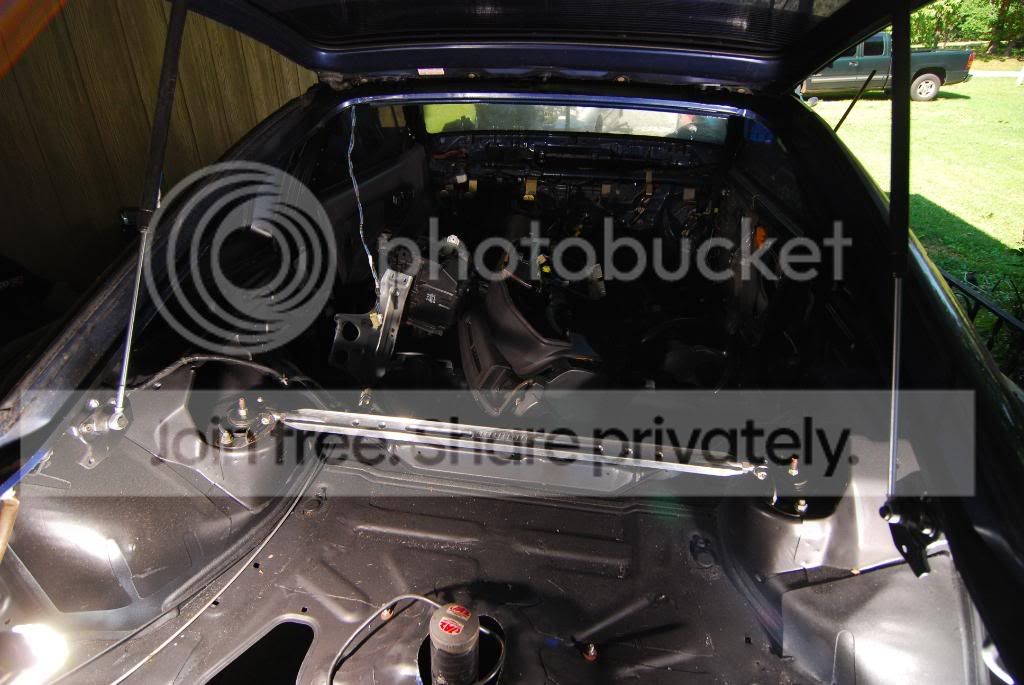

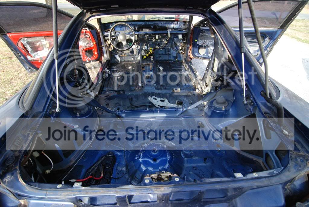

After all the parts were pulled out and the car was hosed down and went to town with Purple Power getting the interior prepped for paint.
So I decided only interior I will have in the car, will be door panels, dash, and seats. No carpet no other interior panels. I sprayed the entire inside of the car black, and the floor board and most of the hatch is all truck bed lined.

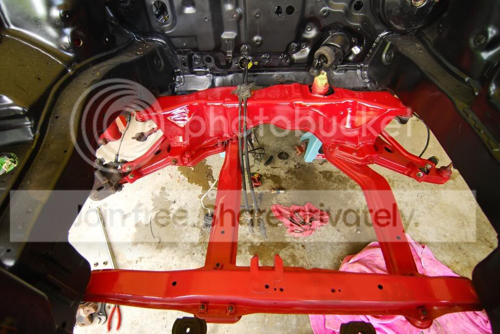

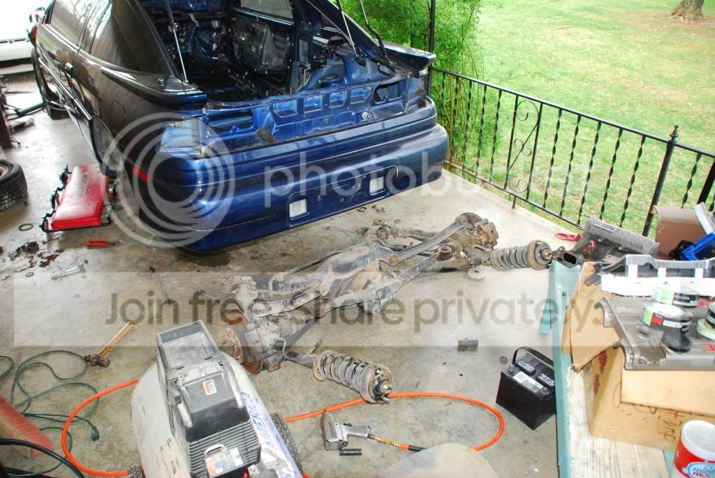

Next I took all the sub carriage and all the suspension off.

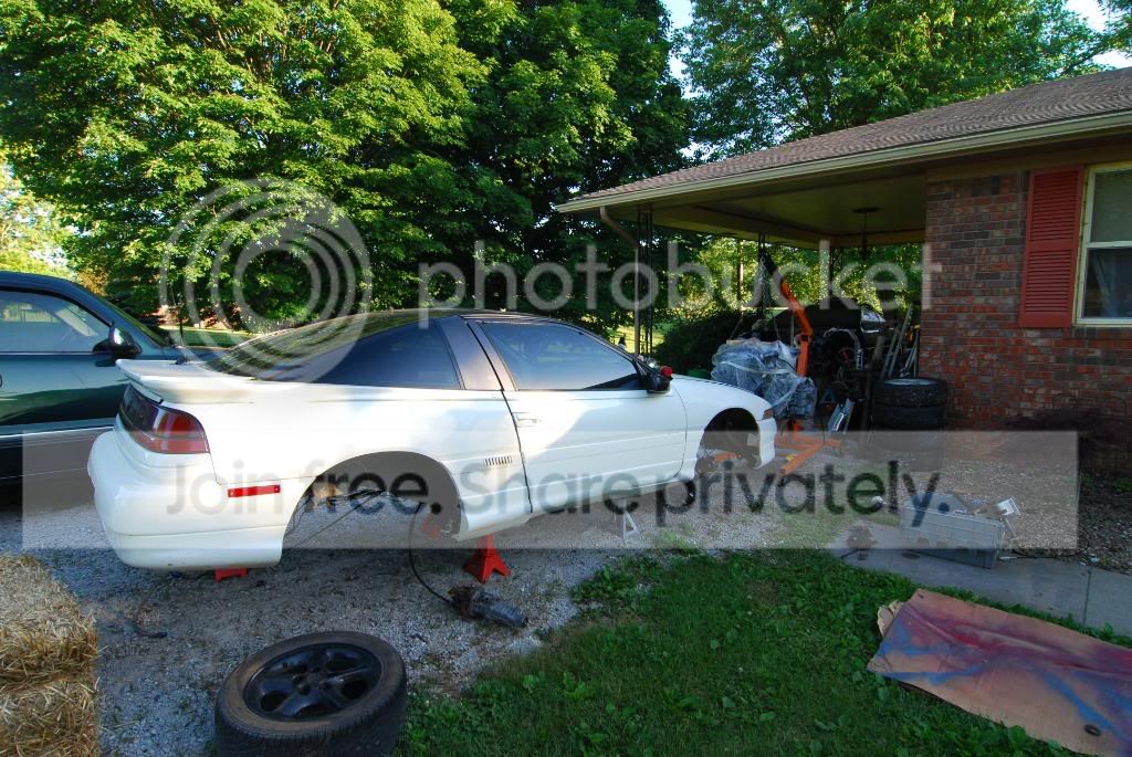

I finally put the talon up in the air as well and dropped its suspension. I decided to compare which suspension components and sub carriage had little to no rust and which ones looked the best. I took the ones that looked the best and pieced it back together.

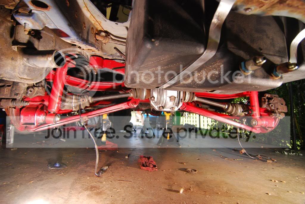

All the suspension has been sanded down rust has been grinded down, and it was rustoleomed, and spray painted to protect it from doing it again.
Here is the cleaned up engine bay. Also rustoleomed and painted.
All the rear suspension is up, and the 8 gallon fuel cell mounted.
