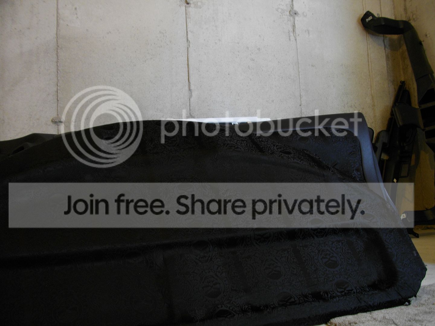

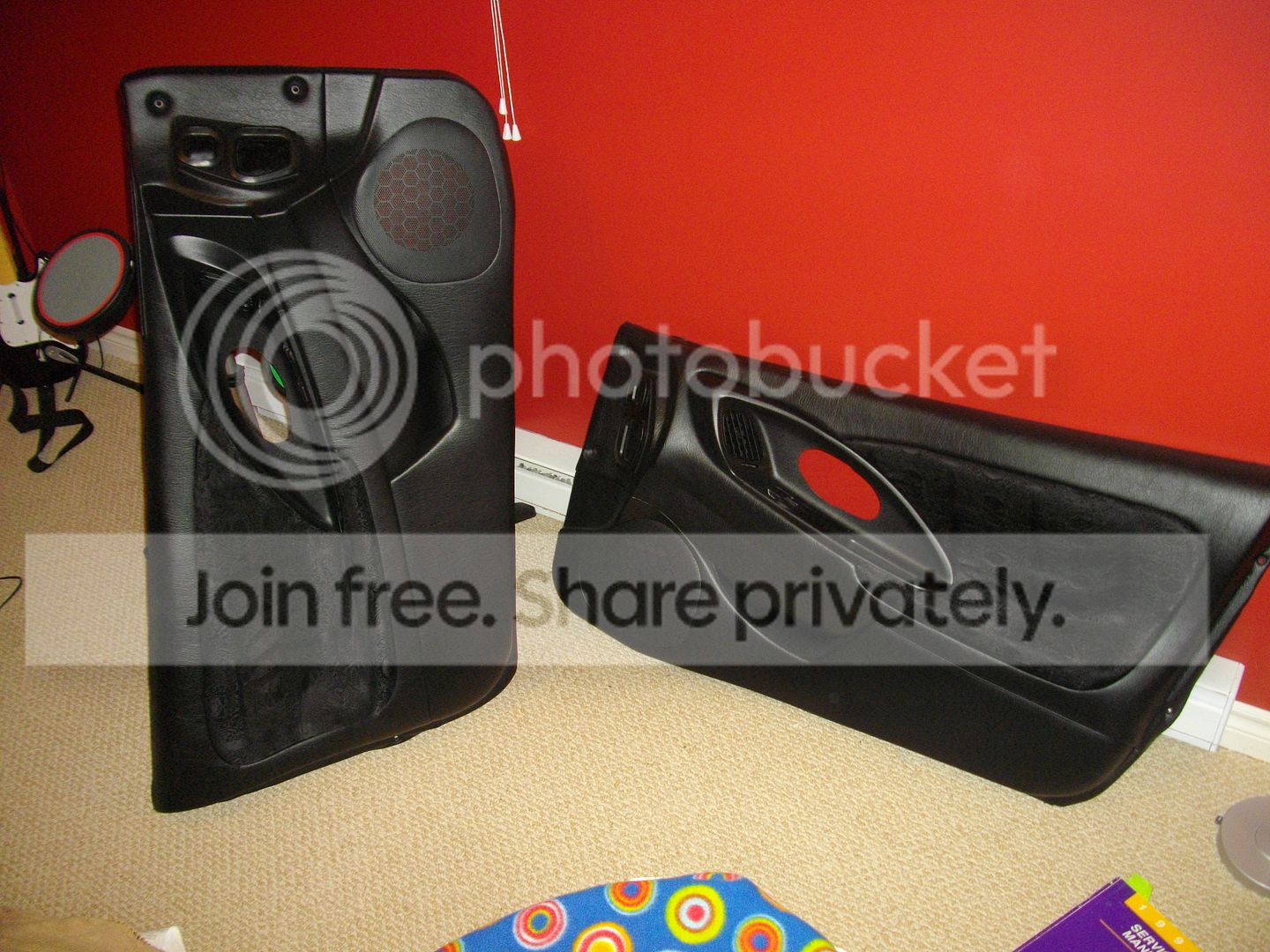

Finished wrapping both my door panel inserts and my cargo cover. There's a few tiny wrinkles but over all not too bad for my first try at doing this. Overall I'm happy with the out come and I can always do it again if it really starts to bug me.

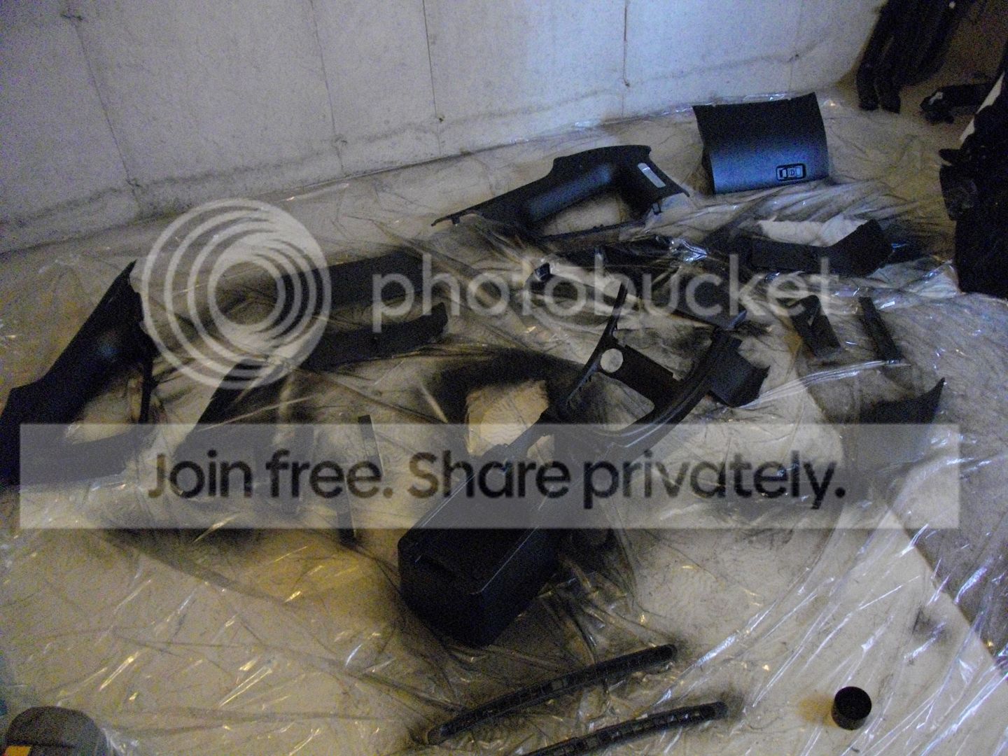

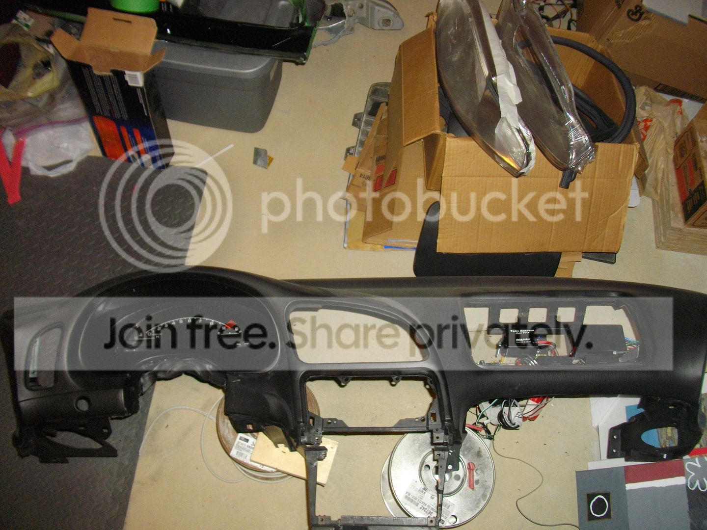

Made a bit more progress. I've now burned through cans 5 and 6. Doing the bigger pieces takes up a lot more of the dye.

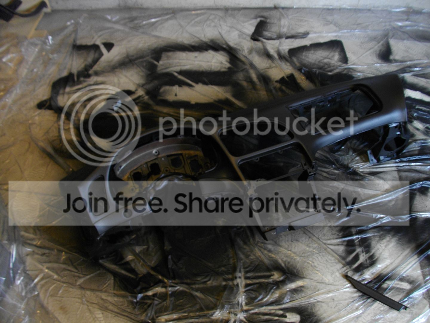

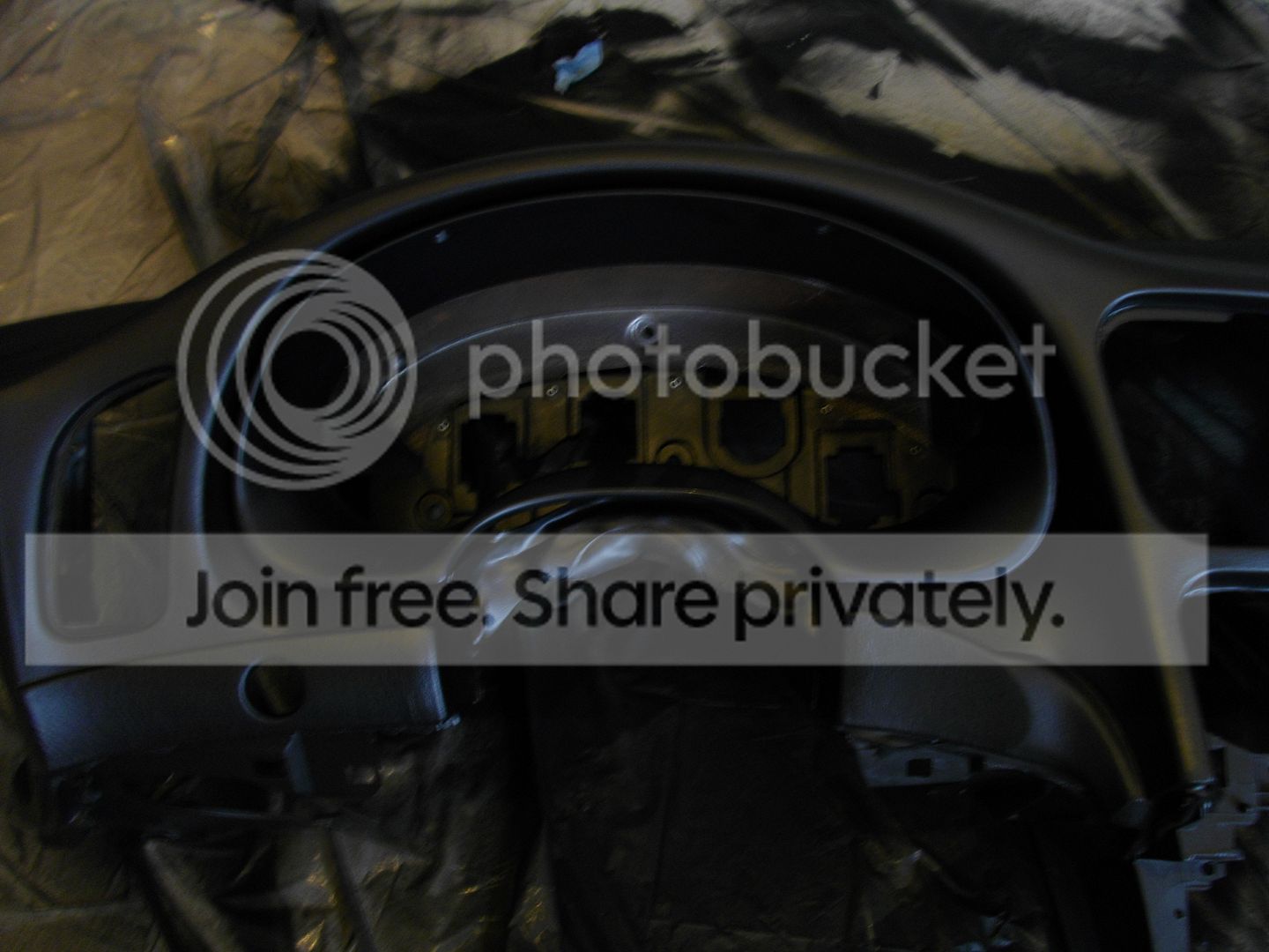

Close up of the dash.

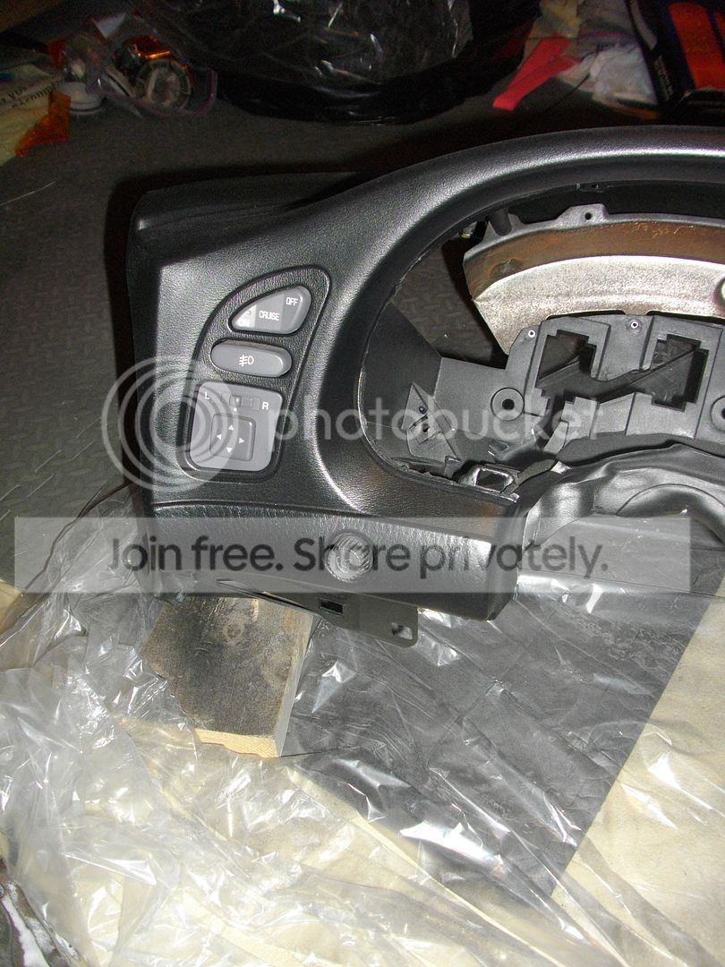

The gauge cluster bezel is black from the factory and the Landau black matches perfectly.

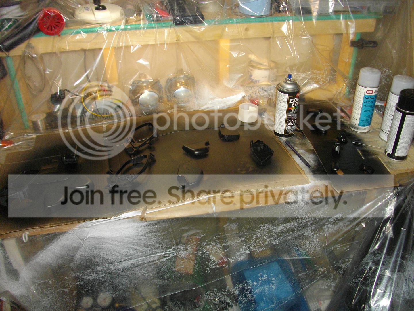

Been a long time since I updated this. I found out clear coated is needed luckily SEM makes a low luster clear so I bought a couple cans of it.

Some shots of the parts cleared.

Comparison between the flat/non-cleared dash and the cleared cluster bezel.

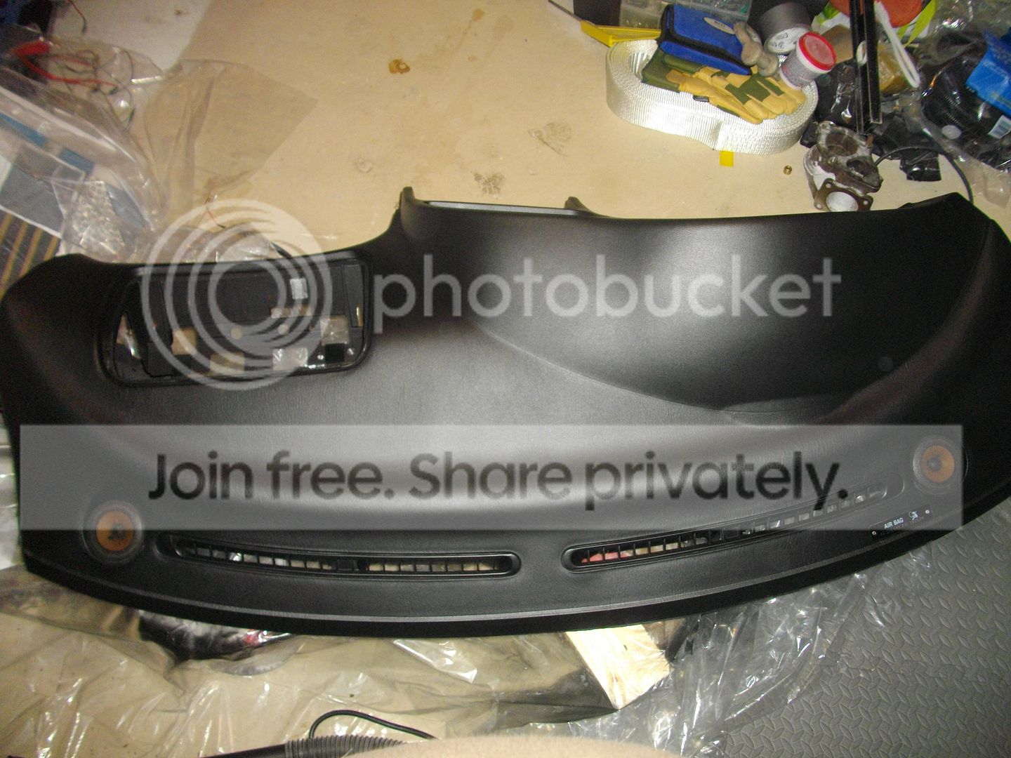

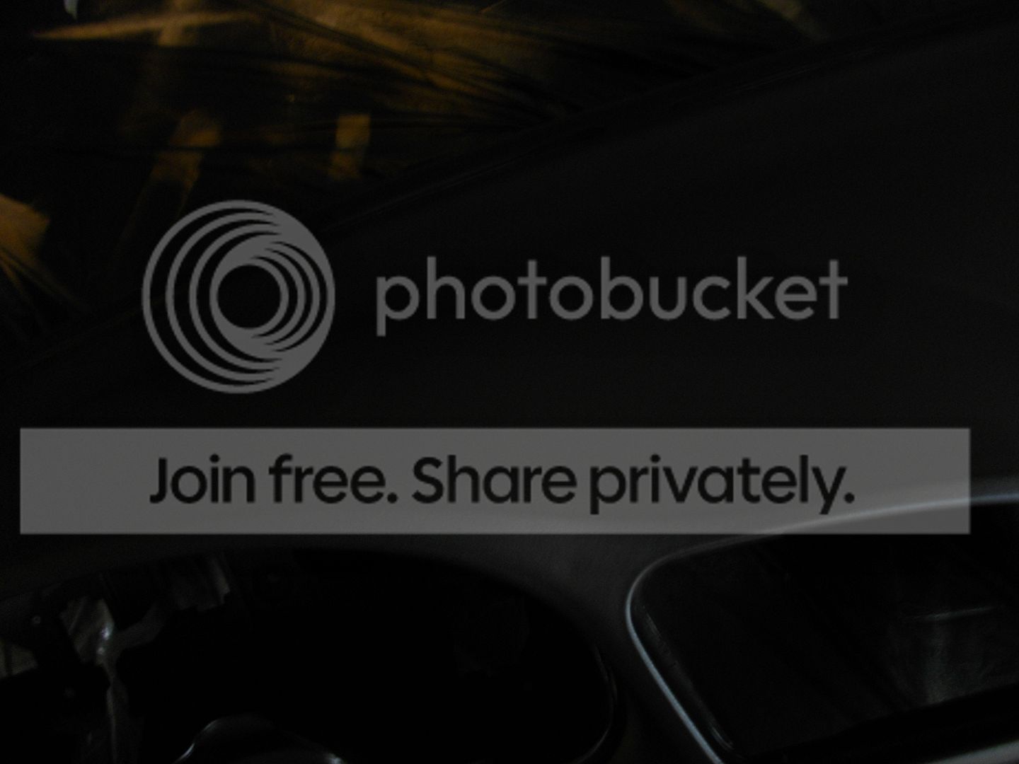

Got the dash clear coated today. I put the vents, tweeters and some of the buttons back in place. I'm 99% sure my Speedohealer is at the post office so I'll pick it up tomorrow and get the last bit of wiring done and put the dash harness back in.
I actually like the contrast the grey switches and dimmer give to the black dash. However I will eventually replace them with black ones.

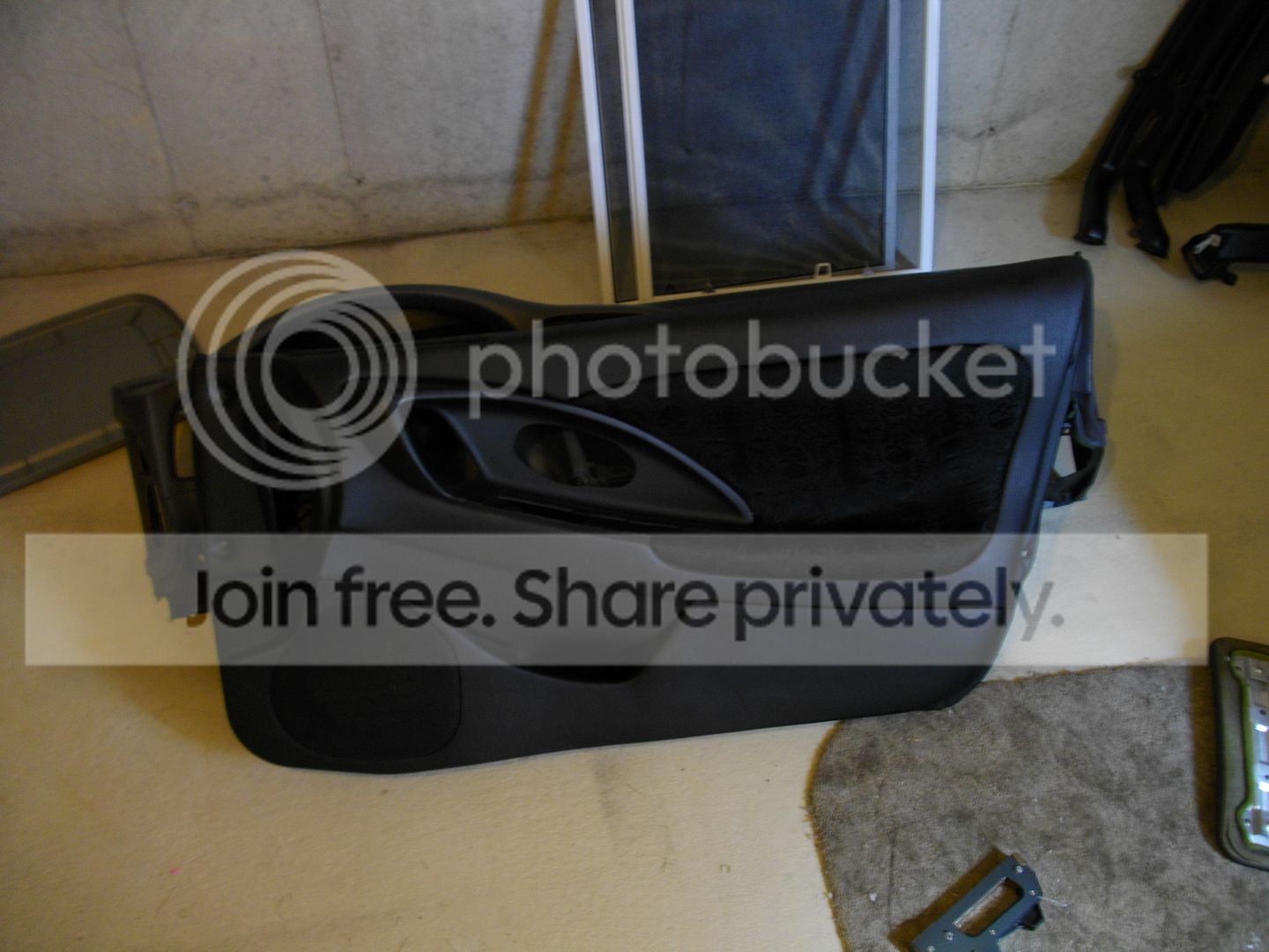

Also my door panels are back together! I need to recover the inserts but that's easy to do. I ditched the Styrofoam and plastic box thingy on the back on the panels, they did nothing and were just dead weight.
