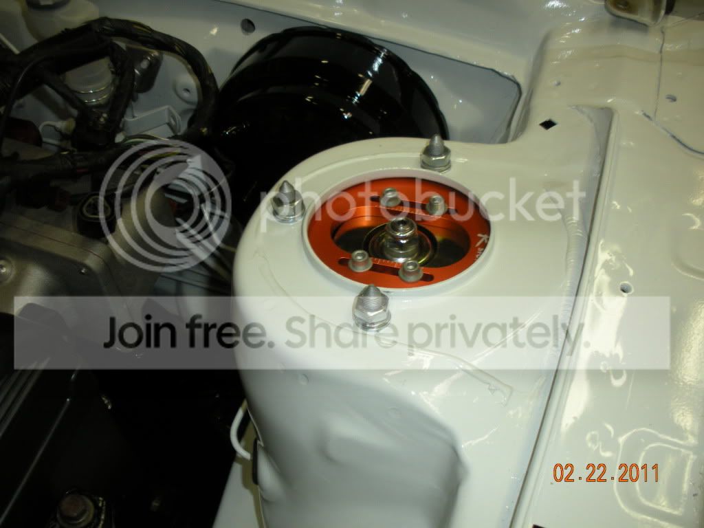

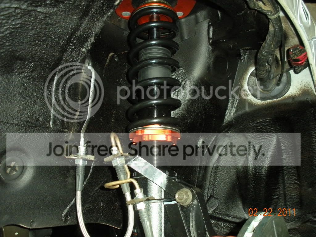

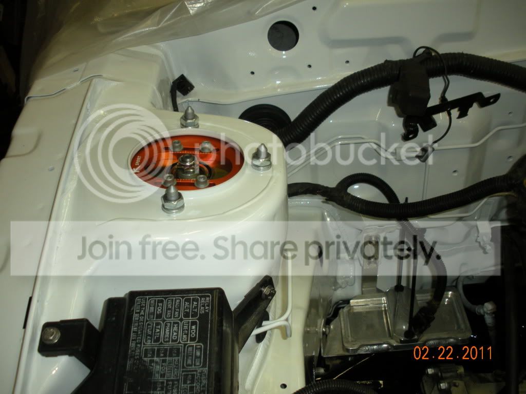

I got the front k-sports installed finally. I love the camber plates in the engine bay :)

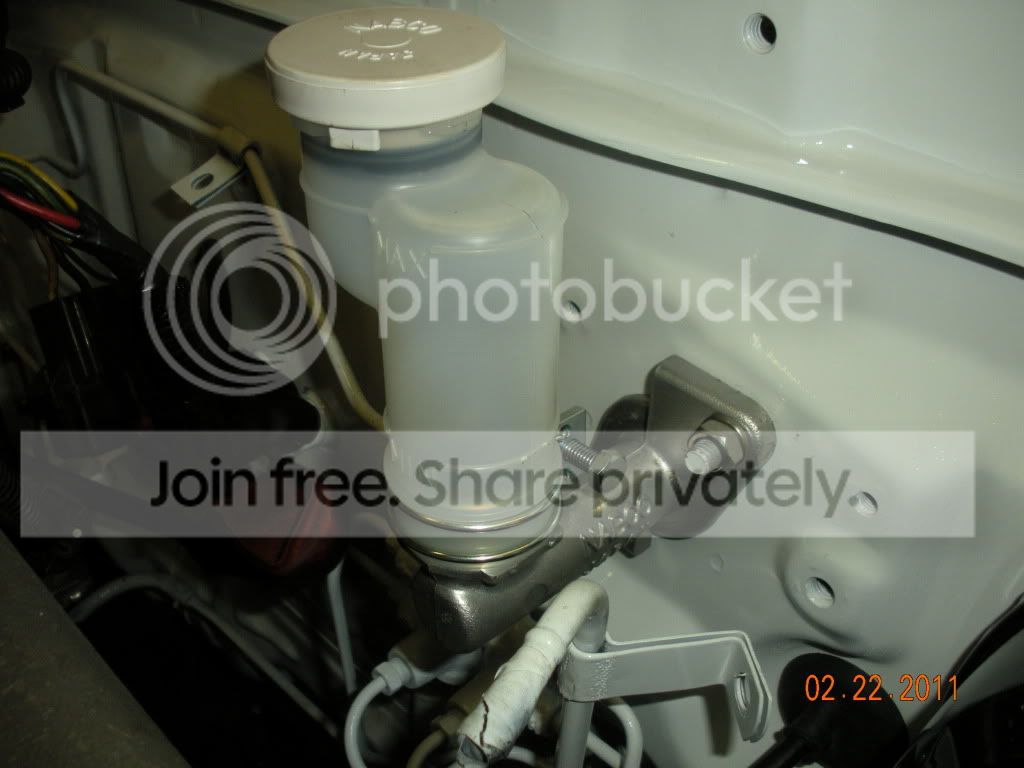

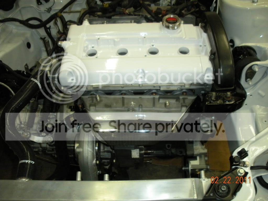

New OEM clutch master.

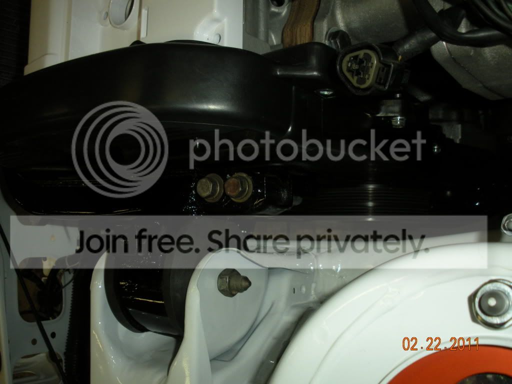

New OEM GVR4 timing cover with new OEM bolts.

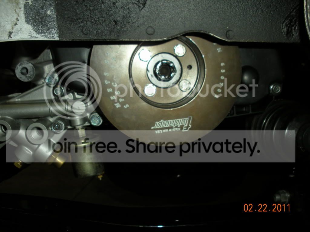

Fluidampr is on.

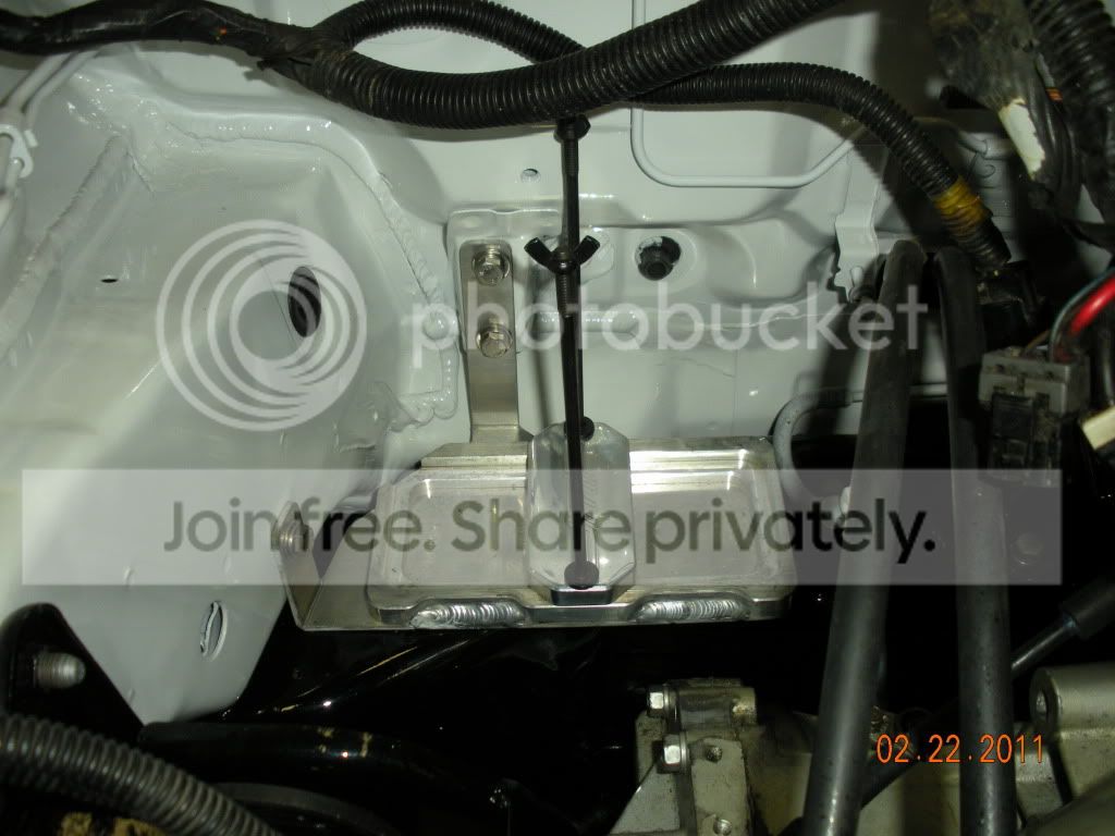

JMF small battery tray.

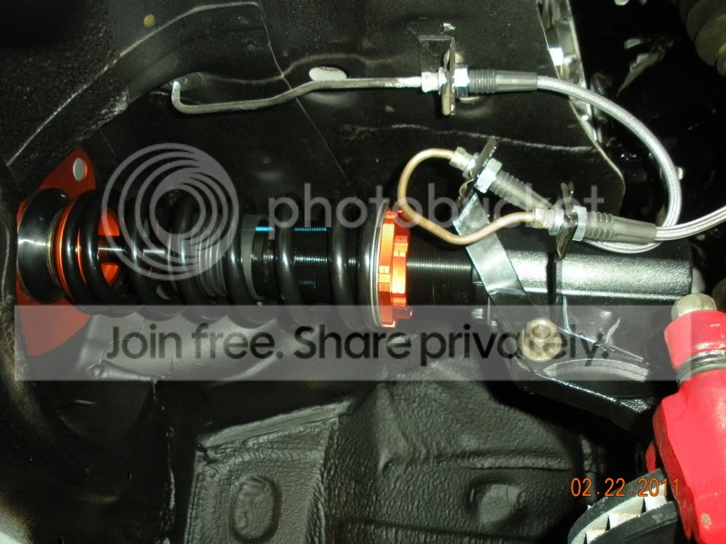

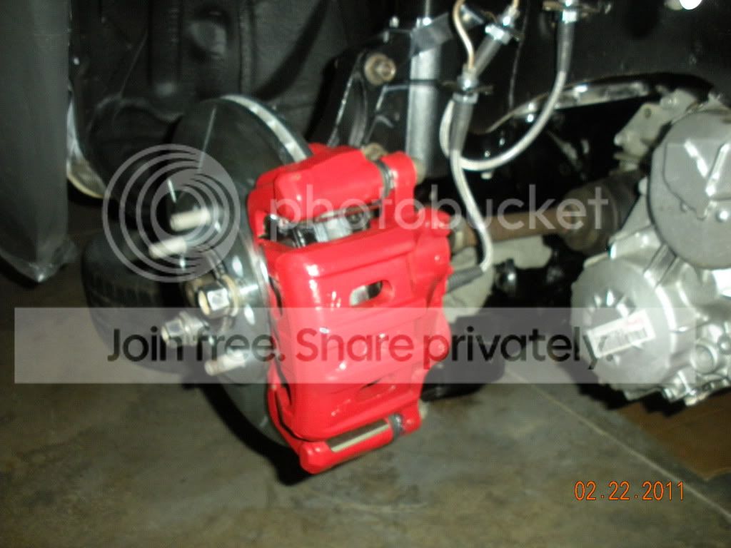

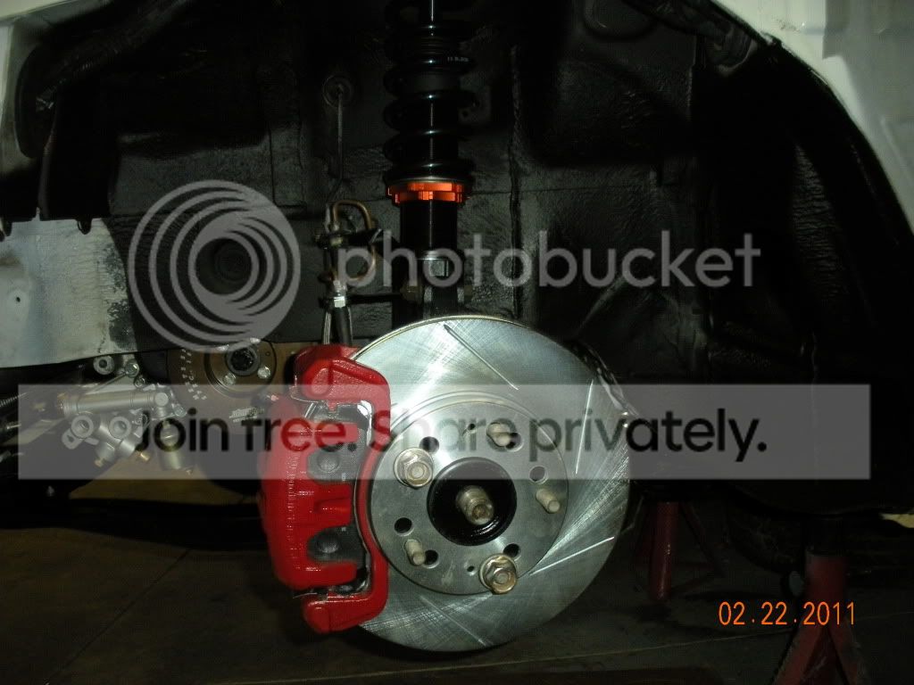

I got my front brake/suspension setup just about done. Just needs a couple more things and she will be ready for track action.
New wheel bearings, k-sports, 2g big brakes, powerslot rotors, PBR Ultimate ceramic/kevlar pads, stainless braided lines. Should handle decent.

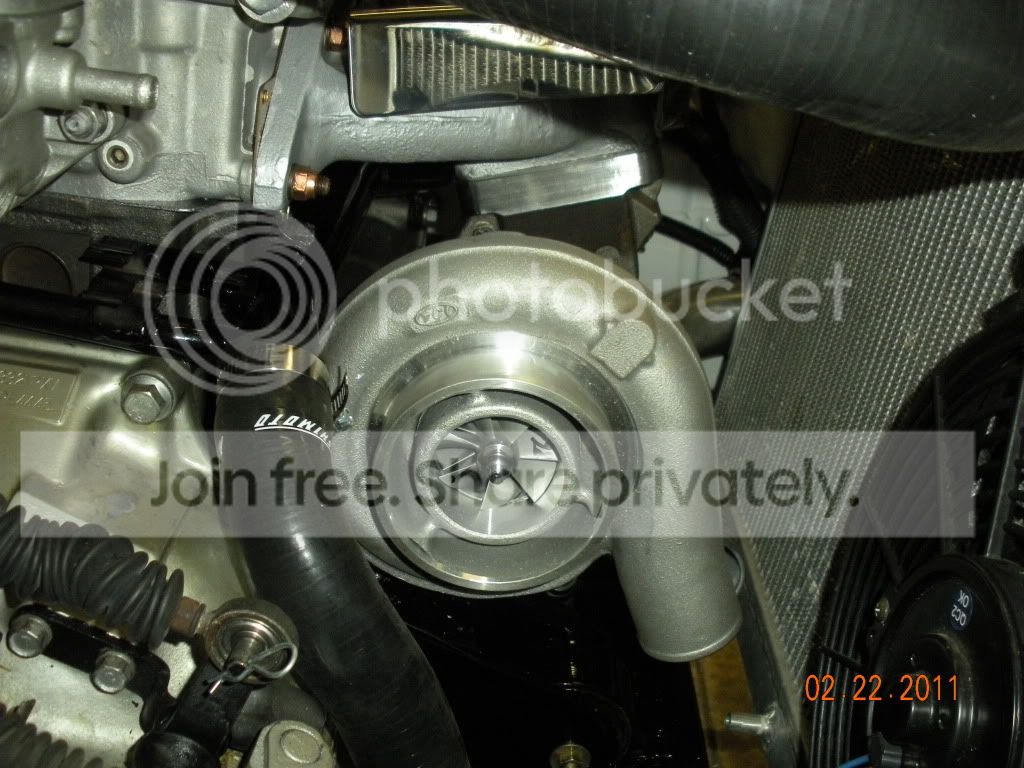

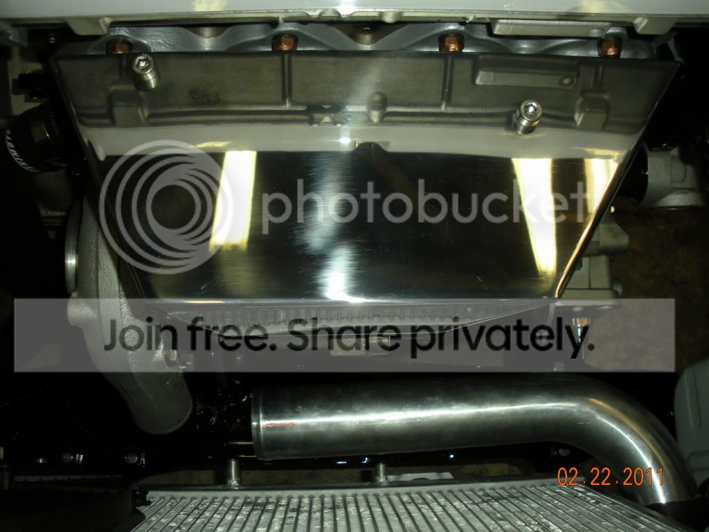

And somehow, one of those pesky snails found its way to my engine bay ;) BW S256ET held on with a fully ported and polished 2g manifold, new OEM studs and nuts, and a Buschur polished stainless heatshield to top it all off.

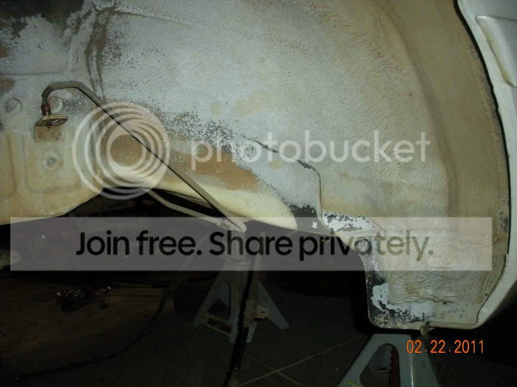

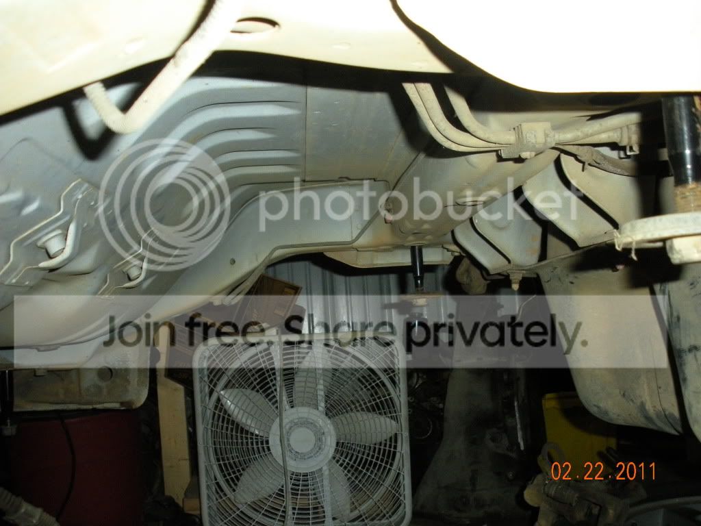

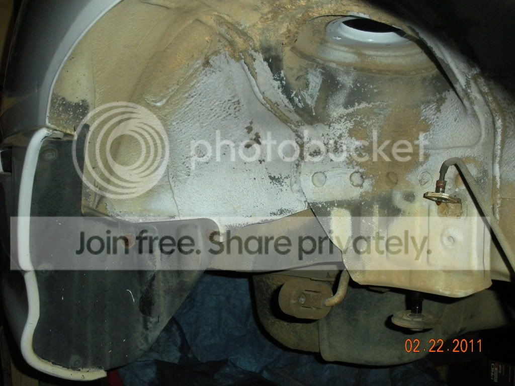

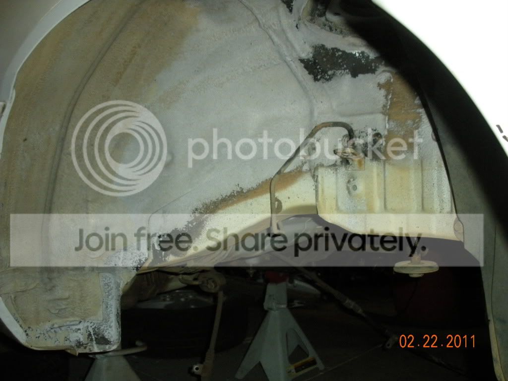

The latest big project on the car has been started also...
I LOVE SC cars! There is no rust anywhere on this thing.
Where did my rear end go??? Don't worry, the rear will look just like the front when its done :thumbup:

Wow, I wish that I would have been able to view these pictures a few months ago. I noticed that your S256ET fit without denting the water pipe. I bought my small frame S256ET because the vendor said that the regular compressor cover would contact my 6 bolt’s water pipe (I was deceived). Also, I noticed that your S256 does not have a nipple (barb) tapped into the compressor housing, which had cost extra, and I had to ask to have it done. I imagine, with your skills, you can tap it yourself to run an external wastegate pressure source (or tap your lower I/C pipe). Similarly, I imagine you are going to tune using DSMlink (or something else).

Thanks for the compliments! The turbo JUST fits with the 6bolt water pipe. It is very, very close. I actually had to tweak the pipe ever so slightly to get the clearance needed. I have link V3 full version and a socketed eprom waiting to go in. I will be tuning the car on speed density and E85. I am hoping to have the car painted and "done" for the shootout. I will be there either way though LOL
