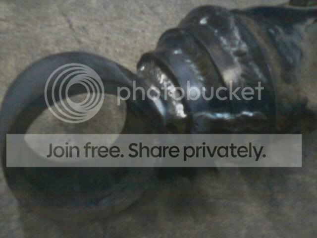

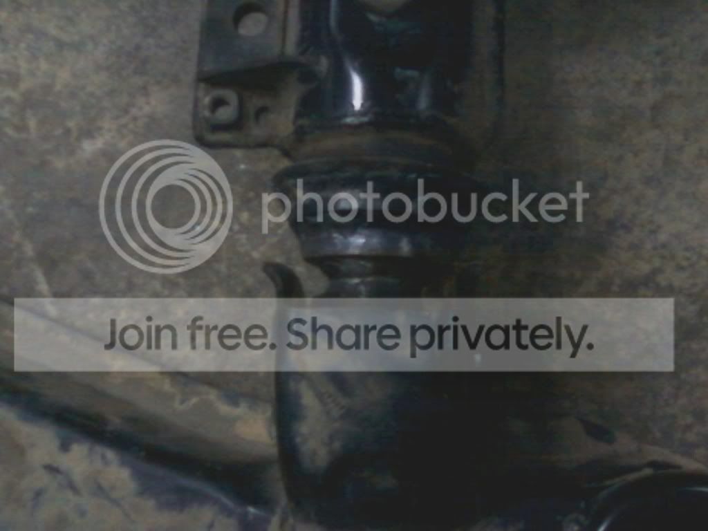

One thing a really hate about the suspension is the active toe system. I didn't want to spend $200 on the jayracing kit, which I don't believe works like they say it does anyways, so I had the arms modified. The welds are super solid and those things aren't going anywhere :thumbup:
Heres a pic of the welding and added material
Still has plenty of clearance in the subframe

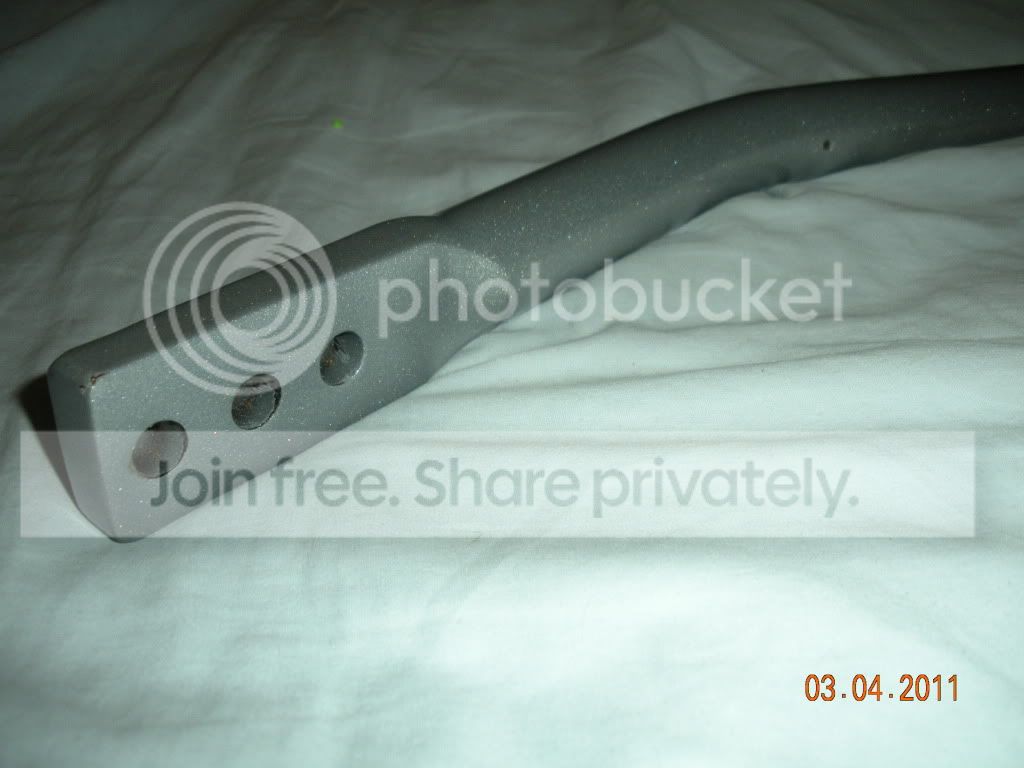

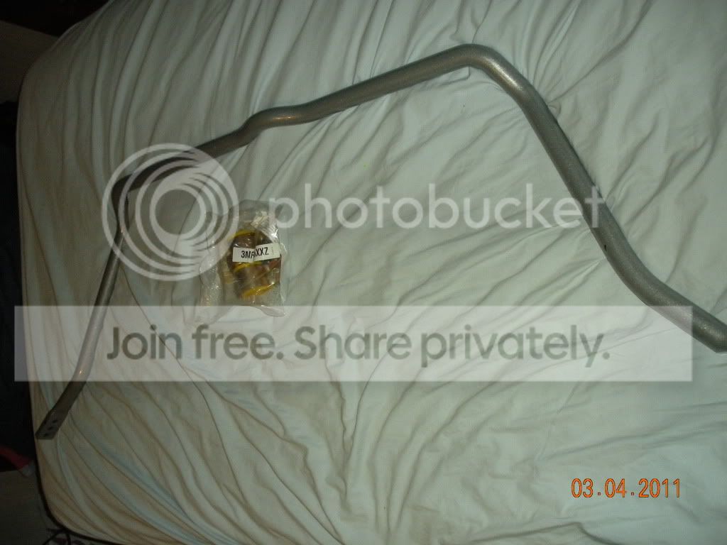

Next thing on the list was to get rid of the stock swaybar. A whiteline adjustable swaybar will be put in its place. Its 26mm thick vs. the stock 22mm. You adjust it by changing the position of the link, which shortens or lengthens the arms and changes how stiff the bar is.
Each side has 3 mounting spots for the swaybar links.

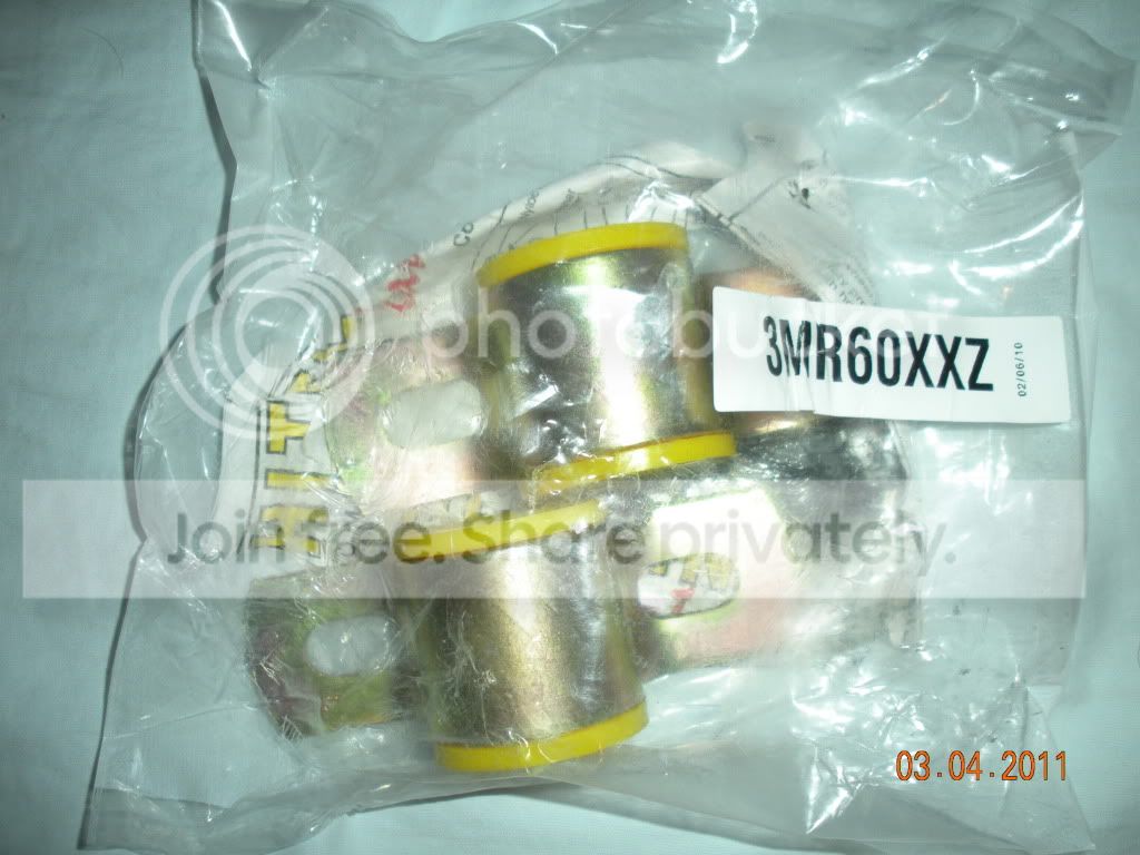

New bushings and brackets were included with the swaybar.

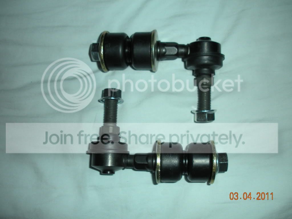

I don't know who started this rumor that you cant buy rear swaybar links for 1g's anymore. I bought new ones at NAPA.
Here they are with my energy bushings and washers on them. NAPA part #1880233

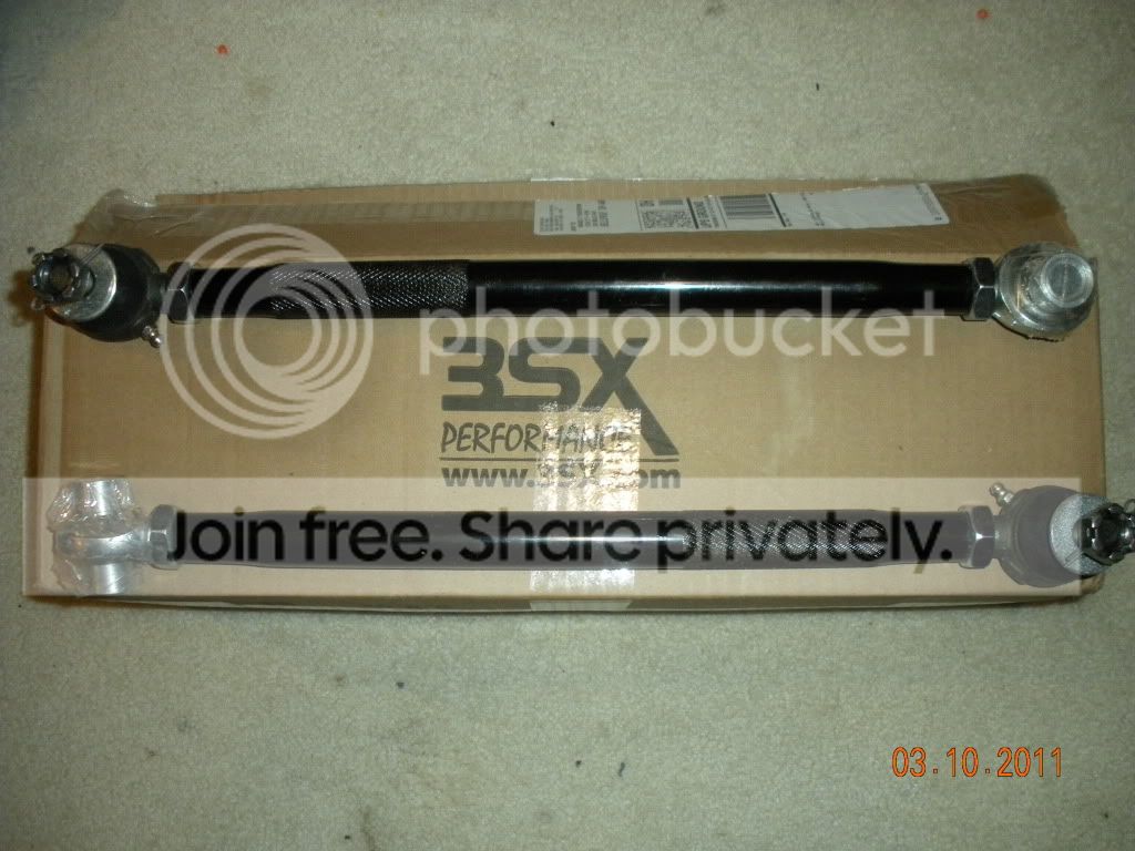

3SX adjustable upper rear control arms

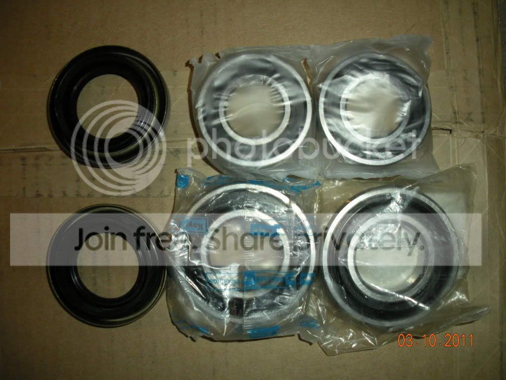

New wheel bearings and seals for the rear end

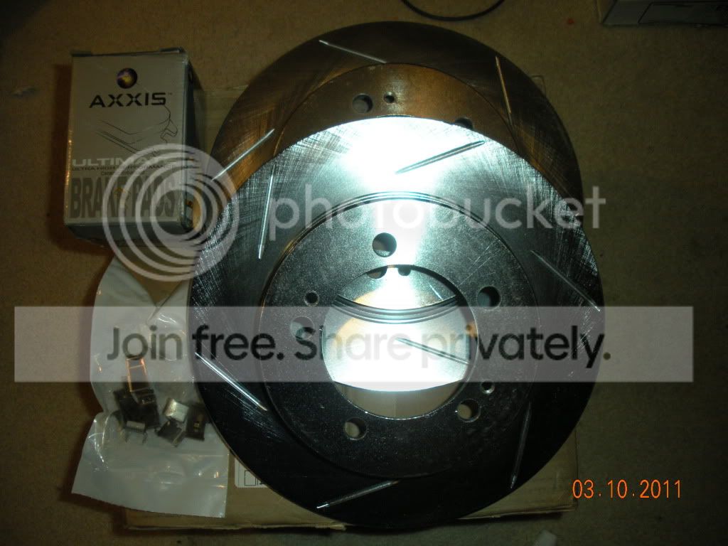

New power-slots for the rear, ceramic/kevlar pads, and new shims
