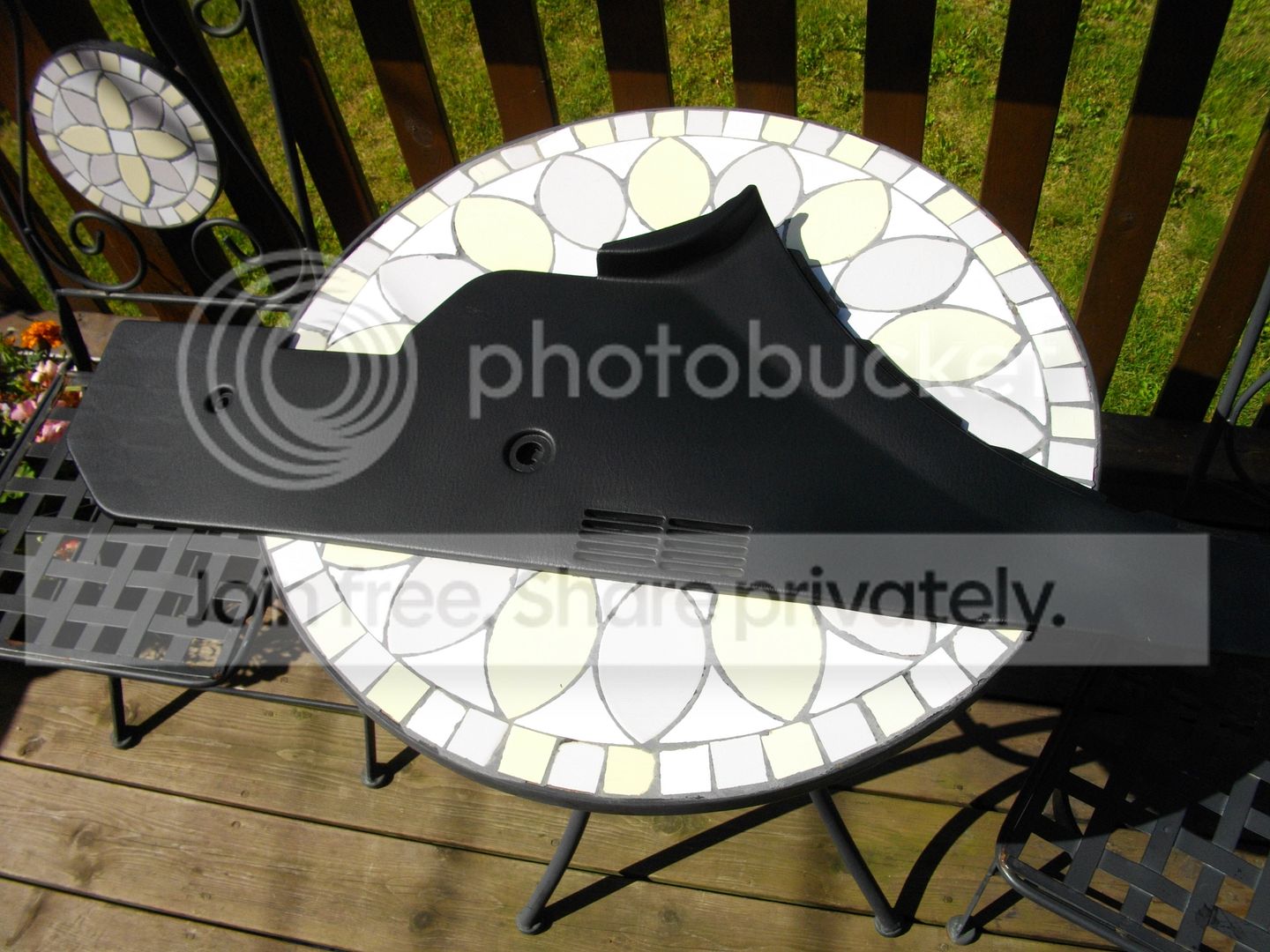

The one thing I can't stand about my interior of my Black car is the fact that it's grey. Black car, grey interior....it just looks odd.
Something I've heard a lot of talk about over the past while is SEM Paints, they make a line of flex coatings for changing the color of your interior. So I went out and bought some of the paint to try my hand at dying my interior.
I'll start off by saying that I prepped everything really well, washed with soap and water twice, cleaned with TSP (degreaser), washed with soap and water again and finally cleaned with SEM's prep spray.

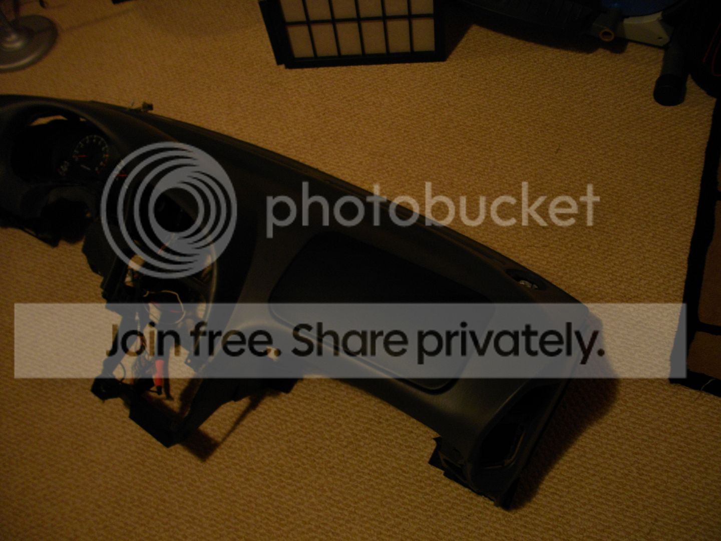

Here's the result of the first piece I tested it on.

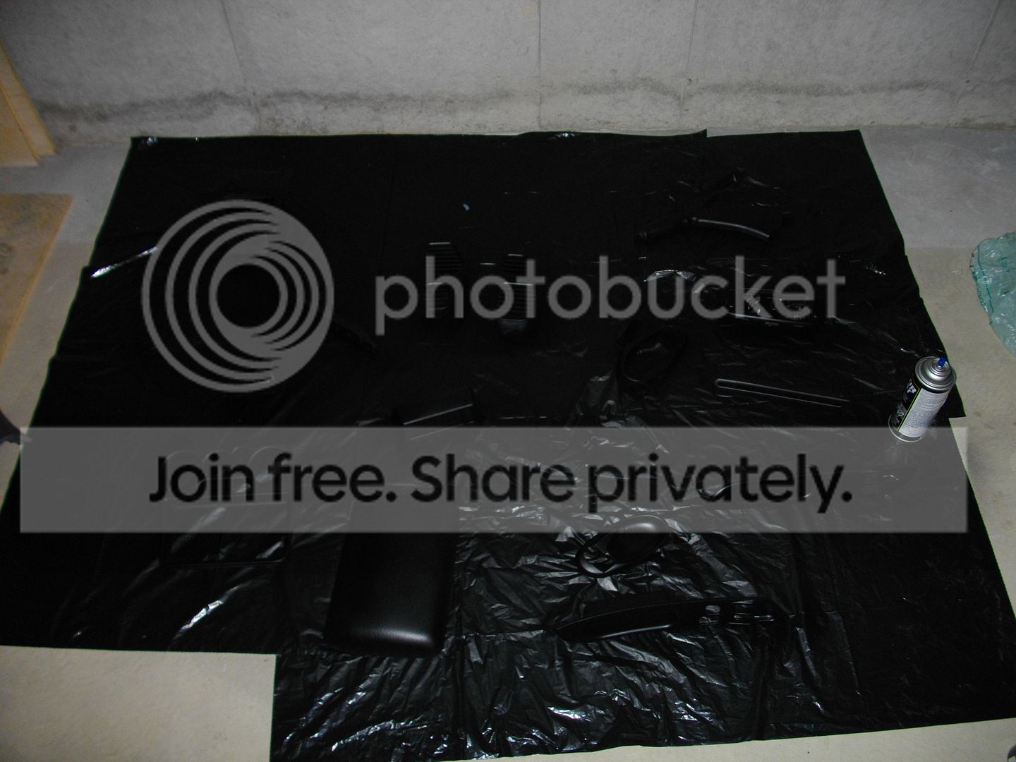

I then tried a few more pieces.

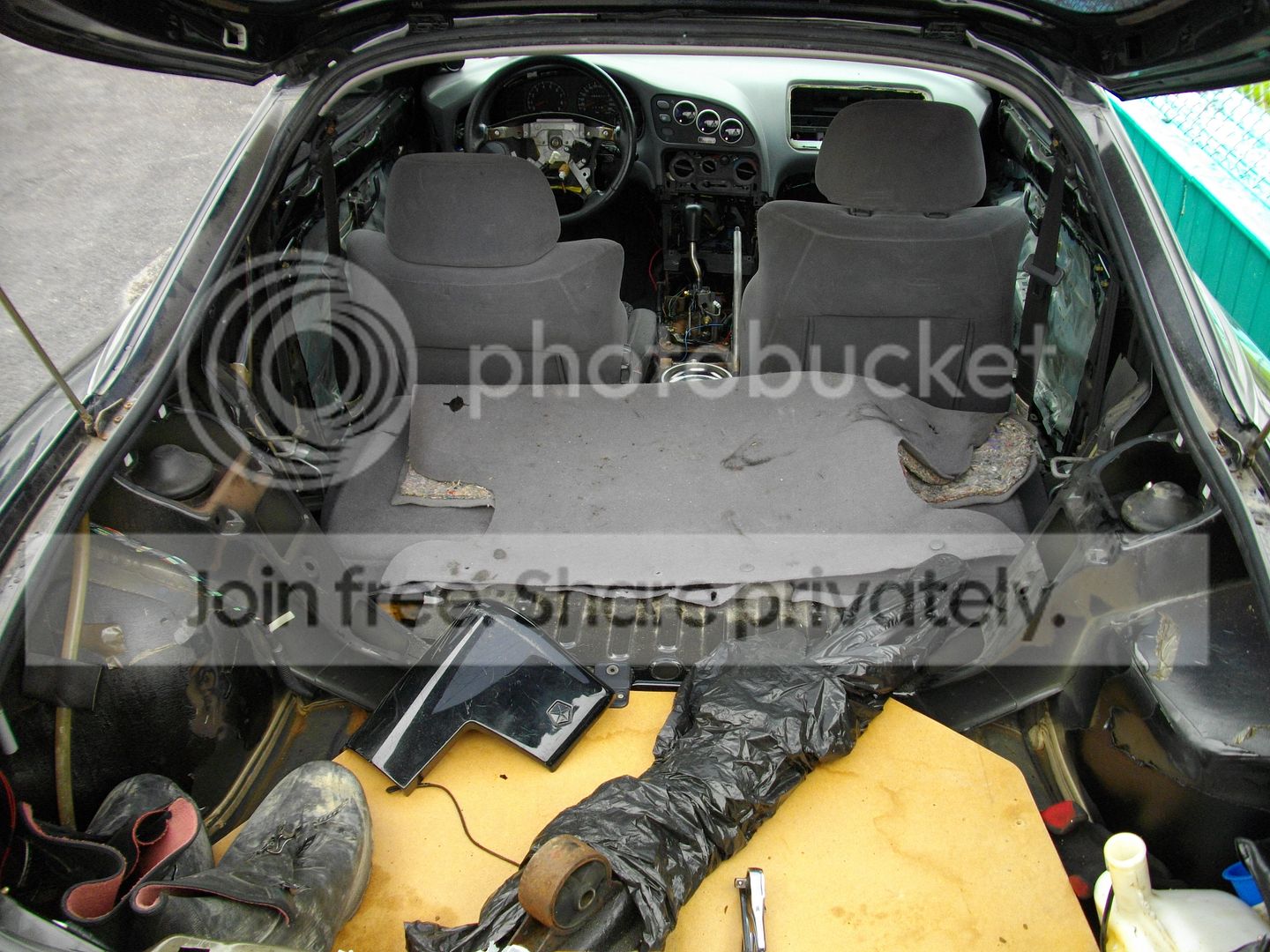

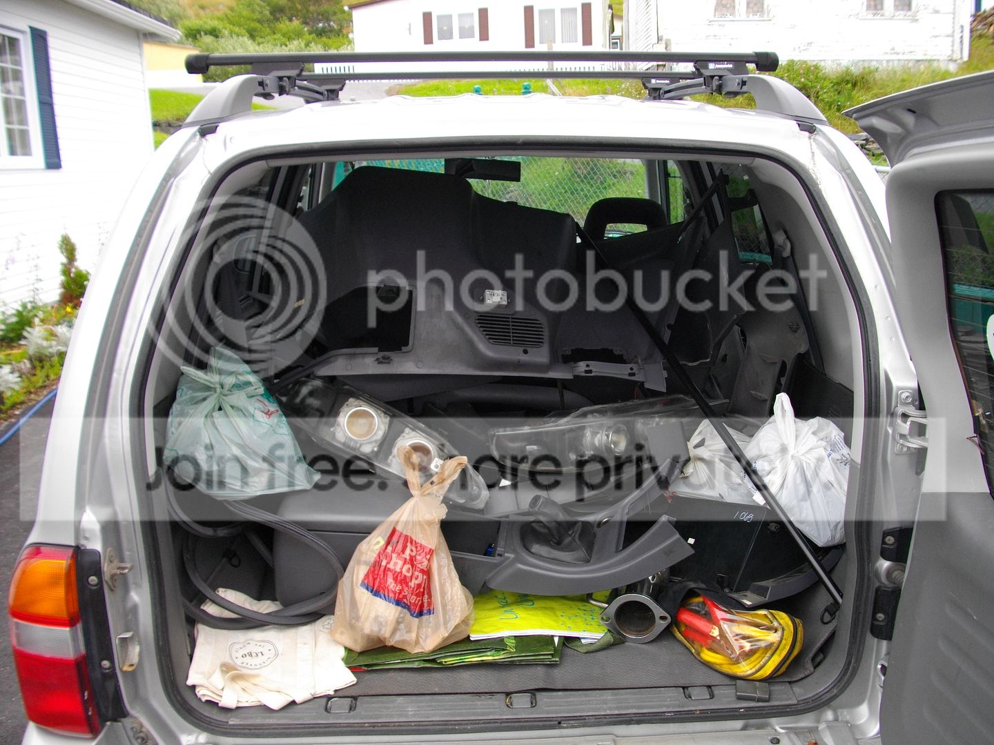

Pulled the rest of my interior out of the car.
Did more parts.

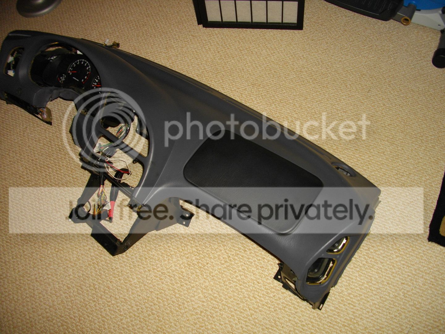

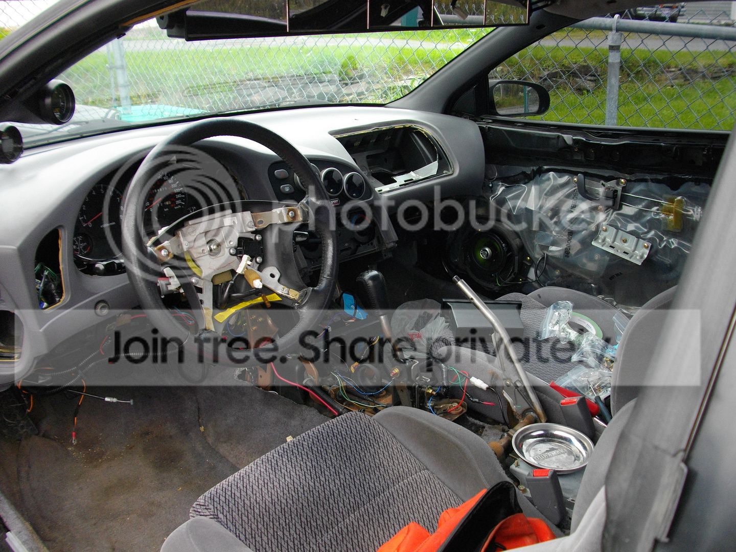

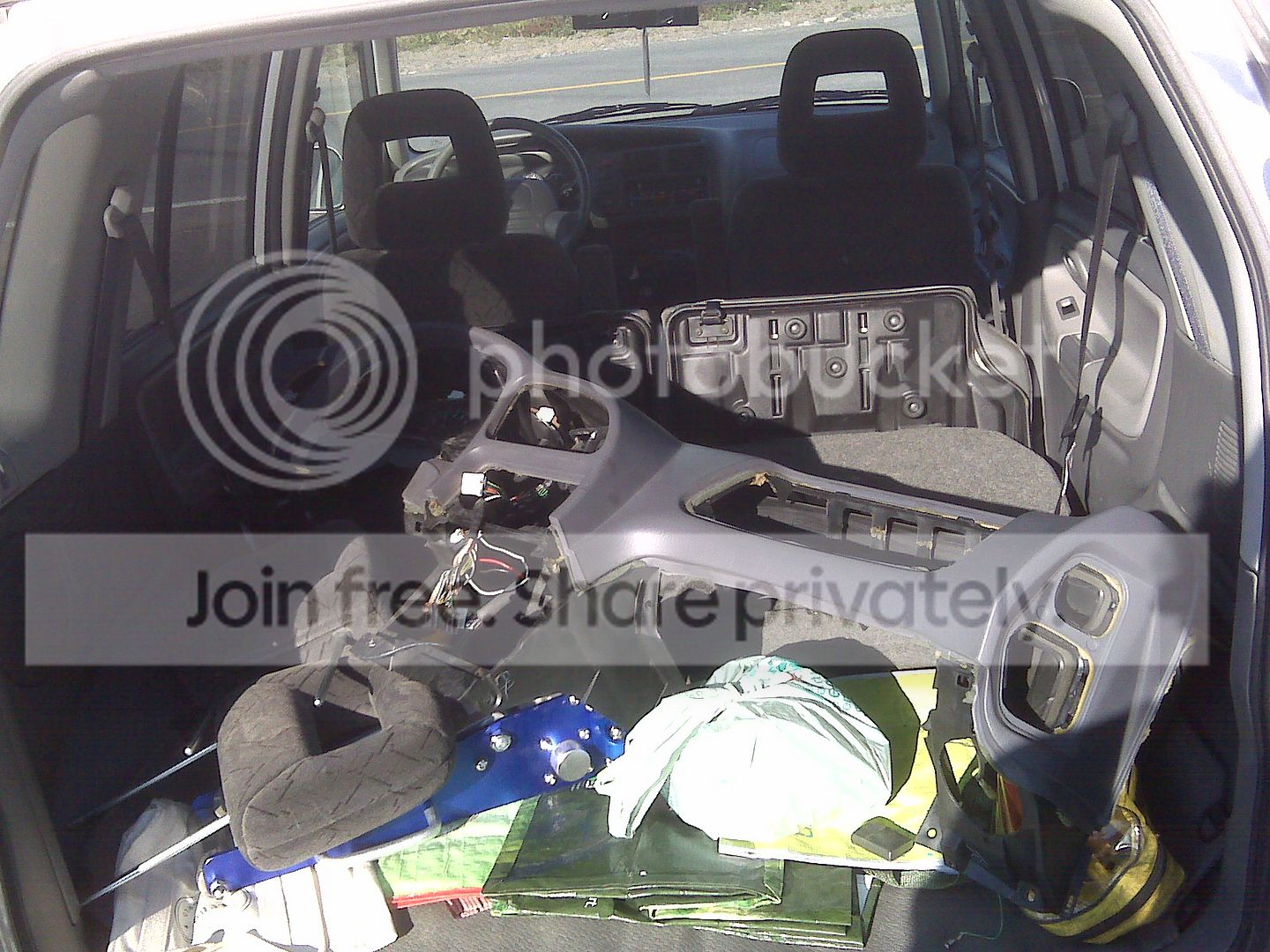

This weekend, I brought the dash home with me.

Looks good. I'd recommend buying a factory molded carpet in black rather than dying yours. That stuff is nasty. :p
I'm doing 5-6 layers of paint for part, I'm just about to open can number 3. I feel as I start to do the bigger pieces I will burn through paint faster.

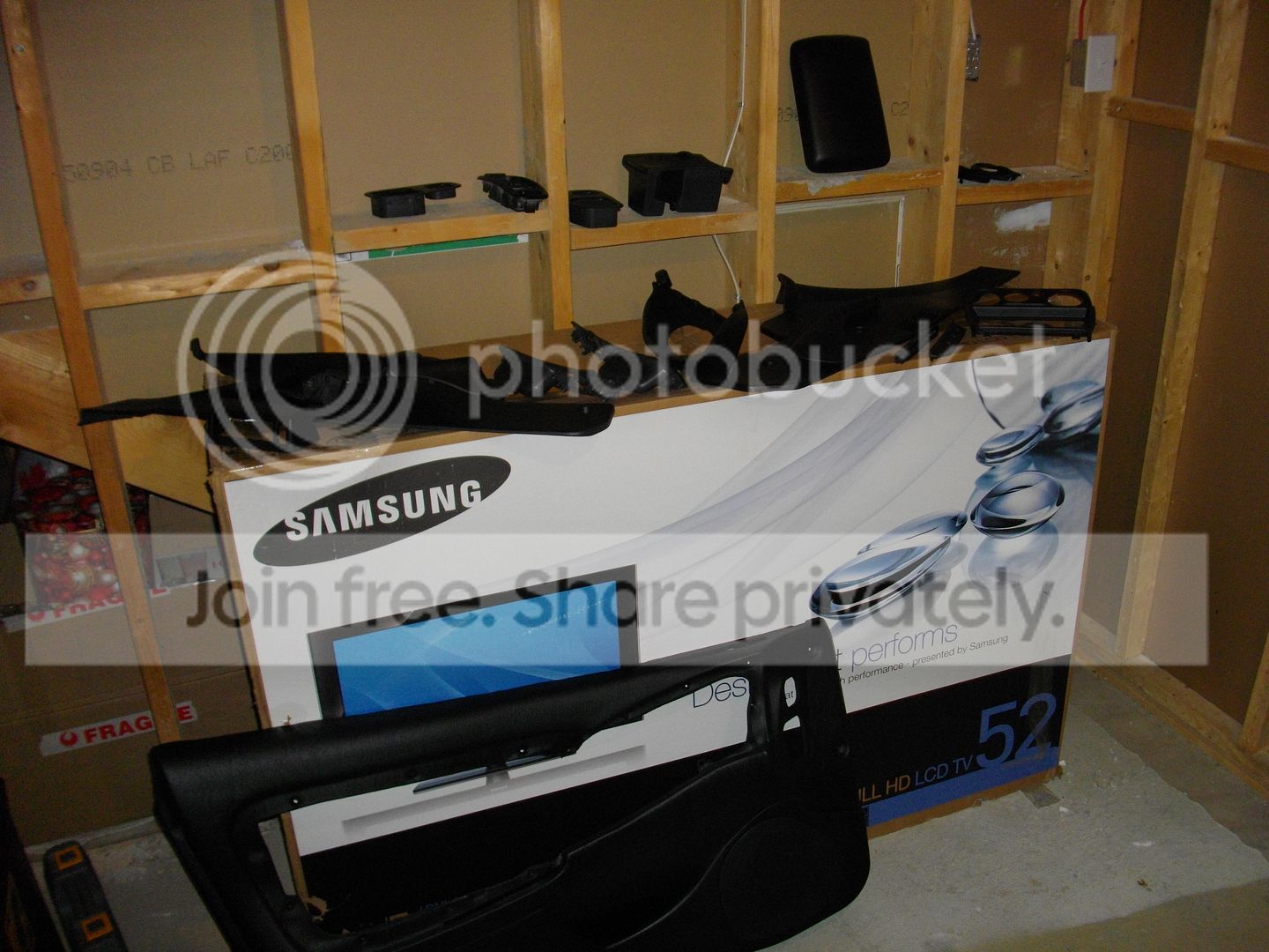

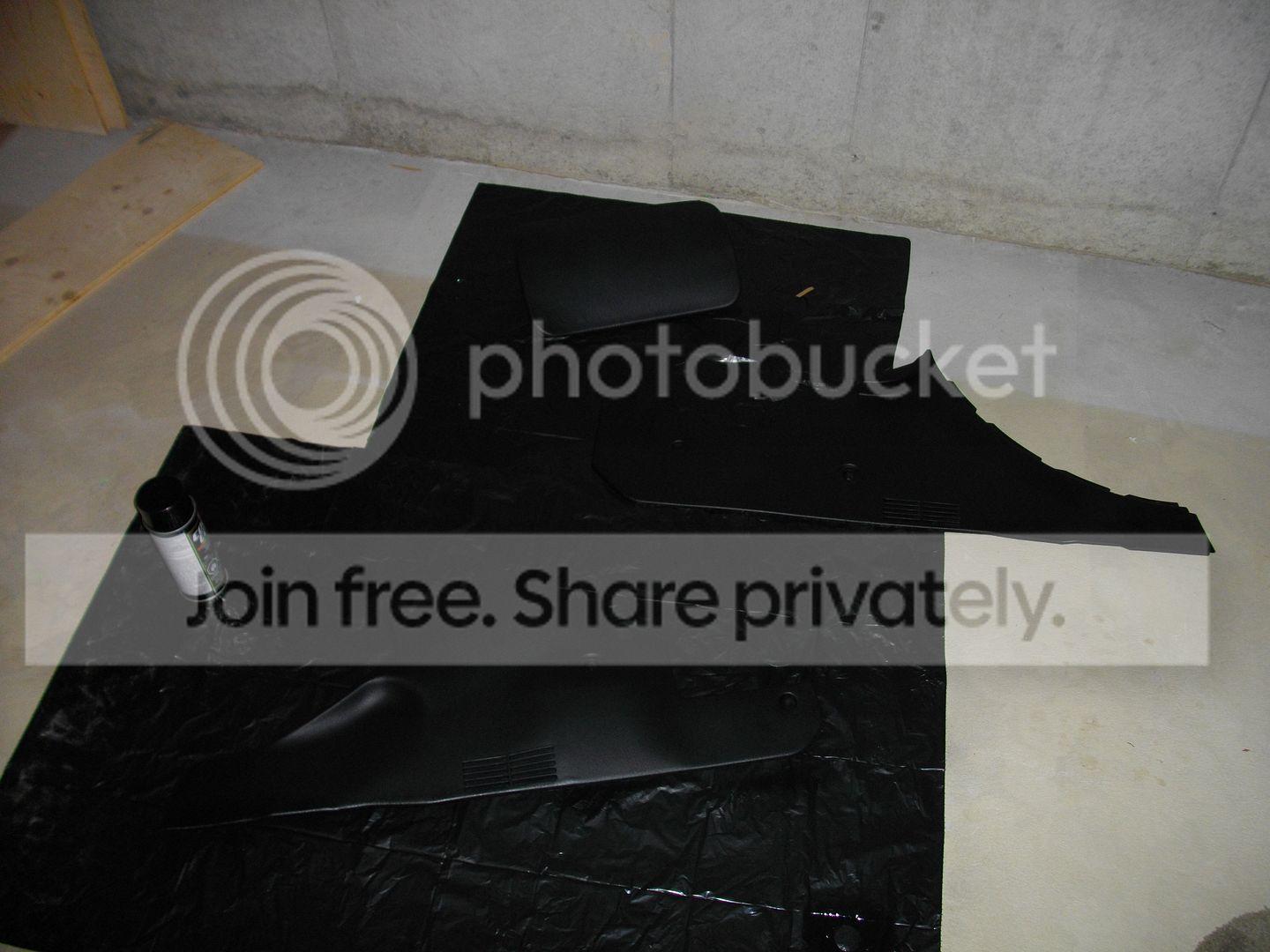

Here's all the parts I've dyed now, passenger door panel is being worked on right now.
I put the air bag panel back in the dash to see the contrast between the factory gray and the new black. I have to say it looks like an OEM finish. First picture has no flash, second one does.

SEM is made for paint plastics and it's the best stuff on the market. I'm very happy with the out come.

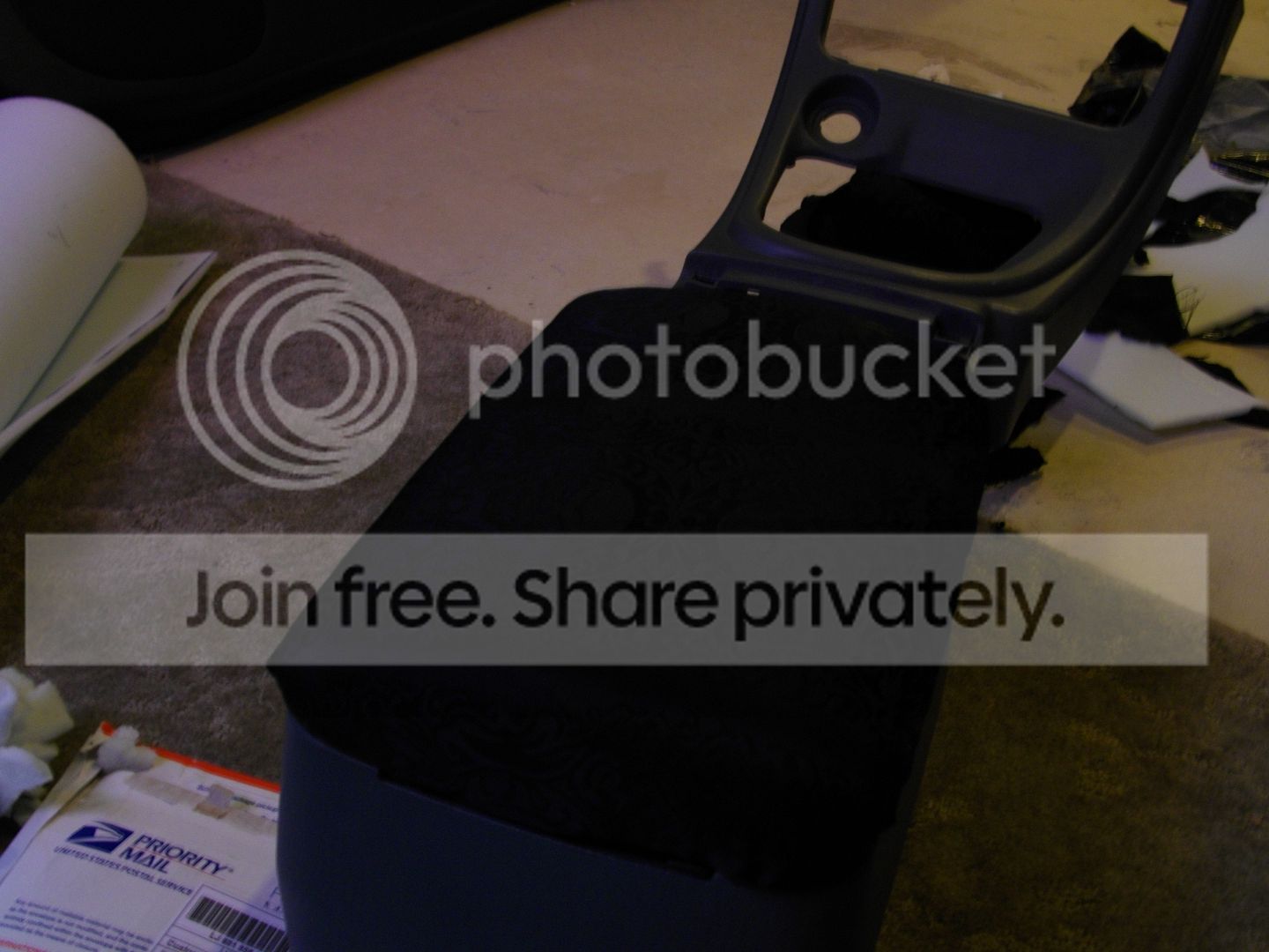

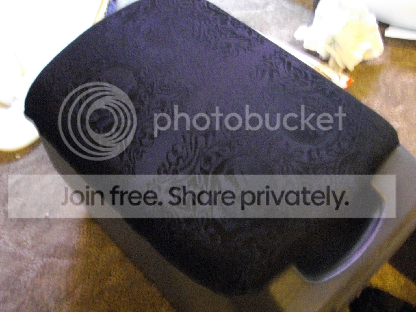

Little teaser of some other stuff I'm working on for the black interior. I'll make how to post of how to do this, don't worry ;)
