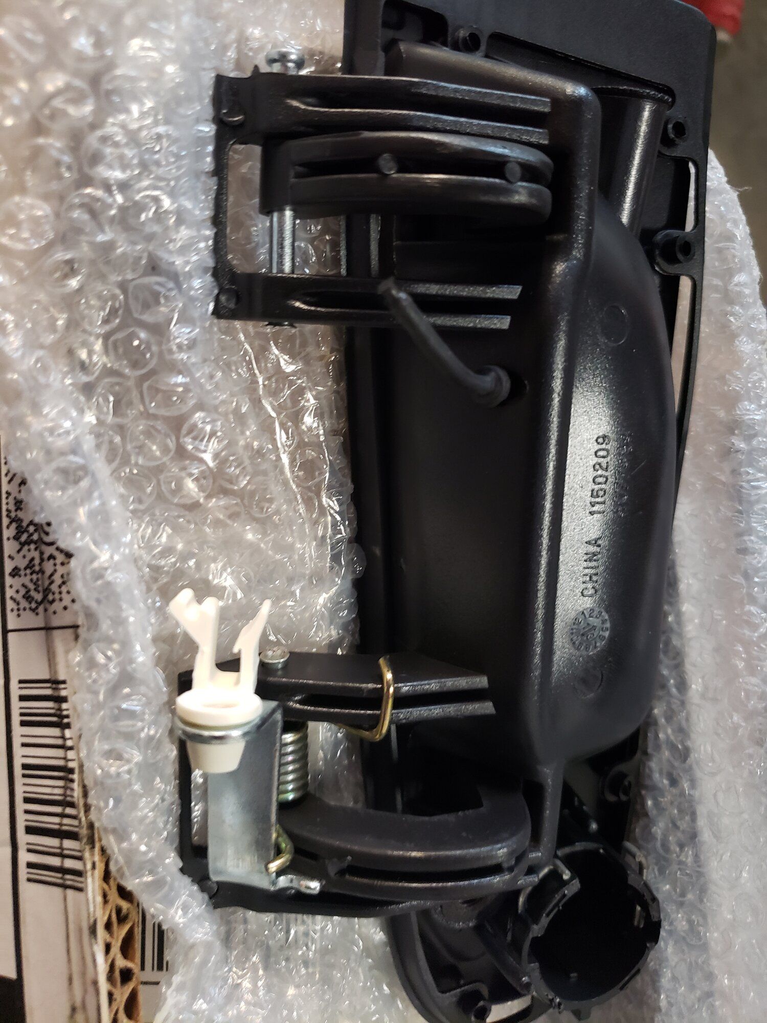

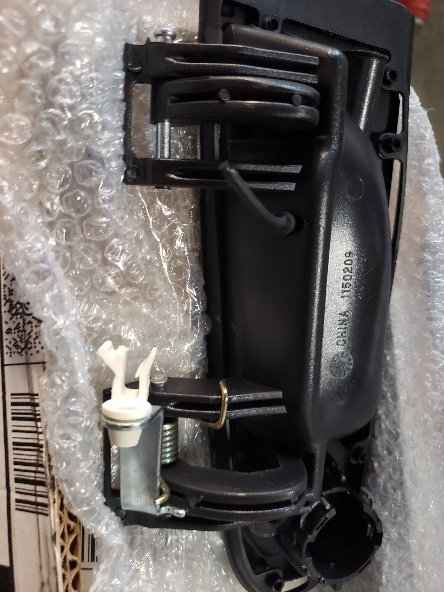

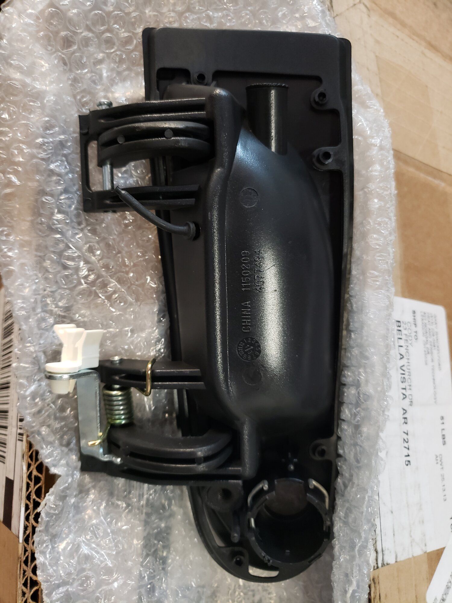

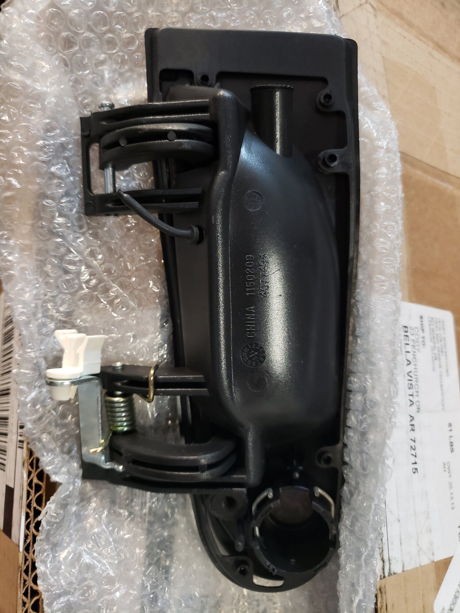

Here's a couple pics of the door handle. Don't know of you can tell much but let me know. I did score a set of billet handles so I'll have them soon and will likely just hang on to these.
Hard to tell in that picture. Tabs look about the same as all the others. Just oil/grease the hinges a crap ton to make life easier on the little tabs.

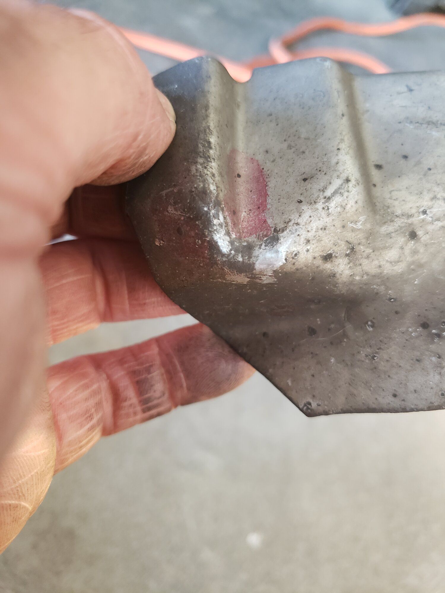

I got under the Talon today and found a heat shield between the cat and driveshaft that was touching. Figured it could be the whining issue so I removed it and took her for a quick spin. That solved the loud whine but now there was another lesser whine and slight howling from front of the car. Jacked the front up and found both wheel bearings bad, left front horribly bad. So it appears I had two whining sounds compounding the issue. I'm just happy that the trans and t-case appear ok at this point. Ordering two Timken wheel bearings now. I thought the front wheel bearings were replaced about 12 years ago at a shop, but I honestly don't recall for sure. Considering it sat garaged for 9 years then I guess not.

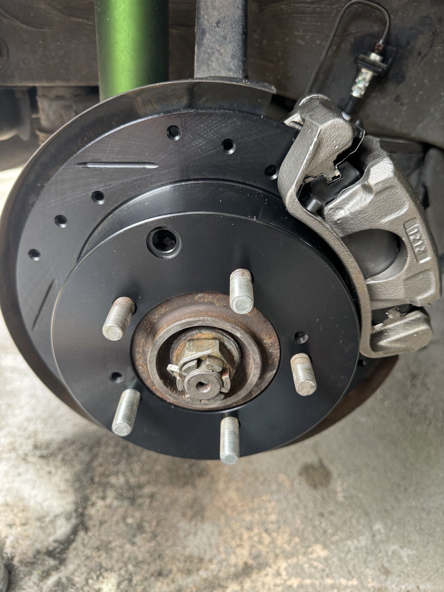

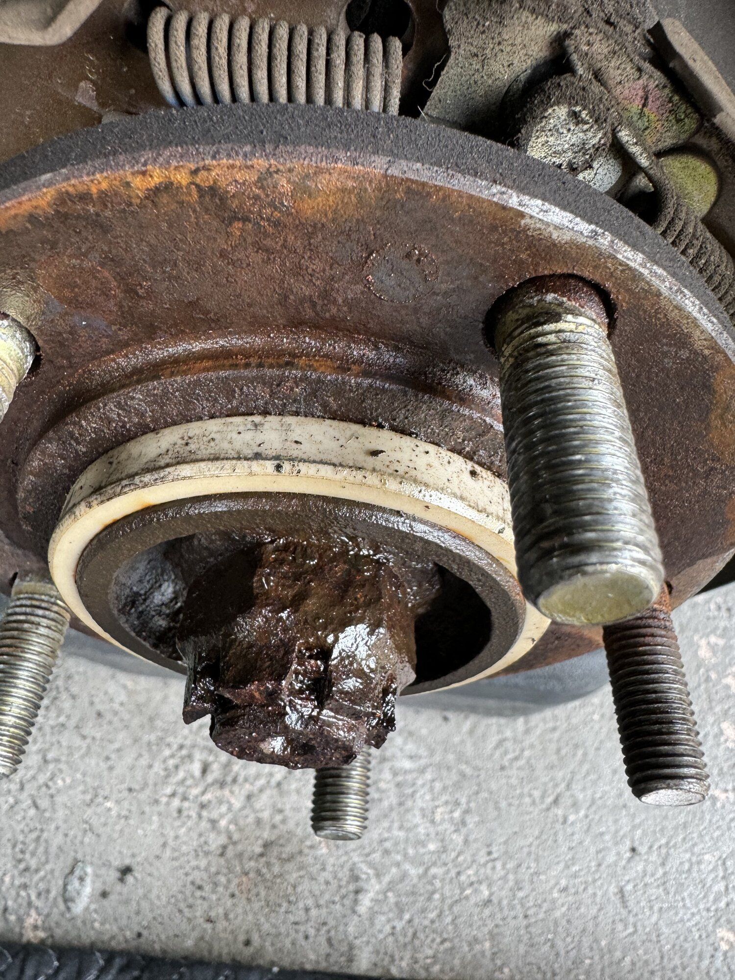

Recently I had the driveshaft rebuilt but it didn't solve the whining noise, but that's ok as I want to go through most of the car anyway due to age and 130k miles. The brakes were noticeably worse on the short test drive after installing the driveshaft last weekend, so I went to work on them this weekend. Pic is of the left rear hub which I noticed was quite hot after my short test drive from before. I imagine this wheel bearing is bad as it appears to have gotten quite hot and is likely my noise culprit. It is the only original wheel bearing, the other three have all been replaced prior. So now I'll be replacing this bearing, spindle nut and washer, plus the shaft. Thankfully the caliper, bracket and rotor all came off easily. I haven't been driving the Talon, thankfully, but once this is done then I should be in the clear, fingers crossed.
Rear brakes done with R1 pads and rotors, new calipers and lines from Rock Auto. The new front calipers shipment has been delayed so I wasn't able to get to them, but can at least get her to my friend's shop to replace the wheel bearing and shaft this week. She finally feels close to driveable soon!
