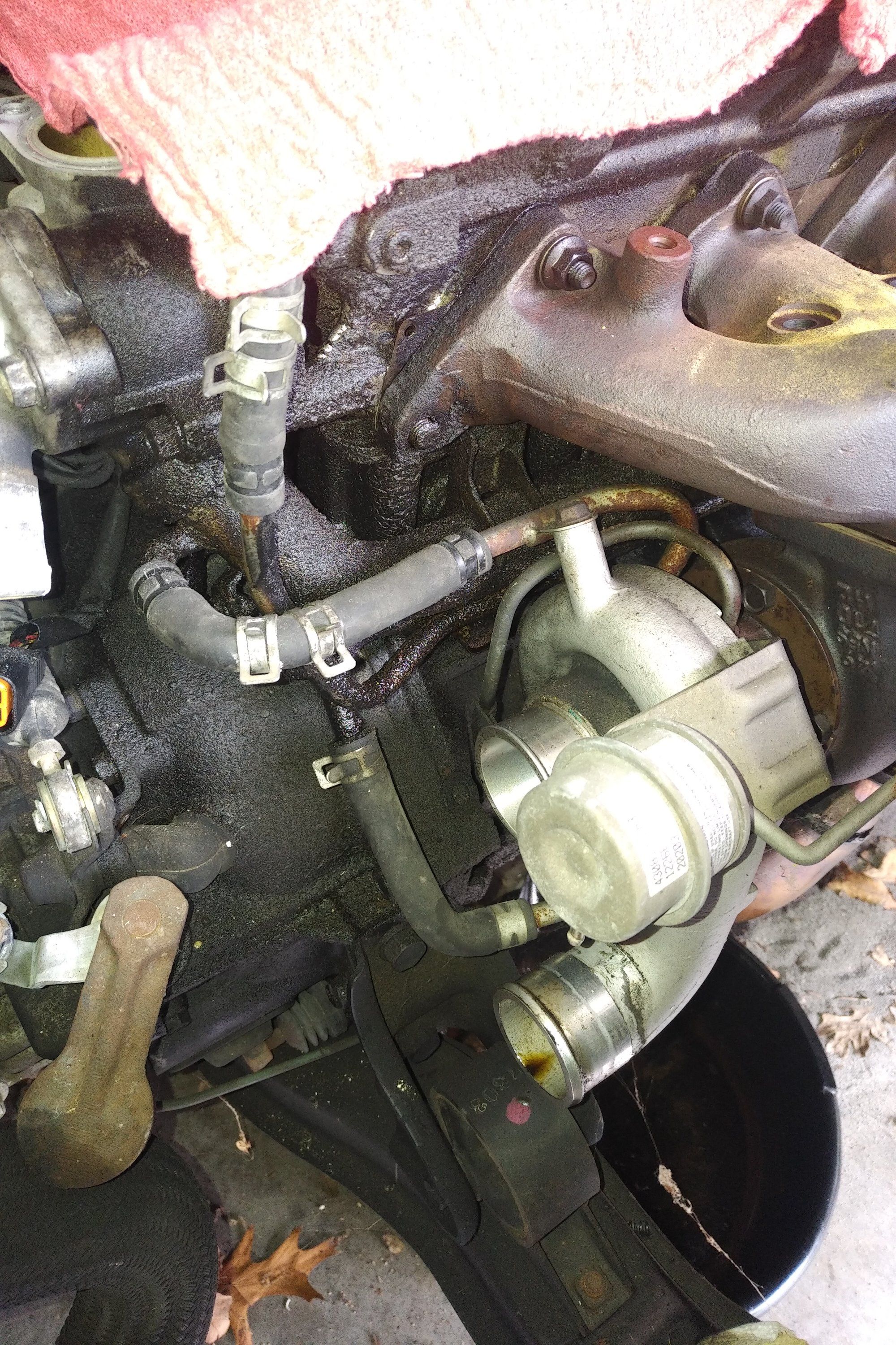

3/5/2020 - Drained coolant and oil. Removed radiator, coolant hoses, air box, intake, and heat shield. Found the plastic where the upper coolant hose attaches to radiator to be cracked off (big surprise LOL). A local DSMer has an ebay aluminum radiator he's selling me along with his FP Big 28. I have a feeling he's gonna be useful!
I hope to find where the oil leak was coming from, but after 7 years I can only recall it was down in the area of oil filter housing to turbo. I suspect it was a hose so will clean those up and inspect for holes. Already finding rusted bolts such as the radiator bracket bolts. Yeah, this is gonna be fun.

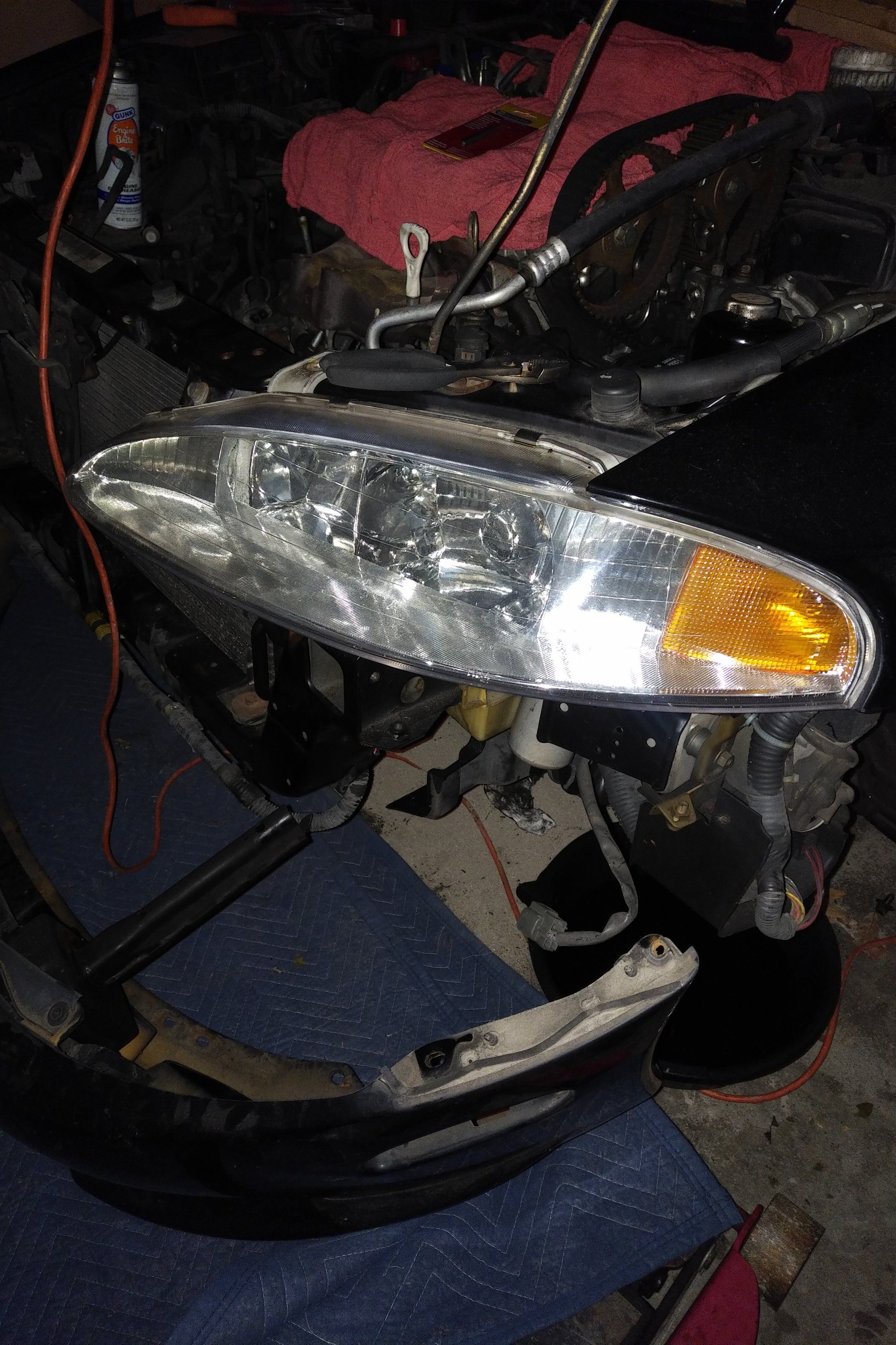

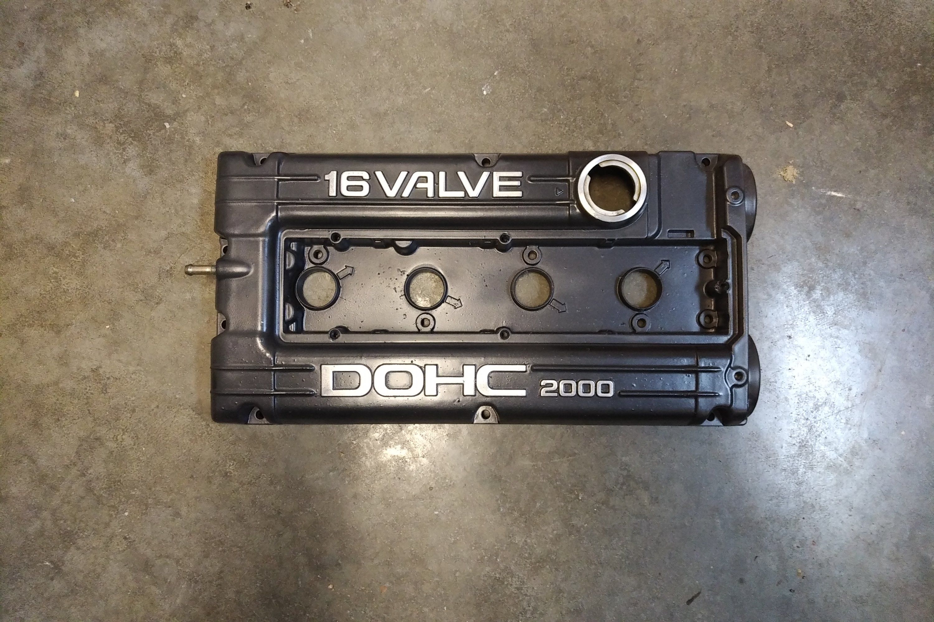

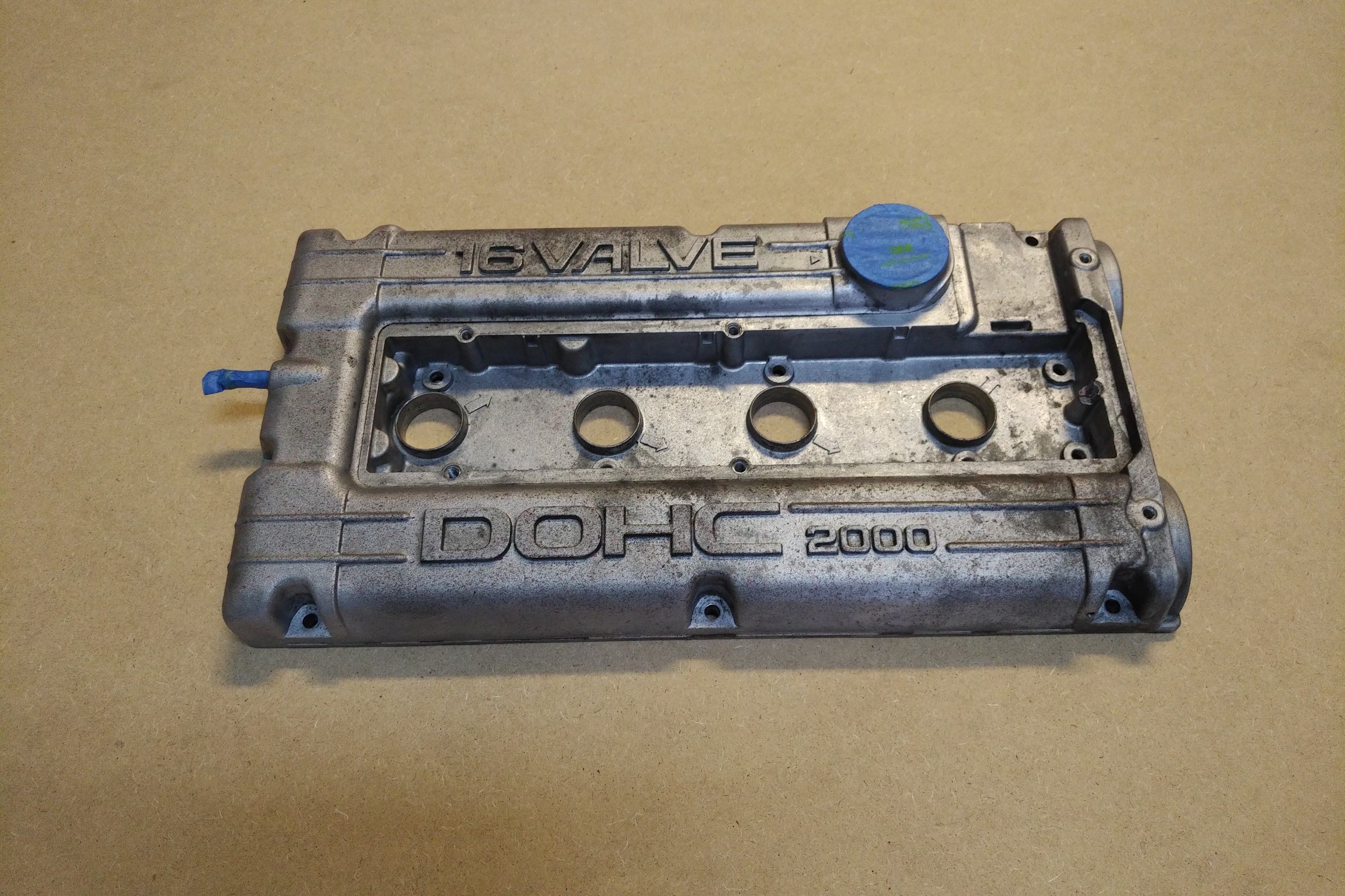

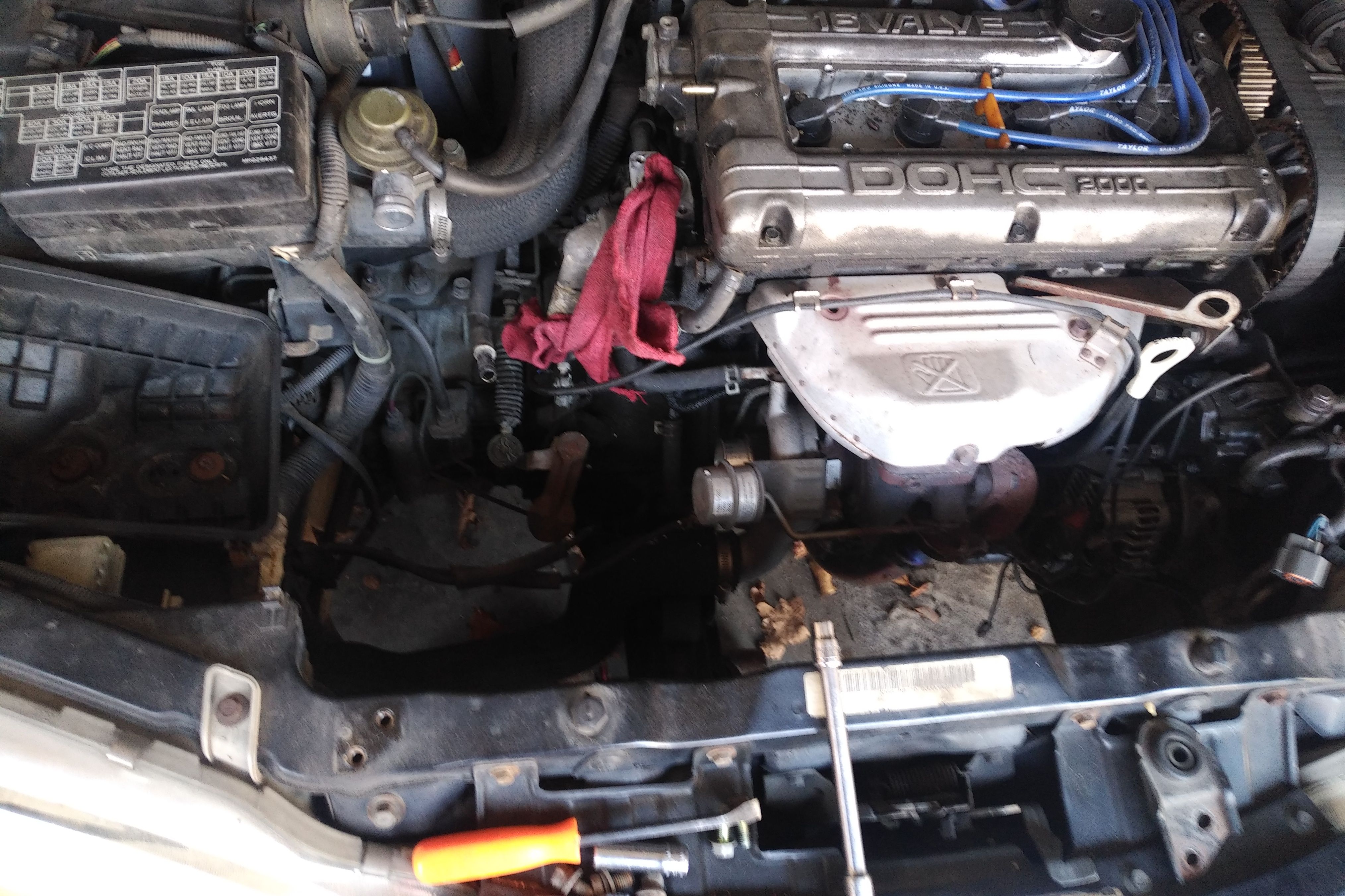

5/19/2020 Got a bit more done the past few days. Valve cover, front bumper, stock turbo, intercooler and piping all removed. Cleaned up the valve cover and added some color to it, though I'm not too happy how it turned out. It was suppose to be a metallic black but ended up more dark grey, plus it's not perfect due to crap in the air getting in the paint but it's better than it was. I knew I should've stayed with wrinkle black as I've done a few times before on past DSMs but I thought I'd change it up. That's what I get for thinking! Pressure washed the front of the motor from the old oil leak and seepage. That was quite the mess but I still need to do the whole engine bay once I can pull it out of the garage. Today I cleaned up the headlights and the water neck and t-stat housing.

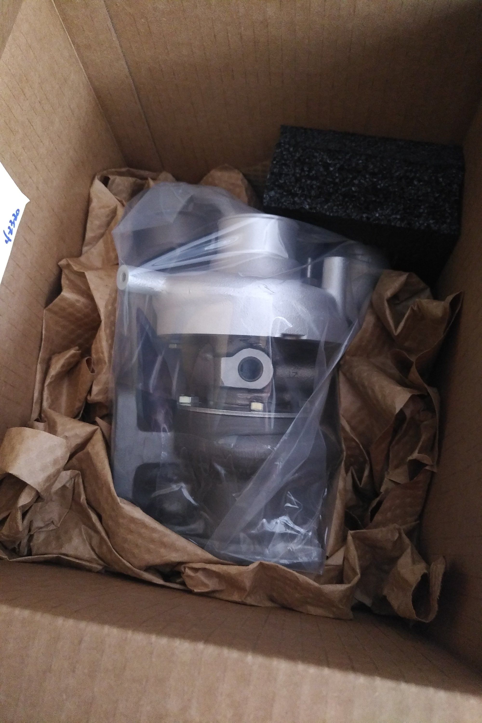

Quite a few parts arrived/picked up already, fresh rebuilt (rebuild by G Pop Shop) FP Big 28, turbo and valve cover gaskets, VR1 oil, driveline fluids, ebay radiator from a local DSMer, ebay hose kit, new battery, t-stat, radiator cap, plus more I'm sure I'm forgetting. Still waiting on more recent orders such as VRSF fmic, Mishimoto coolant reservoir, Vibrant vacuum lines, fuel pump rewire, o2 sensor, and Hallman MBC.

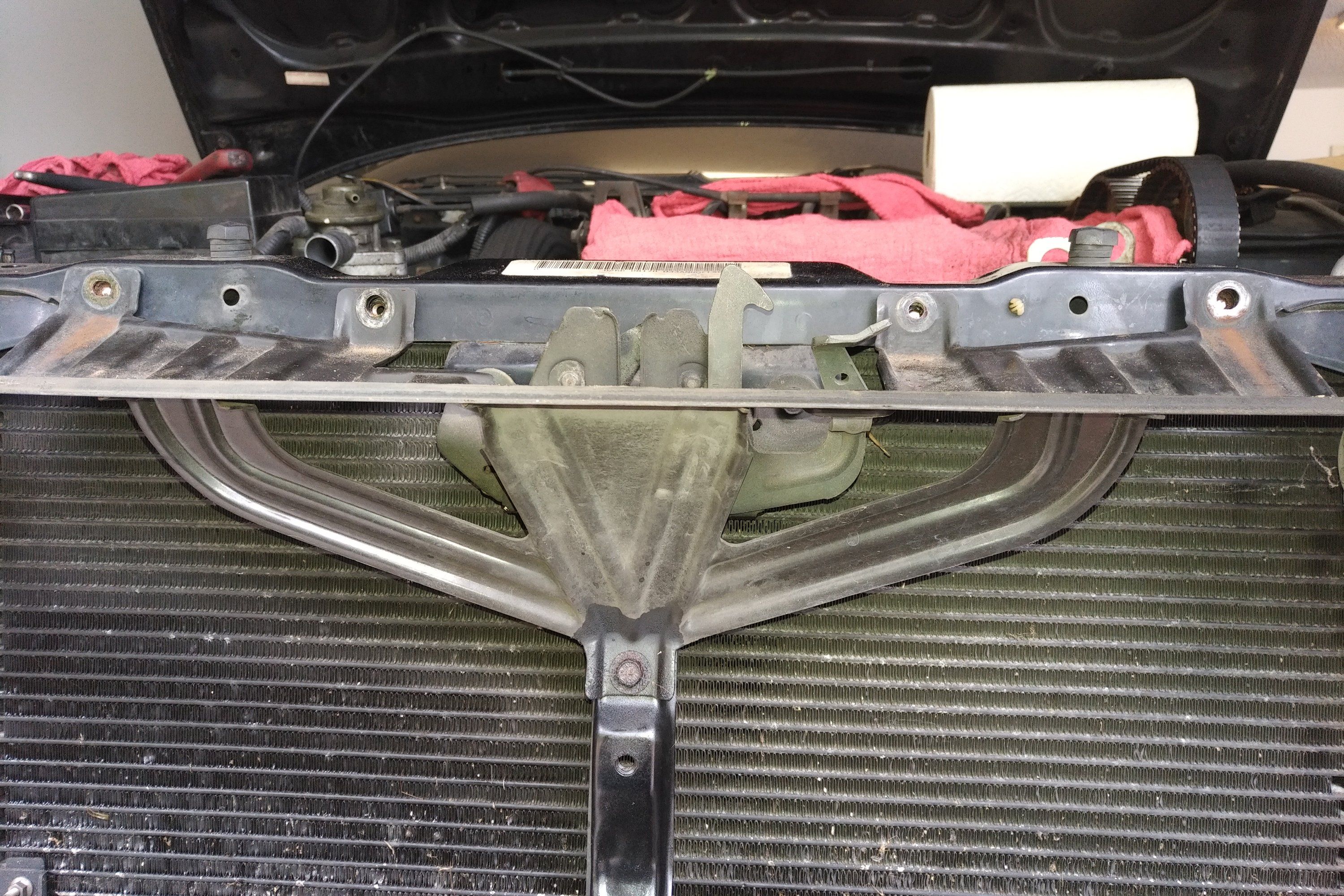

6/8/20202 - Made a little progress with the fmic. Got it mounted and bumper trimmed, the 3" hole saw was a pita but it worked and have the cold side pipe mounted up to throttle body. All that has led to figuring out what to do with the overflow bottle, which in turn has led to oil catch can(s) research, which has all led to the decision to pull the cruise control out and find a non-cruise throttle cable to make room for everything. I never intended to pull the cruise control, but since it's no longer a daily I easily decided it wasn't necessary.

I also removed the oil filter housing to replace the gasket at the block, and also the o-ring. Now the decision is what oil feed line to use. After research it looks like feeding from the head isn't a good idea for Garrett turbos, but can't find whether or not to use a restrictor with a -4 an ss line off the oil filter housing. Tuners is a treasure trove of info but sometimes it leads to not being able to find exactly what you're looking for. While I was removing the oil filter housing I checked the timing belt and fortunately all looks good there. I had changed it not long before garaging her for 7 years so I should be good there, plus being in a garage has definitely helped.

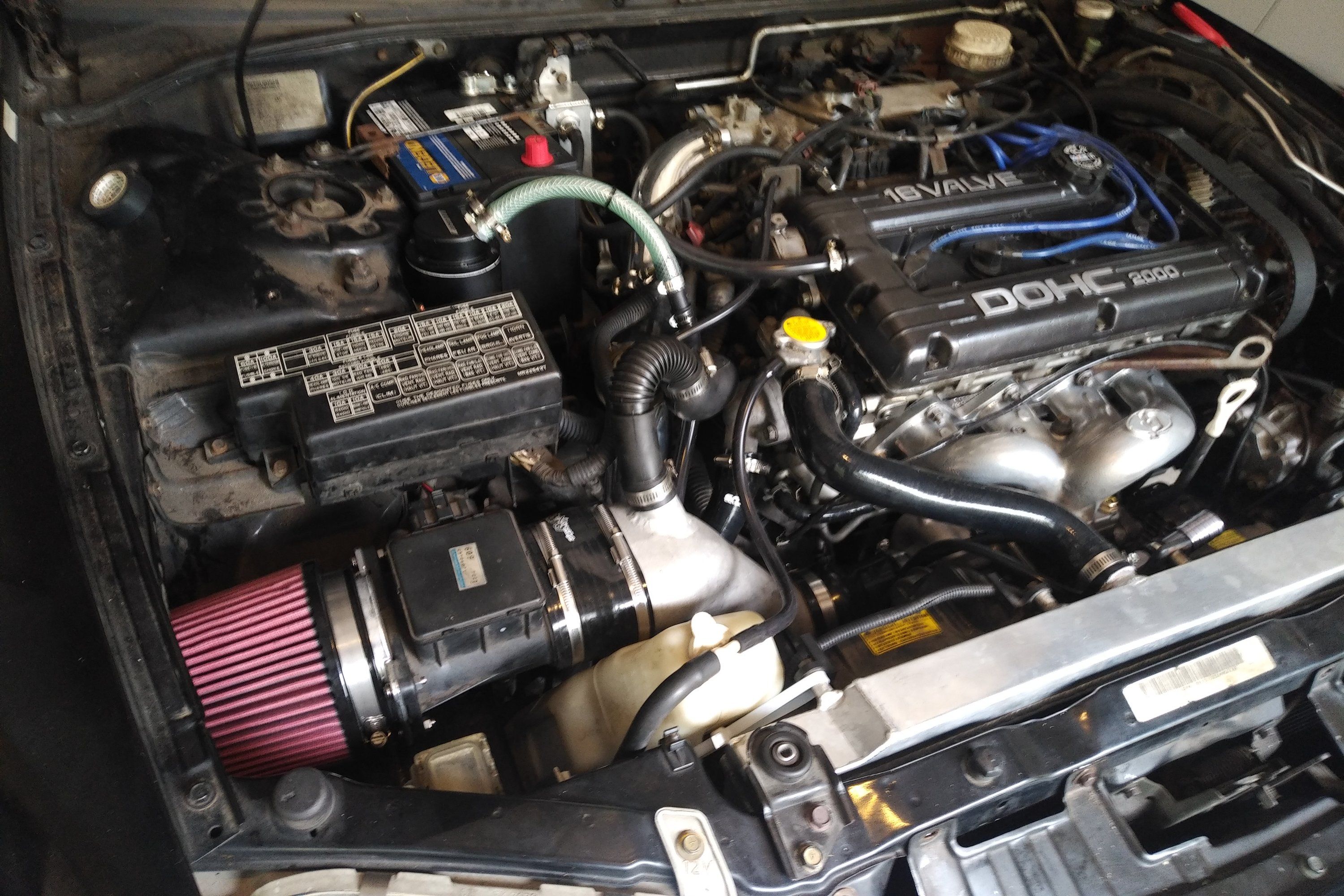

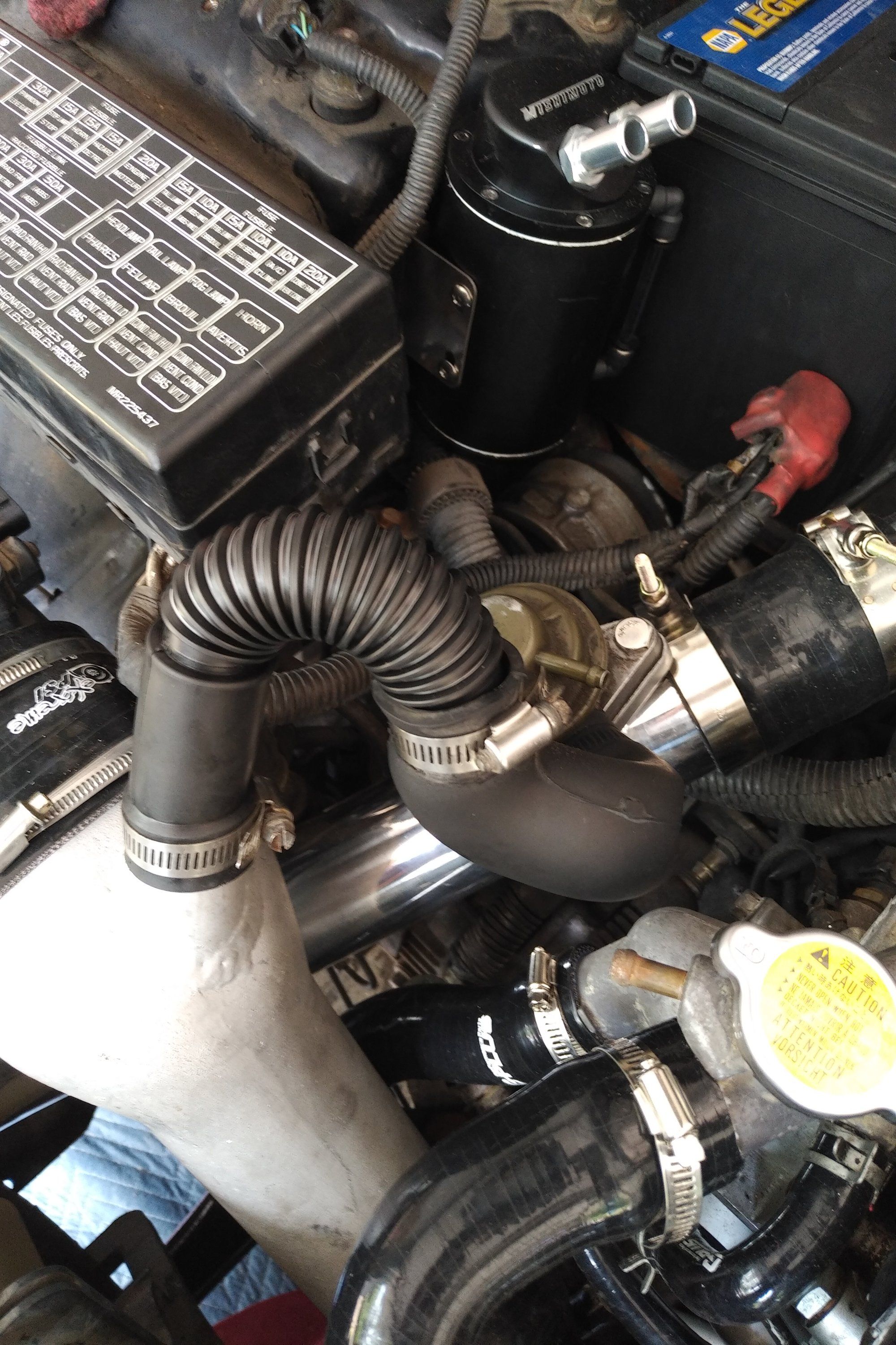

Finally got the motor back together after having the T28 outlet modified to downflow and ordering a few pieces such as exhaust manifold gasket, stud and nut/washer as well as ss oil feed line. The turbine housing was ported to match the FP manifold I ended up using due to cracks in the stock 2g manifold. I drilled and tapped a nipple into the aluminum intake pipe for the catch can hose and also had to find a way to route the bov return hose. It's just temporary right now as I plan to switch to Link and speed density soon. I used the stock rubber piece along with a small section cut from washing machine return line. It's not pretty but thankfully only temporary.
I am running a two catch can setup, both sealed, as can be seen in the pic. Sure it's a little overkill for not running too much power over stock, but it certainly doesn't hurt and am planning ahead. The stock coolant overflow bottle is simply tucked in near the stock location. I have a Mishimoto overflow bottle but can't find a good location right now due to using two oil catch cans. I tried putting the stock overflow down in the stock sidemount location but I just really didn't like it. Eventually I'll probably locate the battery to the trunk to open up space.

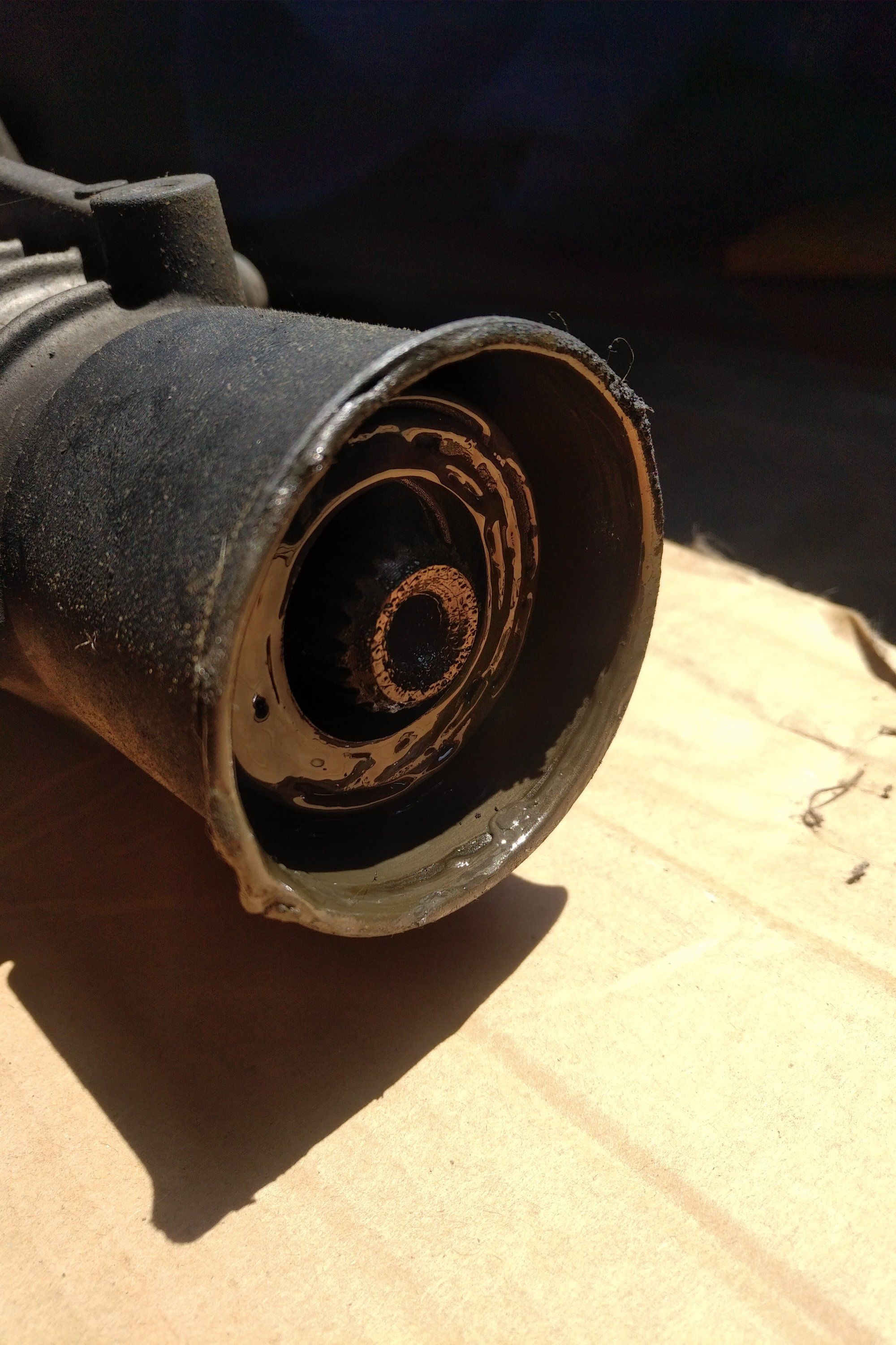

So once I got the motor buttoned up I went ahead and changed the transmission, xfercase and rear diff fluids. The trans and diff went smoothly, but the xfercase didn't leak a drop when I pulled the drain plug! Found the fluid to be sludged up inside both drain and fill plugs. That really sucks as I was excited to hear it run after 7 years. So now that's where I'm at, looking for a good transfer case, having mine rebuilt, or flush it out and hope it's good. It ran fine from 2009 till 2013 though I did see signs of the rear seal leaking when I pulled it off the other day. Am not sure if the remaining fluid turned to sludge sitting this whole time or not. So the wait continues till I figure this out.View attachment 606054 View attachment 606055 View attachment 606056 View attachment 606054 View attachment 606055 View attachment 606056
Glad to see somebody putting some quality effort into their 2G. Why do you assume your t-case needs replacing? Might as well just flush it out and re-fill it and see how it goes.
Thank you, it's been a long process but half the battle is sometimes simply finding parts. Thank God we still have some dsm specific vendors.
I am going to flush it. I came to that realization today after some research. I've never messed with the transfer case too much other than remove and install for other needs. I'll order the seals for it tomorrow and replace them while it's off the car, then flush and fill once those are replaced. I was told that atf fluid is a good choice for the flush so will do that versus diesel. I have Heavyweight Shockproof waiting to go in and will still likely do a quick fluid change again just to be safe. Honestly the sludge kinda scared me but after research it appears to be a fairly common thing. I should've changed it after I bought the car in 2009 but it was bone stock and didn't think too much about it then. Live and learn I guess.
Today I flushed the xfercase with some atf I had remaining from my Ram's trans fluid change. I simply rotated the driveshaft by hand for a while, the car is up on Jack stands. Pulled the drain plug and the fluid came out clean. I have a feeling the old fluid was caked up around the two plugs only. Likely parking it when I did saved the xfercase.
Ordered the seals from STM this morning and will swap those out when they arrive.

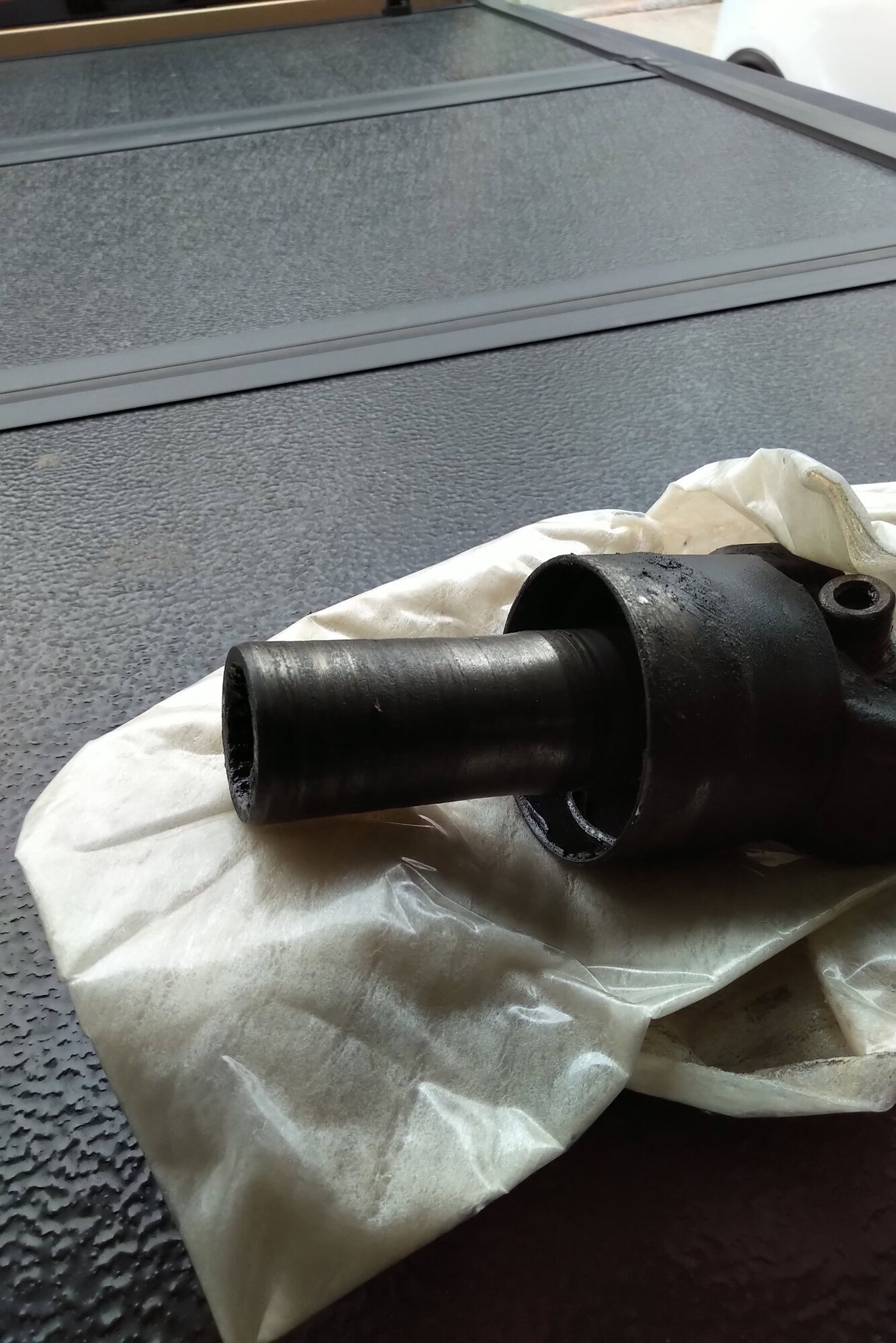

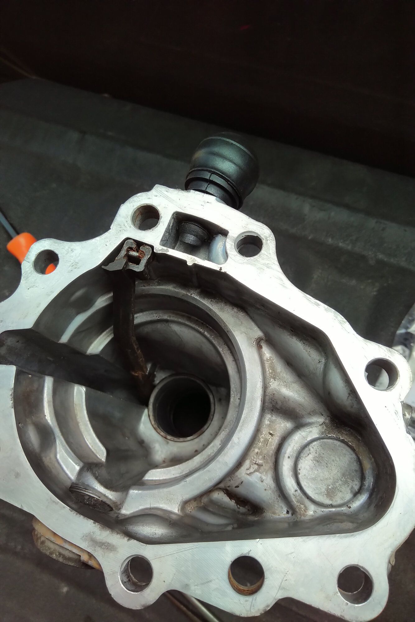

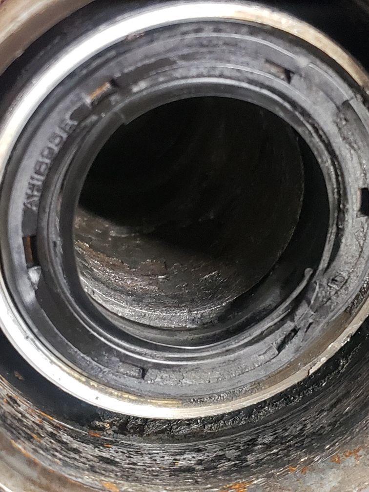

Went to replace the seals a couple weeks ago and when messing with the rear seal I found the shaft has a LOT of play. Up/down, side-to-side and in/out. I took it to a local DSMer who has another 97-99 t-case to compare and possibly swap, his has very little play but the splines are trashed. So back to square one. I've been trying to get to Iowa over a weekend (6 hour trip) to give the t-case to my best friend up there who can rebuild it, but our schedules just haven't matched up. I thought about shipping it but don't want to risk it after hearing some horror stories. It'll be at least two weeks till I can possibly get up there, so am thinking about rebuilding it myself. Problem is that I can't find any videos or tutorials about rebuilding these t-cases. Another thing I'm trying to track down are the caps and clips for the new yoke I have. I have no idea when or why I got the yoke, nor why it doesn't have the caps and clips, but it's definitely a new piece. So the wait continues....

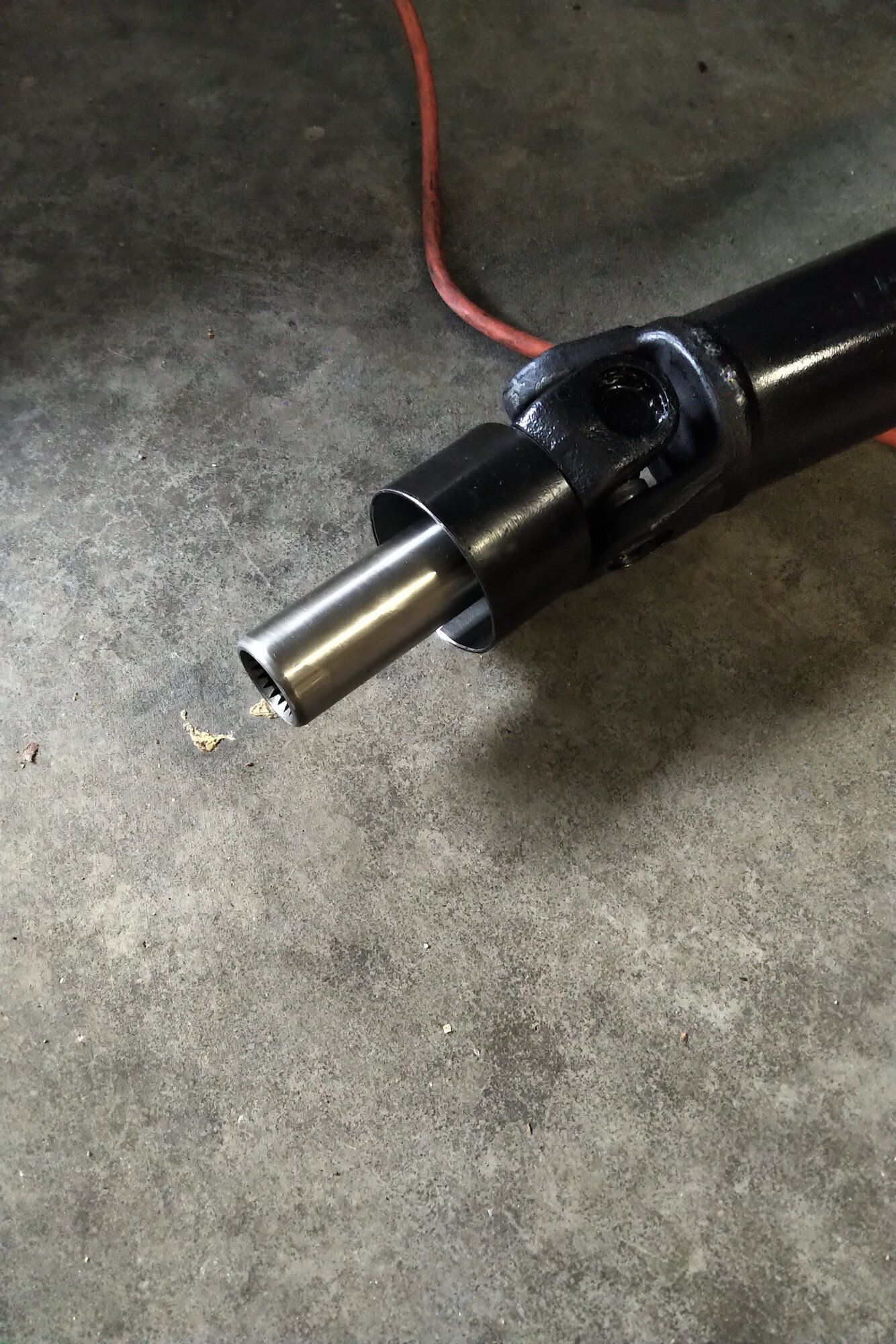

Well almost a year later and I finally have my t-case done. My friend in Iowa rebuilt it with new OE bearings but found the rear bushing to be badly burned up. After some research I found that I had two options, either pay big money for a 300M upgrade or find a tailshaft housing with a good bushing. My Talon isn't high horsepower so while I'd love a bullet proof t-case I couldn't justify the cost for the 300M upgrade right now, and actually found a good tailshaft housing pretty quick at a salvage yard not too far from me. They almost trashed that car when the salvage yard had a big flood and the car was under water, but thankfully I caught it just in time.
Last week I had a local performance shop install a new u-joint onto the new yoke and onto my driveshaft. Plus they also cleaned and balanced my stock injectors and the FIC 650s I've had laying around for years.

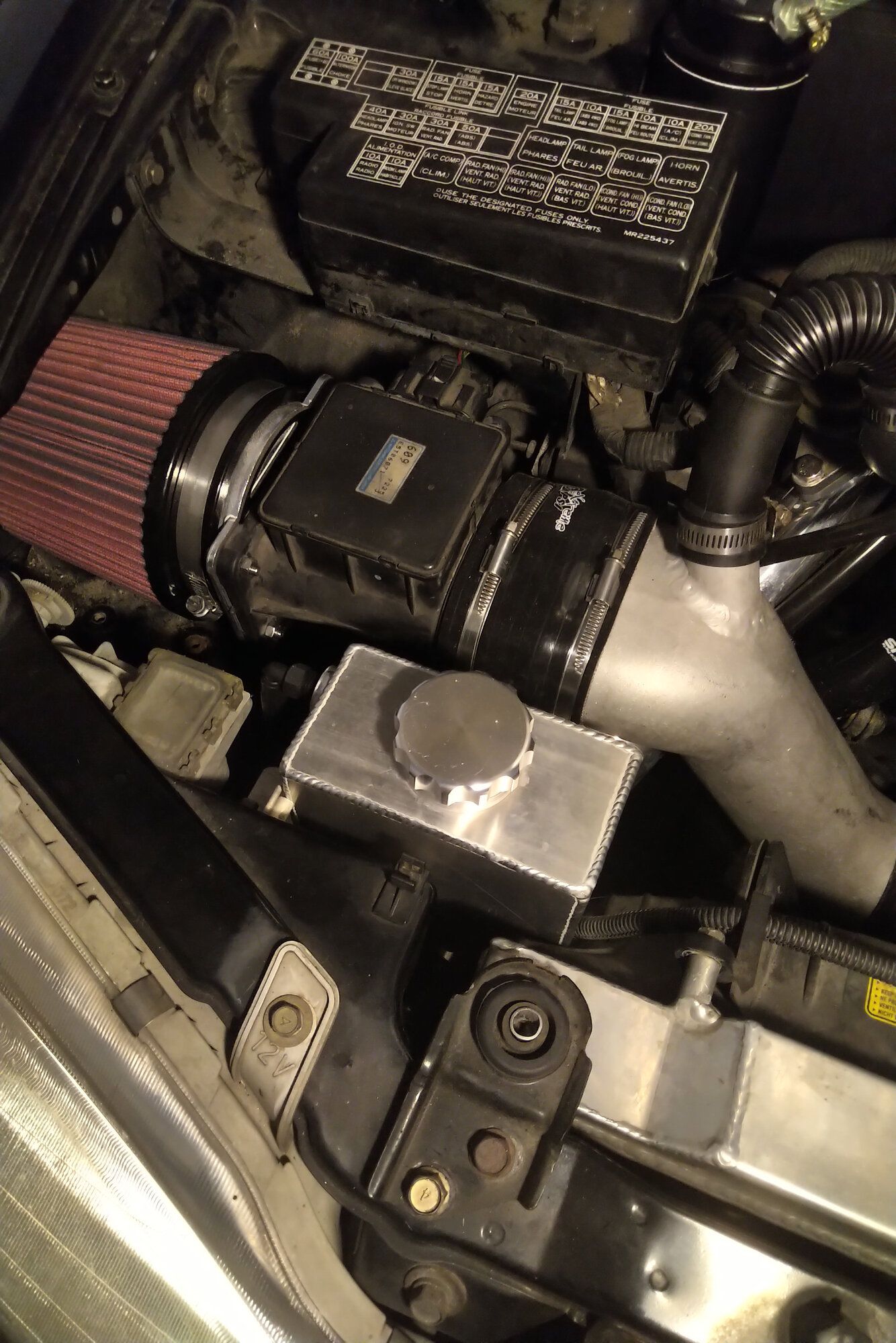

Just realized I hadn't updated after my new coolant overflow bottle was installed. I just didn't like any option re-using the stock overflow bottle after installing the VRSF intercooler. So I got this one from Paul Gamble. It's a nice unit and am sure it'll work just fine.

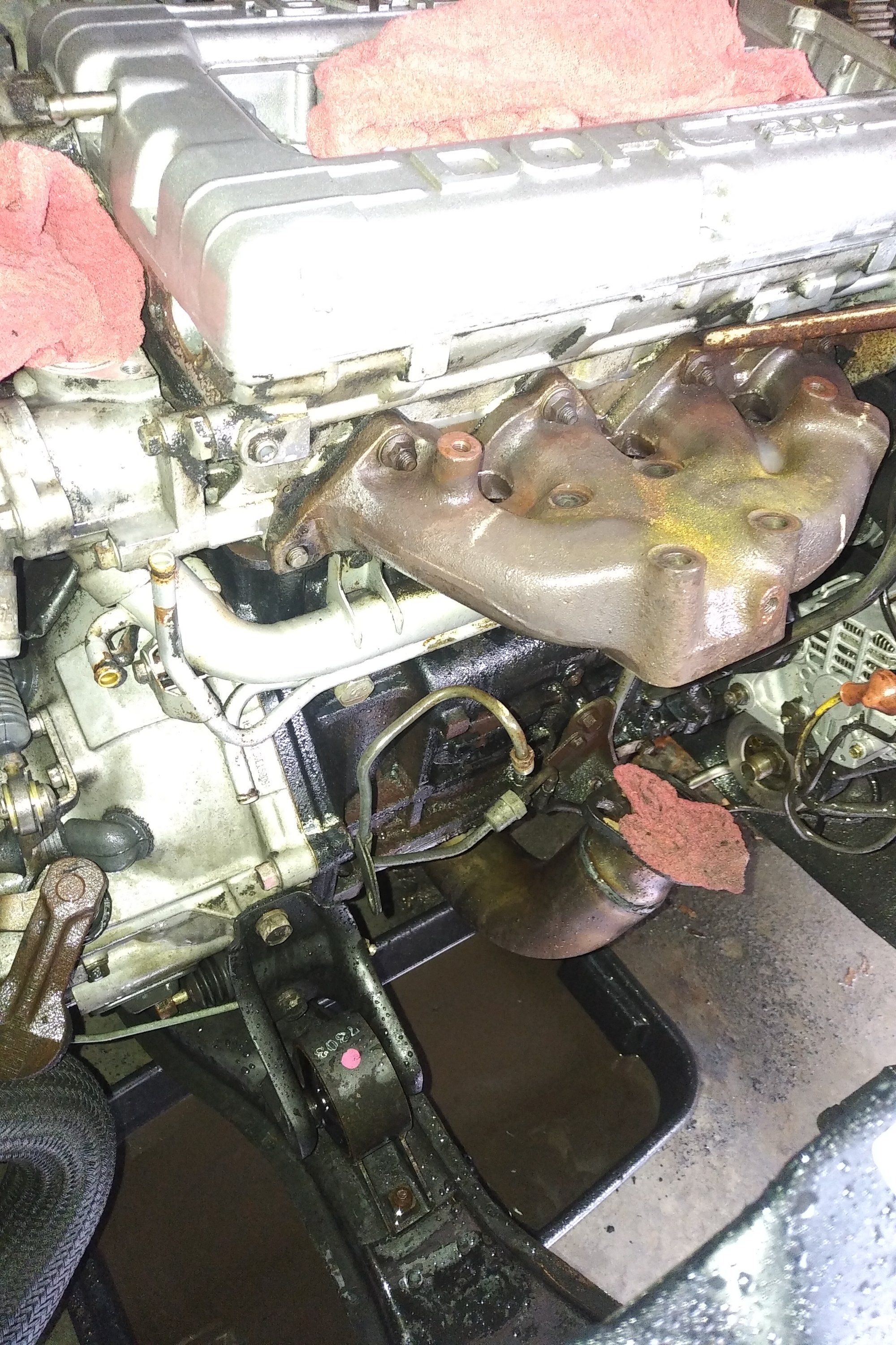

Haven't had much time plus the weather got cold but did get about halfway through the head removal process. I do have the rebuilt head back from the machine shop. Just waiting on cam oil seals to arrive and can finish assembling it. Found the CAS and ignitor connectors broke so they won't clip on anymore, got those ordered as well. It should be warming up soon so I'll hopefully get it back together sooner rather than later. I'm really praying at this point as I am moving to Florida in 4 months.
I also decided to get an EVO III exhaust manifold. Reading enough negative comments about the FP race manifold with smaller turbos made me rethink that setup. They are hard to come by but I finally found a ceramic coated one here in the classifieds, thanks to 'fourgsixty3' for the easy communication and quick shipping. I'd also like to find an EVO III intake manifold as well but those seem to be even more rare.
