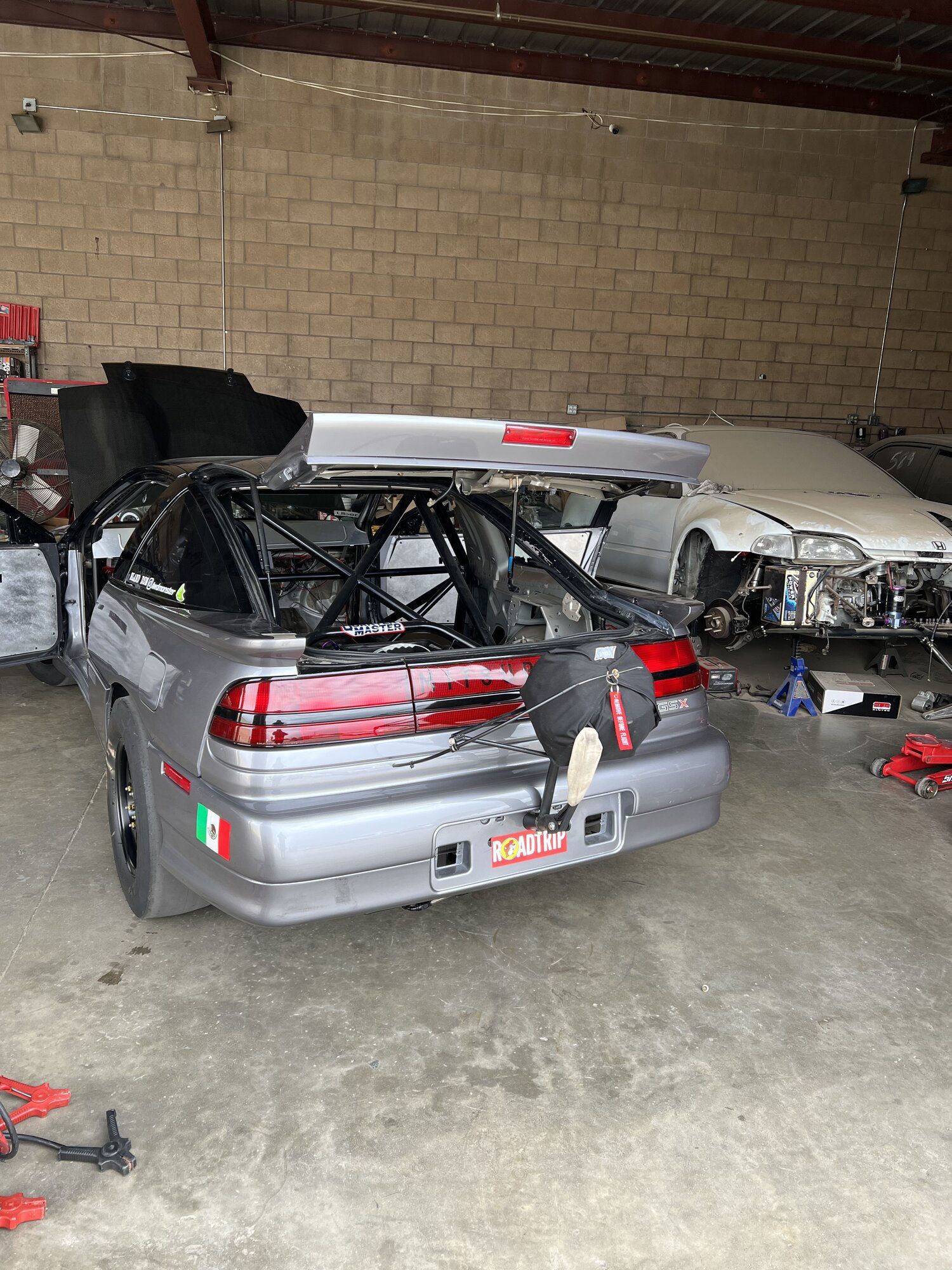

Awdmonster drag car
They used to be a street car but now I'm turning it into a dedicated drag car

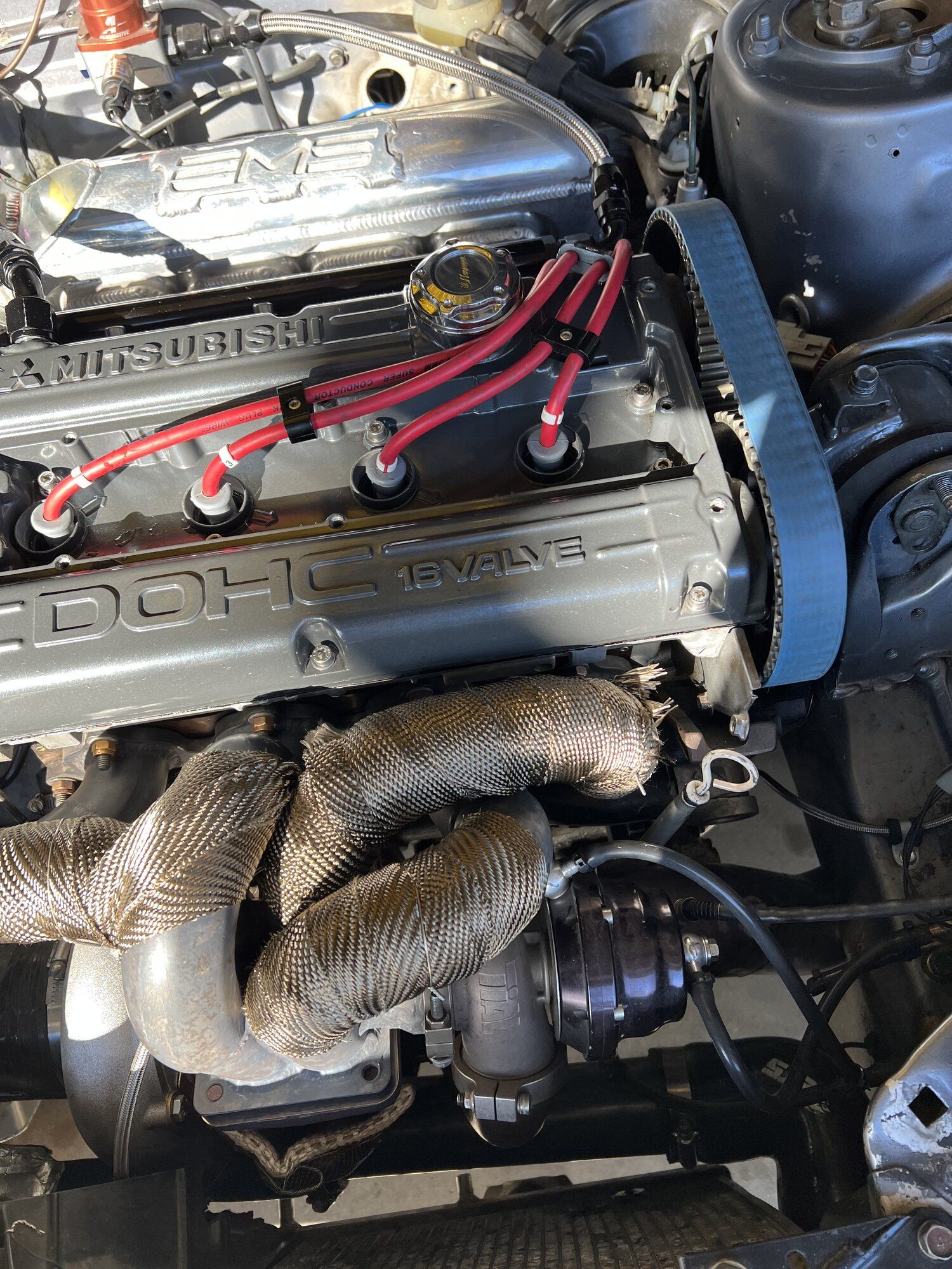

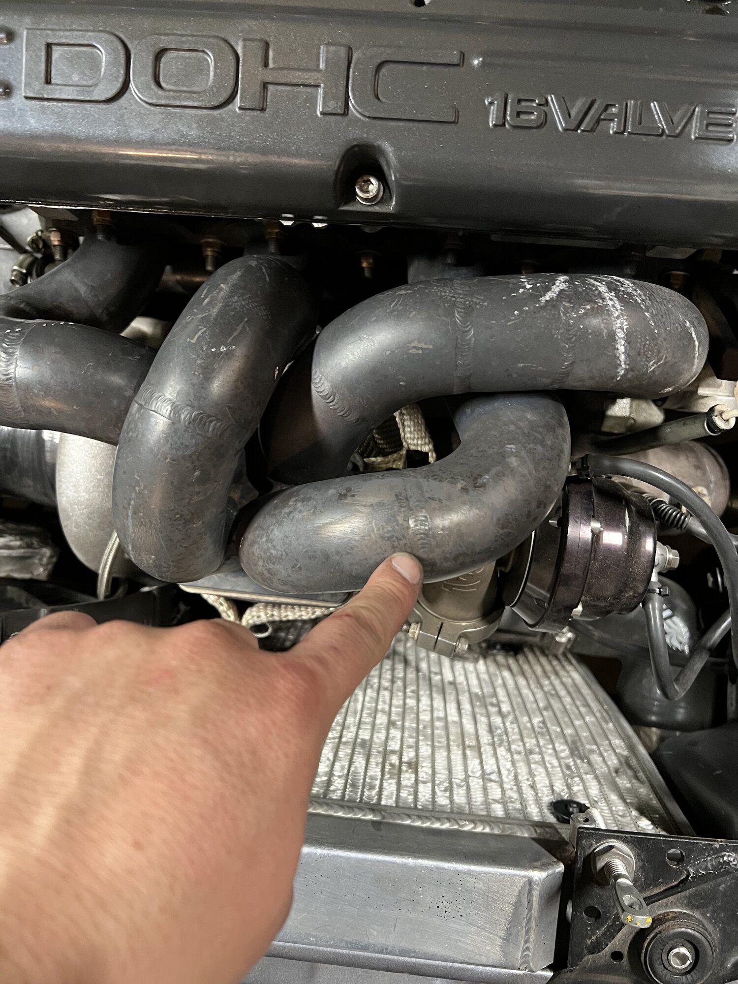

Latest update got a new manifold and super 99 from a good friend. At this time i don’t plan to swap turbos till i got some solid passes on this 6766.

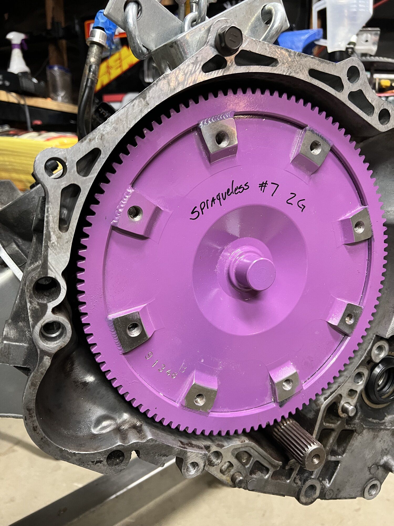

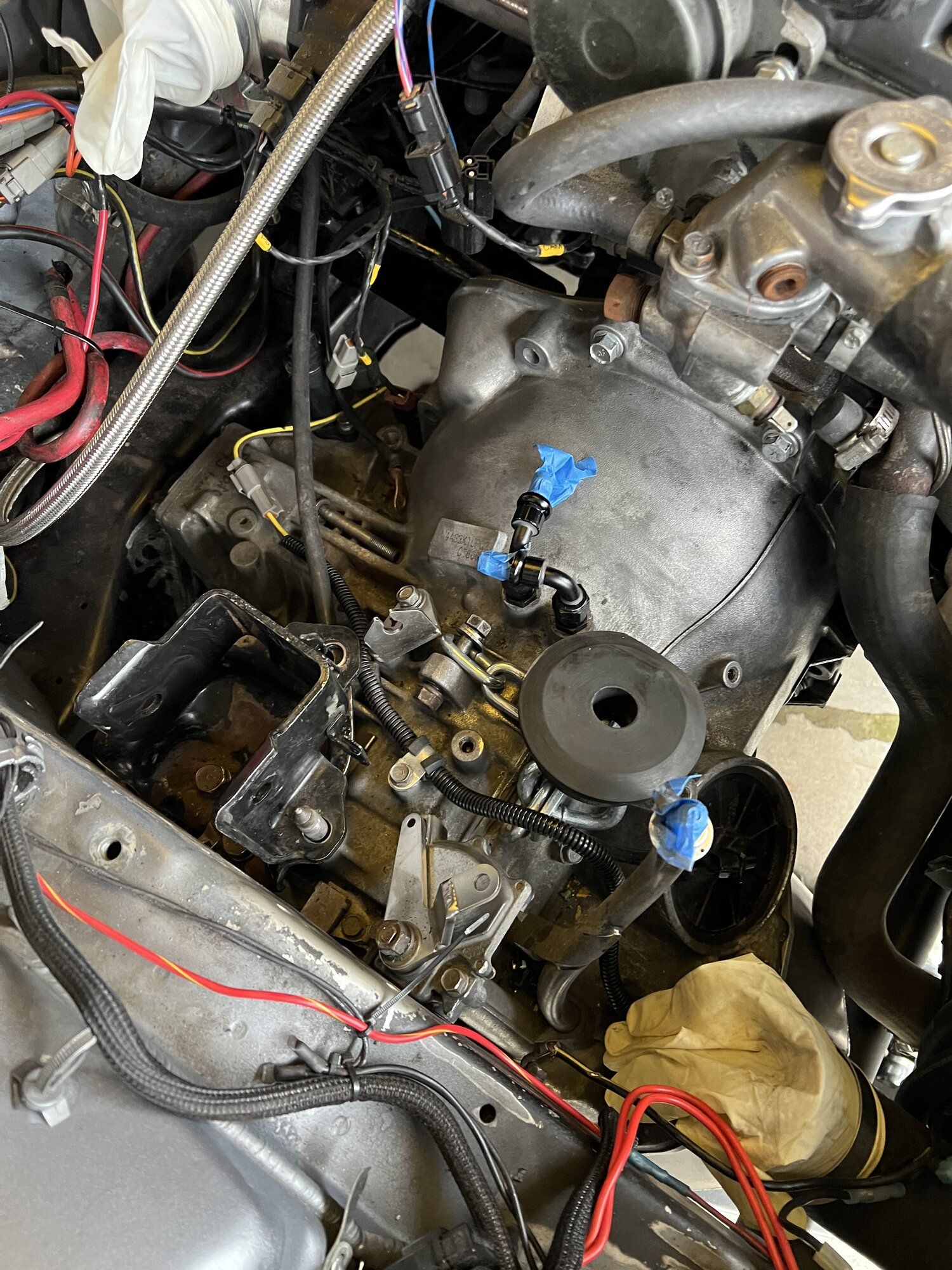

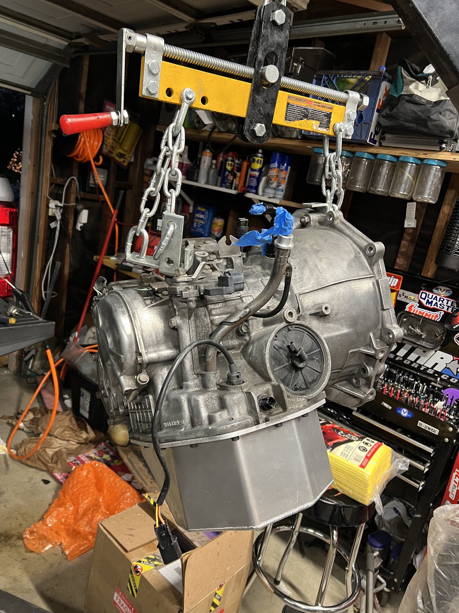

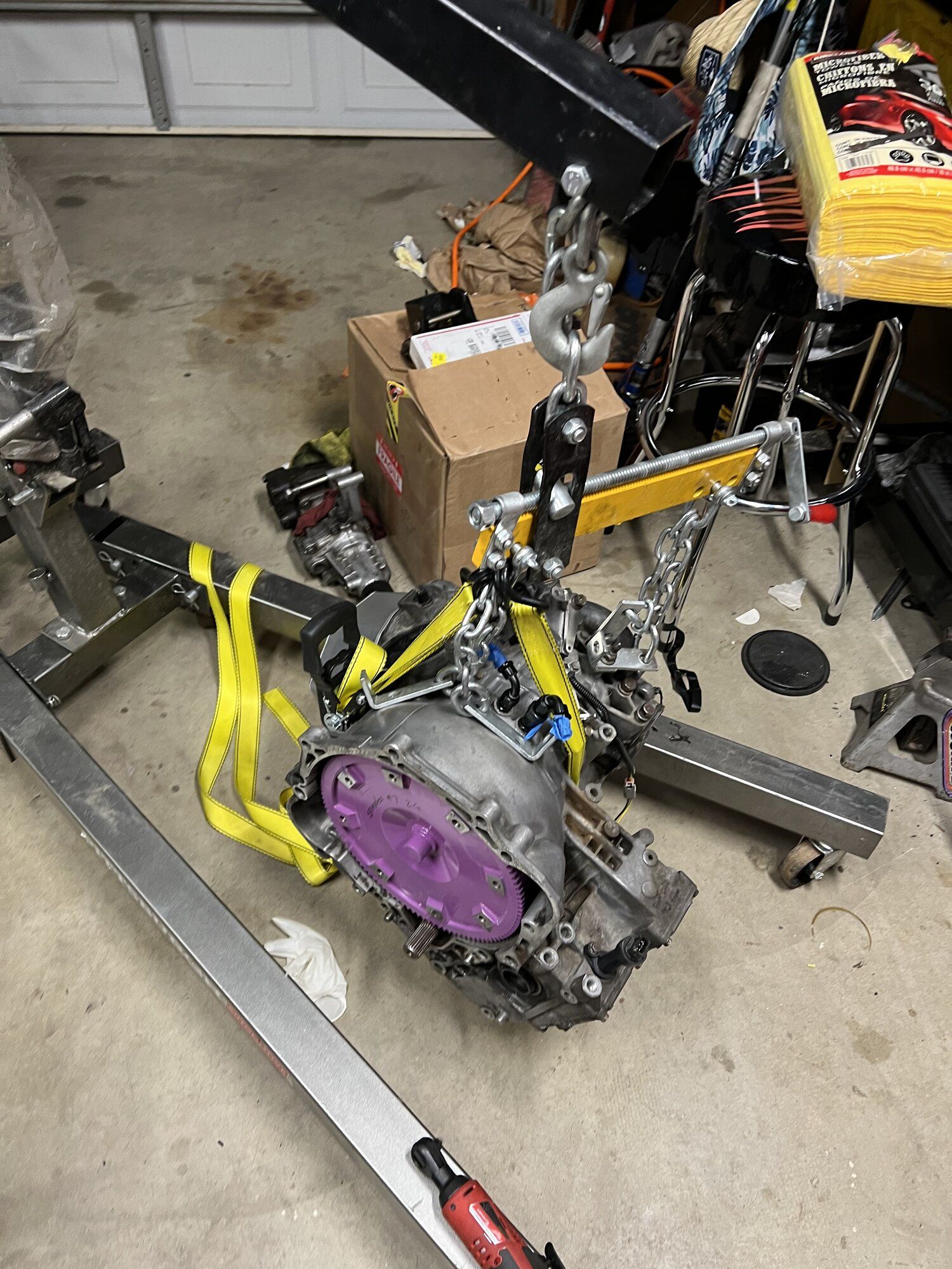

Made some progress I’ll do my best to explain
1 - got the trans got the Torque converter filled. Placed in the transmission
2 - with the hoist I guided the trans but needed to trim the frame rail more to clear the trans as the 2g trans is pushed more towards the passenger side
3- processed to bolt up the TC used red lock tie and torqued to 55 lbs.
4 axles in for 2g trans you need 2g half shaft driver axle from 1g. Passager axle from 2g non Abs axle that’s what i used.
I’ll post pictures tomorrow morning of the rail on 1990 cars you have to trim more than the other models. 1990 cars never came automatic. It was in option in 91+

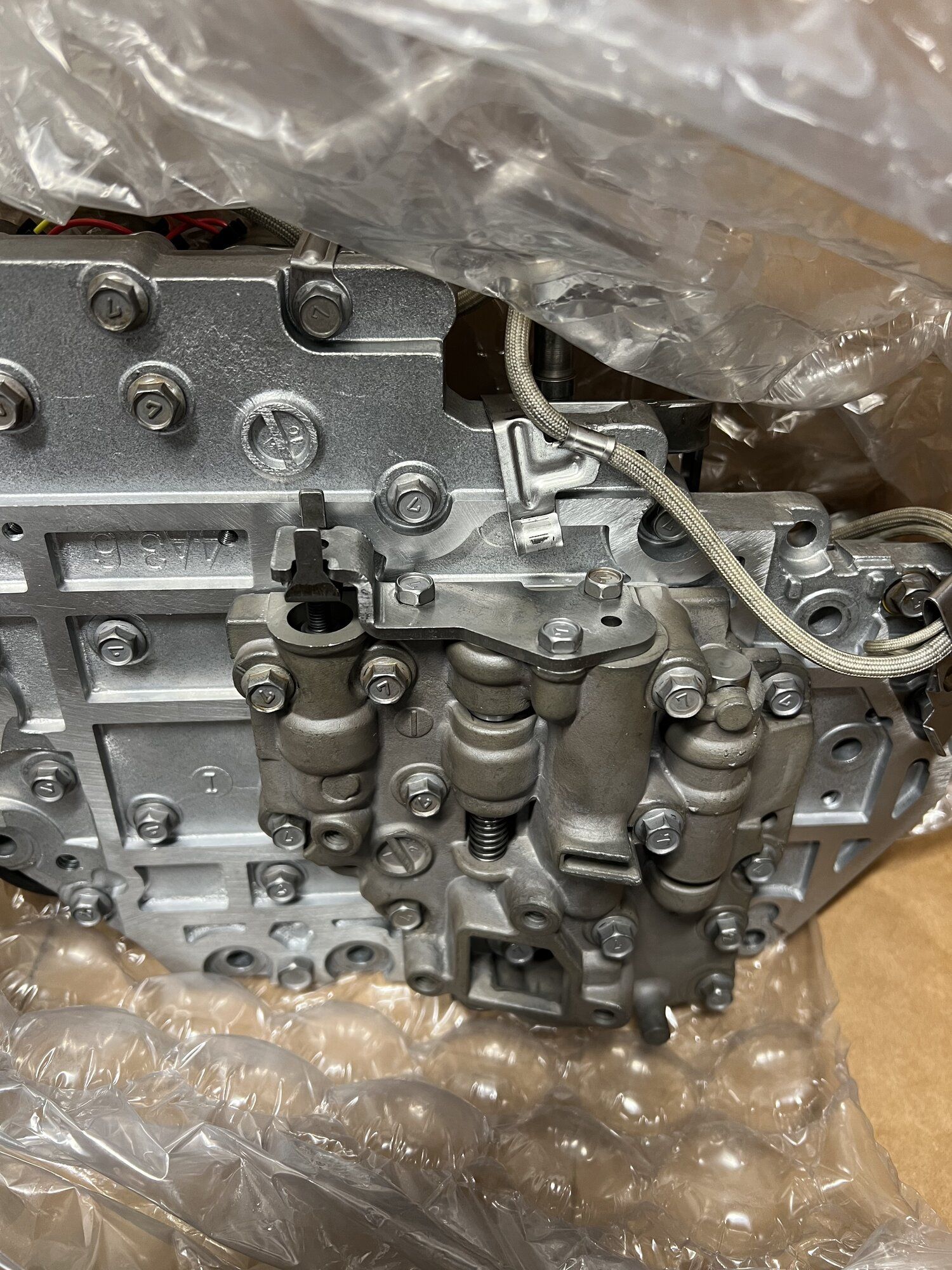

I got the car ready took it to the local track. When I stage and launch when shifting to second gear i got a flare up … I was like what’s going on …
Loaded up took it home … that was last Thursday

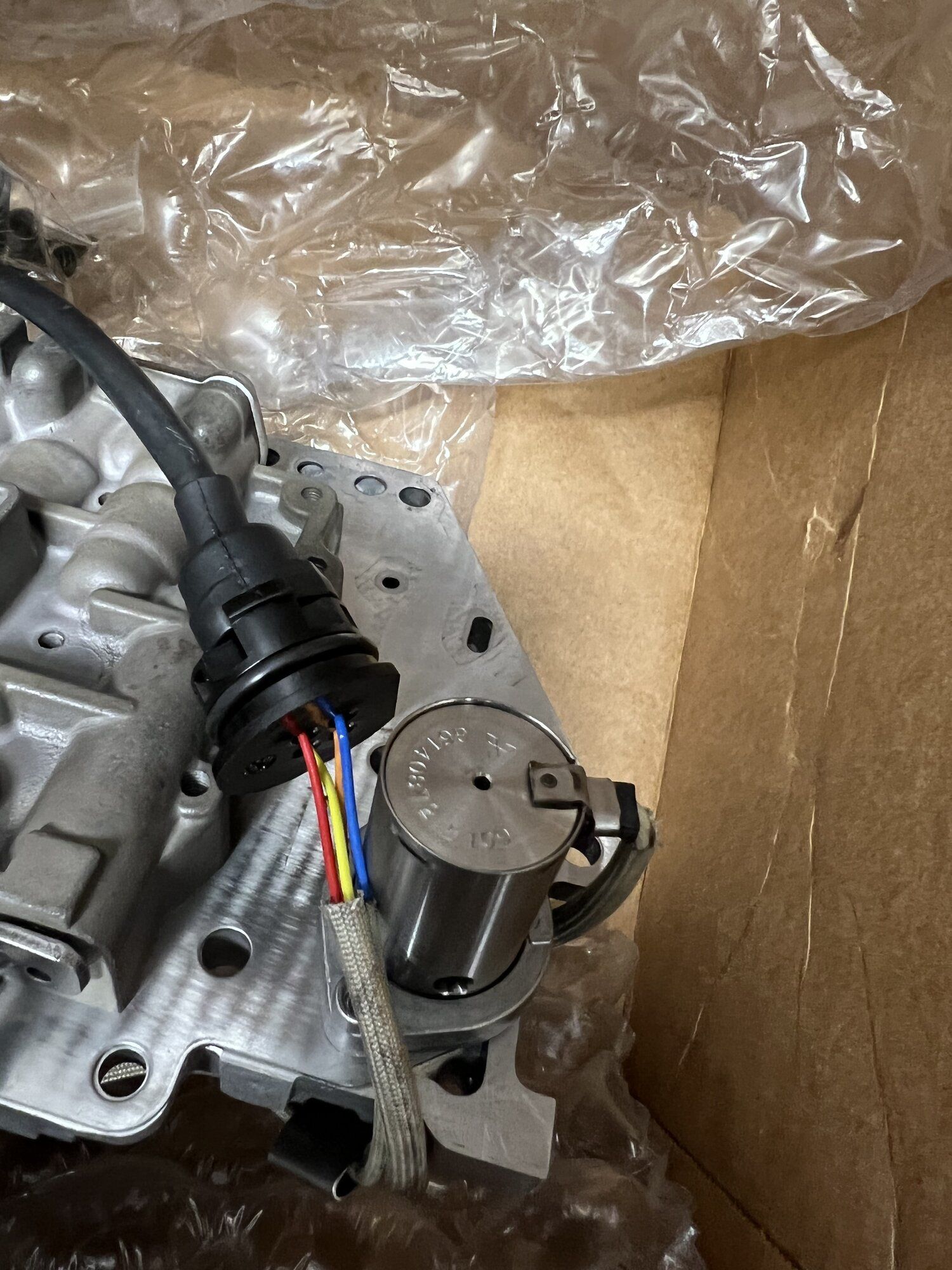

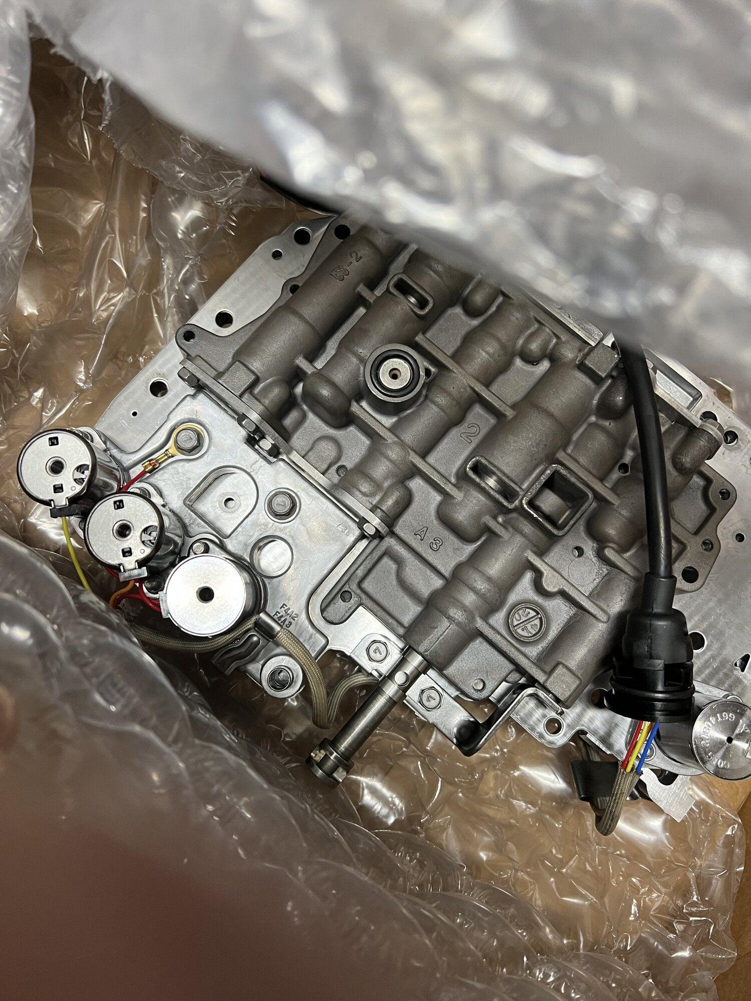

But on the following day after checking my work finding out I wired the silanoids backwards 🤦🏻‍♂️

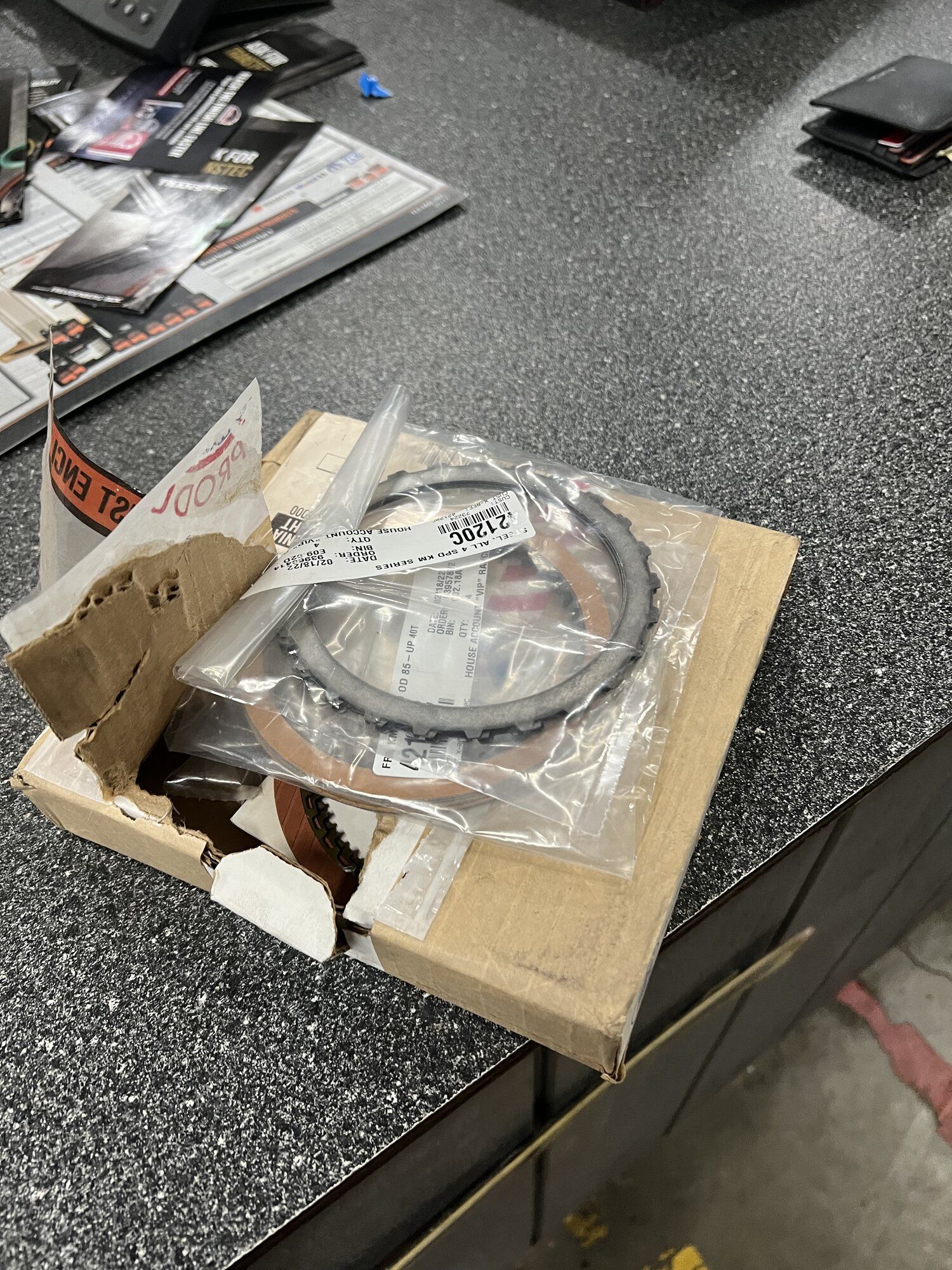

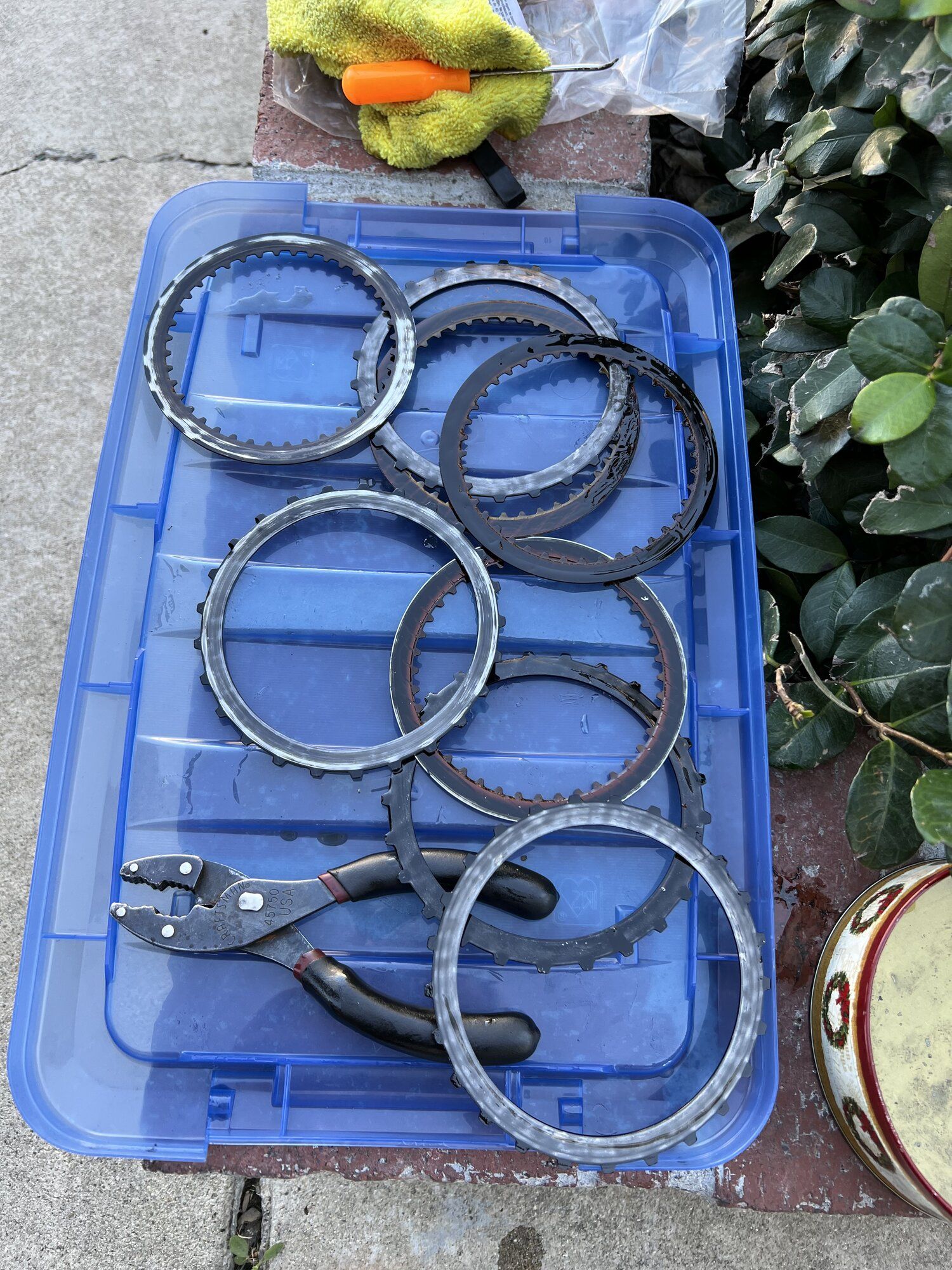

Corrected the wiring and figured out I went to 1st to 4th 🥴🥴🥴. Checked the end clutches changed them on the fly went for the test hit on Saturday (the video posted earlier)
Now is correctly shifting as it should !
Let me tell you, that was VERY SMART on your part to go ahead and change the OD pack. I keep a few sets on hand.

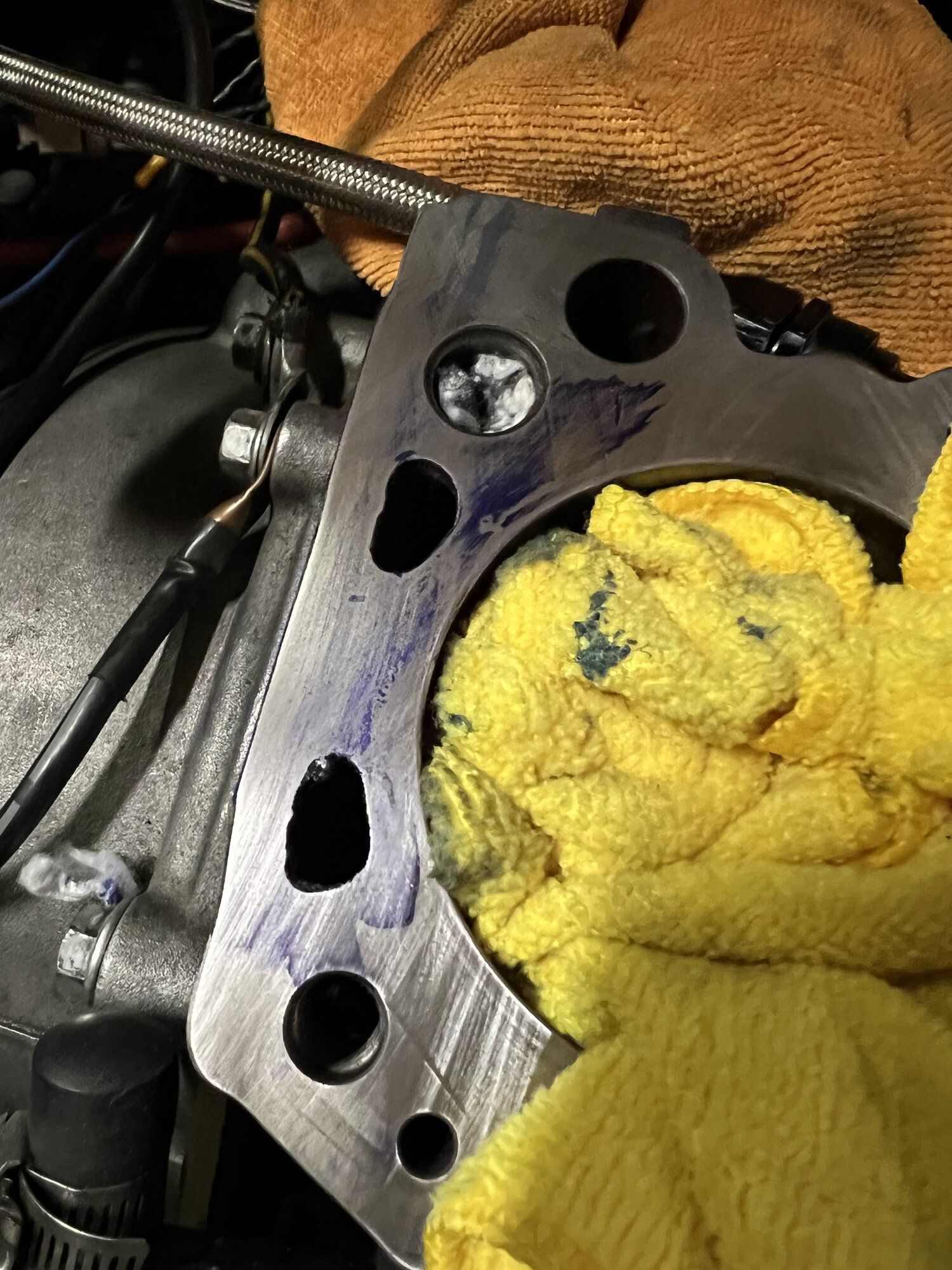

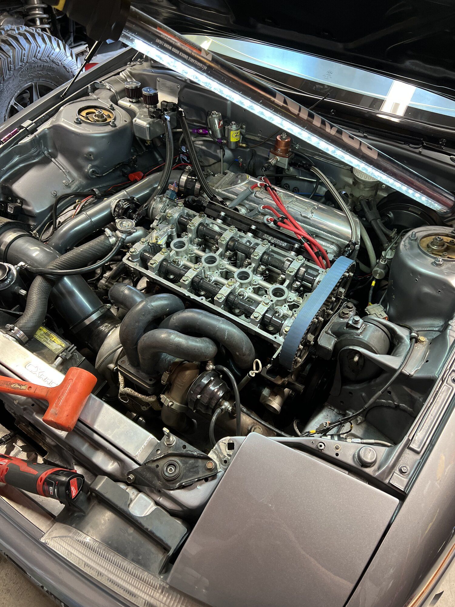

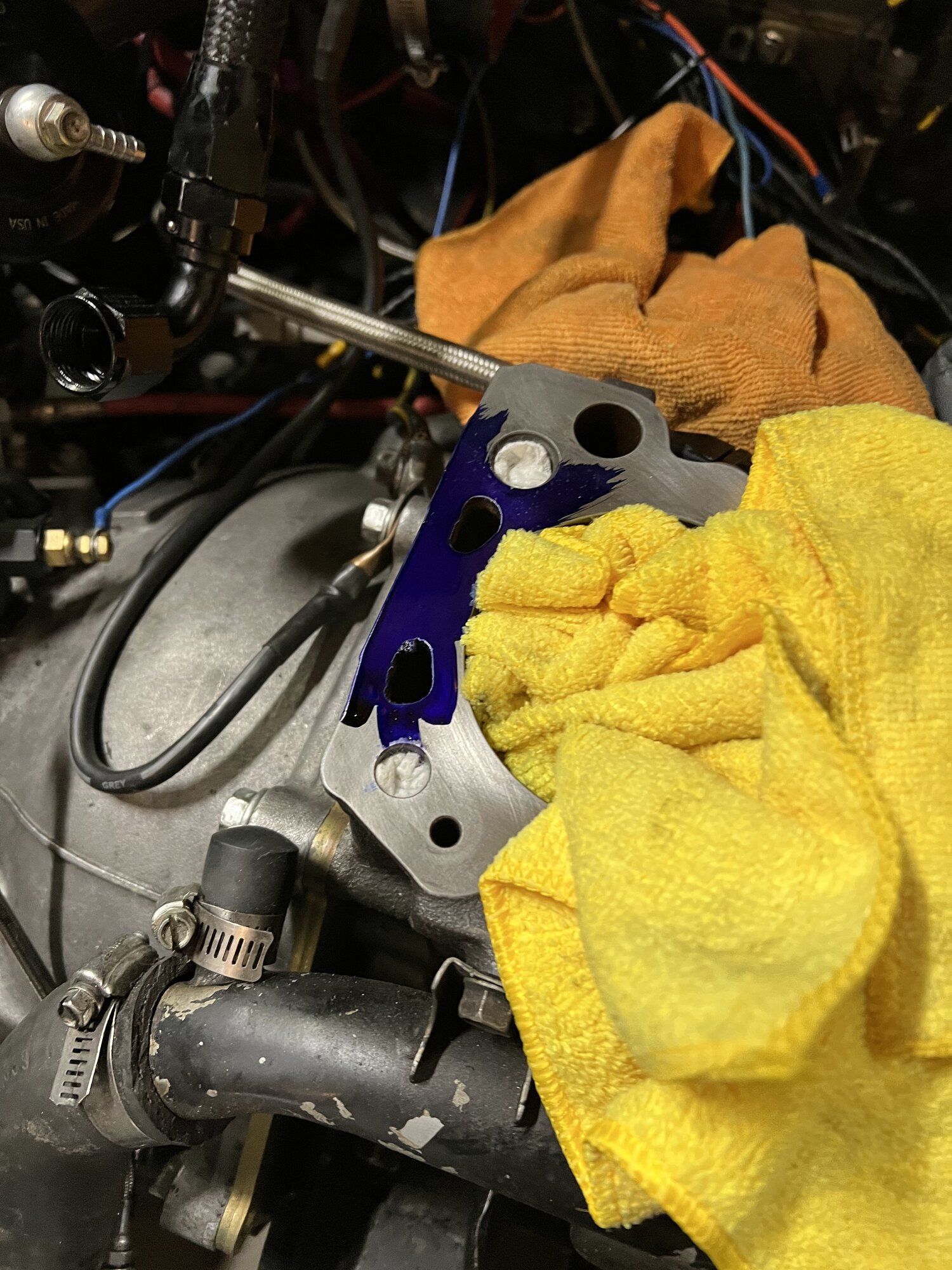

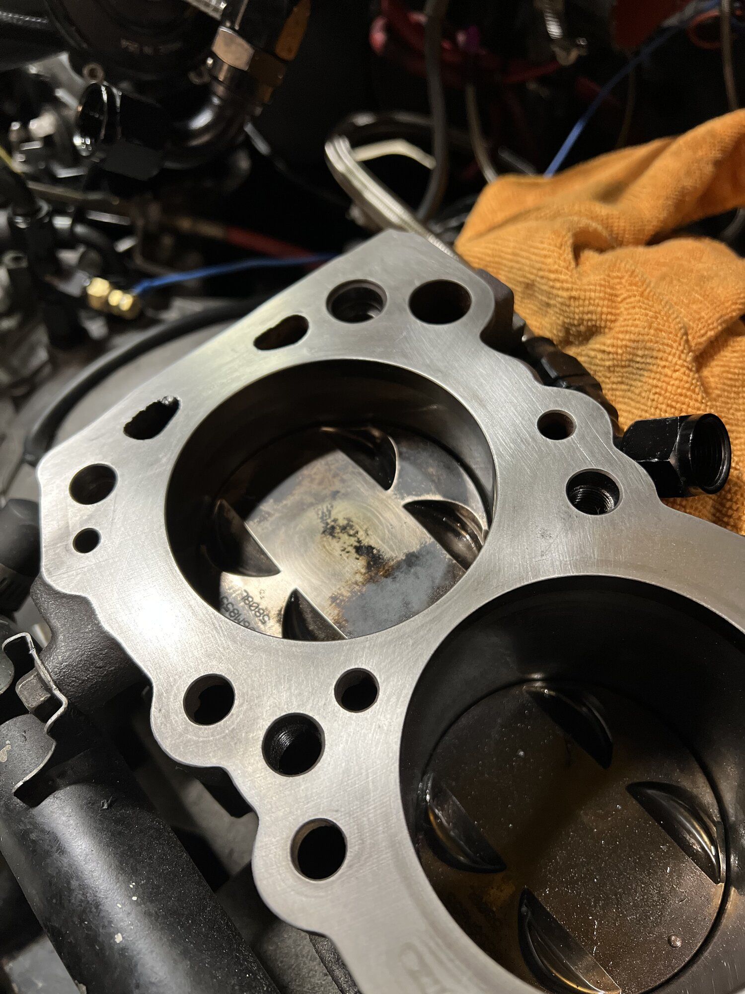

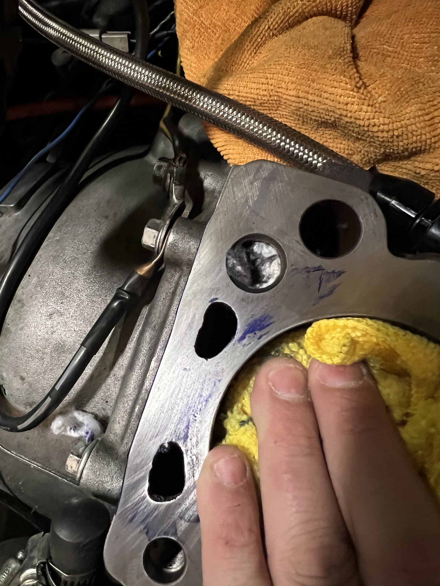

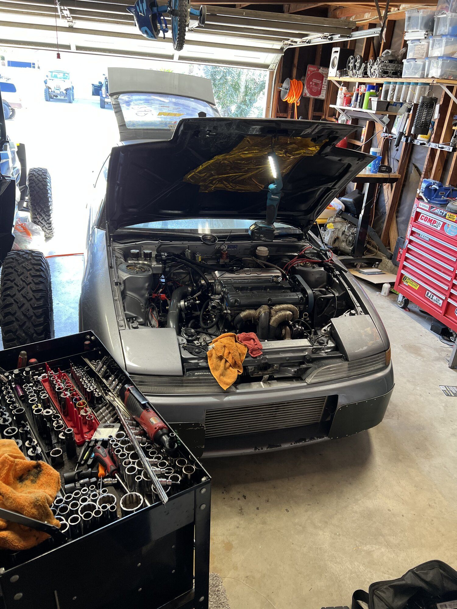

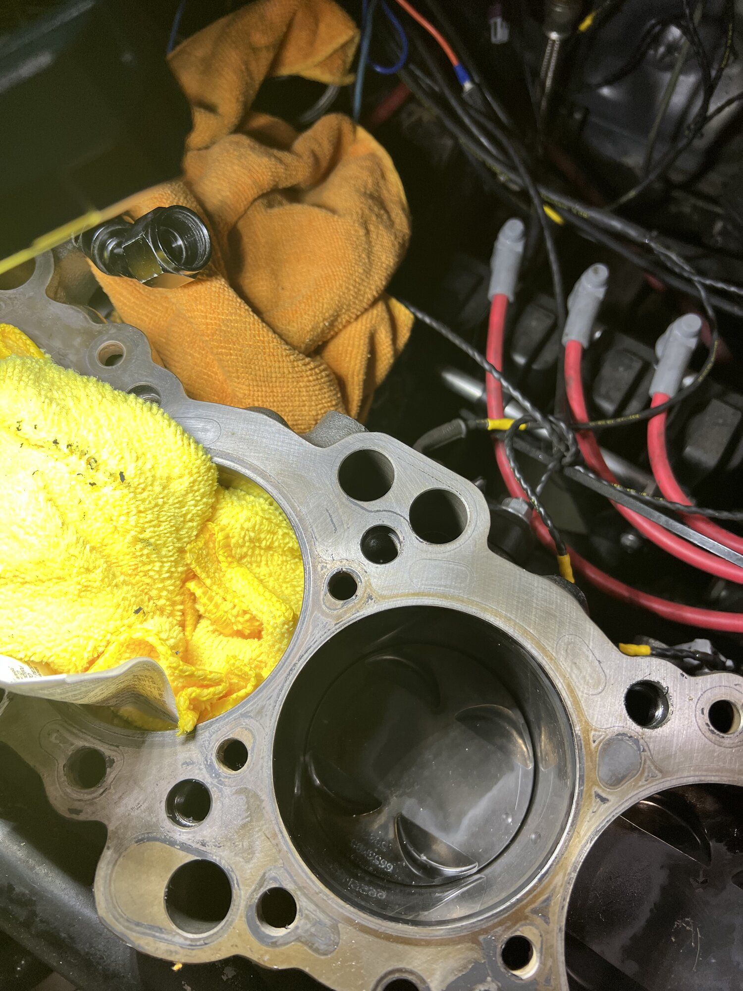

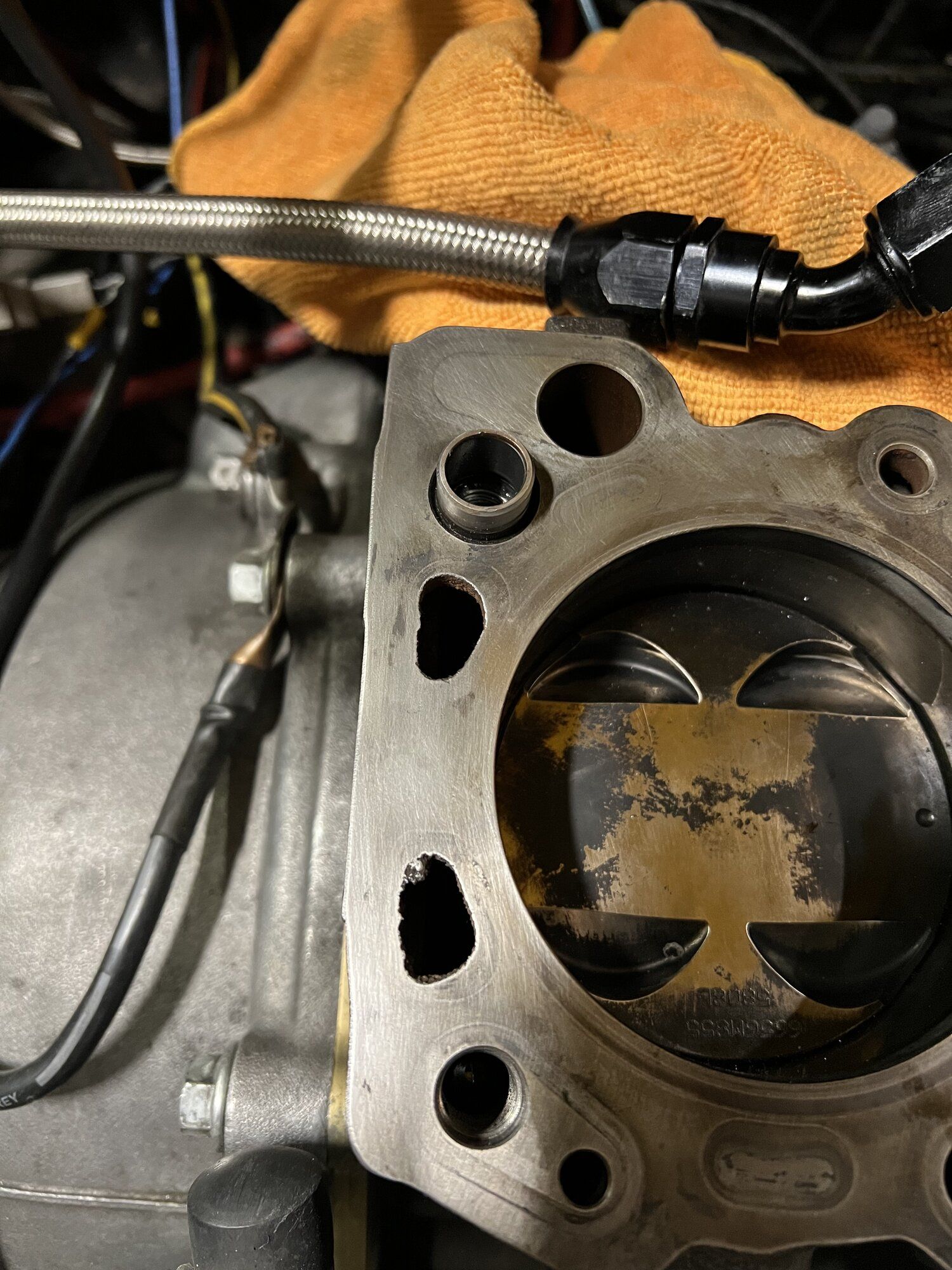

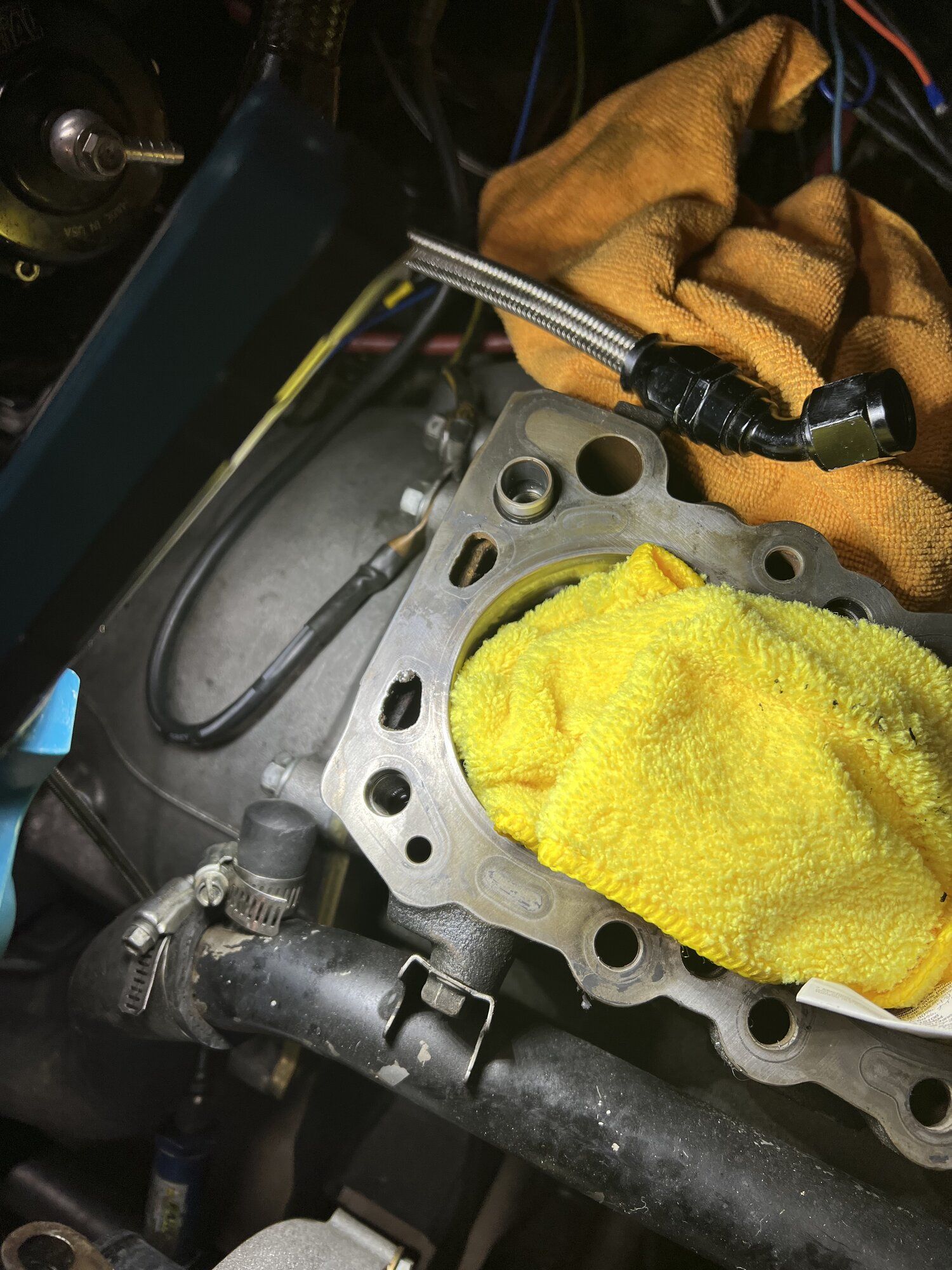

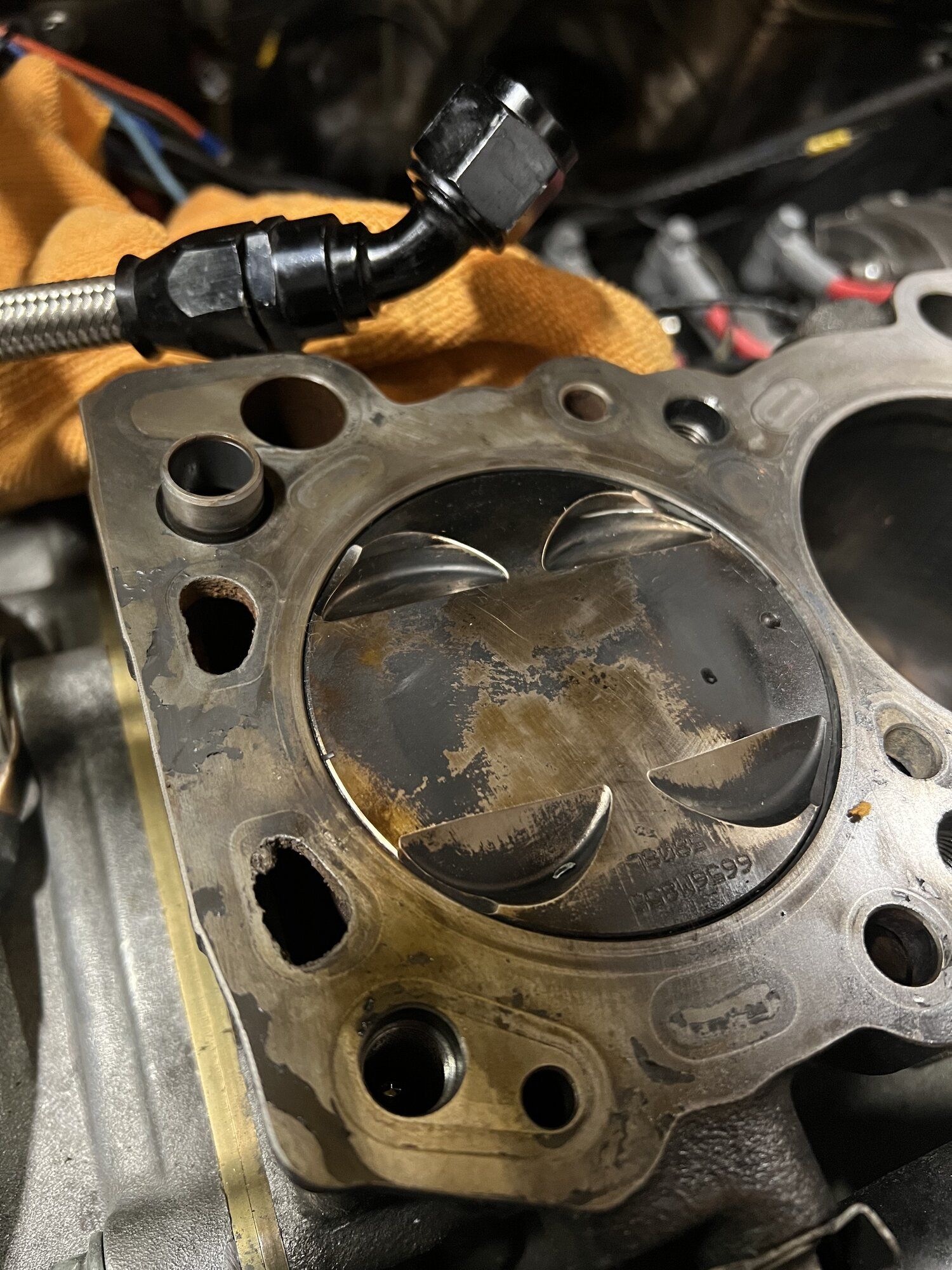

Working on making sure there is not low spots and prepared the surfaces deck.
Thanks to a fell dsmtuner from Los Angeles @Phardo I was able to get an HKS gasket in the 1.6 mm and new Gates blue belt !
I like those 10:1's Frank. :)
Do you feel comfortable with the deck surface?
