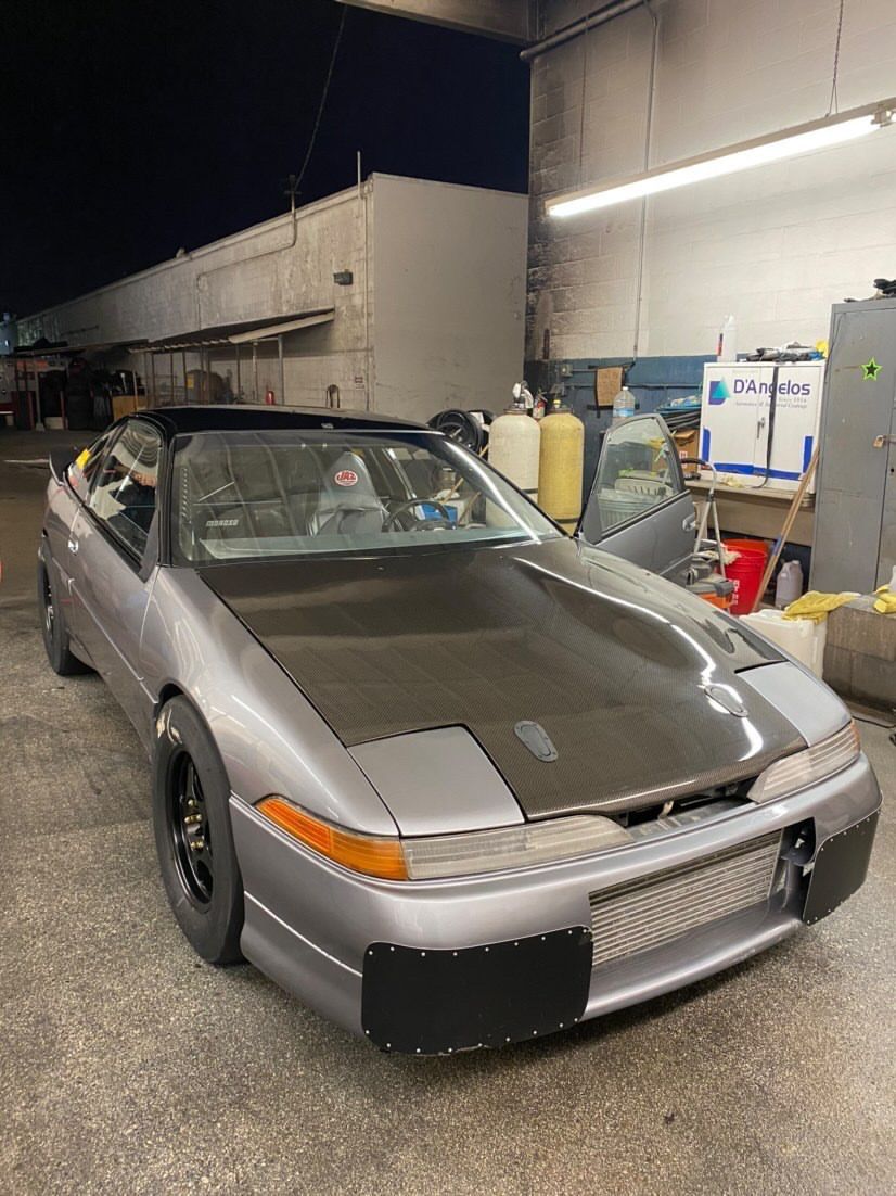

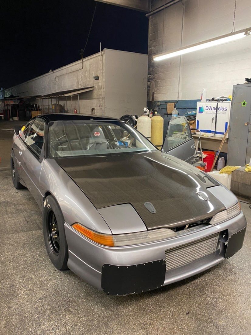

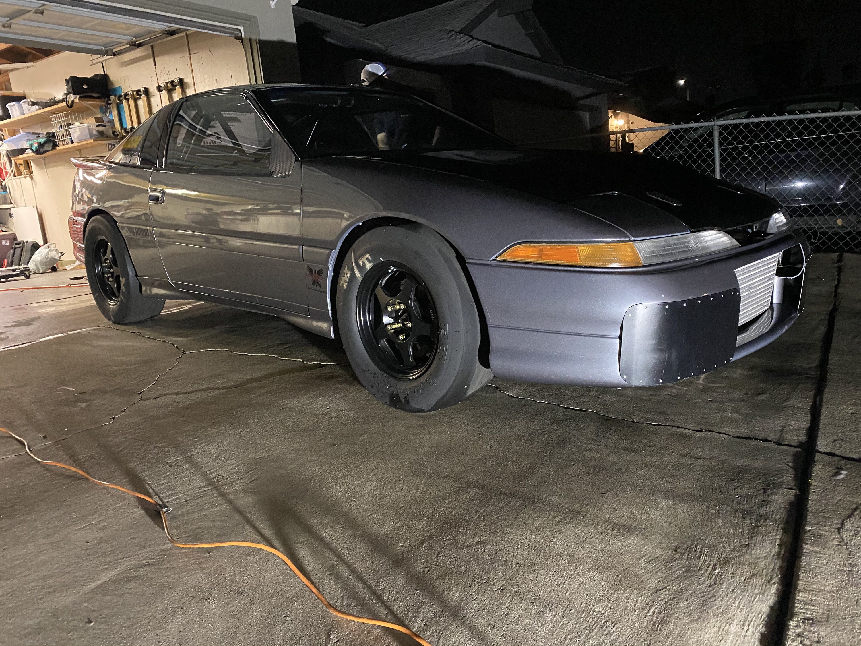

Awdmonster drag car
They used to be a street car but now I'm turning it into a dedicated drag car

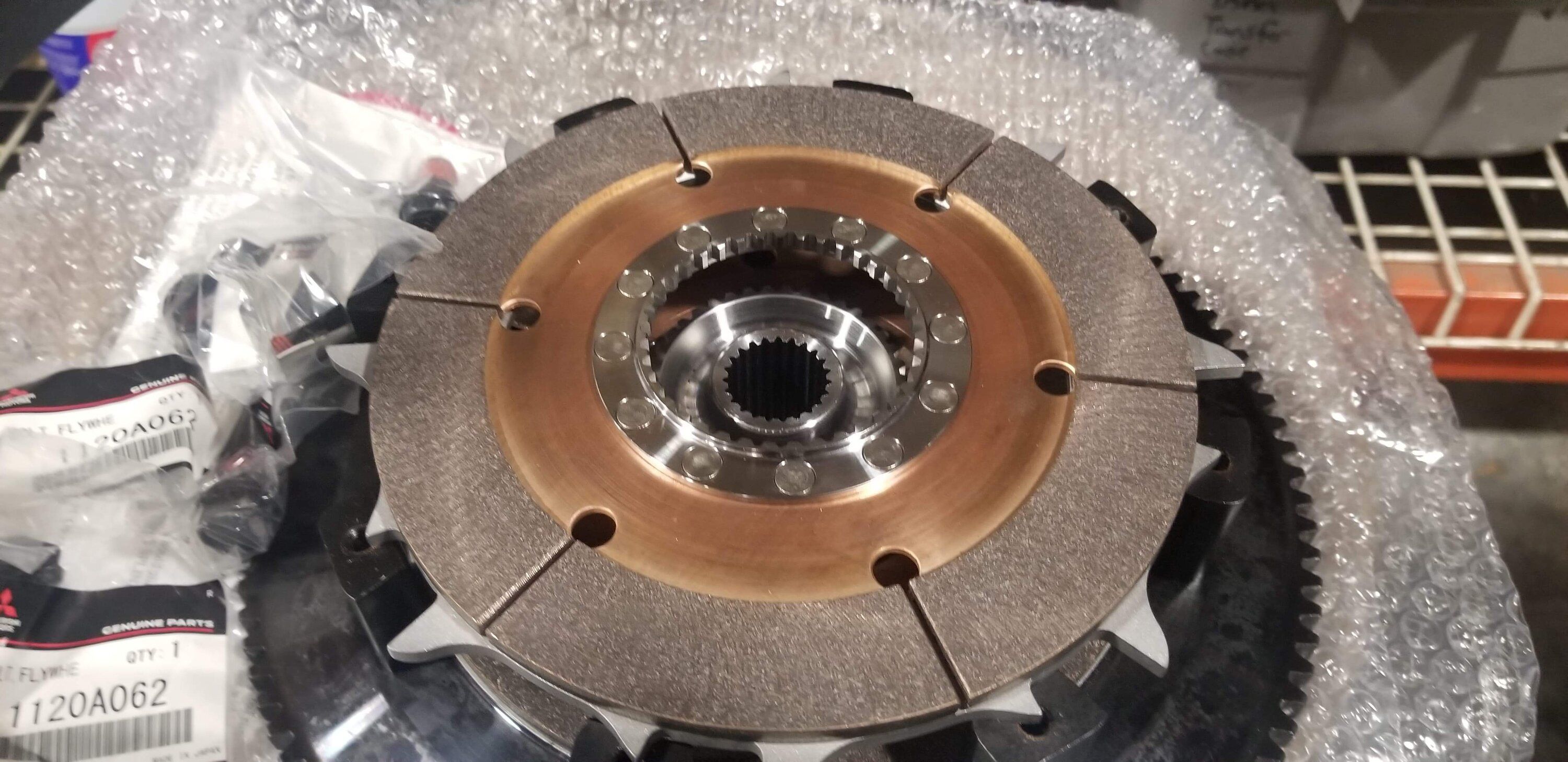

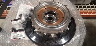

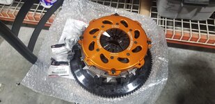

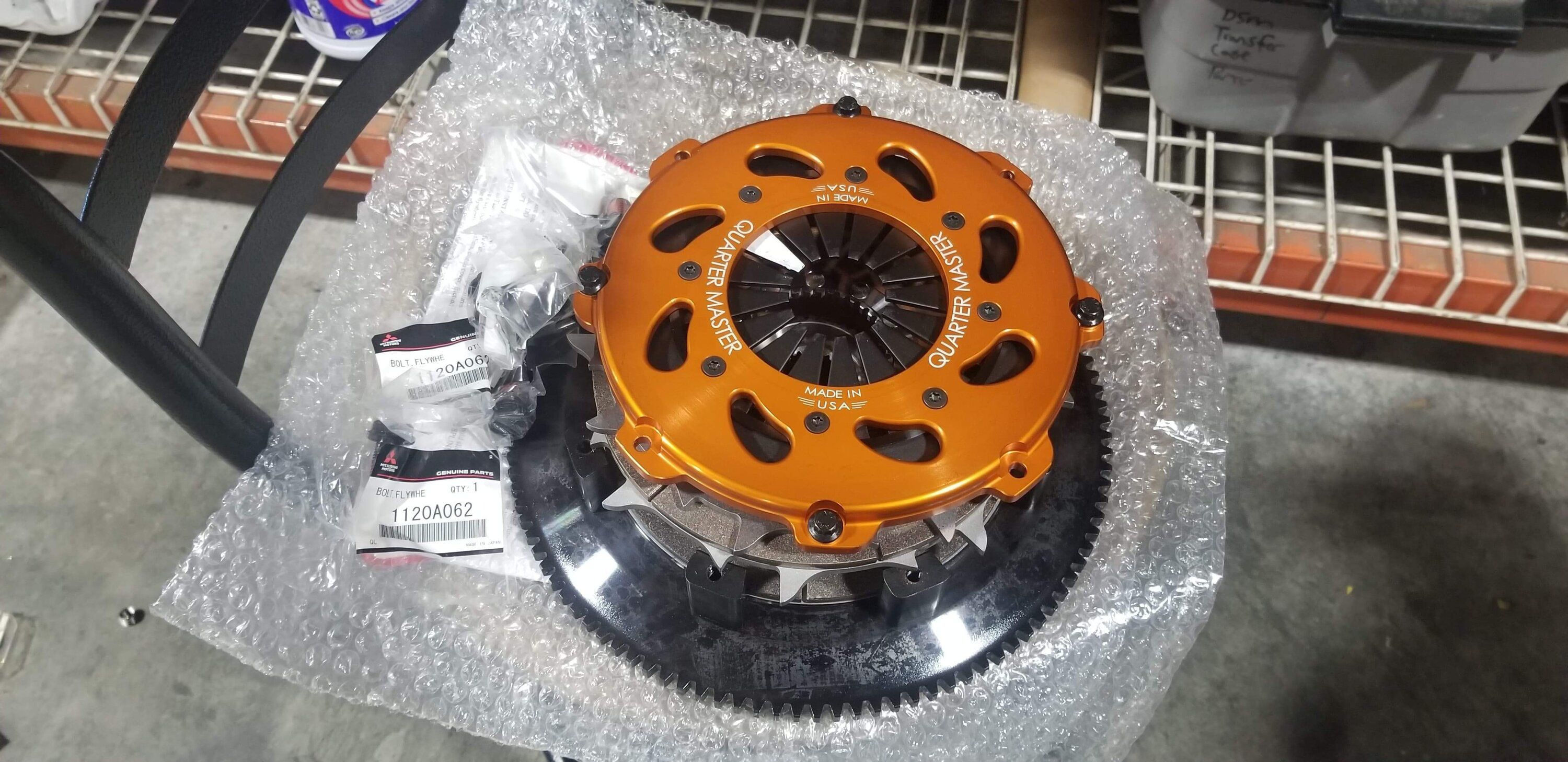

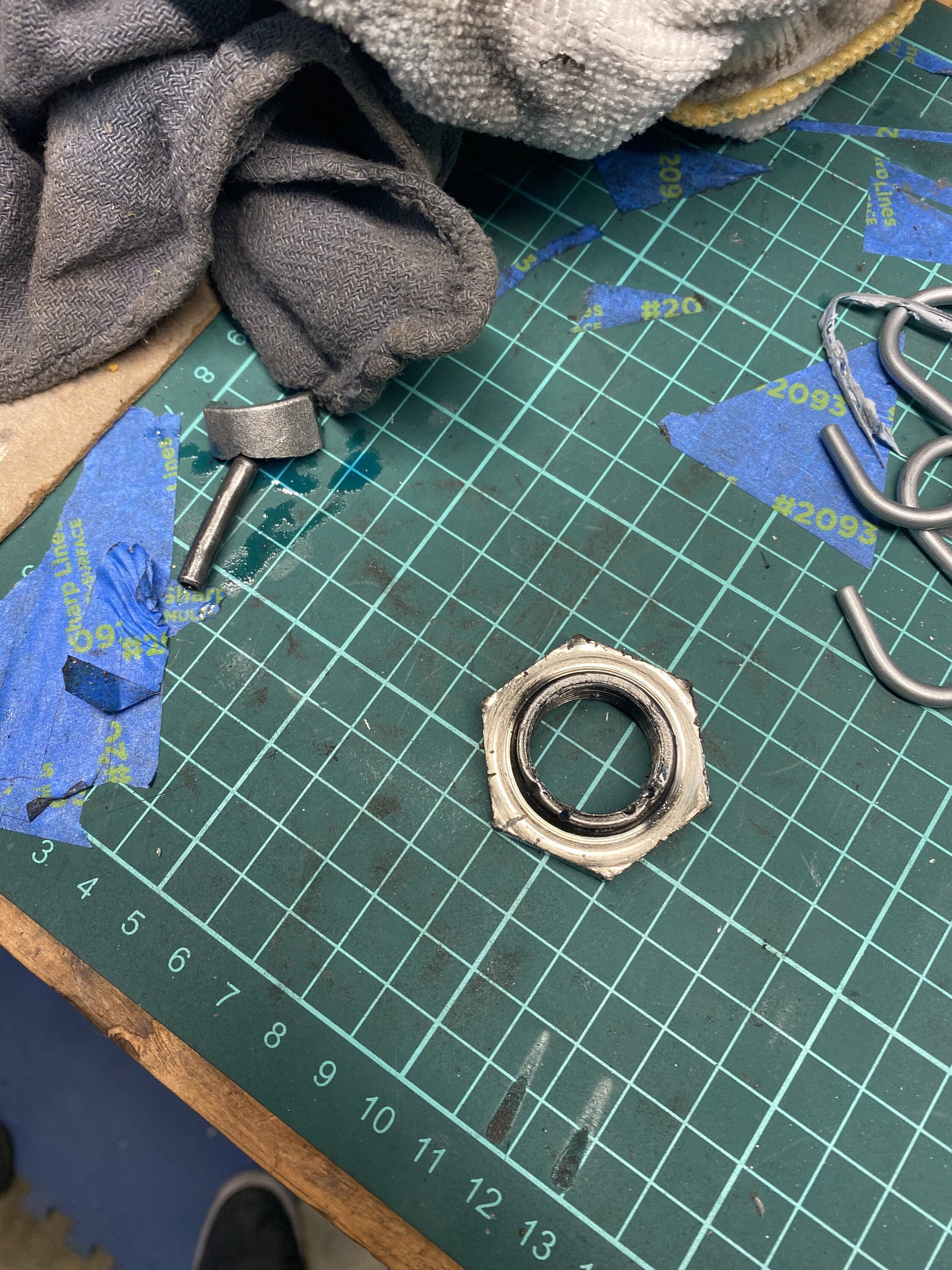

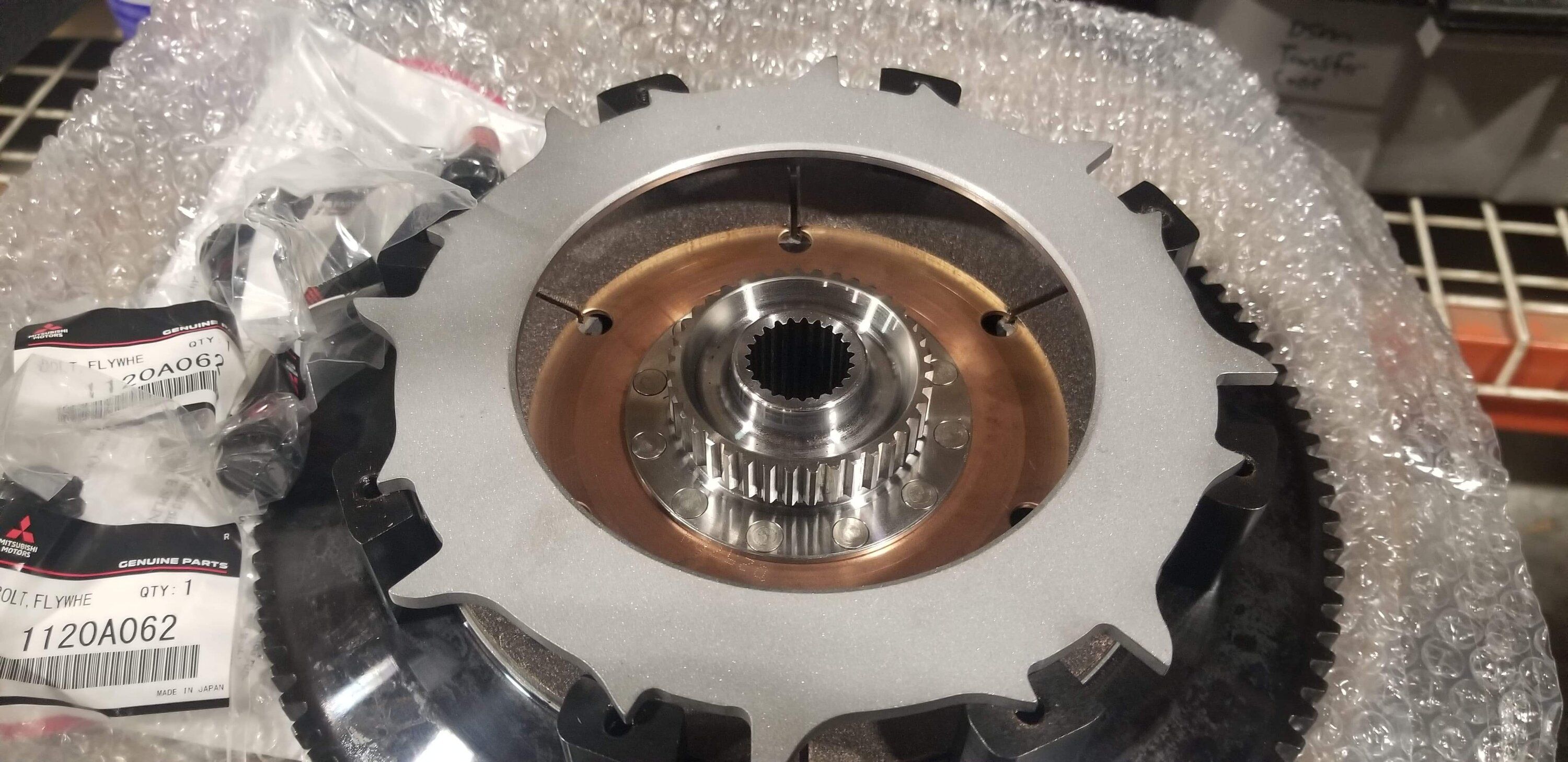

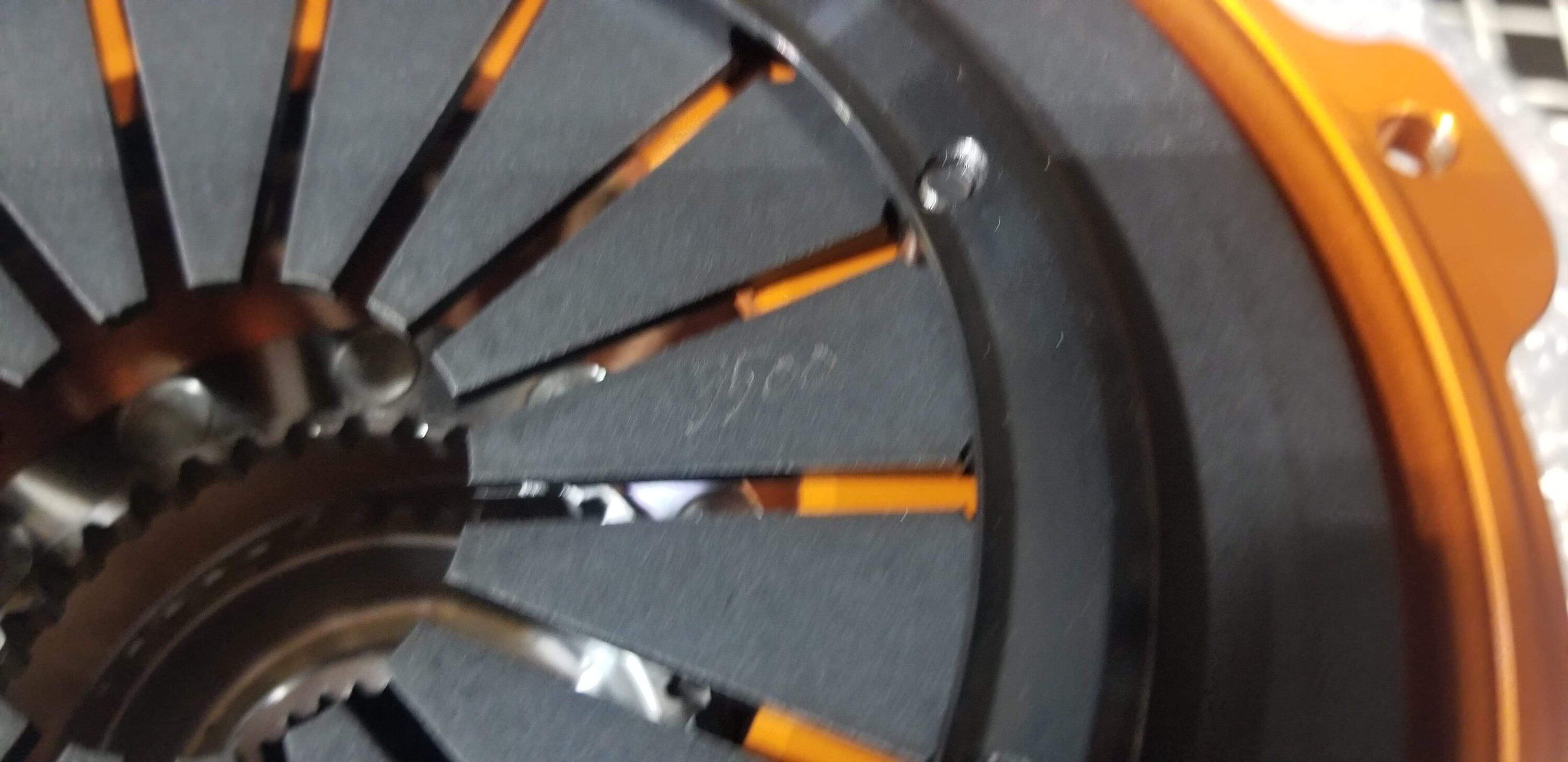

Update ** got a chance to break in the clutch ran in to some issues with my KDN shifter later realized some bolts were coming loose . Finally after some research watching a few videos got the lock out adjusted.
Also had a violent shake rebalance the slicks and all fixed with some fresh hu centric rings.
Did not get any passes I broke on the first pass and that’s the only part I did not bring with me to the track so I decided to call it a day and come back on the next event

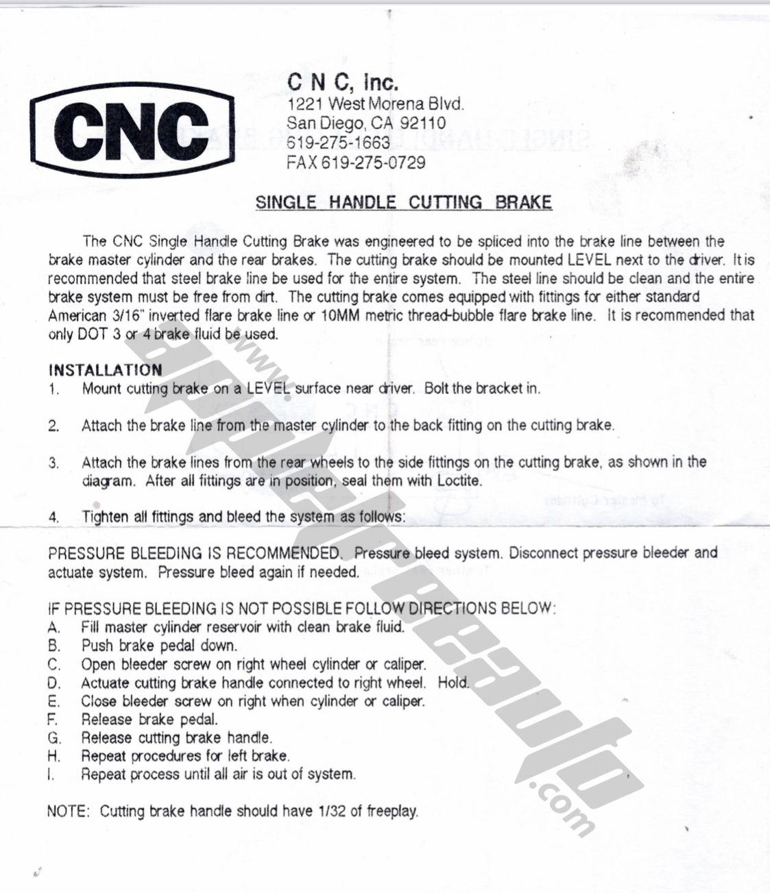

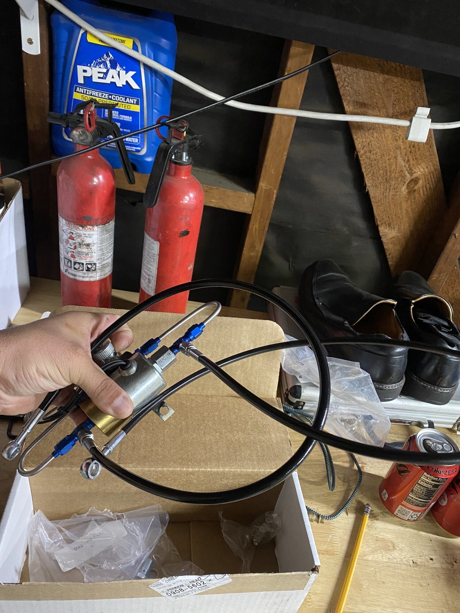

Today doing maintenance realizing that I had a lot of air in the brakes. Posted a picture of instructions how to bleed it with a stage brake. Maybe I’ll do a write up how to bleed it might help others. Took me a while to figure out until I had these instructions.

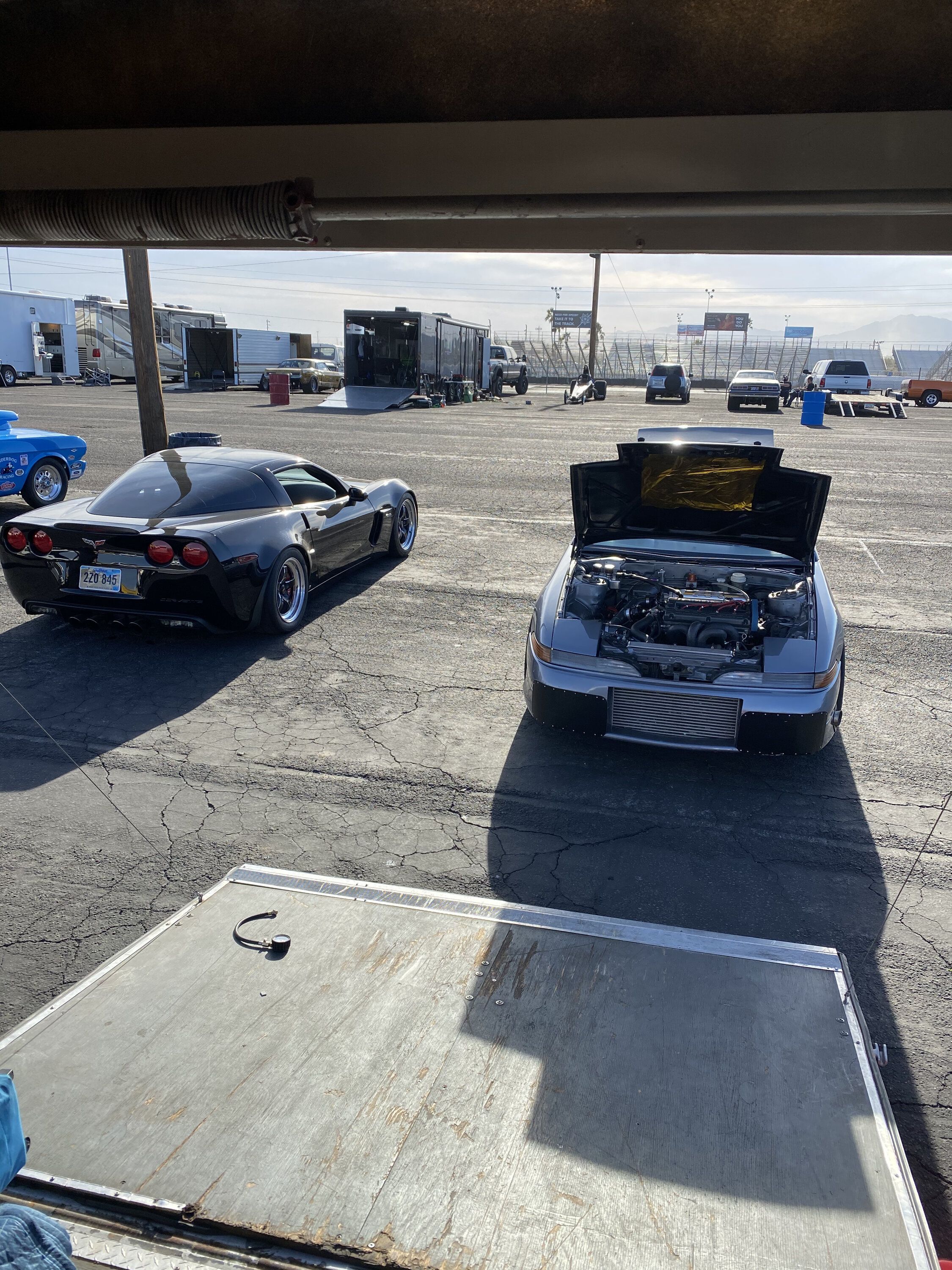

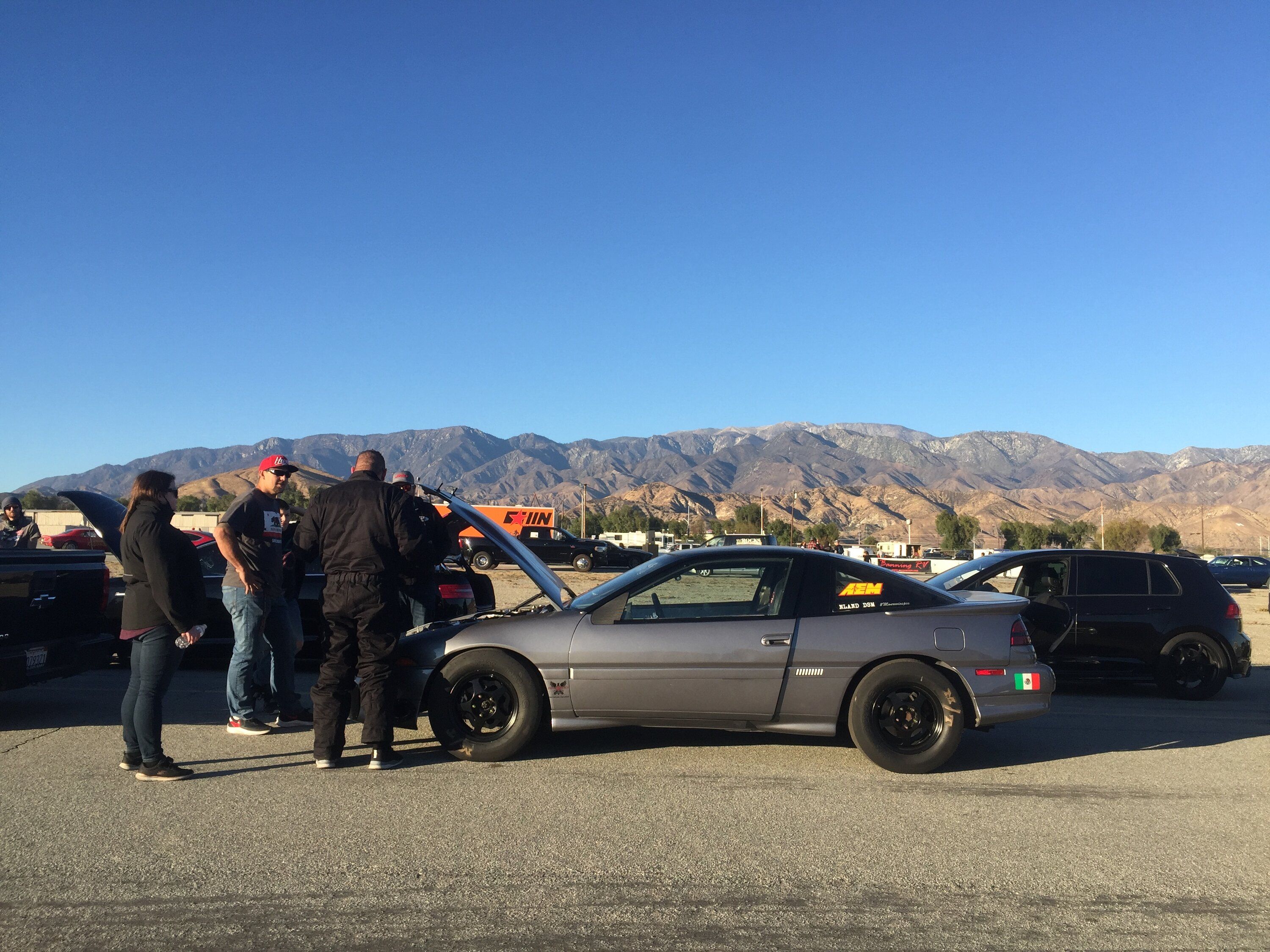

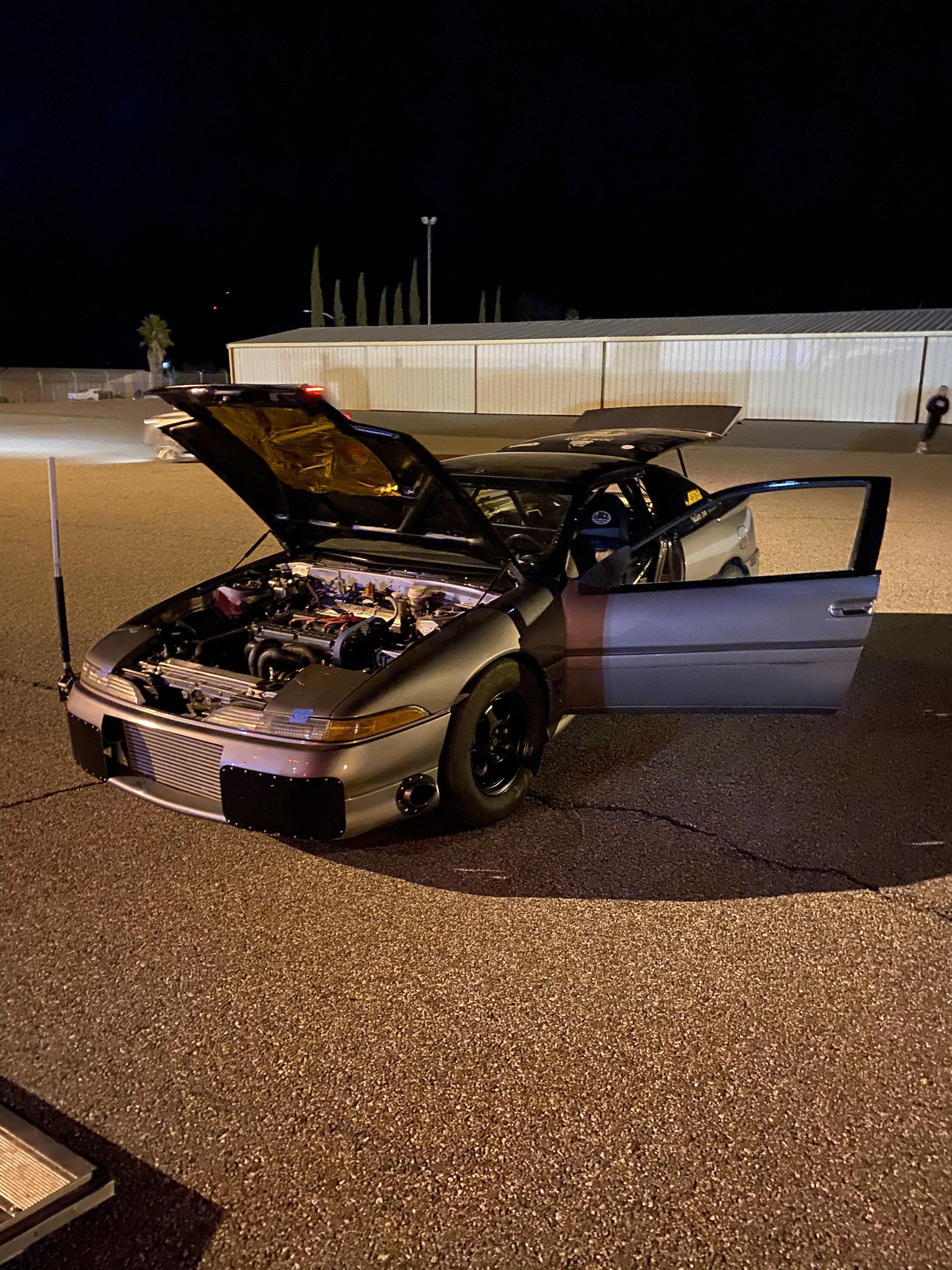

Last weekend decided to go to Arizona since every track here in California is restricted or closed.
It’s was rough again breaking on the first pass

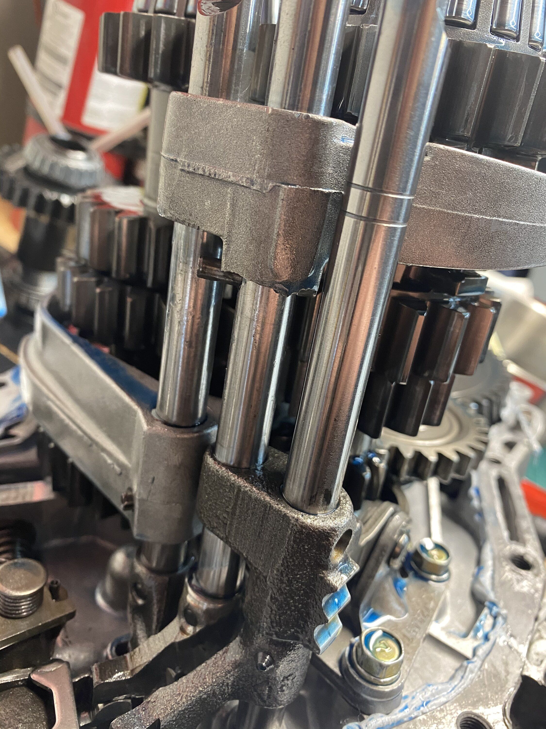

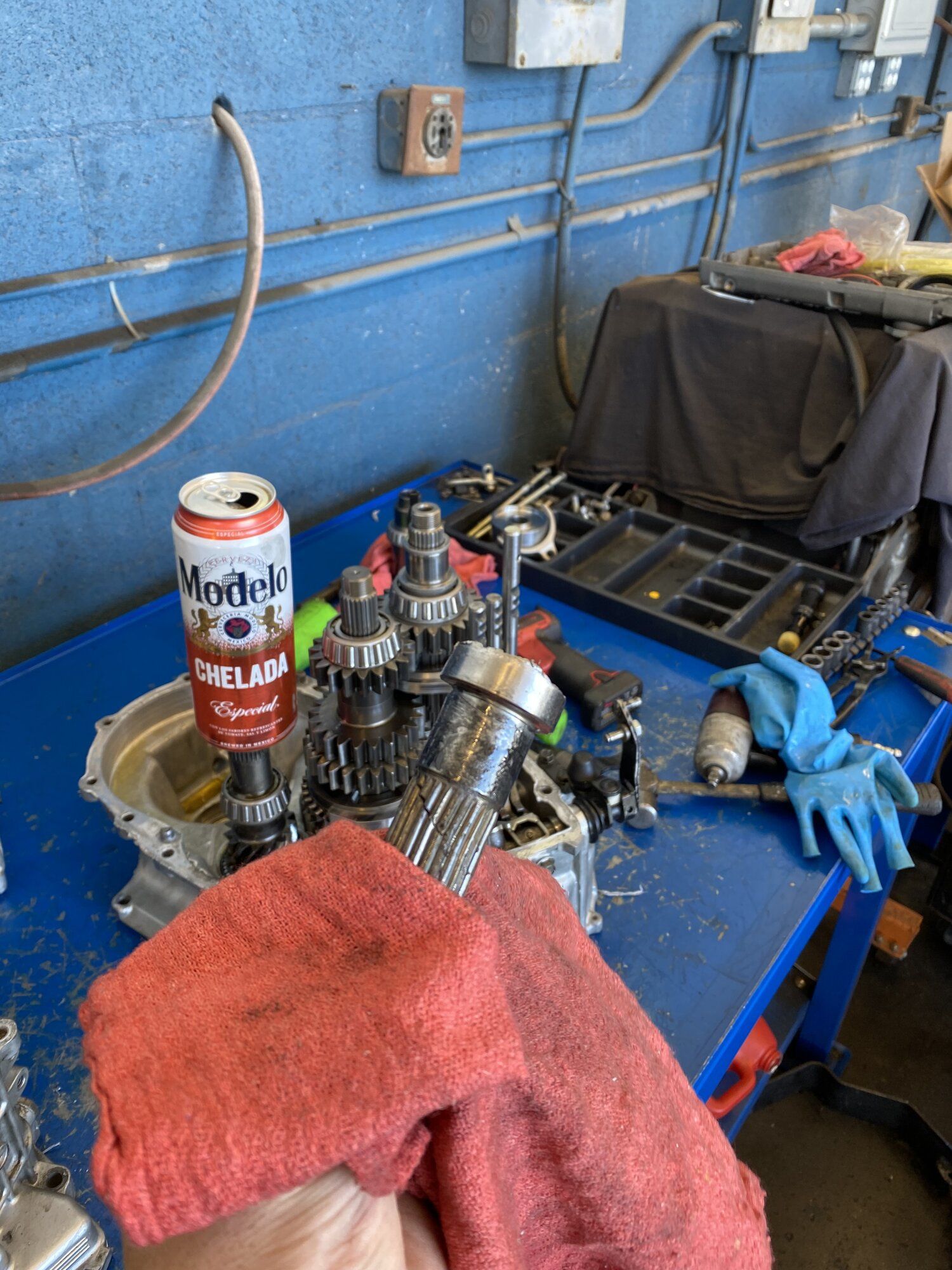

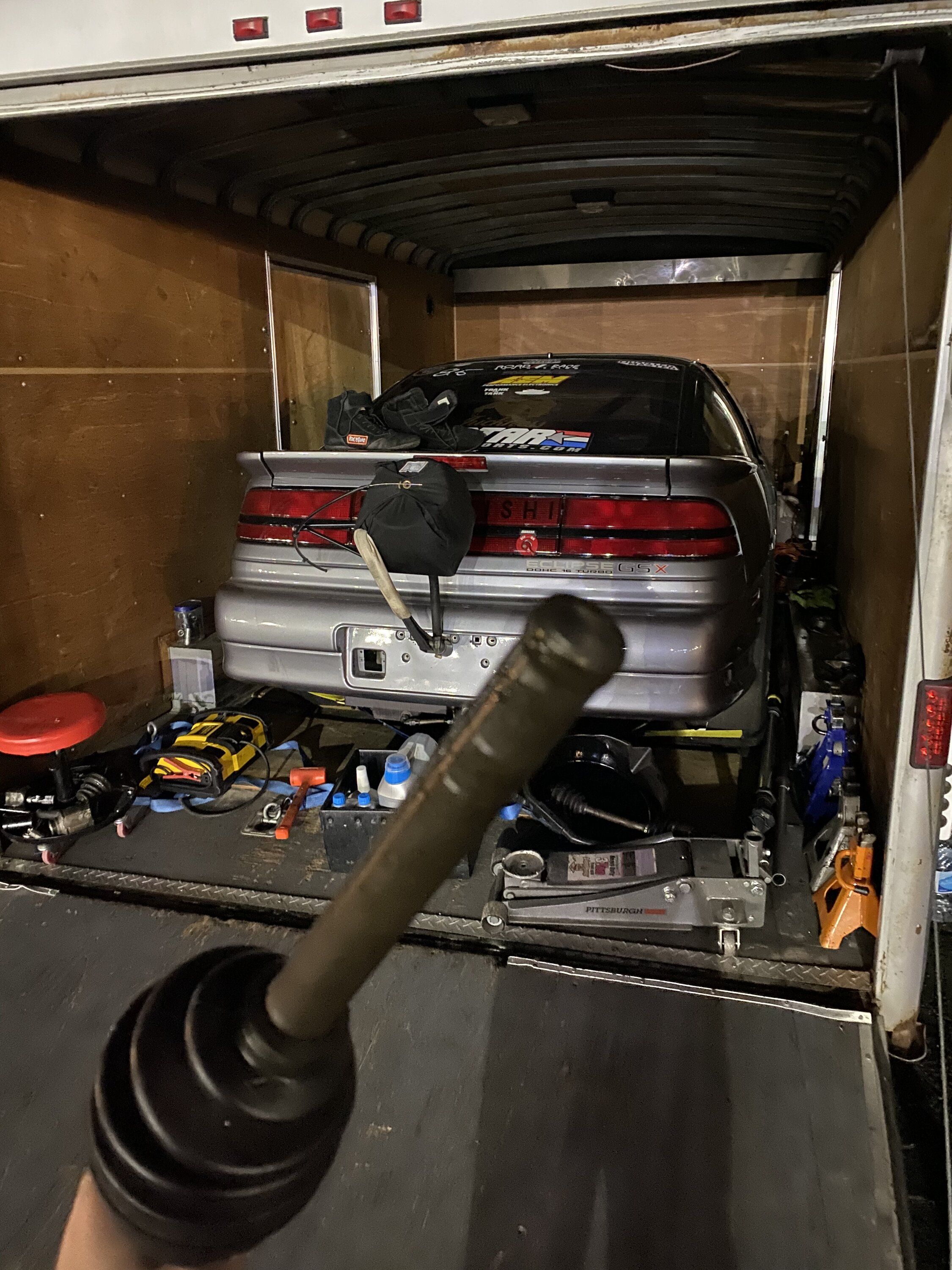

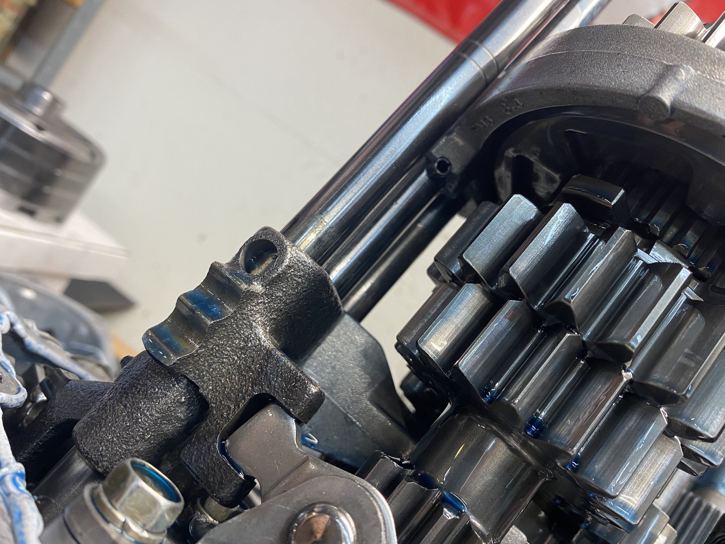

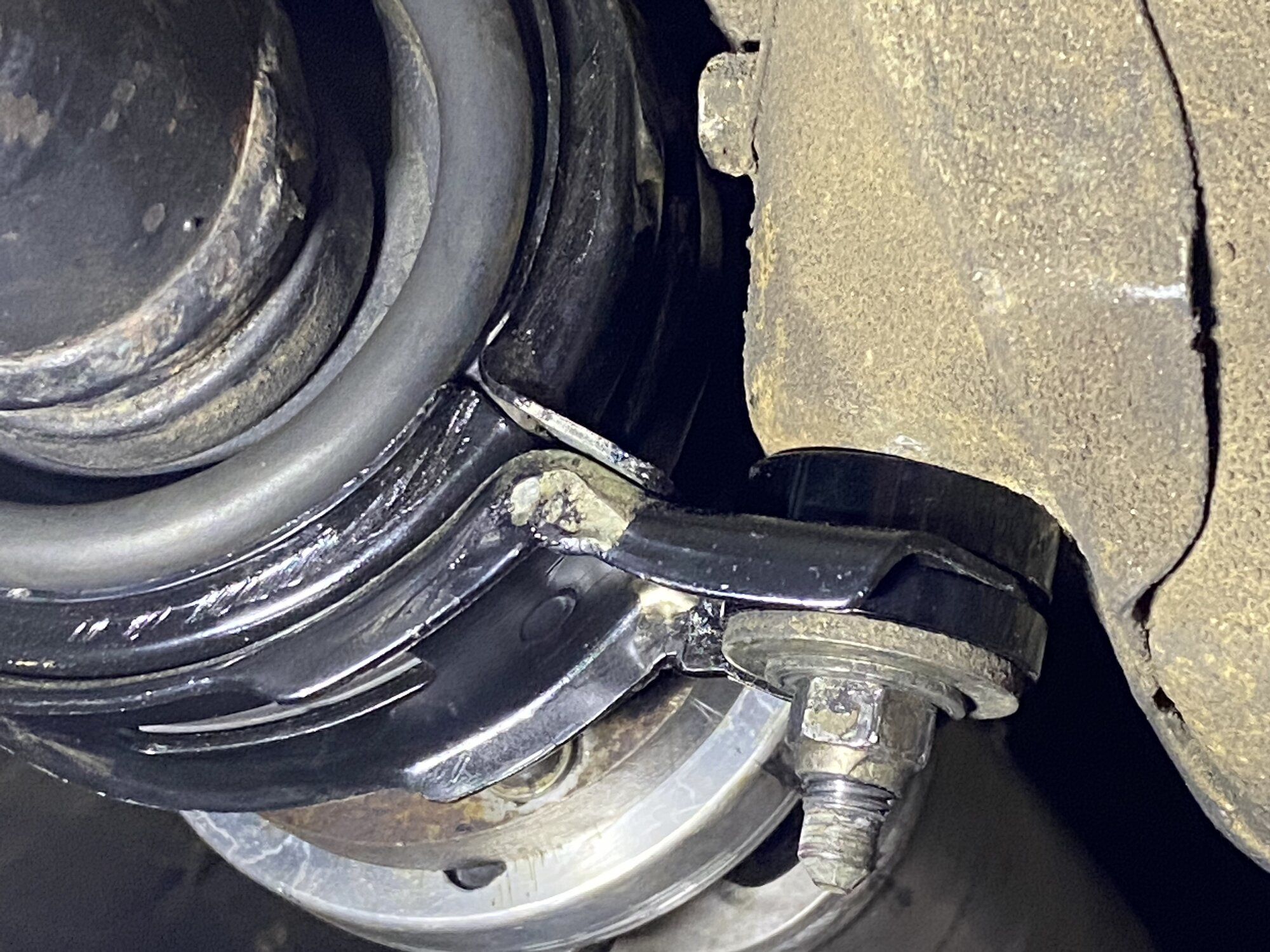

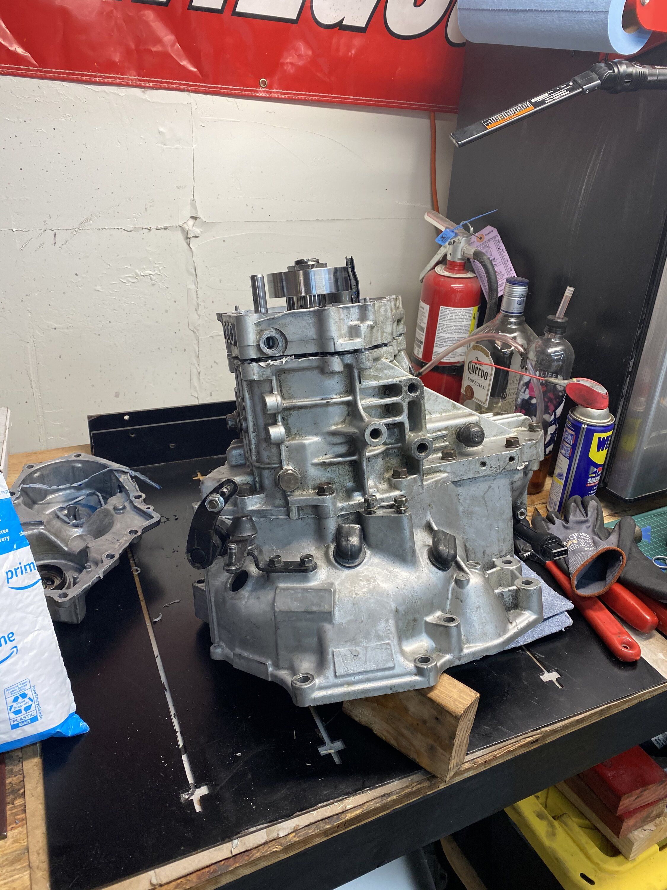

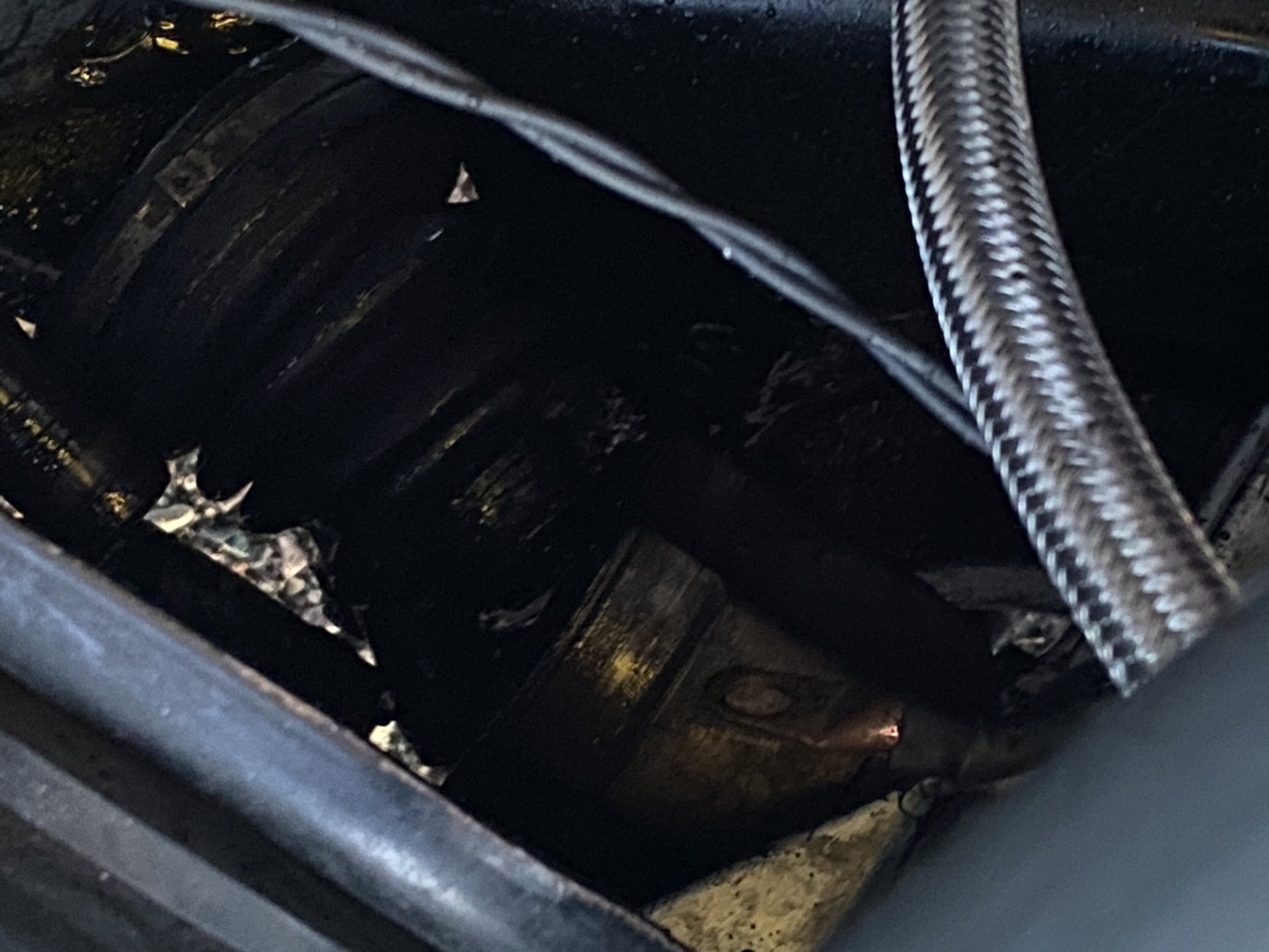

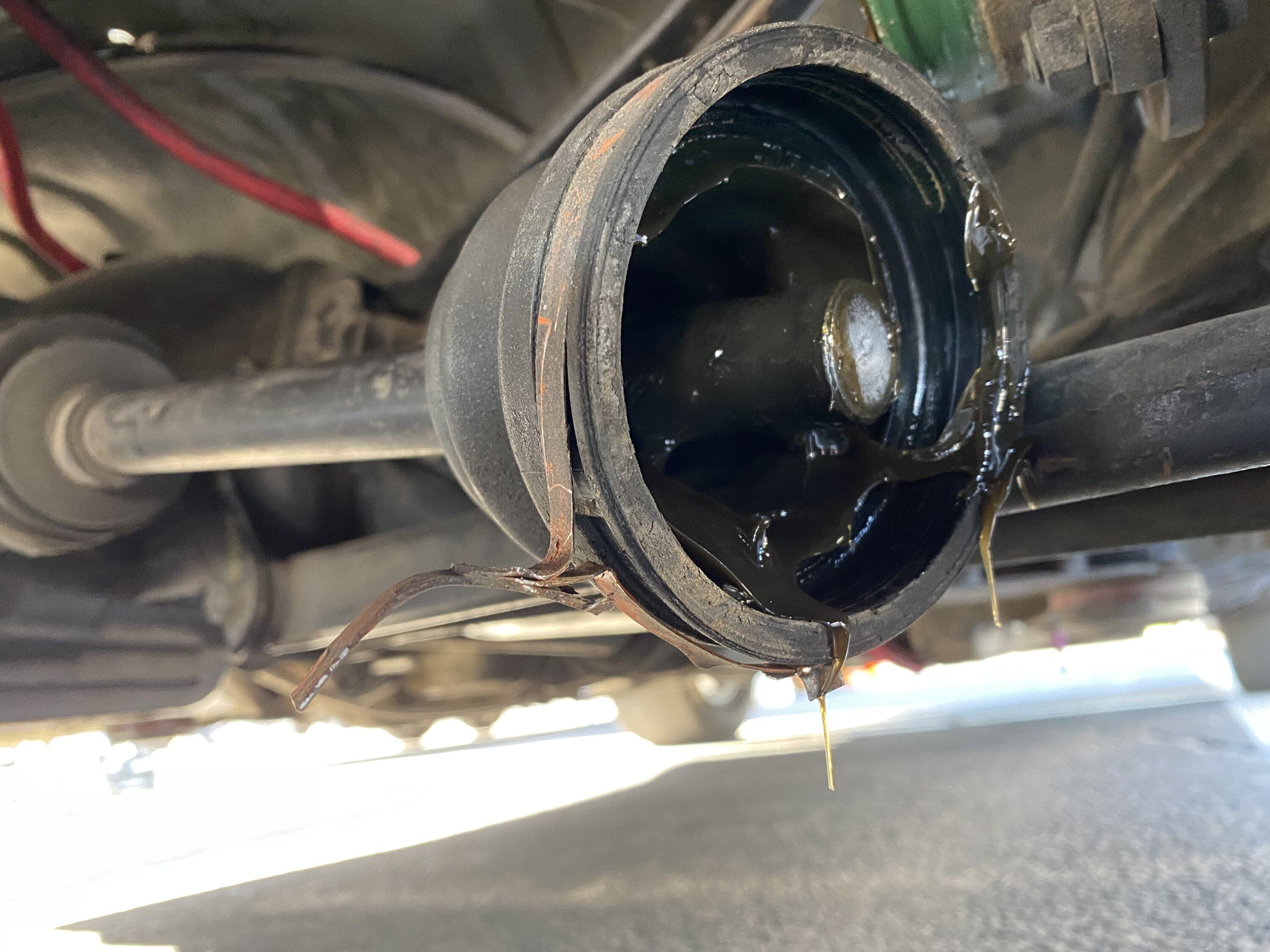

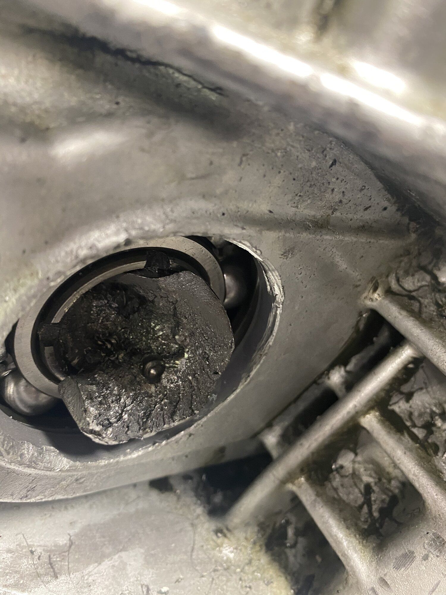

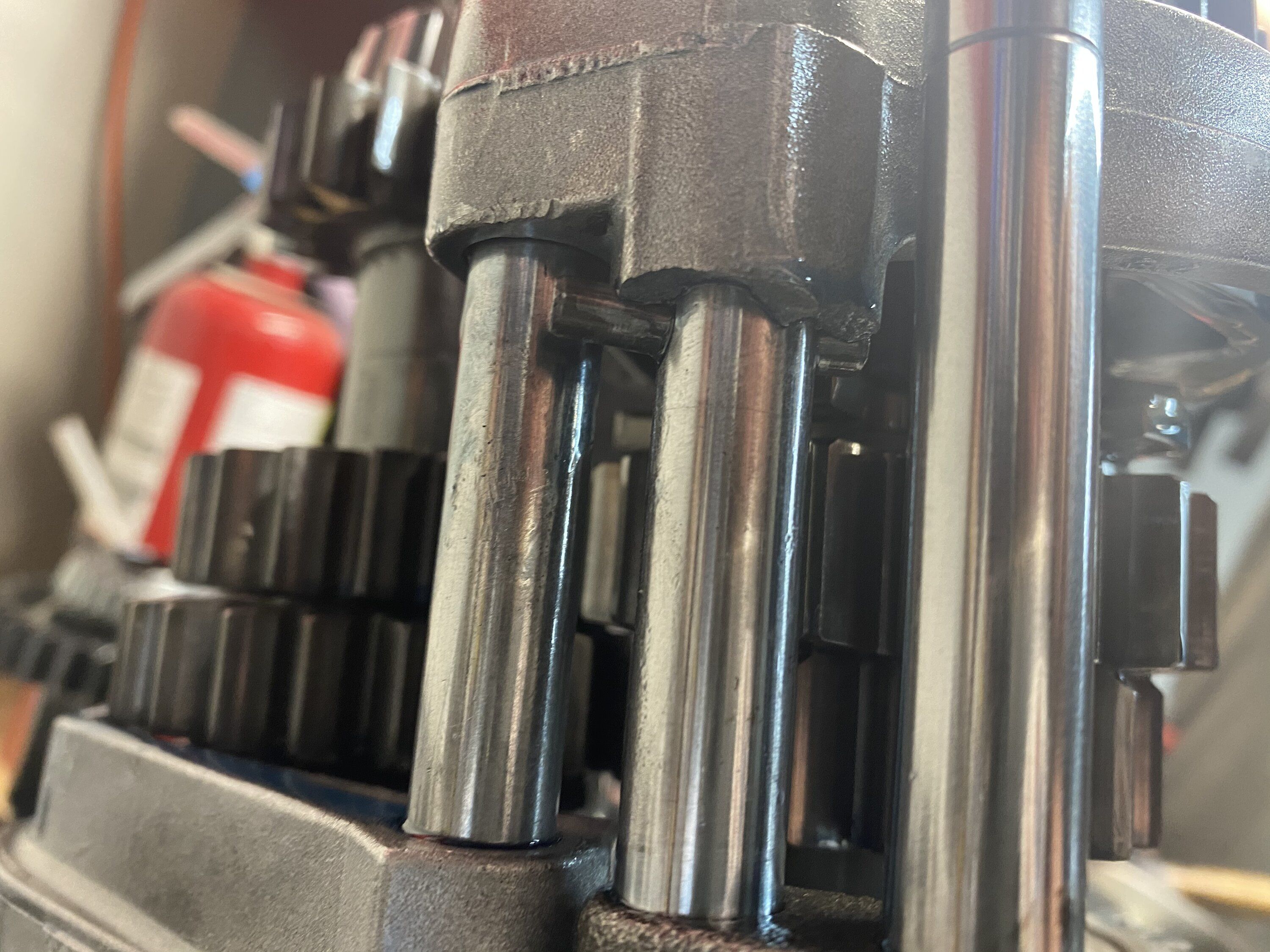

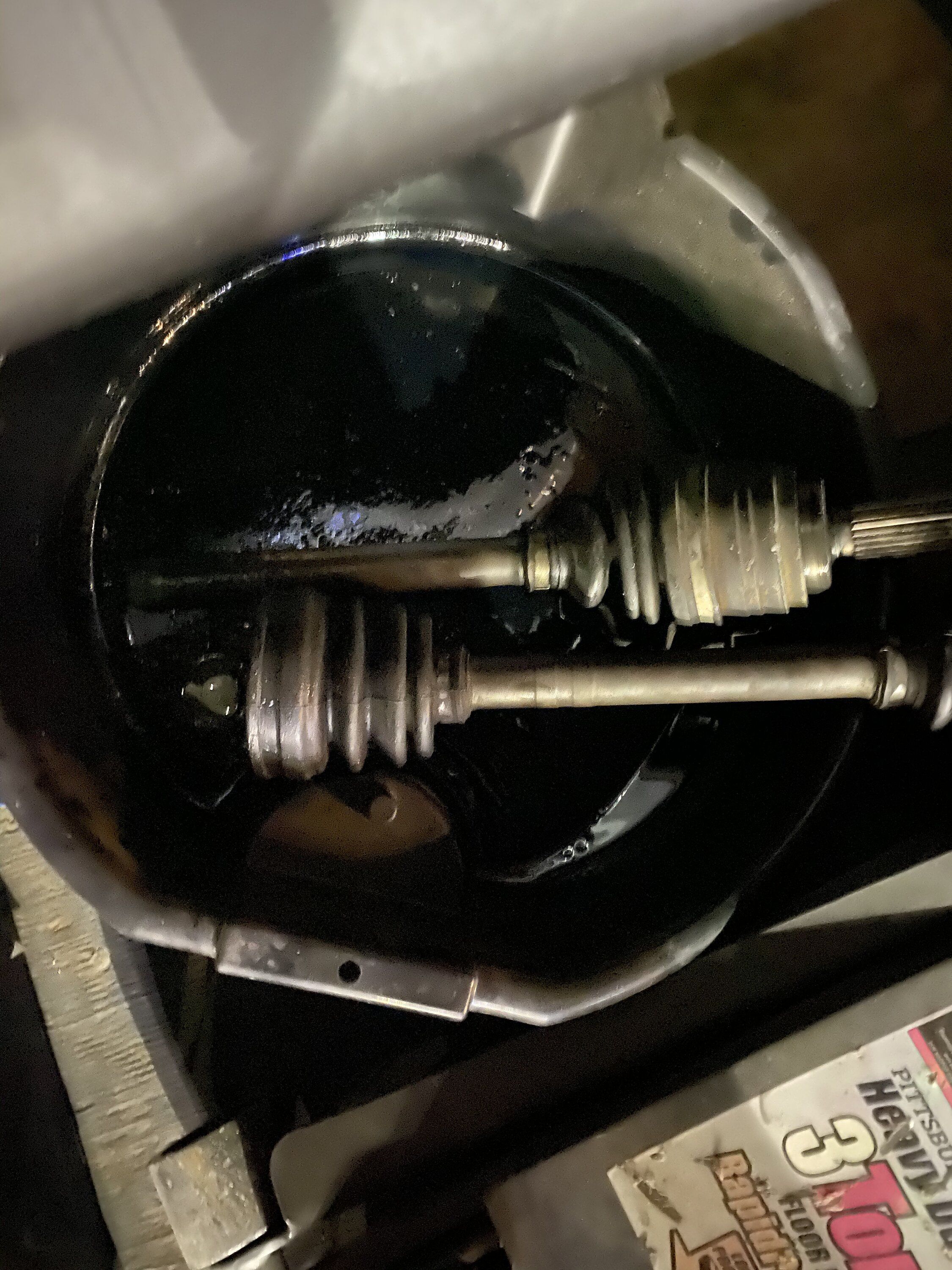

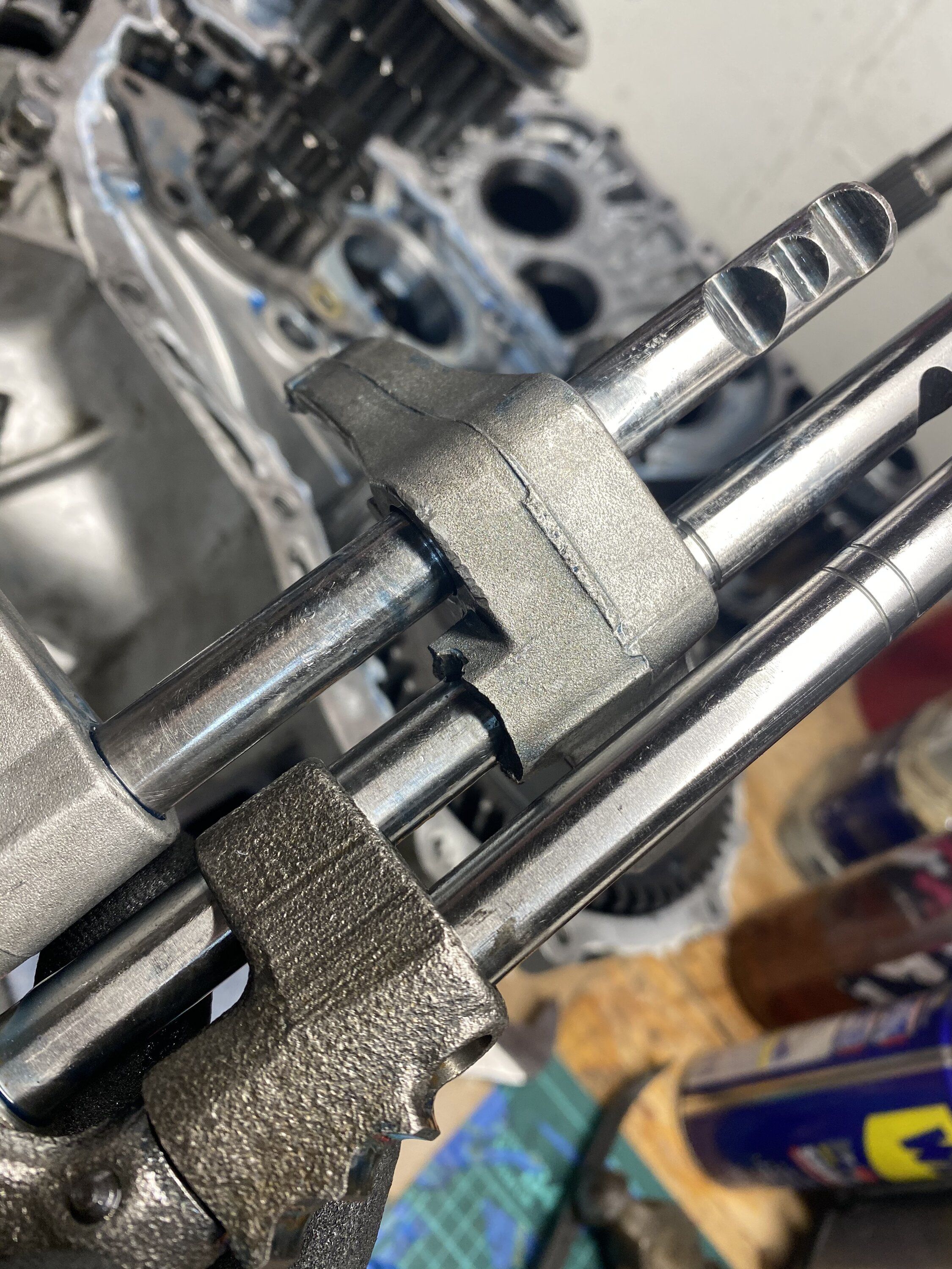

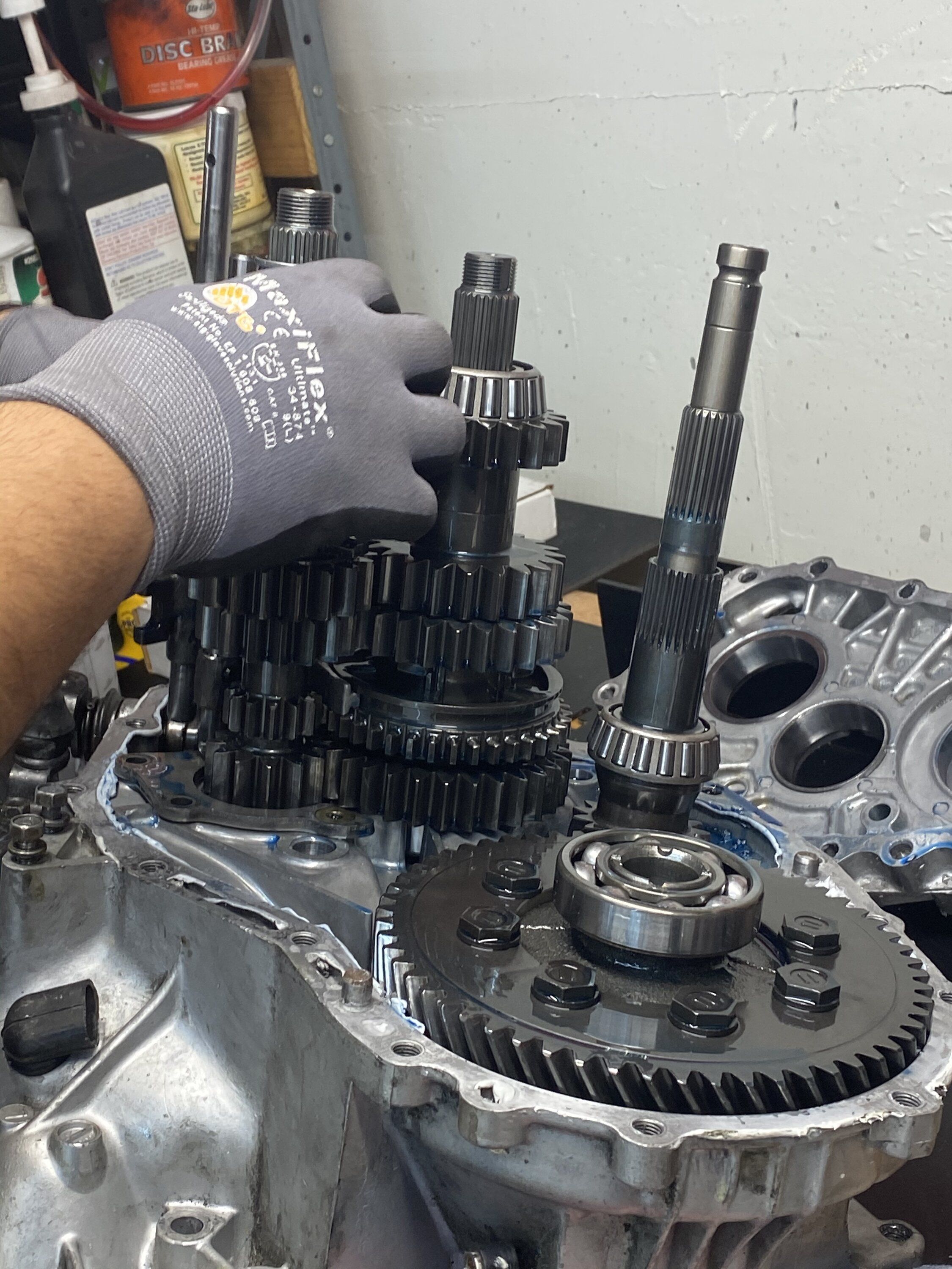

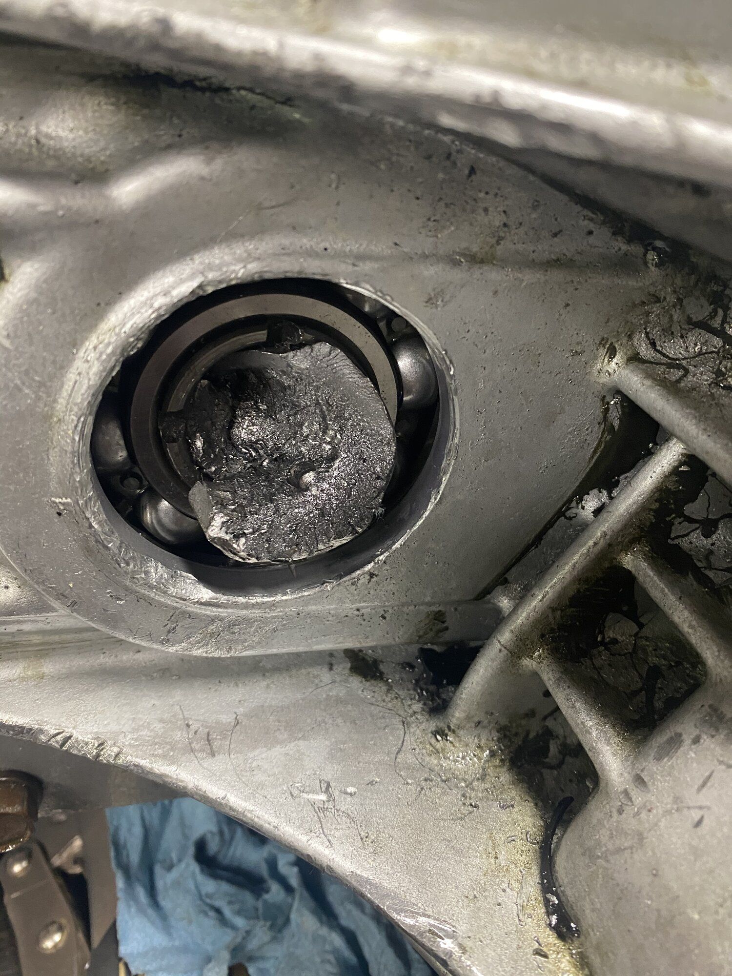

In the first pass snaped the front axles and hurt the transmission for what i see it’s probably the shift fork should be easy fix

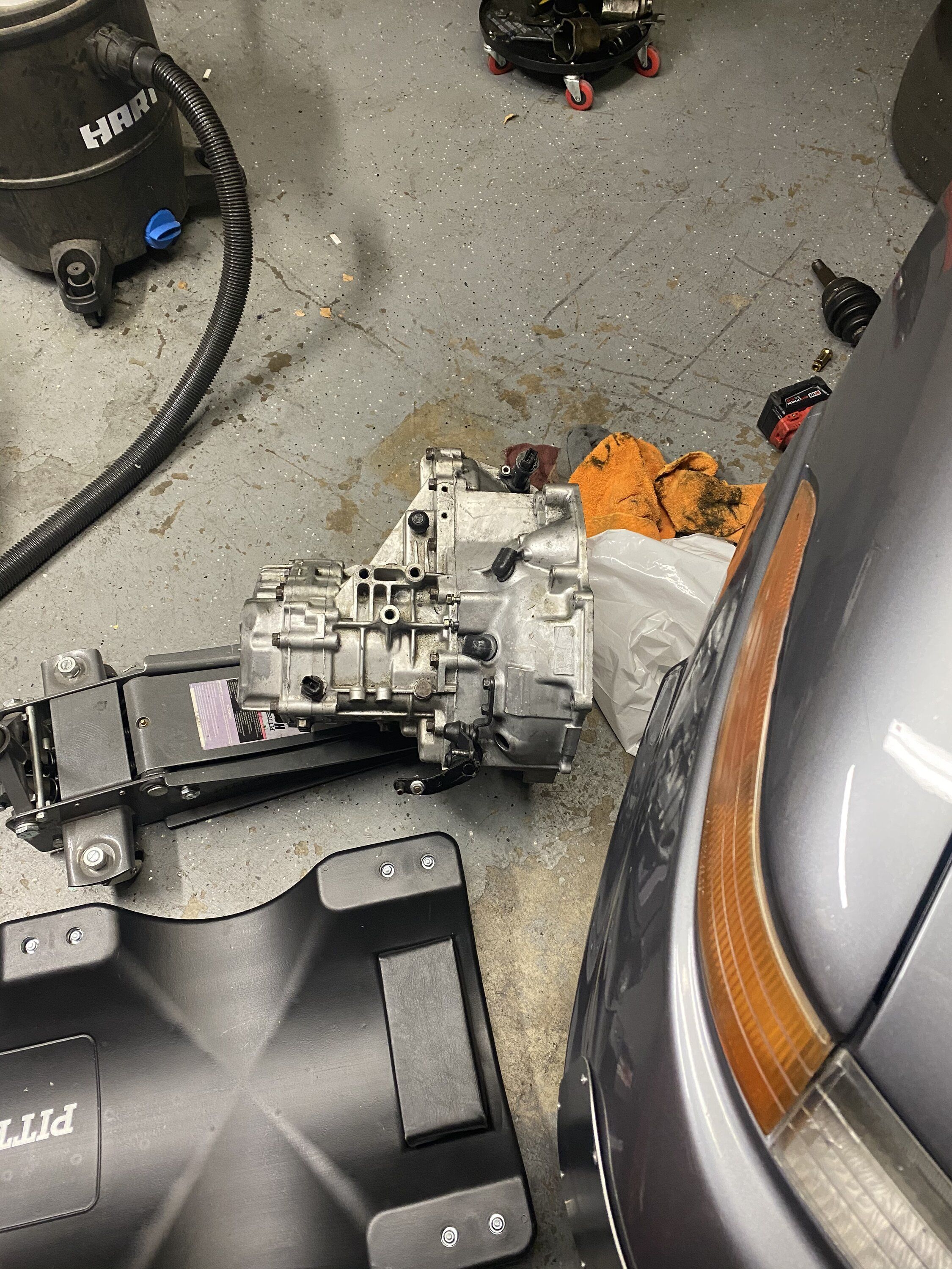

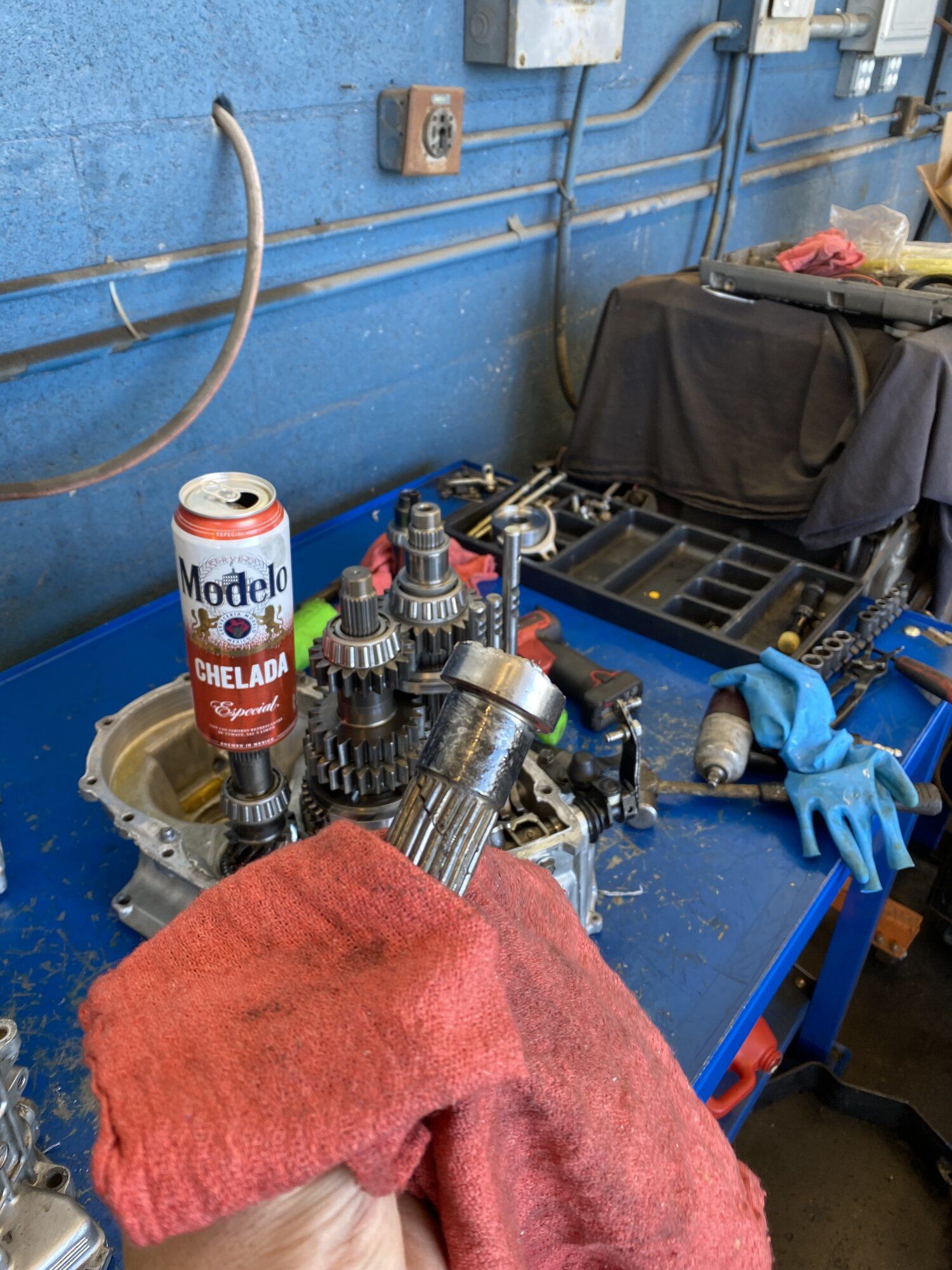

Took apart the transmission we found the problem broken shift fork! Next on the to do list is to order the Magnus forks and some need hardware and I should be back in action!
Went to test again and it was a total massacre.
But figured out in the case of a rear axle breaks the front will break or be damaged and snap on the next run.
After reviewing the logs I ready need to slip the clutch a little longer. But it might be time for DSS axles.

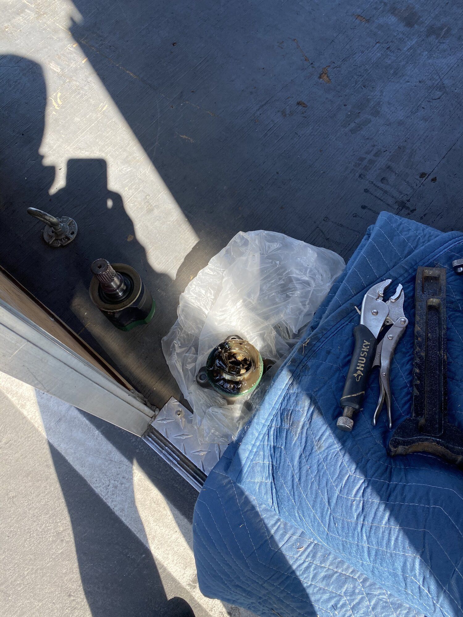

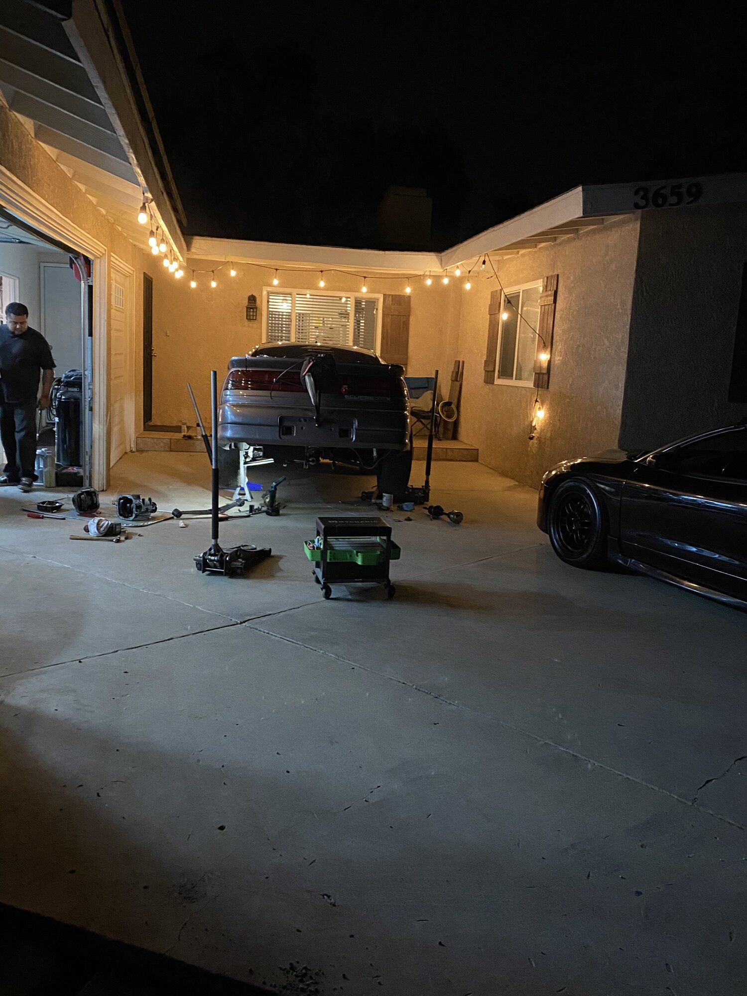

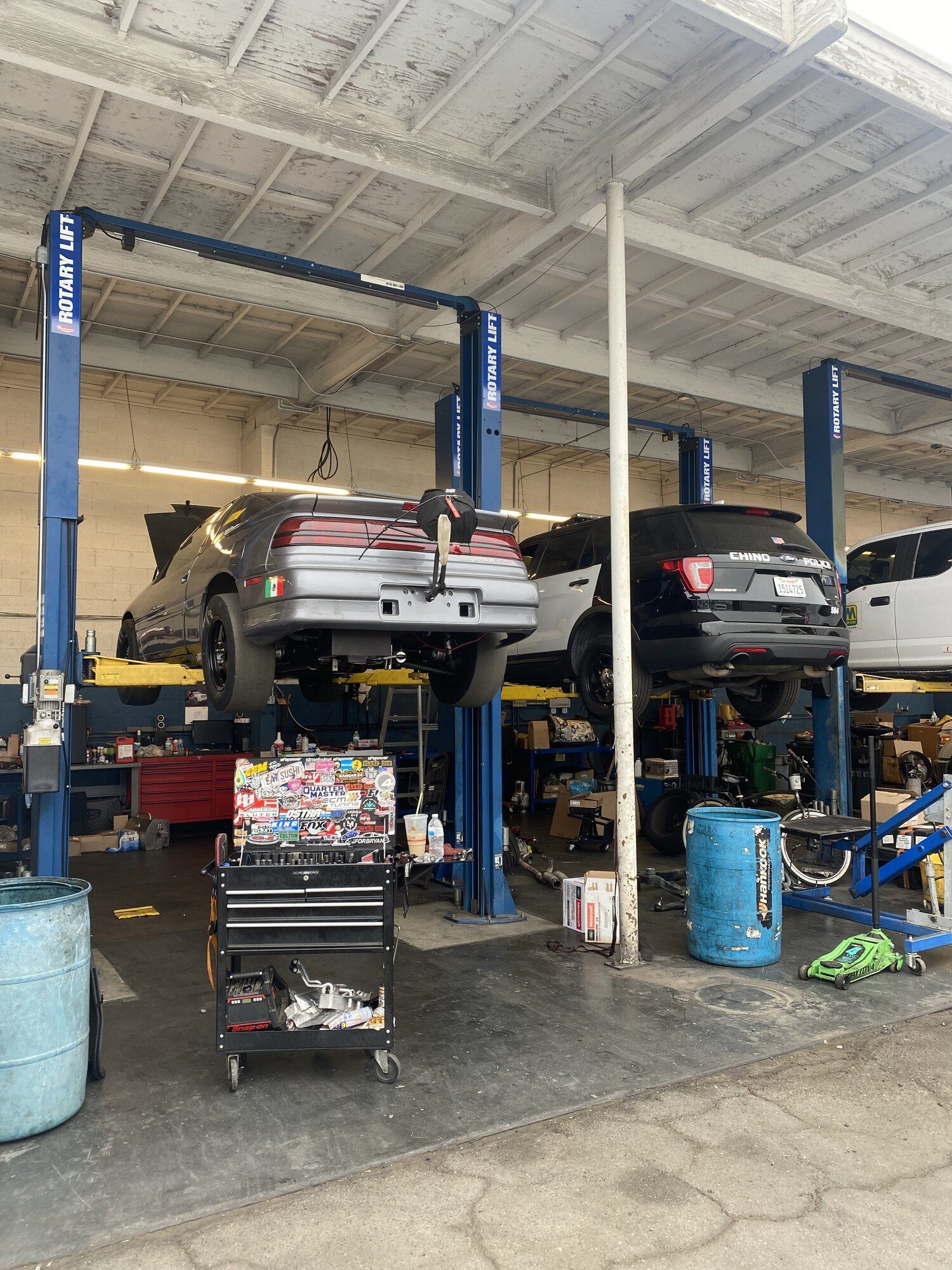

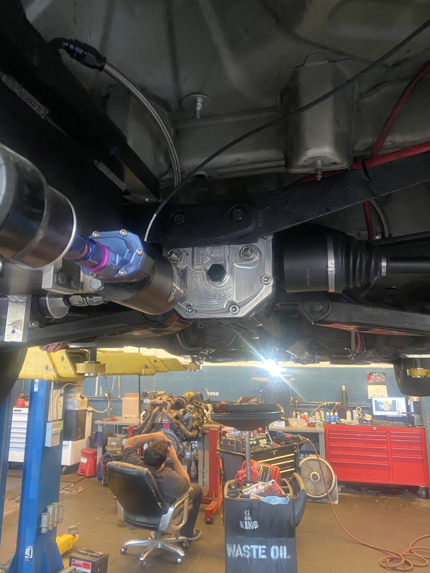

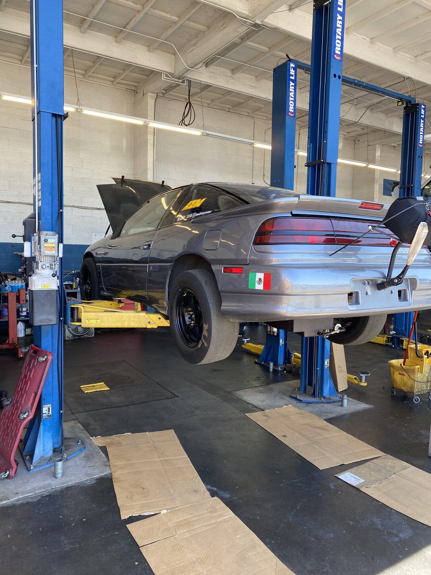

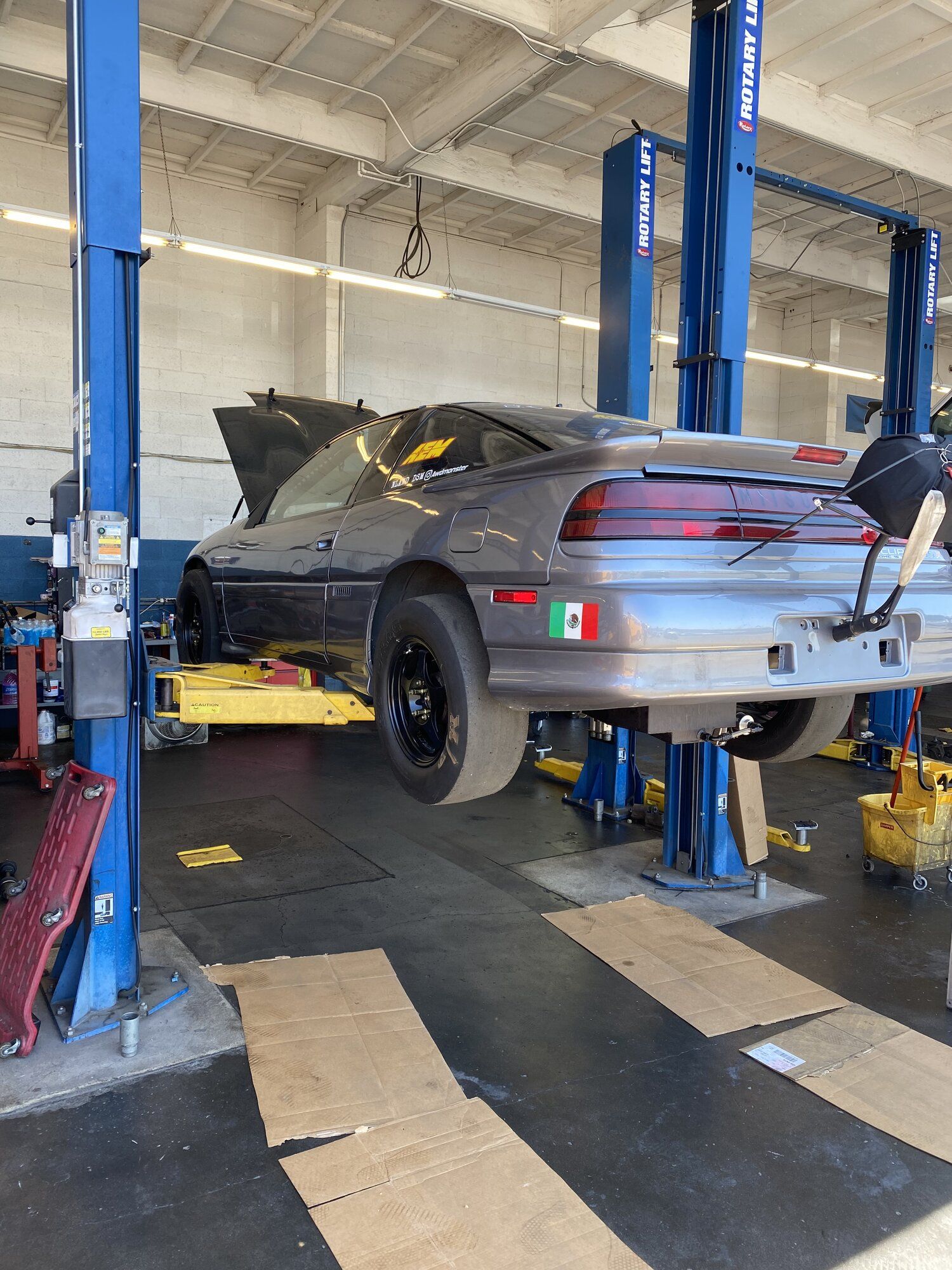

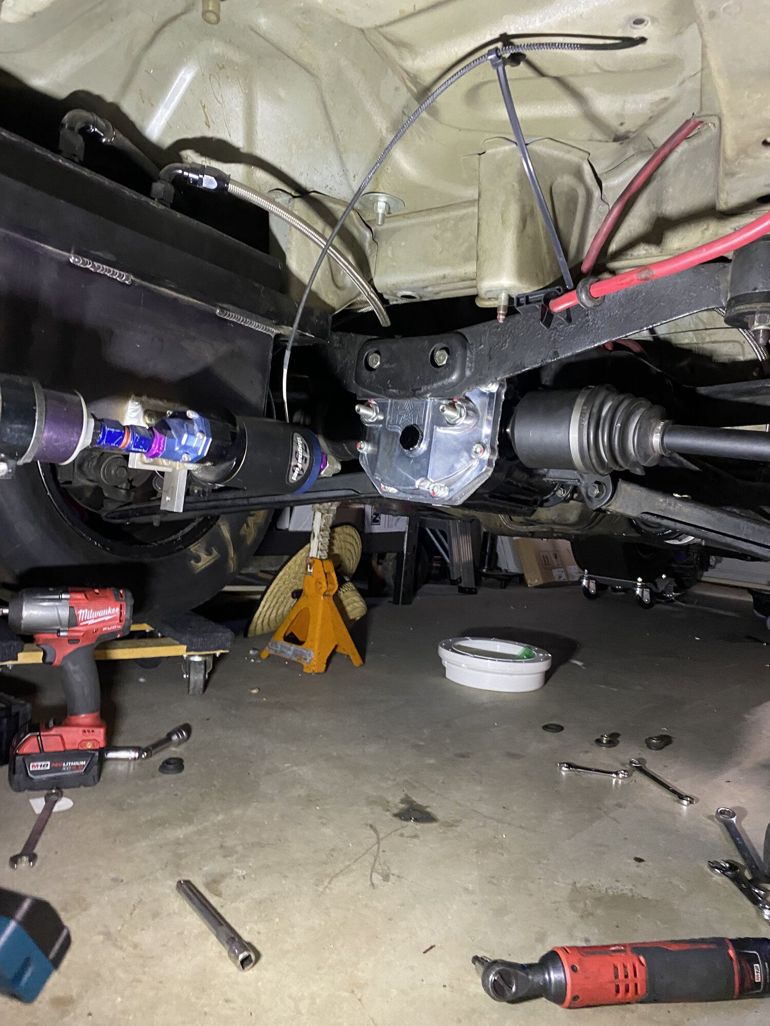

Finally made time to fix the 1g thanks to a friend local to me let me barrow his lift. Got the pro level axles installed fixed my front axles got it going again. Probably go testing in 2 weeks….
Always nice to have a lift you can use. One of these days I'll have one in my garage.
Absolutely! All my tools are a mess since i recently moved homes garage is packed with remodeling stuff 😔 . Depending how i do the end of the season (year) if I can lay a good time I might have to consider going auto. As much As I don’t want to but i wanna start wining some races and be more consistent.

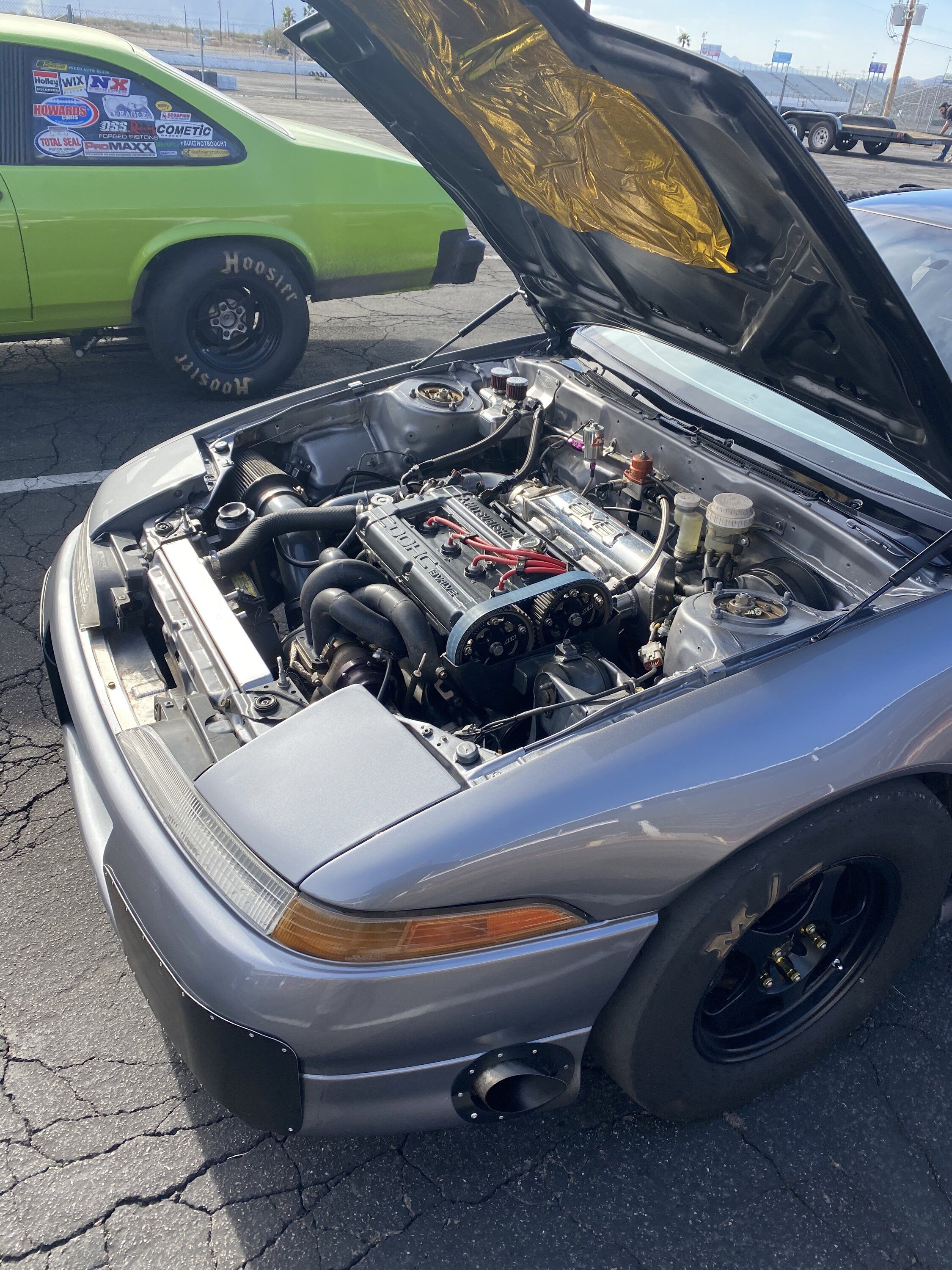

On this pass I preloaded way too much building too much boost got some bad tire shake and the rear end failed 😞 now I’m looking for 4 bolt rear so i can get it going and make an event.
few changes ….
1- minimum preload don’t load it too hard
2 boost by gear on infinity I’m going to do a timed boost limit 200ms probably wel see what works or I’ll leave it alone work more on the foot work
3 boost leak test because on the first pass on to 3rd gear ⚙️ the pipe popped off and touched a wire causing a small fire 🔥 need to secure everything so that does not happen again

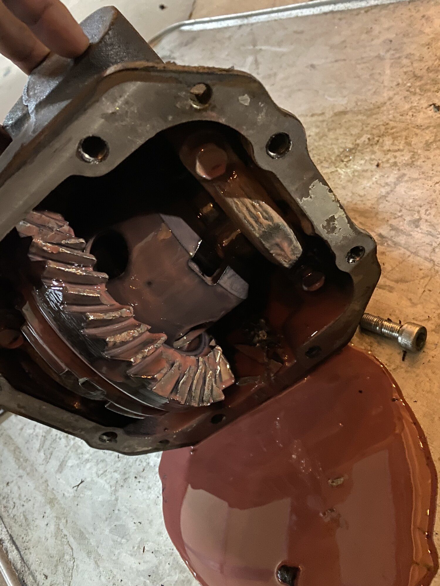

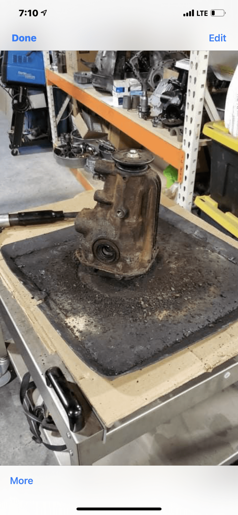

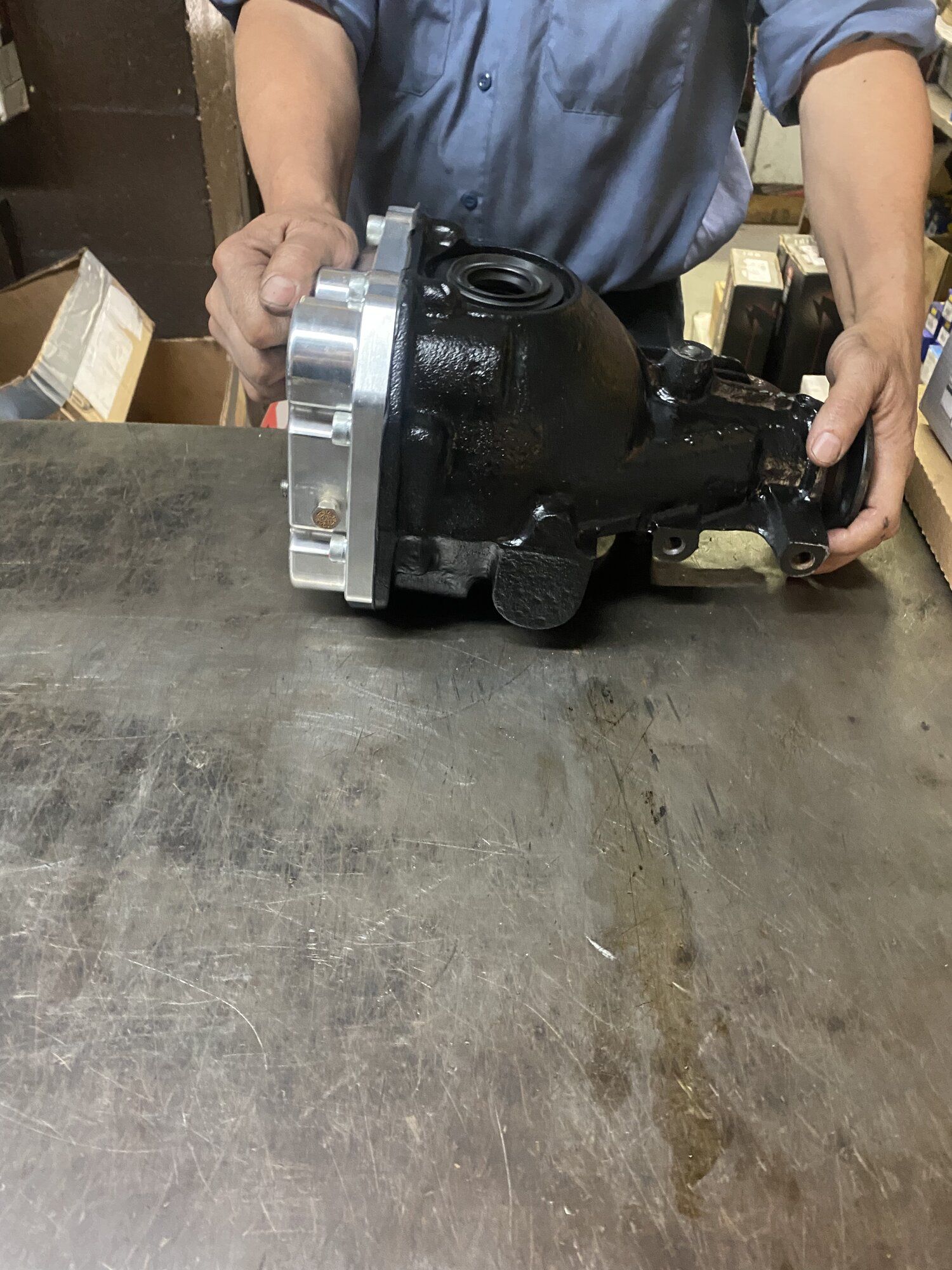

Tested again and destroyed my second rear diff.
After checking at the logs noticed it was hooking and spin then dead hook causing the destruction of the rear differential.
Will work on setting up the chassis better to control the spin and install a Magnus slipper valve.

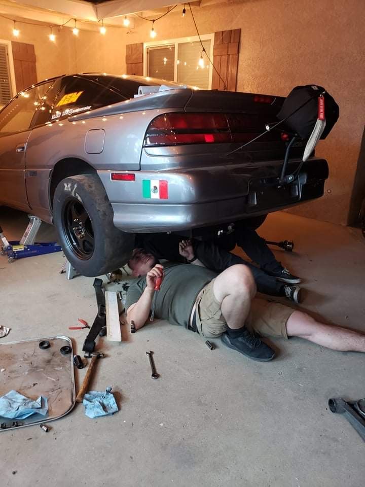

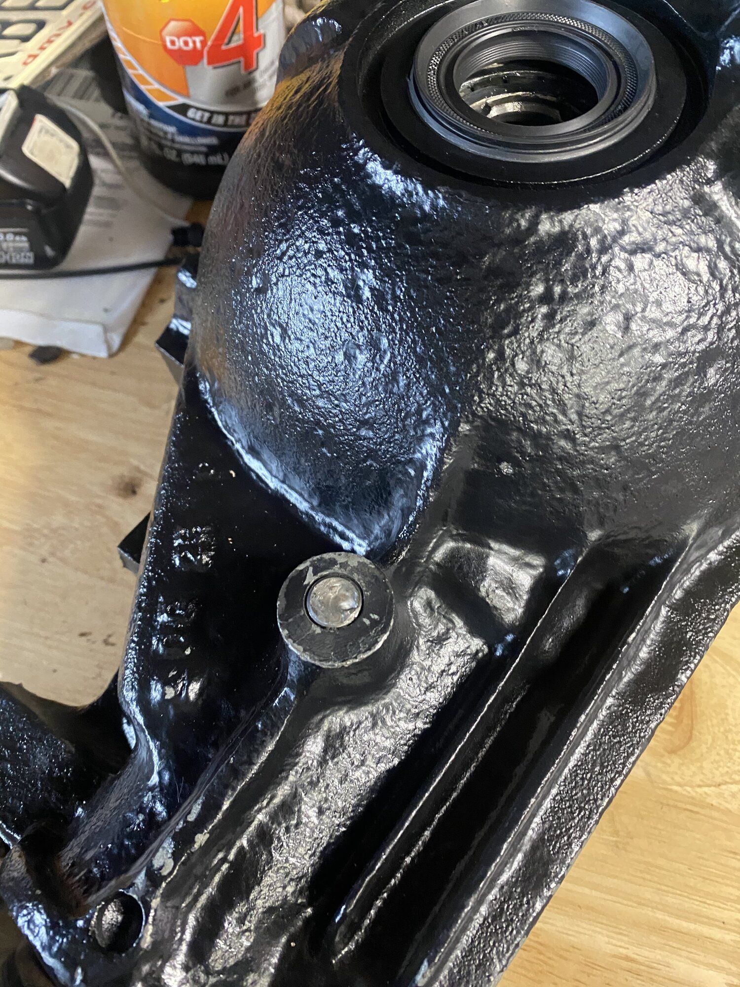

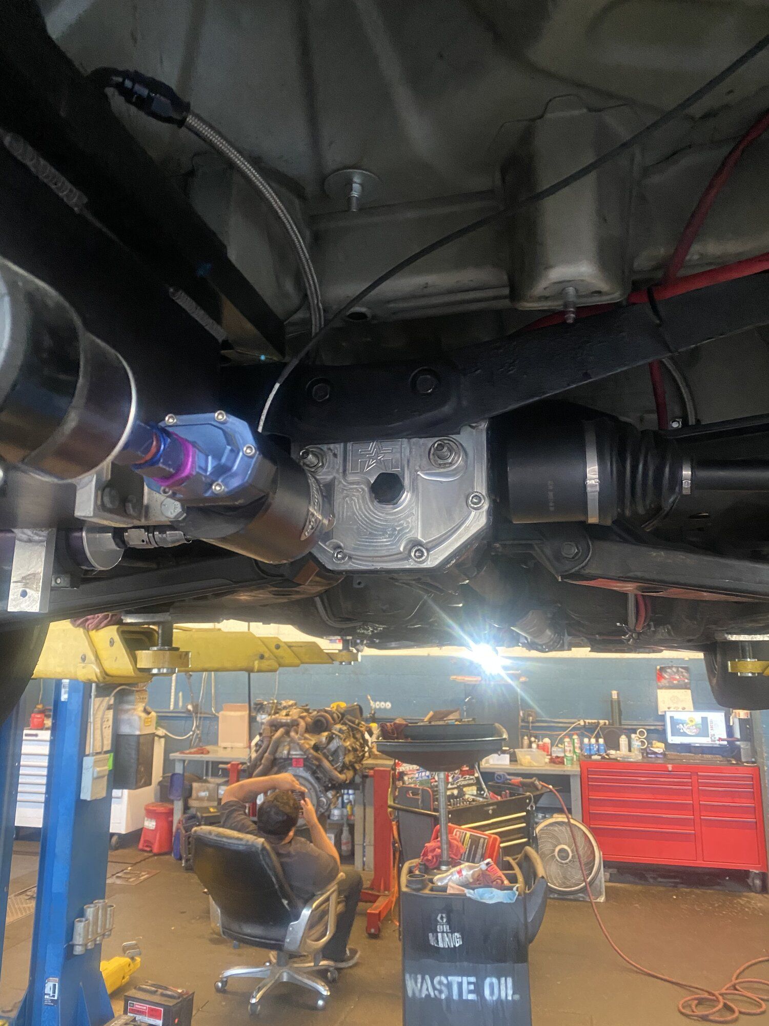

Rough morning snapped a bolt in the diff but we got it fixed. Got the new diff in with form shot peen thanks to Tim Zimmer! Tomorrow we go testing at the track.
