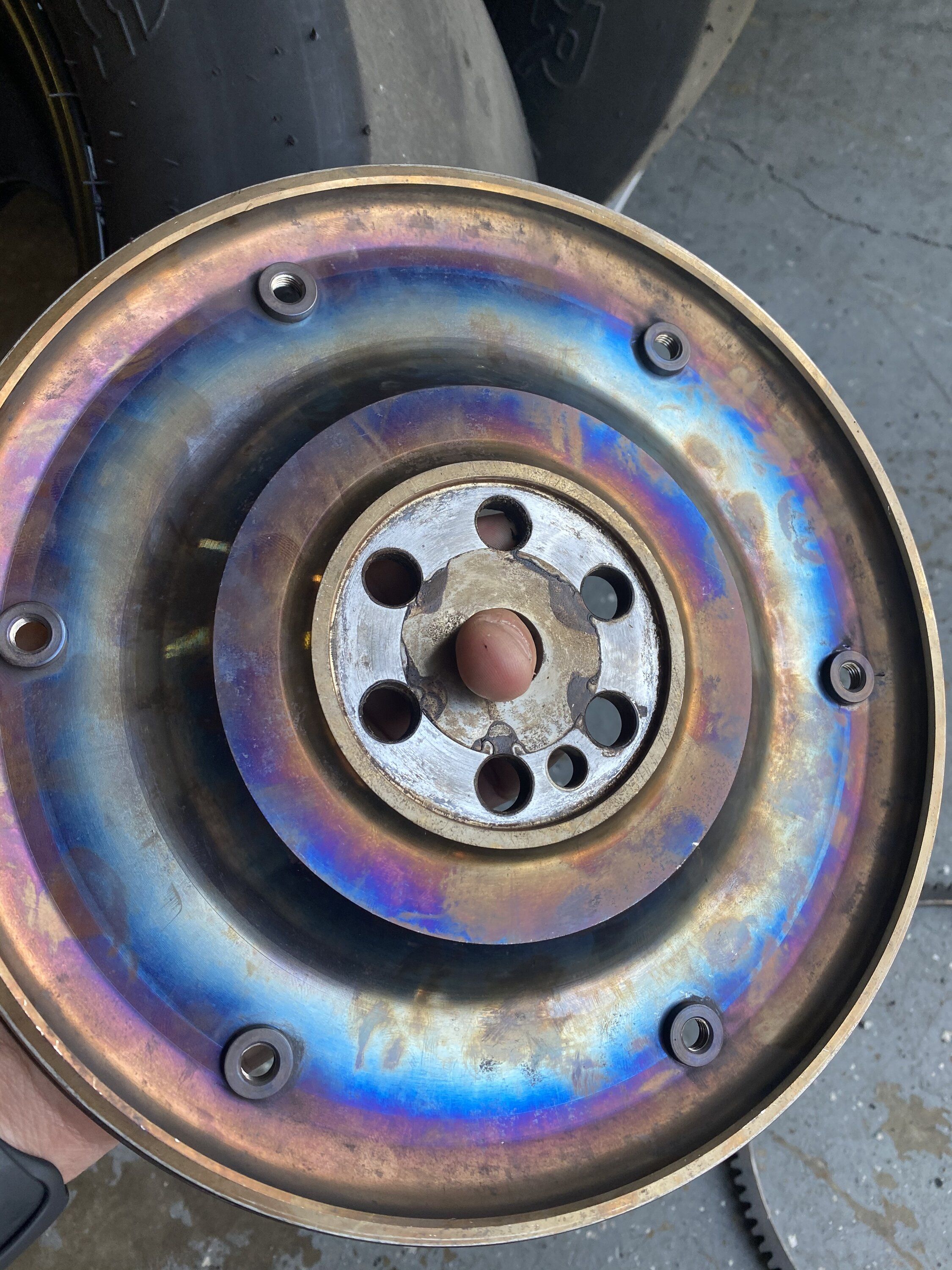

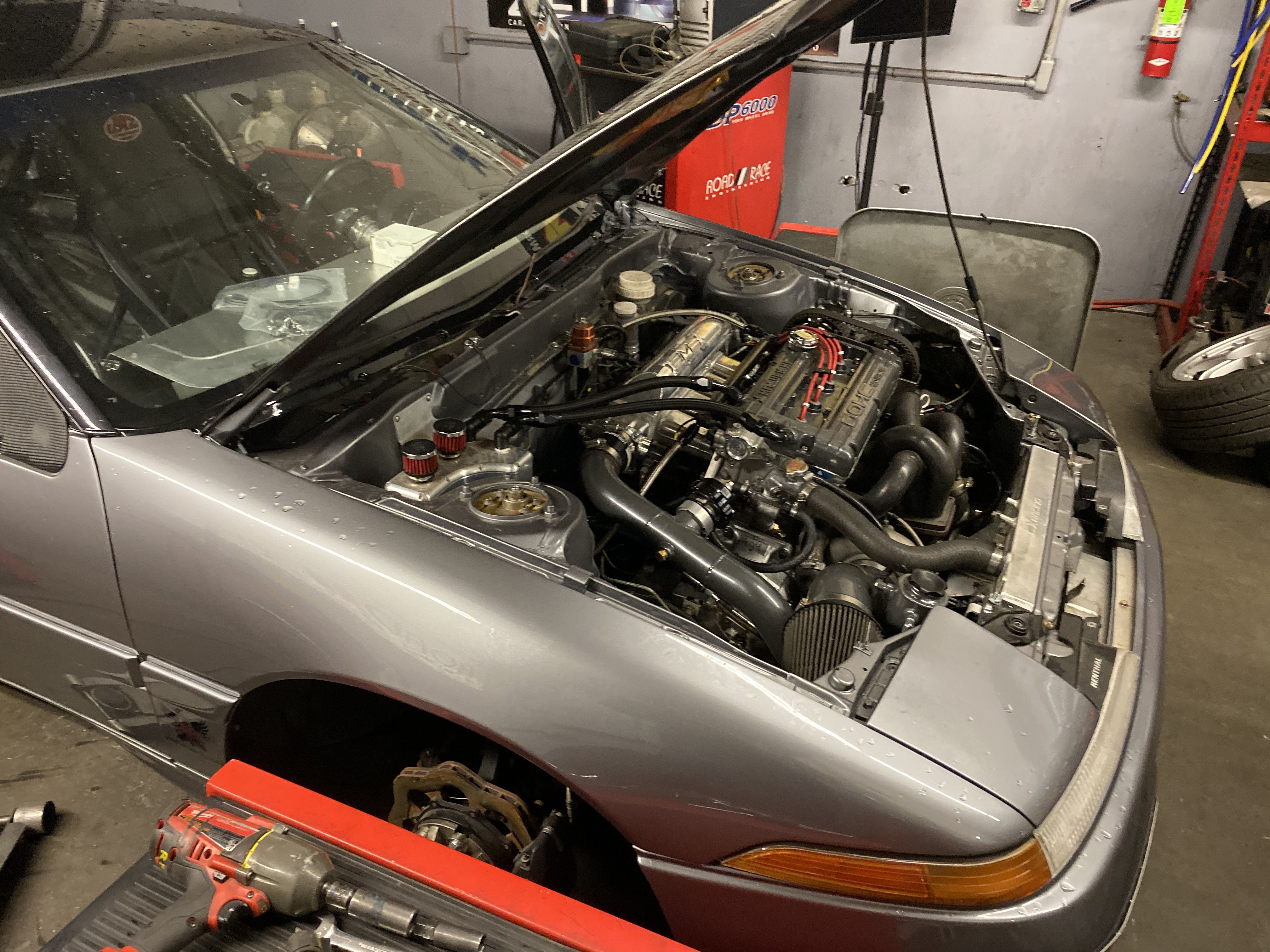

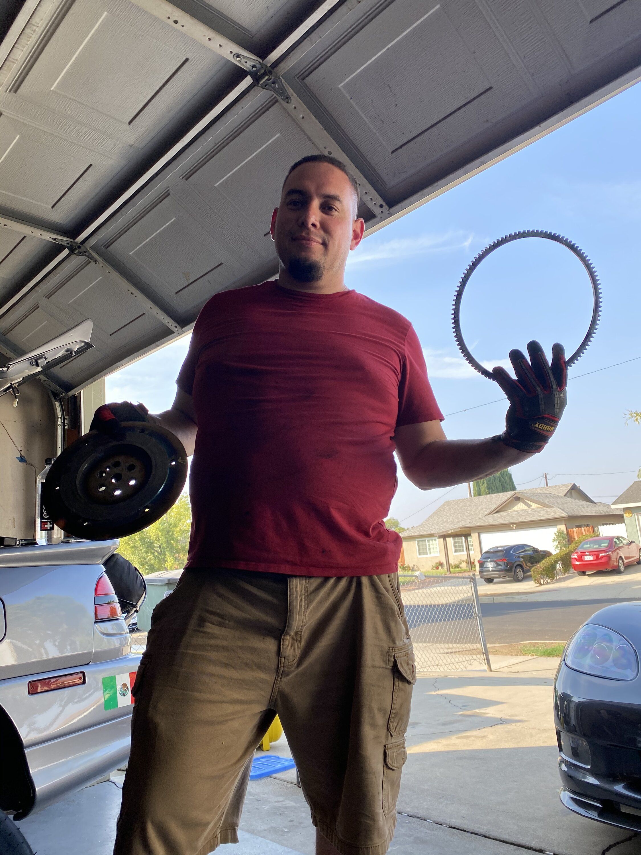

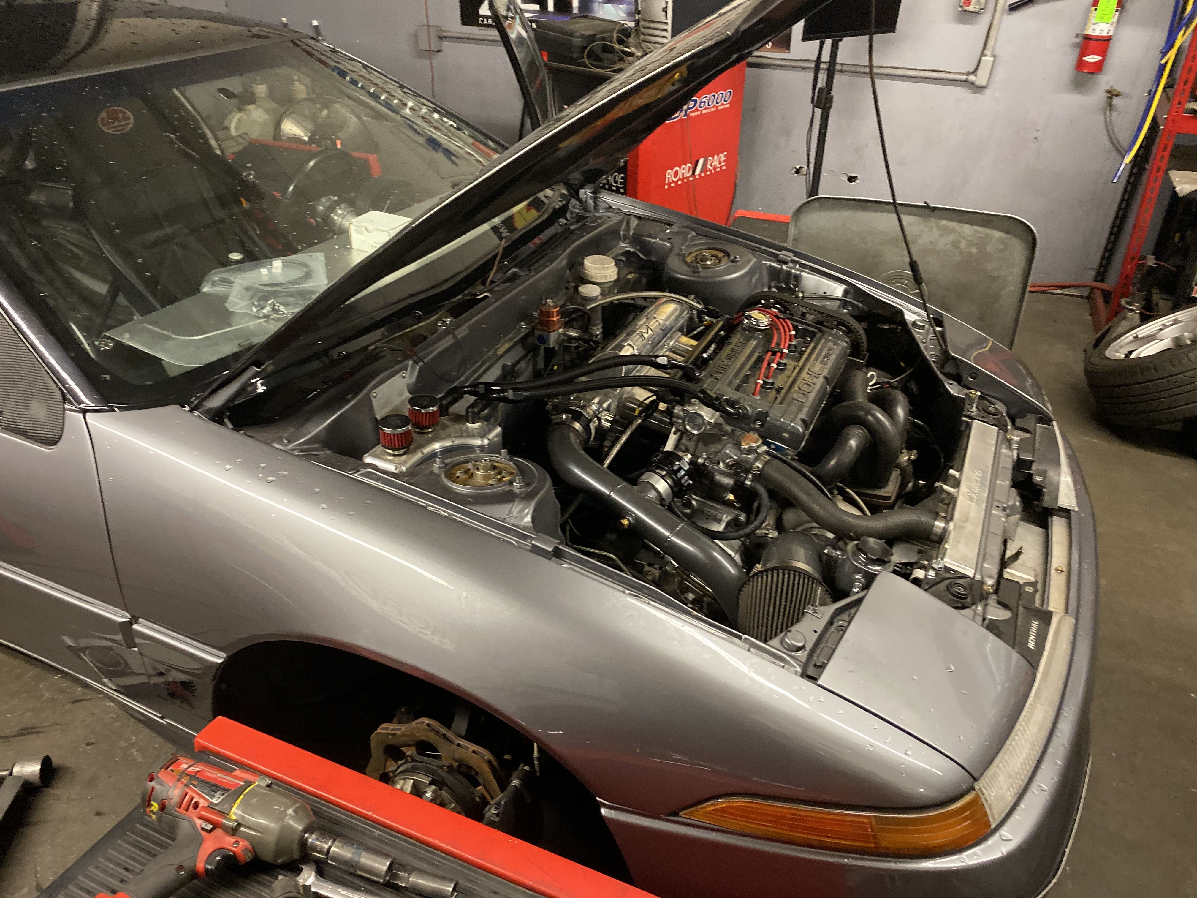

Hi guys it’s been a while. Few weeks of go had a setback where the flywheel was not a all they way in caused some damage to the bellhousing where the TOB rides on got that addressed changed the dowl pin on the crank all good now.

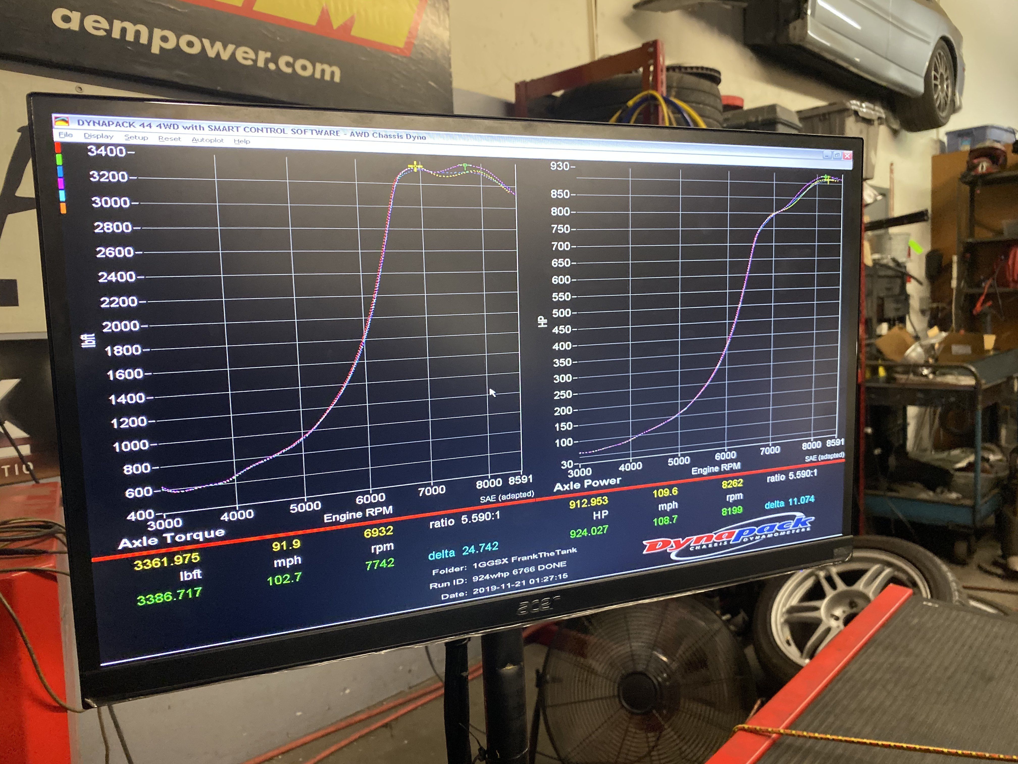

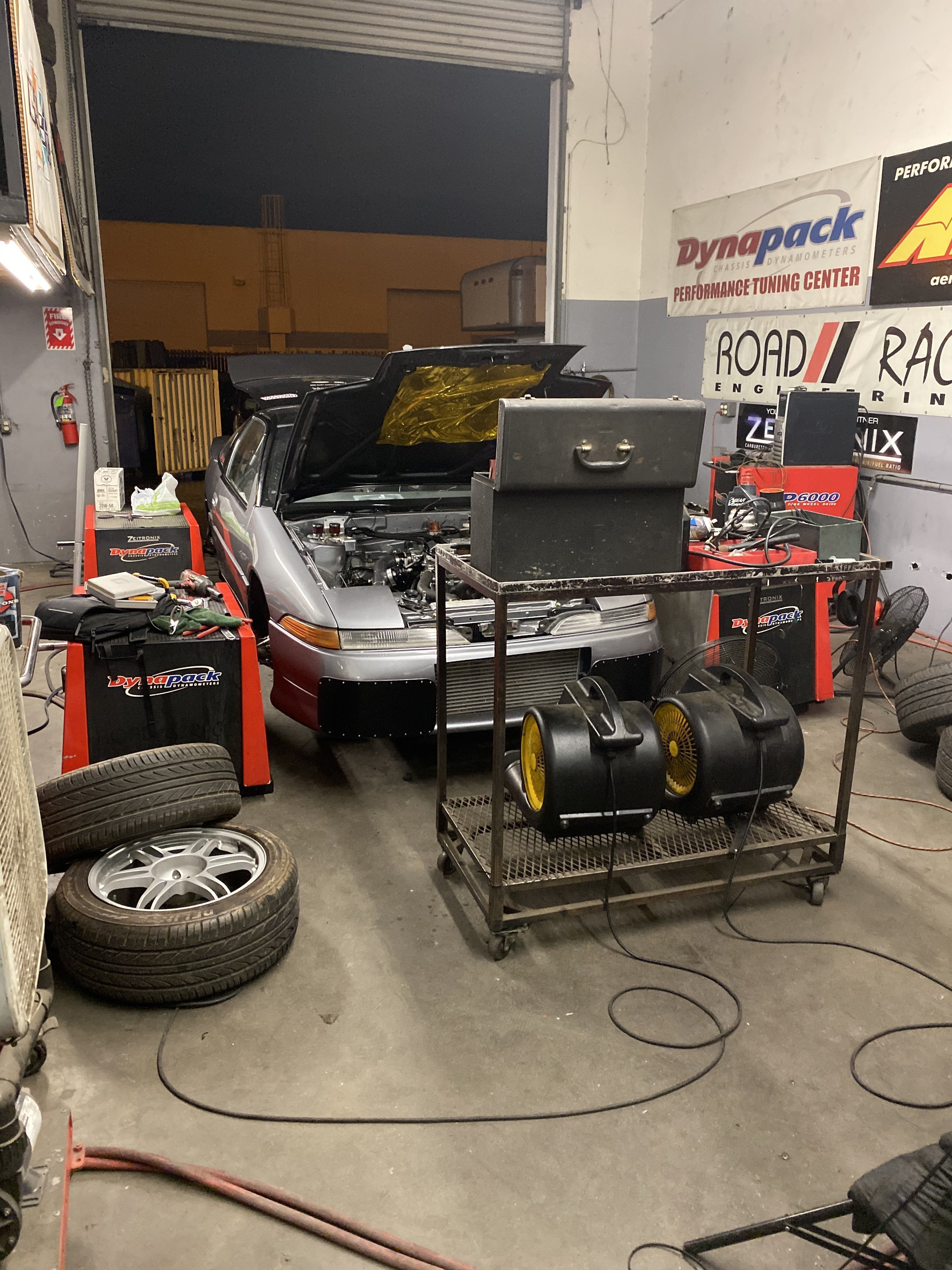

This Friday I’ll be dynoing the car.
Wish me luck
Looks good Frank. What's the word from the dyno?

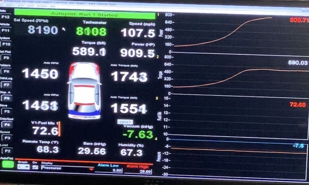

Final numbers 934hp 600tq
Now i need to do a bolt check and Secure anything that gets loose like oil filter radiator cap

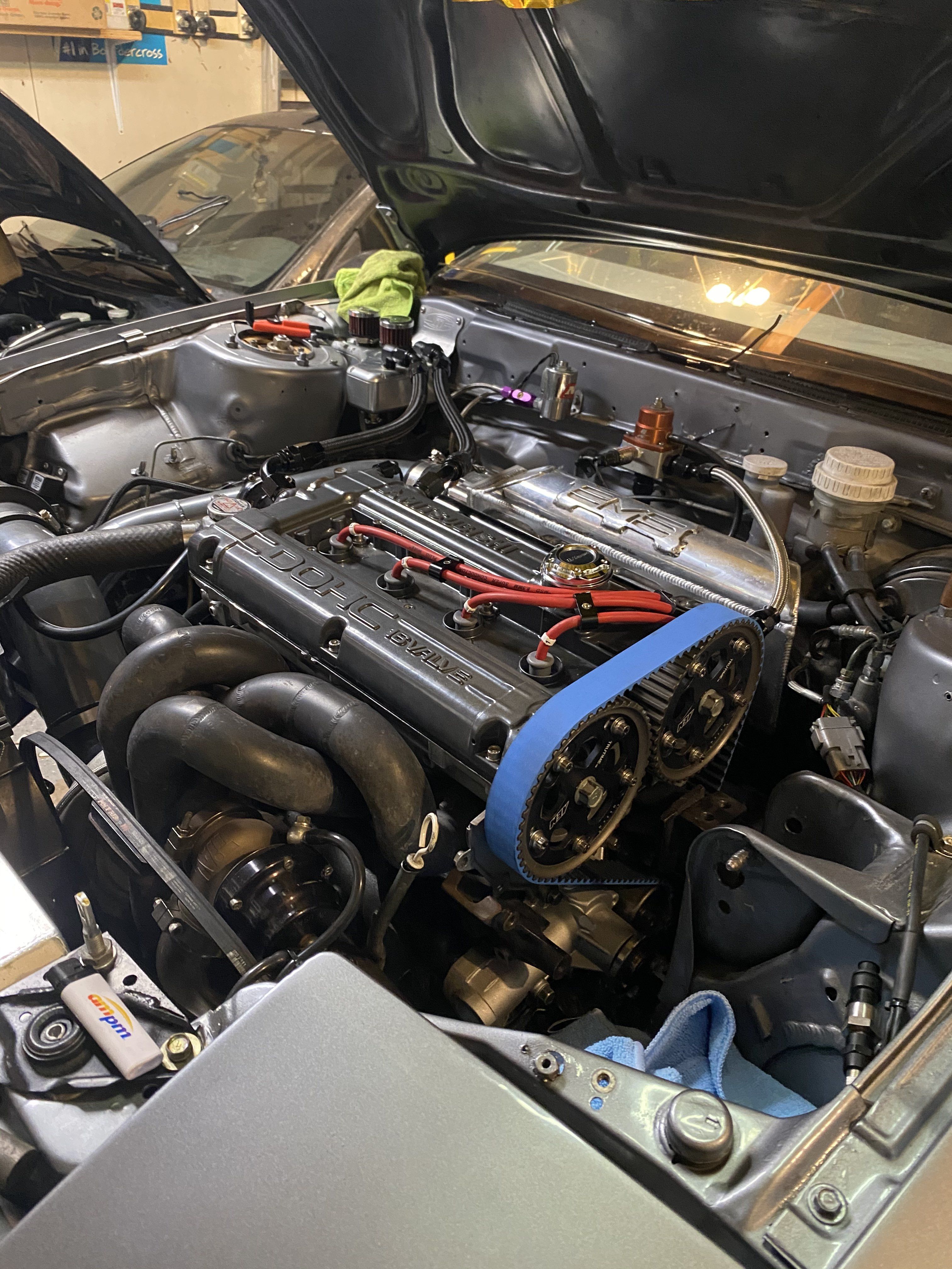

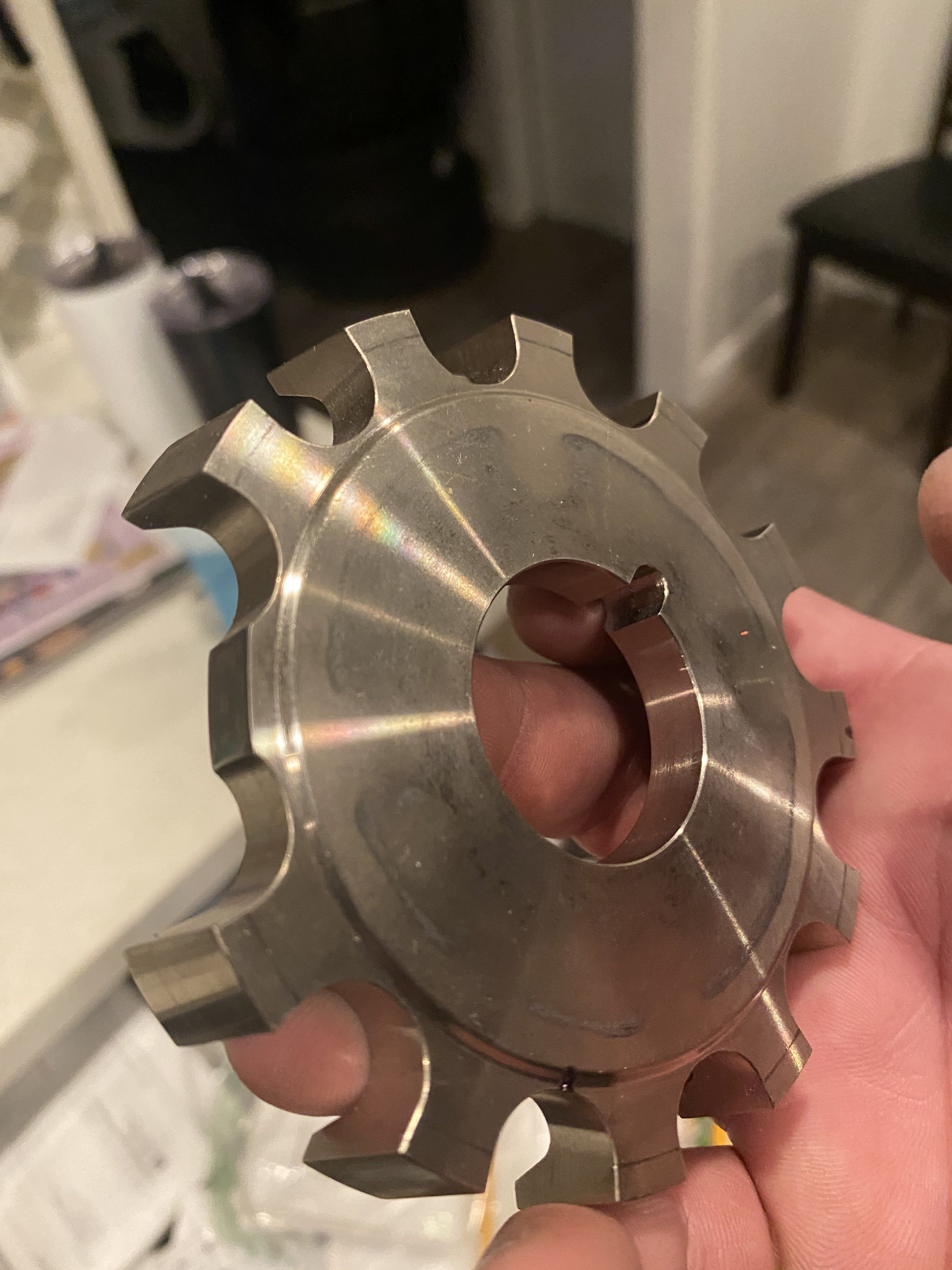

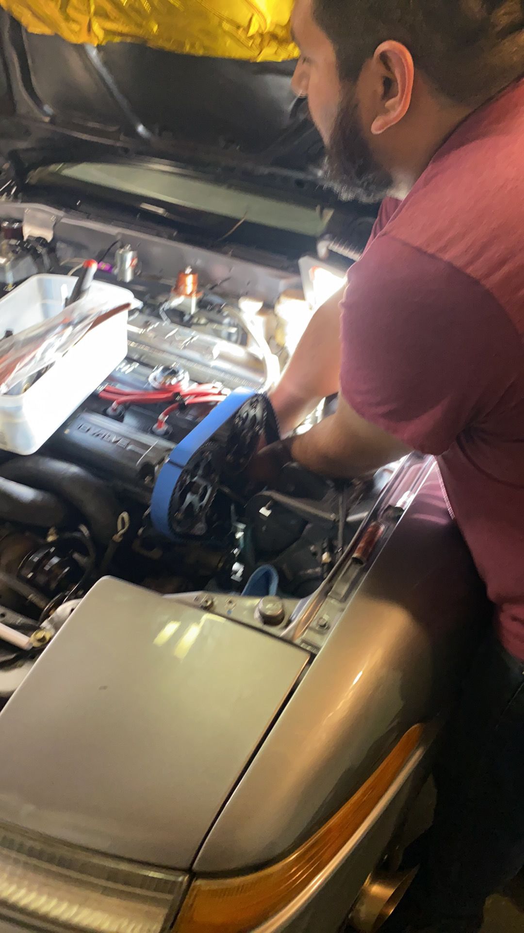

Working on getting license passes. However I’ve been fighting with cam sync issues my tuner and I came up with the tensioner collapsing on high rpm or belt stretch... but at this point I’ll be swapping parts taking it to the dyno to test the car after we swap parts. We also might need to chop on tooth on the crank plate on the kiggly kit. I’ll have more info on this later on.

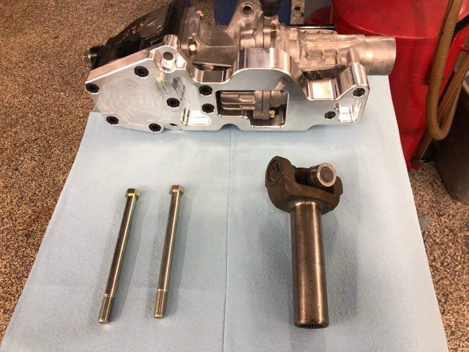

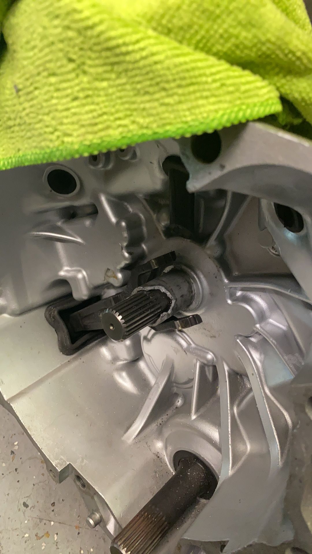

Got a new t case with front line fab brace and 300m shaft realized i need a 23 spline output shaft.
Finally mulled down the tooth as per my tunner now need to put the car all together and dyno it to test for the cam sync.

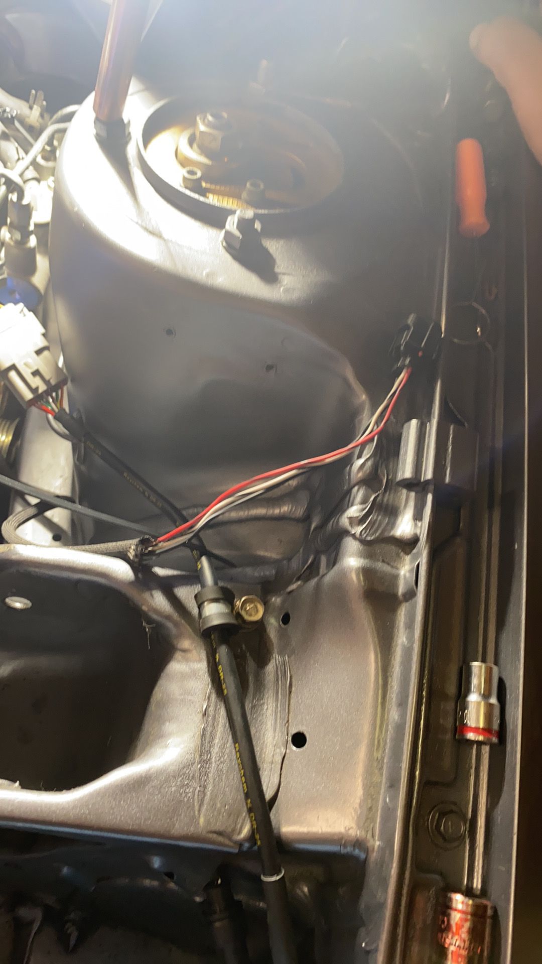

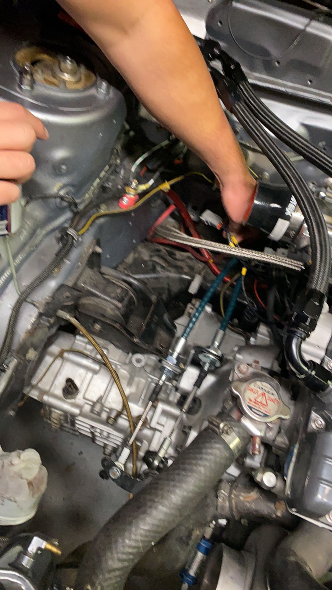

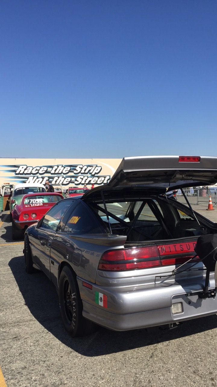

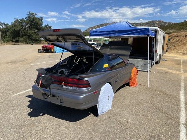

Went racing a few times to work on my NHRA license. At the same time I was battling a couple electrical gremlins coming to find out that the only issue I had with my cam sink issue was a loose wire in the connector replace the connector and it was all fixed. Anna later event my speed sensor was having the same issue replaced the connector and it’s good to go.
So far om getting used to the car
1/8 mile time of 6.5 at 115
Here some pictures from last weekend only had one pass s we will come out again
thanks to my friends Oscar Dustin and Sam for helping me out

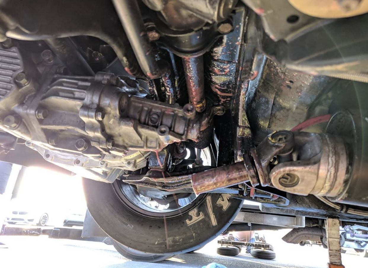

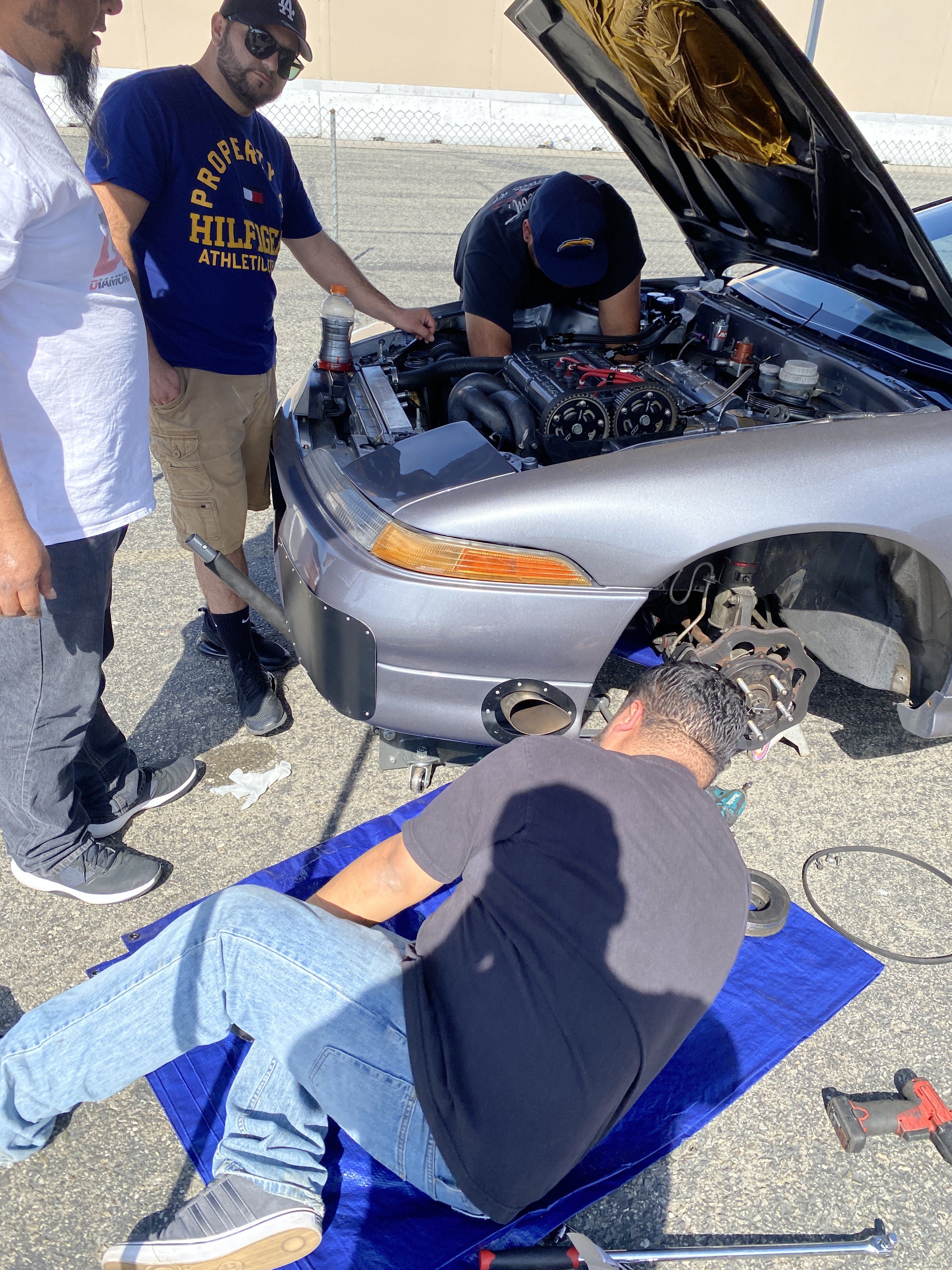

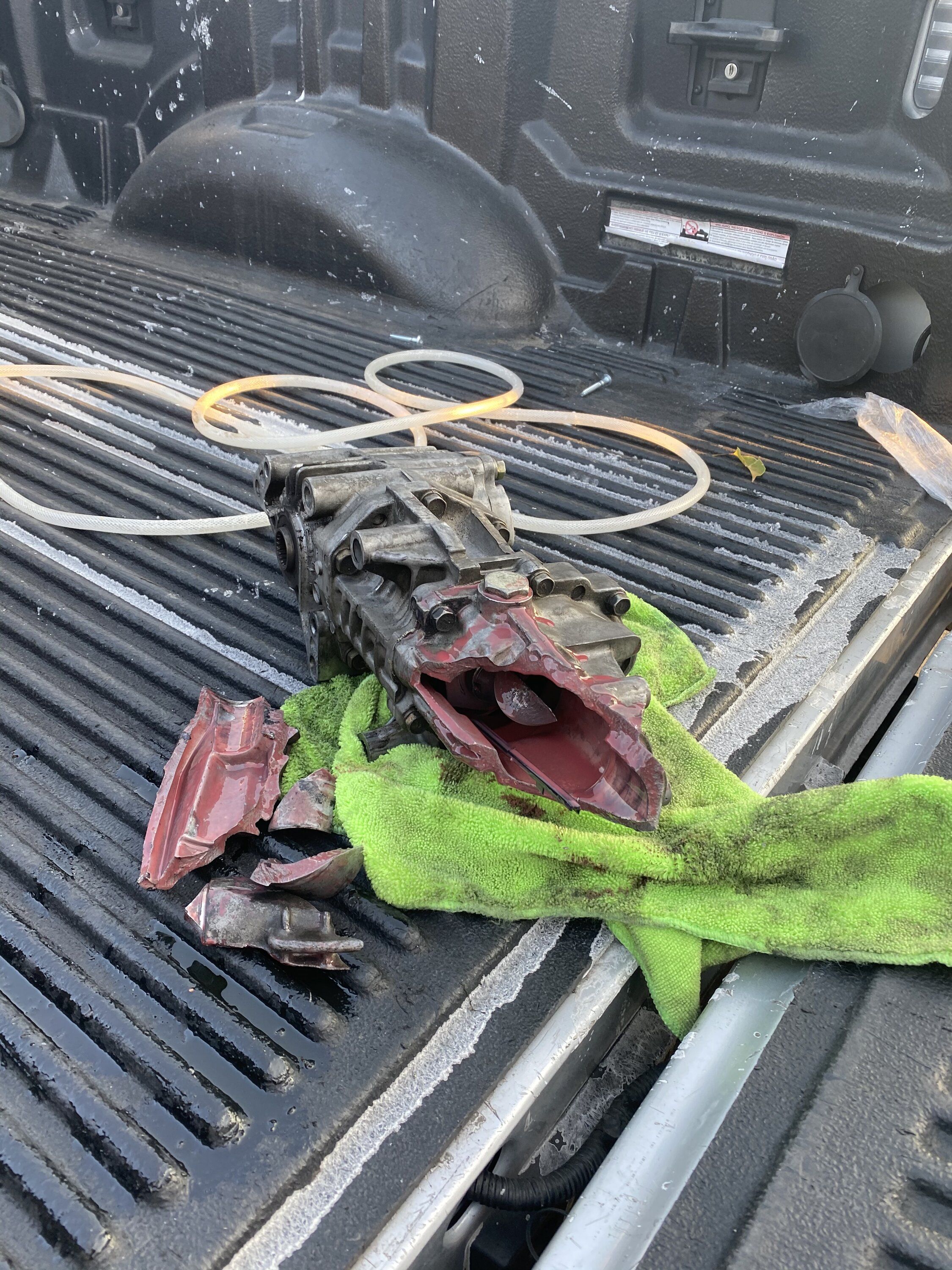

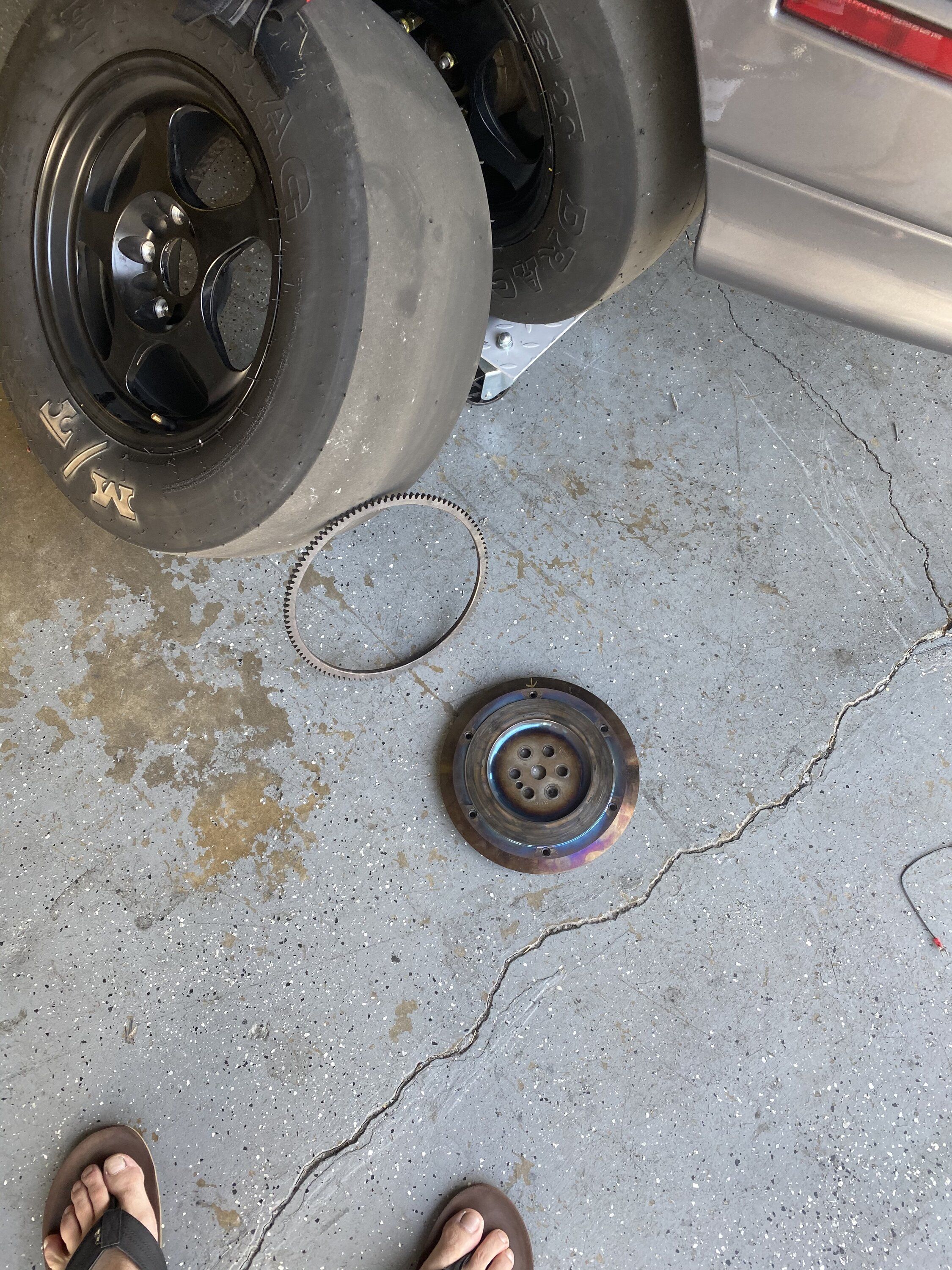

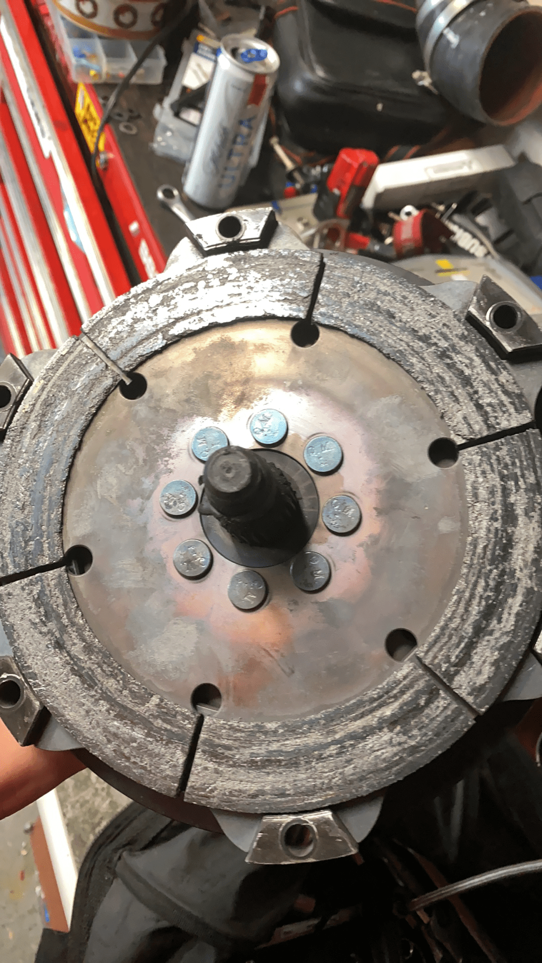

Tim Zimmer came in clutch on the new clutch set up he has coming !
That sucks Frank, sorry to see this. That's some pretty serious carnage. Hope you're able to get it repaired before too long.
Thanks. Just waiting at this point the clutch is 3-4 weeks out gives me time to reset and do some maintenance
