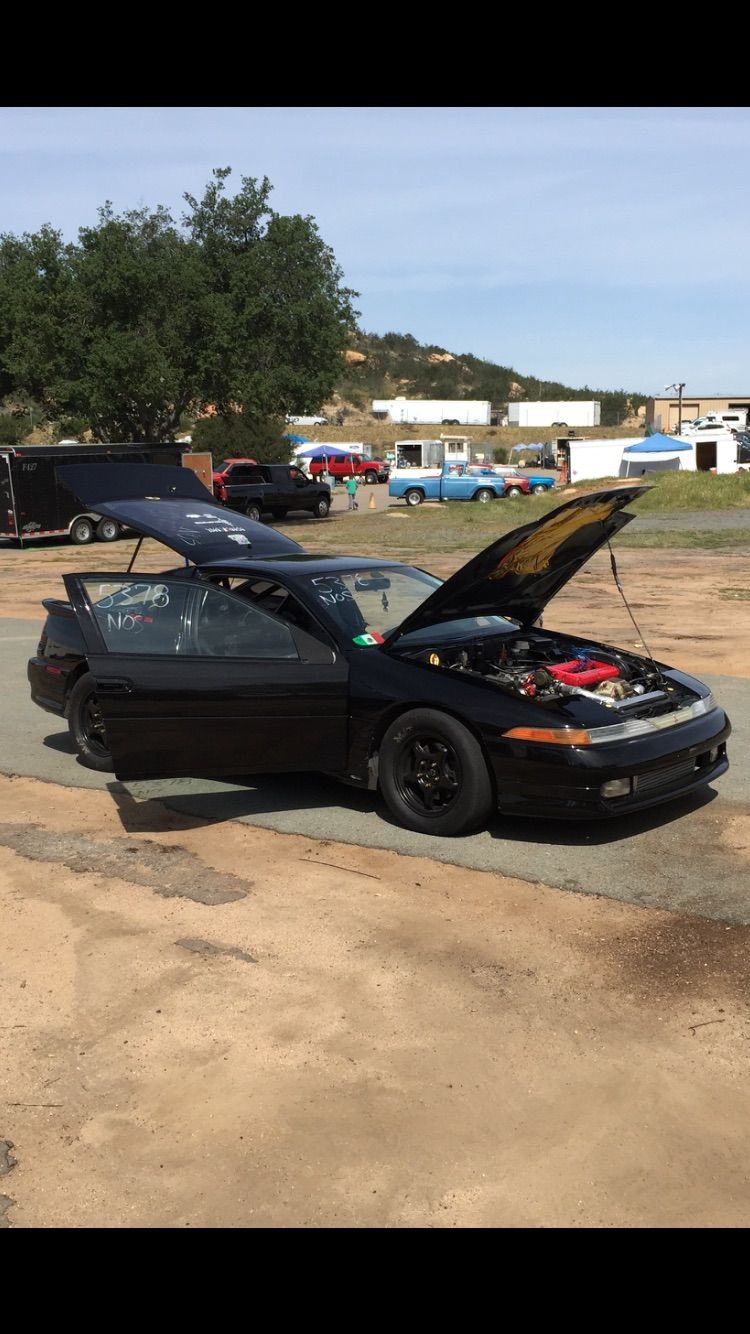

Awdmonster drag car

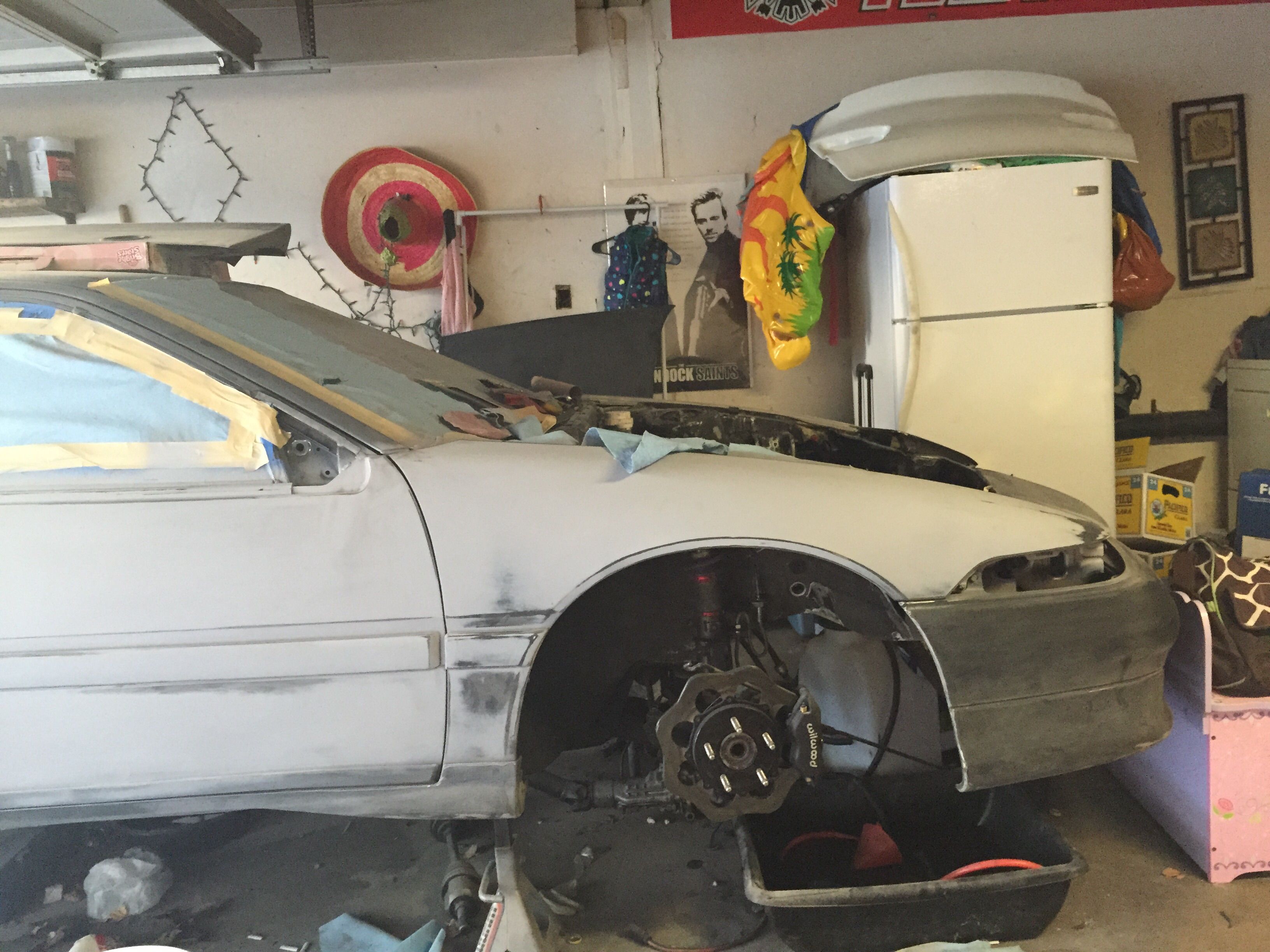

They used to be a street car but now I'm turning it into a dedicated drag car
It’s been a while since I’ve updated here but we have a few things in the works
My engine is getting ready thanks to Ted Spec
Going with the same spec full fill this time dry deck
I’ll be in the process to take more weight out of the car.
Here some pictures

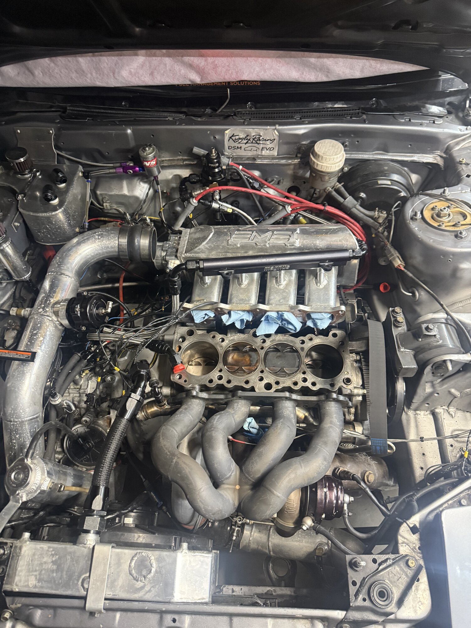

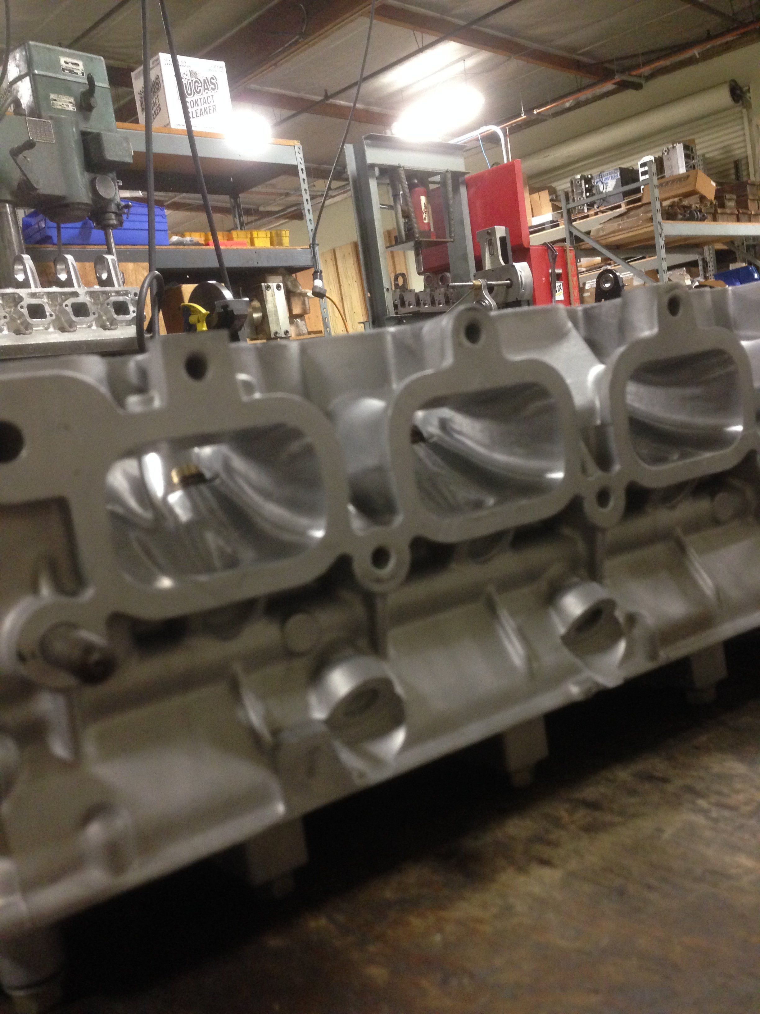

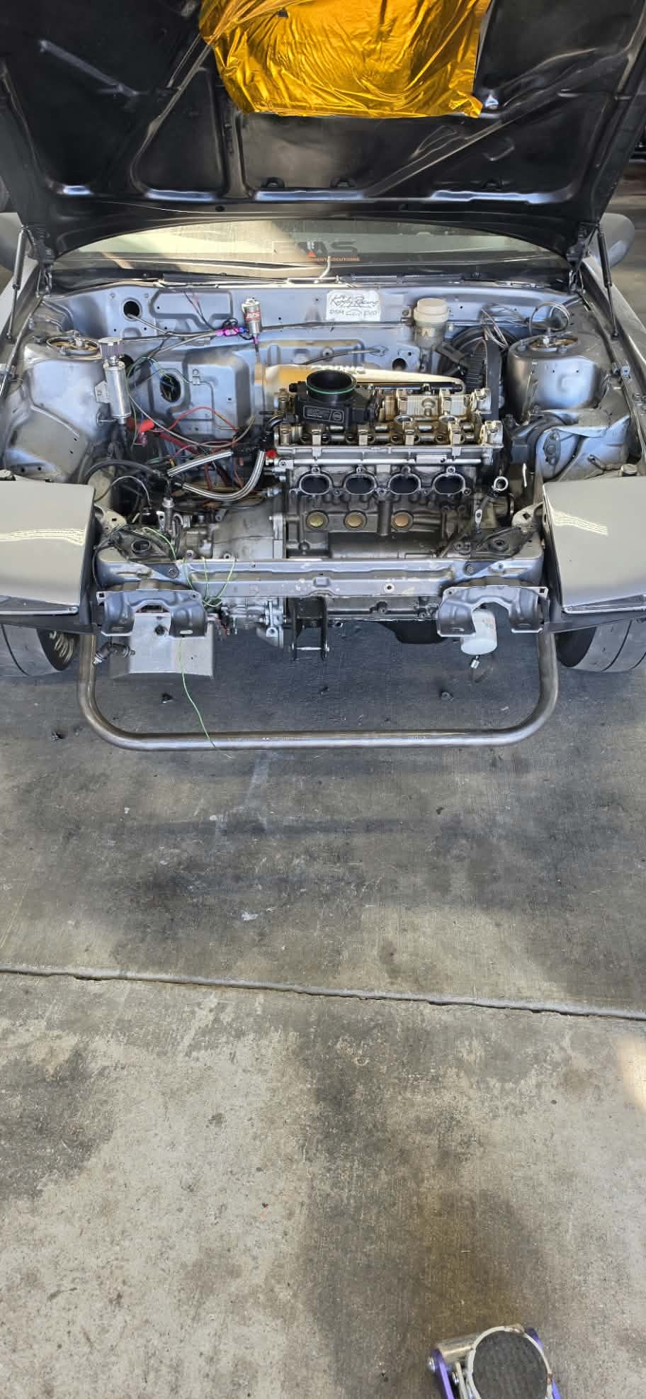

The engine bay without a head and yes cylinder 4 has a crack. Not bad for 7 years ..

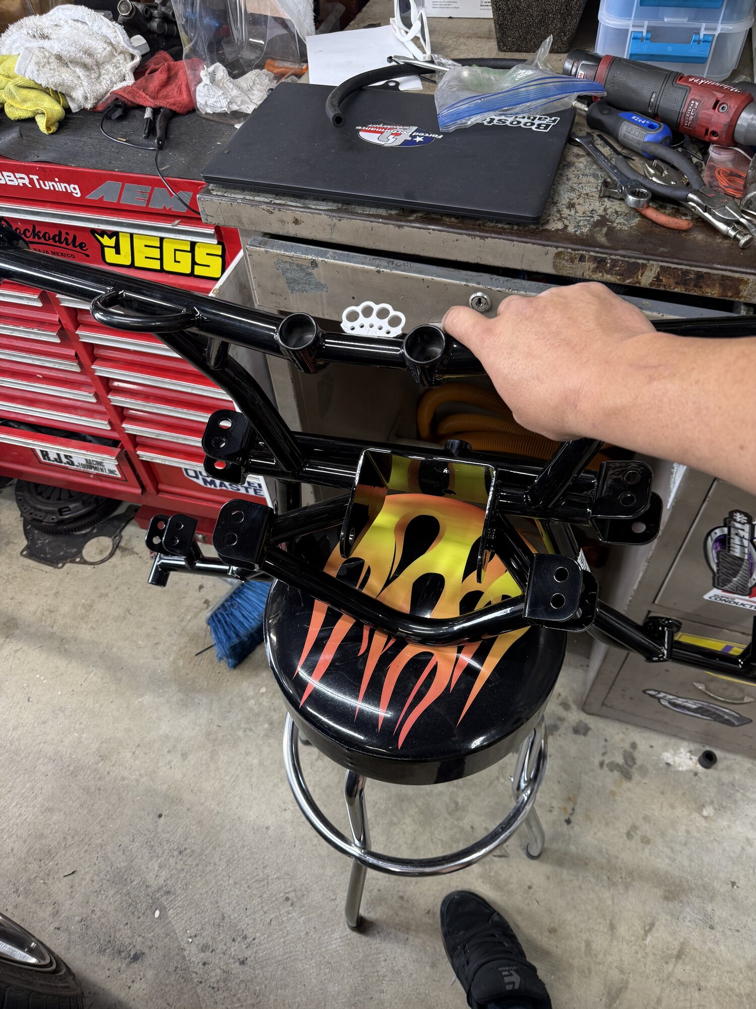

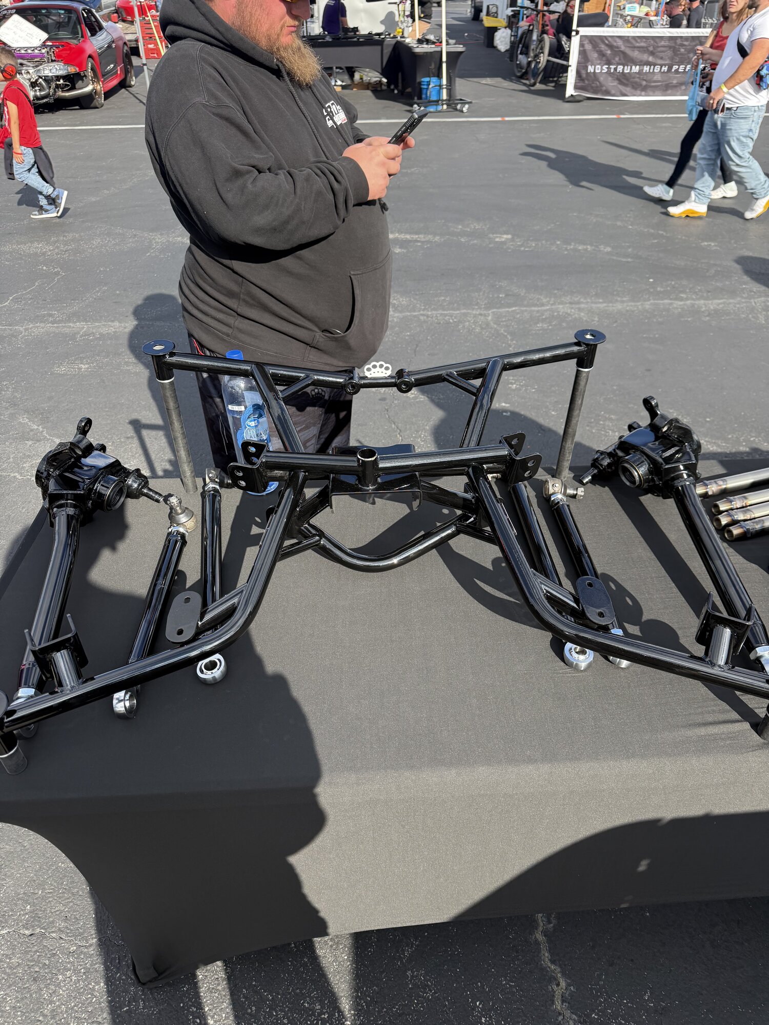

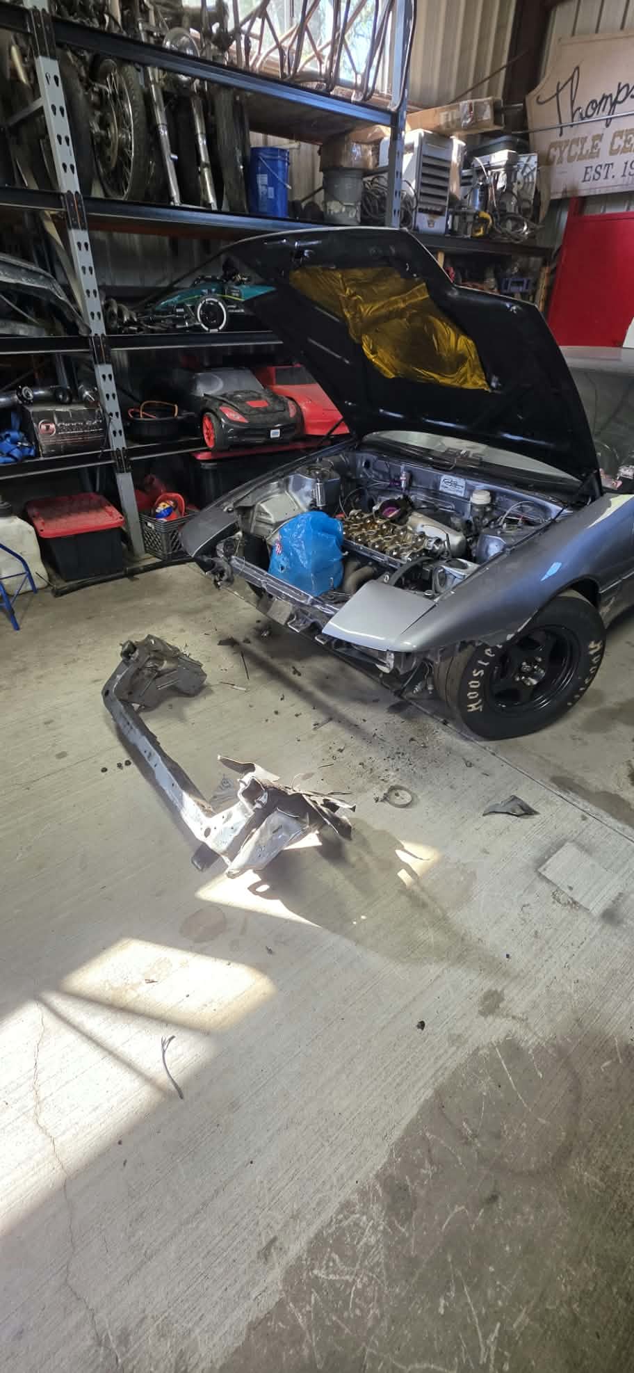

The subframe thanks to Paul at Natefab makes great pieces for our cars got one at the shootout this year.

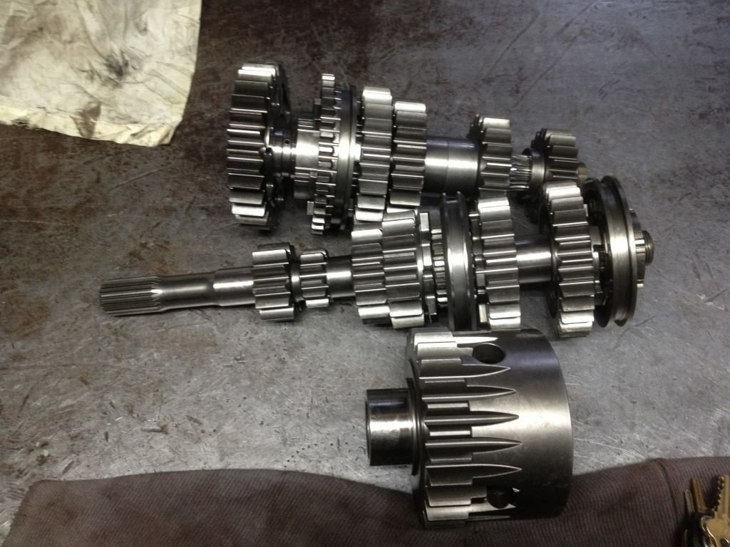

How’s the Trans been holding up? Any pieces of advice for a future auto guy LOL
With both billet drums it has been good unfortunately with the block cracking i was not able to put on this setup hard enough. However I do feel like ill handle 1000 plus hp

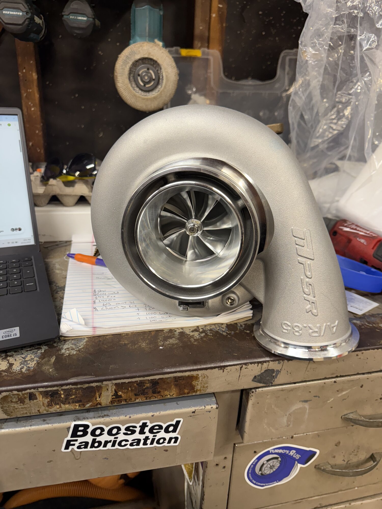

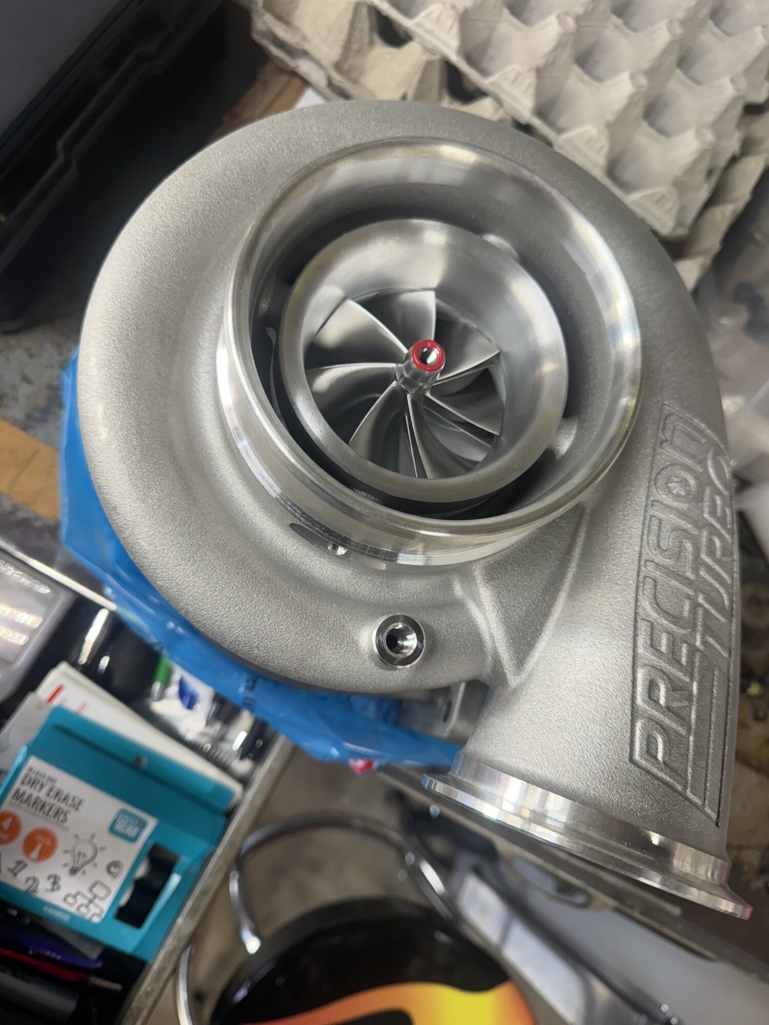

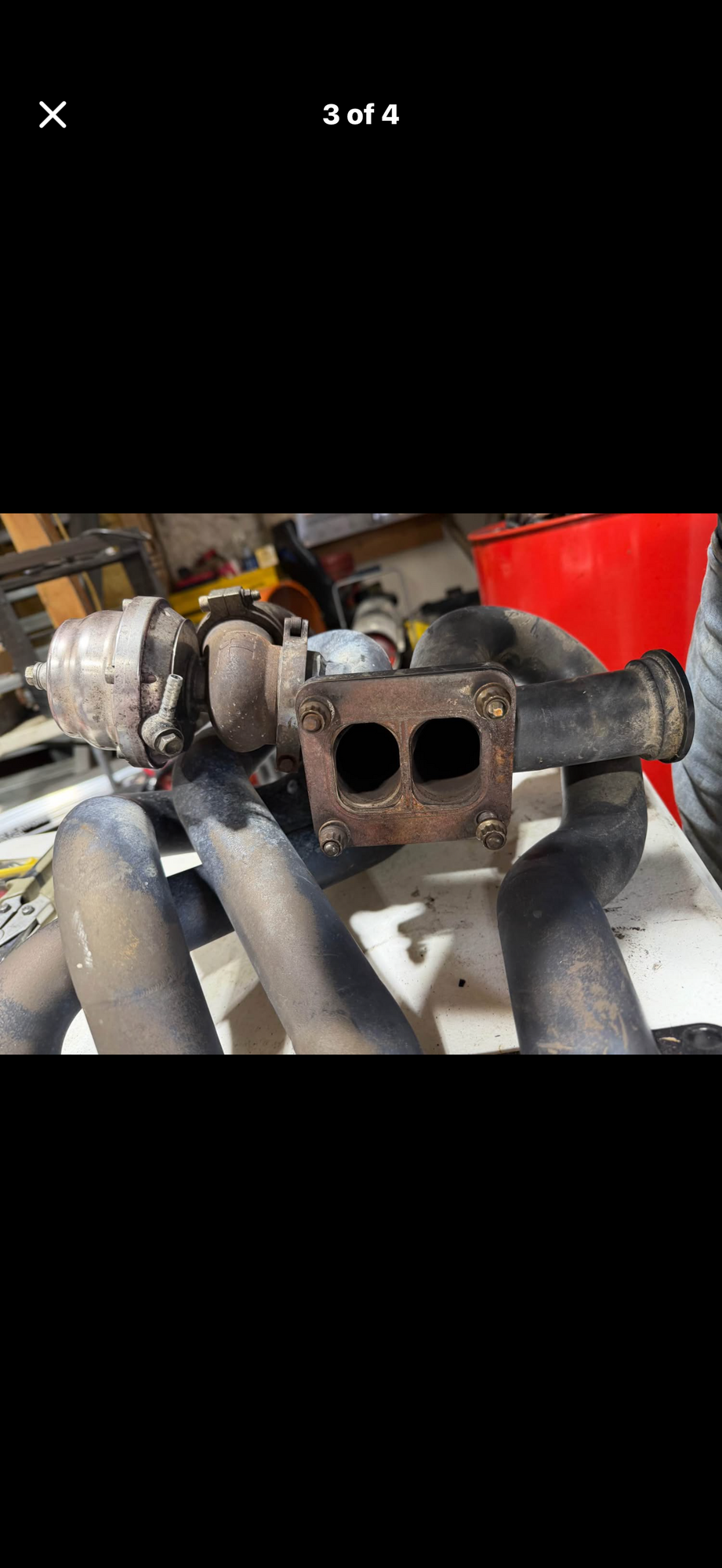

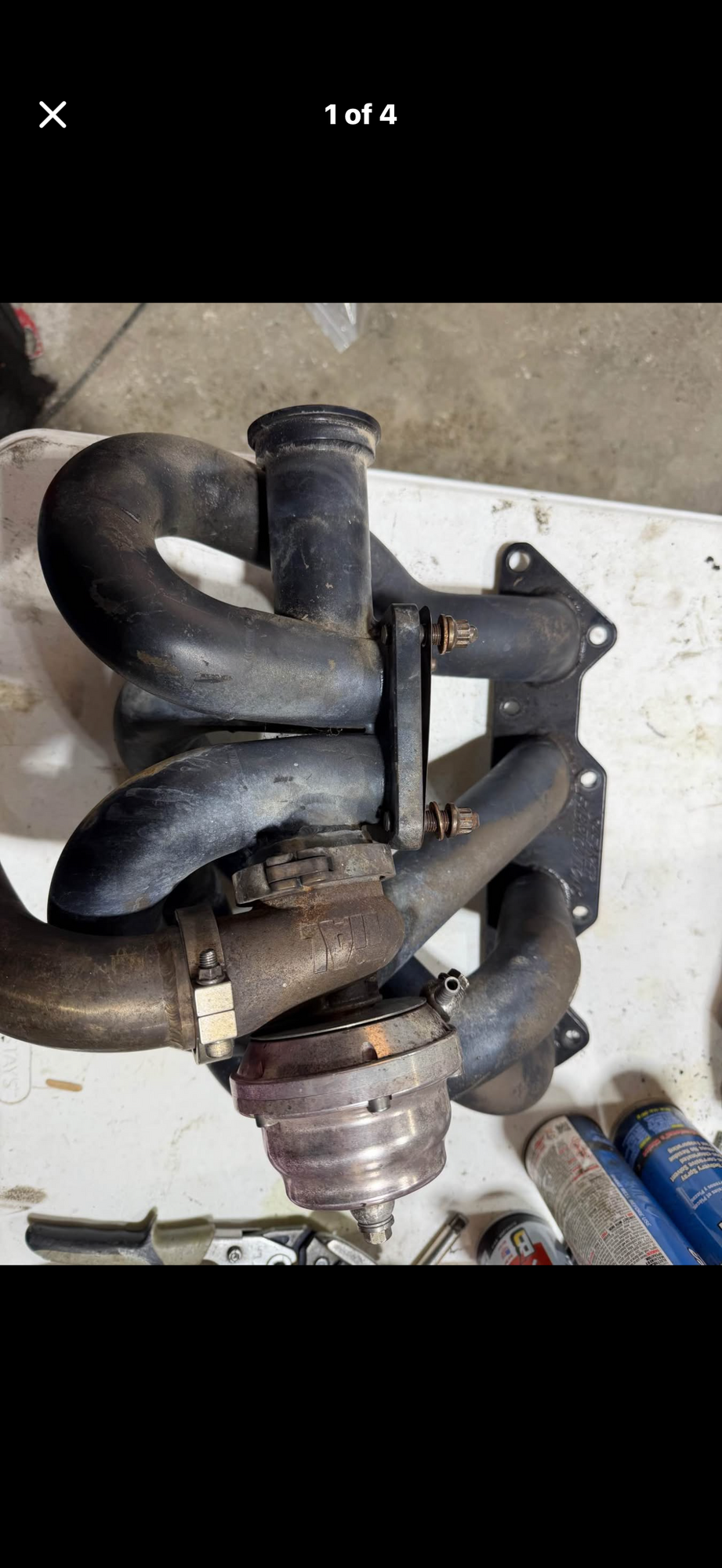

Got a turbo as a gift from my friend David (Uuhh son ) I guess it’s time for a new manifold I’ve contacted Matt Morrison to make make me a good unit I’m excited about the new header.
I’ll be posting more update as I pull the engine to need more of the wear and tear.

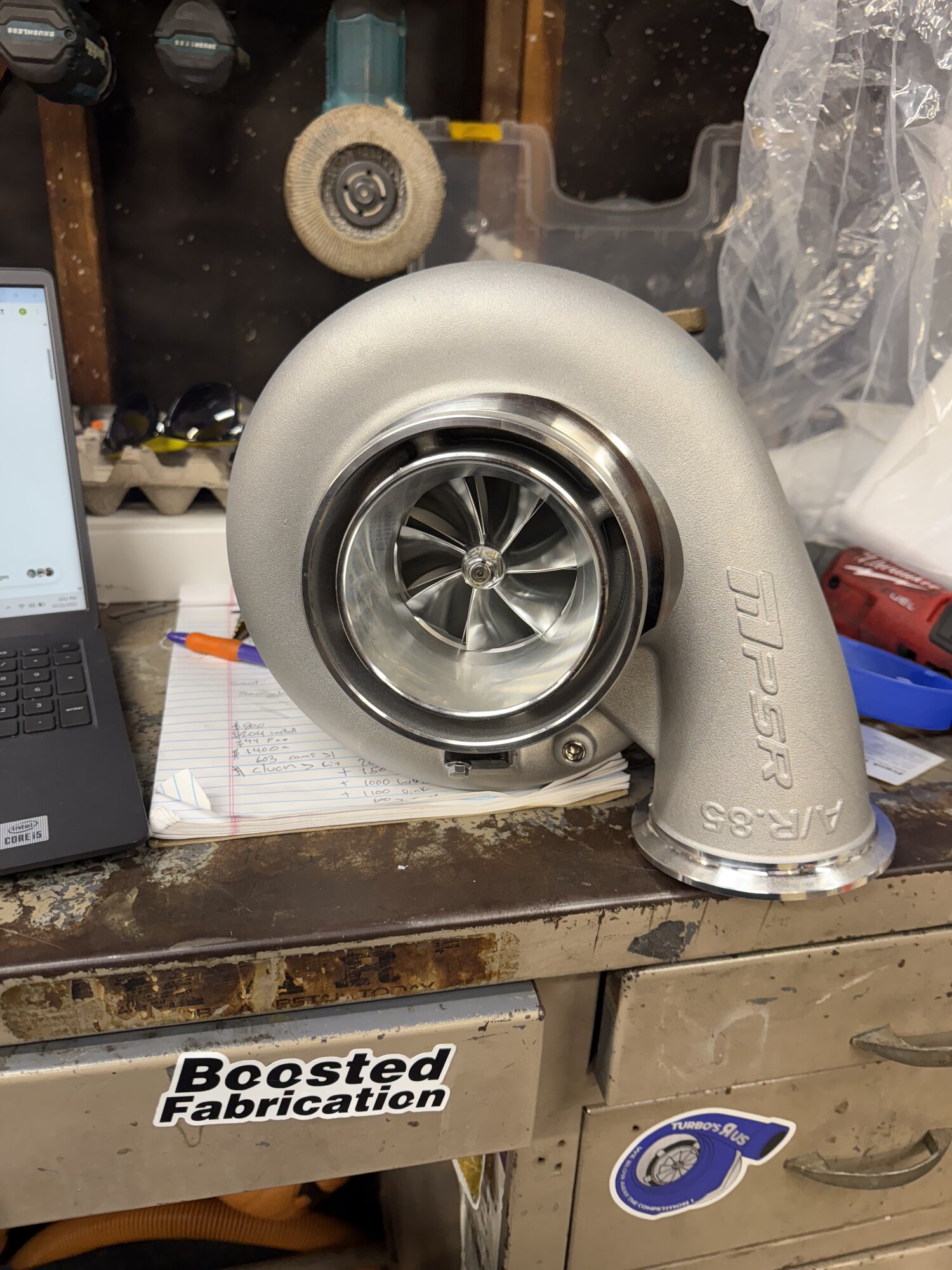

That's a big boy. What is it? I have been considering some of their stuff for my other car. Setup is looking good.
It’s a 7685 t4 twin scroll

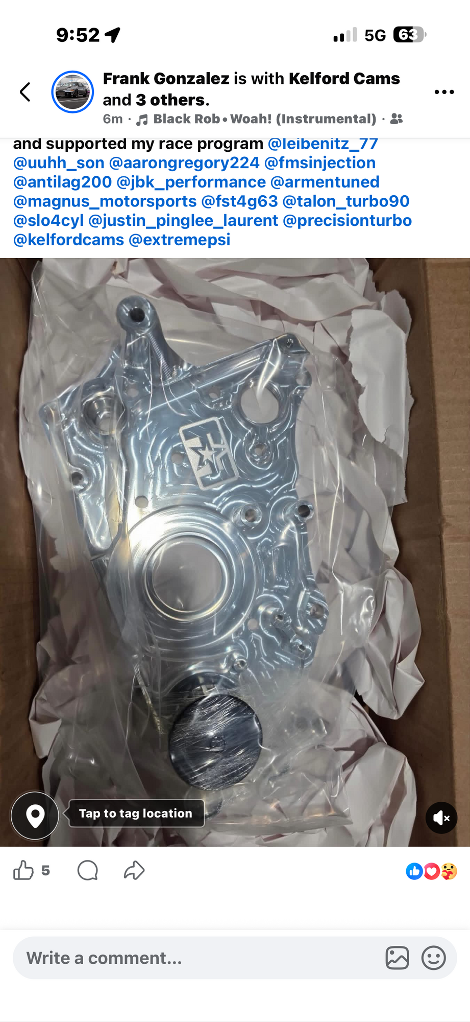

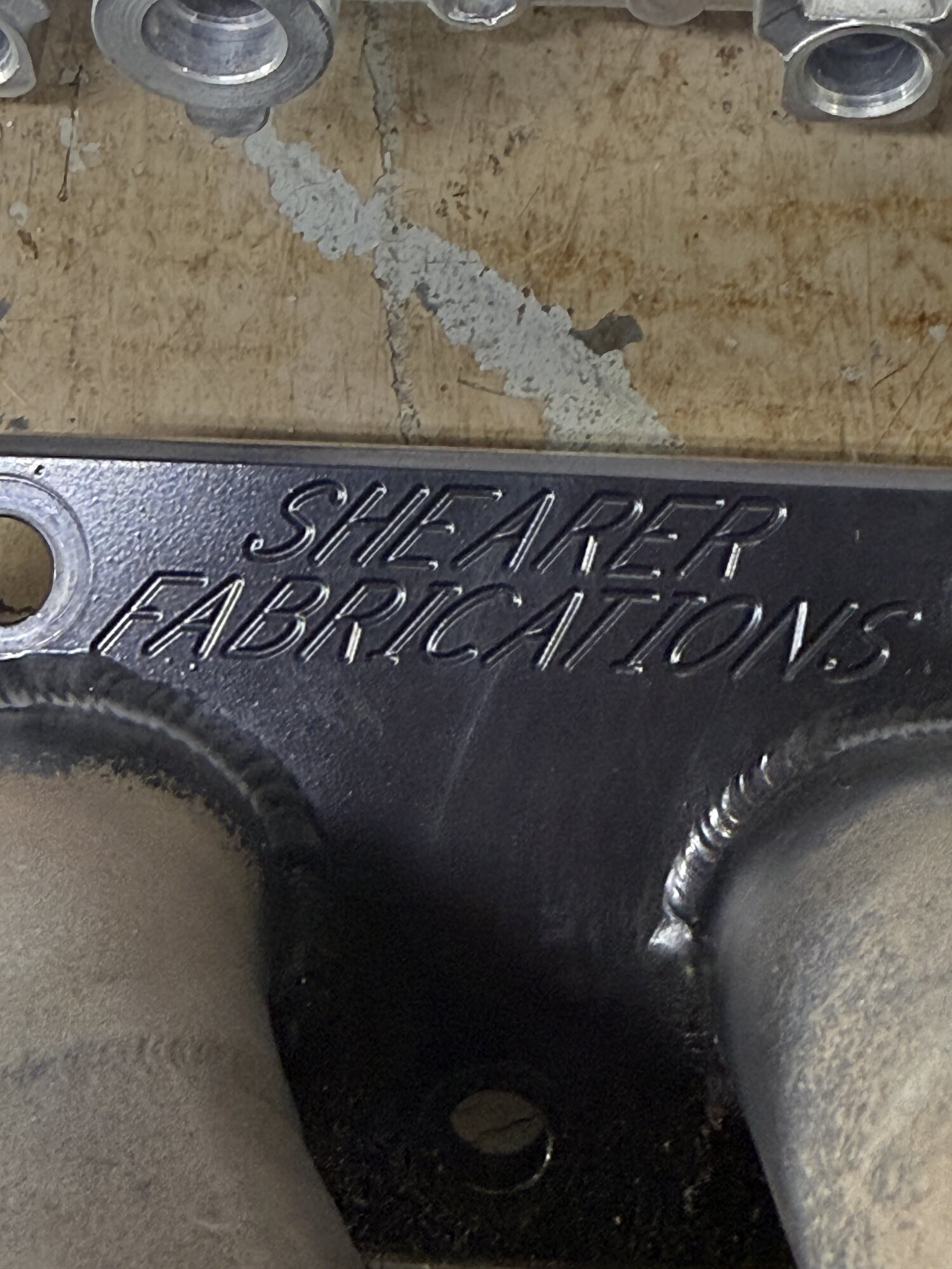

It’s been a while but as some folks know I’m waiting for the engine to be done. We did get some more parts like front line oil pump and next gen 73.9 85
Top mount manifold sheerfab. Once the engine is complete I’ll post more updates as I move on.

Thank you I’ll be at the shootout visiting all the homies after that it’s work time going to the fab shop in Utah to get my car ready
Looks like me when you give me a gas powered cutoff tool. I cut the front frame off of a 80's Camaro to use the subframe after my son crashed the car I built that was toooooo fast for him in HS. ROFL I wanted to cut more stuff, it was FUN.....AND DANGEROUS! :oops:
Yup. Don't give me a plasma cutter. I'd go way overboard.
That is what I used to cut out the back support beams on my crash bars on my 1g's for FMIC's. Super fast compared to a cutoff tool. Those things are super handy, I borrowed that from my best friend.

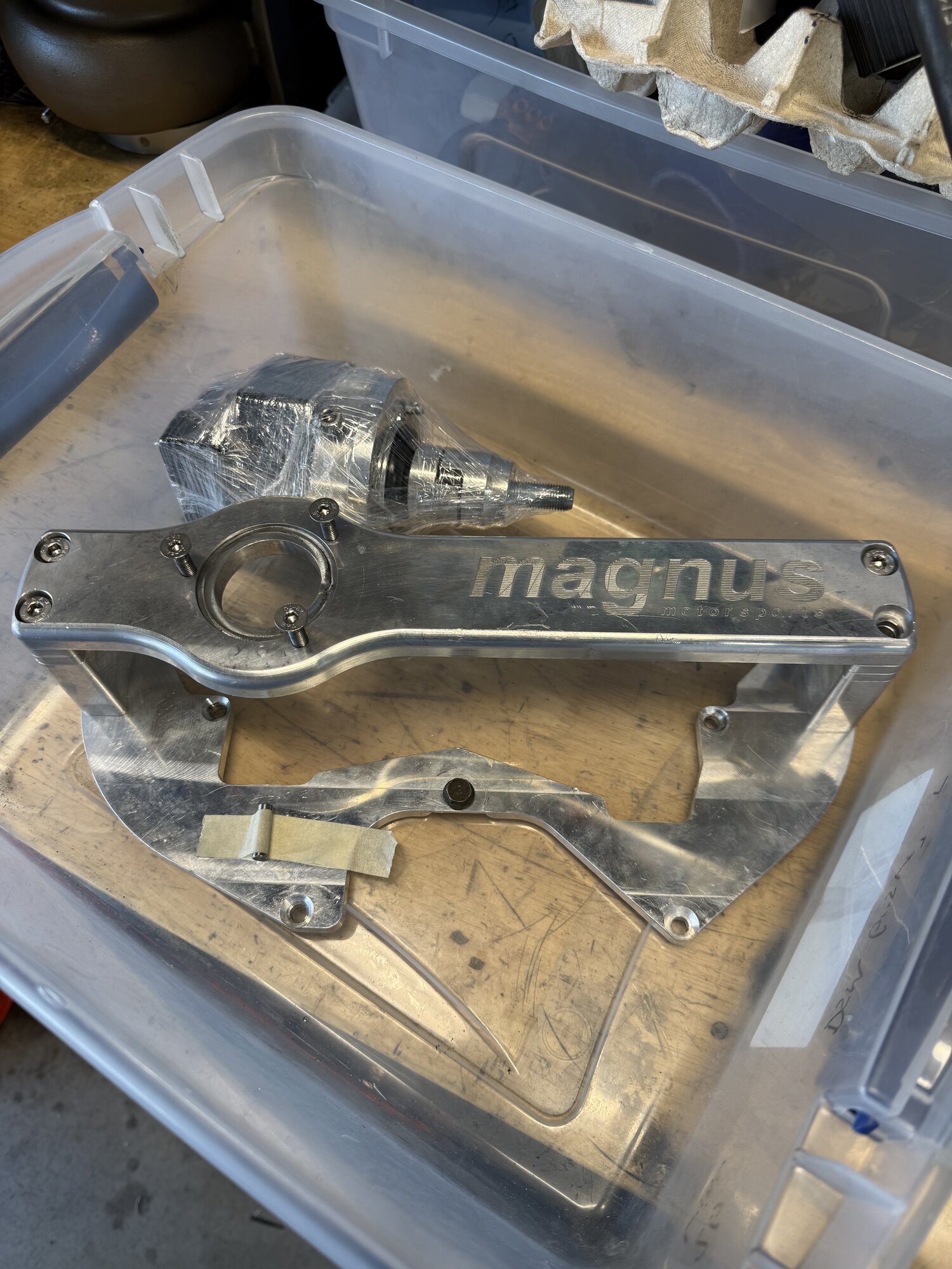

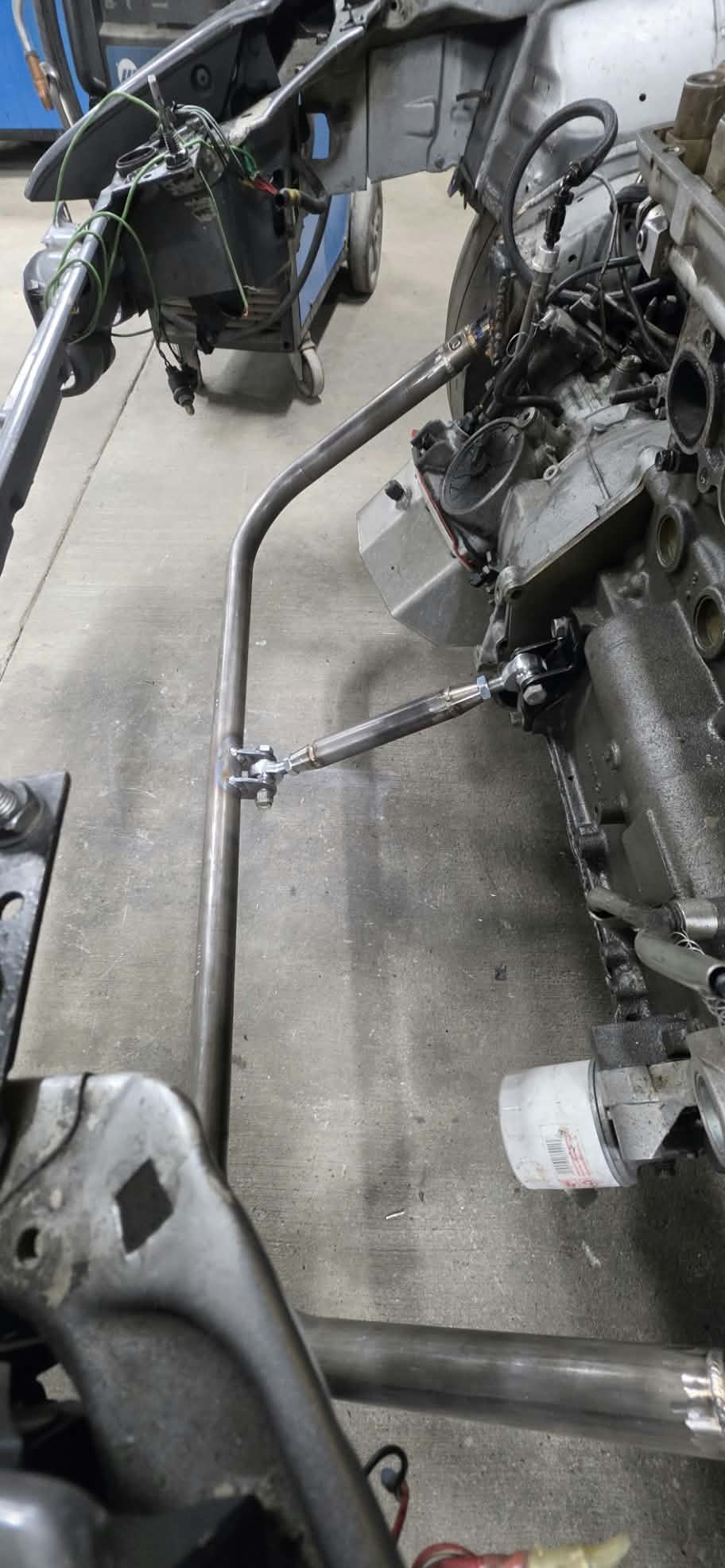

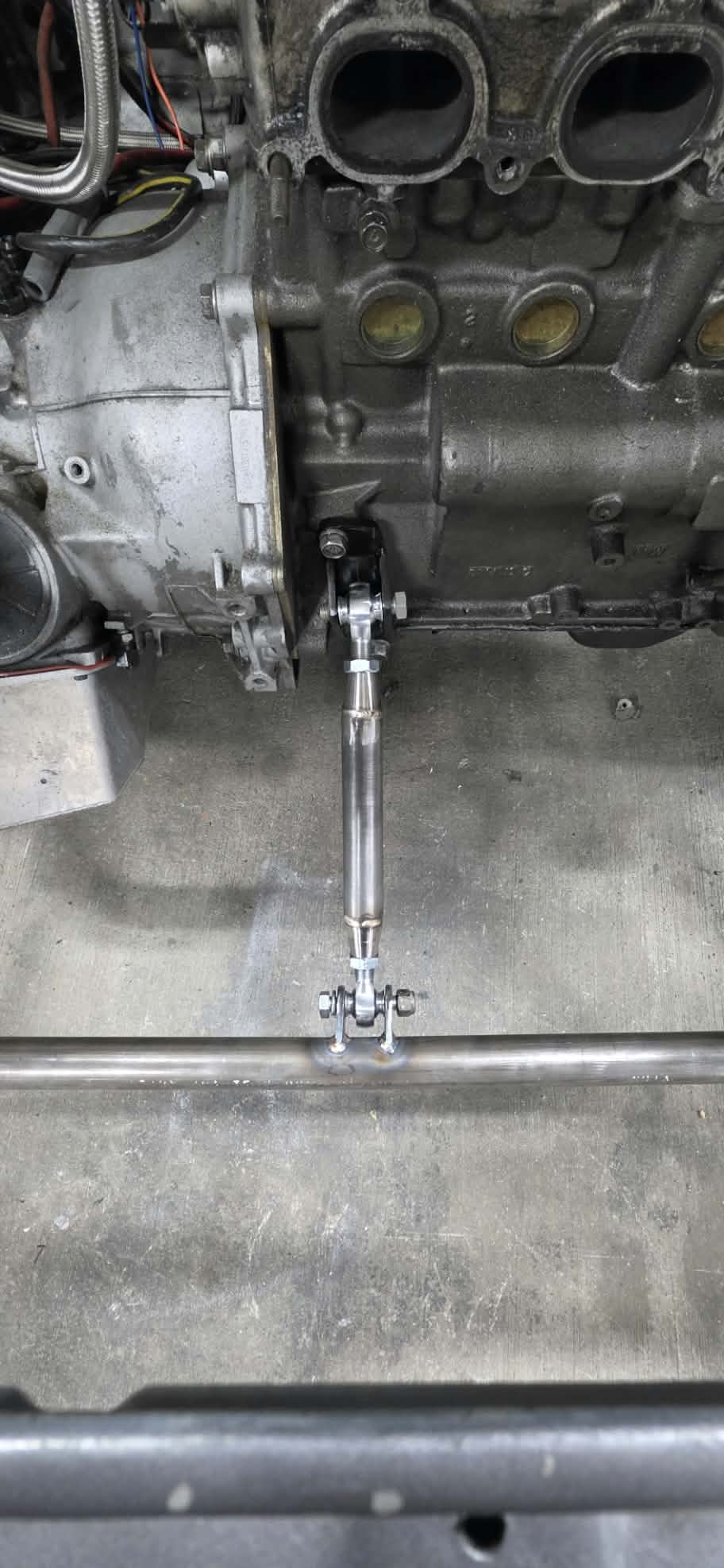

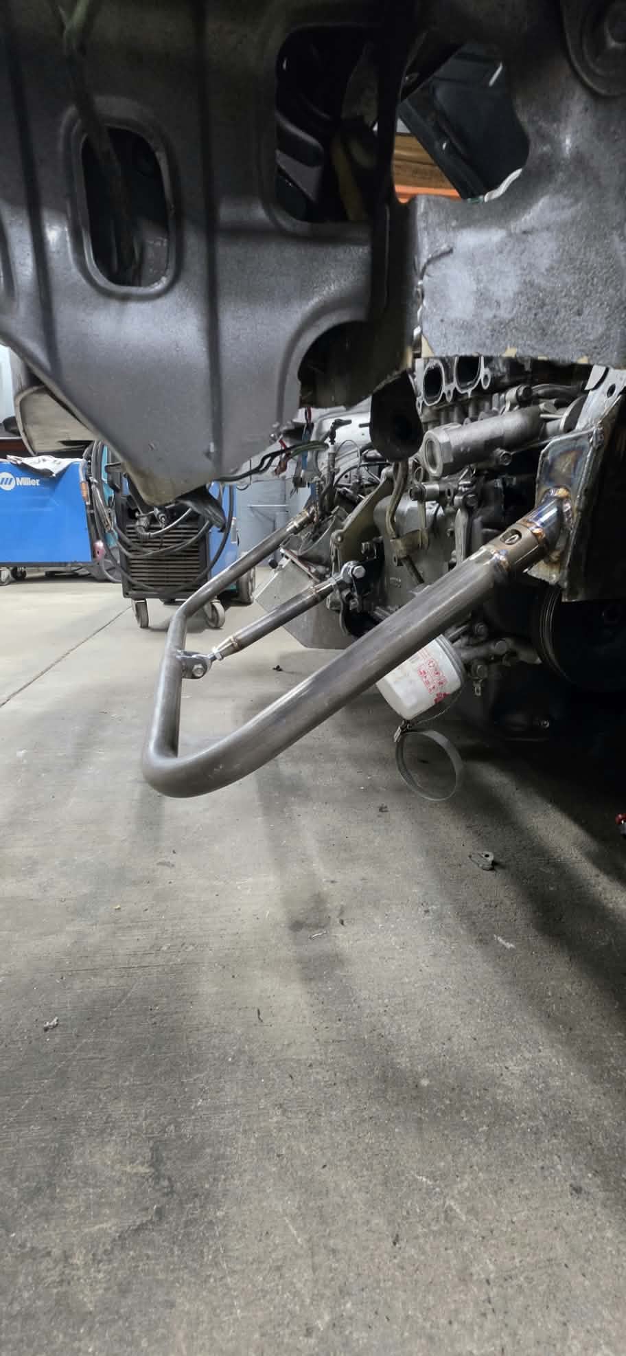

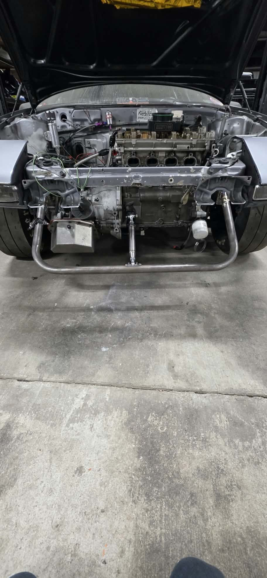

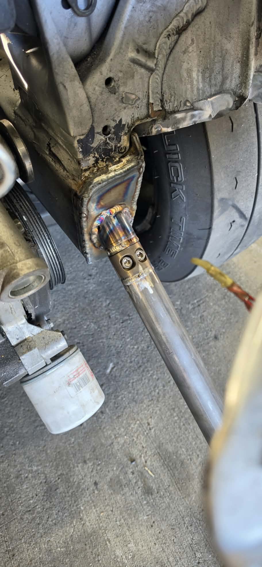

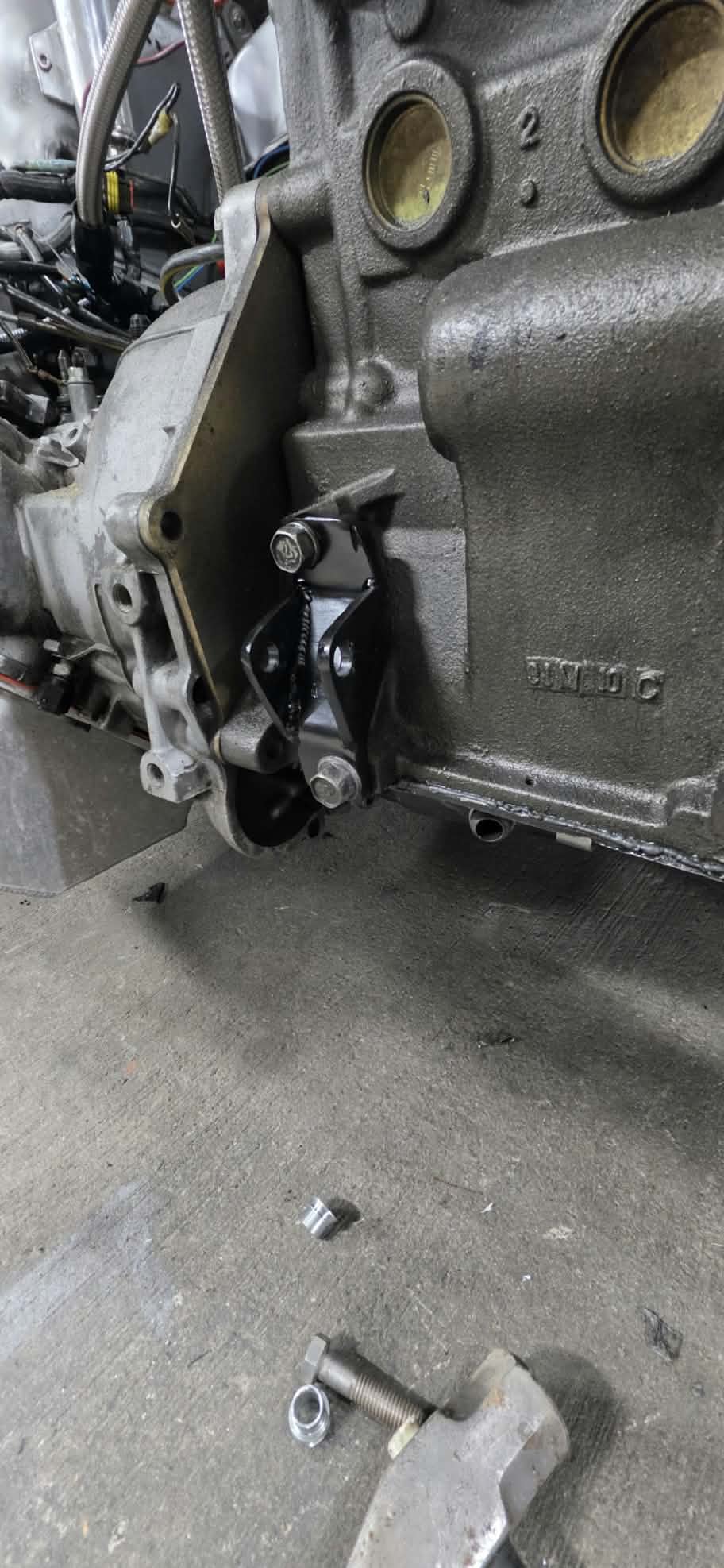

Two wheeler for coming out nicely, we made it removable for maintenance purposes with a Heim joint on the motor mount.

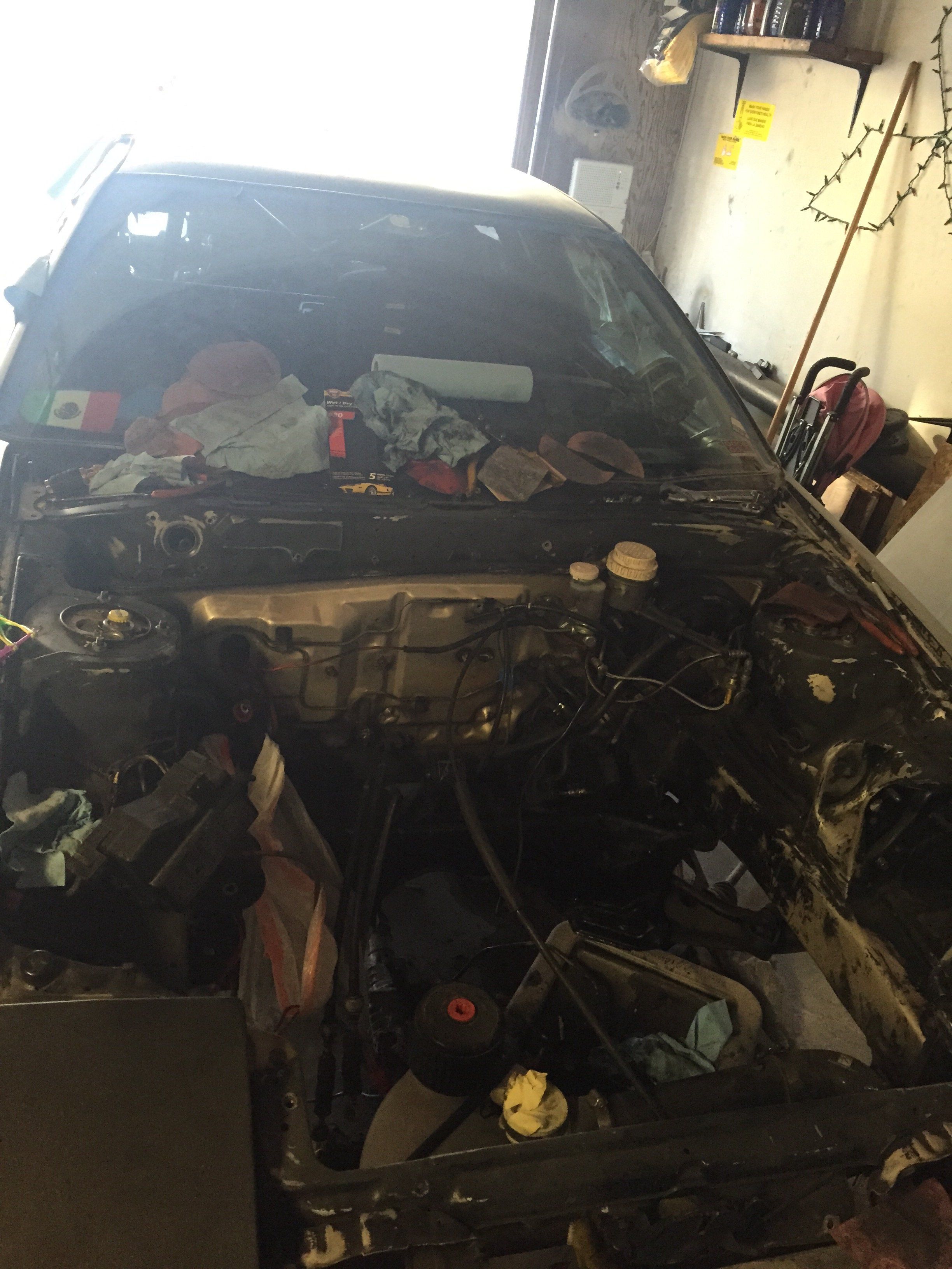

I need to look at my drag chassis and see how bad it is put together or, perhaps it is done reasonably well. I got it home and then focused on a heart first. I like that front end 💯👍
This makes me want to really go and get the front end tubed on my 2G… :cry:
It makes a lot of room the reason why I did is because I’m adding front fuel cell and making room for electric water pump
