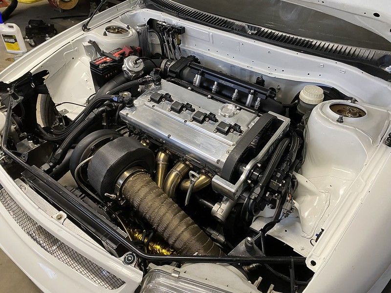

Switched to a small cell up front as I was experiencing pressure drop issues with lots of Gs.

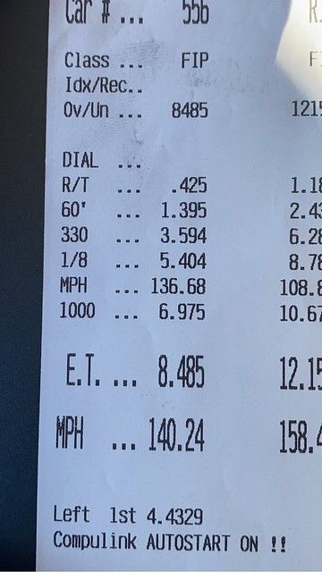

Car went 9.2@150 which is a new personal best at west salem IFO (placed 2nd). Didn't get enough runs in to get the 60' knocked down from the 1.55. Best MPH was 155 (still on the S363).

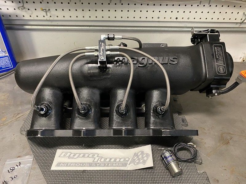

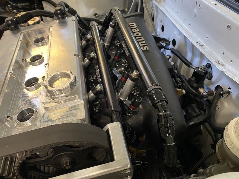

switched from a single nozzle wet kit to a direct port

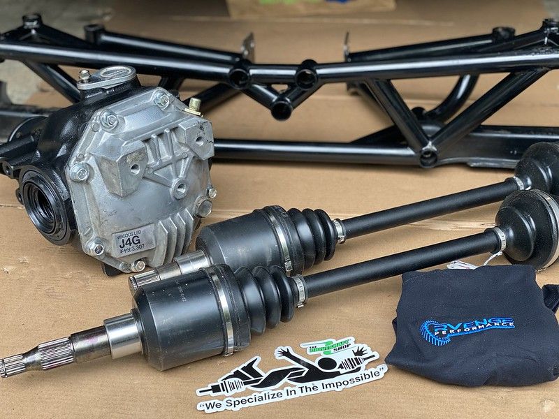

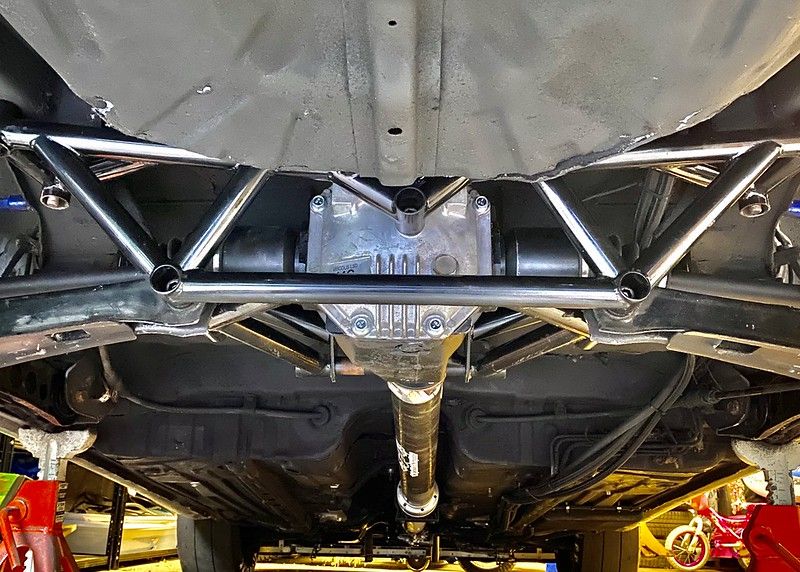

Upgraded the rear axles to DSS 300m and had the rear diff inspected/refreshed while it was apart

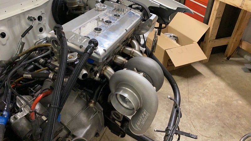

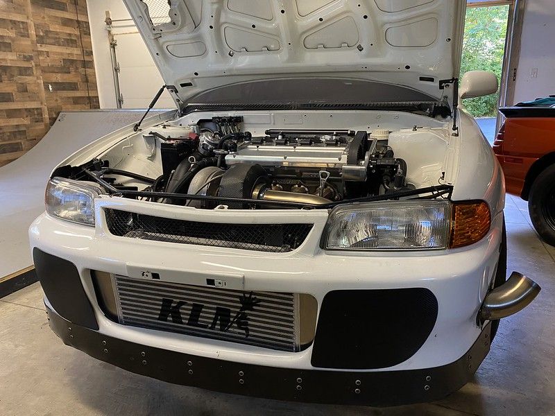

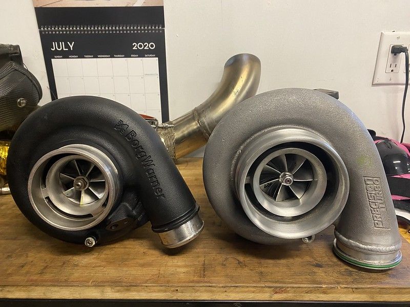

Gen 2 7285 going in to try and run the wcf super street min ET of 8.50 for stage 2 registration.

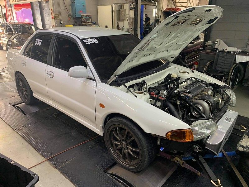

Dialed in the 7285 on the dyno and then went testing at the track. It went 8.68@166mph but was not able to get the 60' down due to a small nitrous issue. Should be heading back in 1-2 weeks to get our 8.50 min et goal.
Congrats! Huge jump from the BW 63mm. Plenty more room to go.
What boost and nitrous was that run? Dyno numbers? Also, what base fuel pressure?
Thanks!
The run was 53psi and some nitrous to the 1/8. Car made 617hp on a mustang dyno at 58psi (my car never reads high on dynos LOL). Base pressure is 70psi with a single set of 2150s.

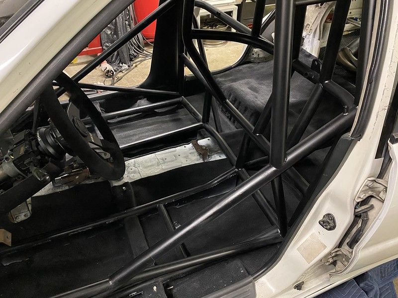

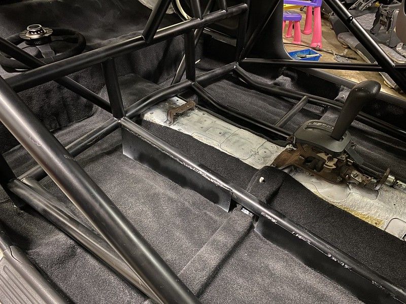

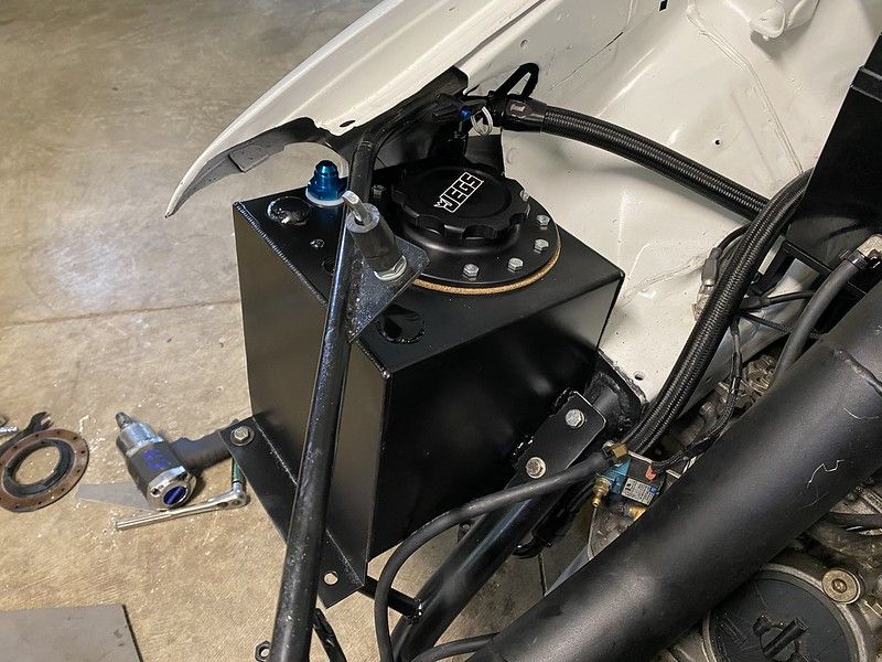

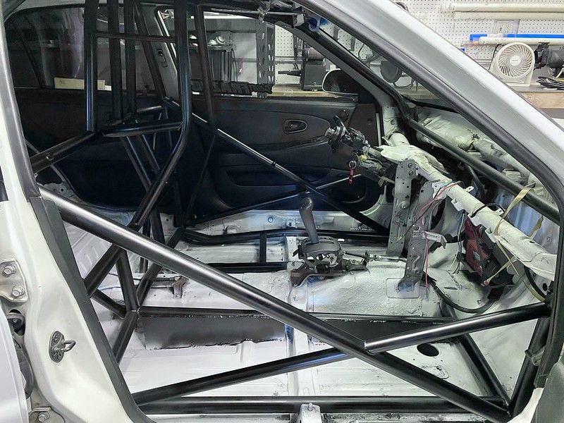

Painted inside and then installed some carpet.

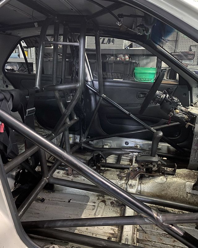

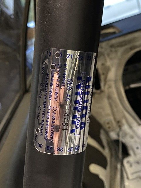

Cage certified

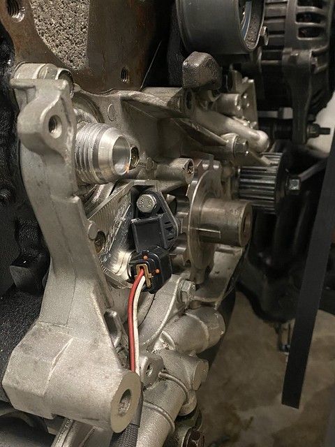

Went from the kiggly 2 tooth to the 12 tooth kit

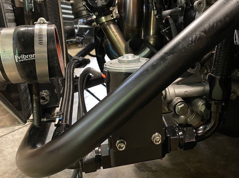

Electric water pump installed and plumbed
8x dekas installed and plumbed

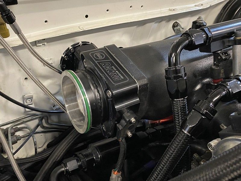

Switching to a Fueltech. I went with the FT550

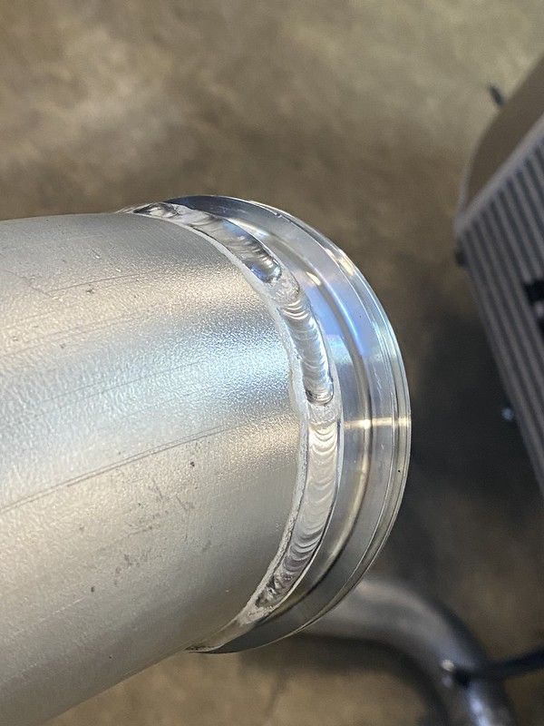

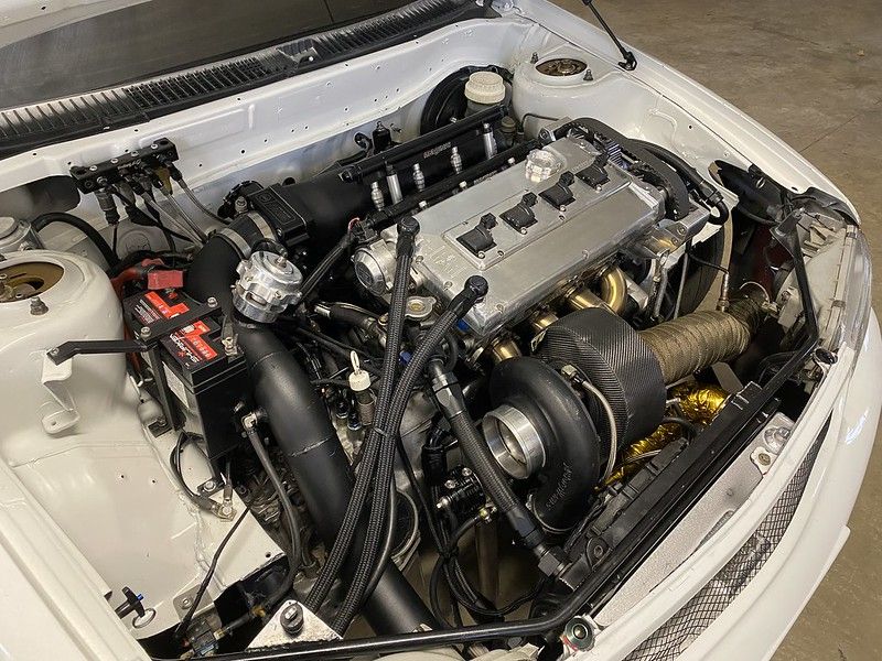

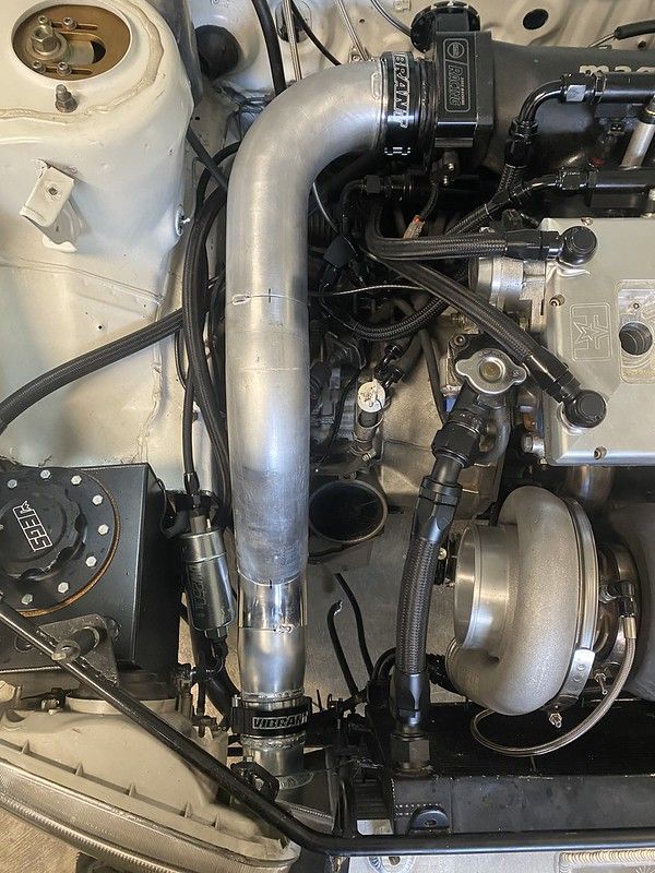

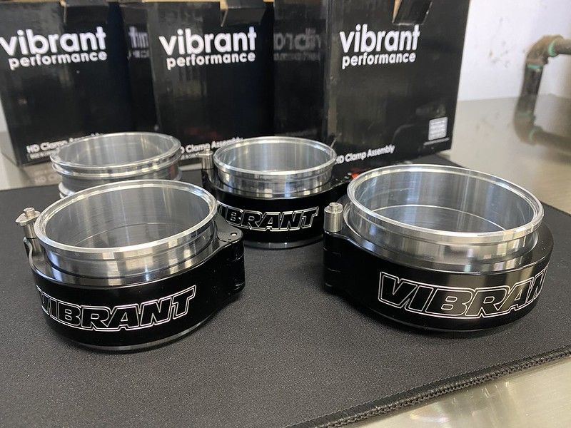

Do you worry about the non-silicone connections not providing any flexibility under engine shifting?
These clamp assemblies offer a lot of flexibility, allowing the pipe to move a little over 3/8" while still sealing. It also helps that my front engine mount is solid (watching the car on the dyno, the engine didn't move at all).
