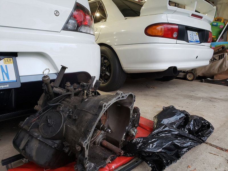

I picked up this car in spring of 2018. It has been 9.7@152 and over 200mph in the TX mile with a built 2.0L and S475. I purchased it with a busted transmission (stripped 4th gear and non-working clutch). The car ran great otherwise.

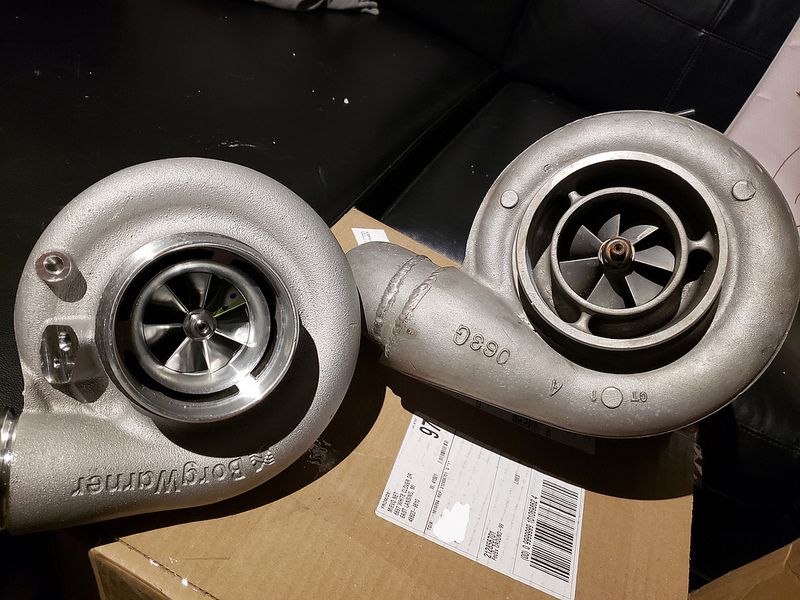

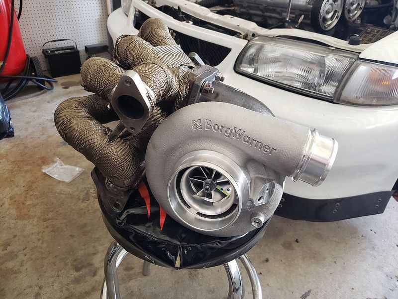

My goal is to keep it in street trim and run high 8's with a 62mm FIS legal turbo (Borg warner S363SXE). The car will go under the knife for the auto swap in fall of 2018. For this season, I am repairing the existing 5spd and having some fun with it on a S363.

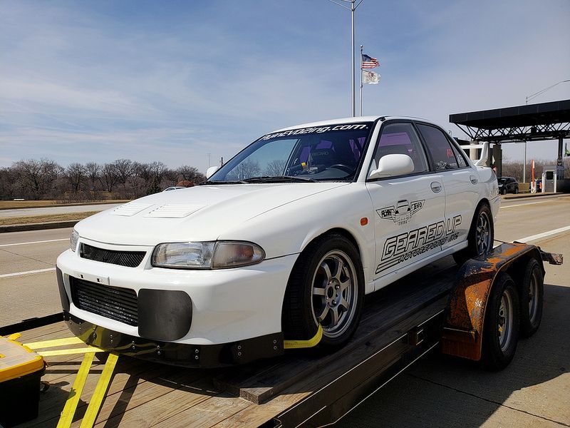

Hauling it home:
S363 SXE sitting next to the old S475.

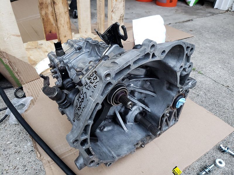

I had Kurt @ White Shed Speed (bastarddsm) repair the transmission. That guy really knows his stuff!

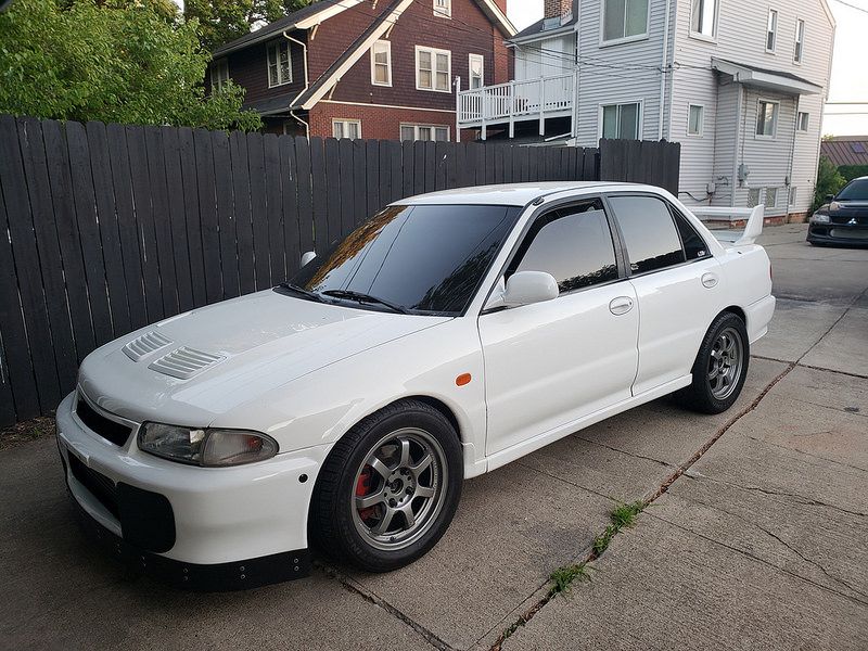

In the mean time, I removed the vinyls and had the window tint redone with new ceramic film.

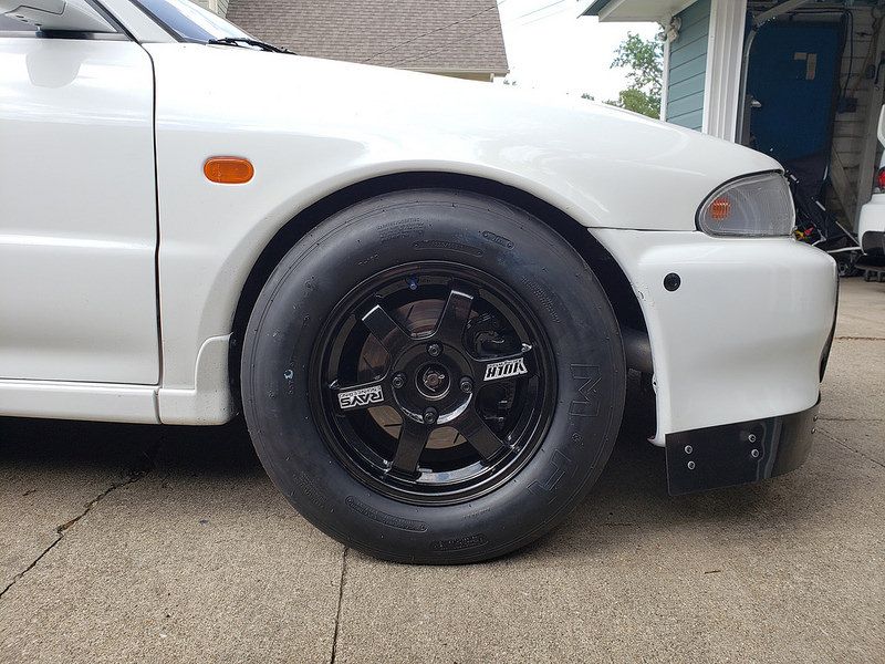

Lastly, I picked up some 15x6.5 TE37's (8.9lbs each). I had them powdercoated and wrapped in 235/60/15 M&H DOT cheater slicks.

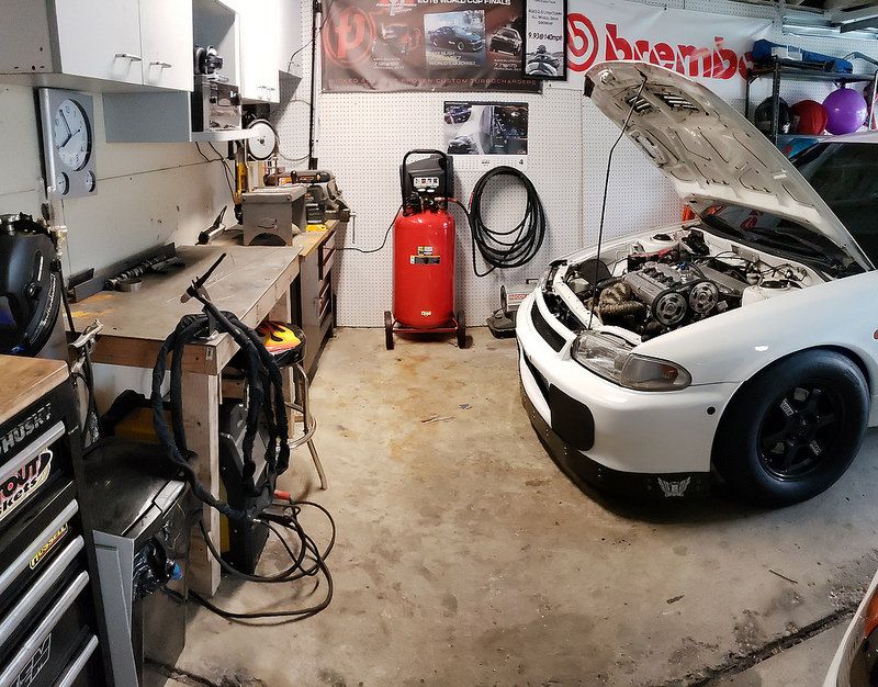

It kinda sucks that it's finished. Doesn't seem like there is a lot of work to do?
There is a lot of work to do. The entire drivetrain is stock minus a few things in the trans. The Auto swap will be happening this winter included a good chunk of other things below (hopefully)

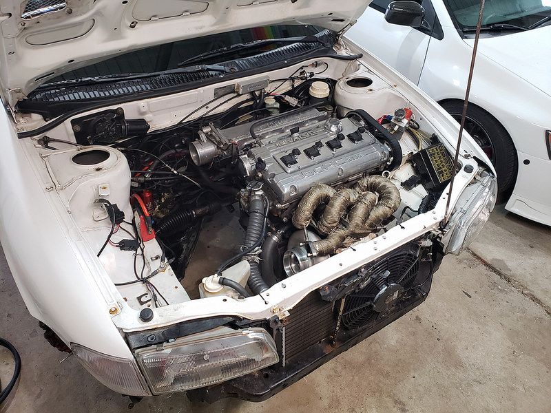

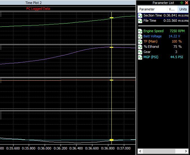

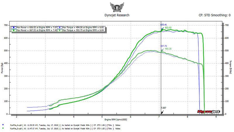

So the Shootout is coming up. I have done some preventative maintenance and had my dude John Whalen tune the car. It feels pretty damn good and I won't be surprised if it traps 150. The plan is to race it in the 9.5 Index or Street eliminator class (I haven't made up my mind yet).
667/502 @34PSI with blown out end tanks (discovered after the fact).

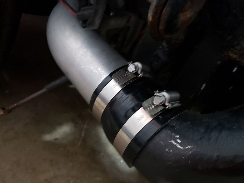

All new 4ply silicone and high torque breezer liner clamps. I prefer these over t-bolt clamps.

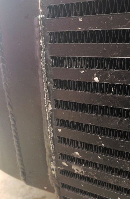

Car is now sitting at 44lbs and feeling pretty good after I welded up the IC. I don't have any numbers at this level as we finished it on the street. I am going to upgrade to a 4.5" Garrett core over winter with custom end tanks.

It seems from the log-picture he is running a Link ecu.

Thank you. The car is on a vipec v44. It is still on a factory CAS with no crank sensor period. Thankfully with this ECU we were able to make up for the large timing drift using a light. A Kiggly 12-tooth setup is in the plans.

Do you have a picture of the rear of your auto?

I had a feeling that I would be making custom mounts for the front, rear and trans which isn't an issue.
I haven't mocked up the transmission yet but I plan on doing that soon.

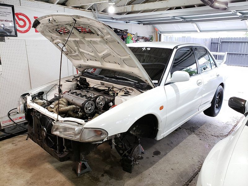

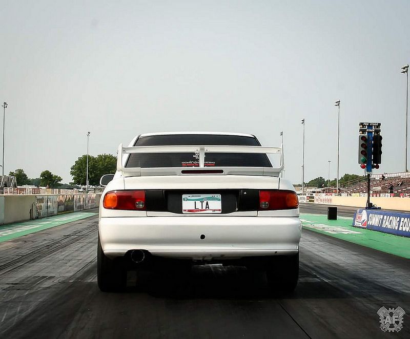

That car was pretty interesting to race with the sloppy suspension and its plethora of other small bugs I somewhat expected with an untested car. If you listen to the first in cabin race, you can hear the rear diff explode half way through 4th gear LOL
I made it to the semi finals in the 9.5 index class and was eliminated by a 1g.
Since the Shootout I've removed the entire 5spd drivetrain and I am currently prepping it for the auto.
