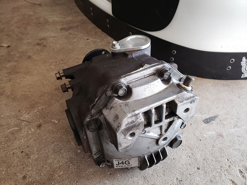

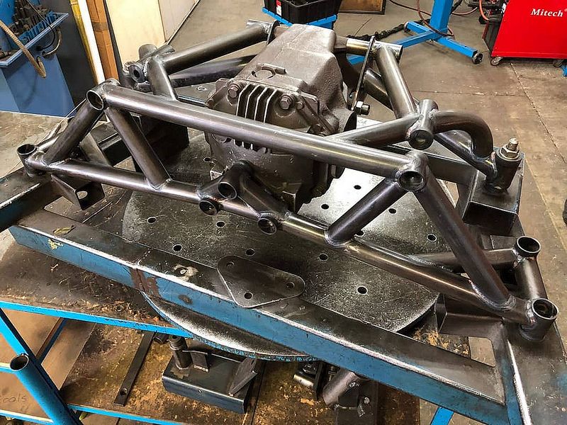

3KGT have 4WS as well or whats that on top? Or just using the diff itself in the evo pumpkin?
That's correct. It's the rear power steering pump for the all wheel steering.
I'm using the entire rear diff in the car. I've deleted the pump using an evospec performance delete plug.

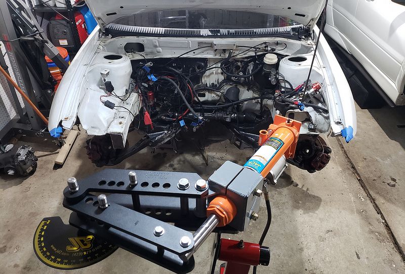

Mainly just waiting on stuff to show up. In the next 2 weeks i'll begin doing the tube work in the front and then starting on the exhaust manifold.

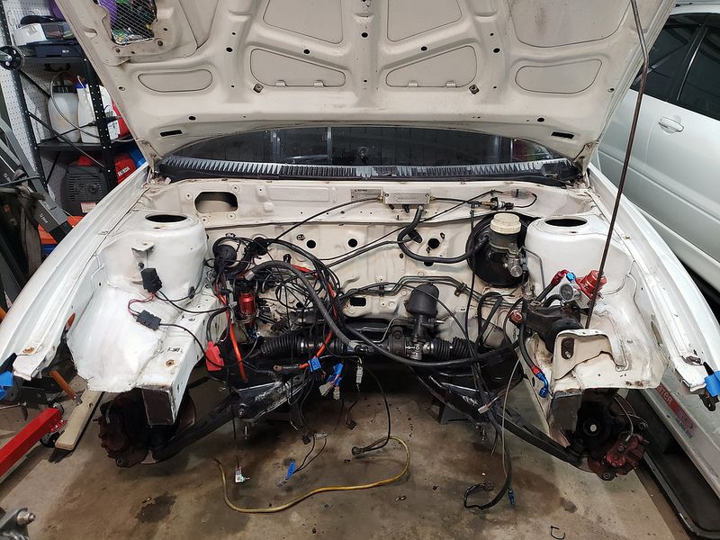

Chopped the front end off and cleaned up the wiring. Each headlight harness will go out through the fenders.

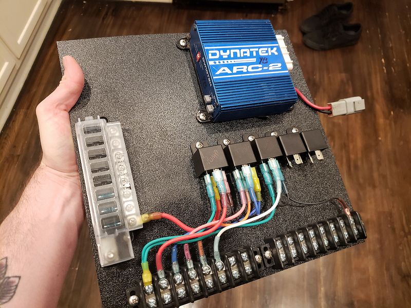

Custom relay board I built for under the dash. I'm redoing the fusebox wiring and will be mounting it under the dash as well.

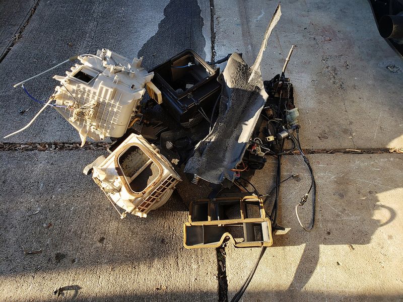

Ditched all the HVAC

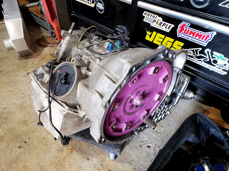

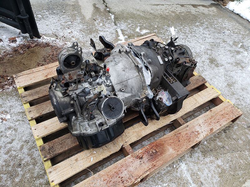

Shipped the trans off to Darren Thomas last week

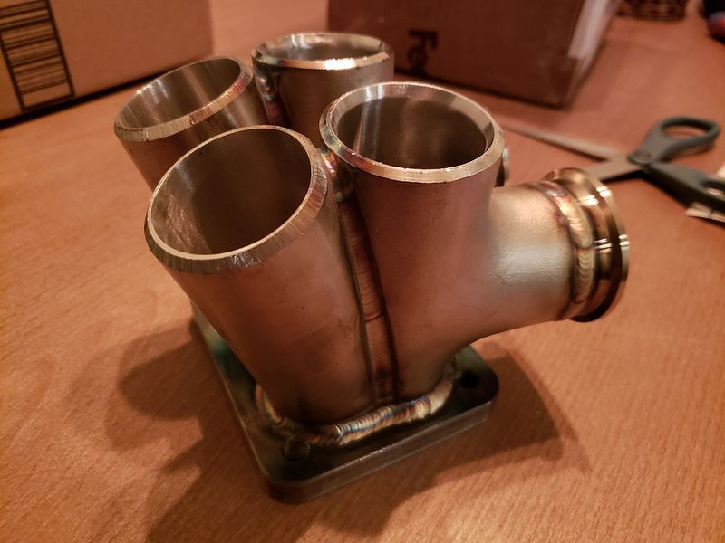

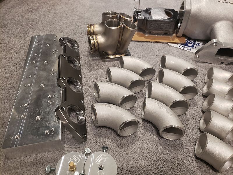

BSFab T4 divided collector i'll be using for the manifold. I really like the tee style butt weld fittings for the wastegate provisions.

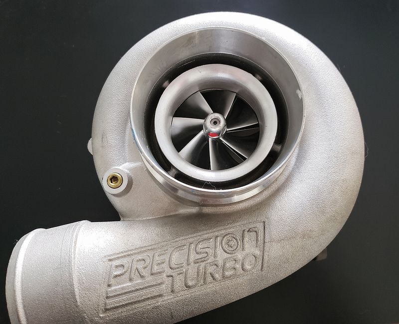

I'll be starting on the manifold once I have the PRL & StreetorStrip purge blocks, turbo and FMIC in my hands.

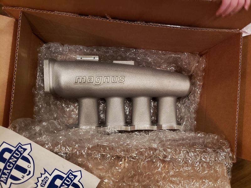

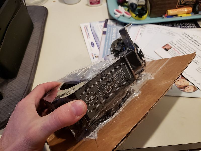

Magnus v3 and RMR 82.5MM TB

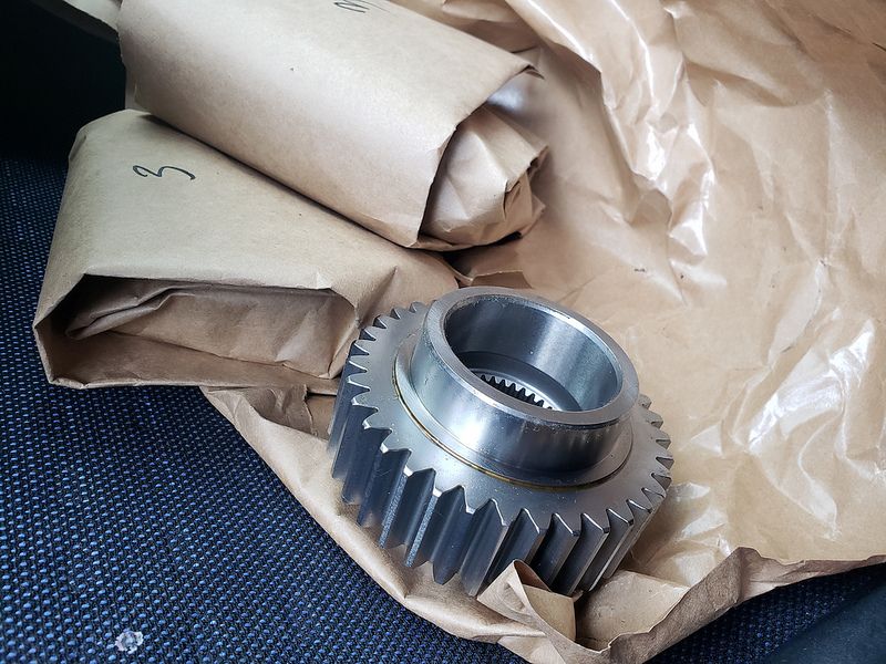

Liberty straight cut transfer gears for the trans
Everything for the manifold with PRL purge block and 1.5 purge locks.

I saw you were selling your Magnus intake. What's the plan afterwards?
i dont think its the same intake. the one for sale is a dual rail powder coated black.
Yeah, those parts I listed are from another car. The v3 I bought for this car is staying. It'll be getting powdercoated a wrinkle black along with a bunch of other parts soon.

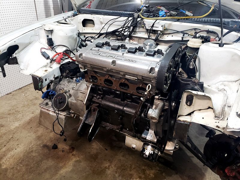

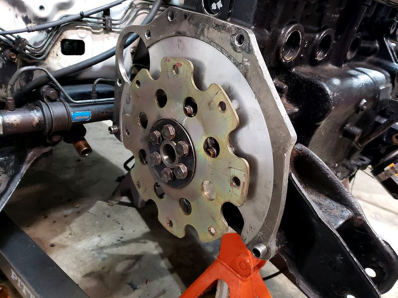

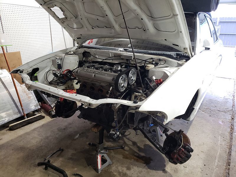

Motor and transmission went in this weekend. I was able to use the Evo frame rail mount with stock dsm bracket.
Trans consists of liberty transfer gears, jb billet forward drum and kiggly billet clutch basket. The converter is PI billet unit.
