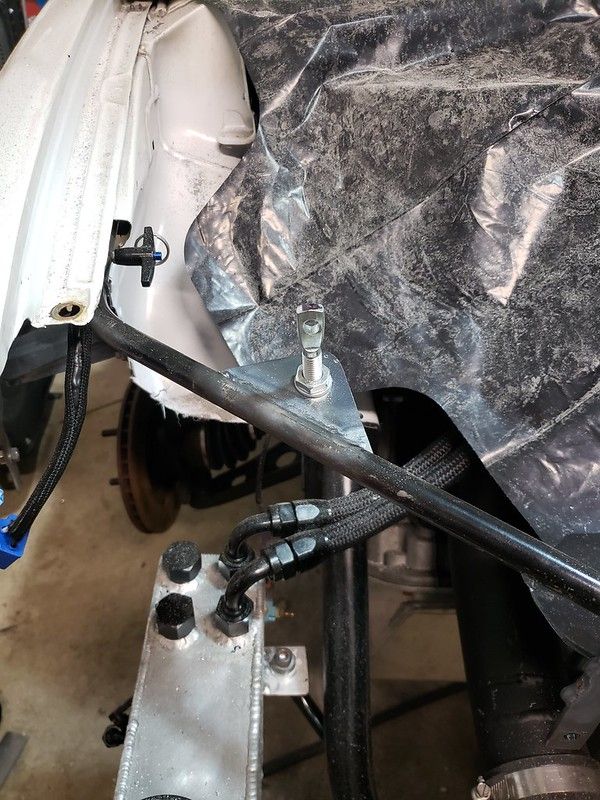

Very clean Scott as always. Interesting way to mount the trans cooler. Are you going to use any kind of spacer say 1/2" between cooler and body?
Thank you. I'm just leaving the cooler as is. If temps get out of control i'll add a slim fan.

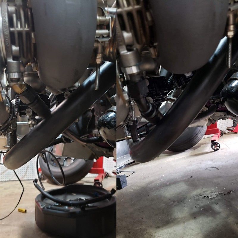

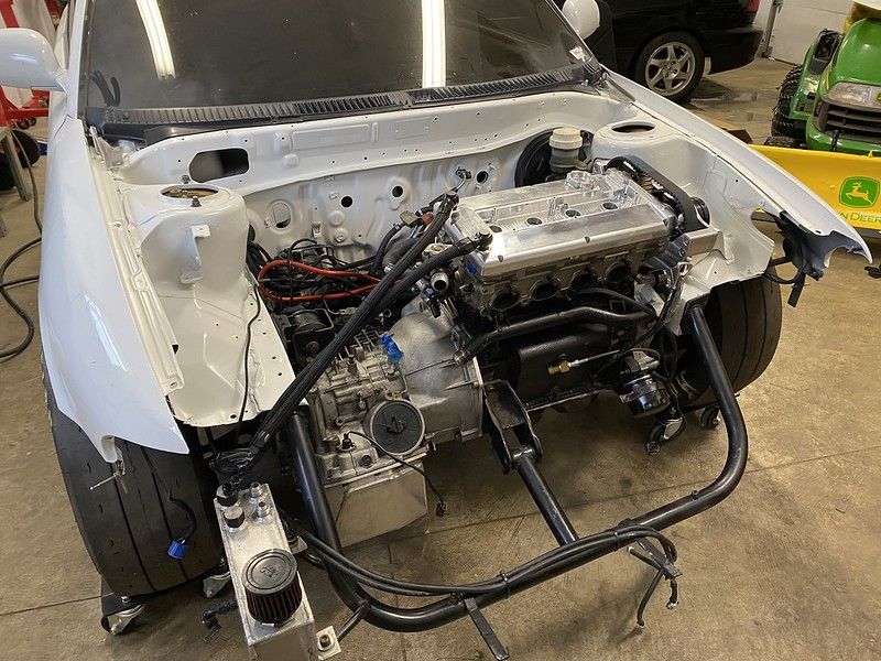

Rebuilt the oil return line as it wasn't draining well enough.

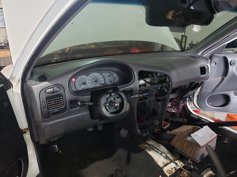

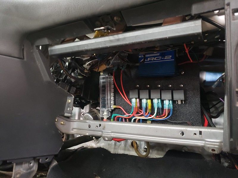

Dash is back in and relay board mounted.

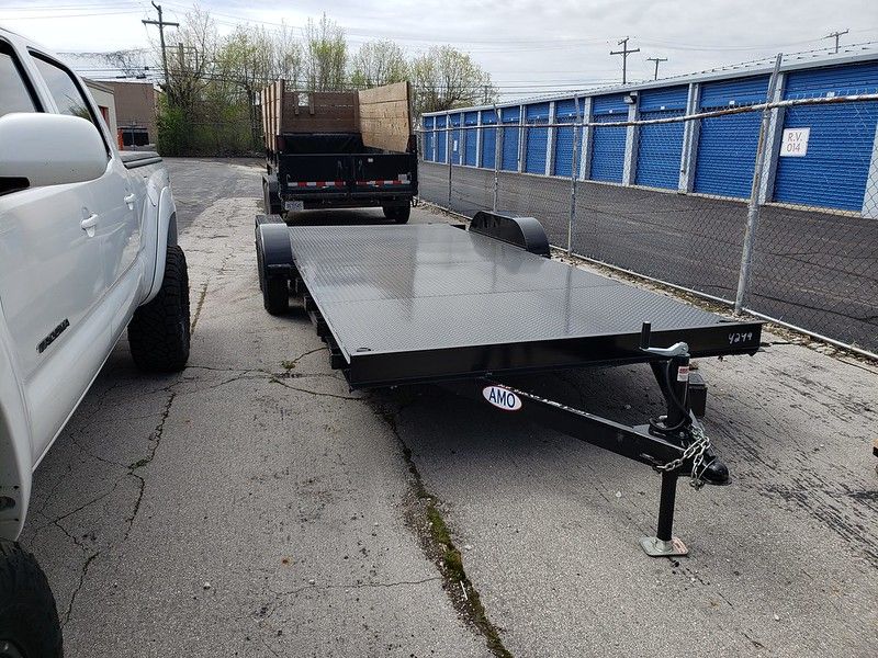

Picked up a trailer for the car as well. 20' open

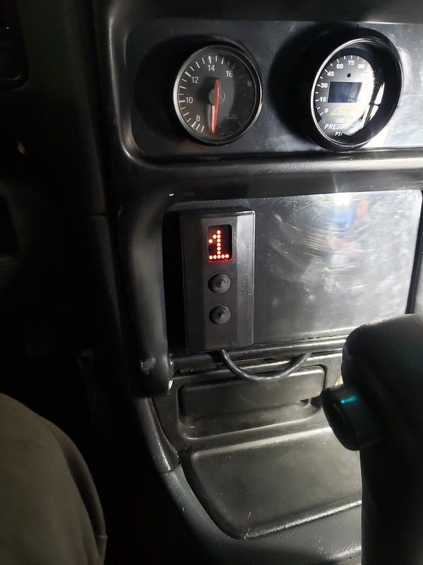

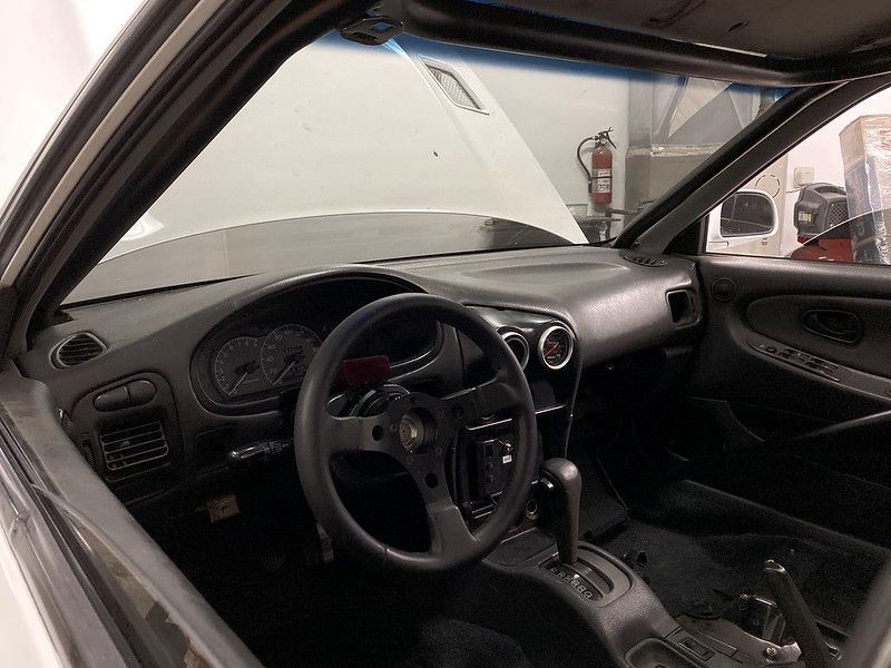

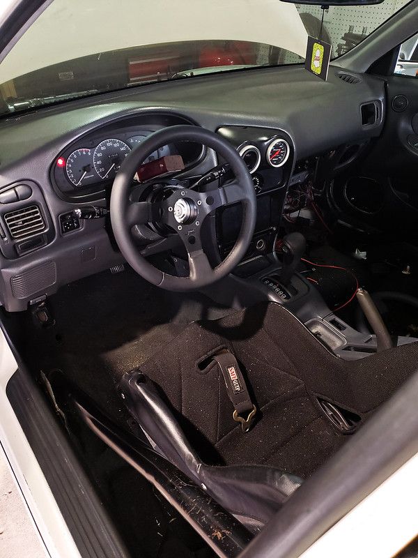

Made brackets for the kirkey seat and got that installed. I added a quick release wheel and installed a factory mirage auto shifter + 100.1 forced four shift box. The 1G auto shifter was too tall for the console. I really didn't see any point in spending $300+ for a ratchet shifter since I wont be shifting the car.

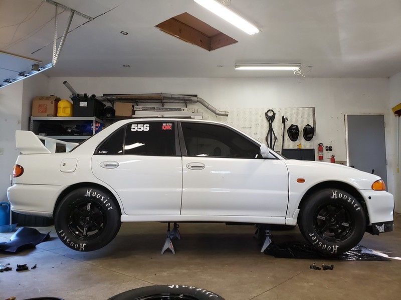

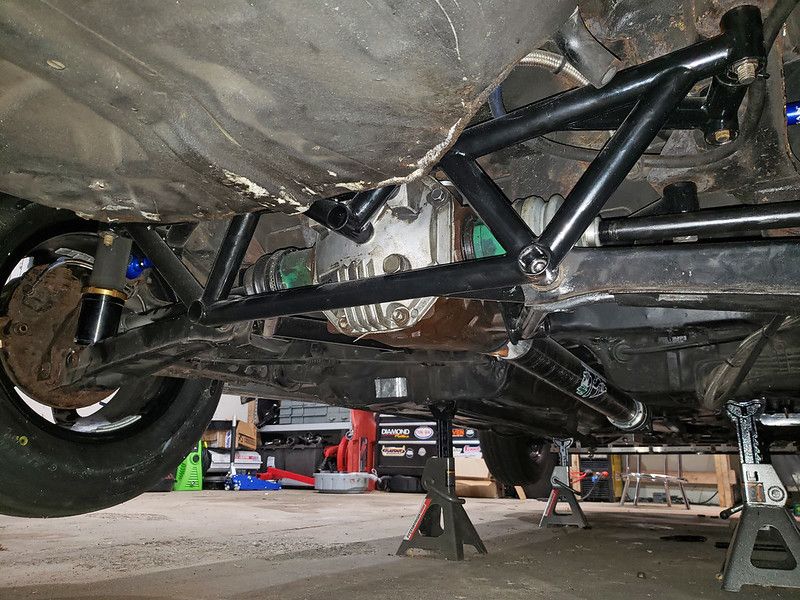

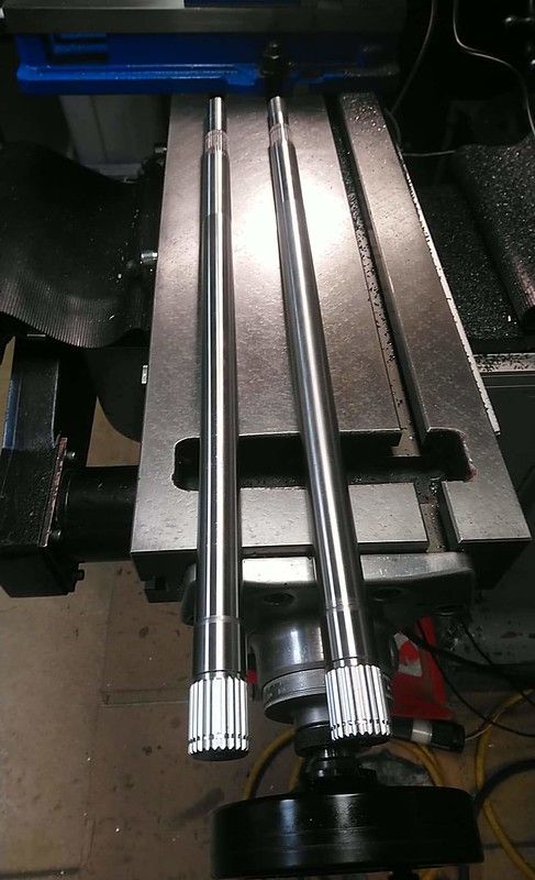

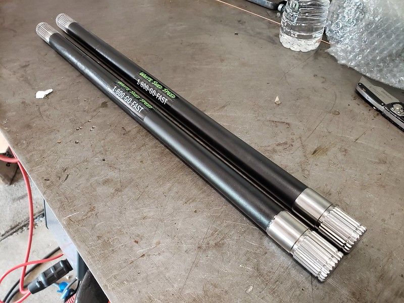

Kurt @ White Shed Speed @bastarddsm got the axle bars finished up for the 3KGT rear diff.

Not much left really. Wire in a couple more relays on the relay board, rear axles and then fluids. I'm planning on taking it out Saturday to a local car show car and then hopefully dyno the following week/weekend.

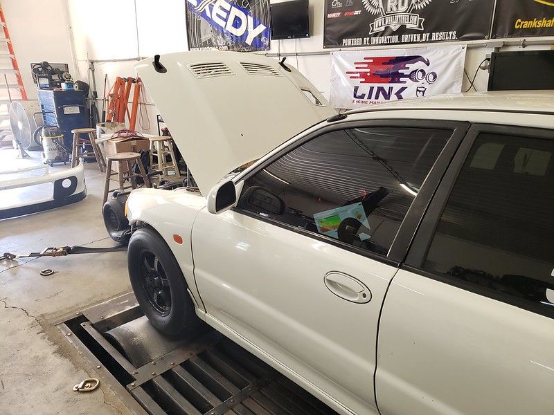

Got it dialed in on the dyno at Whalens a few weeks ago.

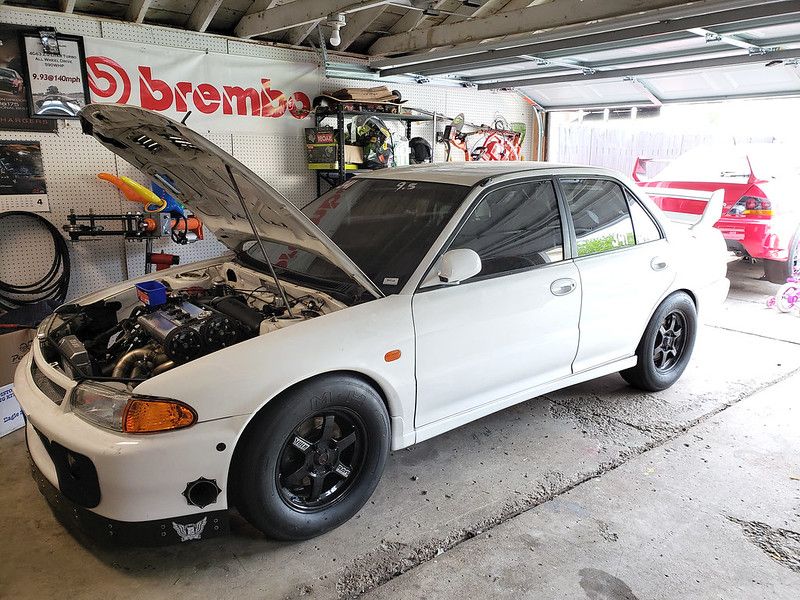

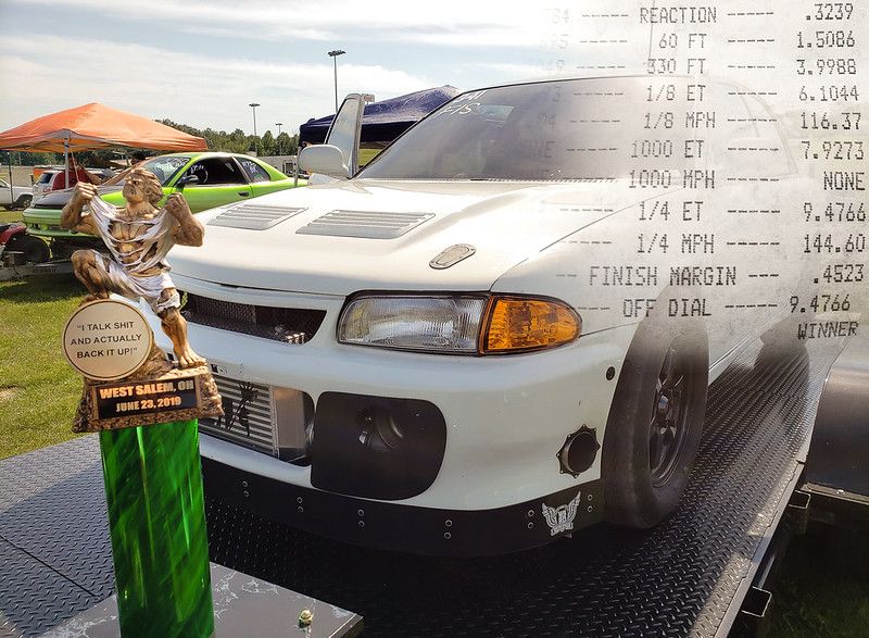

First outing at the track went well at Import face off in West Salem, OH. I focused on the 60' and progressed to 10.2, 9.7, 9.4. Where it sits right now is a great go rounds tuneup. Looking to chop off another 2 tenths off the 60' at the next outing to see what it does.

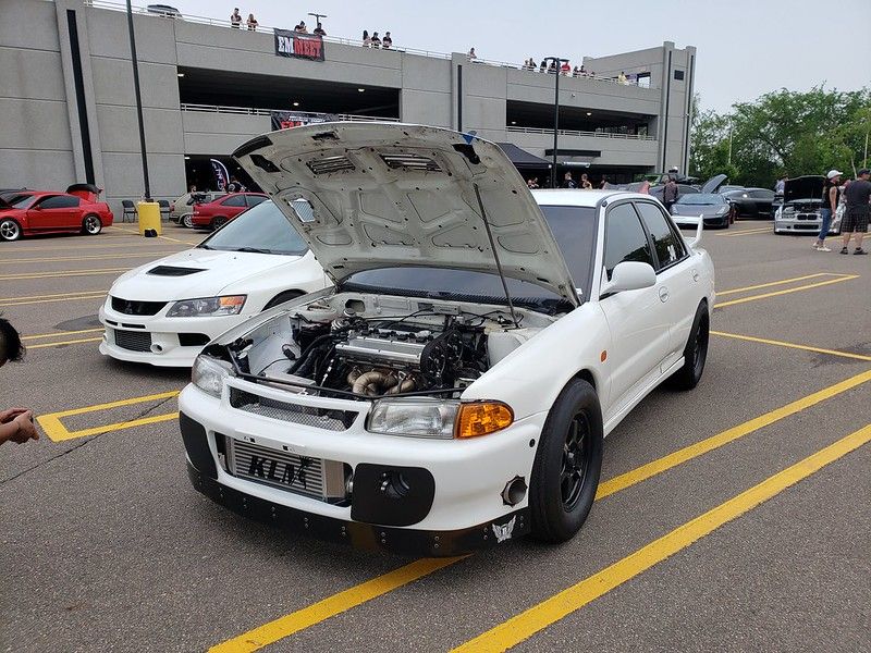

I like that shot of your white evo and the 8/9, not sure which one I like more.

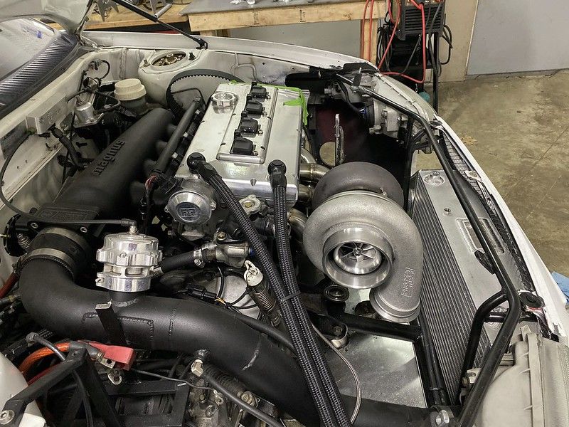

Some changes will include new cams, exhaust manifold/turbo placement, tires and suspension changes. I'll post more details as stuff comes in :) The car is still on the PTE 6270.

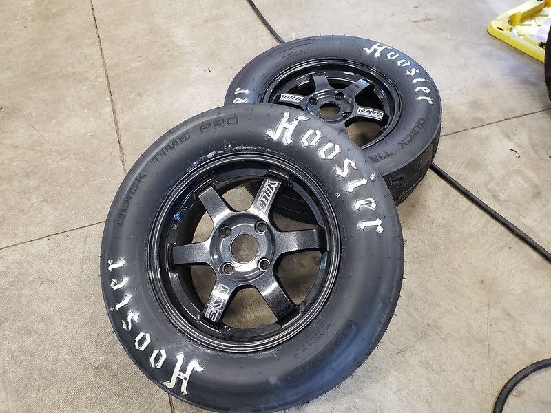

Switched to 26" Hoosier QTP's.
Any update son the car? What cams are you going with? And why the switch from the BW to 6270?
I went with Kelford 272s to give me more mid range power. I went with the 6270 since precision turbos always make pretty aggressive power for their size.

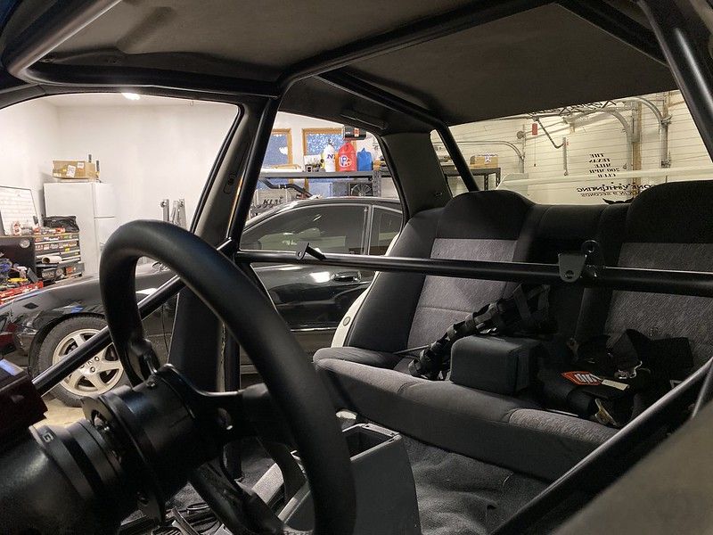

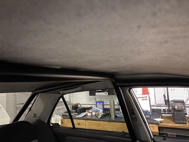

Cut out the existing roll bar and got a new cage built by Diamond race cars in Ohio. Amazing work and quick turn around time.

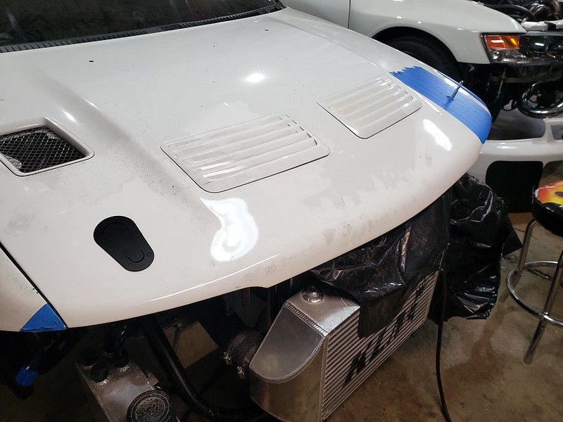

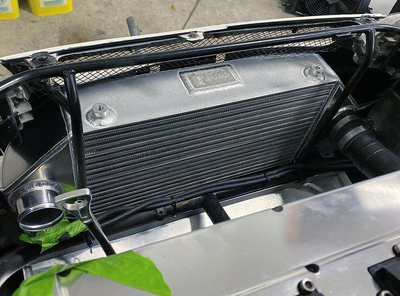

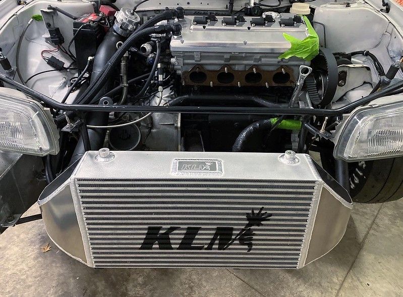

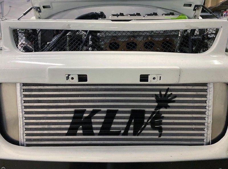

Since the turbo is now going to be under the hood I went with a wider intercooler to fill the front opening with dual back doors.

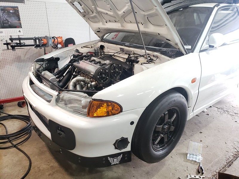

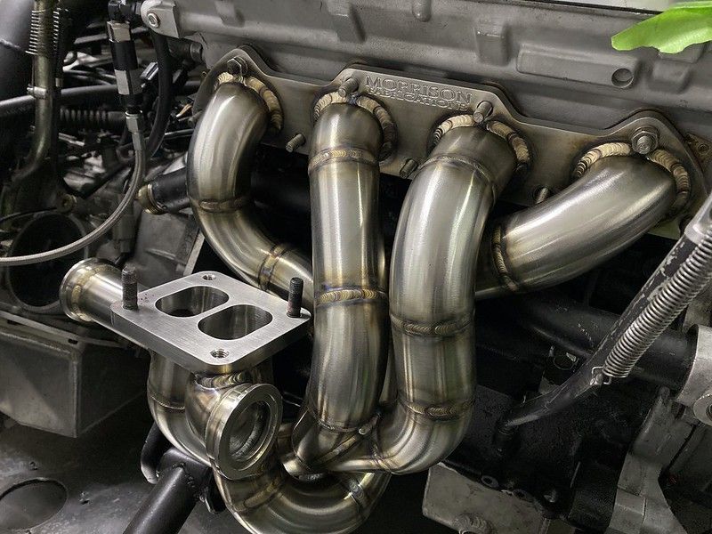

New manifold arrived. @MorrisonFab consolidated T4 divided top mount. Pictured is a 7285 that i'll be dialing in early summer for super street @ WCF.

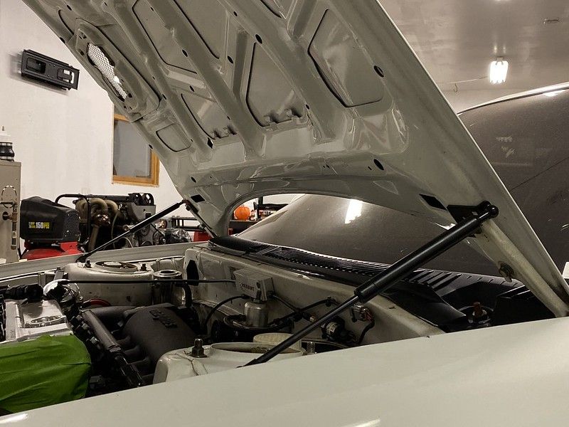

Last not but least, HOOD STRUTS. Using random props was not ideal.

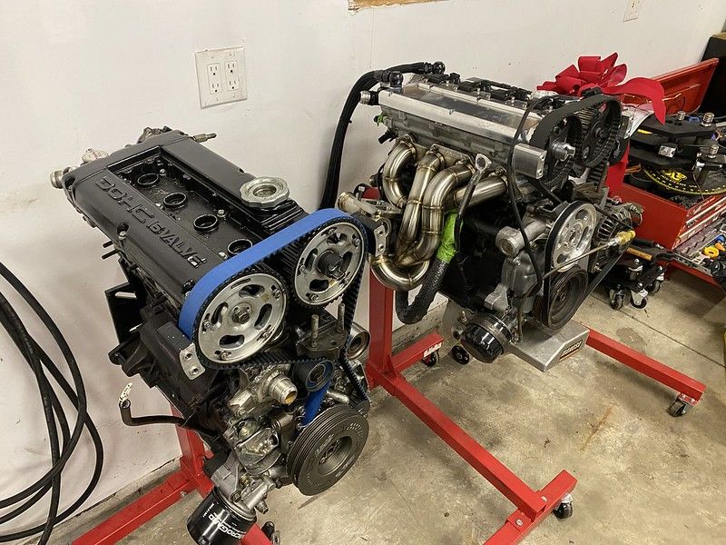

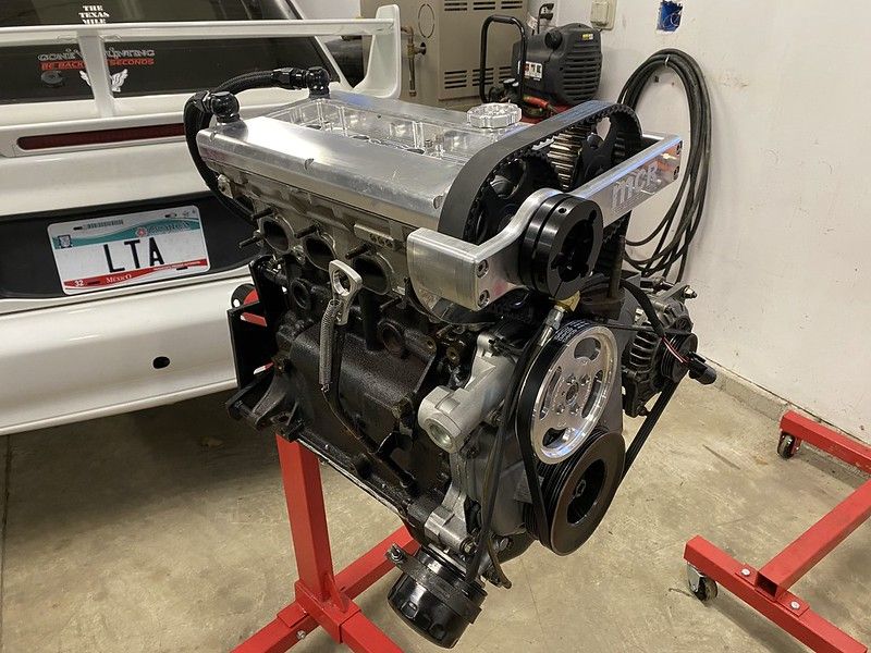

I have another long block here (3/4 fill 2.0 with diamond pistons connected to R&R rods) that I was planning on putting in mid summer in preparation for WCF with the 7285. I decided to just put it in now while it's off-season.

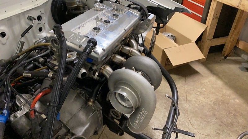

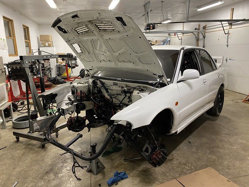

Swapped my goodies over and ready to go in.

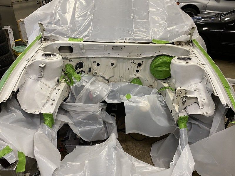

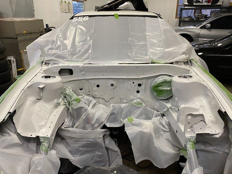

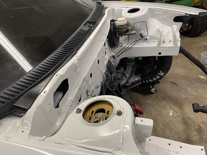

Fresh paint for the engine bay.
