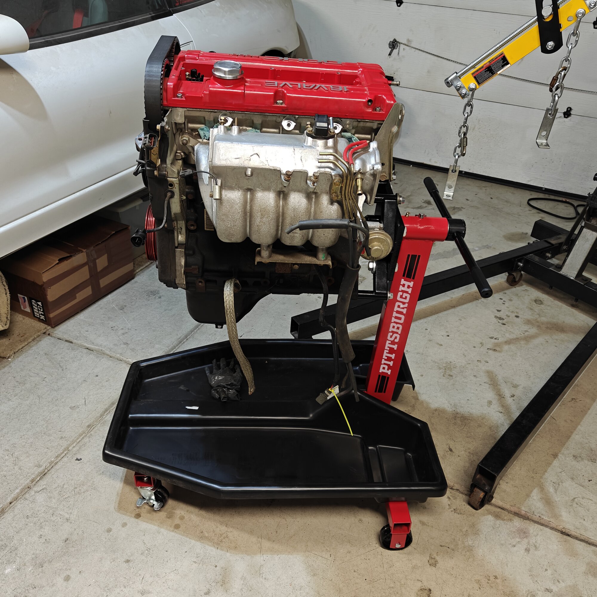

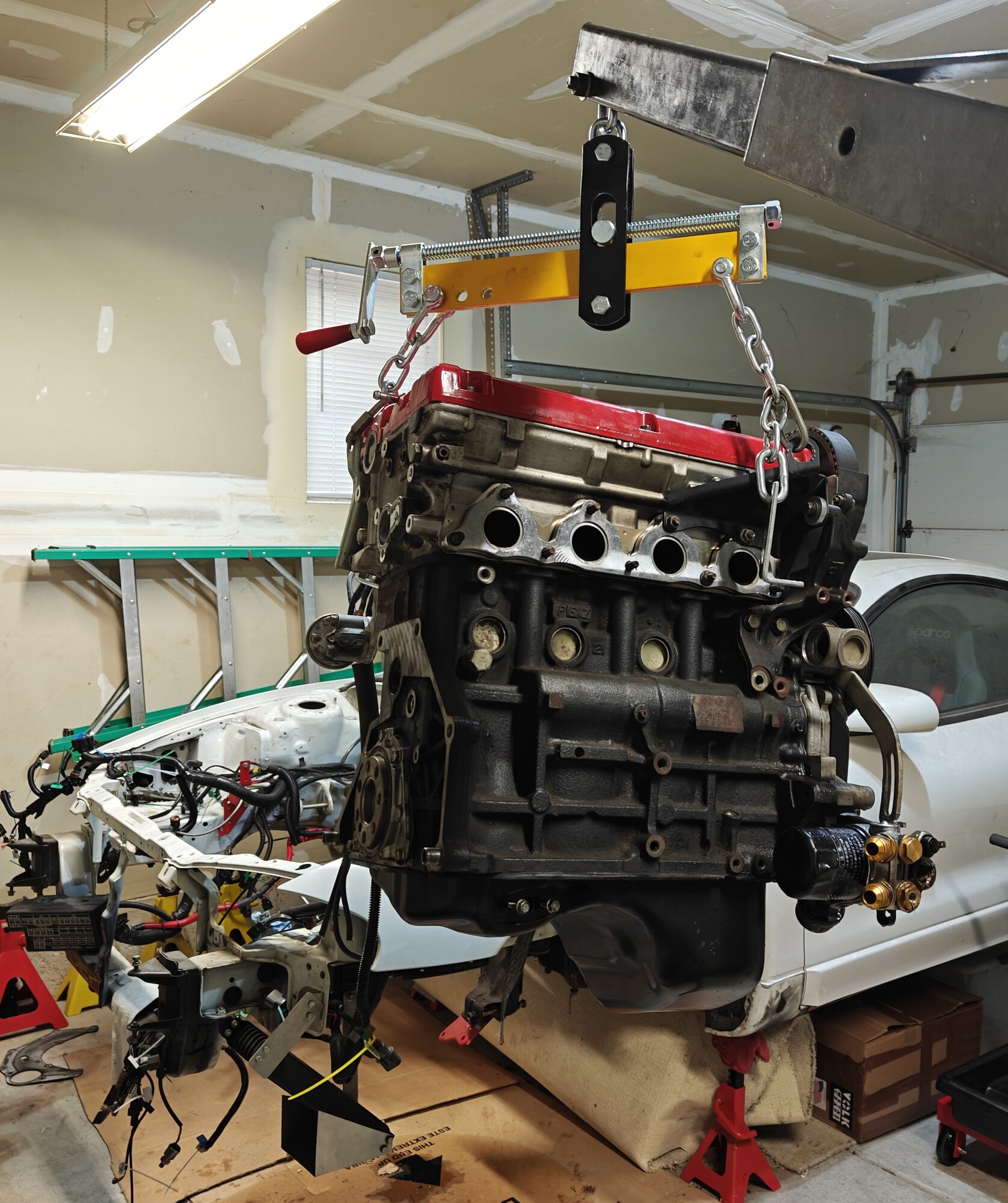

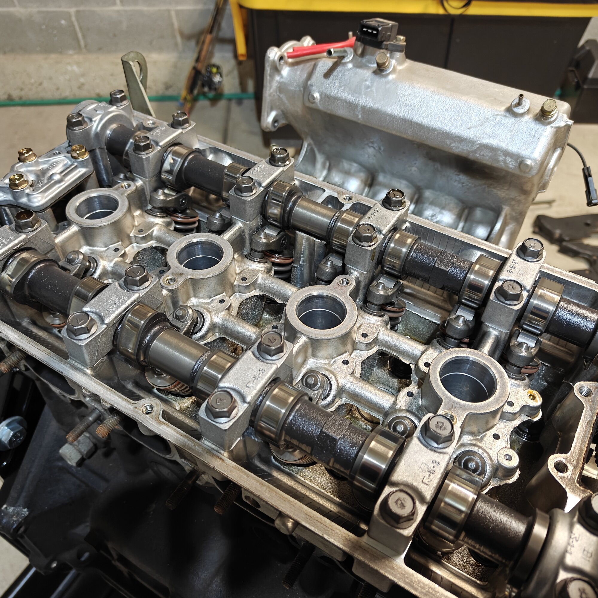

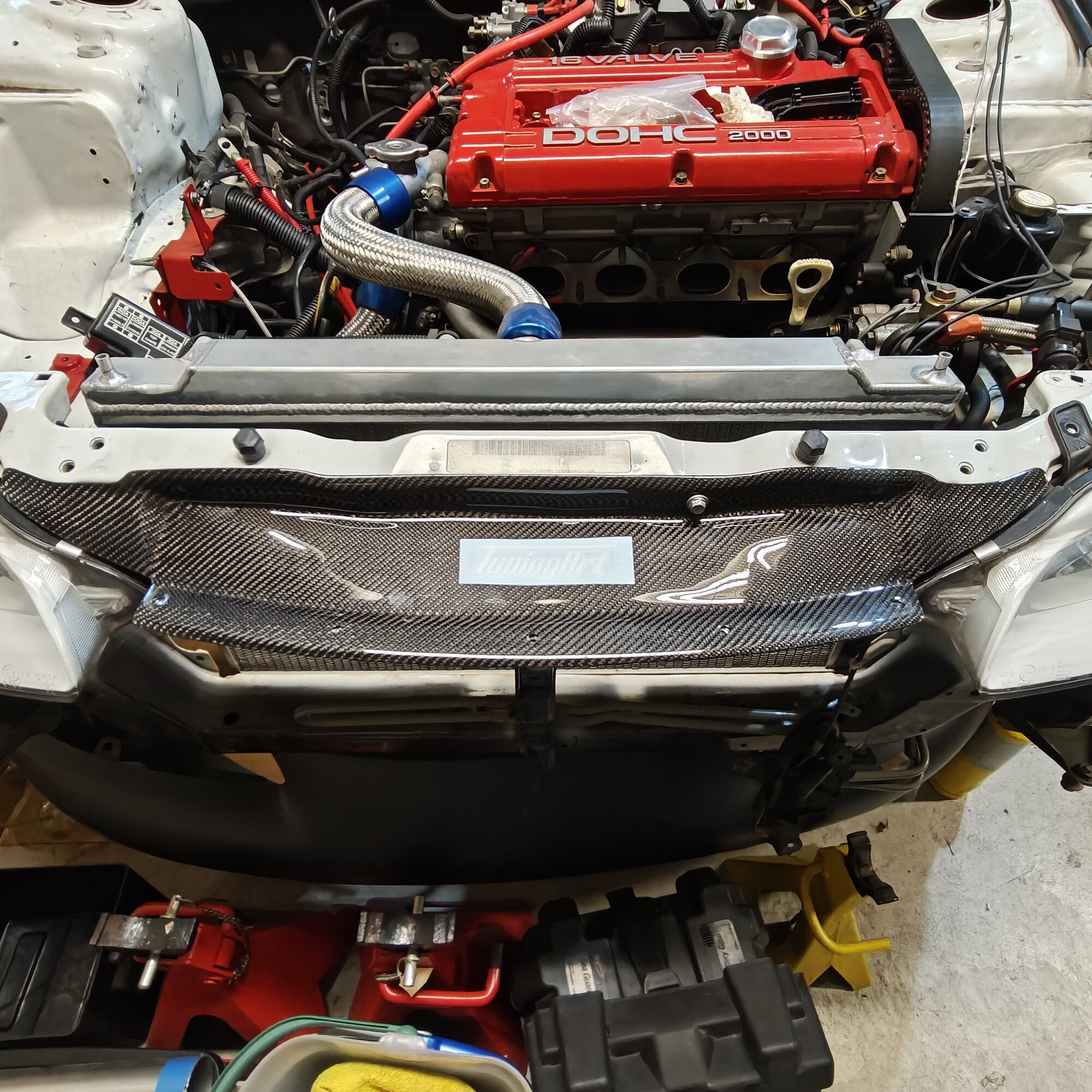

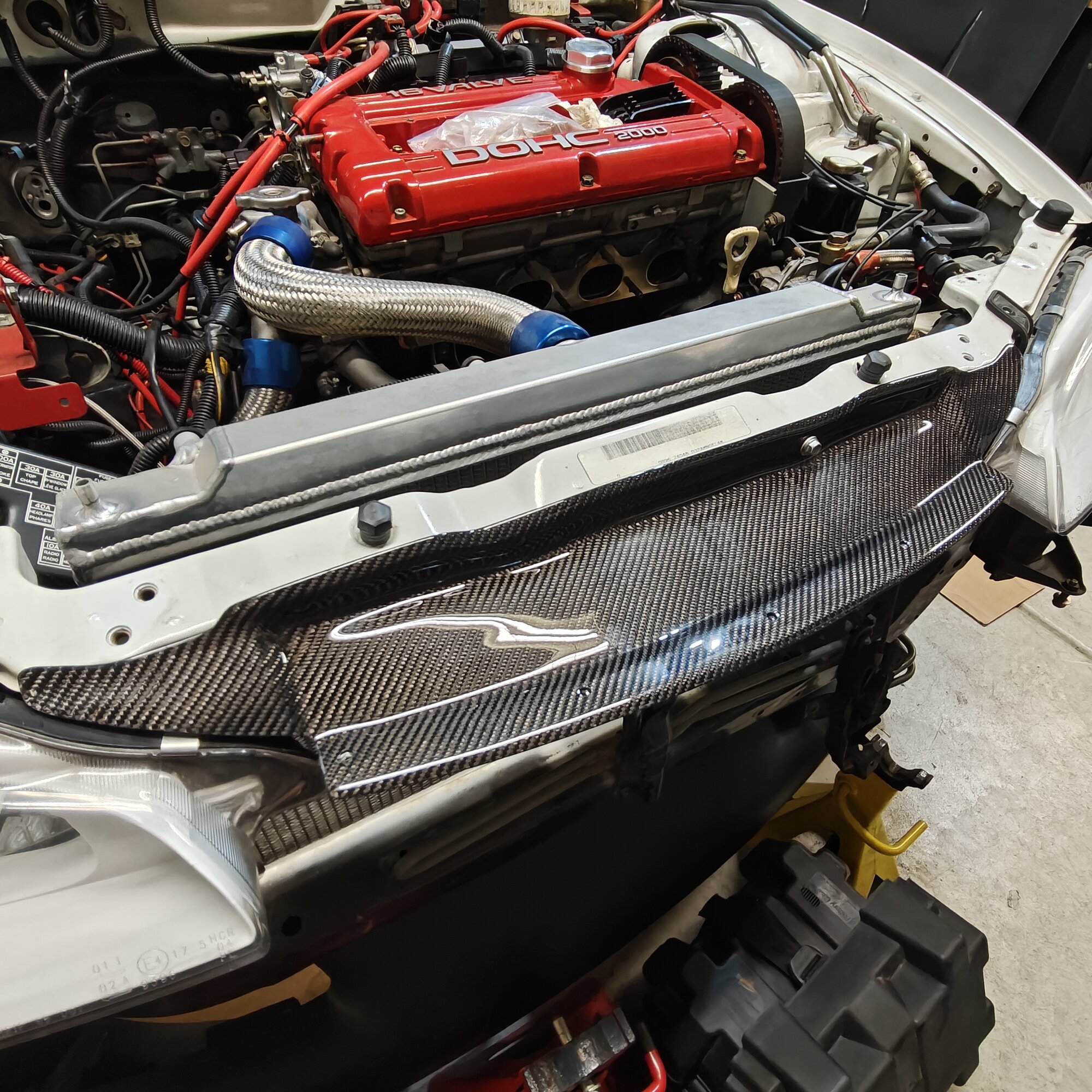

For the first time since being assembled at the Normal, IL. plant, the engine bay is once again empty and I'm beginning to disassemble the 33k stock engine which has never been apart with the exception of the valve cover. It has been 21-22 years since the last time it ran and the valvetrain looks as good as new. I can't wait to dive further into it to see how the bottom end looks.

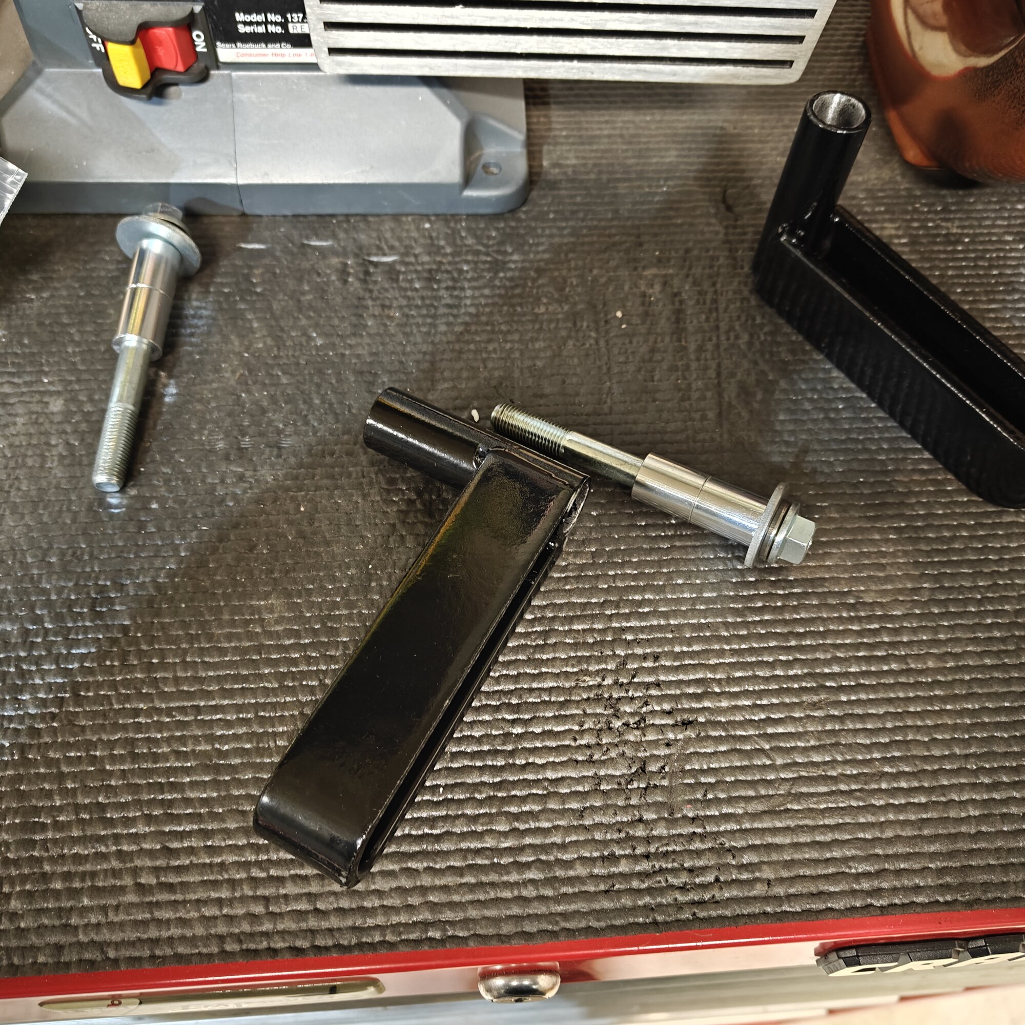

I can't leave things well enough alone. I never liked how the bolts sit in the engine stand arms when bolting up to the engine so to make sure they are centered I bought some bushings which worked out perfectly. Yeah, I'm doing too much. 😄
