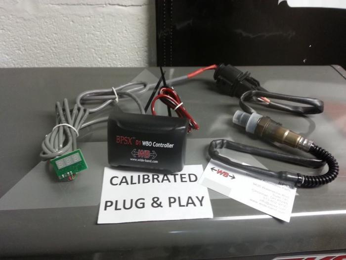

Post 25 New sponsor for 2014 APSX WIDEBAND

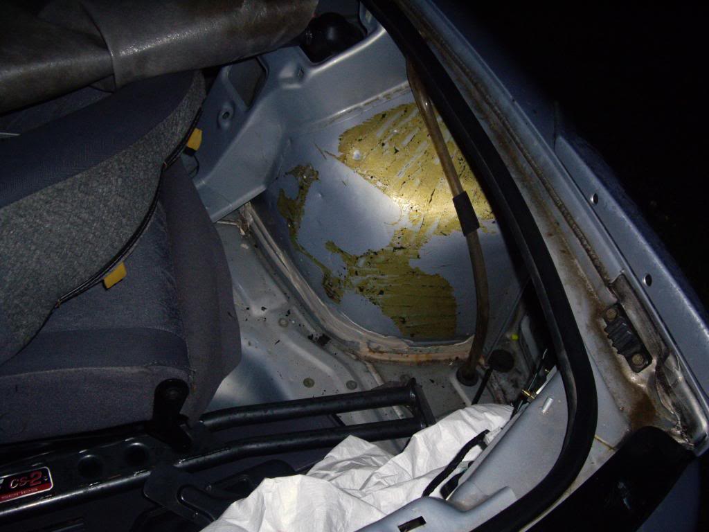

the stranded tar mat removable

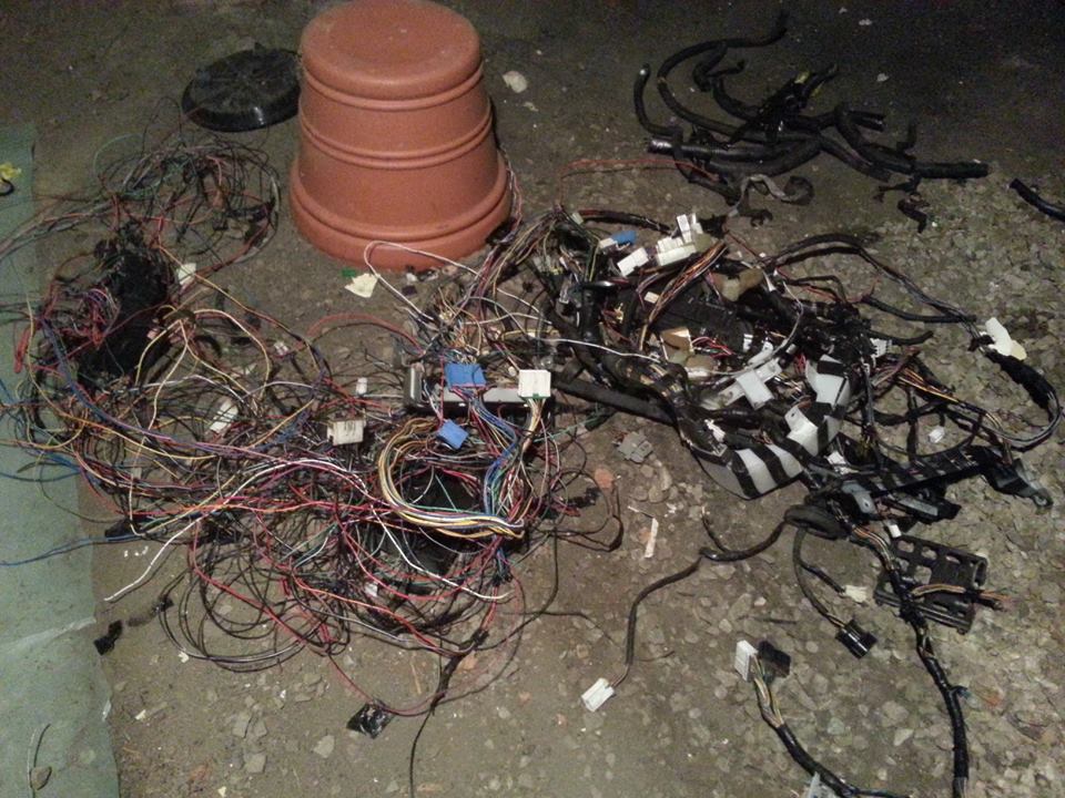

about 1/2 of the wiring that was removed

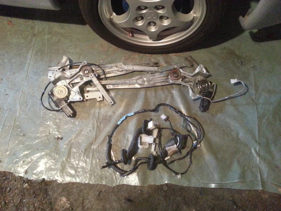

went from power windows to manual after the shootout its nice to have windows that work

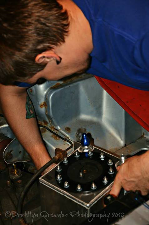

changed to a small front mounted fuel cell

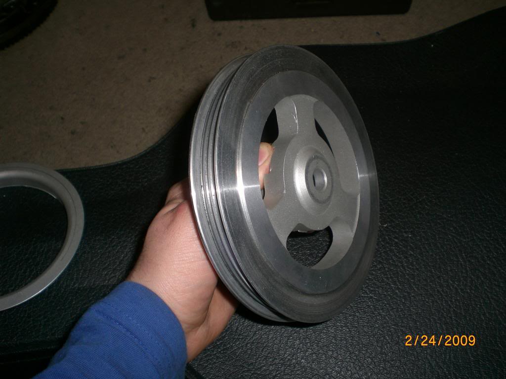

On the last build scene the Ac and power steering was removed I chucked the crank pulley up in the lathe and turned down the outer pulley.

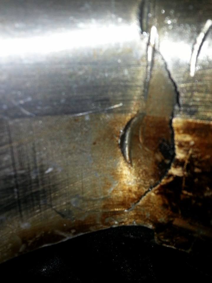

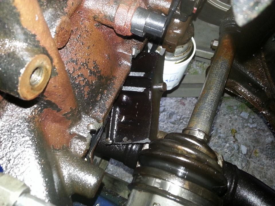

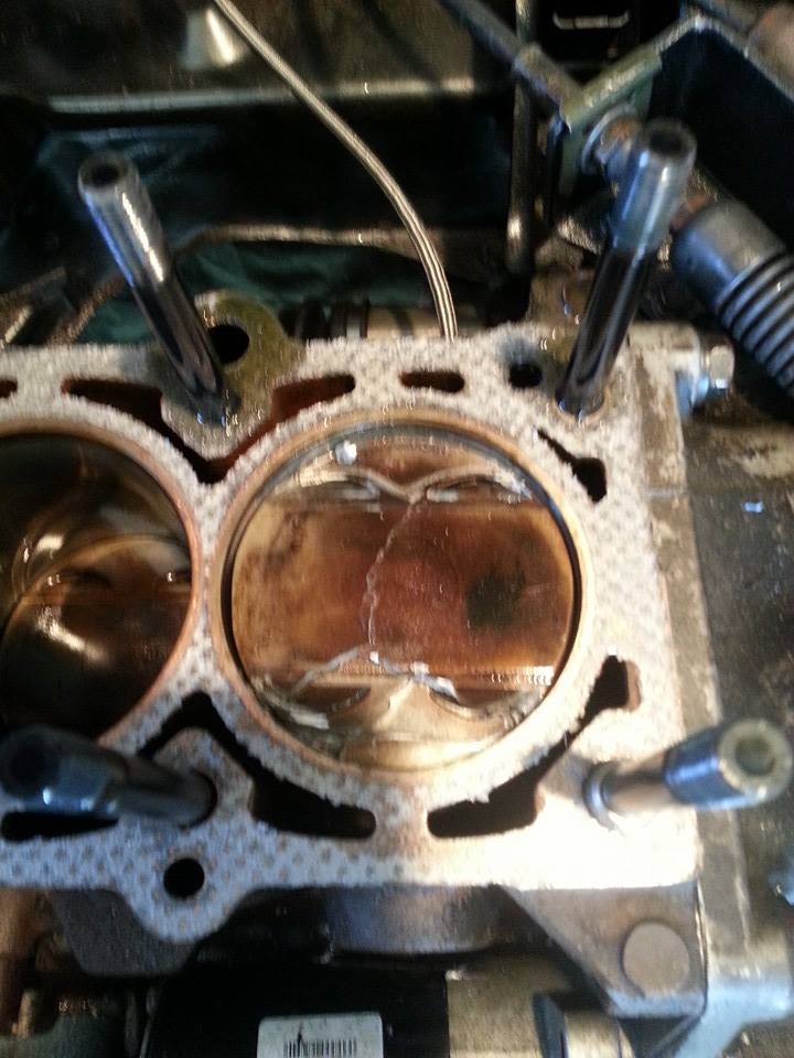

We got it partially dissembled with the block still in car this is what we found. The pistion was cracked on the top from contact with the head.
Cracked cylinder wall from the rod hitting into it
The bed plate broke in the back from the contact with the rod
We think that the rod broke first the piston pin boss was also broke. I think it broke from the strain of hooking up on the burn out it was on the limiter at 8100 in second gear and hooked really hard.

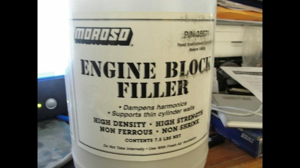

Block is 1/2 filled for extra strength

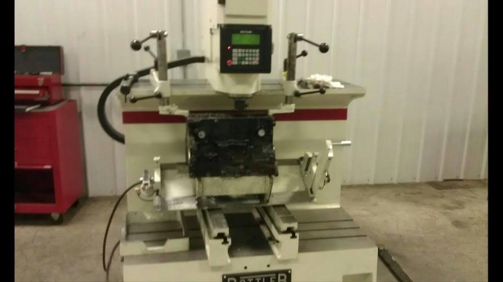

I'm doing most of the machine work my self on this some of it was done when I was at school at the University of Northwestern Ohio. This is the block on a rottler F7A boring bar.

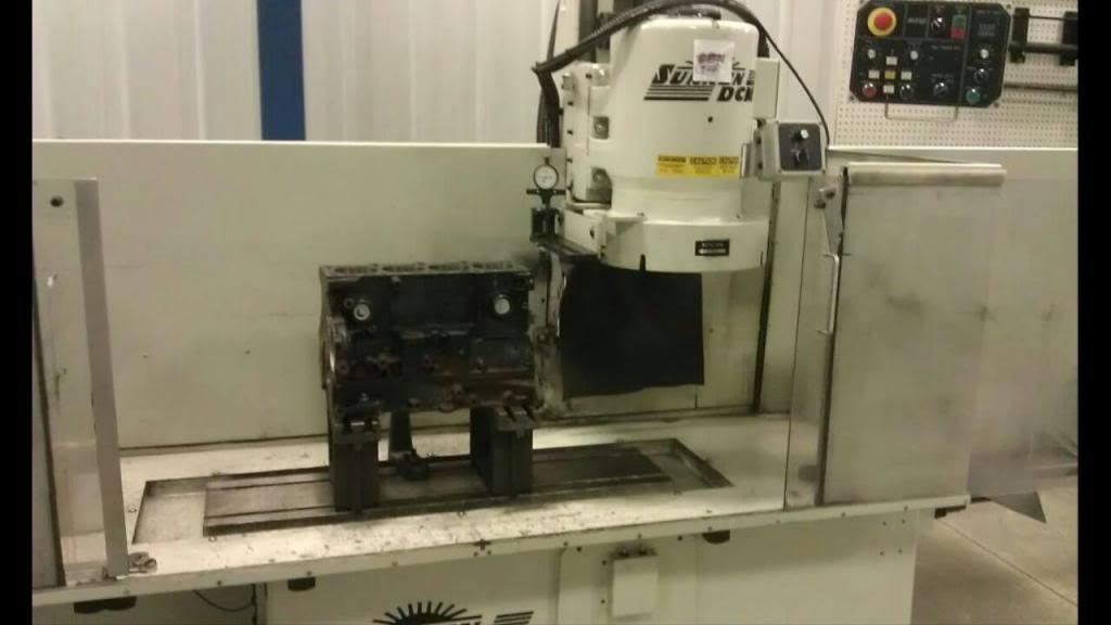

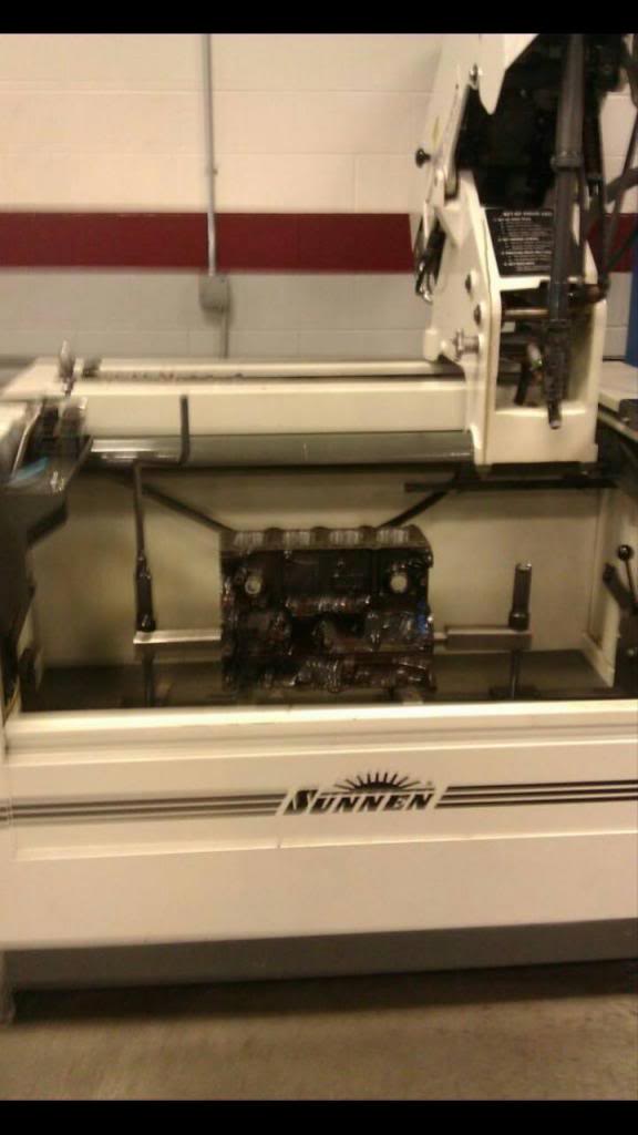

Then the deck was milled flat on a sunnen dcm with a CBN cutter.

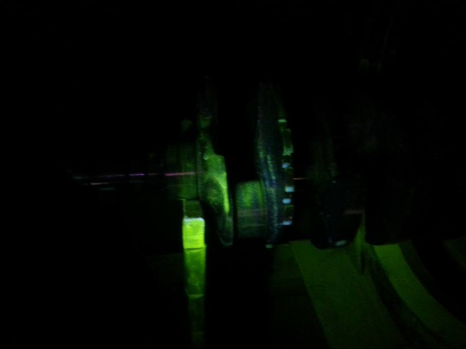

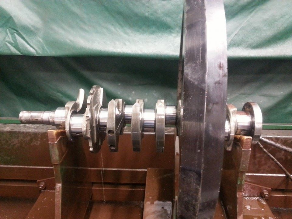

In this picture the crankshaft is being magnetized and an oil with a UV die and iron particles suspended in it.
Then a black light is shined on the crank any cracks will show up as a line and be easily visible
