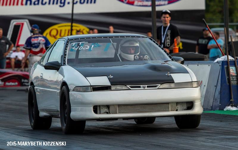

The car finally made another appearance at the 25th Annual Shootout!
AND IT FINALLY RAN A 10!
10.932 @ 123.13!
1.467 60'
6.965 @ 97.47 1/8th
I was over the moon! Over the weekend I made two 11.0 passes, and several 11.1 and 11.2 passes. It finally came together Sunday morning at at 11:36 with a good 60' and shifts (despite a shortshift on the 1-2 actually).
The 14b is now wearing the 7cm2 housing from my evo 3 16g, this is the one from Phil Beers with a 15* clipped turbine wheel. Boost peaked at just under 25psi, timing ramps from about 18* at 5000rpm to 25ish at 7k. AFR's are at/about 12.5:1 using E85. No need for secrets here! The car went 11.9 at 18psi peak and max timing of about 18* on the first pass of the year on Friday.
I had a scare seeing 13.8:1 AFR's on one pass as my fuel system was completely clogged. I replaced the pump and pre-filter and thoroughly cleaned out the post filter with brake cleaner. Glad I didn't damage anything, especially since this is still a stock 6 bolt block!
#3 on the 14b list, #3 to reach the 10's, #1 AWD, #1 awd to reach 10's!
