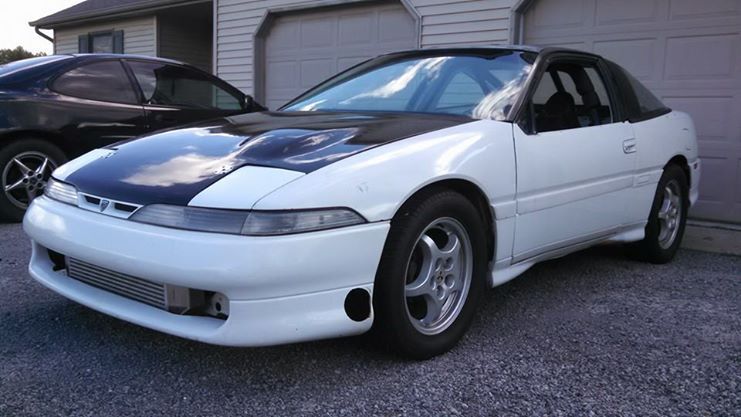

Also she's being called an Eclipsalon due to the fact it's technically a Mitsubishi Eclipse GSX, but it's sporting Talon tails and a Talon Center grill. The eclipse tails I have are cracked, and I do not currently have an eclipse center grill. So far I like the look, it just may have to stay.

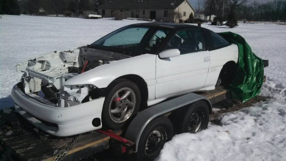

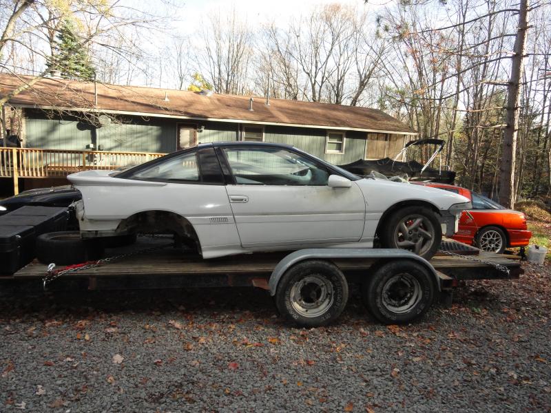

So this is where it all started. The shell had subframes laying under it, unfortunately the rear didn't have spindles and therefore my wife and I had a hard time hoisting her onto my trailer. It was definitely interesting.
Once I got her home she did a lot of sitting on the trailer throughout the winter. Little to no work was accomplished.

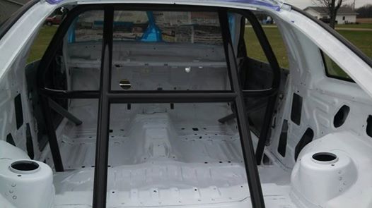

Finally after the snow was gone I started working on her. Most of the time was spent taking the shell completely apart and cleaning. Finally I painted the interior and rollbar so that I'd have a cleaner interior to bask in during a 1/4 mile blast.

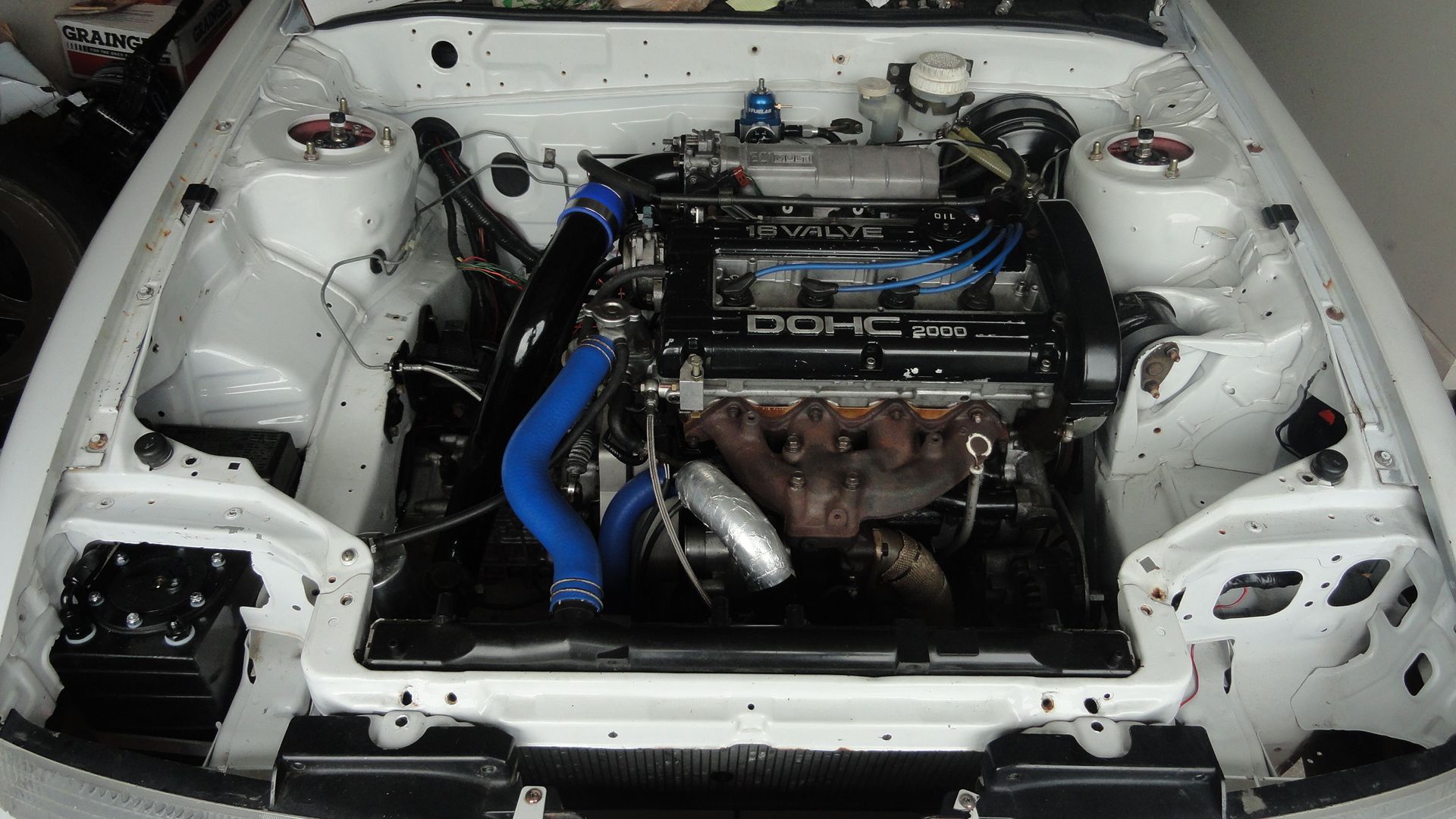

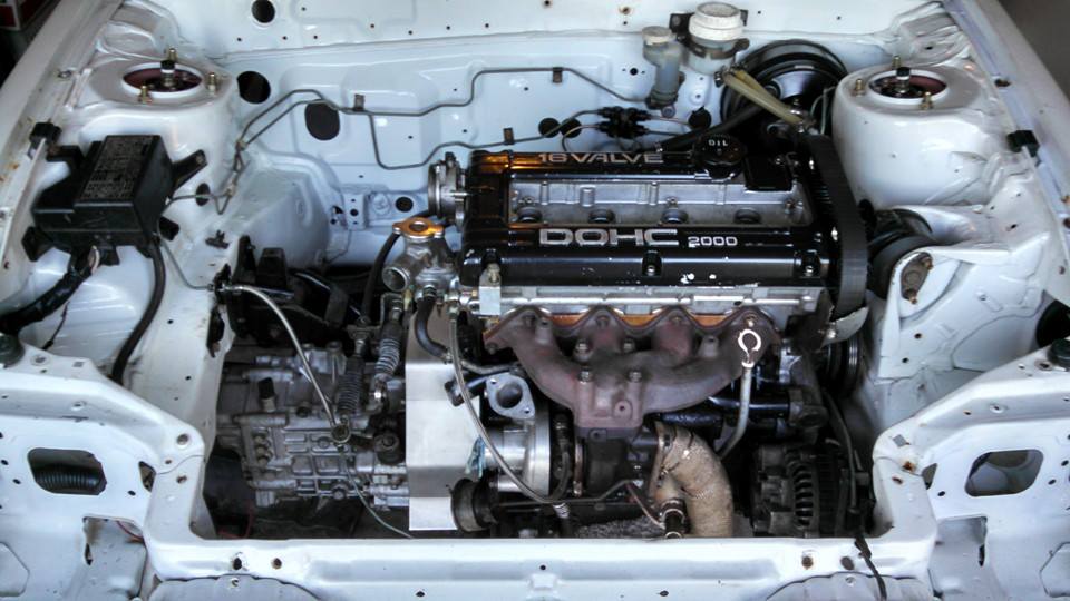

And eventually the engine bay got some attention. I cleaned up the K-member, installed new Poly bushings, and threw the engine in it!
Got everything hooked up and ready to fire. Including a new 1 gallon fuel cell, external walbro 255, -6an lines, and Fuelab AFPR.
During the process I installed some stainless brake lines for peace of mind. I also gutted more of the wiring harness to save a little more weight. Obviously in order to make a low hp car go quick it needs to be light! After fixing some of my wiring mistakes, a few fuel leaks, oil leaks, and coming up with solutions for other minor issues, she was ready to fire up! She now runs and drives, but the tuning is just beginning. I've started playing around with the idle tuning and quickly discovered I had better do some boost leak testing before I get too far along. I'll be sure to update as I learn V3 SD tuning and finish up getting her ready for track time.

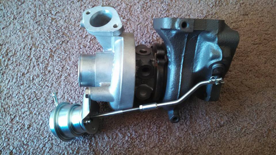

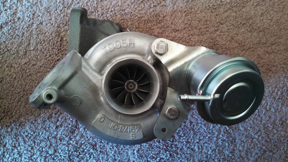

I added an Evo III exhaust manifold thanks to @95talongirl which finally replaced the 1g manifold I'd been running for several years, which coincidentally had also come from her old car. It should help open up some flow.
Unfortunately when I swapped manifolds I discovered quite a bit of oil in the 2nd cyl. exhaust port. I've long suspected I should replace all the valve stem seals which is the most likely issue, but the turbo's shaft play makes me suspect the turbo seals as well. This prompted a compression test which resulted in showing 140, 140, 140, 123ish. Disappointing, but she should hold up to what I'm putting her through for a while.

I'm going to do a leakdown test and see where the issue is at, pretty confident it's rings. I'm probably going to send the turbo out for a rebuild and once it gets back see if I can get some WOT tuning done. This will either have to be done on a track or a dyno at this point so either way there will be some numbers to look at.

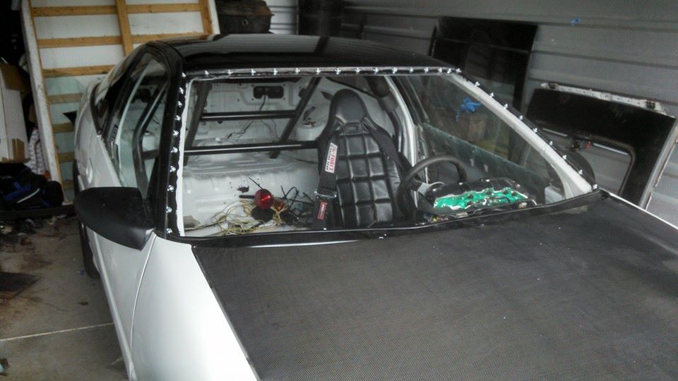

It's coming along. I'm not forcing myself into trying to get it on the track this year. I'm just getting one thing done/fixed at a time. Yesterday I sent the turbo out for the rebuild, ordered new valve stem seals, ordered a new battery, and today I mounted the glass in for the side windows and made myself a door latch handle. I will be putting lexan in the sides but the glass is to get me by for the rest of this year at least. Once the turbo gets back the next step is an alignment and I need to fabricate my air intake. I might do something simple for now and get more elaborate with it next year. Time and money willing I want to get some kind of WOT tuning done, either on the dyno or at the track before she gets put up for the winter.
I see a lot of the local honda's with a steel piece down the center of the windshield when they run lexan. Do you know if this is necessary when switching to lexan? As far as I can tell it just needs to be 1/8 inch.
Lexan flexes very easily, you'll want a center support bar/steel piece in the center of a piece that see's pressure such as the windshield.

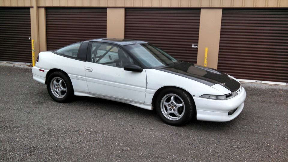

There continues to be progress! I figured out the issue I was having where the car would not rev past 6500ish rpms. Turned out the line I had going to the Map sensor was too long. Shortened that line and the car revs freely. I also spent some time cleaning up some wiring and other miscellaneous little things. The biggest job tackled was swapping the sunroof skin for my old non-sunroof skin along with making a lexan windshield. I think it came out ok, time will tell how much I'm going to hate the lexan as it scratches very easily. Also due to where I usually work on the car it's developed a name. I dub it The S.U.B. - Storage Unit Built
Thanks buddahboost! It has a carbon fiber hatch w/lexan rear window. I've thought about the side mirrors but they really come in handy backing off the trailer and into the garage at times. My memory might be off but it's something like 5 lbs total for them, which is a decent chunk but I've been able to find that elsewhere so far.

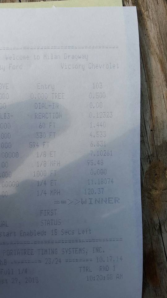

Quick update for those who don't follow the 14b drag racing thread. The car went 11.26 at the shootout and earlier this year did an 11.30 at 122 for a new highest 14b awd mph. I've been working on suspension tuning in order to get the 60's smooth and consistent. I went with a much softer spring combo which resulted in smooth launches at the shootout but hurt traction and made it tough to cut them quickly. I'm going to try the in between setup the next time out and I hope I can find a balance that results in those low 1.4's but without the bouncing! Looking forward to beating my old 14b time and shooting for that 10 second pass!
