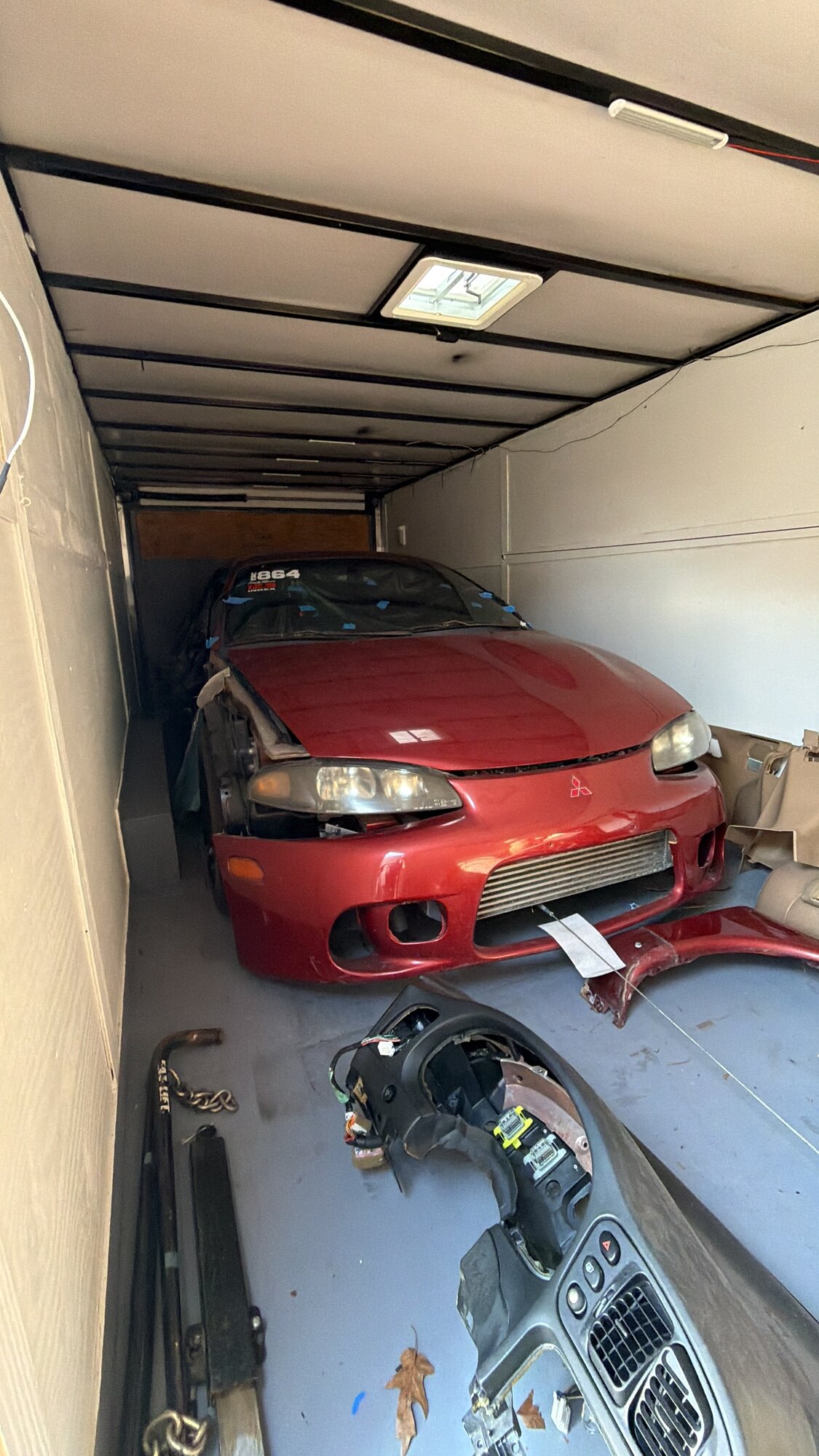

Now for the unfortunate news. Knowing I won’t be around for the 2025 race season, I had a chance to make one more pass after the races were complete. I added a few percent to the wastegate still not even 50% yet. The car hooked and felt good, hit 2nd gear and all hell broke loose. The car is still strapped in the trailer but I pulled the plugs out and number 3 piston isn’t moving, so my guess is a wrist pin snapped or the rod. Either way when it let loose it blew out every freeze plug there was and temps were low 50’s, even with my catch pan that water got on the slicks and then something locked up in the drivetrain. I did my absolute best to save it but I hit the wall at probably 60-70mph.
I haven’t really looked hard but the body has pretty good damage that’s going to need professional hands to see if it’s worth fixing. Rims are done, slick is done, hoping the rear subframe isn’t tweaked, rear axle, the diff, when it hit, my wing hit the wall and ripped off. This is not going to be a nice to the wallet repair. It’s been one hell of a wild ride to say the least going back 20 years of messing with these cars. I never thought I’d being running mid 8’s and winning against big name shop built cars. I’m pretty happy with what I achieved out of my home garage with a full wetblock and this video 2800lbs race weight.
While I’m away next season I’m going to reflect on everything and either part out what’s salvageable and retire from DSM’s or fix everything and continue the adventure. As of right now I’m figuring $10-15k to fix and repair everything and it’s been a very expensive 2 seasons.

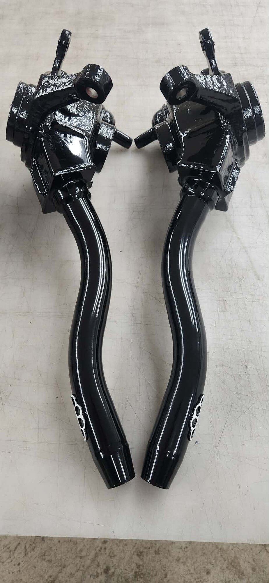

I made the purchase last year and I’m not in the U.S to unbox the carbonetics care package but there will be some new aerodynamics on the current chassis or new depending on a full assessment after the crash. I also have my order in for the kiggly straight cut planet gears. Every billet piece you can get for an auto trans will now be in the car. I’ve been in contact with Wiseco about making me some custom pistons with some beefier wrist pin landings and added gas ports. I didn’t get to tear down the engine but I know number 3 let go and my money is on the wrist pin ripped out of the piston, same thing that happened back in 2018.

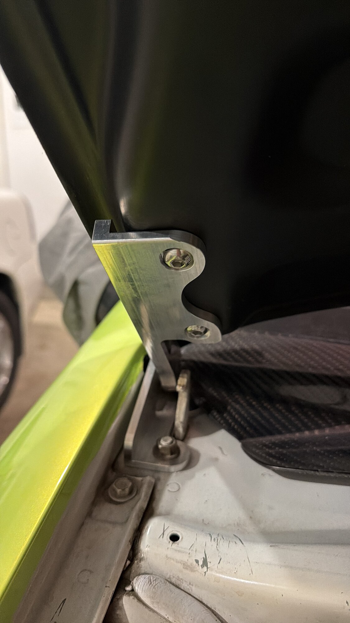

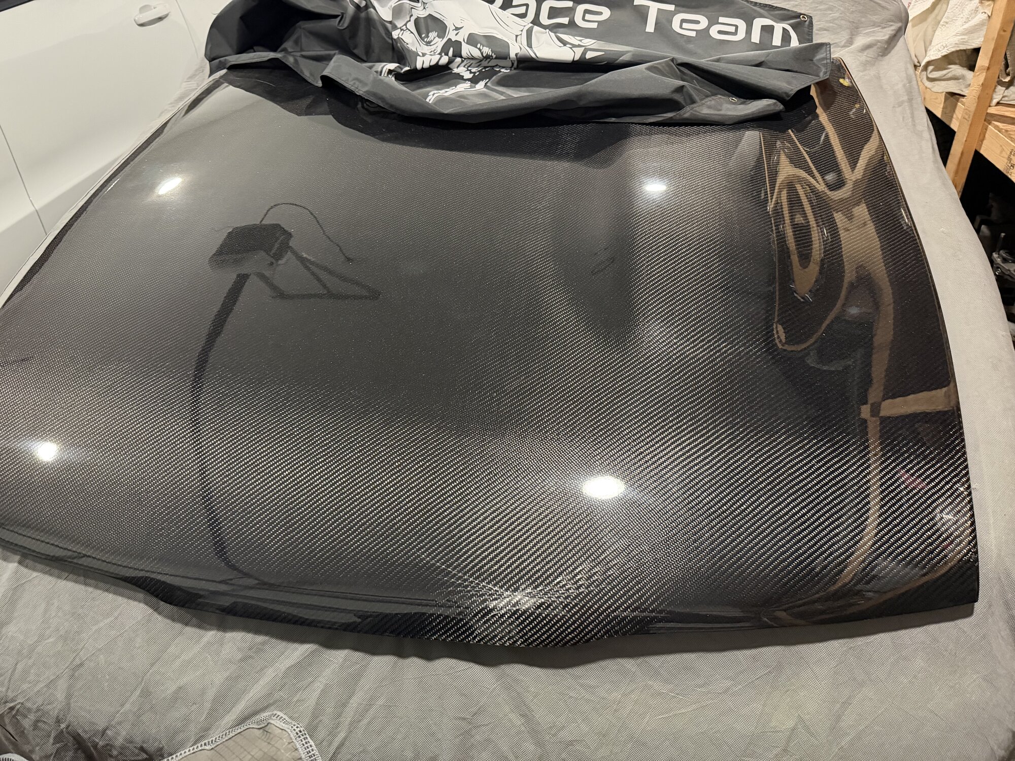

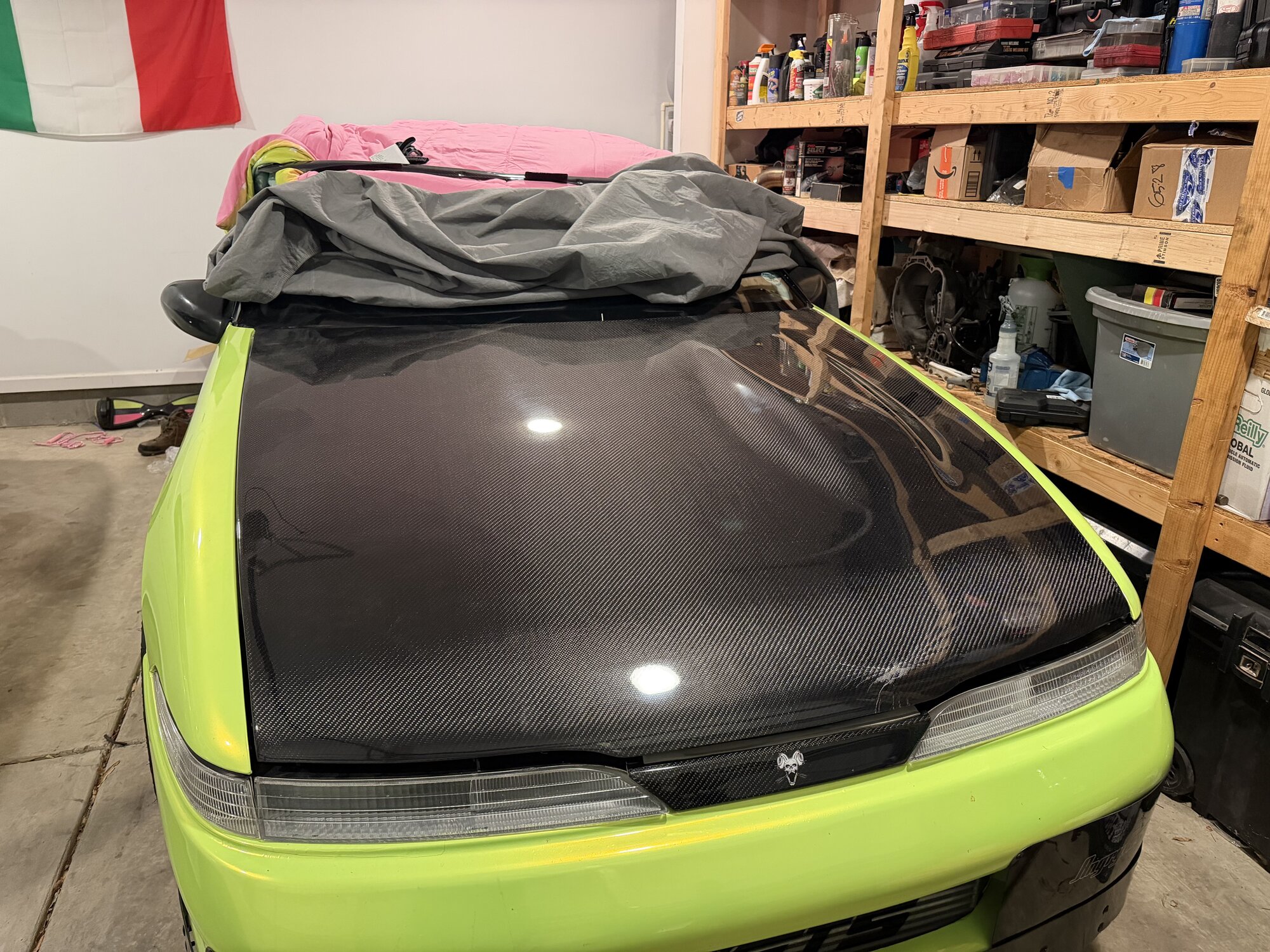

Also picked up the removable hood hinges, great quality and makes it easier working on this thing because I’m always pulling the engine and trans (hopefully not in 26’).

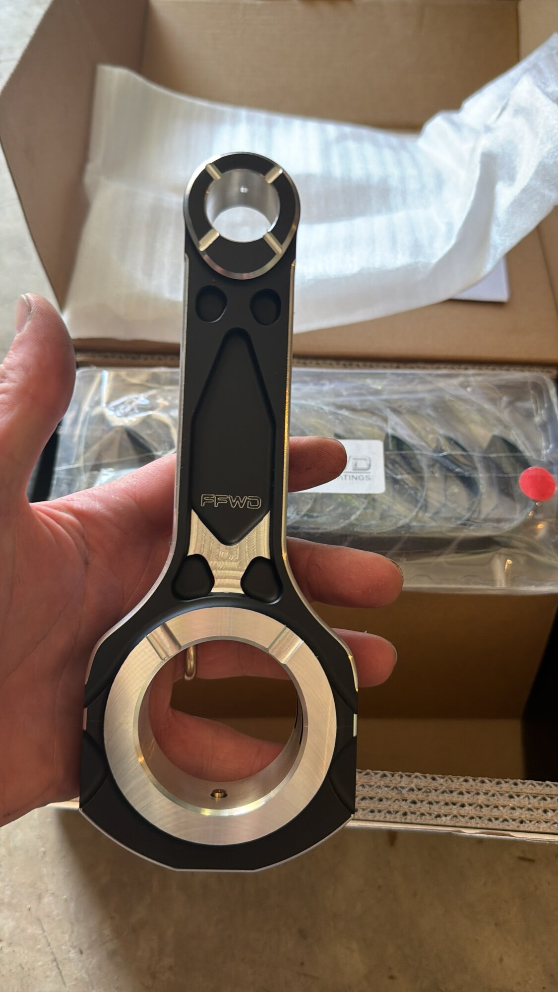

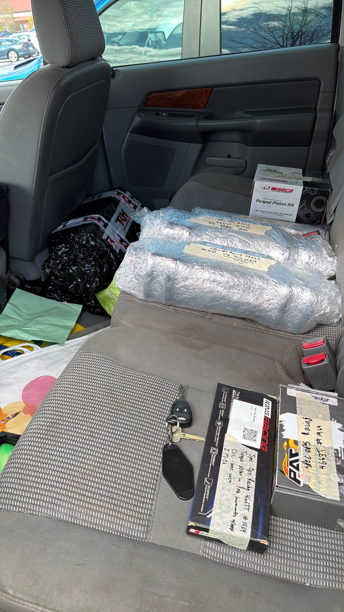

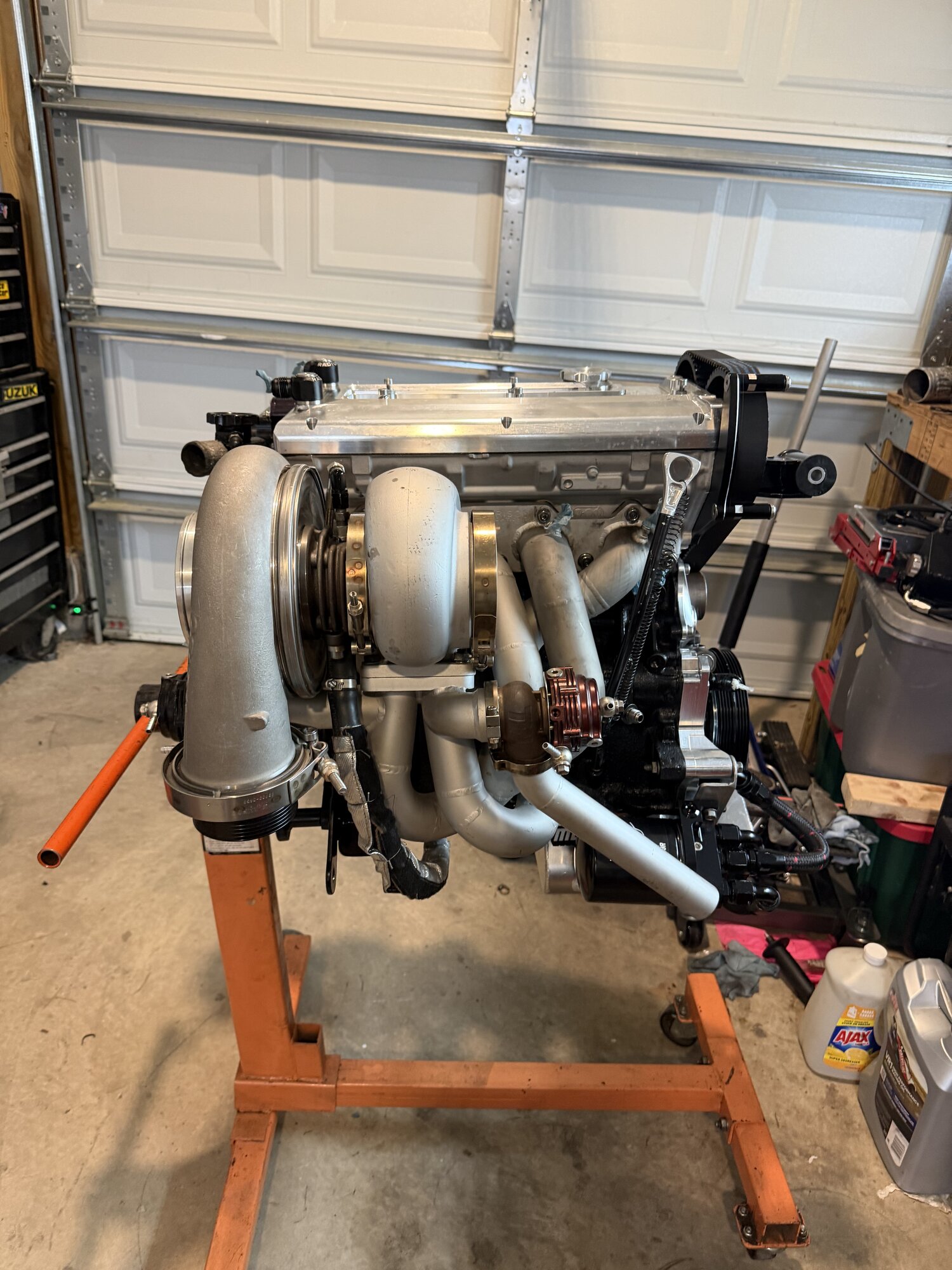

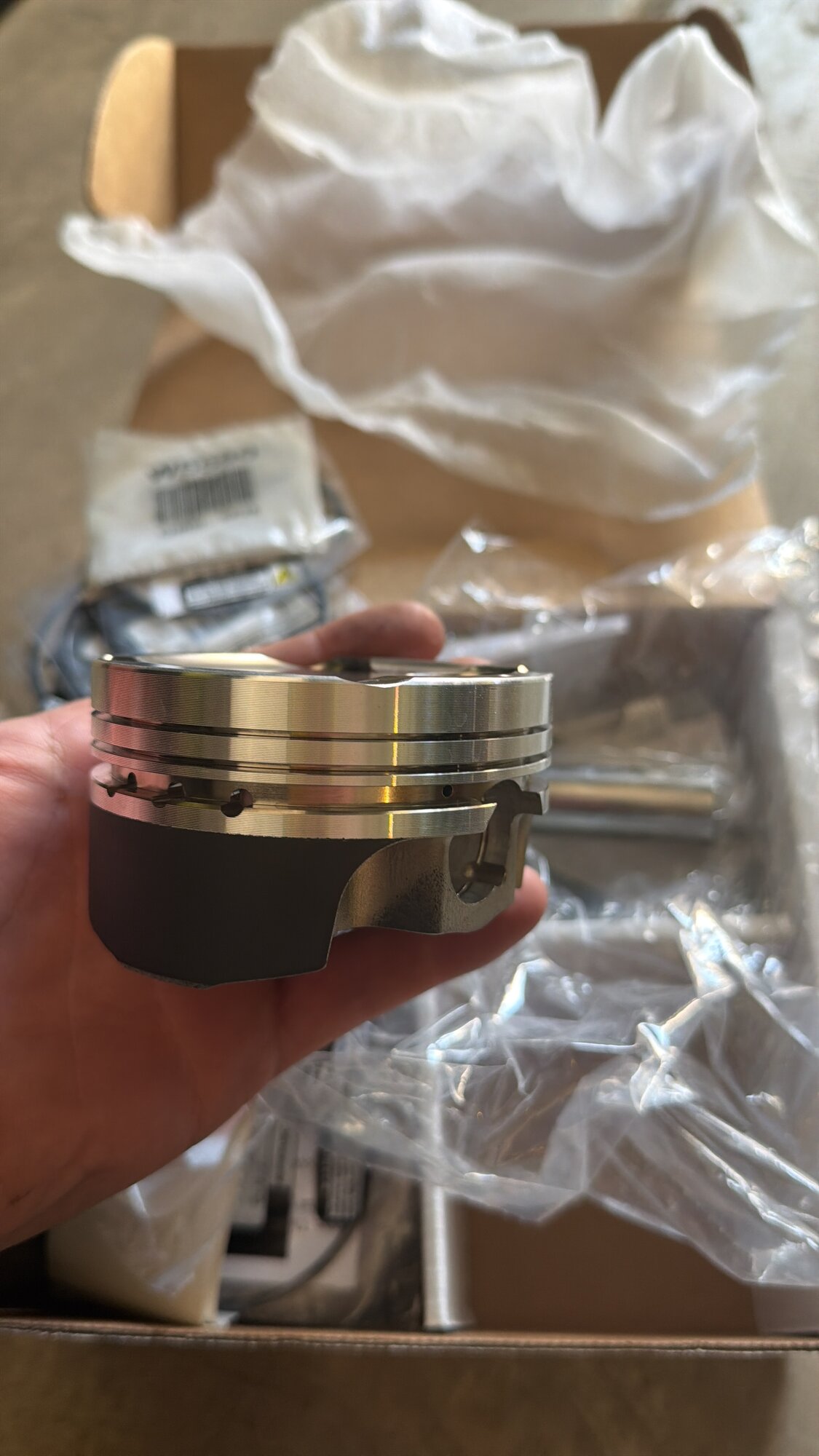

I have everything to build the short block, a fresh set of Vader rods, king main bearings (finally!), wiseco custom pistons and an oem crank. Sticking with the 2.0LR 156mm rods, 22mm pins and dropping compression down to 9.5:1 vs the 11.5:1 and 10.5:1 in previous seasons. Today we knocked out 3/4 filling the block, probably more but the concrete is about 1” below the deck surface. I don’t feel like welding the head shut and the full wet block took us to a healthy 1000whp+ but I know I was really pushing it. Right or wrong i don’t know but it’s done and that’s what I’m trying. Old shearer spec wiseco 2.0 spec vs the new pistons.
Should be able to drop the block off at the machine shop sometime this week and then start chipping away at tubing the front end. I got ahold of a 2G auto transmission so I’ll be swapping to that. The caveat is I need a good converter which is dang near impossible to find. I don’t have any timeline or goals this season other than getting out to the track, making some passes without breaking and having fun. Glad to be back, lots of catching up to do on the forums it looks like lots of guys have been busy.

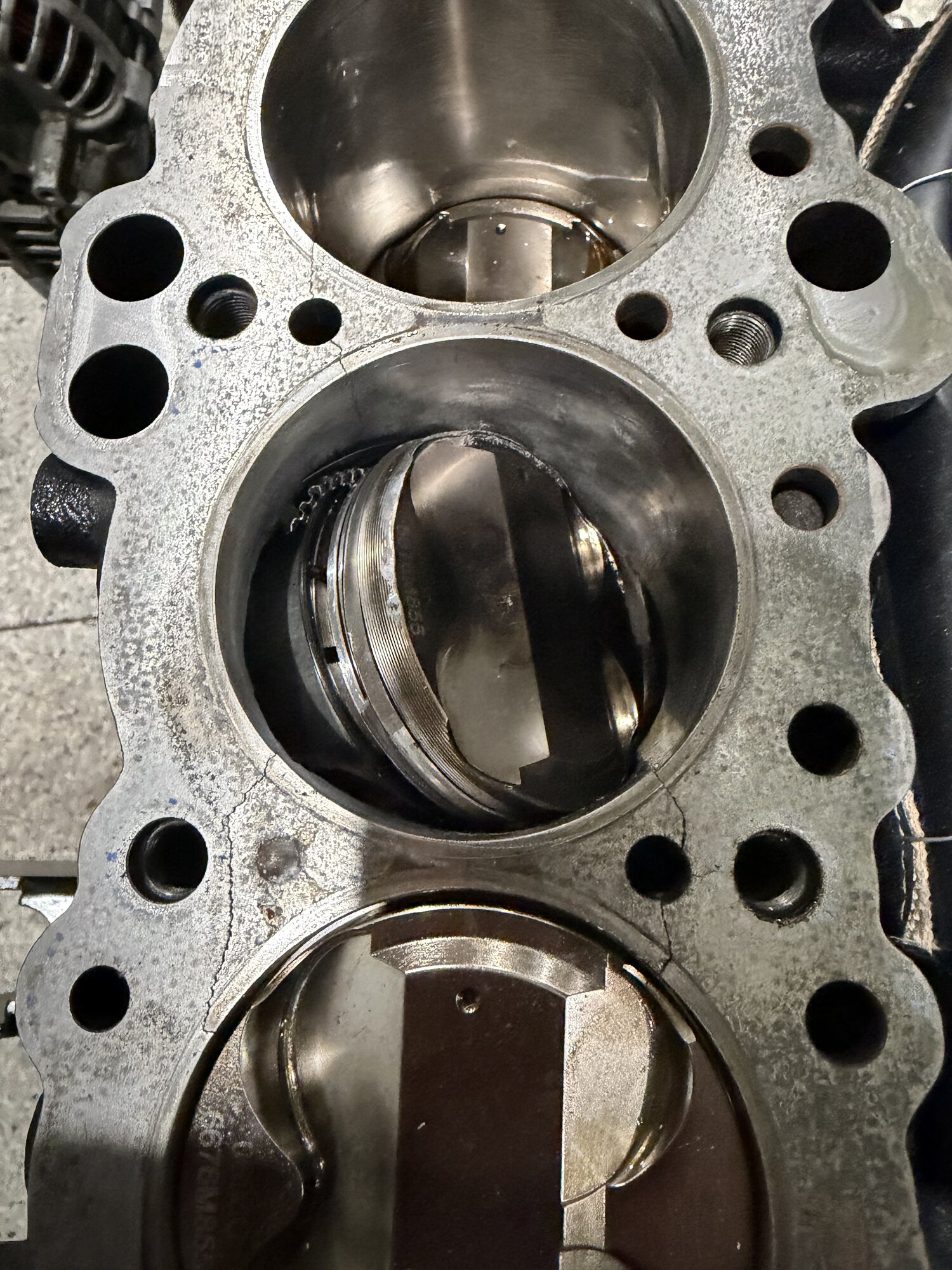

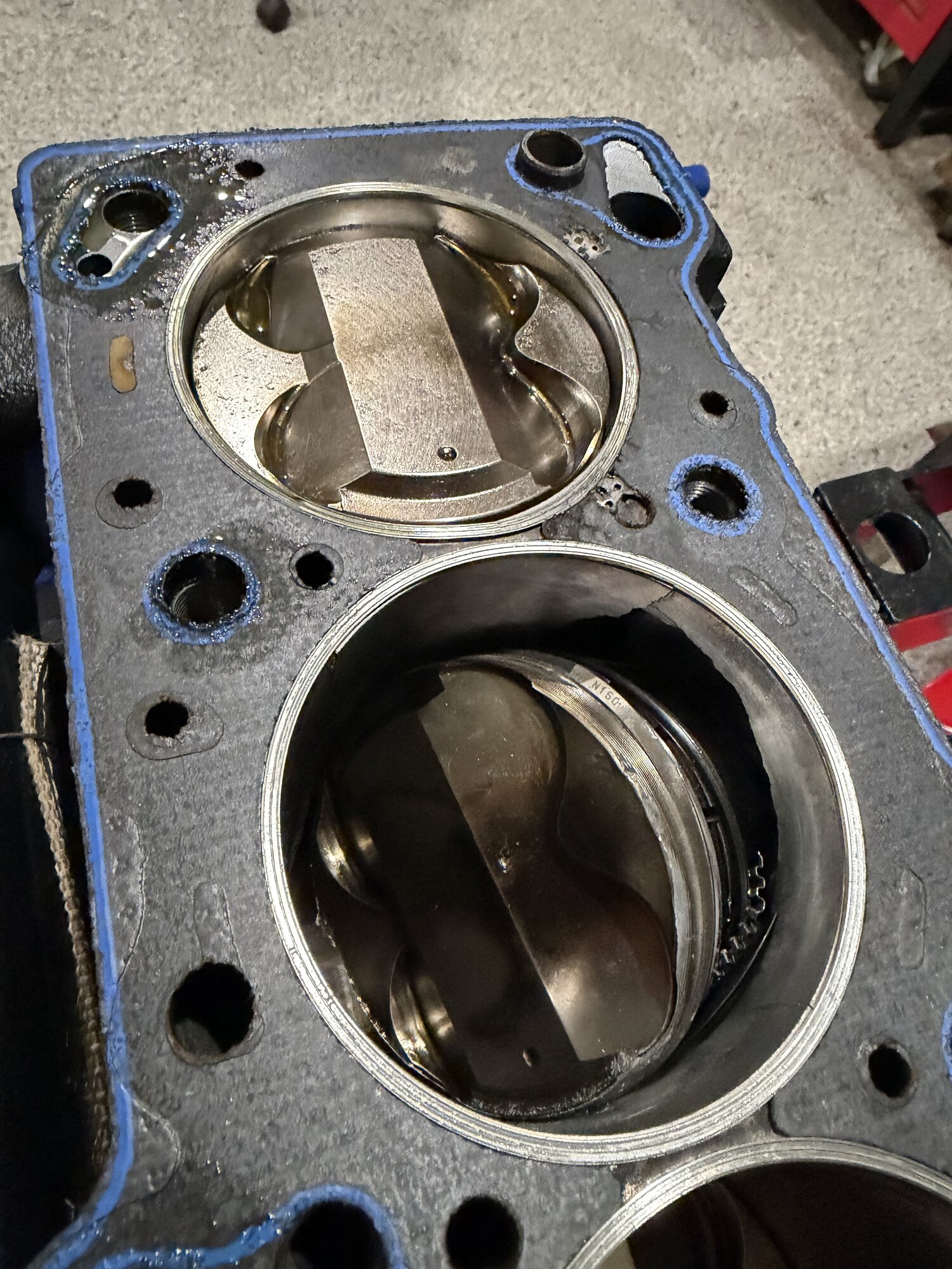

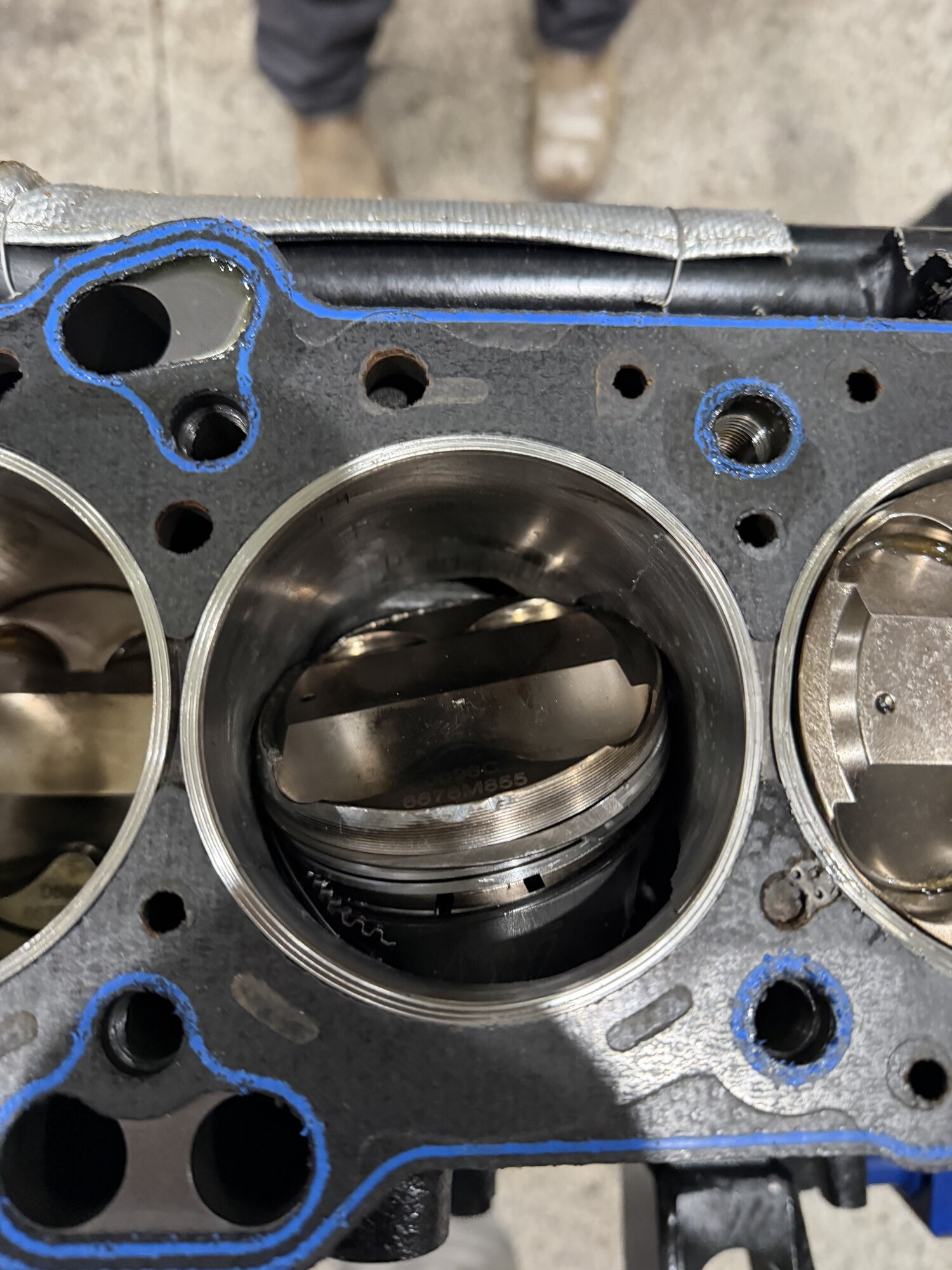

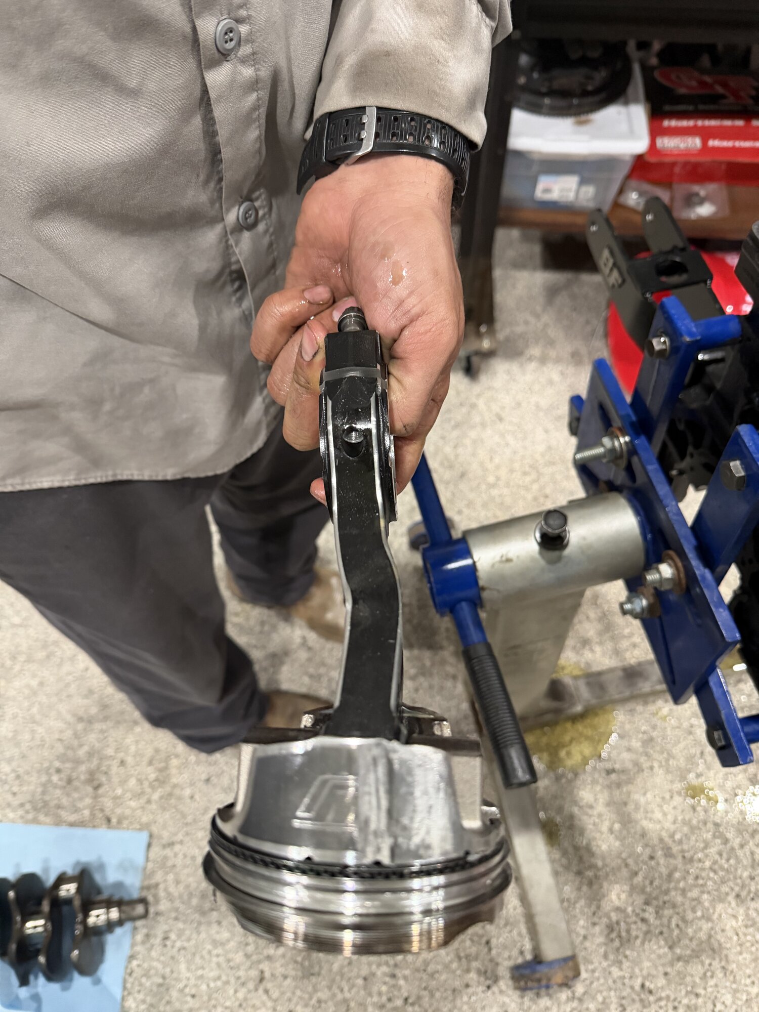

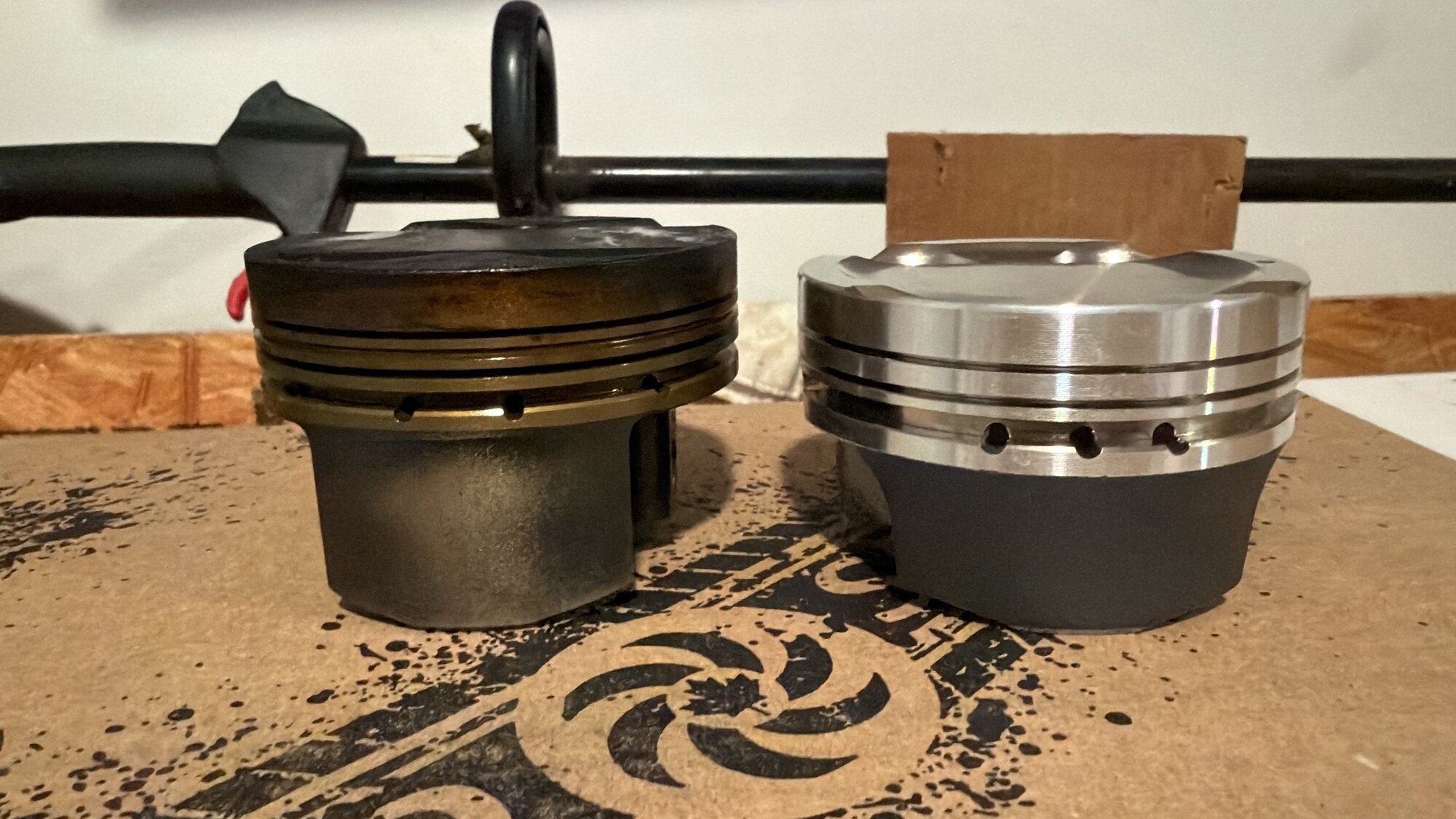

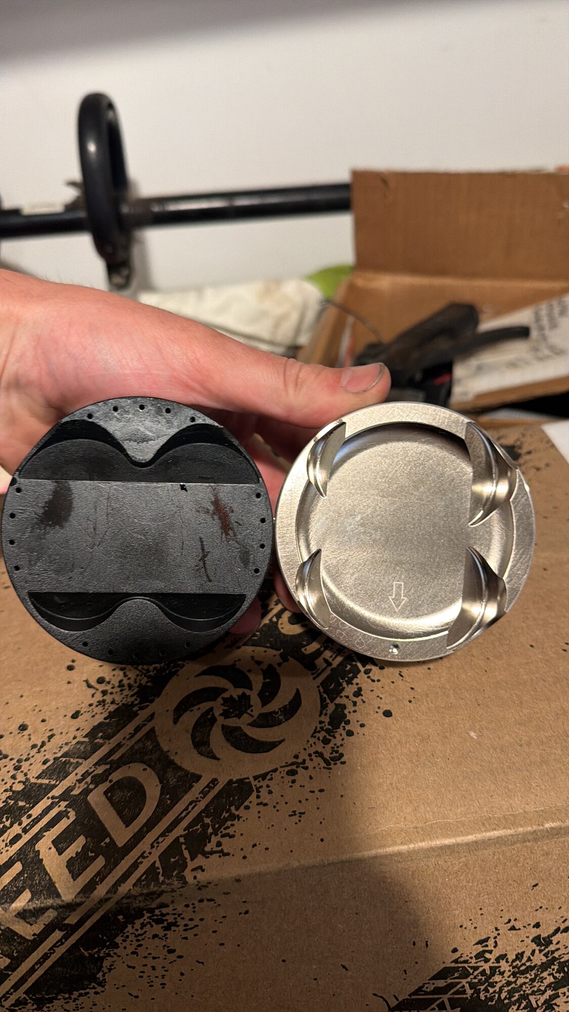

We got the old engine ripped apart, the way it broke was pretty amazing. As I suspected cylinder 3 gave out, my guess is the cylinder wall cracked, water rushed in and hydro locked the cylinder, snapped the rod and then all hell broke loose. It slammed cylinder 3 into #4 offset that one, cracked the deck on 4,3 and into #2. The craziest part of the whole thing is that it didn’t window the outside of the block. When I pulled the valve cover no rockers were kicked off, timing marks were still in line. It looks like it nicked the intake valves on number 3 (bent) but I couldn’t see anything else with the eye ball test and I’m super relieved for that.

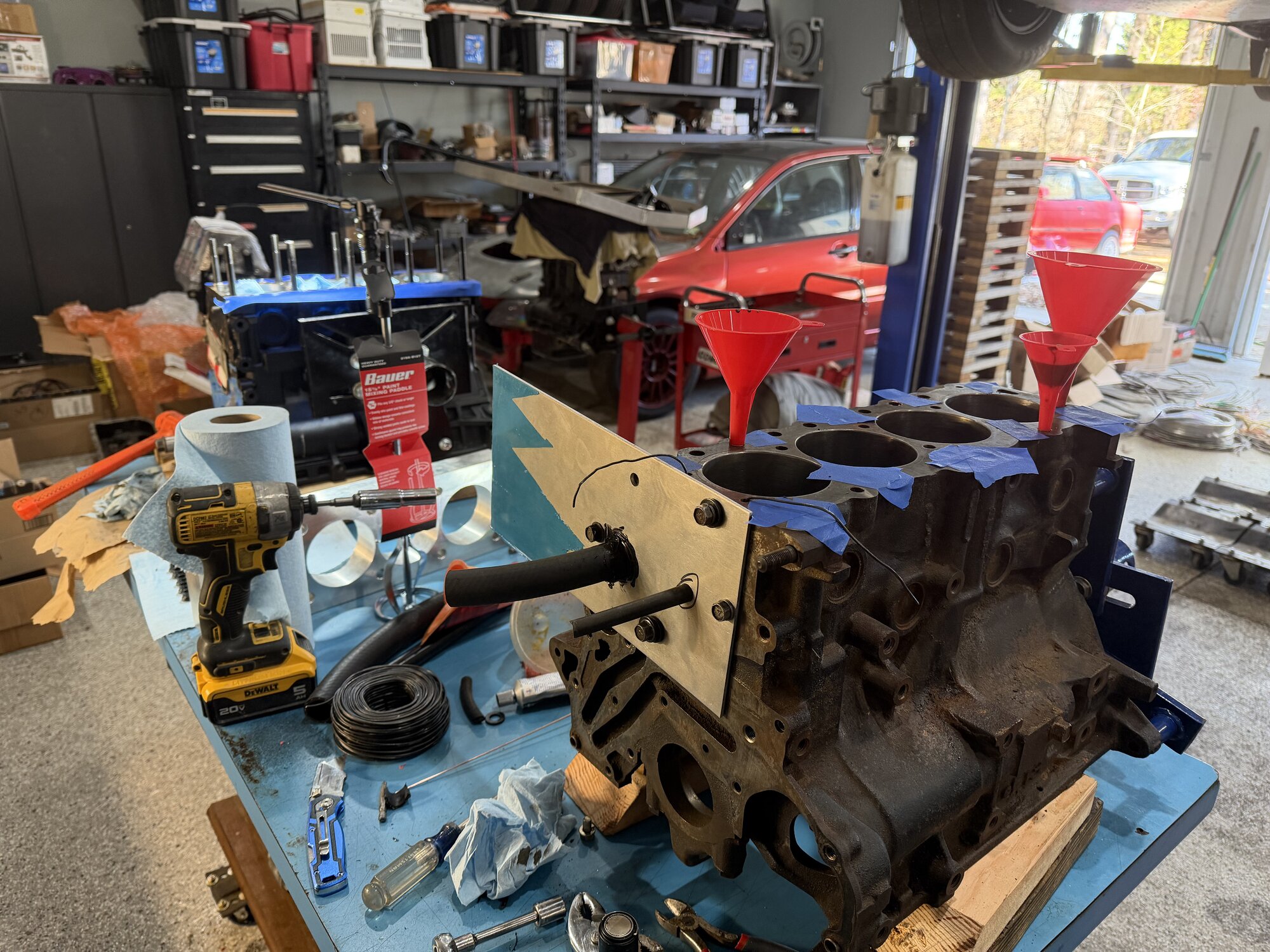

Block was dropped off yesterday at TKM Performance in Denton,NC. We’ve been feeding them 4G blocks for the past 2 years. Great facility, they do a lot of the big V8 cars including Cletus Mcfarlands engines. I gave them my specs and they’ll handle the machine work like in 2024 and then I’ll assemble the block myself again.

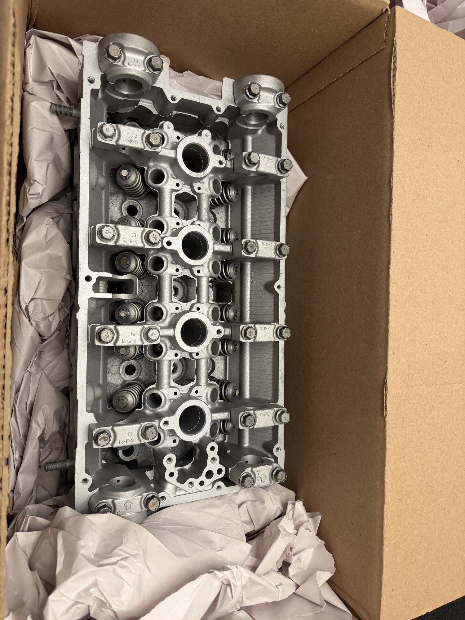

The head I’m going to ship down to Dover cylinder heads in SC again, I really like their work and they’ve been doing the 4G heads for at least 15 years now.

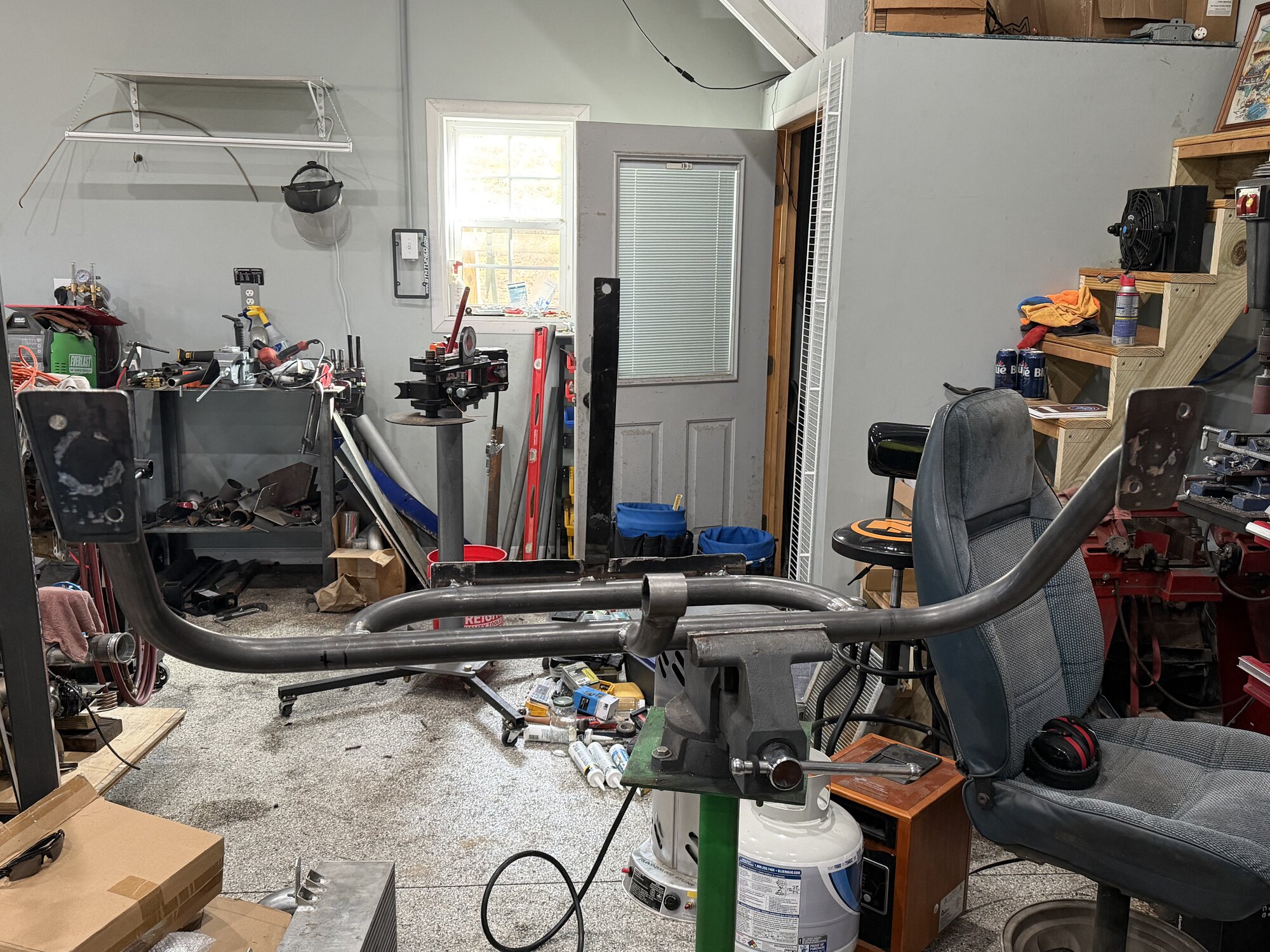

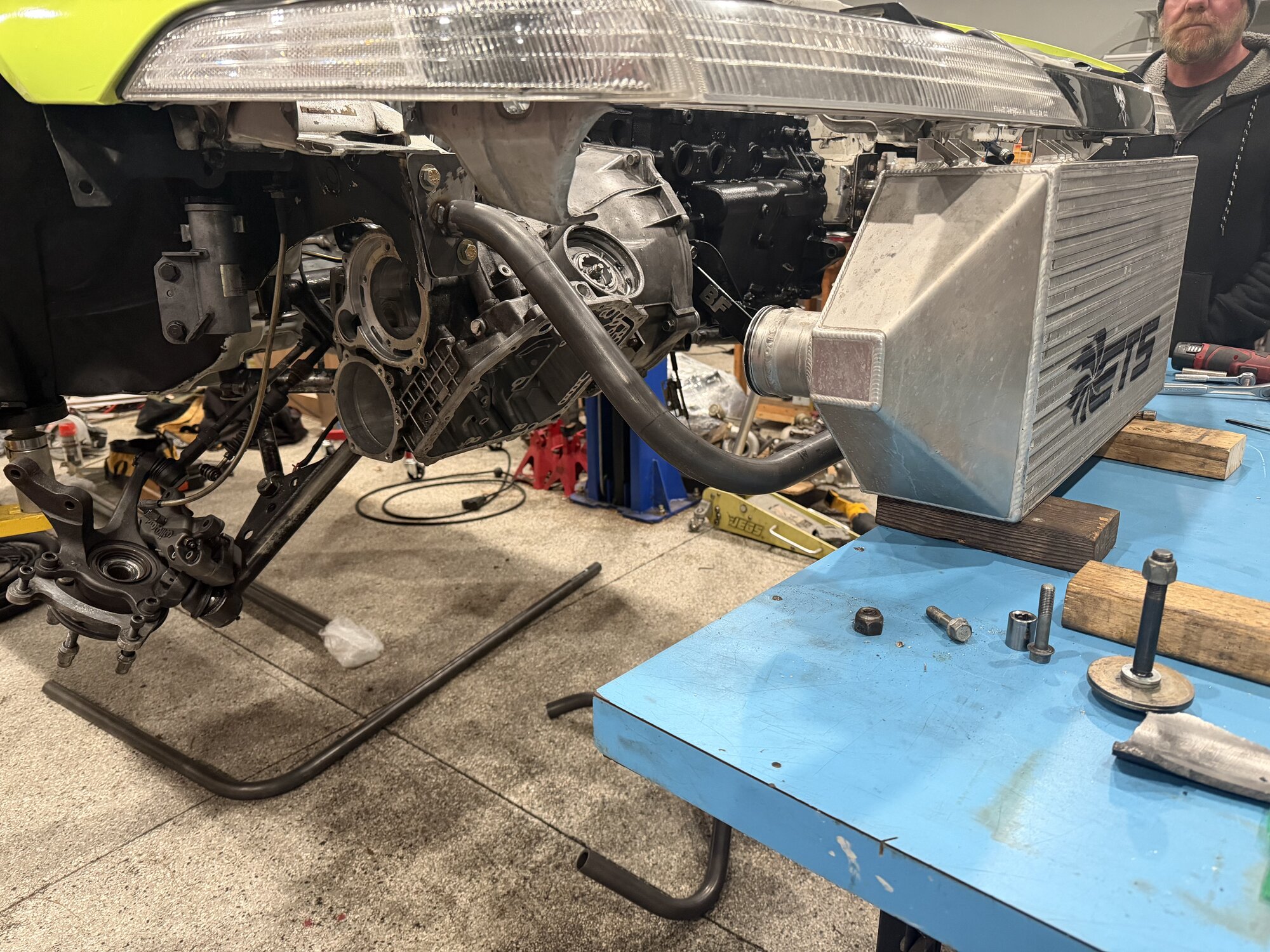

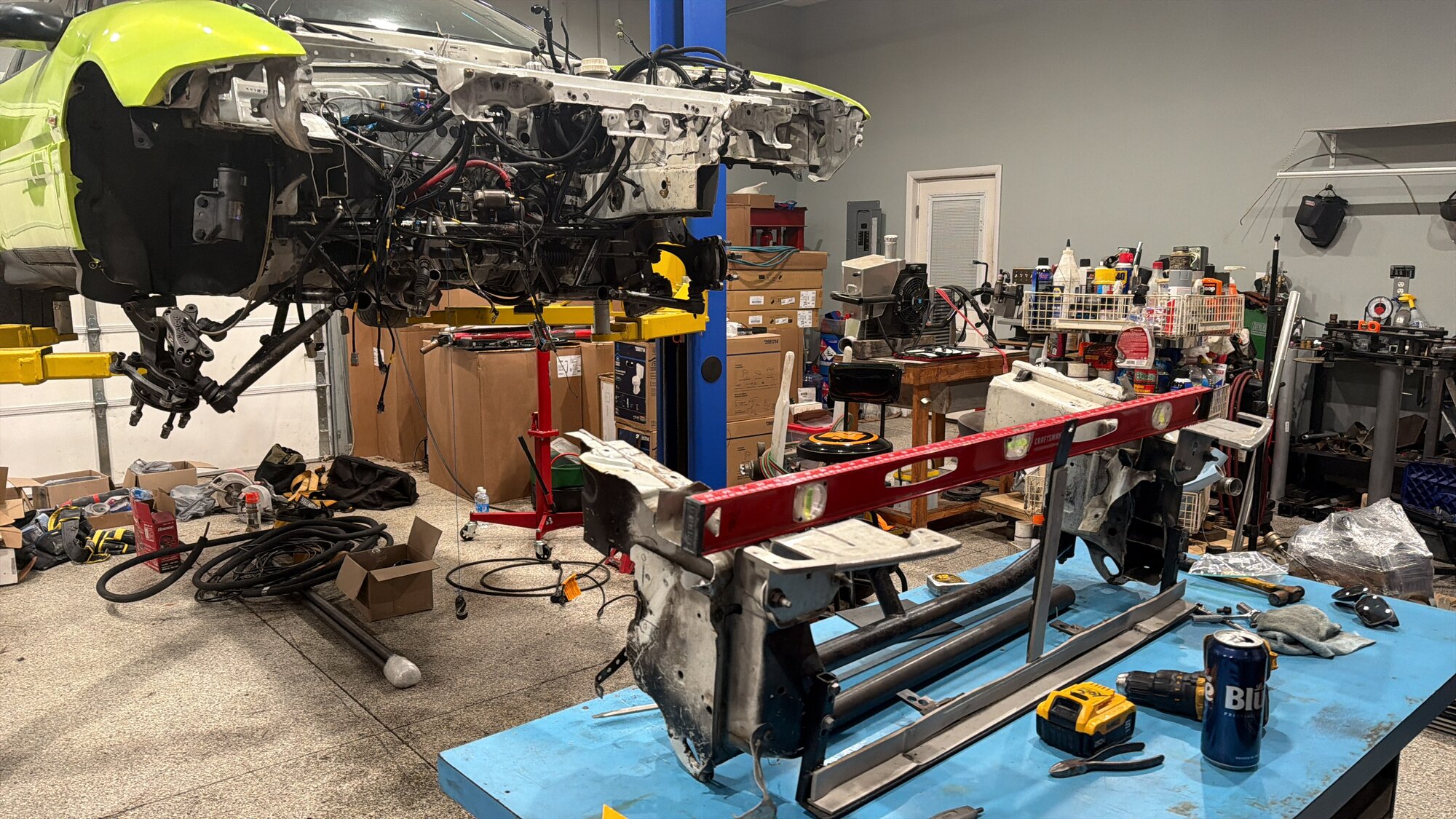

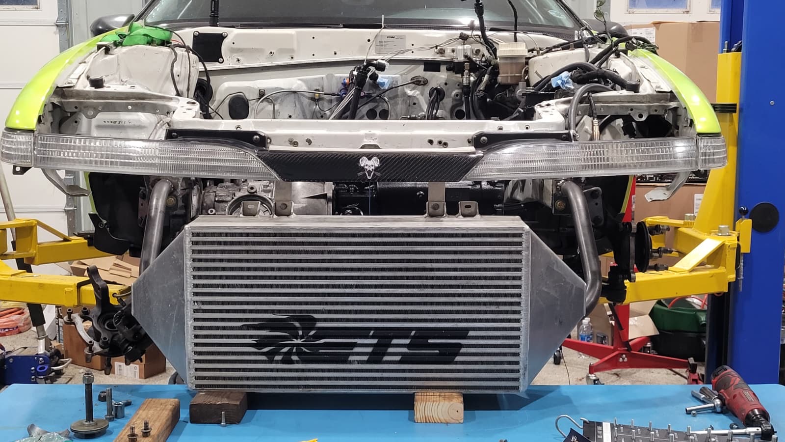

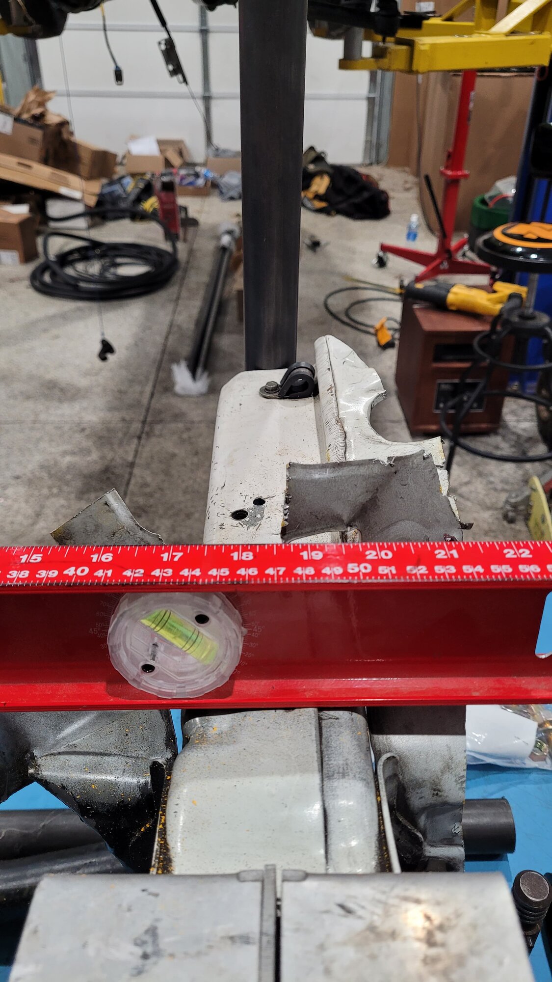

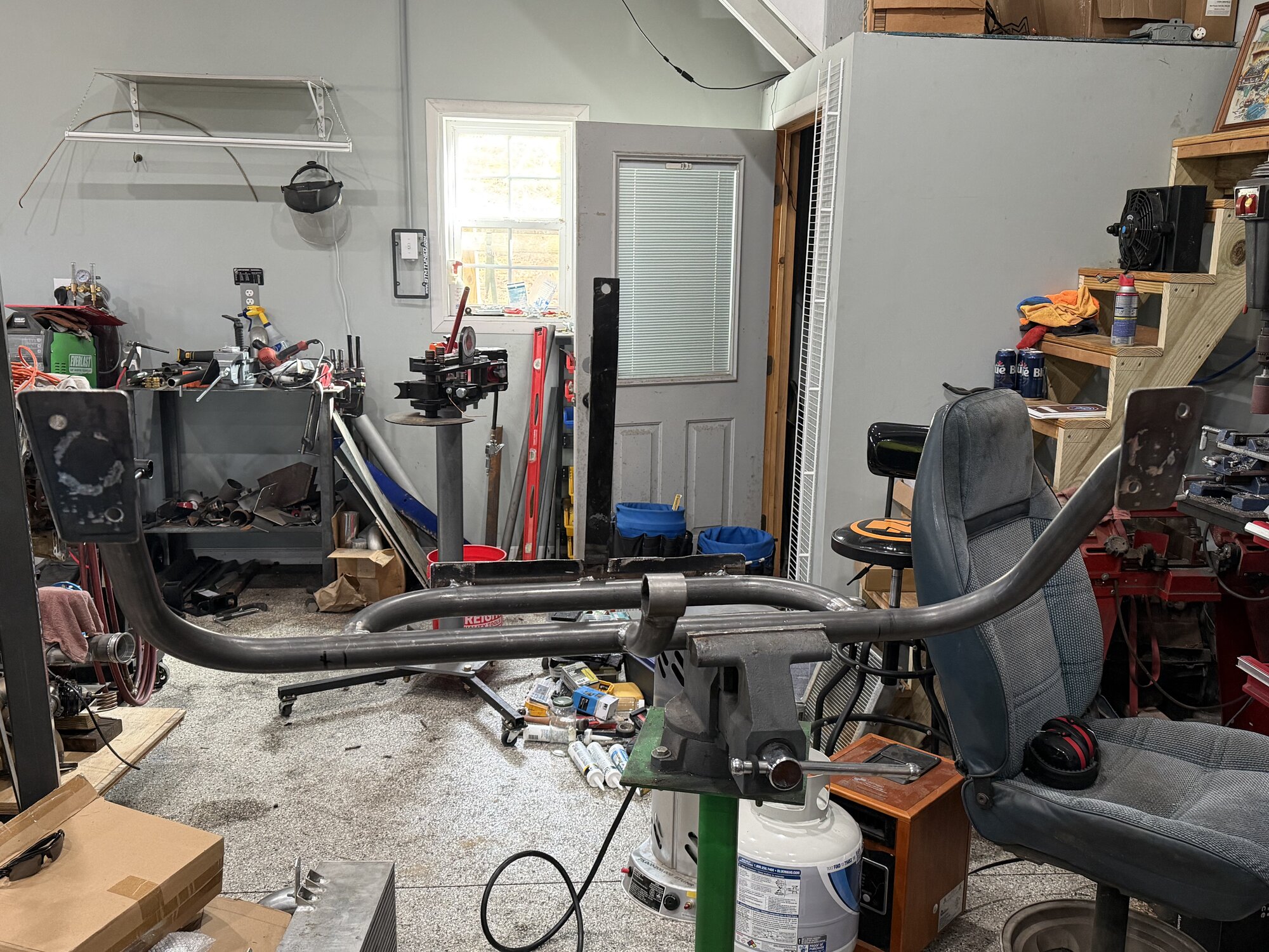

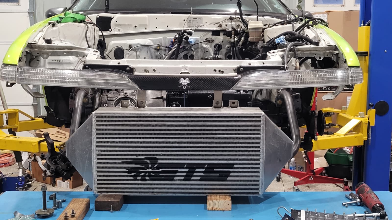

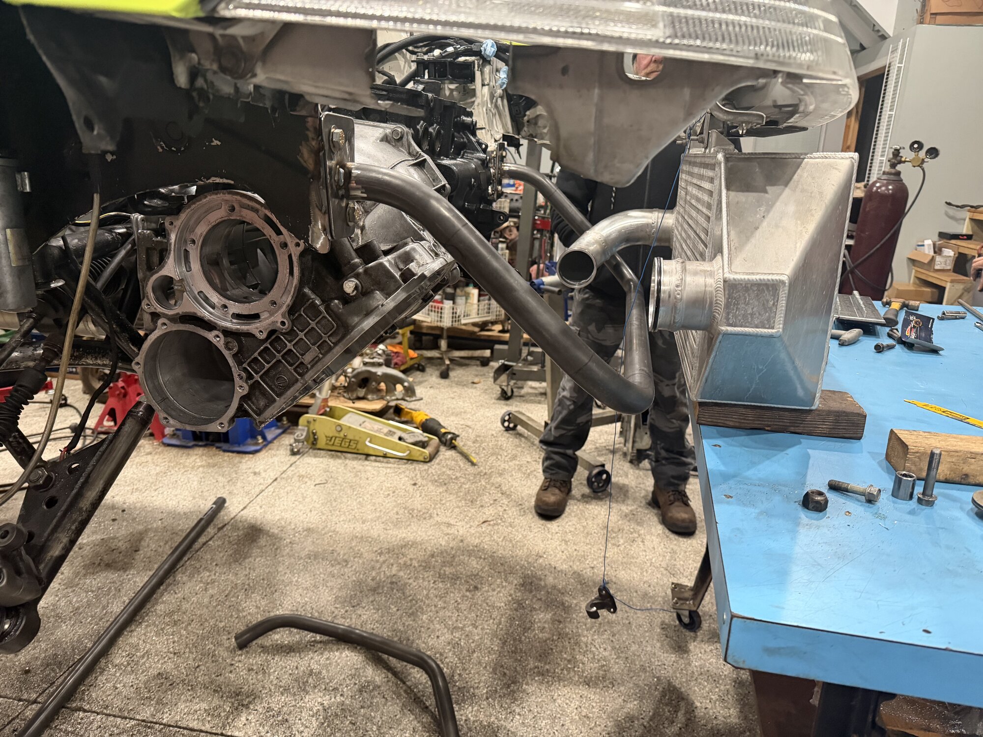

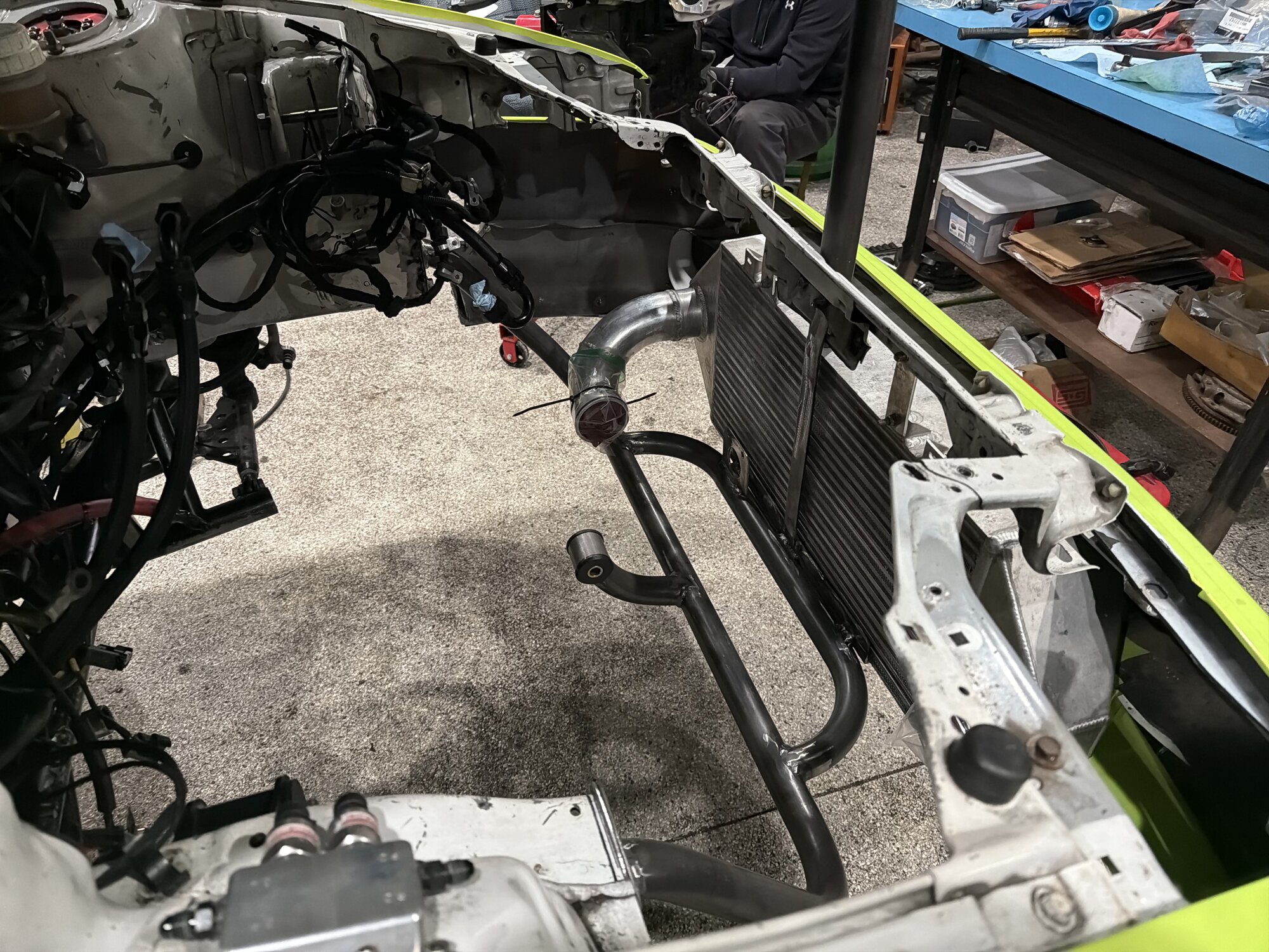

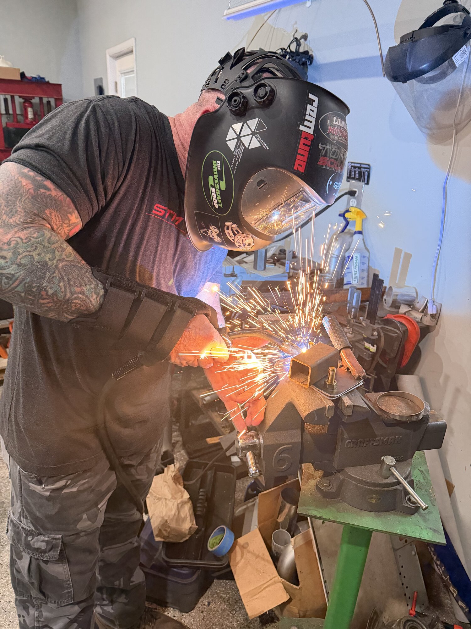

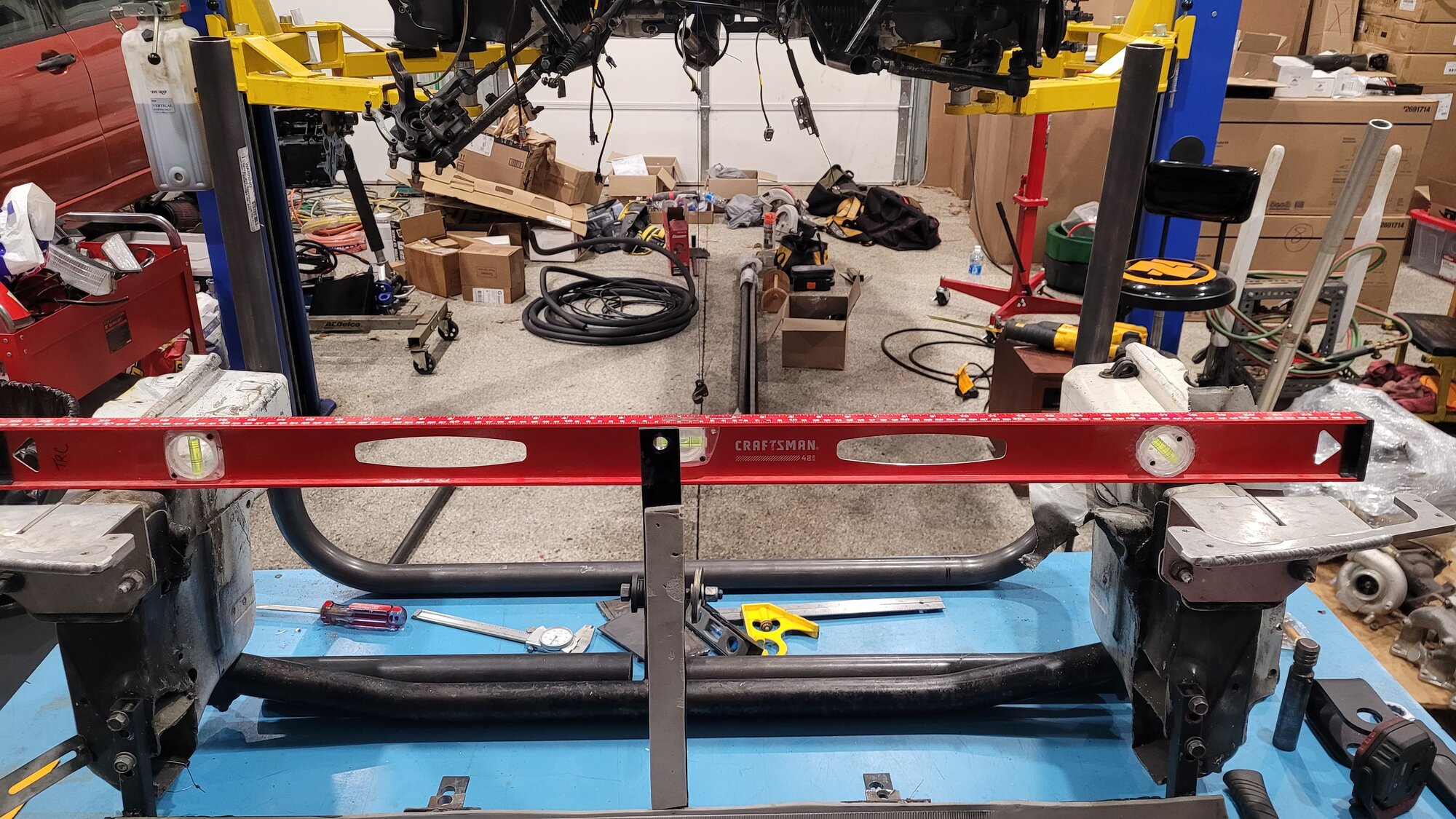

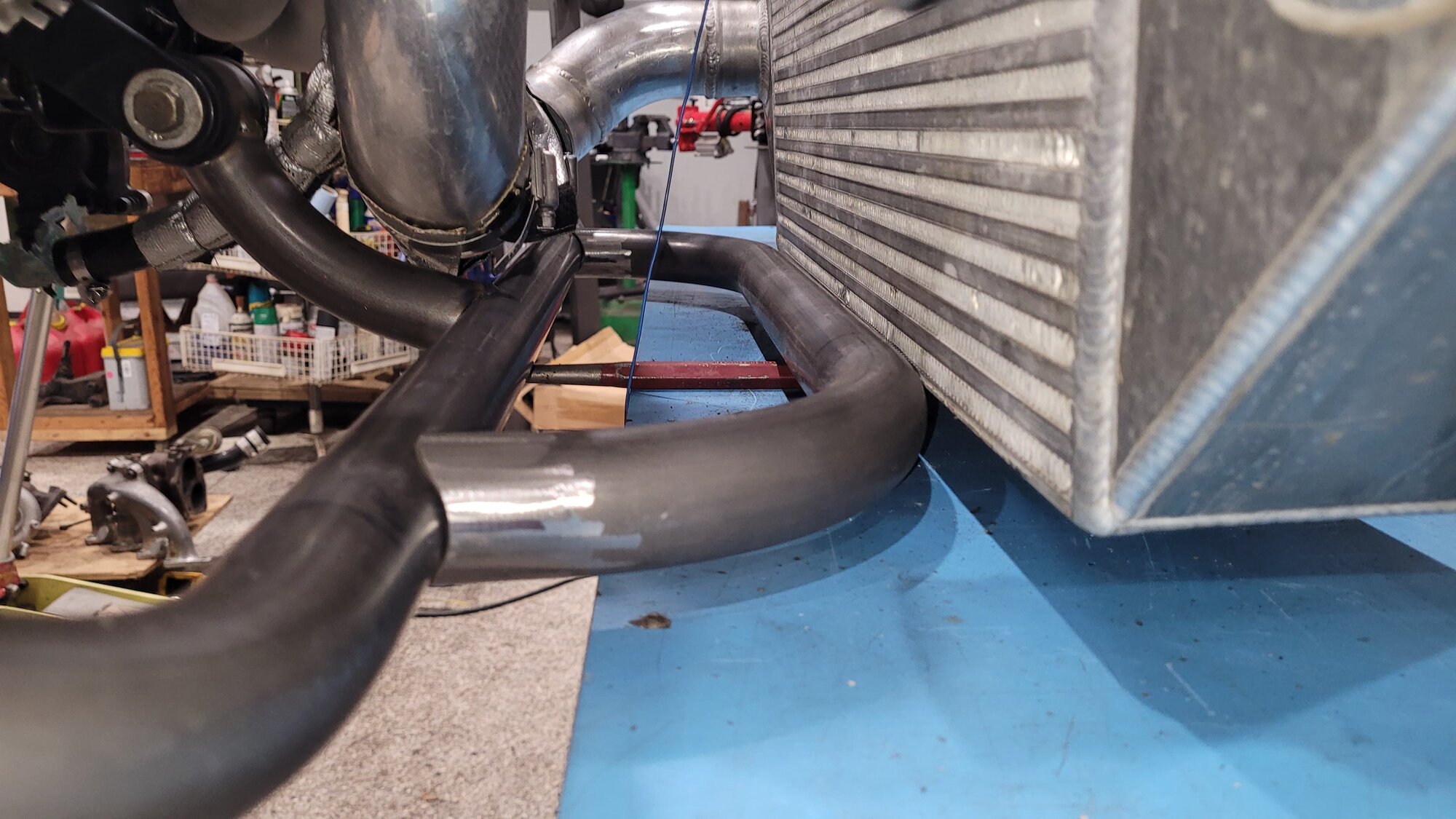

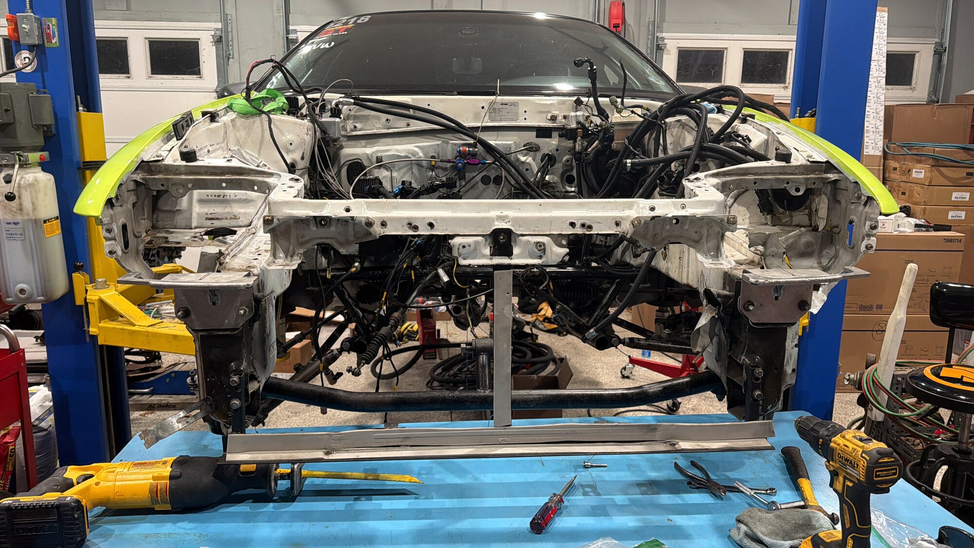

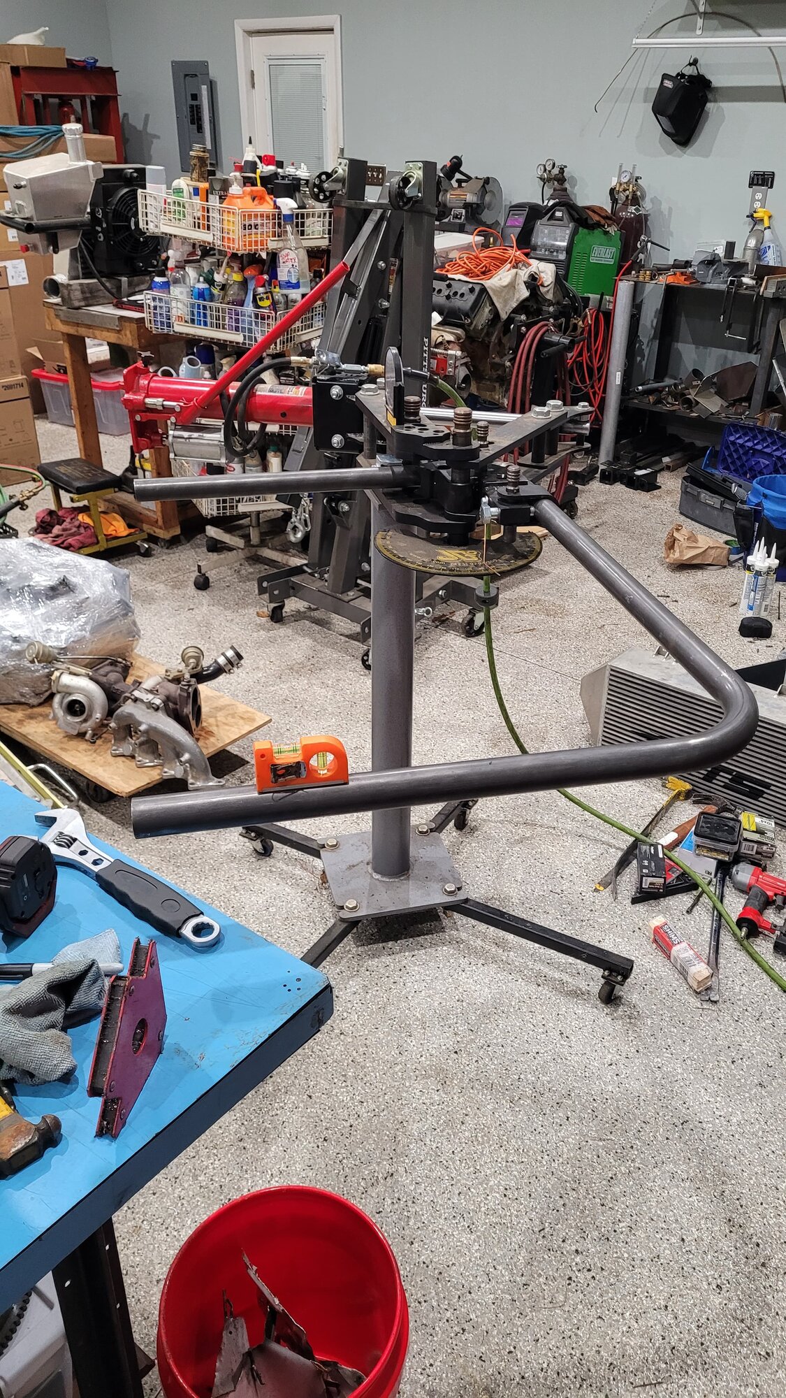

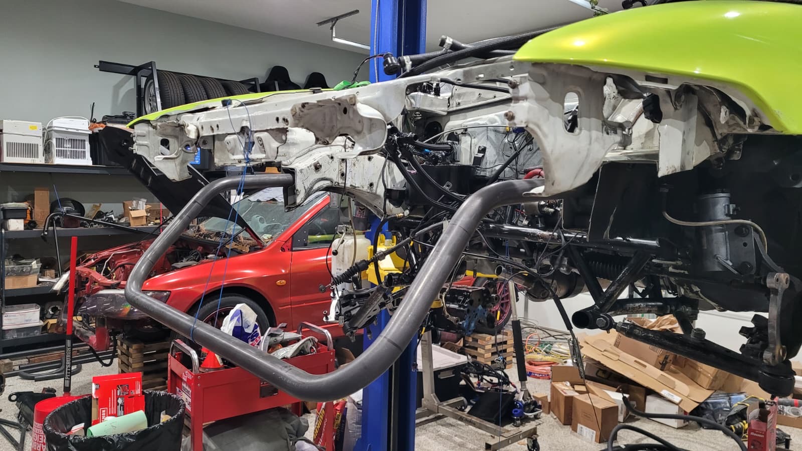

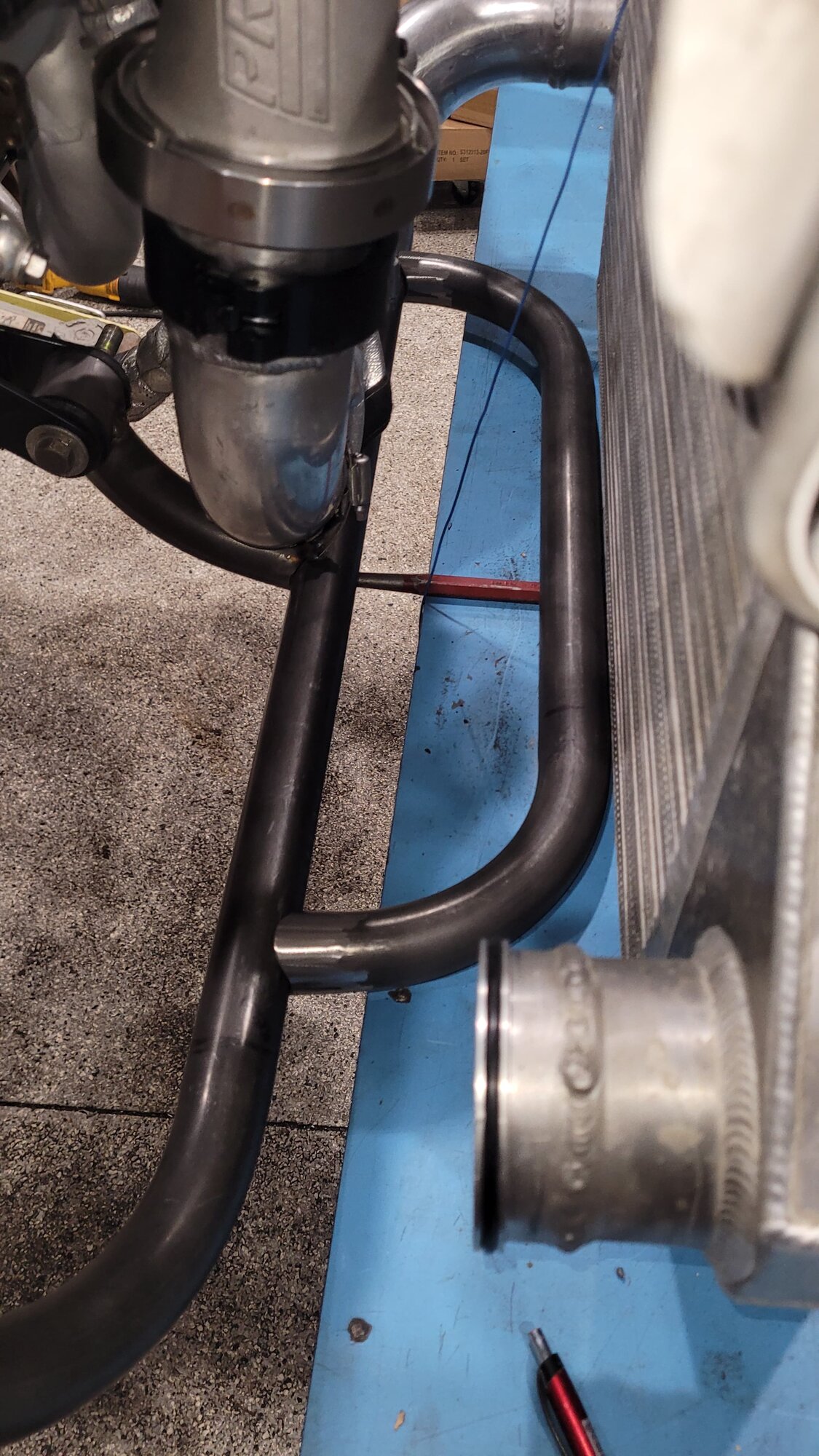

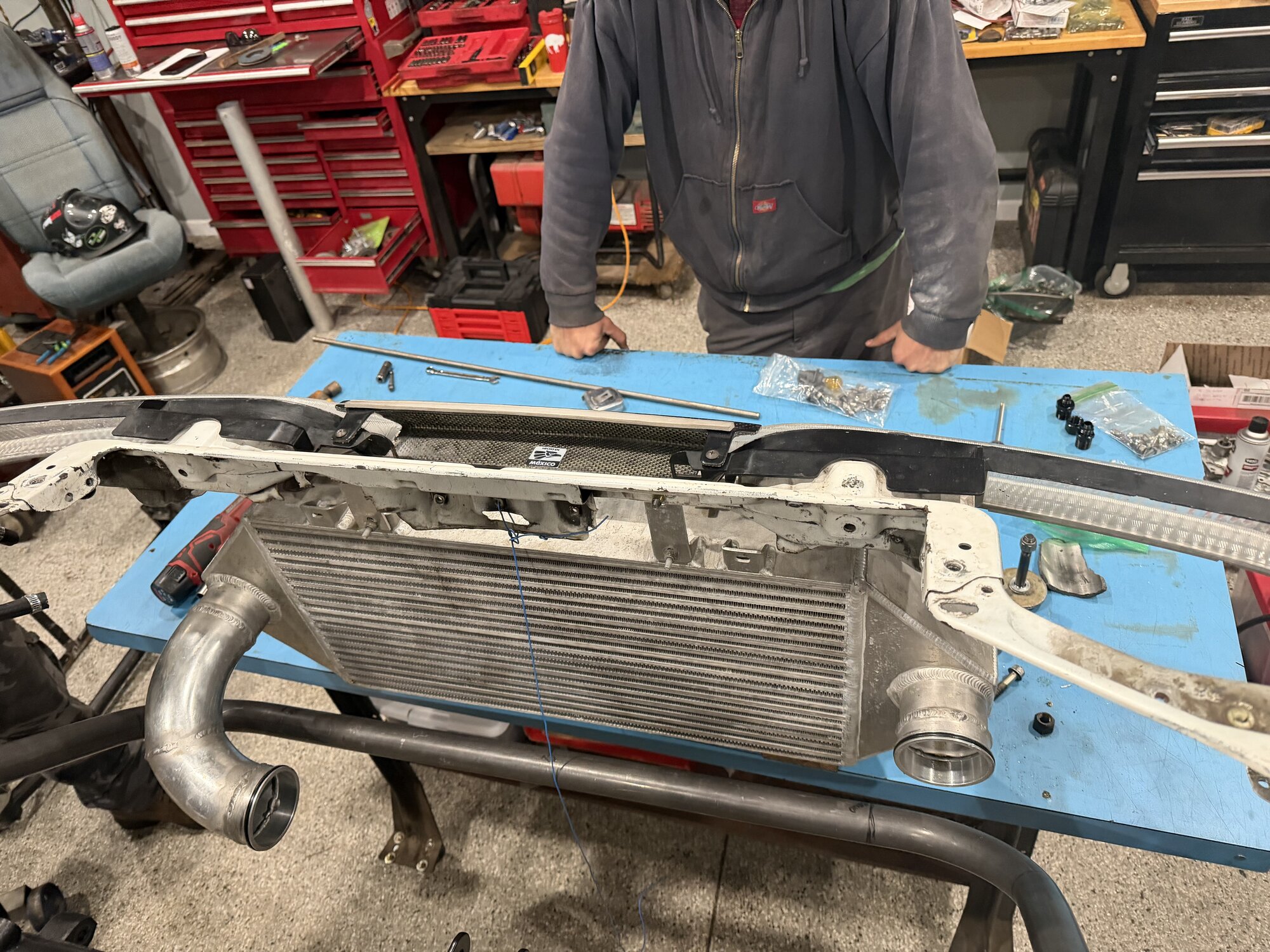

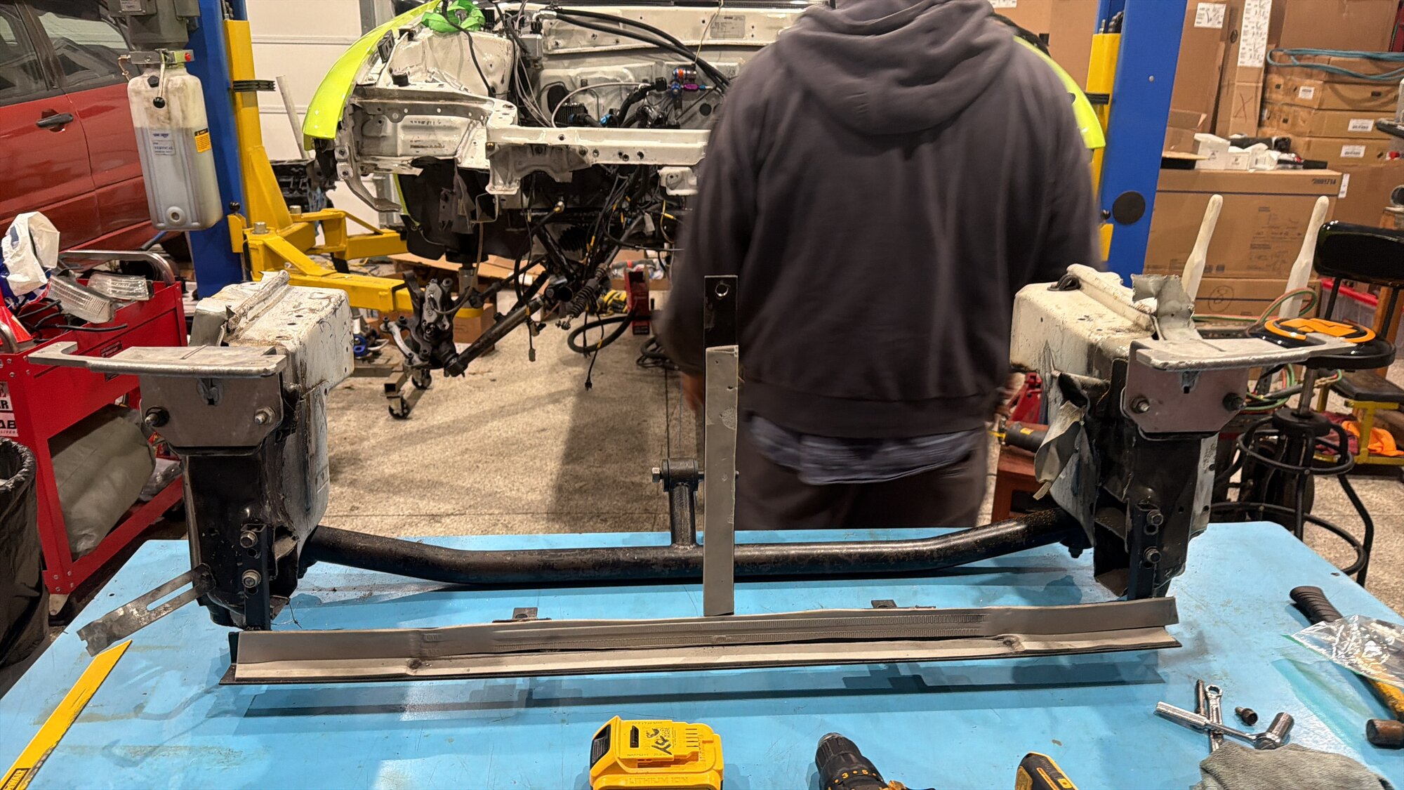

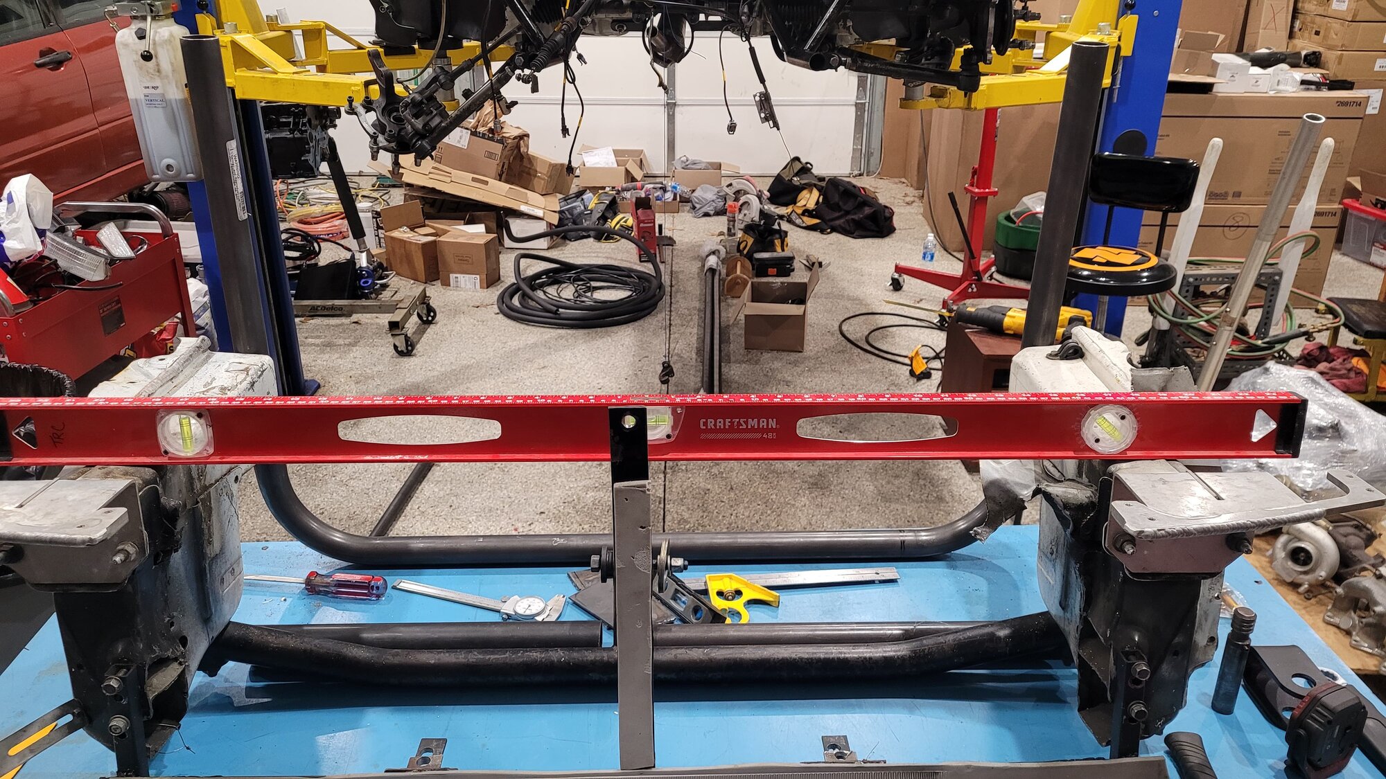

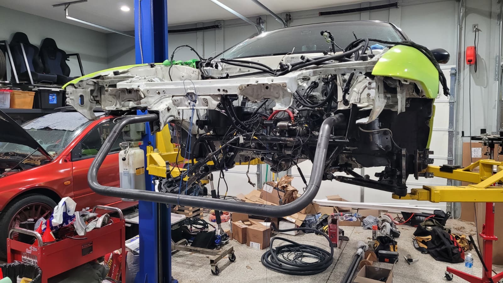

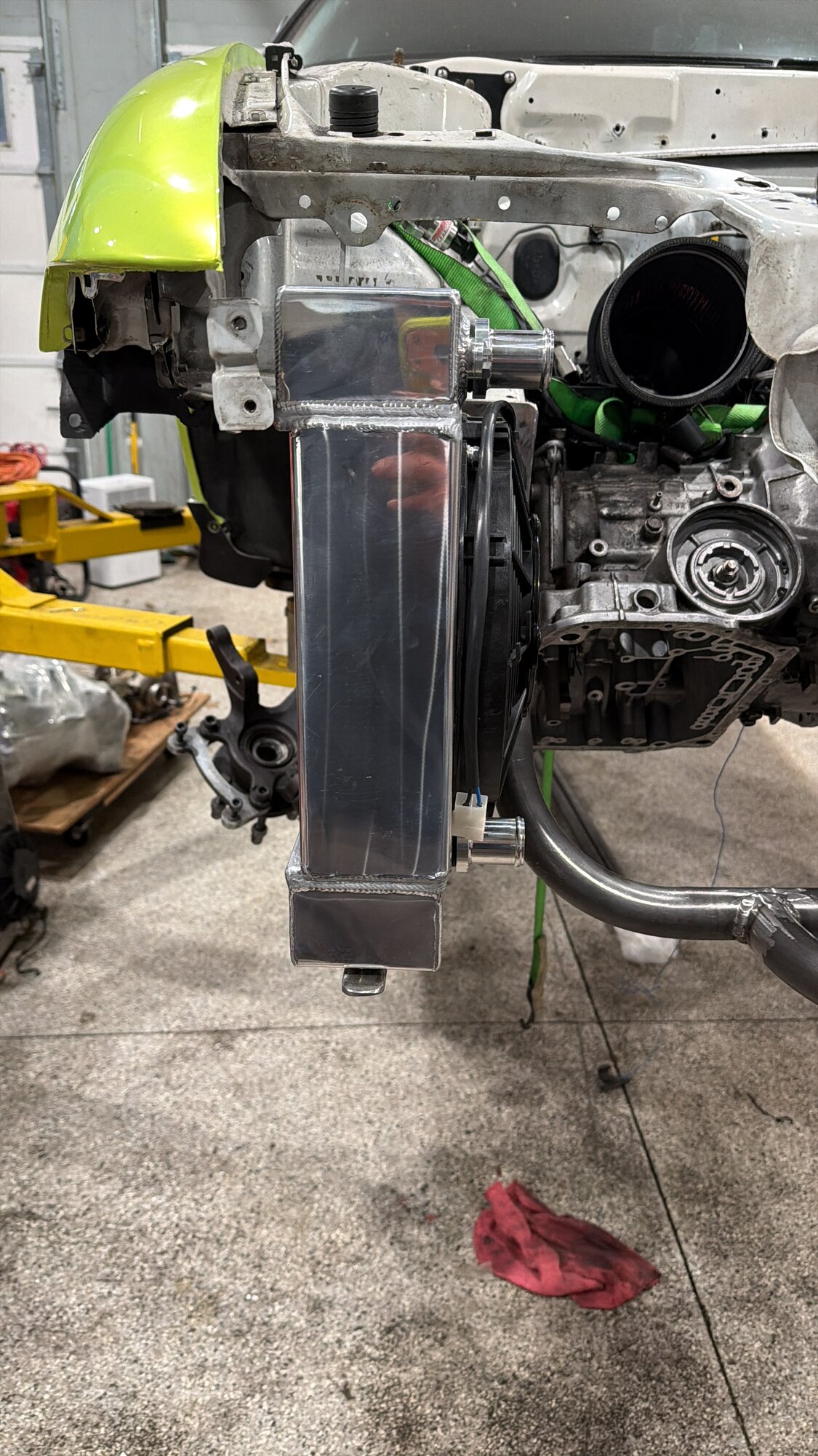

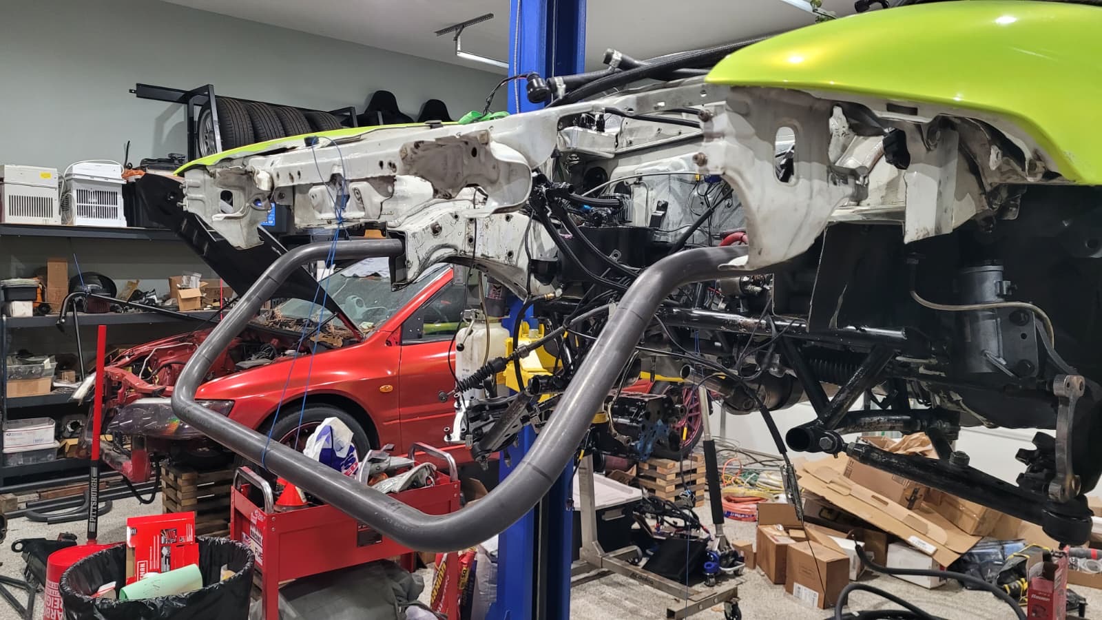

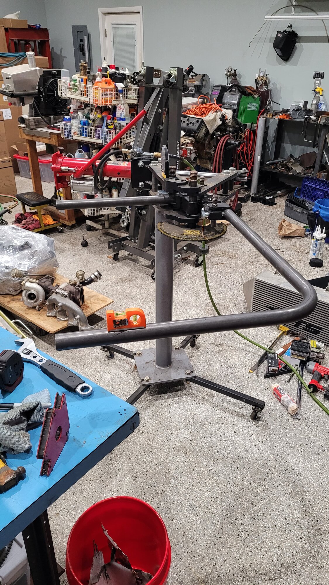

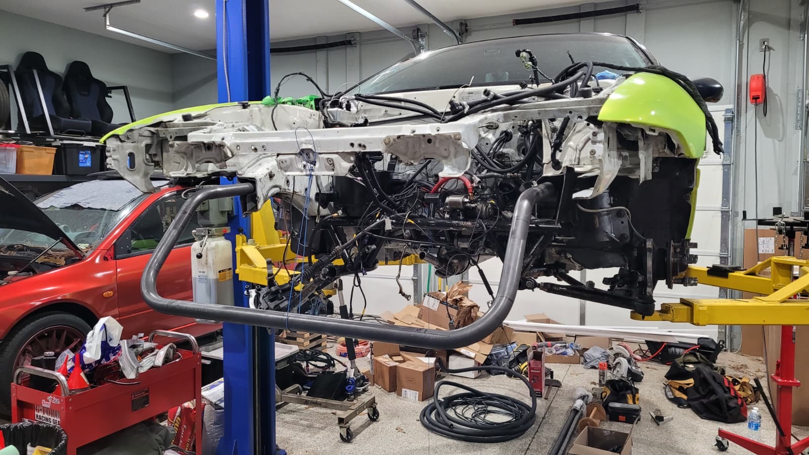

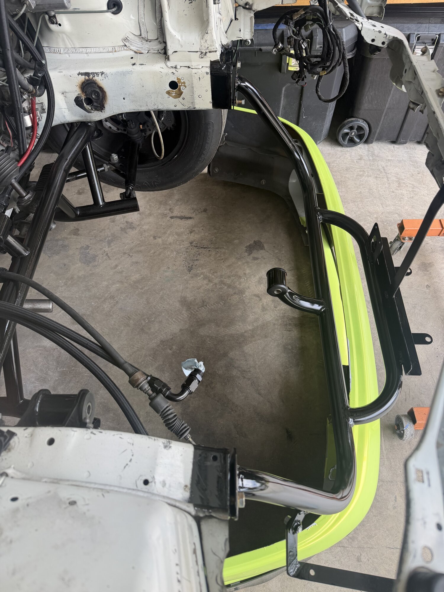

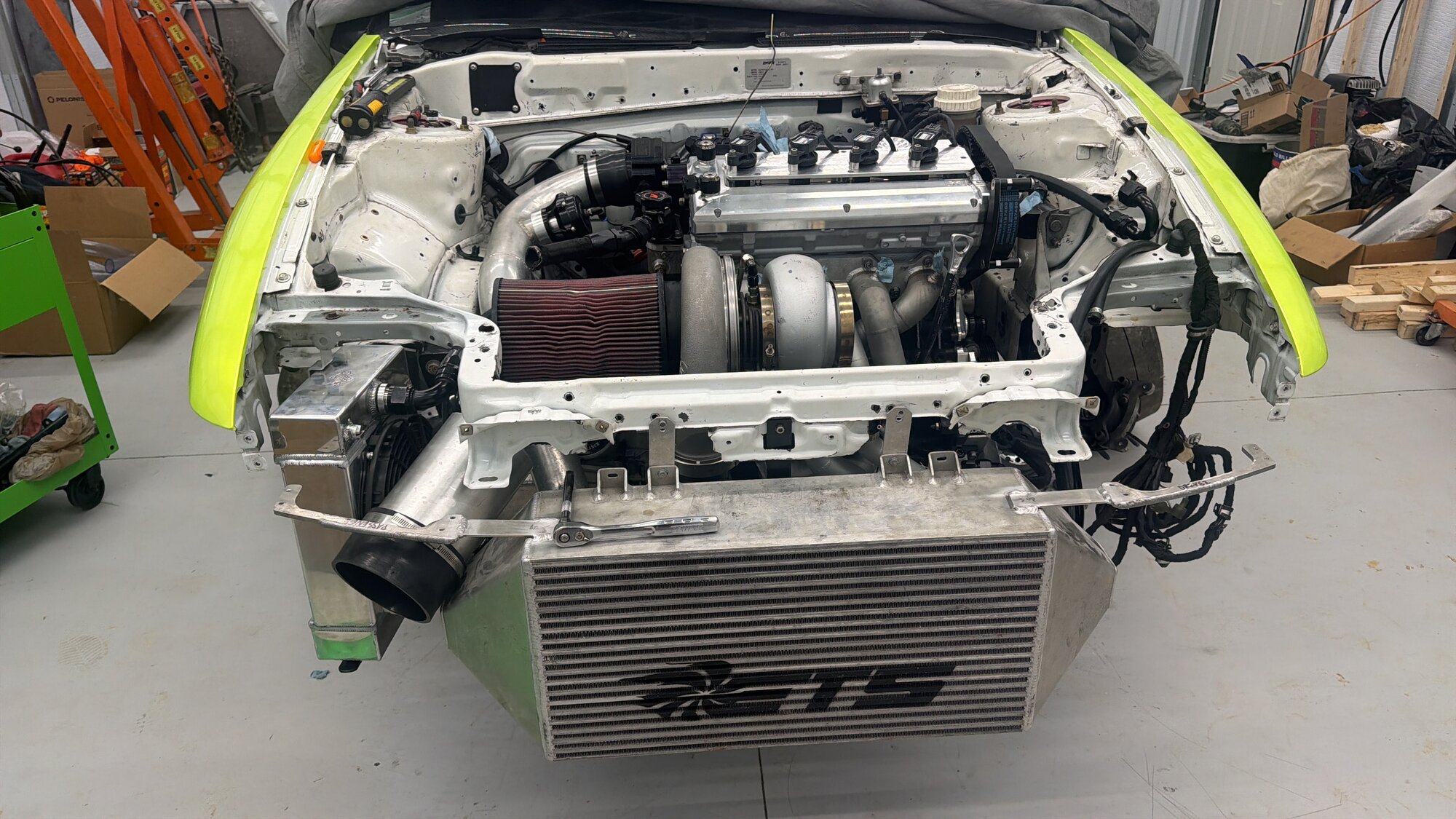

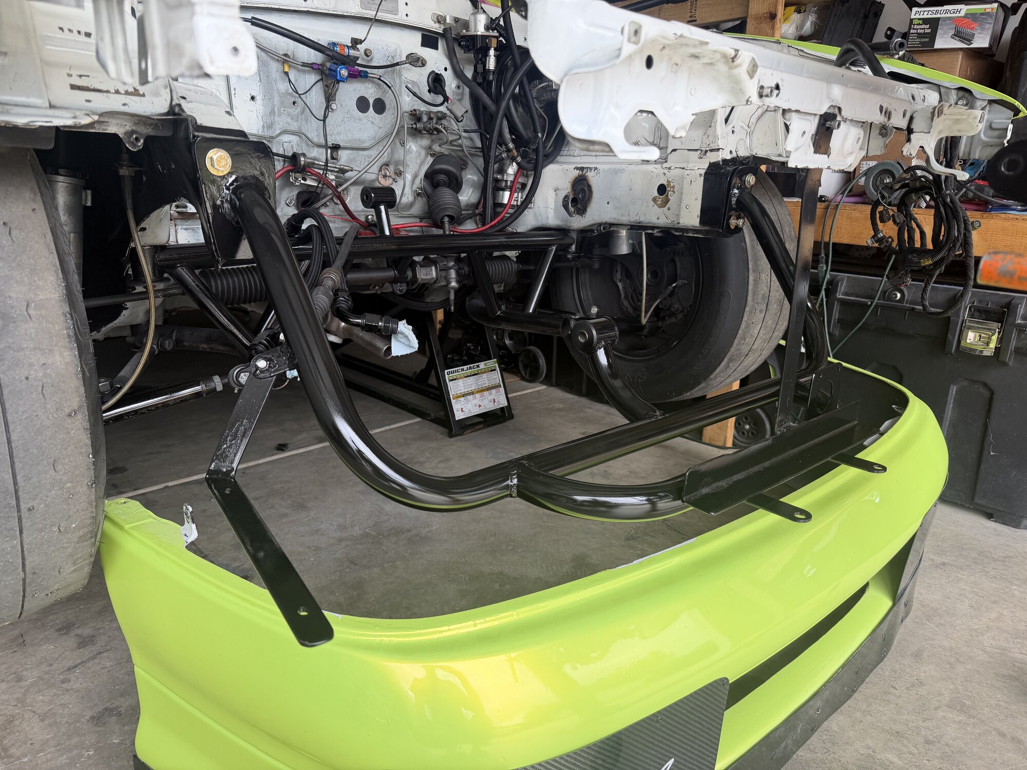

The next order of business was chopping the front end off in preparation to tube the front end. Lots and lots of measuring had to take place. I wouldn’t call fabricating one of my strong suits and this you need to have a good imagination of the vision. I’ve been talking to Gregory and Leisure a lot on this one. In the end I’m going to follow @Mark L design. The top bars will follow more of the factory curvature frame rails but the bottom portion will be similar. This will save a few lbs of weight but more geared towards having room to work on it easier and it was about impossible to pull the compressor cover off without removing my radiator. The class racing I do they measure the comp wheels and then once tech is done you’re into qualifying shortly afterwards. As I progress I’ll keep the updates coming. Trying my best to have the car at the body shop by the first week of February.
I also had a chance to gut 2 of my 1G parts transmissions. Next will be transferring over my current 1G internals to the new 2G trans and build the new valvebody.

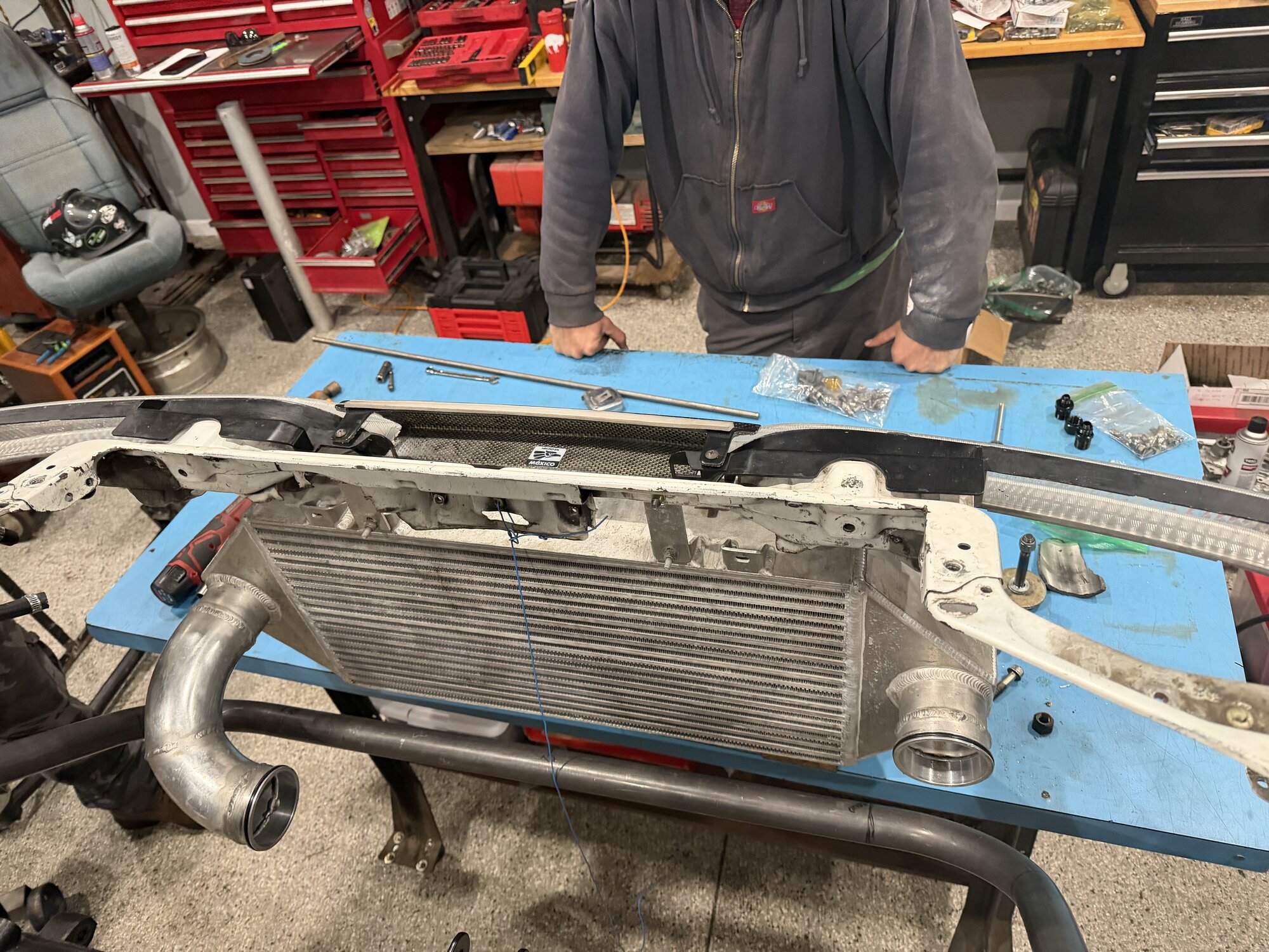

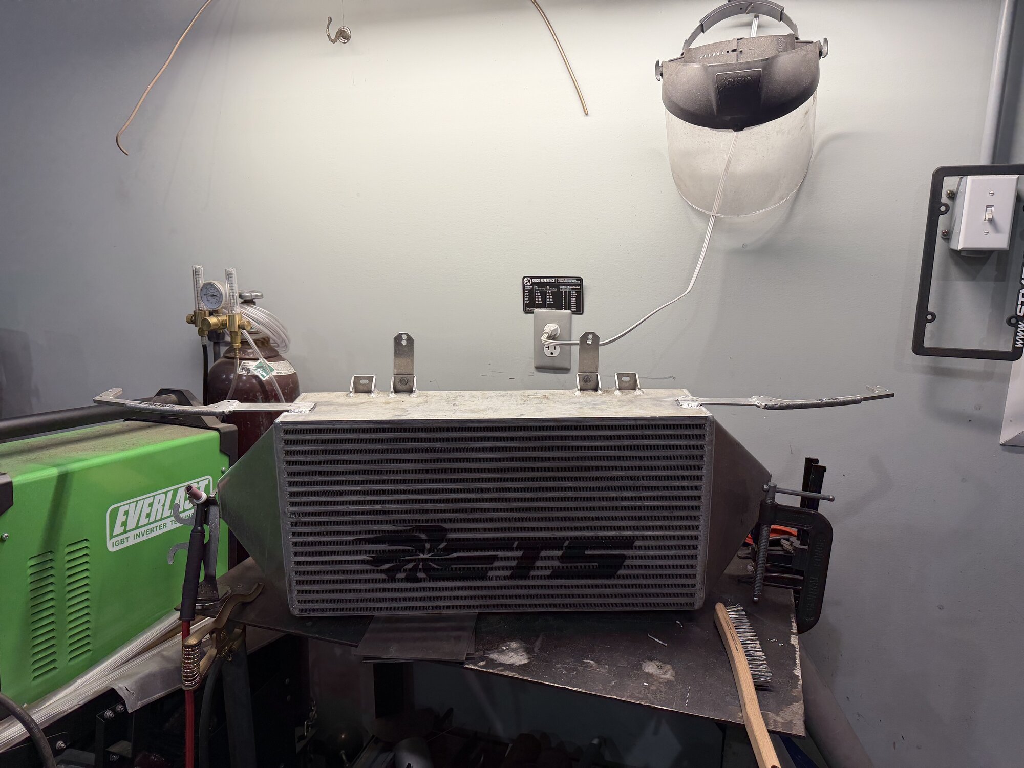

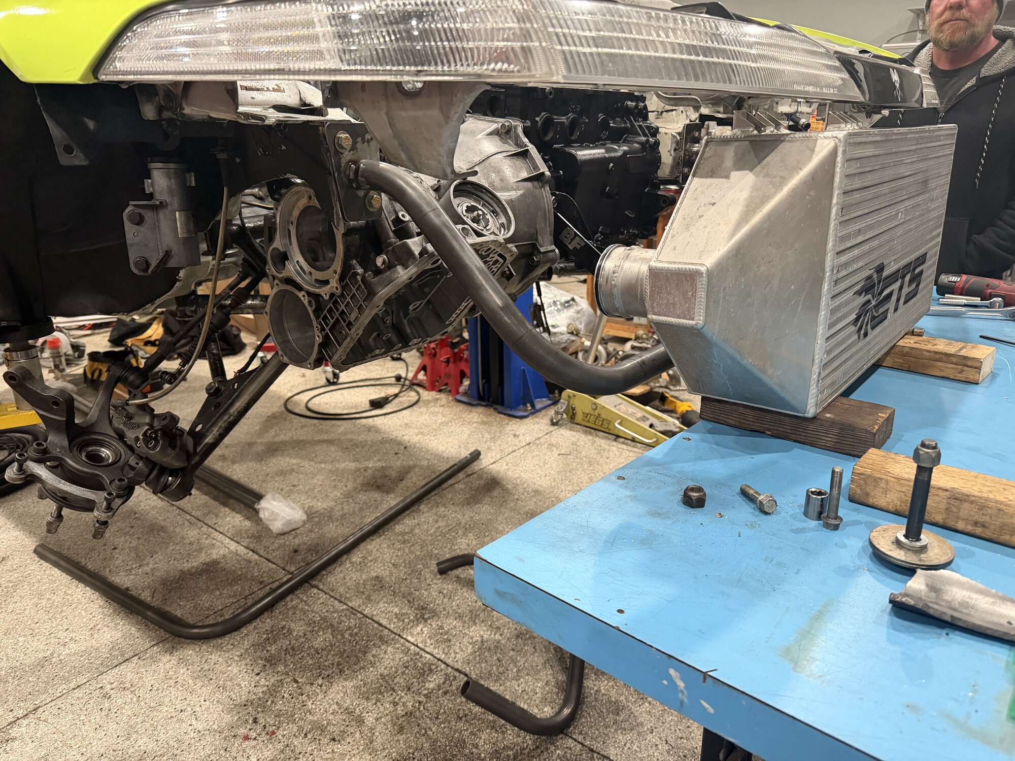

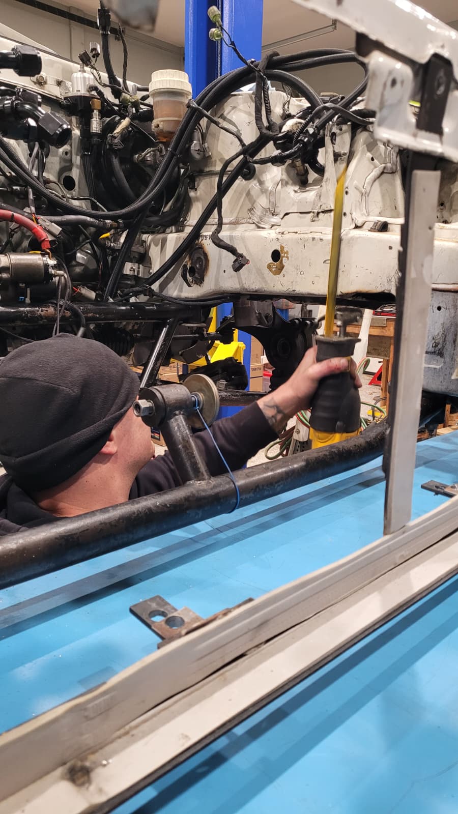

Had a chance to get a few more hours in on the car with the help of the Spec Ops Race Team crew. We got the main hoop bent and tacked on. Decided on making it removable for whenever we have to tear the engine or trans out this will make it much easier. Next up, is slapping a head on, mounting the exhaust mani and turbo to get the intercooler at the right spacing. Where it was in factory front trim was where it will end up, need the turbo on before we make the front engine mount to clear the hotside piping. Once that’s done radiator time, for this car being dedicated to drag racing only the full size rad will be going in favor for something smaller, then mount the electric water pump and so on. Lots and lots to think about methodically for what makes sense. 14-18 days to have the front end all finished up to stay on our goal for dropping the car off to get the damage from hitting the wall fixed.
Really trying to stay motivated and push through this entire thing. Having to build a new engine, transmission, get ahold of a good 2G torque converter, body work, paint and fabrication is a lot of time and $. As of right now I’m enjoying the challenge and being in control of making these small changes that have made things more difficult working on the car between rounds in the past. All said and done I think is going to be pretty awesome.

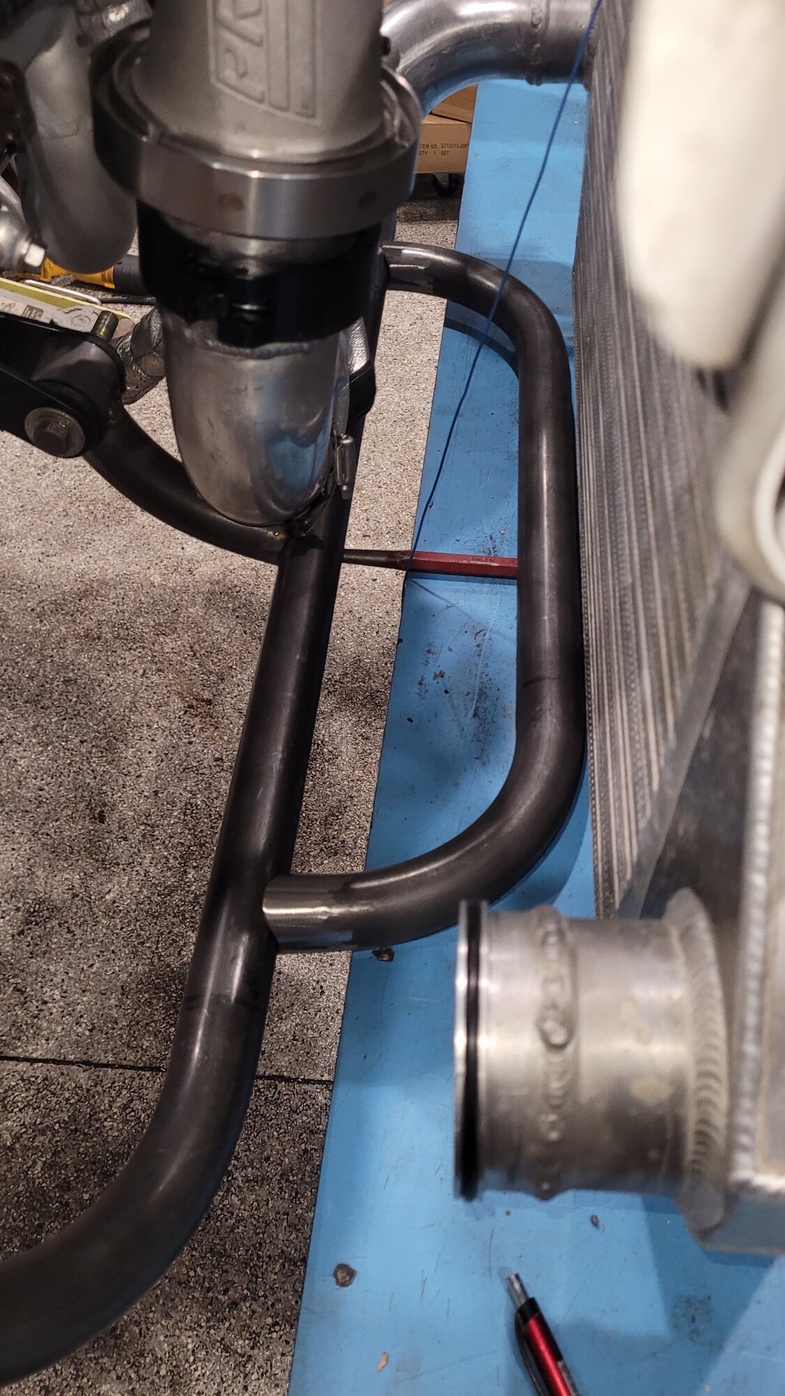

View attachment 783232View attachment 783233View attachment 783234View attachment 783235View attachment 783236View attachment 783237View attachment 783238View attachment 783239View attachment 783240View attachment 783241View attachment 783242

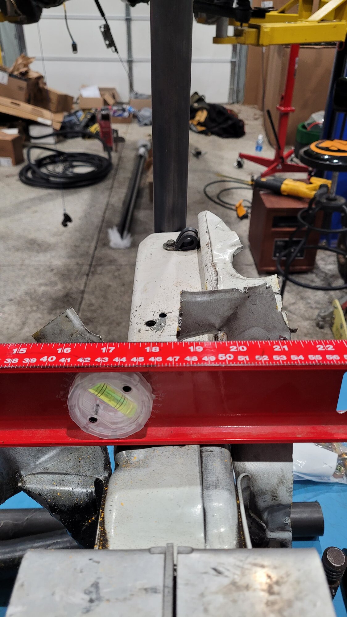

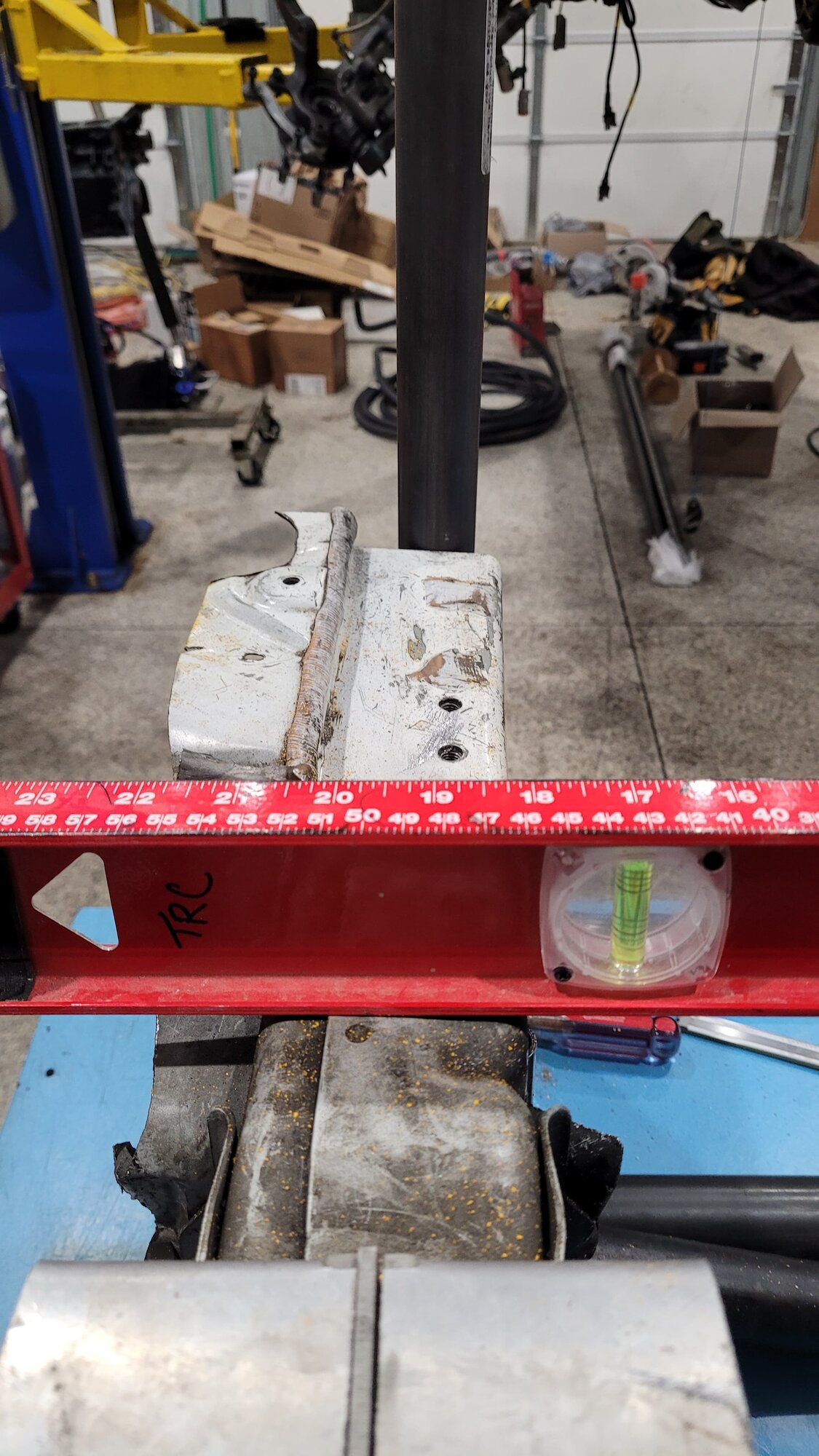

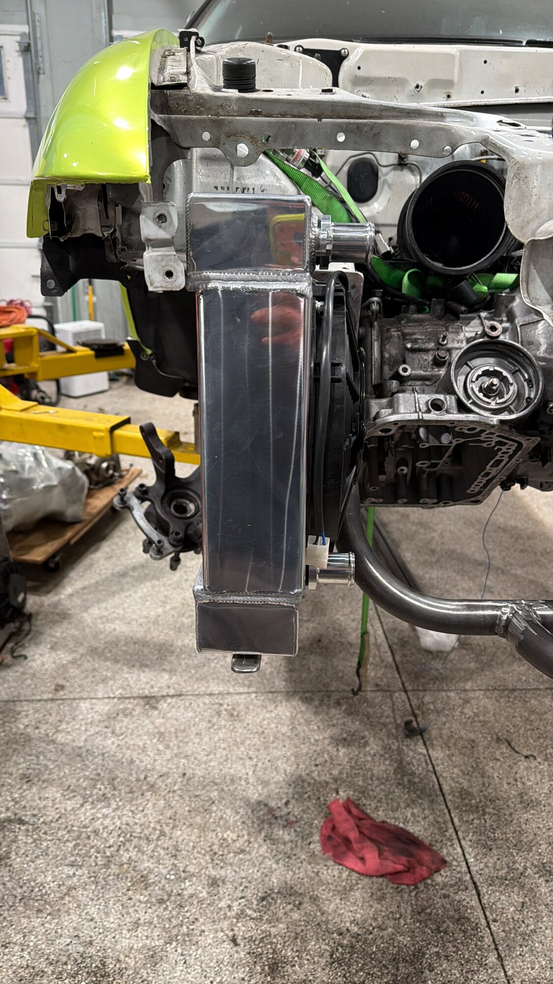

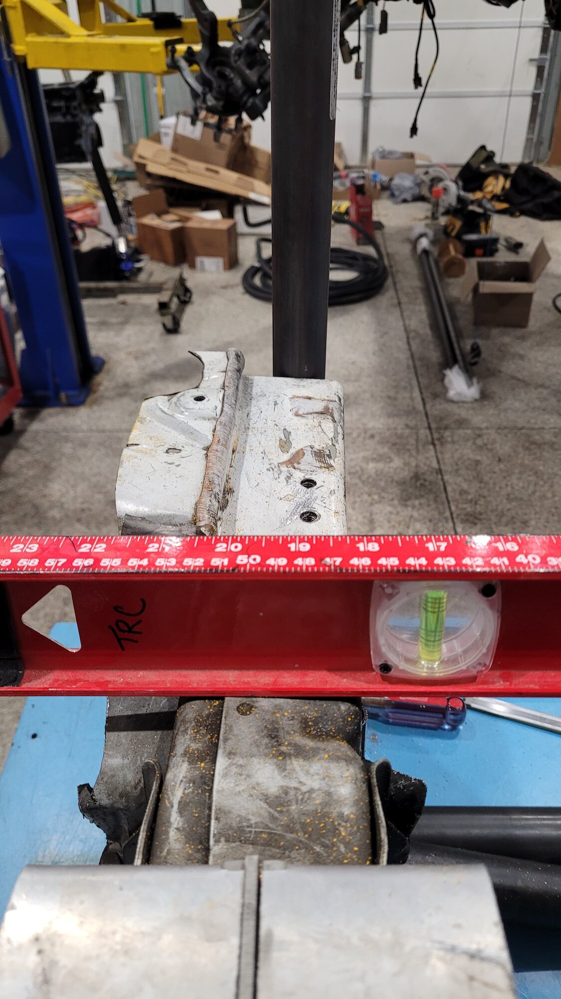

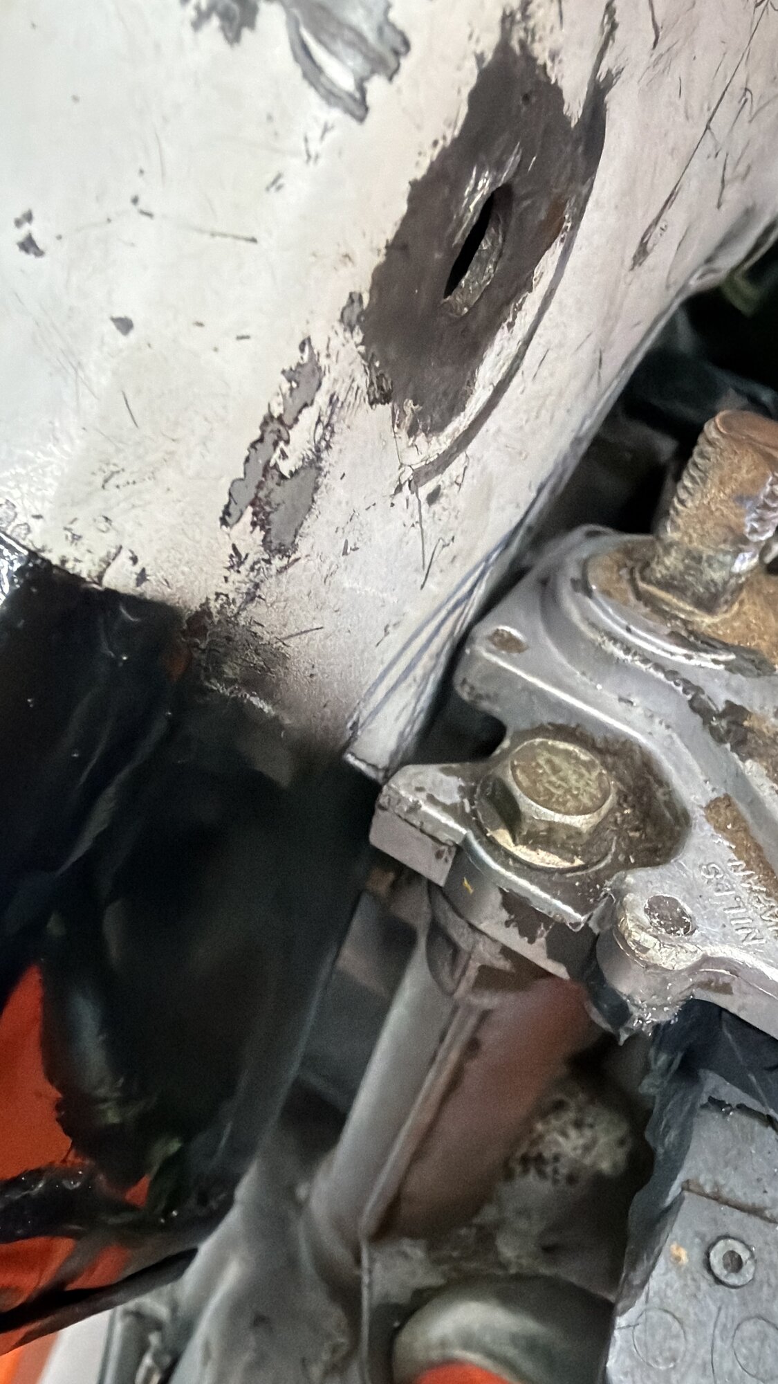

Hey brandon. I would grind down and re weld the front radiator support. Those are cold welds and snap easily. I would personally do 3/16 or 1/4 for the plate. I can cut them out for you if you don't have someone locally. Good luck
Oh yes 100% agree on re-welding, these were just tacked into place with a MIG for measuring purposes. I did look at using a thicker steel plate but that seemed a bit excessive a half inch of plates welded to 1/16” sheet metal, since they’ll be stacked up being a bolt on design 2x 7/16” grade 8 bolts per side. We made the plates a little oversized to make sure there is good penetration to weld on the paper thin sheet metal frame and the 1/8” steel plates leftover from doing a roll cage a few weeks back. TIG the chromoly to the plate and add gussets vertically. I’m guessing the front hoop will be holding around 100-110lbs total between rad, intercooler and the little brackets for boost solenoid and the water pump. The front of the engine really have any weight on it just the small amount of forward backwards movement of accel and decel. The final load test will be me and a friend standing on it with a few bounces of 400lbs load test hahaha. I’ve always looked at this mod to be more for making room than increasing the strength of the front end per se.
I’ll be sure to get some better up close pictures of everything when I get back to it. This is also not meant to sound like I am right and I do greatly appreciate the constructive criticism and tips from you or anyone else who does this more frequently. That’s the great thing about the forums a solid piece of correct advice where Facebook would have comments on how this is not right at all but not offering how to fix the issues correctly.

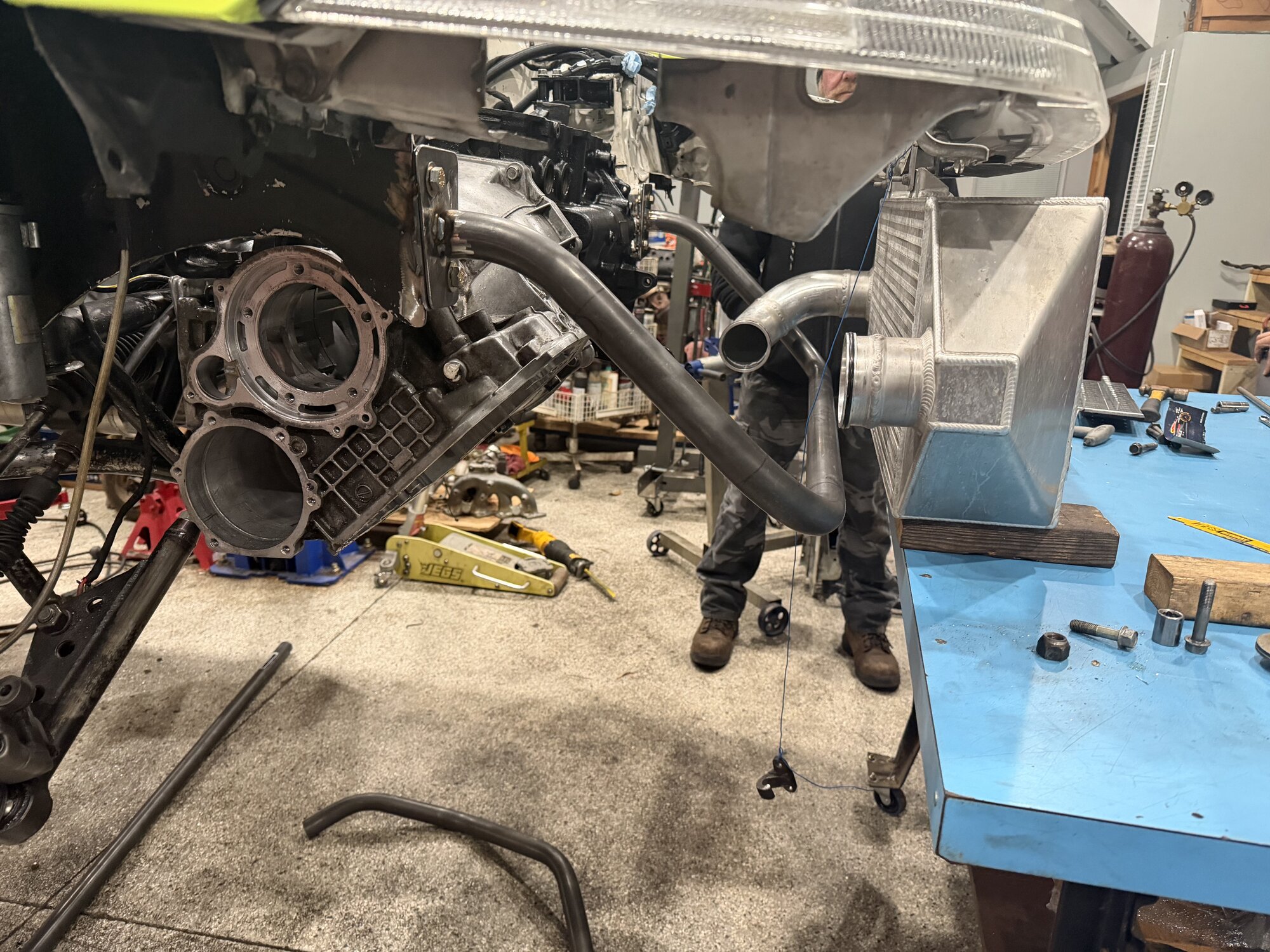

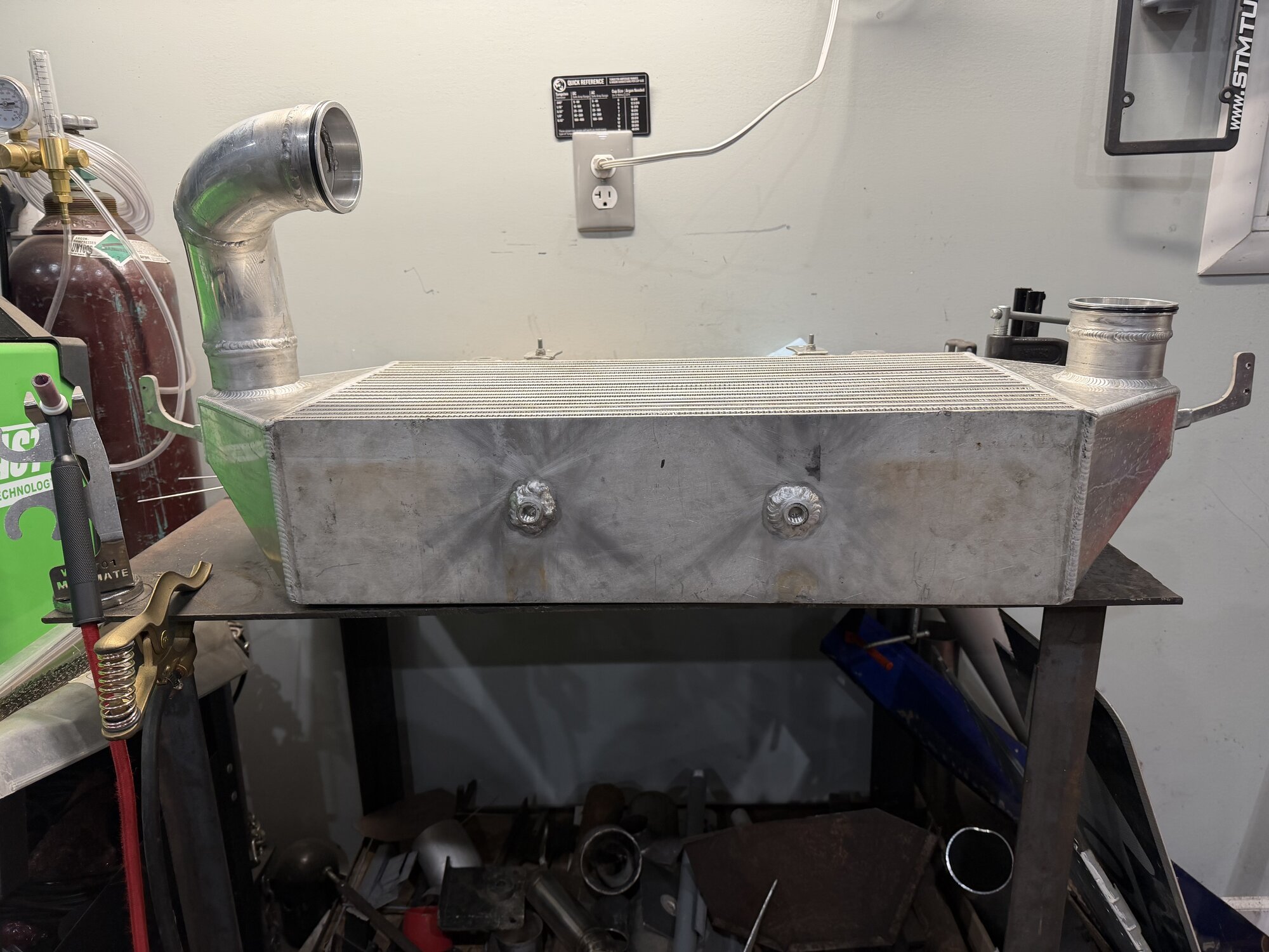

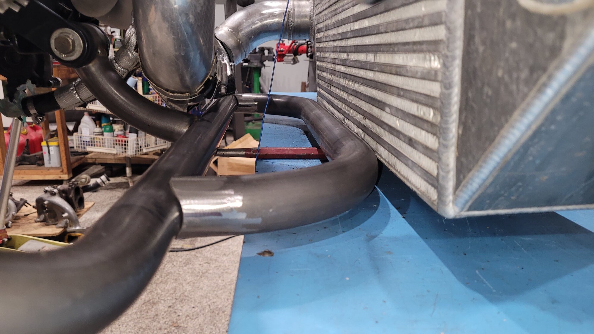

2 week update from last post, let me tell you chipping away at this thing at every spare second. Finished up the tubed front end. After going through some more R&D we had to shorten up the main bar and add the bull bar to hold the I.C pipe for what I envisioned. Also had to order a new half radiator to fit in a place I liked so that was a few days delay. CSF 600CFM fan should be plenty for cooling the head and 1" of water that will flow through the top of block since it's not a full fill. Making the front engine mount was fun as well, we had to bend it for clearance on the original hot side pipe for I.C, so we were able to retain the current I.C pipes without any modifications needed.

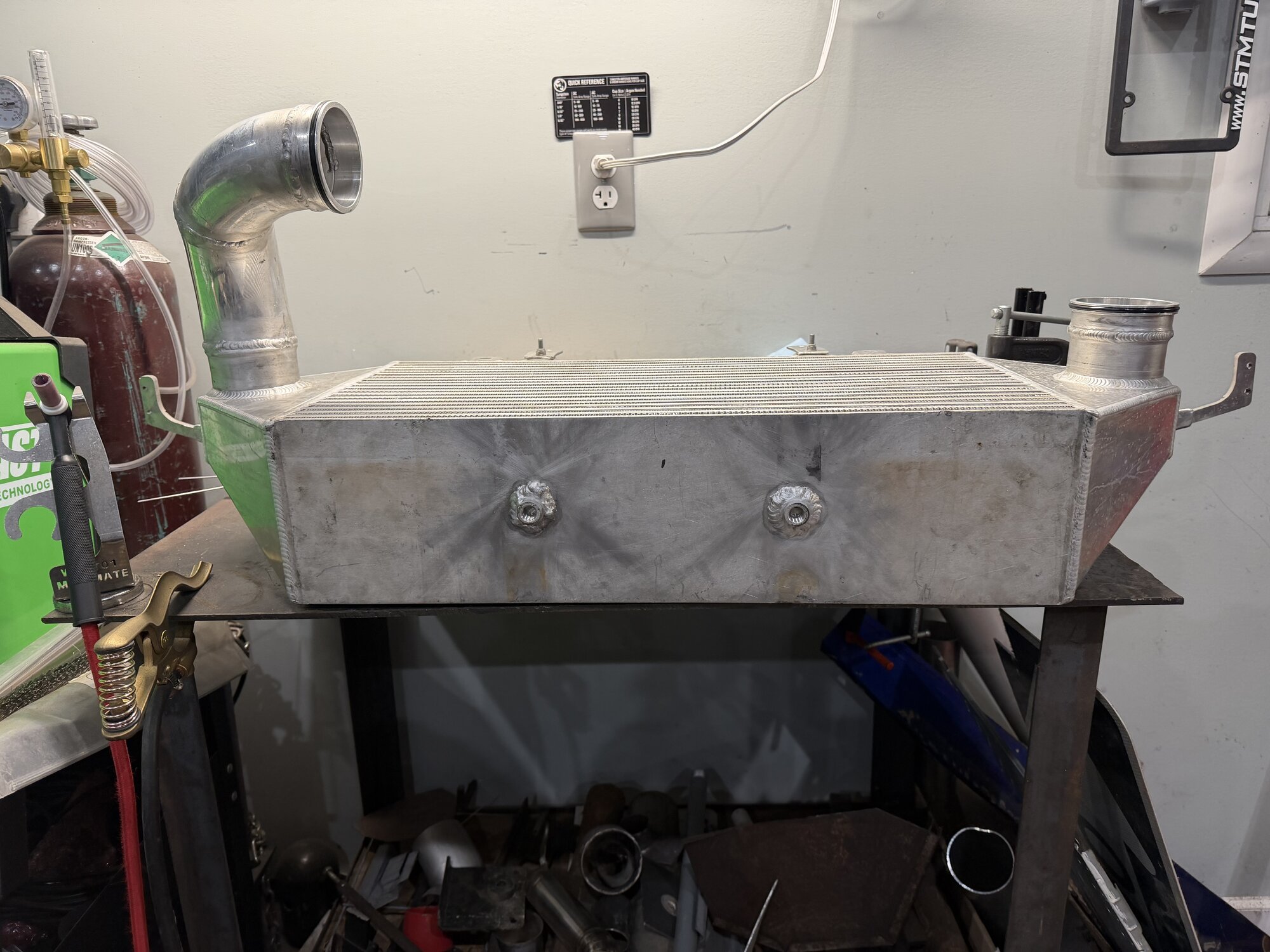

A new side exit will be needed, The 3.5" pipe should theoretically be fine for about 1300HP but buy once cry once 4" titanium will be coming soon.I sourced a 8 pass #6 Precision 2G converter from another 8 second Mitsu which is huge to keeping on path for the be ready to hit track in April goal. Called up MASFAB and they had 1-1G drag wing in stock so I picked that up. Not entirely sure if it will help at my almost 170MPH trap speed but I figured since the car will be getting the rear quarters back fixed and painted from hitting the wall mine as well fill the factory wing holes now and just do it to match the bumper lip and drag side skirts. I dropped the car off at the body shop yesterday with a 2-3 week estimated timeframe for work to be finished on it.
The head should be back this week, block I need to call and get a status on but I think this is some great progress for 1 month of going hard. Always playing catch up after these long deployments and then catching back up to the competition. Still lots to do and I need to add in some more ECU related stuff. I haven't tackled the 2G transmission yet but maybe I'll make a valvebody video- this will be similar to IPT's since we all follow his but with some of kiggly's mods explained a little more in depth and what I have found to work for transmission pressures and springs. That's it for now.... Stay tuned.

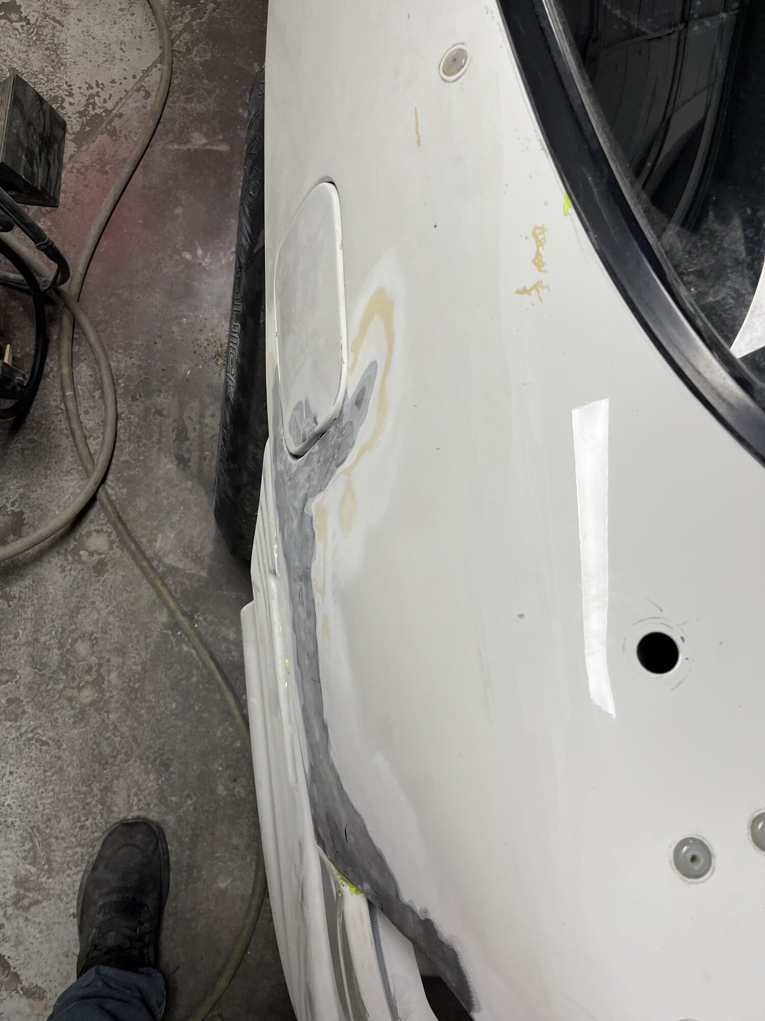

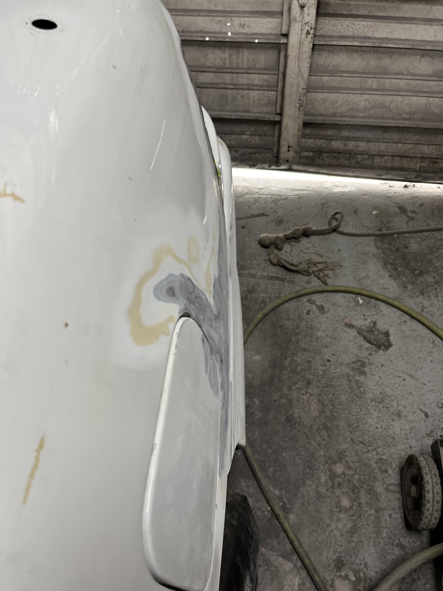

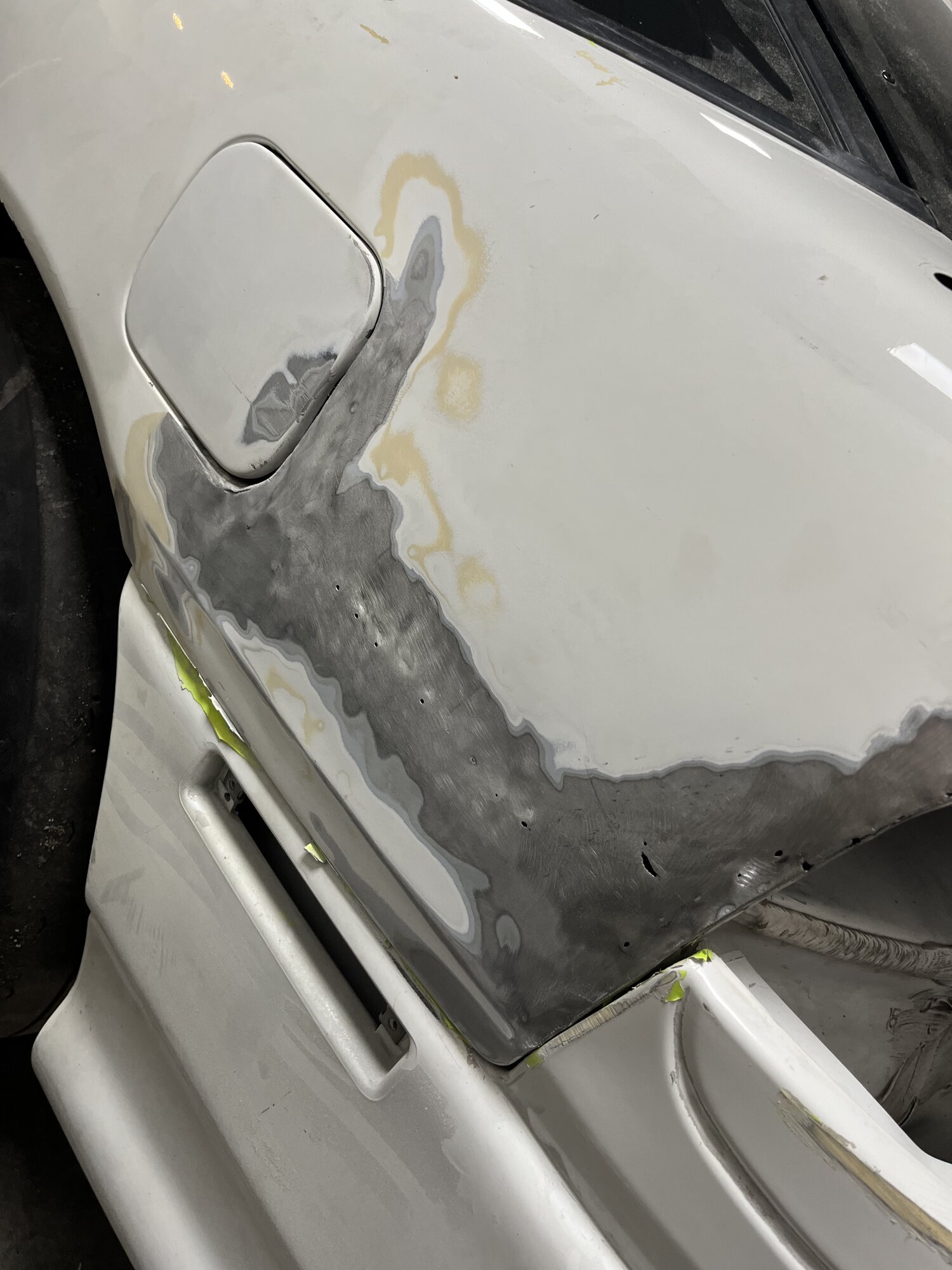

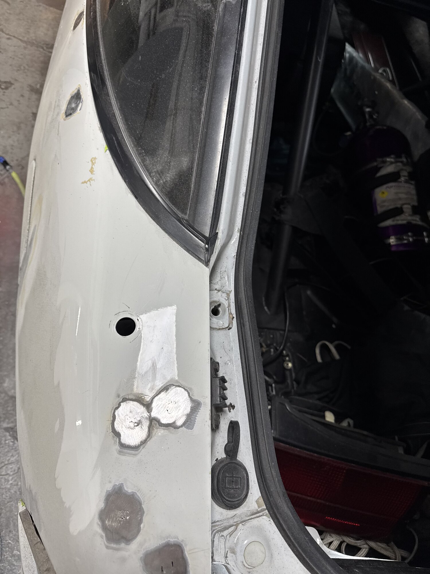

Body shop has been keeping me posted, they got the main damage pulled out really well and the car will require minimal bondo which I’m super happy on that part. I only have pics of one side so far, also having them fill all the factory wing holes since they won’t be needed with the new drag wing.

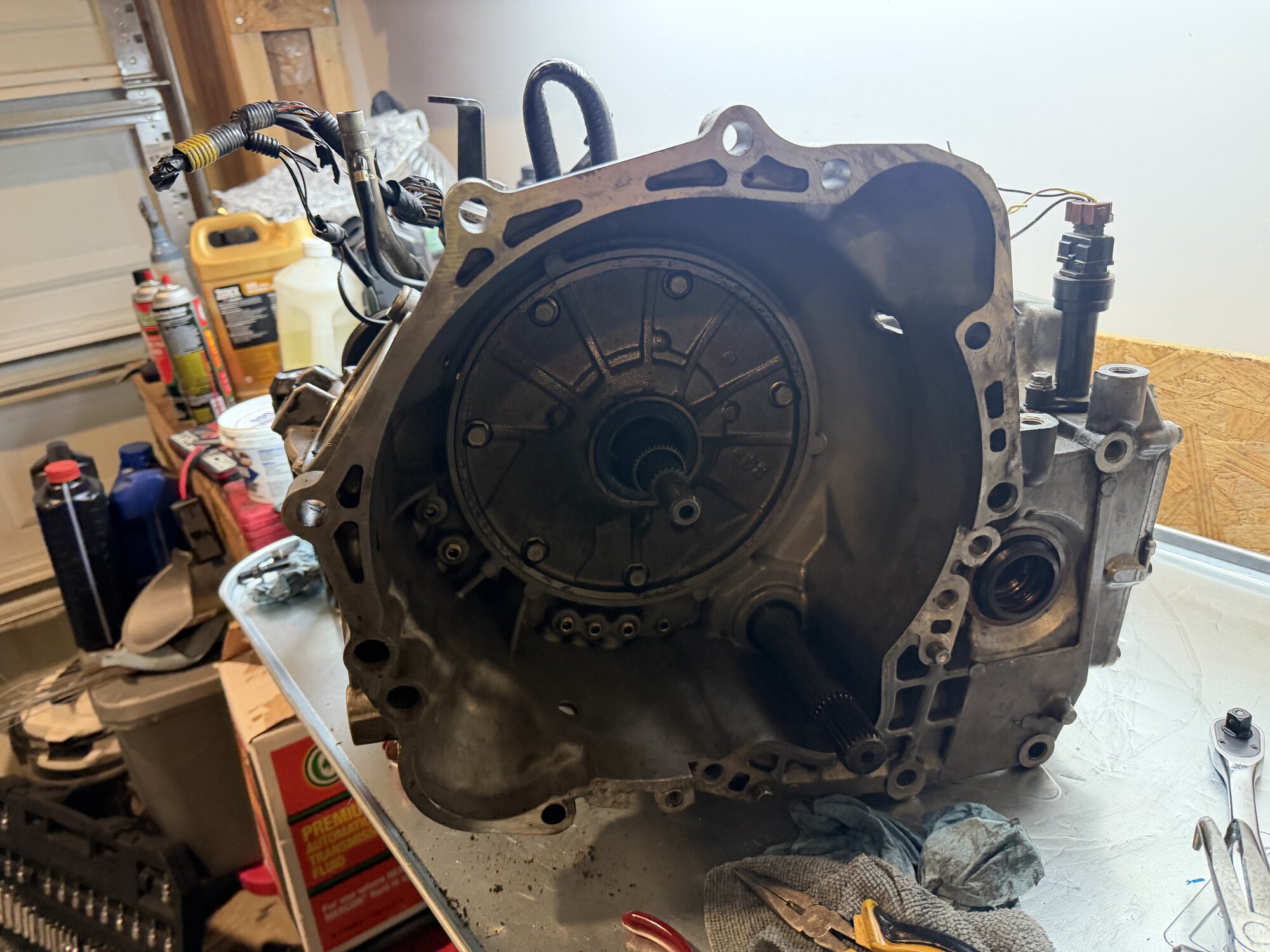

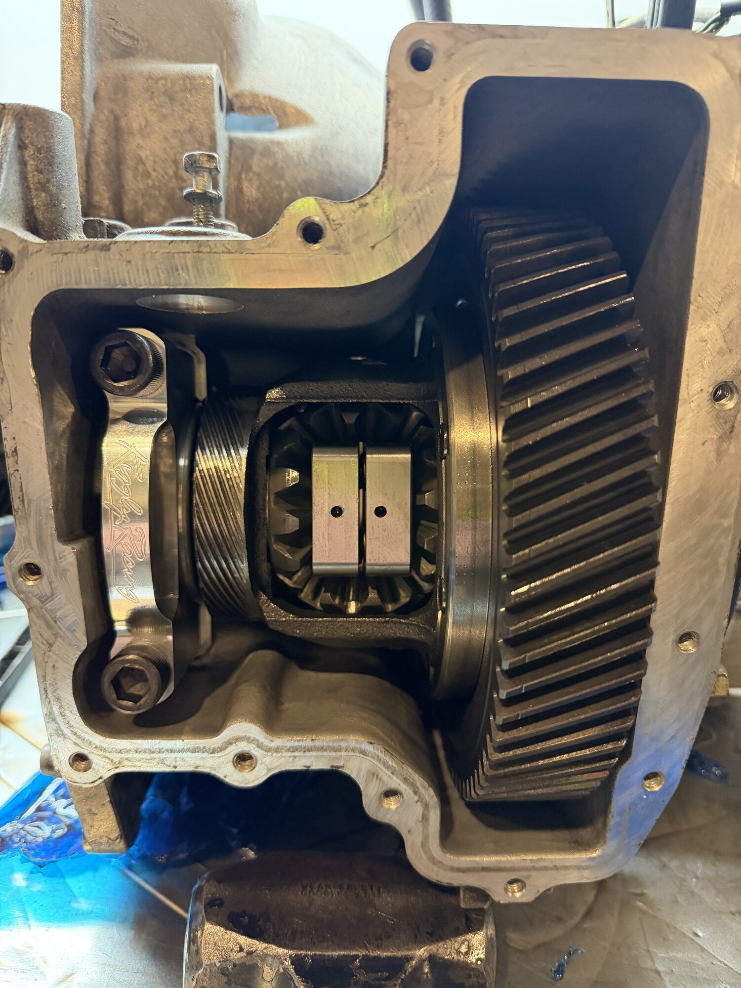

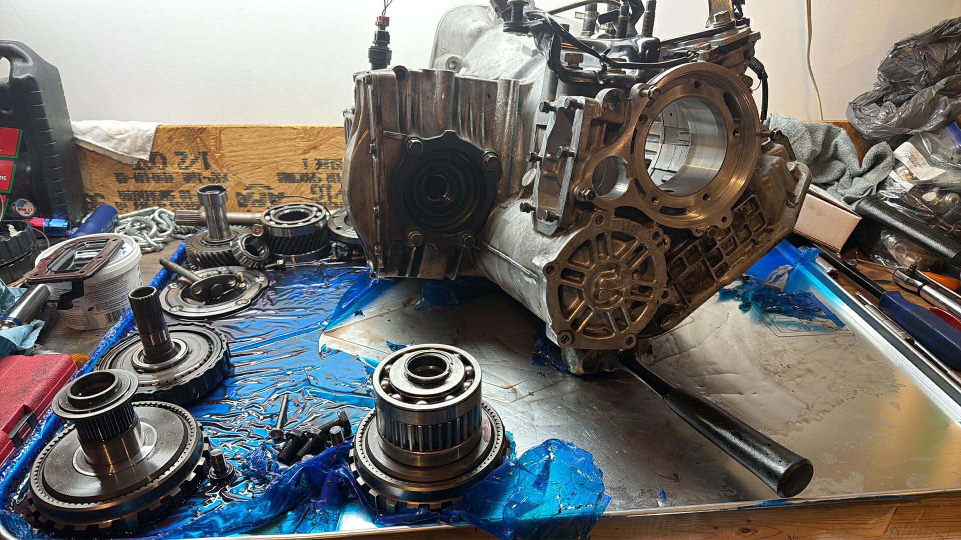

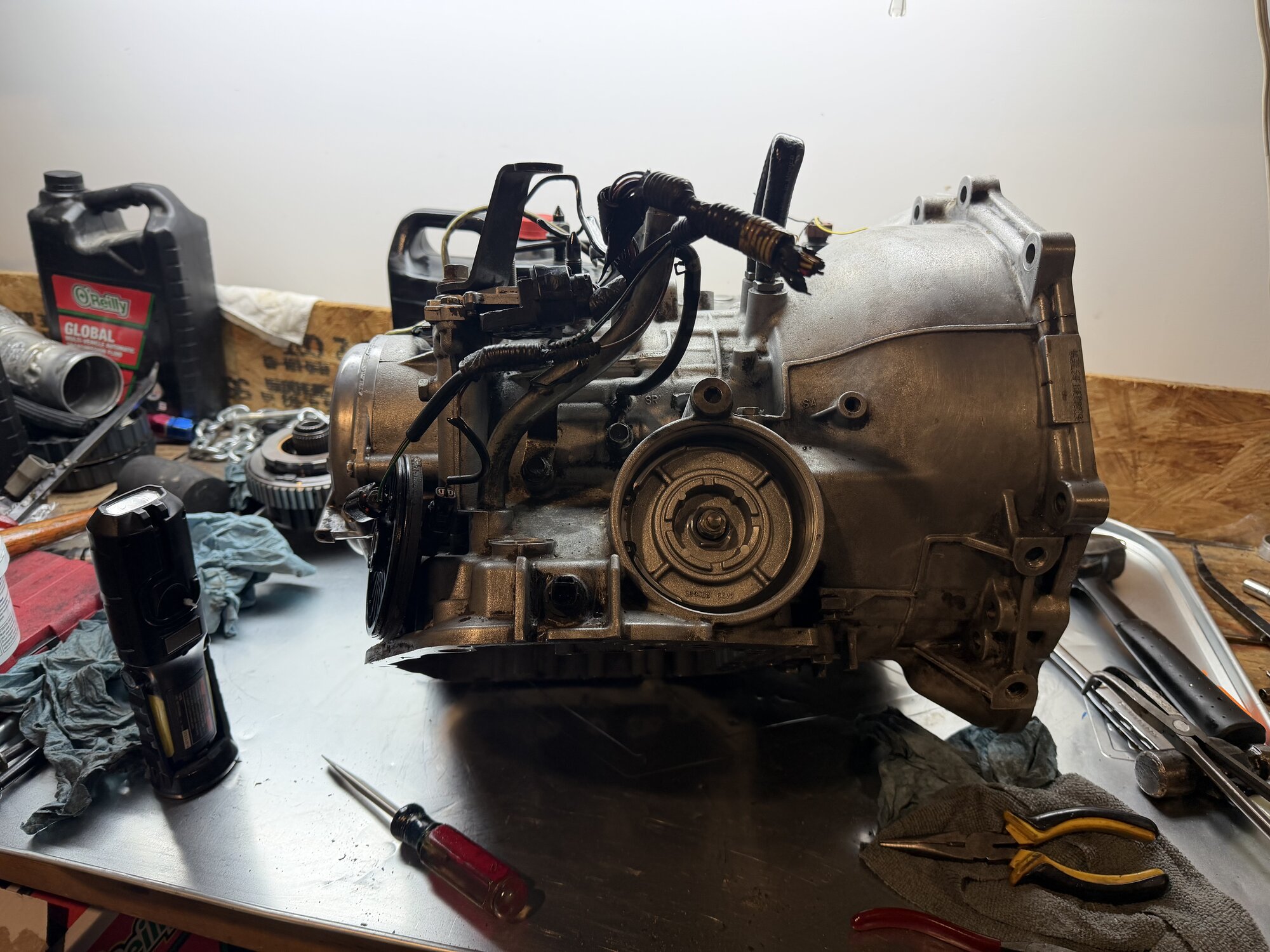

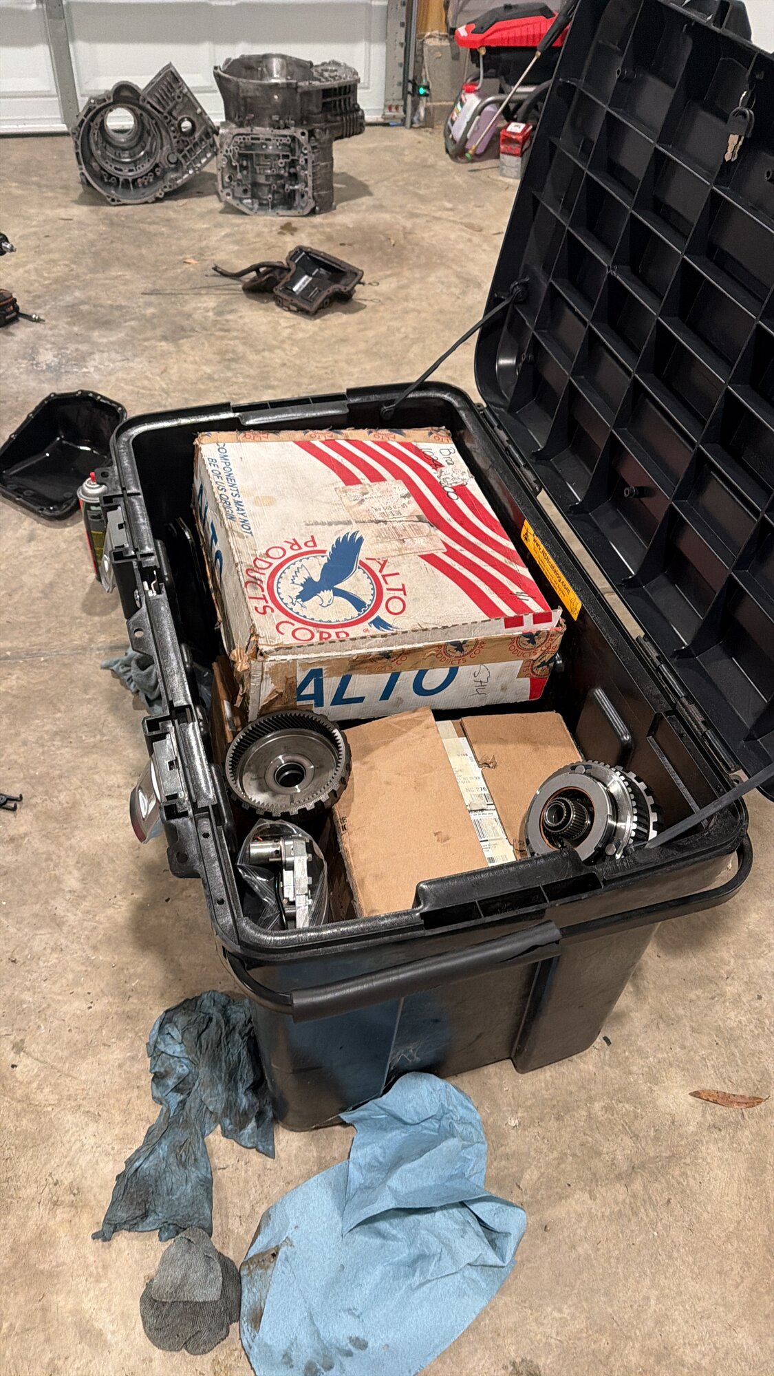

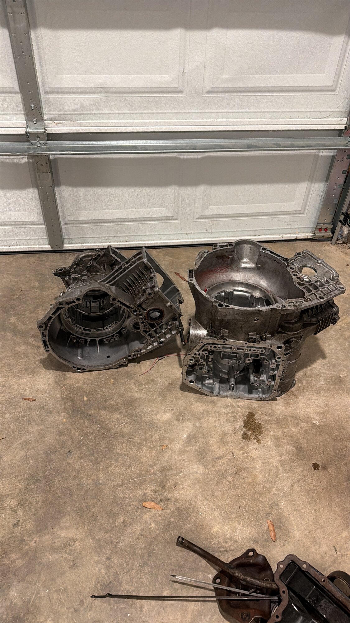

The past 2 days I’ve been chipping away at the 2G transmission. Tore it all the way down, clean and inspected the case, trans pump and input shaft. Everything else was transferred from the 1G transmission. I need to do set the kickdown band adjustment and then build up the valvebody and that’s a wrap. Kiggly straight cuts were installed, straight cut transfer gears, the front diff had to be transferred because this was a 97-99 different ratio trans, billet saddle. I’ll get some pics of the valvebody and possibly do short video explaining some of the internal VB mods that are outside of the standard translab shift kit.

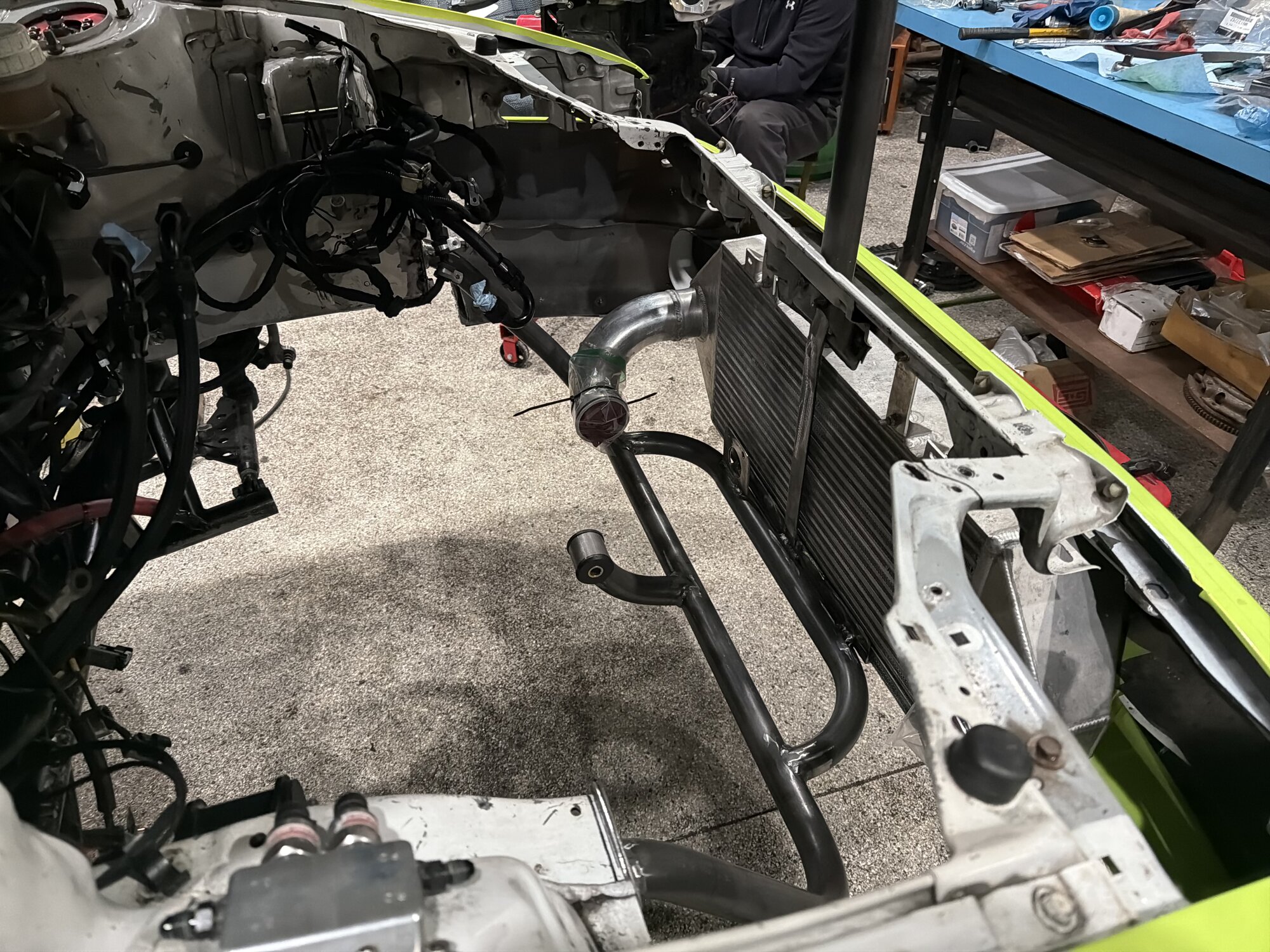

Next up will be finishing welding the front end plates to frame rails, powder coat, slap the long block in, slap the 2G trans in and then modify the frame rail so that fits correctly. I also bought an input expander to gather further data, I’m all about data with transmission and turbo shaft speed plus some other things I’m working behind the scenes. With all this being said I’ll probably just do 1 tnt make sure all is good then the shootout will be my first real outing in the car. I also have another dsm which will make its debut at the shootout should be a real contender.
Here we are once again 2 1/2 months later. To be fair though I didn’t get done with that red GSX until a month ago. I’ve gotten a few small things done on the car but a long ways from home stretch. I’m glad I predicted back in May that I would maybe get one TNT in before the shootout as now it’s looking like the shootout will be the first time the car hits the track after all this work.
I didn’t end up powder coating the tubed front end. Used some chassis paint for now due to time constraints. This winter, 100% the bay is getting re-sprayed because the white just looks like crap. I will probably go black to be honest. Matches with both this highlighter wrap and the factory white well.

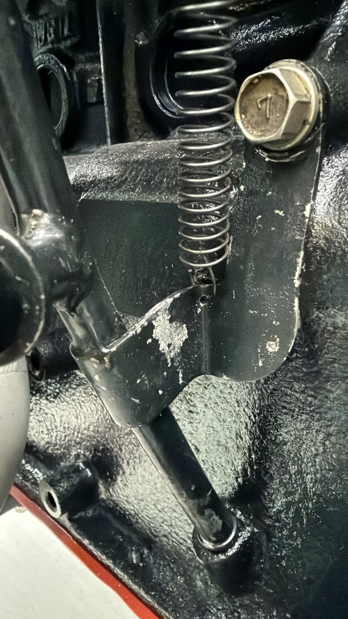

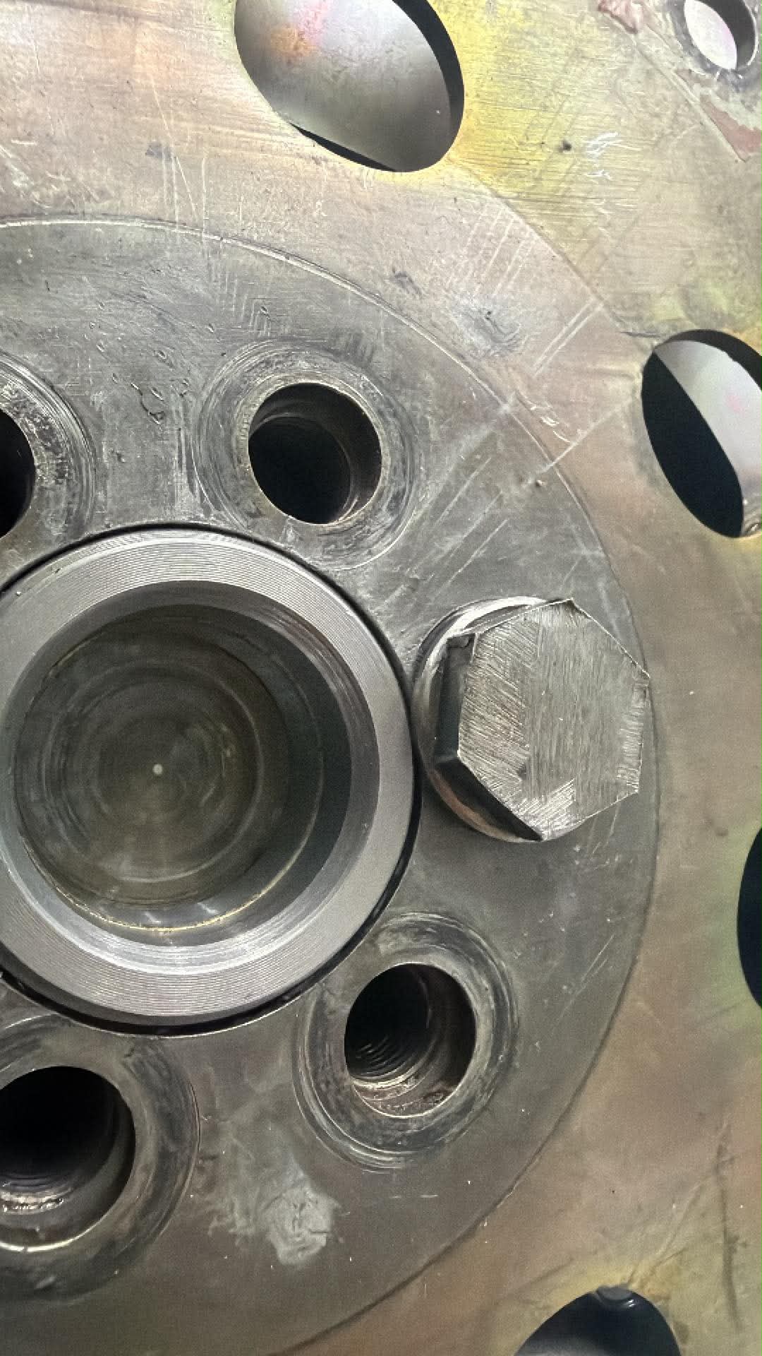

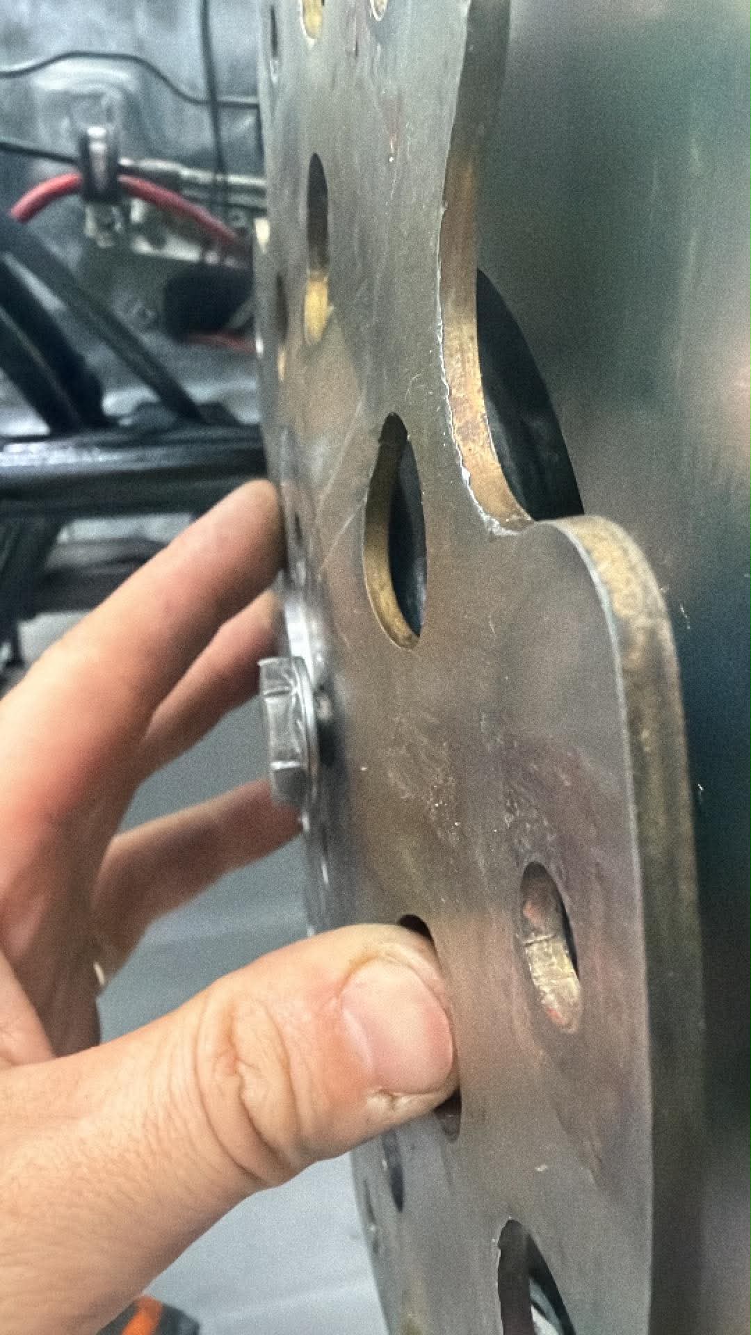

Next up we ran into a problem with the factory flexplate to crank bolts. I didn’t realize there were 2 versions of these bolts. One with a 17mm head and the other with a 19mm head which I had a for whatever reason the 19mm do not clear the pilot bushing. I ordered some 6 bolt ARP bolts and the problem was resolved. *one thing to note on converter pull up I target .1-.120”. Low end .7”, high end .140”, it can be a larger gap but I don’t think I’d run less than .1” personally. With Kigglys 6 bolt in a 2G kit my gap ended up being .110” which is completely acceptable from my experience.
The 2G auto transmission is just physically bigger. I used some elbow grease and a ball pin hammer to massage the frame rail for clearance.
I’ve been running some part store special rear wheel spacers so my slicks don’t run on the trailing arms. After a quick message to my man Paul Natalino he got me squared away with the NTRR spec ones which can fit a 10” slick no problem.

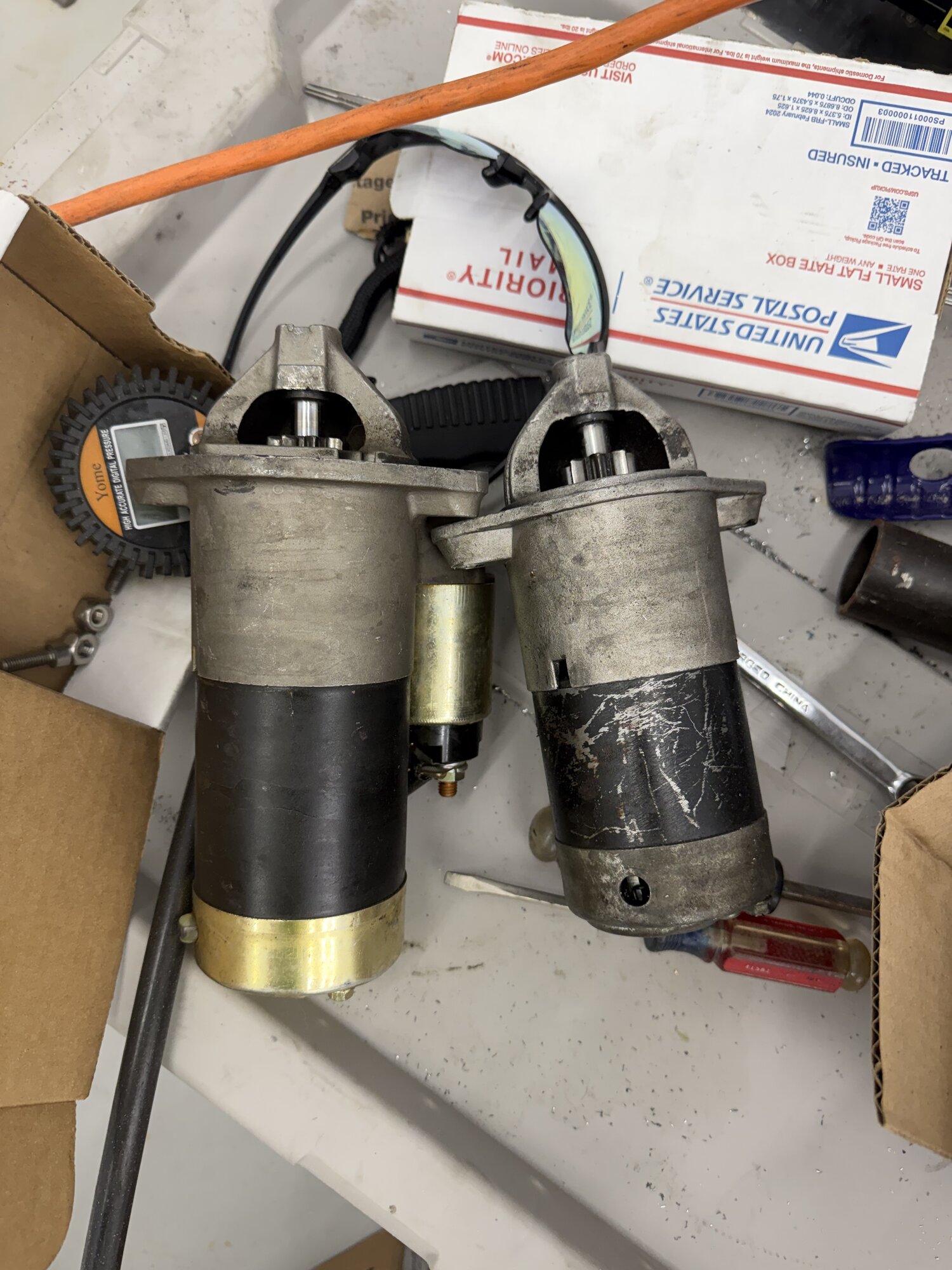

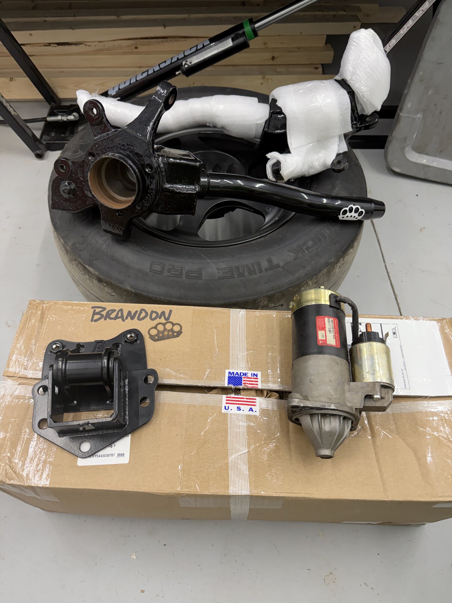

Also didn’t realize I needed the 2G auto starter and the intermediate shaft is 1/2” longer on the 2G auto. Small road block but it’s all installed now.

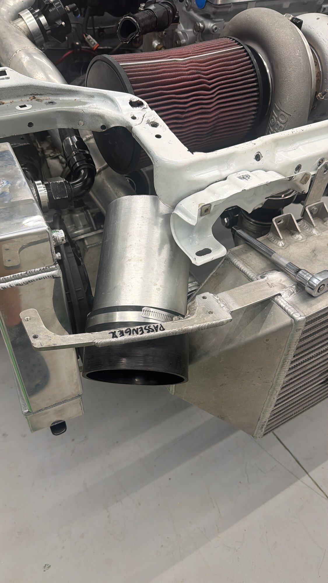

Still mocking up how I want to run the intake. That one is a work in progress but I’ll get it figured out soon.

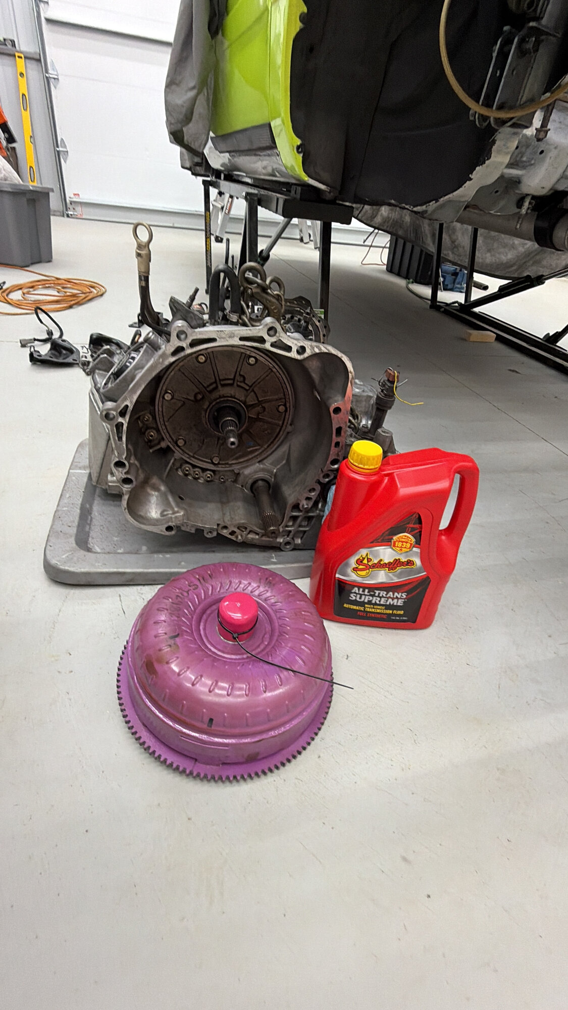

Always been a hygard, oreillys tractor fluid or at4 kind of guy. This year I’m giving the Schaefer’s brand a try.

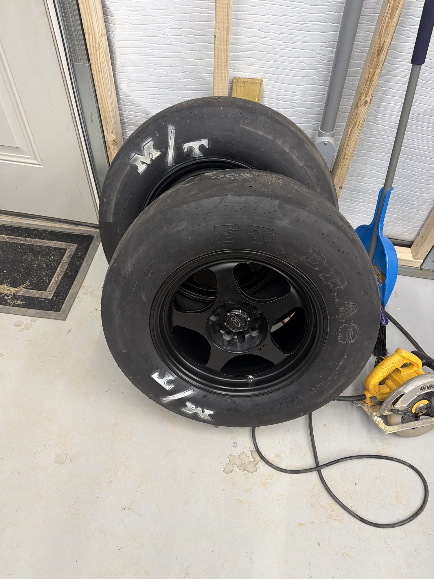

I also got some new sneakers. The classes I will be running do not require a DOT tire so I went back to a full slick. The prep in 24’ was Trashtastic and it took me a few passes to get things good enough on the launch. Hopefully these will suffice without too much fuss. The dip stick tube as you can see the oil stains on my exhaust manifold from the 24’ shootout. I went ahead and drilled 2 small holes to retain the spring and now I don’t have to worry about it falling on the ground or in my catch pan.

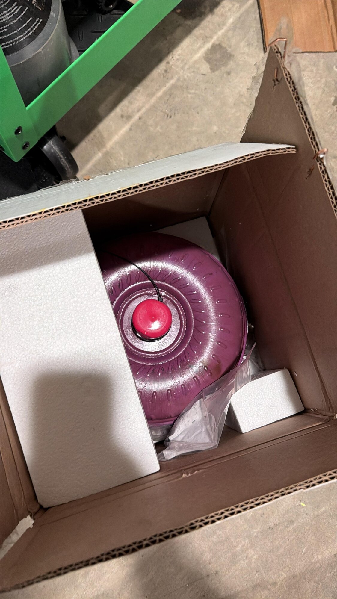

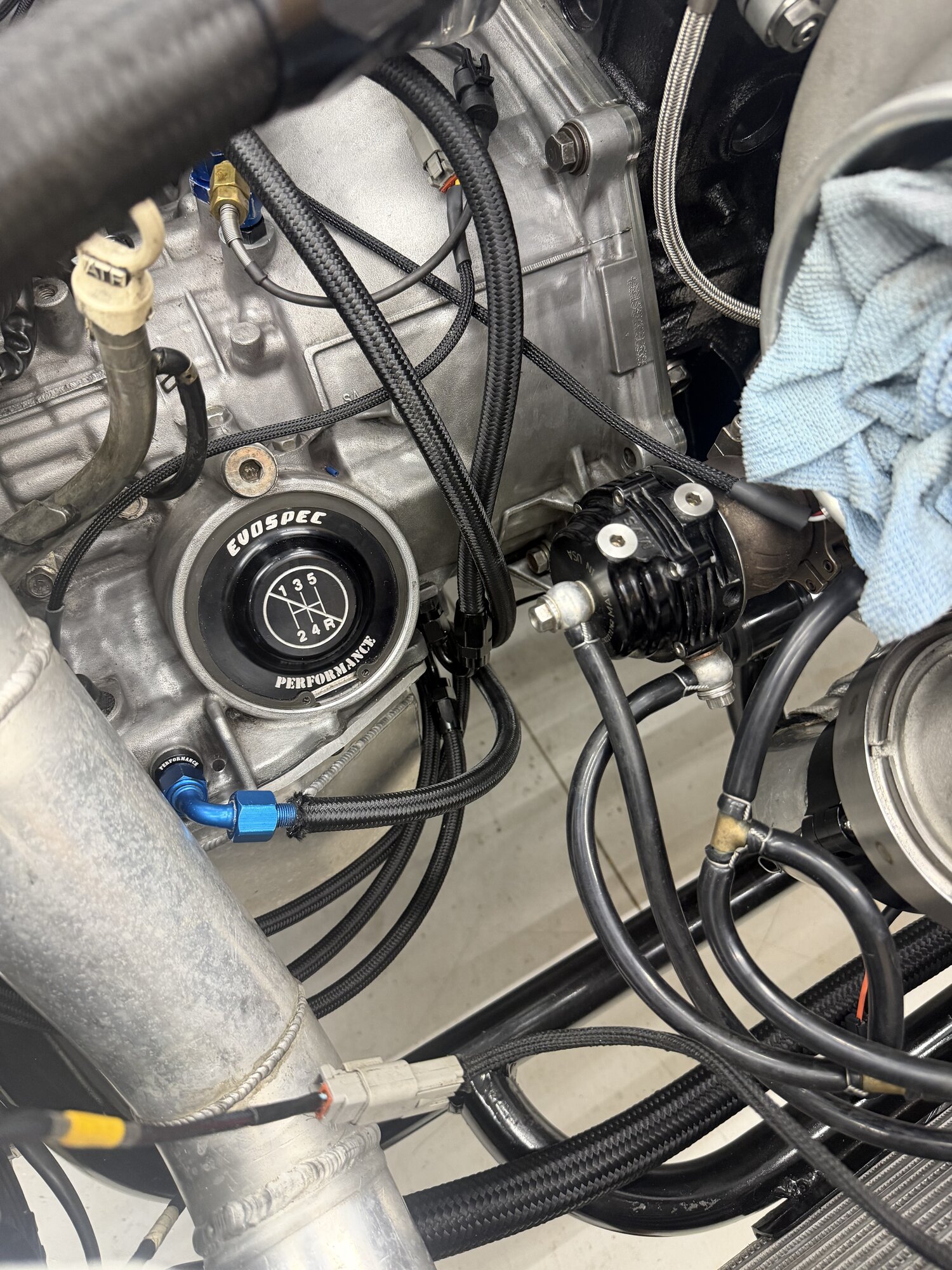

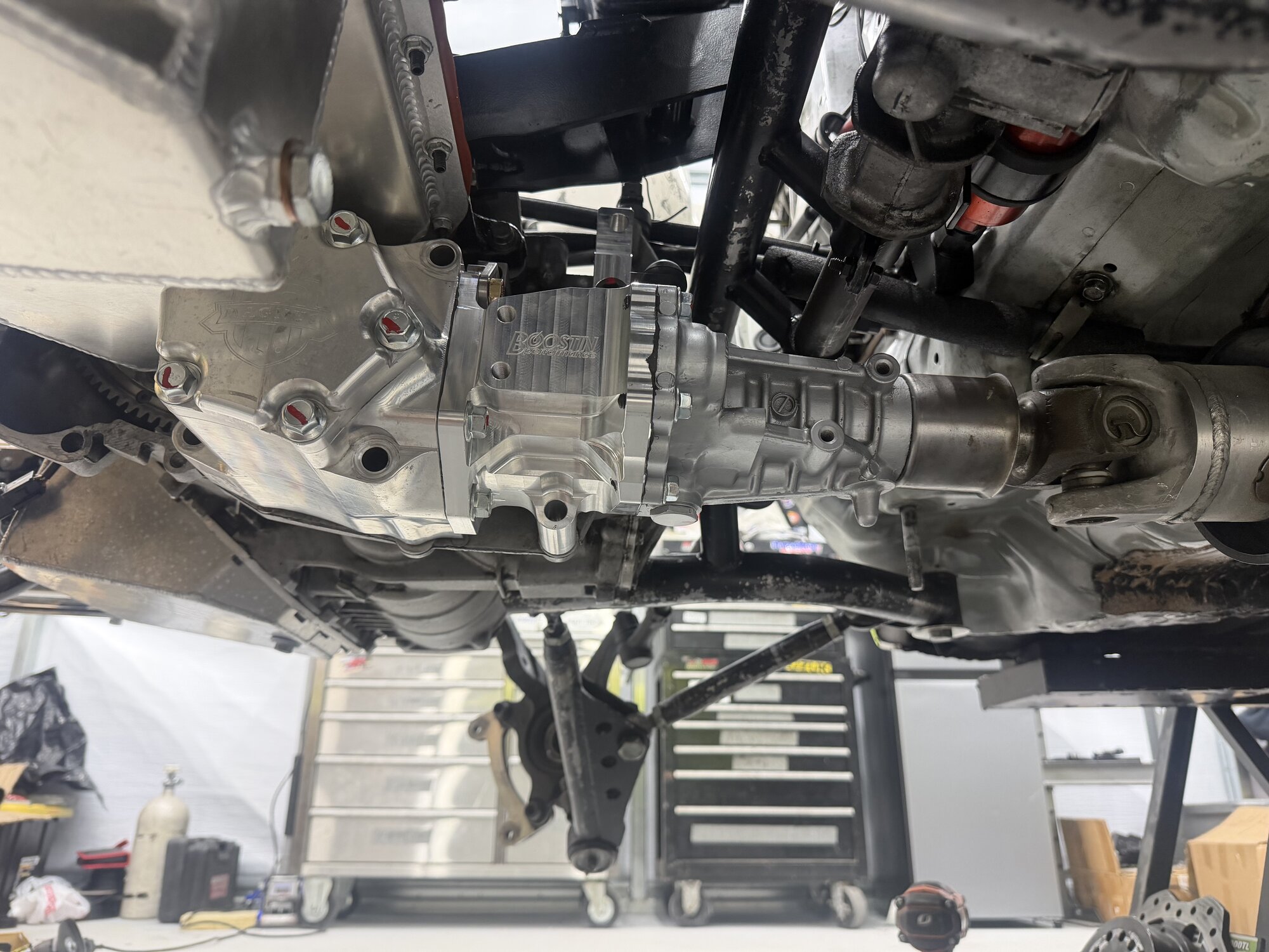

Now that we have the kiggly planets and are following their instructions it was time to bring back the RD port mod. Ordered a evospec return fitting, which I thought was solid then you drill out. That was not the case at all, so I had to modify it myself to accept a nitrous jet. The jet hole is .1” right now, I will adjust as necessary after the car is running and I can look at the data.

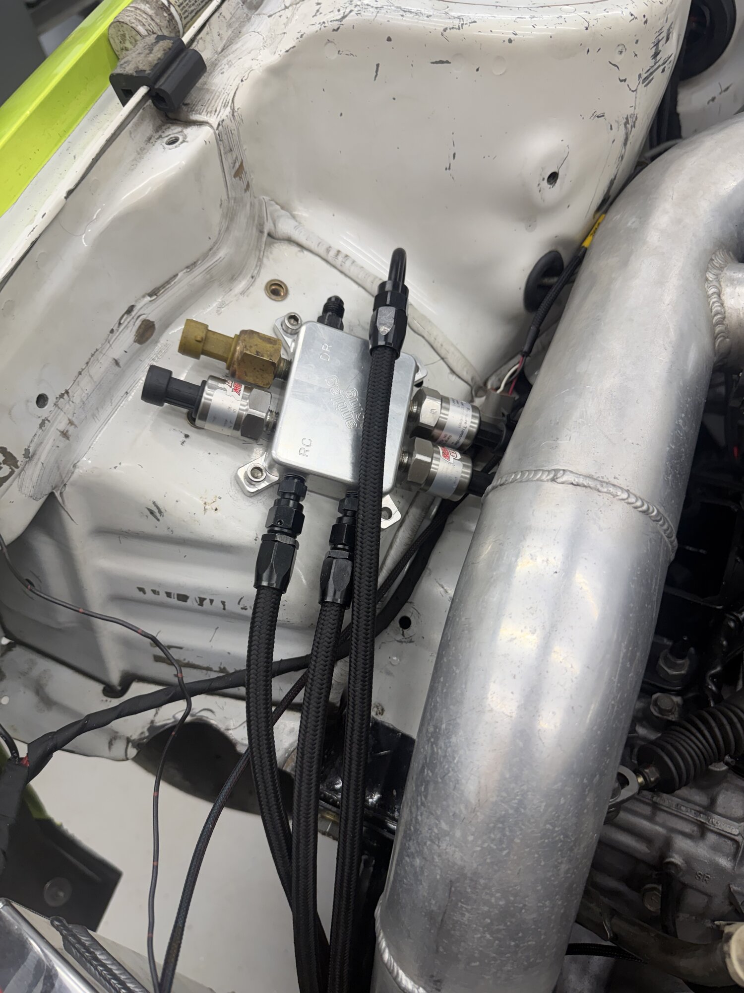

Now onto more transmission shenanigans. This thing looks like Madusa now LOL, monitoring front clutch, rear clutch, converter charge, converter discharge and RD port pressures. I also am logging input shaft speed on the trans and need to finish that off with output shaft speed for slip calculations related to transmission pressures. After I gather some more data I will make a small blurb about what I think is acceptable left and right limits per said port.

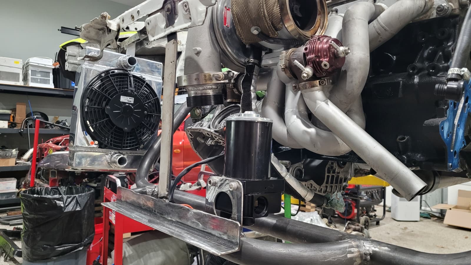

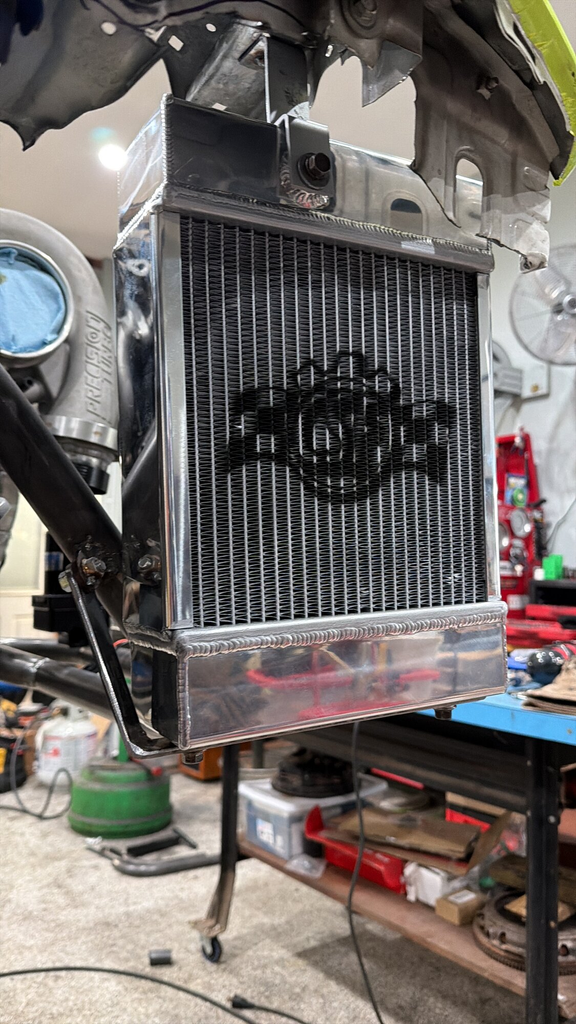

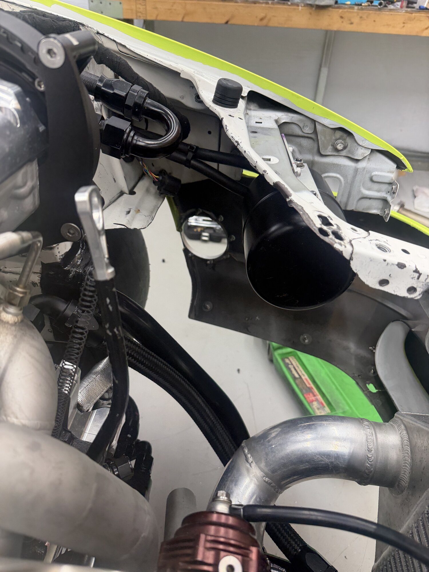

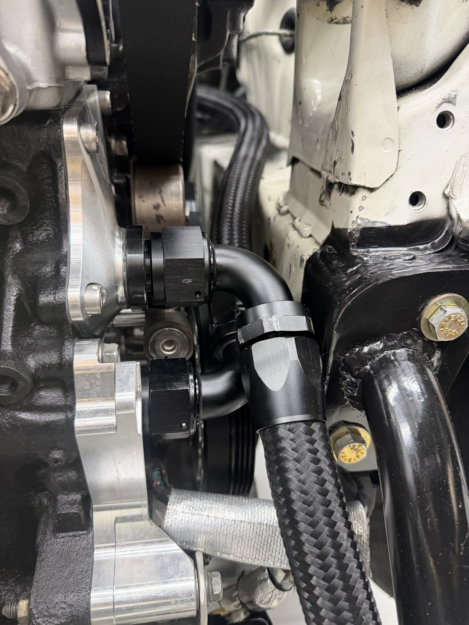

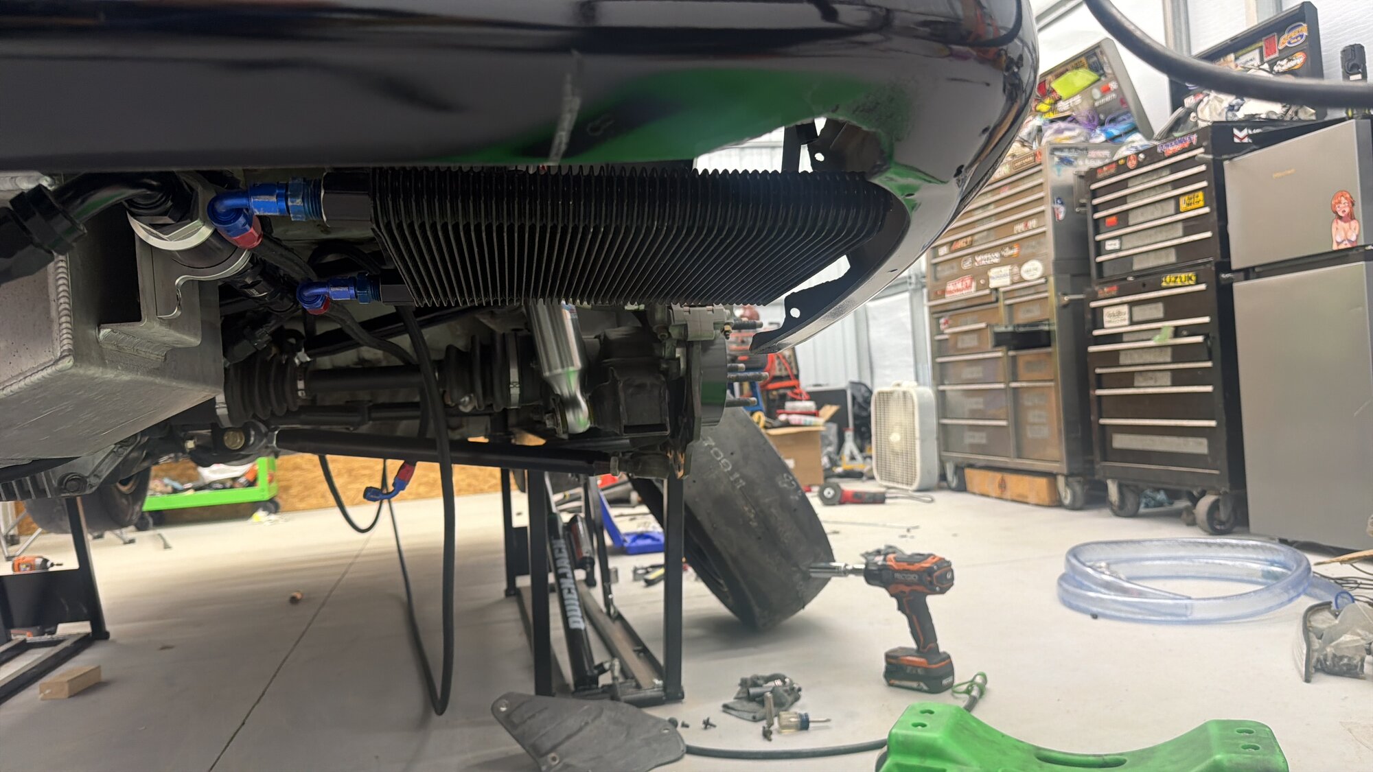

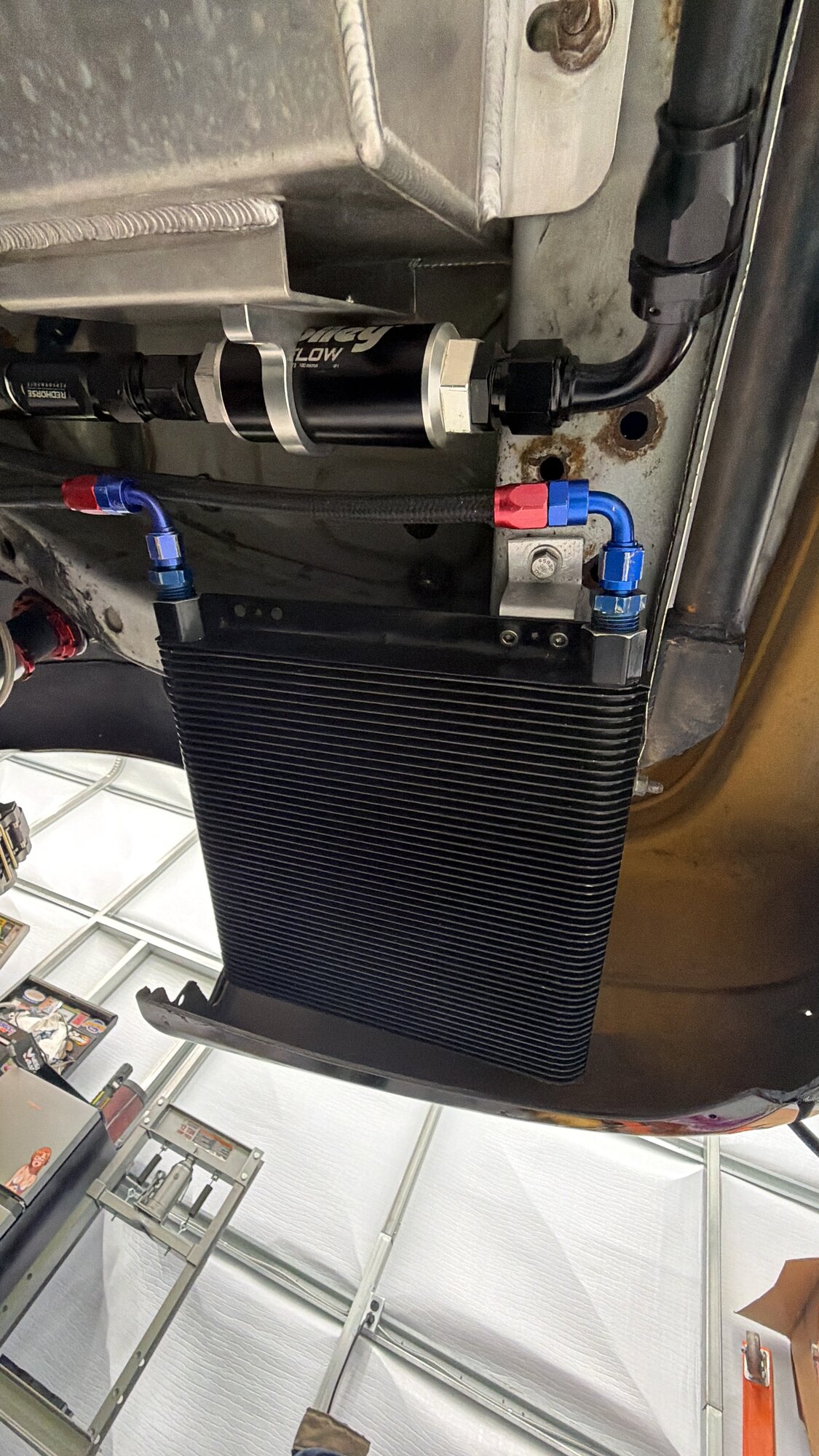

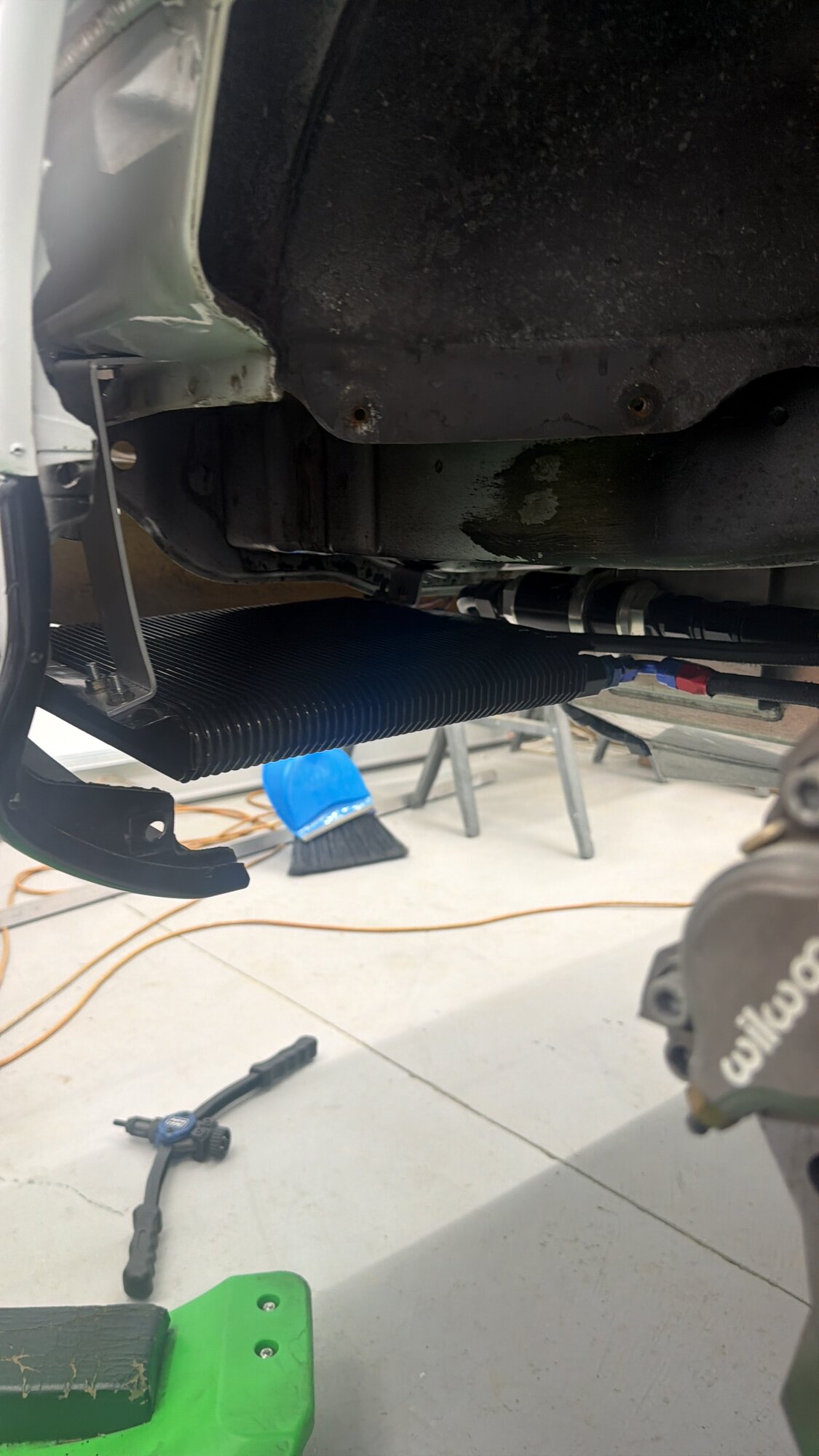

To keep the bay as clutter free as possible I relocated the transmission cooler to the rear of the car. I think it turned out pretty slick.

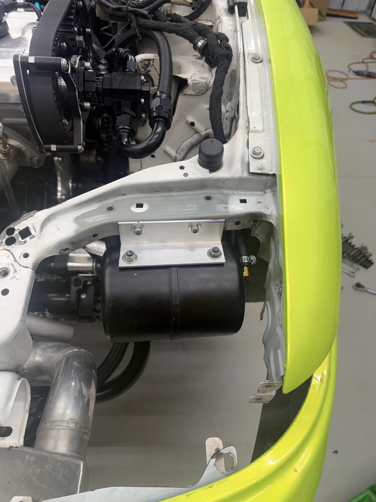

Now I did get to mount my vacuum reservoir but I don’t necessarily care for how it looks there. This will 90% likely be relocated under the dash in the cab.

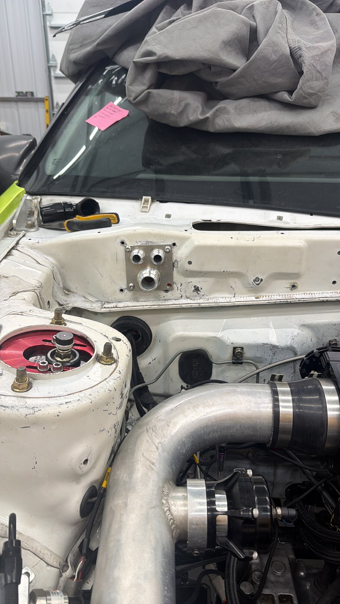

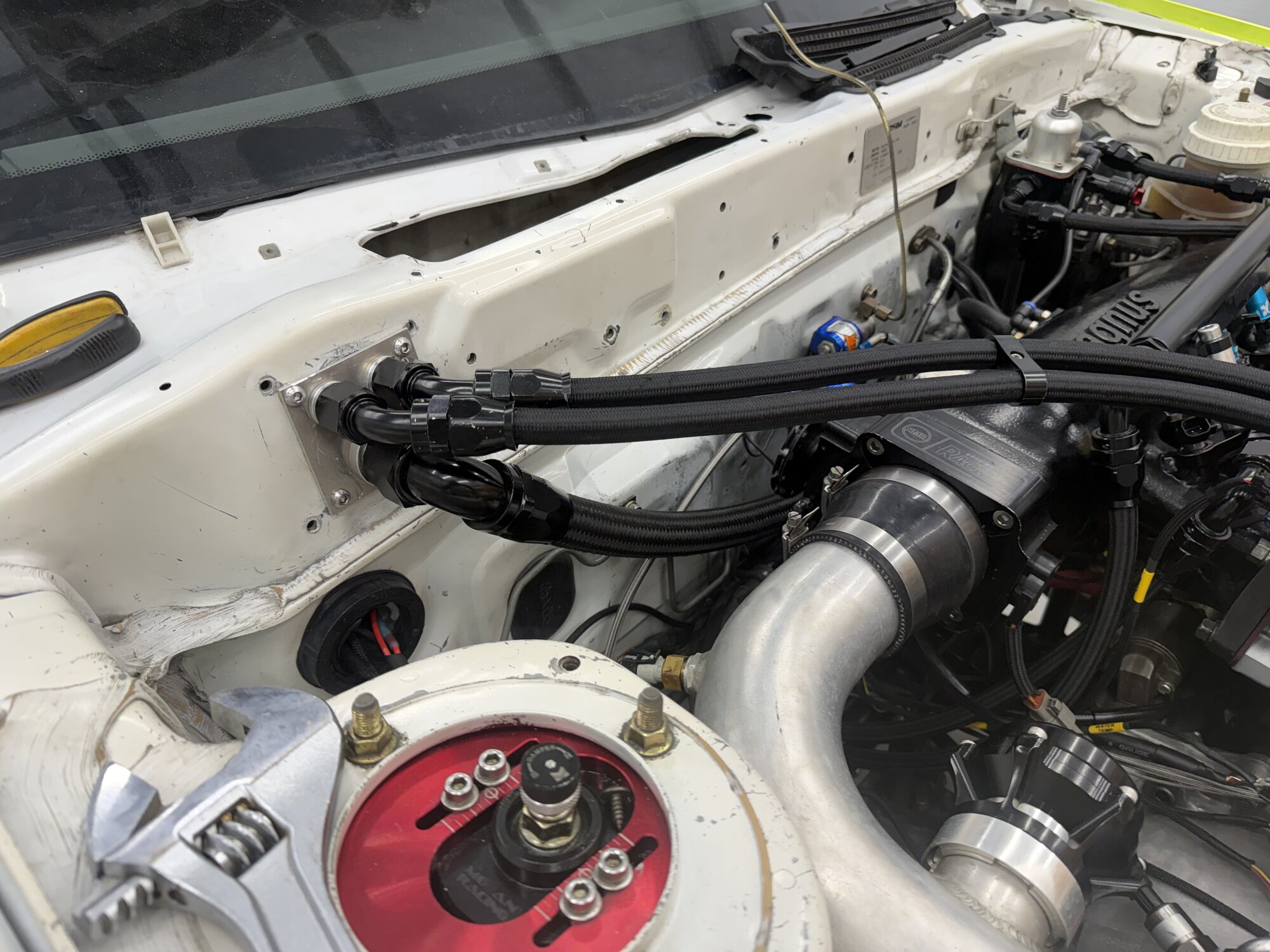

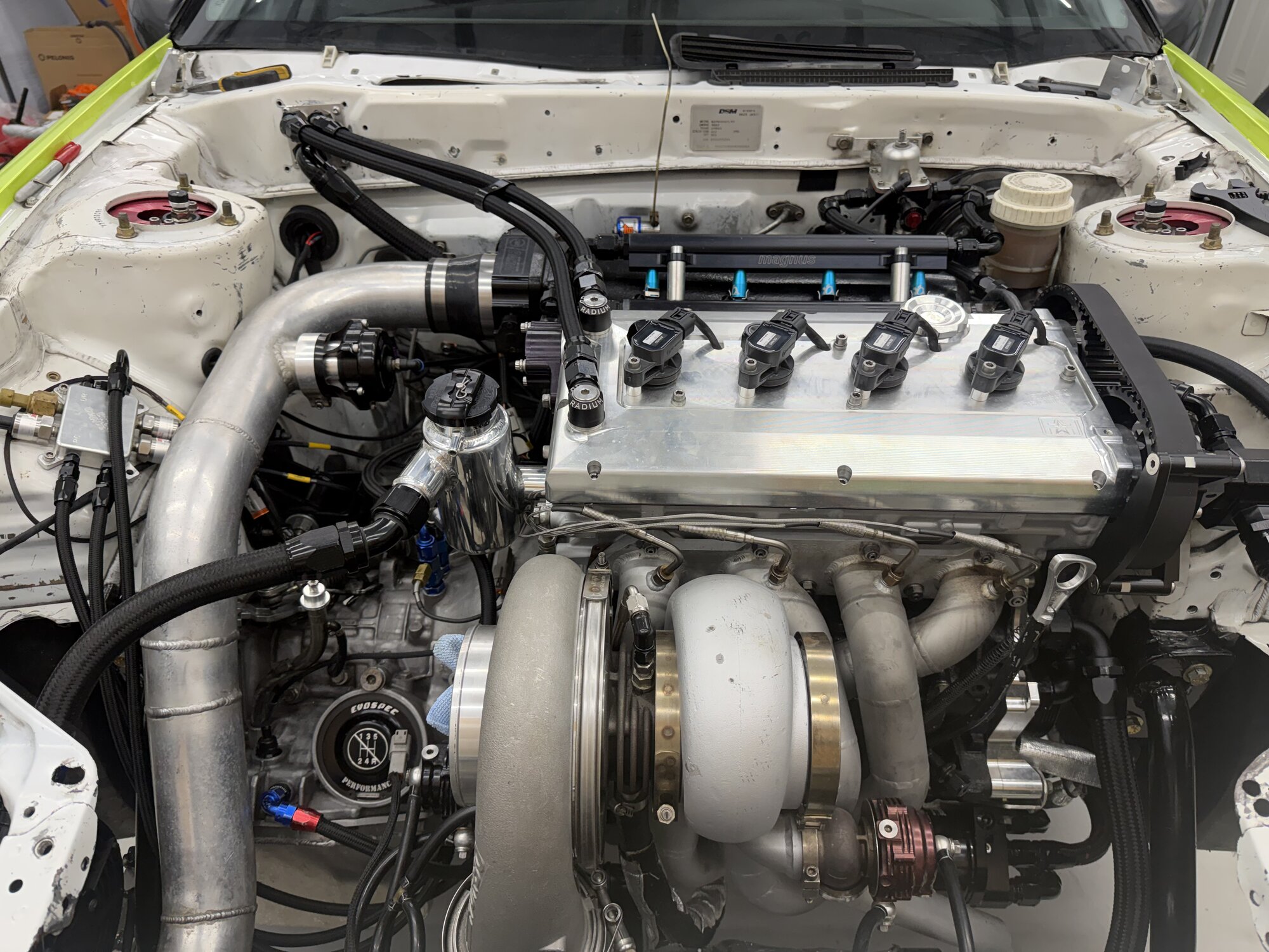

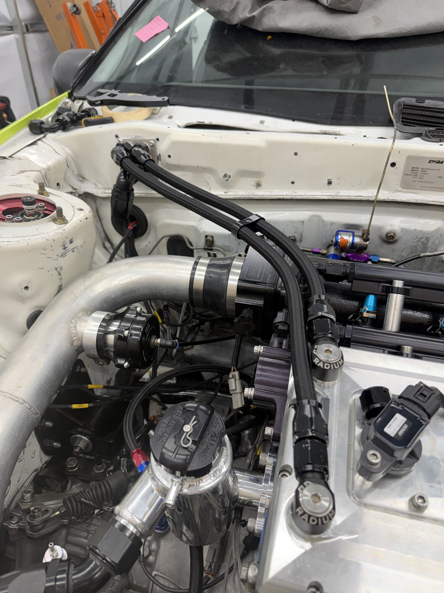

2 days ago I finished up the firewall block for the new burn down tank setup. I also made new VC vent lines and the big -16 off the frontline fab oil pump. Next up I’ll be installing a pressure sensor on the block to monitor crankcase pressure utilizing a 2 bar map sensor. I’ve always been curious what it is.
In the next day or 2 I need to figure out how to route the 1 1/2” breather hose and where to mount the puke tank. Crazy we’re now 28 days away from the shootout and I still have a shit ton of work to do. I don’t think I’ll be shooting for the moon after not running in almost 2 years. Some solid passes and I will be completely content. We’re all signed up for ST32 again but I don’t think I’ll be that competitive this year due to no testing with the car and a rusty race car driver. I’ll keep the updates coming as I get things knocked off the to do list.
