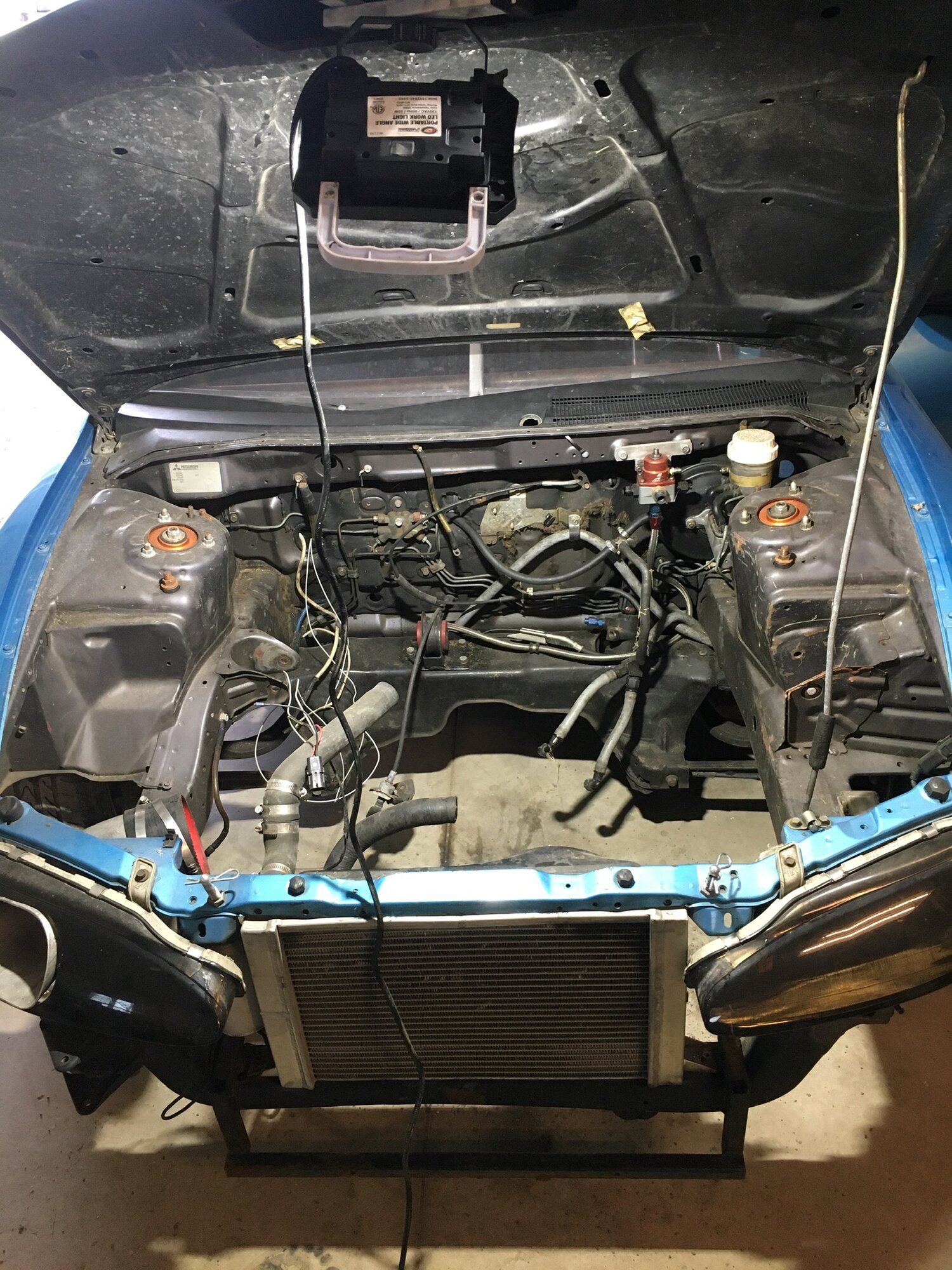

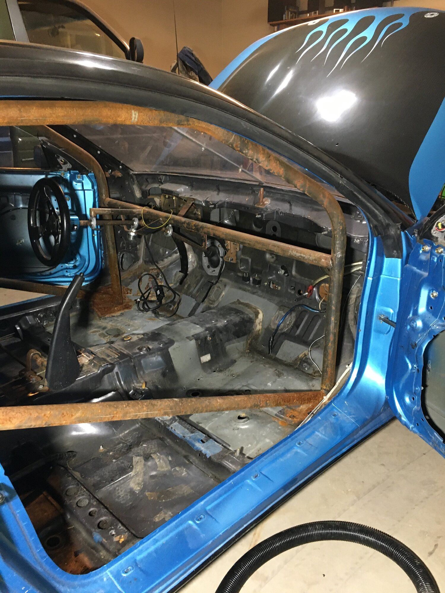

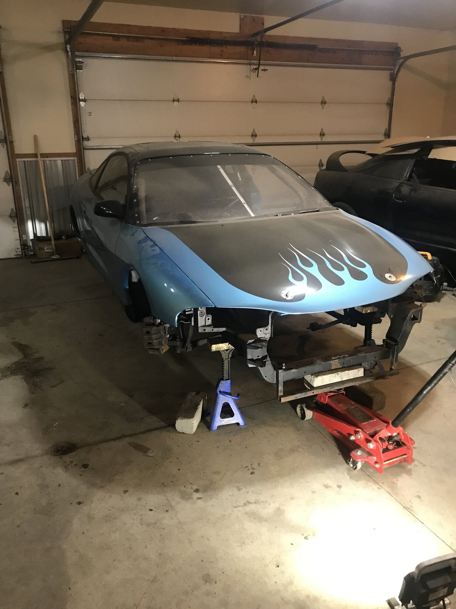

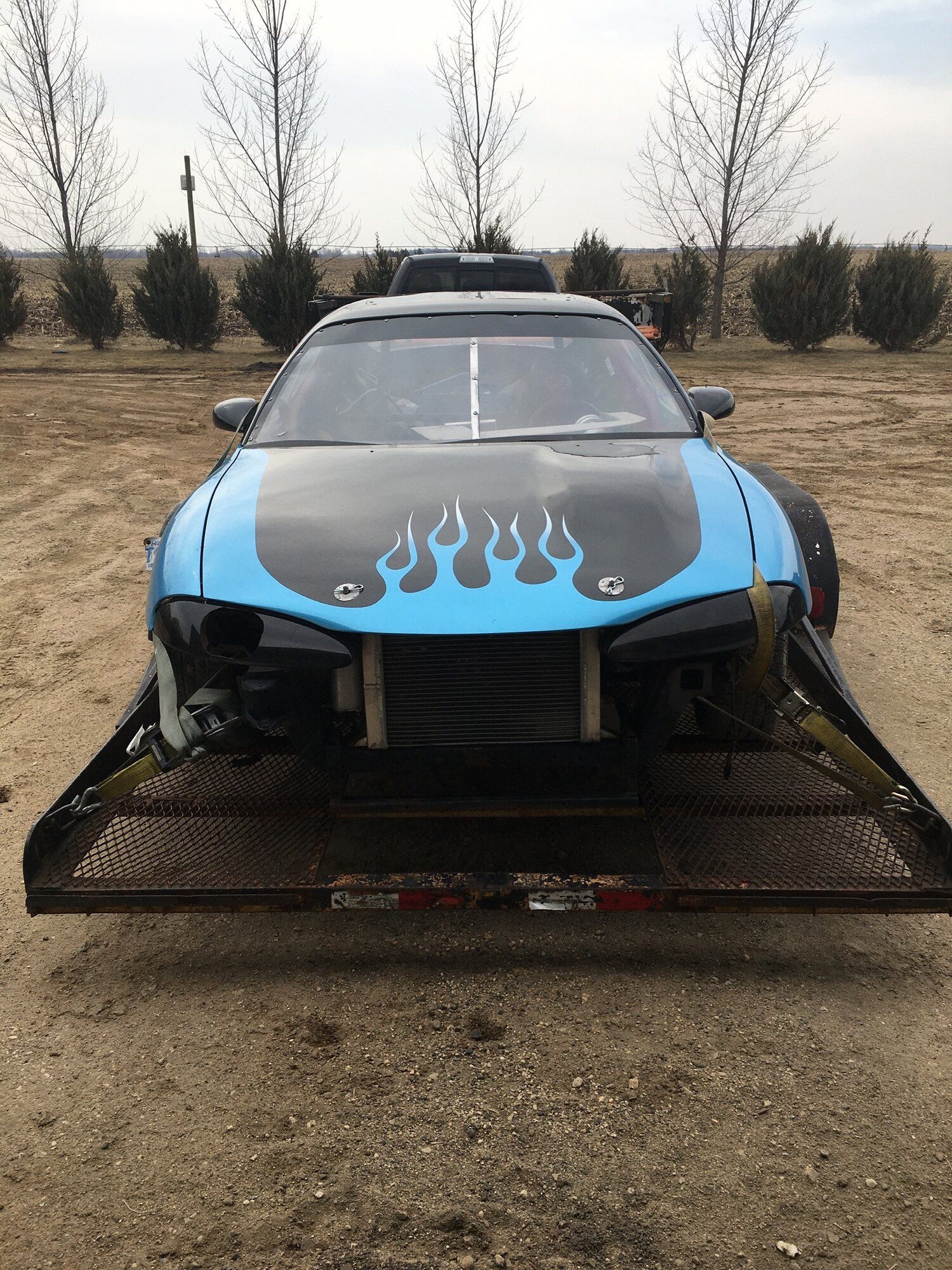

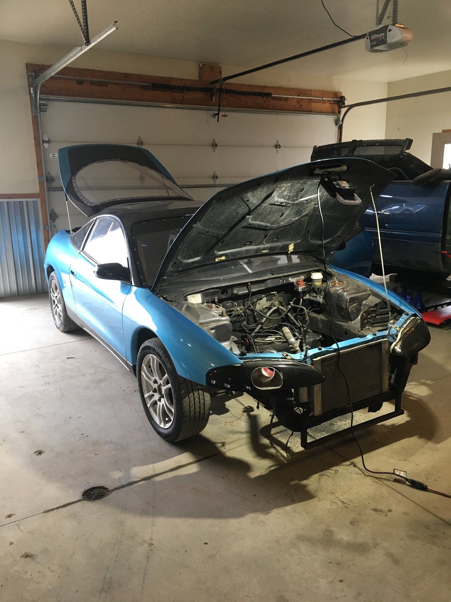

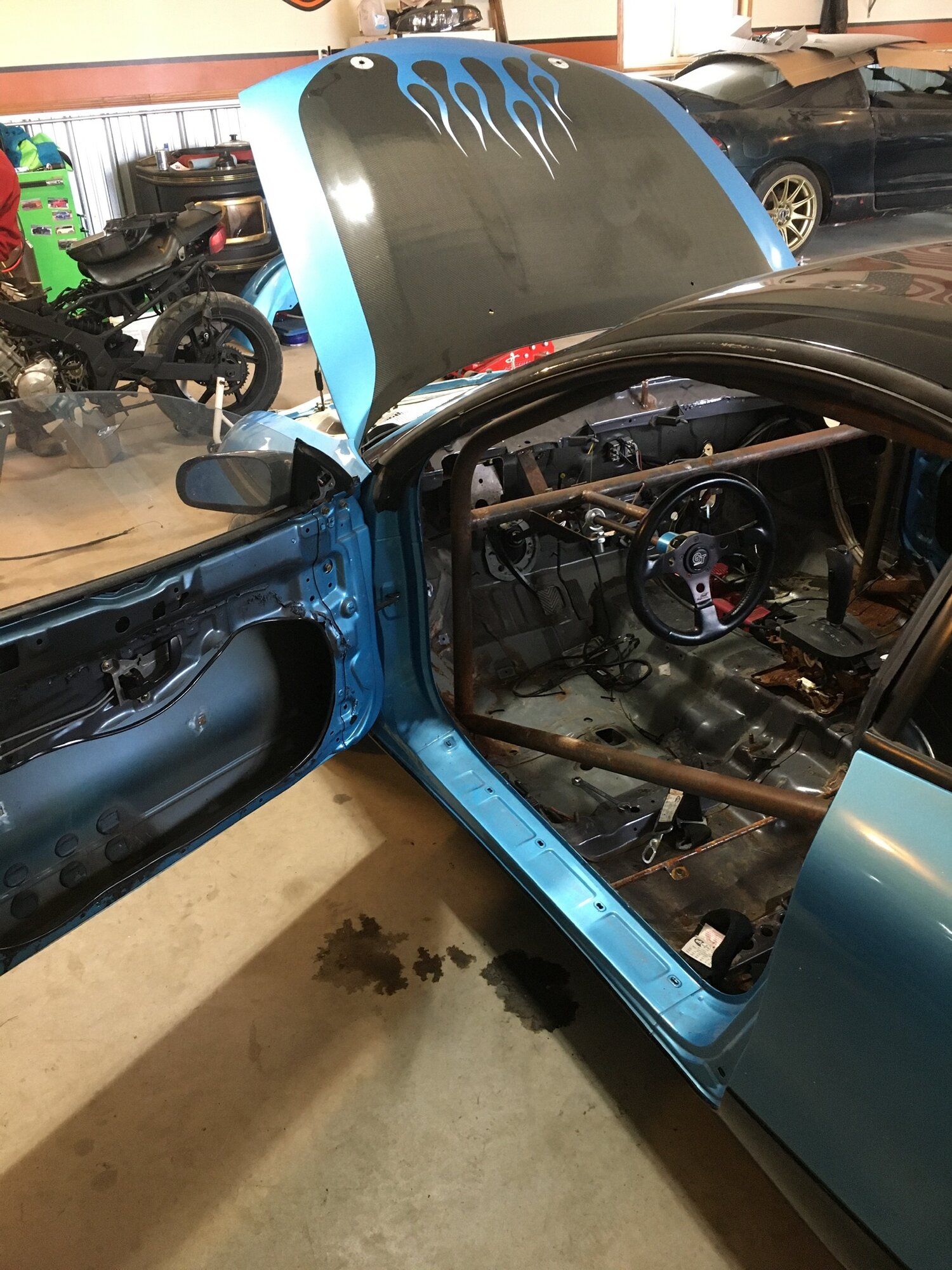

Blue Blaze was the member that built this car. It ran out in colorado and from my understanding was one badass ride. I drove 11hrs to illinois to pick this up and bring it back to Minnesota. I have had the car for about a month. Spent some time stripping it down (not much to strip) and getting an idea in my head of a plan of attack.

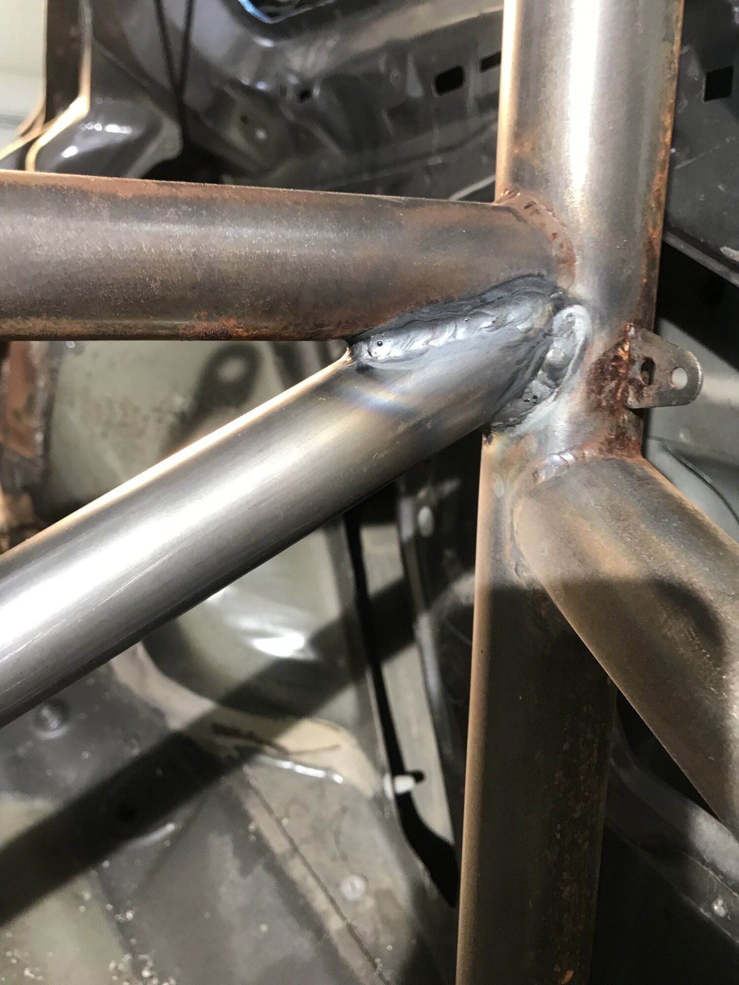

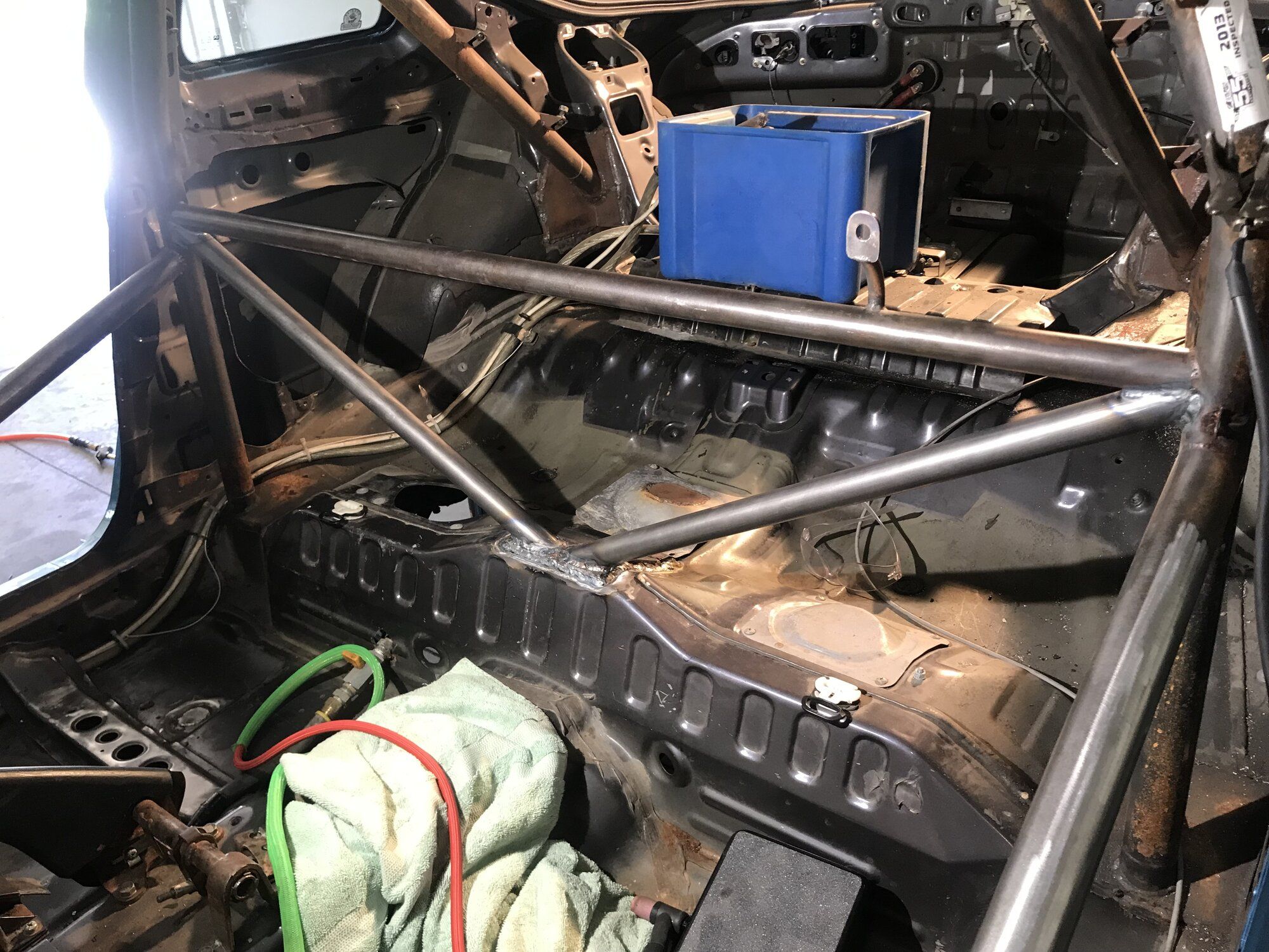

The chassis is in a perfect place to start. Alot of the fab work has been done. My understanding is for it to cert 8.5 NHRA i need to add lateral bars. There is a ton of work i want to do, every day i think of things i want to do. I have told myself i want to get it done for next year.

There are alot of unknowns and one of them is the turbo. Unfortunately funds are low after recently buying the dog box setup. It needed to be done tho and am excited to get it in the mail. Currently waiting on my chromoly order so i can add later bars, position the seat/Wheel, and tube the front end. For the next month or two its back to cheap lunches and strictly working on it no more buying.

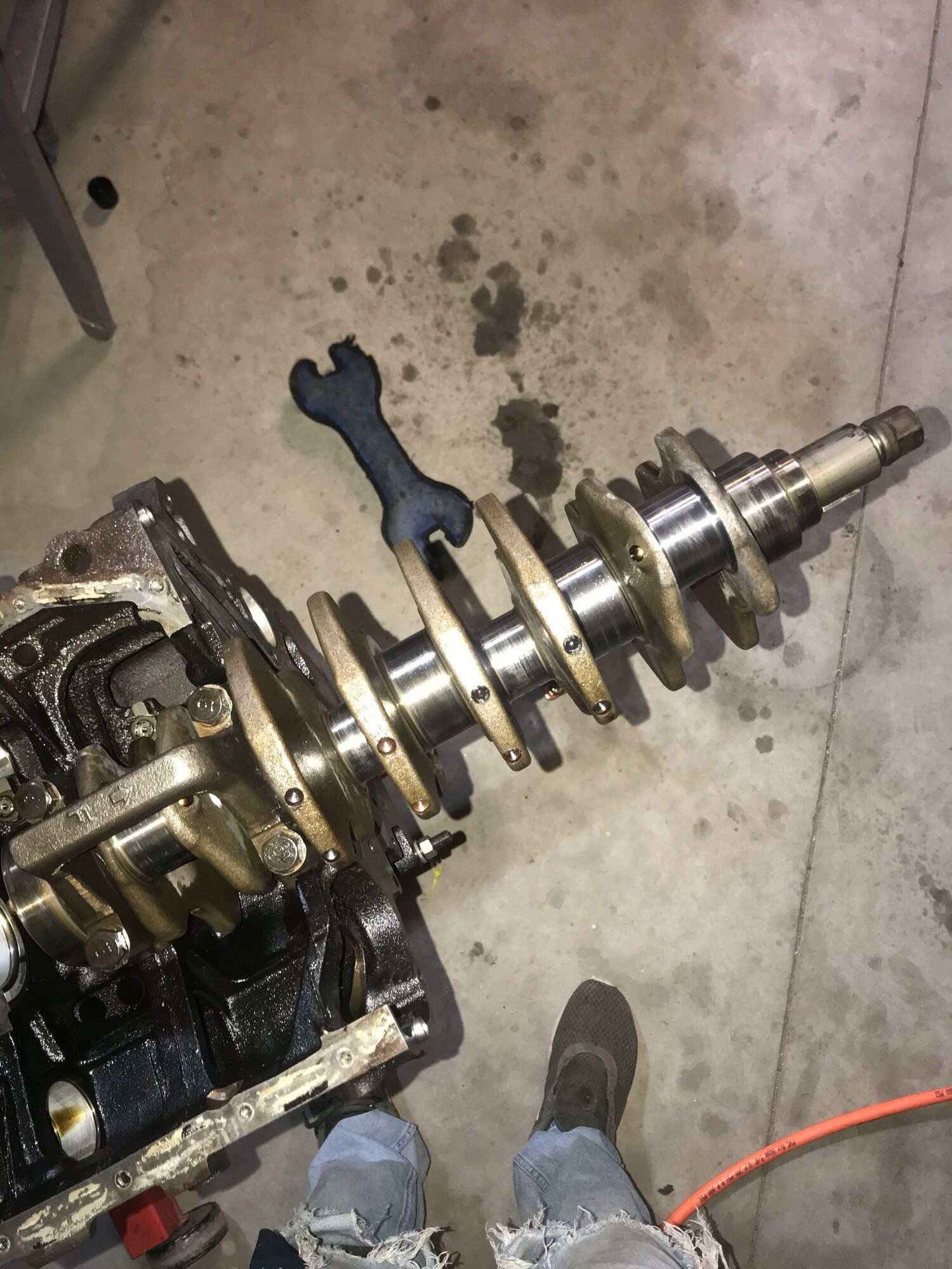

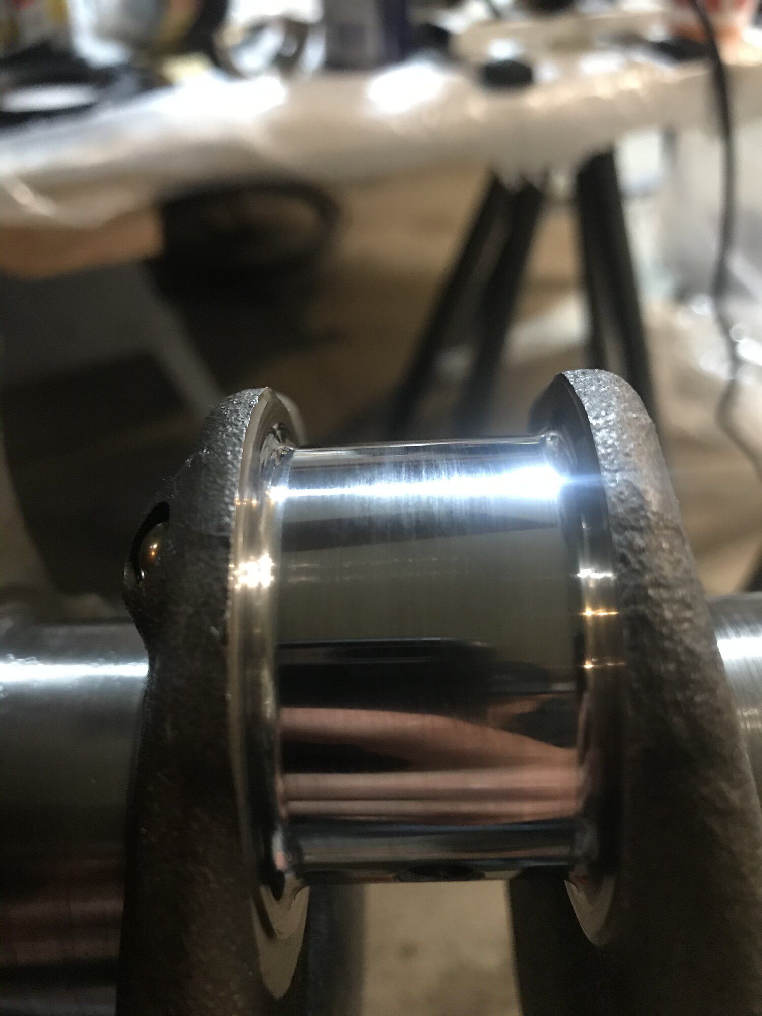

I measured the main and rod journals which all checked out. I positioned the crank back in the block while i did some polishing.
This is one of the rod journals i got done. I plan on remeasuring everything once polished to see where its at. Need to order some block fill so i can get it sent to machinist.

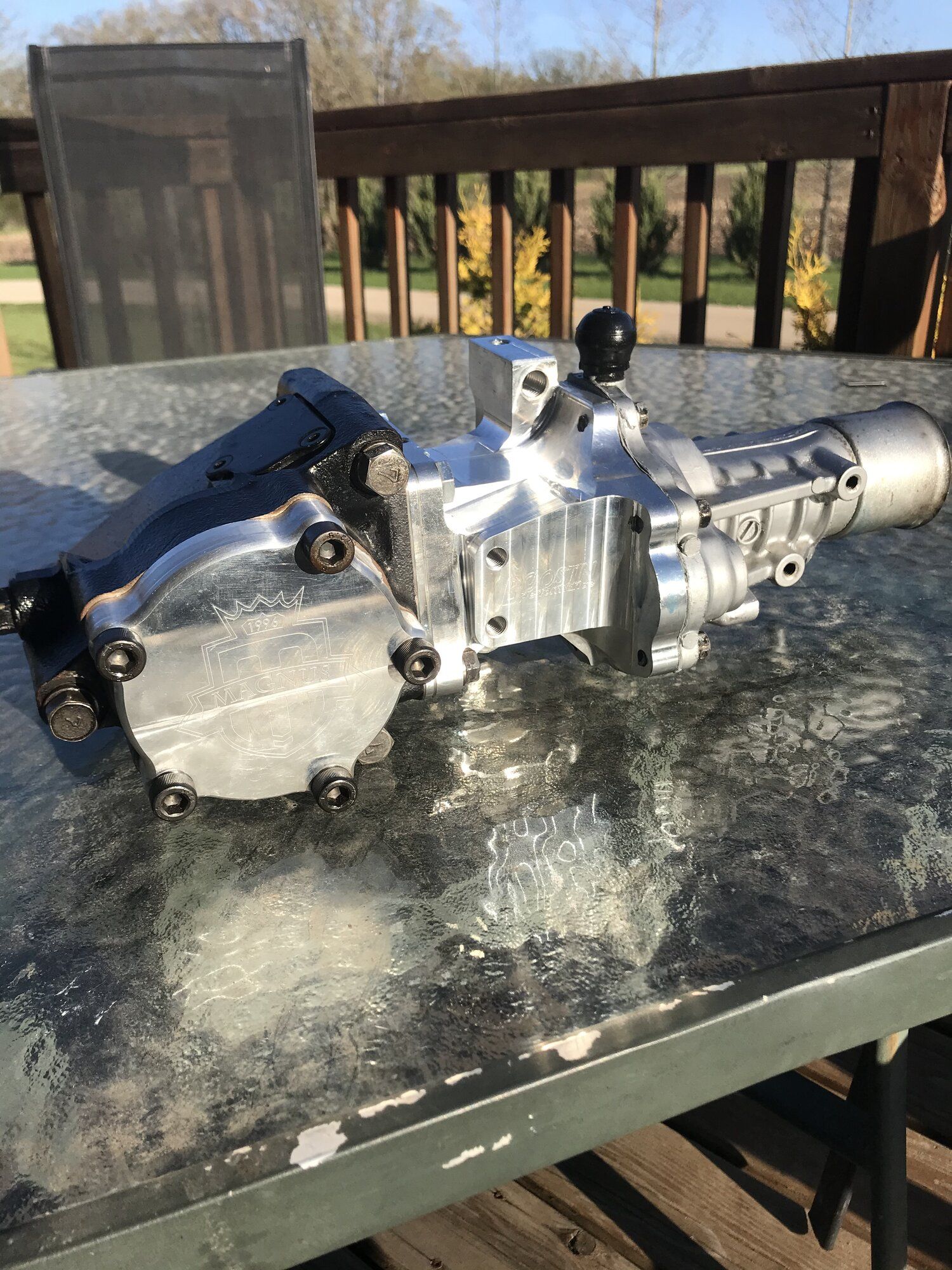

Got the transfer case the other day. Still waiting on chromoly, I have been told we are in a shortage. Planning on traveling to Chicago to pick up the dogbox, DSS front hubs/axles, and DSS driveshaft late may early June. Need to find a machine shop local to MN for the block. MAP seems like the only option. Was told they wont touch the block for cheaper than 1500 though. Going to start working on mounting the seat and wheel in a position that fit me better.

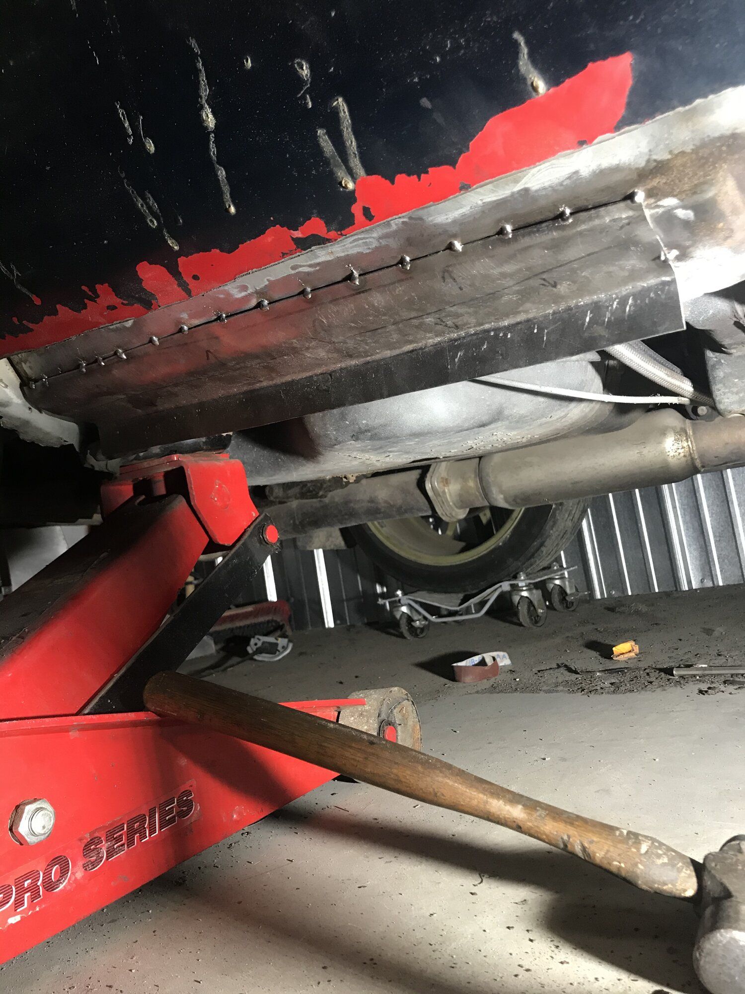

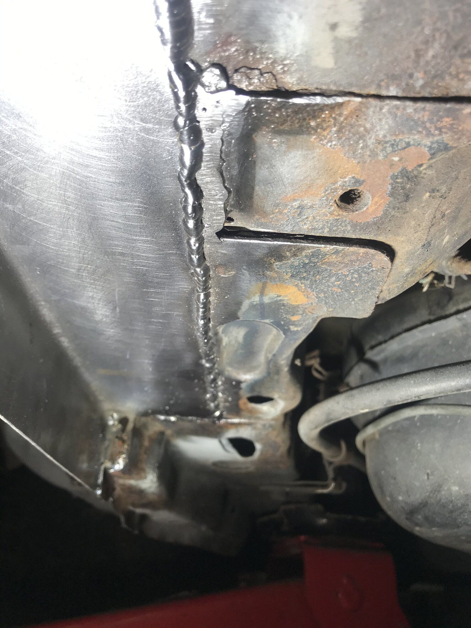

Also working on repairing some rust on my first DSM i owned. First time doing rust repair thought i would post some pictures of it.

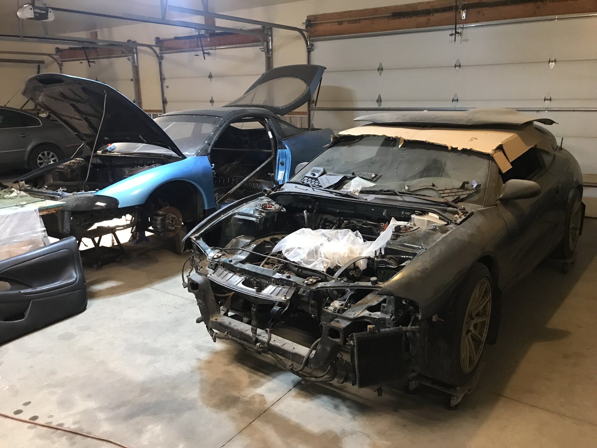

Finishing up my other projects and am starting to put my effort towards this build.

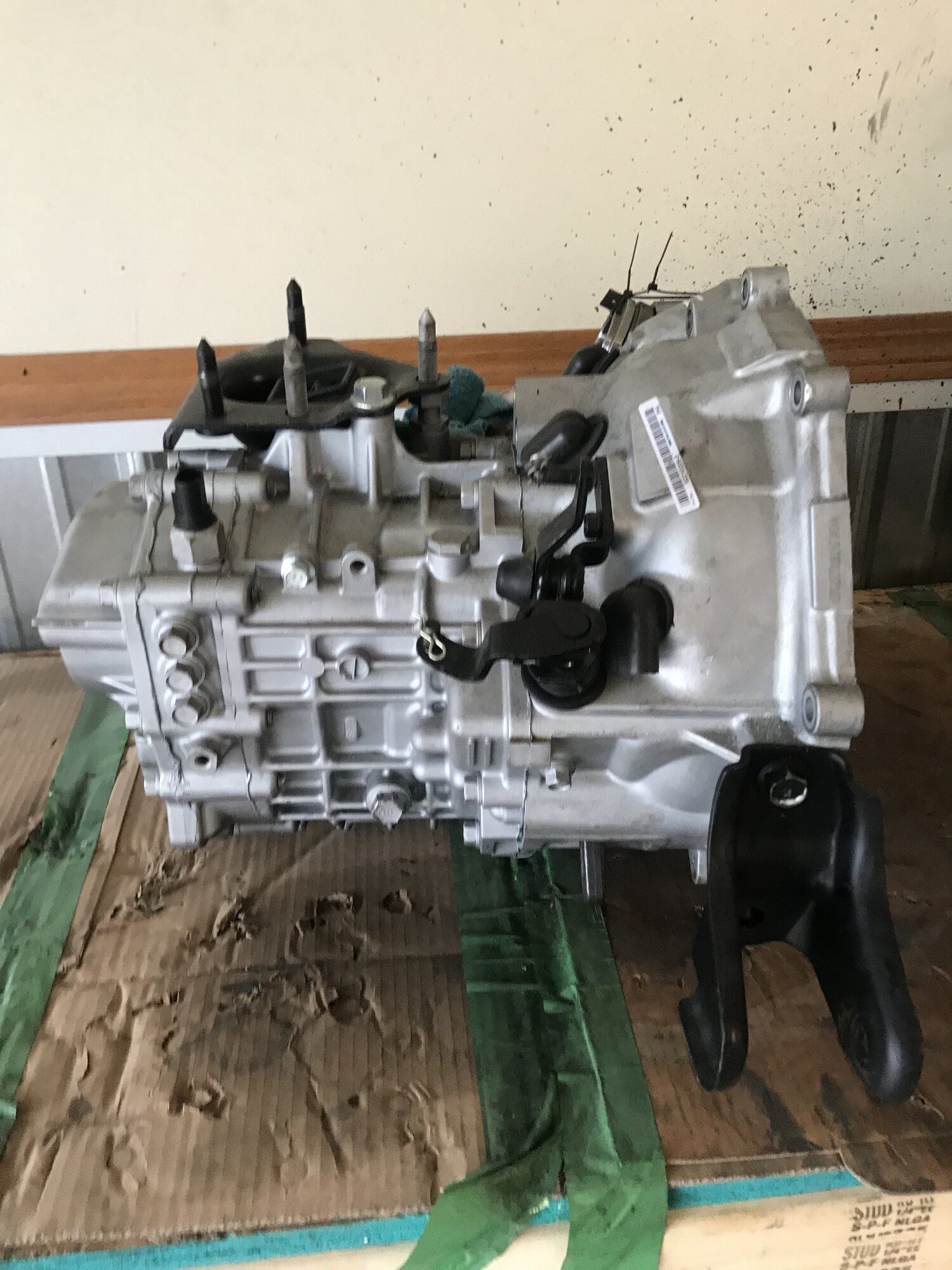

Dogbox came in last week, built by shep trans. Its going to end up sitting on a shelf for more than likely till next summer.

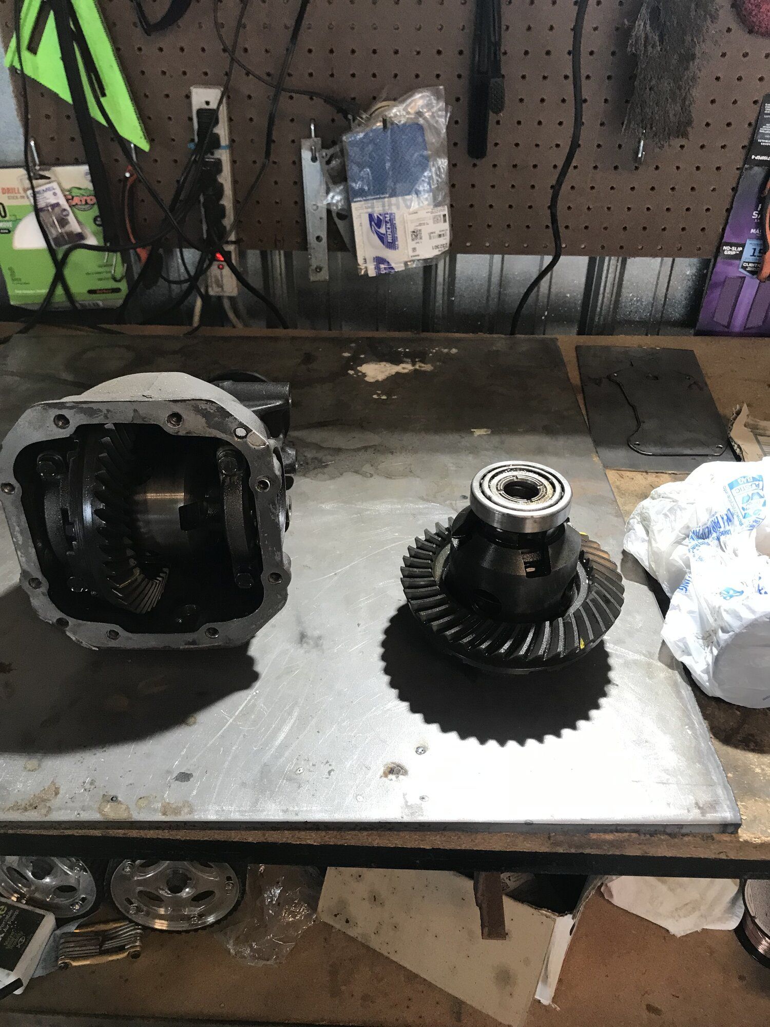

I pulled the rear differential out of a buddies manual 1g. Plan is to drop the pinion/ring/LSD of the 1g into the diff housing that came with the car. Still debating if I should separate the differential or just drop it in.

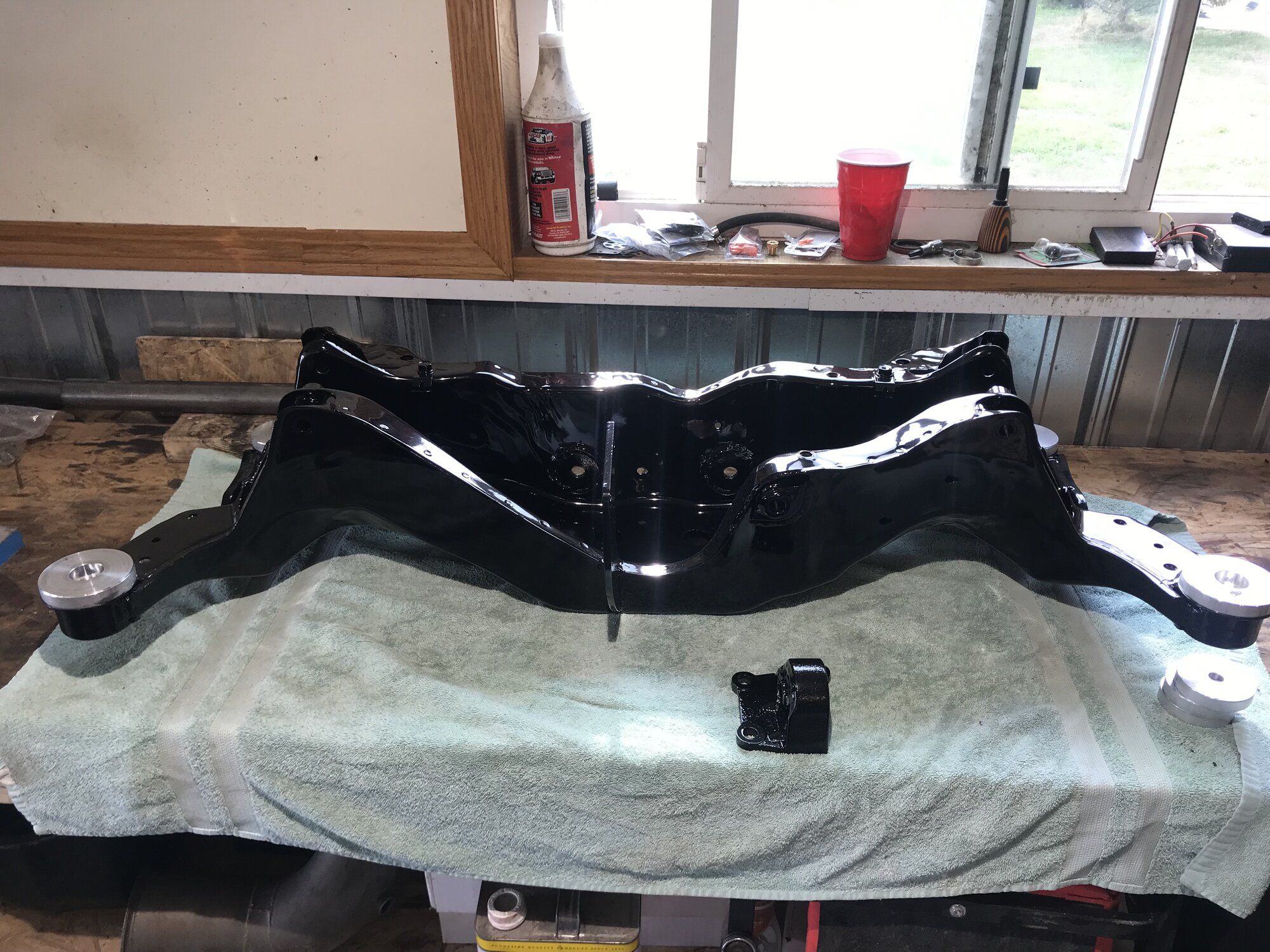

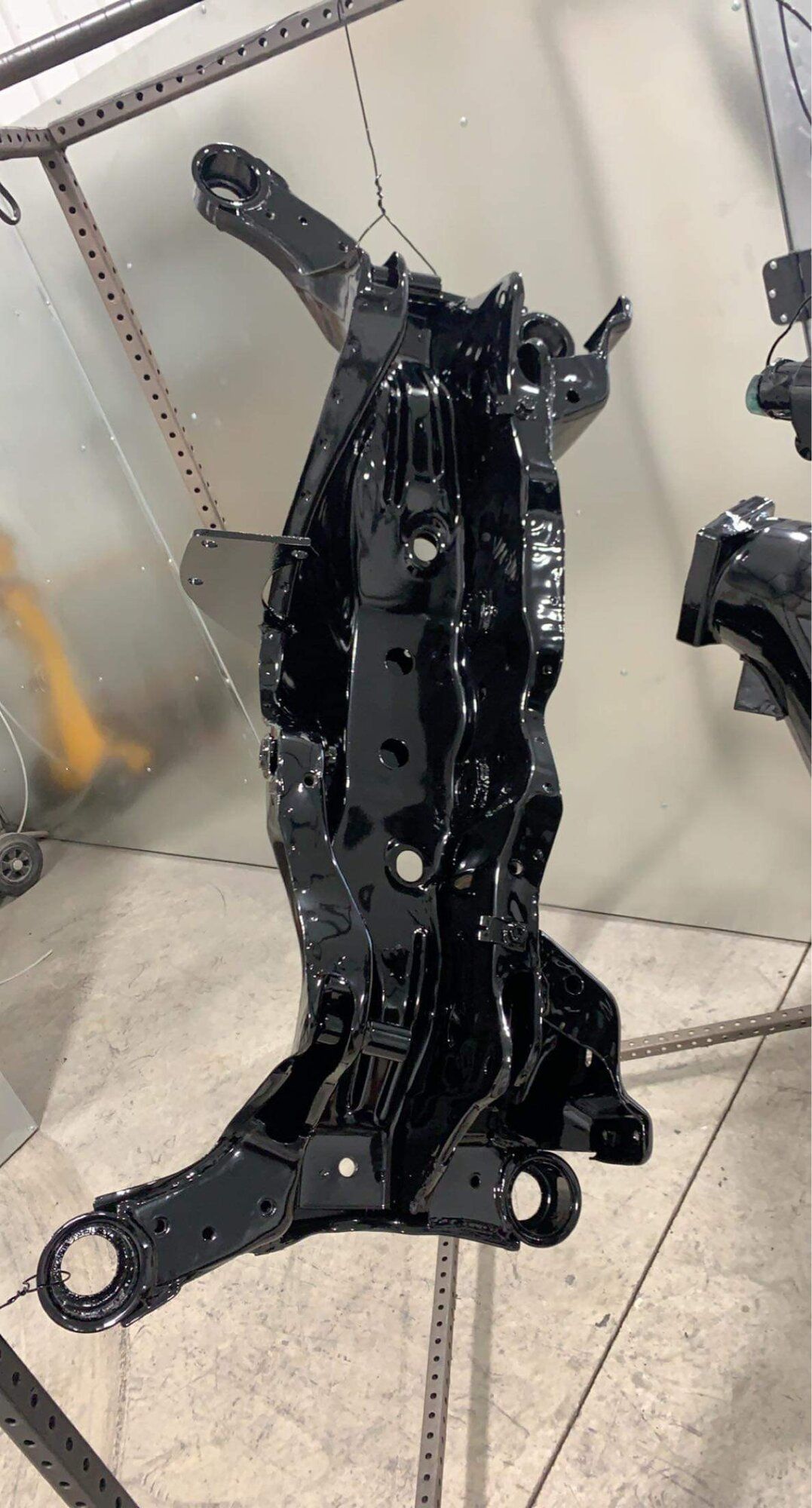

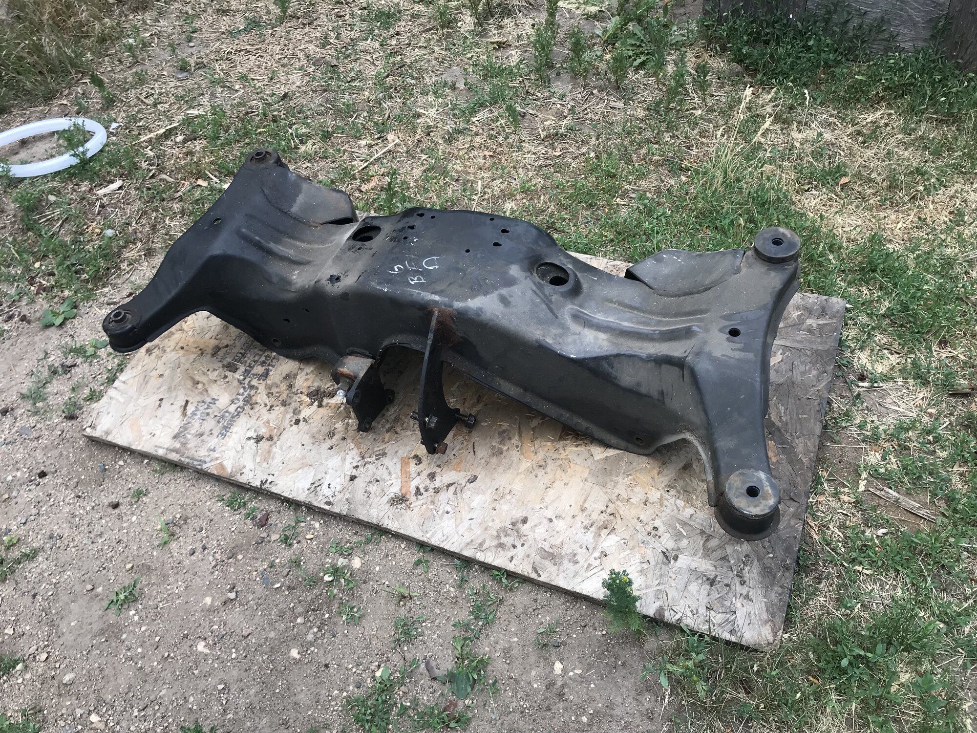

I wet blasted the rear subframe and dropped it off at the powder coater. Need to ordered some sold bushing from VOLK. I dont have a picture of it after being blasted, it developed some flash rust but coating guy did not think it would be an issue.

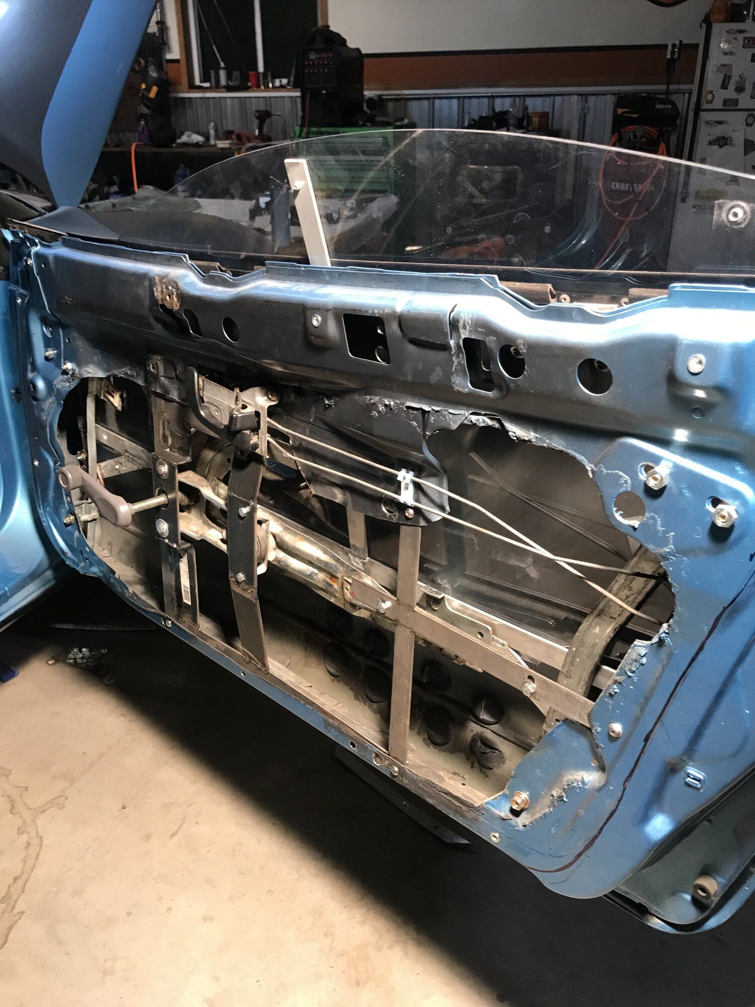

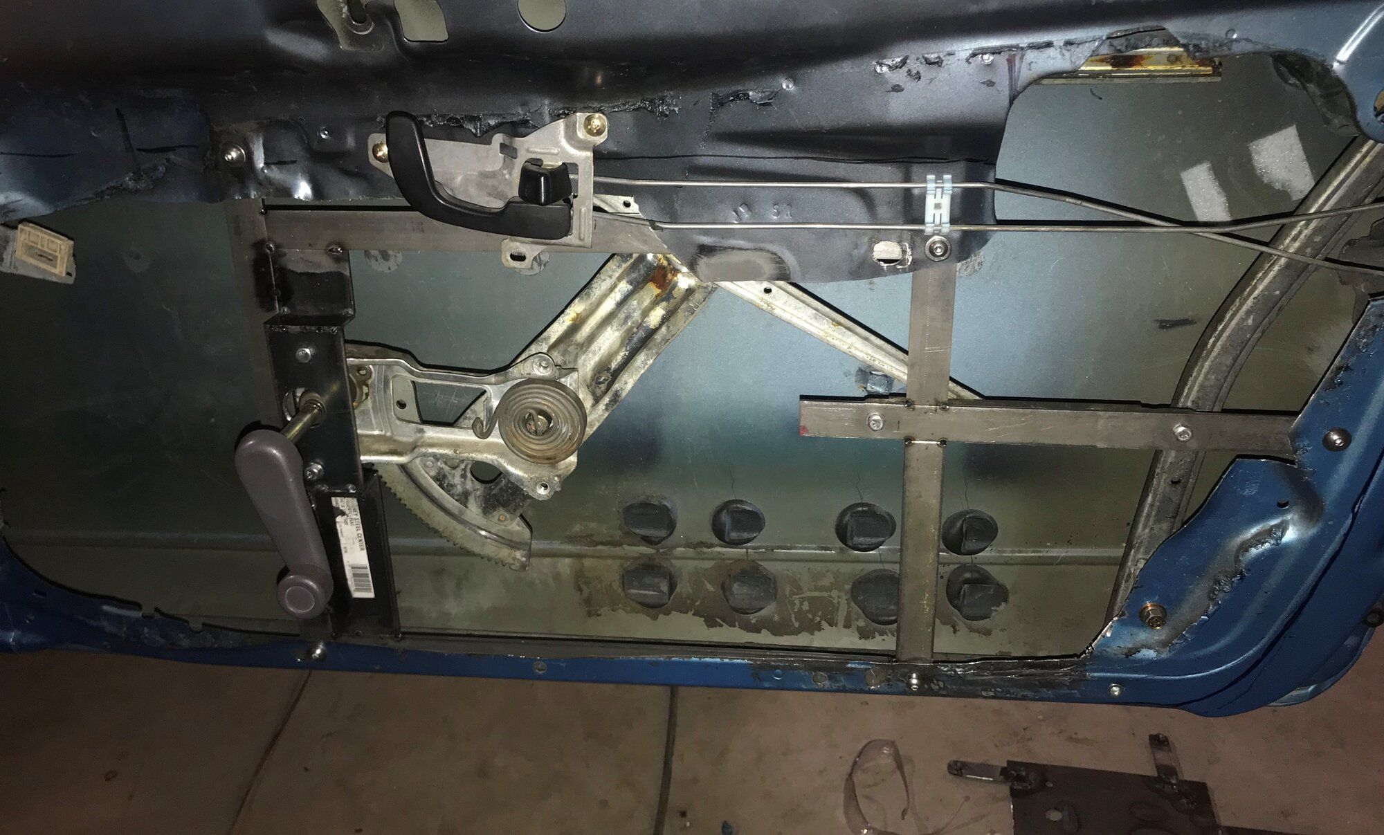

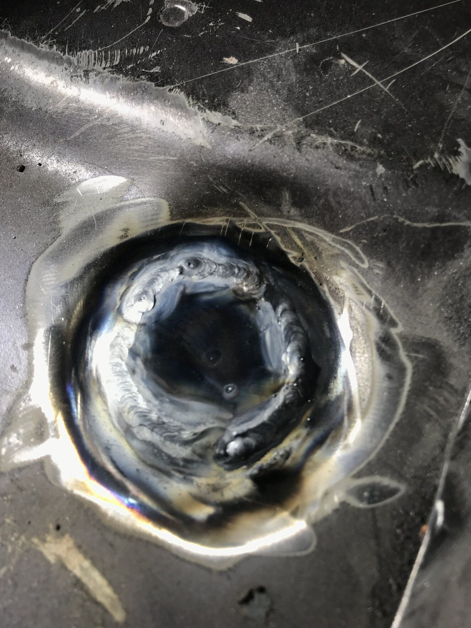

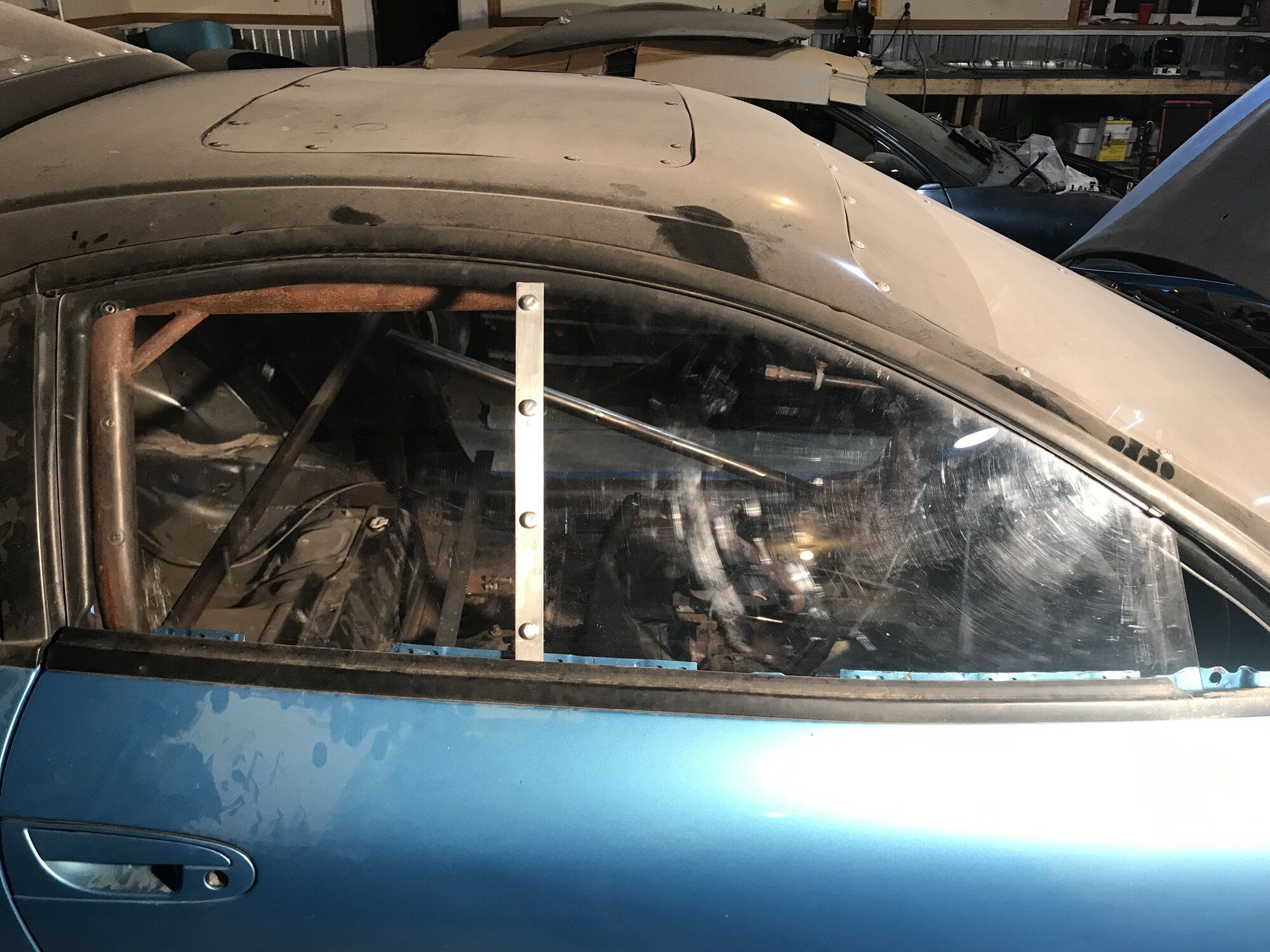

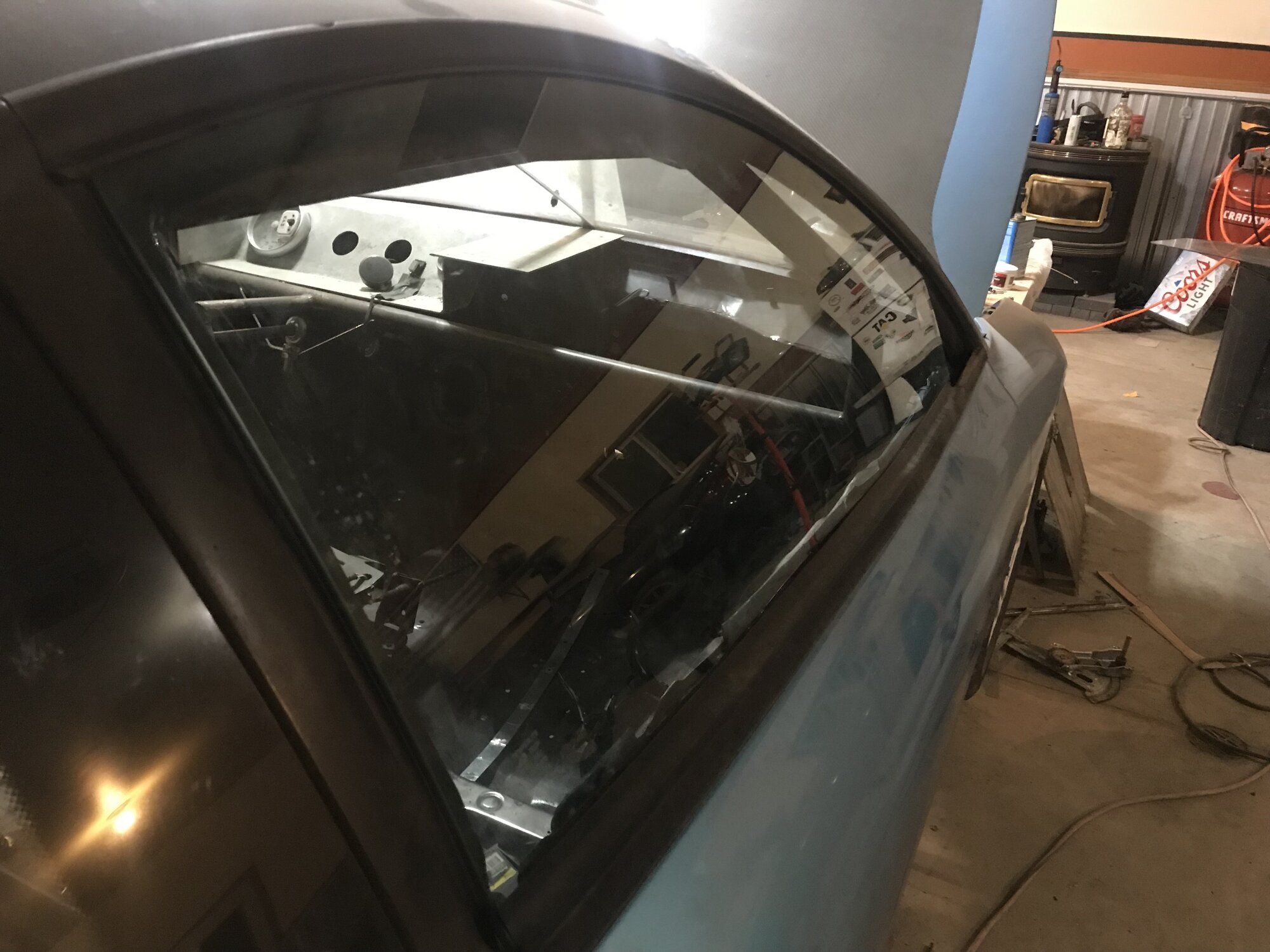

Another thing I have been working on is my tig welding. Plugging holes, building a window regulator mount. Need to keep practicing before I tube the front end. Plan on driving it on the street so I want to be able to roll the windows down. Got some glass from a guy who was junking a 2g. Was able to get the glass to fit somewhat good. Once I get the regulator mounted to where the glass fits perfect I'm going to try to get the Lexan in there. Thinking of building an aluminum frame to support it to still allow the up/down function. Which might be a waste of time but Im going to give it some thought.
The rear subframe has been coated just waiting for the bushings to come in. Also mocked up an aluminum frame for the lexan, needs more support bars. Otherwise it will work for what I want to do. Final version will be tinted. I have aluminum to make door cards too. The chromoly came in for the lateral bars so this weekend plan is to get them welded in.

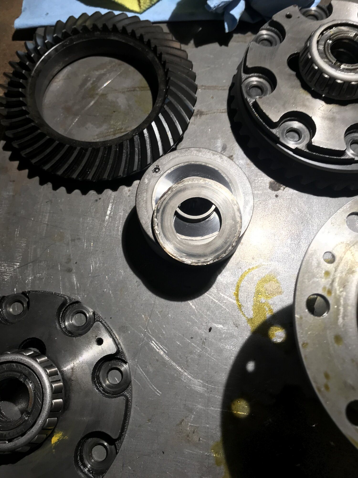

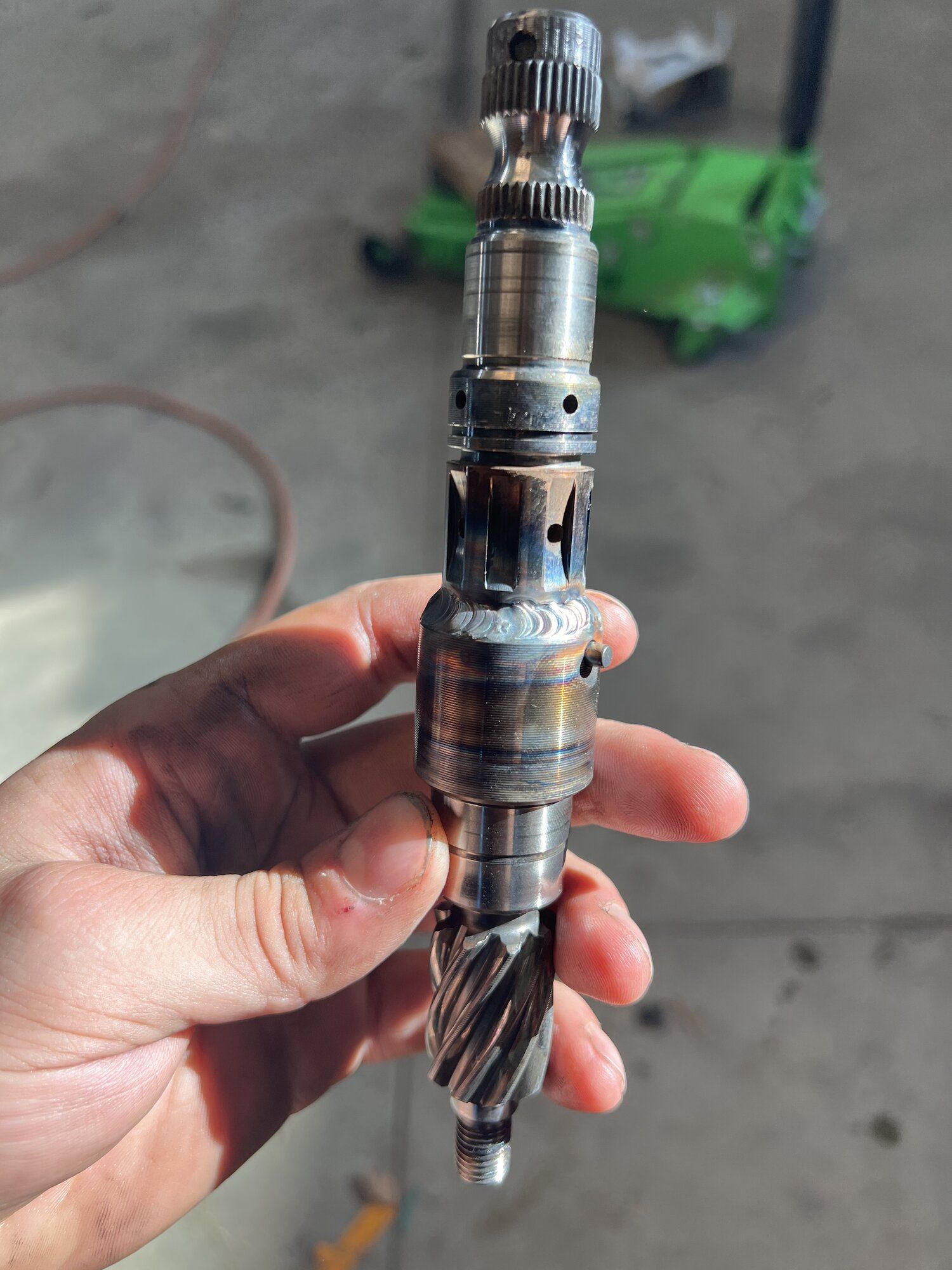

Took the auto rear differential apart. I can tell this thing made some jam, has some discoloration/embedded particles on the viscous coupler.

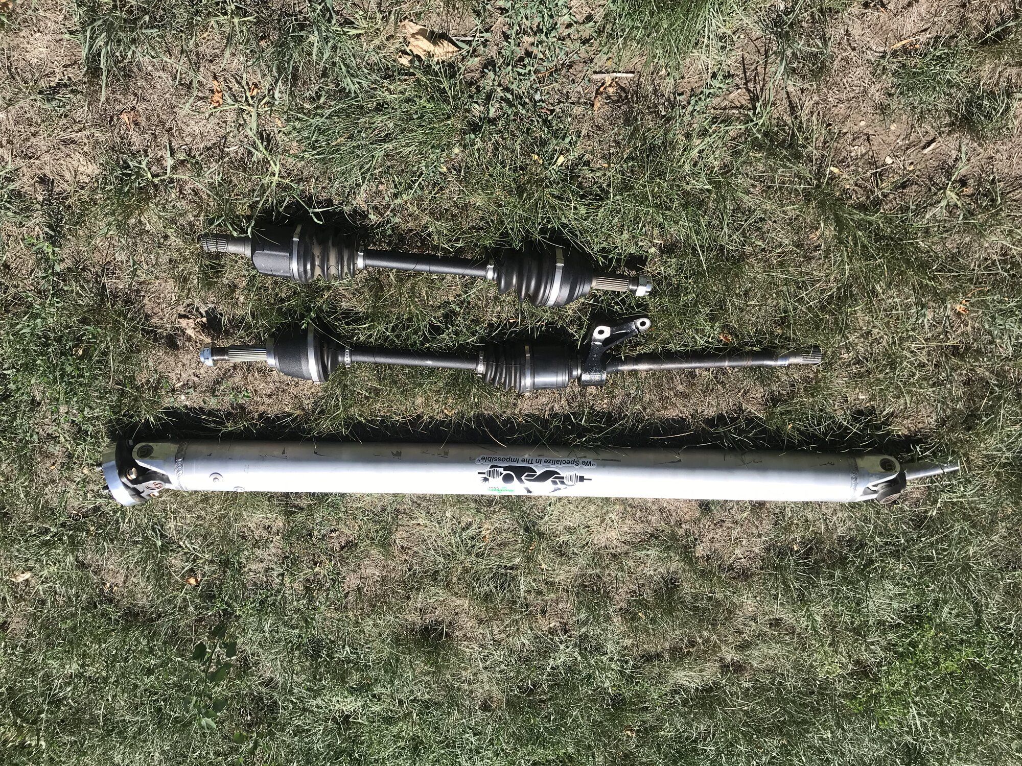

Any chance someone has here can sell me this part? Also looking to buy a 2g clutch pedal. Got all the DSS axels only need to find that third section of the driveshaft. Next thing I order will be some aluminum long rods and possible a callies crank.

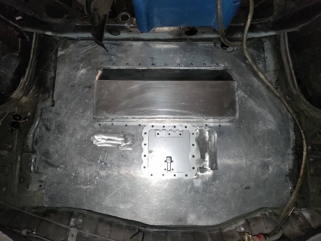

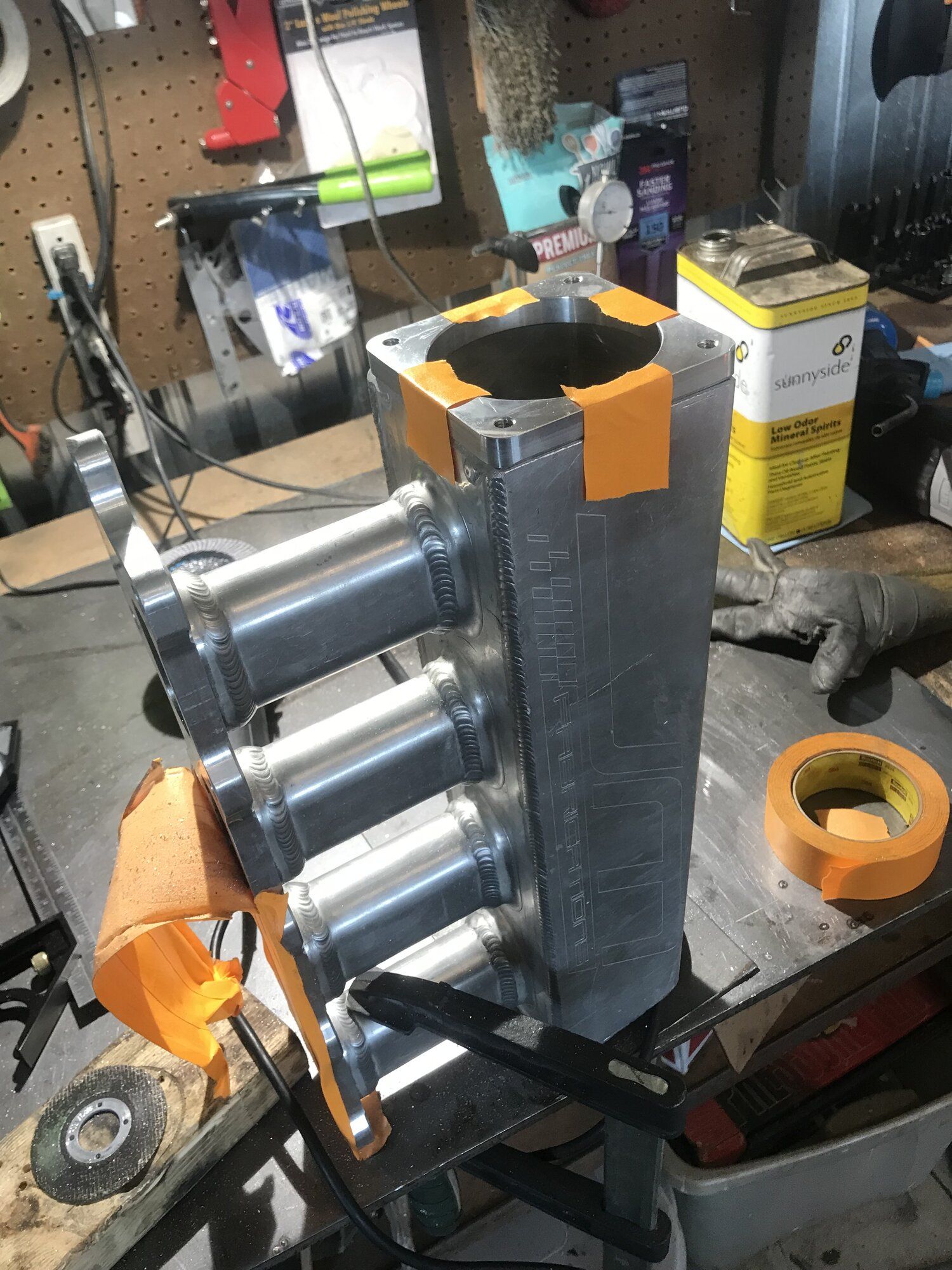

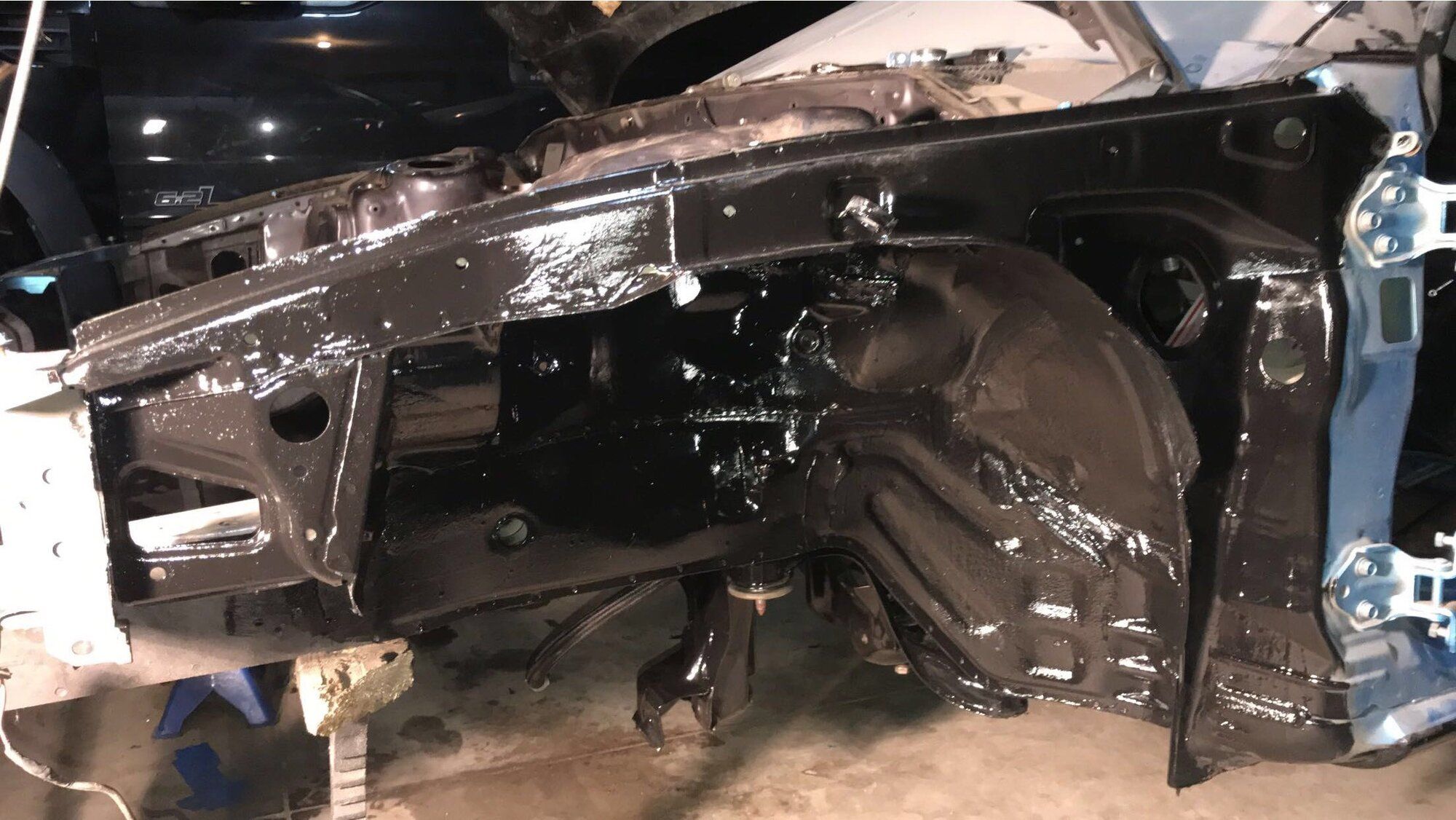

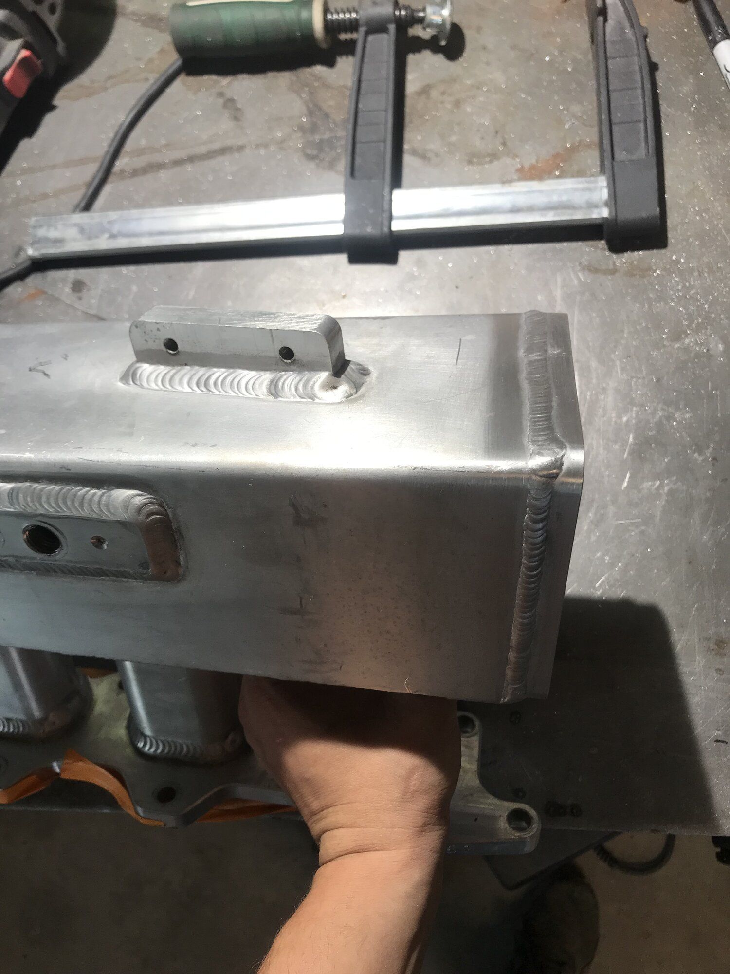

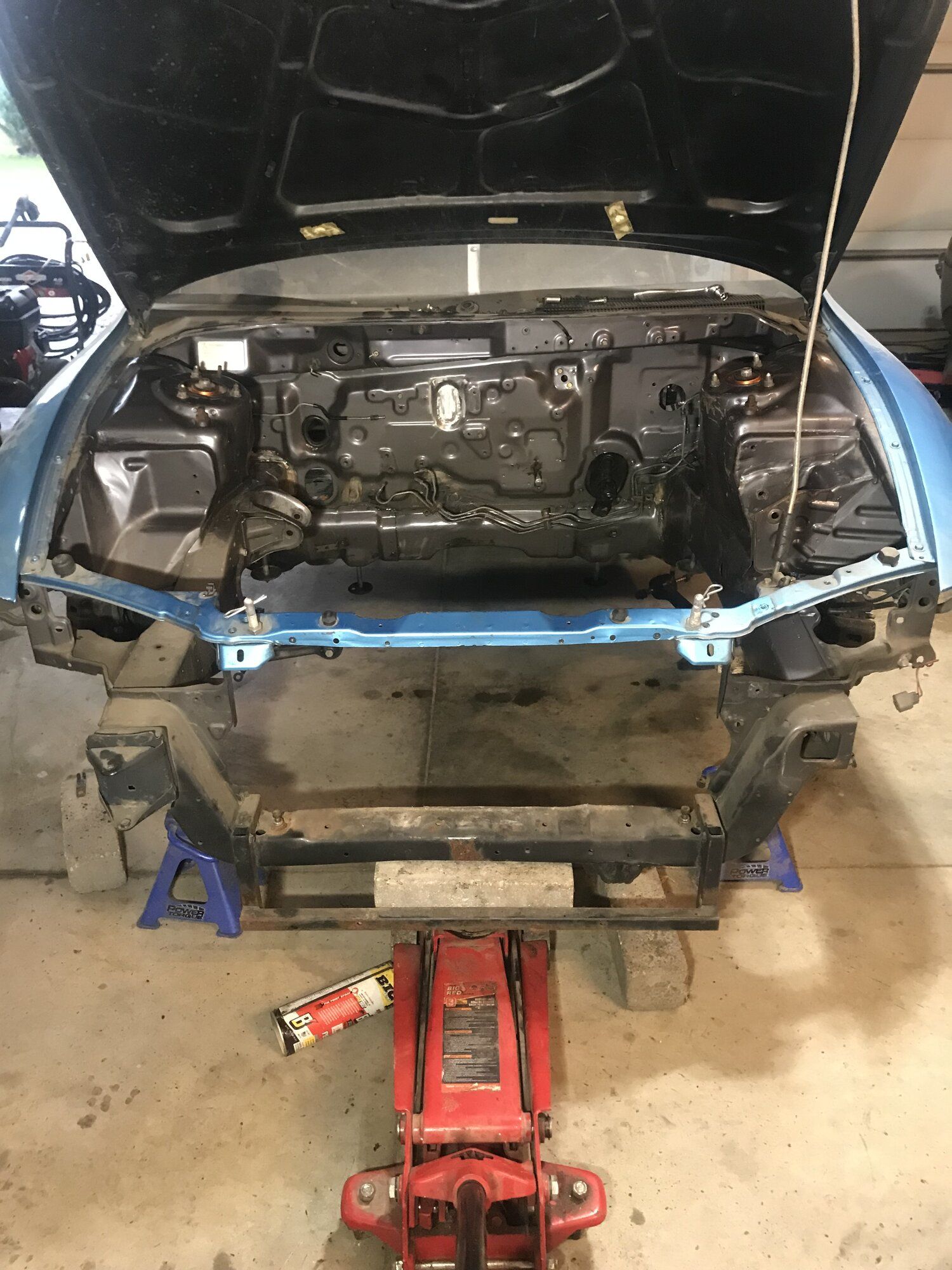

Removed the front subframe, brake lines and fuel lines. Going to be using POR 15 on the under side. Before I coat anything I want to get the new fuel setup installed. Currently working on the mounting should have that done this weekend. Today I cut off the throttle body flange on the JMF intake. The intake is port match to the head I plan on running by Curt Brown. Threw a 90mm throttle body flange on it. Was my first time welding aluminum, I did screw up in one spot but there is no leaks.

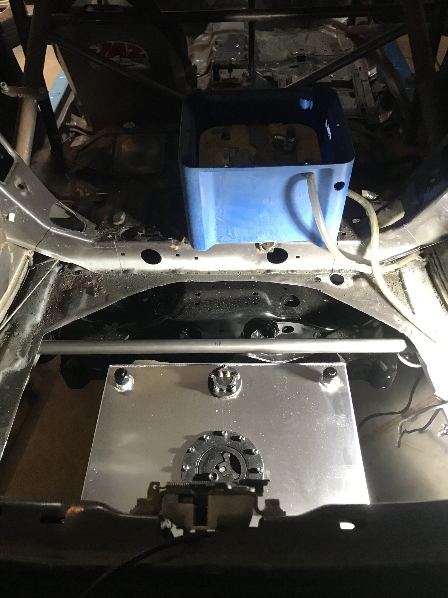

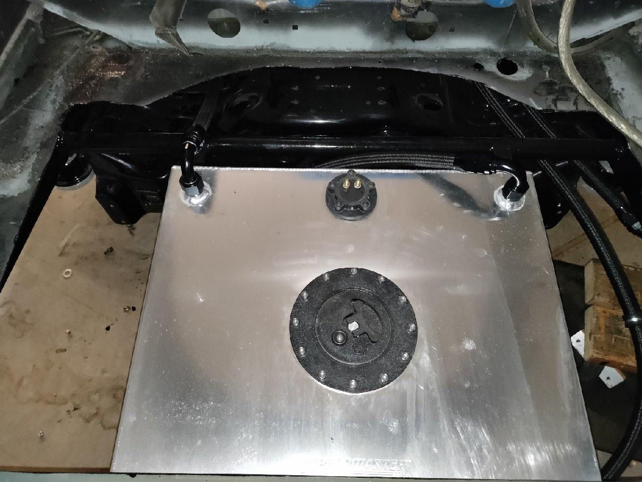

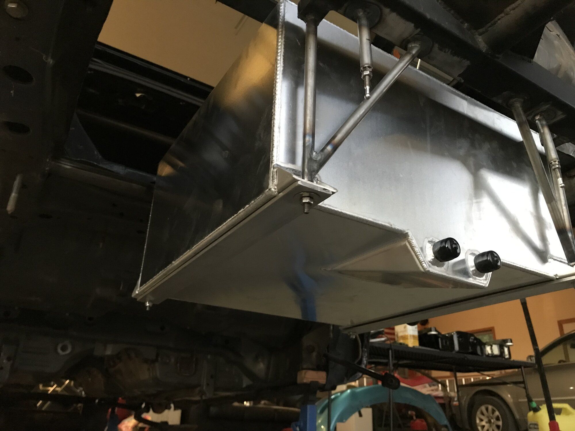

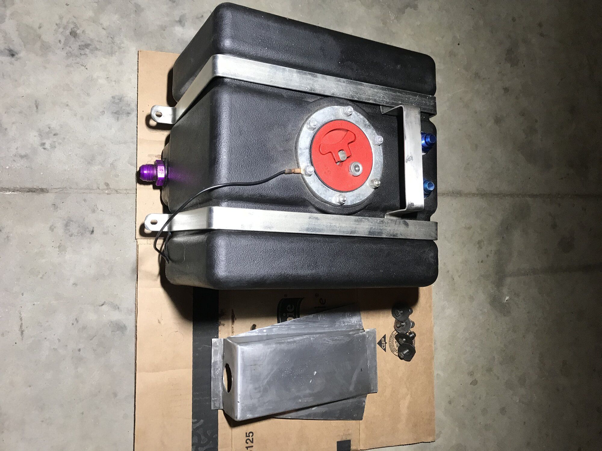

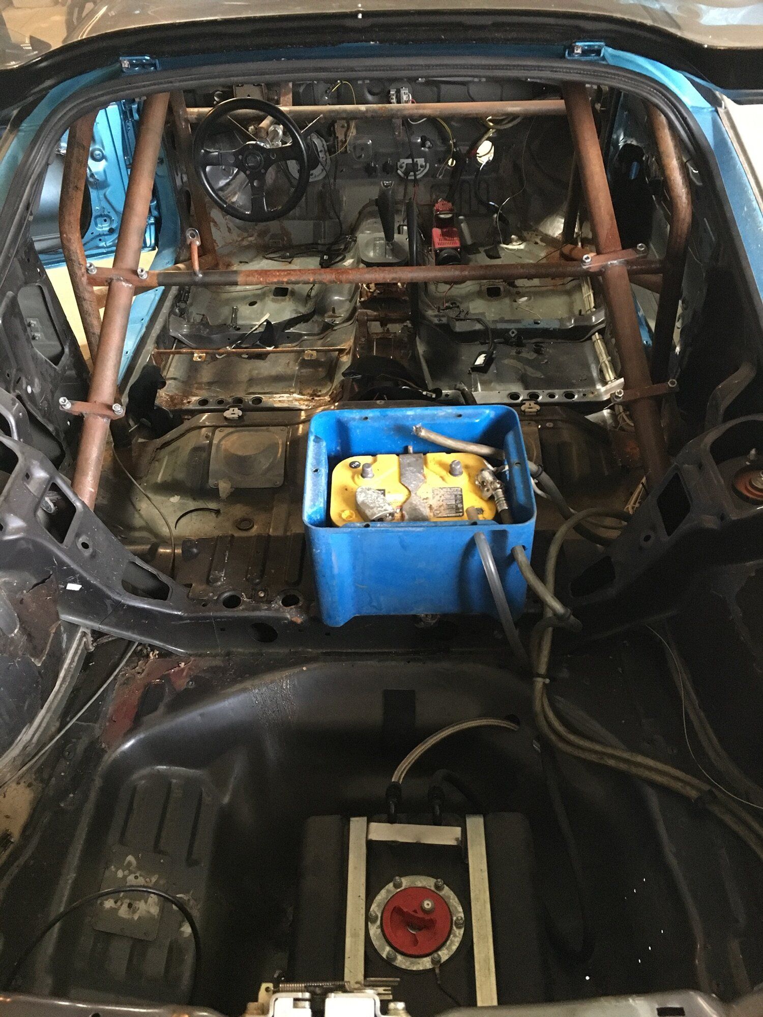

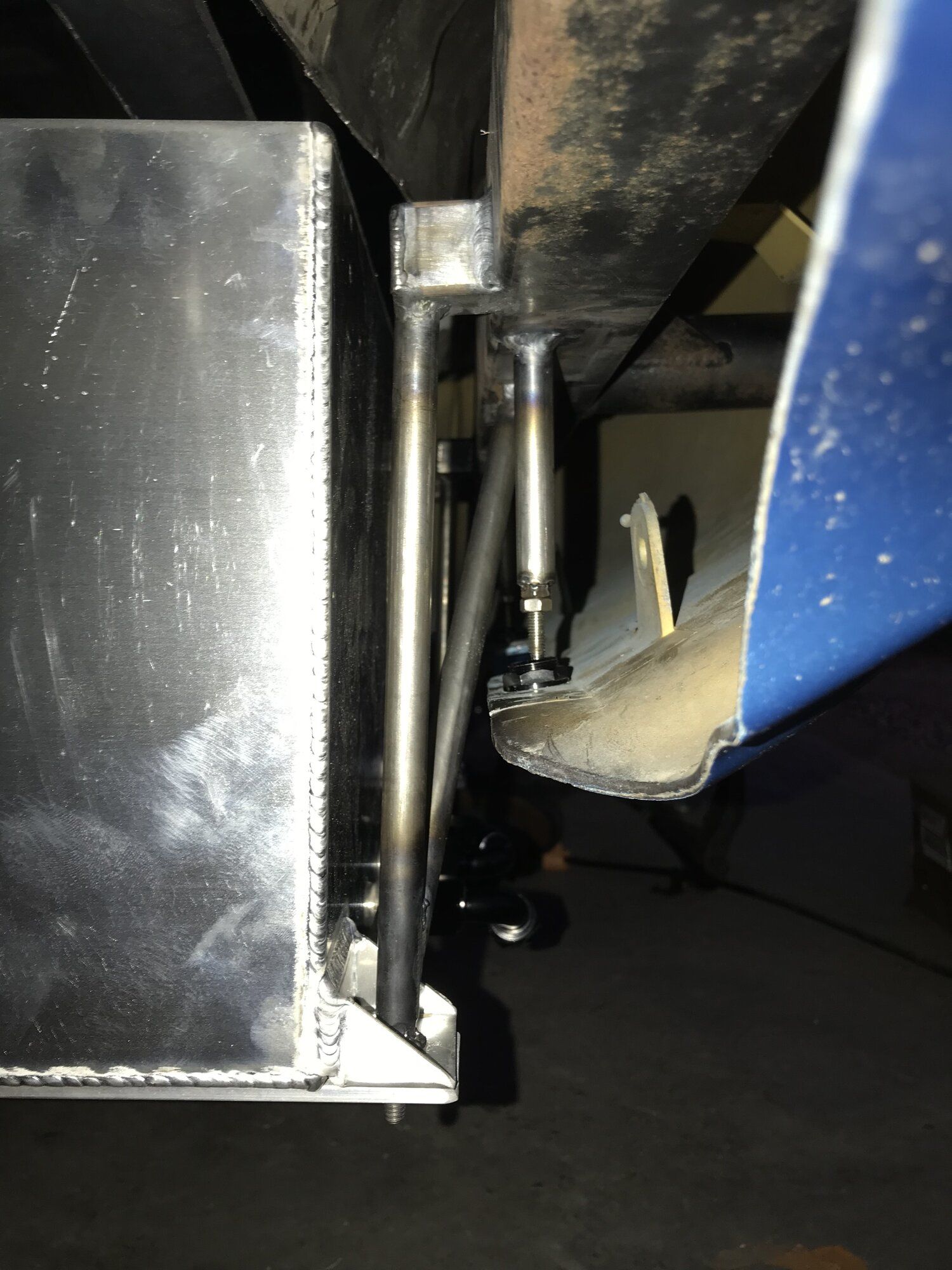

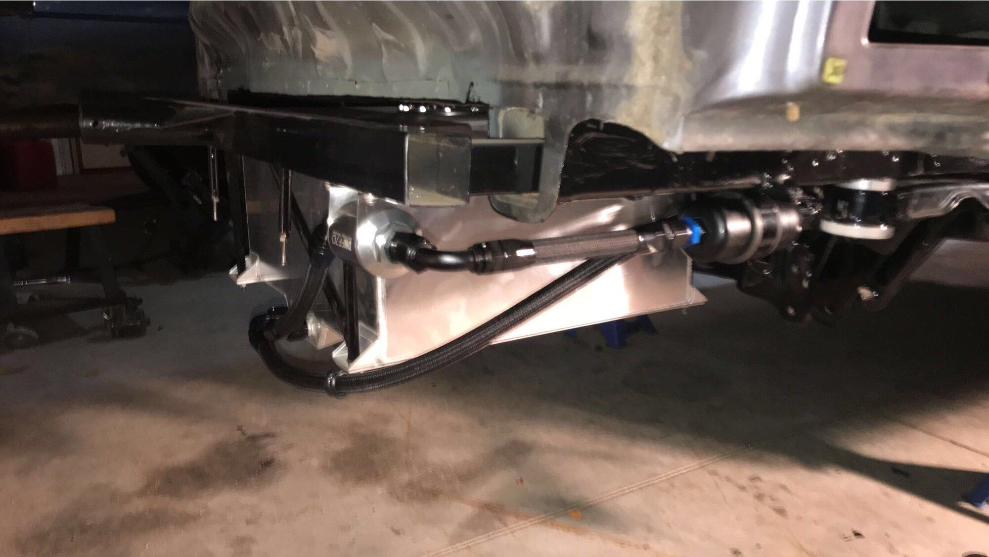

Got the fuel cell mounted with some left over chromoly. Ordered an AEM inline pump to run for my primer pump to the mechanical, also ordered all lines and fittings to get it plumbed to firewall.

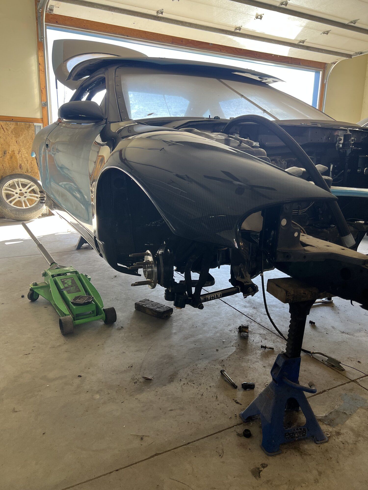

Turned my attention back to my green 2g that I was doing rust repair on the passenger rocker. Going to be finishing that up this week.

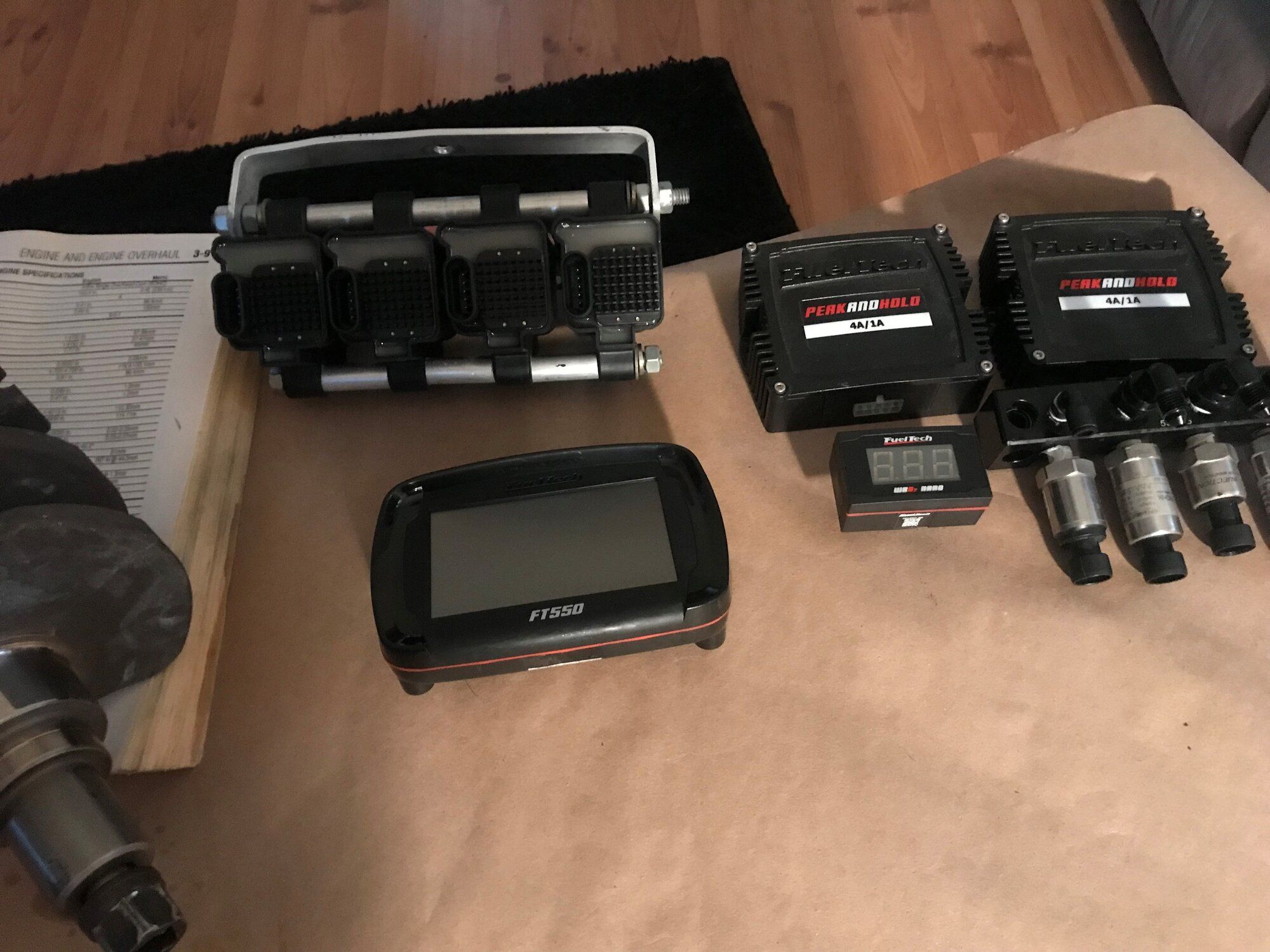

PARTS RECIEVED
-FT550
-2x Injector drivers
-FT nano w/sensor
-Holly sensor Block with x4 PT
-1GN1A Coils
-Volk front and rear LCA
-Volk K-member bushings
-Volk trailing arms
-AEM 400 with bracket and shit ton of AN fittings, Line, Clamps ect
The fuel cell is mounted so next step would be get it plumbed. So I will be working on K-member bushings and more than likely creating clearance for the 10an feed (previous owner already did some). The electric pump is going to prime my mechanical which will feed 8 injectors. Thats the plan atleast. I will more than likely end up wiring this my self as I find that relaxing.

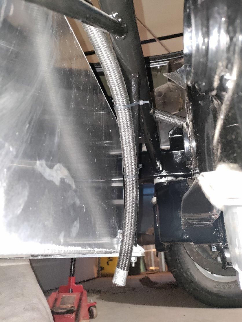

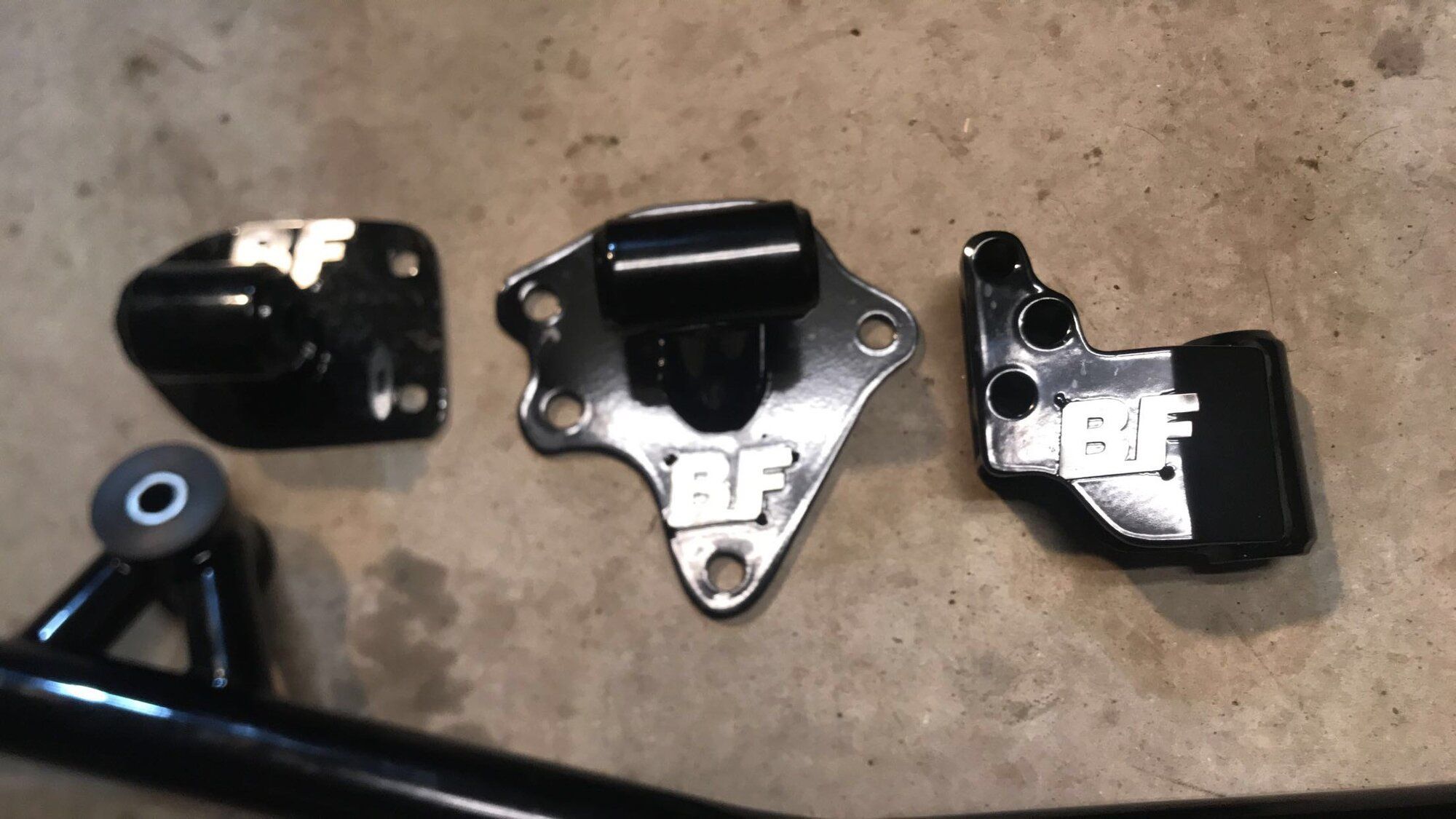

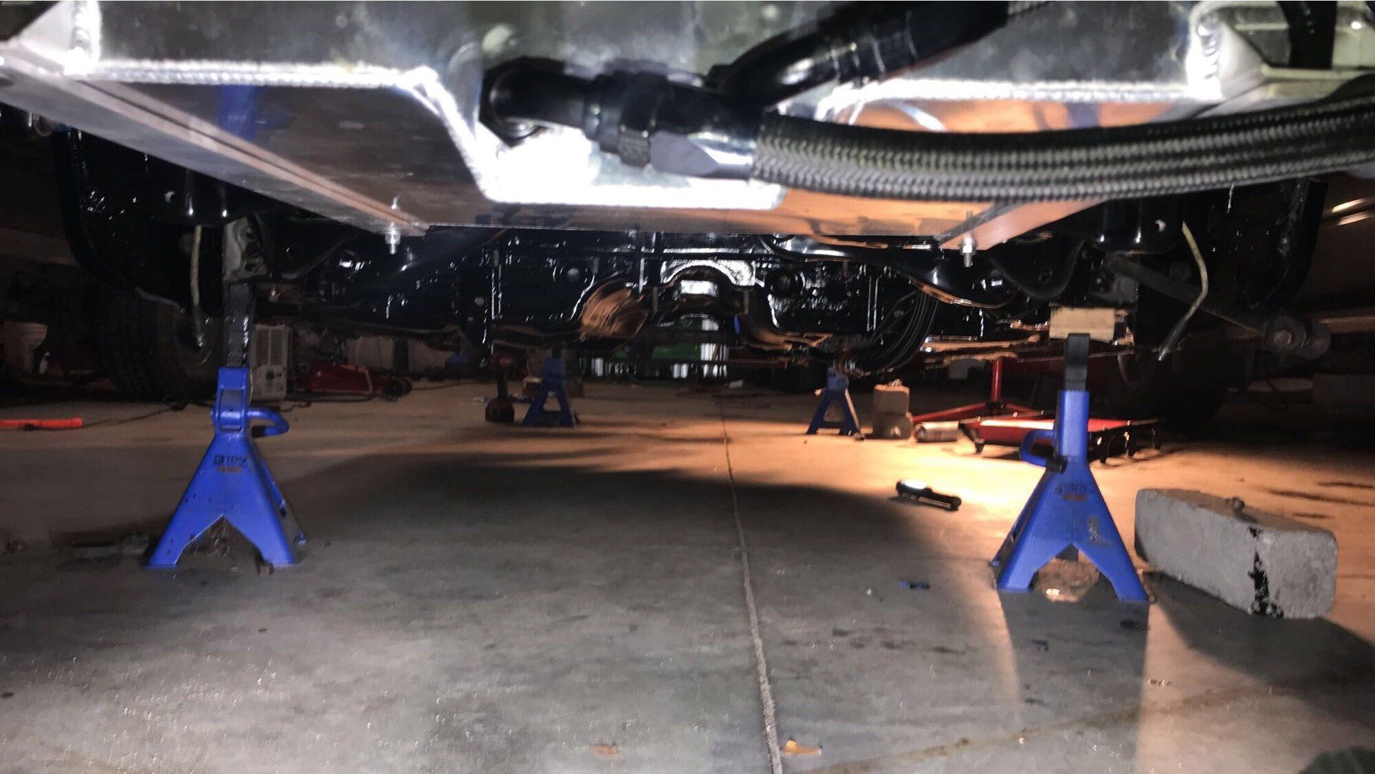

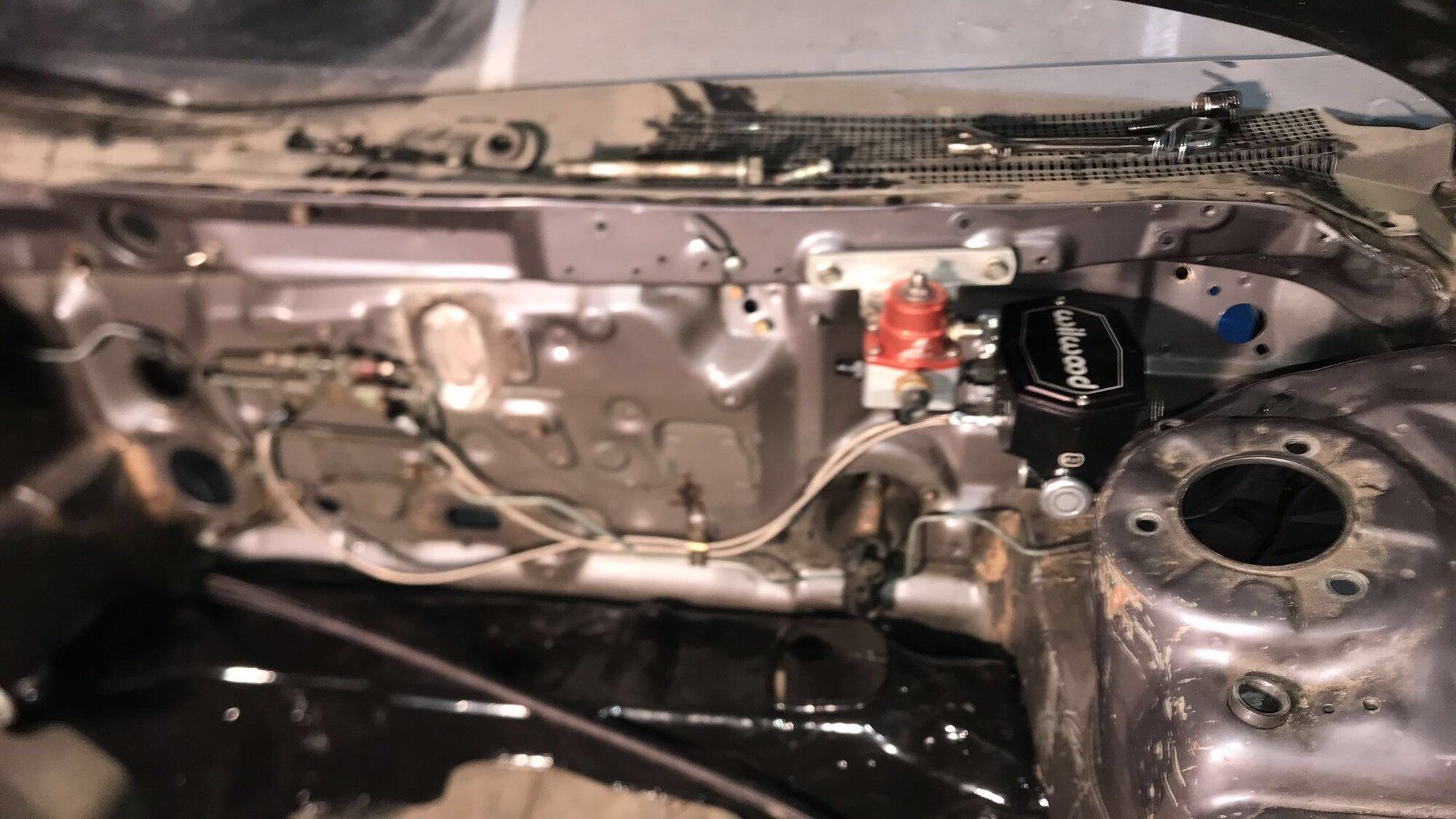

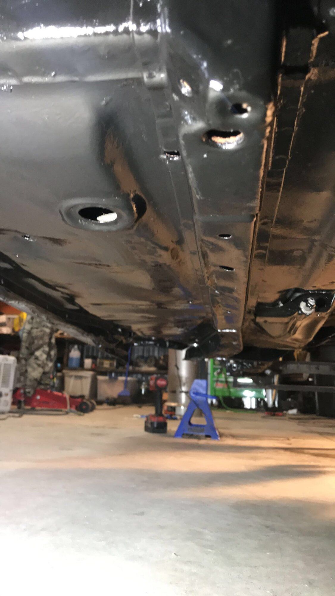

Painted the under carriage along with the wheel wells. Three coats of POR15 and two of the top coat. I routed the fuel feed up to the firewall, still going to have to figure out the vent and return. I cant just put a 180 fitting on there as it hits the cell. Also got the brake master cylinder mounted up, its 7/8 bore tandem reservoir. Still waiting on the engine mount set to get here from boosted fabrication. Once that gets here mocking up an engine and transmission to tube the front end. Will be buying a treadstone core to fabricate and intercooler. Also I'm looking to put a xona 105 (super 99) on this (if anyone has one laying around). Hopefully I will get the Oil pump I ordered from Frontline Fabrication in February of 2021 soon so I can get the motor together for this summer. Here's some shitty pictures because my phone sucks.

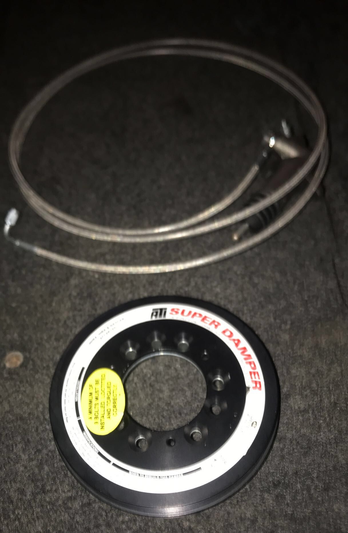

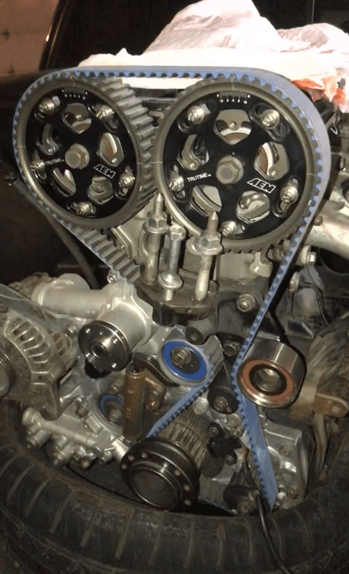

Solid Mounts, cross member, Fuel pump, slave cylinder + SS line and clutch pedal came in. Also picked up a 98 split thrust long block locally for a very good deal.... at least I think it was.
Eagle Crank
Eagle Rods
Wiseco 1400HD 9:1
Felpro MLS HG
ARP L19 Head studs
Frerra Valves
BC springs and retainers
Comp cams 272's camshafts
ATI Dampener
AEM Cam Gears
Timing Belt was put on by Chris from B&M Performance in Mankato
Definitely not going into the blue car. Going to take the oil pan off see what it looks like. I probably should inspect the mains and rods? The only dislikes I have are the MLS and BC parts. This will be going in my 2g green car that I have had since I was 16. One thing that was unique is it has a 20an bung on the inspection plug on front housing. Way to large to run to a catch can, wonder what the point of that was.

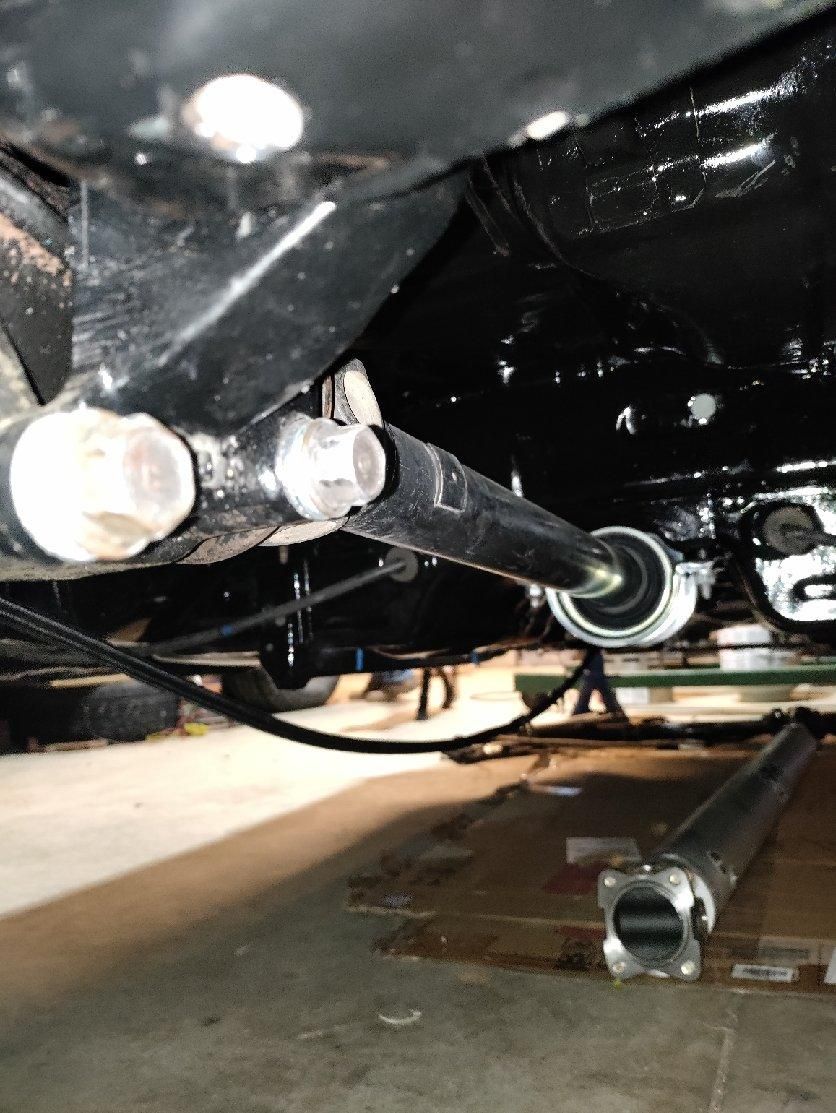

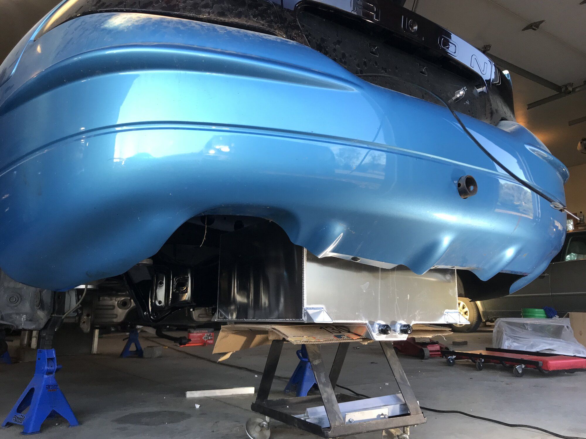

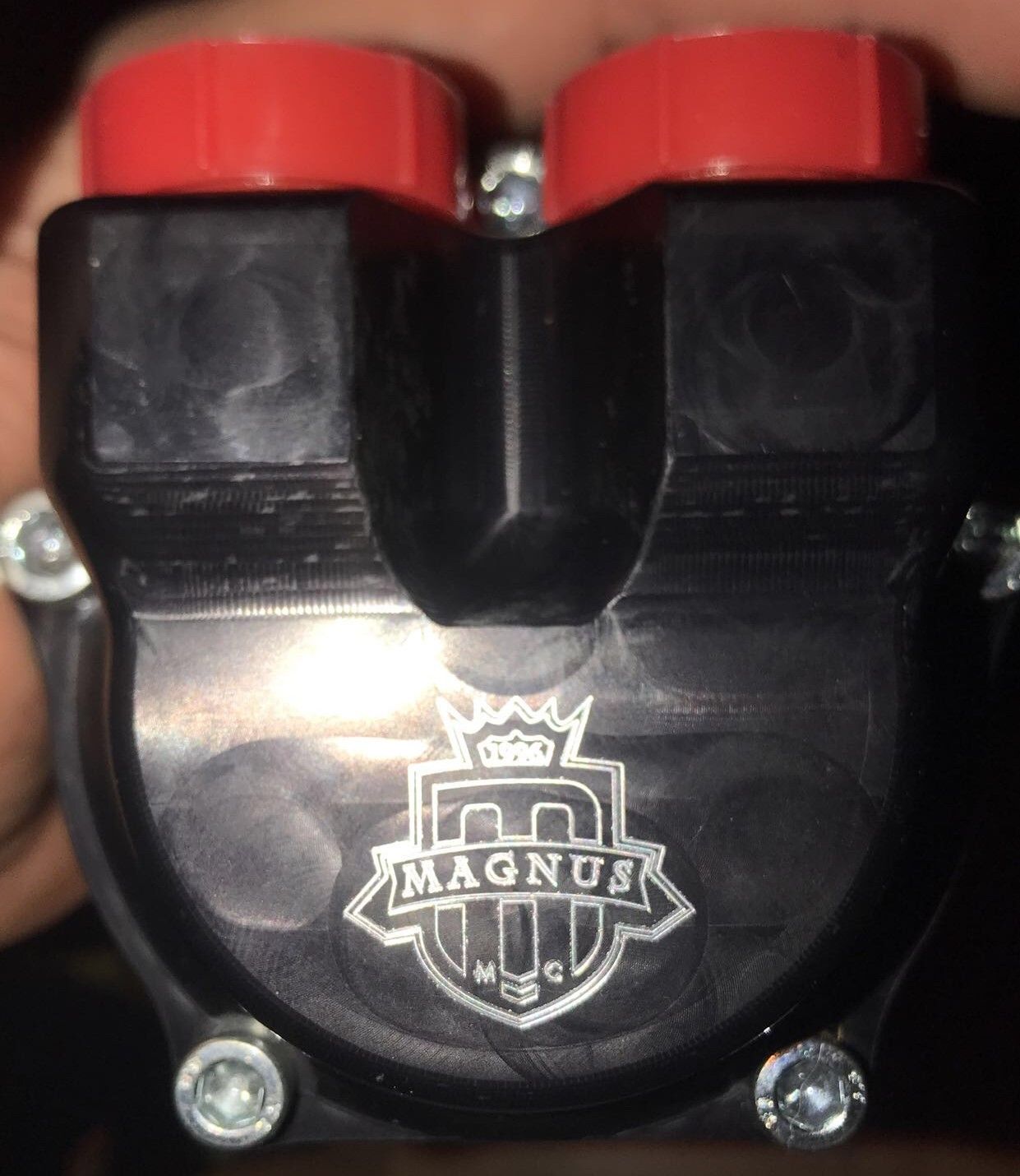

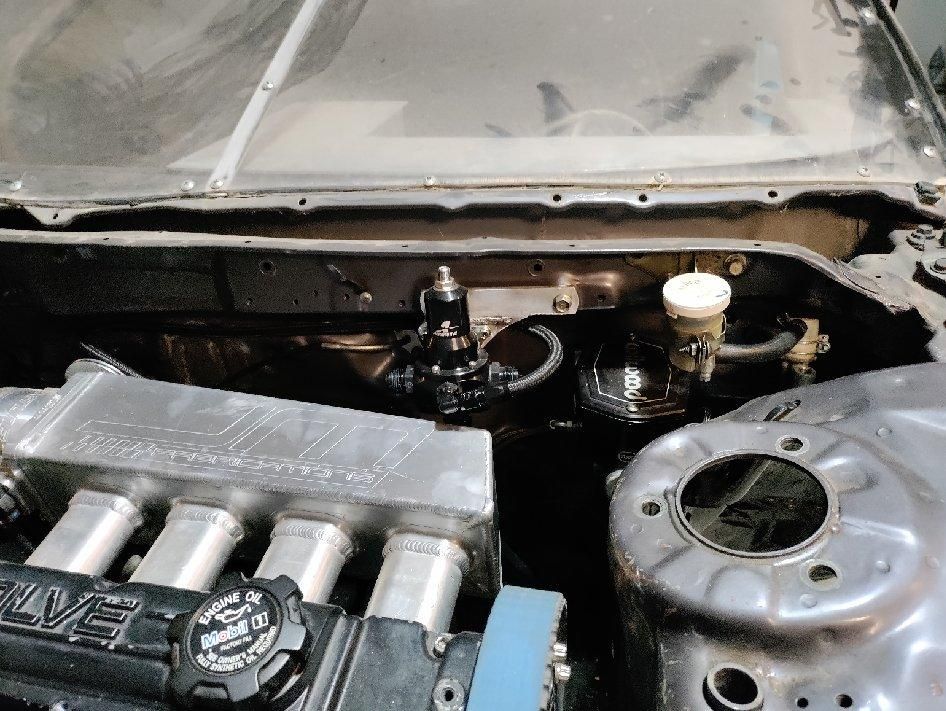

Fuel pressure regulator came in, torched a bracket out of some aluminum I had laying around. Also finished the hatch cover for the cell. Bent by hand using relief cuts on .08 aluminum, gets the job done for clearance . Rear drive shaft is mounted, I need to double check that I installed the bushings correctly, looking at it now seems like its got some angle.
My one question for the day, How do you guys do your fuel cell vent? Currently just a -10an 120° zip tied below the cell. I have read about roll over valves in NHRA rule book. If anyone can spoon feed me it would not go unappreciated.

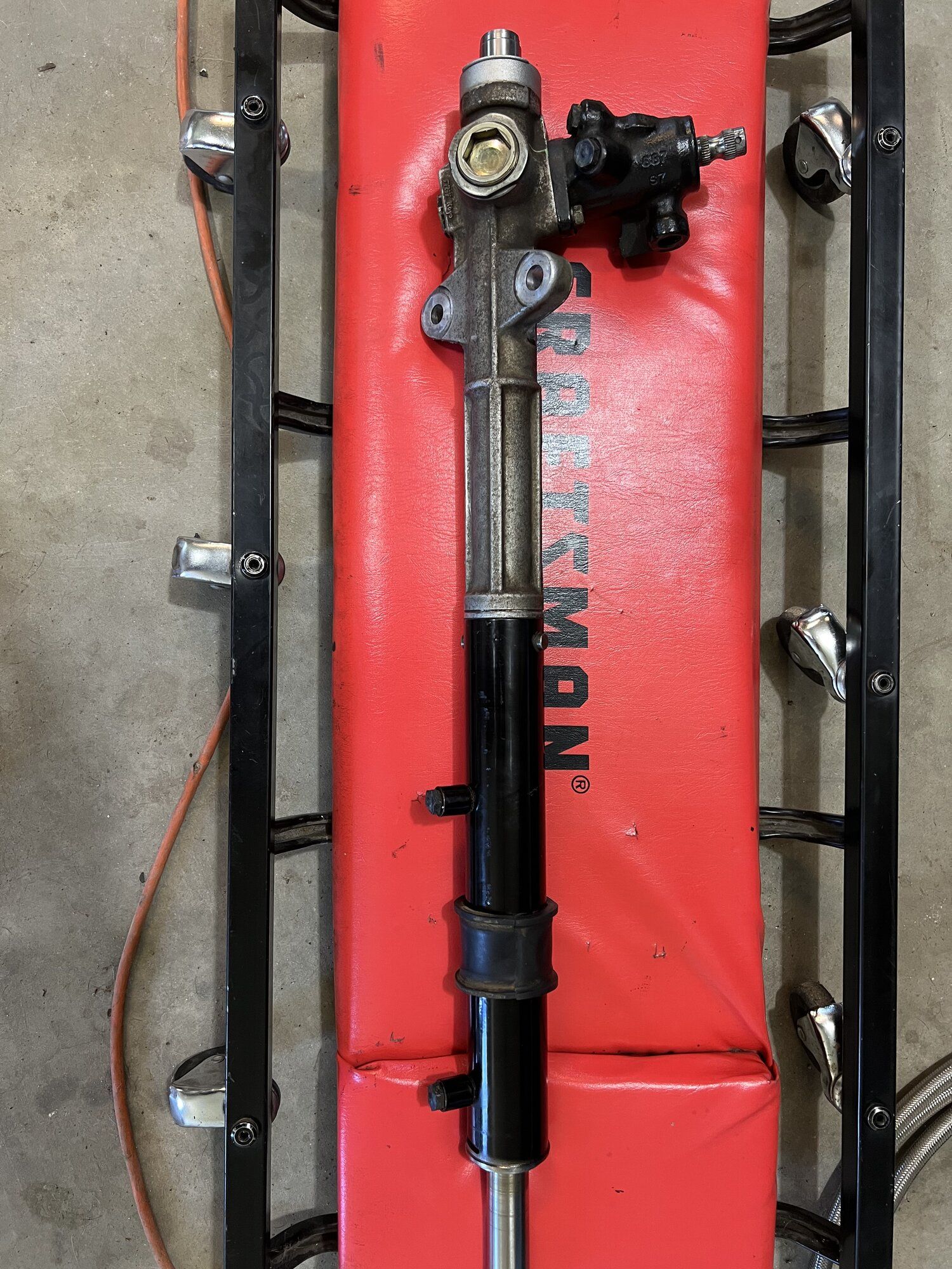

Converted the steering rack to manual, gonna order a set of moog inner and outter rods for it and call it good.

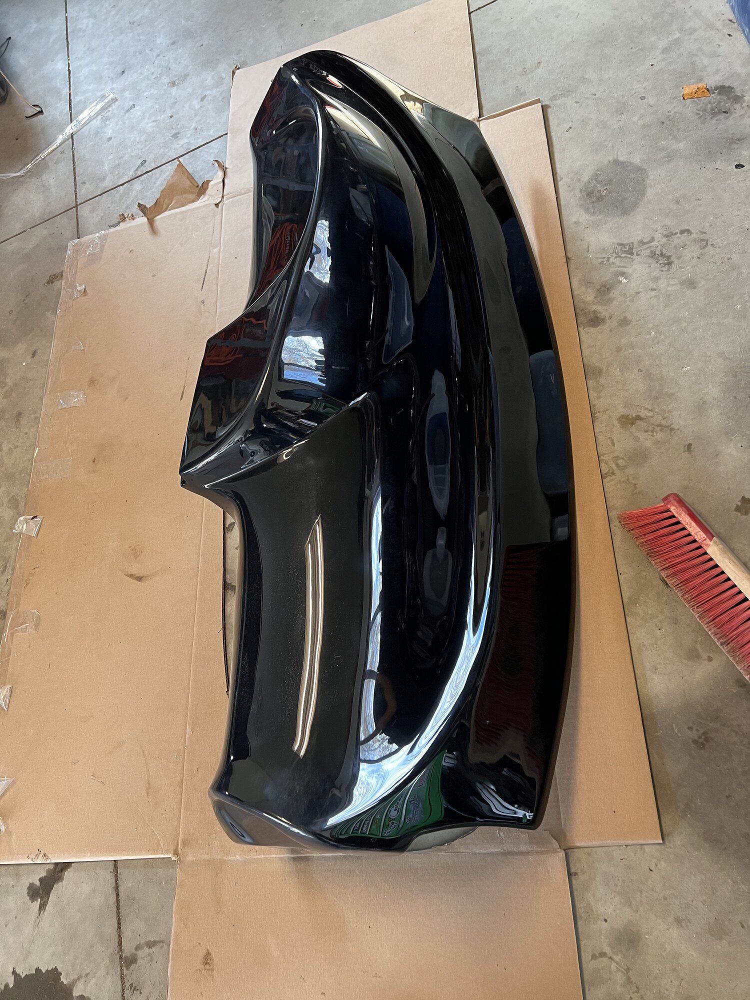

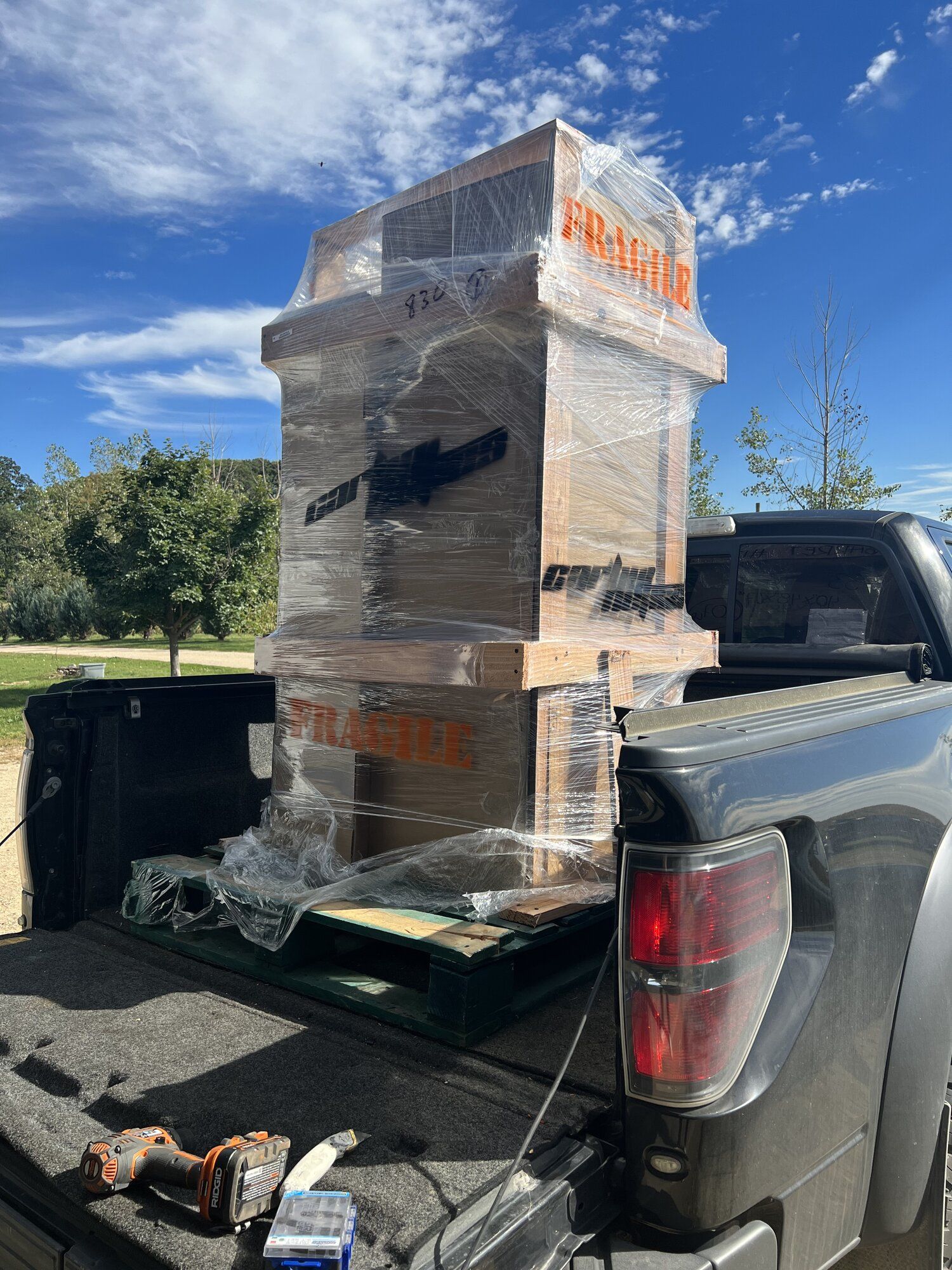

Also got some AR carbon fenders and a fiberglass race dash. Hopefully going to start cutting the dash up and get it mounted with some quick latches this weekend. After I get the dash in I will paint the inside a matte black and will color match the cage. I was also told by andrew that he has my oil pump done just working on the remote regulator.
