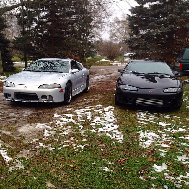

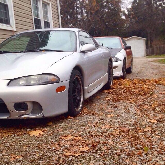

Also some pictures I almost forgot! Trust me you don't want to see the back:nono::cry:
