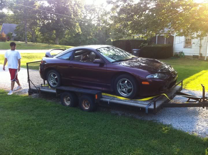

Just recently my old friend called me up and asked if I still wanted a project. He told me its yours if you give me $800. Well of course I jumped on it.
pics of it:

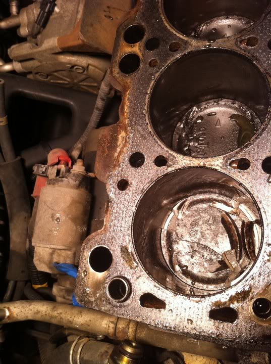

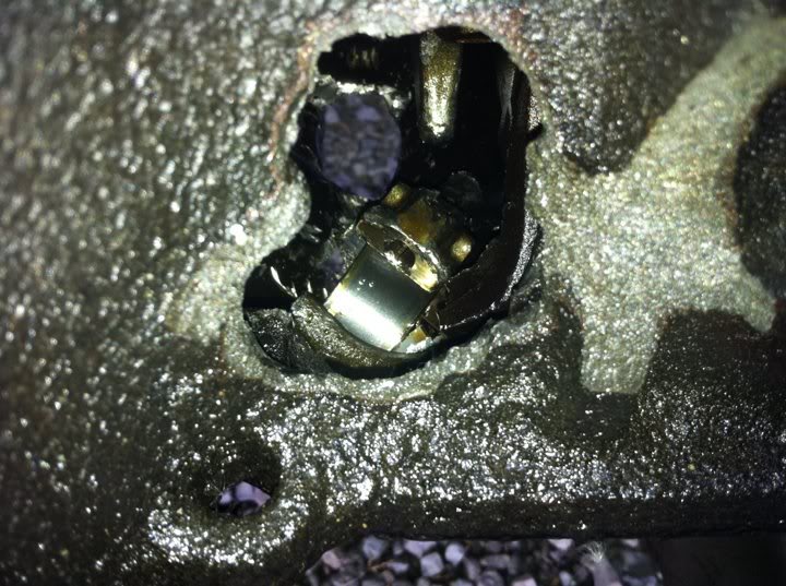

Well theres a little problem with it. He blew a rod through the block by "cruising" he said...

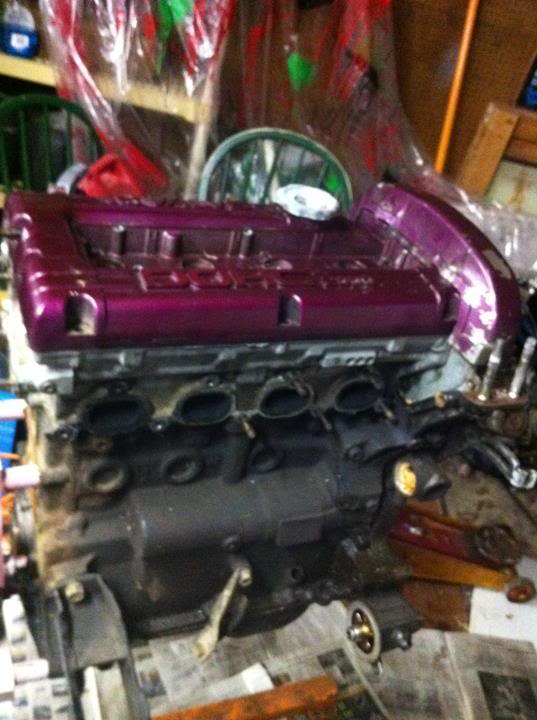

Well I've always planned on doing a 6 bolt swap in my car.
She just wants to get hers running.
Heres the plan, I'm going to build a 6 bolt for my car and then put my great running 7 bolt in her gst.
I'll keep this updated as I go with the build!

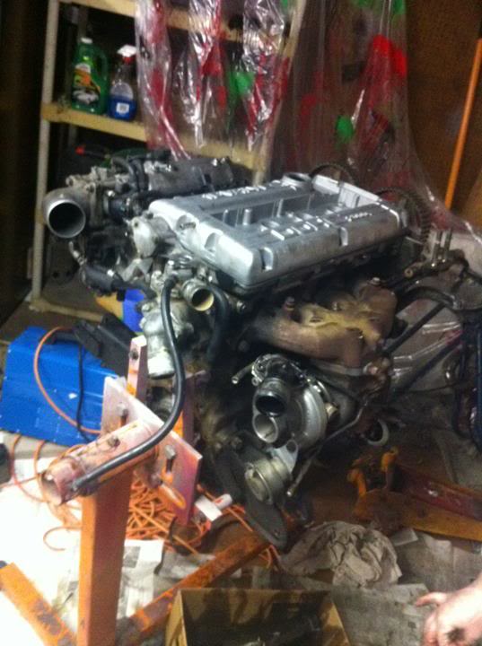

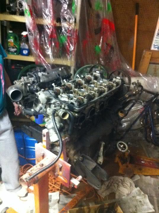

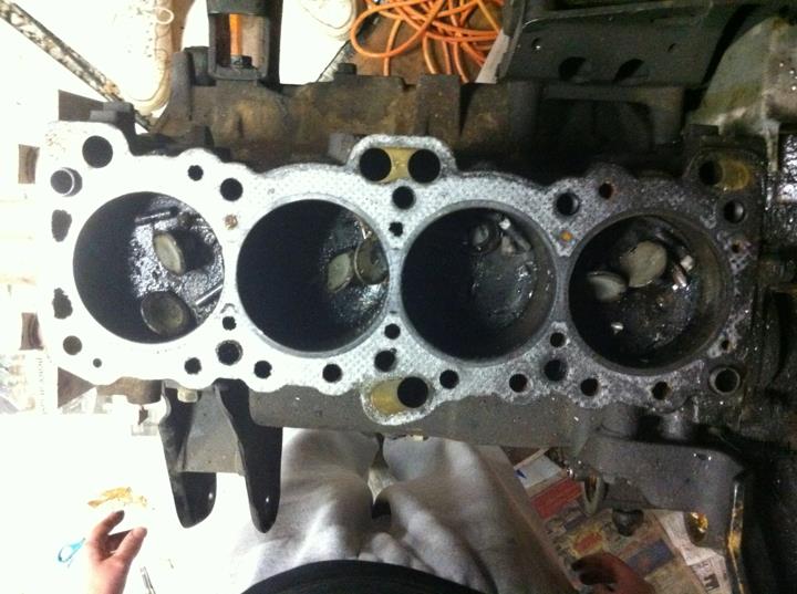

Just picked up a 6 bolt for 80 bucks. Im positive its non turbo but for 80 bucks, you cant beat it.
The guy I bought it off of said it was "locked up". He said it would barely turn.
Well I pulled the head off and found out it wasnt "locked up"
Theres other problems.
Crank and block are in great condition. I'm going to use 1g Rods with 2g pistons. I have a spare 7 bolt head that I'm going to use on it. I'll have more pics up when I get back home and working on it.

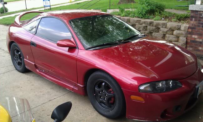

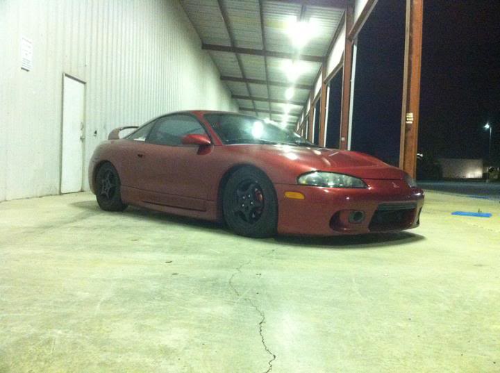

haha our cars are almost exact twins.. not trying to jack but check it

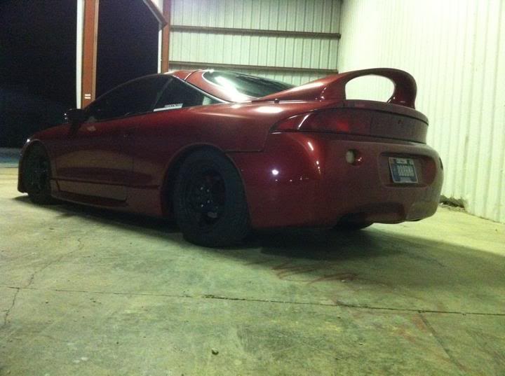

The one with the black wheels how much drop and what did u use to get it thier?
I'd say around 2" drop, maybe more. It looks alot lower in person. It's lowered on eBay coilover sleeves. It rides awesome in the front. The rear is pretty stiff. The only reason why I put them on is because I got them for free and a had a extra set of struts. I was pretty surprised when I put them on. It wasn't bouncy but it was firm. My struts are blown now. The ride quality got worse but it's not bad unless your on a horrible road. Would I ever put eBay sleeves on a Dsm again? Never again. Do it once, do it right. I'm going for Megan full coilovers set in the spring.
