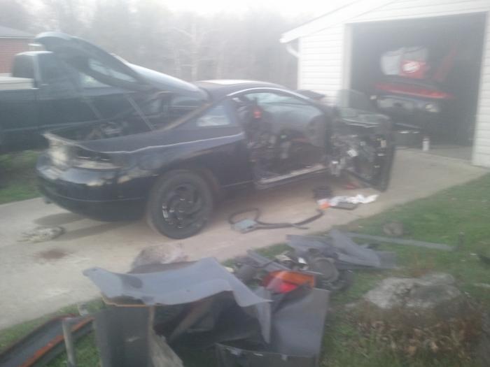

Well I got my parts car in front of the grage over the weekendand start to tear it apart. It is being striped down every nut bolt and clip. I will be slaving alot of stuff off of her for other dsmers. Some of the stuff I will be modifing for my car. Just so you u know i think she had a hard life and her engine and trans was already gone when I got her.

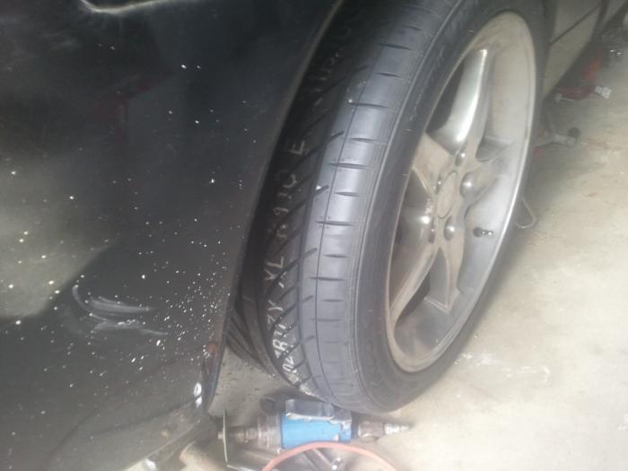

In the process of finding lugnuts. I ran into a old friend that is giving me the hook up.1 gen scion tc wheels are painted a hyper silver sorta like a gunmetal. The wheels that I have are a polished alum. If u have ever polished a wheel u know that up keep is a pain so im going painted.
Um sorry but i dont think they will work on your car.
correct me if im wrong but Tc wheels are 5x100, and DSM wheels are 5x114?? Good luck tho

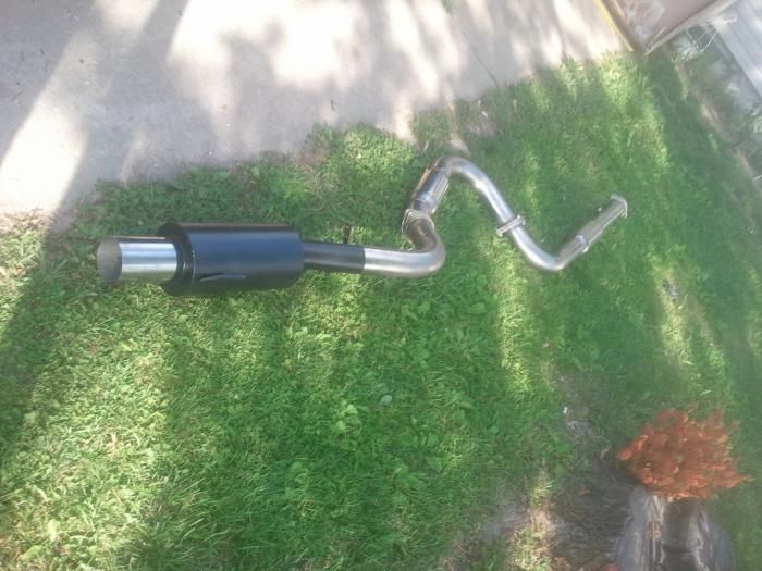

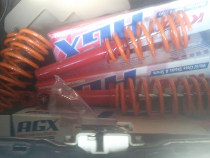

Well I managed to get some more parts. A 3 inch cat back,agx for the 4 corners with ksport springs. New sway bars 19m rear,21 mm front. Rear hub and bearings. Rear pads and rotors. Need new rear hoses and the back will be done. Went with hancook evo tires 245/40/17 for the mustang wheels. Still have a tone of parts to buy!
