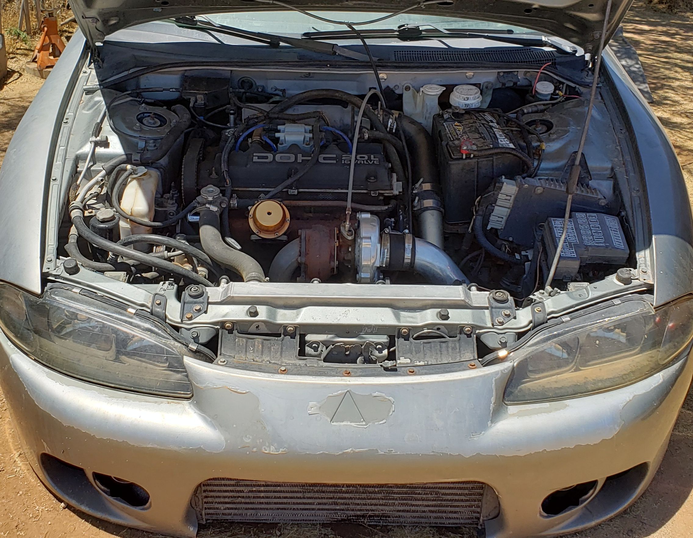

So I've had this 99GS eclipse for a little while started going through the car found everything that was done wrong now I have a huge electrical problem I turn my key the engine will crank but I get no power to my instrument cluster I have no power to the radio door lock's or windows but headlights brake lights tail lights all work I have no idea what's going on I thought it might be the car's ECU/PCM or maybe a relay I tried to find help online going to random places then I realized the only place to get help is from people who know these cars the car is stock with a 420A engine 5speed tranz but modified with a Turbo and a walbro 450 fuel pump all I'm trying to do is sort out my electric problem get the car running again and continue dissecting the build
So if you have any hints on what to do diagram schematics relay locations what relays control instrument Cluster Or any of these You'd be doing me a huge solid
