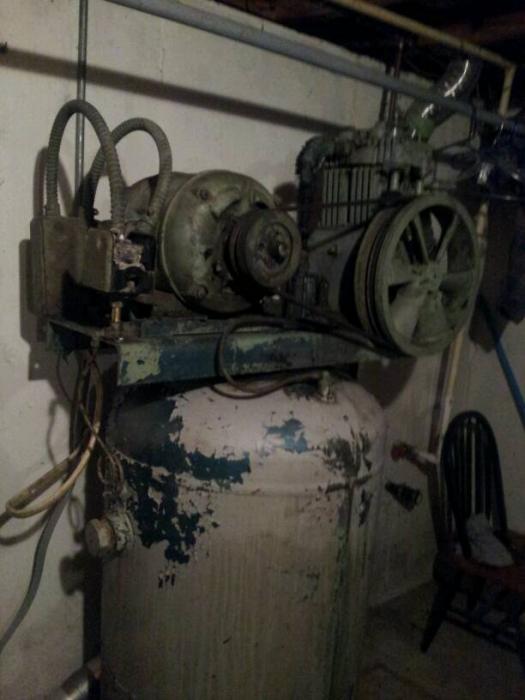

Picked this up off of crags list . It a very old quincy air compressor . Its a 80 gallon unit with a 175 psi ,single phase ,and 2 stage pump. I went thru it roughly and cleaned it and the changed oil . The only hard part that it needed was a diaphram . Its up and running like a champ. After confirming that it all worked broke it back down and put it down in the basement which was a pain. Now i have air that i need and piece a quite .

Hi there, I just pick up a compressor similar to yours it is a campbell housfeld, glad to hear you are coming along, I needed more air than my other unit was giving me this has an 85 tank, 5 HP motor.
You mentioned replacing the diaphram, 2 things, you need a guard around the pulleys, you know they can chew up hoses, extension cords etc, I can not see it since it may be the box in the back but your motor probably draws 25 amps, if that is the case you also need an electromagnet box to start an stop, besides your pressurestat, this is to protect your motor and pressurestat, it is not needed in the smaller units that dont draw as many amps.
They are not cheap, you can run it just off the stat for a while but it is not advisable as the stats will not last long.
Best of luck on your build.
Mandy
Its actually up and running. Its down in the basement and the garage is upper floor. It is now hard lined and the wiring is 220 which is on the back side. The motor is a 3 1/2 hp with a Max rpm of 3,400 . No mag start needed. This is very old tech built to last. This is a 1930s to 1940s era compresor. As far as the belt guard is concerned I'm not worried, its not in a well traveled area of the house.
Good to hear that, mine is a 1999, it is really nice to have air, remember your air filter and pressure regulator for different tools, I also have about 100 ft of aluminum lines, with the outlets and connectors, best to you in these holidays.
