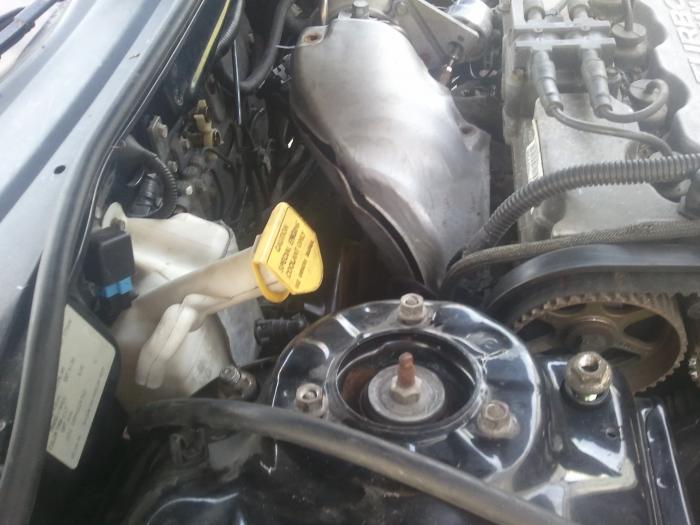

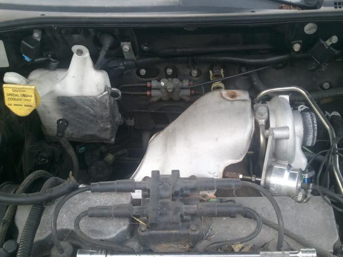

Maybe i need a better pic for that area will post when i get to work. Thier is like a 4 to 5 inch gap between the firewall and the turbo. Thies only like a half inch gap between the intake and the rad, sorta like neon.

If u notice thier is a overflow bottle on fire wall its from the neon. Its using a left over hole from the 420 a cruise control. With that on the fire wall and power stearing pump being more compact, the only thing on the right apron will be a/c stuff and a engine tork mount.

Dude, this is pretty cool, but I too would be a little worried about the heat that the turbo manifold will be producing that close to the fire wall and all the things on it!
You have Brake line right there and I'm sure you don't want those getting to hot and the line that run to you heater core(good thing about THIS is during winter you heater will work exceptionally well :thumb: haha) if you don't melt them.
And some other wires I see on the fire wall I would try to protect more!
I'm not saying this to be negative at all, because i'm not even sure how hot it may get. I would just be caution and protect the valuables anyways to INSURE nothing would go wrong! :D
I would like to see this thing work also, just hope you get it all worked out to your best benefit. Good luck and keep us updated!
Ok heres something to think about, and im not being a smart ass. U have the exugst manifold then the turbo then u have 2 ruber hoses conecting inlet and outlet piping. And if ## looking at the pick the turbo is farthest from the engine. Im not saying that it wont be an issue. I guess if its built chech it with a laser temp gun.
If heat is an issue just put some heat mat on the firewall, DEI would probably come through for ya. Alot of turbo models put the turbo up against the firewall, just look into how they combat the heat. Looks like a neat swap, and you've started it with minimal investment so it might not end up being way overpriced. Hope you complete it.
