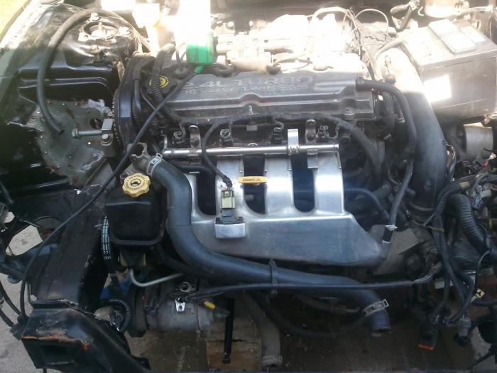

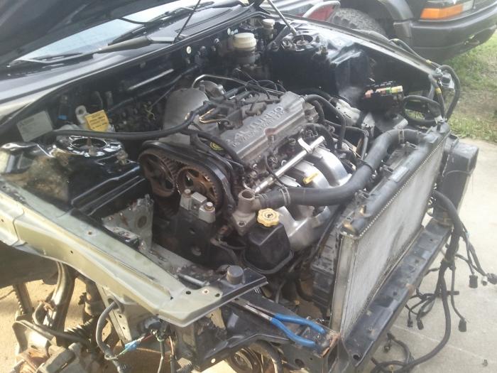

I was up till 11 last night stuffing this pig in. Still have a long way to go. Its siting on blocks till i determine were i want it extally. The hood closes without rubing. The axles are hybirds.Will post more when avail. Im at a family reunion were thiers 3g, at home dial up.heres the rest of my picks till i get home.
Am I the only one who realizes that looks a lot more like the PT Cruiser turbo engine and not the SRT?
Perhaps? I'm not a car fanatic by any means to know what kind of motor comes in any other vehicles other than my own.
Regardless, it's still an improvement over the 420a.
Idk they are both very ugly engines... But I thought it looked different to...I've seen a Srt-4 engine once.
This is a mockup its siting on bricks. The car cost me 125 the srt 300. I figure if i can get it to work ill have my own unique turbo eclipse, if not I will part every thing out and make money. The biggest problem i have now is the main engine mount its gonna be the bigest pain of this project.
