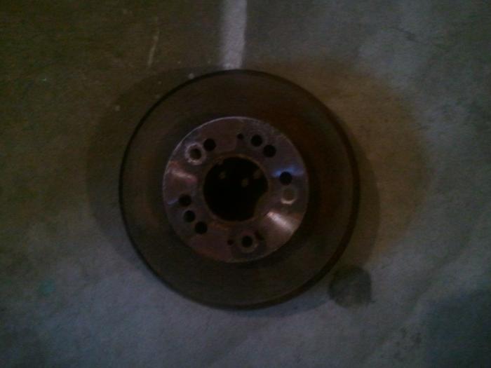

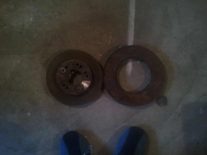

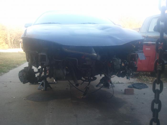

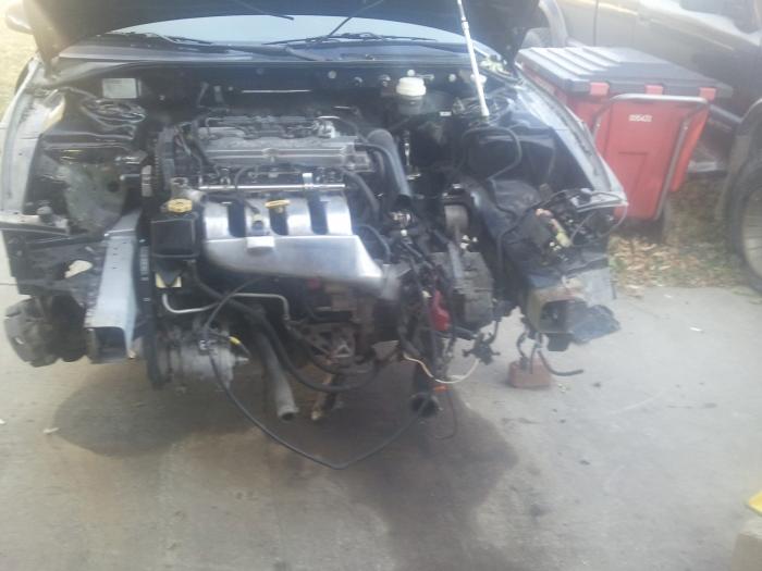

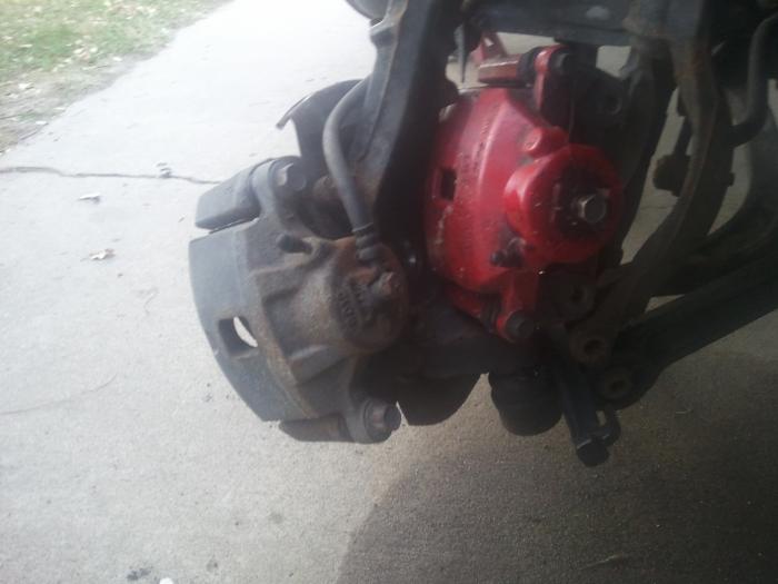

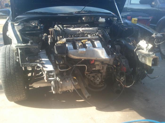

Well the srt engine and trans fit the eclipse 3 out of 4 mounts made. The 4th being the simpler of all but i need more parts, preffably a tubular control arm. No custom hood needed. Now what is left to be done,exhaust,clutch linkage,axels,throtle cable,shifter,a/c lines,power stearing,cooling,fmic,wiring, using the srt harness and guages,fuel pump upgrade,de program the pcm anti theft. Will post further in new picks. The srt brakes are pitifull. The fronts are single piston and look simular to the gs brakes with the rotors being a half bigger and the whell bolt pattern being diffrent, so im not going thier. Gsx front and gst rear looks like to be the best cheap upgrade. When i get done with the above stuff will move onto body and interior.

I think it's a little too early to celebrate, but none the less, congrats on getting this far.
Ditto that, but I'm rooting for it to work smoothly. I give you props for all this work and can't wait to see it in action.

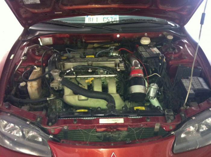

Gs on top of srt.
Thanks for the reality check. But ive got a lot of flack that it wouldnt fit so im kinda on a high. Yes thier still is alot of work to be done. Just take my time keep lots of notes and try to keep my cool. I know that when it pisses me off i just take a brake and go kill somthing on the ps3 or the 360. Had a small break after trying to get the left axel out of the eclipse to find out some one had cross threaded it, so ive gota find a eclipse axel just for the outer cv joint. So far vested 20 bucks in scrap steel, bent lower control arm free, used for the upper torque mount. The bennifit its solid so no play.

Man that is one jacked up pick of mine im gonna have to shoot another. I guess because of the angle of my phone, it makes the left rail reaching for sky ugh it dose not look like that.

Somthing not right the power stearing pump is not right and the upper tork mount is not thier. Leading me to belive that it is a diffrent block with a srt head and componets. But i could be wrong.
wondering if he has a 420A block with a 2.4SRT head...Heard of Neon owners doing this a while back...I know somebody who has the Neon RS with a SRT4 but he has to run megaaquirt for it to run..
