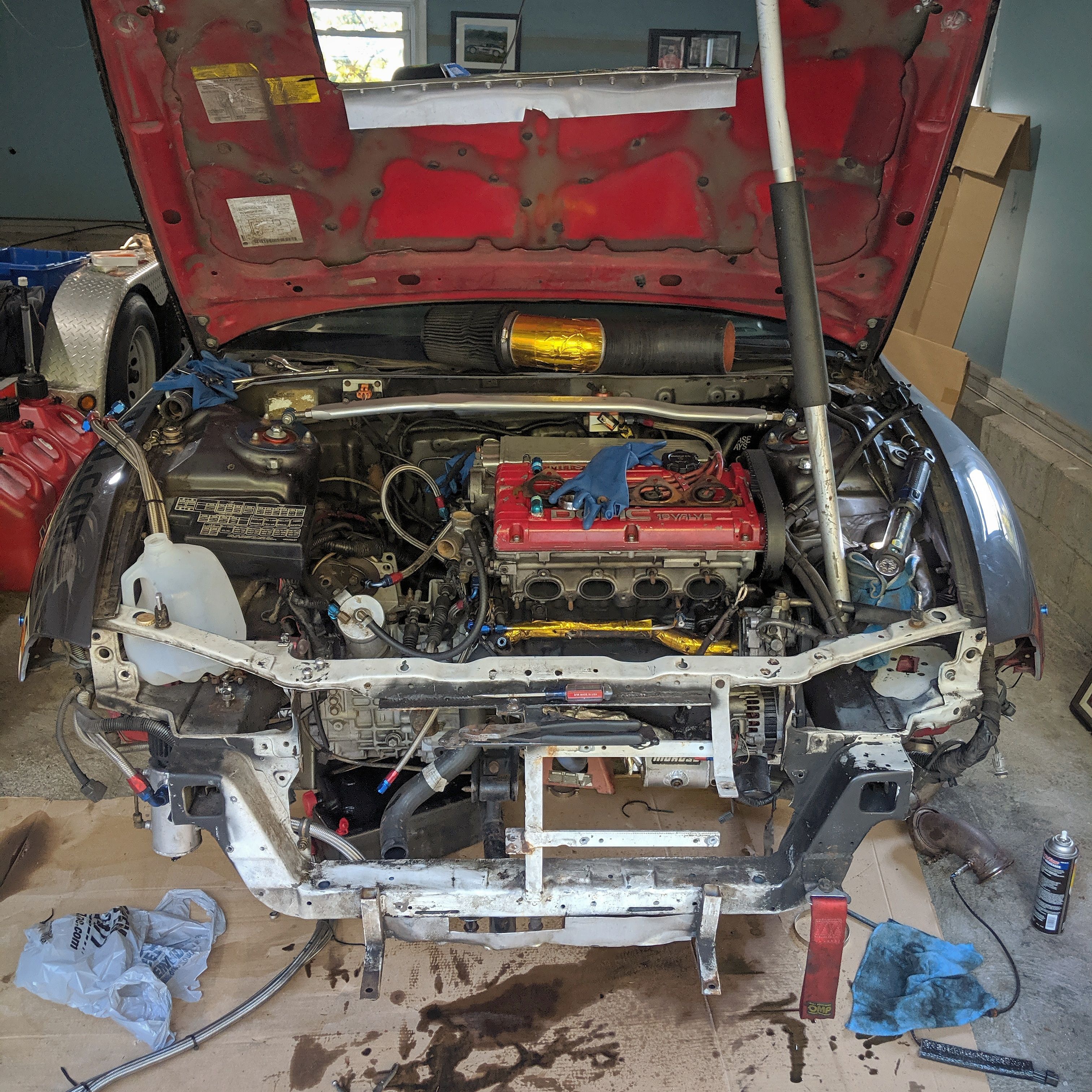

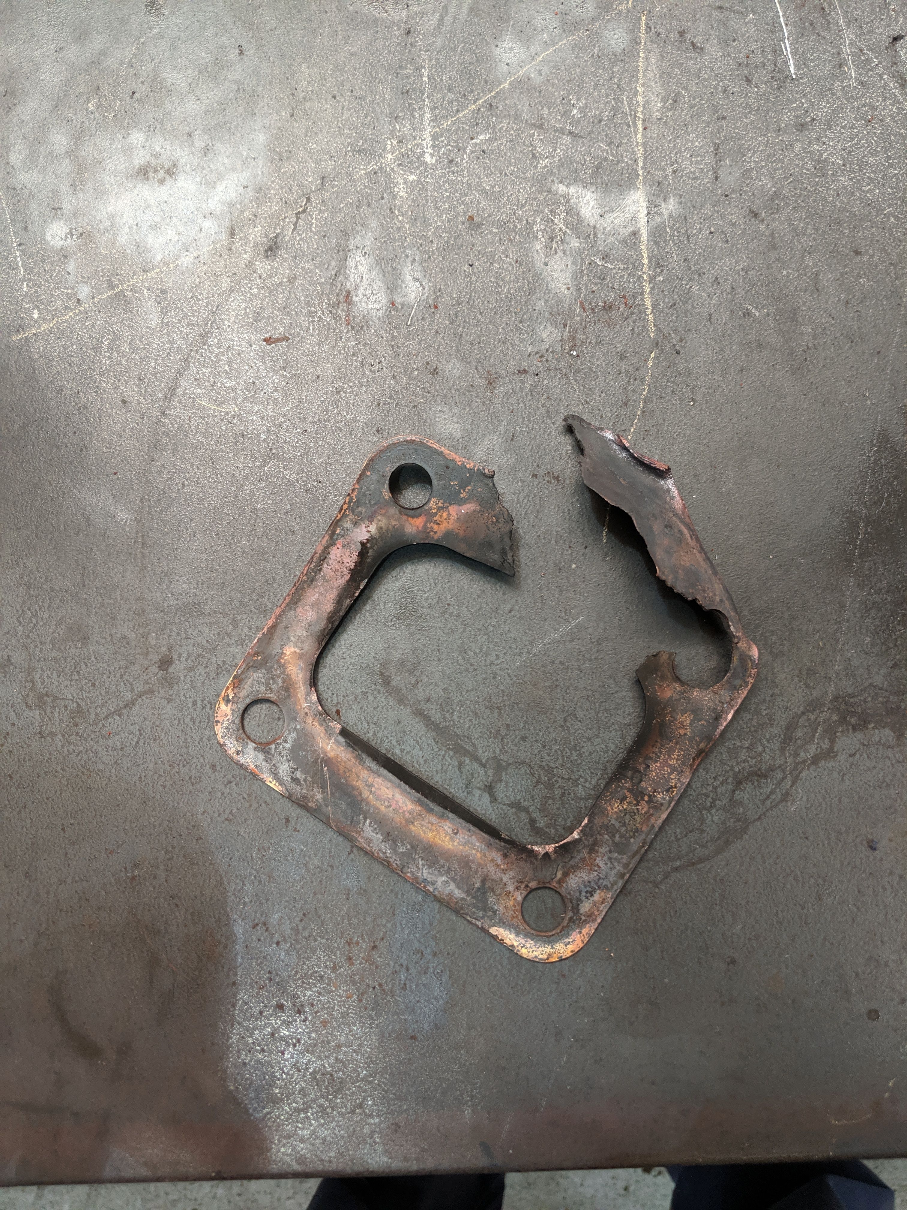

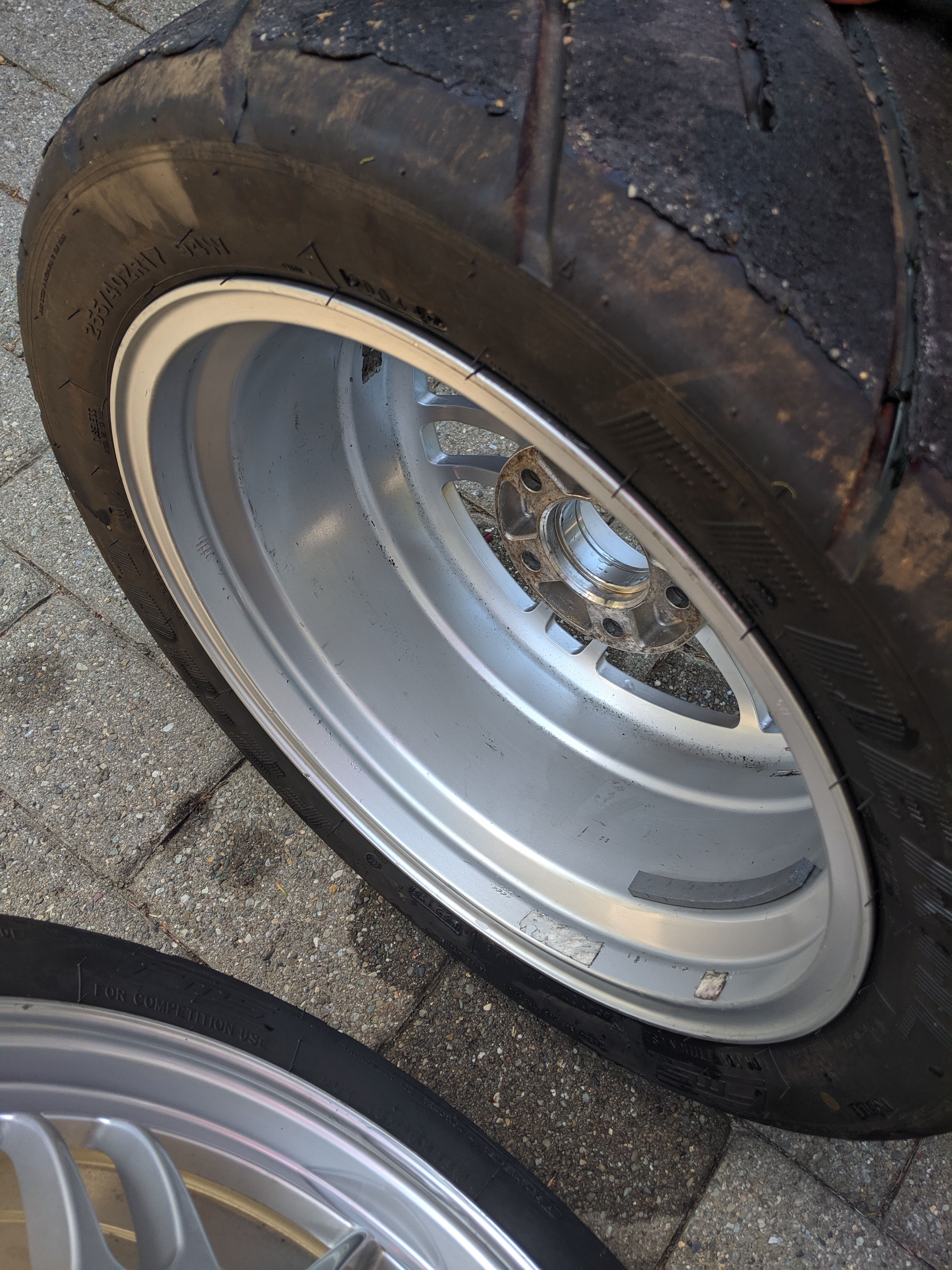

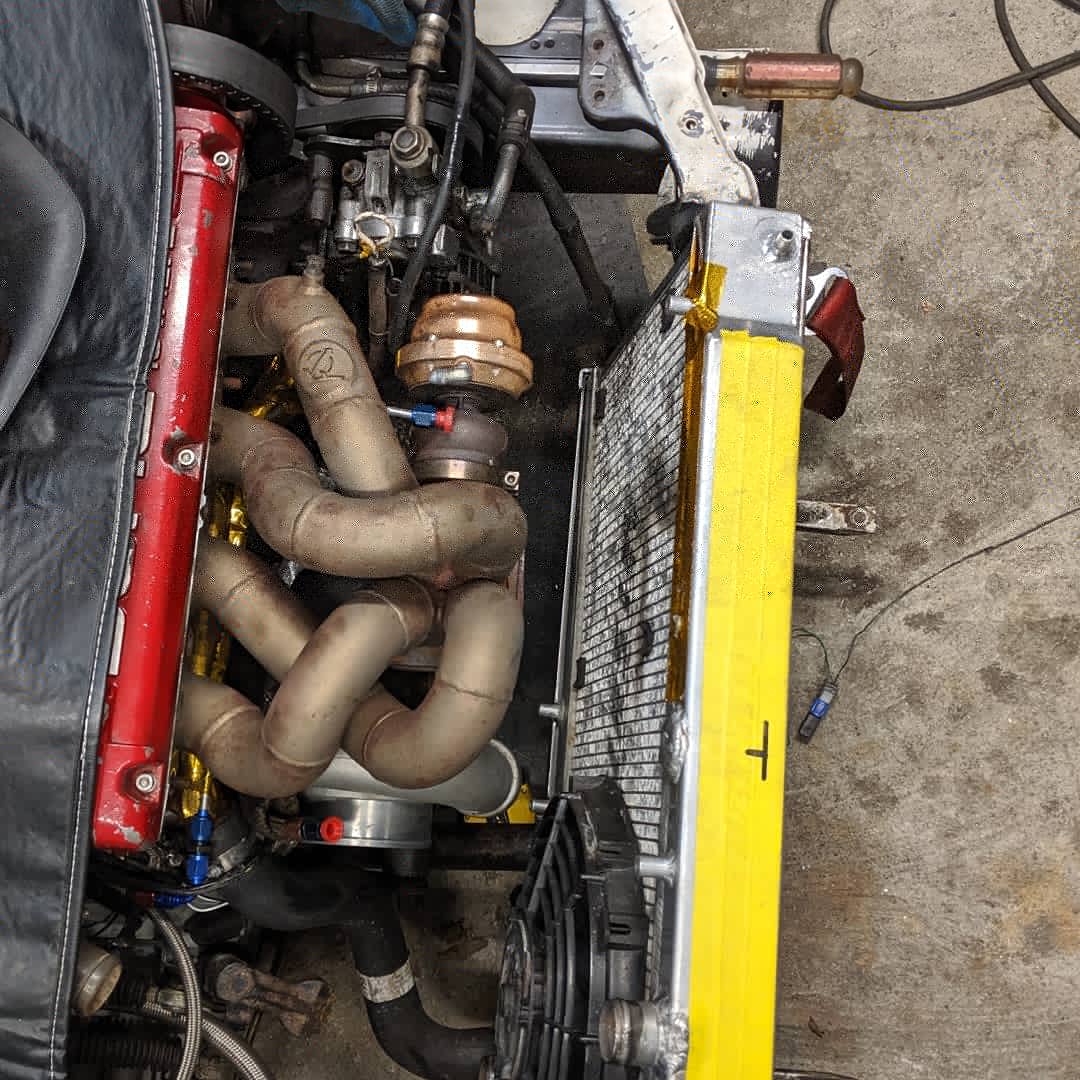

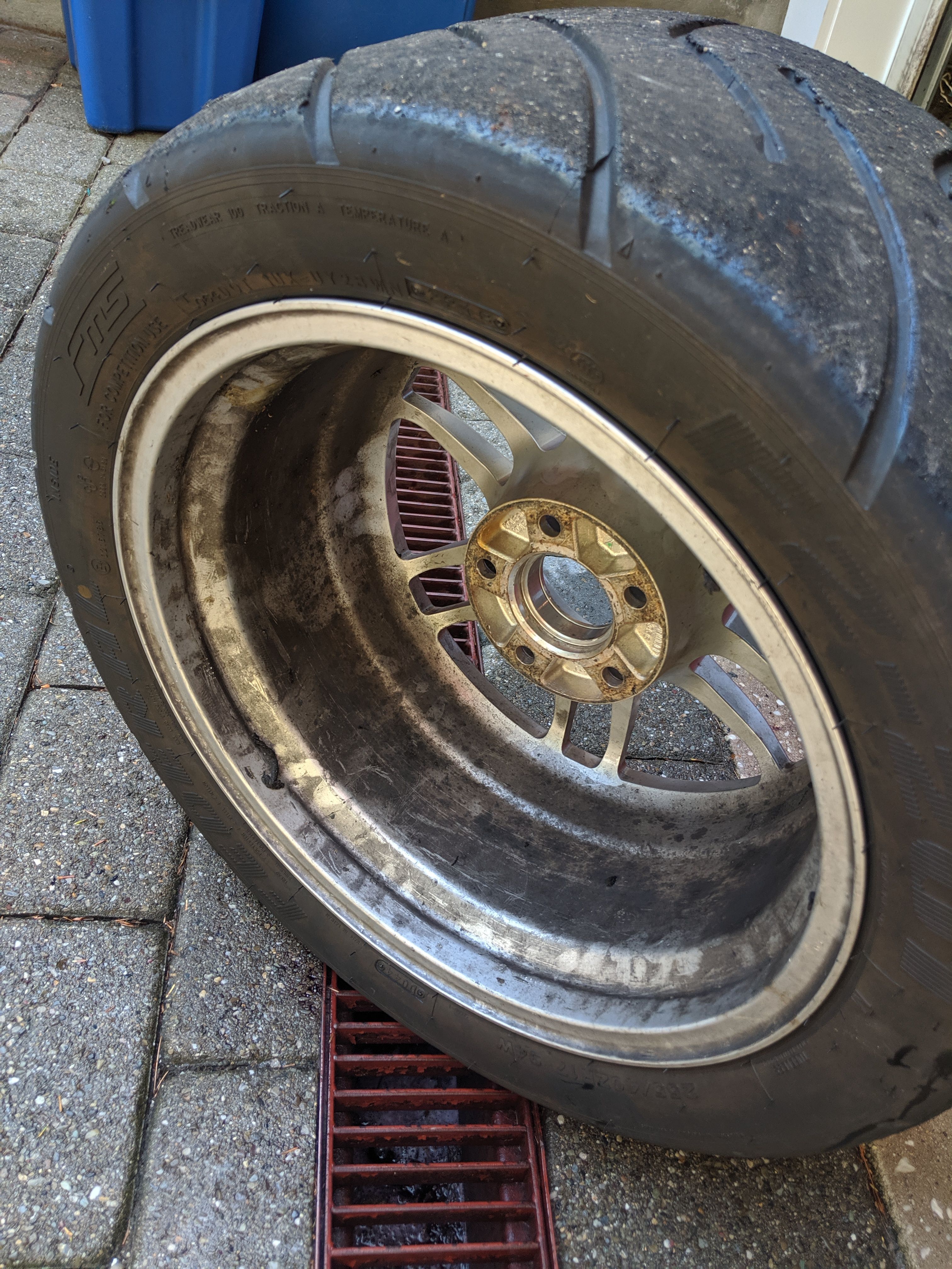

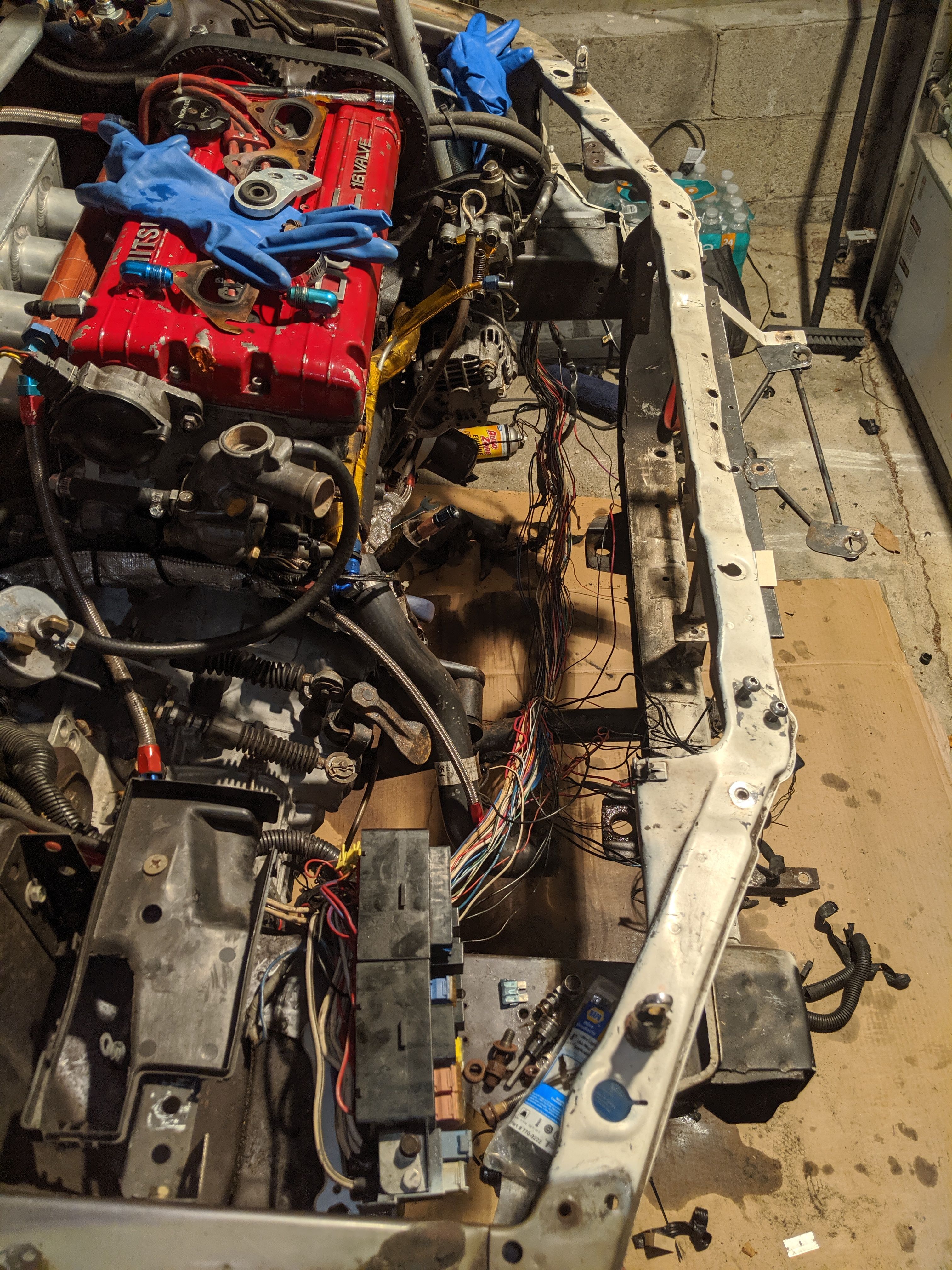

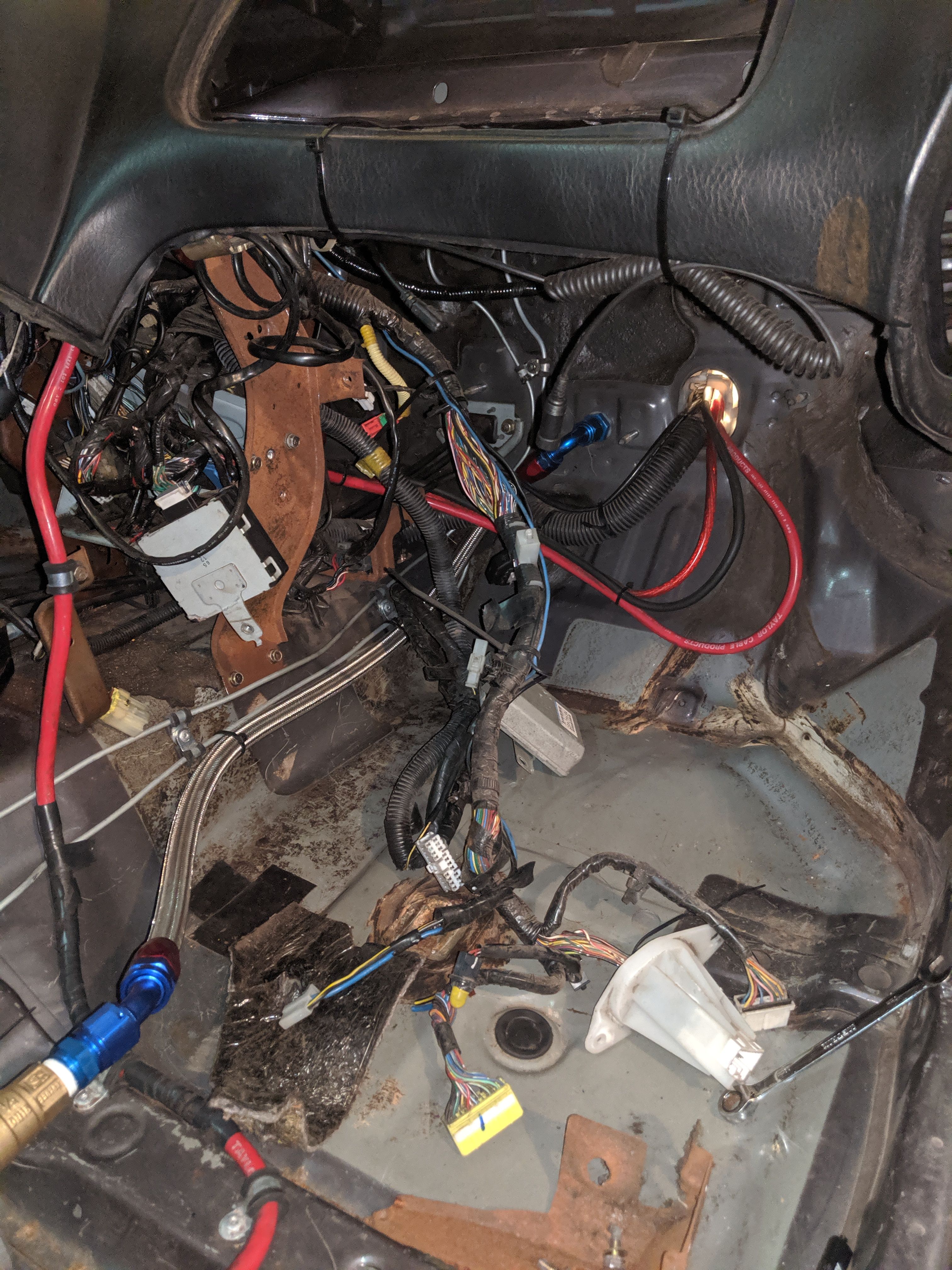

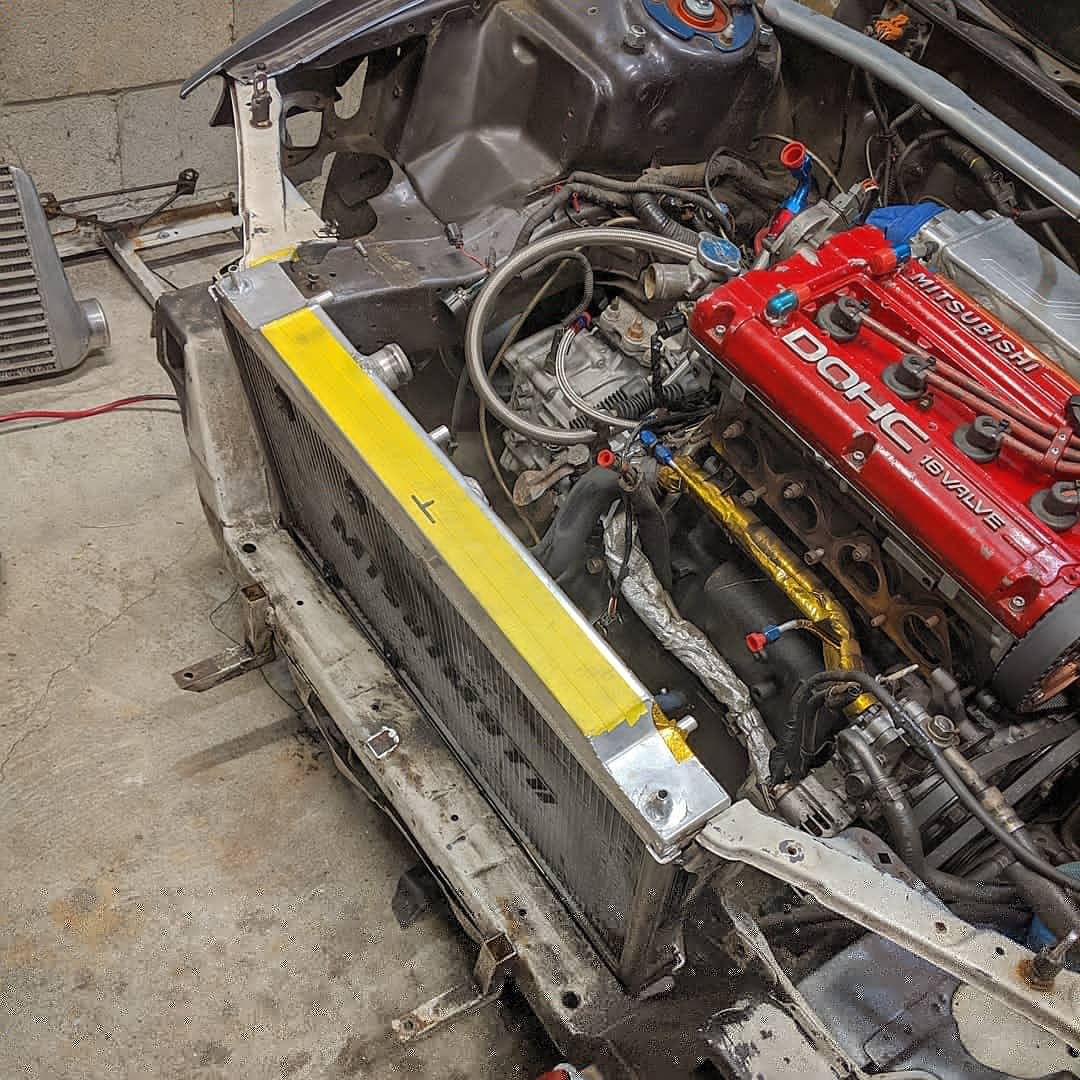

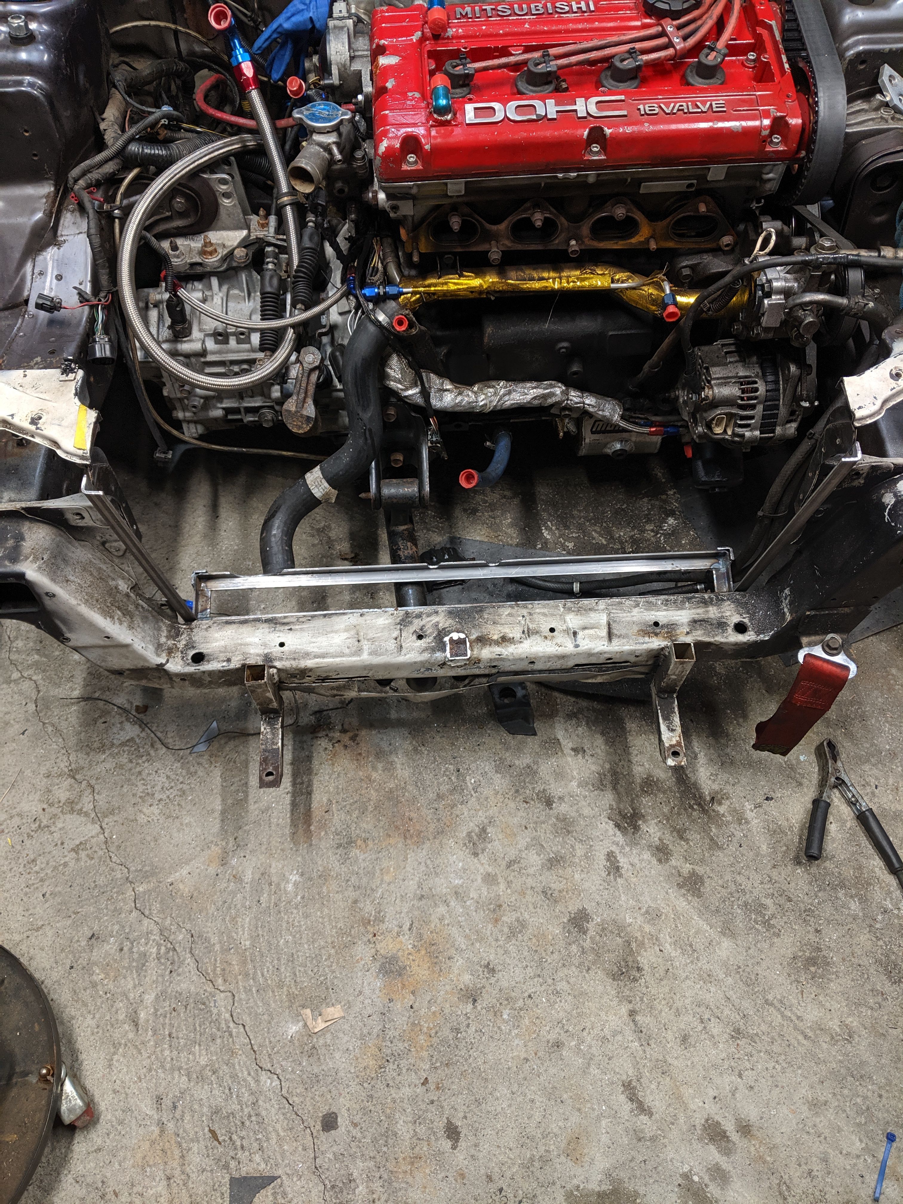

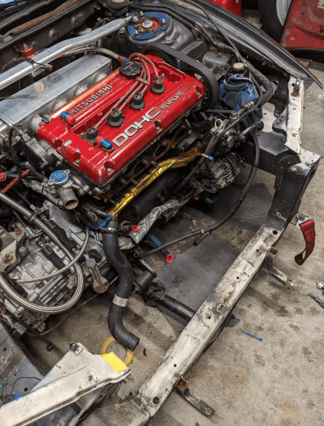

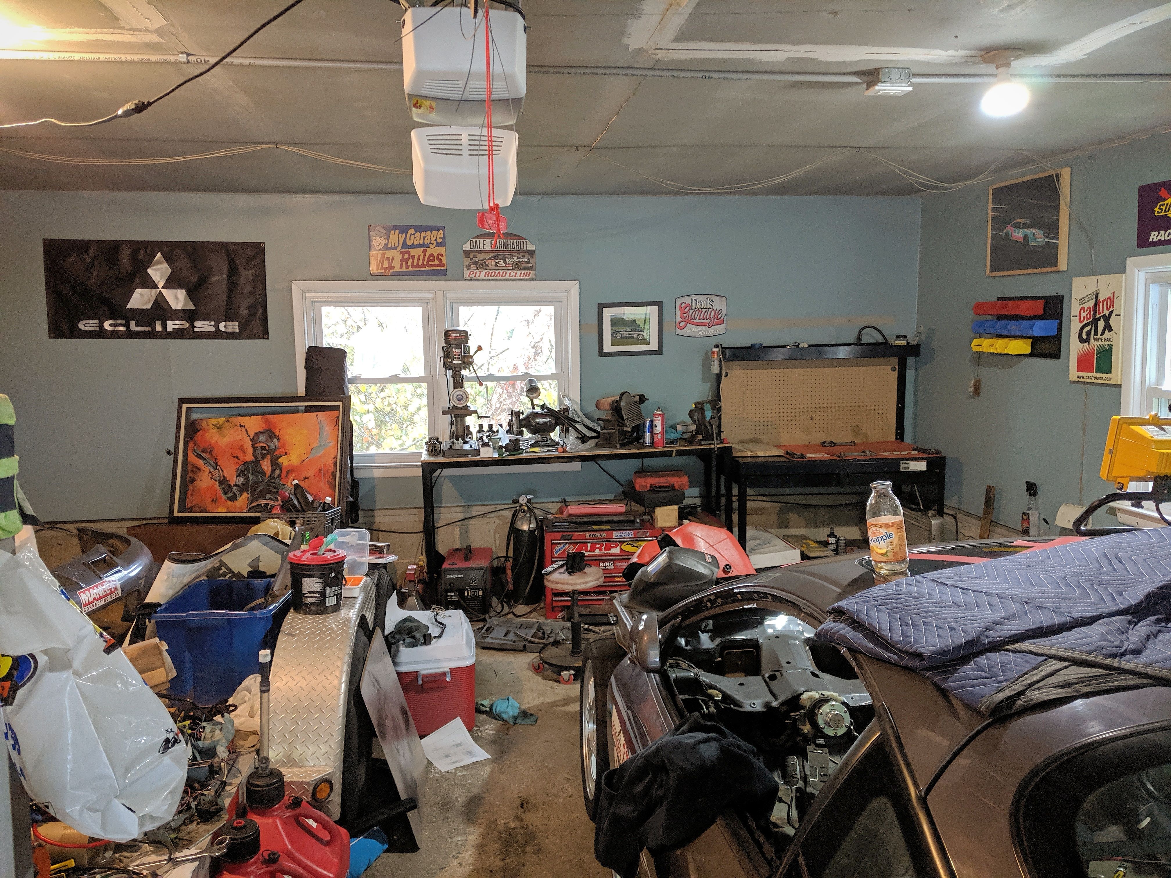

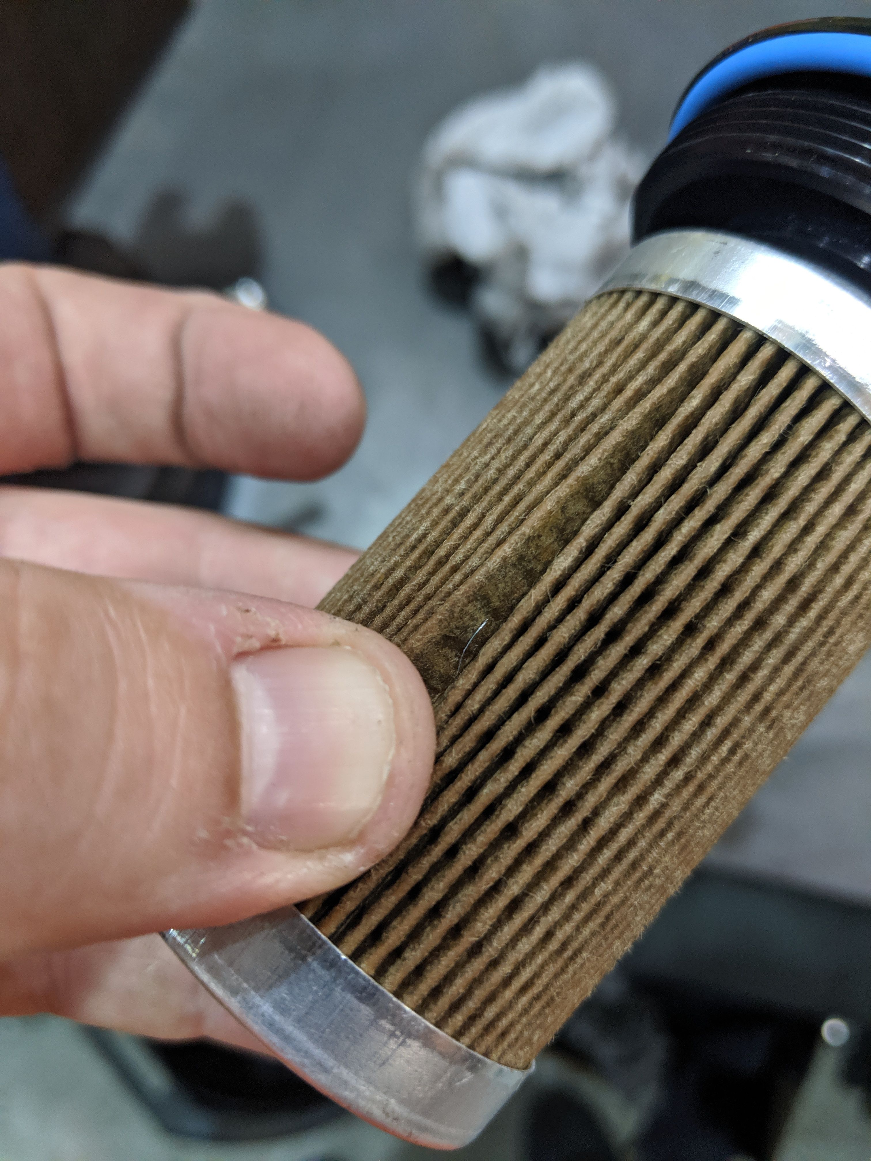

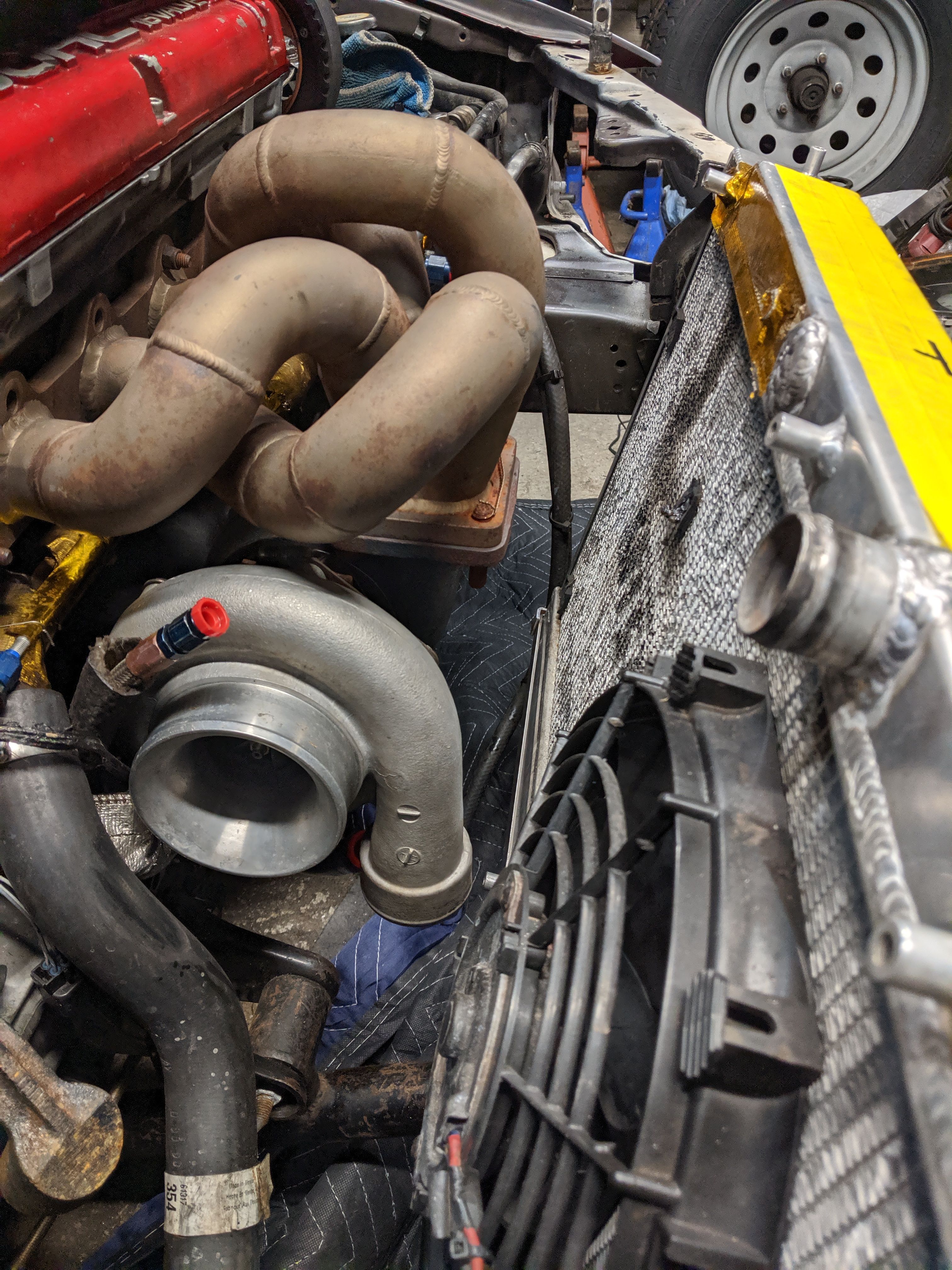

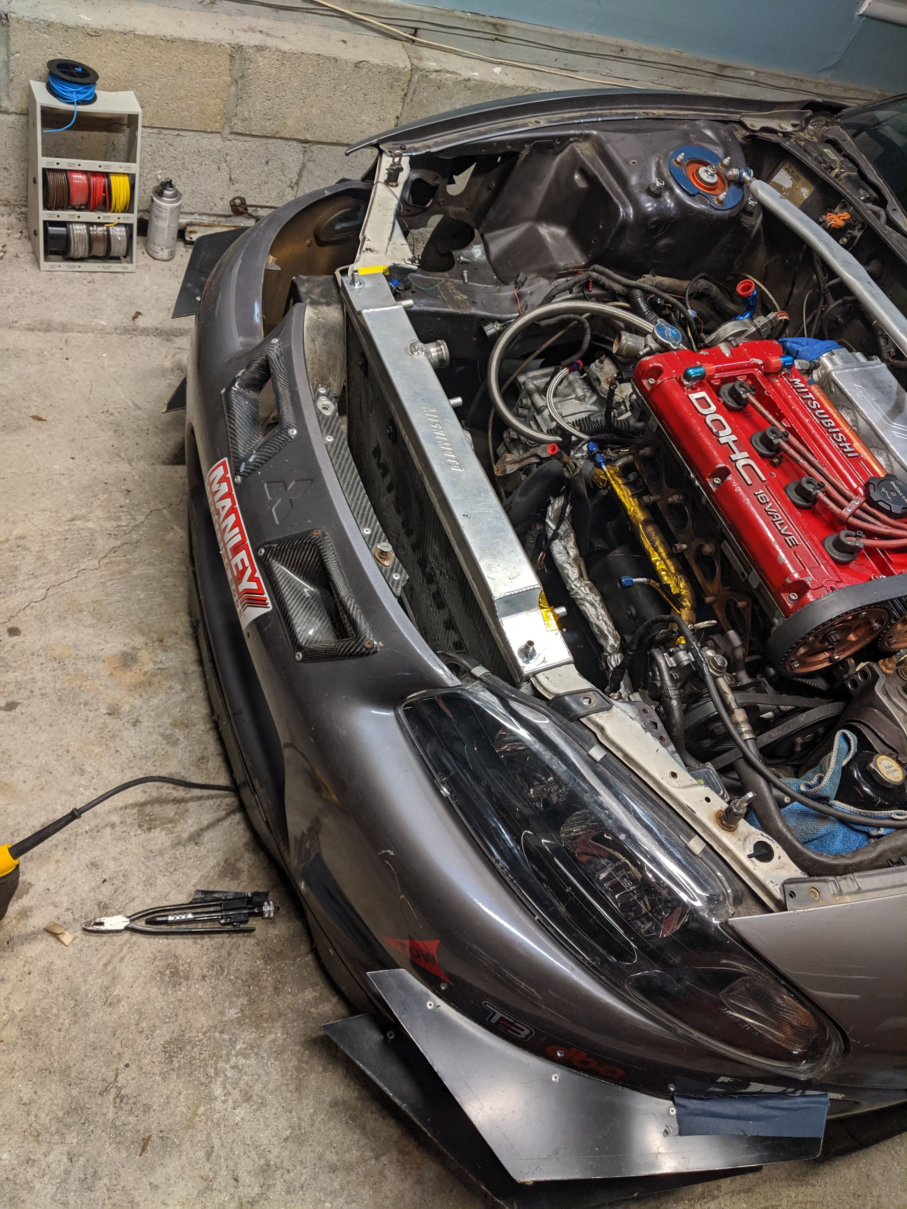

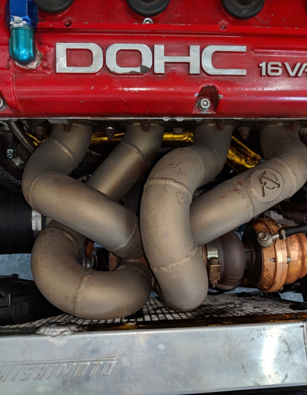

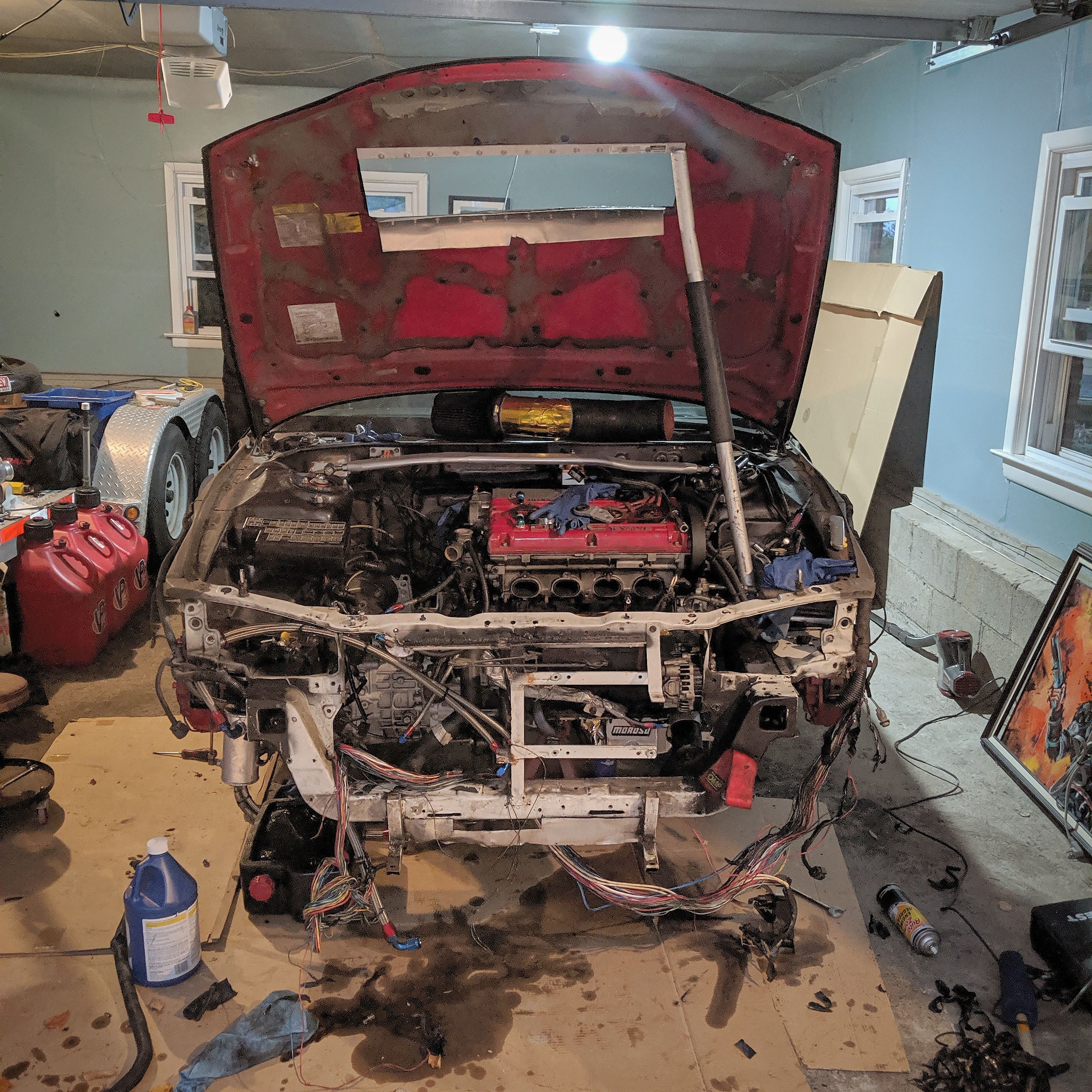

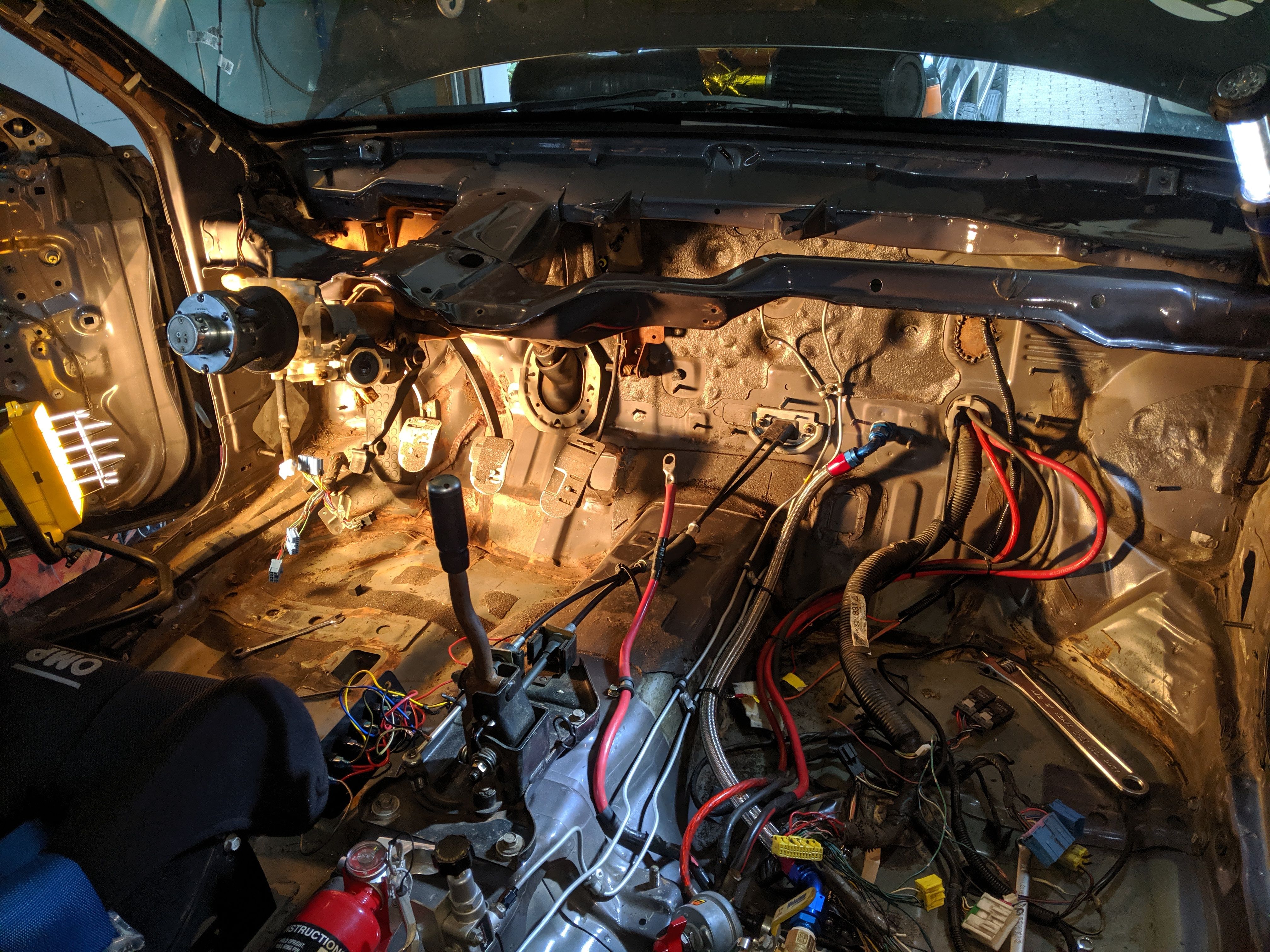

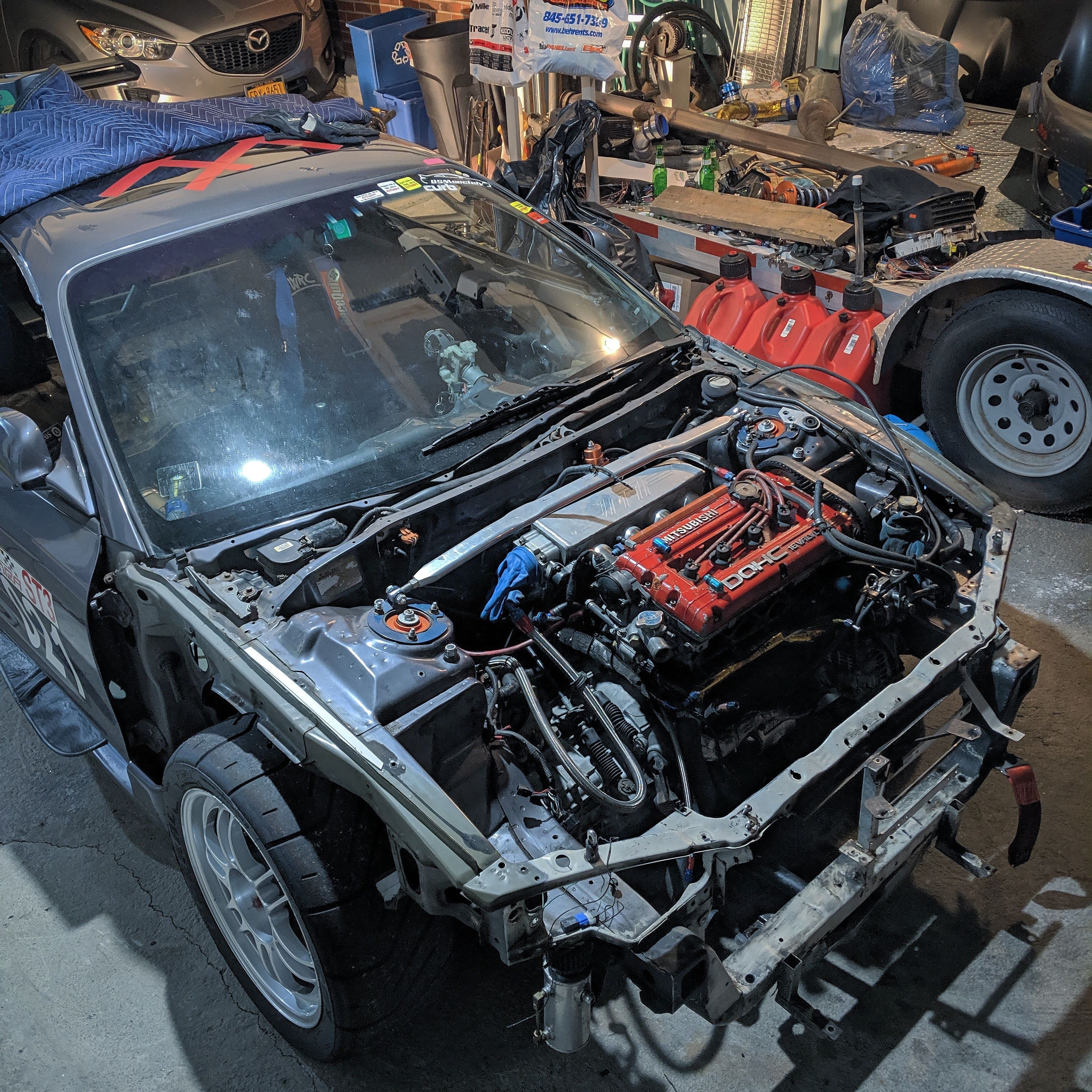

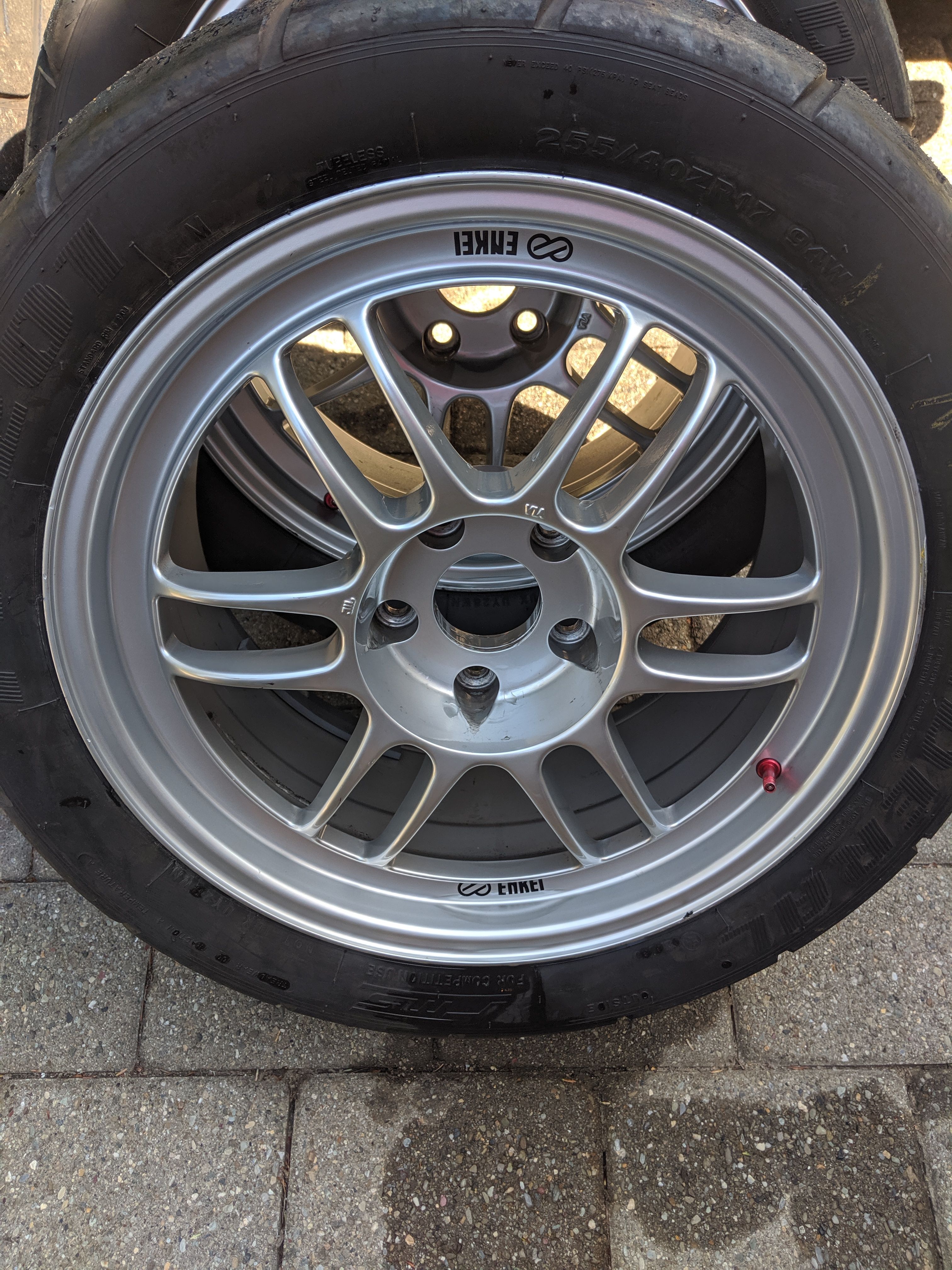

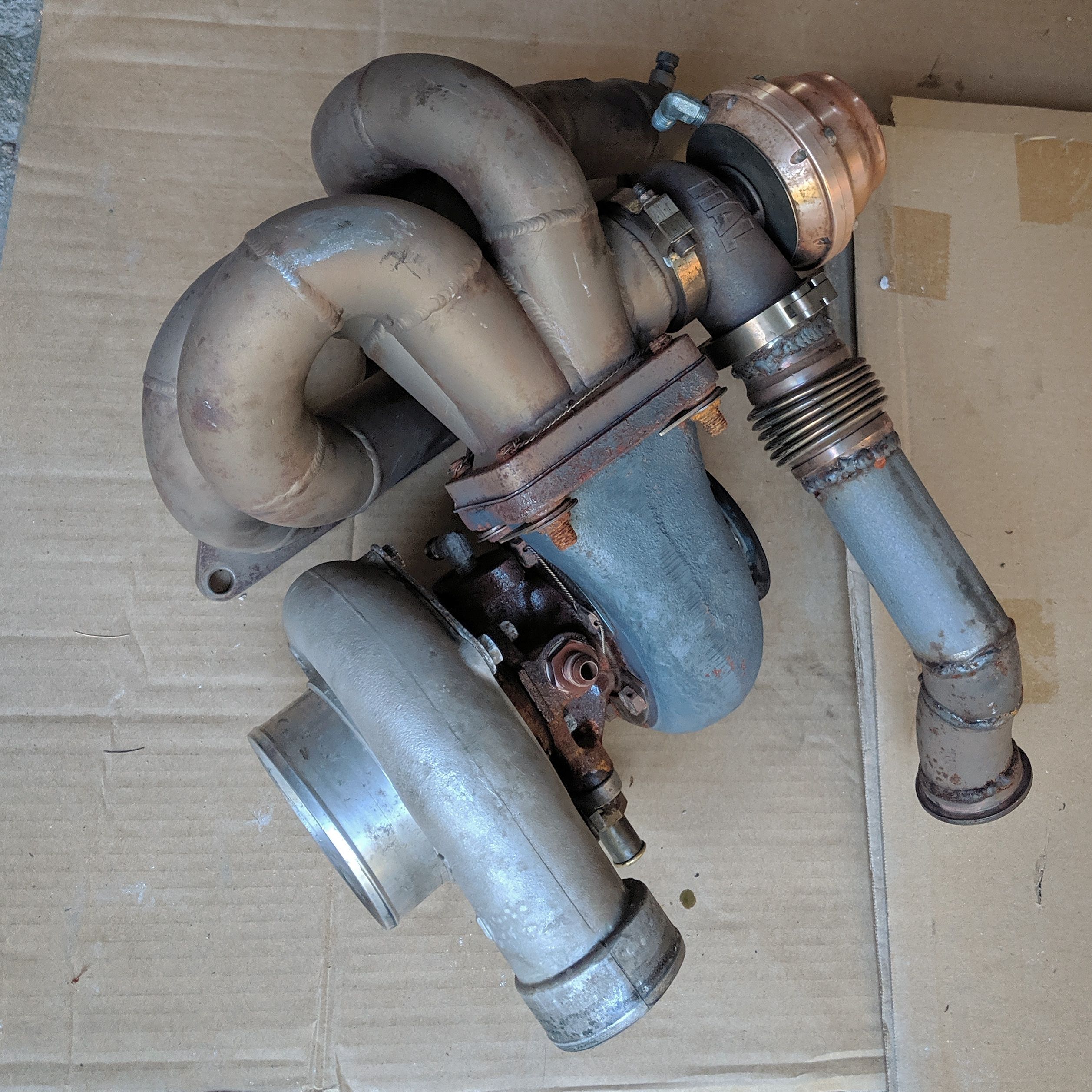

Got some work done over the weekend. Got the turbo setup out and apart. Gasket is good and blown out. Already in talks with Archer about the new setup so that's good. Also cleaned up the wheels and scrubbed them down really well. Other than that, just been dealing with house stuff. Trying to figure out a heat situation for the garage. But in due time.

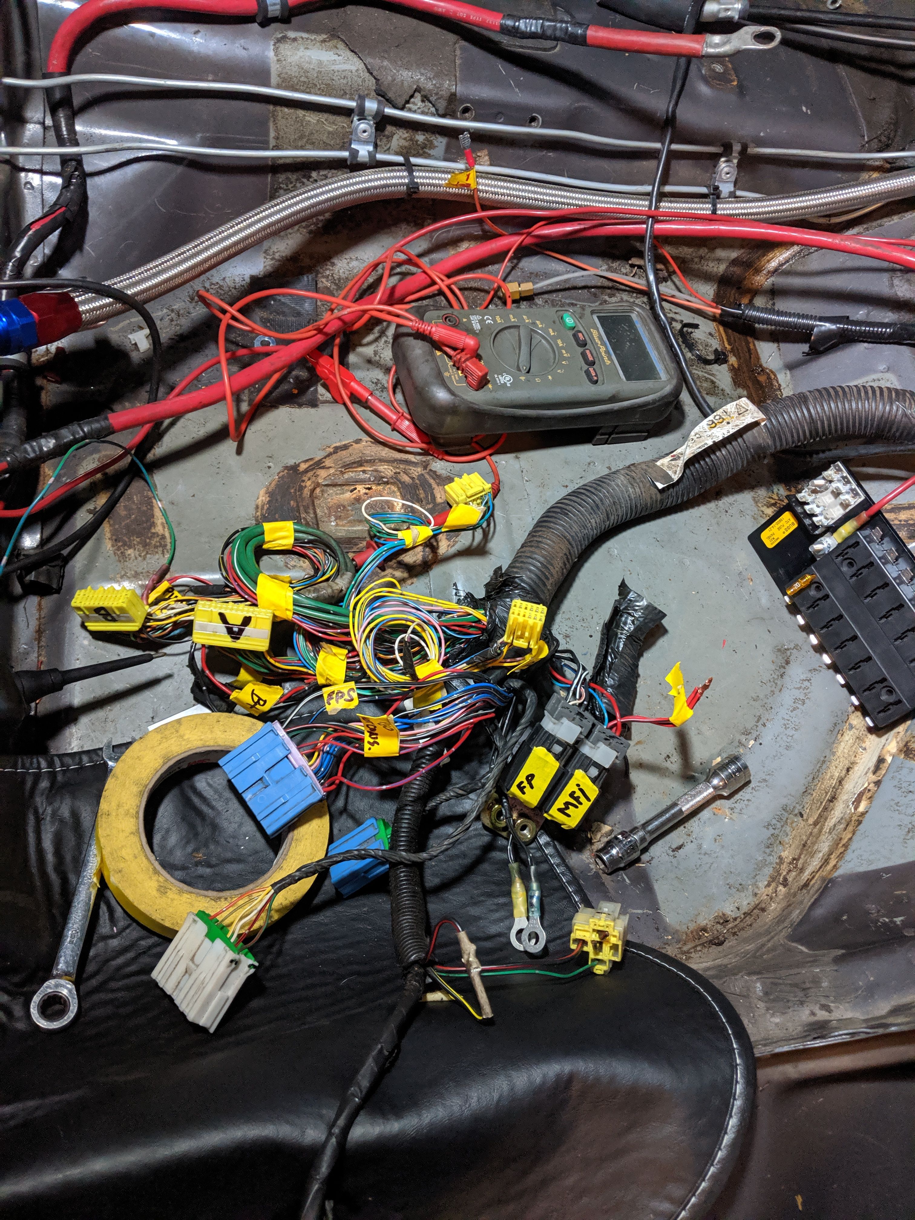

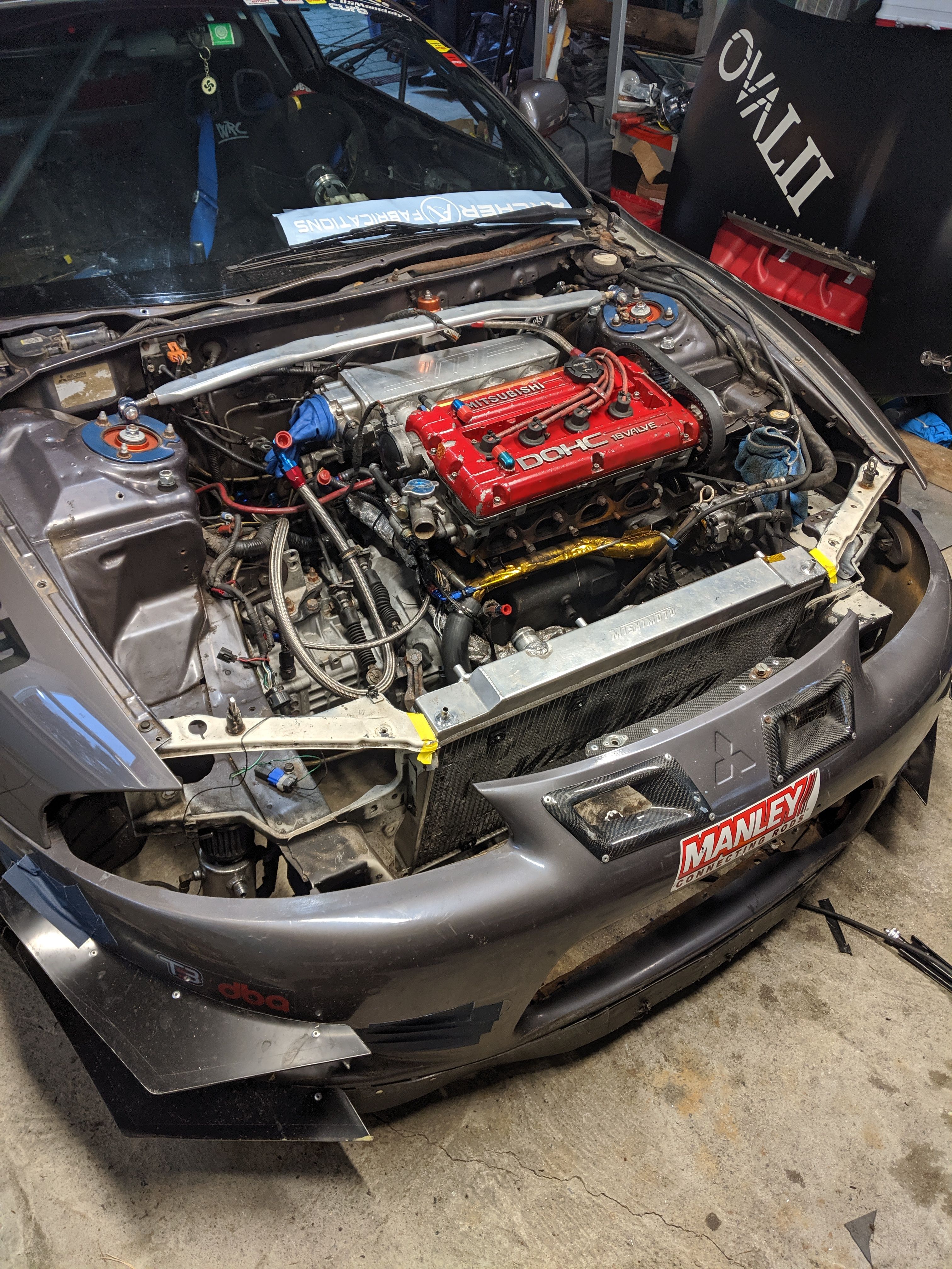

. Still don't have my toolbox or any of my benches or tooling at the garage yet, so I'm limited on my ability on what I can do. But at least now the cars in the garage right outside and I don't have to commute to work on it. As long as I can put some time into getting things done, shouldn't be a problem getting all my stuff done for next season. Need more light in the garage badly. Also got the fuel filter out and apart and found some metal in there. Just more proof it's time to change that pump out. Also found the giant ground wire that goes to the starter bolt on the trans was loose. Hoping that was also contributing to the fuel cut I was having at NJMP.
